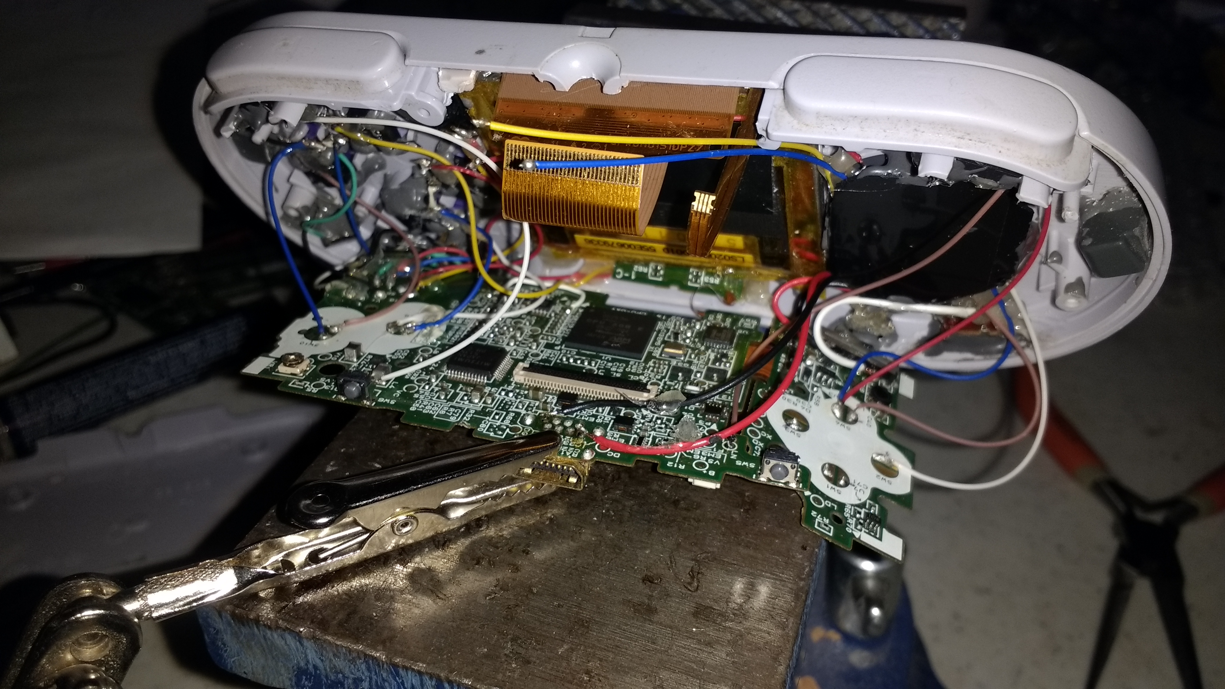

In case anyone is curious, I did eventually finish this and it works great! I ended up getting an EZ Flash IV, which I took out of its plastic shell, so it could live in this SNES controller semi-permanently. Ideally, I would have come up with a way to play carts on this thing without having to take them apart, but at least this doesn't have any gaping holes in it for the cartridge. And I do still use this to test carts that I'm troubleshooting, I just can't put the back cover on it when I do.

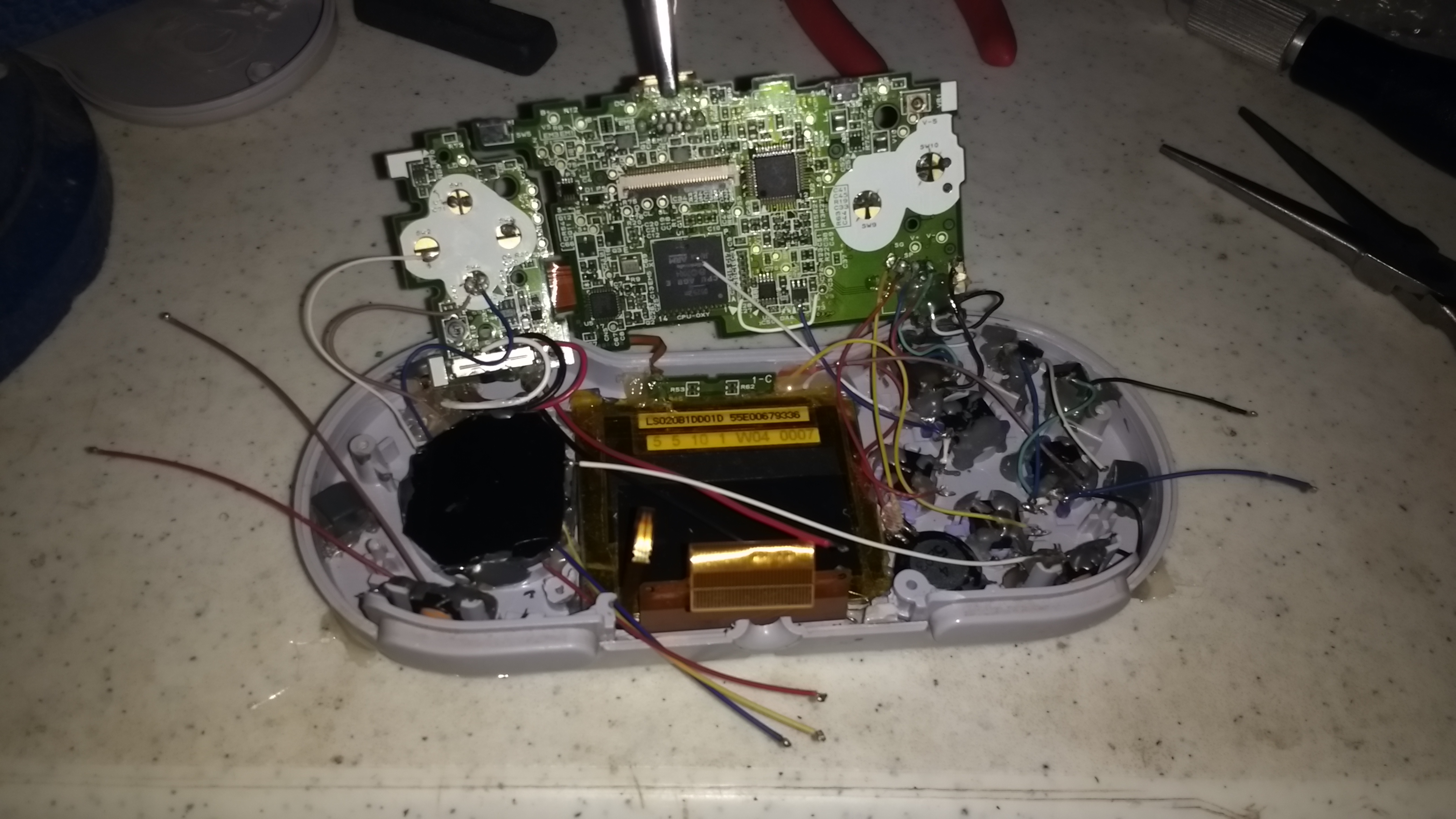

I did swap out the tacts on L and R in favor of squishy ones, which was annoying to do, but that's definitely one less regret I have for this project. Stuff like that is always worth it IMO. I got every button and switch glued to the front shell, with tinned wires hanging out, and then I started soldering them to the micro mobo, starting at the bottom, and leaning it further in until everything was attached. I made absolutely no effort to avoid spaghettification. It's a mess in there. After browsing worklogs on Bitbuilt, I definitely wish I had gotten some magnet wire, and fed everything via the top edge of the controller, so that when everything was attached I could just lay the board down and hot glue it or something. That would have made it much more serviceable in case something stops working.
It's held together with neodymium magnets, which are mounted on the grey rectangles visible on the far ends of the controller. So when I want to take it apart, I just grab both sides and pull it apart. The back shell isn't attached to anything on the inside. I thought I had more/better pictures, but these are the only ones I can find at the moment. I may need to take more.

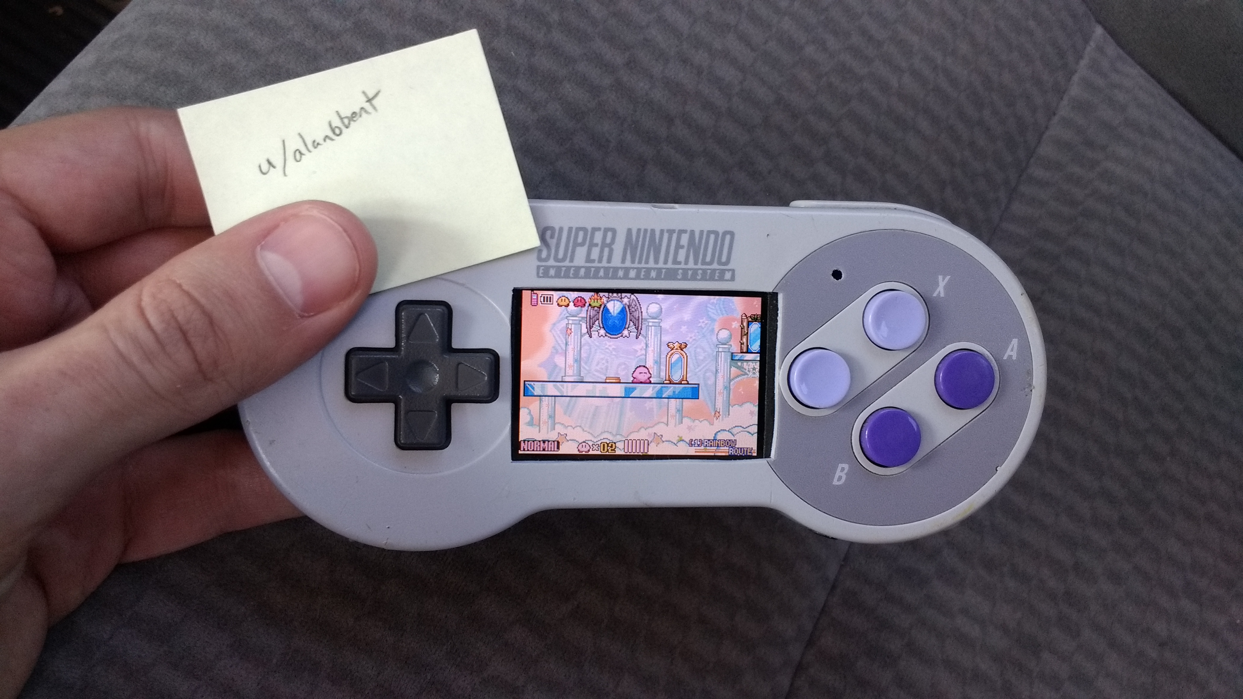

Then here's a picture I used to show it off on reddit a while back:
The hole next to the X button is where the speaker is. I like this thing a lot, but that hole for the screen isn't even remotely rectangular. And looking at this picture, the screen looks a little skewed. I've always been bad at cutting straight lines out of plastic. Definitely something I need to figure out for future projects. There's also nothing protecting the screen, maybe I could use some peel-off film for it. But anyway, there it is.
