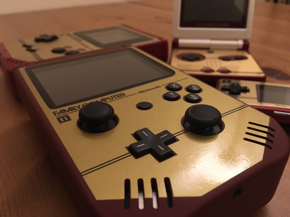

It's been a long ride building this Gboy but I am so thrilled to have finally finished it! My goal with this build is to aim for a portable that could be as close as possible to something that Nintendo could have made. The kit is from the last batch of kits that Gunnar put on sale at the end of 2021. I'll go over the different aspects of this bad boy:
The shell, buttons, lens and gold sticker
Wii portables often lack a lens which is something that I've always found a bit odd. I found this lens that fits perfectly in a DMG-styled cutout. Unfortunately I have no 3D modeling skills so I sent one lens to Curtis (a member from the BitBuilt and Shank Discord servers) who was kind enough to modify the shell to fit the lens. The rest of the shell as well as the buttons are untouched from Gman's original files. I ordered the print from PCBWay:
  • Shell: Standard White Material (UTR 8360) with Pantone 188 C spray painting (I found the Famicom color tone on this website).​

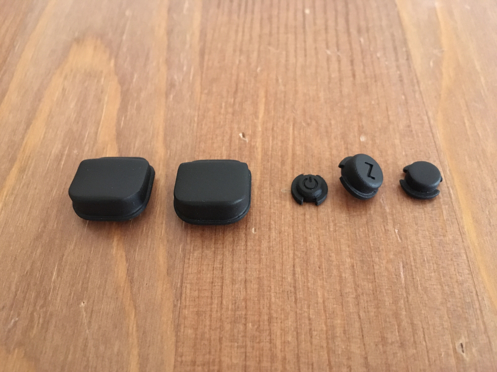

For the DS Lite buttons and membranes, I salvaged them from a broken DS Lite I bought online. From the different mods I made on Gameboy consoles, I've come to trust only OEM membranes as they have the best feeling and responsiveness. I took the opportunity to reshell the DS Lite as well.
All buttons work great but I have a small issue with the D-Pad horizontal axis (left and right). You have to insist more for them to register properly. From what I've read I'm not the first person to have this problem and it seems the 3D model is slightly off on that part of the design.

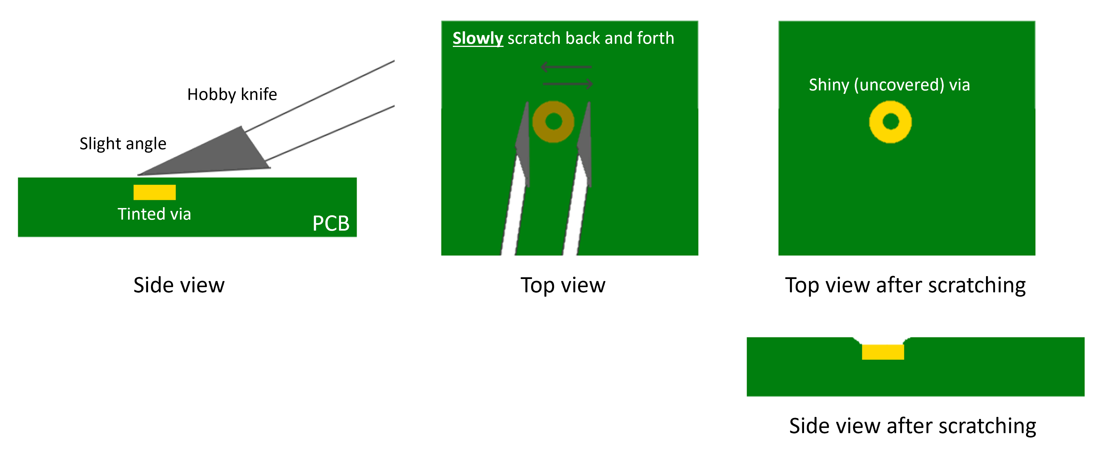

I've gained my soldering experience mainly from Gameboy modding. For the Wii what I found the hardest was working with vias. This is the technique I am now using to properly solder to vias, in case it might be of help to someone who's also having trouble. The thing is to be very patient and go slowly to avoid seriously damaging the vias:

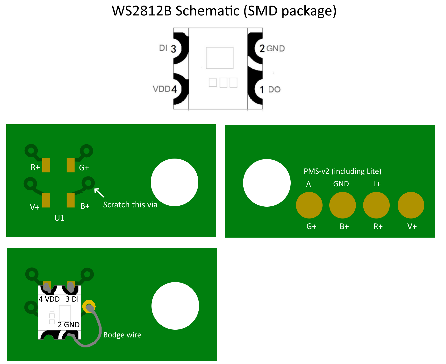

Regarding the LED, you can't really use the included LED with the RVL-PMS-2 as it just does not fit in the shell. For another Game Boy mod I'm doing (a DMGC for those in the know) I bought some SMD WS2812 LEDs (these ones) and used them in place of the original Gboy LED. I used the original LED PCB to jank the LED inside: the footprint is not big enough to cover the 4 pins of the new LED. Here's what the first iteration of it looked like, on the right you have a diagram of how I ended up doing it for those who want to keep the LED PCB (one wire instead of two in my first attempt):

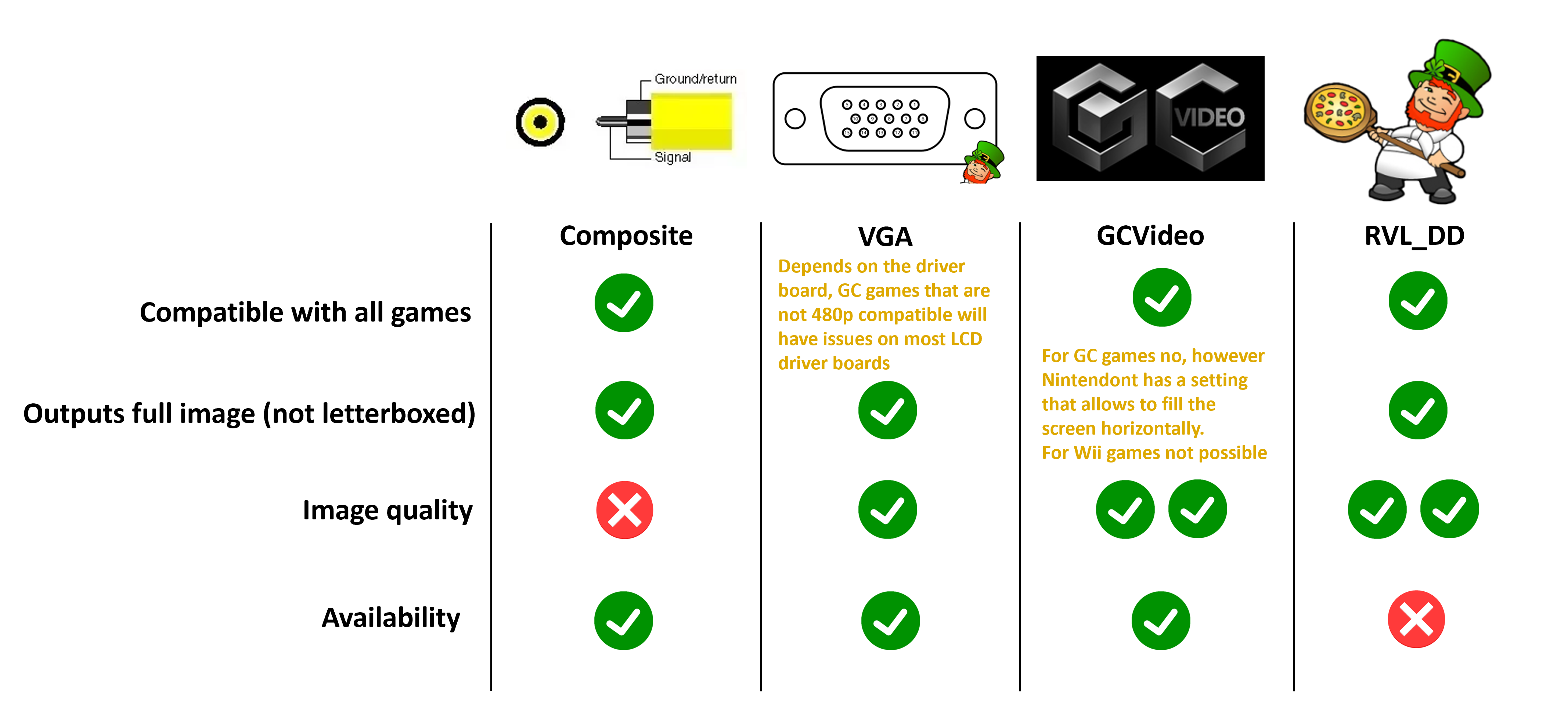

Now the most interesting part IMO, the choice of video output, here's a diagram that summarizes my vision on the different video options for the Wii. This part is often overlooked but it's a rather complex point with no easy solution:
Basically every system has its benefits and drawbacks. What I soon found out is that the VGA patches (which are made by @Aurelio) are great but some GC games just won't boot because they are not compatible with progressive scan, will output an image at 480i (interlaced) and that specifically is not compatible with all LCD driver boards (feel free to correct me if this is wrong). I wanted to have a system with no compromises on what games I could play, unfortunately the RVL_DD has been out of stock since end of 2020 and I wanted to move forward with my build. I thus settled with a GCVideo system for maximum compatibility and best image quality, and bought an AVE-HDMI from Electron-Shepherd. Mine was the previous iteration on a normal PCB, not flex. For the screen, I used the famous Wisecoco 3.5" IPS screen that you can grab here.
For the AVE-HDMI install, I removed the AVE_RVL with hot air from the Wii, used magnet wire according to the provided diagrams. On the screen board PCB, I removed the HDMI connector and replaced it with a 19-pin FFC connector. Regarding the AVE-HDMI board, as I am not using audio over HDMI, I didn't wire ADATA, LRCK neither BCLK. I had seen that @vipe_202 also didn't do it on his Zelda Partybox. However after wiring everything I didn't get an image. Initially I thought there was an issue with the PCB, so I sent back the board to Electron-Shepherd to test it and turns out it was working perfectly. I got the board back and after testing it turns out you have to have BCLK wired for GCVideo to properly initialize. This is only true since GCVideo firmware version 3.1 (maybe 3.0). As I said these technical points are tough to nail down and I only found out because as I was testing my board I saw that it would output an image only if I put my thumb on the PCB where the BCLK pad was. I also looked at GCVideo's source code on github and noticed that Ingo had changed how it initializes, now requiring the BLCK line to be wired.

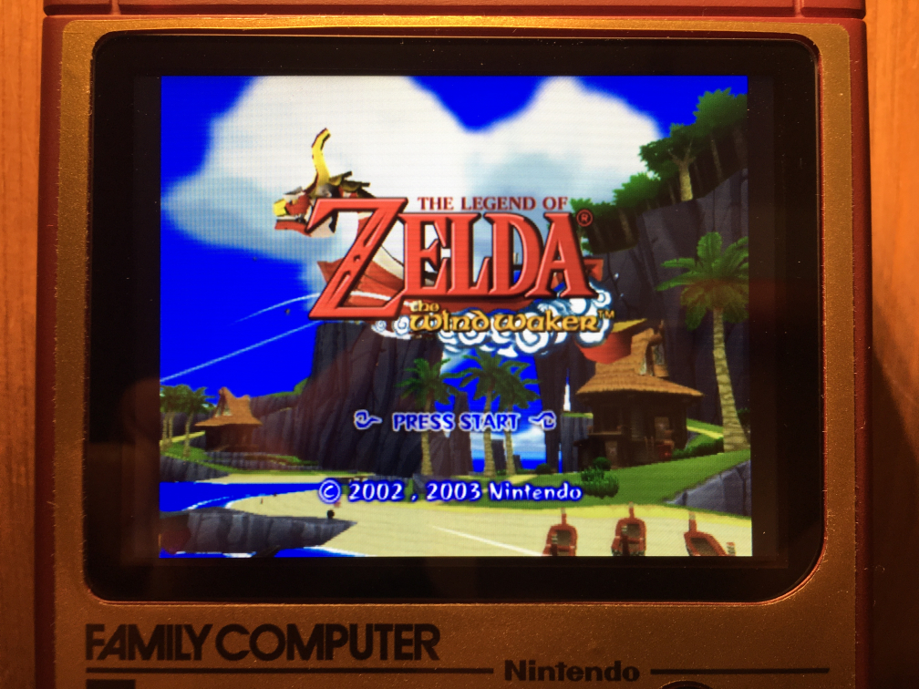

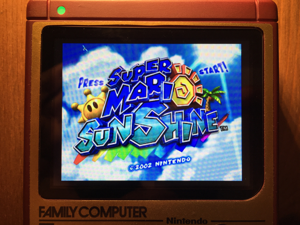

Regarding video output, the way GCVideo works means by default GC games are letterboxed and most Wii games as well. Some games will have black borders on all sides (as Super Mario Sunshine), while others only on the left and right side (like Wind Waker). This depends on the original resolution at which the game outputs (getting technical), unfortunately none of the GC games output an image at 720 pixels width (which is what this screen's width is at). I only recently found out a workaround for this: Nintendont has a "Screen Width" option that lets you change the width to 720, meaning I can get a full image on some GC games. I have to test this setting on all my games. This is where RVL_DD is better than a GCVideo solution: it integrates a scaler that will deliver a fully-sized image. Frankly the letterboxing does not bother me that much, and now that I know that there's a possible software fix it means that only a few GC games will be letterboxed. For Wii games, I don't know if Hiidra could force an output of 720 pixels width. All that being said: the quality of the image on this IPS screen is just fantastic!! I couldn't compare with VGA patches, but according to @thedrew (see here) it looks better.
Another bummer is that it seems that GCVideo is not compatible with GC+2.0 as of now. GCVideo has an OSD and brightness control which I can't access because of this issue. Hopefully it could be fixed one way or another in the future.
Sorry for the contrast but the screen was left with the brightness set quite high, and I can't change it unless I open up the Gboy again. I also shot a video showcasing how the Gboy works with GCVideo: it takes a bit of time to initialize and when you launch games it drops frames everytime there is a screen resolution change. Once you're playing though it's top notch!

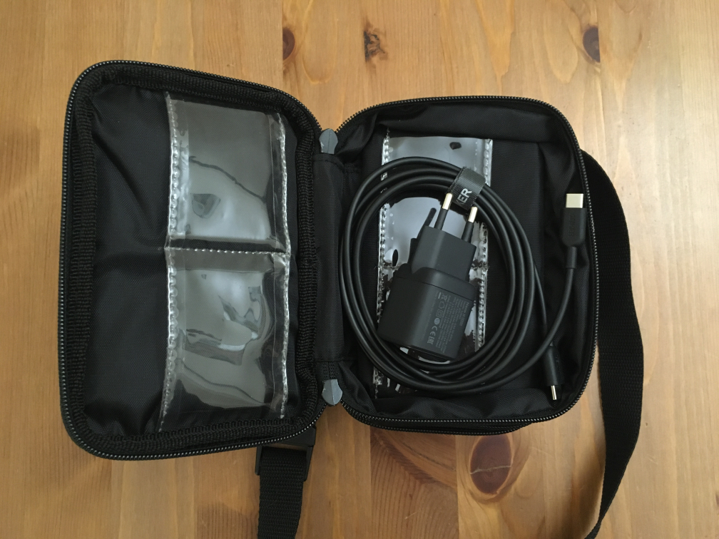

The main advantage of the Gboy is its form factor that is based on the DMG. That allows me to use original accessories such as DMG travel bags to keep my Gboy stored along with its Anker charger: it just feels right.
