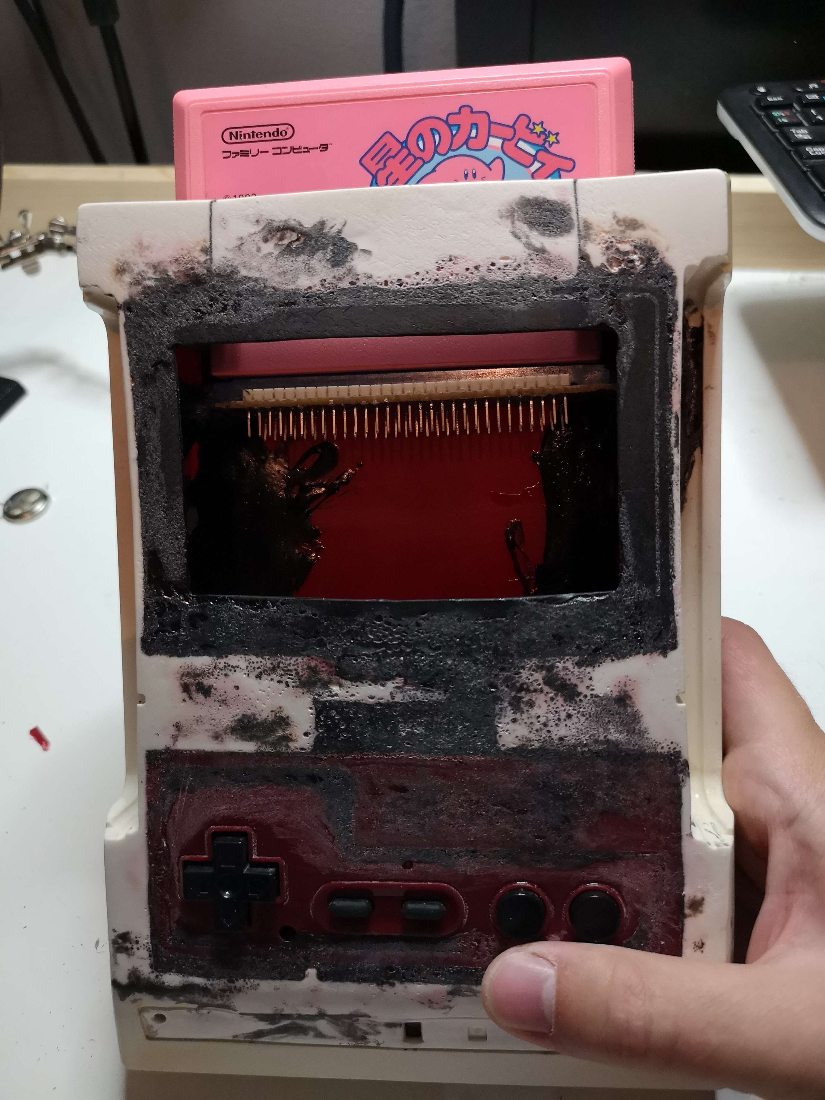

I do not have a fancy 3D printer, so no custom case. However, I found something even better :D... I'm going to use the Famicom... as the case! Let's get started!!!

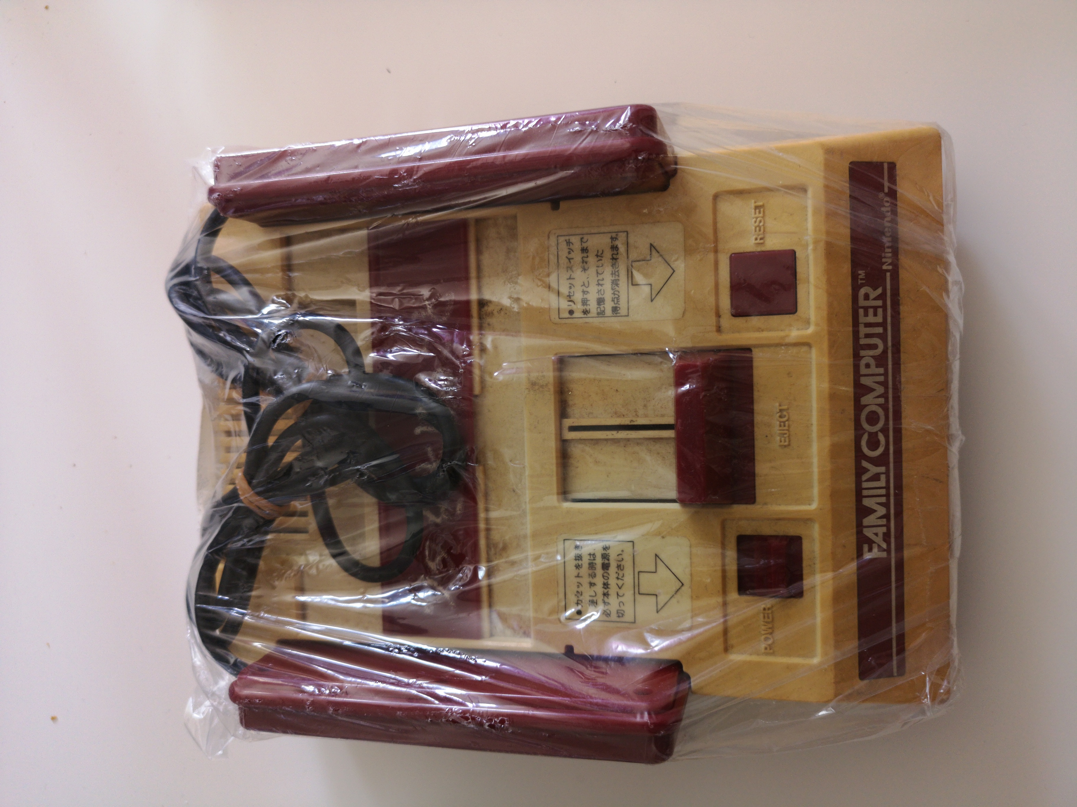

So I got the most ugly Famicom i could find on Ebay:
Removing and cleaning the dirty PCB, then testing it, everything works, great!

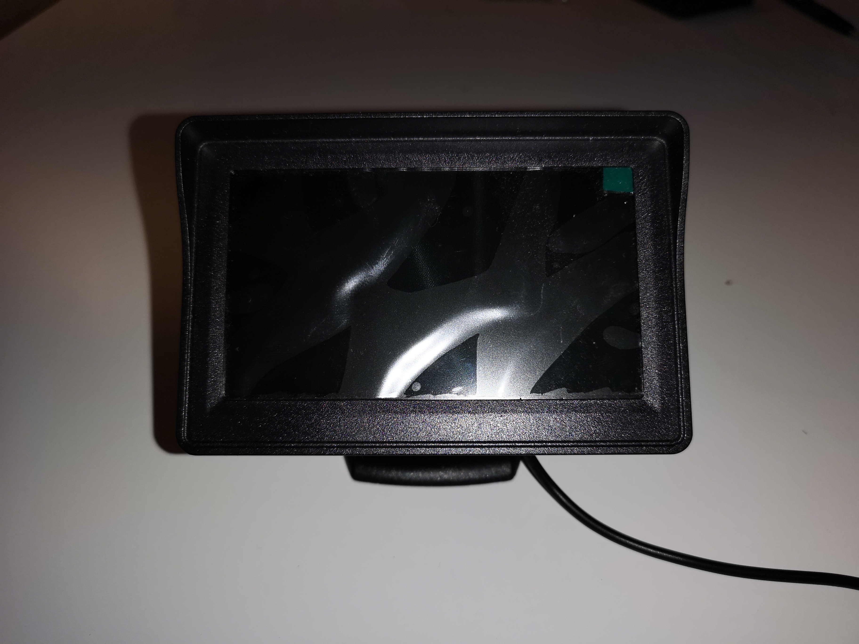

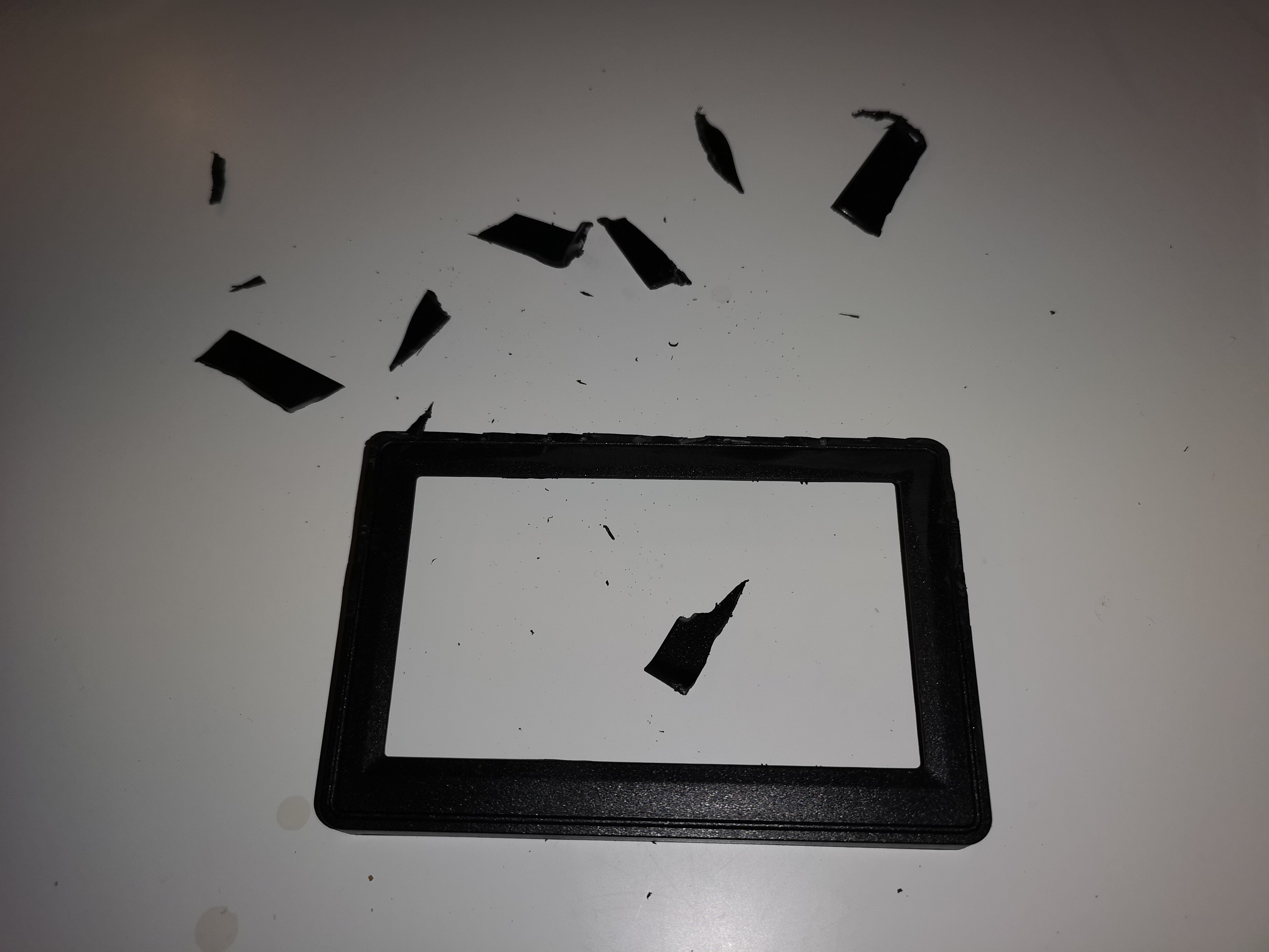

Going to use a standard screen that most people seem to use. Starting with flatting the edges

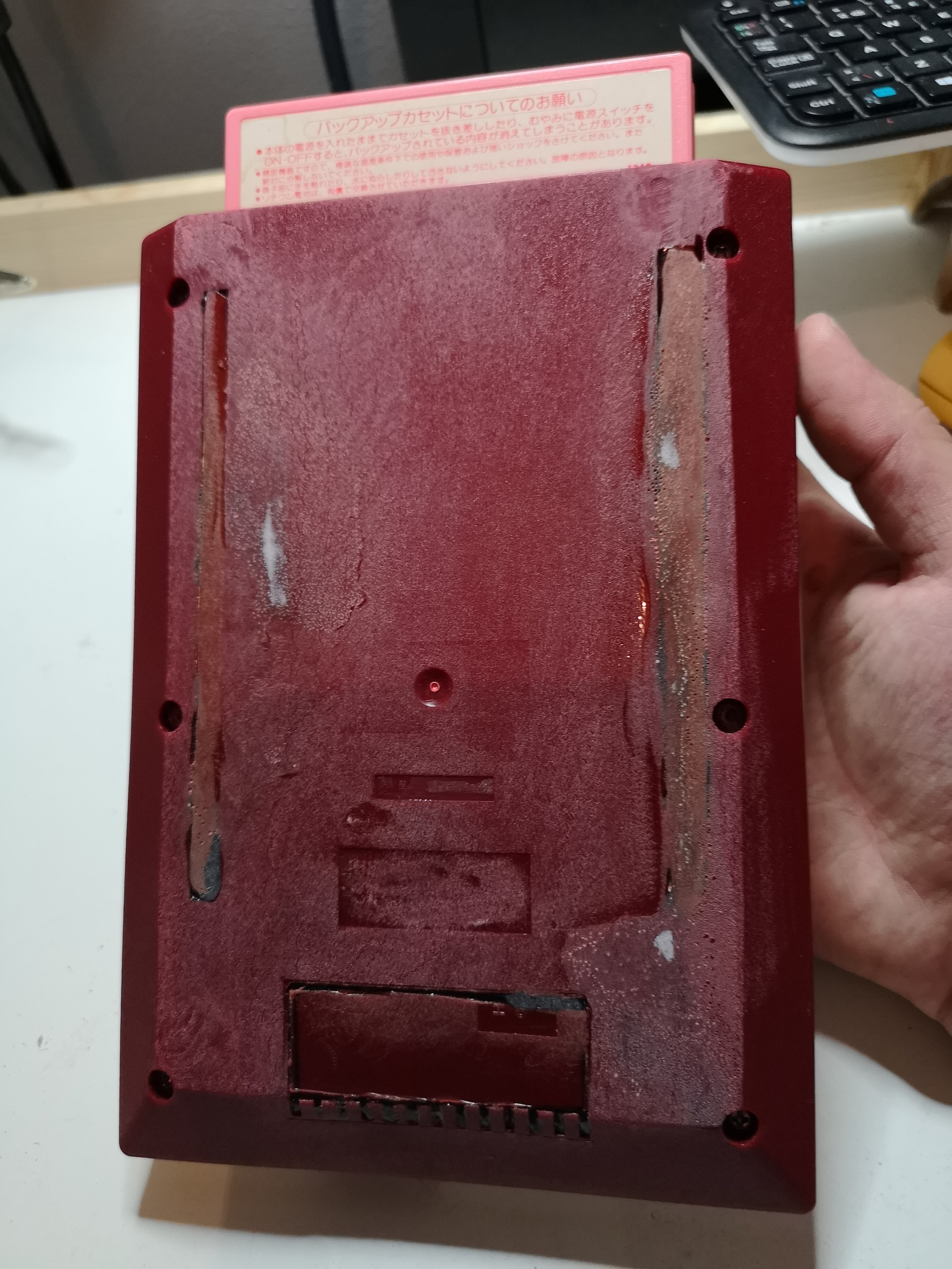

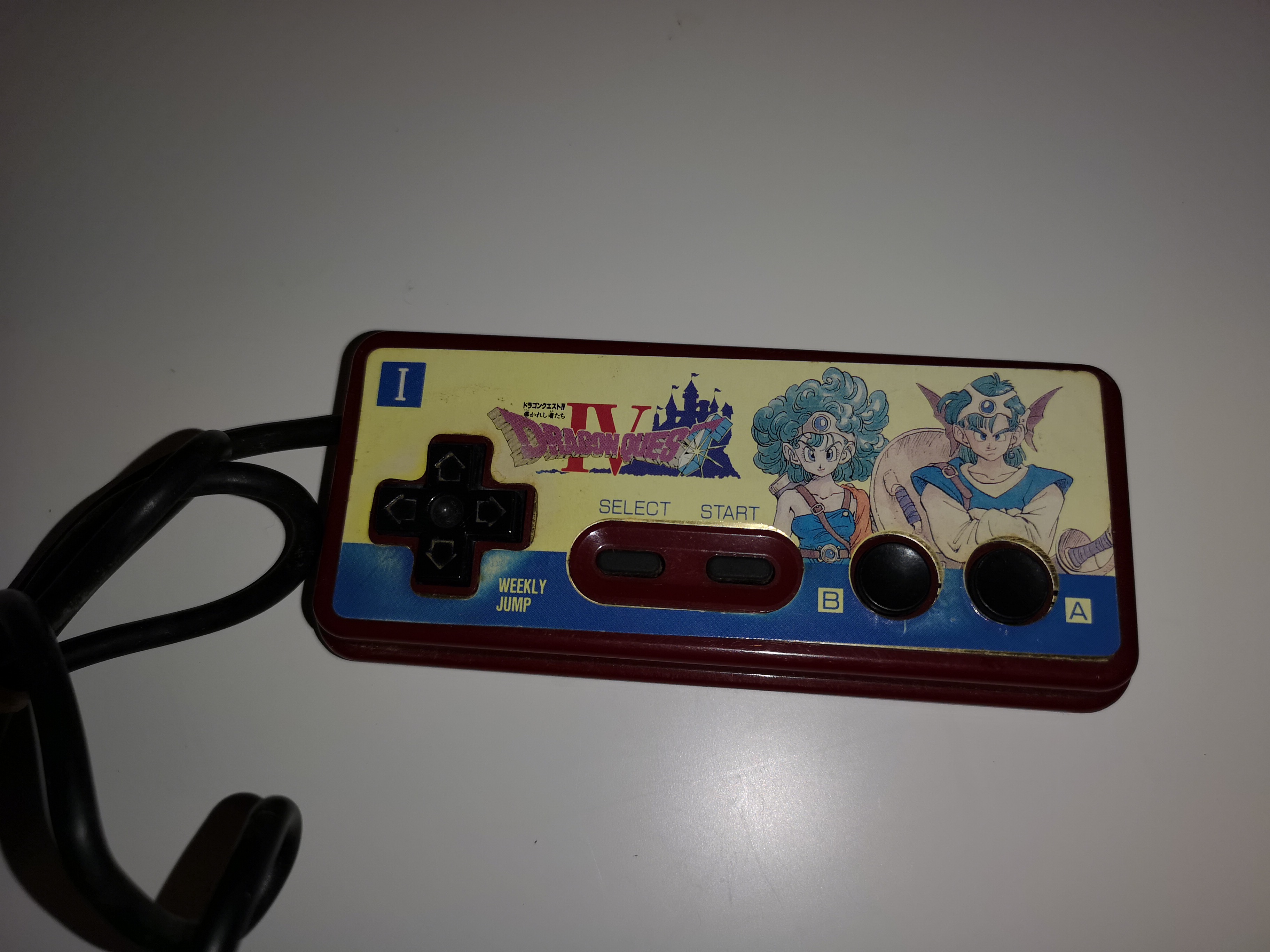

Someone had placed a sticker on the controller, so I had to remove it and the gold decal.

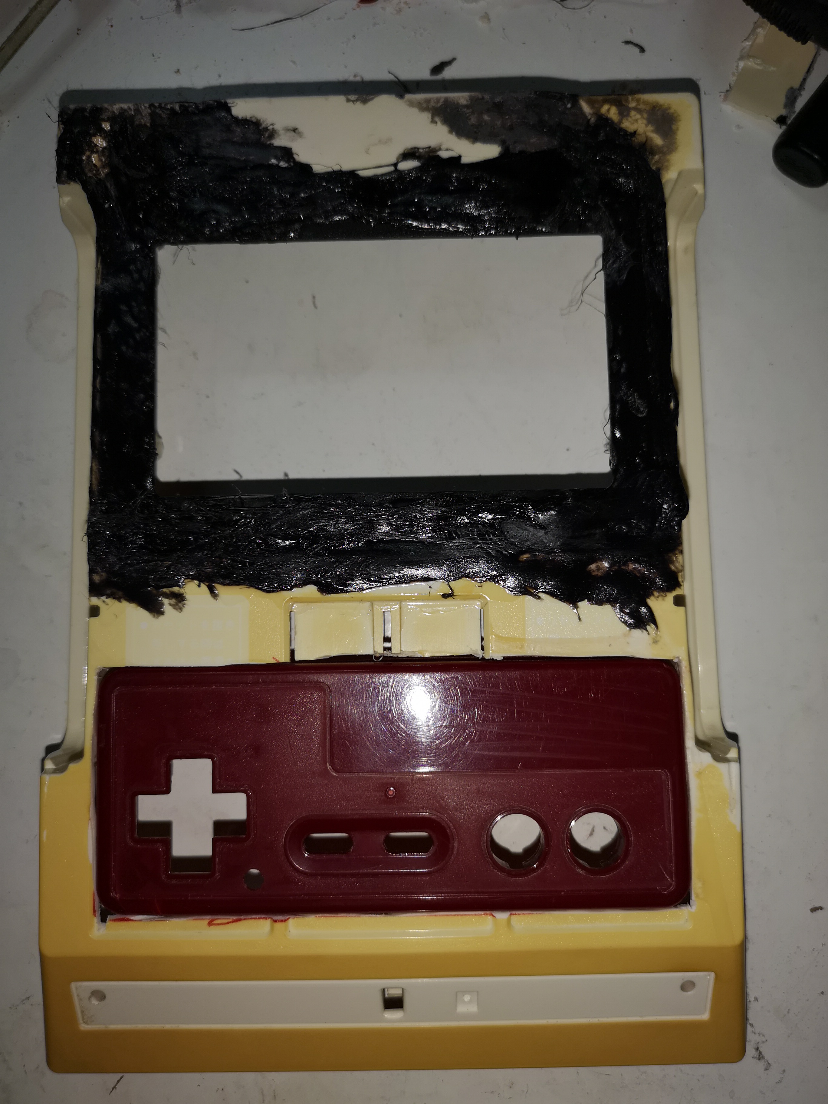

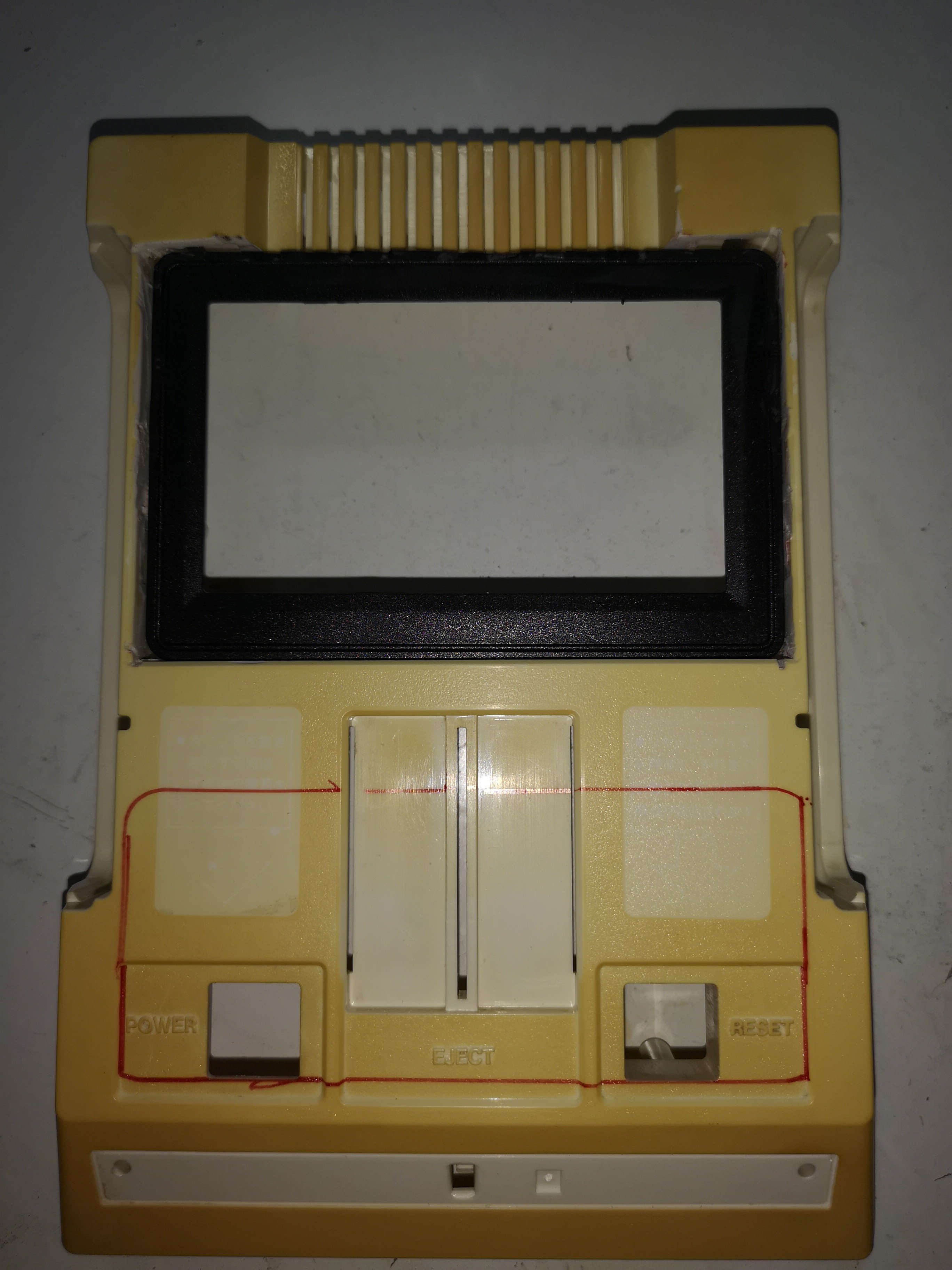

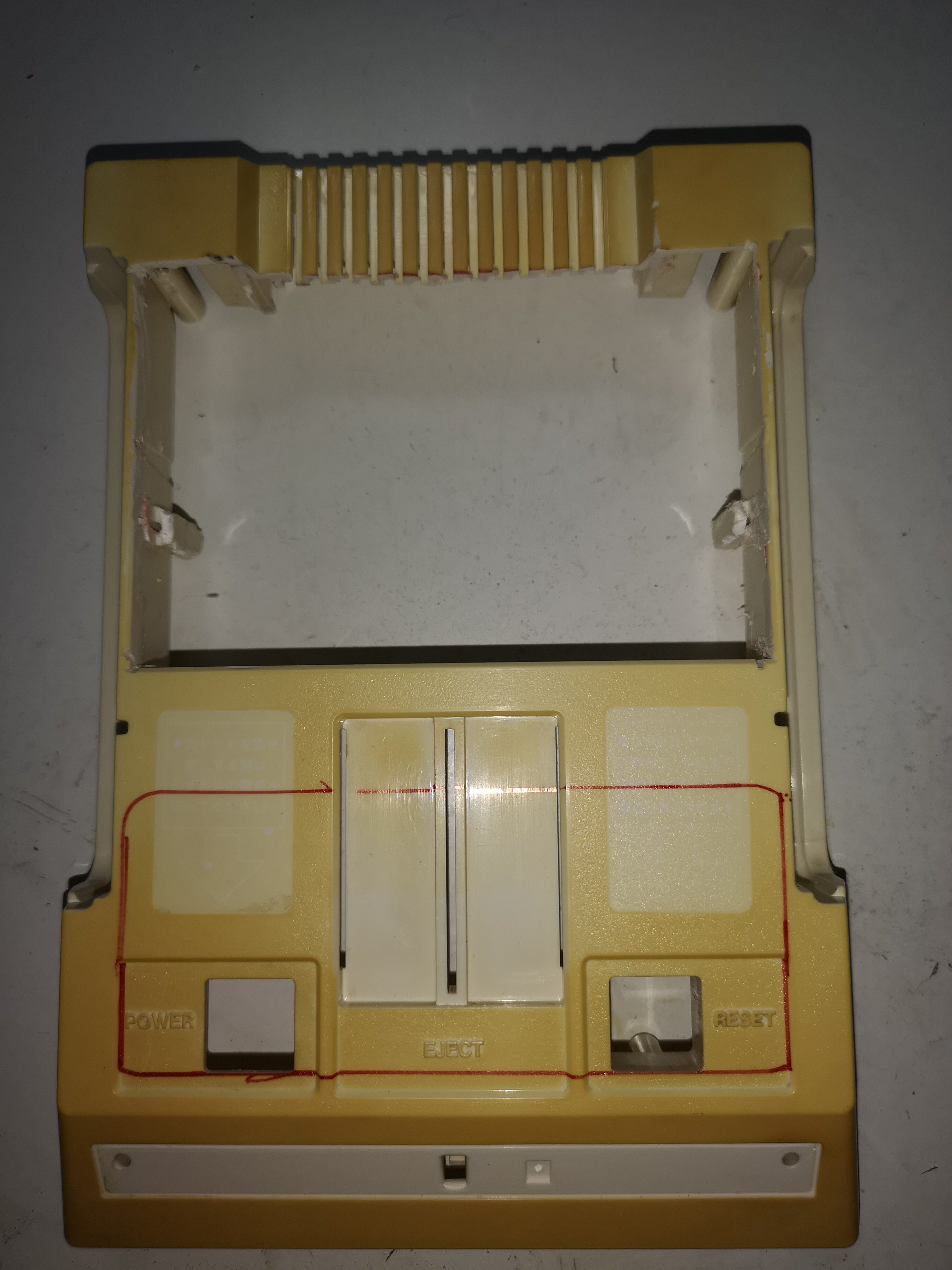

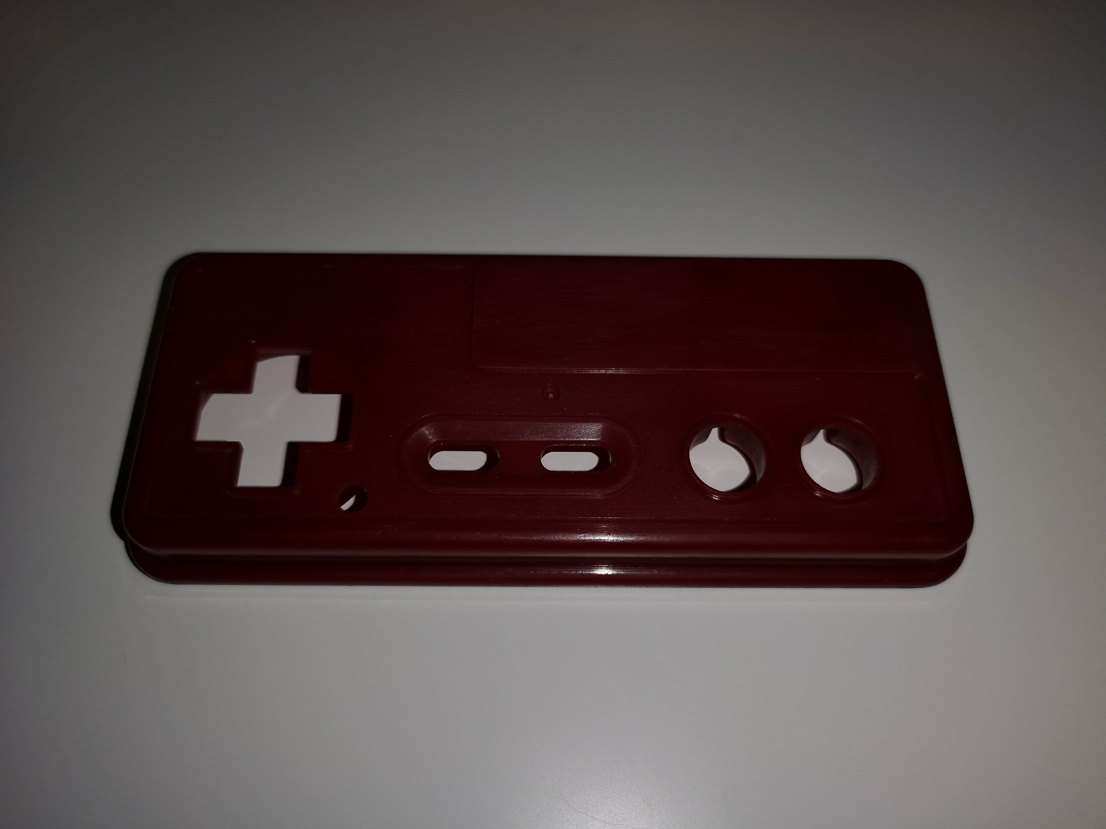

The case has a perfect size for the screen and controller.

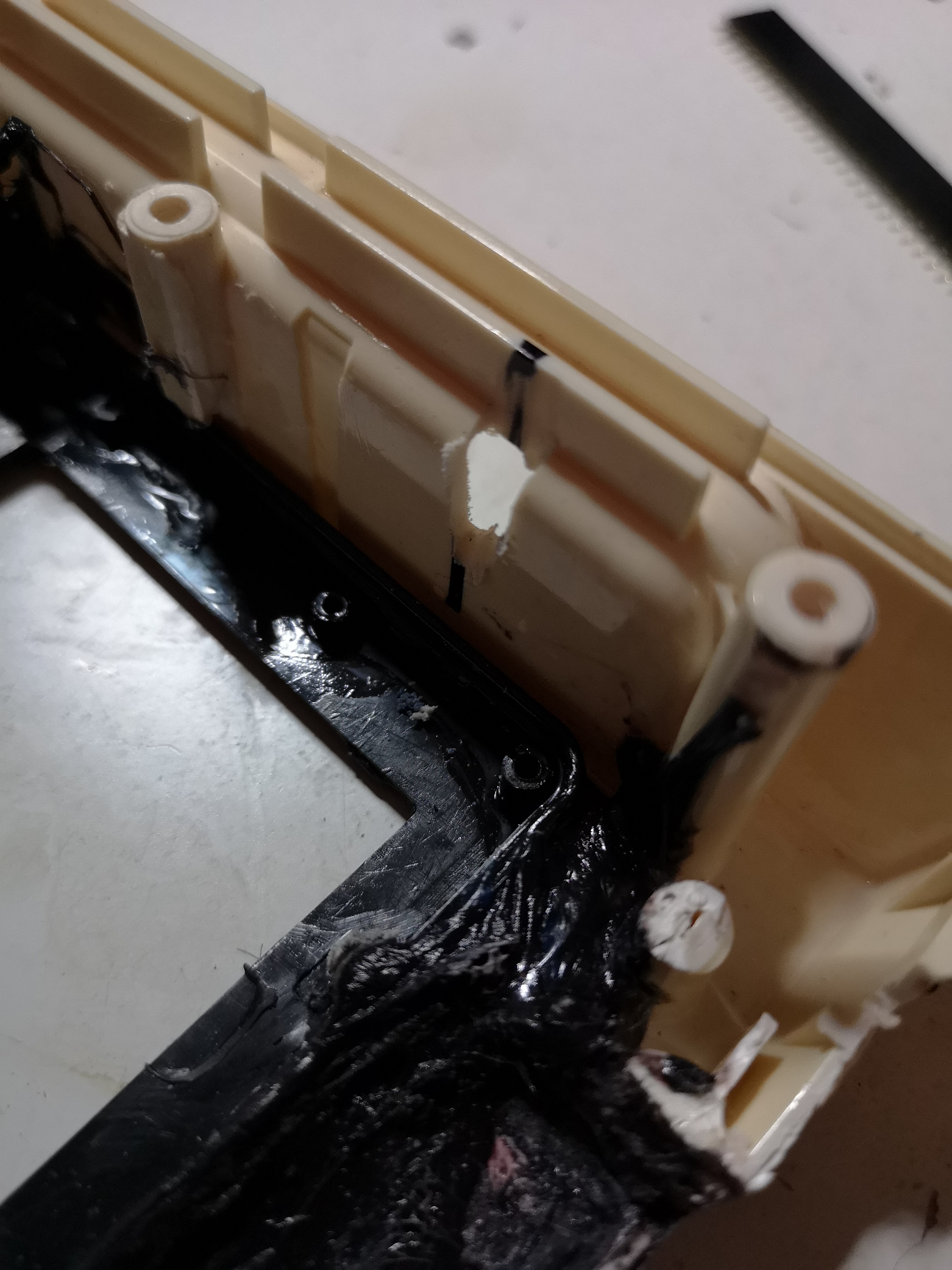

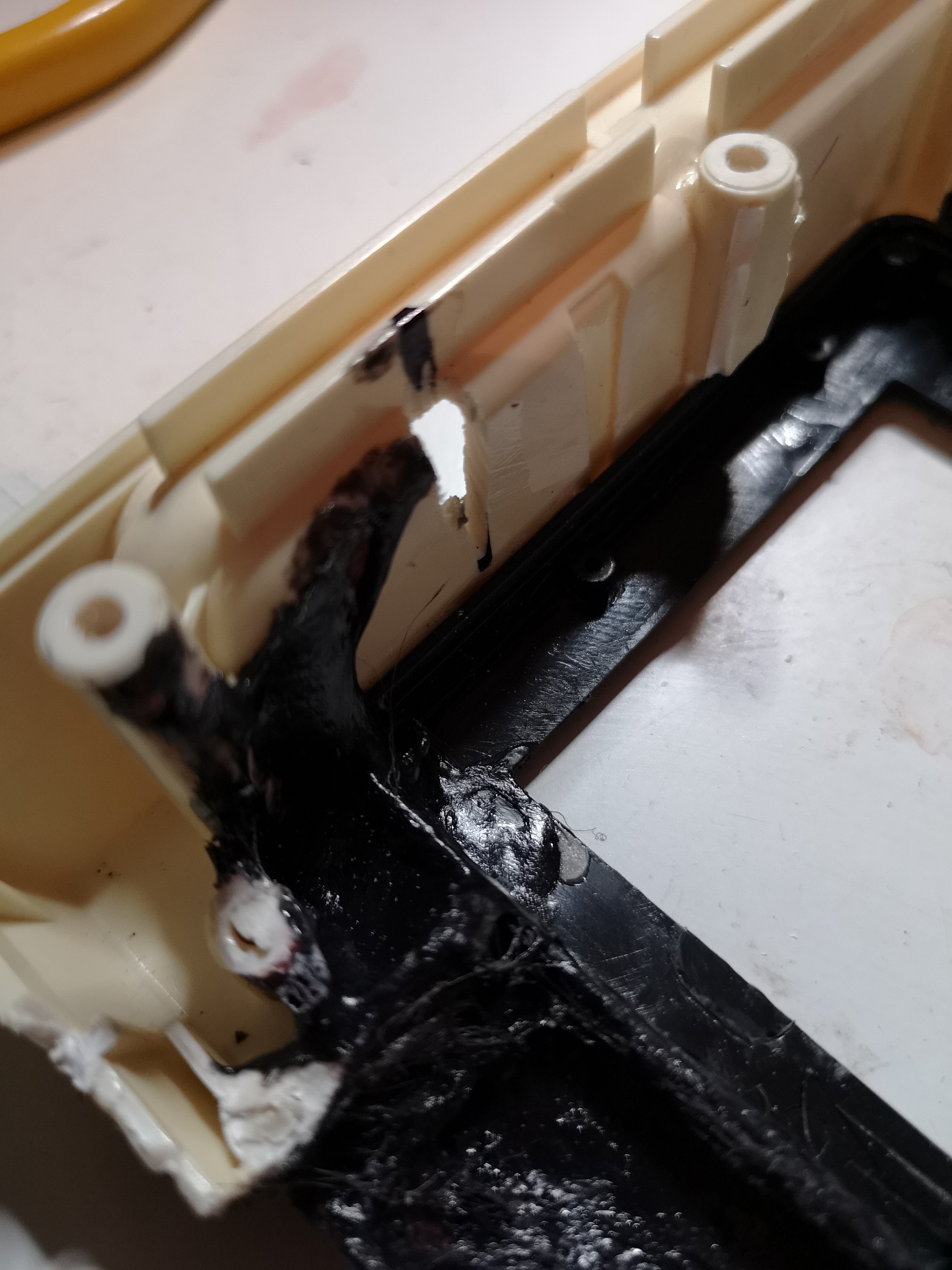

Using the Monitor and controller frames, i started marking where to cut and place them using my Dremel.
IMG_20180622_120215.jpg IMG_20180622_122914.jpg IMG_20180622_122923.jpg IMG_20180622_162940.jpg
I am using "ABS Cement" (Old Famicom parts + Acetone) to make a perfect bound with the original case.

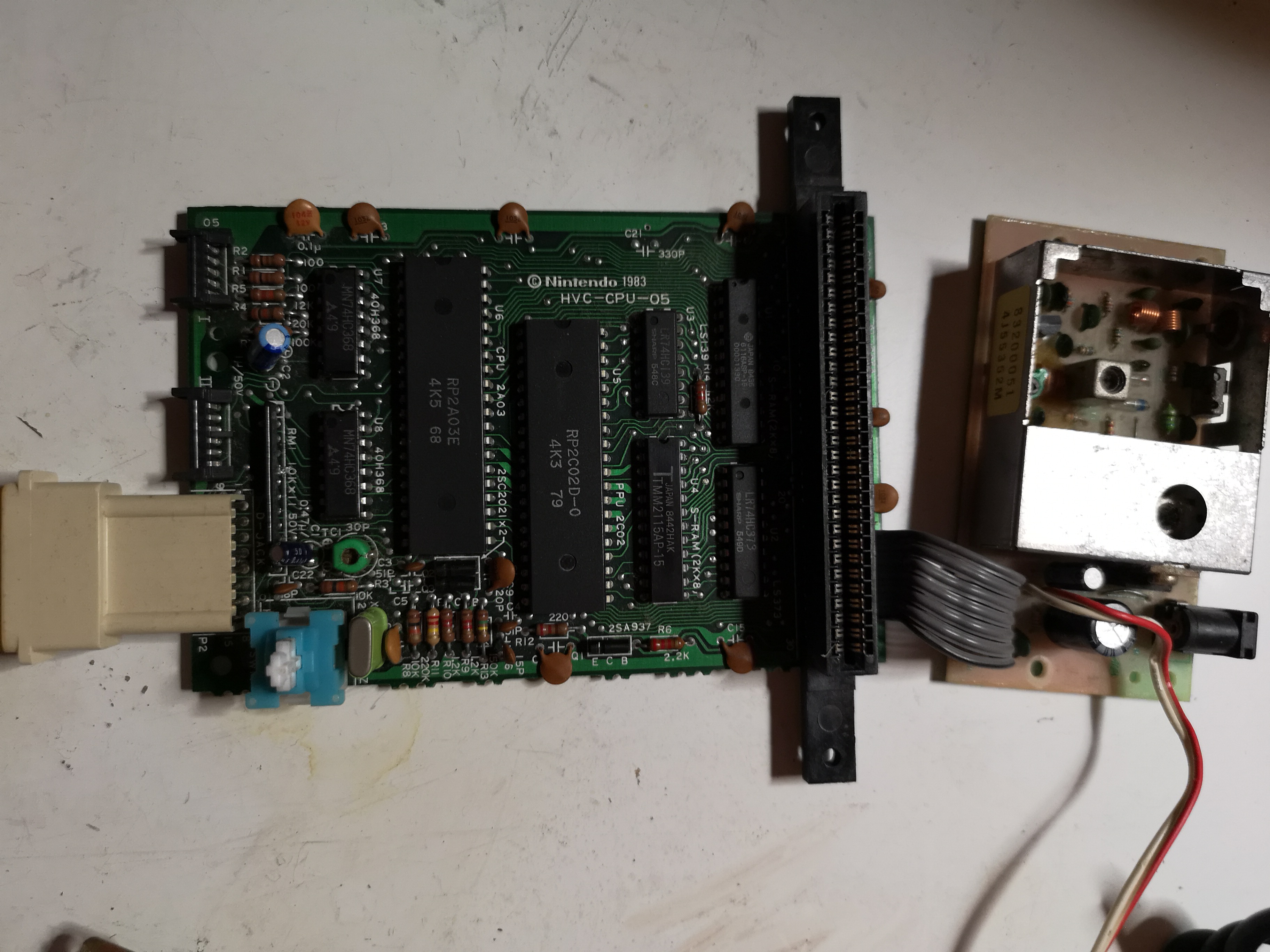

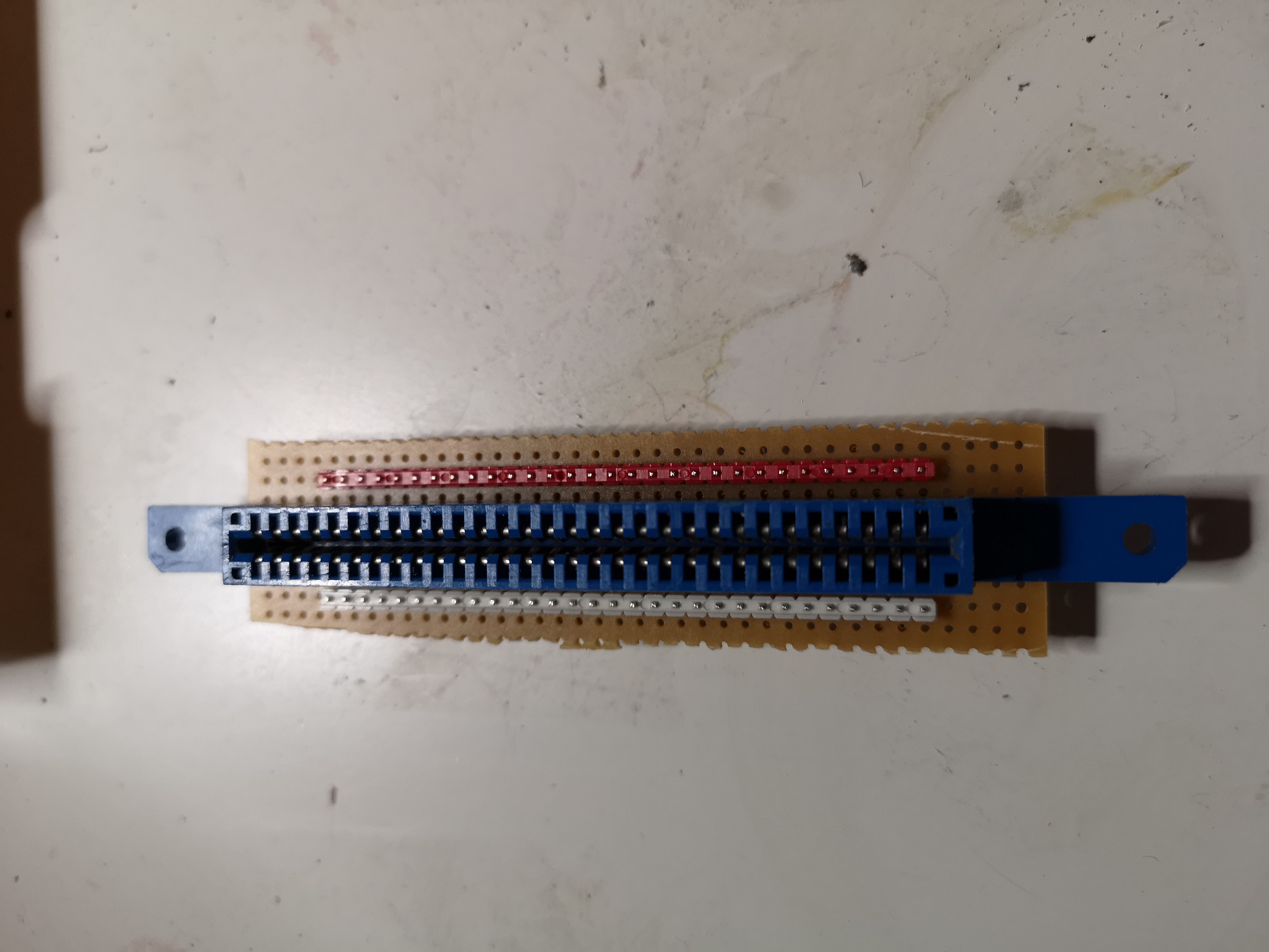

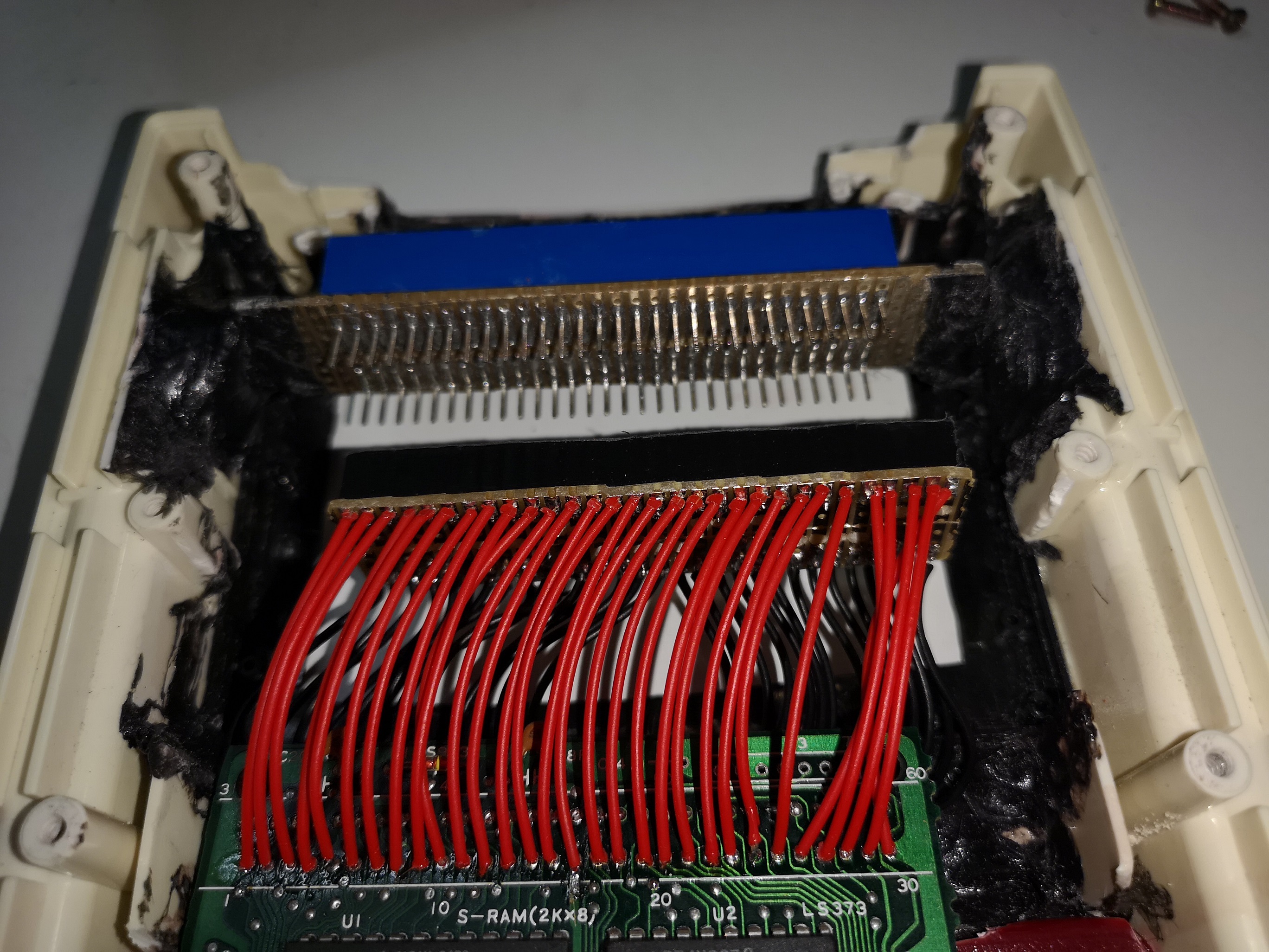

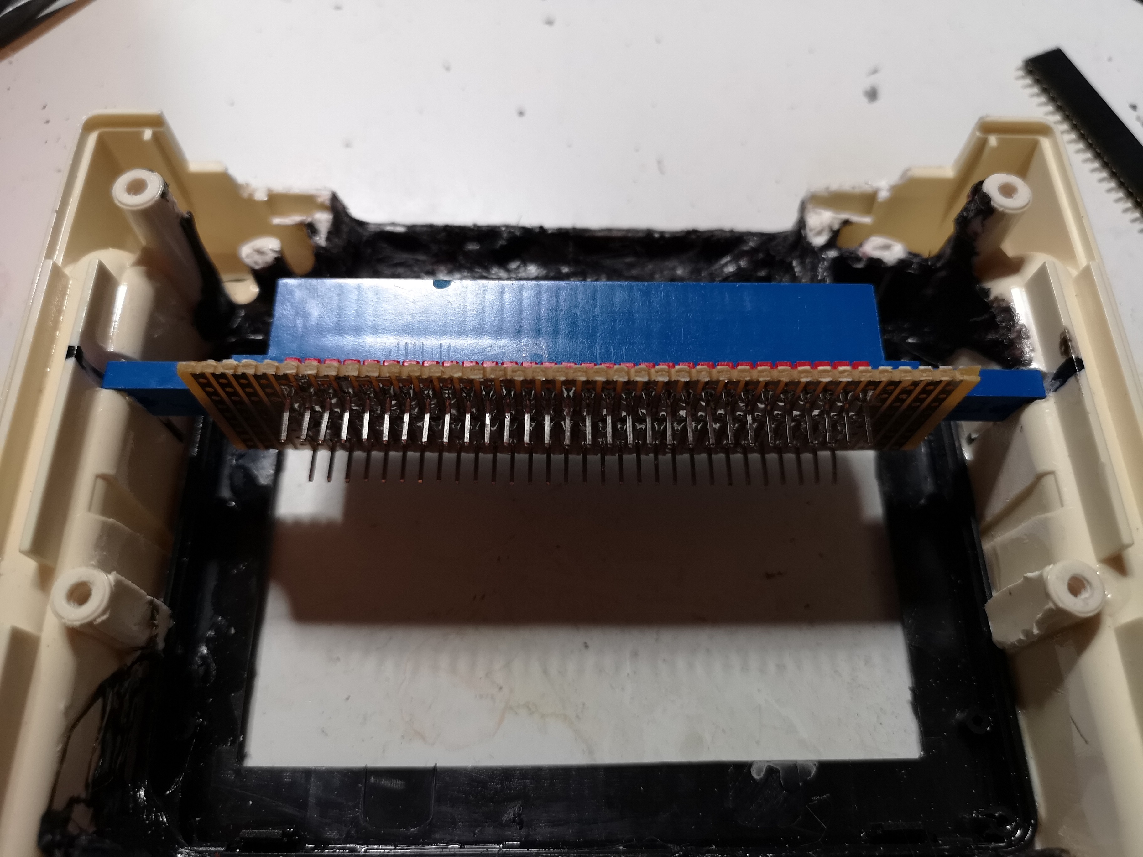

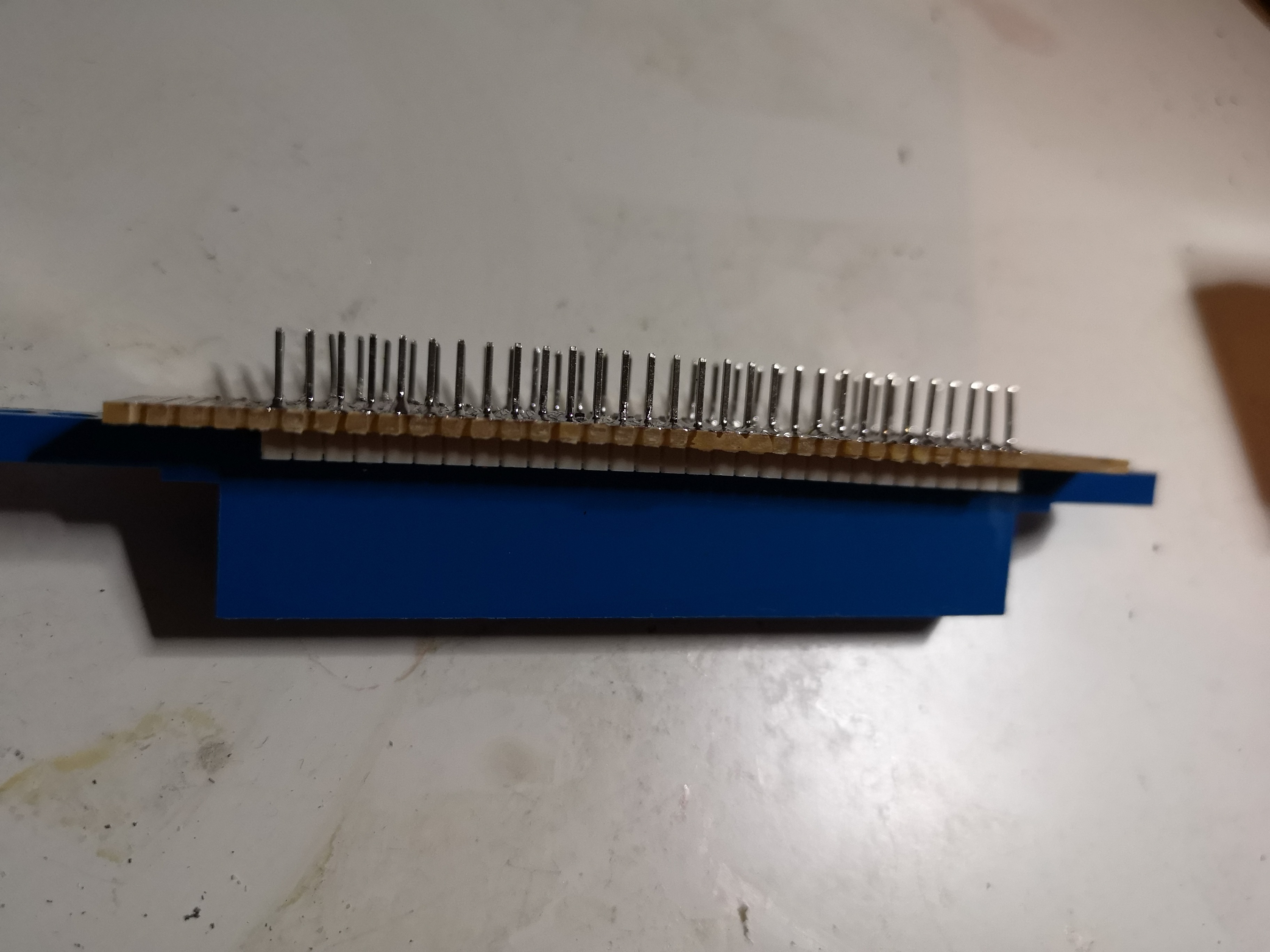

While waiting for i the ABS Cement to harden; I started with the cartridge connector. Removing the connector and replacing it with a newer one with less wear, I mounted it on a perfboard to strengthen it and soldered long pins on the bottom of it so it would be detachable from the motherboard (Will show pictures later).
I cut two small holes on both sides of the case so i could slide the cart connector into place.

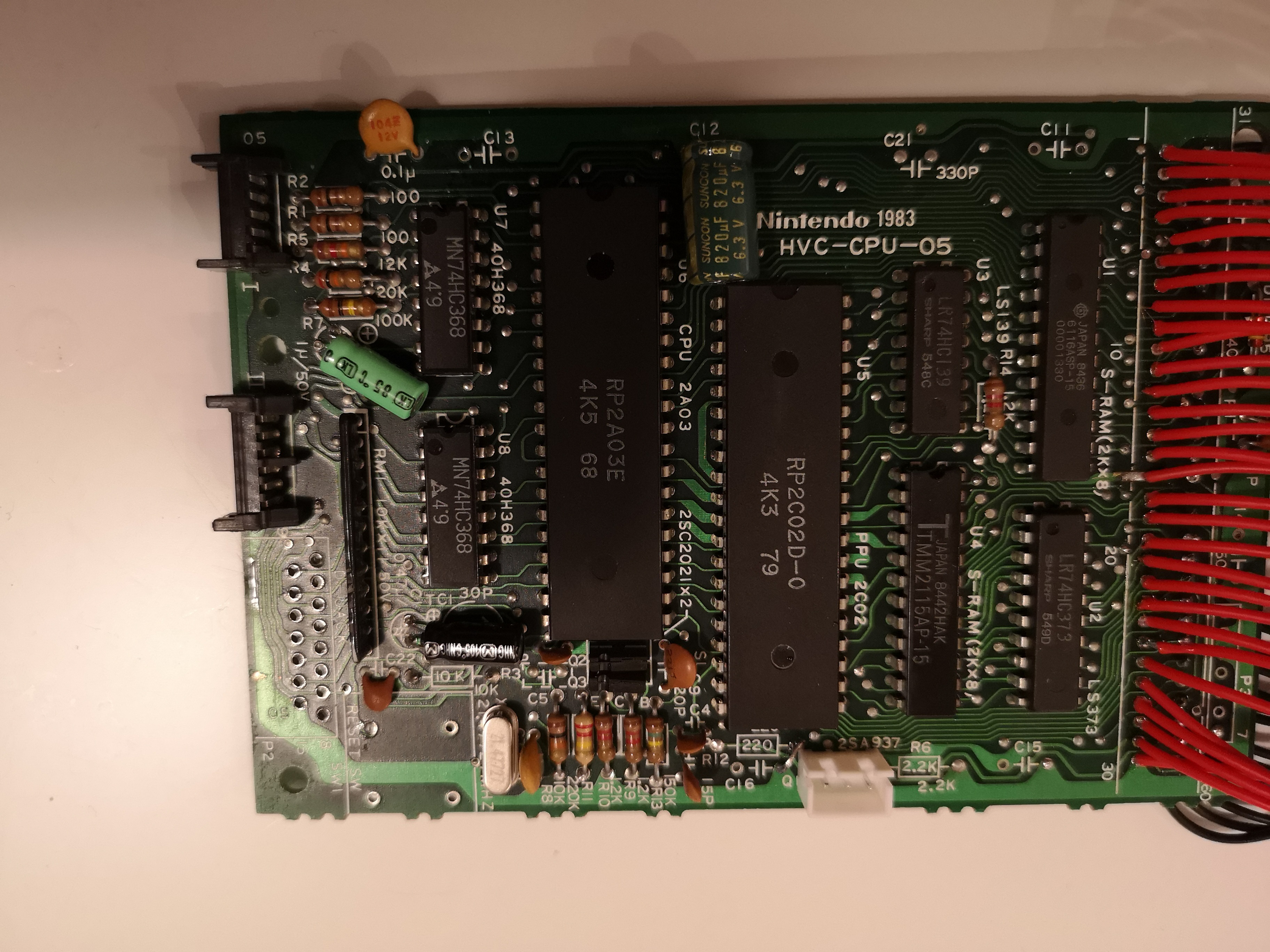

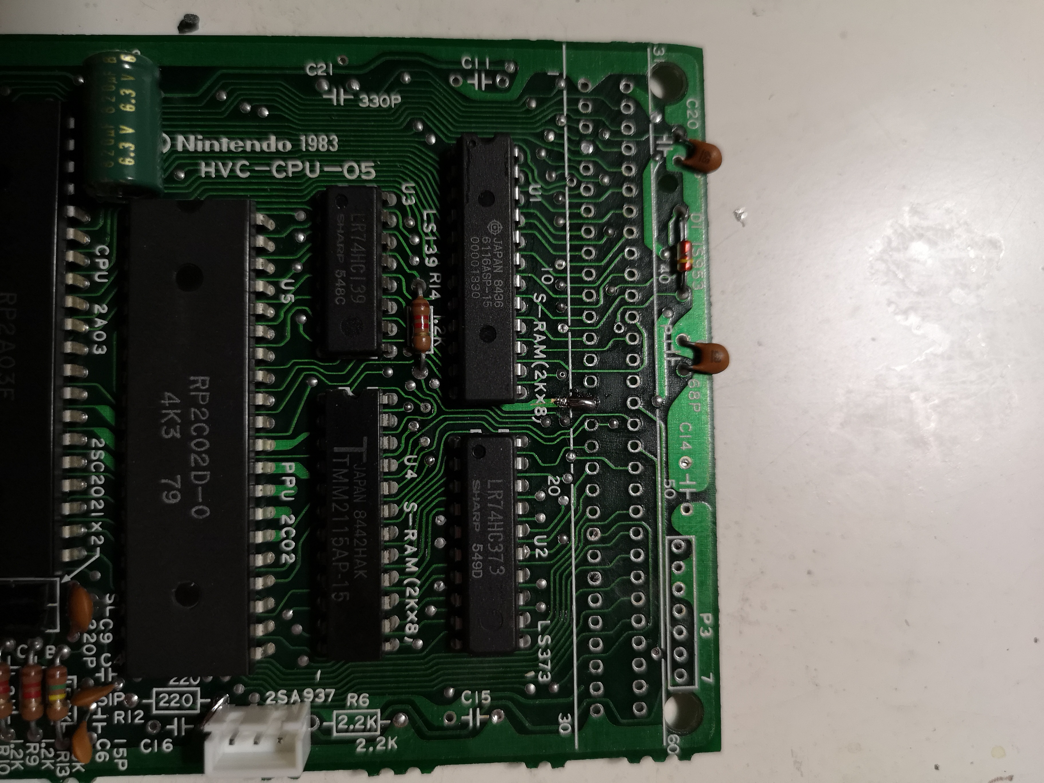

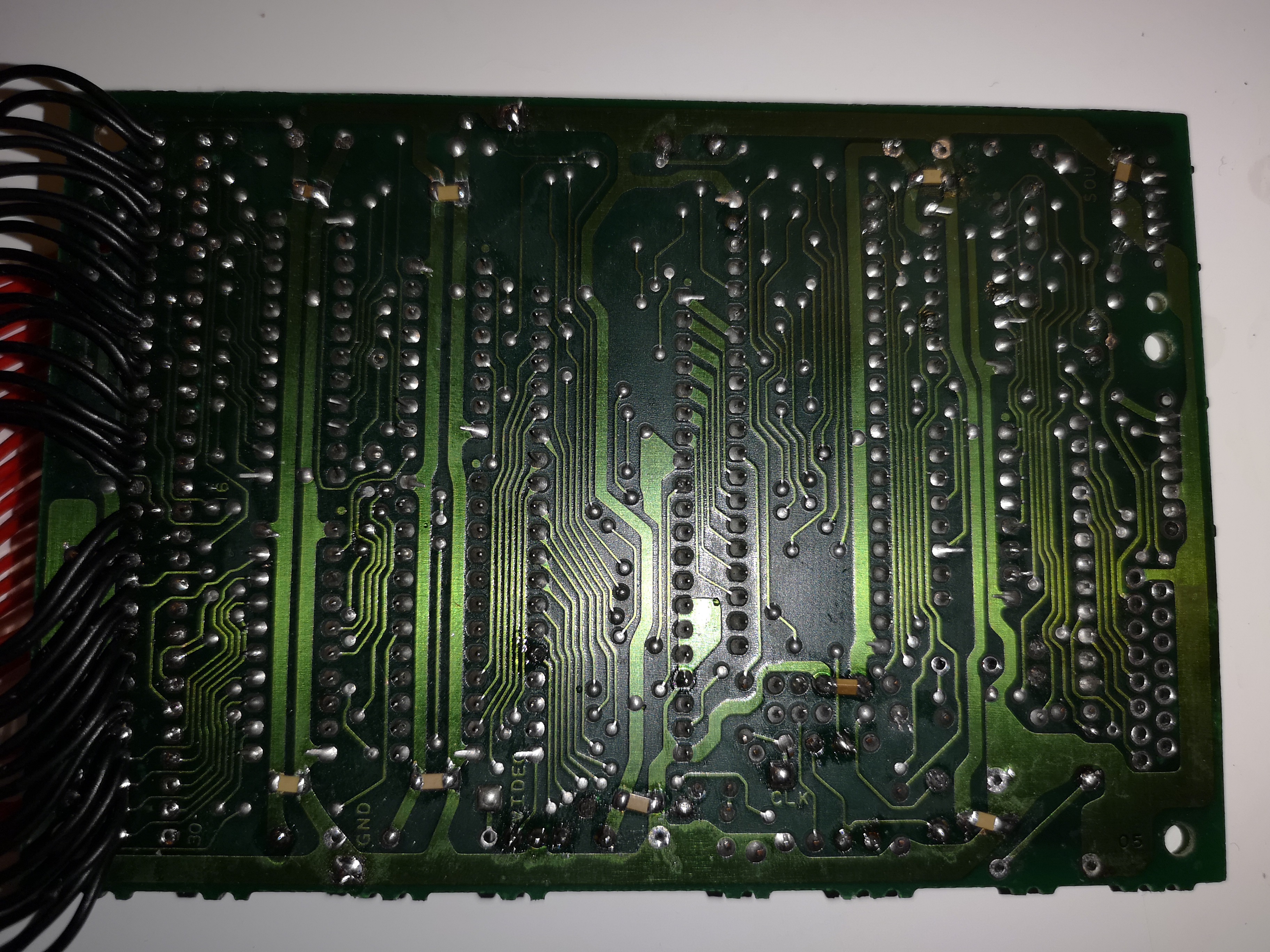

I have done a lot of modifications on the motherboard. :D
Removed the RF-board, removing the old ceramic caps with new SMD, soldered them to the bottom of the PCB.
Also removed the expansion port on the front and the reset switch. Replaced the crystal with a brand new one (some Famicoms crystals have gone bad after some use). Added a 820uF capacitor to the PCB.
Removed the parts that has to do with the video circuit, going to make my own amp. Removed resistor R3, so the microphone audio wont mix with the internal sound. Added a 3-pin connector that the screen will be attached to (Providing 5v, video, Ground). B|
I have also temporary wired up the detachable cartslot - for testing purpose!

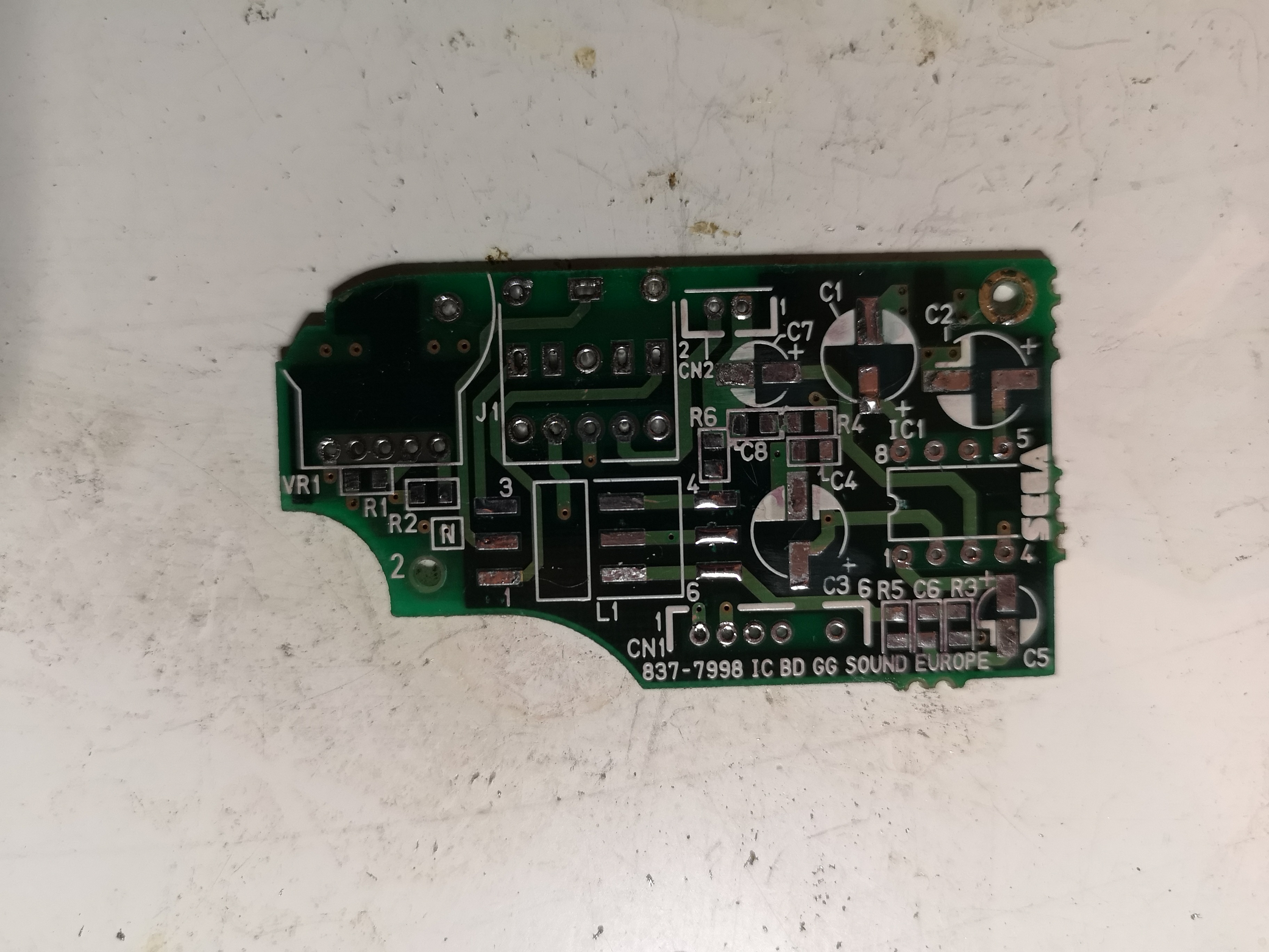

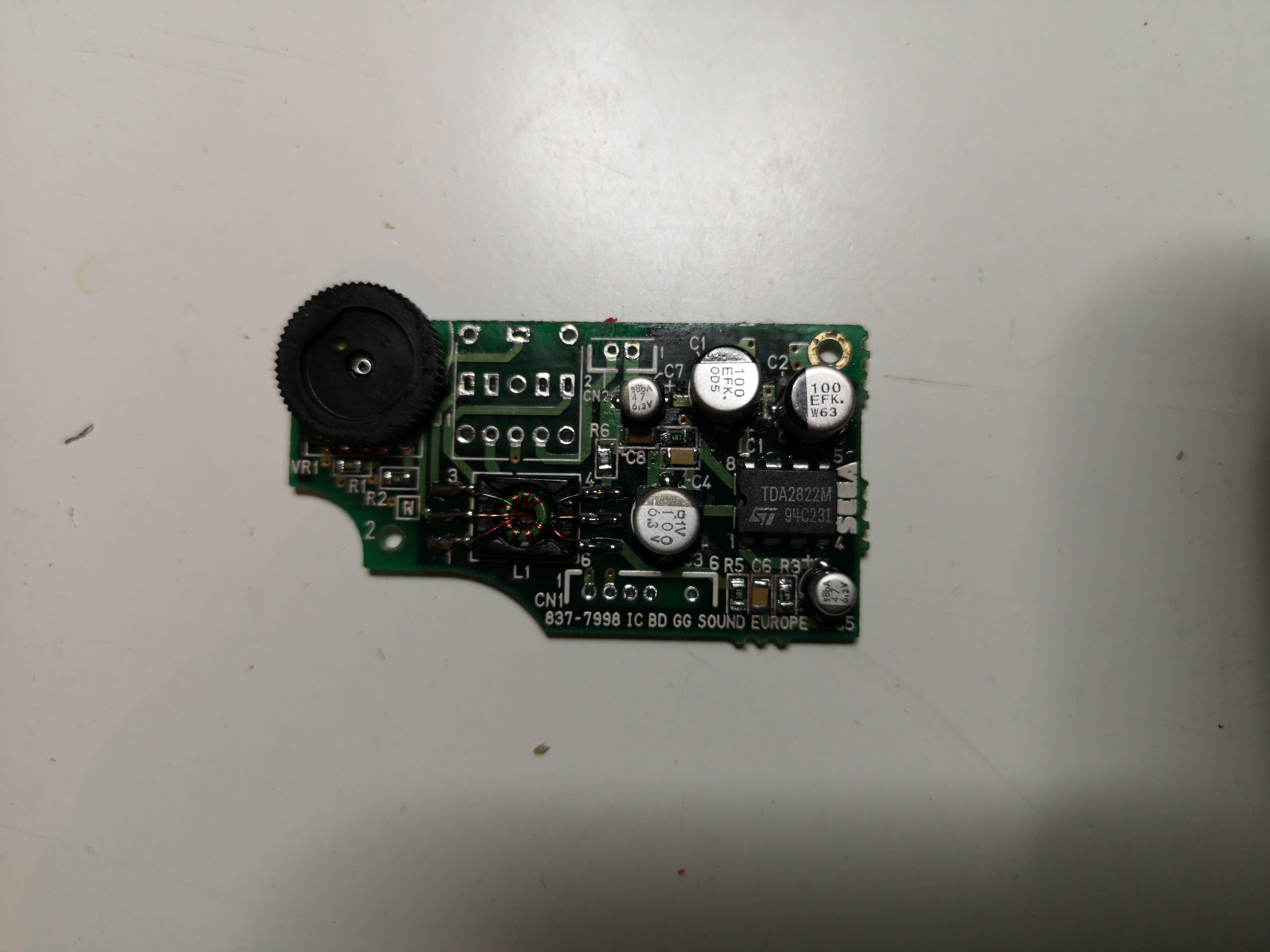

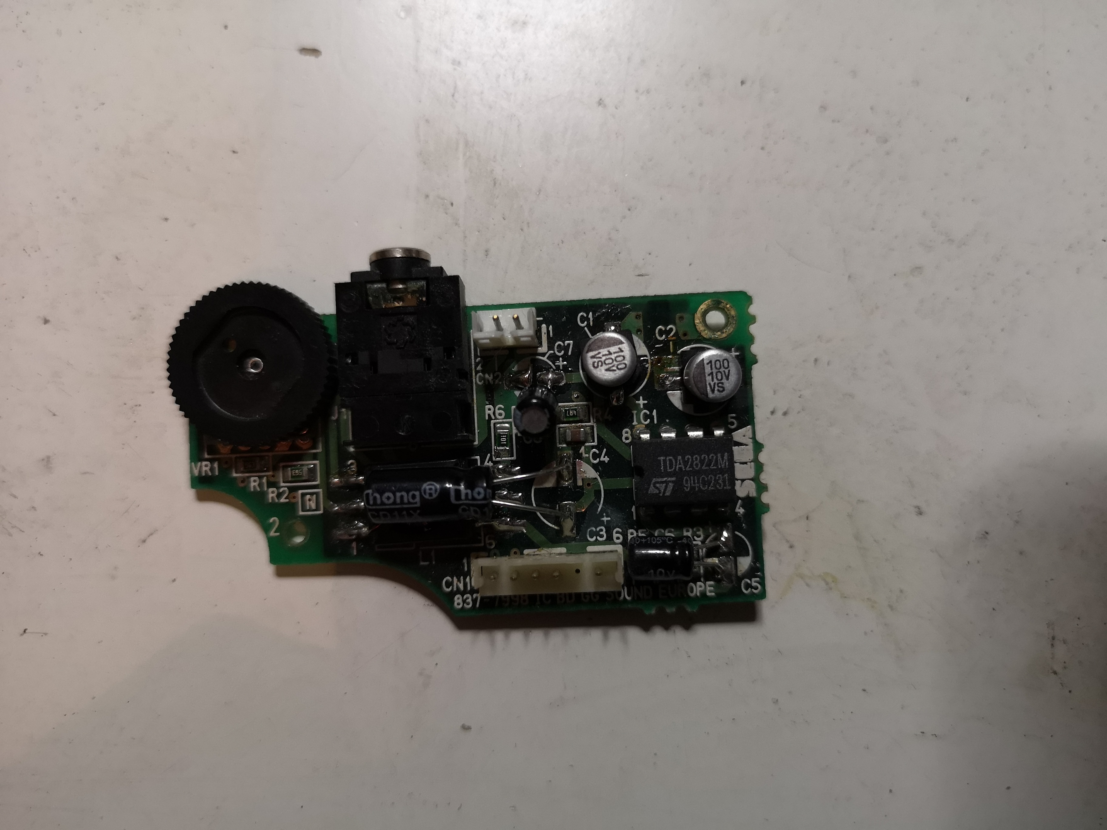

Moving on to the audio, I got some broken gamegears from Ebay a while back, that someone had tried to fix.. badly...:facepalm:O.o
The GameGear have a nice audio amp pcb with audio control and headphone jack + speaker.
So I started with removing all components on the PCB, the old owner had only removed the caps and soldered on new, and never removed the leaked electrolytic...
After that I cleaned everything and soldered new parts in!
I'm not sure were Im going to place the headphone jack, so I've not soldered that in yet.

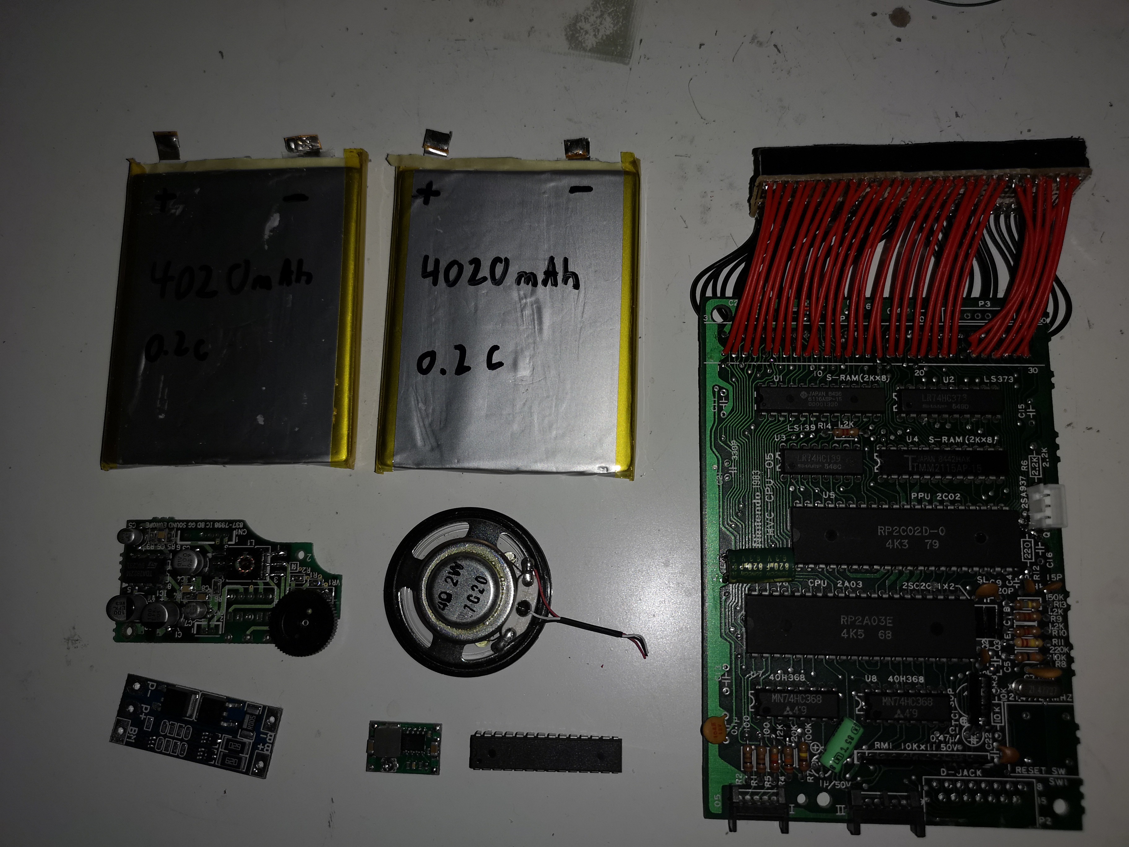

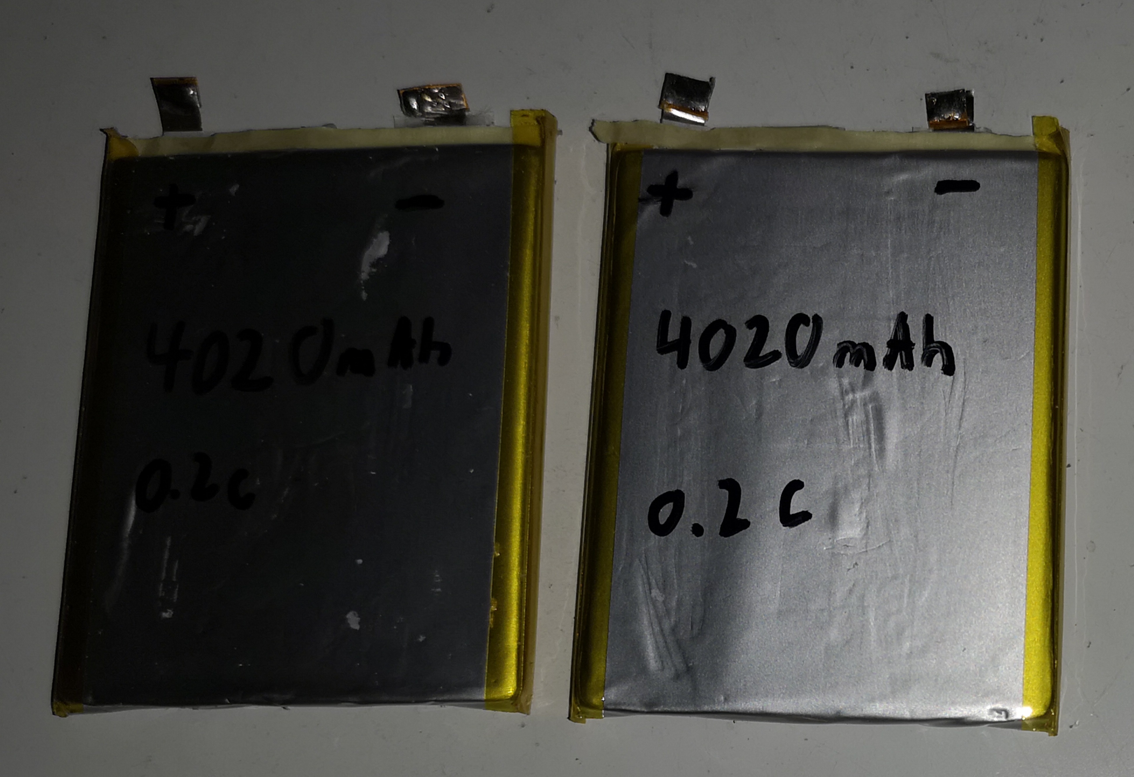

These are the batteries I'm going to use, taken from an 1 year old laptop, I charged them full and tested the Famicom+screen and they lasted for about 9 hours! :awesome:
These are most of the parts I'm going to use for my portable (might change the speaker). I will program the AVR-chip to handle the battery indicator, turning on/off the system, resetting (any maybe more!).;)

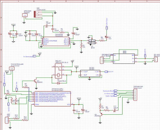

Sorry for the late response, life got in the way, but now I am back.:blush:

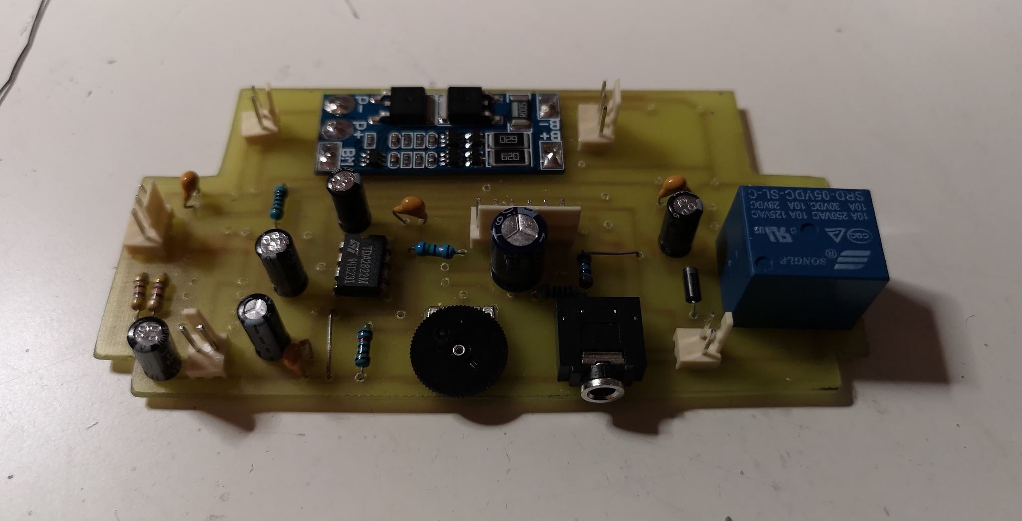

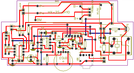

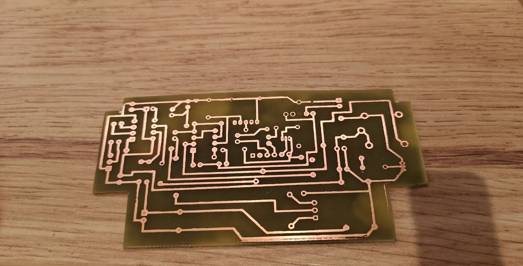

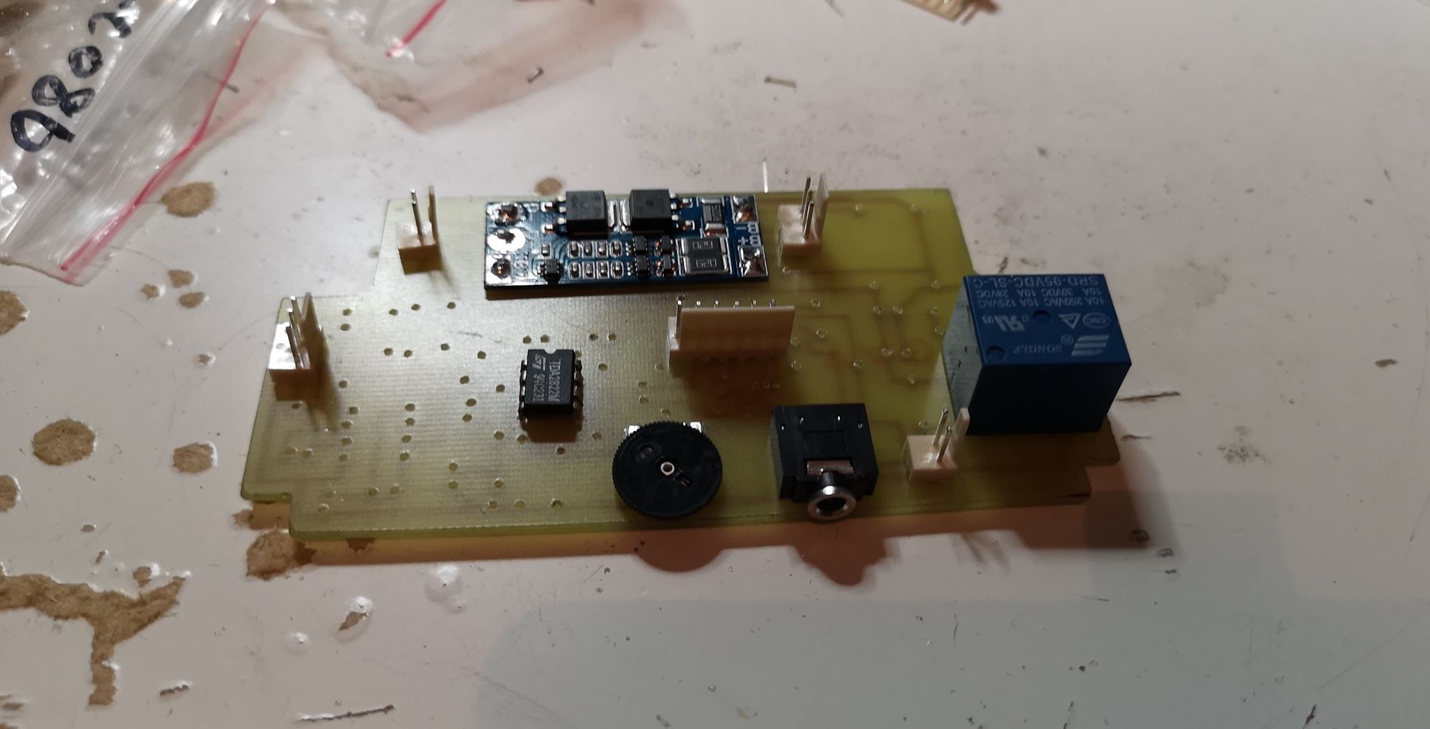

I have spent several days working on a schematic and designing the PCB that will handle the audio, 5V-regulator, BMS, Relay to turn on the console, Turn on/off.B|

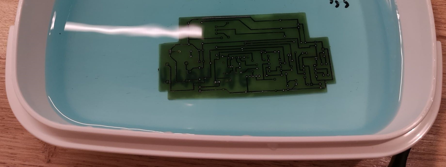

Etching the PCB

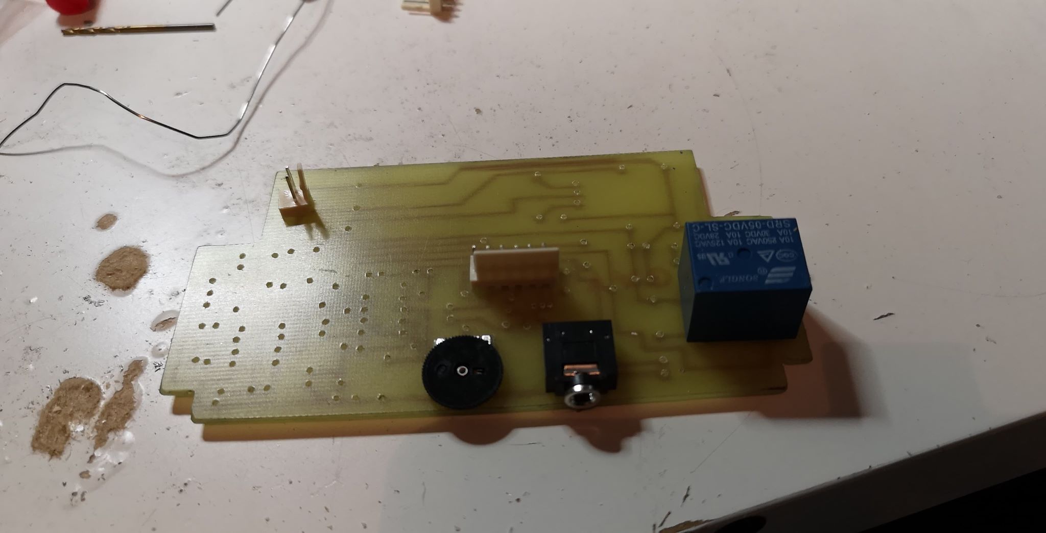

Drilled holes and started to solder the parts into place
Not everything soldered into place, will update when I am done with it.
I am also working on the AVR-chip that will control everything. :awesome:

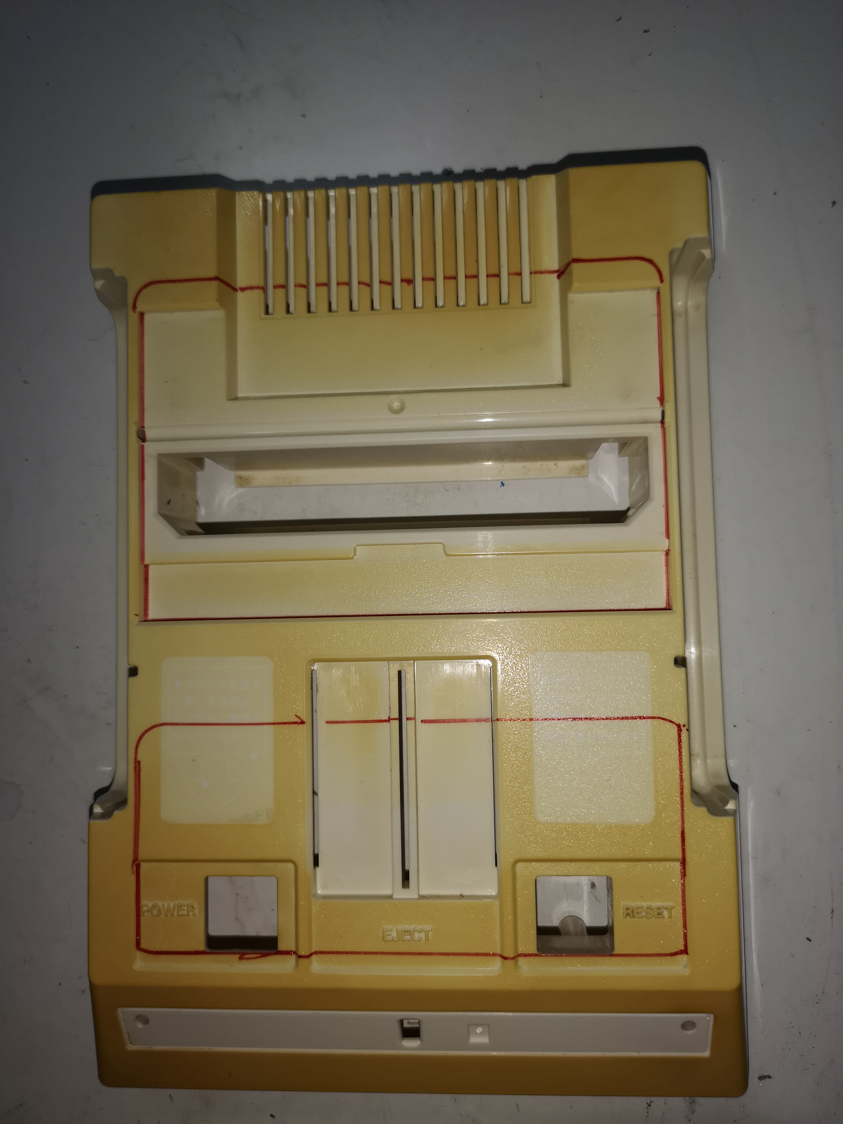

PS: The PCB will be placed here
