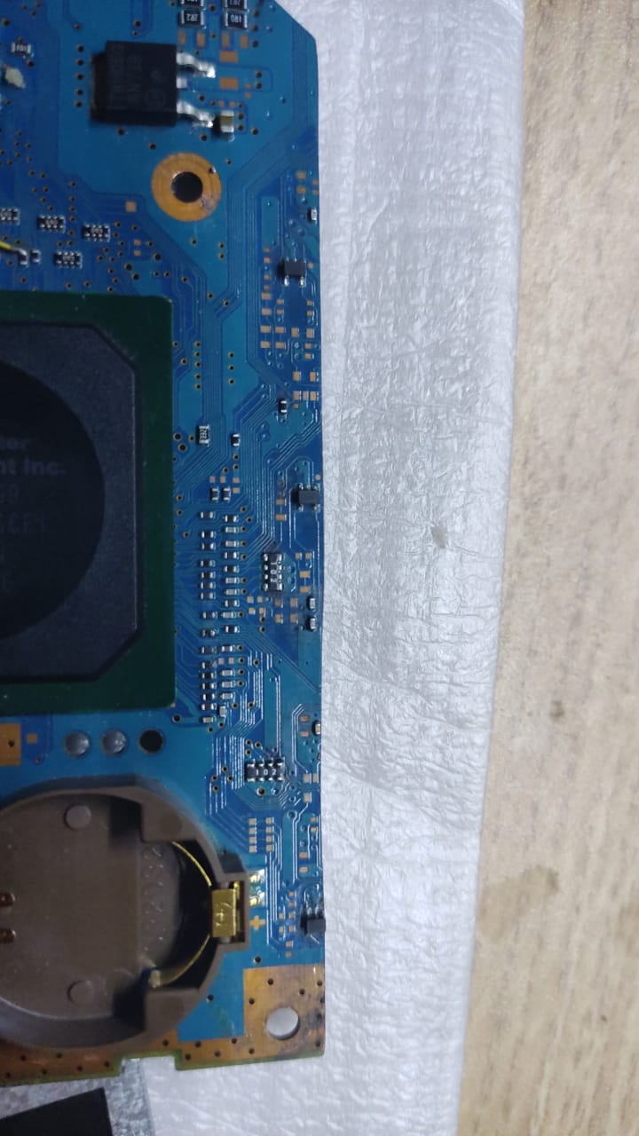

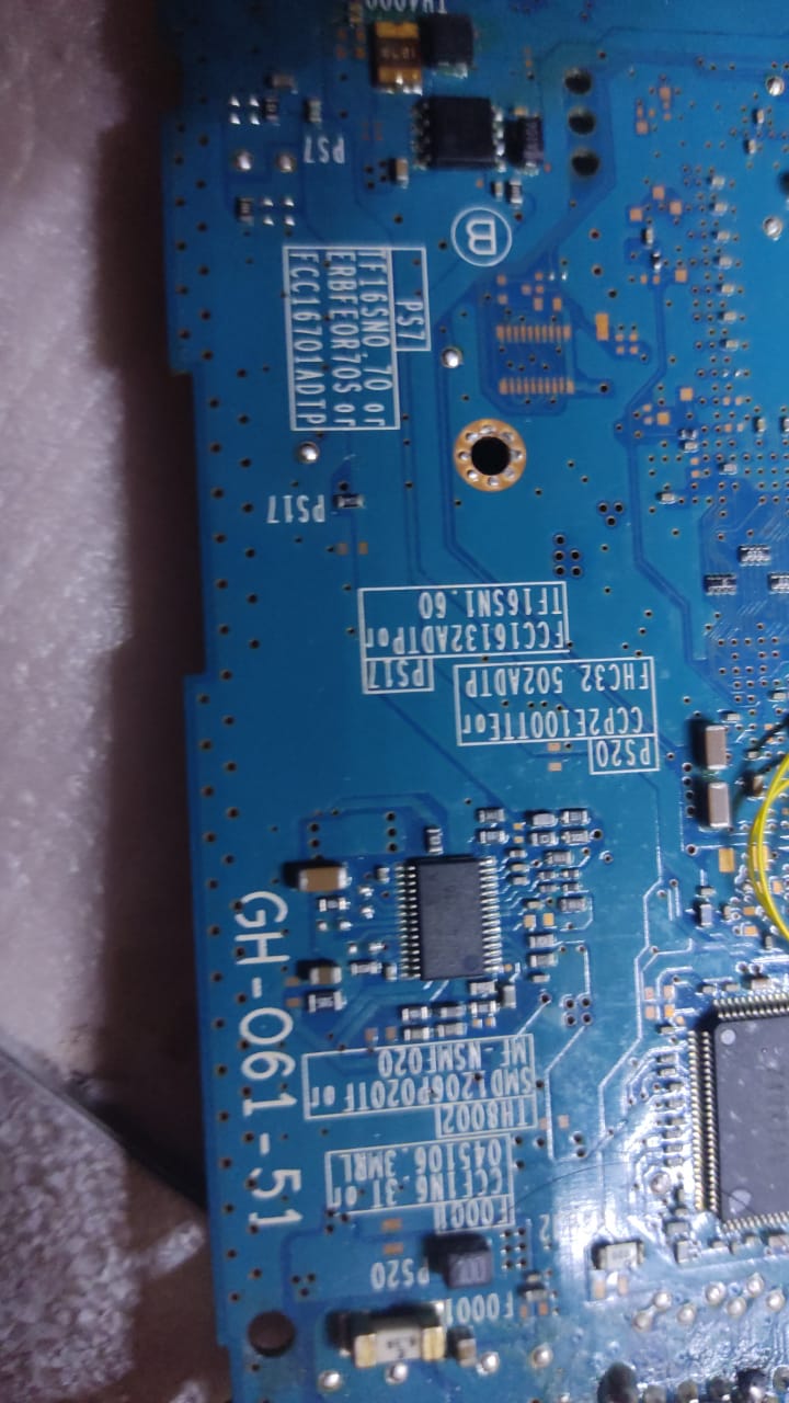

hello, a few days ago I started with my portable ps2 project, I used trimming guides without realizing that the version of my board is different, so some lines do not match when soldering the control and the memory card, any recommendations how to detect them or any other guide to follow?
Thank you for any help you can provide me.

Do you have picture of the board before trimming ?
I have this one that I got from the internet in good resolution.

The plan is to follow the vías and trace back to the connector of the controller. That way you’ll be able to figure out what pin is what. Hopefully this helps ,what ps2 version is it

I tried to follow the lines of the controls, I think I found 4 of these, but the yellow line I couldn't find its origin.

I tried looking online but couldn’t find anything, if you still have the piece you cut off it might be easier for you to desoldar controller port and check that way.
Creo que no me queda más remedio que esperar a que alguien que aún no haya cortado la placa o encontrar una ps2 de la misma versión para seguir las líneas con el multímetro.
Si no tendrás que comprar otra del mismo modelo What’s the ps2 model ?
Hopefully someone else could help maybe they have the diagrams for this board.

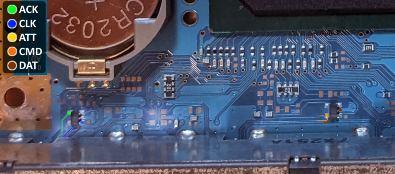

Well, so far I've mapped the Memory Card port 2, their points are marked with a "3", I've also used Mr.Jakes's image since it's pretty good quality. I'll go out for lunch, will map Controller port 2 when I get back home.
