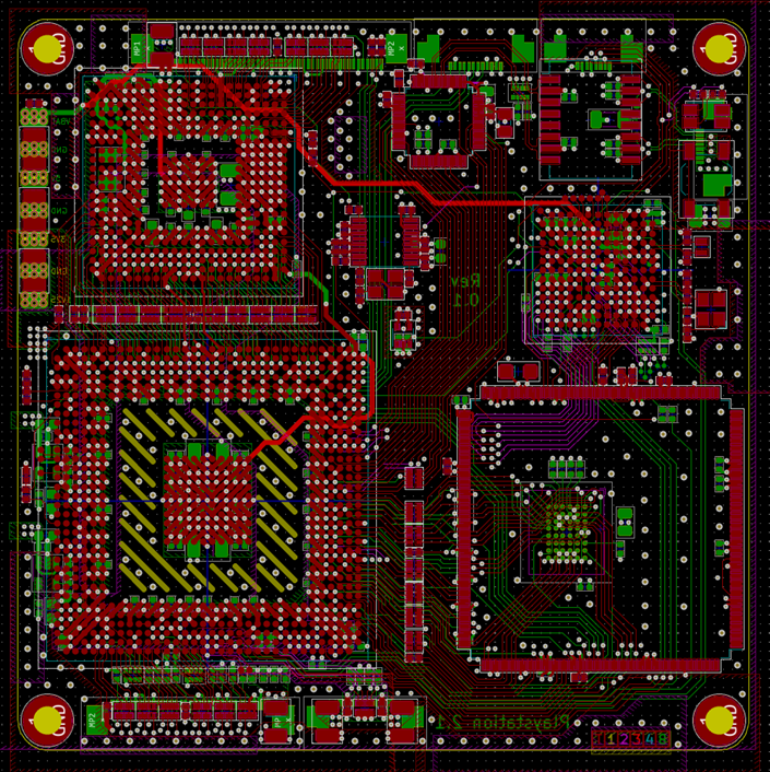

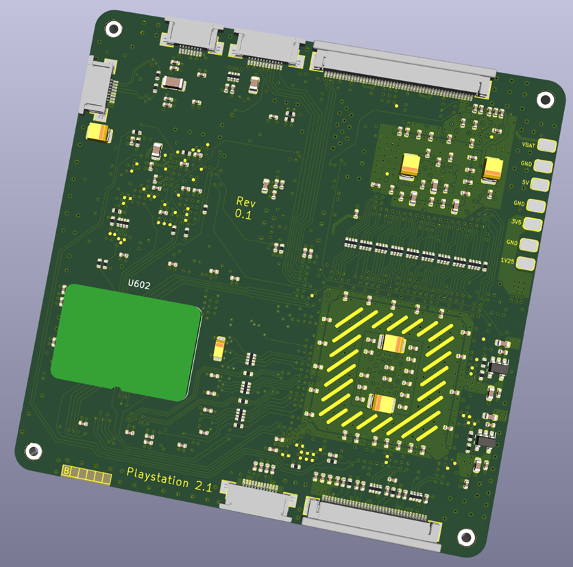

I found another component that although it's in stock, the BOM has a name for that component that I can't find anywhere outside of china, it's the 16.9344MHz oscillator, NX3225GA-16.9344M-STD-CRG-2, it's not in digikey, mouser, TME, etc..., it's actually under the name STDCRG2-16.9344M, it's the exact same component and it took about an hour to find it.
The part number of that crystal may have changed at some point (?), because all stock I ordered back then is marked with NX3225GA-16.9344M-STD-CRG-2. Searching for it in Digikey or Mouser now redirects to the STDCRG2-16.9344M, which is the correct part and fine to use. I will try to update that in the BOM today or tomorrow!
I was going through the BOM to see if I could find cheaper alternatives to some components and I noticed that there's no caps in the BOM for the 32.768KHz oscillator, did you leave those out for some reason? I've never seen oscillators without caps, I'm going to use 10pf caps here as using the formulas in an adafruit blog post gave me around that value.
