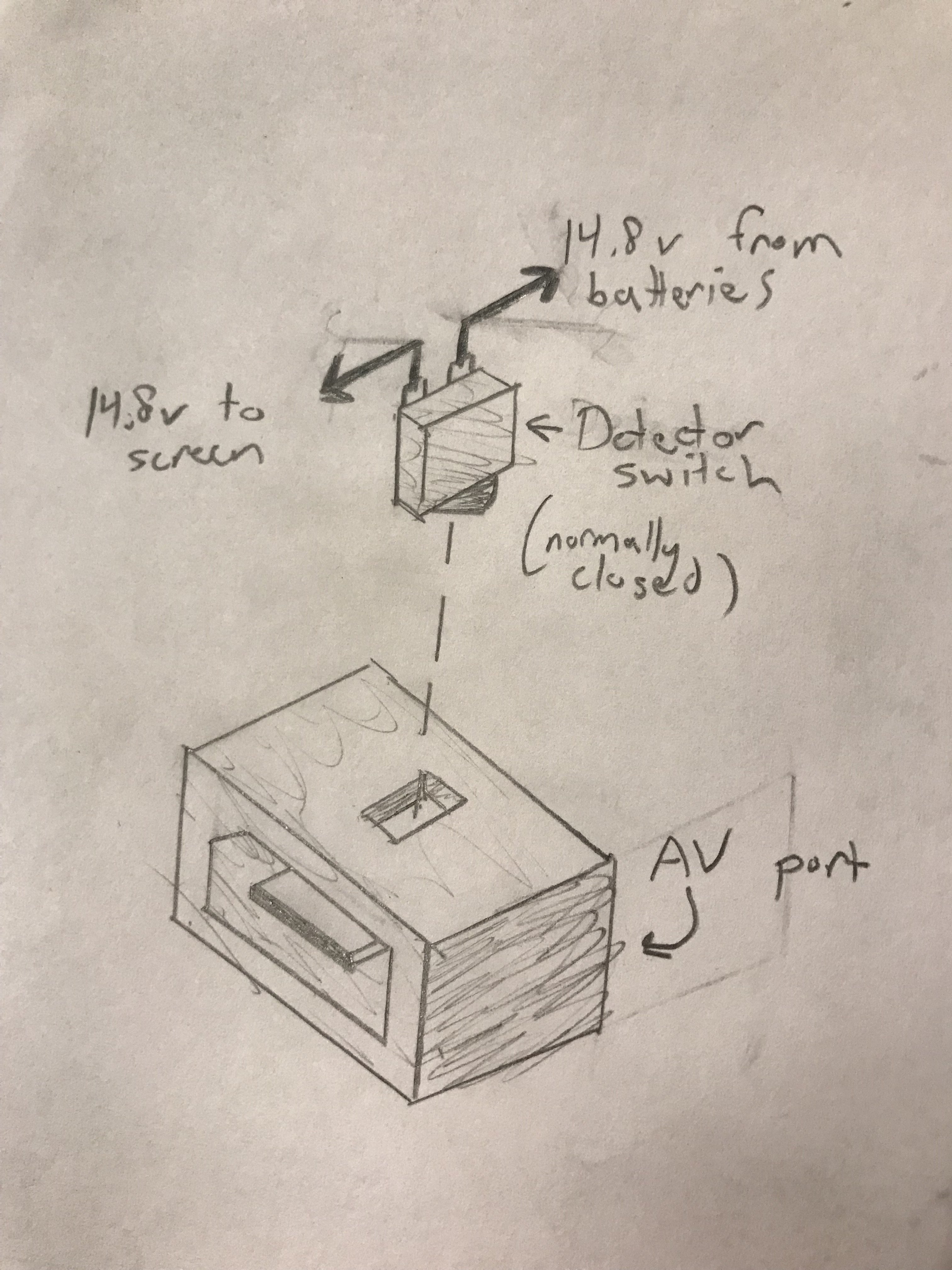

Okay, here's the rough implementation for my portable design. When the AV-out port is connected, the switch disconnects power from the screen. My pinch point is that most of those switches are rated for really small amp loads.
I don't know what your female port looks like, exactly, but if you've got room to cut a groove into it, switches such as @SabelToothTiger mentioned would work great. Detector switch, that's the term I was looking for.
To switch controller ports, just have P1 wired straight to a pin in the dock connector, and to the internal controller via the normally-closed switch. Easy-peasy. There shouldn't be much current on that line and the little switches will work fine.
That's a particularly smart solution you have there! Would not have thought of that, and it looks like it can be implemented without undoing any of the work already done.
Edit: Thinking on though, the female hdmi is a plastic outer, with metal inside to make contact with the male hdmi. If I were to do it this way I would be making a hole in metal part of the female hdmi. Gonna have to have a think about this.
