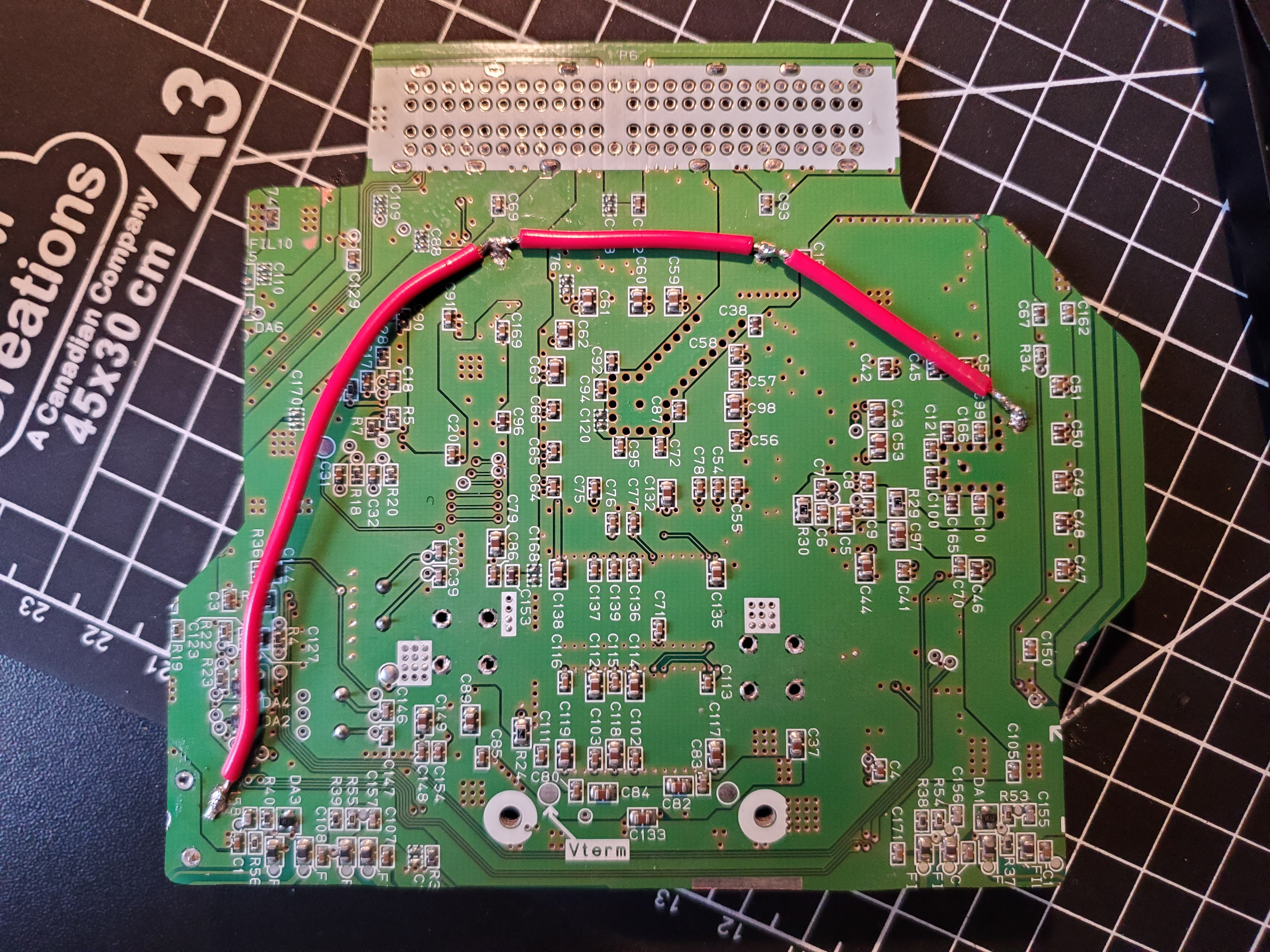

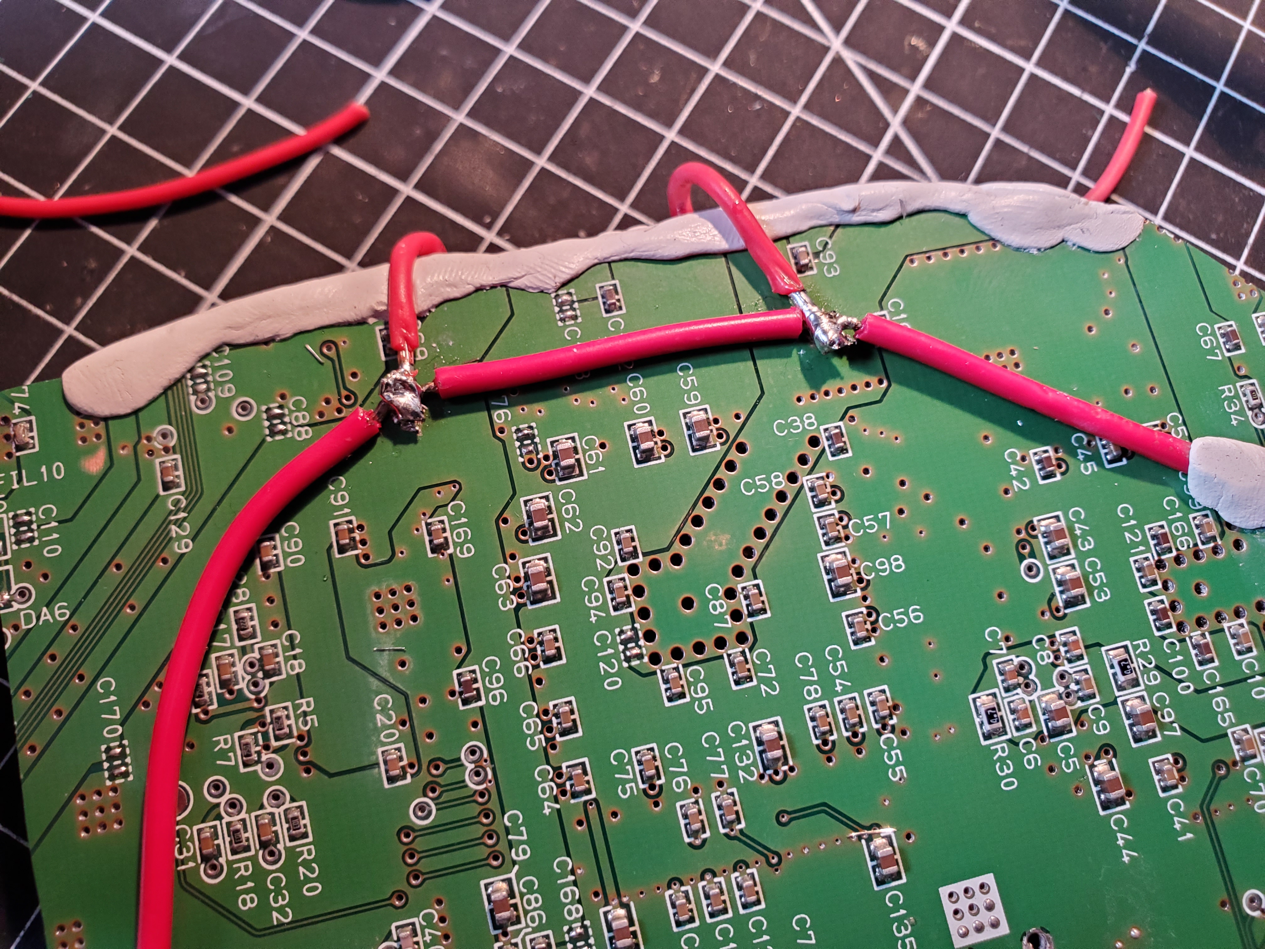

So it's been slow lately, but I connected the 3.3v traces on the back of the board today

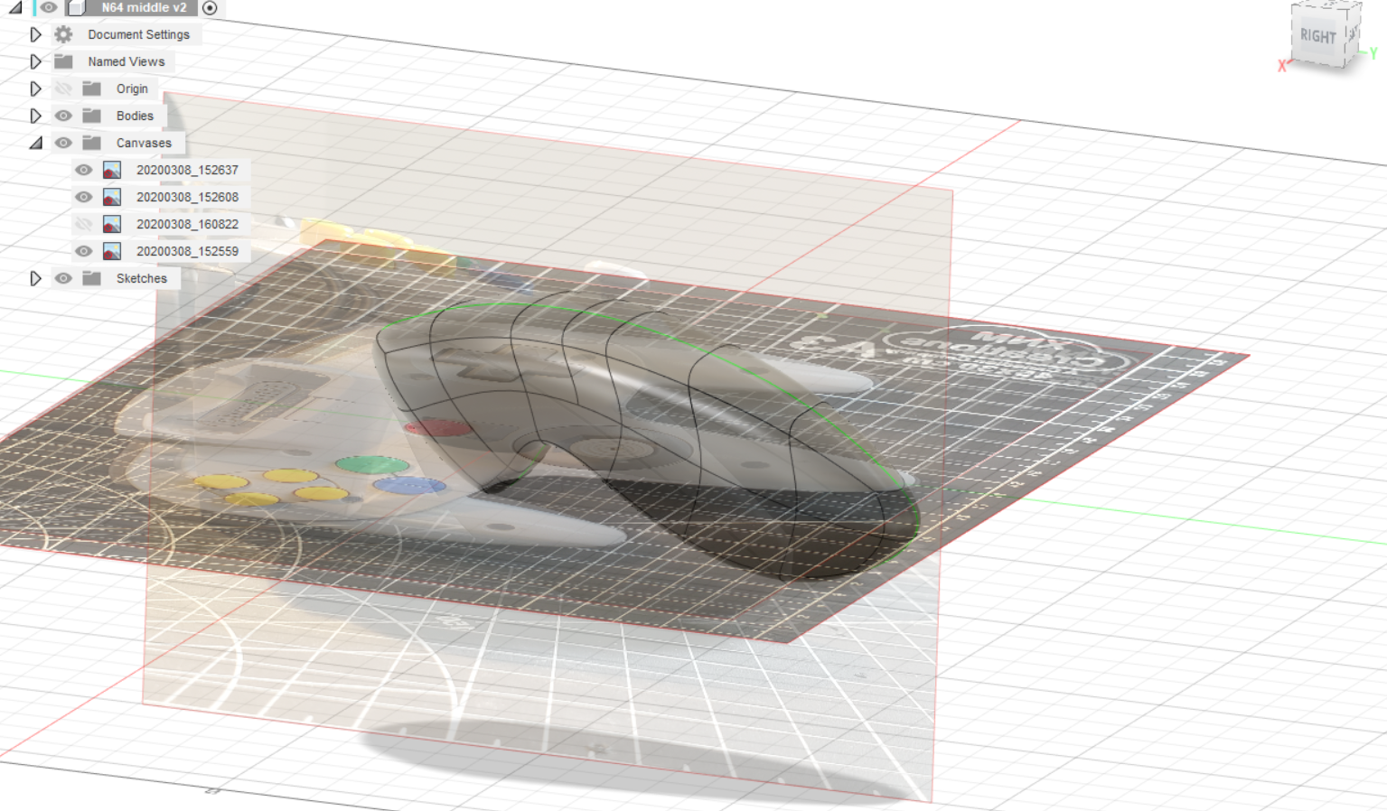

Currently I'm cadding up some models of my motherboard and some other components. I'm planning on using the OG N64 controller buttons, but I'm making custom PCBs for tact buttons, which is also helping me learn EAGLE :)

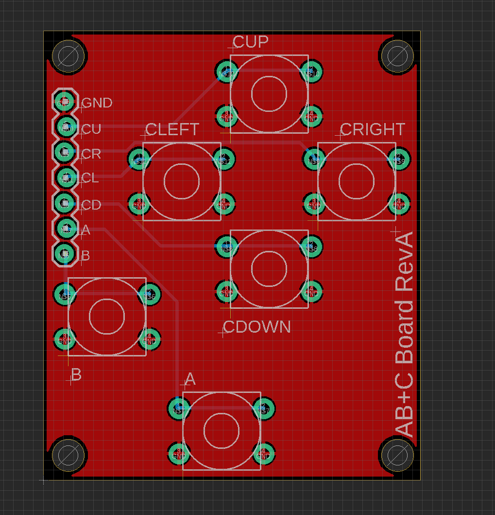

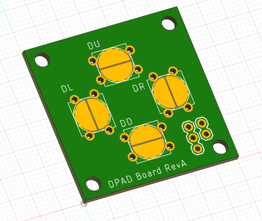

I'm using these ALPS squishy tacts I found at a local supplier, but I couldn't find the CAD files nor EAGLE library for the Alps 7.8mm x 7.8mm x 5mm tacts I'm using so I just made my own using the datasheet. If anyone wants I can make them public and upload the CAD and EAGLE library so others can get some use out of them.
So far here are the preliminary boards I've made, I'm definitely going to revise them and ensure they all are manufactureable before ordering, if anyone with more experience has any suggestions I'm open to learning from people more experienced in EAGLE.

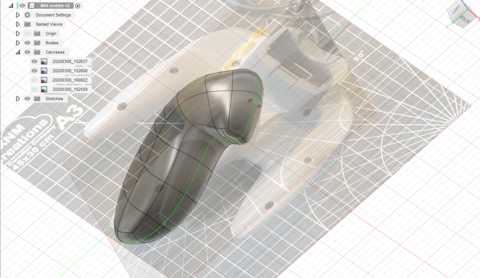

I've also completely modeled each controller button as well as a quick sculpt of the middle part of the N64 controller (I guess it's the nunchuck part):
I initially wanted to have two handles similar to the middle controller part each with their respective Z buttons to maintain the feel of the controller, however I'm not sure how realistic this will be using only FDM printing which is part of the goal here. If I can end up making the case a multi-part print which screws/fits together then I may be able to use this model later on, or perhaps I can made a 'grip' attachment like they have available for the switch.

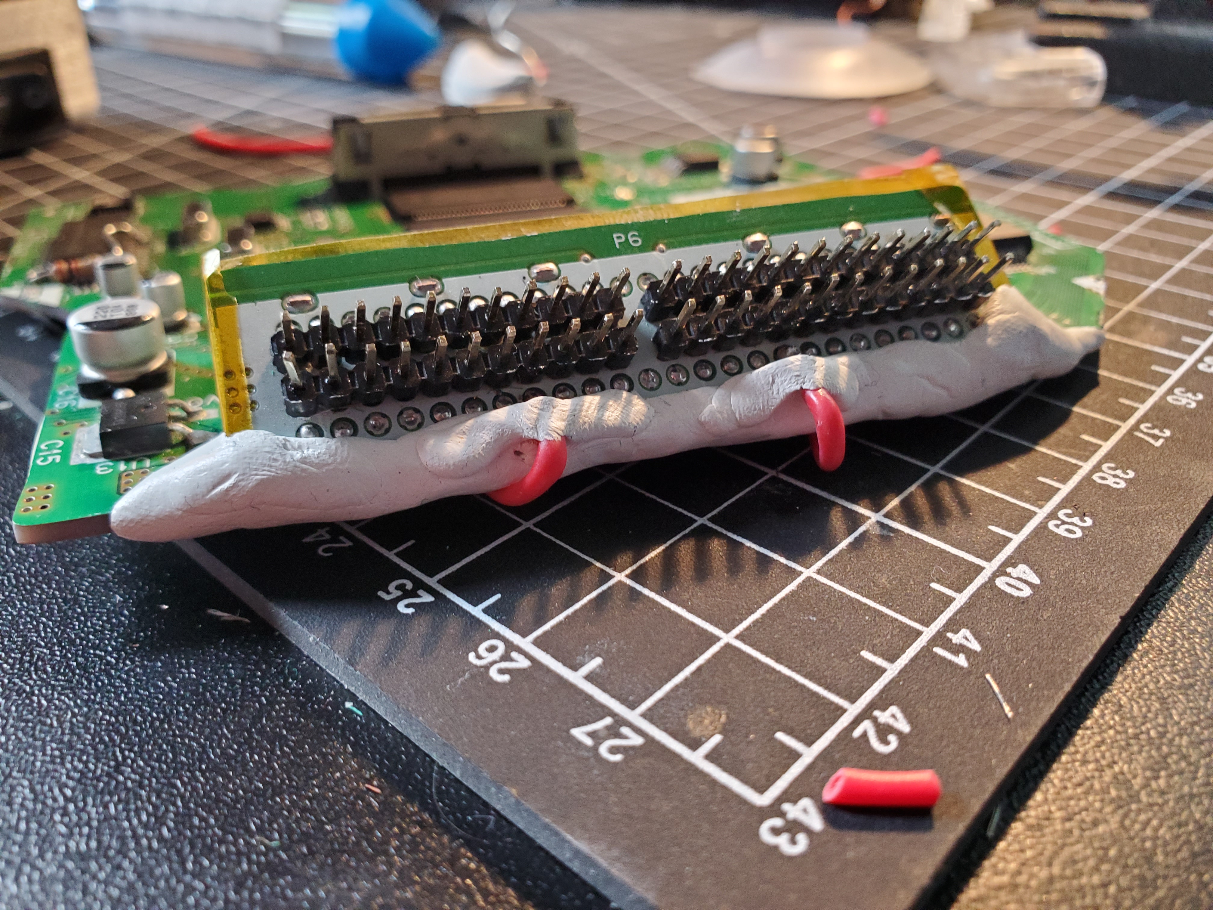

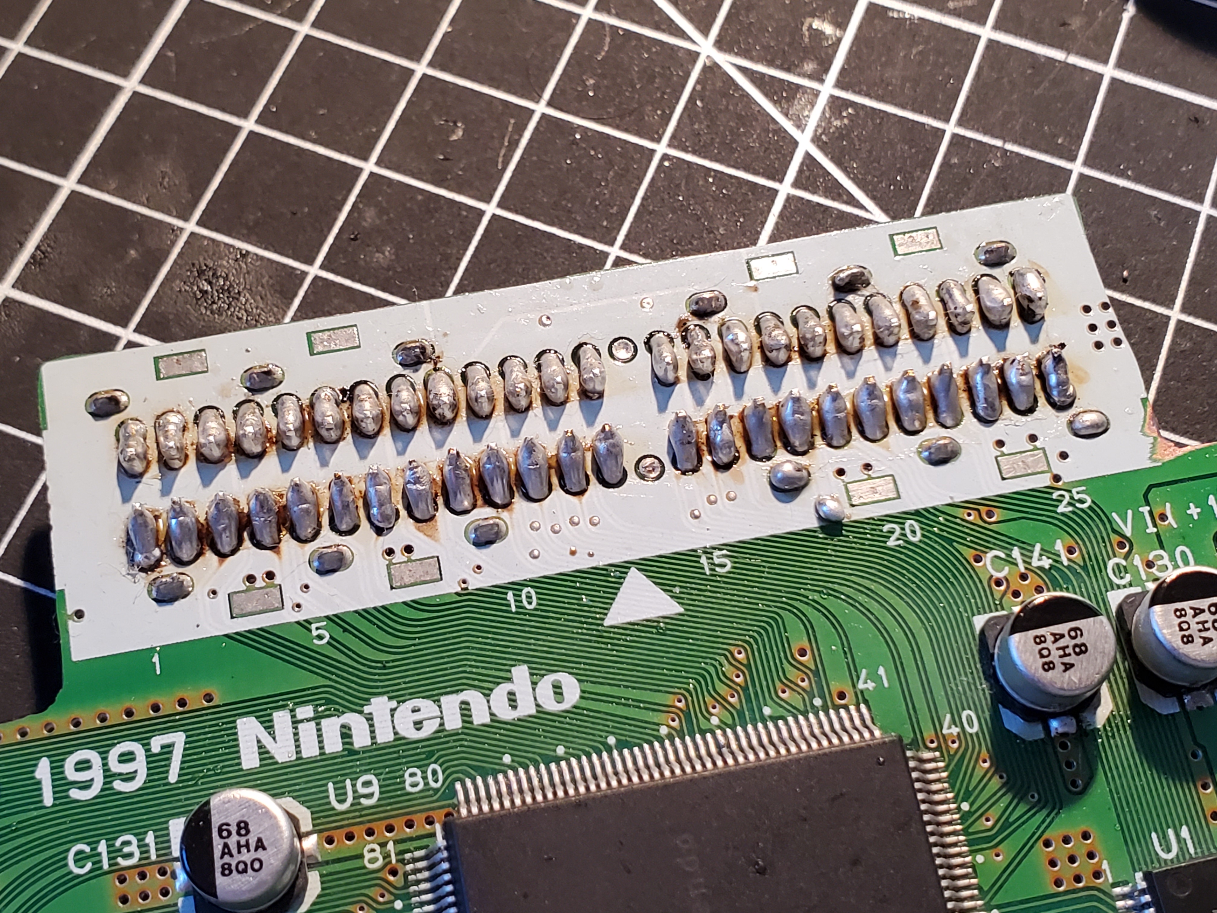

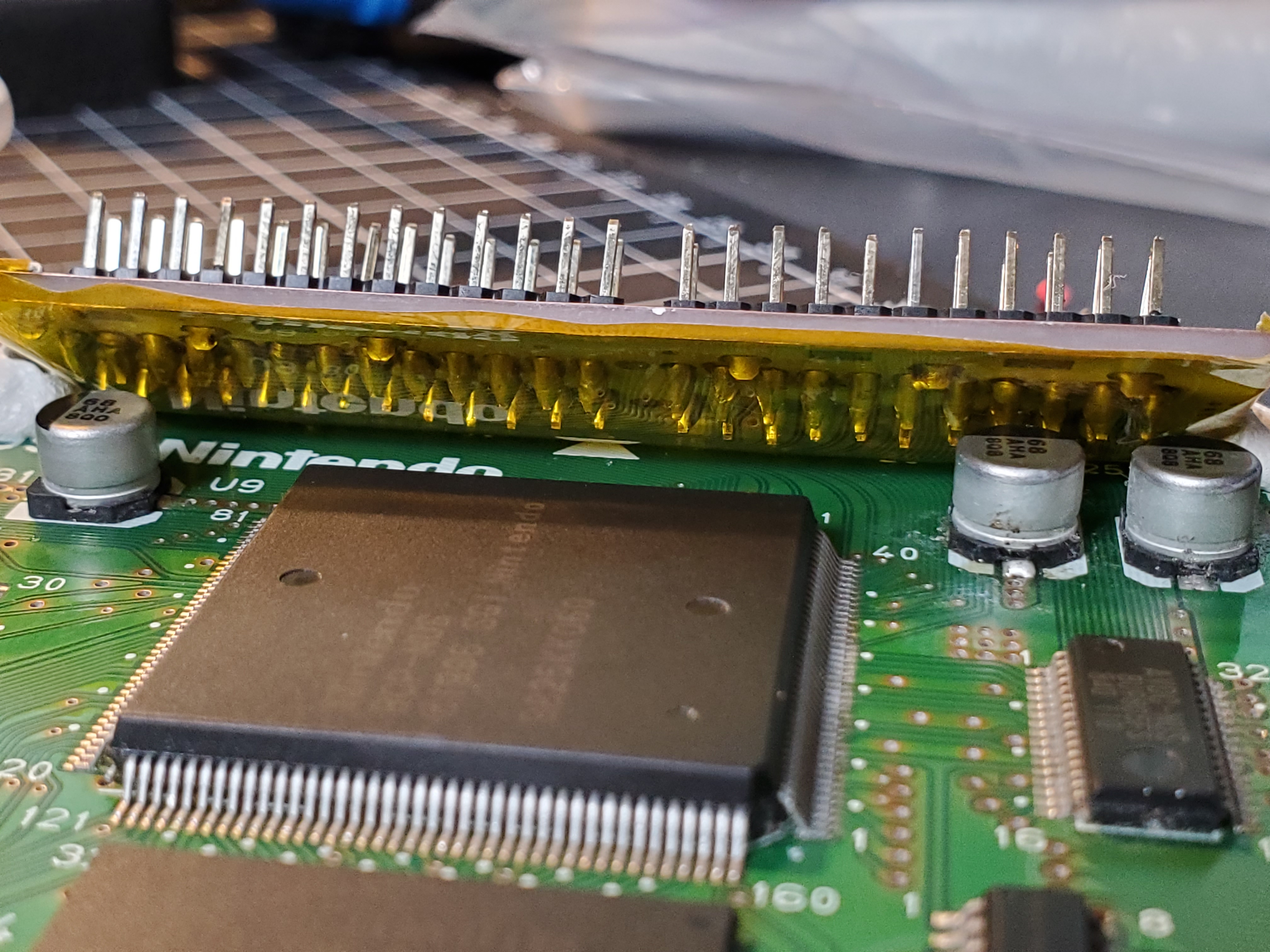

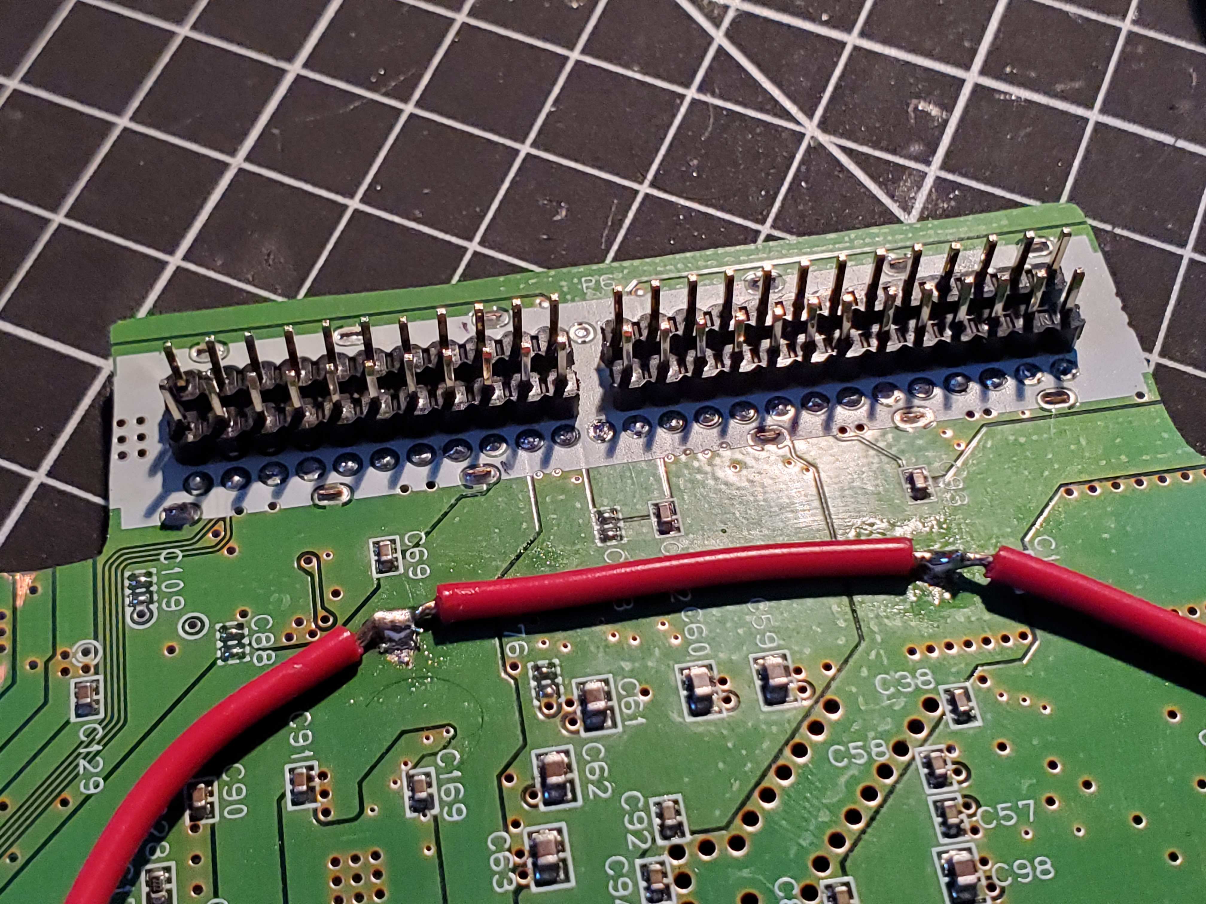

I've been super busy working on the portable. Ended up performing the board bend and decided how I'll finally relocate the cart slot: I'm taking inspiration from the SixtyFlex but putting my own little twist on it.
I soldered in some pin headers upside down in the holes where the cartridge slot normally resides, and bridged them with solder onto the exterior connections. I cut the board with a razor blade very carefully, resoldered the 3.3V traces and then went ham with some milliput. I probably put more than I needed, and I could have used hot glue, but I like the rigidity of the board now and I can always sand down some of the putty.

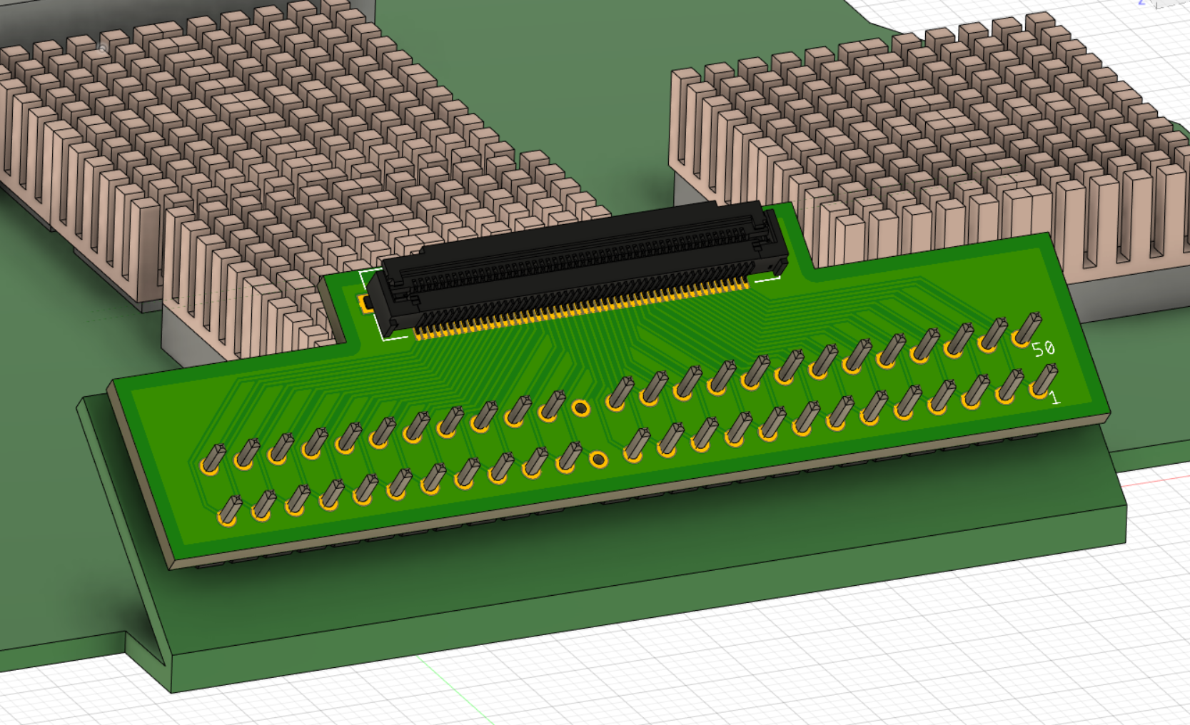

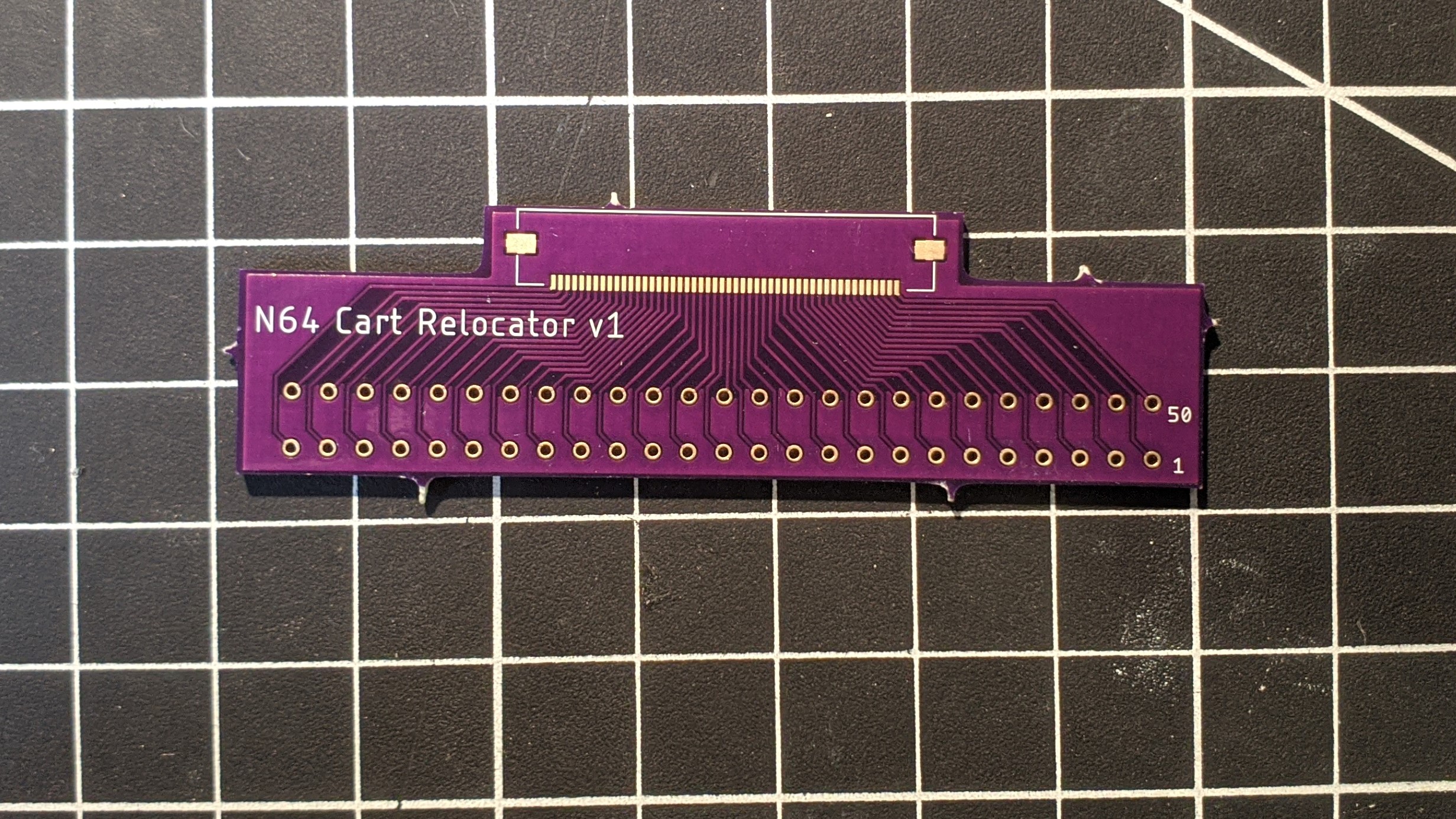

I'm going to be connecting the board via a breakout board with an FPC molex connector and flex cable. The same board is going on the cartridge slot and the motherboard, and I'm using a flex cable that has leads on opposite sides of the cable.

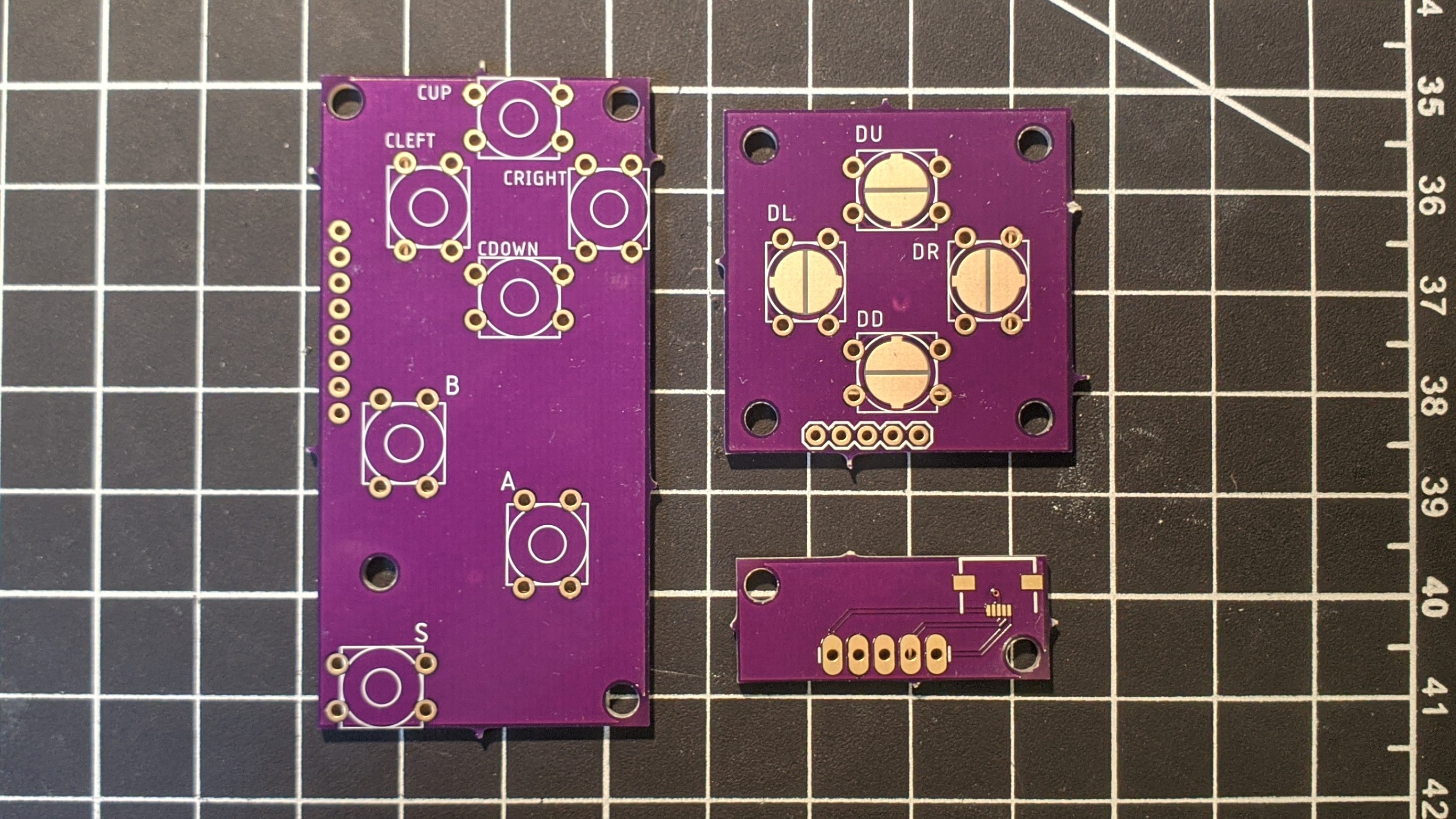

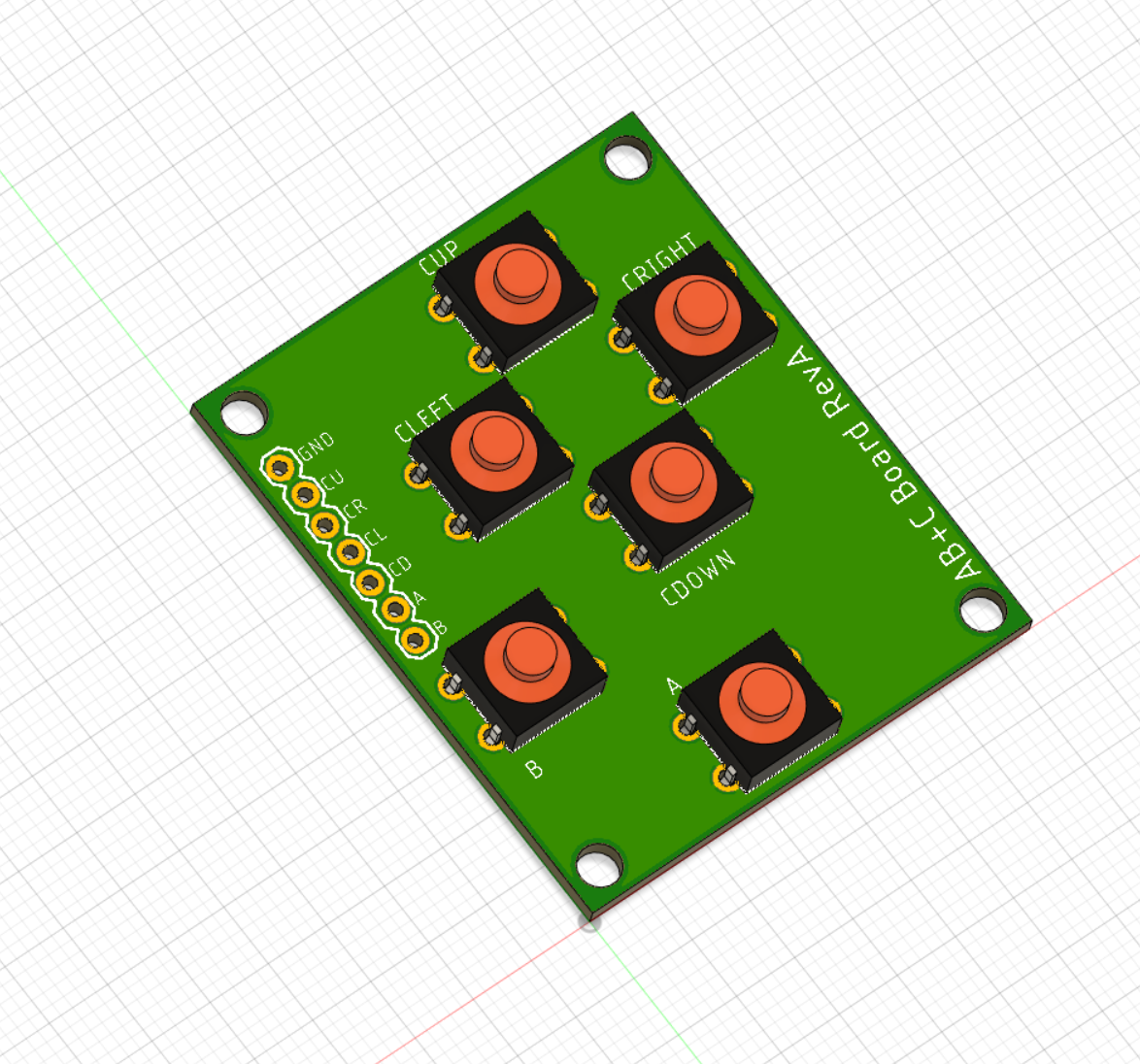

In addition to this, I've been hard at work on my custom PCBs for all the other components in the portable. I've got a board ready to go which has the CNT-NUS chip from a first party controller (along with the required resistors and clk chip), connections for an FRAM chip to have an internal memory pack, as well as an ATTINY for the stick converter.

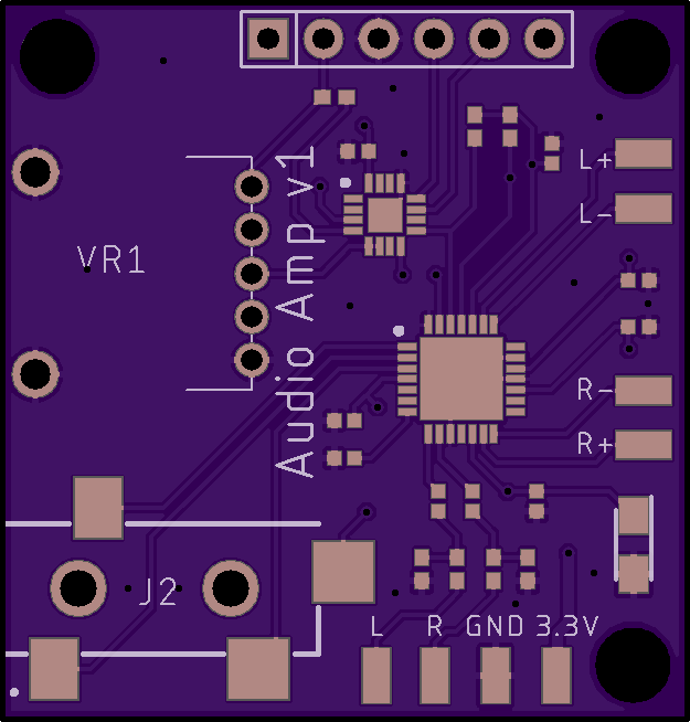

I reached out to JacksonS for a little help on using his audio amp solution in my portable. I'm opting for analog control of the volume via a potentiometer, much like the GameBoy Color audio control, so I was able to remove some of the components which handle using tact switches for audio control.
I also have boards ready to go for the AB and C buttons, the first party D pad as well as a board to use a DS4 joystick (10k pot), but I think I'm going to end up going with a Switch joystick instead due to the small size. I'm still pretty new at PCB design, so I'm a bit nervous to order my boards but my digikey cart is full, and I'm just about ready to pull the trigger.

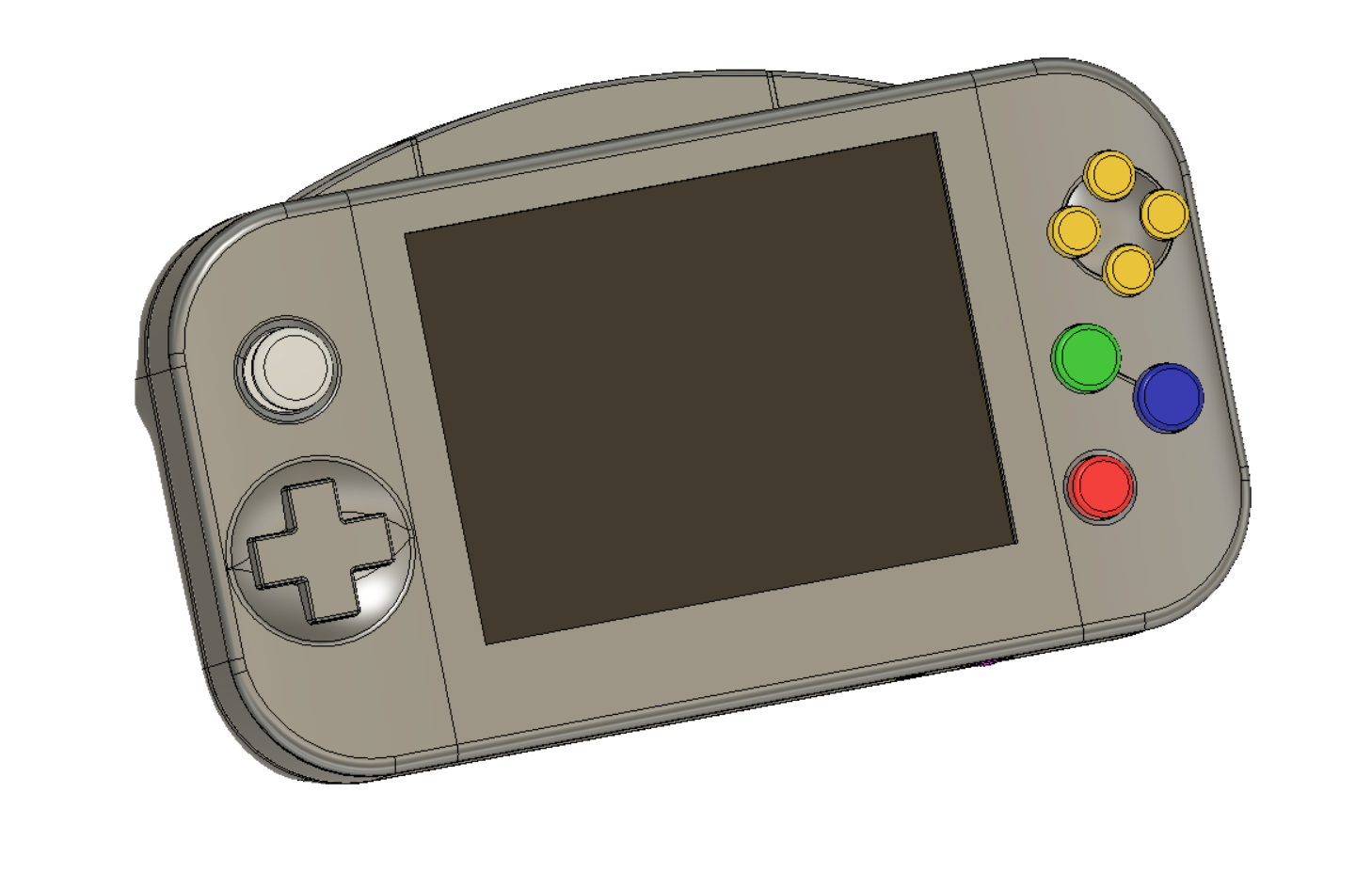

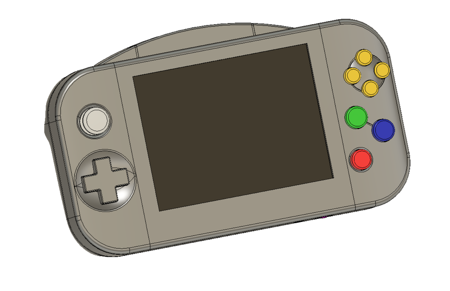

So I figured I'd hunker down and work on my case design. I knew from the start I wanted the case to have an N64-esque vibe about it, and to me that means a slightly curved front similar to the curve on the original N64 controller, as well as the circular features on the DPAD and C buttons. To do this curved front I'm going to be printing the case in several pieces and fitting them together with small pegs and then glueing filling sanding and painting. I'm getting to the point where I'm happy with the front, and after some test prints for sizing and tolerances it seems to be good. It's still missing holes for the speakers and I haven't decided where to put the board for controlling the screen yet (mainly because I don't have the screen and board yet, so I don't have the proper dimensions for it). Anyway here's a preview of it so far:
Currently working on the back, using the Wii-u gamepad shape as inspiration. I've got the basic surface shape down, but now I'm going in and hollowing out sections for the batteries, expansion Pak, motherboard and red battery board. After then I'll work on the triggers, I'll probably go dual Z buttons.
Love the case design!
Thanks, I can't wait to show off the internals, and I'm hoping I can pull off the back of it as I imagined in my head. So far it's going well, but I had to do a good amount of tweaking to get the surface model the way I wanted. The hardest part is gonna be the filling and sanding, but I've got plenty of time to worry about that...

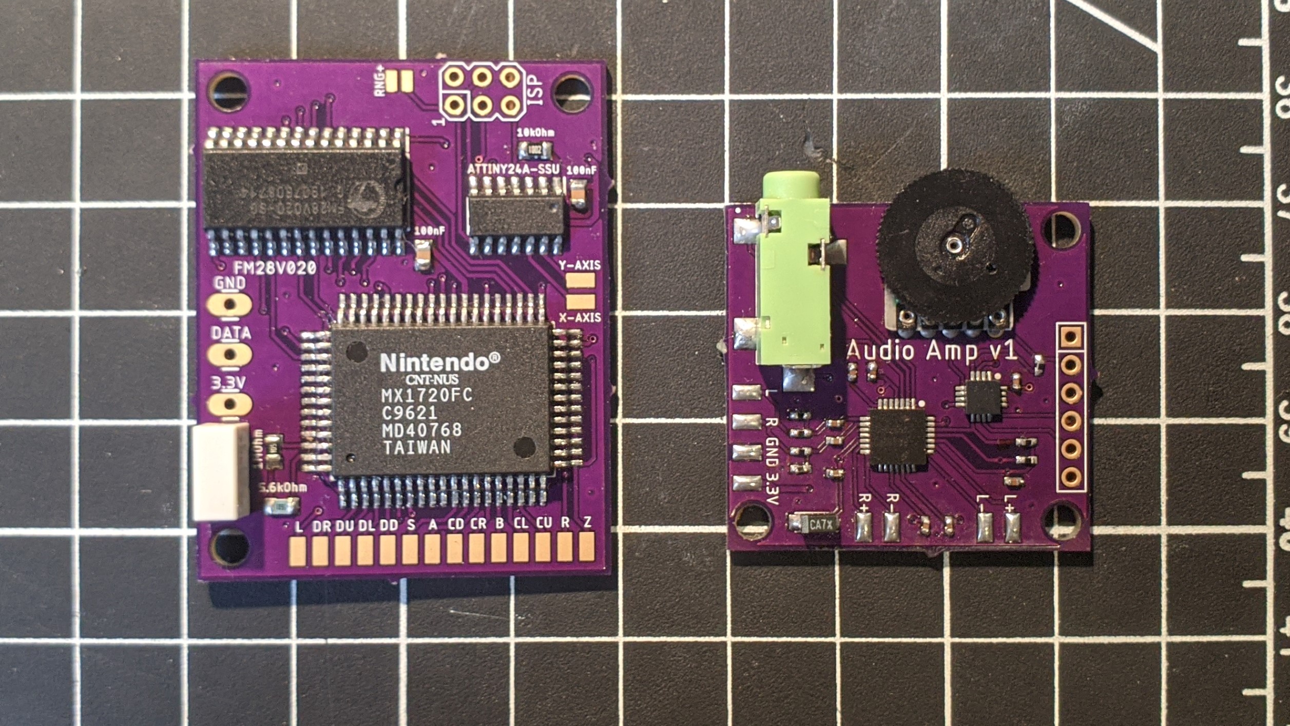

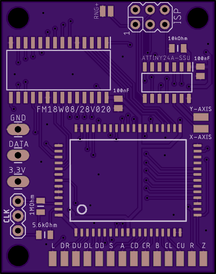

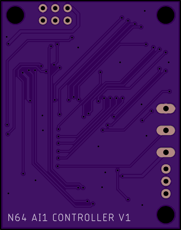

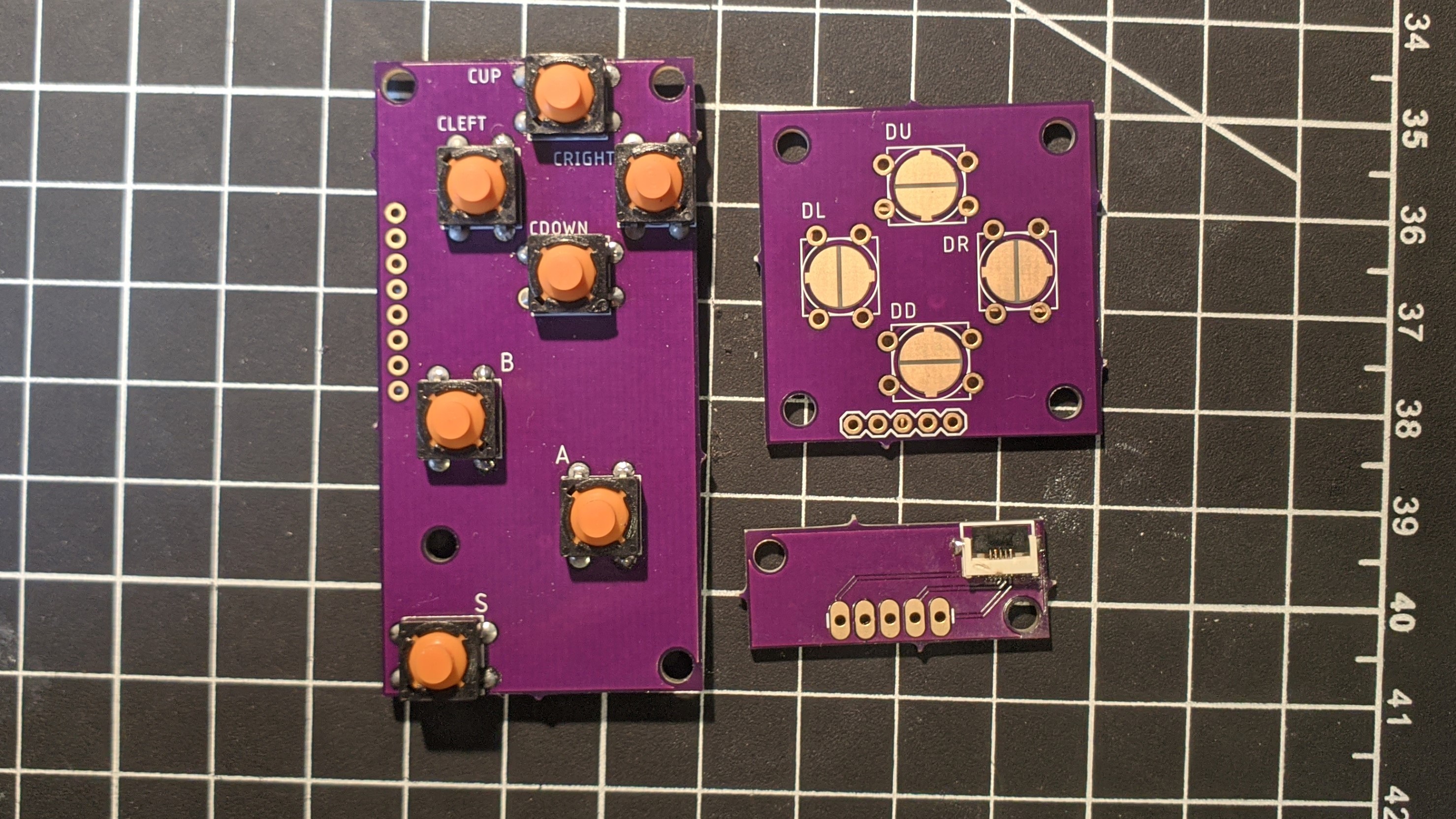

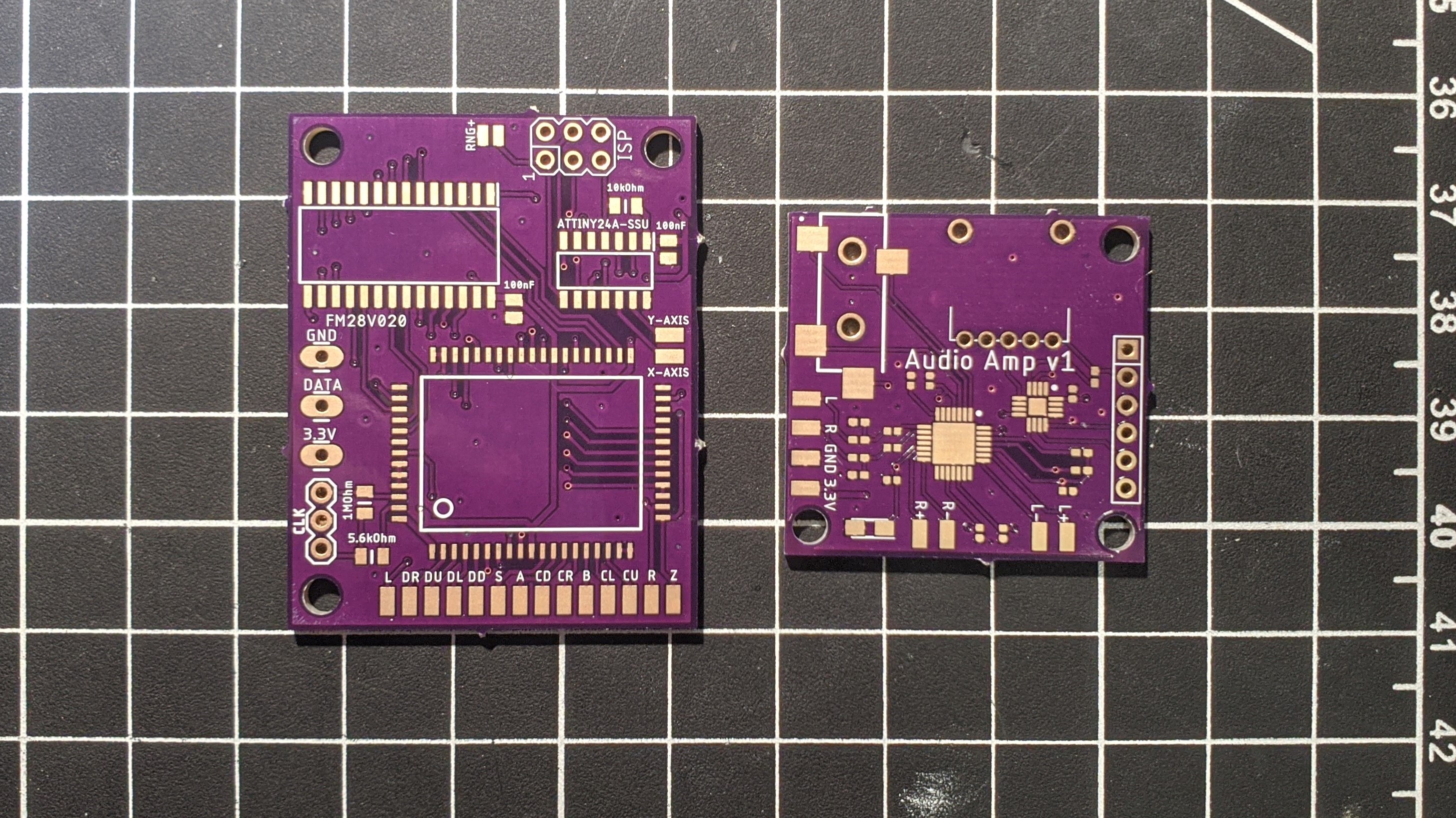

Got my PCBs in the mail on Friday so I spent the day soldering a few up. I ended up ordering from Oshpark, took around 2 weeks to ship to Canada but didn't get hit by import duties so that's awesome. The finish is really nice, only annoying thing is I need to file down the little tabs on the edges of the board but besides that I'm quite happy with them.
On the left is the all in one controller board. Features a first party N64 controller chip, FRAM for a battery-less internal memory card, as well as an ATTINY with the stick converter code allowing me to use the switch joysticks. On the right is the audio amp which I based off of JacksonS' amp, but removed the components required to control the volume digitally, and added in thumbwheel potentiometer much like the one on the Gameboy Color.

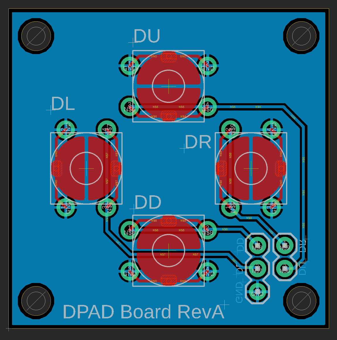

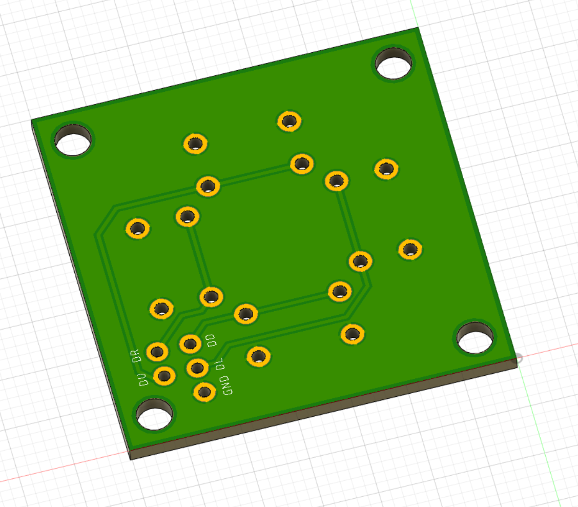

Next up are my controls. This is pretty self explanatory, squishy tacts for the ABC and Start buttons on the left. The DPAD on the top right which has the option of tacts or the rubber contacts of the OG controller (which I'll be using). I custom made the footprint for the buttons in Eagle, from preliminary tests it seems to work well. On the bottom right is the switch joystick board. I made it so it will fit on top of the switch stick and be part of what anchors it into place.

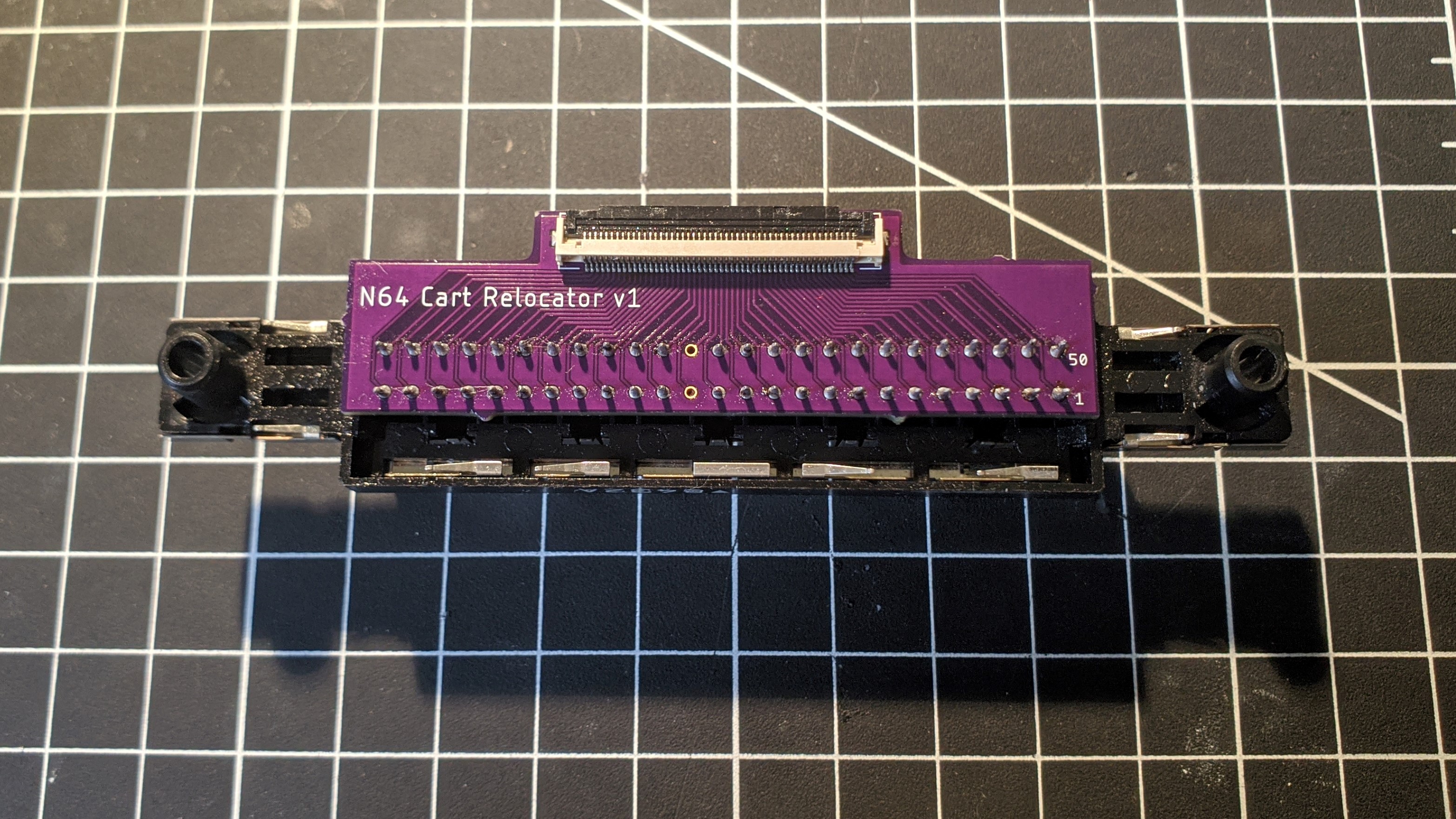

Finally I have the method of relocating the cartridge. Full props to Noah, used the sixty flex as inspiration for this design.
Here it is wired up to the cartridge slot
I was planning on using the same PCB on the N64, however I used 0.1" male pin headers on the board, which are too large to fit through these holes, so I'm going to have to order another set of boards with larger holes. That's a measure twice cut once kinda moment, but not a big set back because I'm still waiting on my battery management board, speakers and screen to get here. I'm thinking of ways I can test everything now but until I get my screen, speakers and new PCB, I may have to hook my controller up to my other N64 to make sure all is good. Anyways, time to continue working on the case I guess!
