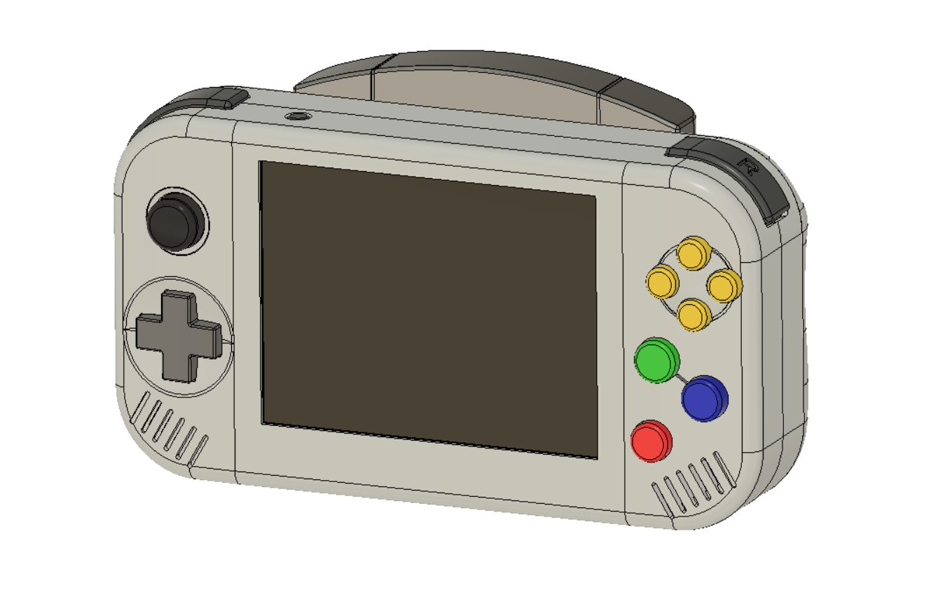

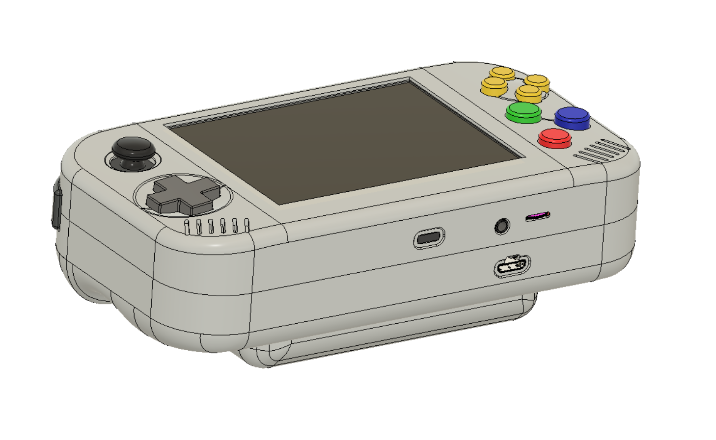

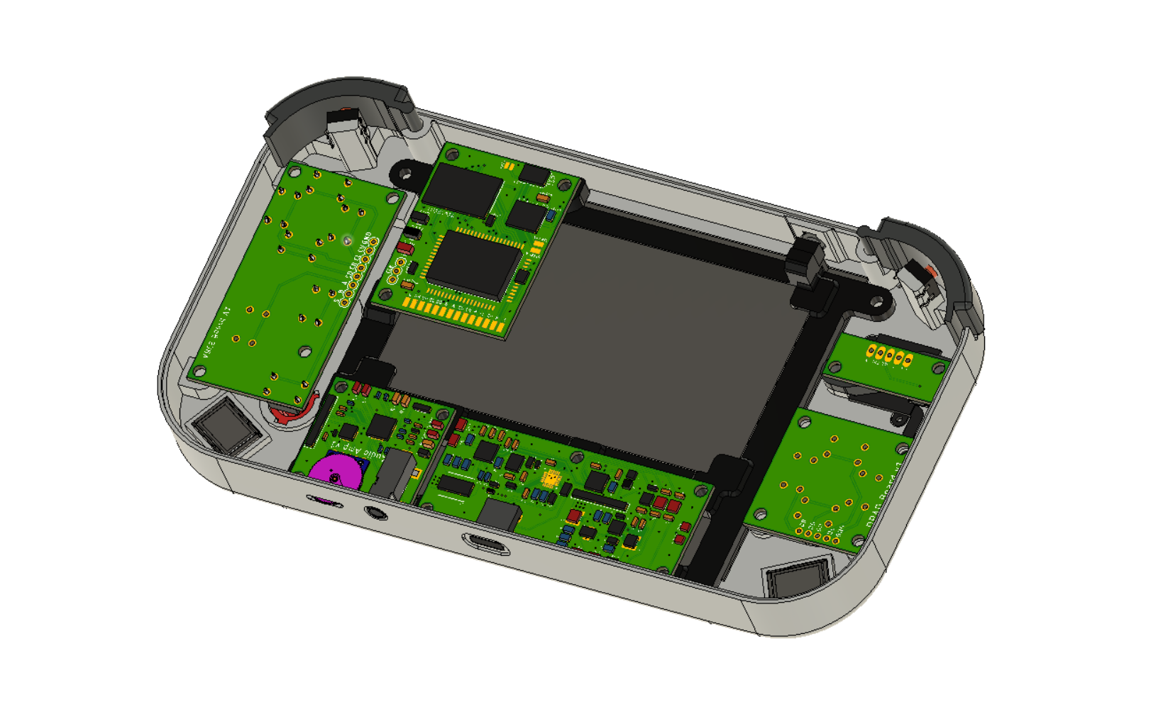

While awaiting all these components, I've done tons of work on my case design. As was with previous iterations of my case, it's heavily inspired by the WiiU gamepad, but I also took inspiration from the N64 controller for the DPAD and C button layouts, as well as DMG for the speaker grill. The bracket that holds the screen and LCD driver in place doubles as a way to mount the N64 controller PCB, audio amp and PMS/USB charging board.

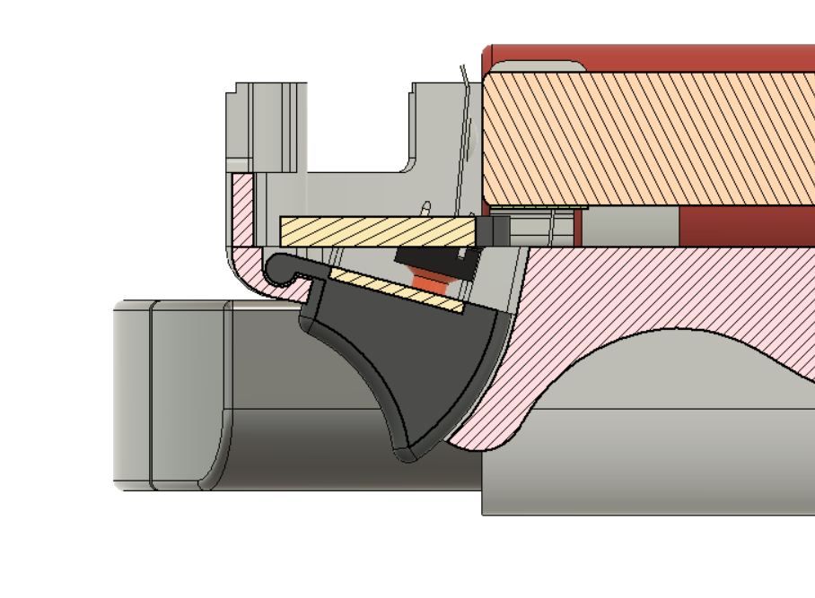

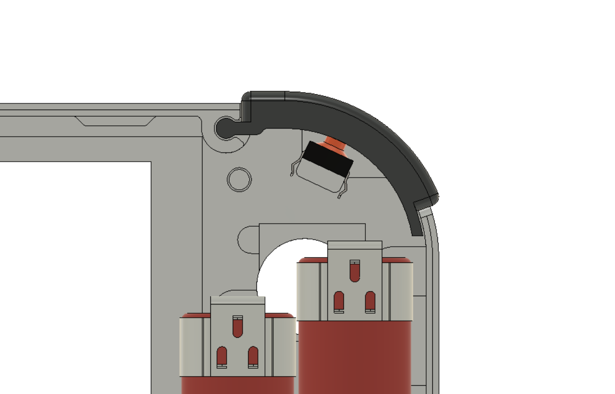

I've been able to do some prototyping for my trigger designs and boy do they feel good, When I print the final versions I'll post a video of the buttons being pressed. The ZL and ZR proved the most challenging, but I think the hinge type mechanism I have is what I'll be using in the final version because it feels pretty good.

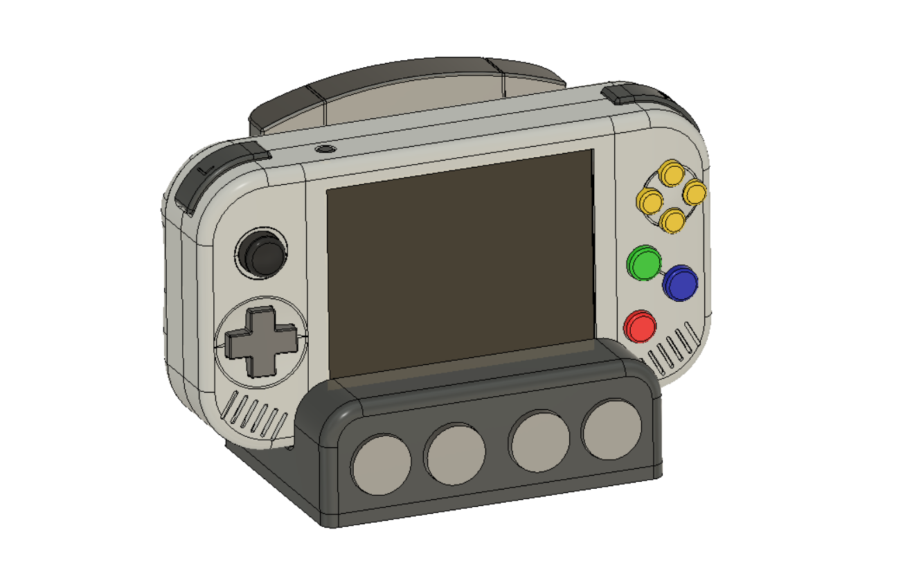

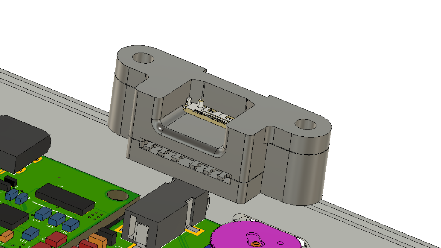

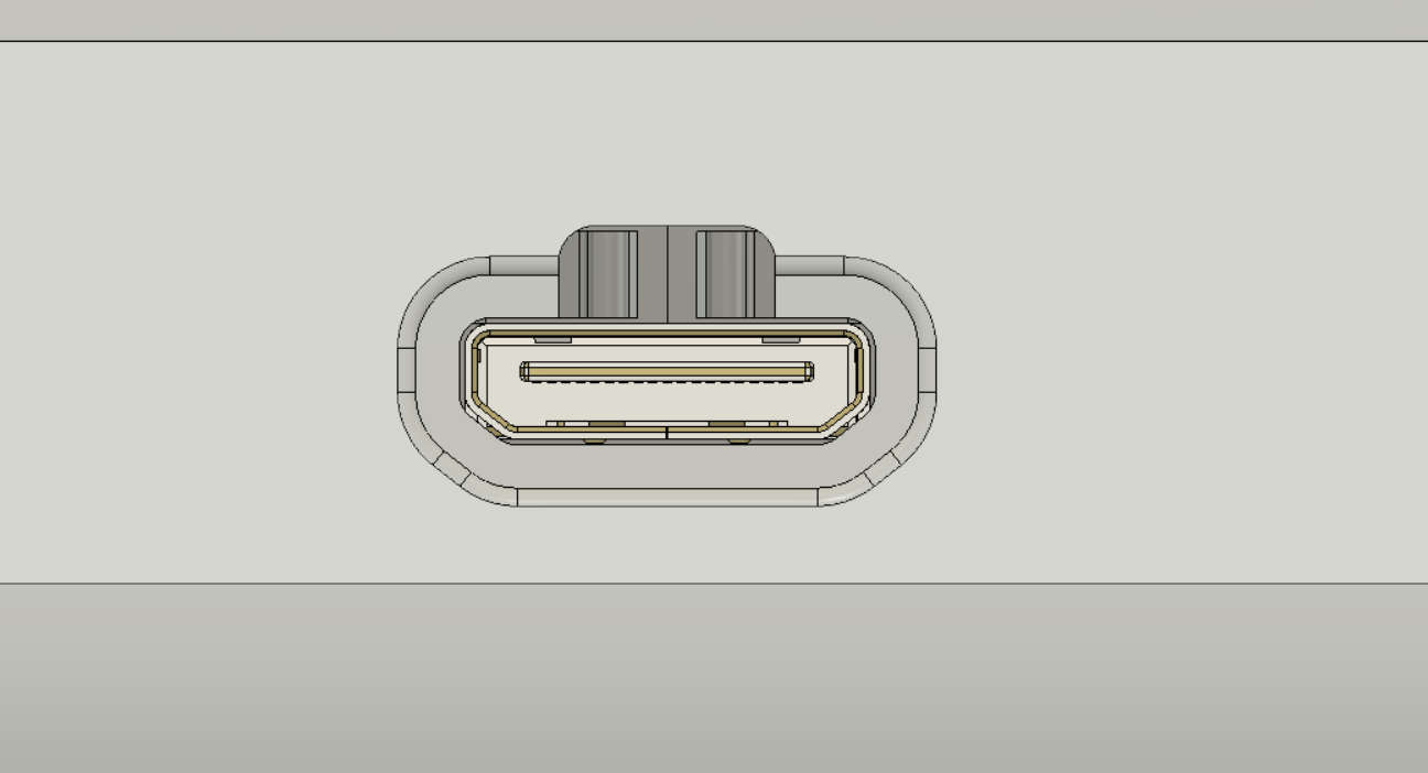

One of the original goals of my design was to have this portable be able to be docked for charging, video out and 4 player mode. After lots of the design process, I wasn't sure if I'm going to be going through with that but I think I have devised a way to do so. I prototyped a 3D printed connector which sandwiches a miniHDMI and 2 SPST NO switches together, which will be used to switch P1 and video out. The switches will be pressed in by a part of the dock printed next to the male miniHDMI connection. With the miniHDMI I have 19 pins to work with, and I need to route P1-4, video out and 3.3V, so each can have 3 pins and the left over will be given most likely to the 3.3V line. Now I should have made a custom PCB or gotten a miniHDMI on a breakout board, but this idea only came to be after I sent out my second PCB order, and I'm not gonna risk waiting on a miniHDMI breakout board from China to get here on time. I'm going to try to hand solder to the miniHDMI pins.... it may not be possible because they're damn tiny, but I will try none the less. If all else fails, I'll whip up a tiny custom PCB.
And finally, I've settled on not painting it the portable, opting to go the wet sanding route. I was able to source some PLA with specific pantone colours which I find closely resemble old school Nintendo controller grey colours which I'm super stoked about, and those are the colours you see in the CAD models above.
That't it for now. There's still some small internal structural features I need to make to hold the N64 motherboard in place, and add screw holes for the portable to be held together, but other than that the design is almost complete. Once my screen arrives I'm going to be prototyping the case, probably in black PLA since I have a few rolls of that lying around.
Love those hinge mechanisms. This whole project is looking super good, looking forward to more!
Thanks, I'm gonna try and post a video of the button mechanisms at some point! Now comes the hard part, getting all the electronics to play nice together....

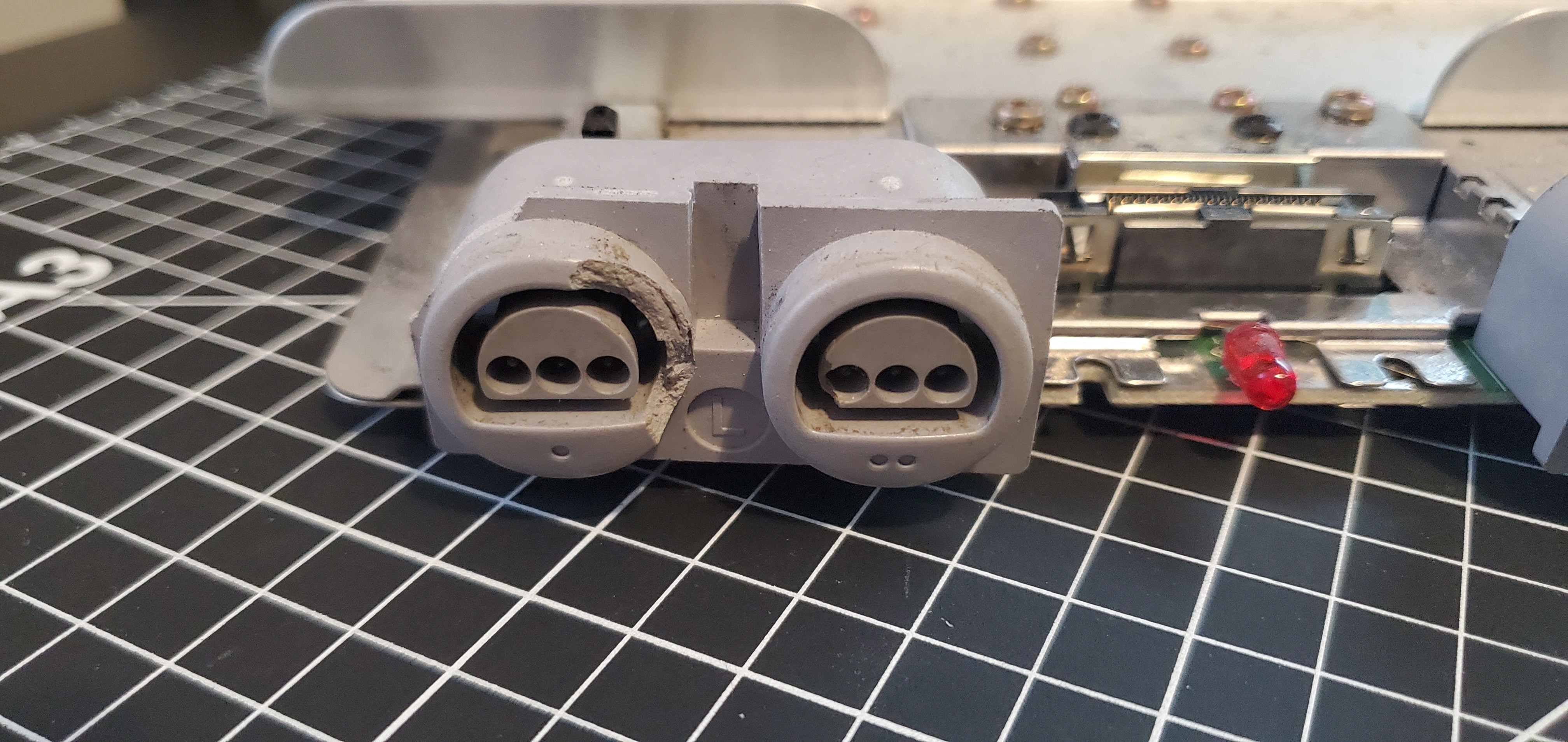

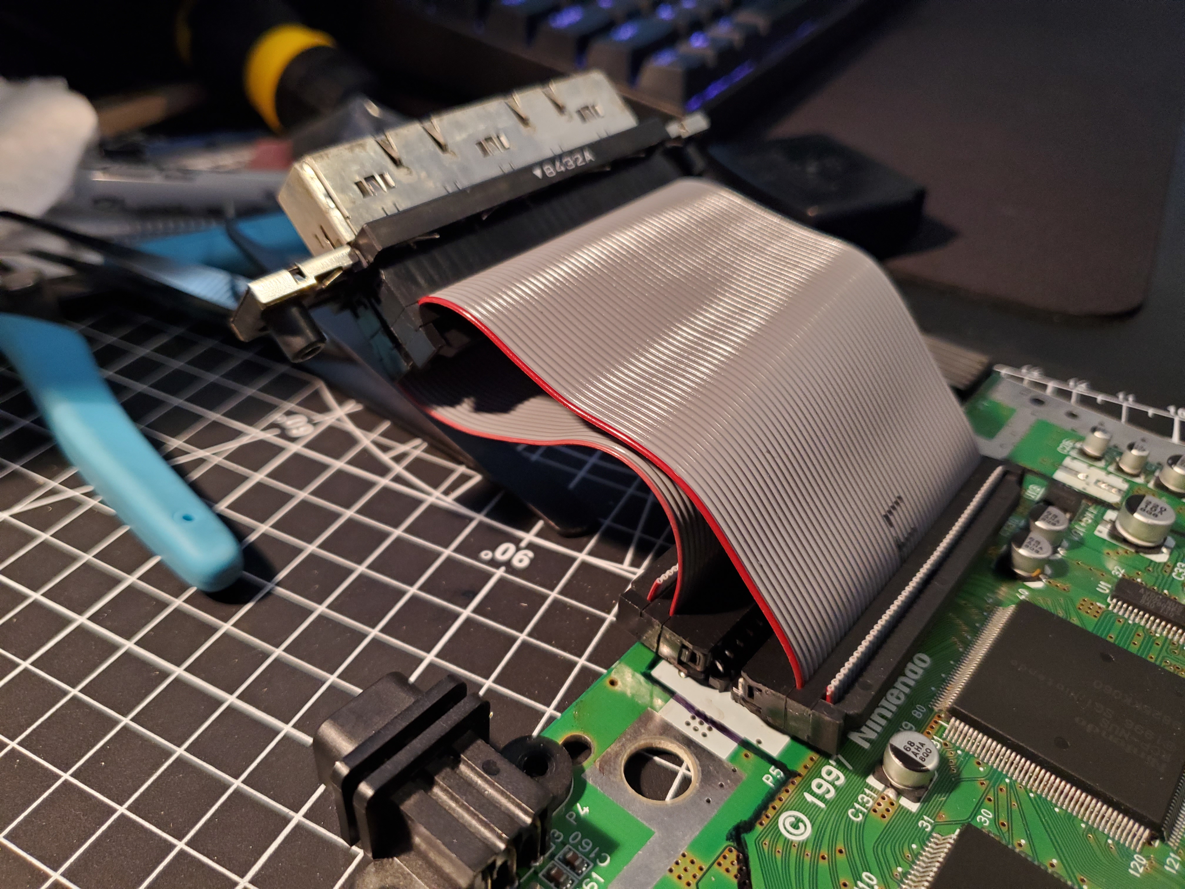

In the past month or so I've been printing lots of parts to test fit for my PCBs and buttons, I even printed out a full case prototype which allowed me to pinpoint a few issues that needed correcting. For the past few years I've been using heat set threaded inserts instead of captive nuts or threading into the plastic, and that's what I'm going to be using for this design.

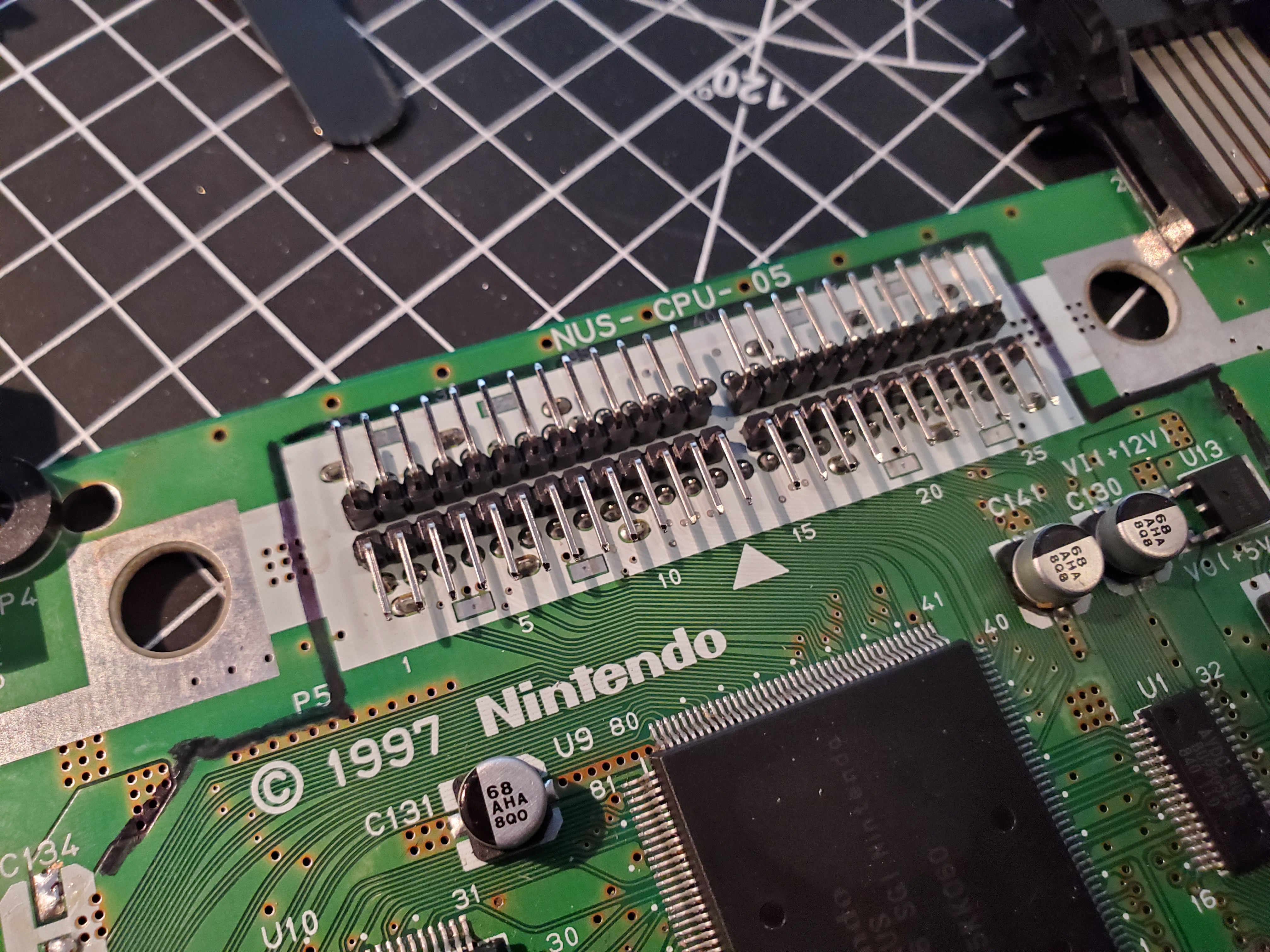

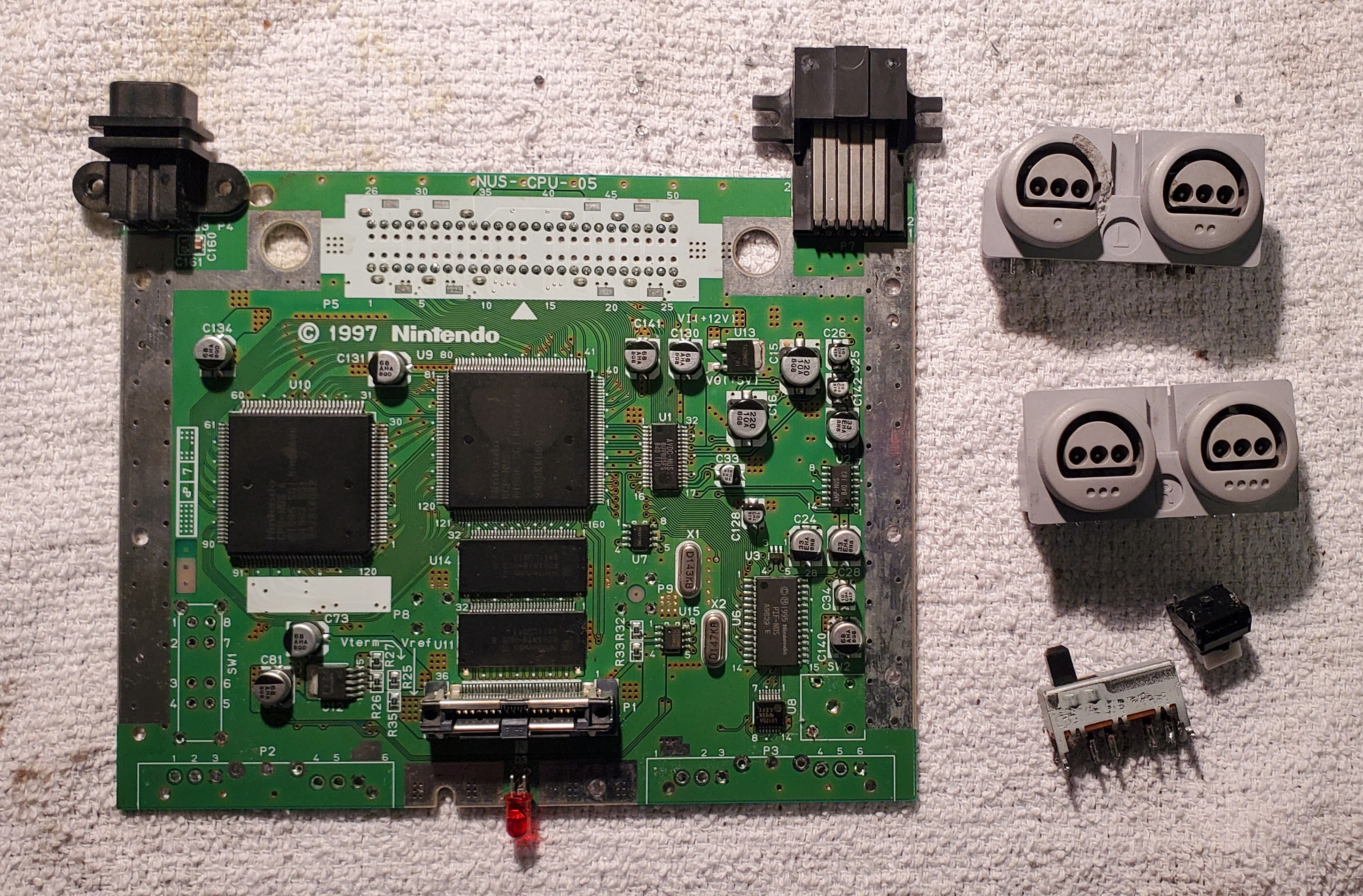

Additionally, I've managed to get a trim working of a Rev05 board after I somehow killed a Rev03 (won't boot, no clue why). I was able to confirm with this trim that the PMS/USBC PD board I made work perfectly, as well as the cart relocation works just fine. The case feels hella comfy, and I'm excited to print it in the final colour as well as wet sand it to smooth perfection. Here's a few photos of the prototype and some internals.

Damn dude, this thing is going to be quite a beauty when it's all finished. Looking really great so far! It reminds me a lot of some of @LOCtroviser's early N64Ps but having it all tightly integrated with the custom PCBs will make it one of the best portables out there for sure. Keep up the great work!!!
Thanks, I'm really hoping the wet sanding will give the case a nice texture, the colour filament I found is really close to the OG grey controller coller, would be awesome to see it looking kinda OEM

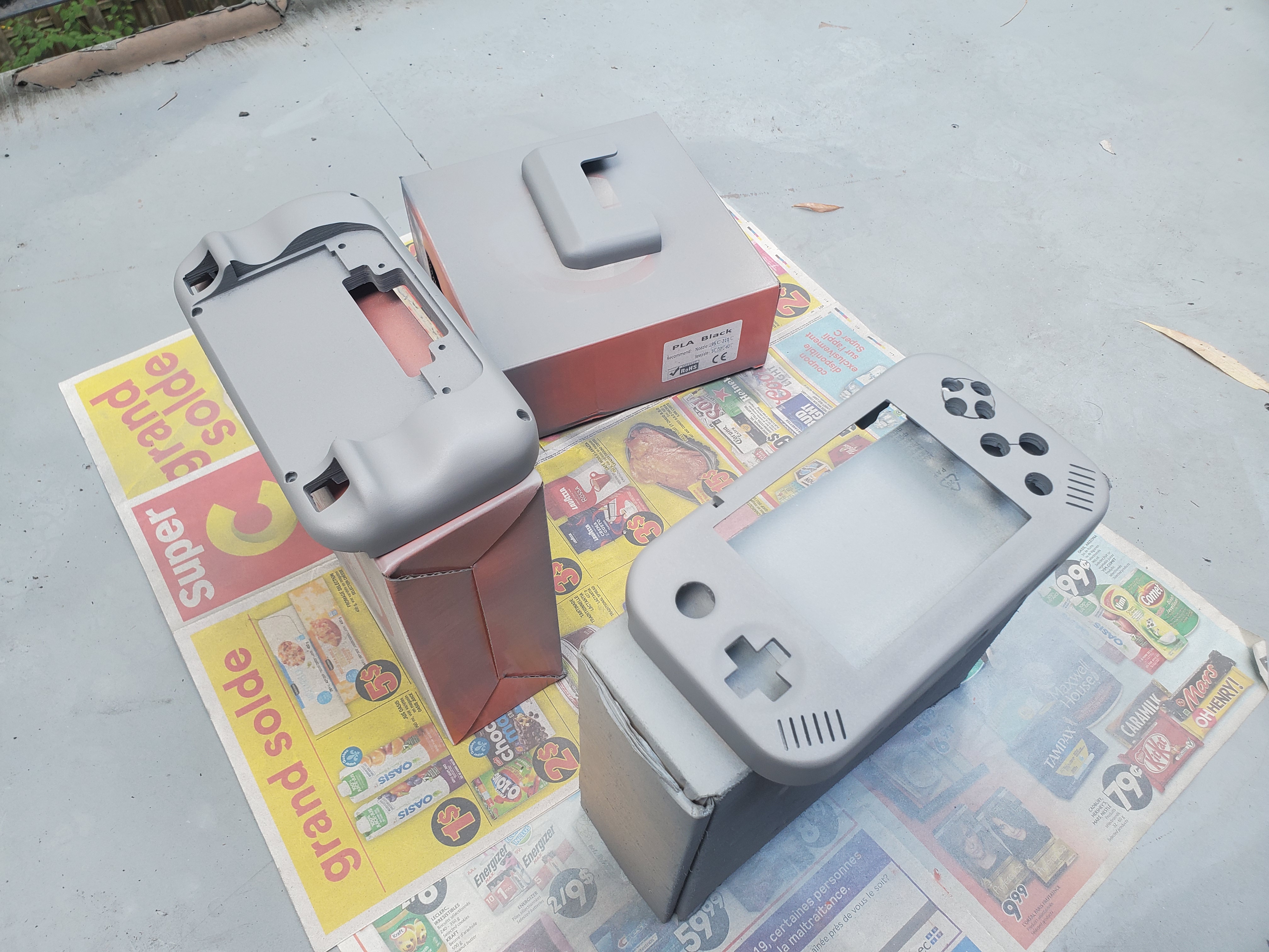

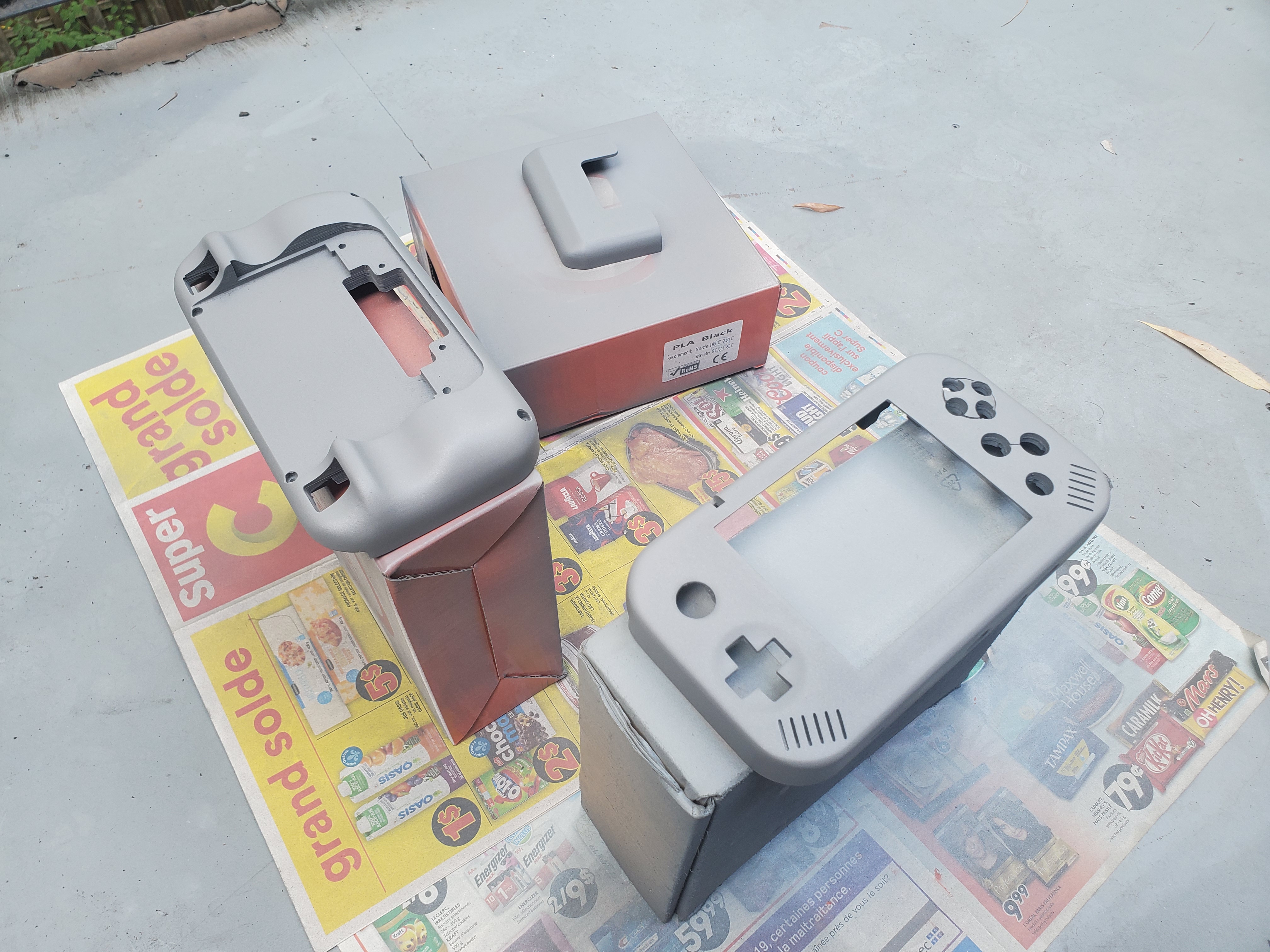

So not much has been happening as late besides case work. I initially wanted to just wet sand my case, but in the end the seams between glues pieces turned out kind of ugly. In addition to the colour of the PLA I got not being exactly what I wanted (I wanted something like the OG N64 controller grey, I got a more Wii white colour) I decided to bite the bullet and paint the case. So here it is being painted. Clear coat is going on today, gonna let it dry with a fan on it overnight and see how it looks and feels tomorrow afternoon. Then maybe Ill start assembling !
So not much has been happening as late besides case work. I initially wanted to just wet sand my case, but in the end the seams between glues pieces turned out kind of ugly. In addition to the colour of the PLA I got not being exactly what I wanted (I wanted something like the OG N64 controller grey, I got a more Wii white colour) I decided to bite the bullet and paint the case. So here it is being painted. Clear coat is going on today, gonna let it dry with a fan on it overnight and see how it looks and feels tomorrow afternoon. Then maybe Ill start assembling !View attachment 13428
Hot damn this is looking sexy as fuck. I hope you don’t encounter any more issues with the N64 mobos and you can complete it on time! Those curves look so comfortable. Good luck!

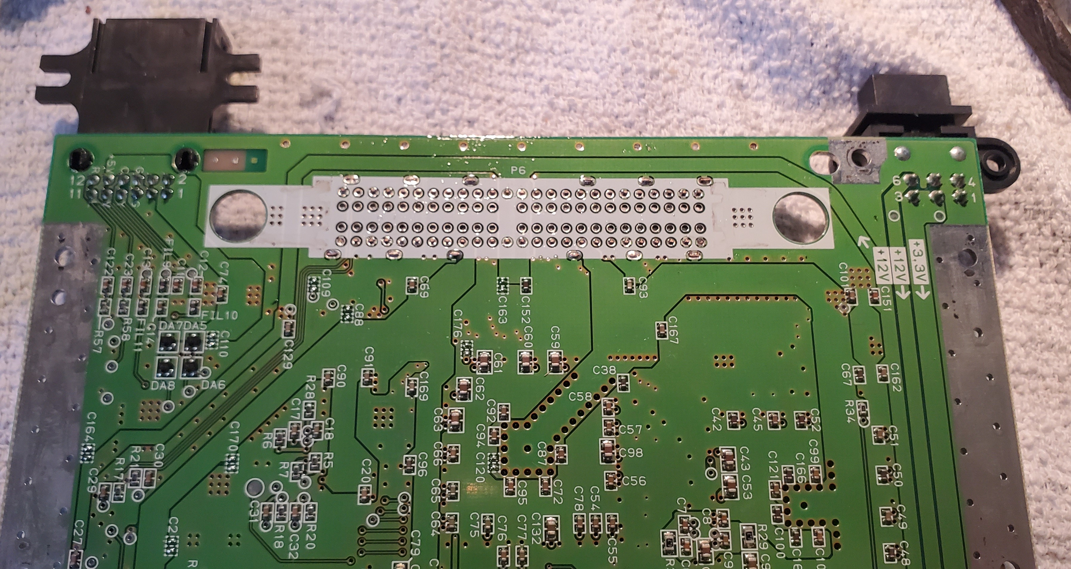

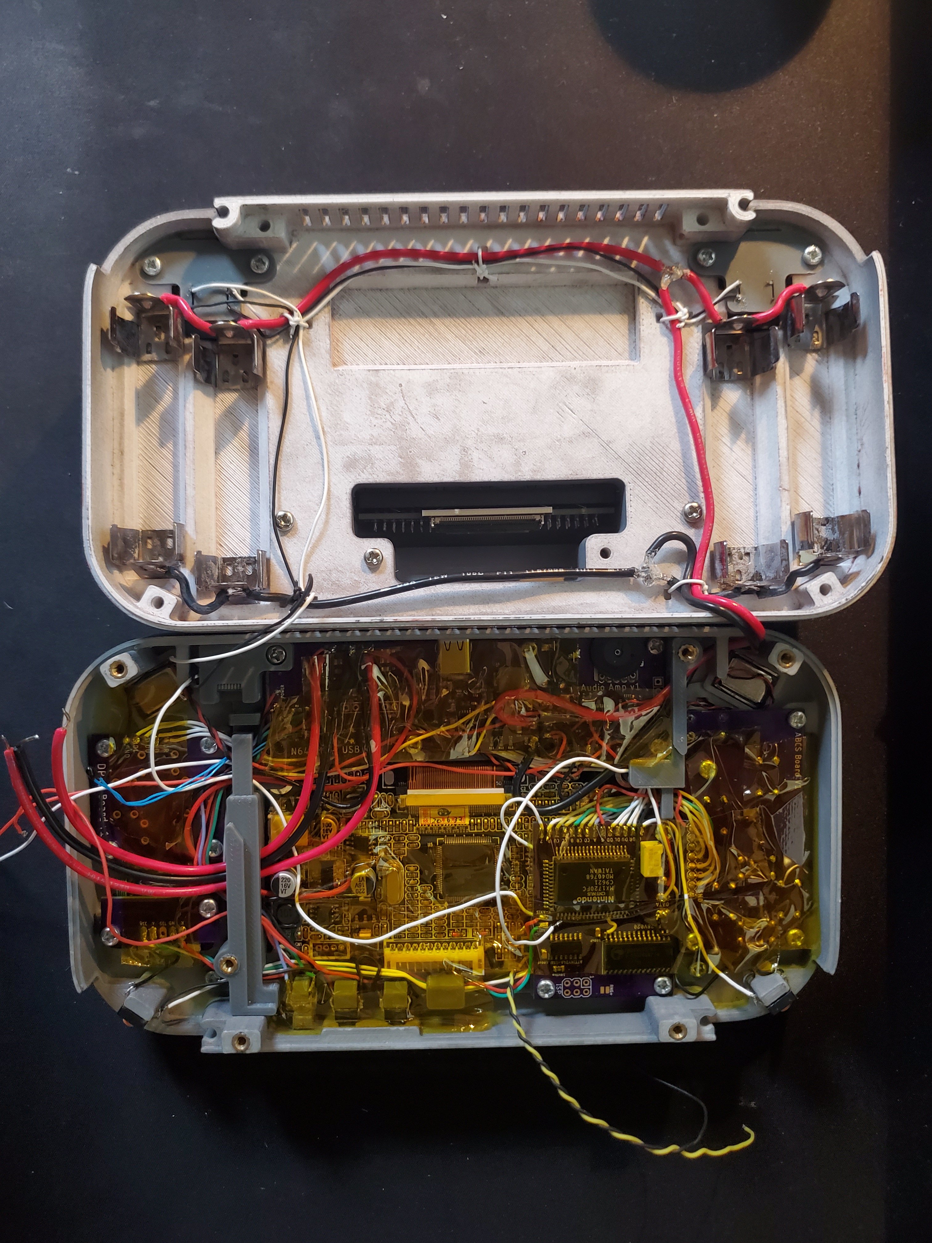

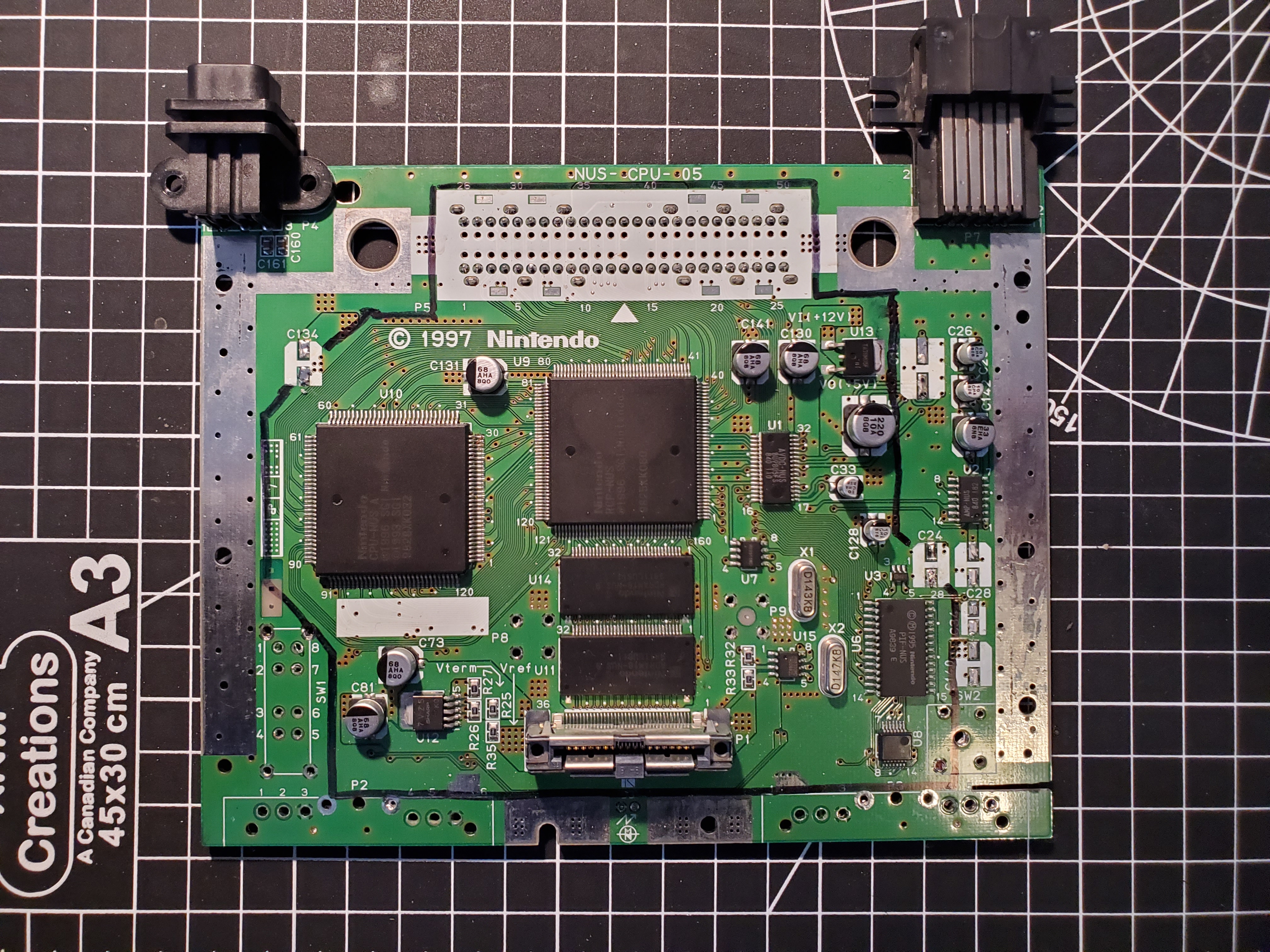

Been a while since I've updated. Audio amp, USBC charging and PD are working perfectly. Controller board works like a charm as well. Unfortunately I'm having more N64 board issues. I performed the board bend and it seemed to be working okay, but a few traces weren't connecting anymore and eventually let me to try and RCP the board. RCP worked fine, but then for some reason which I believe to be a short, the board died mid test. Video went dark and static then nothing :(
I've been quite busy with work this August as well so the timing for the competition just didn't work for me anymore
This won't stop me though, I'll find a new N64 board to terrorize soon and plan my board bend out more methodically, perhaps with a dremel this time. This gives me more time to get a working trim, and test my dock and video + P1 switching plug I designed. For now here's a picture of the internals. Lots of kapton tape, but I'd rather that than a short :P
