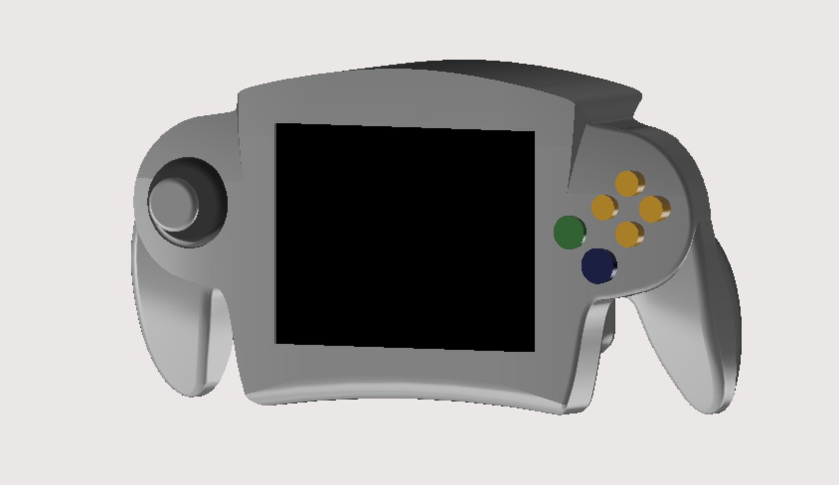

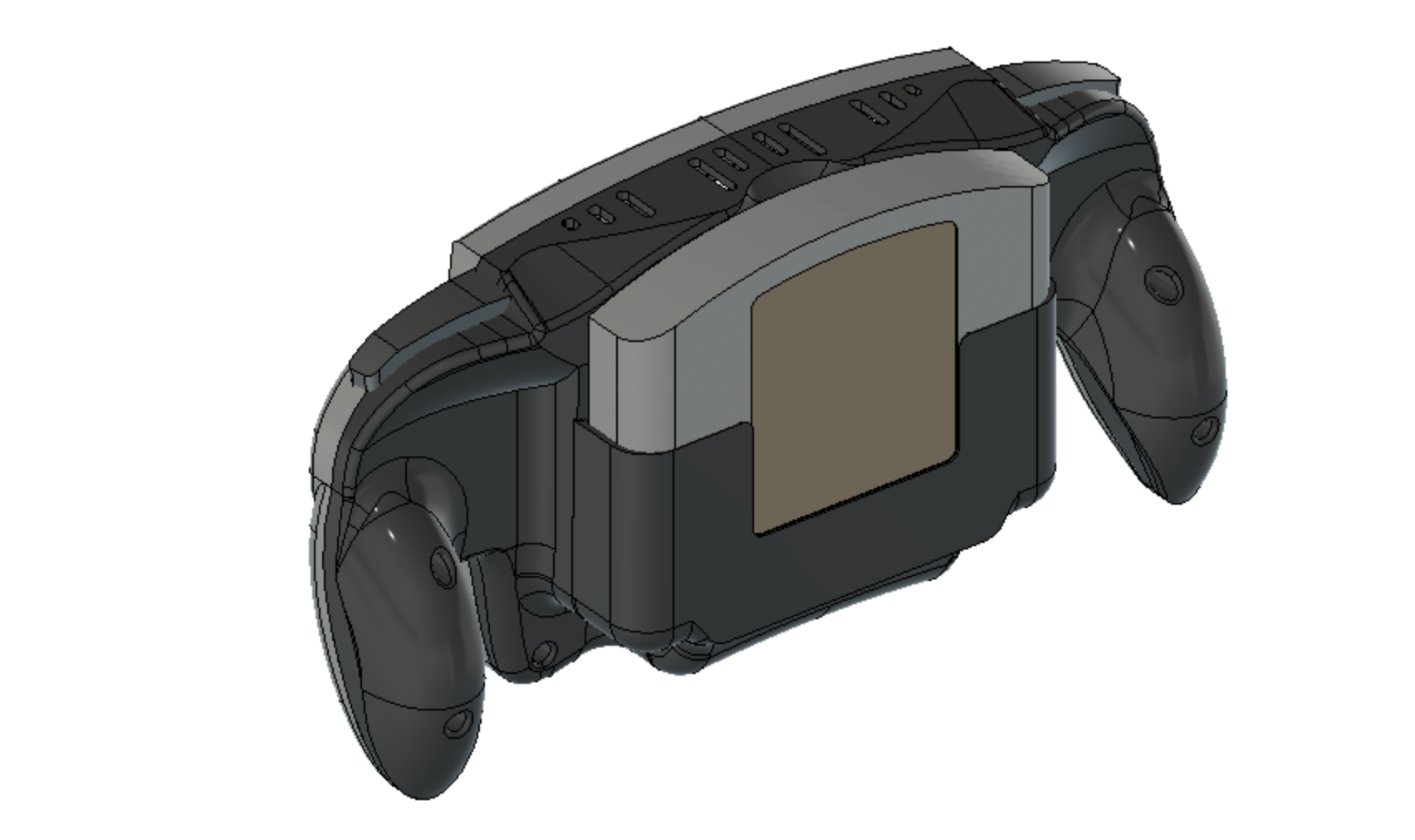

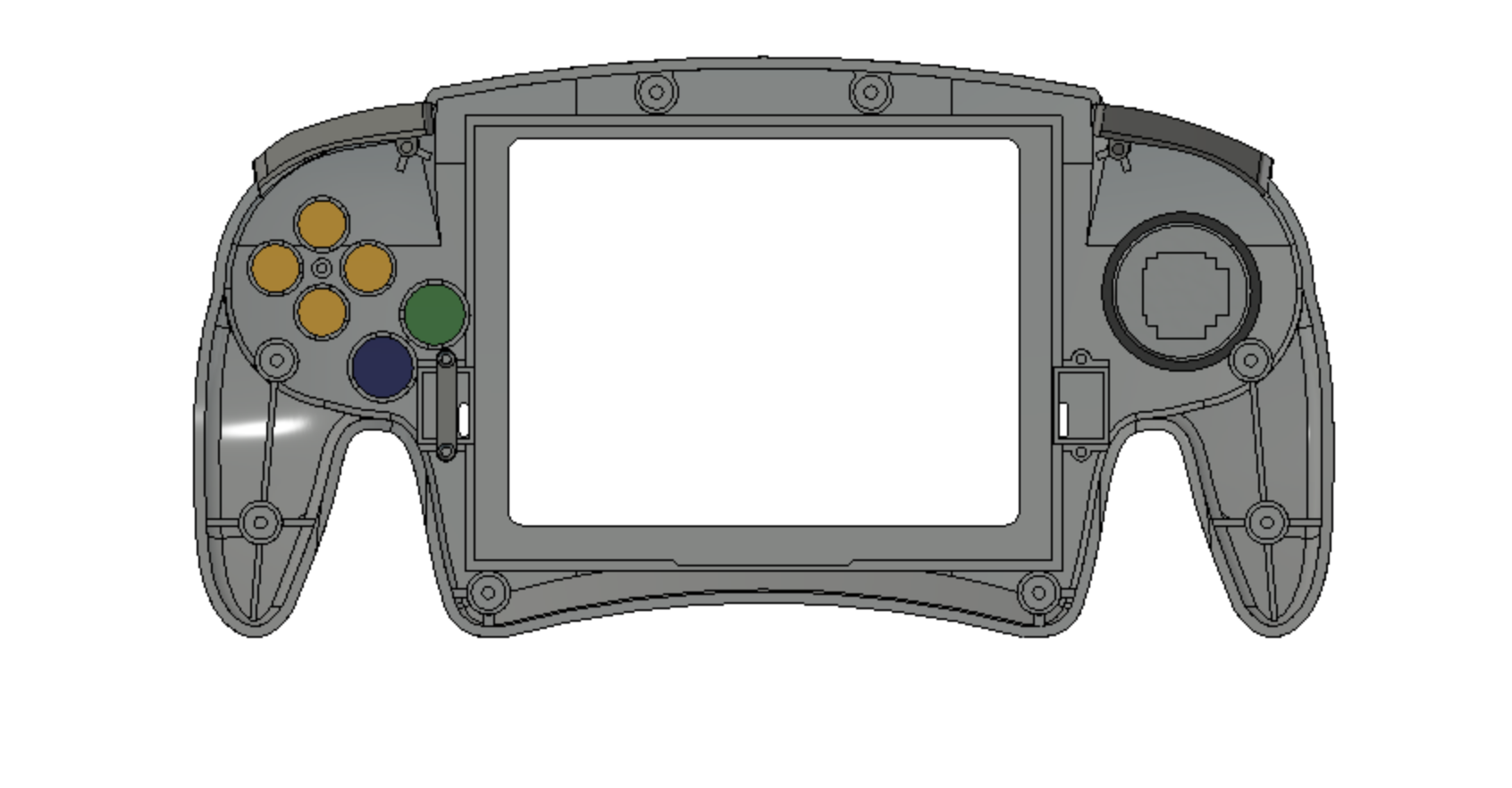

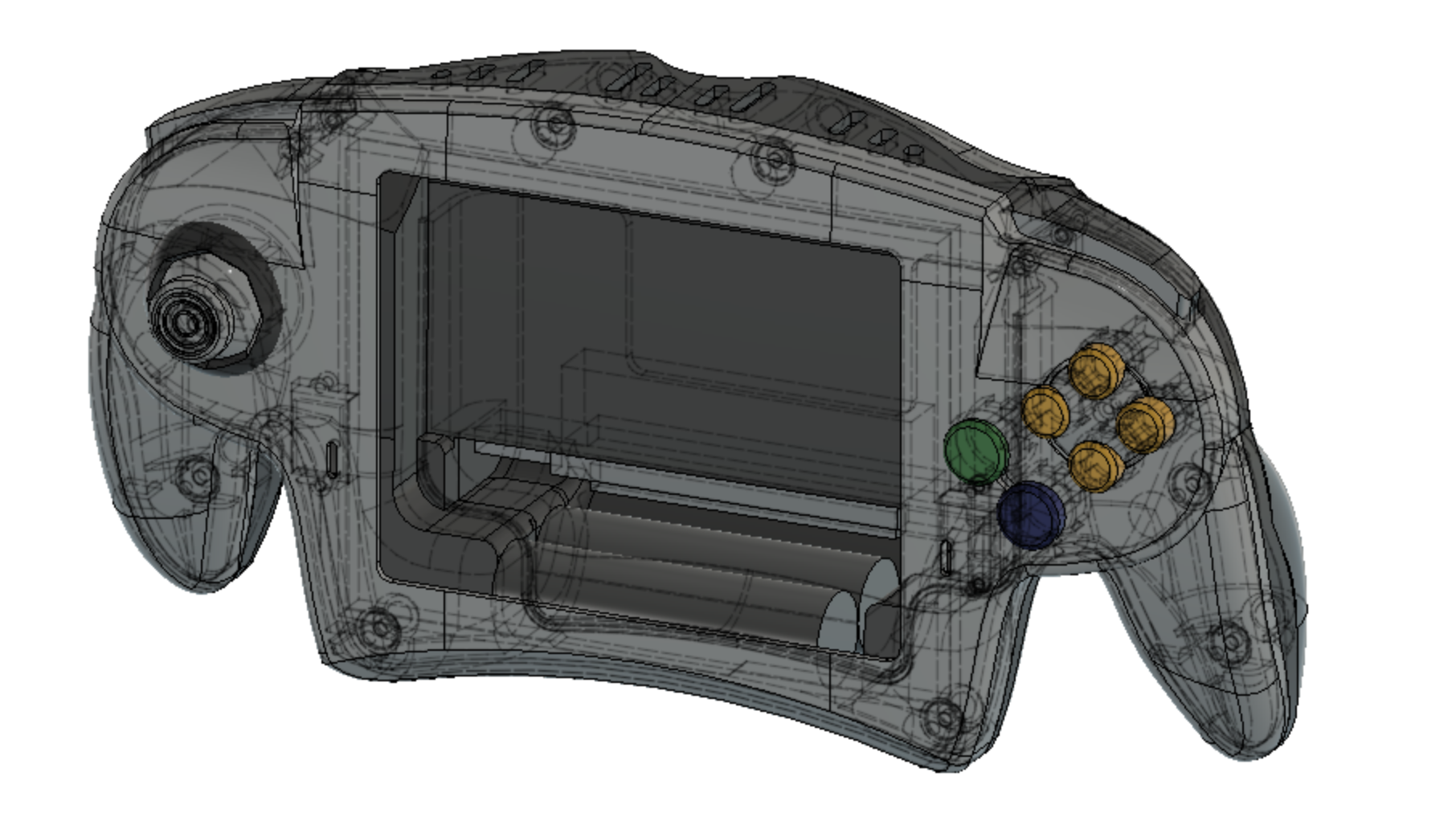

You do not want to see how messy my fusion Timeline is lol. I am working everyday on this case design, here's a few pics. Will use all OEM buttons, L button will act as Z, No Dpad as of yet, thought about using a PSP slider as a small D pad. OEM screws as well
Also test printed a side of the handle and I got it feeling pretty identical to the OEM controller
I plan on making button combos to adjust screen settings

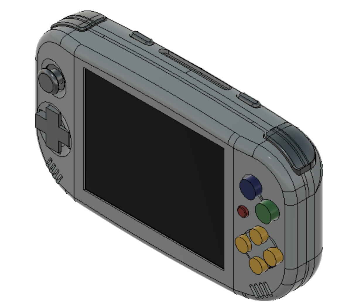

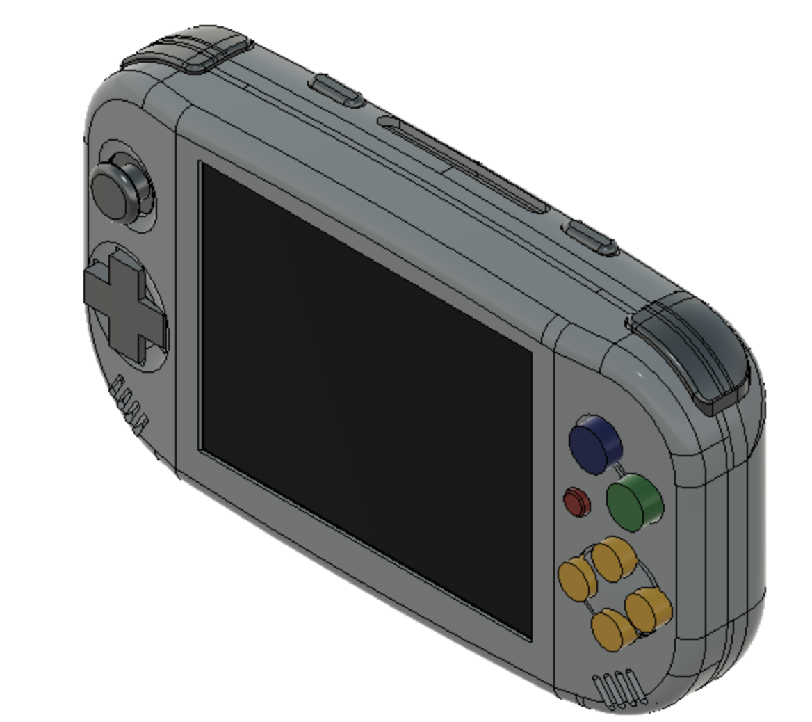

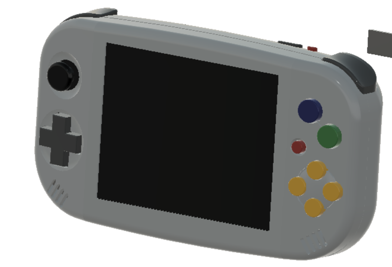

I've put work into this almost every week since my last post. Unfortunately, I did several test prints of the controller-inspired design and it just is not comfortable to hold. Also, the unit needs to be so thick in only the middle, because the controller is very slim, which makes it not too great to look at...... so sorry to those looking forward to that design.
However, I returned to my original design and am making quick progress. The internals are fully designed, except for a mount for the motherboard. This unit will use my ED-64 plus pressed up against the heatsinks, which will be actively cooled by a very slim, metal housing blower style fan. The two long buttons on top are for volume and brightness. The long oval holes will have a dust cover mesh sheet glued to the inside of the housing. The power button will be transparent for LED battery status. Gman's PD charger is here as well
I actually really love the new design, it looks extremely sleek, kinda like an N64 G-Wii but more curvy hahaha. Ik you're pretty far into this design, but one thing you can do to improve the overall thickness is put the batteries behind the controllers and shape the grip to fit them, kinda like an N64 Steam Deck look. If you planned on using 4 18650s you could move to 2 21700s instead possibly and get fairly decent battery life? Just a thought, no need to go crazy if you're already satisfied with this design, its quite good either way!

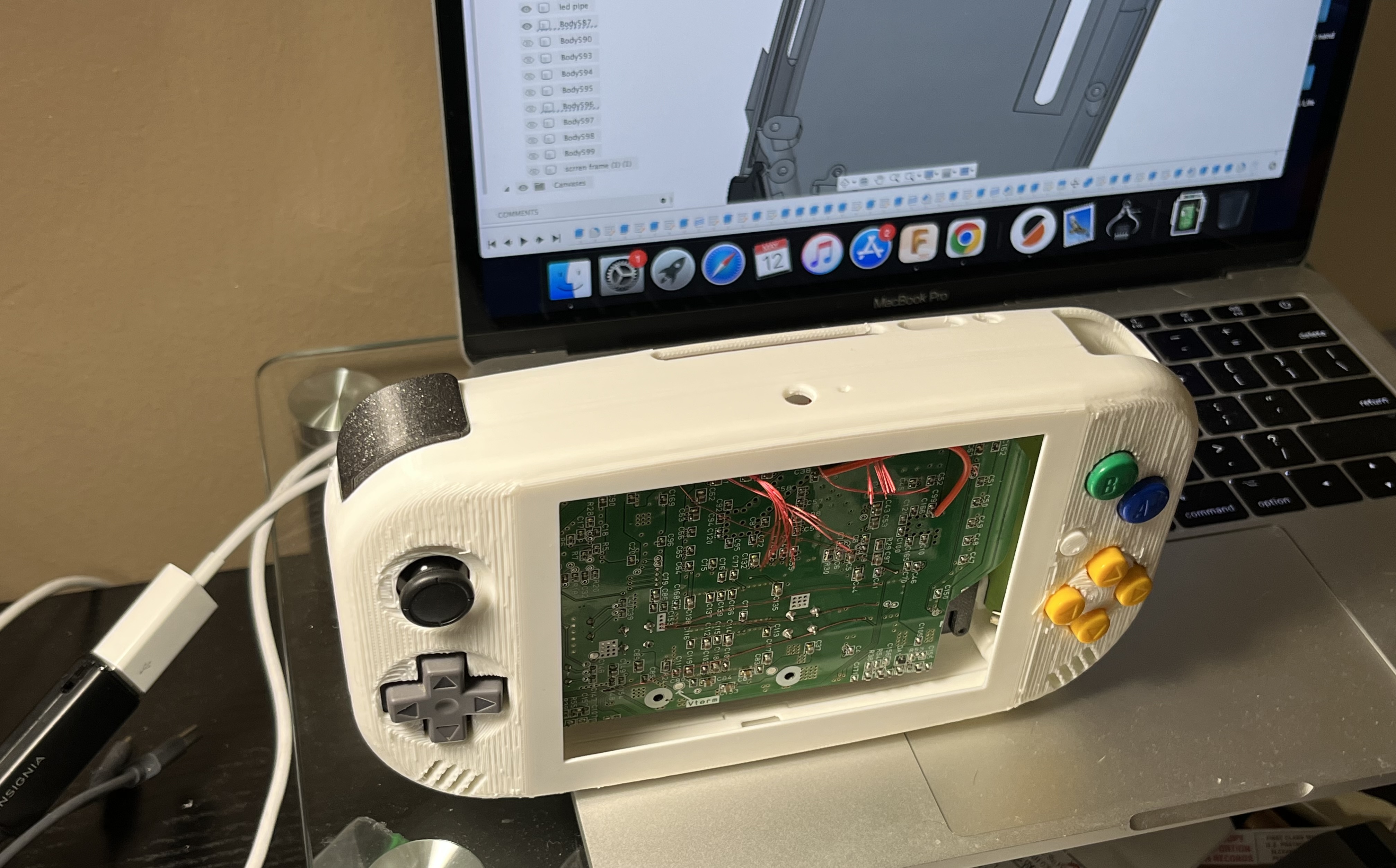

Making progress.. New, better feeling trigger shapes, volume and power on top, corrected button placements.

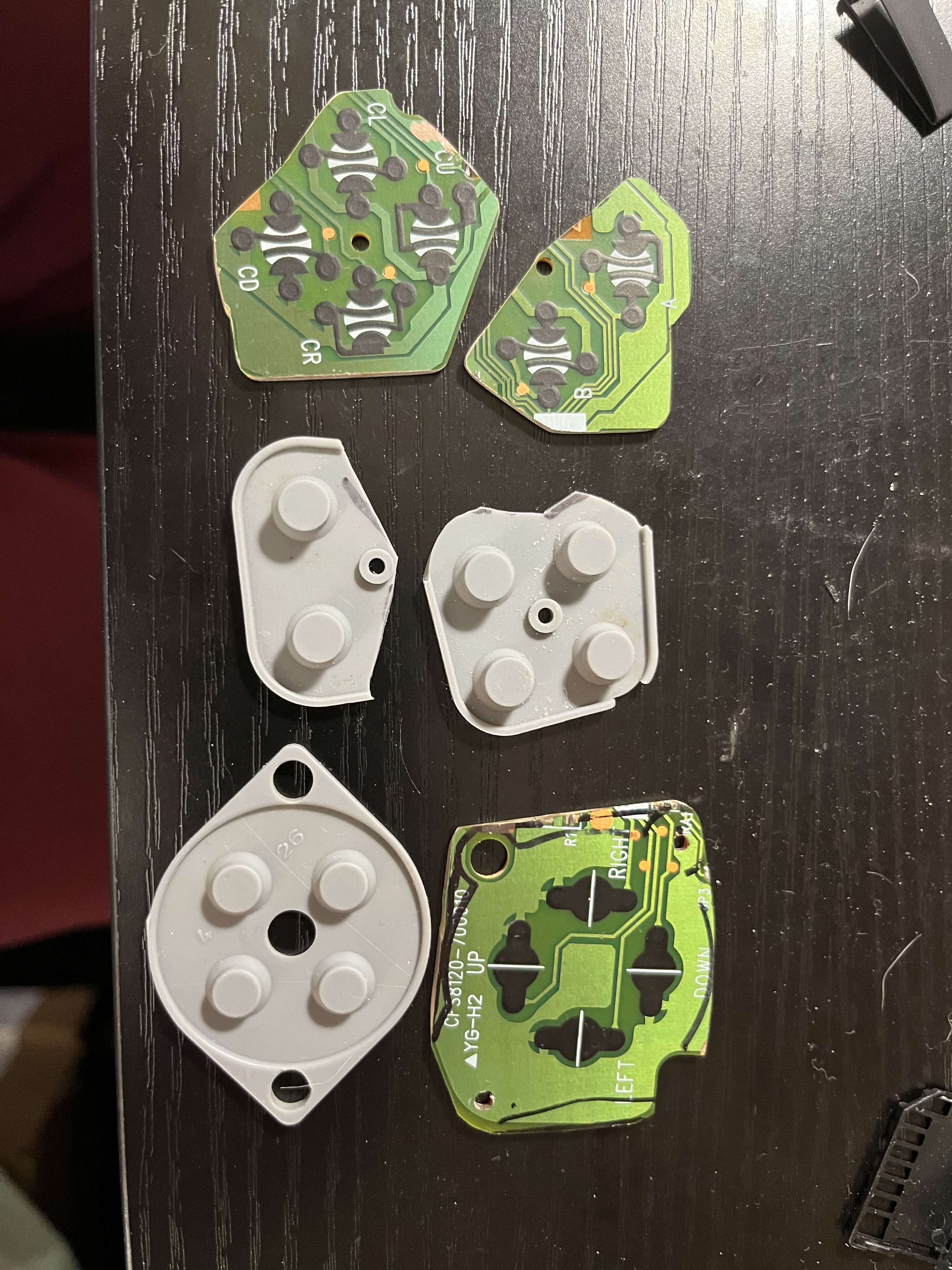

take a look at my custom pcbs lol, they are from the og controller. I plan to make 3d printed mounts to make cutting the board easier to replicate. The pieces will be held by brackets that’s screw into the front:
