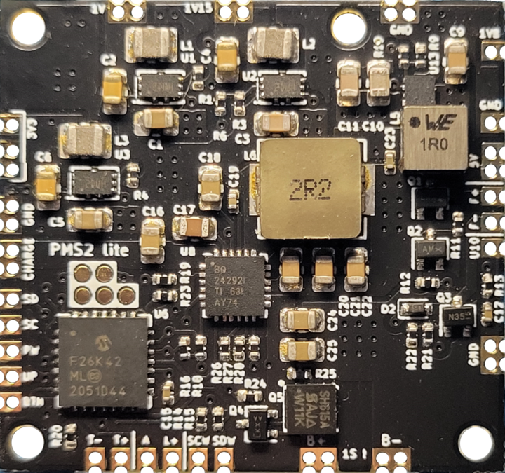

Hey all,
Today we have more information on the upcoming batch of PMS Lites. Unfortunately, we are not going to be able to deliver them before the end of November like we hoped. Early on we sent some prototypes out to testers for feedback, and, long story short, they found some unexpected quirks in the new chips we were using. We were able to tweak the design to solve this issue on version 2 of the prototypes, but this led to a setback. We have always been adamant that we would rather take the time to iron out the issues in our products than ship out sub-optimal products early. As of writing, the board assembly is going into production.
The current chip supply constraints continue to make things difficult. We are doing our best, and are sorry for the delay. Any customers who placed preorders are able to get a refund at any time. For everyone else, hopefully things go smoothly and we can have these boards in your hands by the end of the year.
Update: The parts have been sent to the PCB assembly company and are in production
Good news! The PMS Lites have arrived. @Gman has been hard at work testing and packaging the preorder units. He expects to ship all preorders tomorrow (1/13). This batch took a little longer than we hoped due to outside circumstances, but we are grateful that everyone has stuck it out and been so patient. We are excited to finally get this batch into your hands, and looking forward to seeing all the cool Wii portables that they will go in.
As of now, new orders are no longer preorders, as we now have PMS Lites in stock on the store ready to ship.
Awesome! Thanks for keeping us updated. I'm excited to get back to my project as this was the last part I needed. I got a tracking number yesterday, so it should be soon. It sucks that there were issues slowing you up, but stuff happens.
