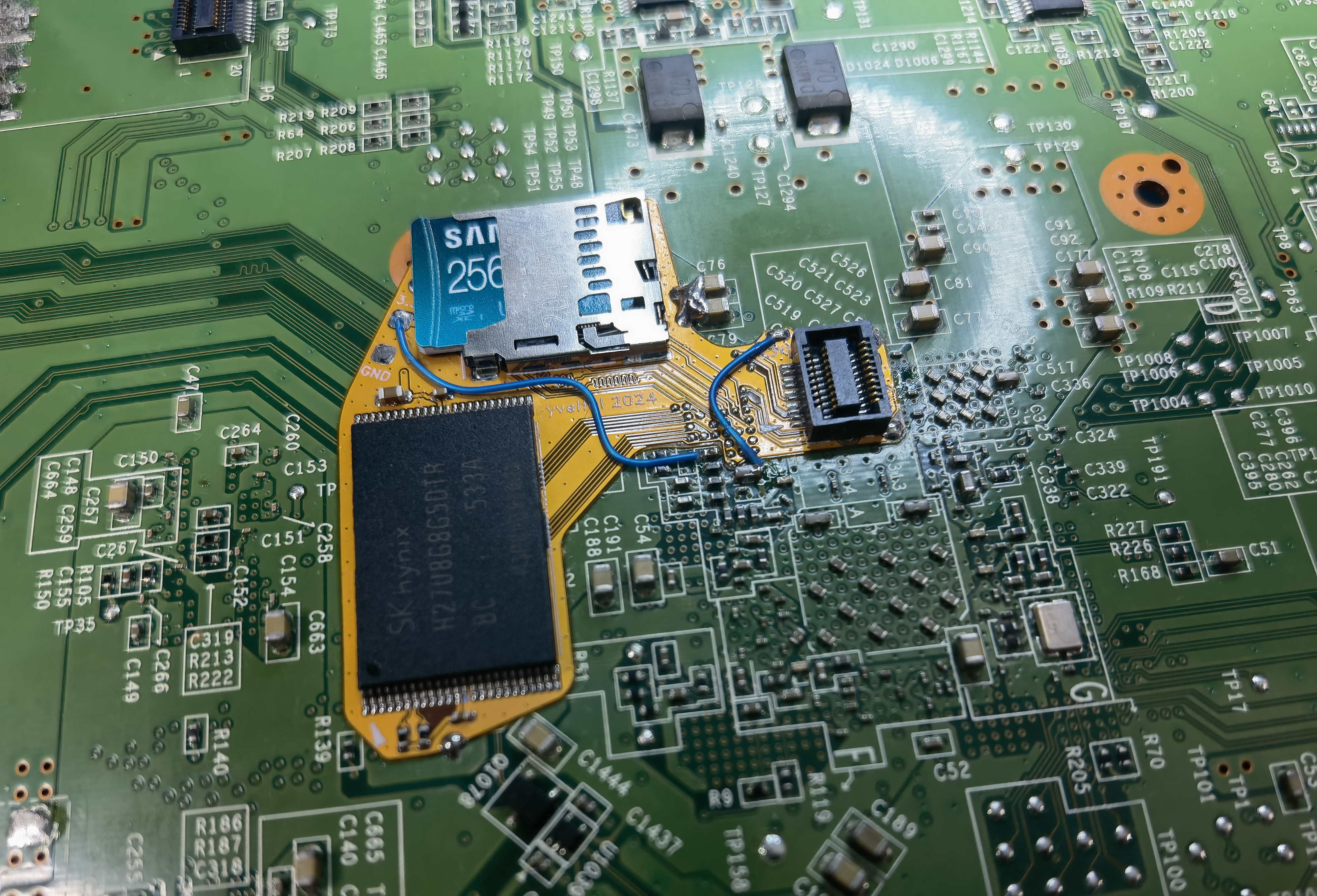

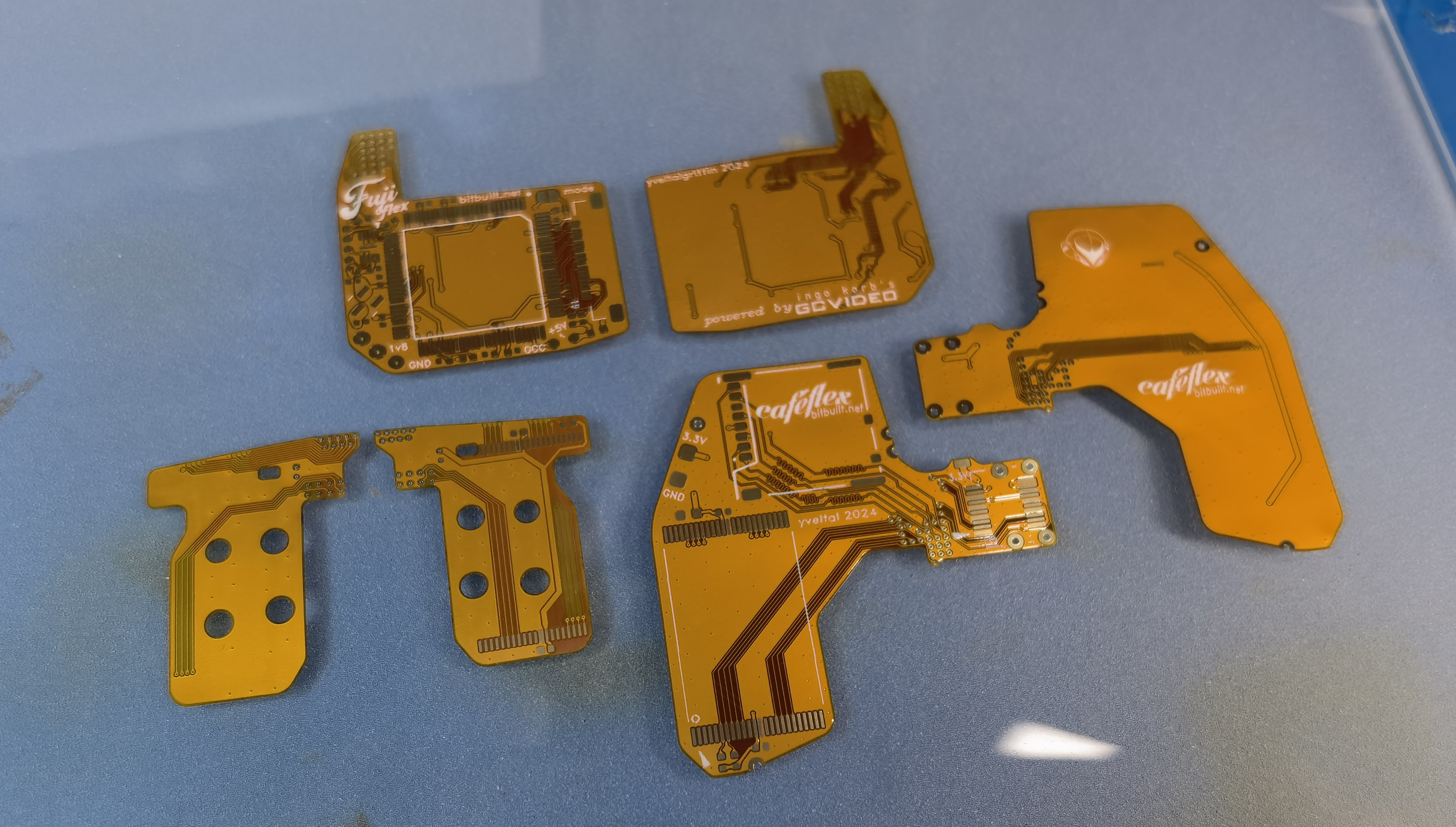

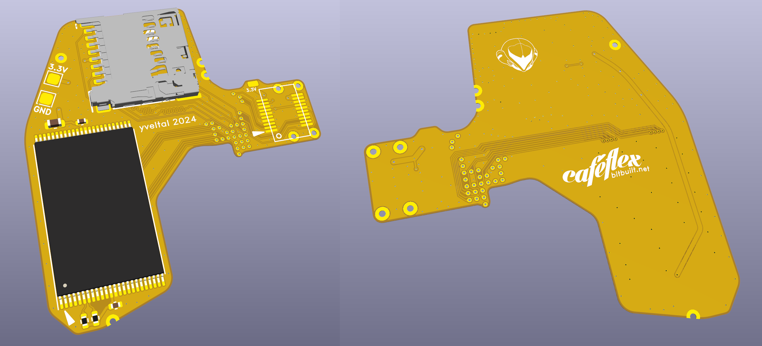

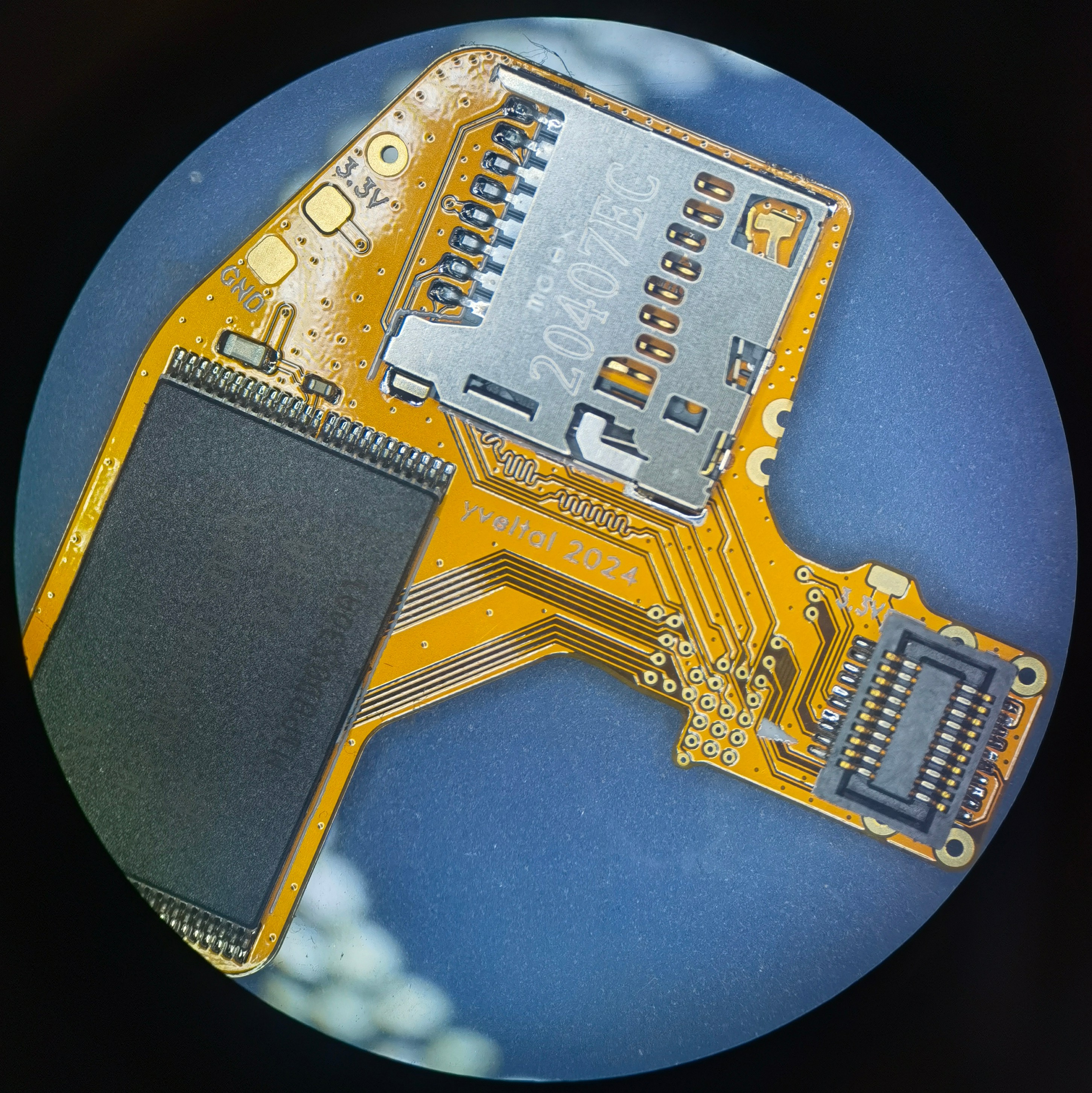

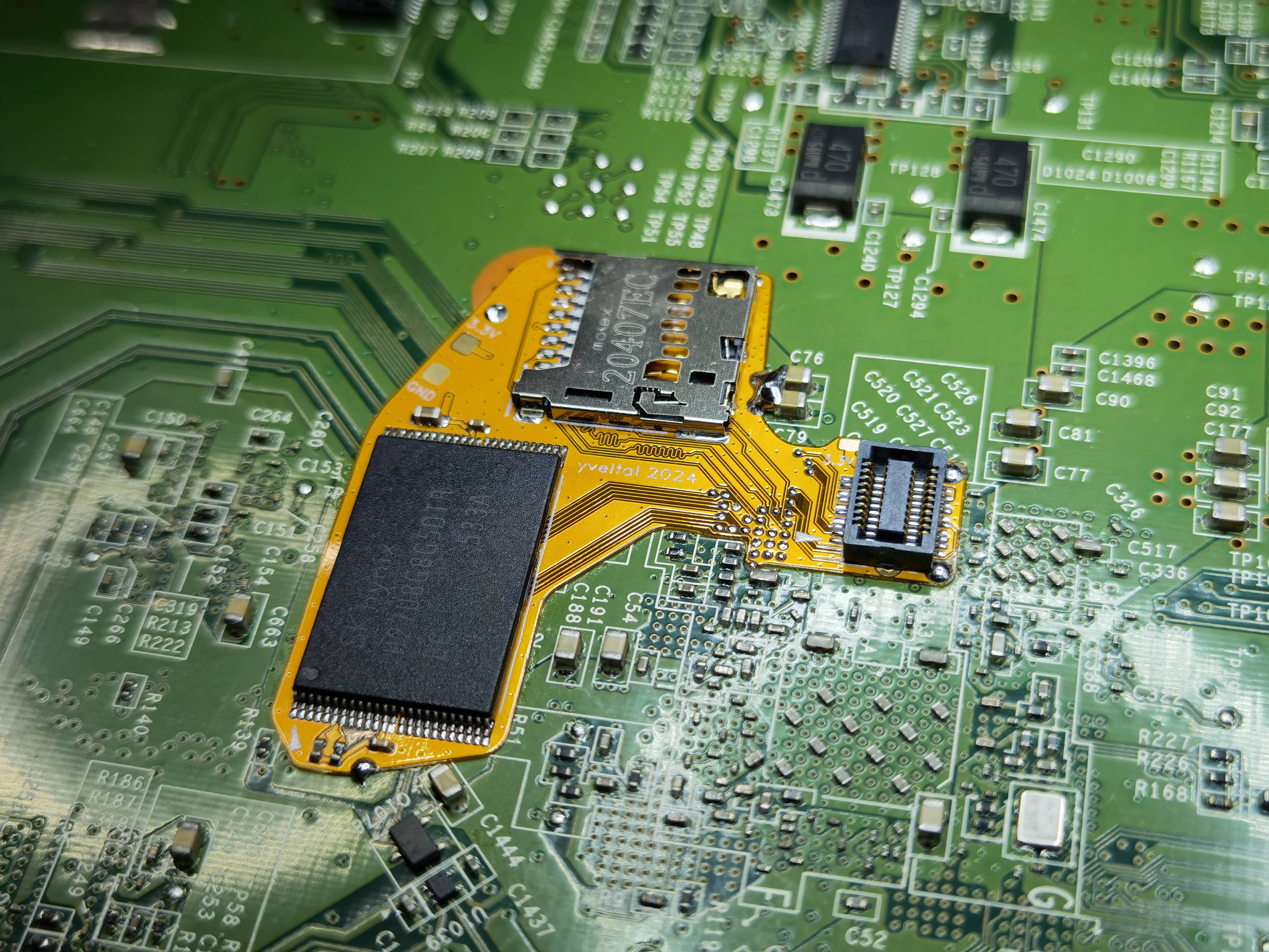

Caféflex is complete and open source on GitHub: LINK
Caféflex usage will eventually be integrated into the trim guide; in the meantime, this post will have some notes for early adopters!

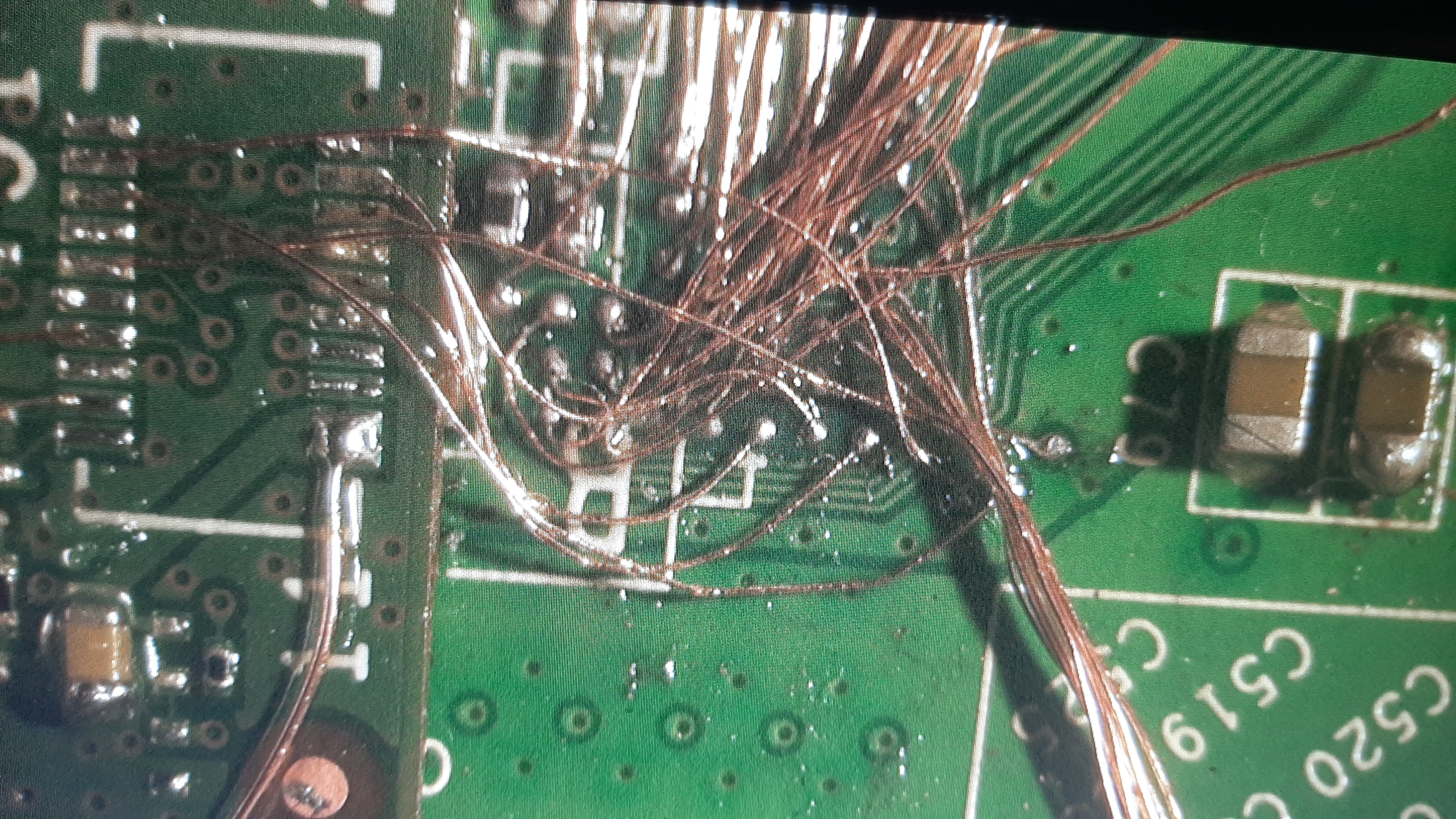

As planned, caféflex relocates the SLC (NAND), has a microSD slot for eMMC replacement, and a WiFi module connector. I searched long and hard for the Wifi B2B connector PN (with help from the Discord homies!) but it seems all the wireless modules on the Wii U use custom connectors. So the connector has to be harvested from a Wii U, which isn't a big deal since users will be trimming off that part of the board anyway. To avoid melting the connector, just blast the underside of the mobo with ~420C hot air until the B2B slides off.

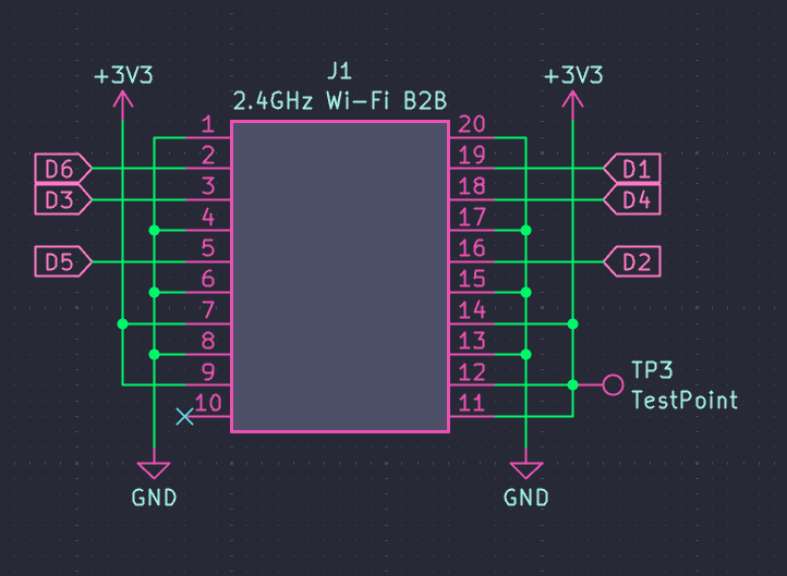

While designing the flex, I did some tests to see which WiFi module GPIOs are actually required. Turns out none of them are! Some need to be high, and others need to be low, but none actually need to be connected to the SMC/RTC/SOC. Again, this info will eventually be added to the trim guide. For now, here's a schematic snippet:
I ordered some flexes from PCBWay (0.12mm thickness, 0.5oz copper) and assembled them tonight. Always get an electropolished stencil, it makes pasting a breeze.

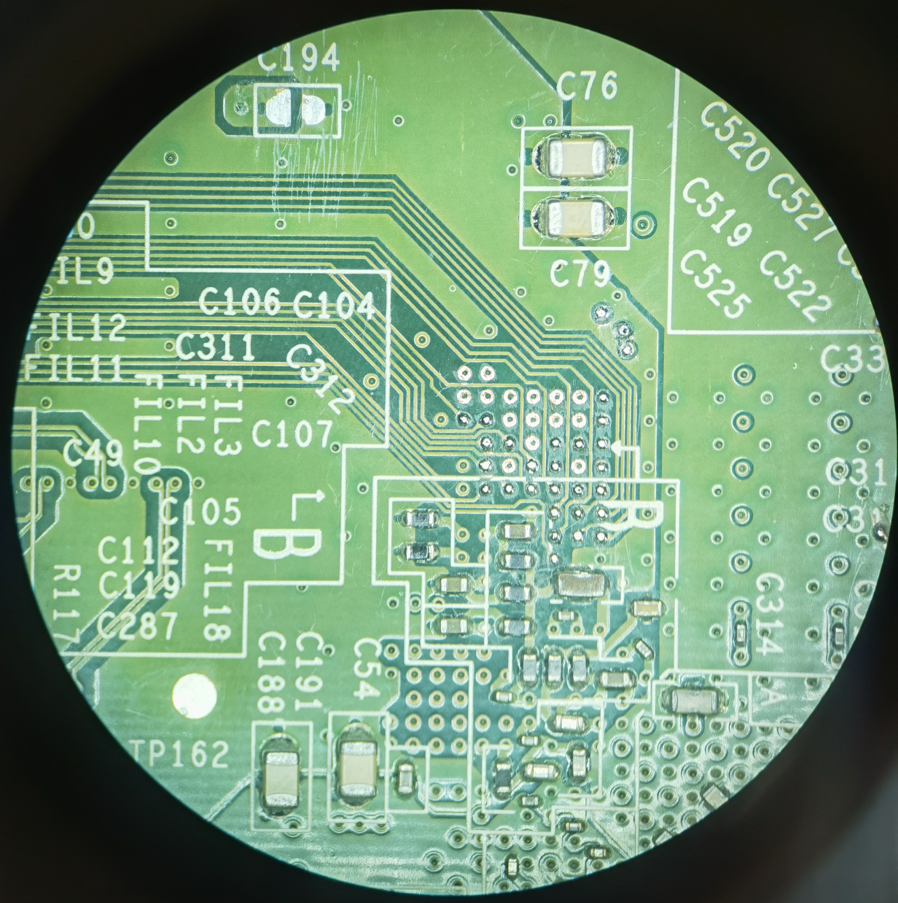

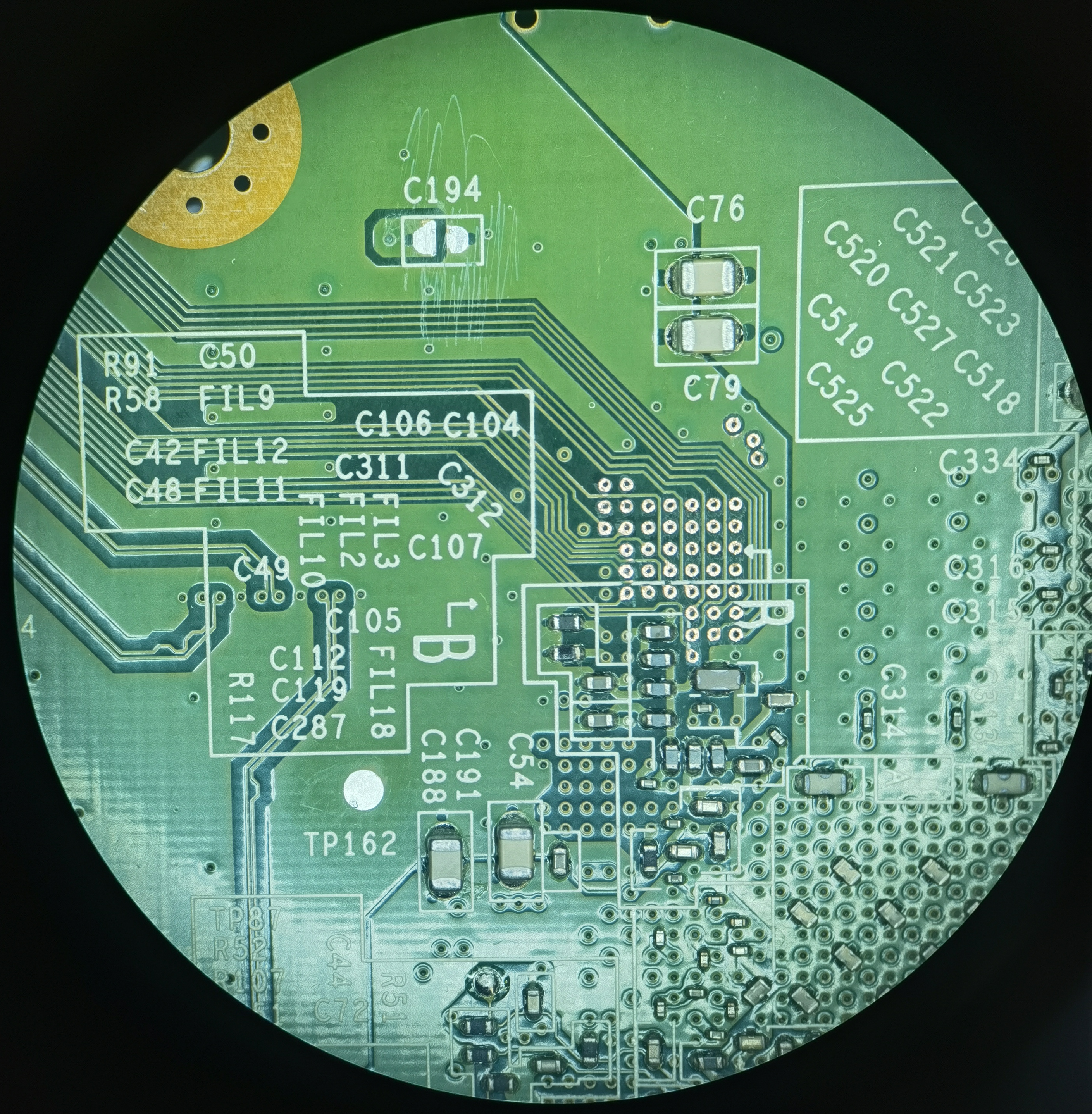

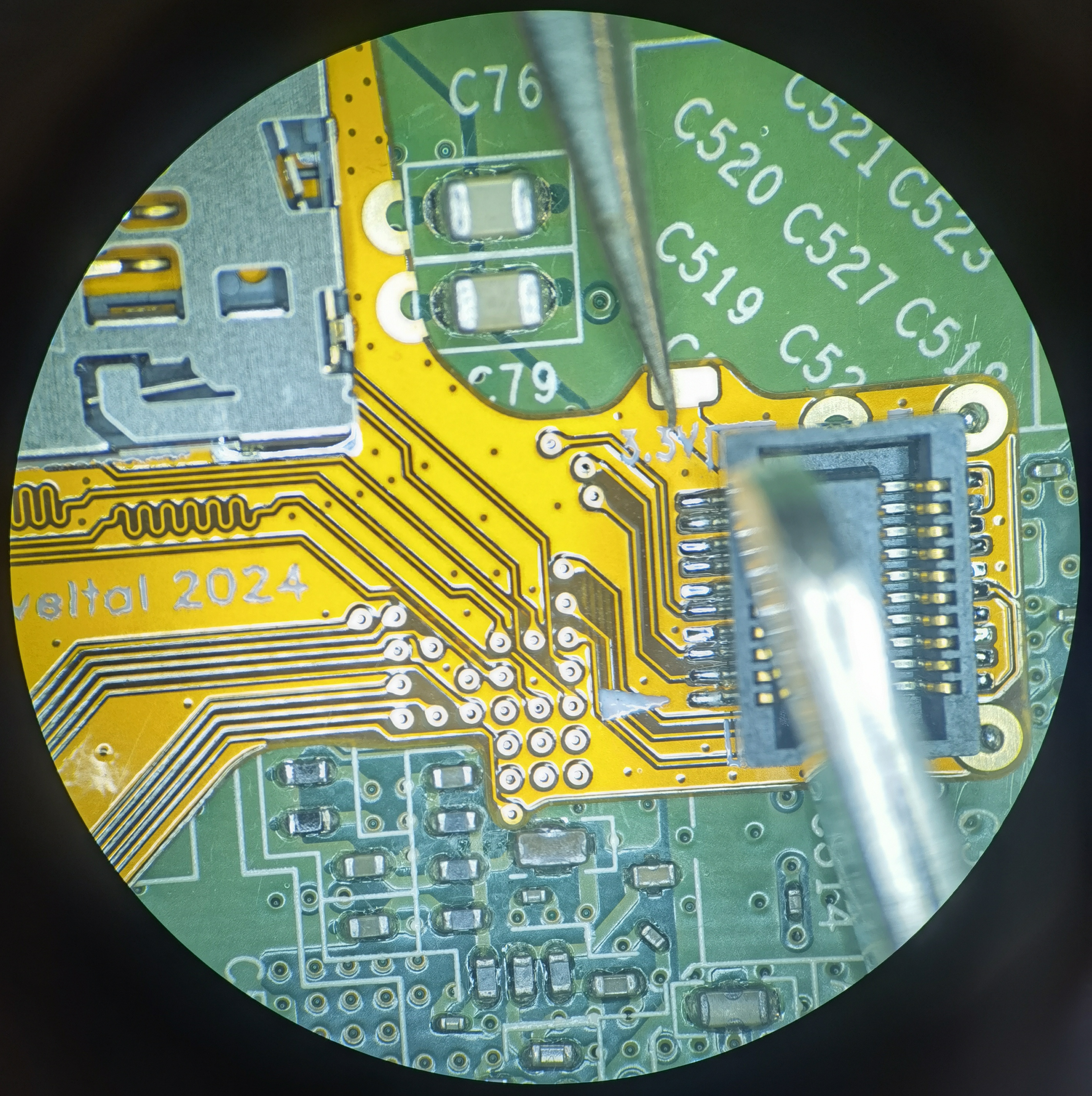

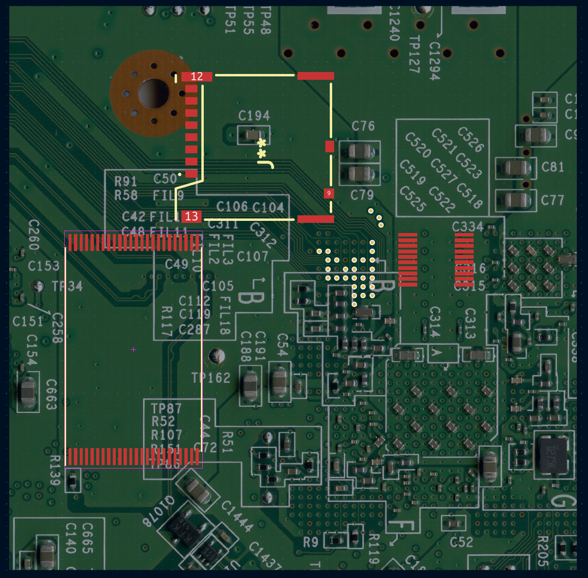

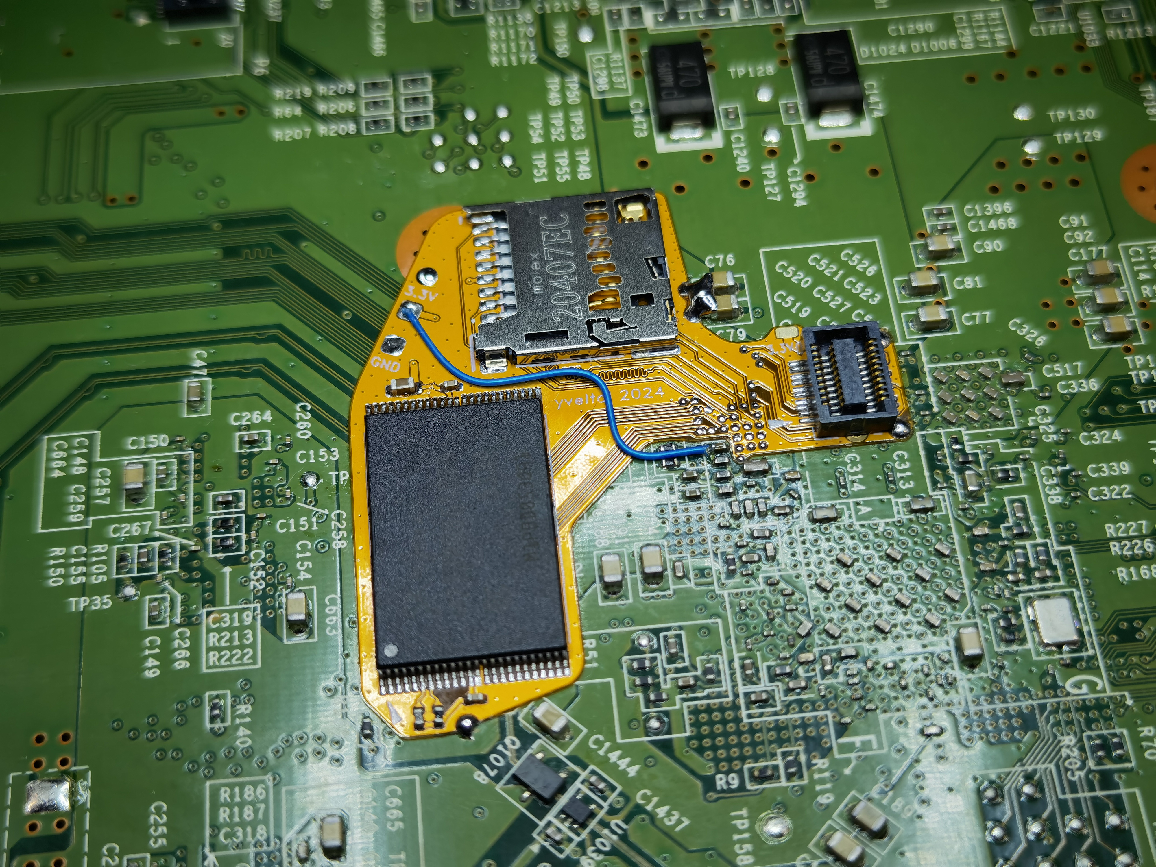

Removed C194 and wicked off the excess solder. I wicked off TP162 too. Then I scraped and tinned the 0.8mm pitch vias under the SOC. (I scraped more vias than necessary-- you only really need to expose the ones that align with the flex.)

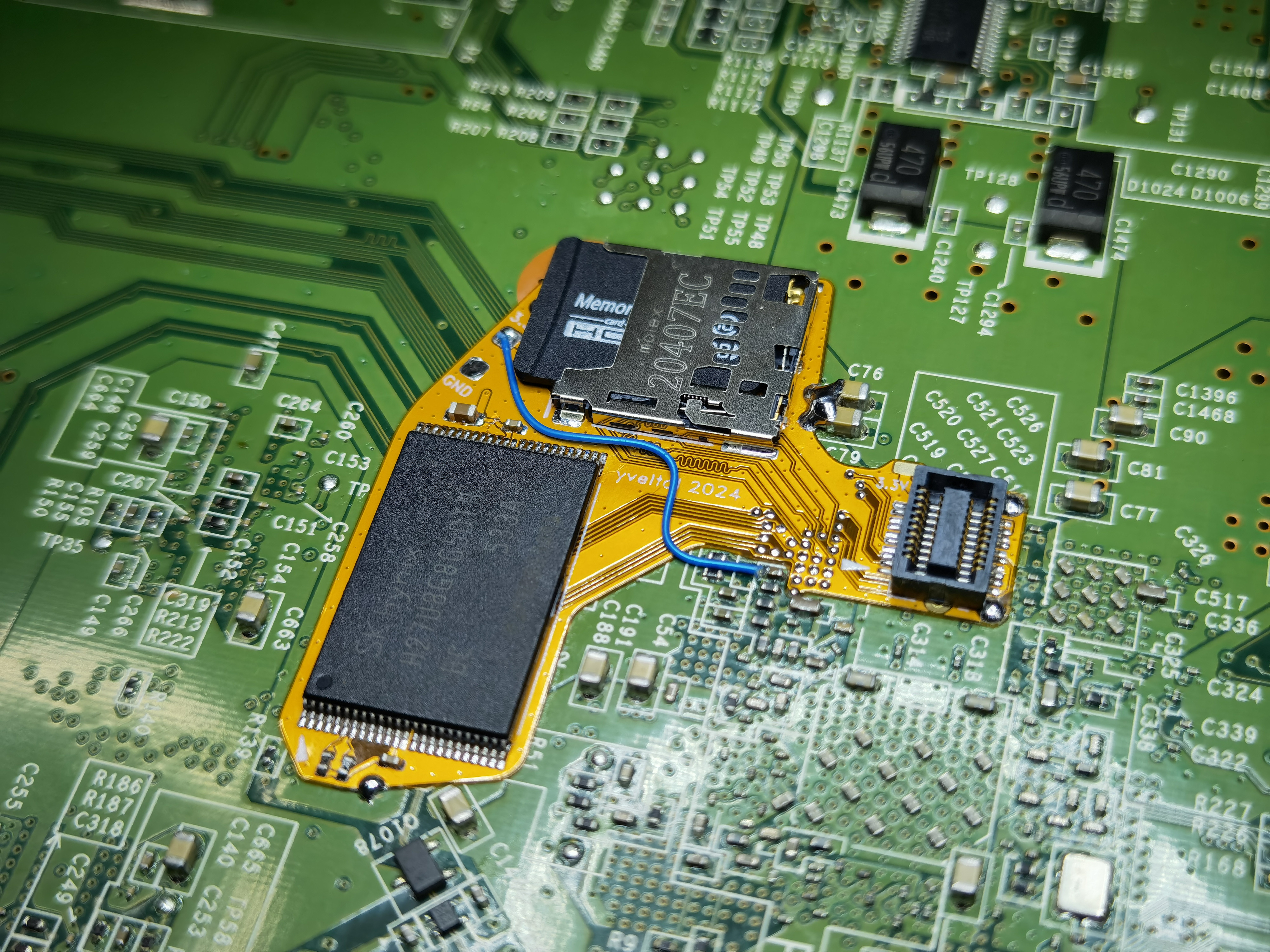

After tinning it was just a matter of aligning everything and soldering away!
I added numerous mechanical solder pads to the design, to hold the flex down. This is critical when there are connectors on the flex! The ones near the SD card and NAND are GND points. But the ones under/around the Wifi connector are actually on the 1V pour, so beware.
The 3.3V wire needs to be very low profile so as not to interfere with the microSD slot. I was lazy and omitted the GND wire, since there are already many GND solder blobs between the flex and mobo. The Wifi module also gets a 3.3v wire to its dedicated solder pad (not pictured).

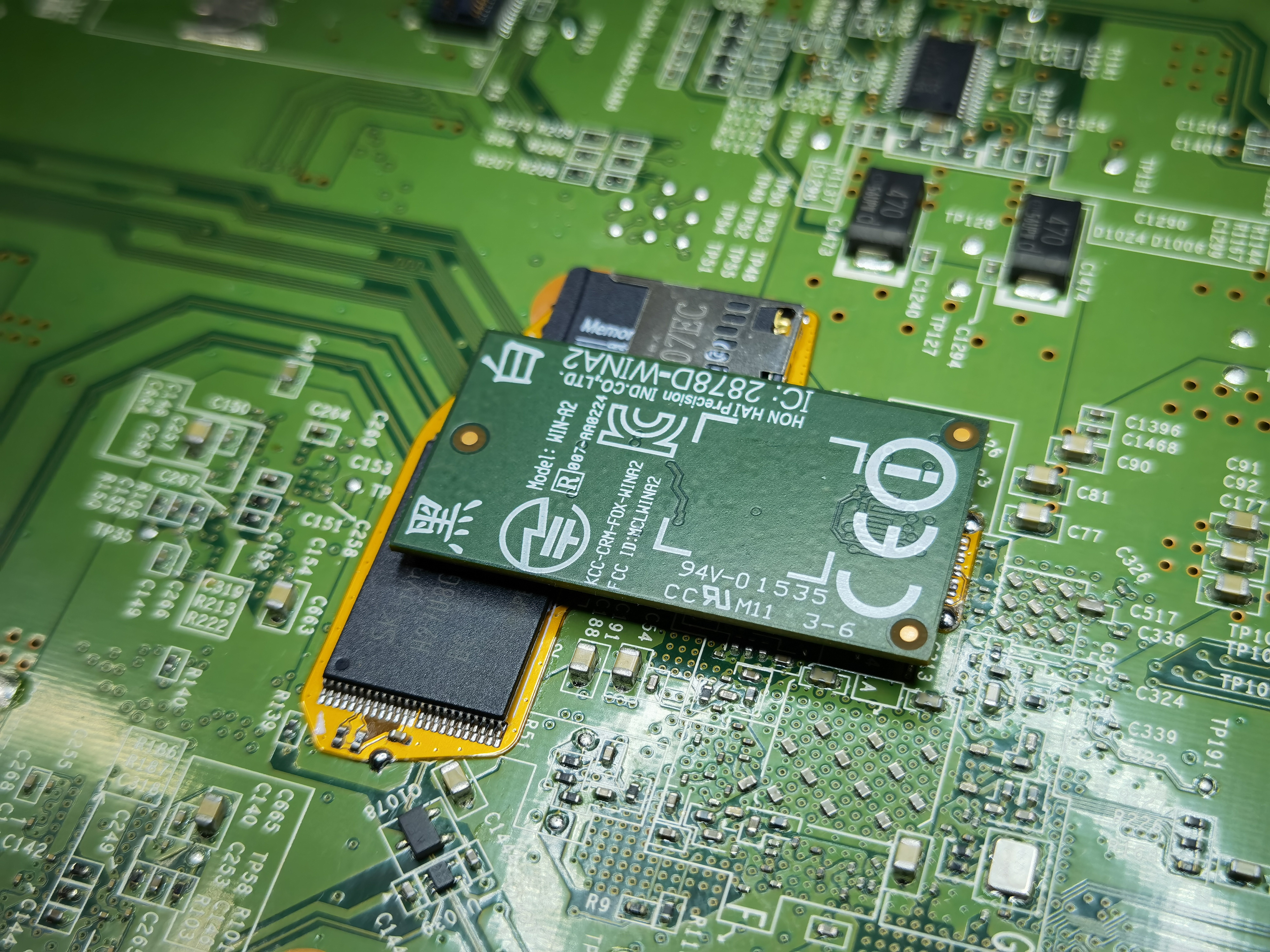

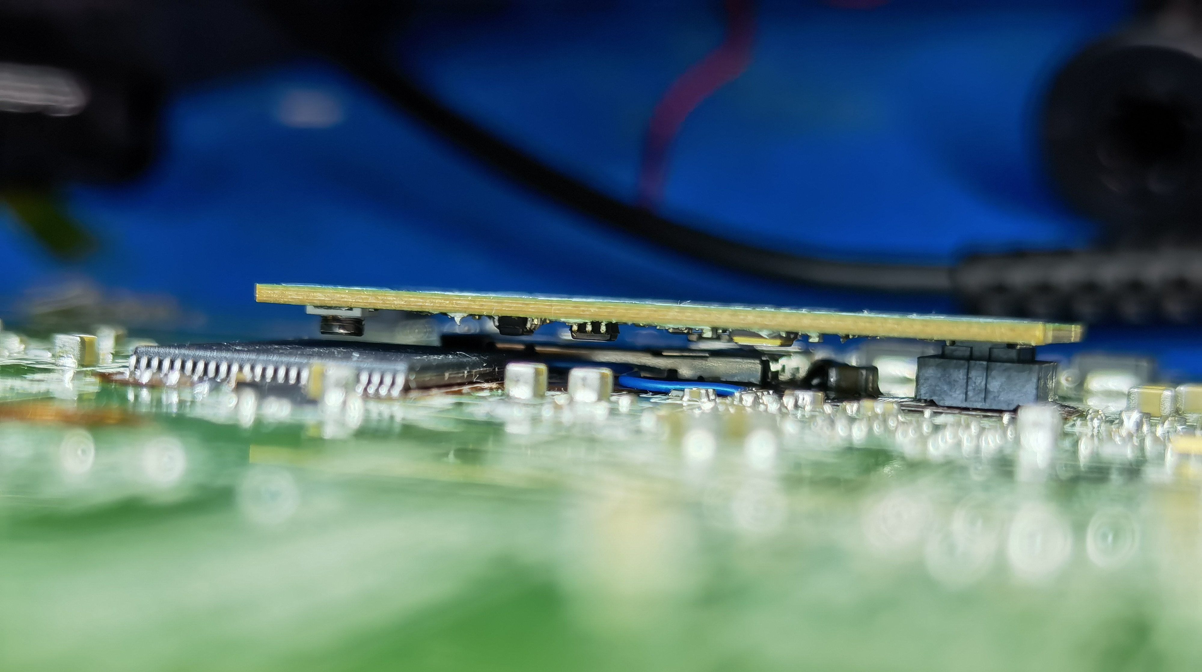

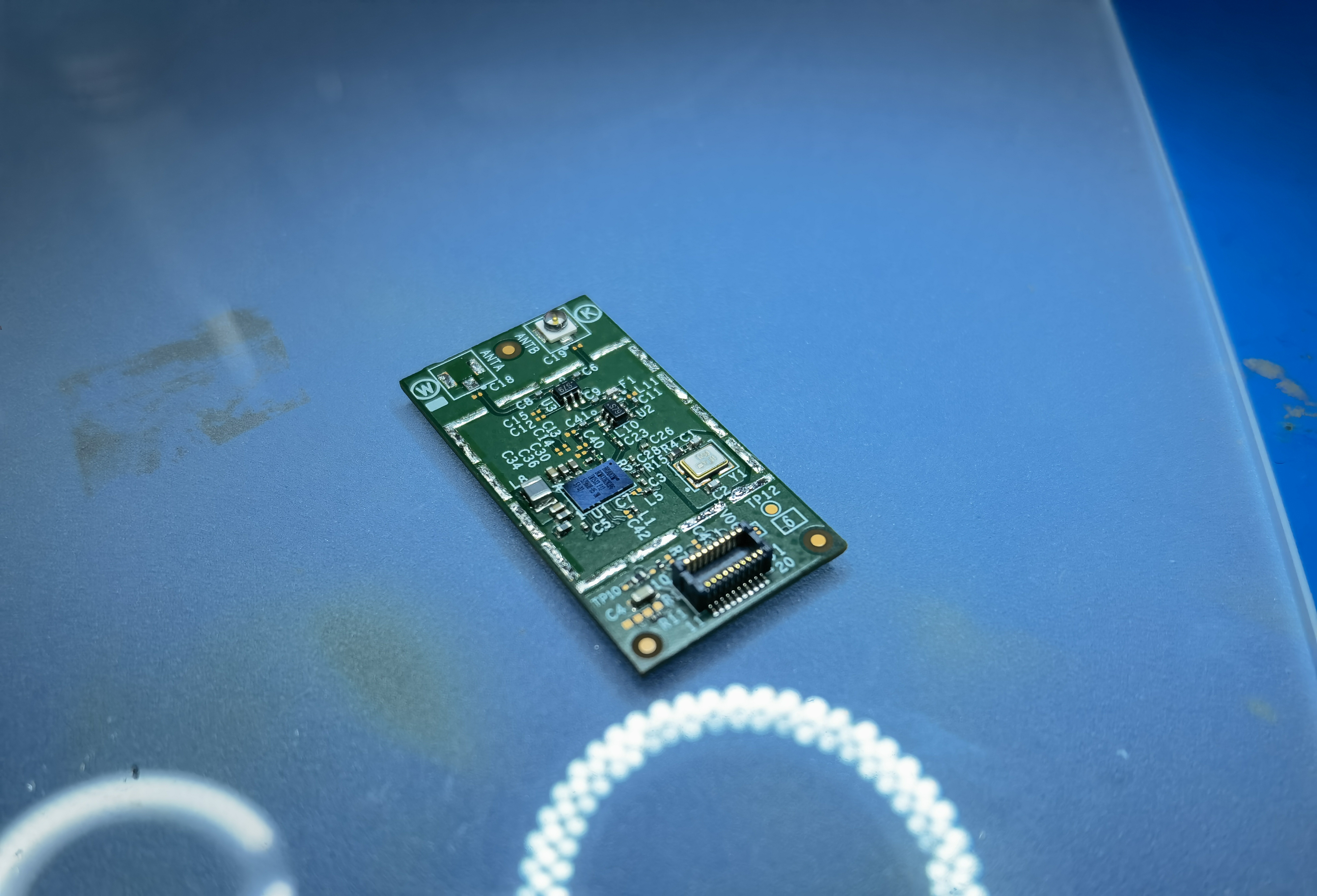

The Wifi module had to be slimmed down so it wouldn't collide with the NAND and microSD slot.
Plenty of clearance after desoldering the can! Final builds should still have some kapton between the module and flex.
The end result: an ISFSHax-modded Wii U with relocated SLC and WiFi module! Worked first try. I still need to rebuild the MLC and flash it to a high quality, high capacity SD card, so the SD part of the flex remains untested for now.
Very pic heavy post for testing a single flex. Oh well... :XD:
EDIT: Rebuilt the MLC onto a 256GB microSD. Everything is working perfectly! Goodbye, eMMC!

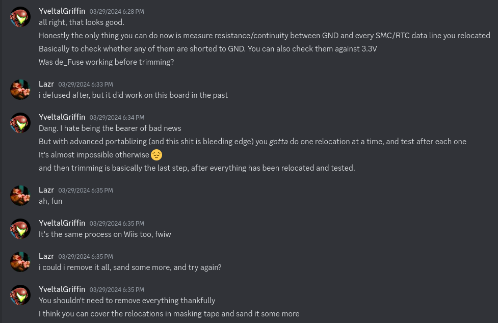

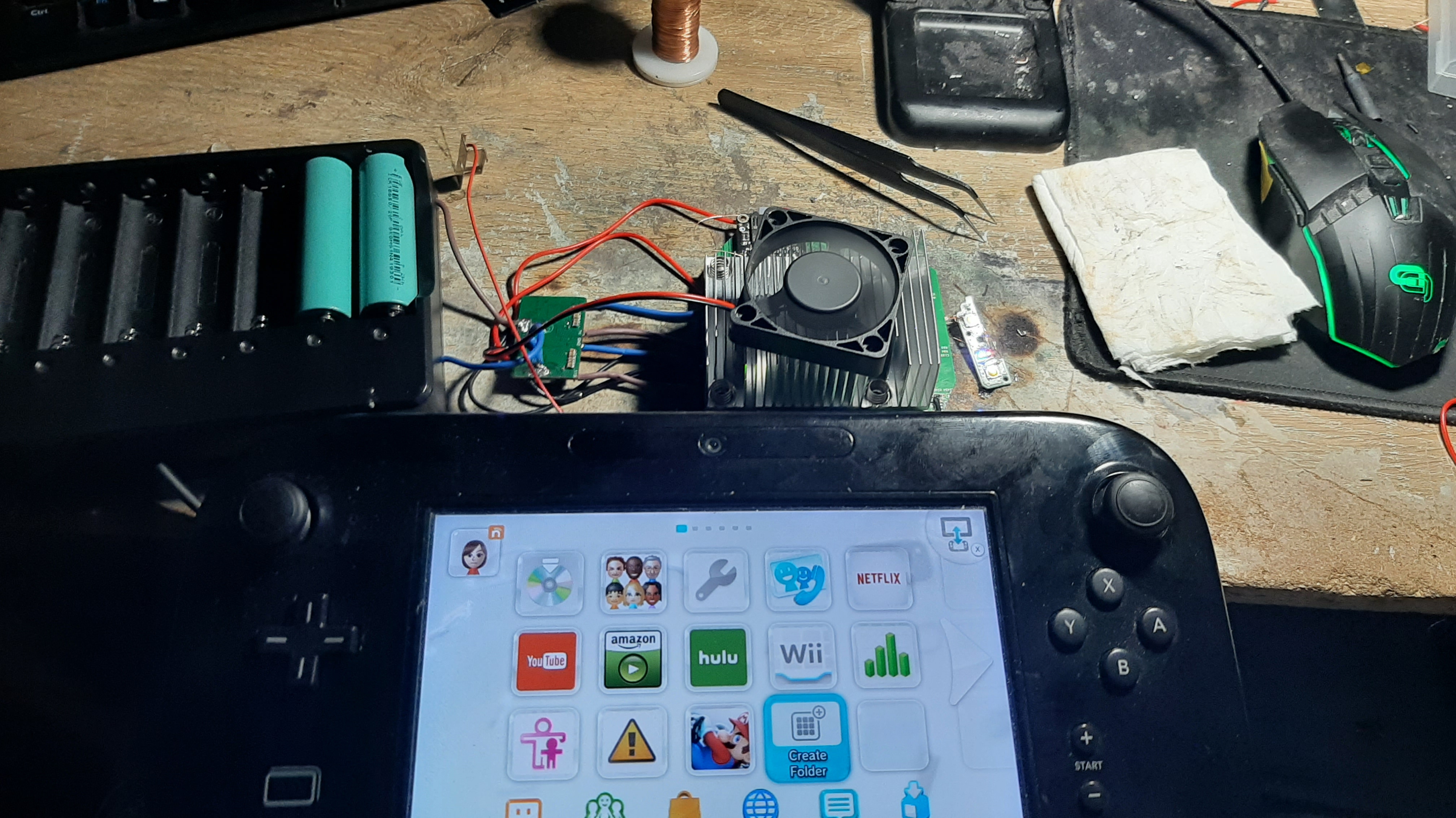

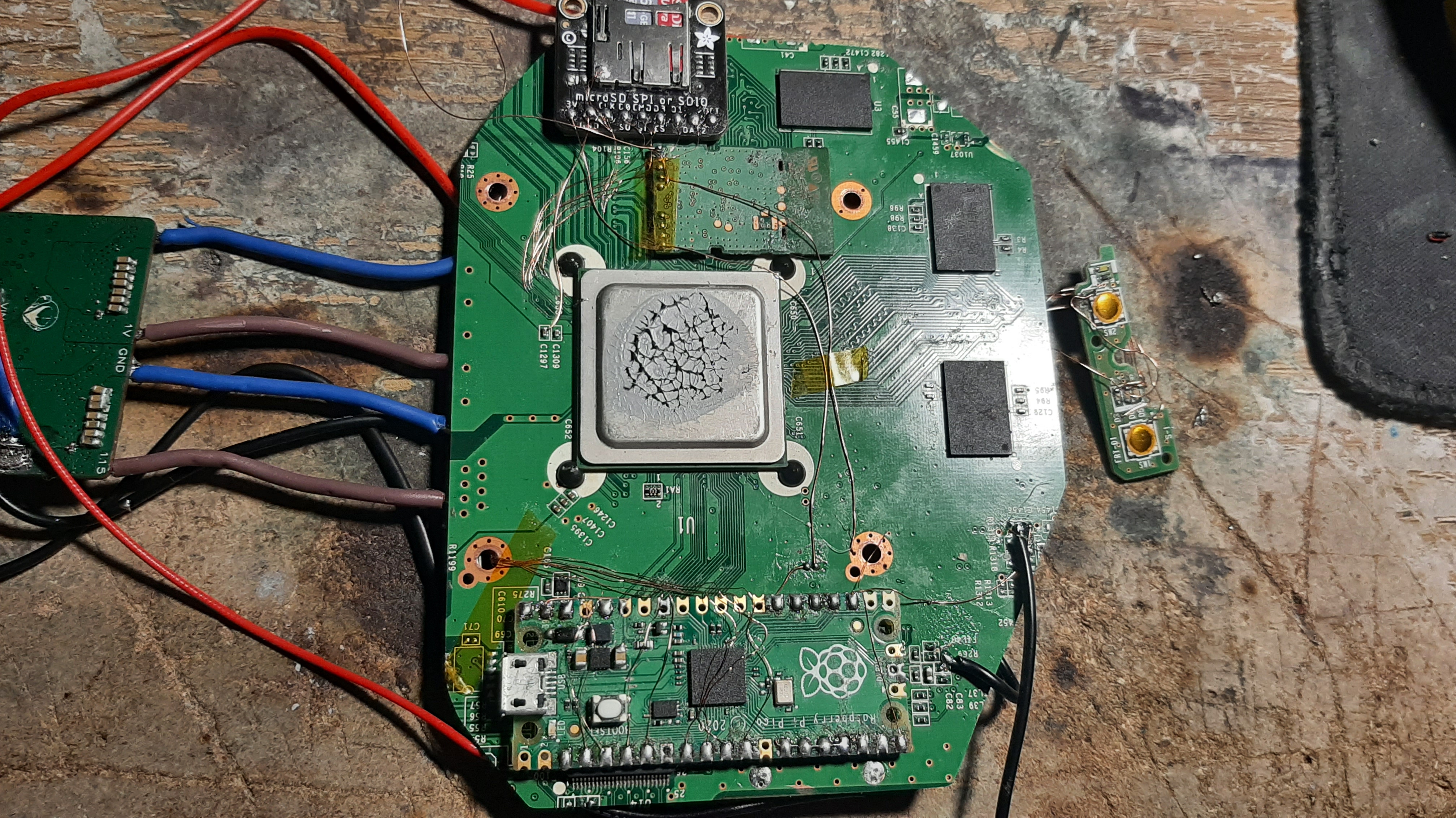

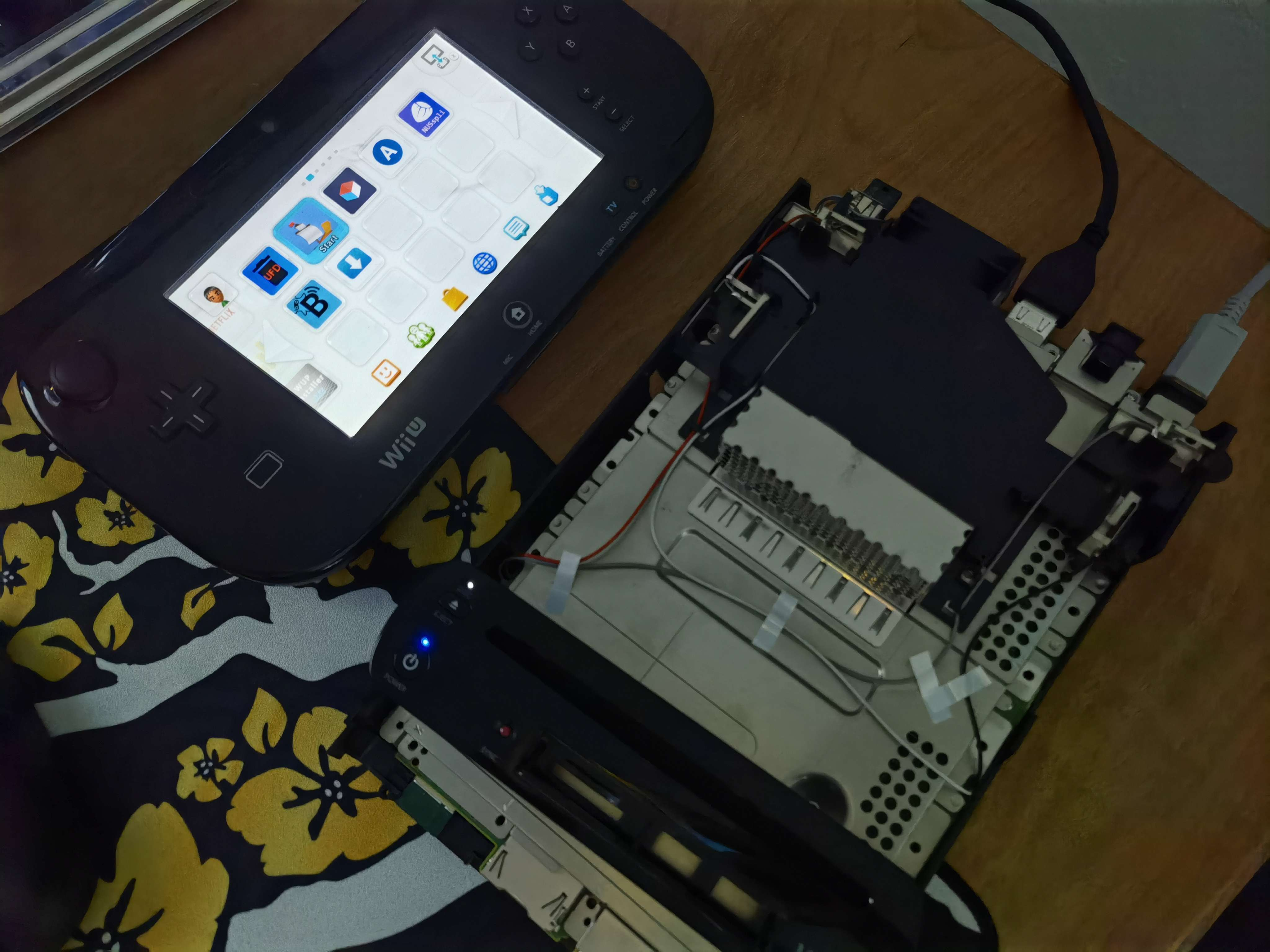

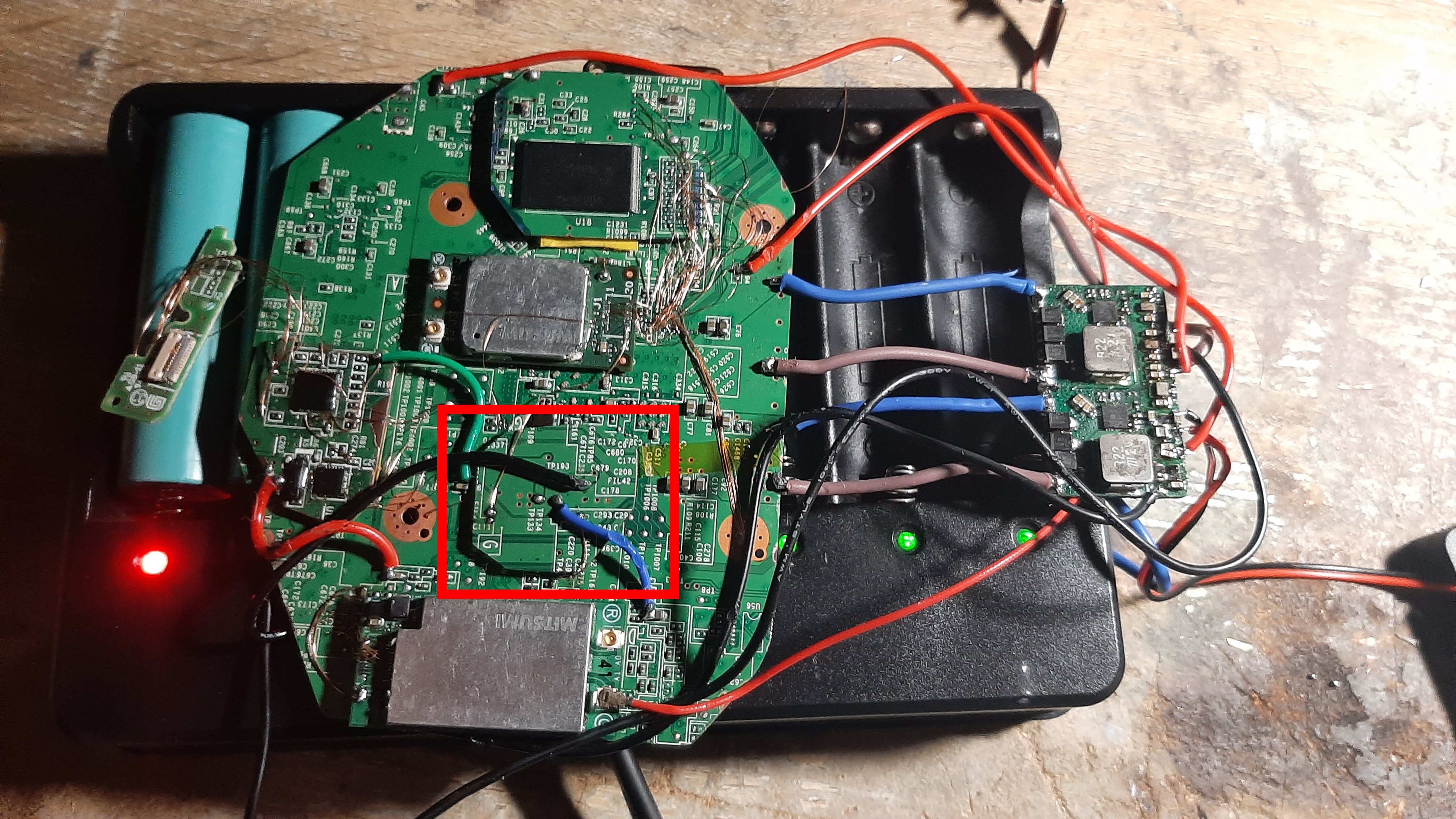

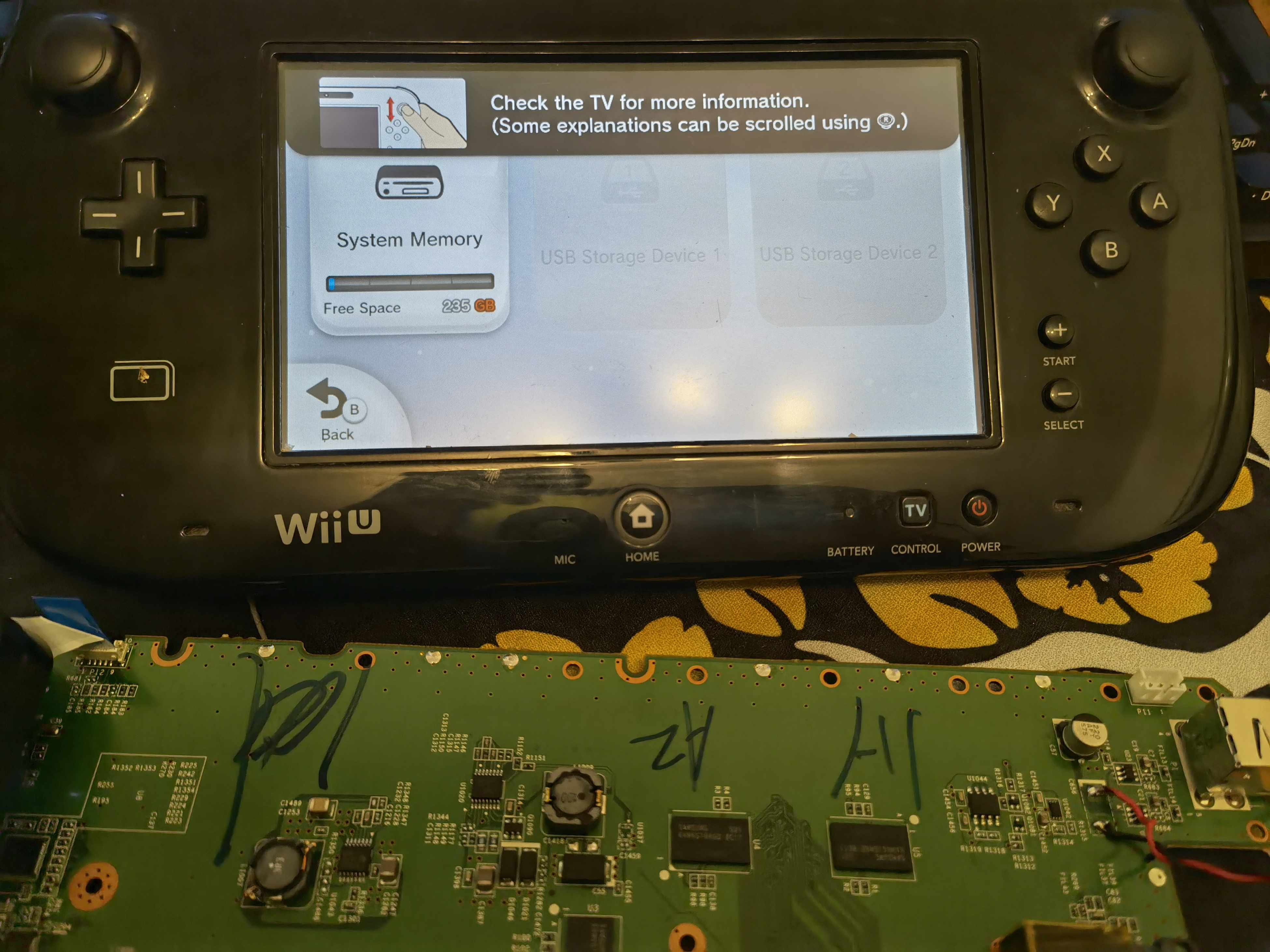

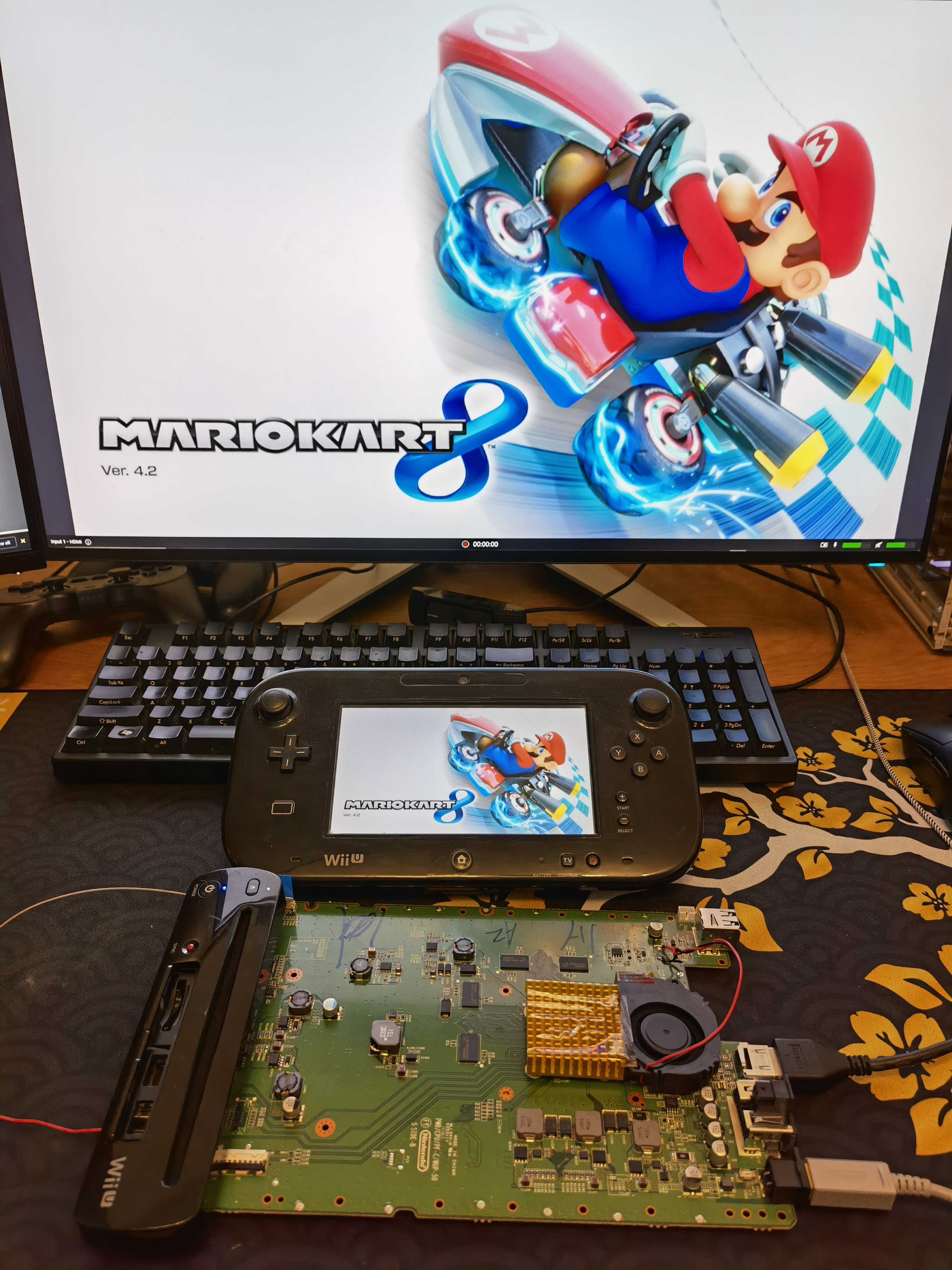

The LOLWUT trim is replicable (and no this isn't an April fools joke)! Thanks to Yveltal's guide (and my questions throughout these past few days (week?)), I have gotten the trim to boot into Wii U Menu!
The Wi-Fi module doesn't work atm, but it is probably due to my crappy wiring for it (SDIO is really bad; those cafeflex' will be incredibly useful for this relocation).
Pictures of the top and bottom of the Wii U:
I found that none of the SMC pins for the BT module were needed, but the one to the SoC was
I also found that the SMC pins for the 5Ghz module aren't needed.
A few things I will say to those who are itching to get their dremel, sandpaper, and magnet wire out:

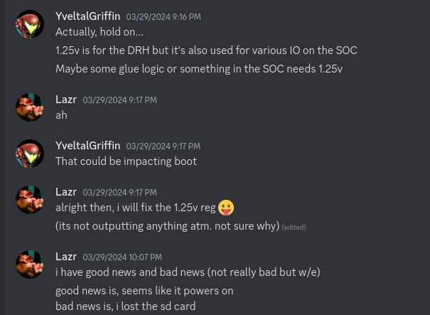

1. The voltages you must have connected to the board are 1v, 1.15v, 1.25v, 1.5v, and 3.3v. 1.25v is needed for everything you test. The SoC uses that rail for IO (that stumped me for a long while until I asked Yveltal). 1.1v is needed to test the DRH (and for it to function), and the 5Ghz module. DRH wont work without 5Ghz, and vice-versa.
2. Don't have the newcomer mistake of trimming before relocating everything, and then it being impossible to debug because you relocated everything.
(yes, this was my first console trim ever)
3. Building the bistro regulator board by hand sucks, but despite that, the only rail that doesn't work is the 1.1v, but that is why I have an extra board that's not documented on the trim guide. The DRC is pretty stable in my experience, but I can only get to the Wii U Menu and no where else to fully test it.

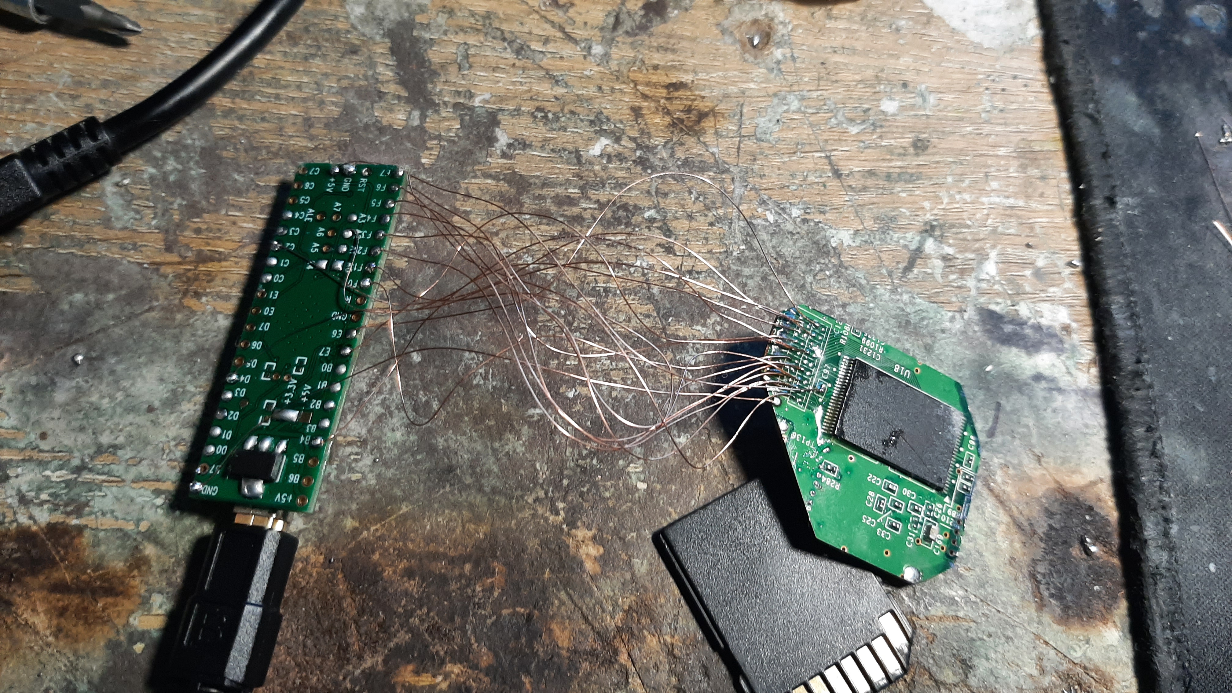

4. You likely wont have to do this, but I had to do this on hard-mode, since my only non-sdhc card died. I flashed the slccmpt boot1 blocks (which are normally blank) with the minute boot1. I finally had another use for the teensy I bought so long ago!
Hopefully as time goes on, the trim gets easier with the planned flexes. I know I am excited for what comes next :awesome:
