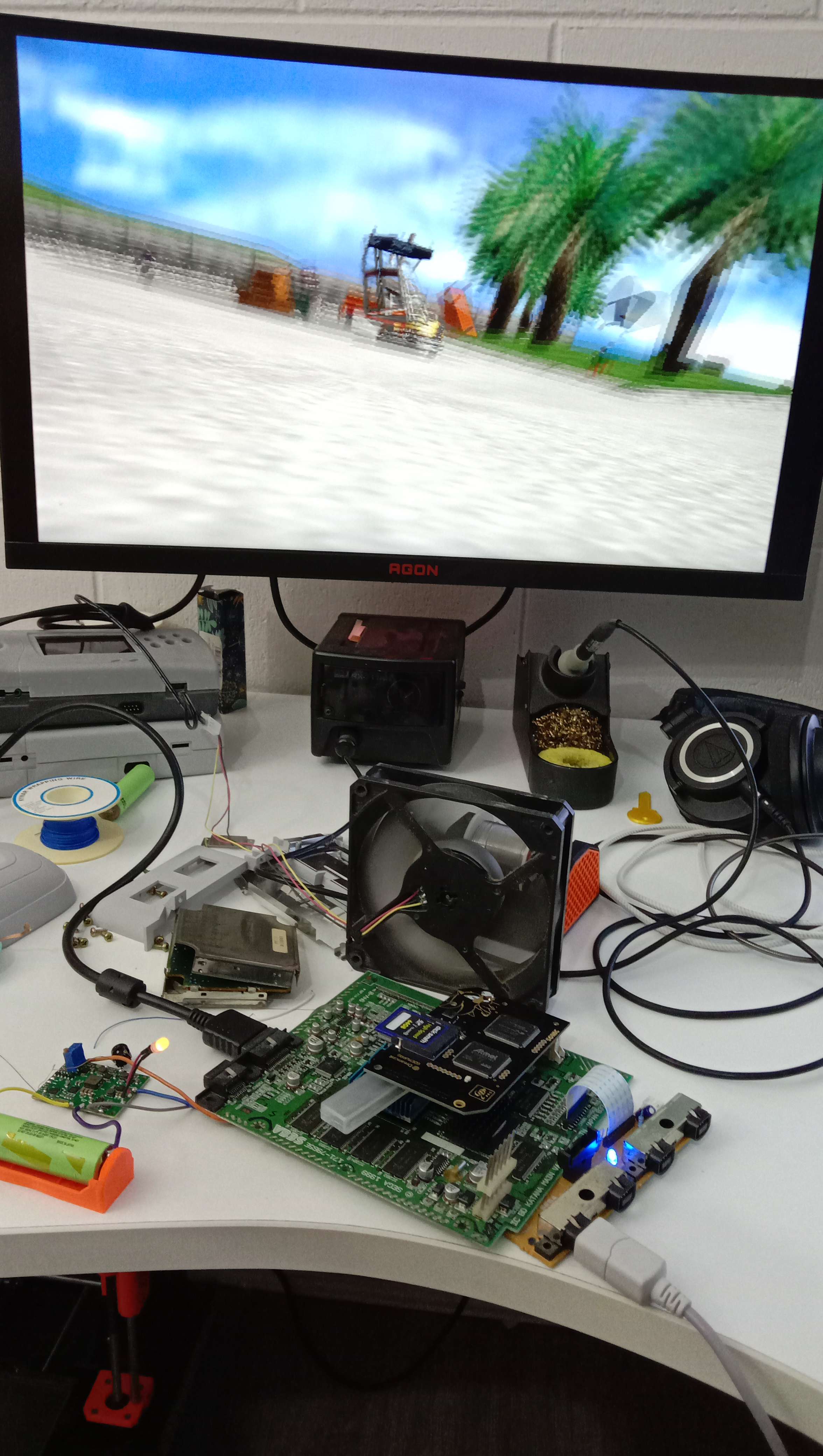

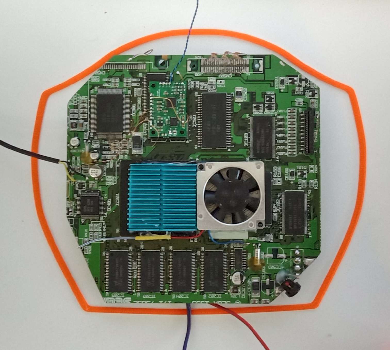

Now that I have a design in-mind I get into a "what if?" mood and figure that the Dreamcast *should* be able to run from just 3.3v and 2.0v if my undervolt numbers are correct.
I begin testing it out, lo and behold the Dreamcast runs just fine while running with only two voltage lines(with small caveats).

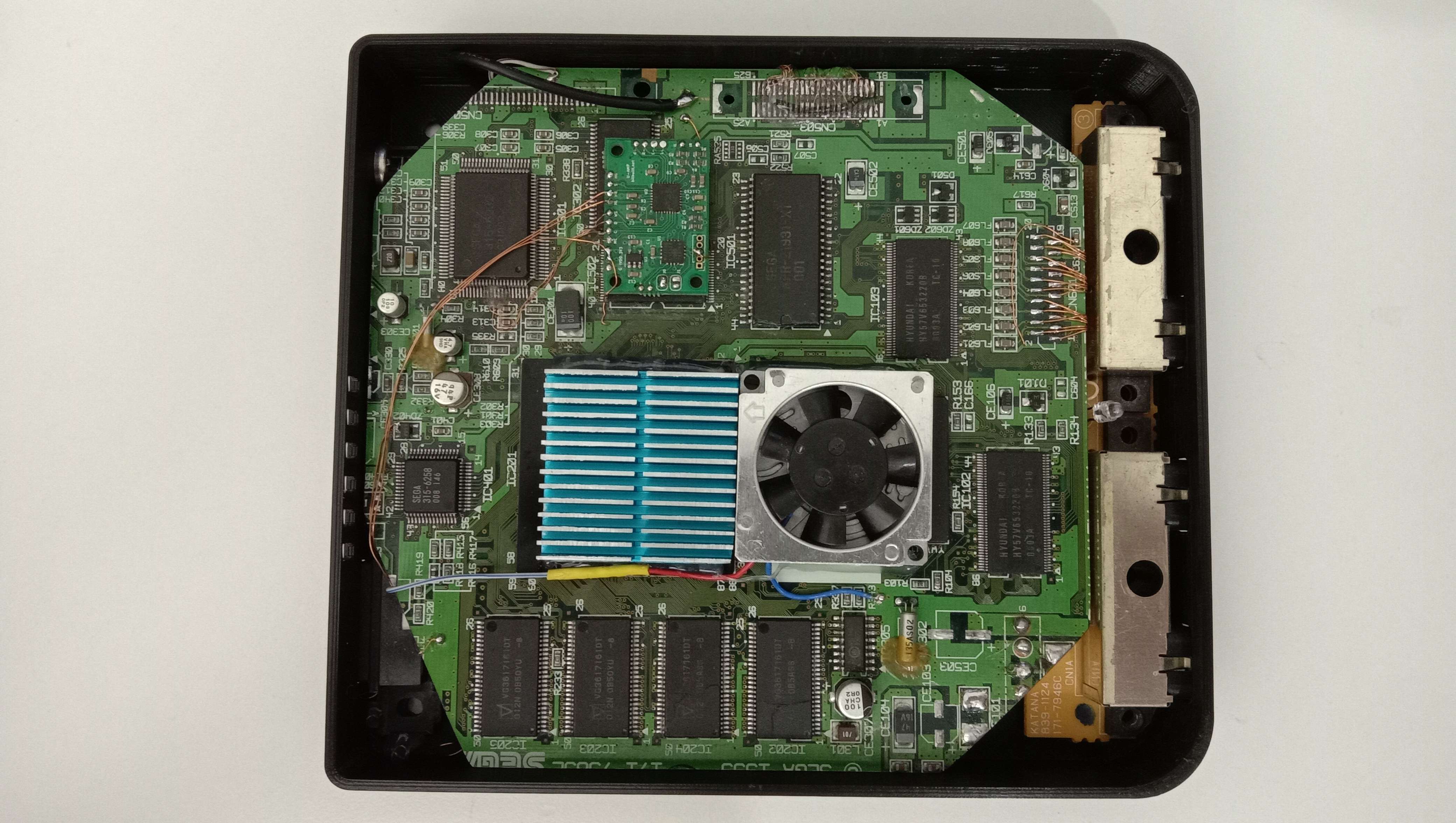

So what now? I suppose I should trim the board and make the portable with it?
I trim the Dreamcast with a relatively conservative trim retaining the GDROM connector pads to simplify the GDemu wiring (I did initially solder to the vias/pads on the underside but ran into issues).
Fitment seems good (GDemu and regs are mounted on the underside).

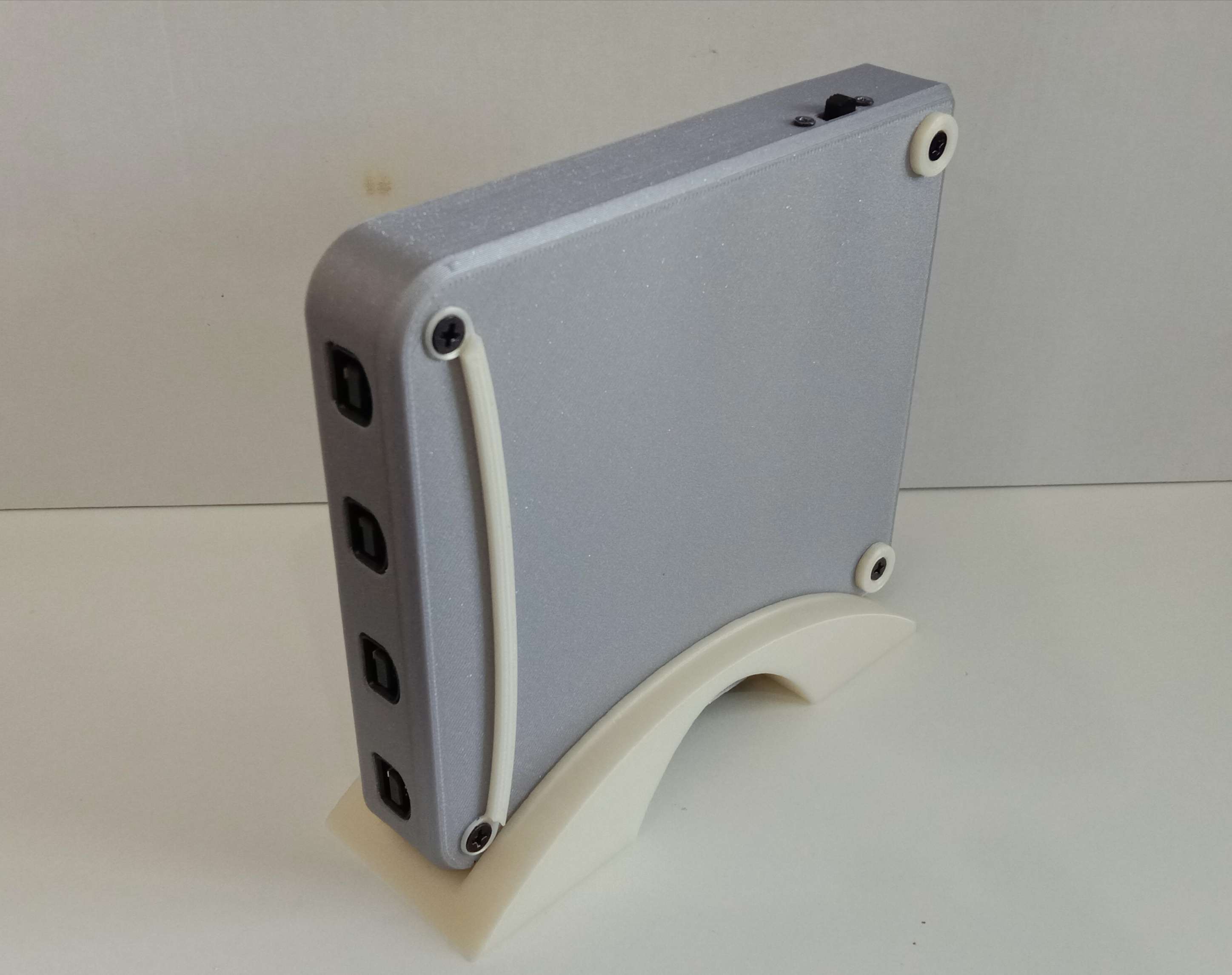

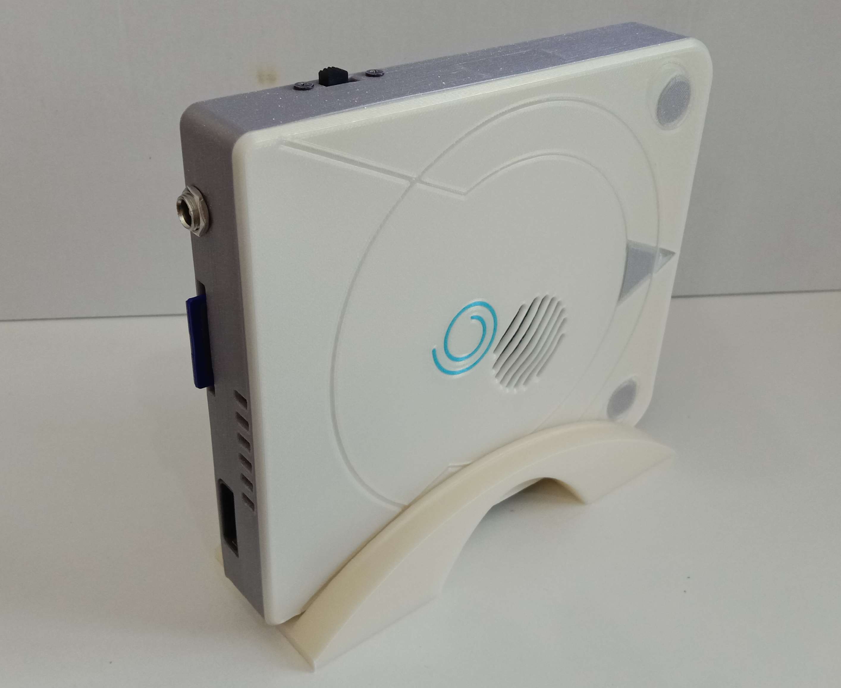

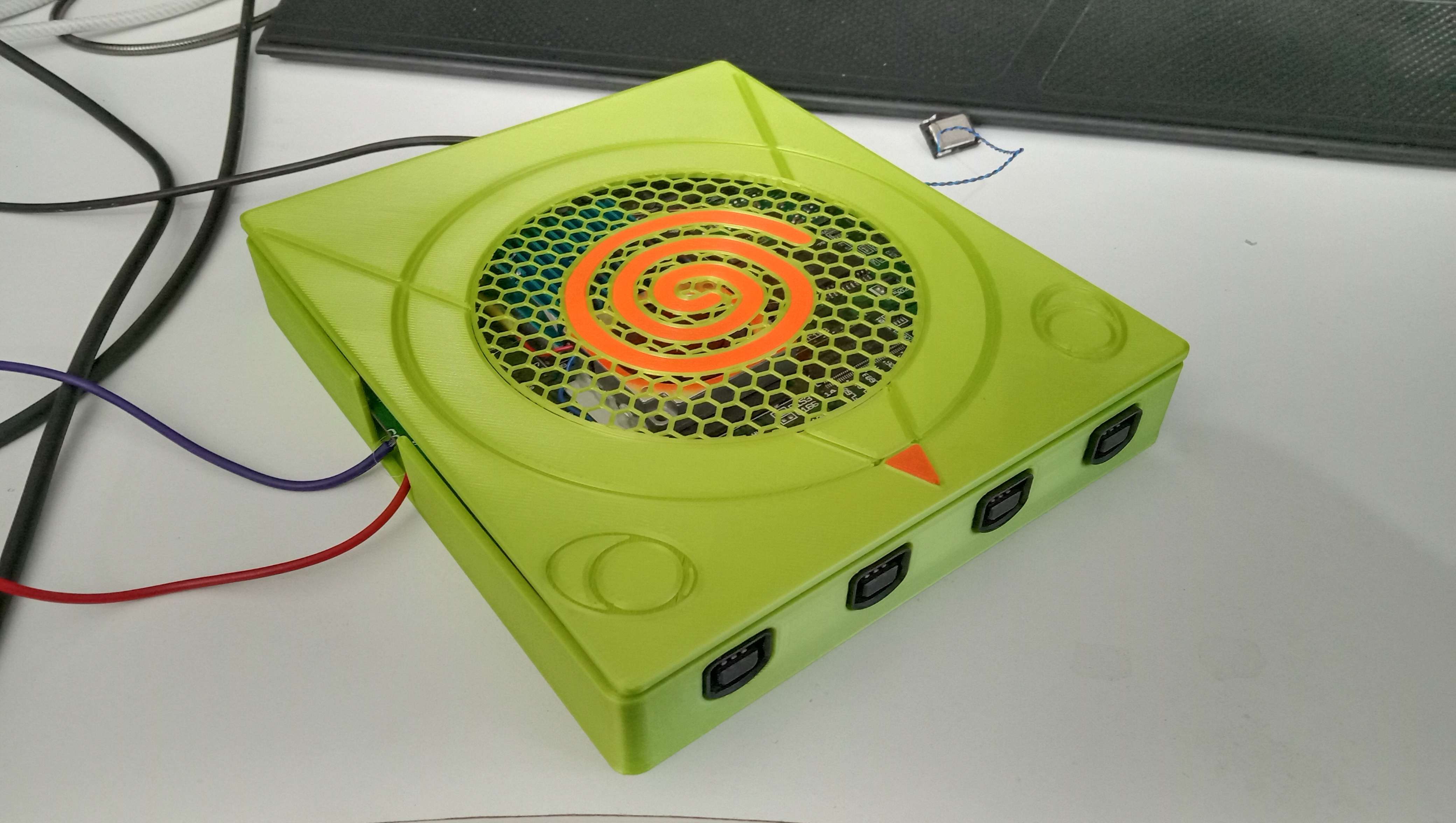

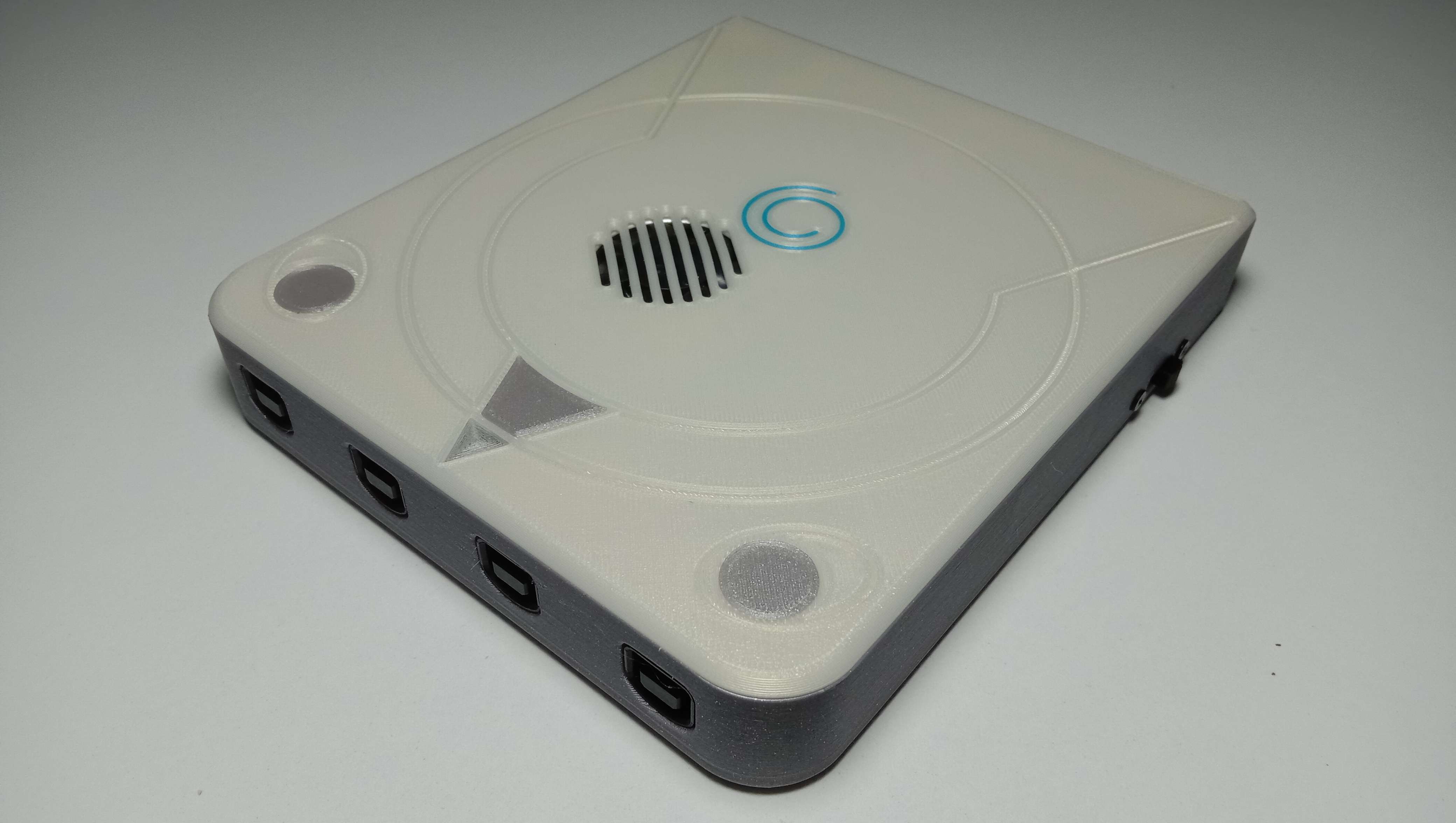

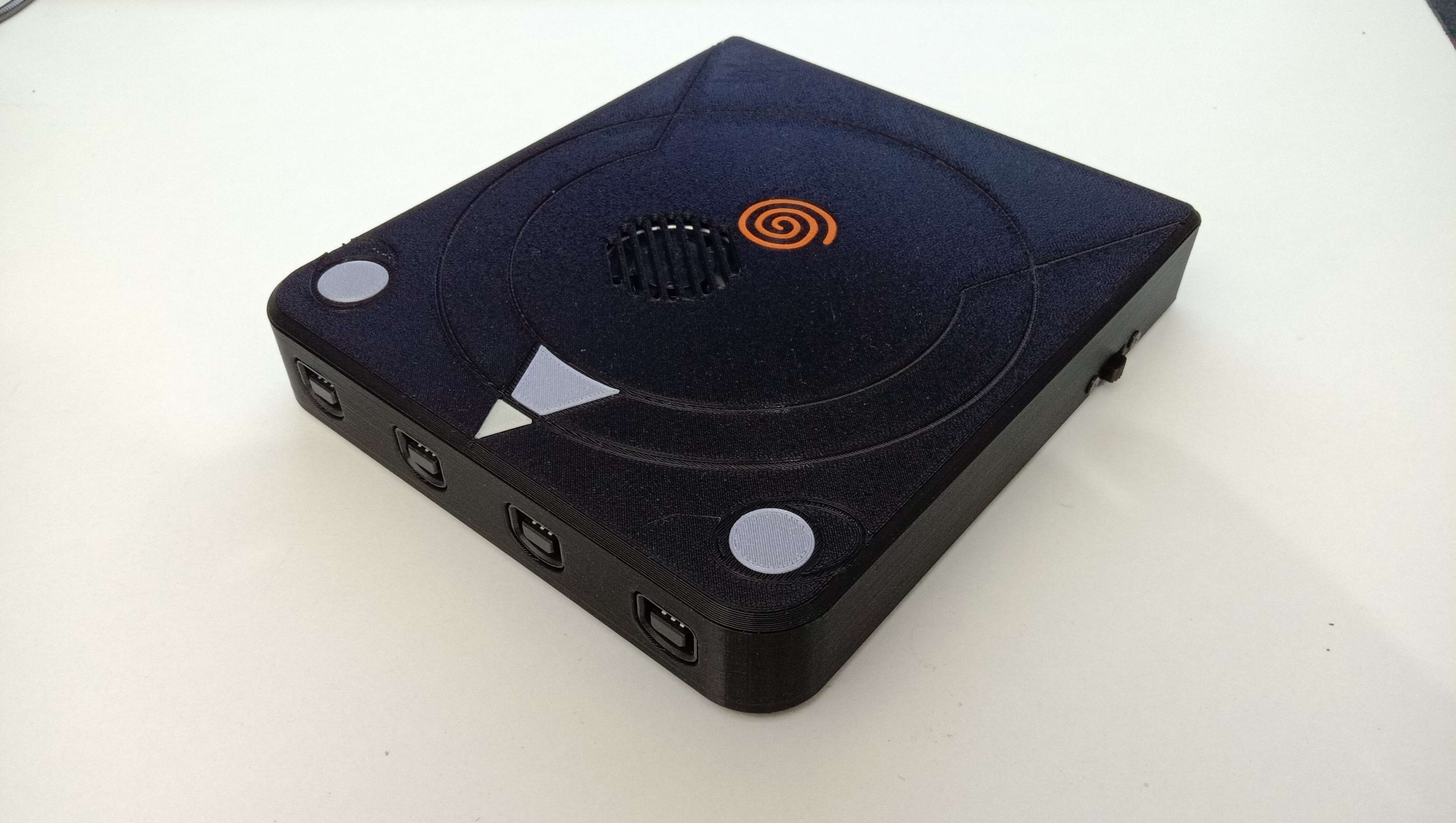

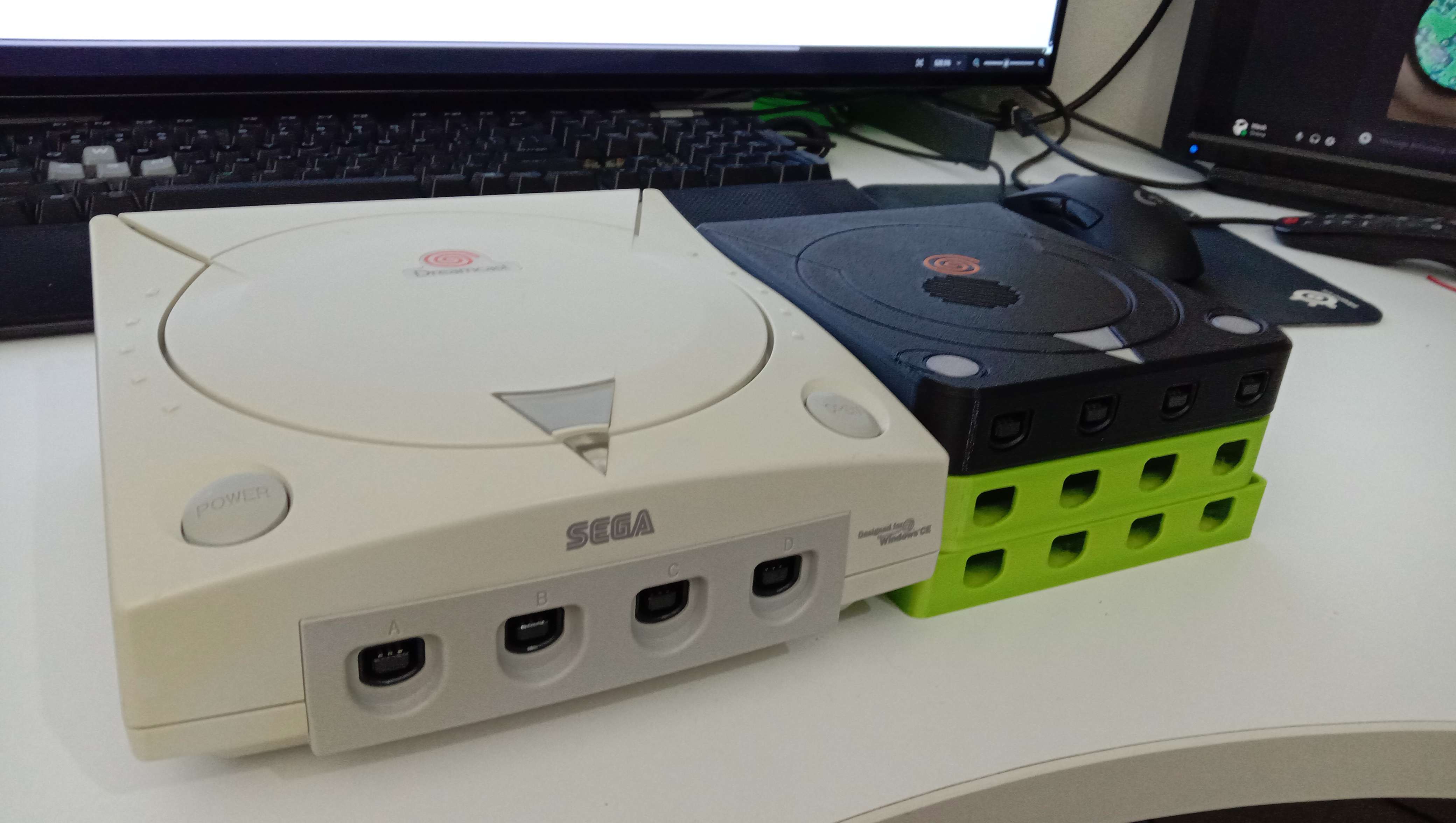

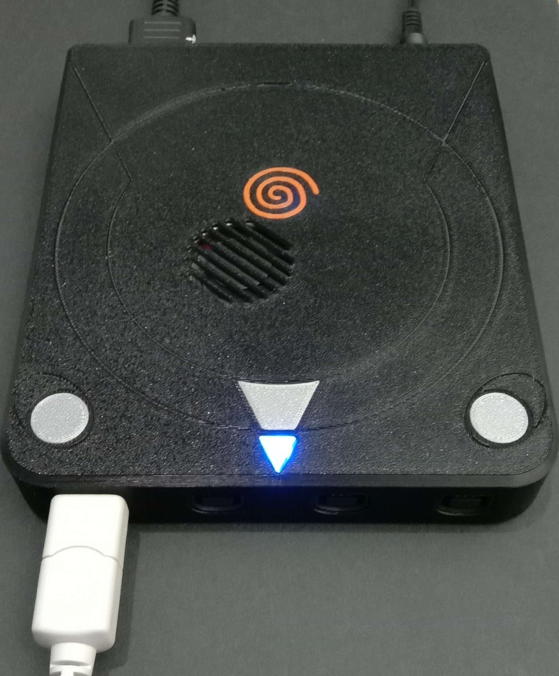

I spend a couple hours measuring things out and print a rough early design to confirm fitment:
And boom, after a couple more test prints and adjustments to design we have the current working version:
AEYmBYT5VRgZC_wSxeC-IvyJCDxcY7C4hgo83vwhbjTe9-g2kOnCRNTl5fzOC91gf9MGGYXXmx-psCEBlKb1P_uE2nyUrVD3=s2560
AEYmBYTtsAQ6RtPireWfN4piqBMH0OTe7esnU9L0--0hKZAljK8TU2ERBzyZJf00O_I8rPx1sr1wyQg0sycmPkHAi2JnXkQu=s2560
Volume-wise it's about 1/4th the size of a stock Dreamcast and can be slimmer with some additional custom boards.
I wasn't able to get the SD extender working so the SD card is internal for the time being and I've only hooked up composite video+audio for ease of testing.
The system is also running on all the required voltages for maximum controller compatibility (2.0v and 2.5v lines are undervolted however)

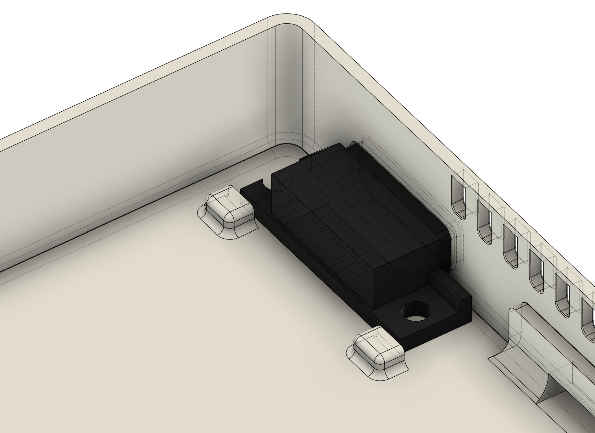

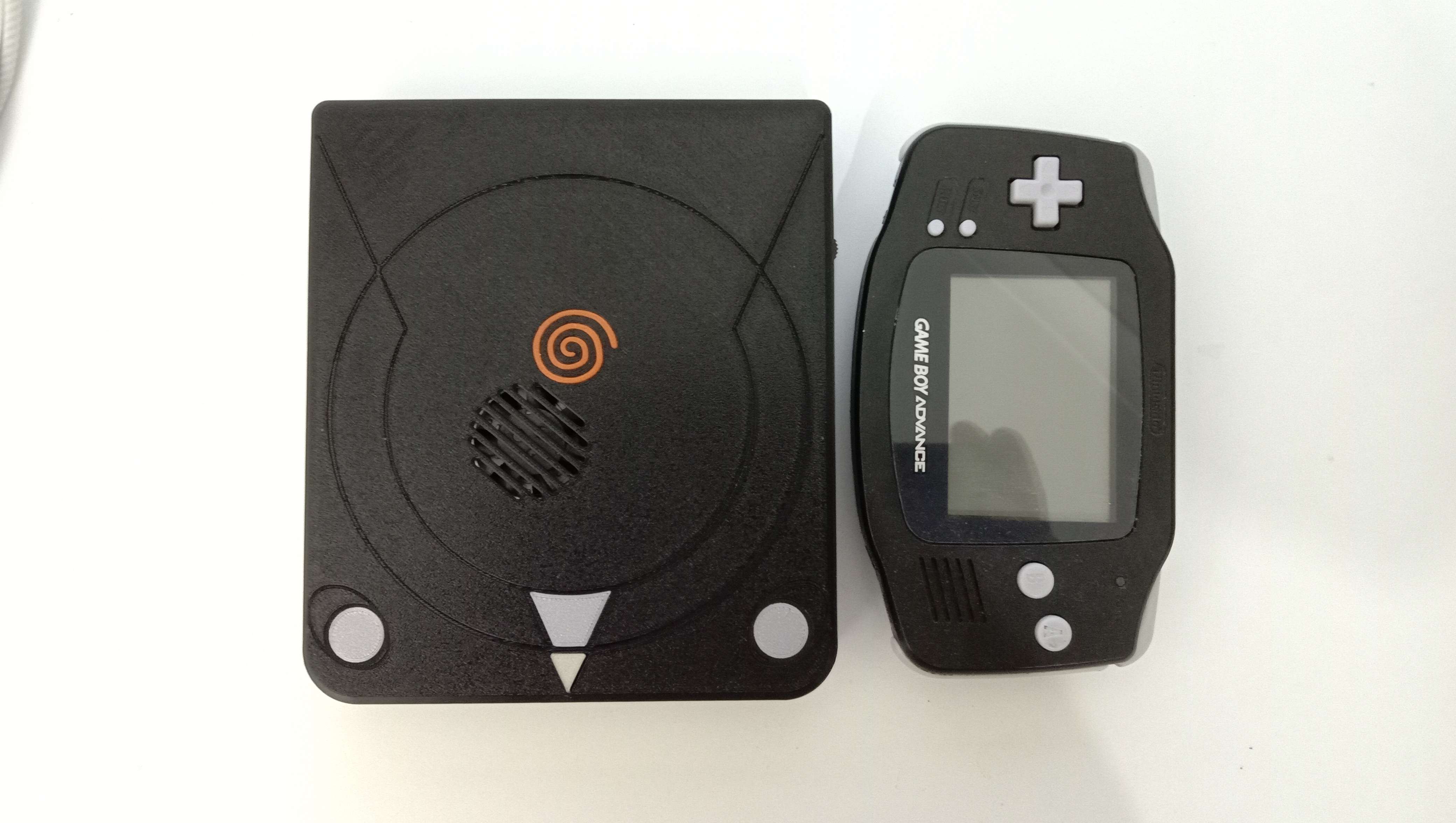

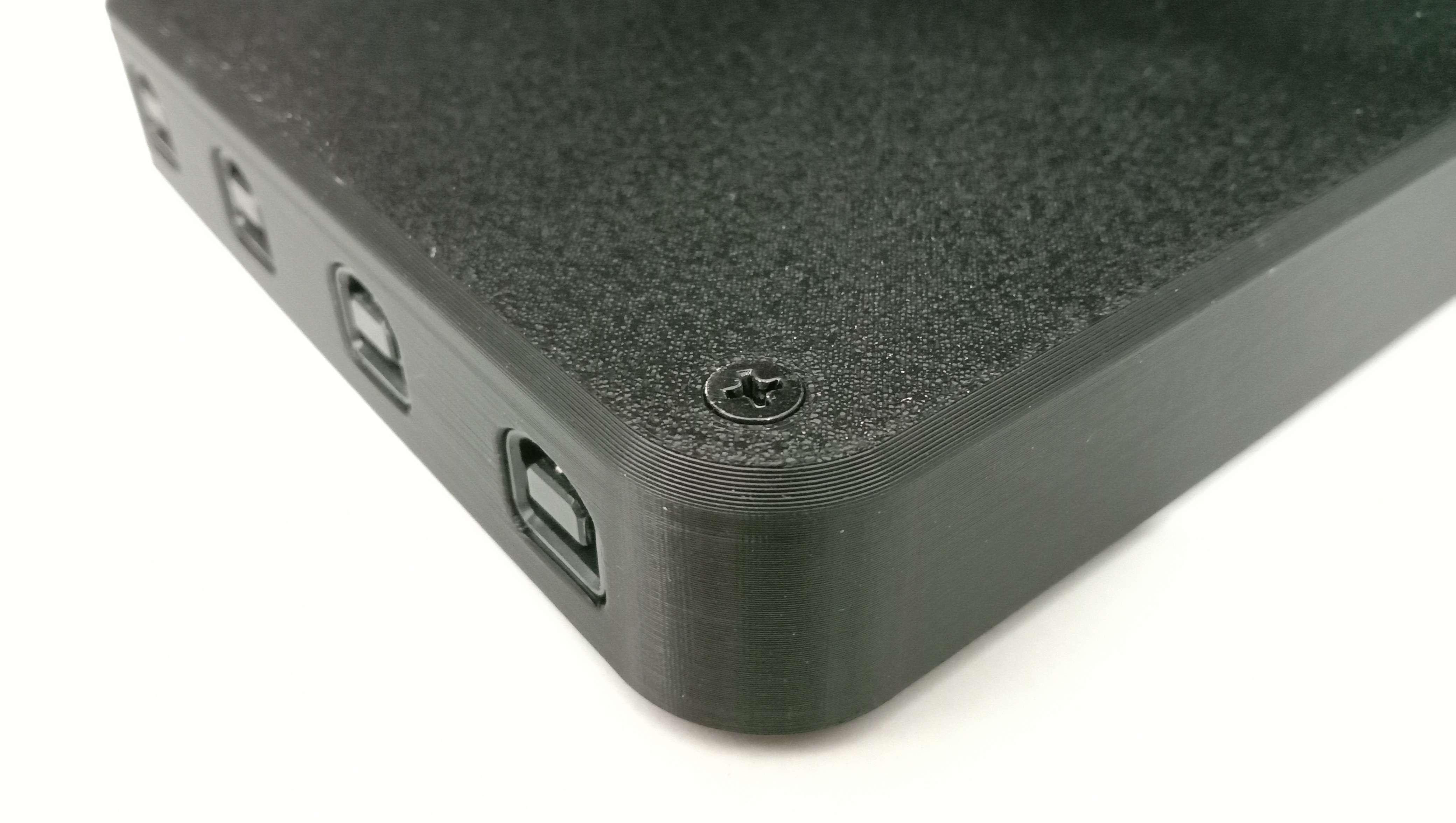

I have made some slight adjustments to the design for improvements to wire running as well as additional bracing for parts that undergo considerable pressure such as the AV port:
And have further played around with colour, unfortunately the filaments I have just aren't close enough to the DC's colours:
Also, the LED guide is now press fit instead of print-in-place which is the same change I made to the GC Nano after release. I find it's easier and cleaner to do it this way.

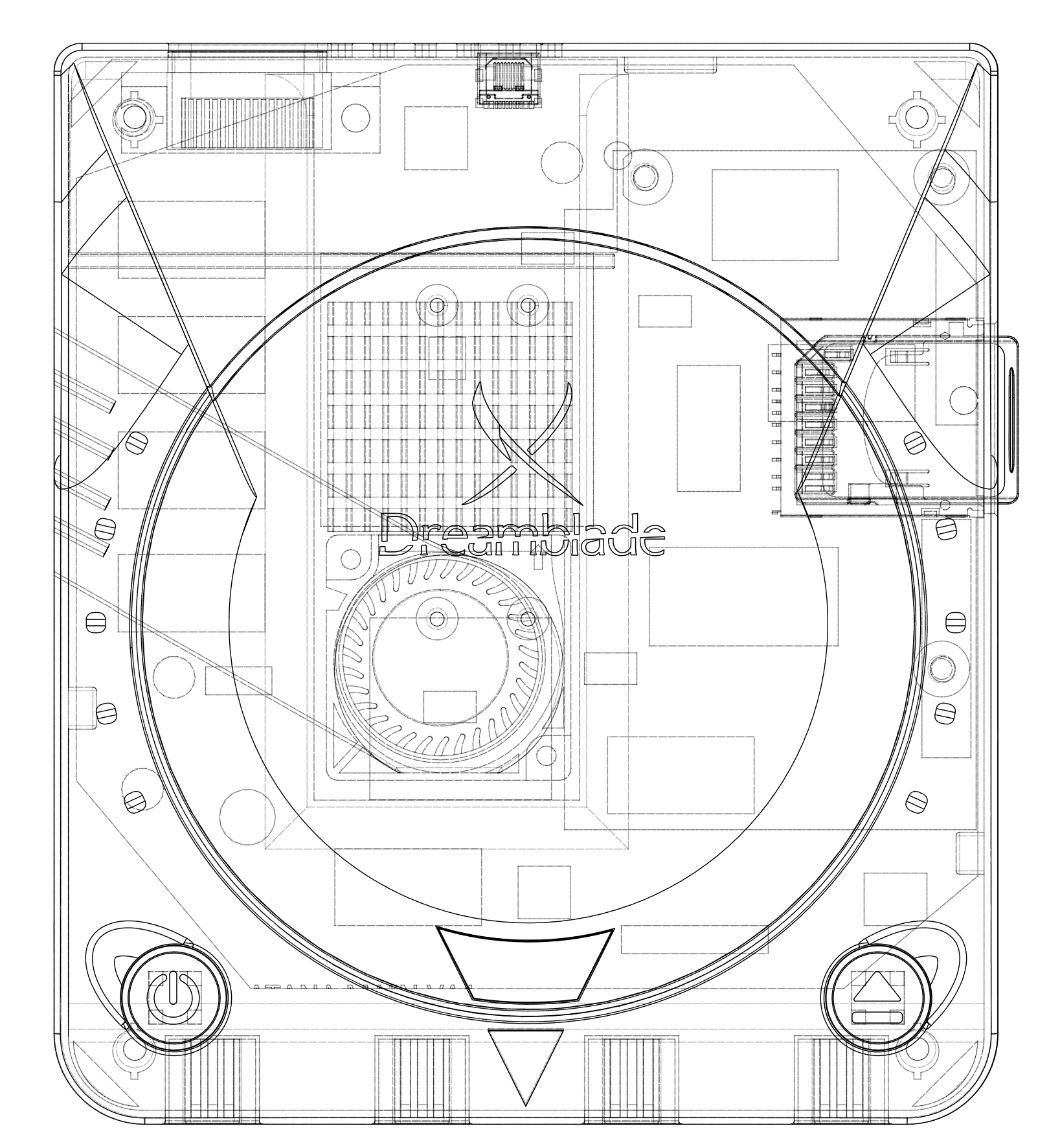

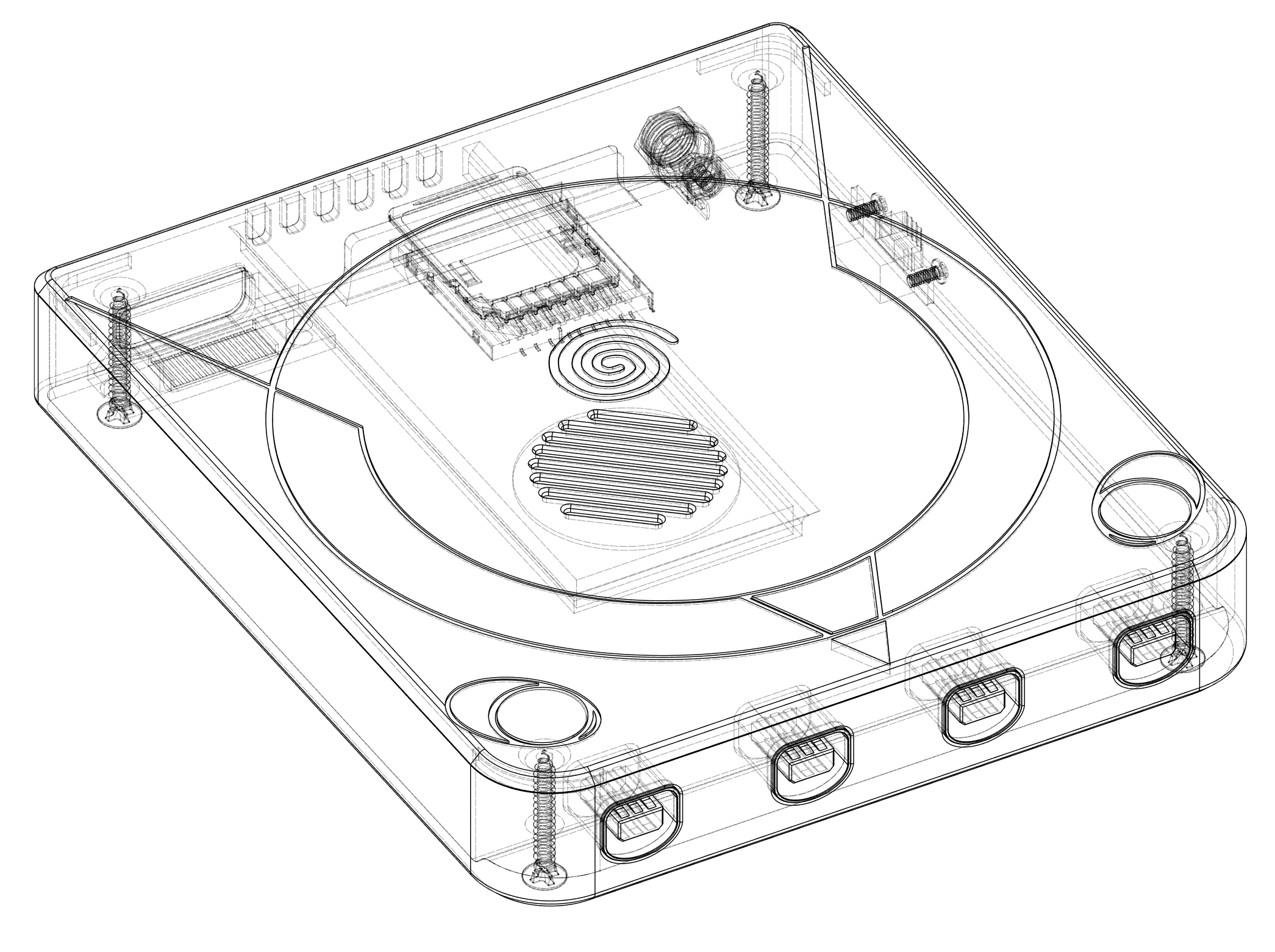

Redesign is mostly complete, and to bring it to the masses it's looking like this will be a joint collab between @CrazyGadget , @Y2K and myself.
The unit is larger now having grown from 25mm tall to 32mm but the quantum jump in aesthetics has more than made up for it.

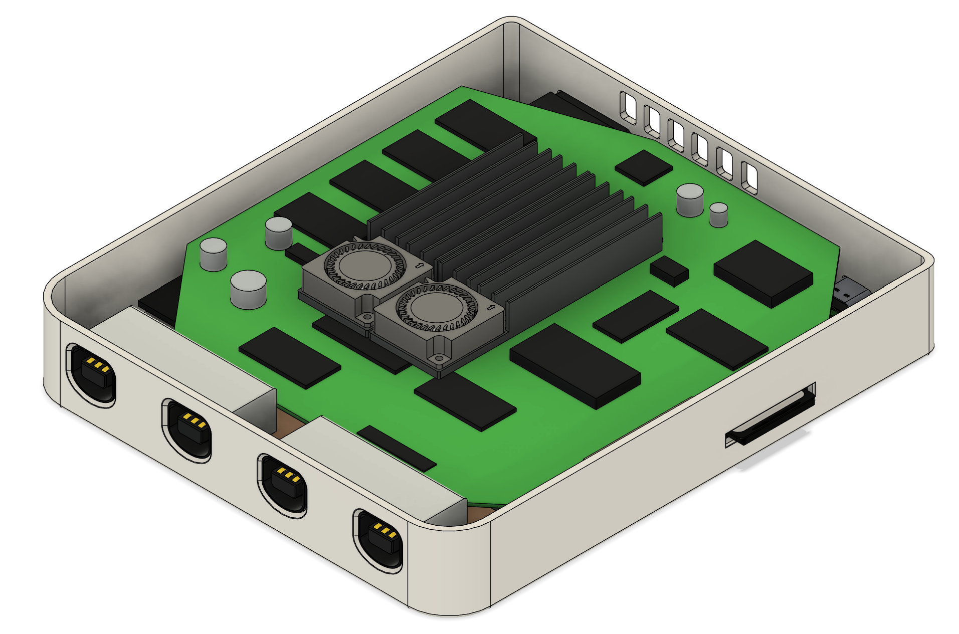

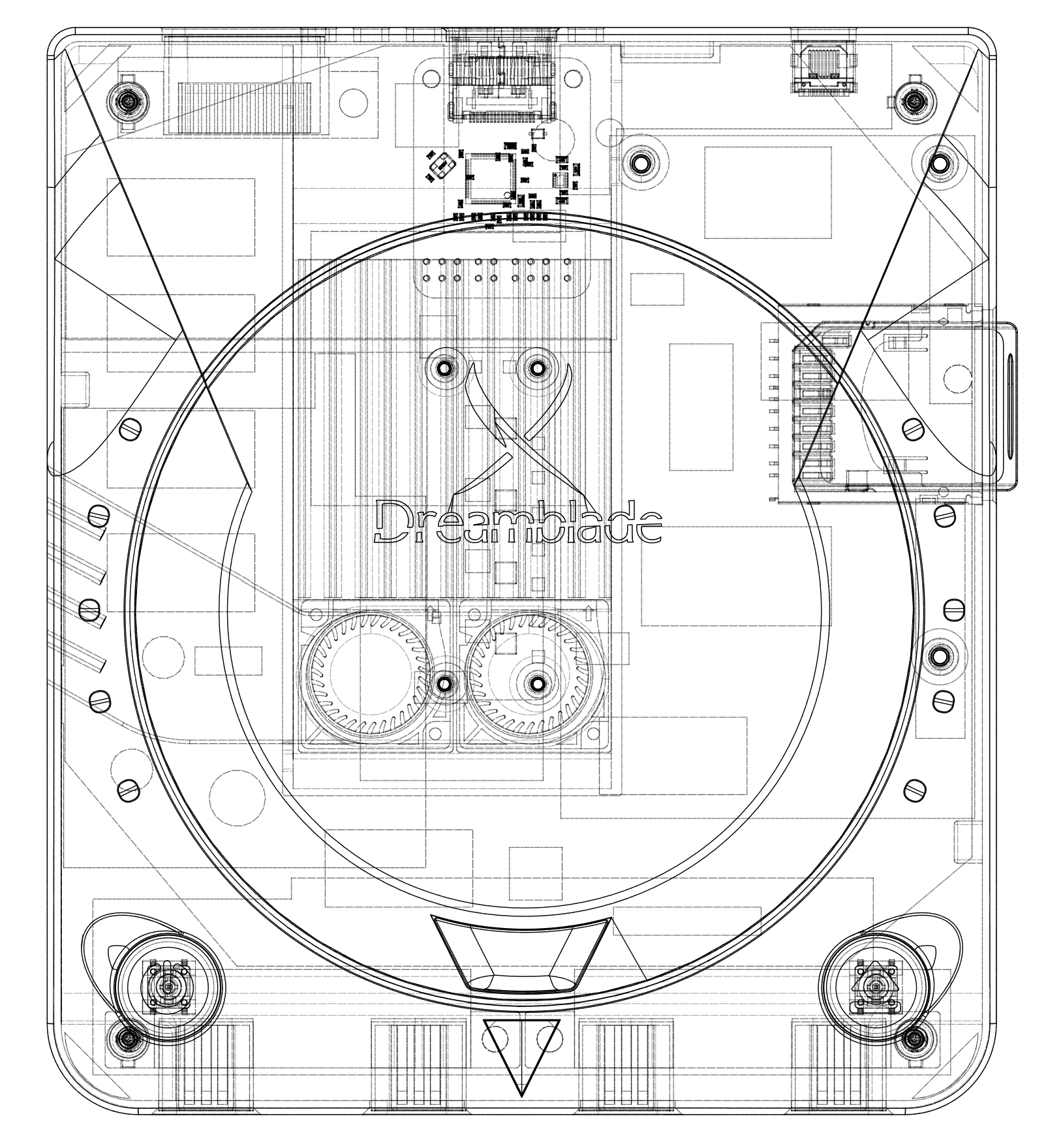

Still waiting on parts to arrive but I'm hoping we can effectively cool the system with dual M.2 coolers. This would simplify the cooling setup significantly.
We are also planning on supporting both VA0 and VA1 Dreamcast motherboards provided the VA0's don't run too toasty.
ElectronShepherds Analog2HDMI will also be supported along with PixelFX's DCDigital, giving flexibility to cost and features.
System has been updated with dual air intakes after testing the new cooling setup. Temps are looking really good with more than acceptable fan noise levels.
On a VA0 motherboard running stock voltages (most power hungry and heat generating board, approx 9 watts?) the system topped out at 67c. Not exactly amazing but still well within safe limits.
On an undervolted VA1 board (approx 6-ish watts) the system topped out at 51c. This is exactly the target we were after.
So with this info we've determined that both boards will be suitable for the build, the m.2 coolers are a solid option and this will broaden the appeal of the project and make building one even simpler.
And in a move that should really shock nobody but was very nice to confirm, the VA0 motherboards seem to be able to handle the same undervolts as the VA1 boards. This has also confirmed that we can get the VA0 boards down to the same temps as undervolted VA1 boards.
