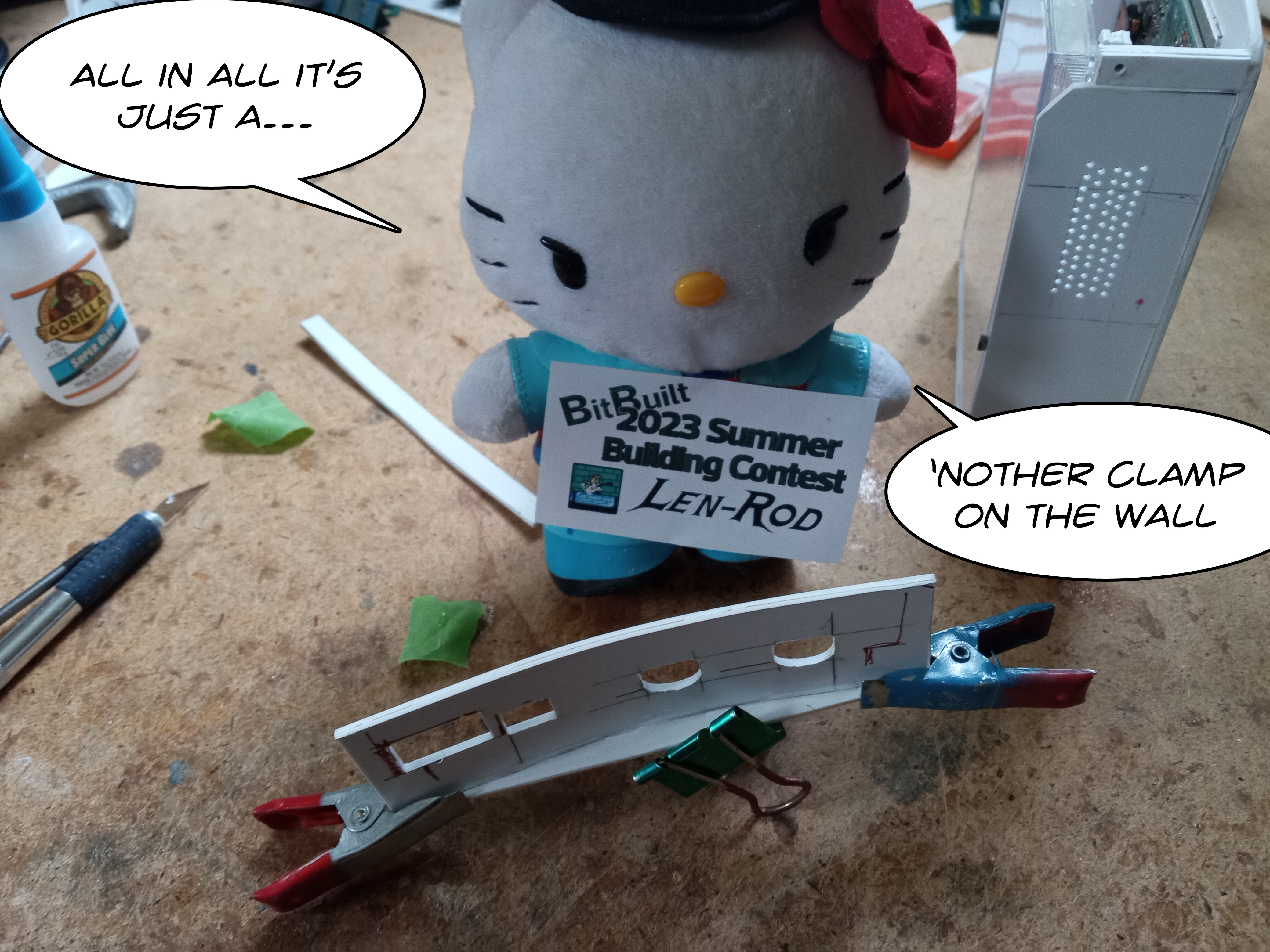

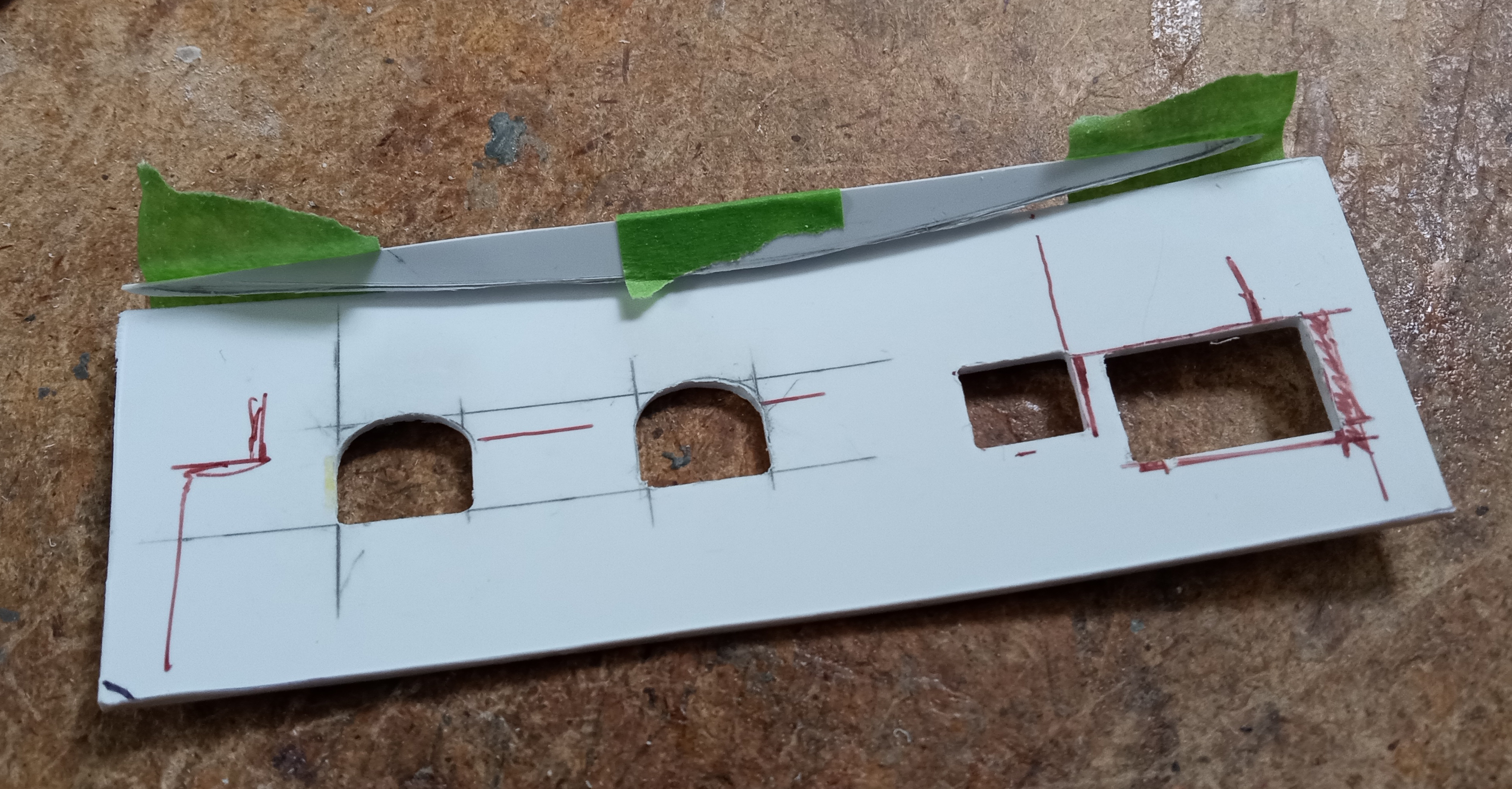

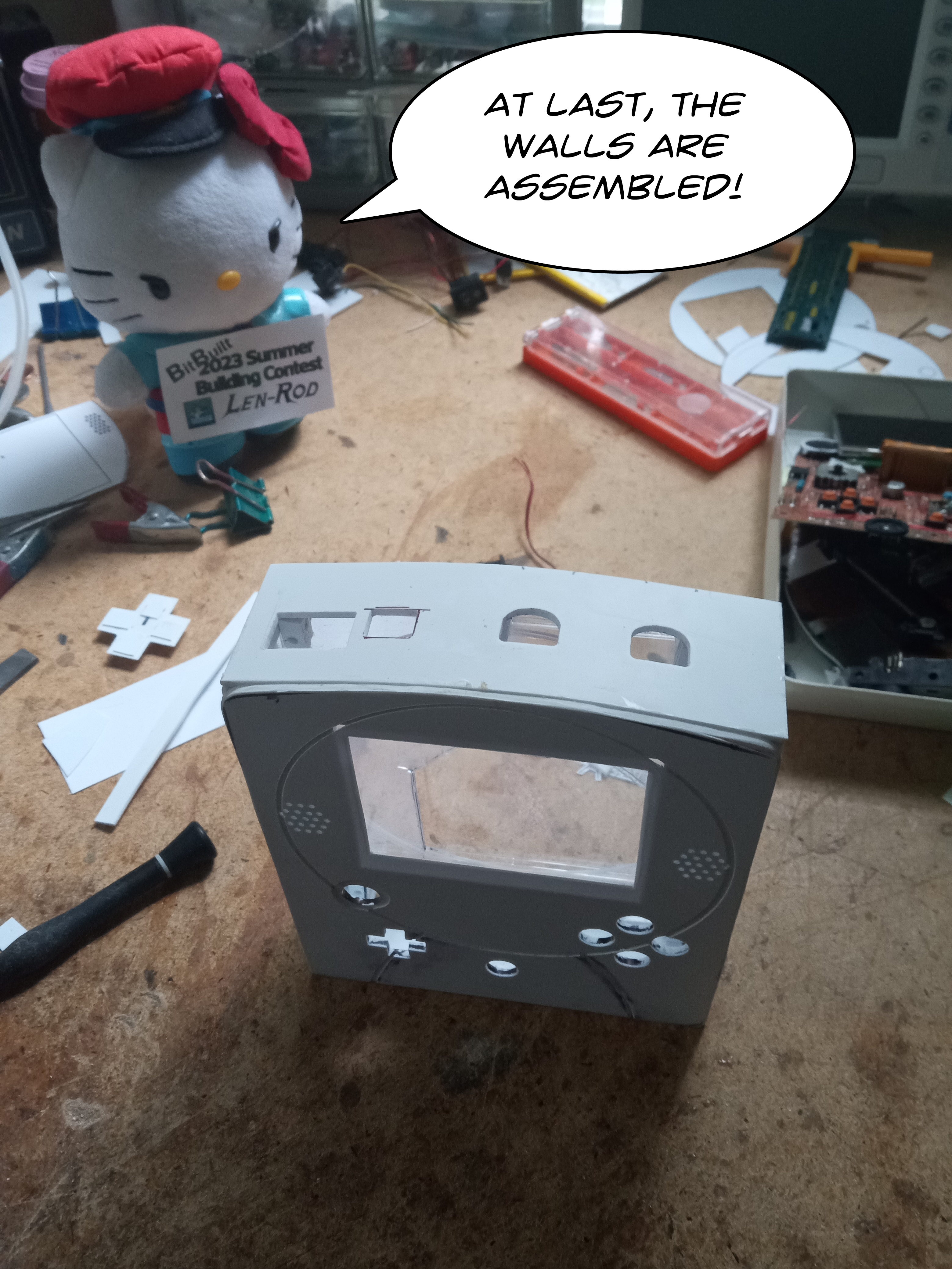

First the bottom wall
Then the Left...
and then the right!

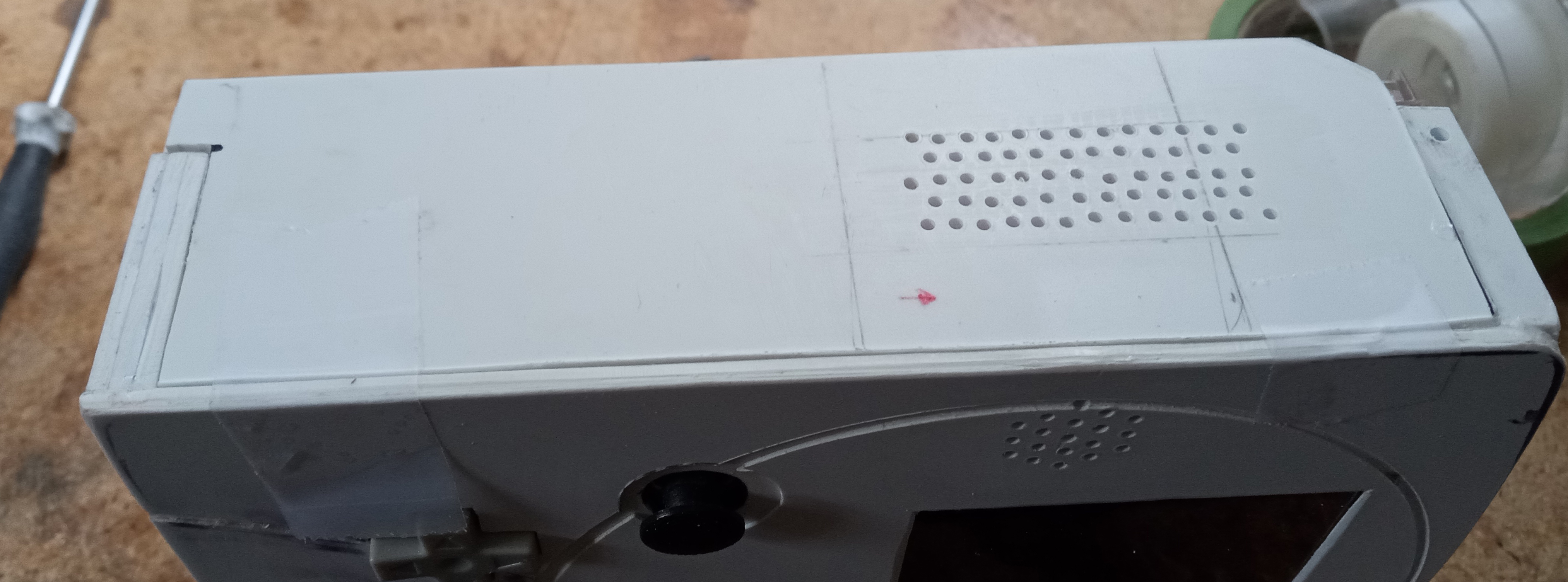

Now for the top plate...it requires a nice extra curvy part first.
and lastly, attaching that plate!

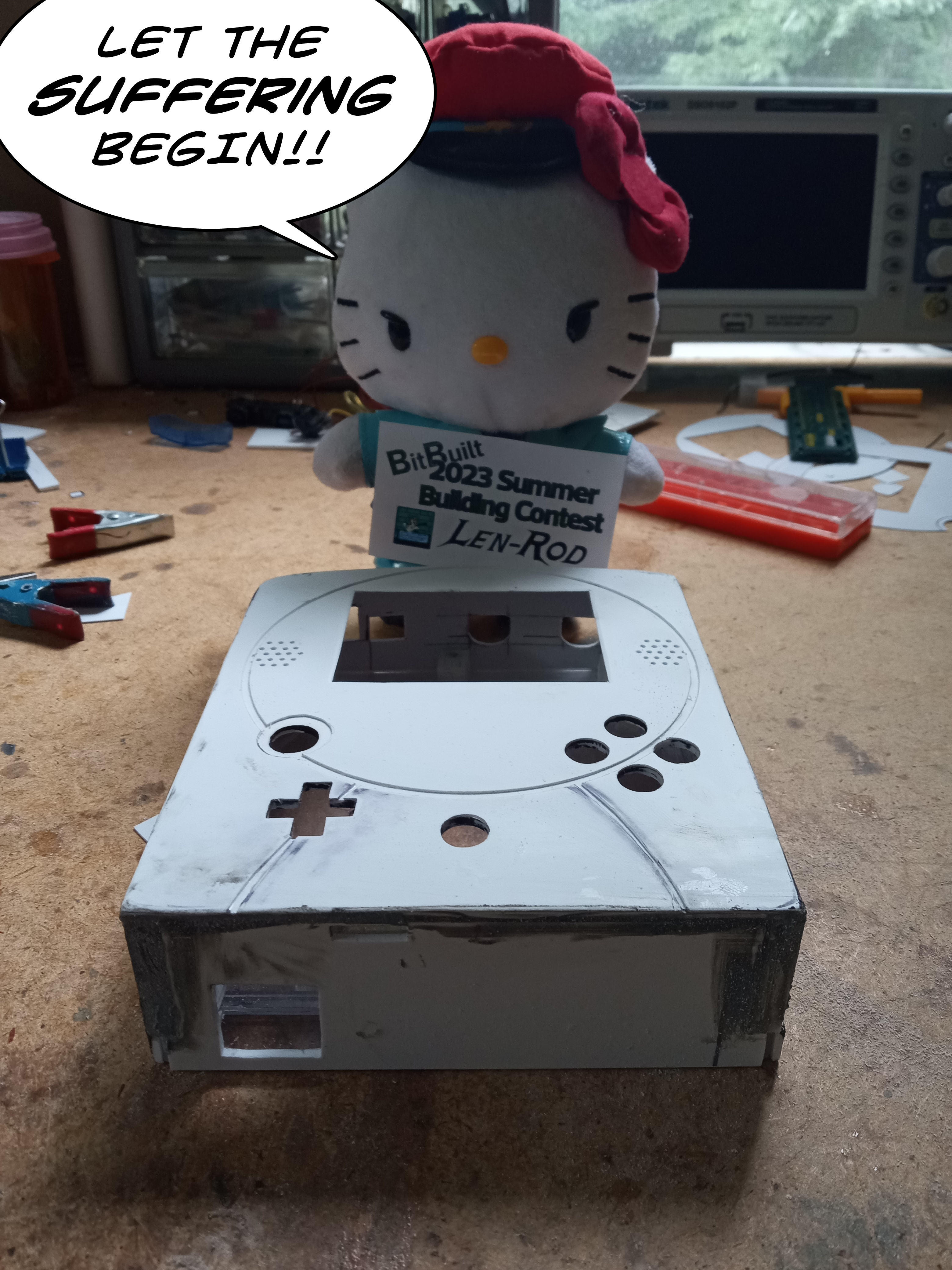

Now we gotta let it sit so the glue can fully cure before doing anything else with it today.
The putty work is soon to begin! Will the mess of putty be too much? Will it all look terrible? Stay tuned for our next putty-tastic episode of Dream Xtreme!

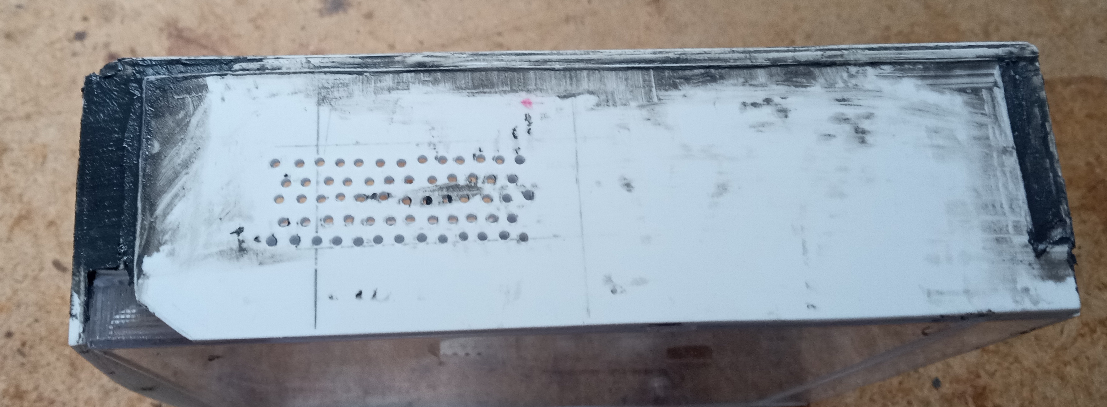

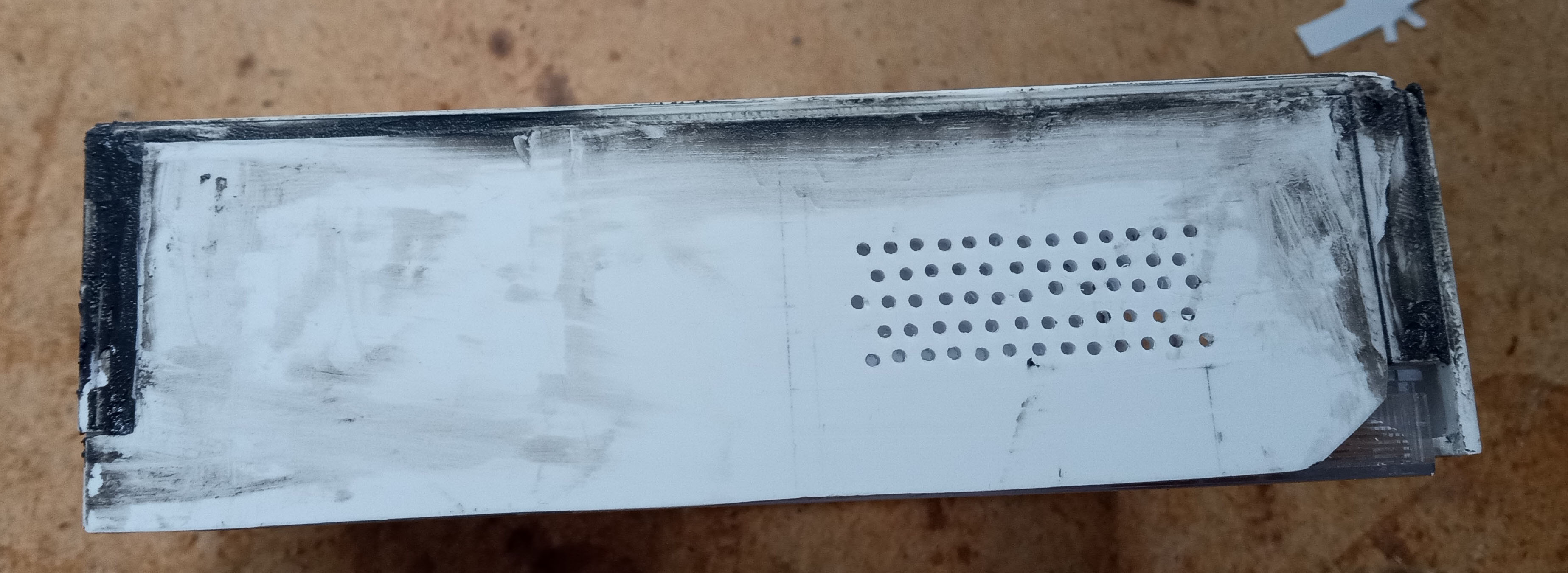

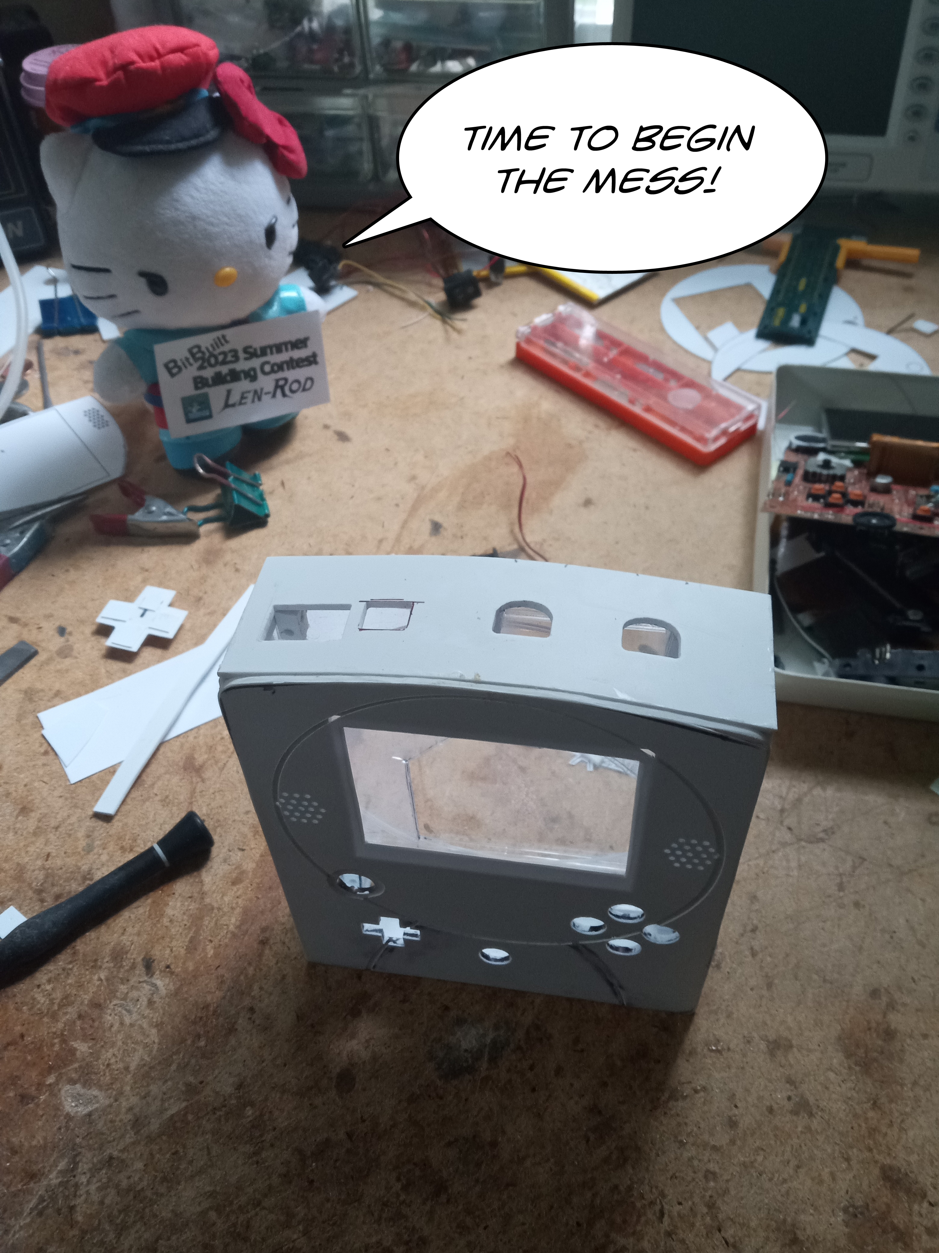

Well, this is a short one as it is time to get the body work done up!
Nothing works better for mixing and applying my case putty material than magic cards ;)
Black does alotta sacrificing....and I shall sacrifice it! mwa ha ha!
Aaaaaand...PUTTYFACATION!
Then some more!
And then some more still!
It doesn't stop!
Ok, while that's hardening over the next oooooh....24 hours or so...Let's get to one last thing...
...getting that player 2/3 port setup....it fits good :)
Ok well, that's all I can do for now. Gotta wait for the putty to solidify, which will take pretty much a full day. Sanding is next on the agenda!

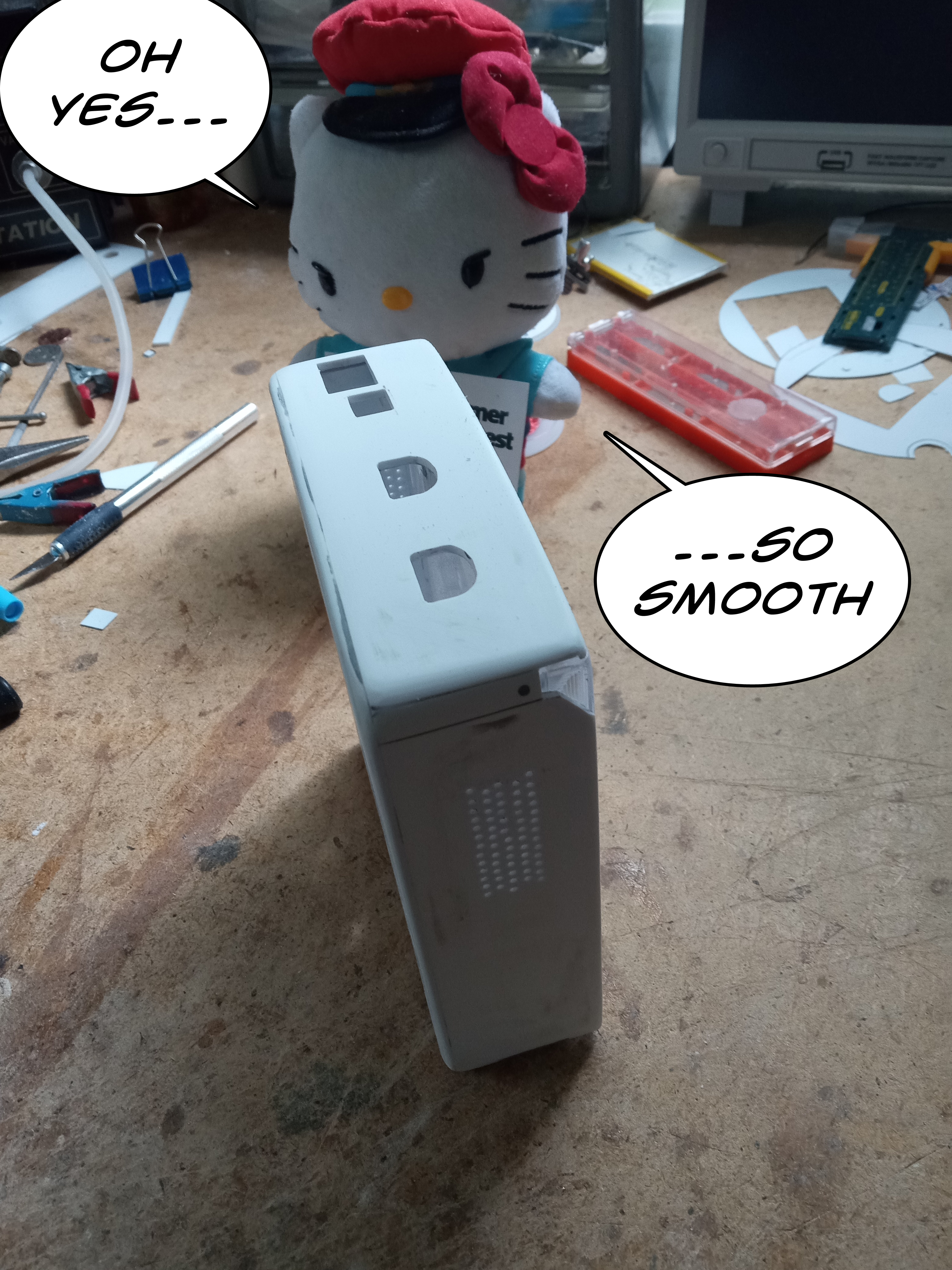

EPISODE 25: The Sanding of Pain!
The goo is cured....it is time to murder my hands and wrists!

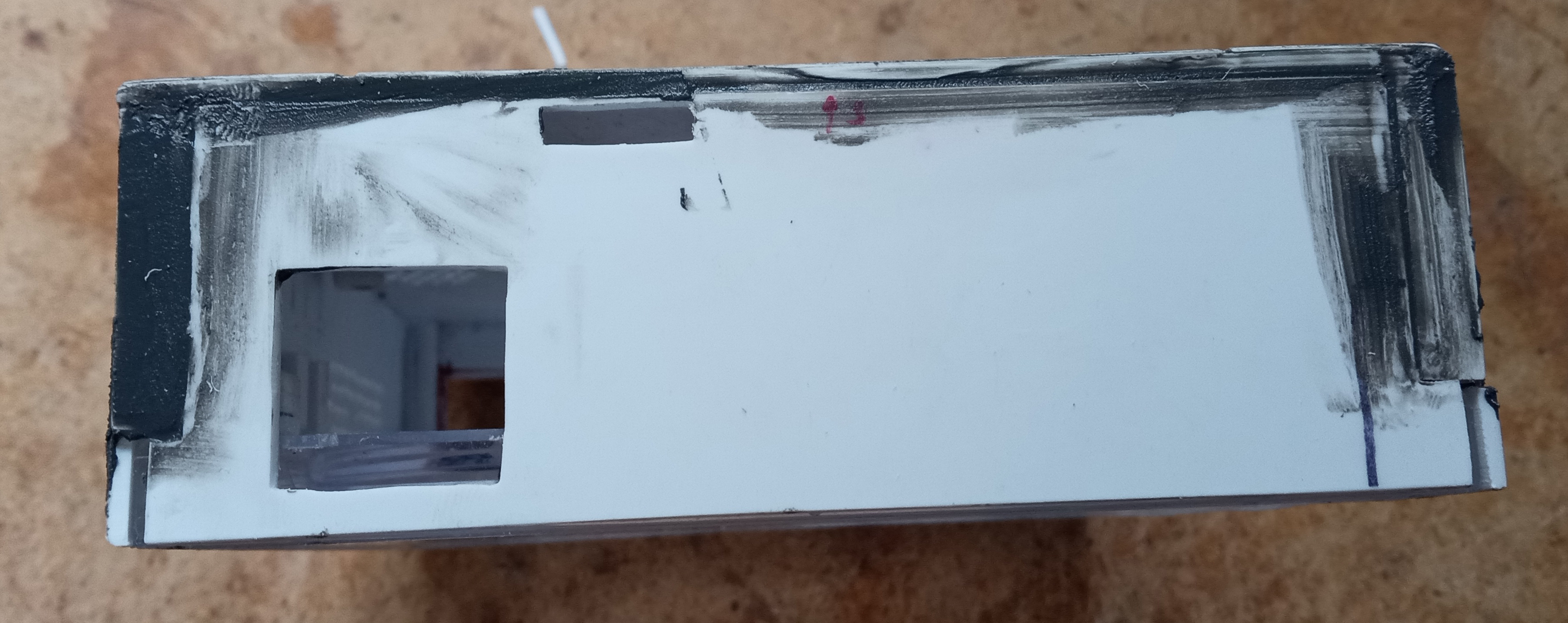

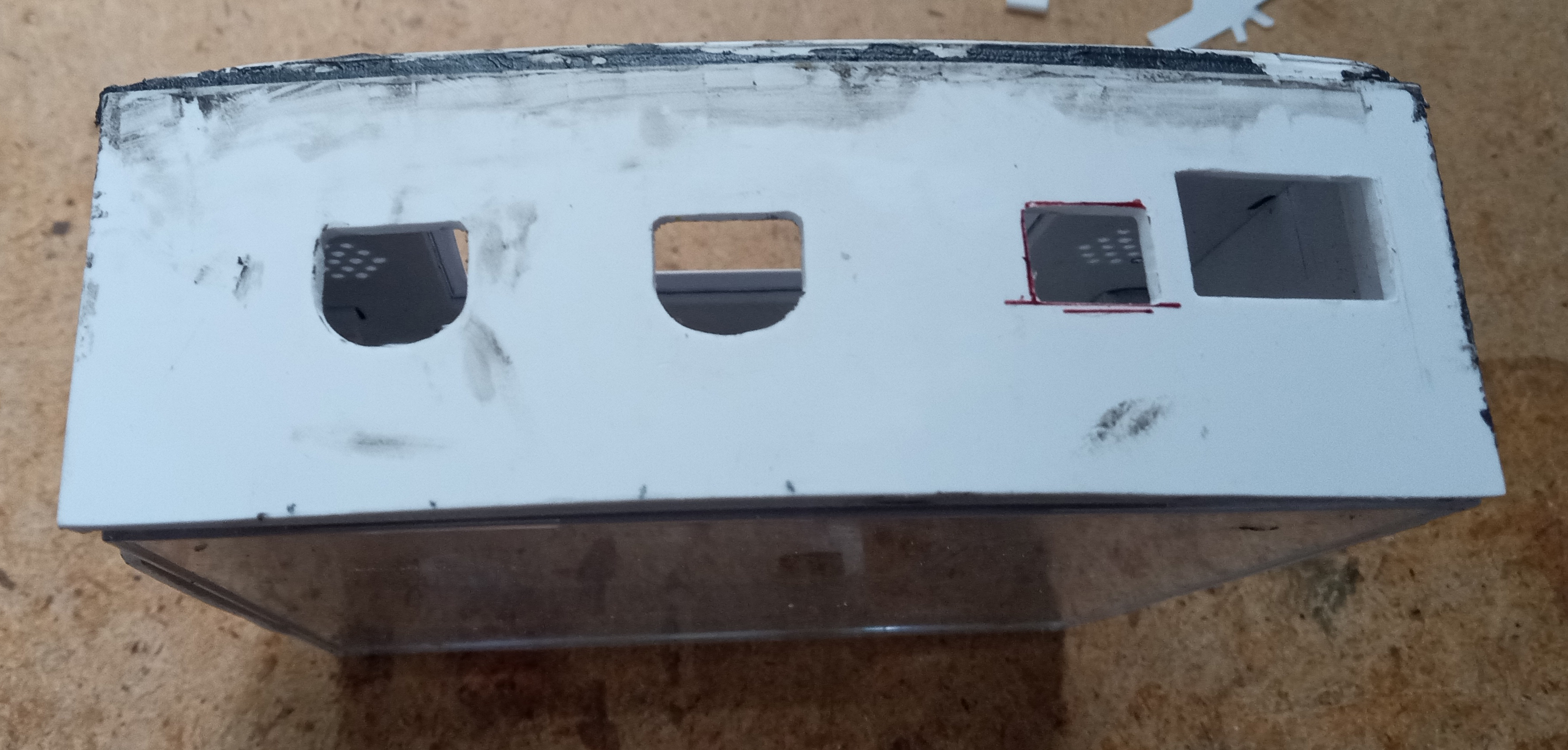

...and after way too long....and alotta pain...
The shape is perfect! I somehow managed to fill all the holes on the first go! Pretty surprising considering that it usually takes at least 3 coatings normally lol.
...Ran into a major issue tho...

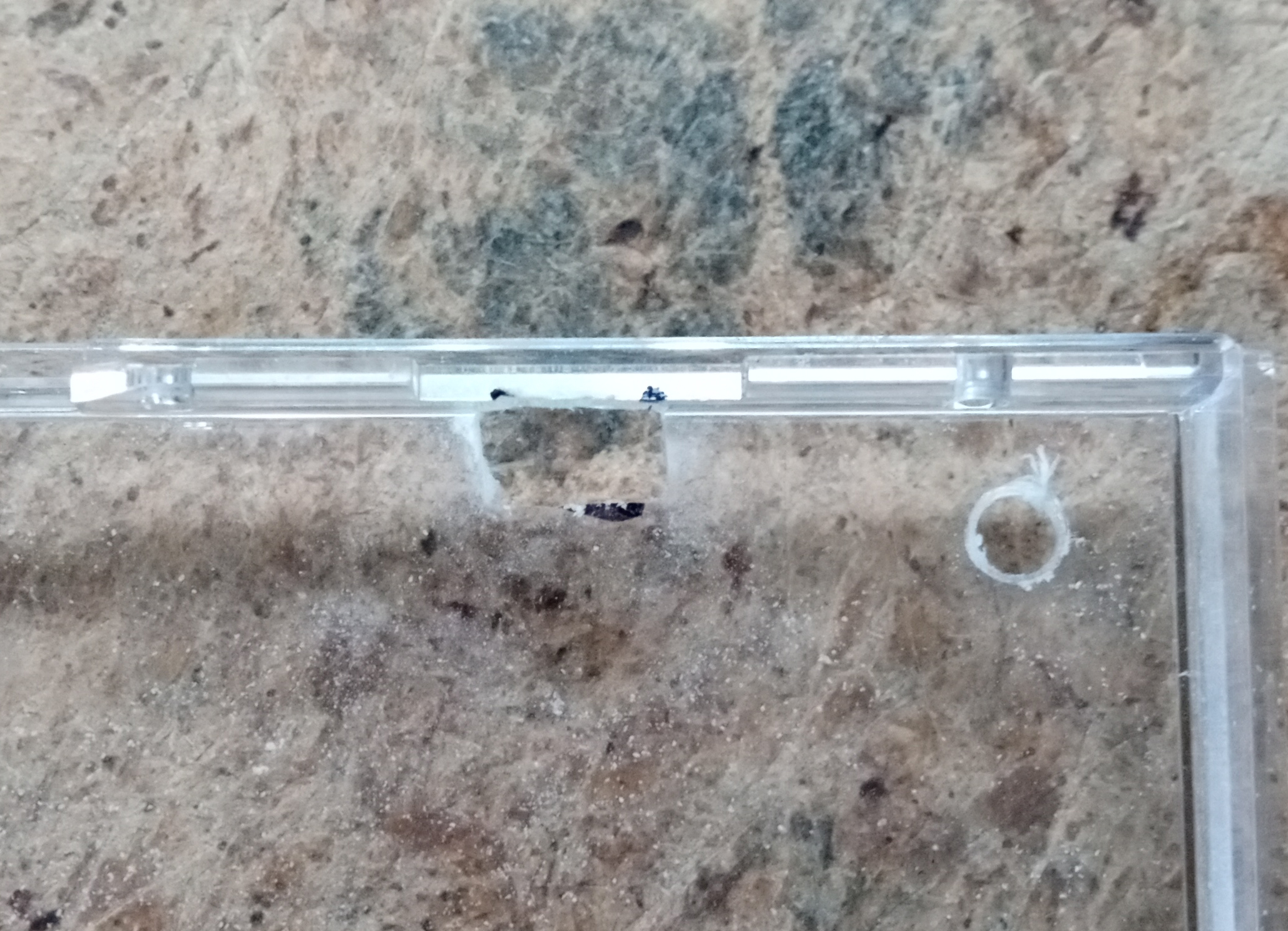

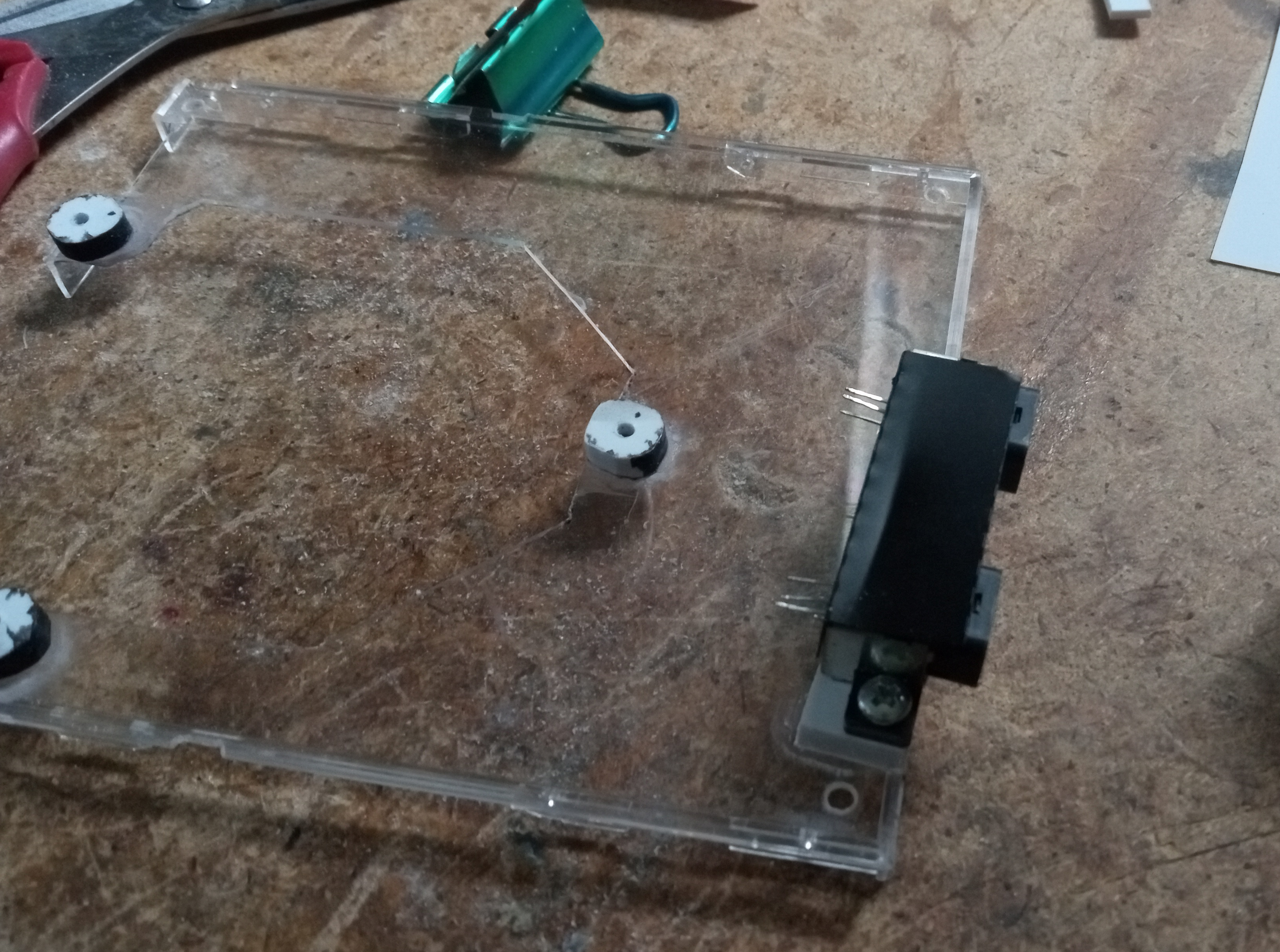

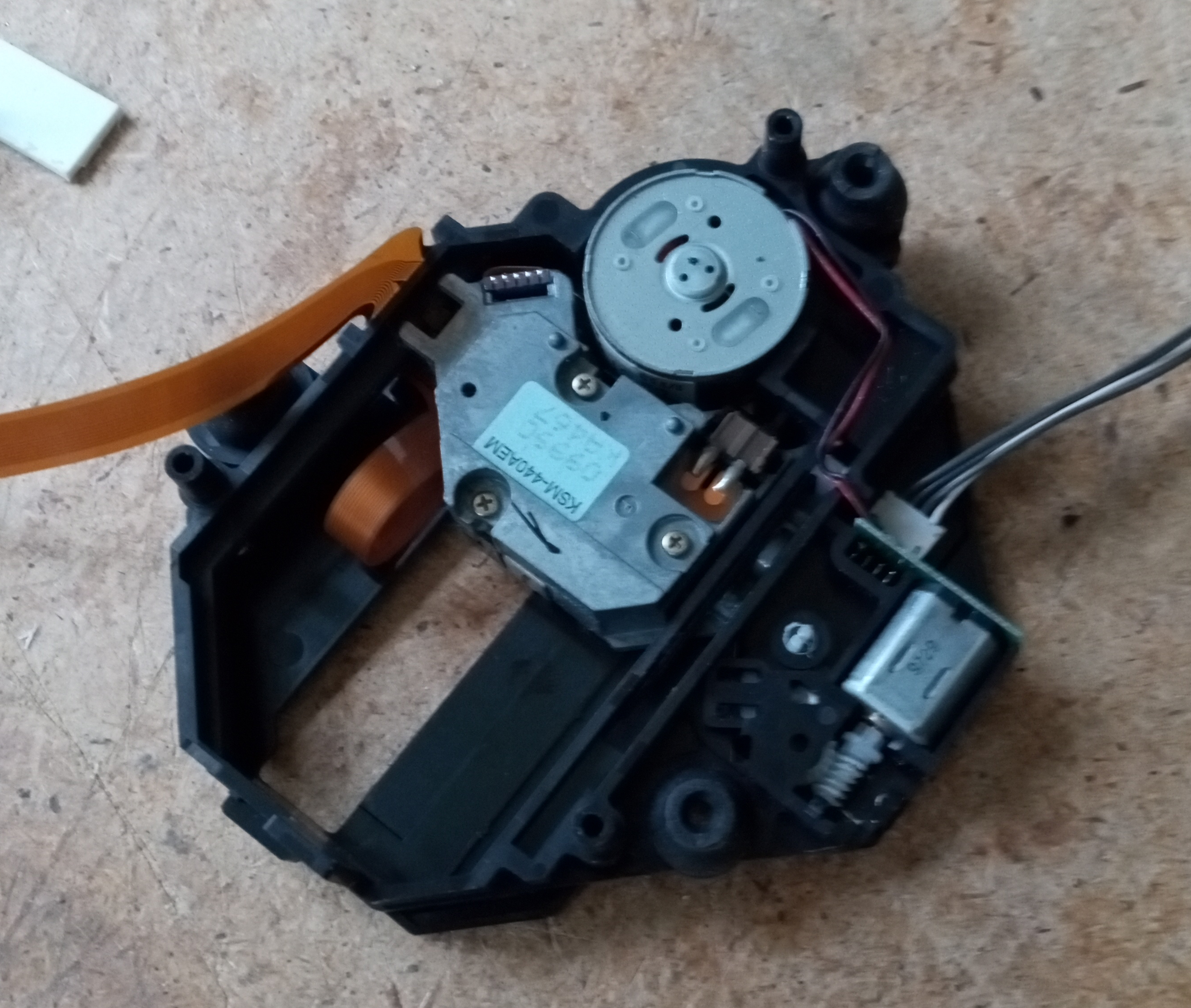

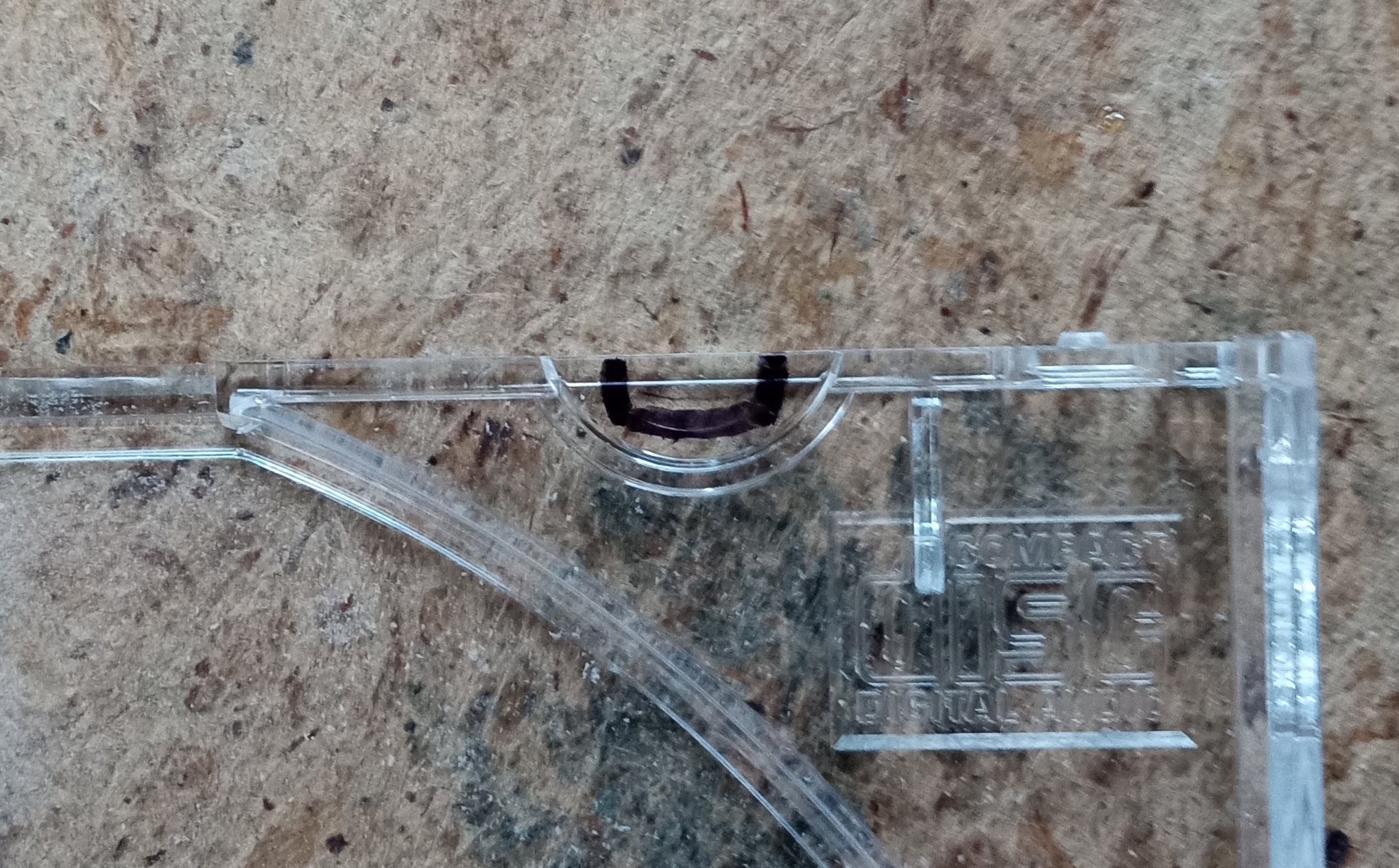

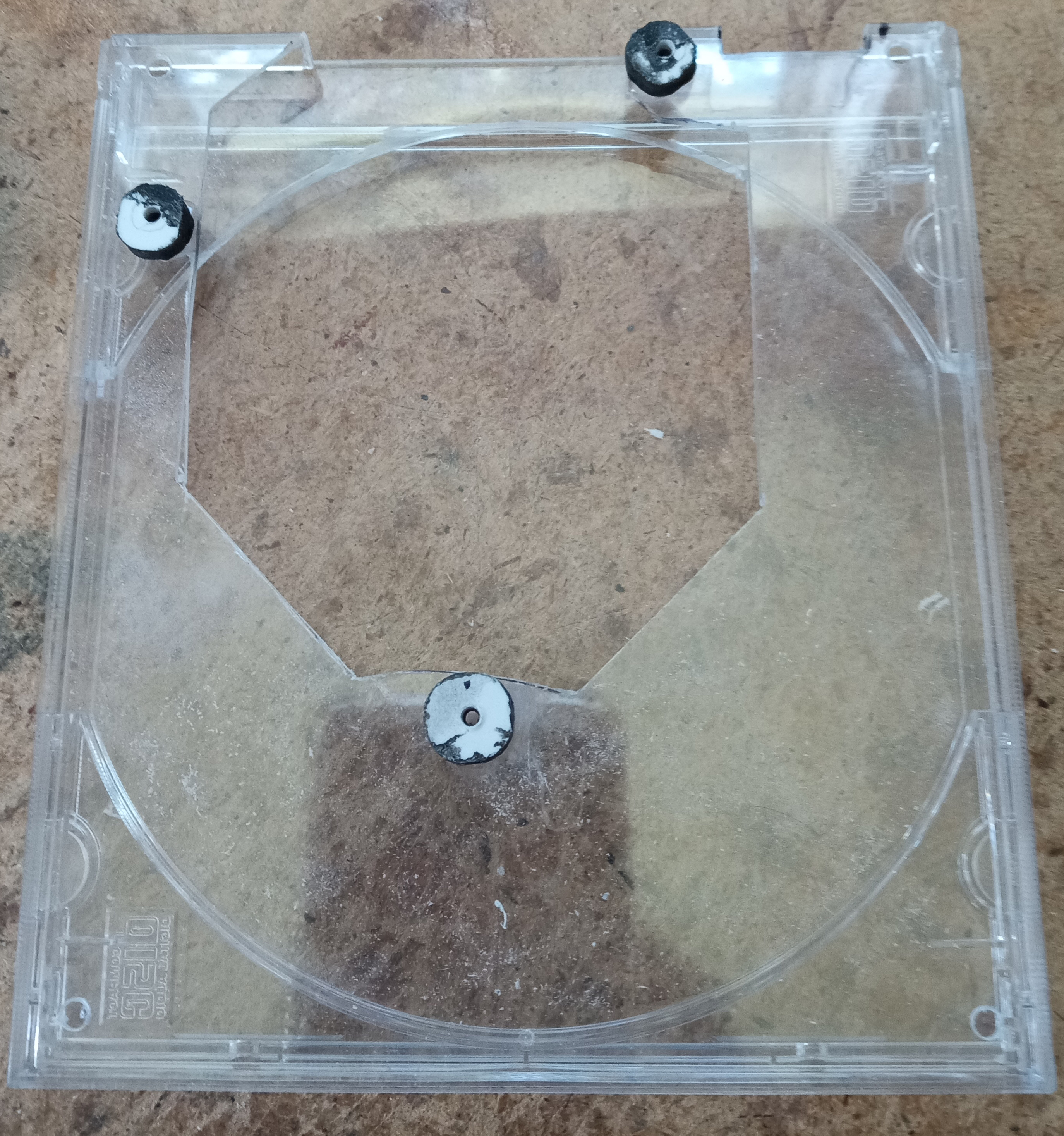

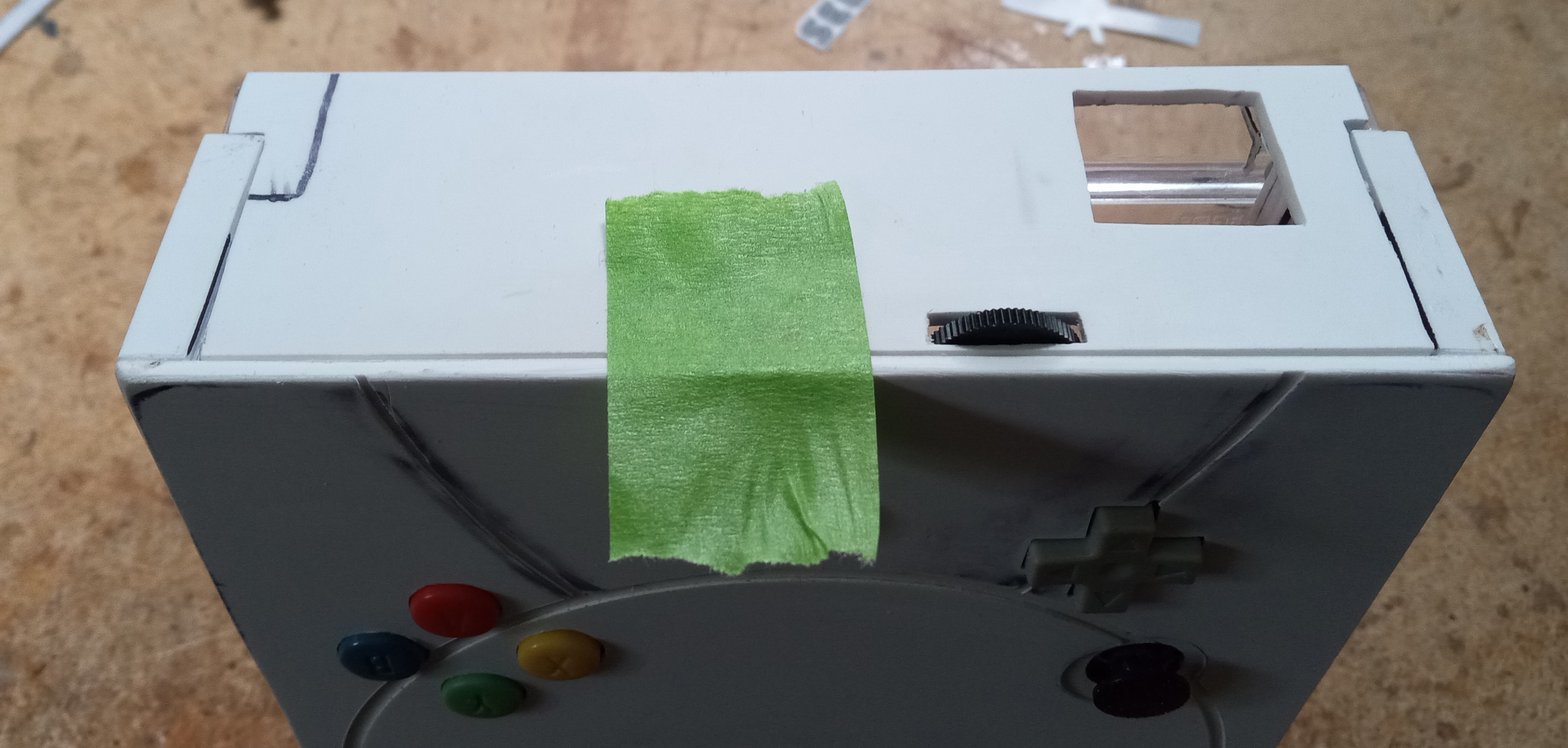

Sanding finished...now onto a small speed bump. I realised that since I have a proper disk cover that I want to also have a lid open/closed switch!

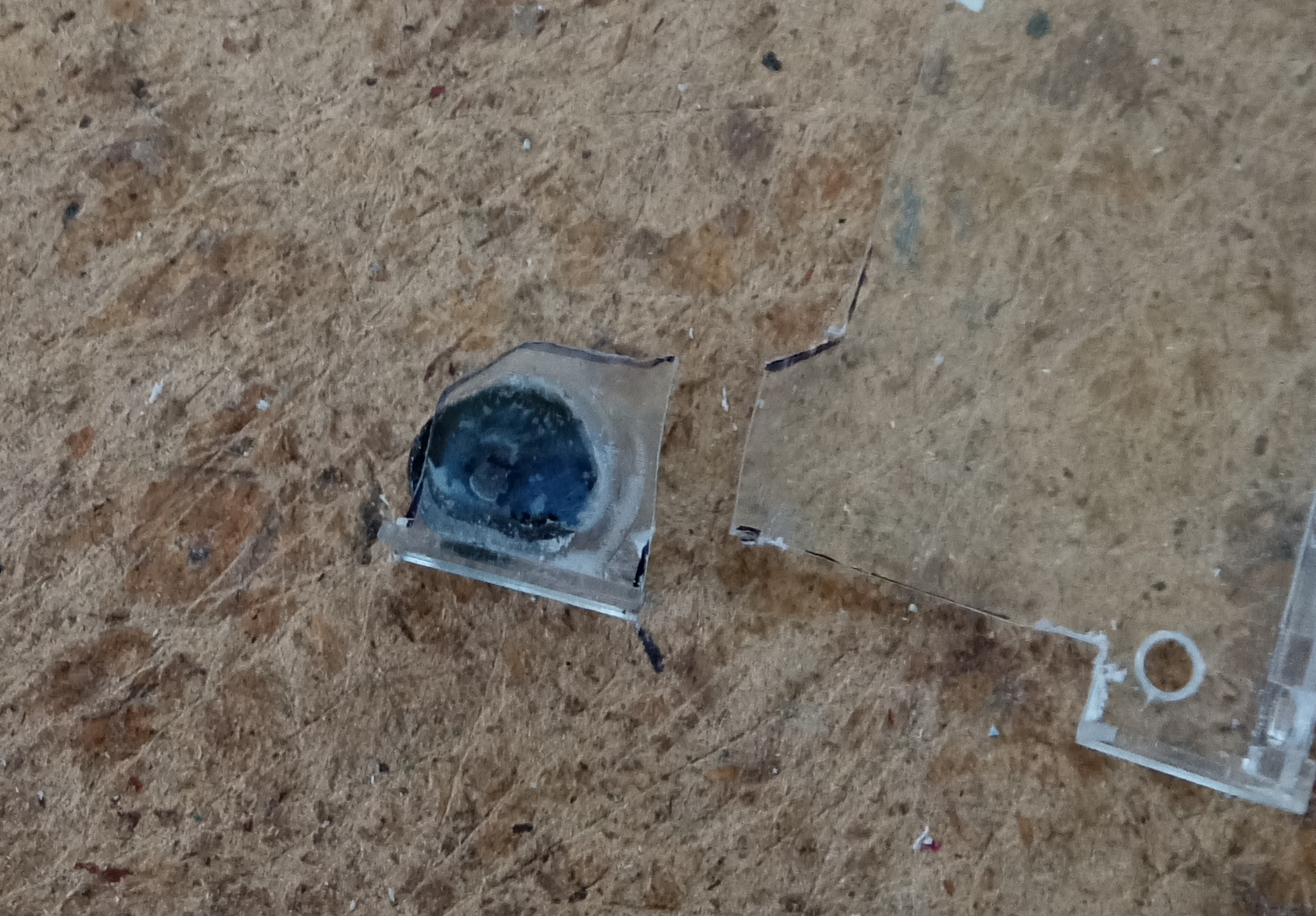

But then...Disaster! Wretched acyrlic plastic is just too darn brittle...
Sooooooooo....for the fourth or fifth time now, I have to make a new DD holder thing. Again, it's a good thing I have at least a hundred of these lol.
Probably for the best anyway, the previous one got really scratched up.

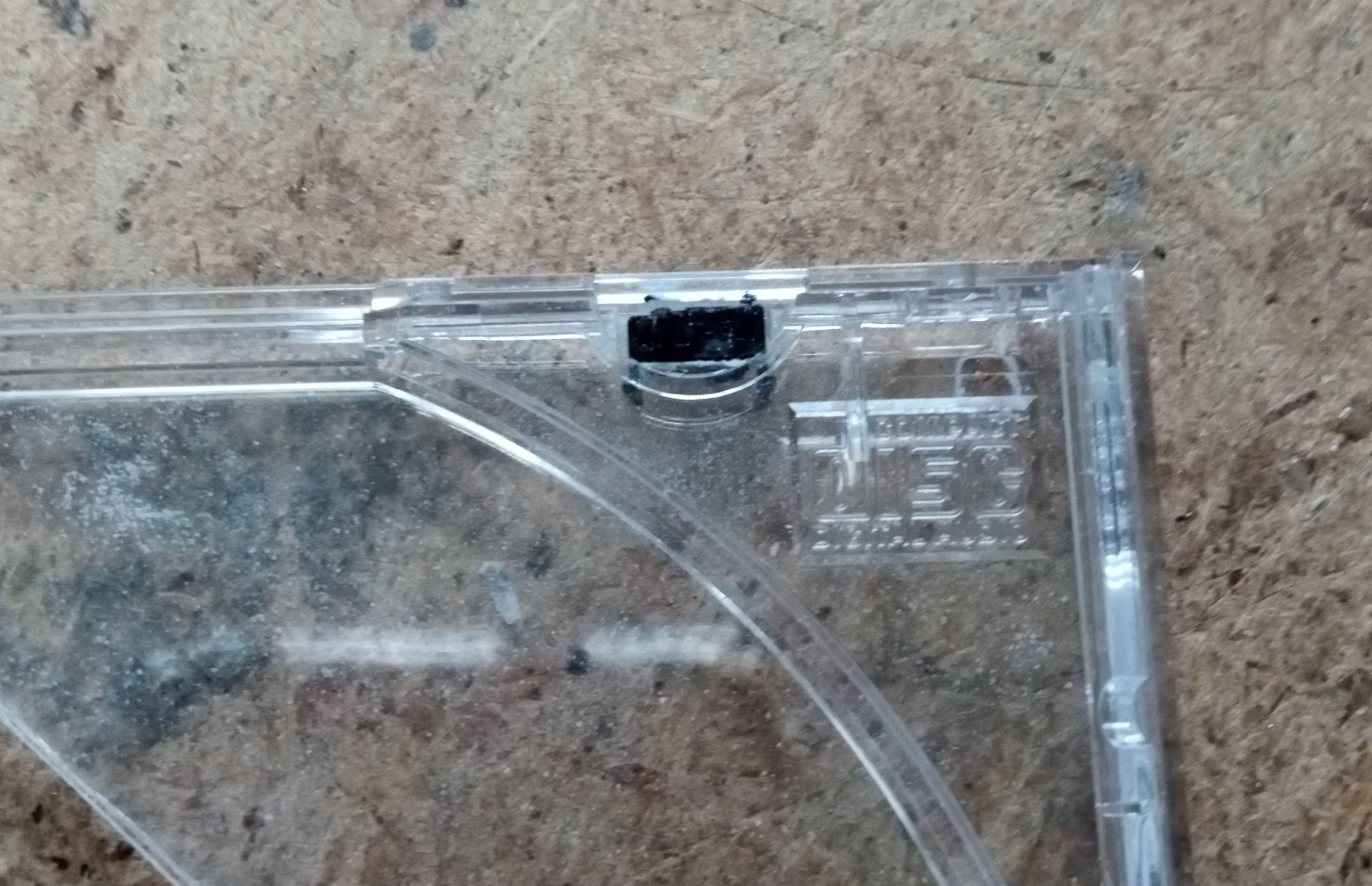

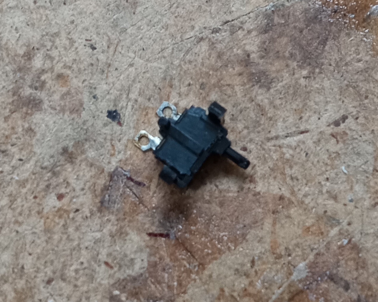

So now onto the lid switch.........but where do I get a lid switch that'll work?
Aha! This busted old PS1 DD has exactly the right kind of switch for the job!
aaaaand extracted!
with a little bit of the carving...
...and a little bit more
We get another perfect fit!
It makes use of the little tab that's normally for holding the CD's booklet!
Wiring is next to tackle...should have that done soon :)

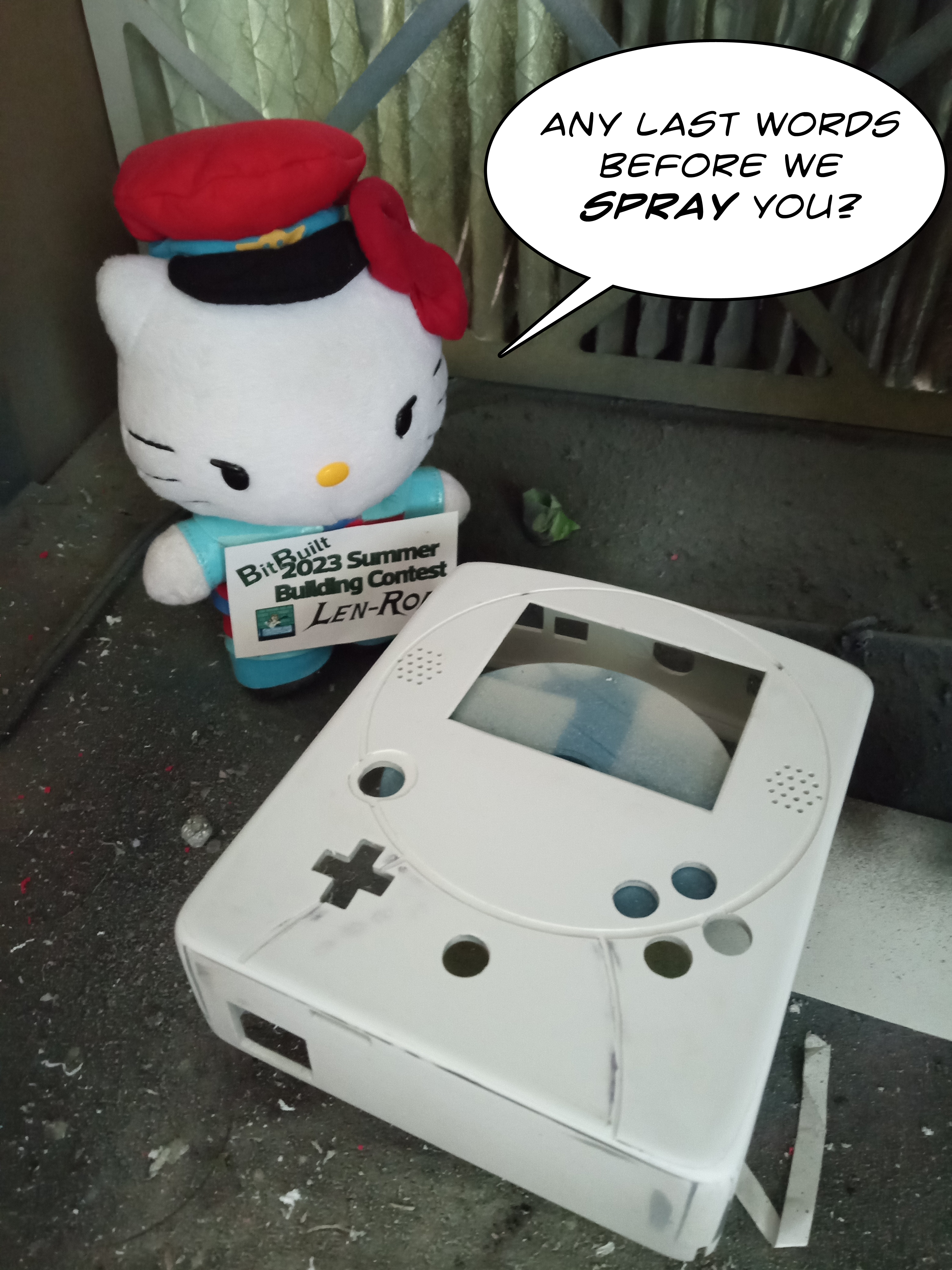

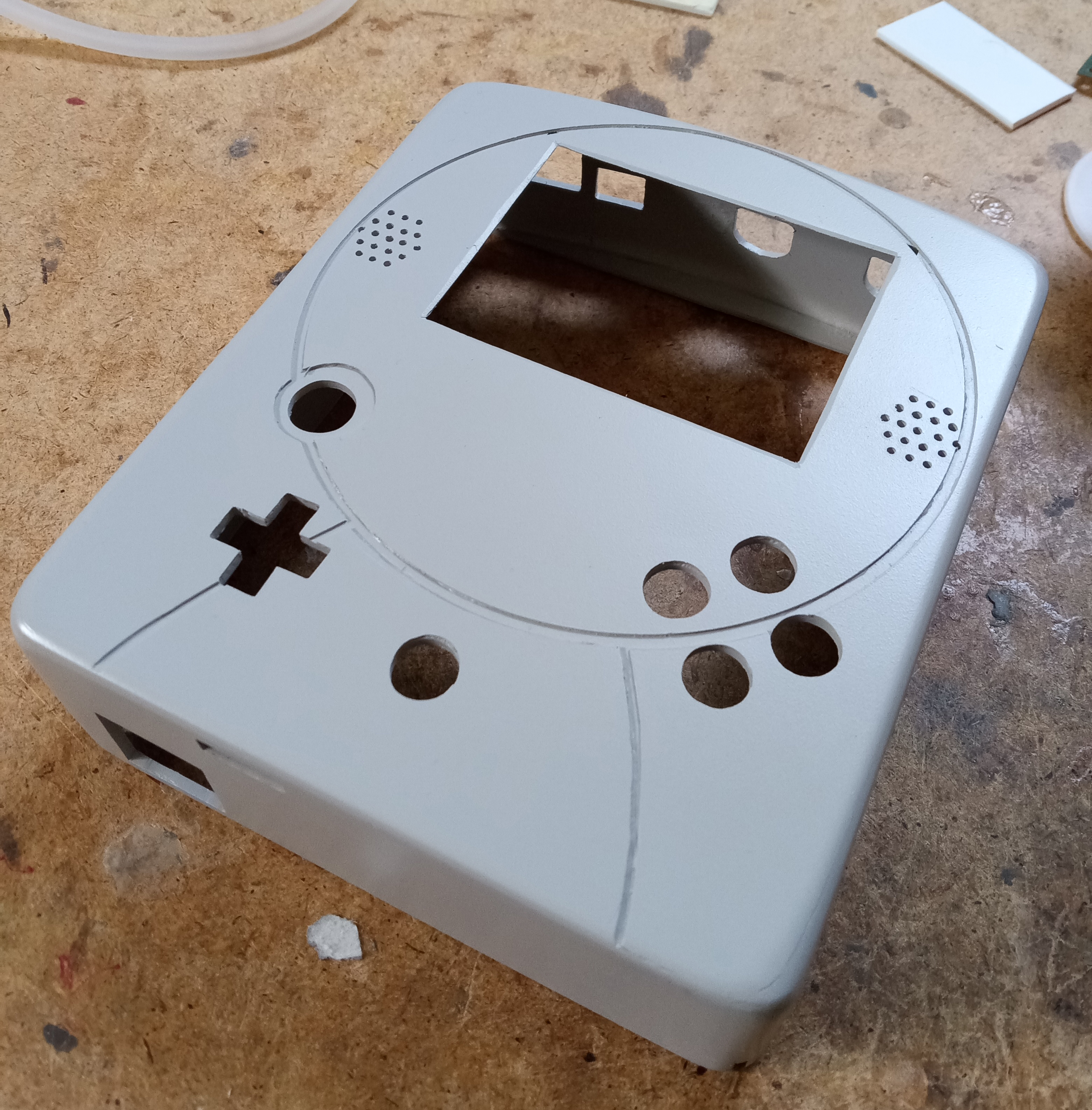

EPISODE 27: Paint it Black Gray

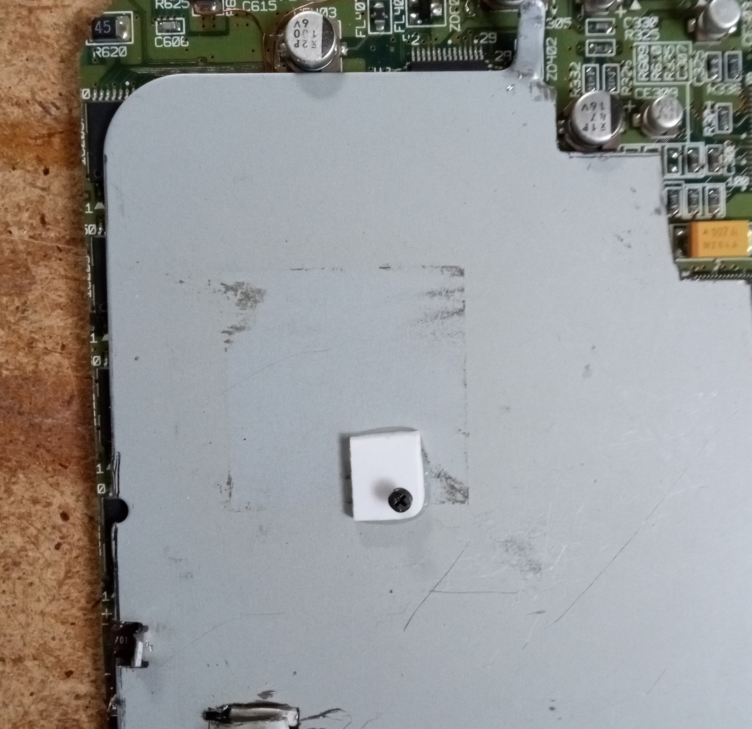

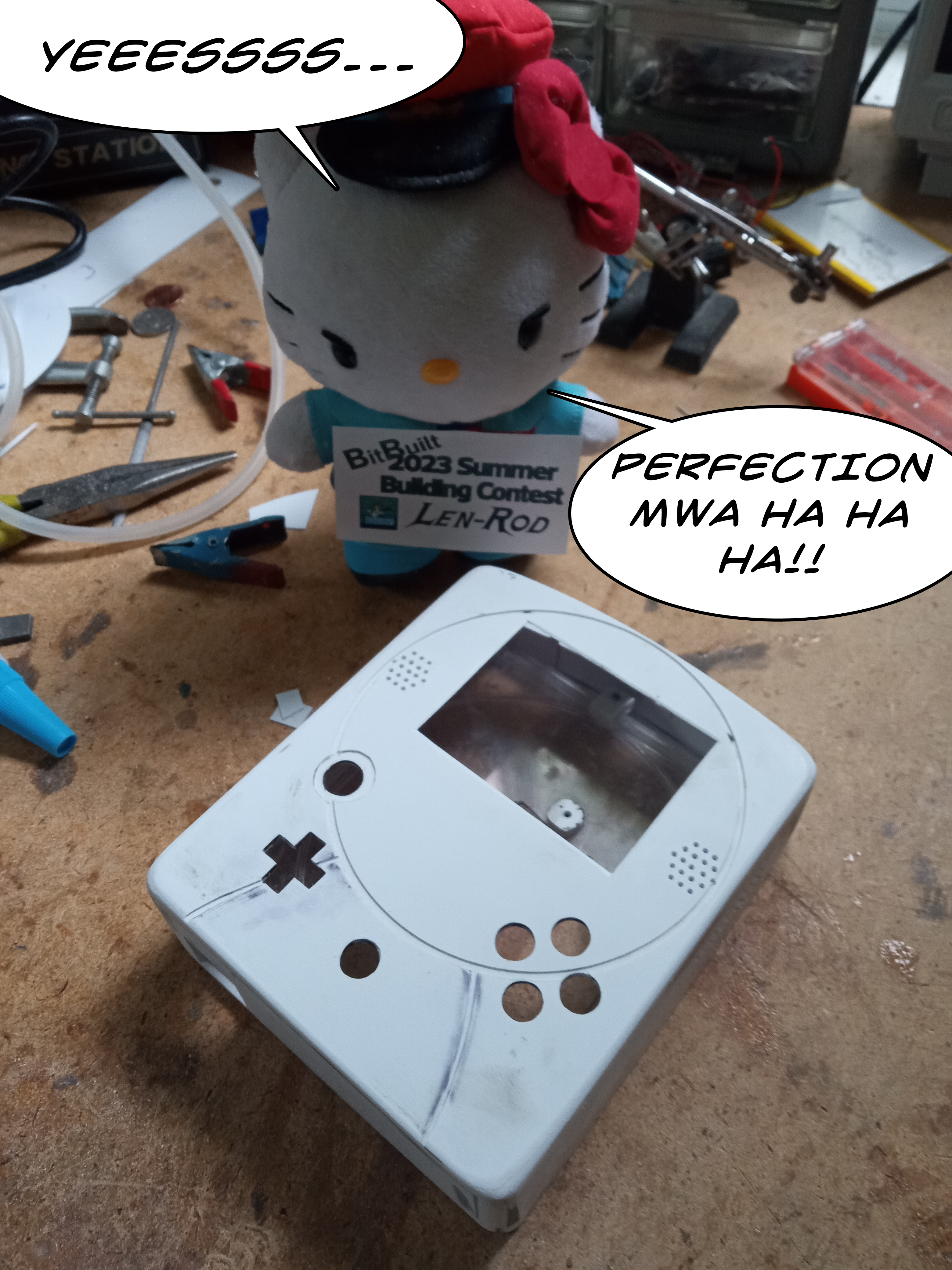

Since the paint I'm going with likes to stay tacky for a few days after spraying, I decided to go ahead and spray the shell now while I work on the rest in between...
After a good 4 coats of paint, while subtle, there is a now color difference!
Now, with that slowly drying...back to the electricals!

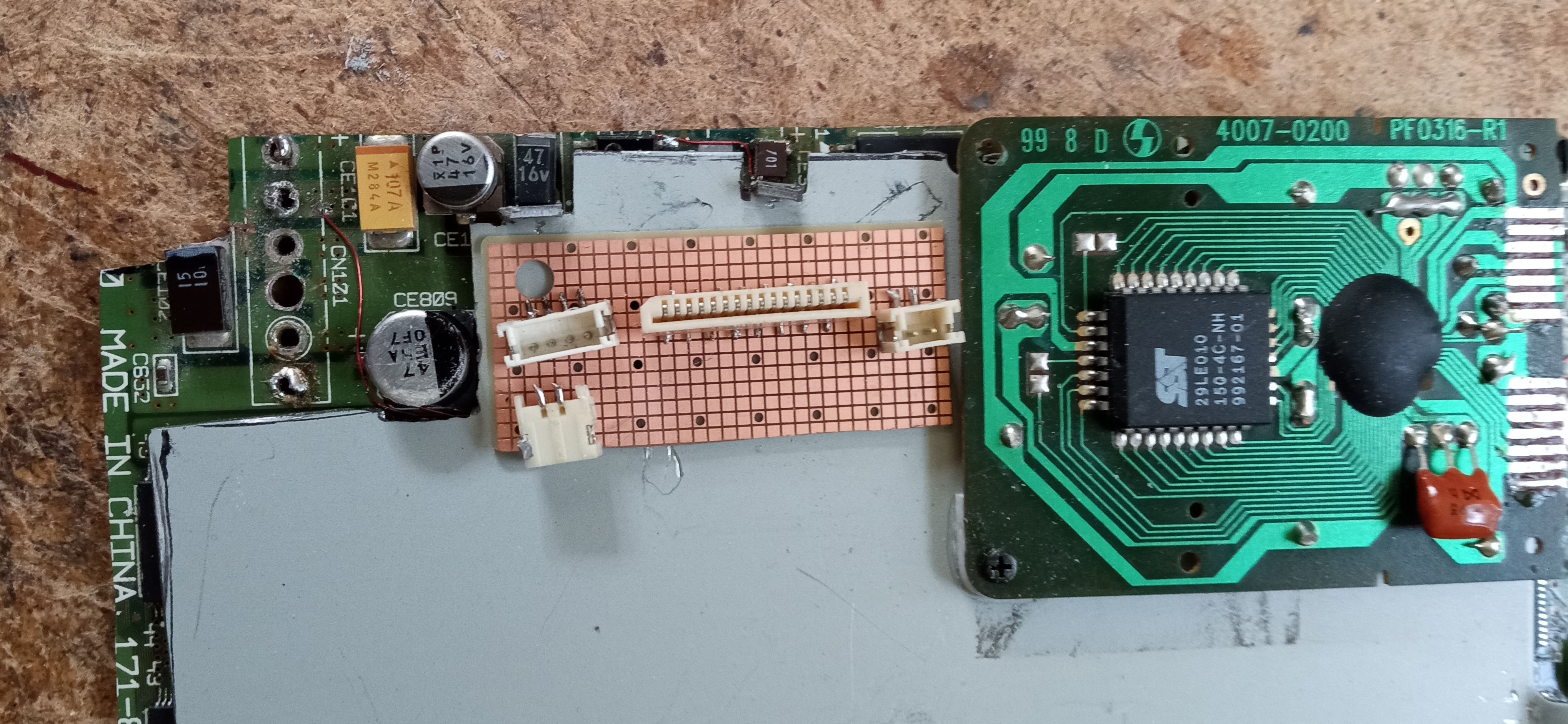

First thing I'm going to slap wiring in for will be the memory card. A bit of a pain...but with a touch of hot glue, it should remain perfectly stable :)
Then I had a thought...and decided that I need to actually mount the memory card in place to minimize the risk of the wires detaching when they feel like it...

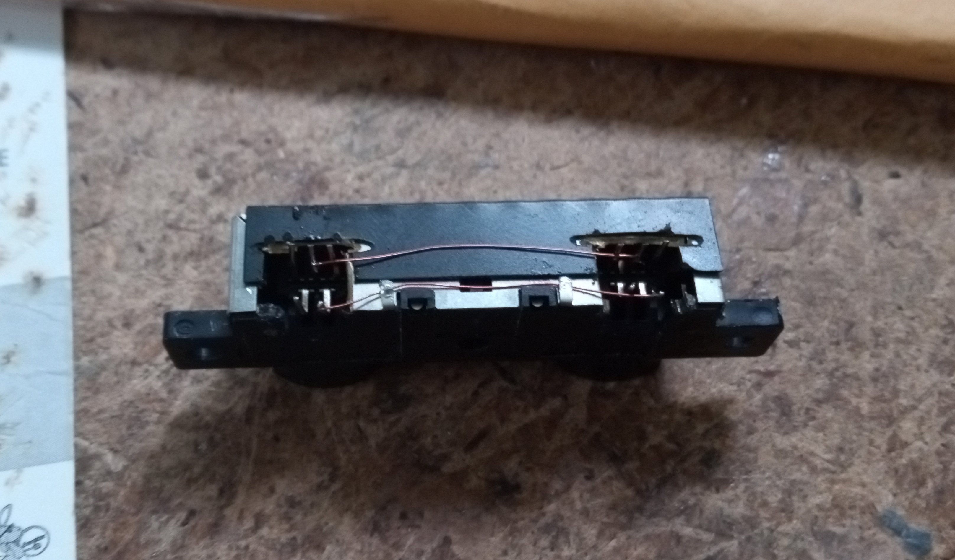

Doing this gave me another idea on how to make the wiring more stable. Initially, I was just going let the DD connectors float around, but if I were to put in something like this...
...it'd be not only be less likely to fall apart, but it'd also make installing the DD much easier! Yeah!

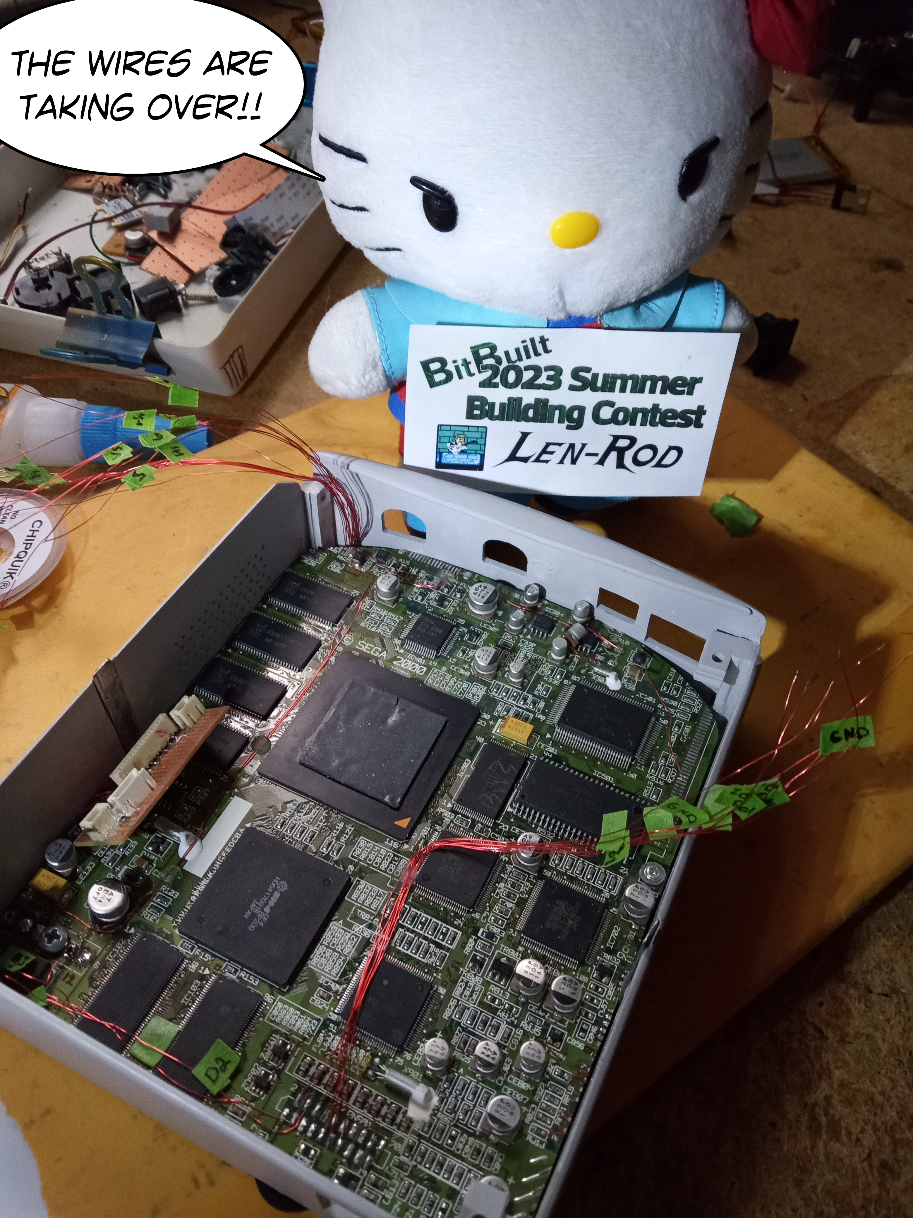

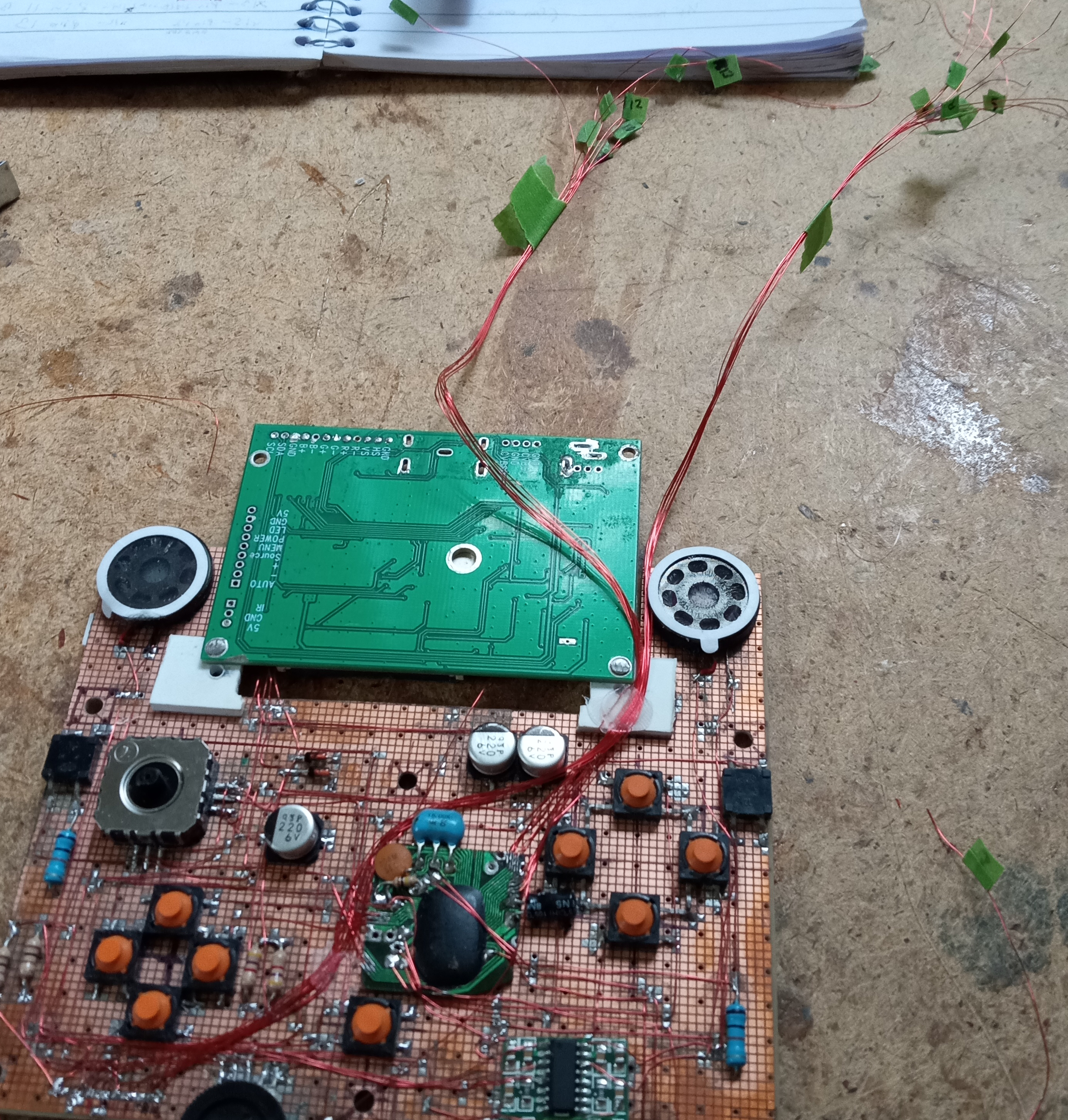

EPISODE 28: The Wires are Nigh!
Countdown continues...and the completion is ever nearer.

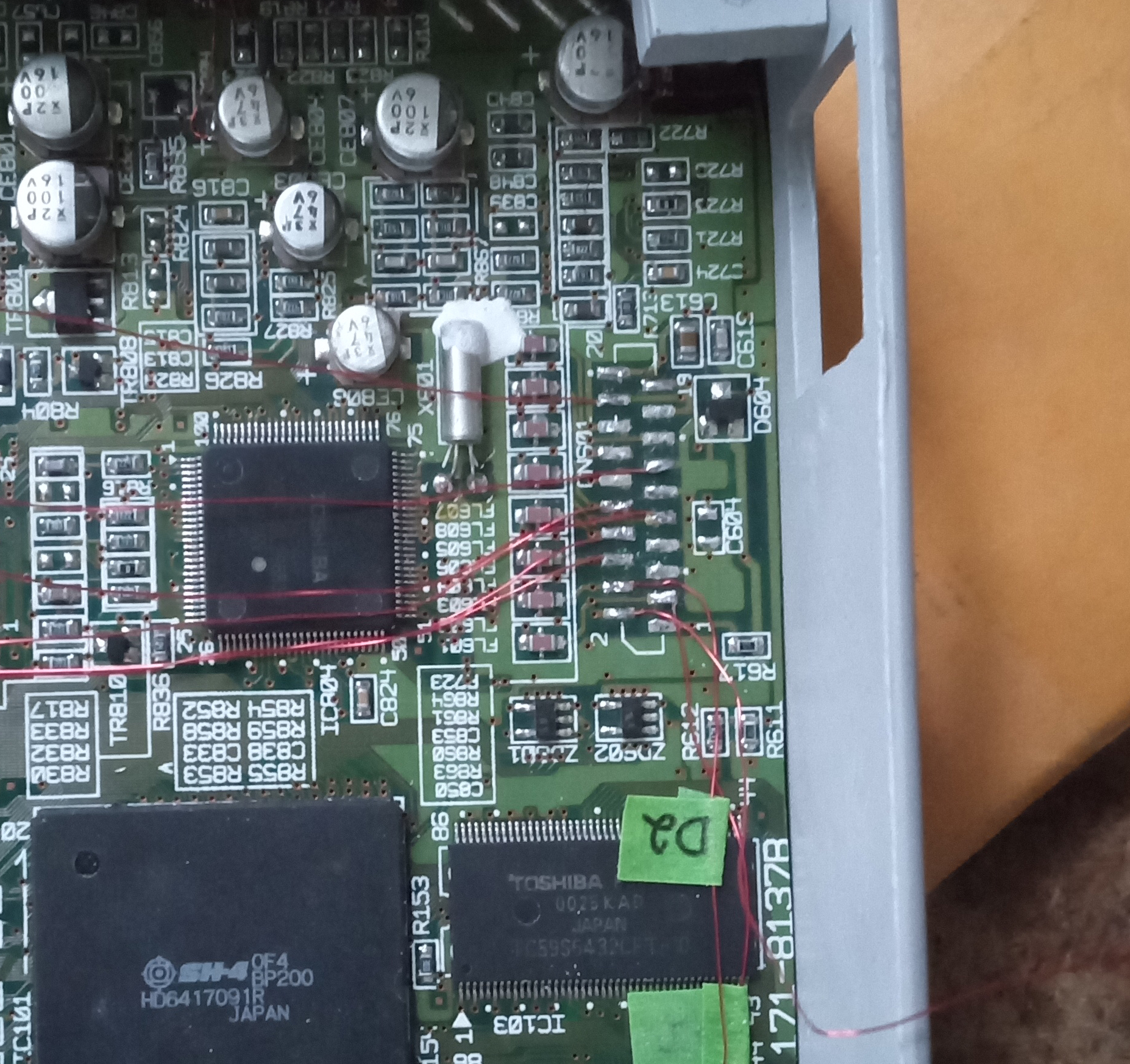

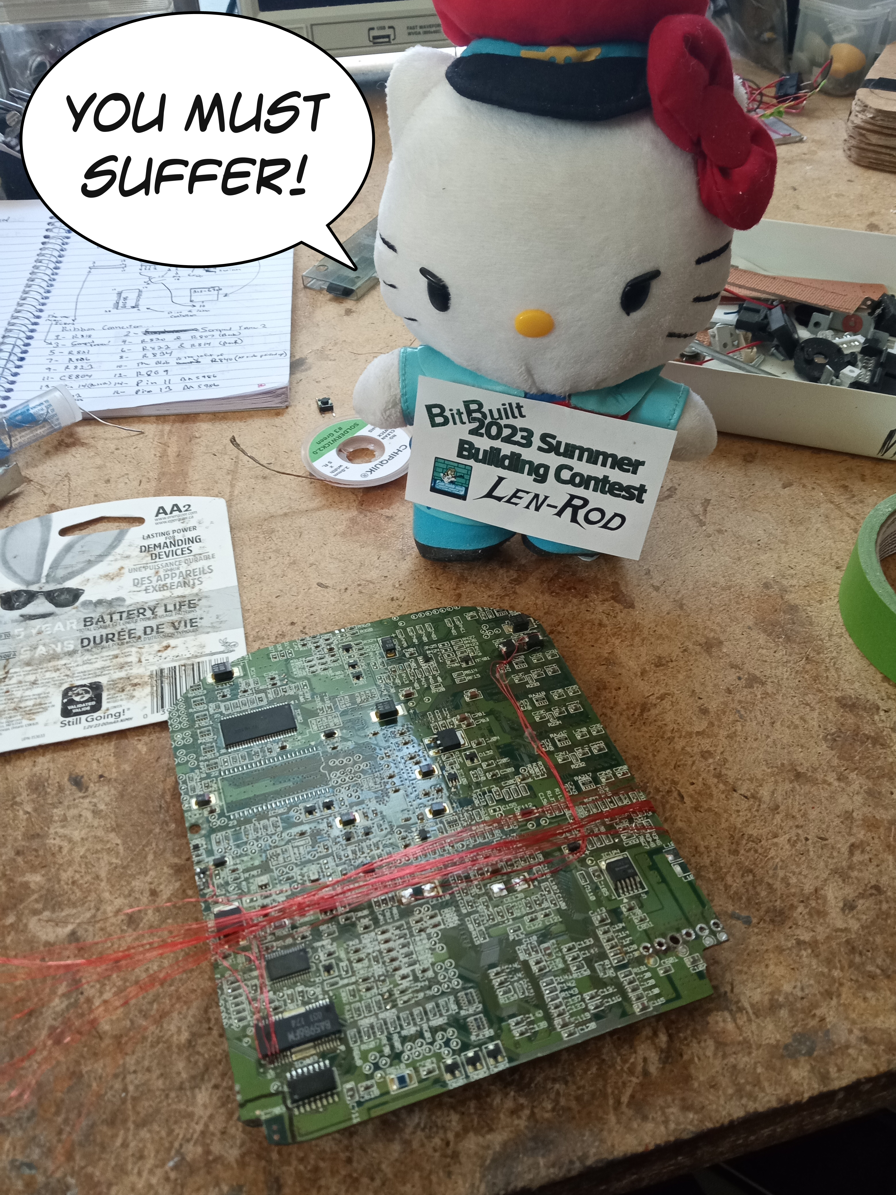

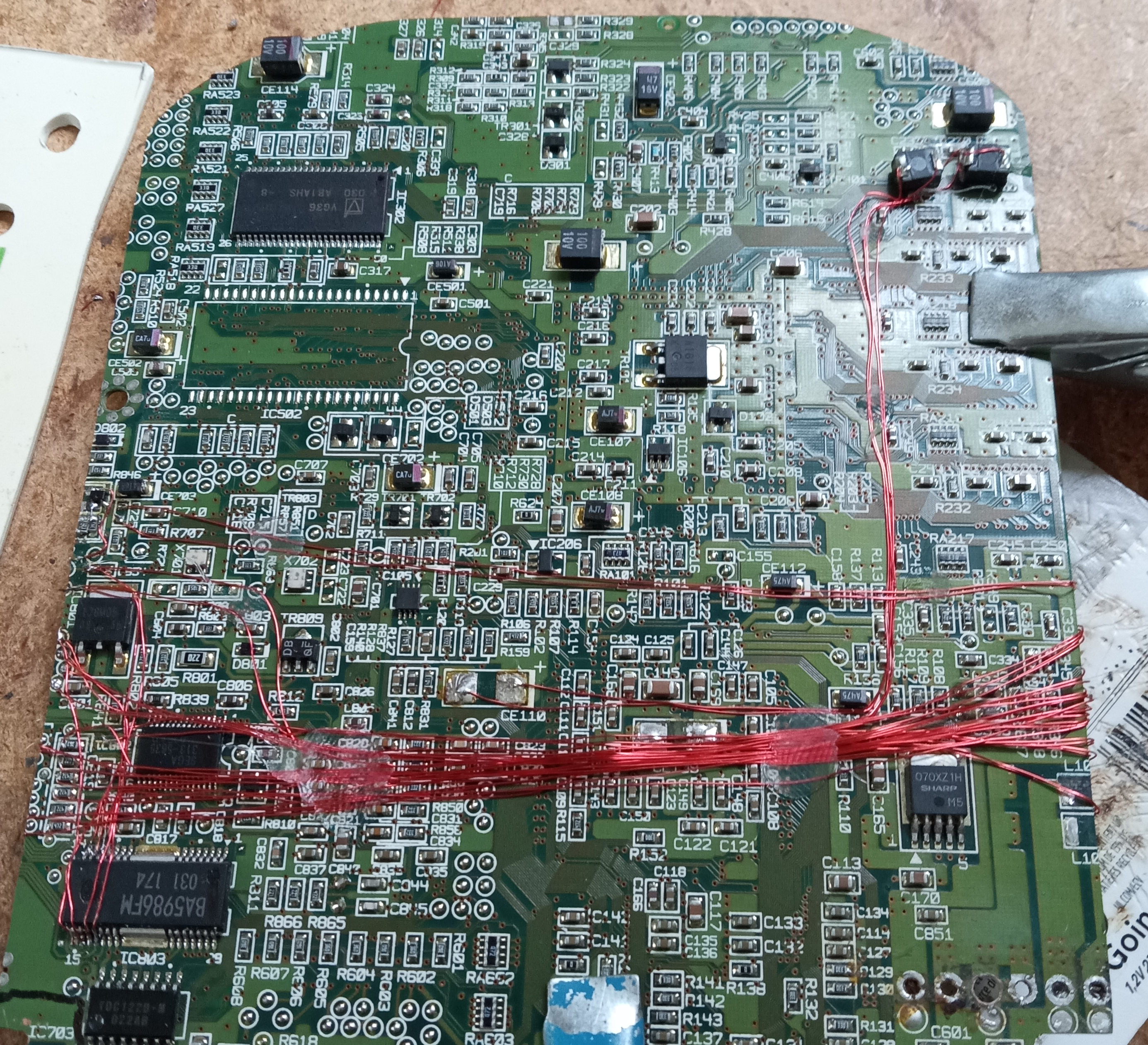

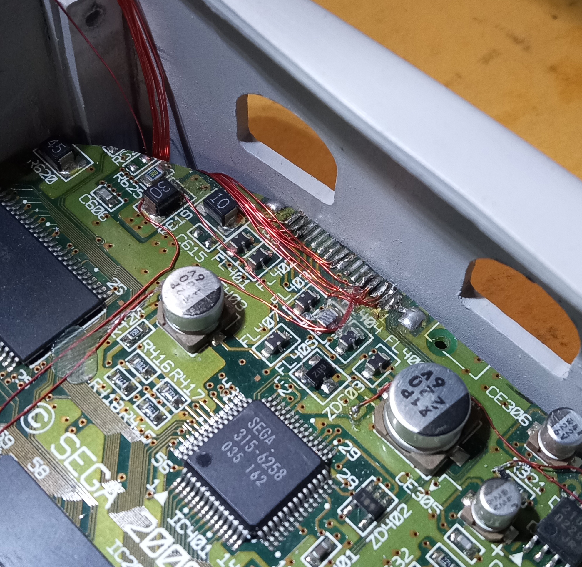

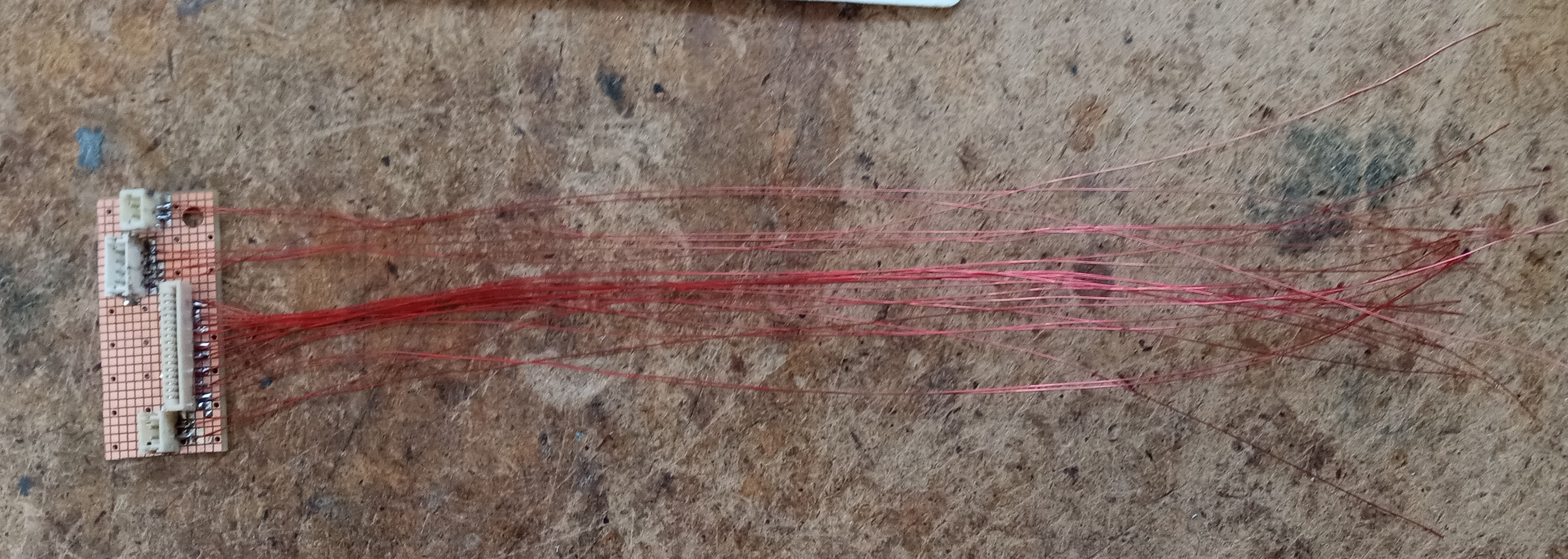

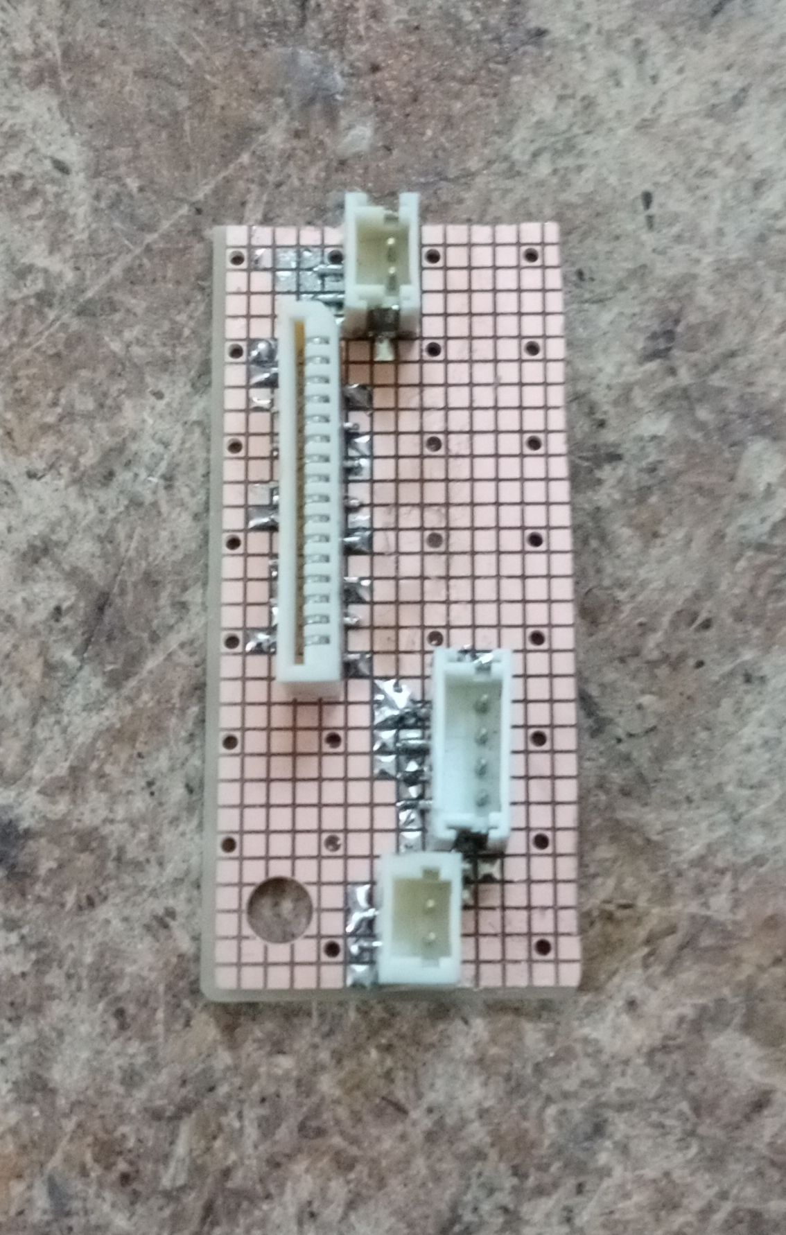

next item on the list is to get all those little wires finished up....

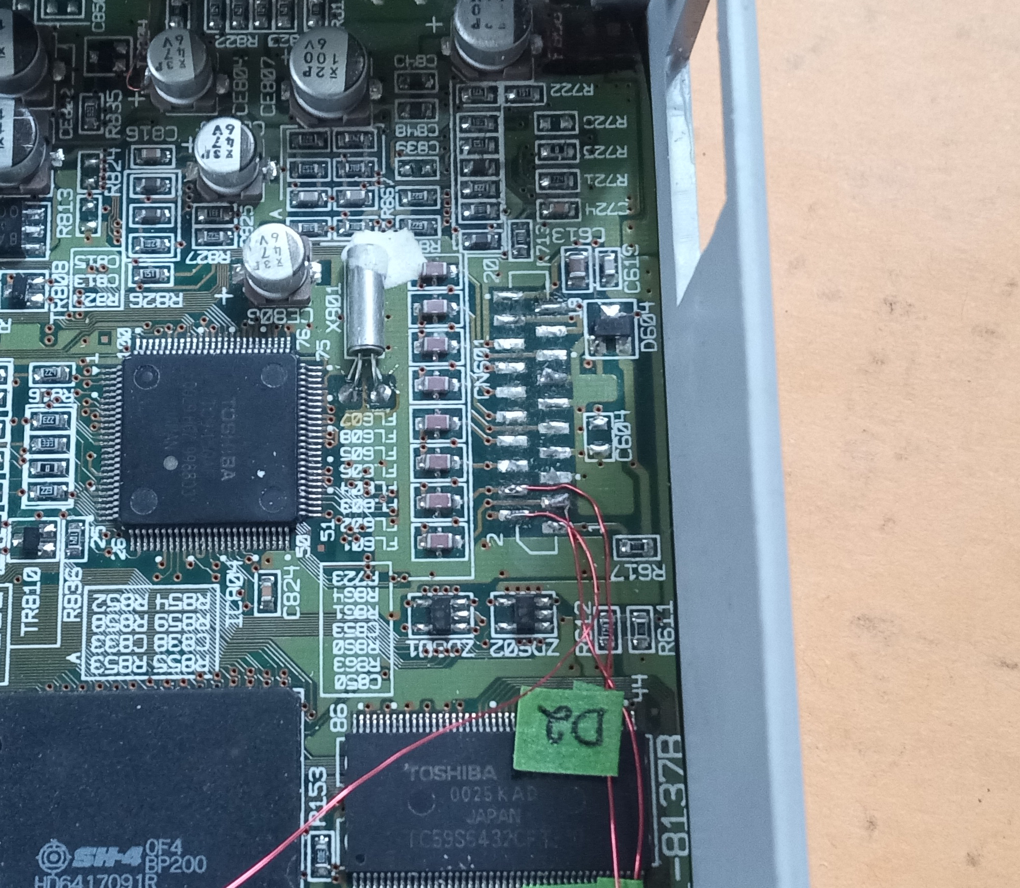

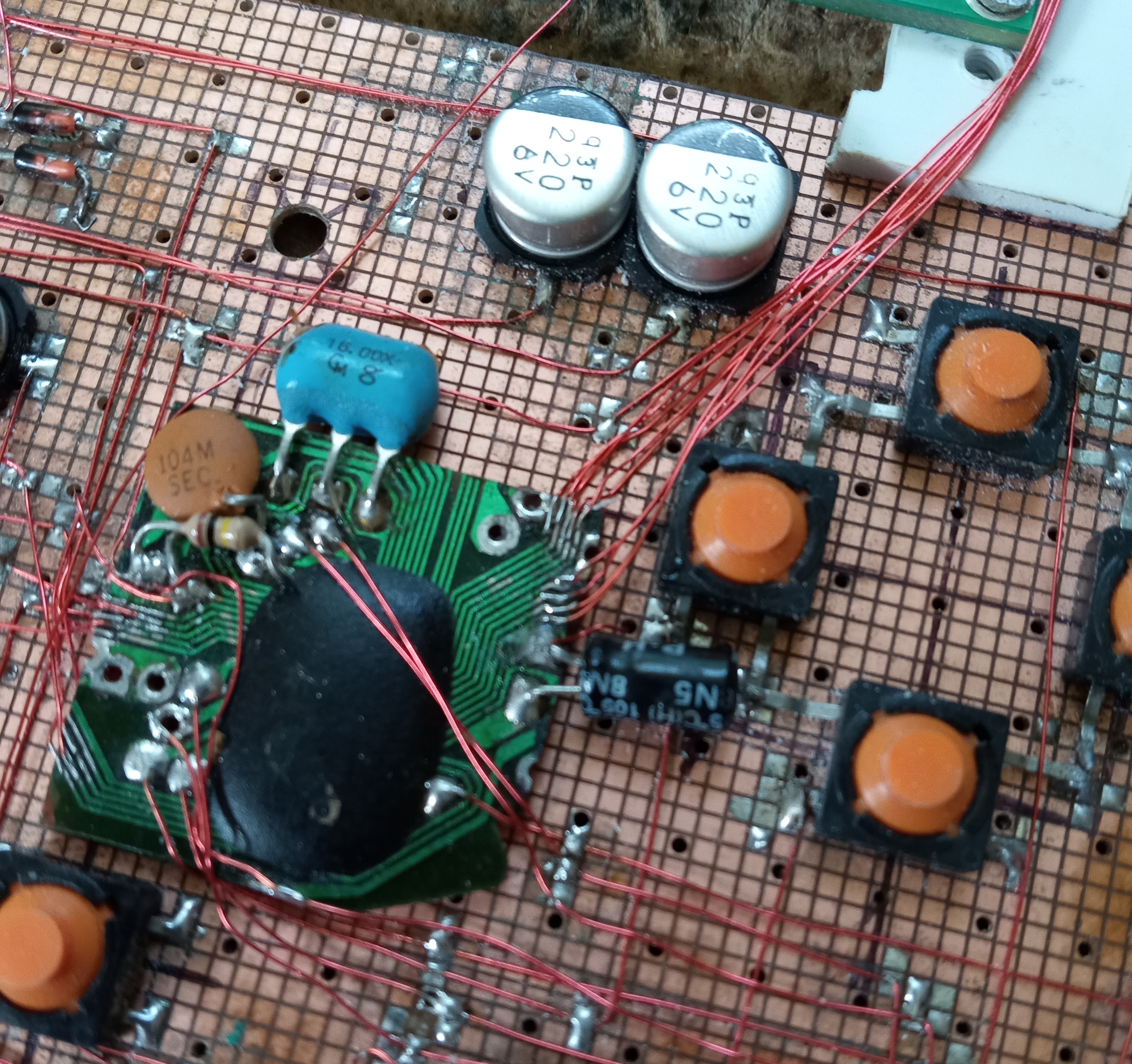

First thing is to get that little board soldered up...
Then we create a tentacle pr0n monster!
Now for the final bit of horrible teeny soldering on this side of the board...
There we go! All wiring in place and fixed into position! Also relocated a couple of caps that were in the way lol.
Last thing for the day is to finish up the rest of the wiring on the controller/AV board...all hooked up, flagged and ready for installation!

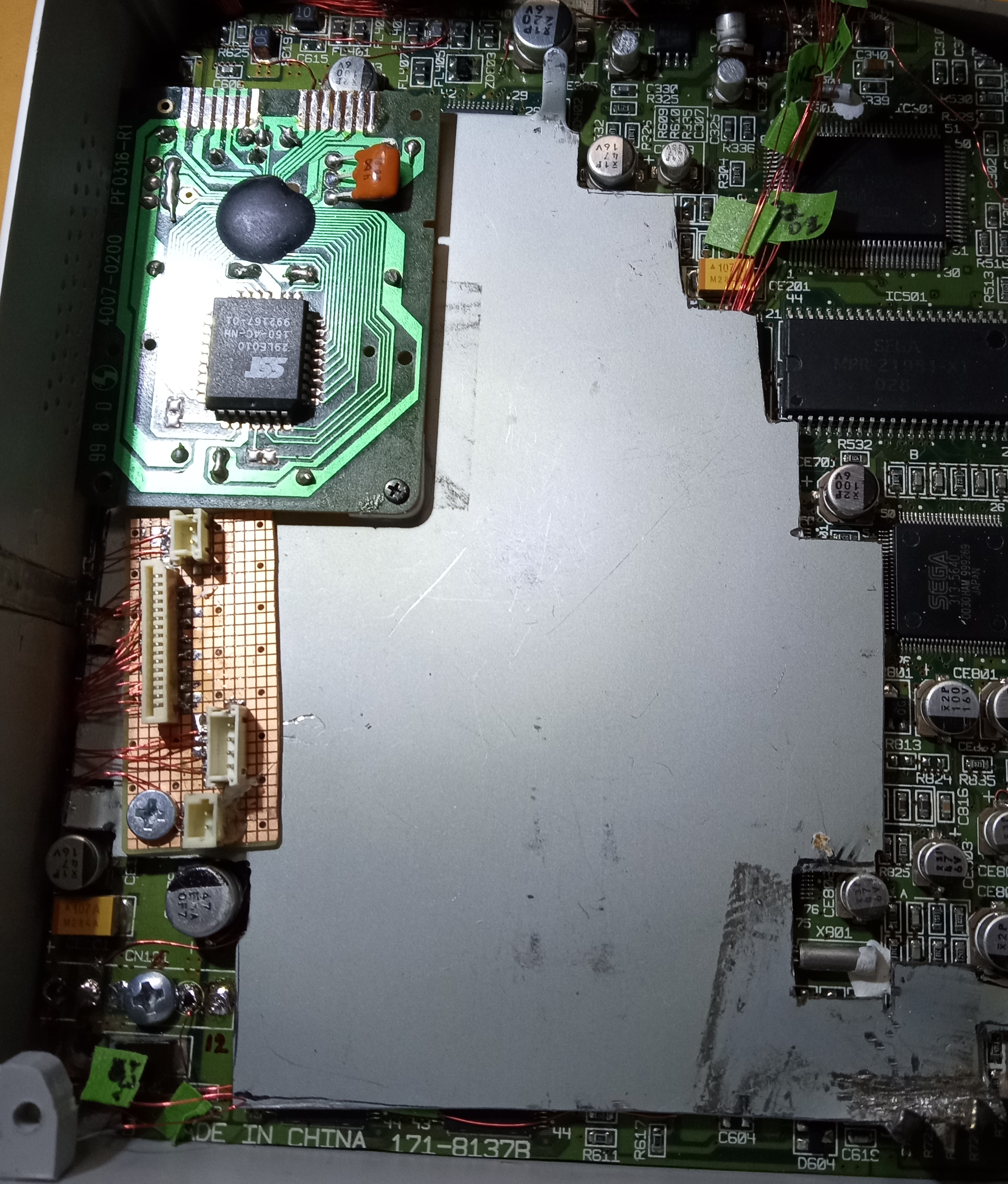

We're almost there! Now all that remains is to set up the wires for the P2/3 ports and stuff on the DC mobo...then assembly can begin!
With the wiring nearly complete, will our hero find the time to pull it off on time or is disaster lurking in the future? Stay tuned for the next nail-biting episode of Dream Xtreme!

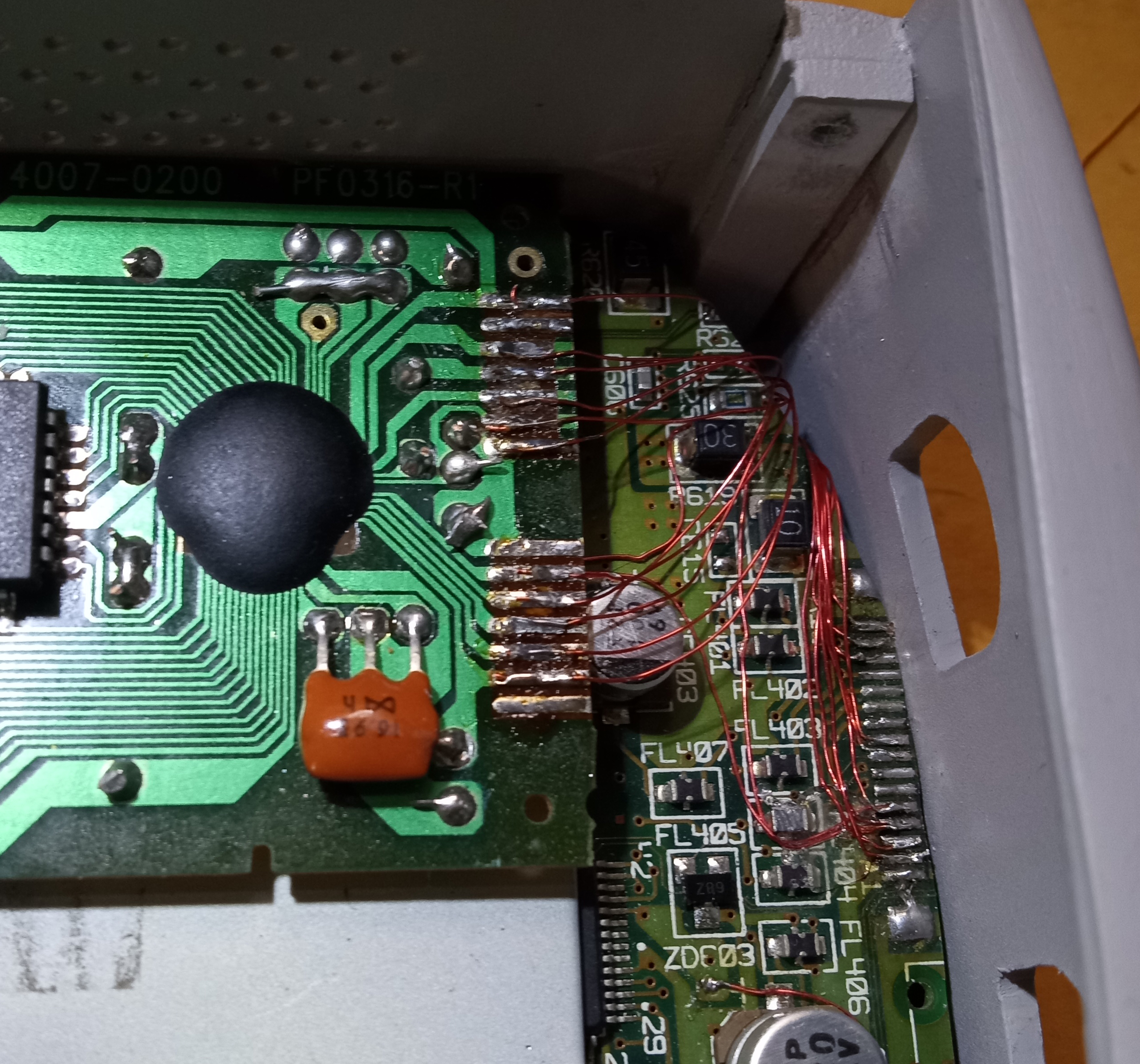

EPISODE 29: The Final Countdown!
The moment of truth is drawing ever nearer!

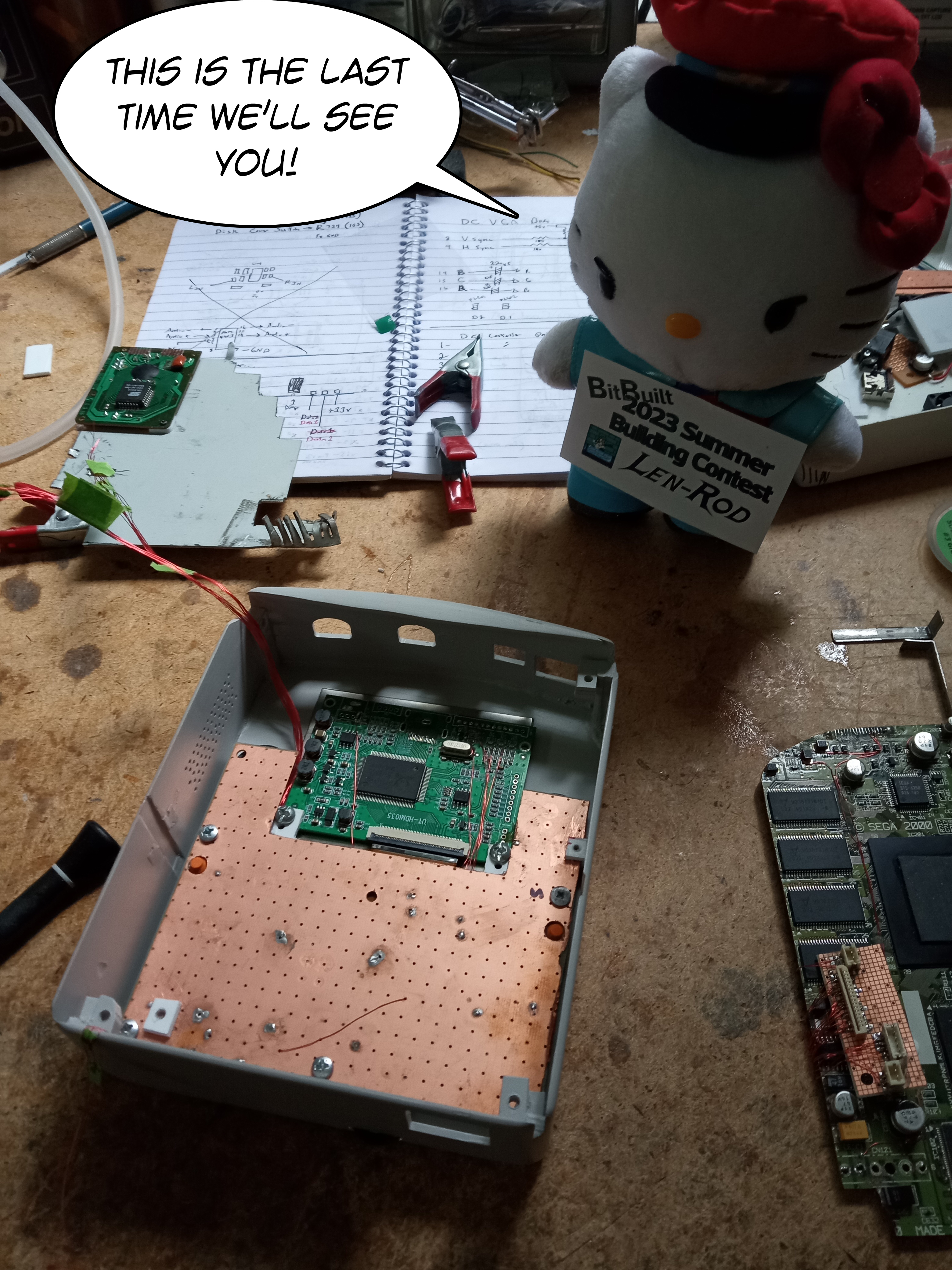

So for today, we get the controller and AV and what not all hooked up!
First, the board is hooked in...for hopefully the last time!
Then we get it hooked to the Dreamcast's Mobo...
After that, we get all the other controller's wires in place!
Of course we gotta make sure that the power and grounds are connected!
Everything flagged and good to go!
Now for the Audio and Video connections! It wasn't as much of a headache as I had anticipated, tho it still took way too long to do lol.

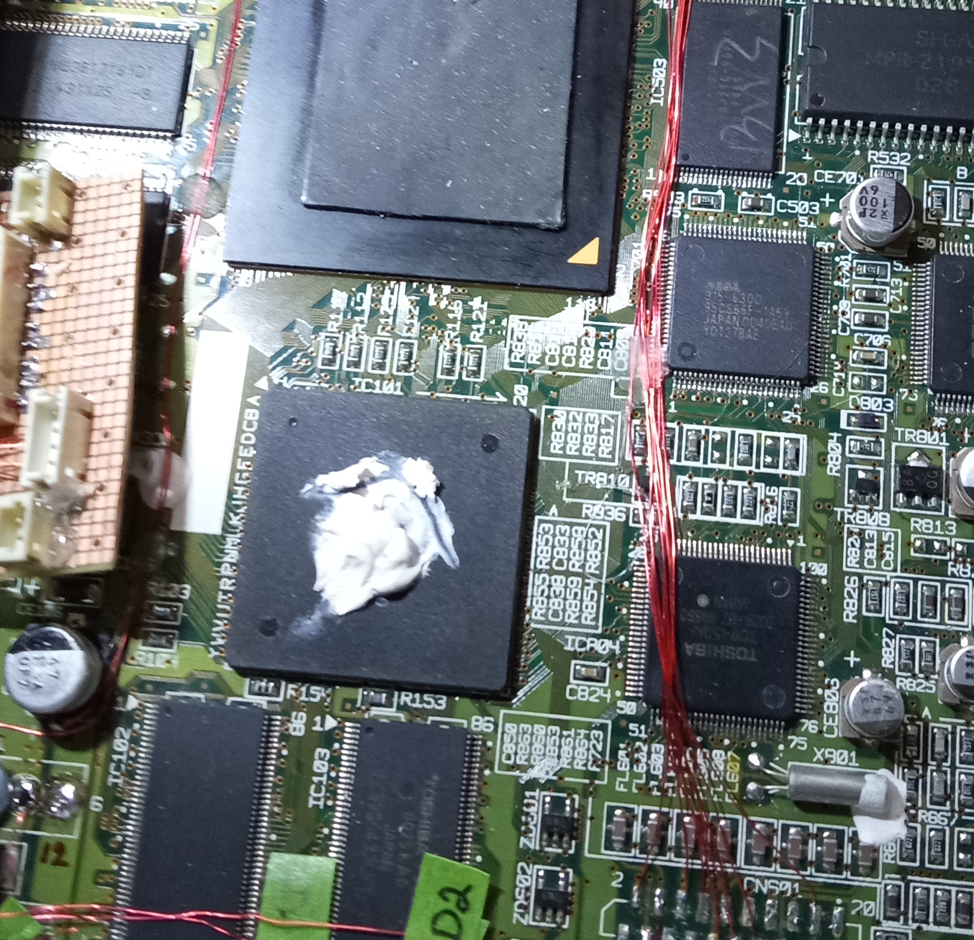

Next, a little goober of thermal paste before we attach the heat sink!
Fit looks darn good, I'd say!
Now with the heat sink in place, we get our memory card hooked up as well!
Ugh...ran out of time again...but we're on the fast track to finishing! All that remains is hooking up the P2/3 ports and getting the power supply installed..then, it's the moment of truth!

After much not sleeping, I made an attempt to get this beast running somehow. Unfortunately, the damage went deeper than expected as the laser is also cooked. There's also a slight chance that the laser controller is done for, too.
Sadly, I don't think it's possible to get a replacement laser within 24 hours so all hope for finishing this on time is lost.
