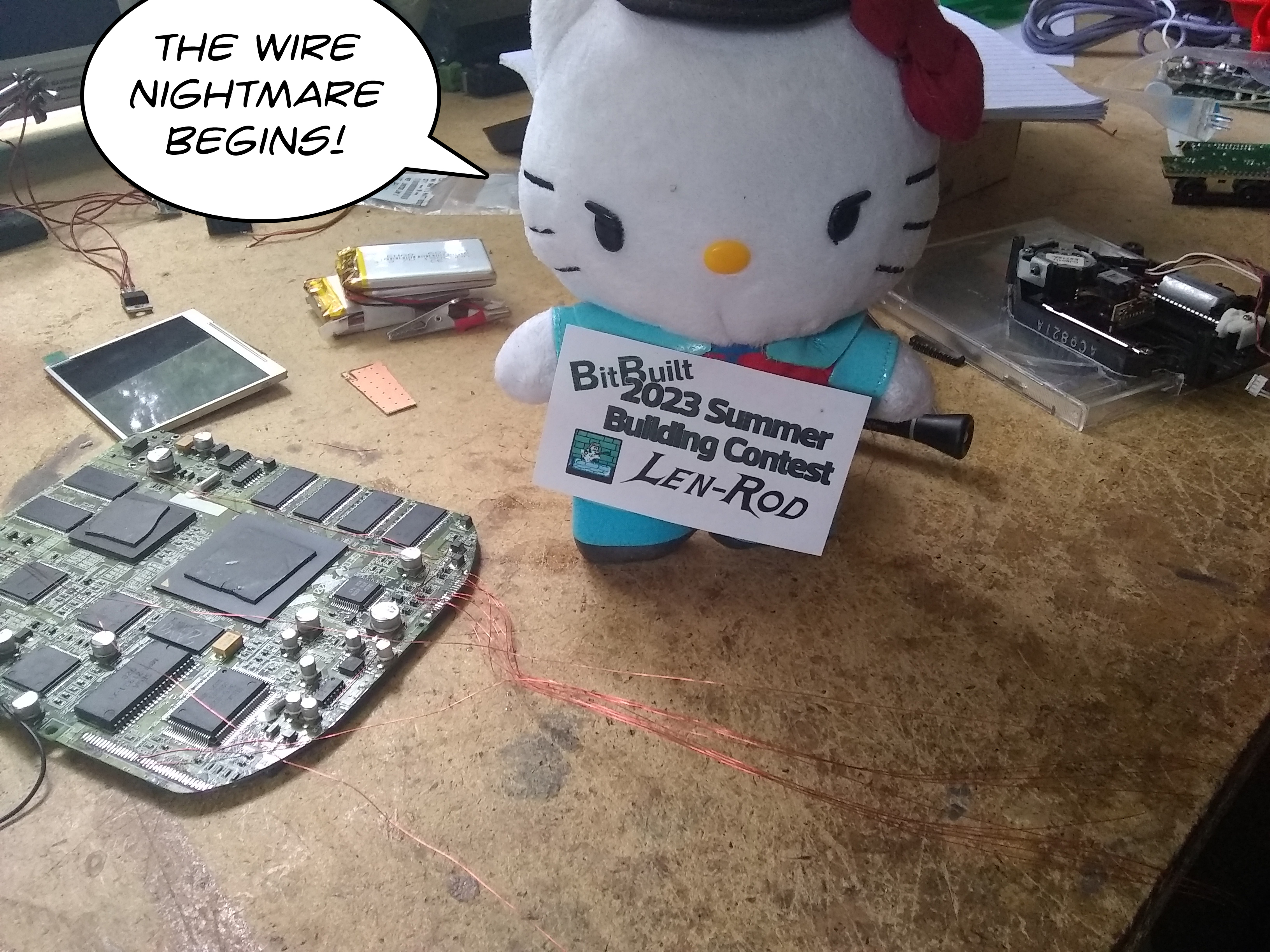

EPISODE 28: The Wires are Nigh!​
Countdown continues...and the completion is ever nearer.

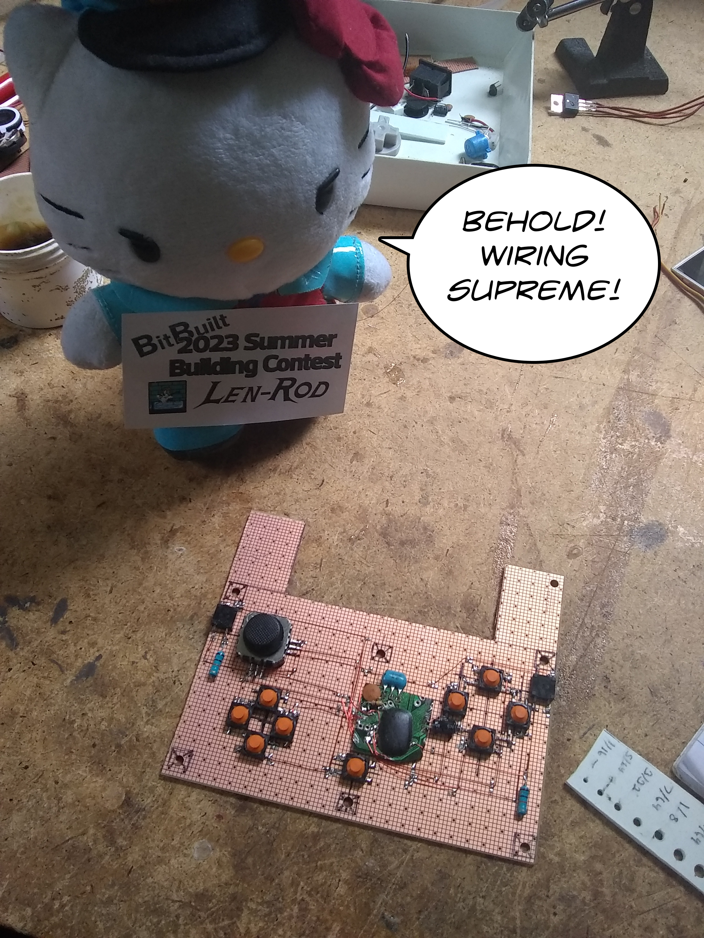

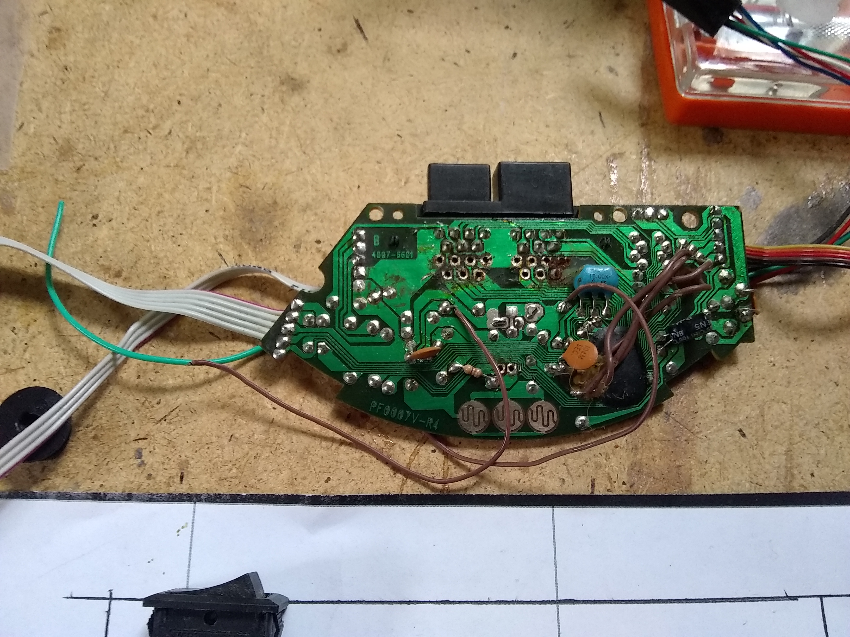

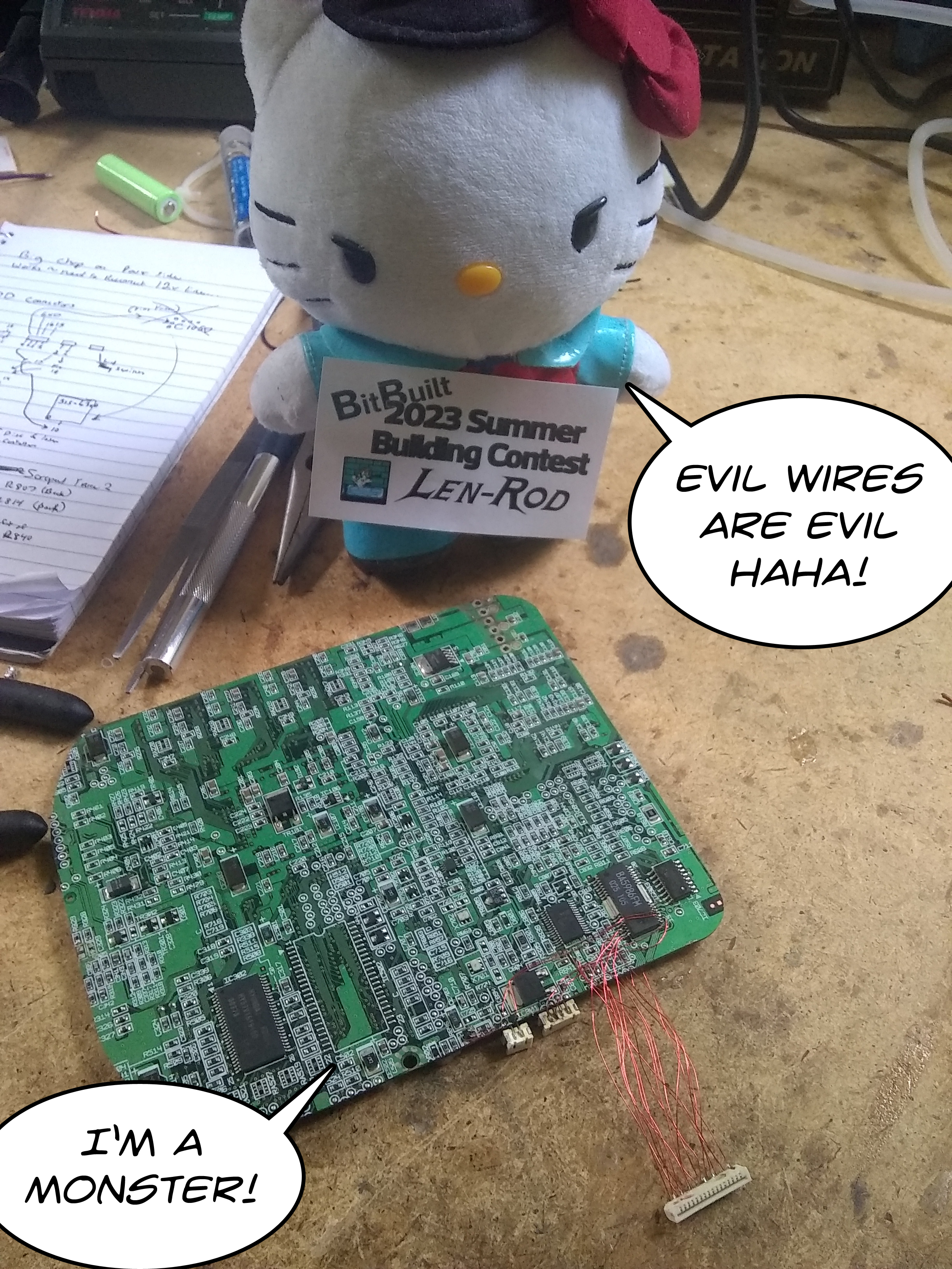

next item on the list is to get all those little wires finished up....

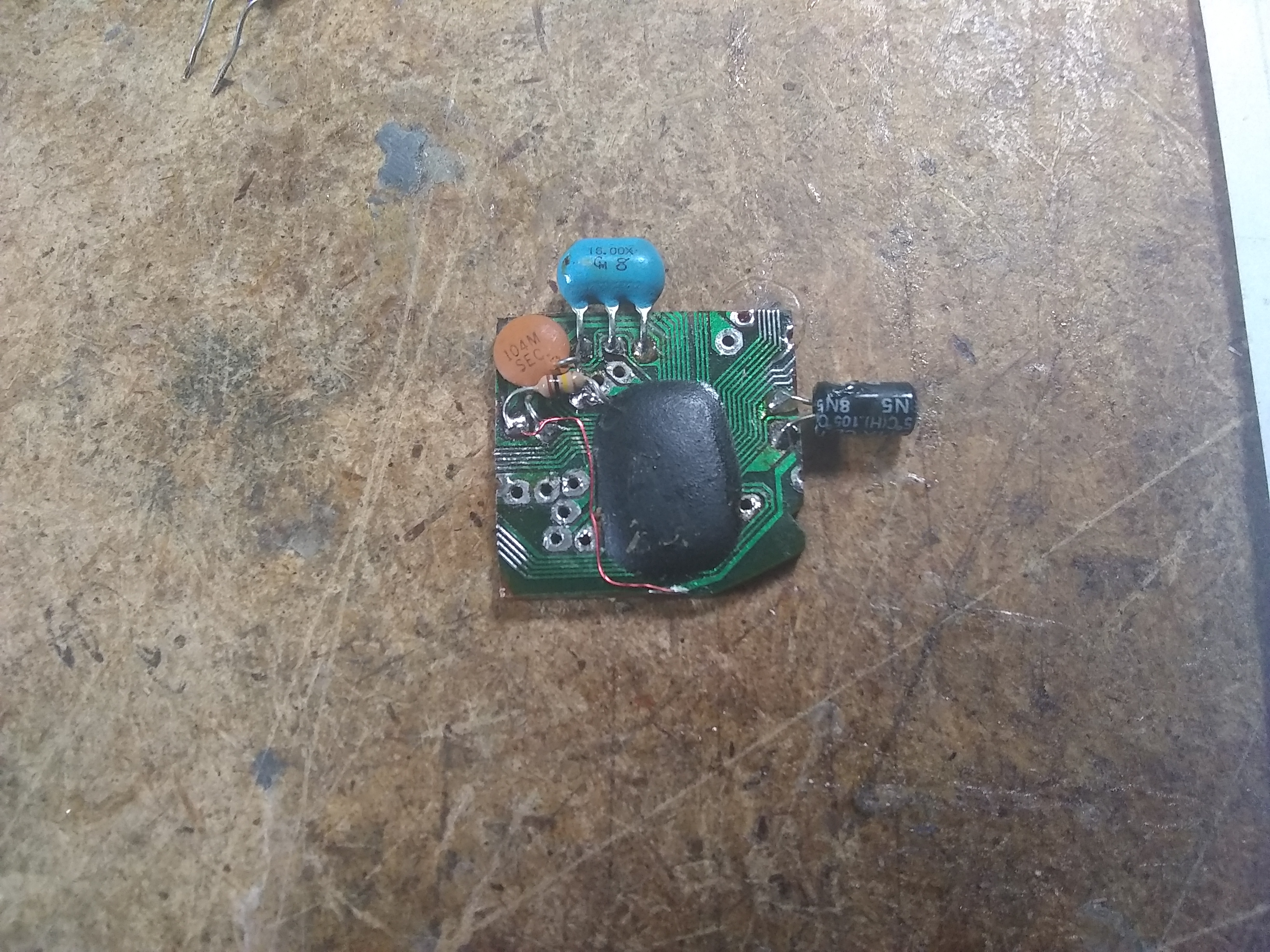

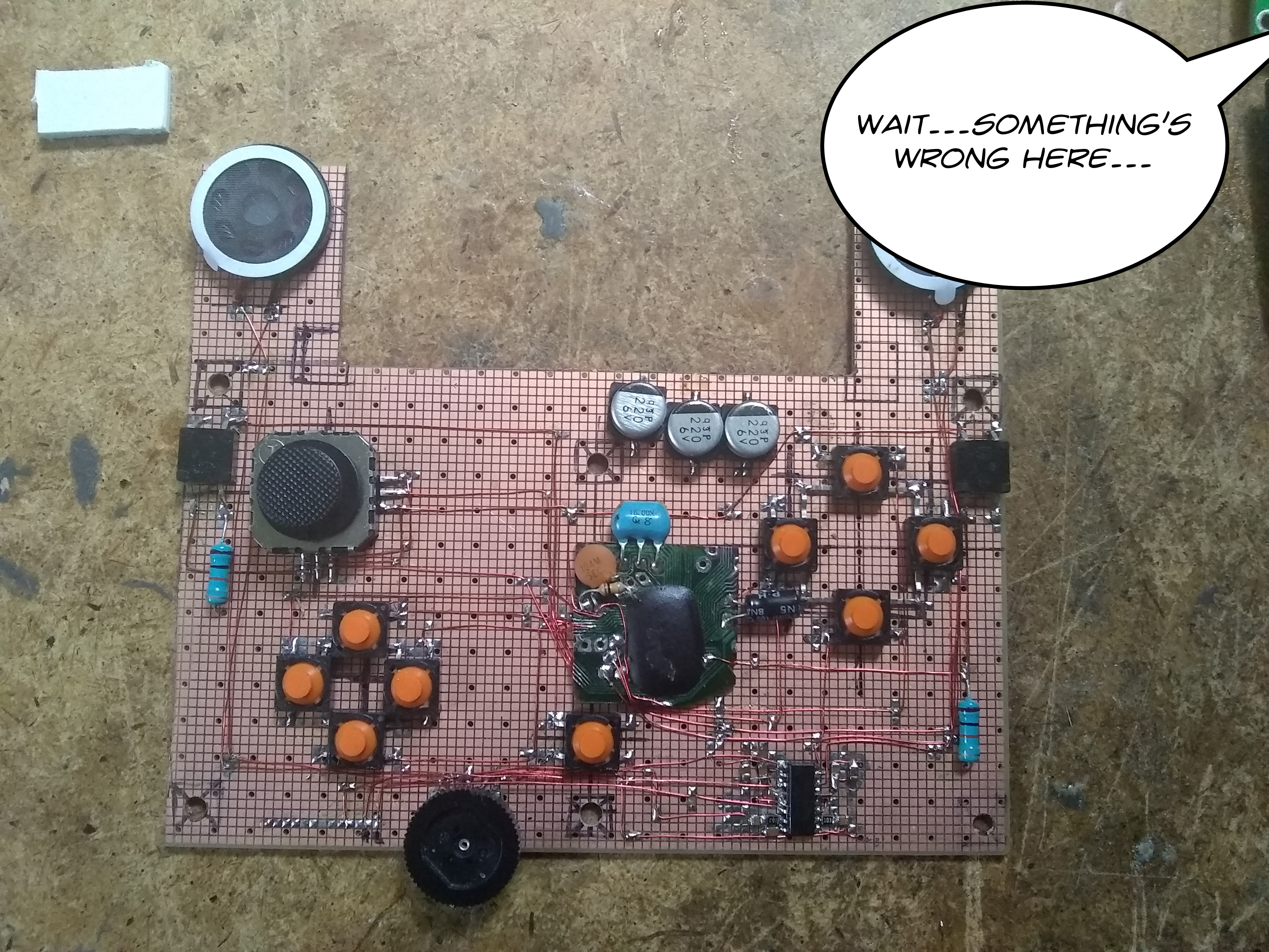

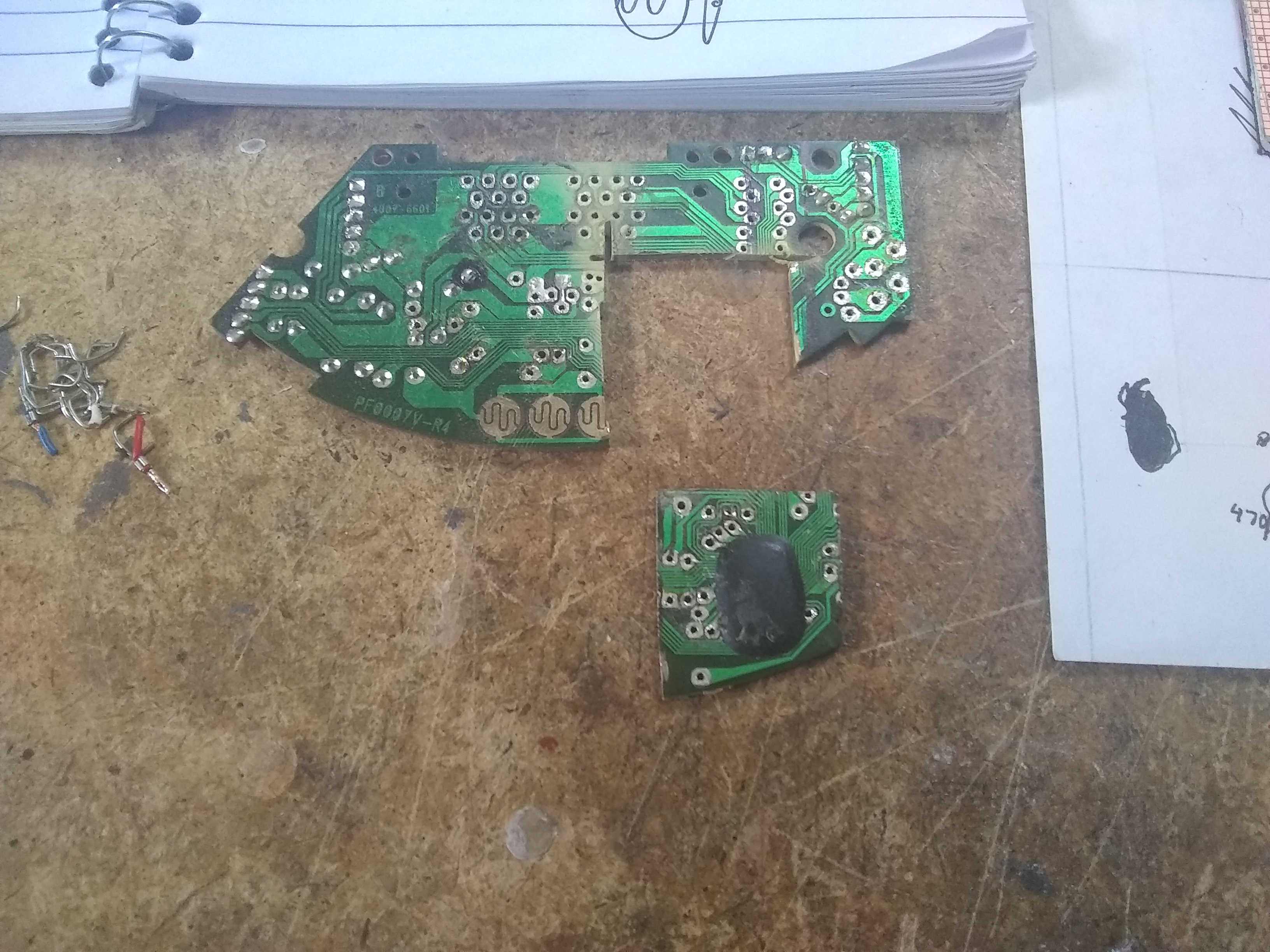

First thing is to get that little board soldered up...
Then we create a tentacle pr0n monster!
Now for the final bit of horrible teeny soldering on this side of the board...
There we go! All wiring in place and fixed into position! Also relocated a couple of caps that were in the way lol.
Last thing for the day is to finish up the rest of the wiring on the controller/AV board...all hooked up, flagged and ready for installation!
We're almost there! Now all that remains is to set up the wires for the P2/3 ports and stuff on the DC mobo...then assembly can begin!
With the wiring nearly complete, will our hero find the time to pull it off on time or is disaster lurking in the future? Stay tuned for the next nail-biting episode of Dream Xtreme!

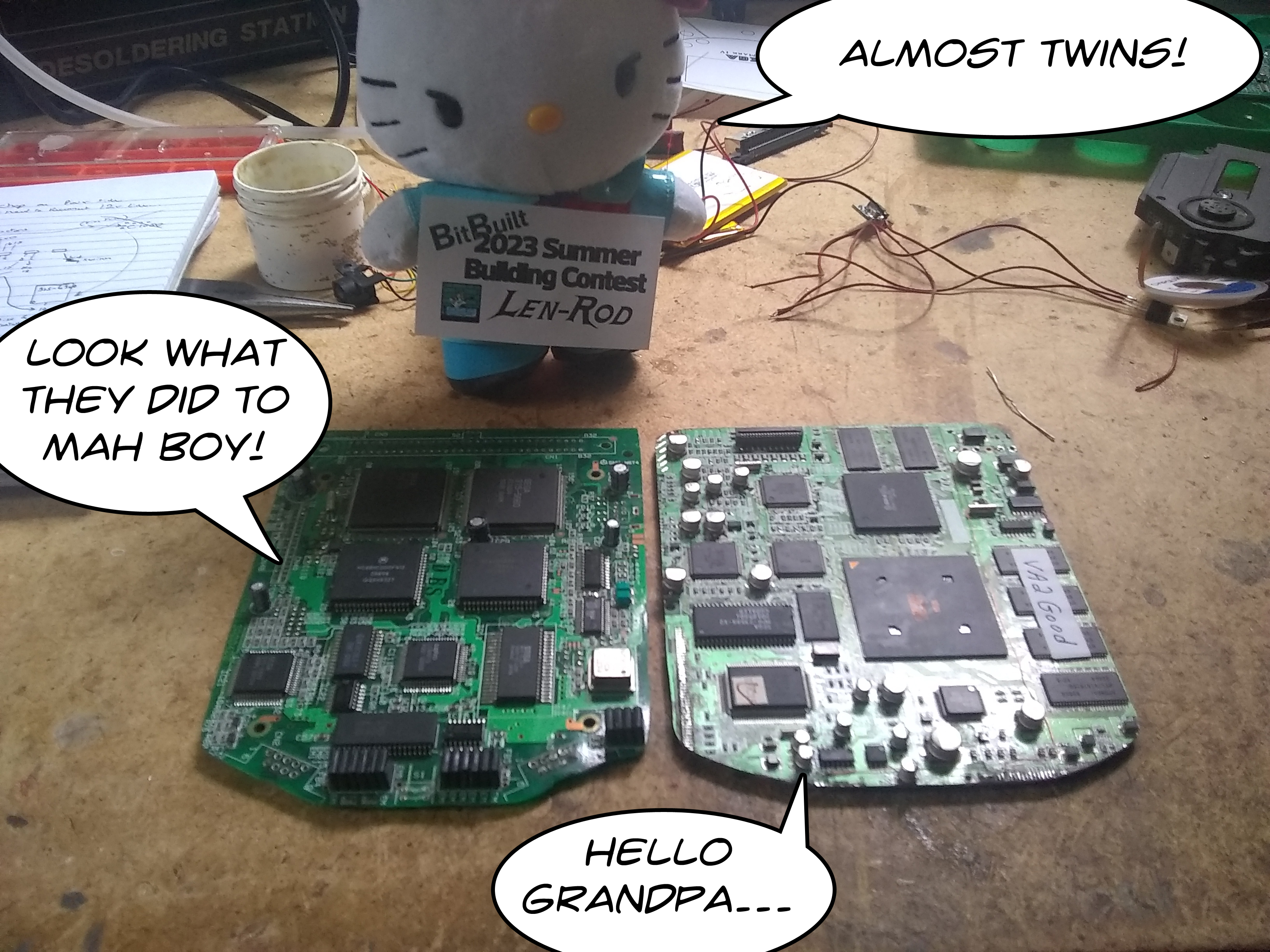

The moment of truth is drawing ever nearer!

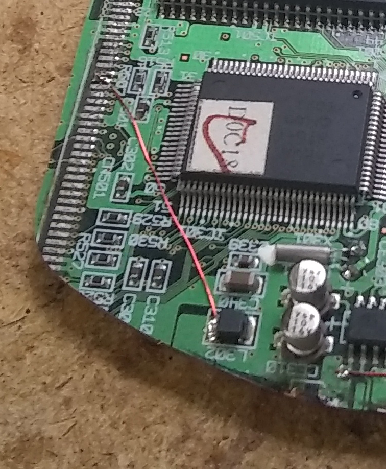

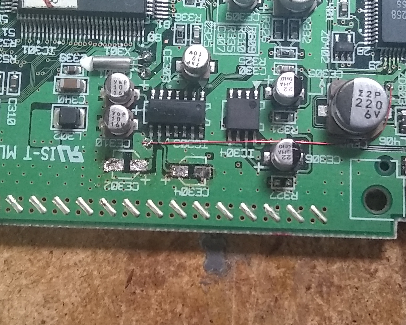

So for today, we get the controller and AV and what not all hooked up!
First, the board is hooked in...for hopefully the last time!
Then we get it hooked to the Dreamcast's Mobo...
After that, we get all the other controller's wires in place!
Of course we gotta make sure that the power and grounds are connected!
Everything flagged and good to go!
Now for the Audio and Video connections! It wasn't as much of a headache as I had anticipated, tho it still took way too long to do lol.

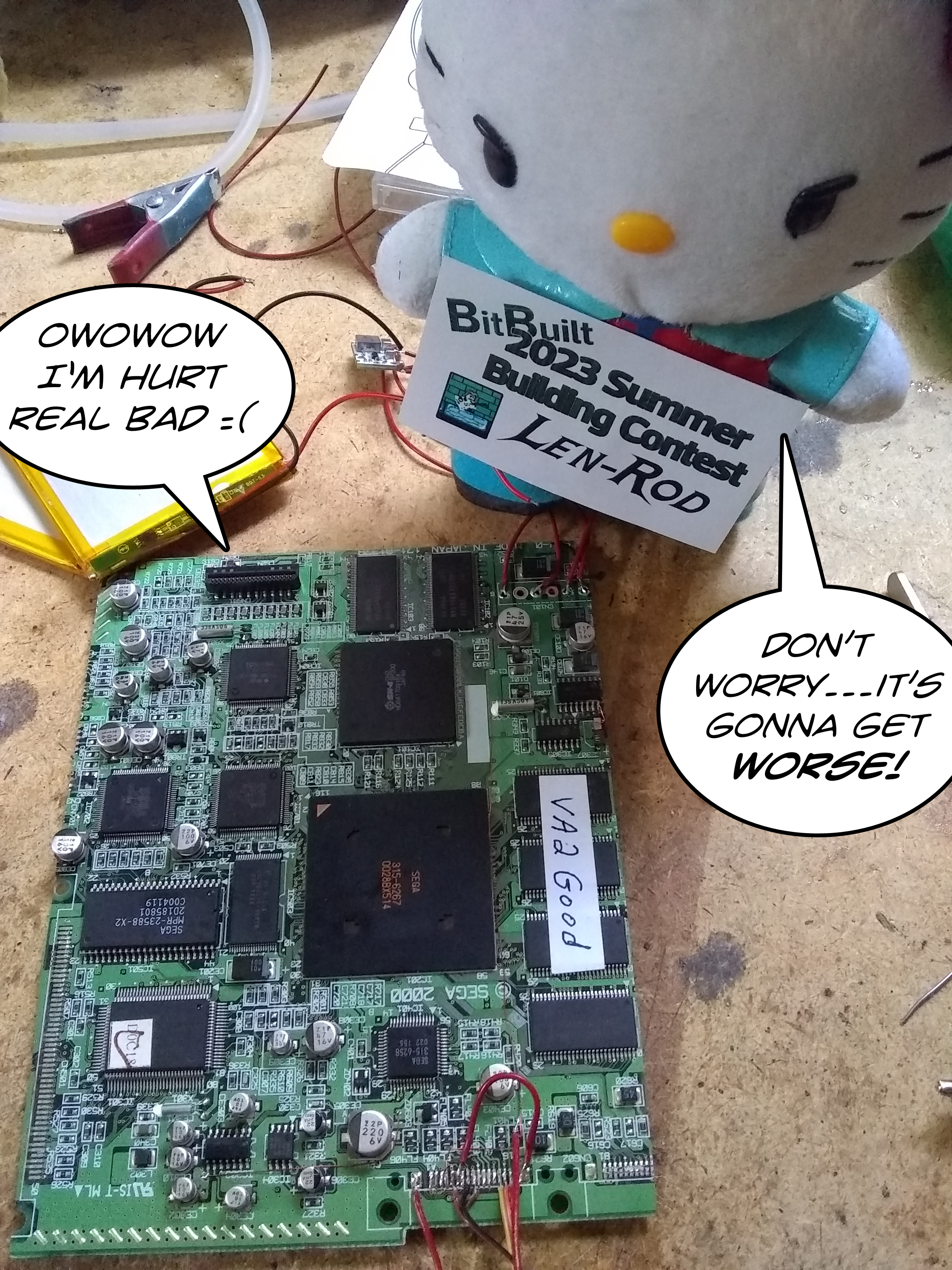

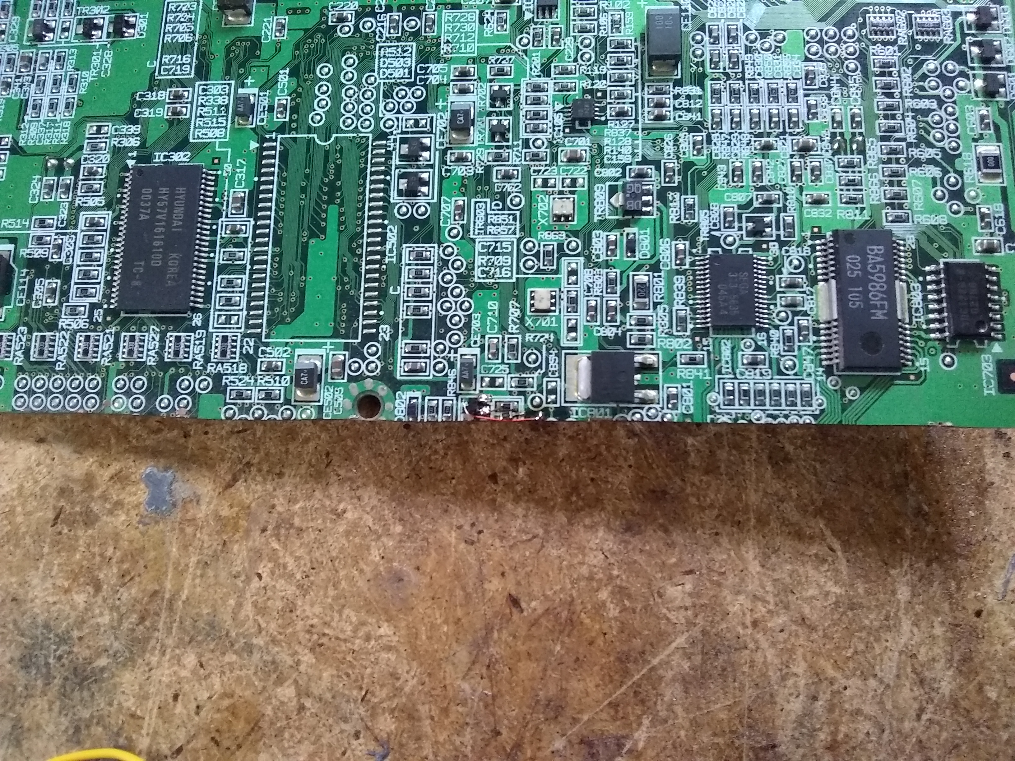

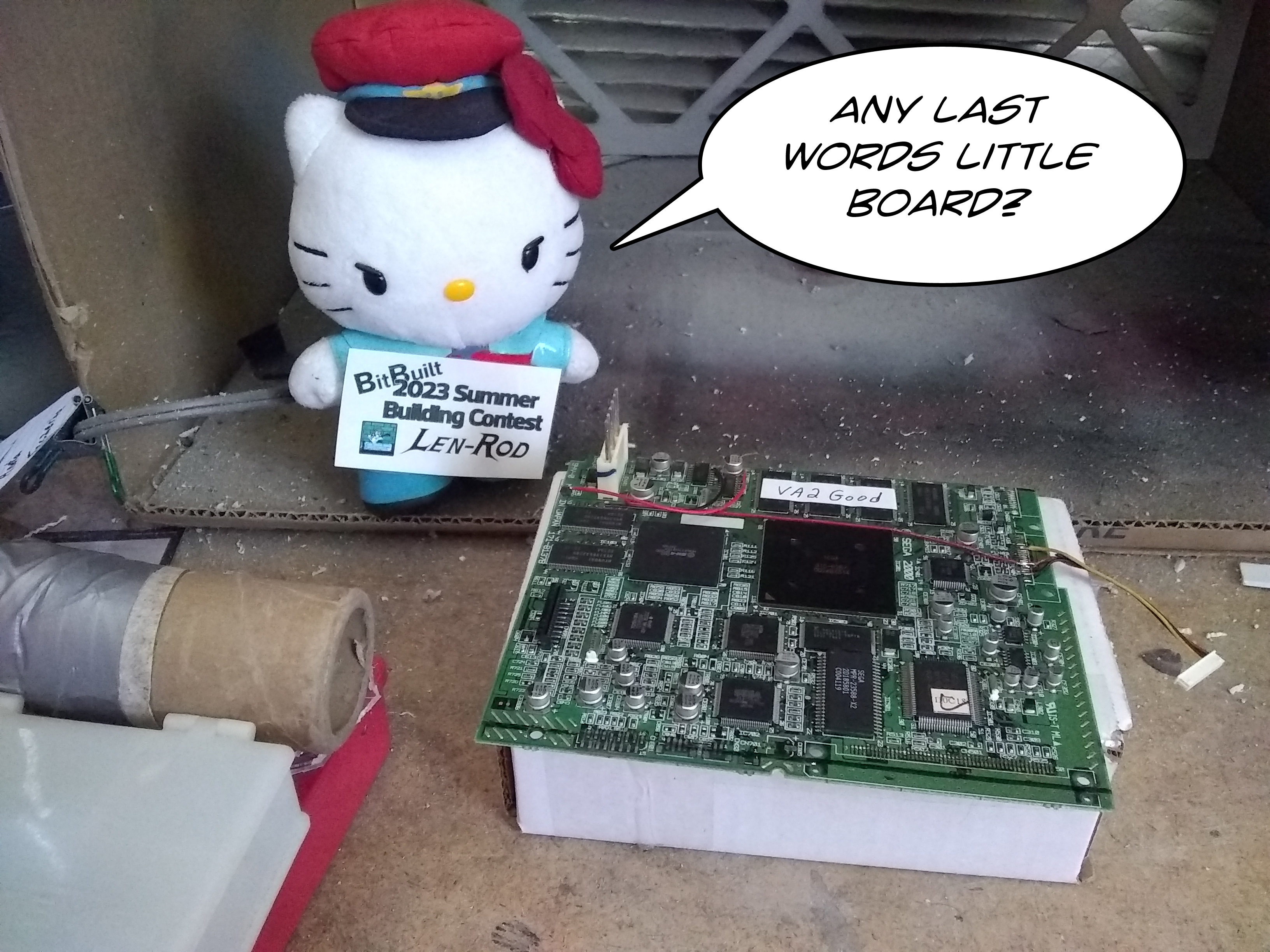

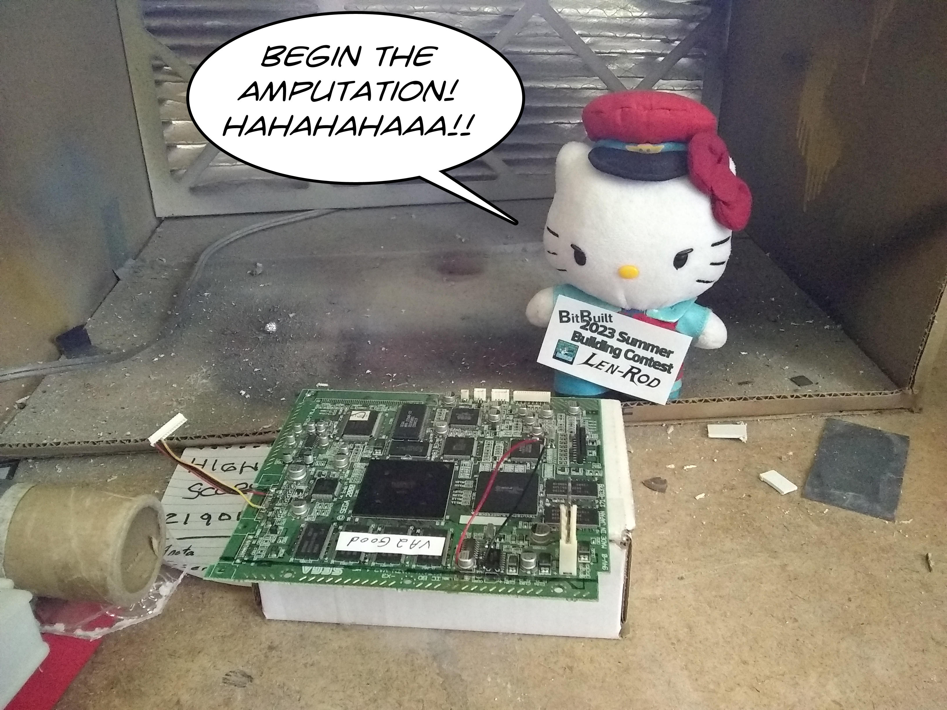

I was hoping for a glorious, triumphant episode 30.

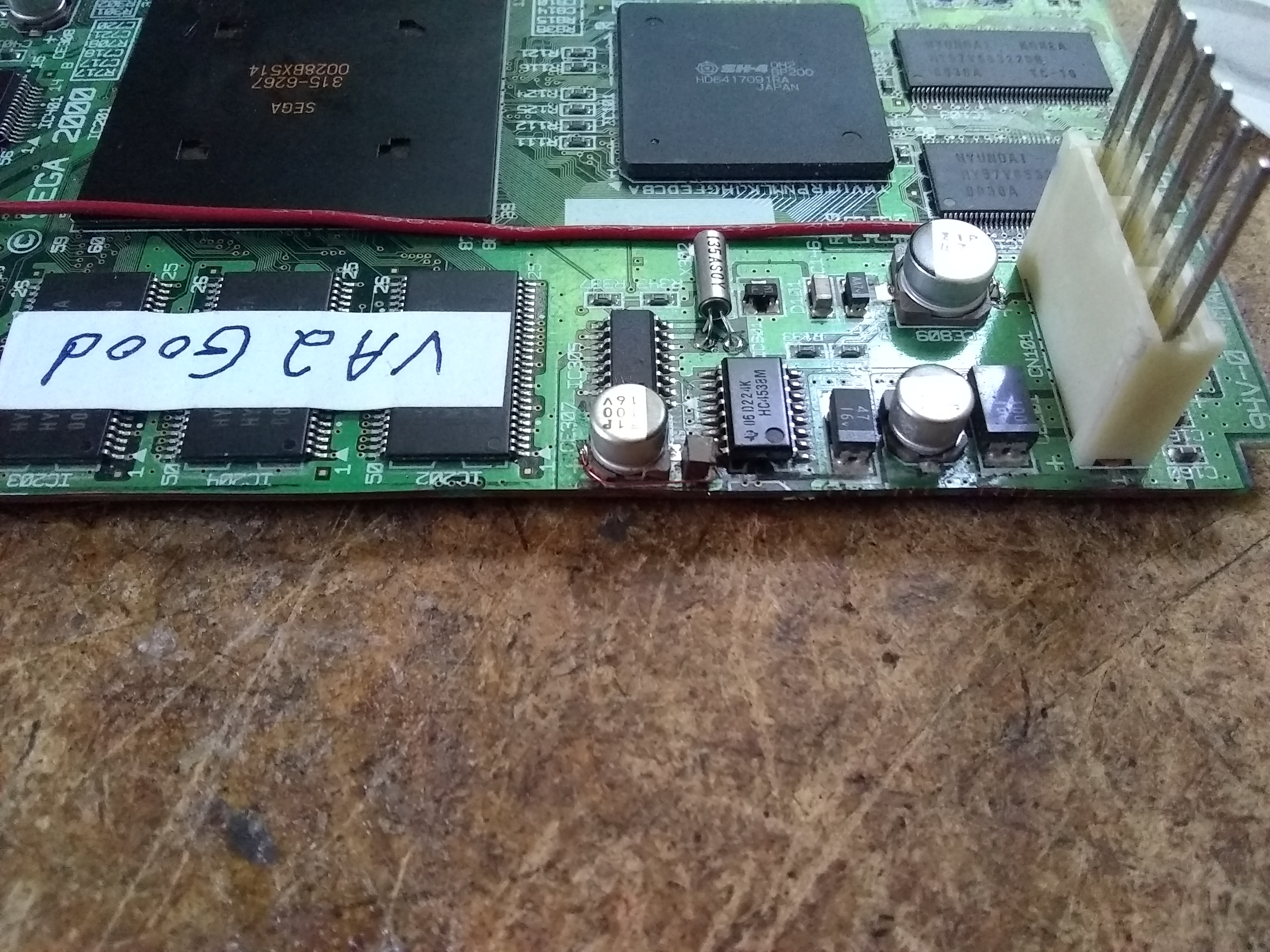

instead, all I get is magic smoke.

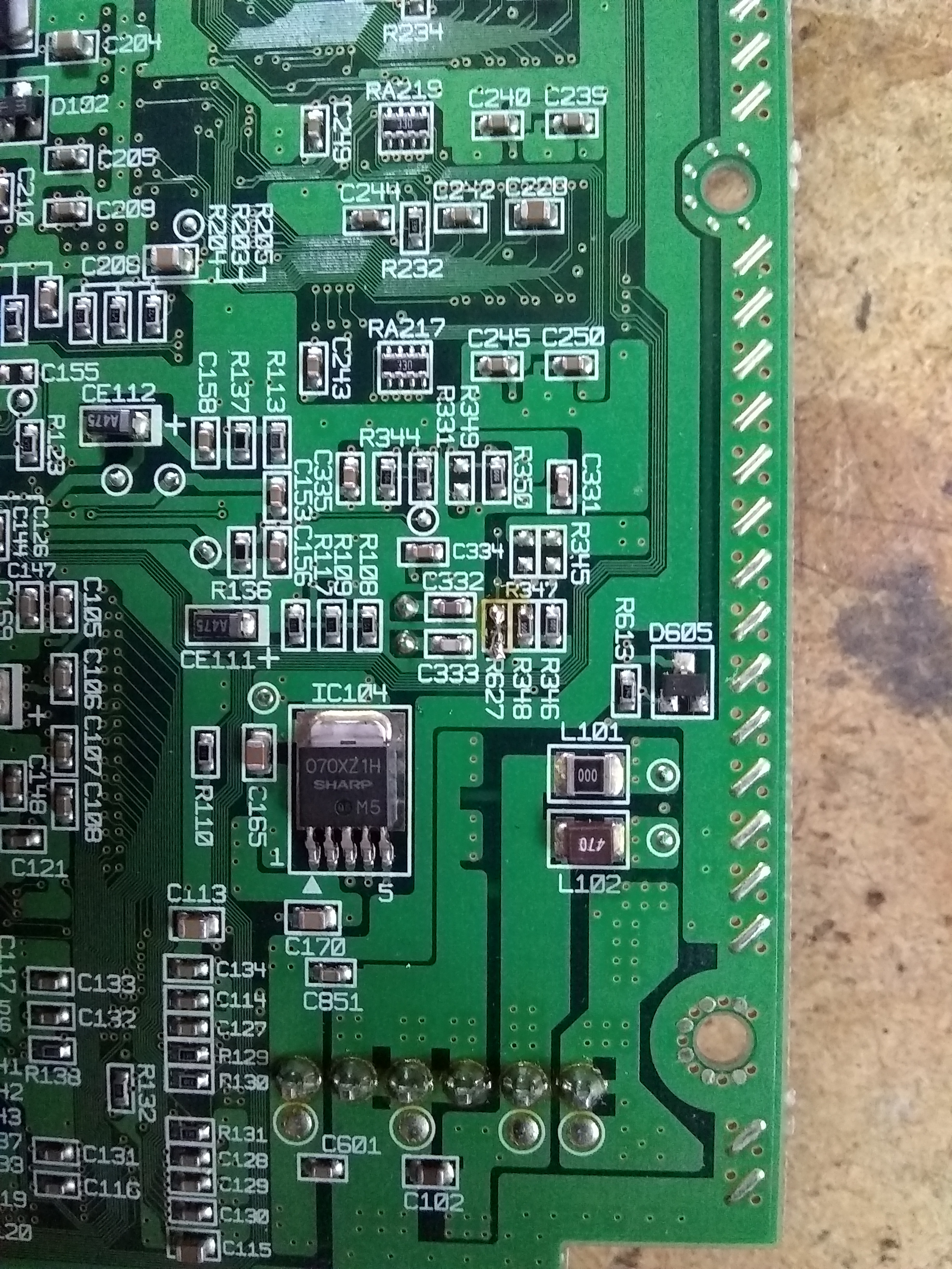

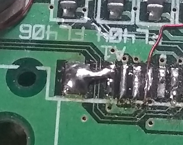

I got it all wired up. Assembled in all its glory. Hit the power switch and it started on fire. Projekt is dead. I'm out of the competition :(
Good news! So I was messing with the remnants....and found that the DC appears to still be functional! Audio amp is smoked, VGA circuit might also be smoked. BUT, everything else looks like it's still working! I might be out of the contest..but at least this projekt might still live on :)
Hooray I'm so glad the project seems recoverable. I can't wait to see it working some day.
My fingers are crossed

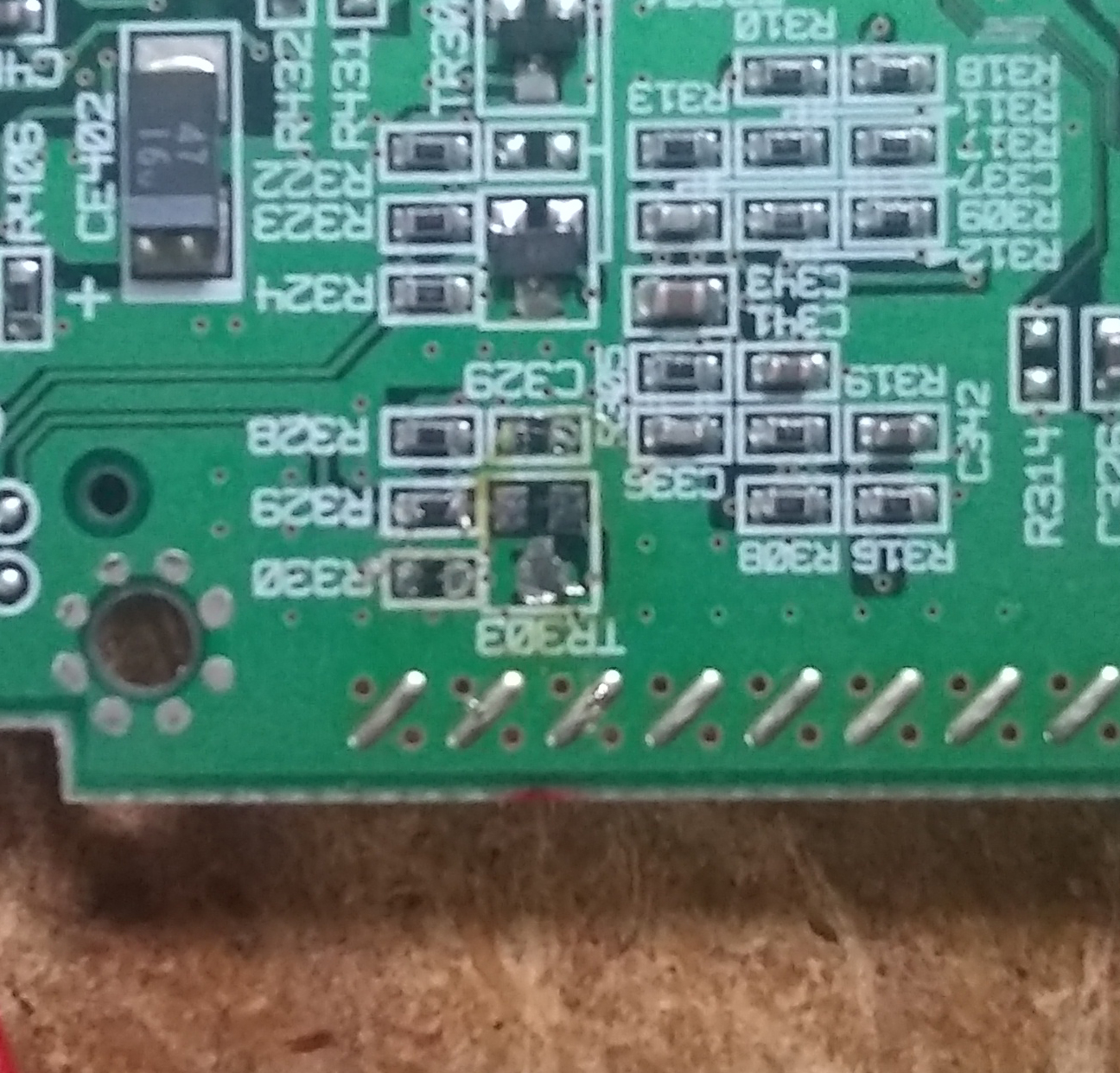

I think so...despite my flagging every wire to not get them mixed up, I somehow got the 5v and 12v lines backwards. Since the sound and VGA are powered via 5v, that's what caused the explosion there.
Is it possible to salvage something in time for the competition close? I ended up busting an entry of mine in the final hours also and figured what the hell - I'm going to enter this broken mess. It didn't win anything, but it was something.
After much not sleeping, I made an attempt to get this beast running somehow. Unfortunately, the damage went deeper than expected as the laser is also cooked. There's also a slight chance that the laser controller is done for, too.
Sadly, I don't think it's possible to get a replacement laser within 24 hours so all hope for finishing this on time is lost.
At least the rest of it appears to be working yet...so hopefully, someday, I'll get this beasty finished.
