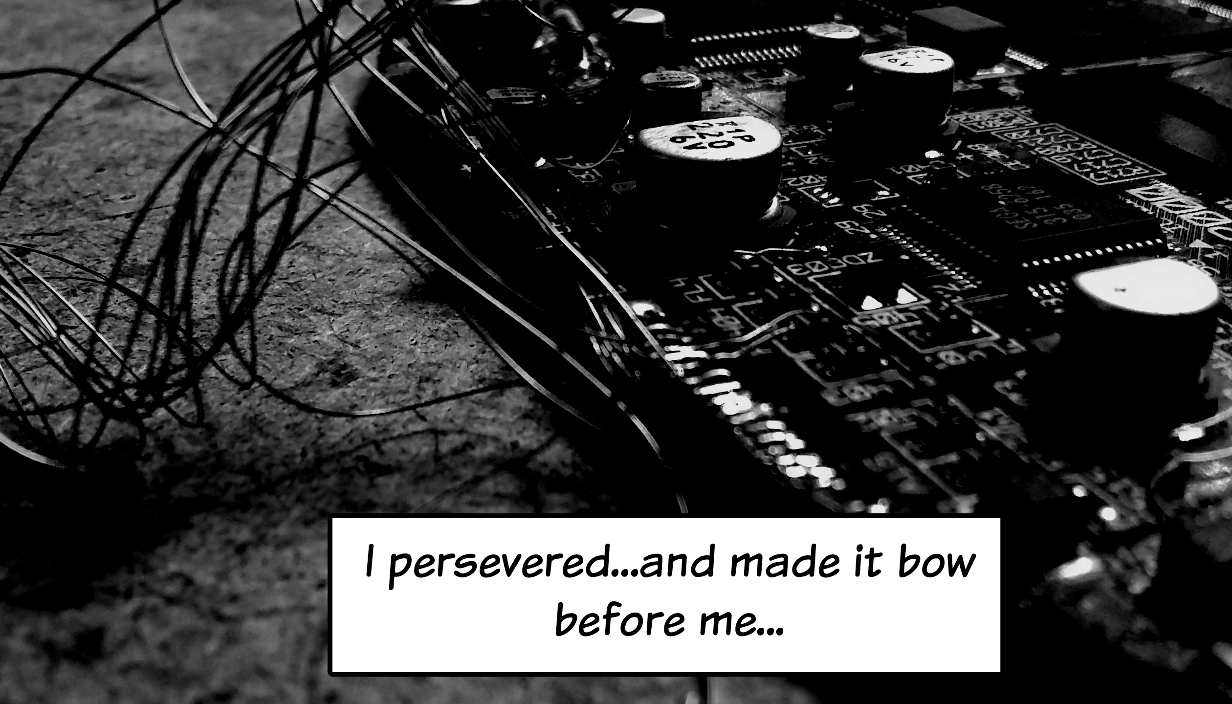

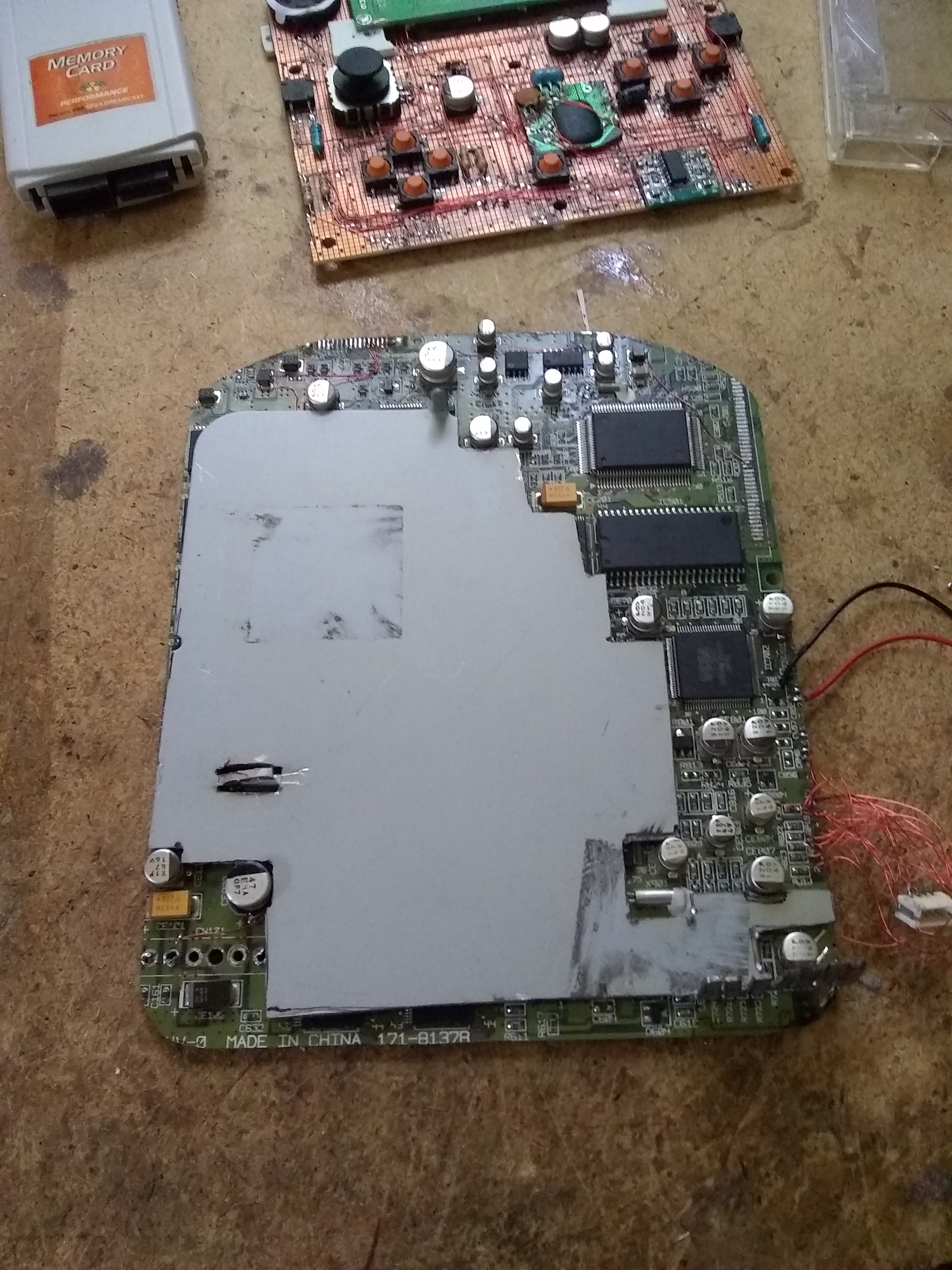

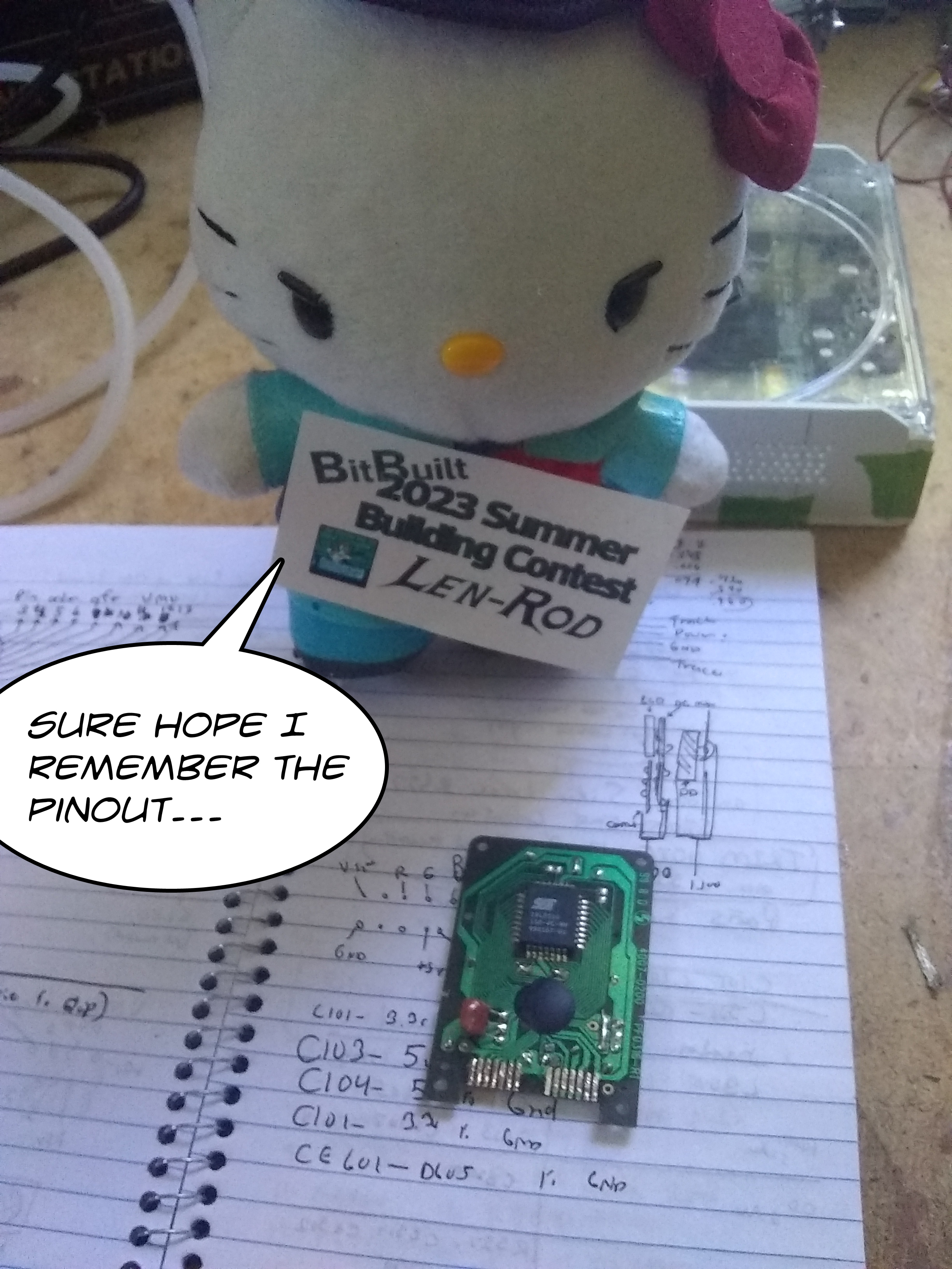

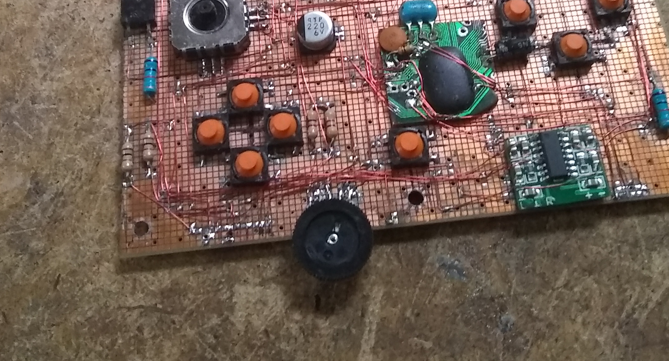

That all being said, I did get the controller working (data lines were backwards). It's wonkey as all heck and I wired the analog stick backwards...but it is "working" lol.
Also smoked the audio amp...cause I do that..a lot.
Minor update...no fancy episoding for the moment....just being frustrated with the controller...I redid the analog to be in the right orientation (up is up, left is left, ect). Now I just have random buttons not working issues. At first Y and B didn't work...got Y working, then start quit working. Got start working, then Right on the dpad quit working...and B refuses to work anything more than at totally random. Annoying, but as always, not unexpected.
EPISODE 13: Trials and Electrocutions...
Well, work on the guts is more or less finished!
Had alotta issues with the controller misbehaving and the audio amp cooking on me..but now it's all working! ...Mostly! Unfortunately, the audio pot was junk and I was unable to find a suitable replacement in my bins. No biggie tho, they're not expensive.
All that remains now is integrating a VMU, which should be easy enough as it will be sitting next to the battery pack, opposite of the big board.

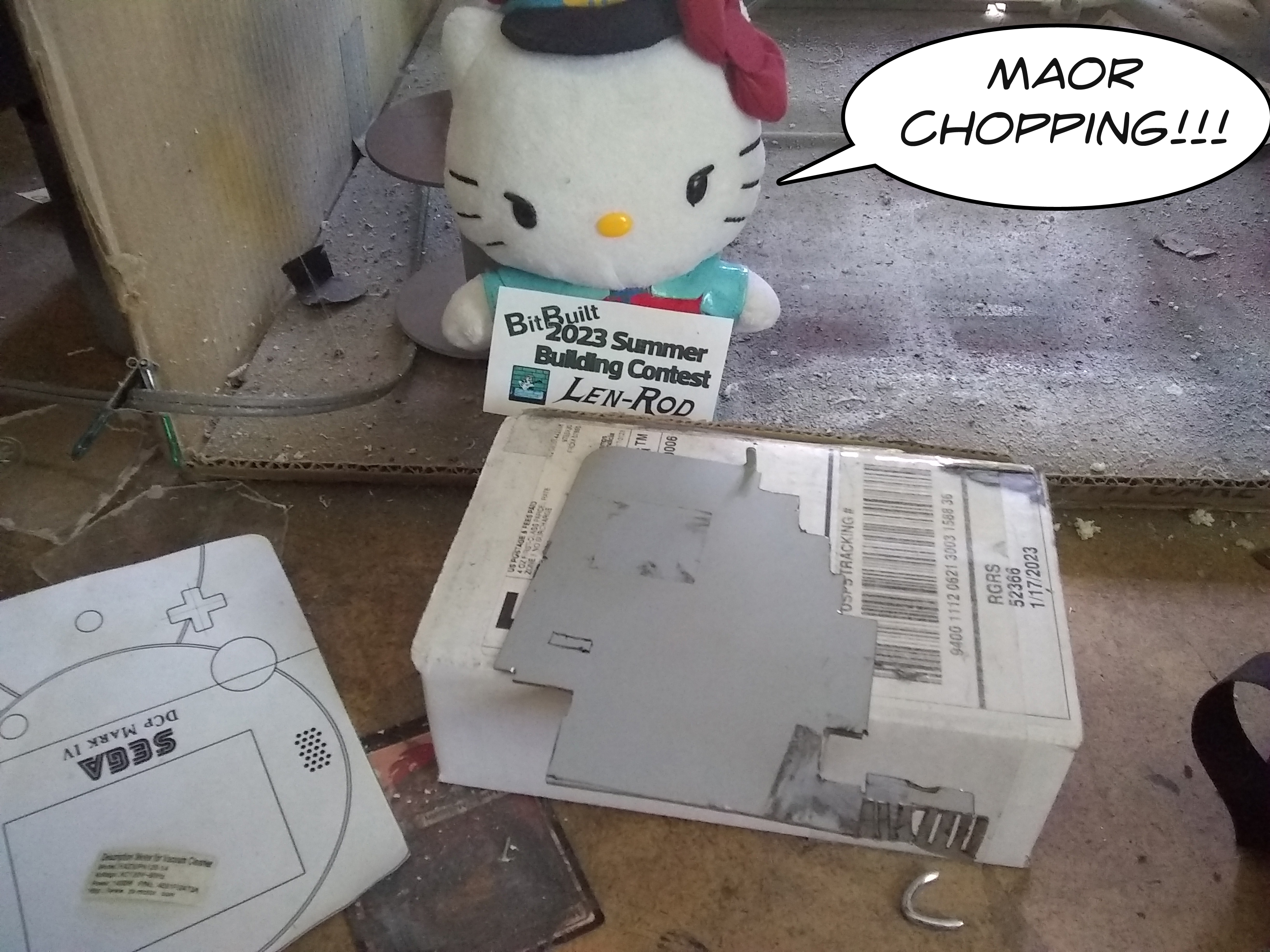

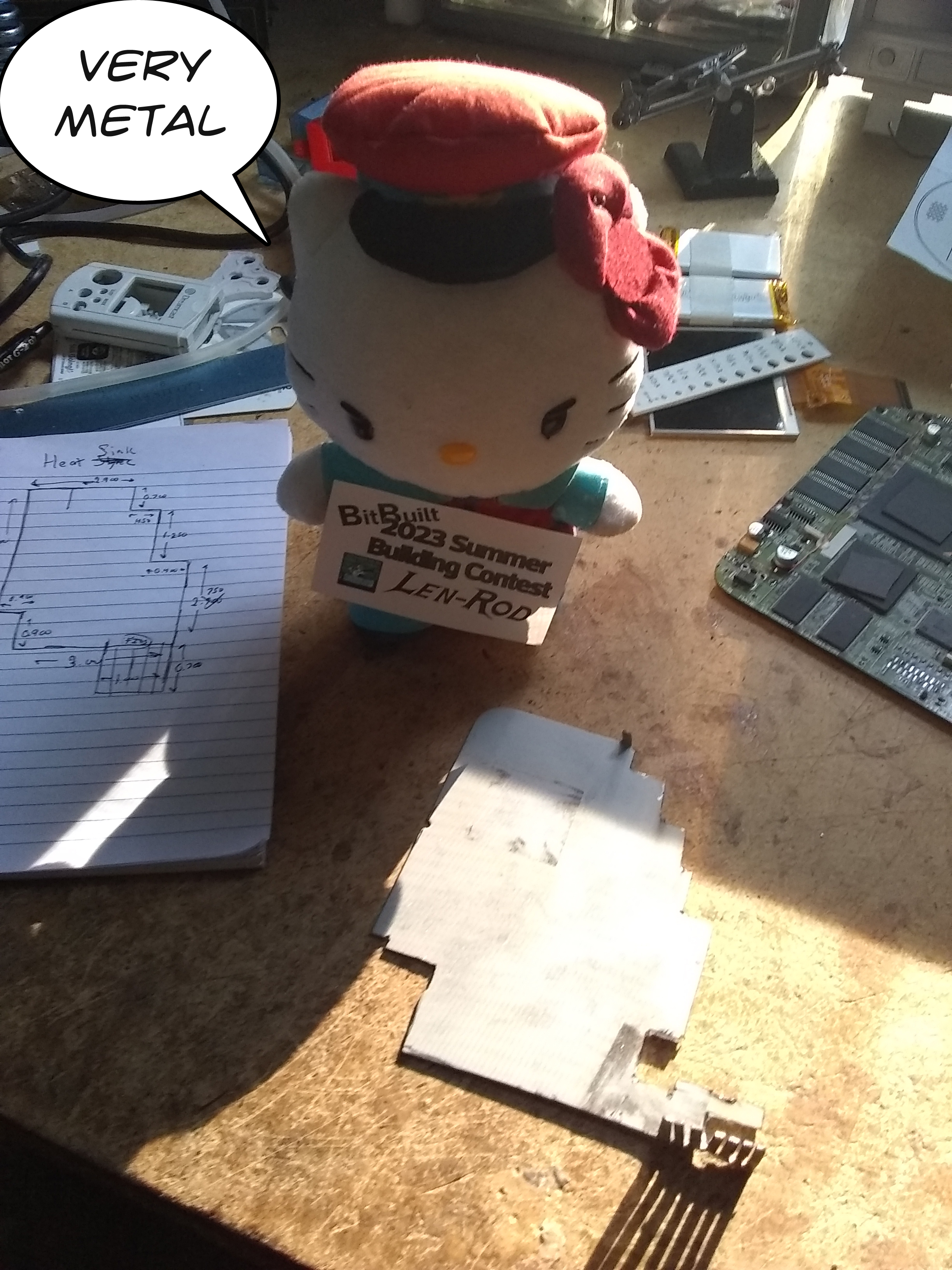

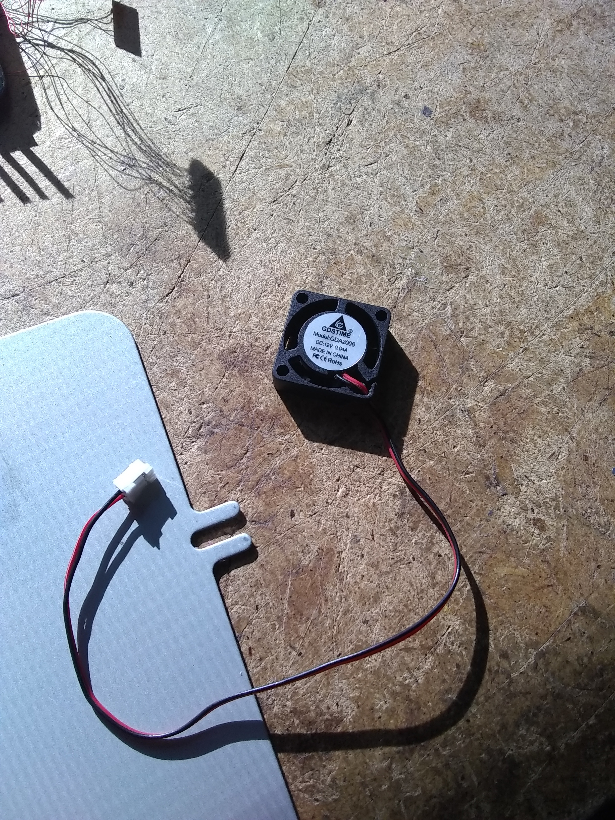

Back to work again! Time to build a custom heat sink!

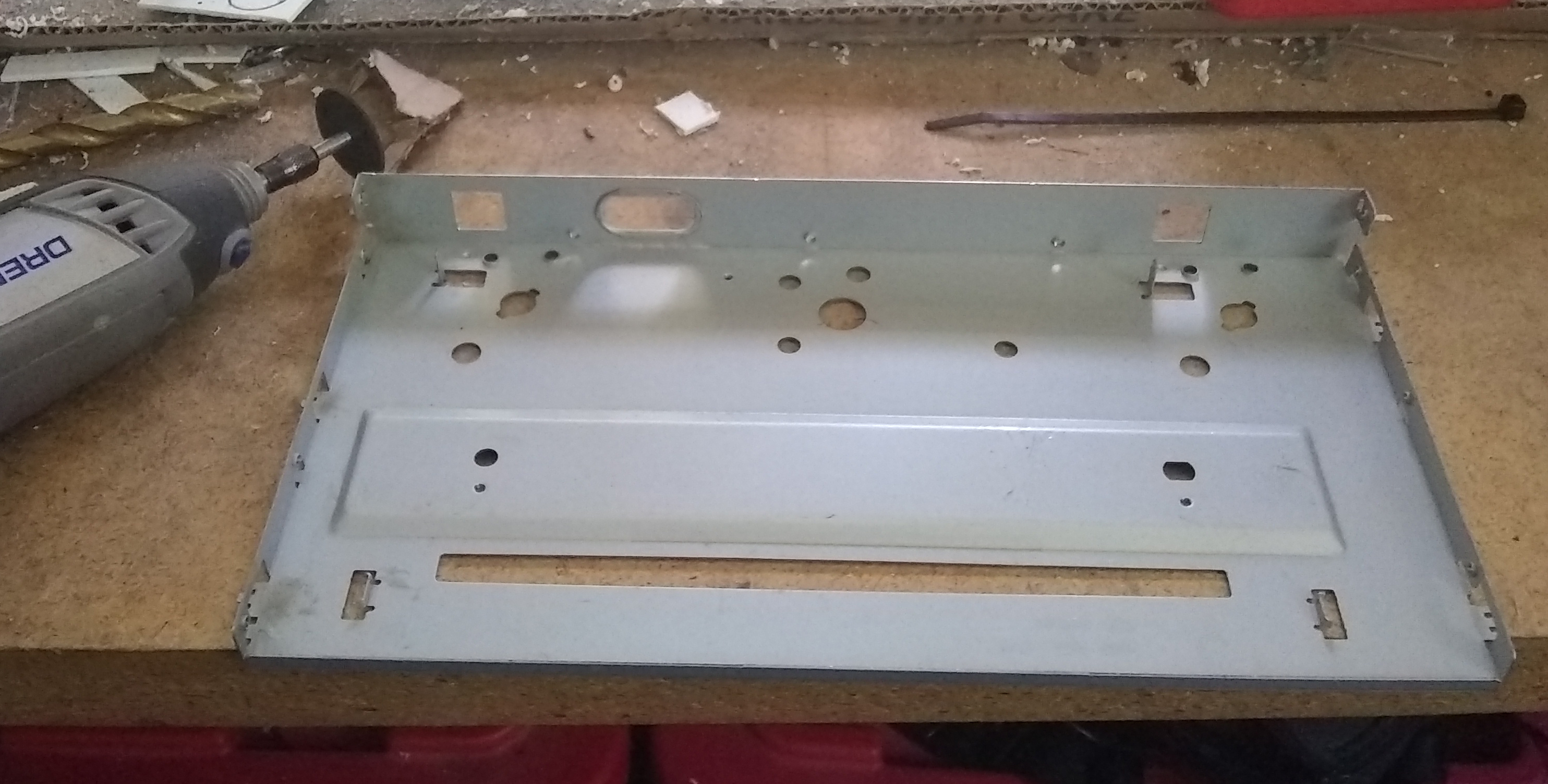

Found an appropriate metal slab to make a heat sink from...it's part of the heat panel from an old power amplifier (yay recycled junk!)
It's not super big, but from what I can figure, this should be more than enough to keep it cool. Especially with this little fan I got here...
...It's tiny, but it moves a surprising amount of air!

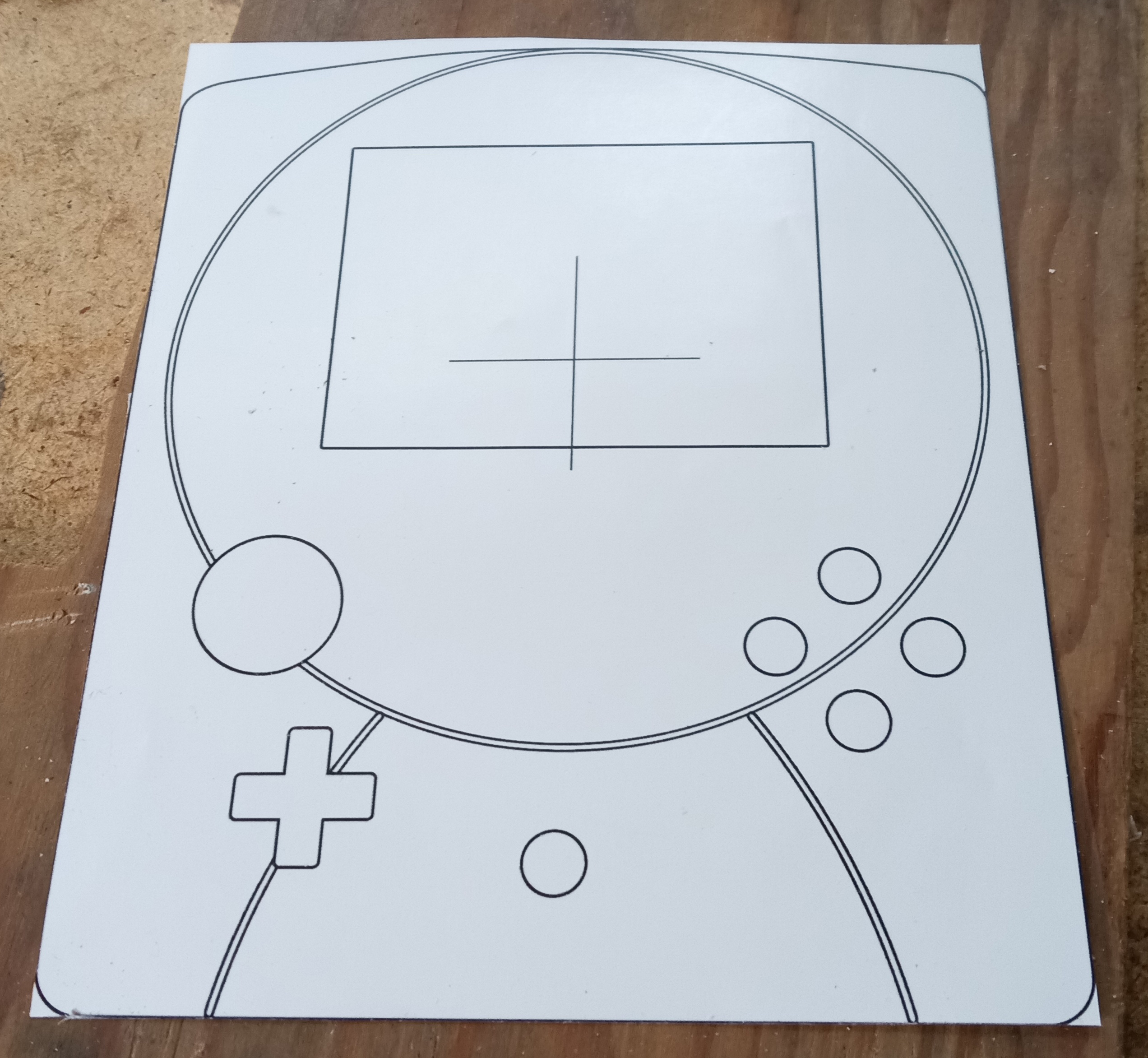

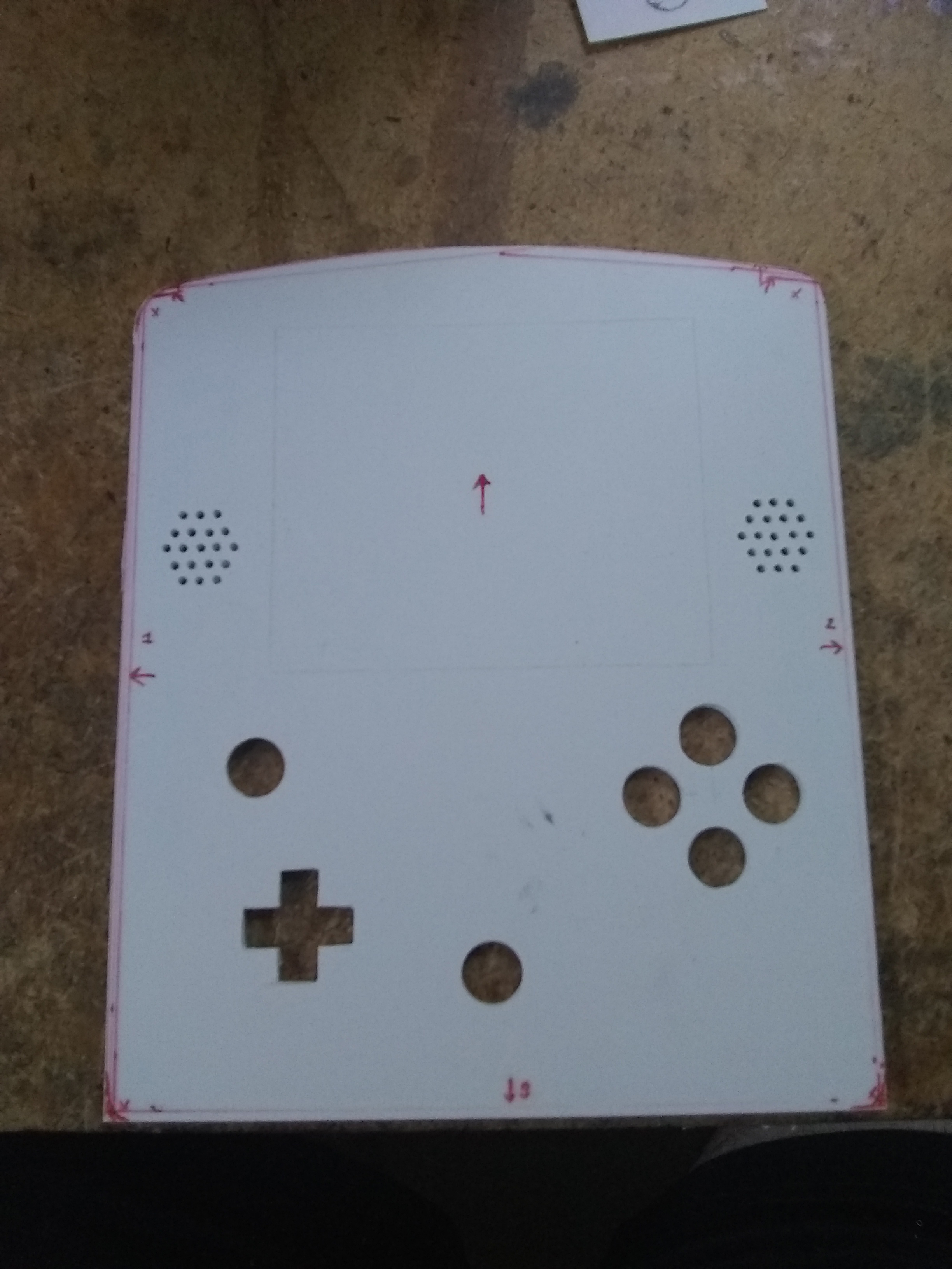

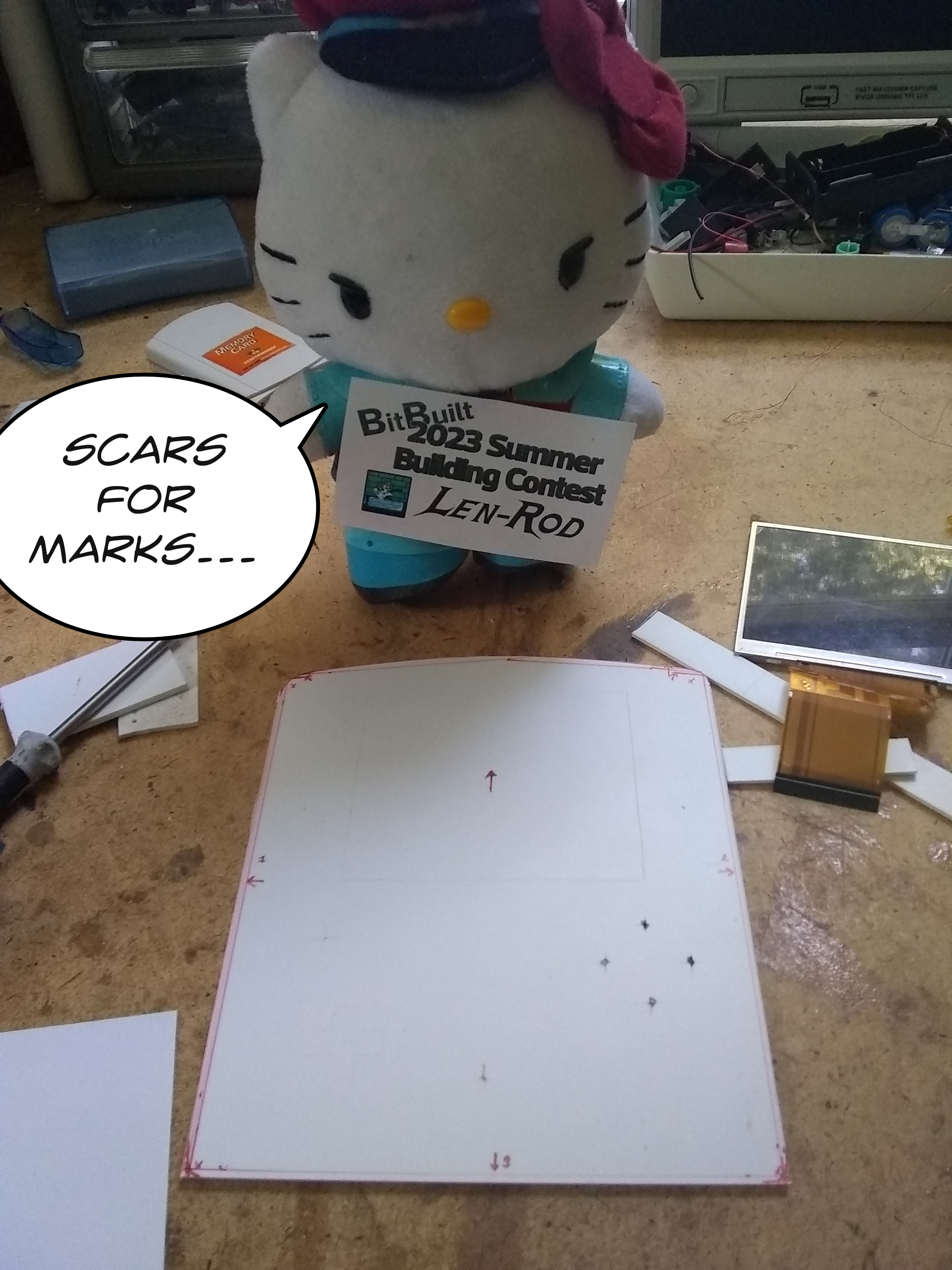

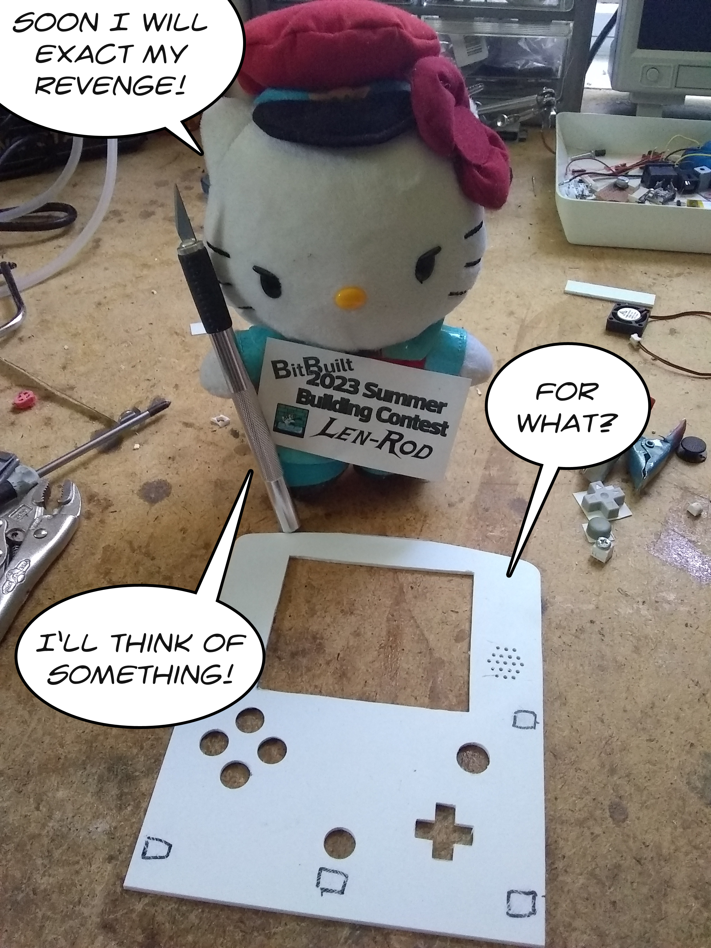

So now we're onto the case construciton...y'all saw a bit of a hint as to what my design is earlier...so now it's time to make it physical!

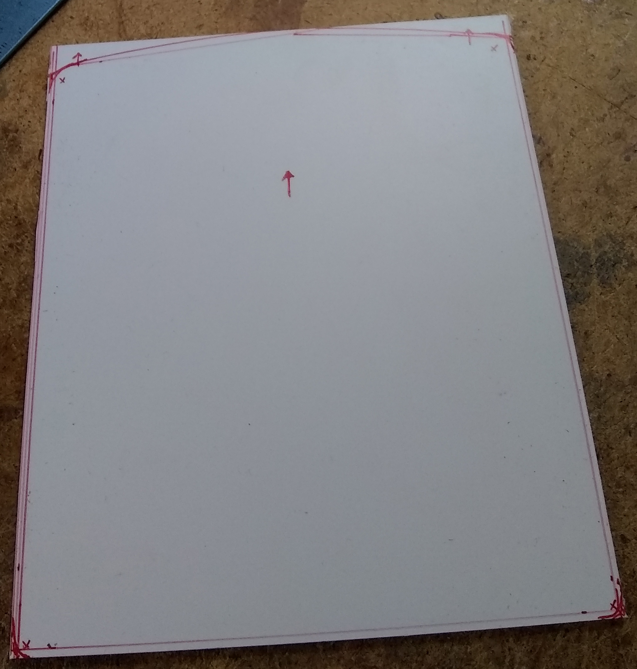

Good thing I have plenty-o-styrene hanging about. I can make it wrong a dozen times and still have material leftover :)

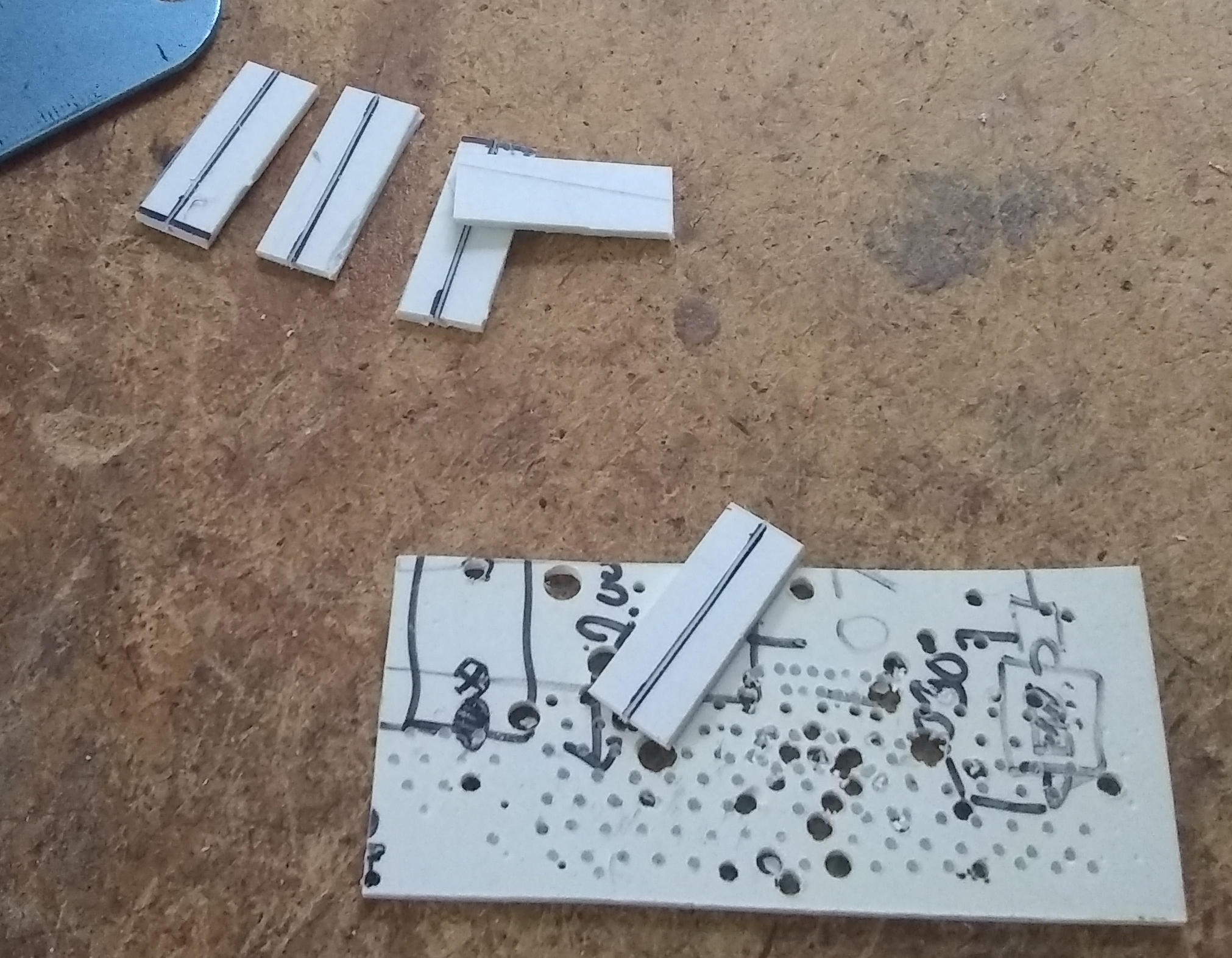

Cut down to size..wall positions marked...ready for last bits of cutting...
Cuts done! Now time to make the walls. The case won't be nearly as thick as those walls currently look. I cut them well oversize so what when I get the guts installed, I can cut them to perfection!

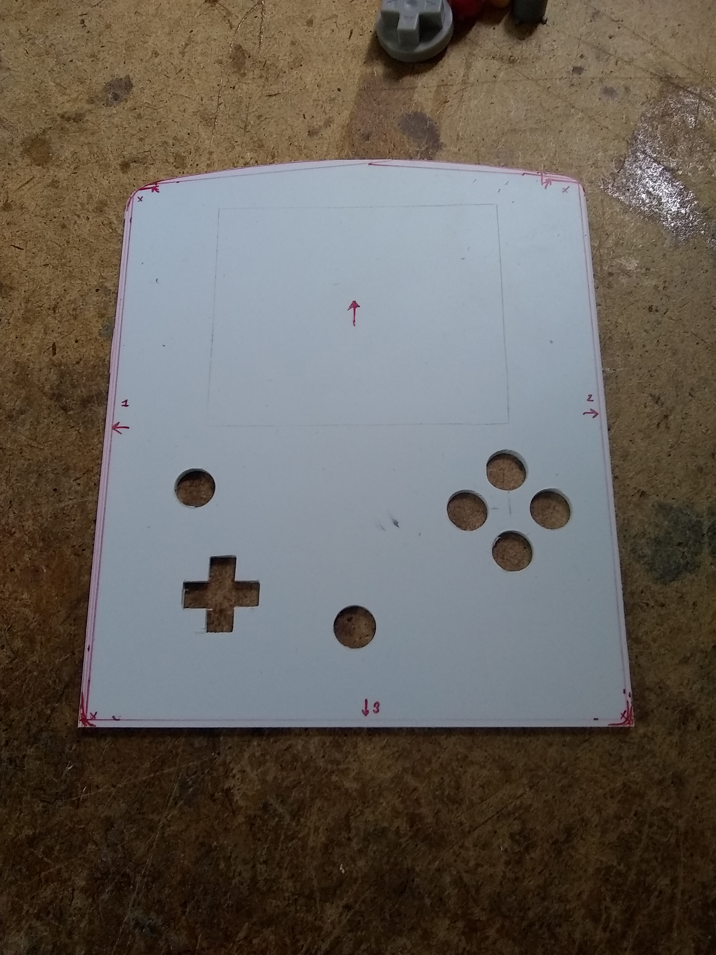

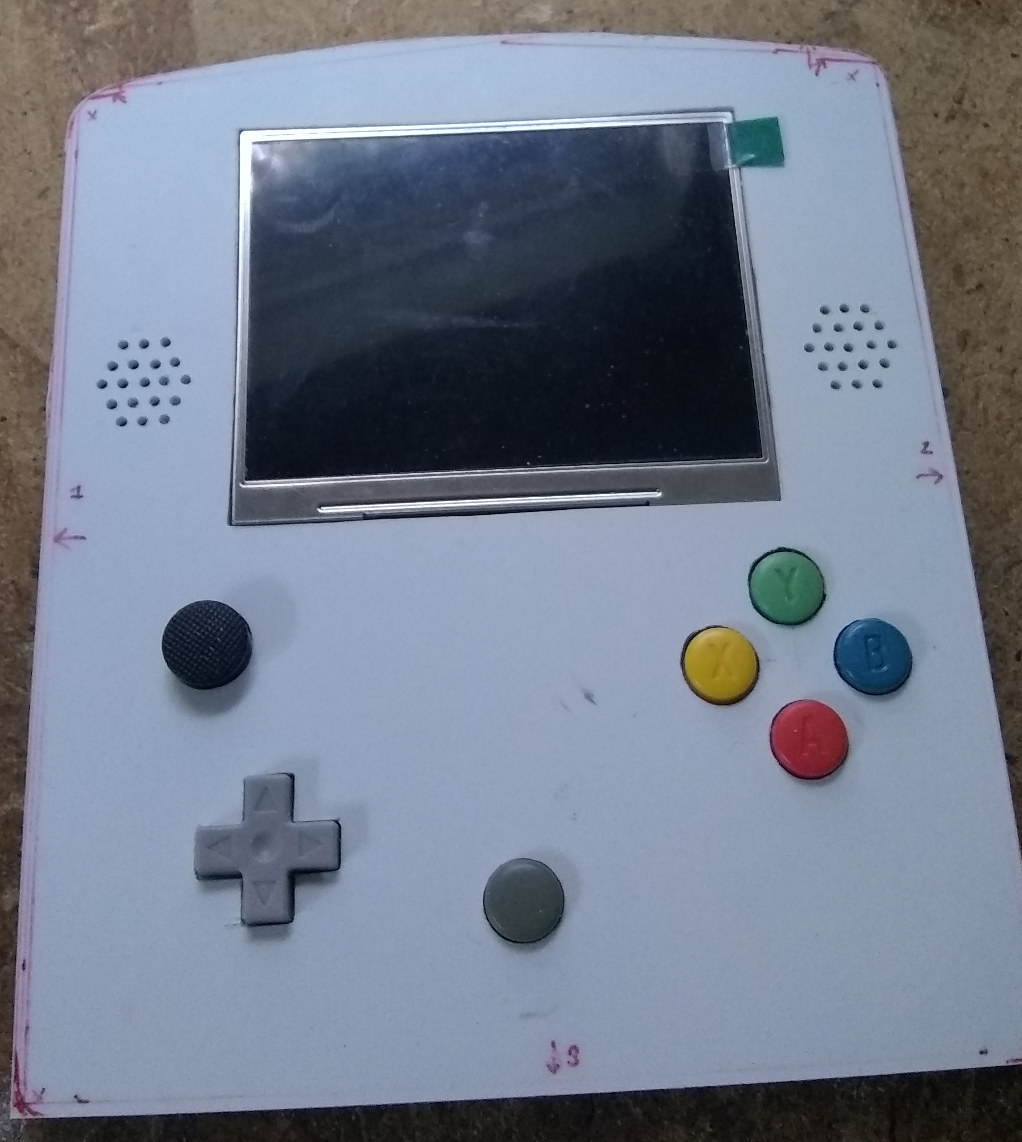

Last on today's list is getting the button holes dealt with!
First some starter holes........
...aaaand BOOM!
Button holes are all good to go!
Case front is...getting there! Still have to drill the holes for the speakers and of course get the space for the screen knocked out.
And so our hero continues his plight against the forces of plastics! Will the buttons come out good? Will the case decide it wants to take on another form? Find out in the next exciting episode of DREAM XTREME Z!

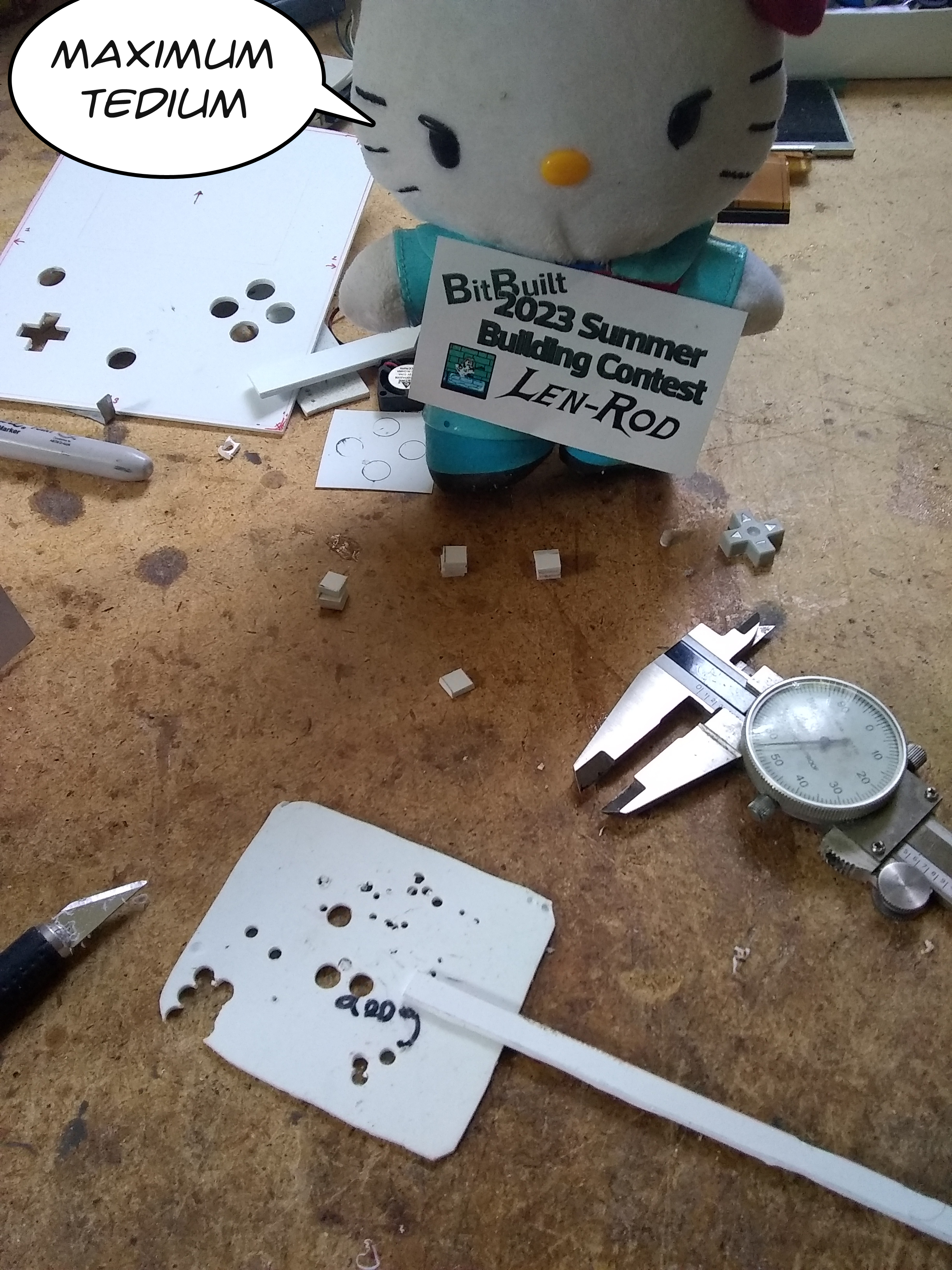

Can't work a controller without buttons, so let's cook some up!

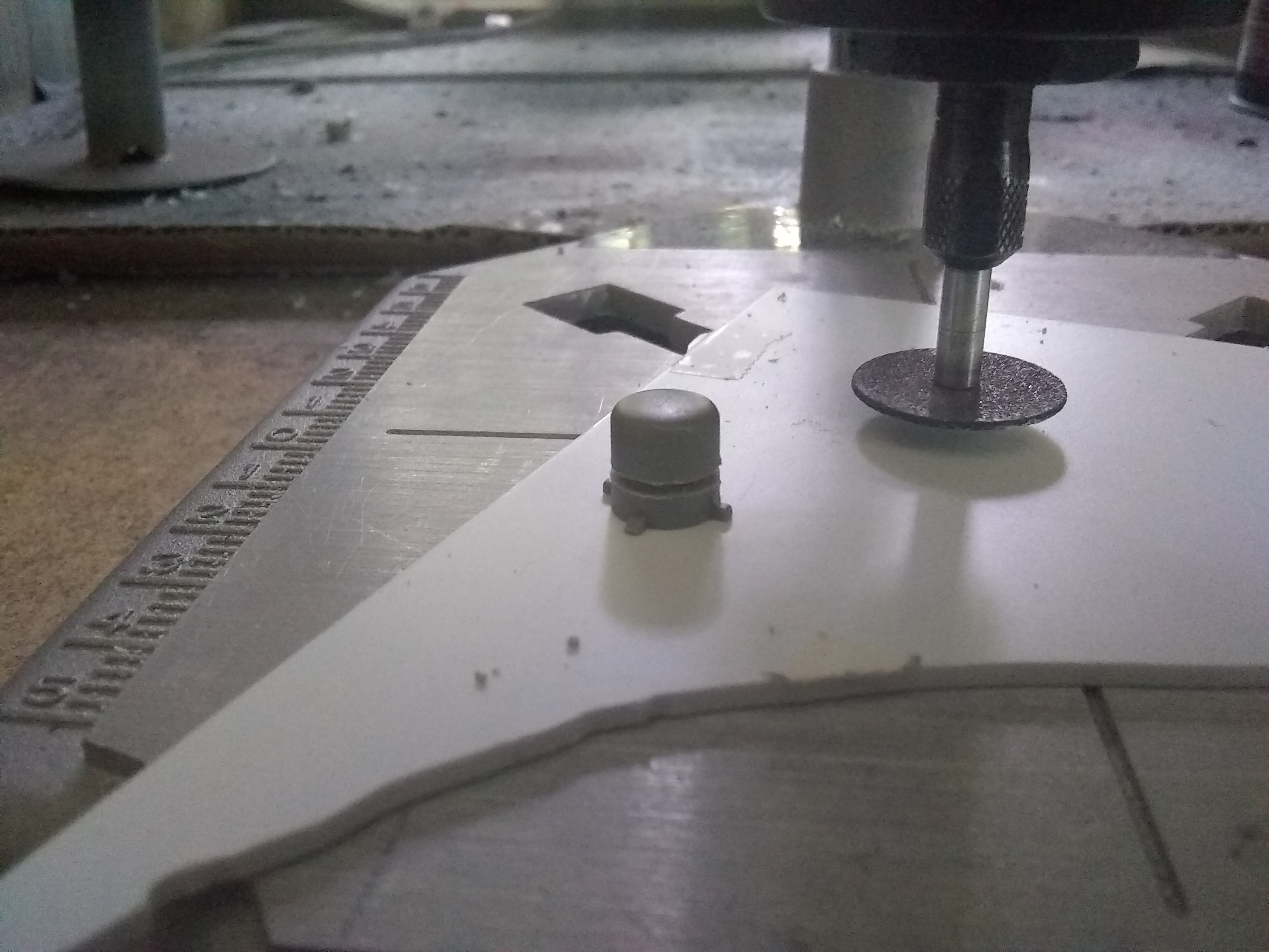

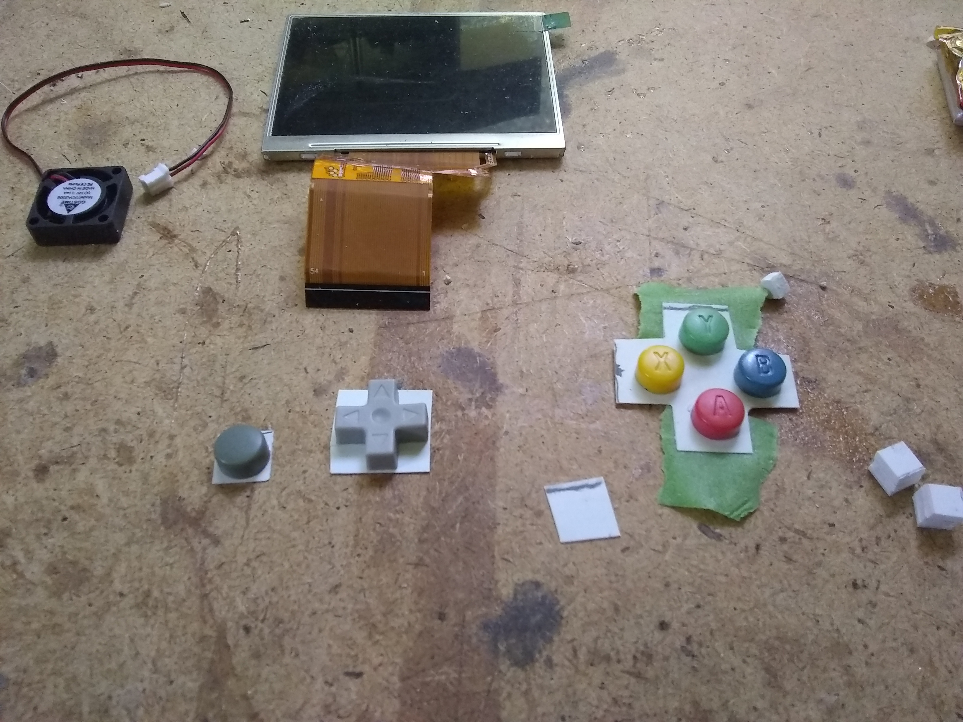

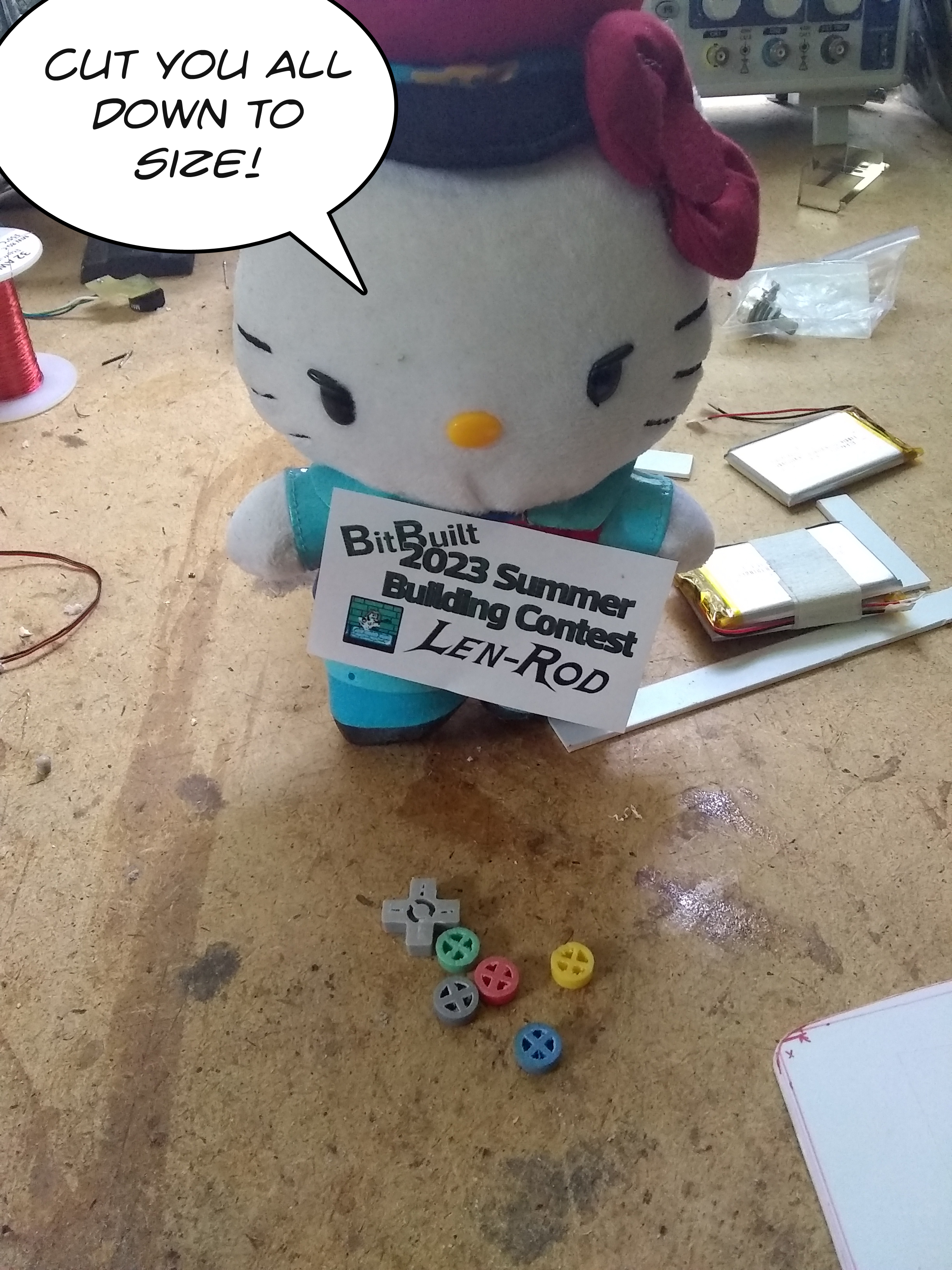

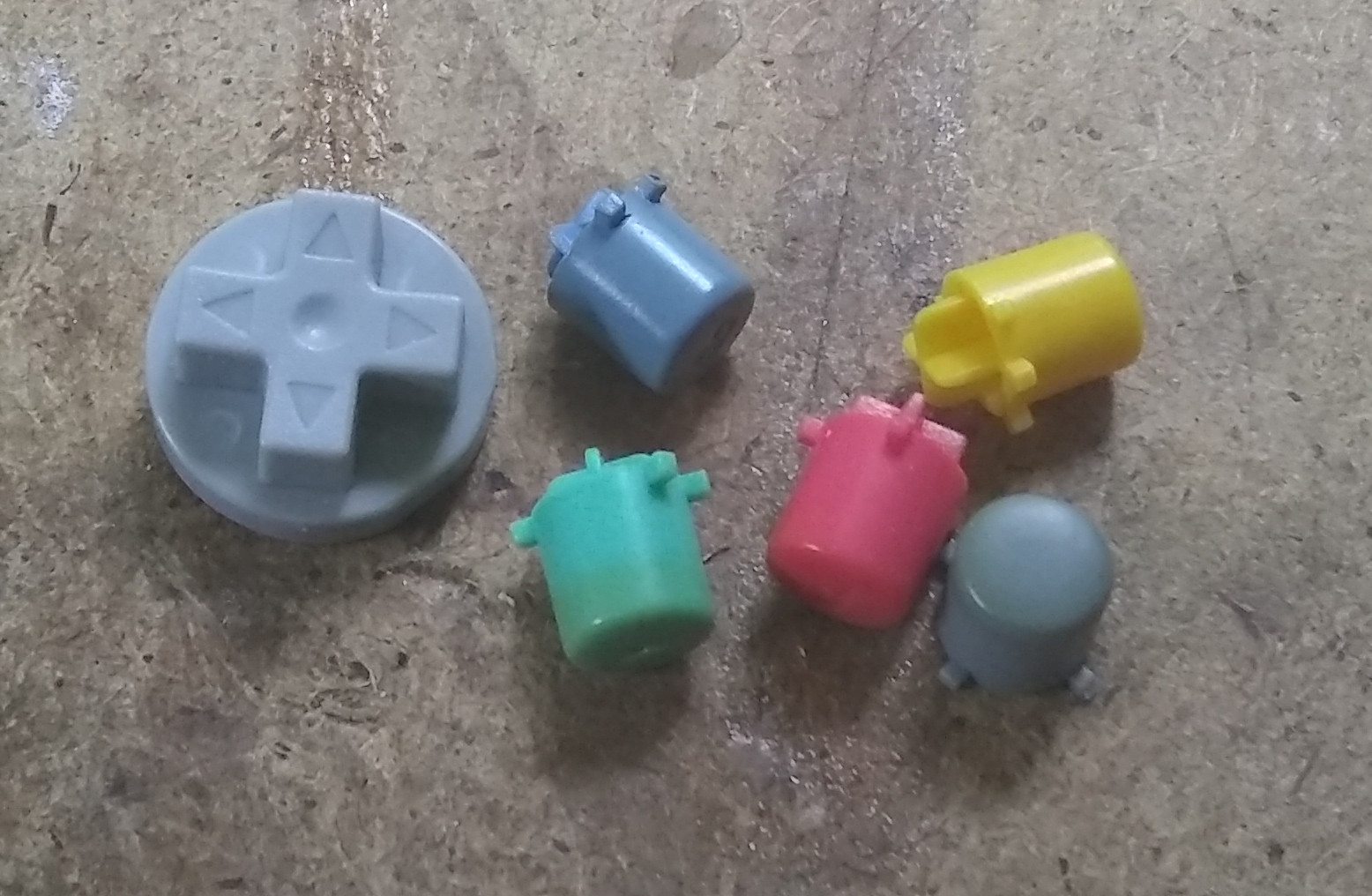

Decided to use the buttons from the gutted controller. However, the D-pad in it was far too large. Fortunately, I have plenty of gamecube dpads that are the right size!
Obviously, the original buttons are far too tall for my case, so much chopping was needed.
After much chopping and sanding...the buttons are now all down to the proper height!

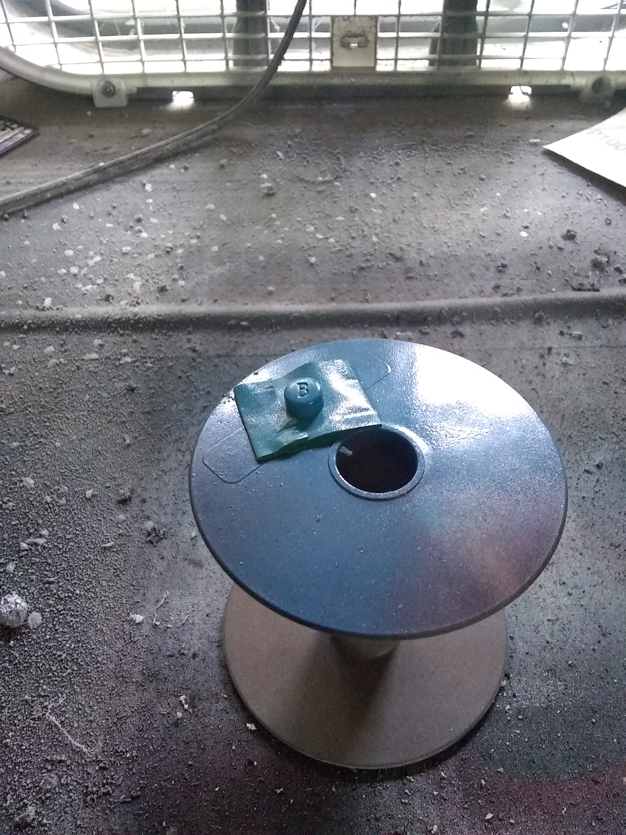

It may not be noticeable in the pics, the buttons are all sunfaded. While most of the buttons were fine, the b-button being very bad (it was more green than blue!). Had to break out a can of paint on that before doing anything else with it...

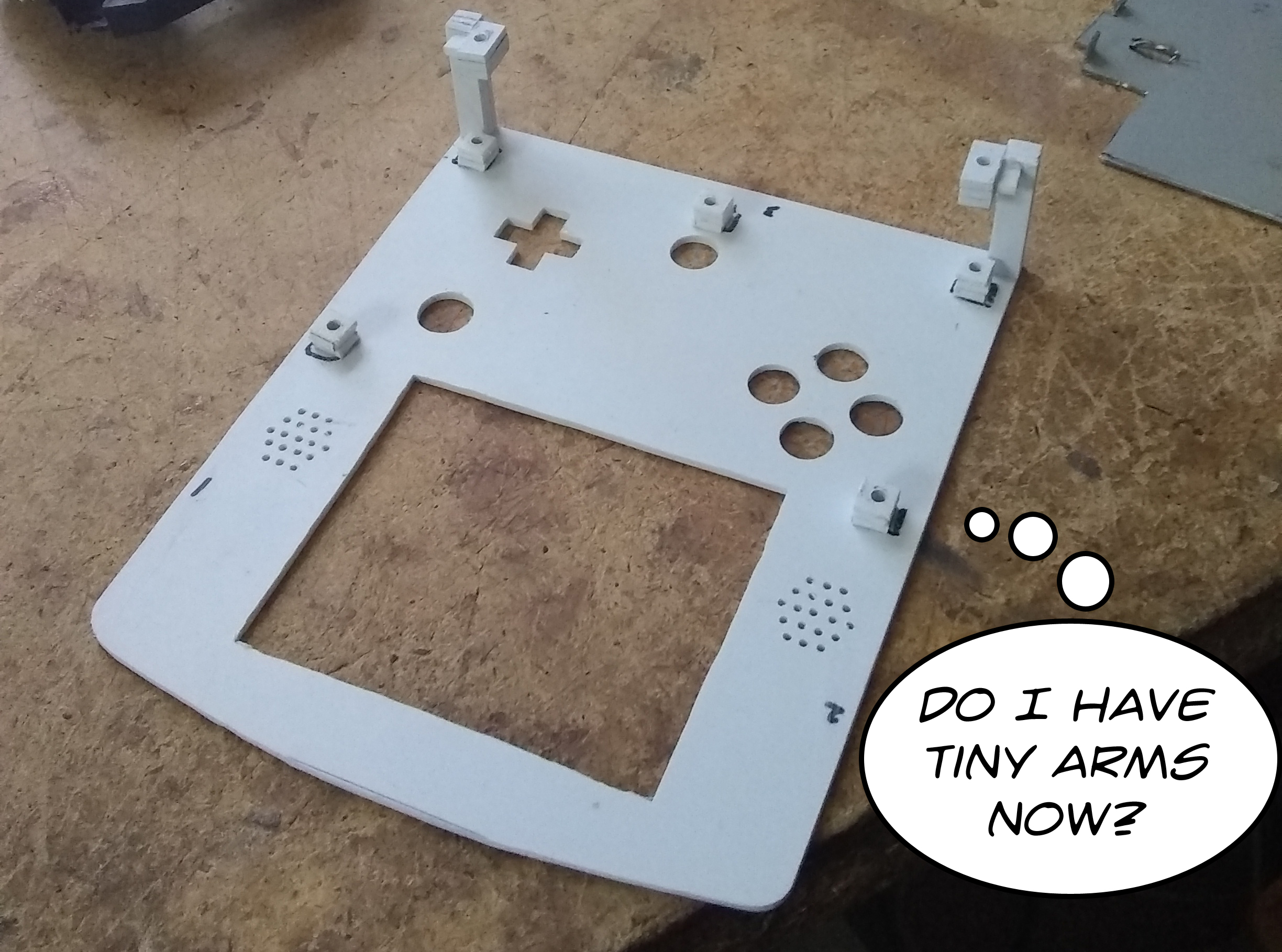

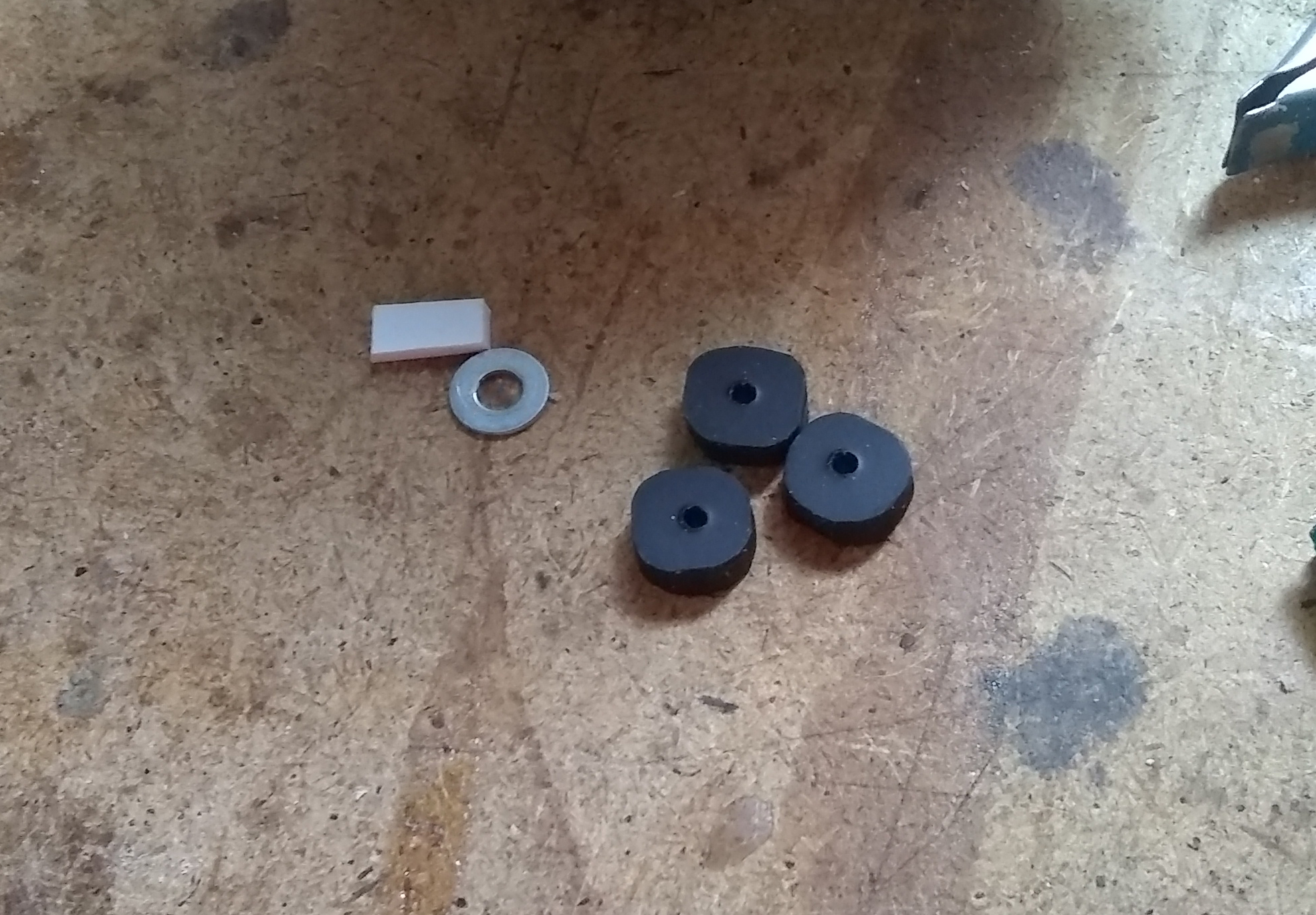

Since there was time, did one final tidbit..making the screw posts for the controller mount!
That'll do it for today!

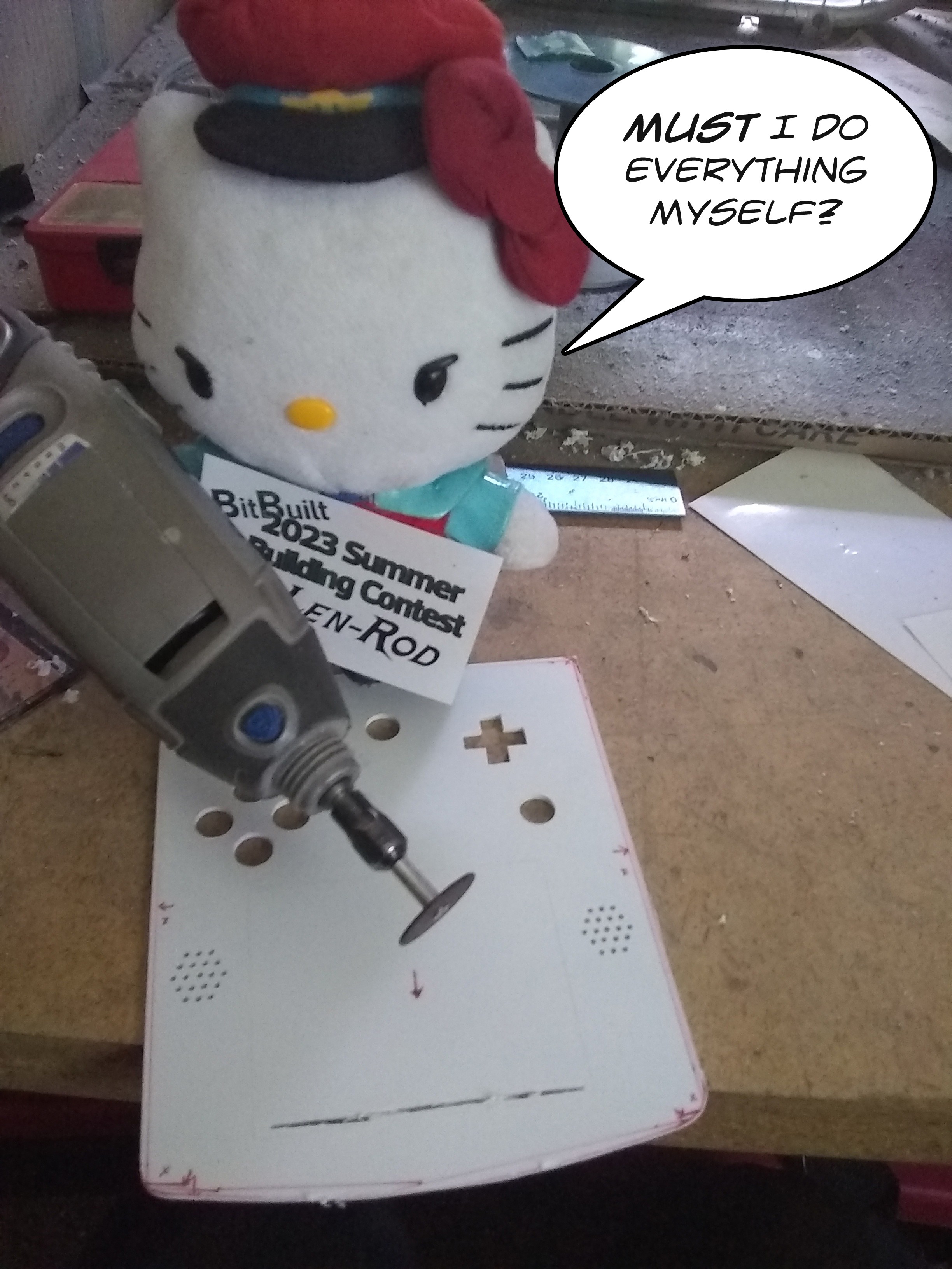

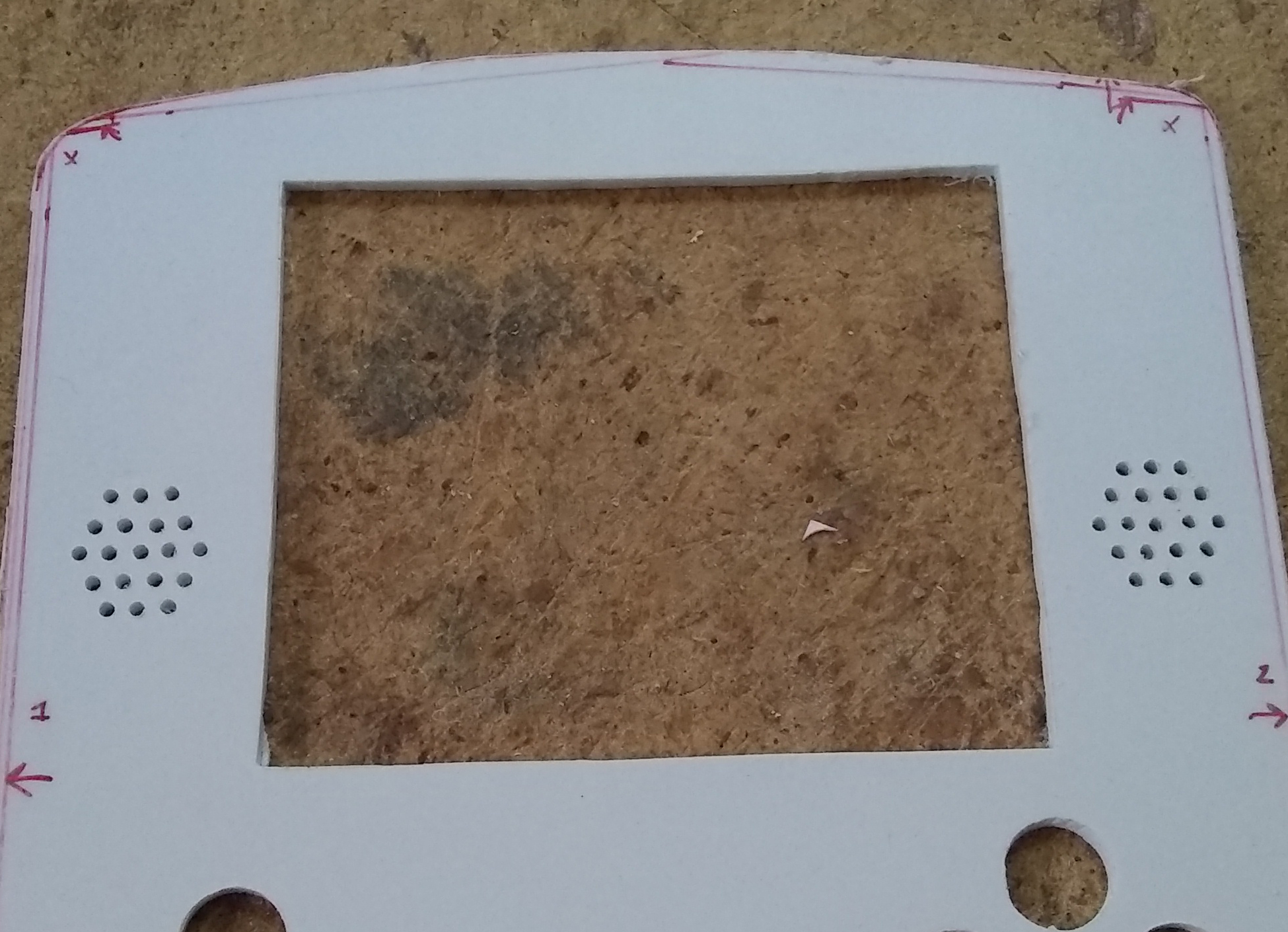

Next phase...let's make some holes for the speakers!

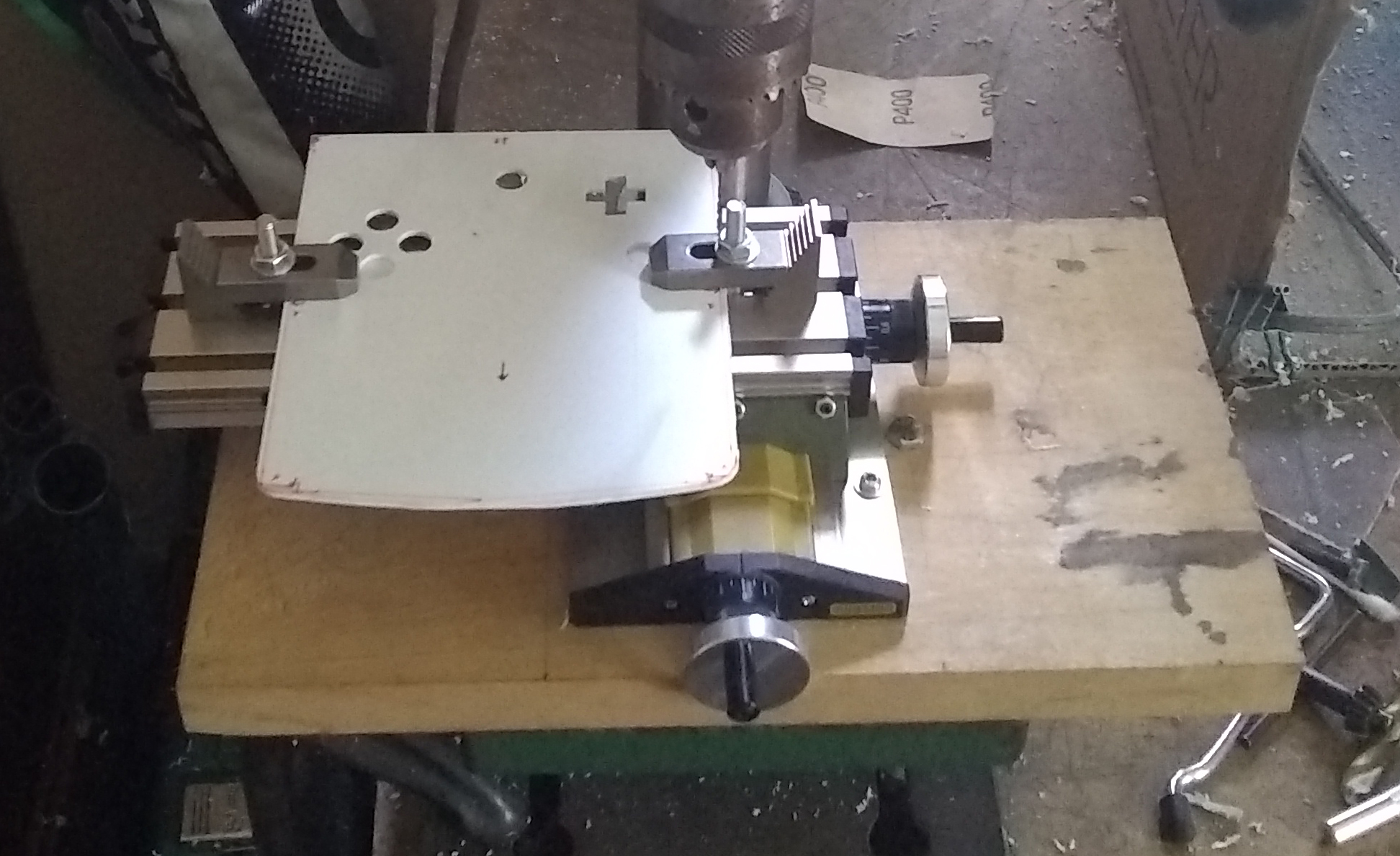

With the help of my mini milling table...
...we get some very nice looking holes!

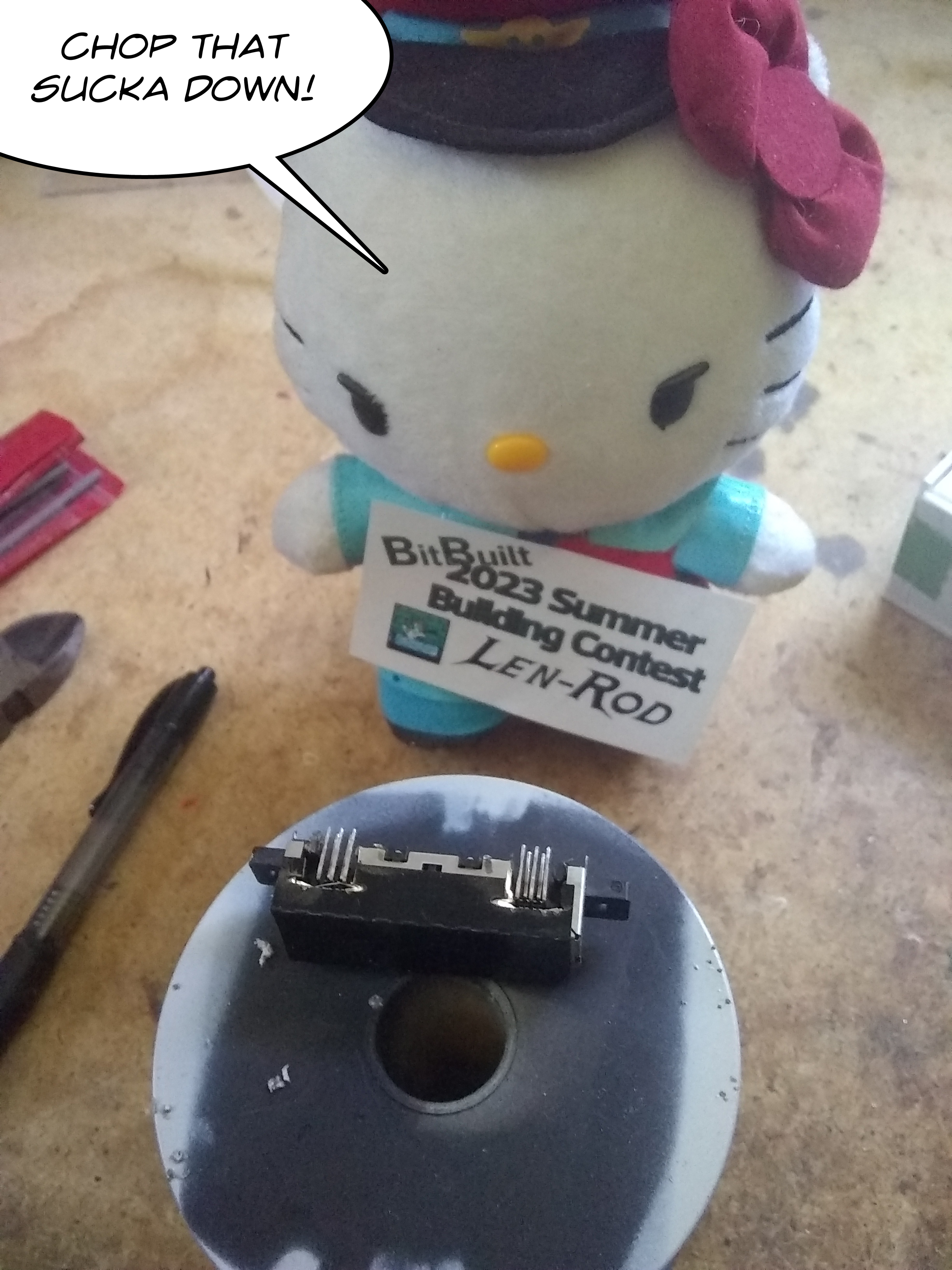

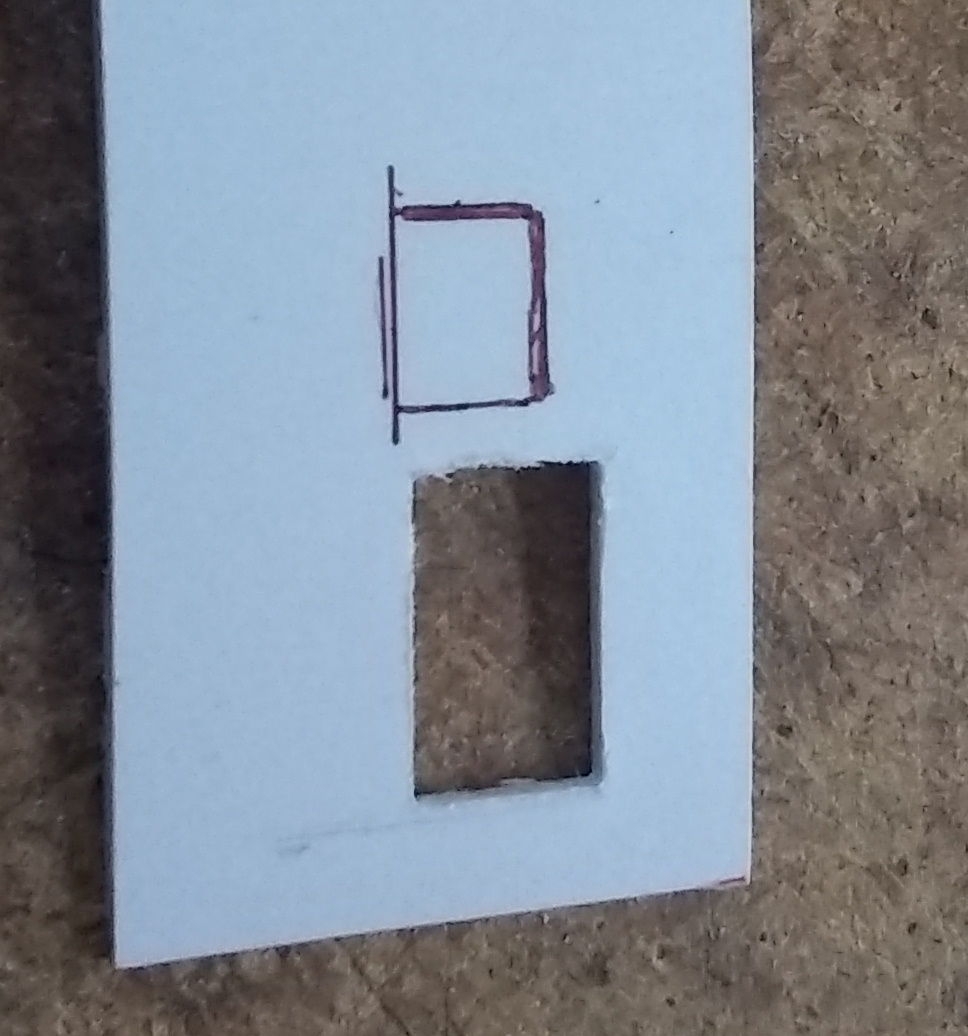

Next up is the screen hole! Time to get more hands on!
Not bad considering the tool was just as big as Hello Kitty, herself! ^_^

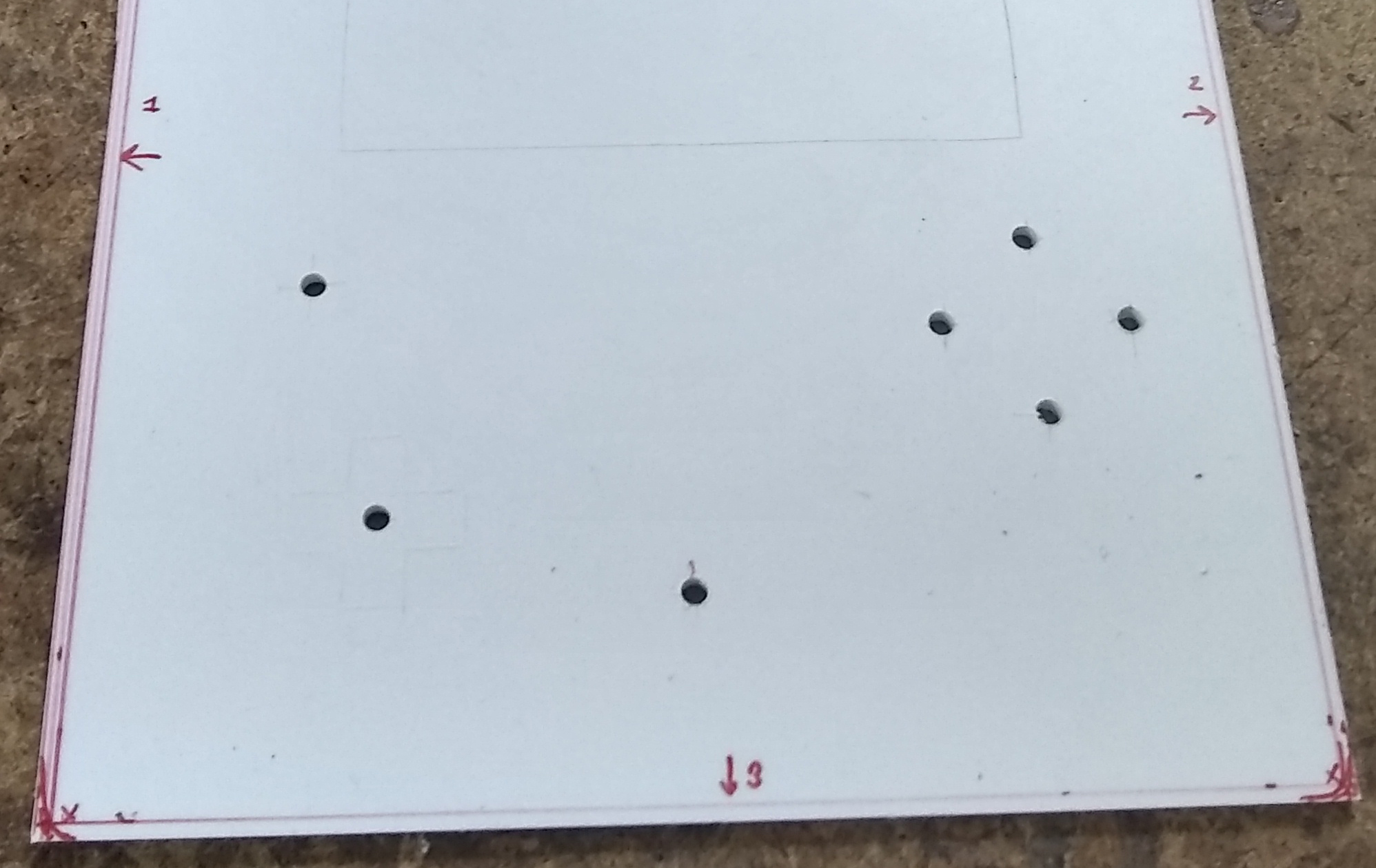

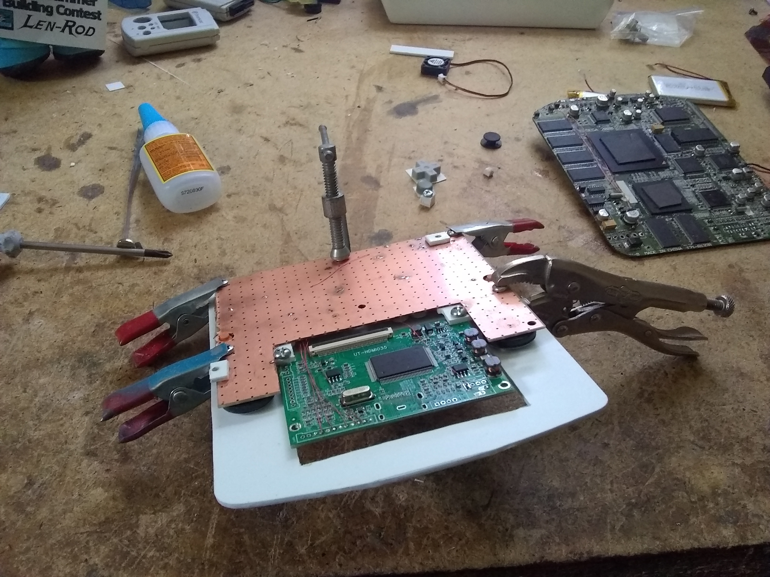

Last on today's list will be getting the buttons finalized and attaching them screw posts!
Spaces marked....
*Star Trek computer voice* CLAMPING CLAMPING
Looks like everything fits nicely! :D

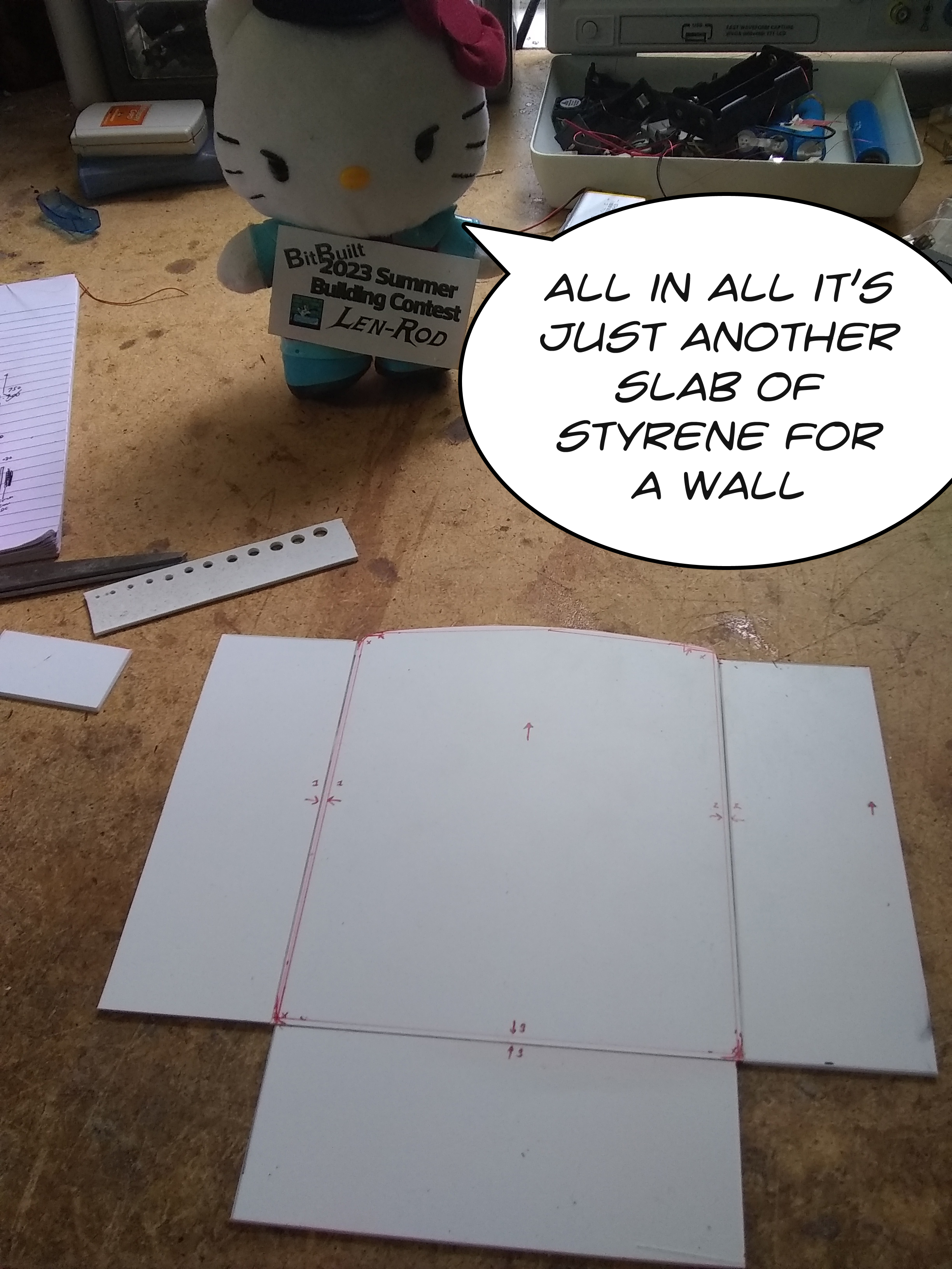

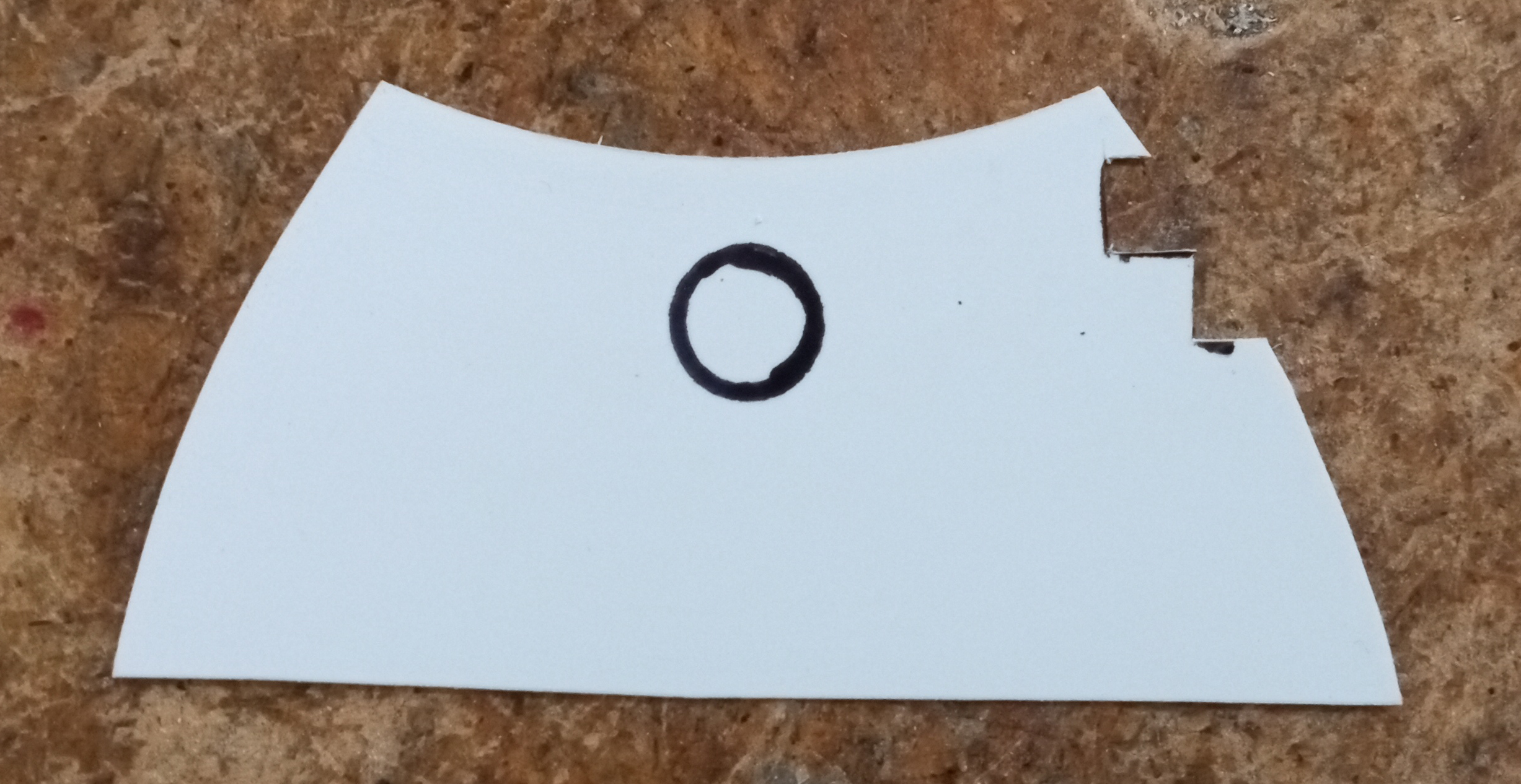

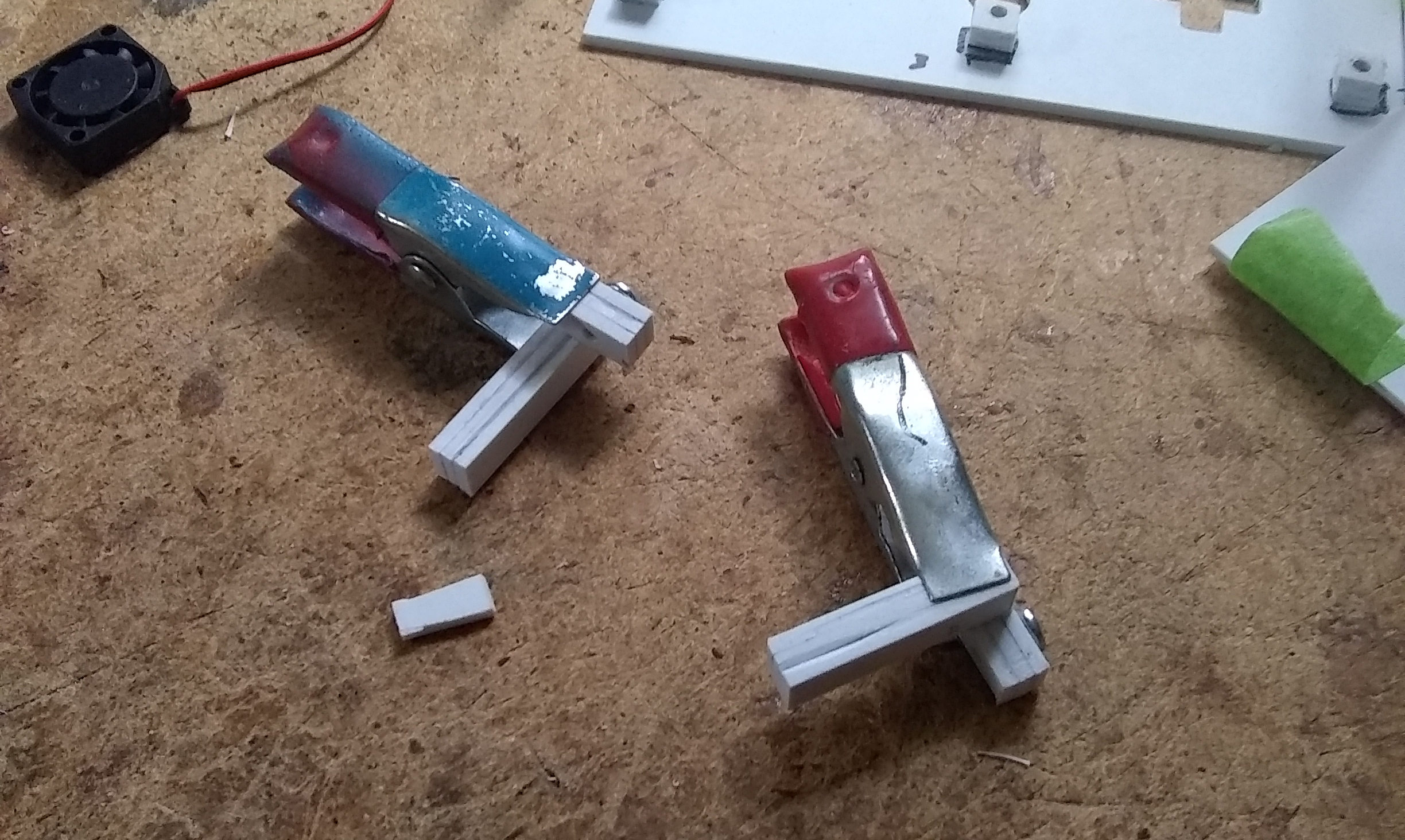

first thing on the list....making some structural posts!
Much gluing and clamping...
then more gluing and clamping...

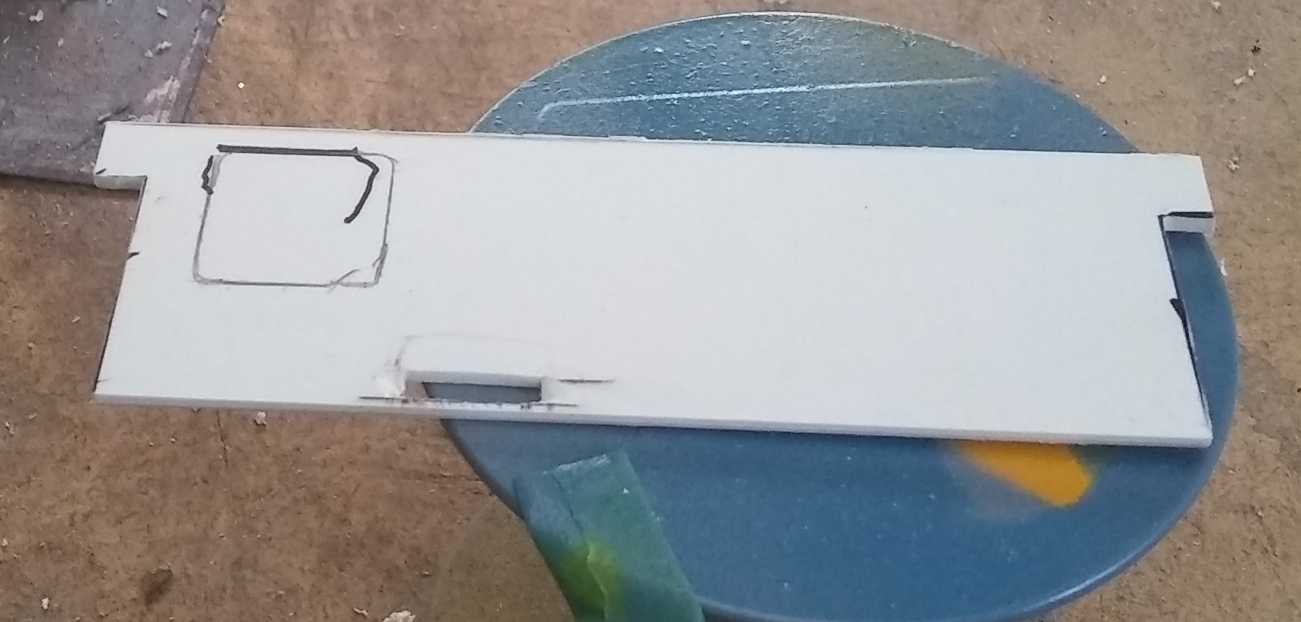

With the structural posts created, i can now move onto the walls!

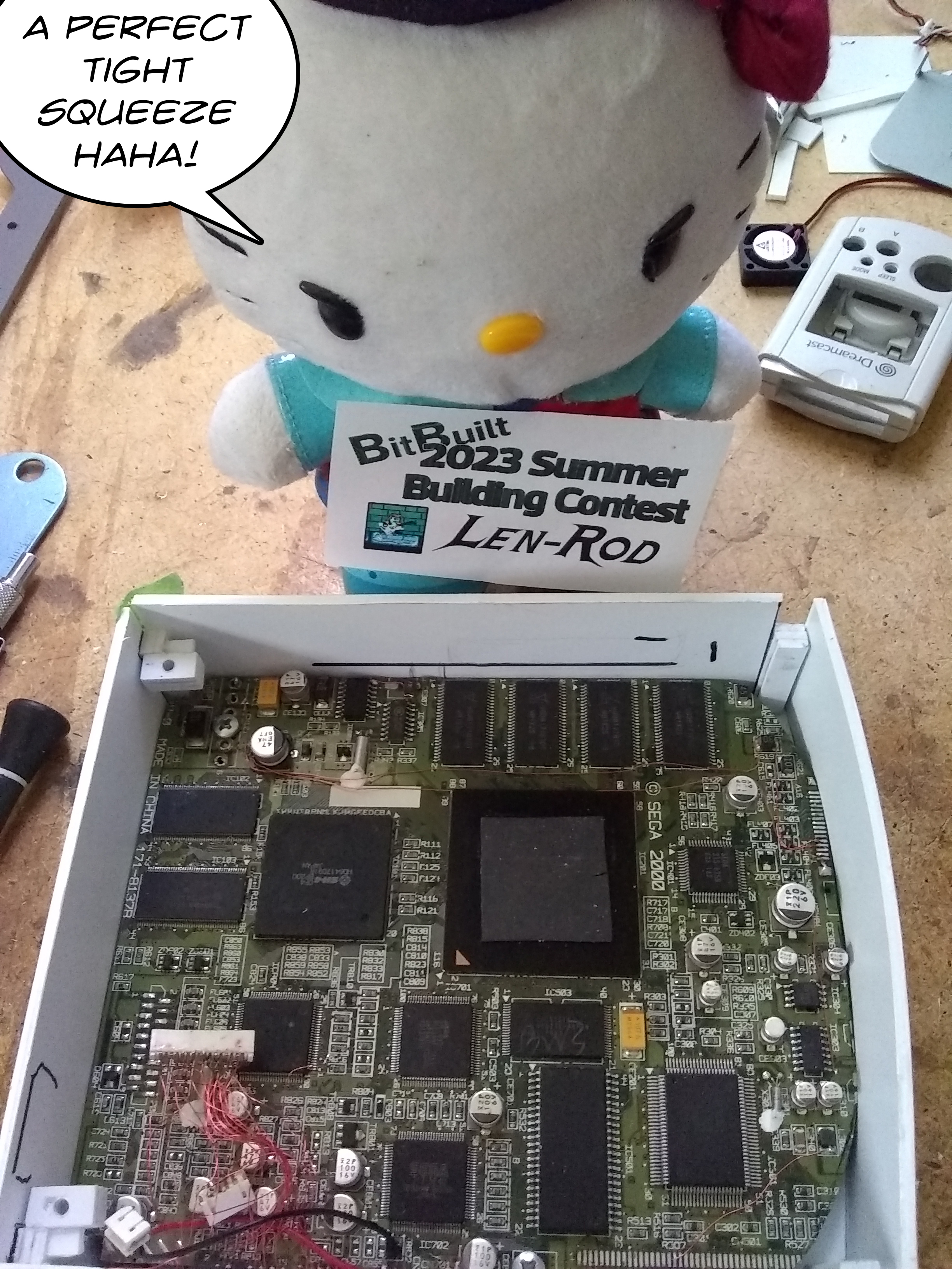

After much chopping...I can do a test fit to see if it all fits in...which it does!

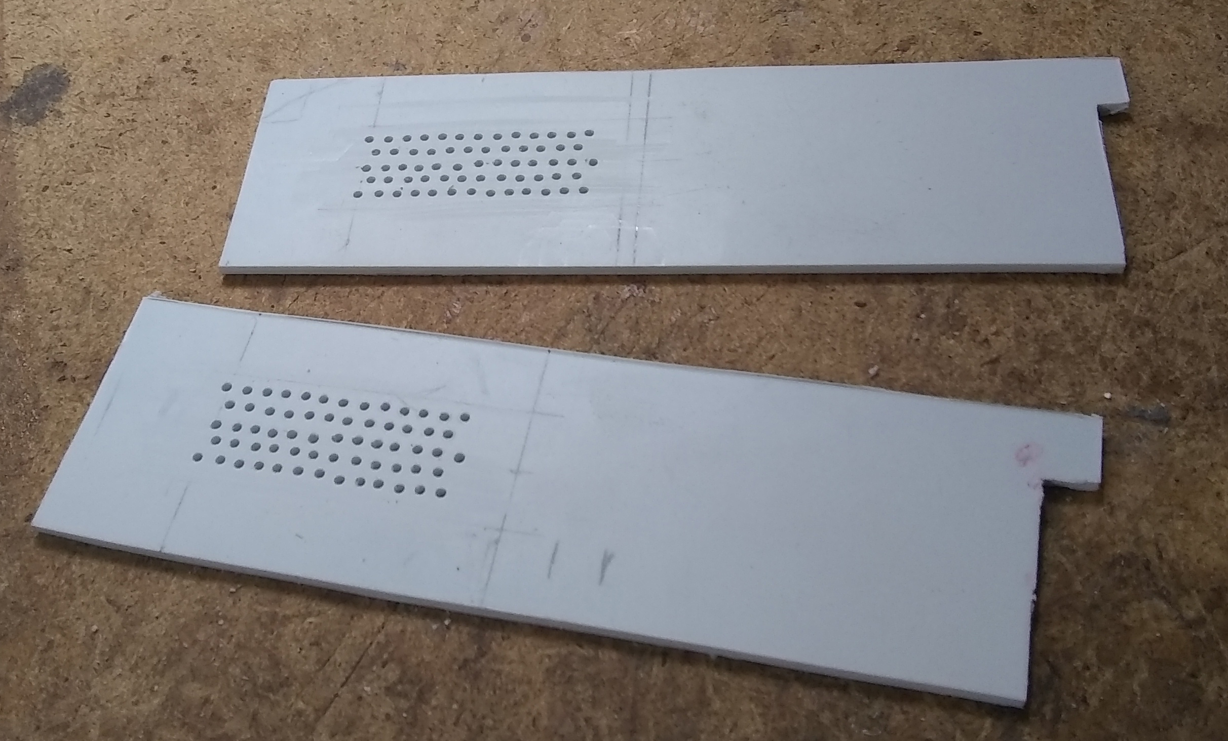

Oh, but we won't stop there! no no no! Now it's time to make more holes!
First up are the air inlet holes on the sides...
Then we can get to the holes for the cooling fan and the volume pot.
Speaking of volume pot, my new pots arrived in the mail, so that's finally attached now :)

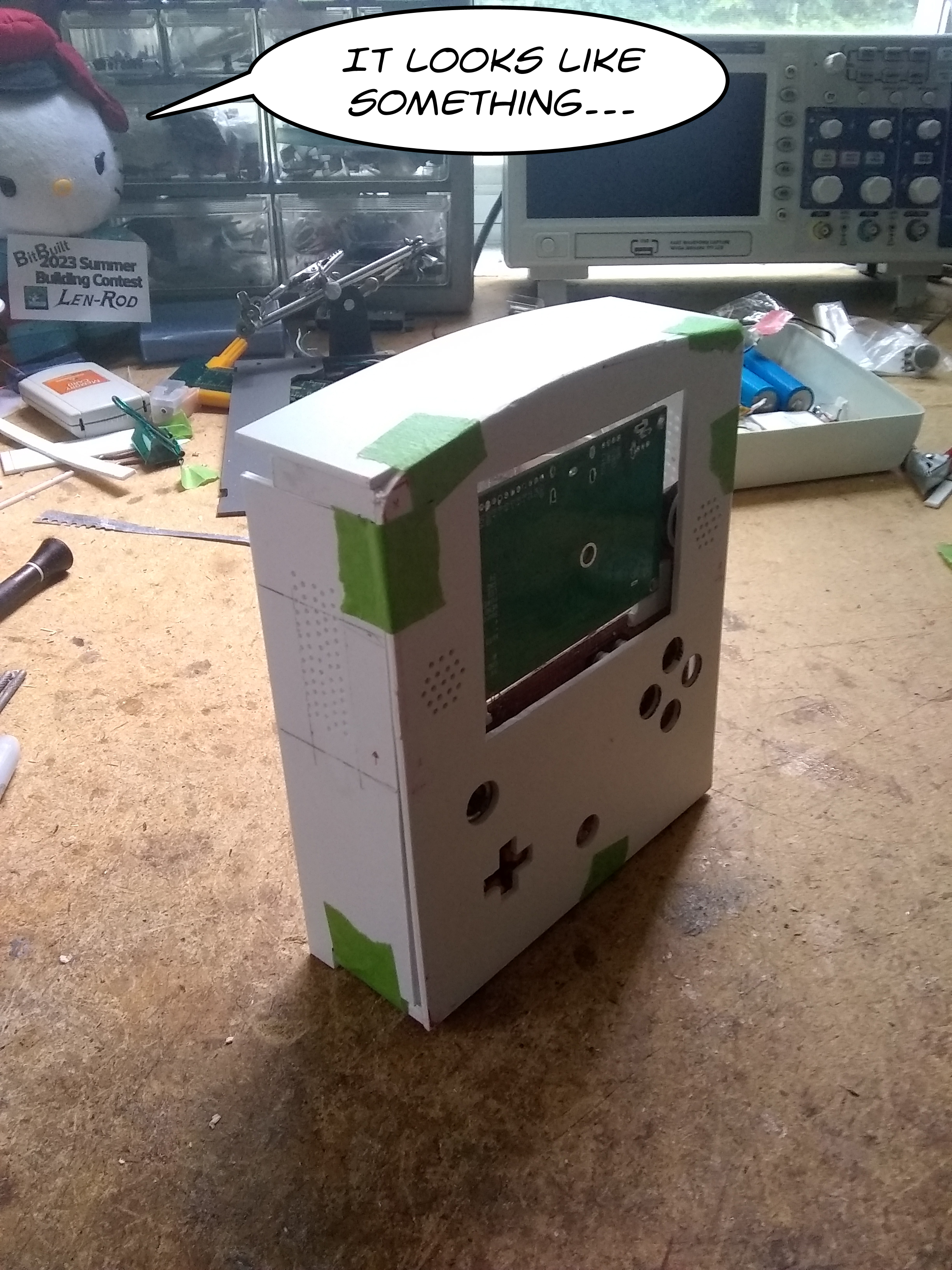

aaand after all of that...we can finally get a first glimpse into what the overall shape and size is going to be!
All right, we're getting there! Soon I shall unveil my secret master plan for the DD....and it's gonna be shiny!

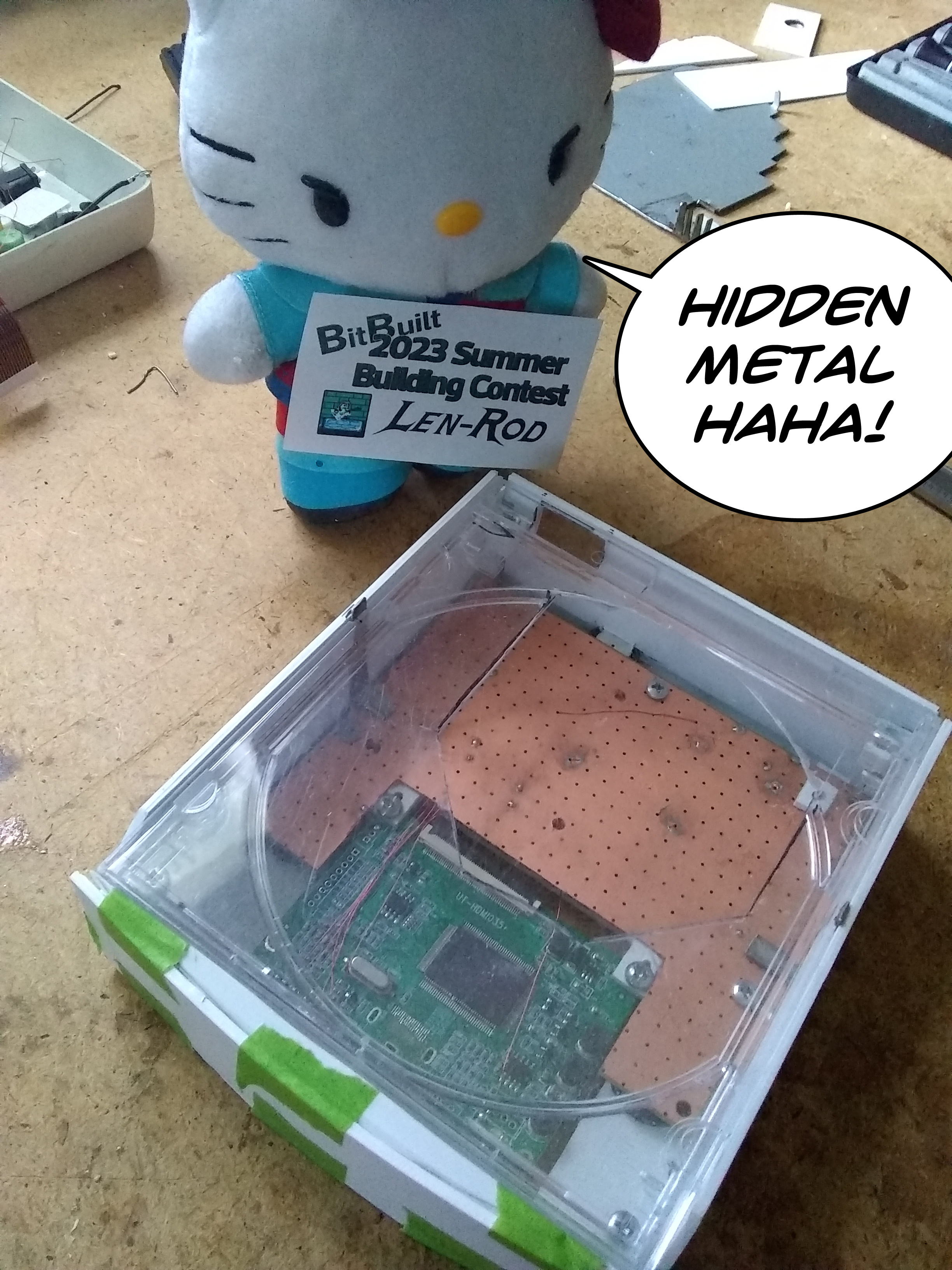

EPISODE 19: The case of the CD Jewel
OK, so the next phase is happening!

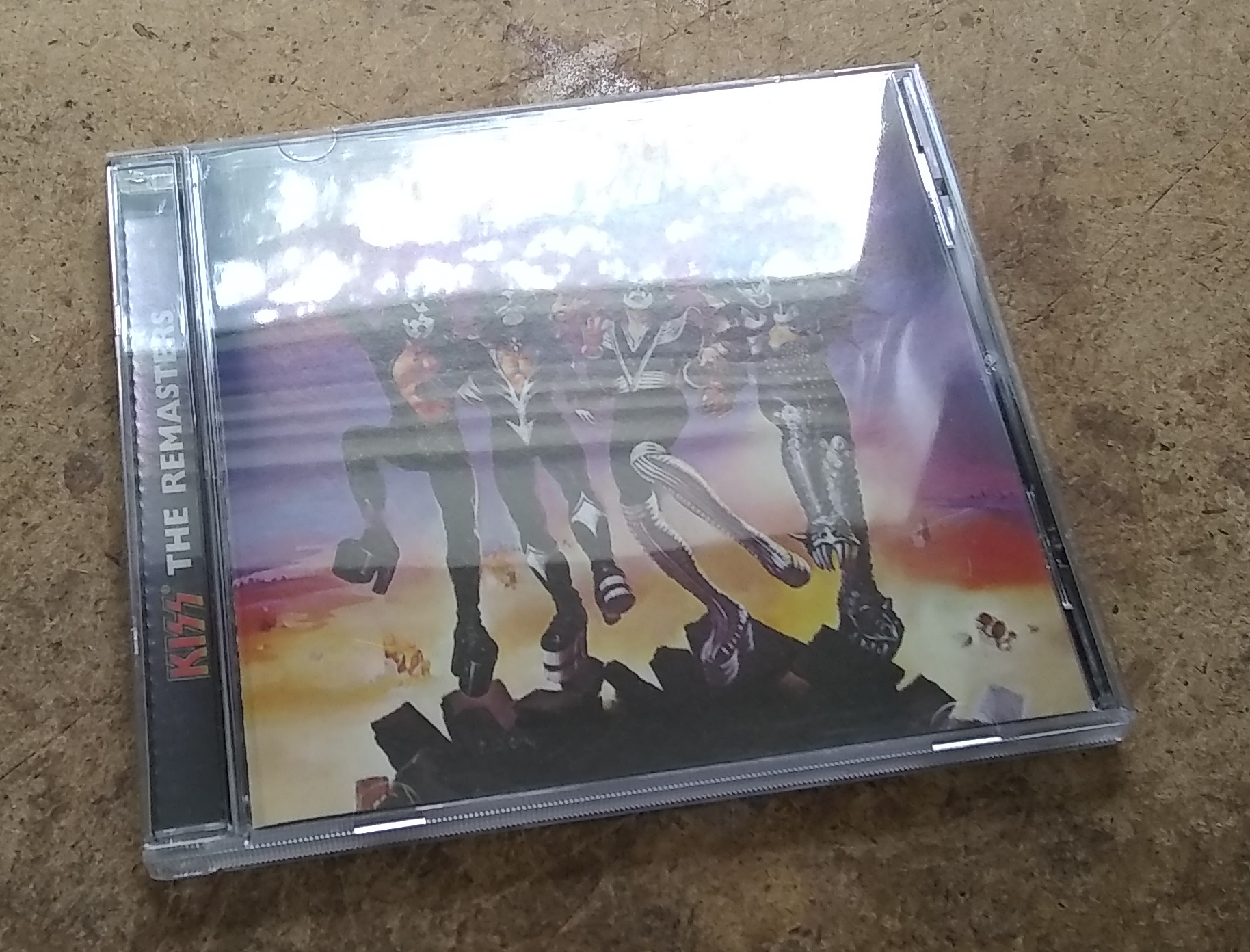

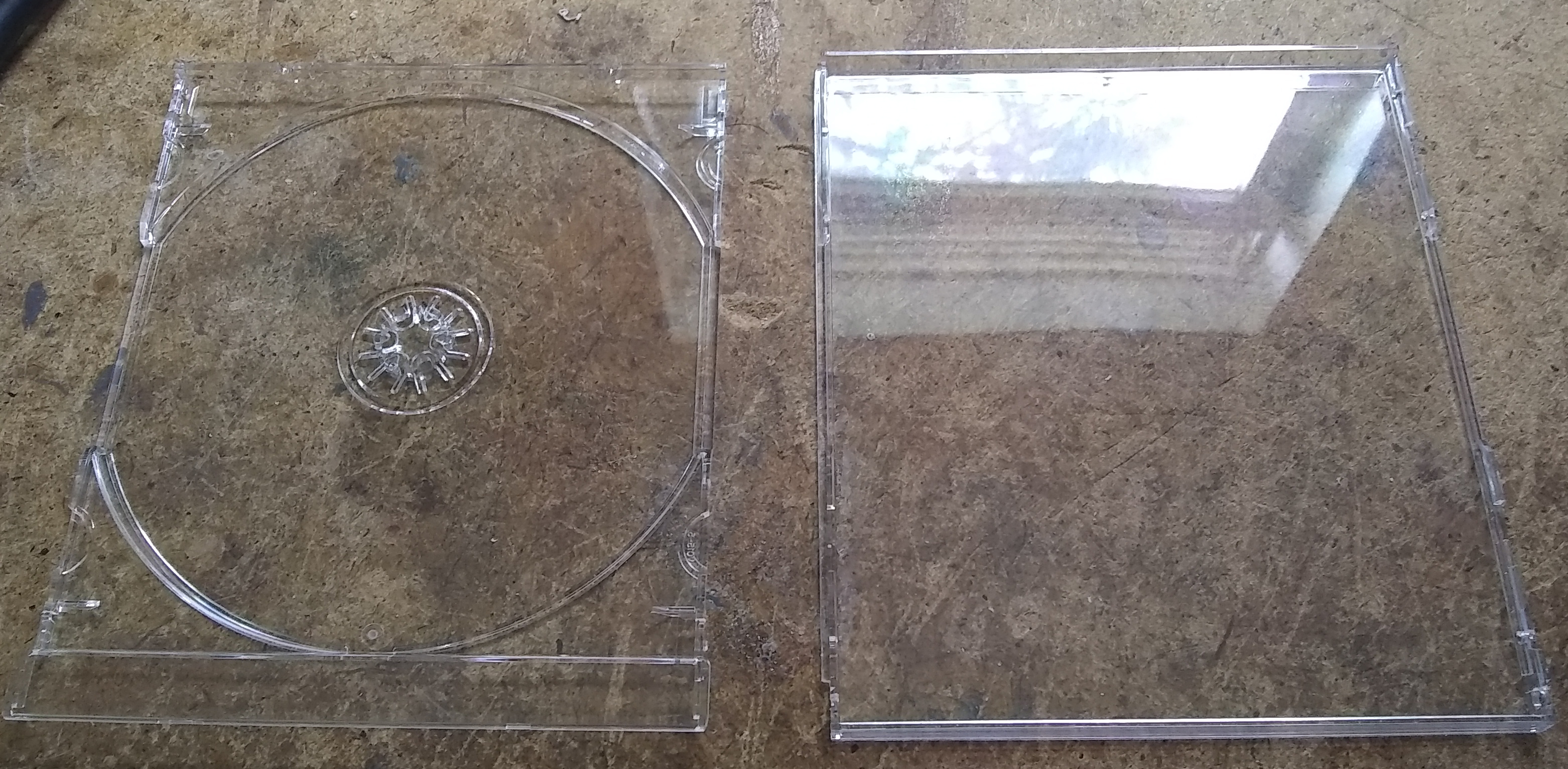

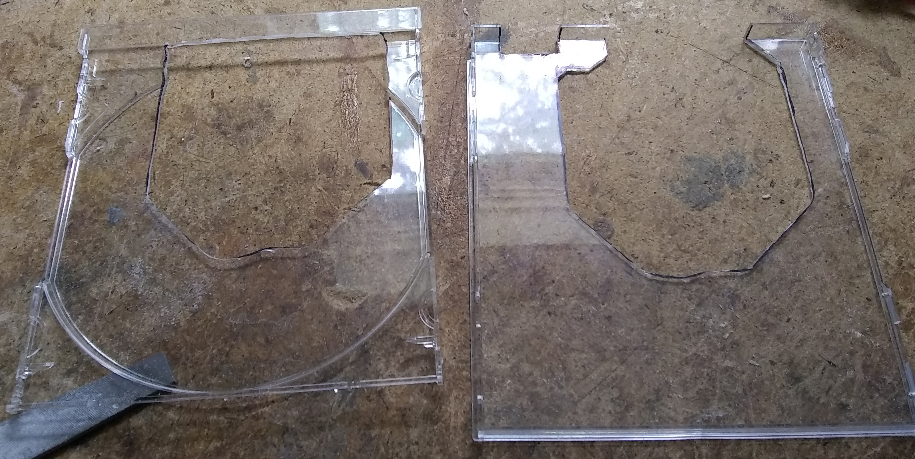

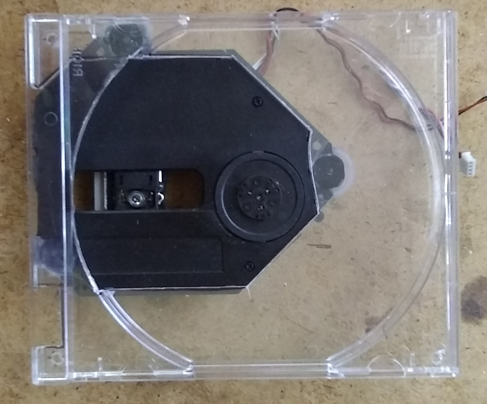

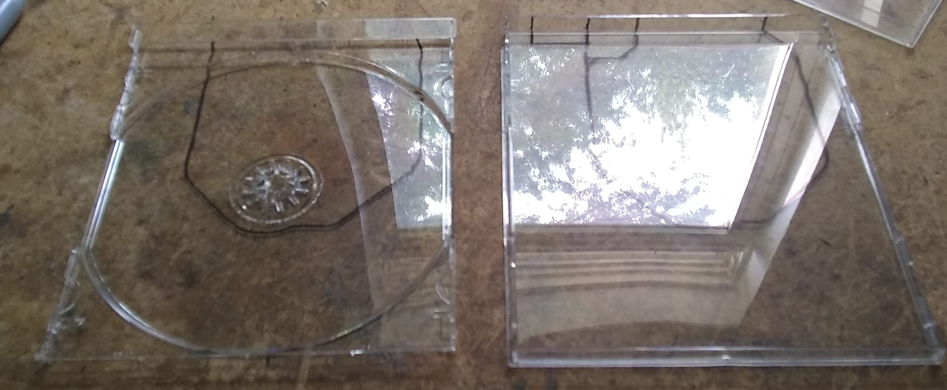

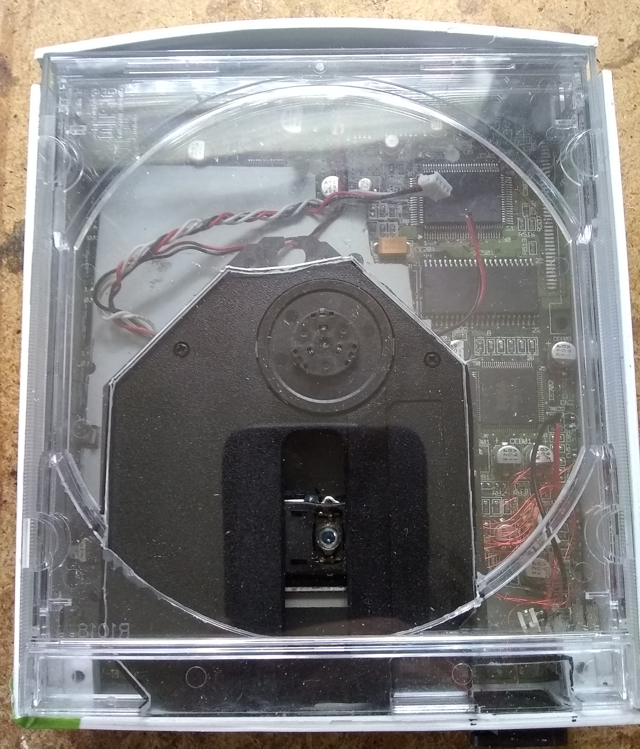

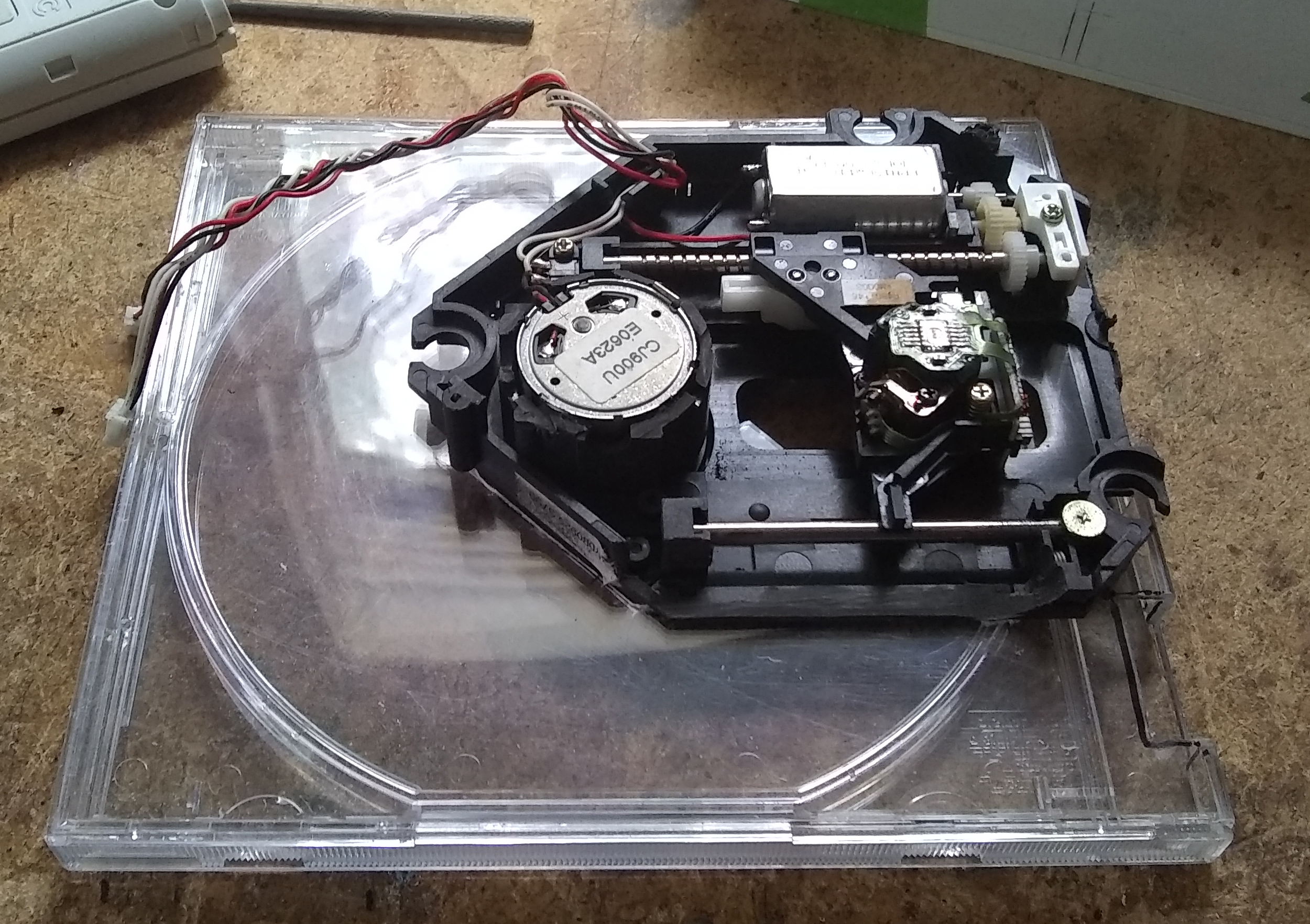

One big issue I've had with disk based formats in the past is how to keep the whirling disk from chopping up people's hands...
The height and width of this thing is roughly the same as a CD Jewel case...and then it hit me! Use the case to make a lid and base for the DD!
As fate would have it, I just so happen to have a box that is loaded with around a hundred or so empty CD jewel cases!
...empty because some a**hole stole the disks many many years ago >_<
Bonus points to the first person who can name what album this is ^_^

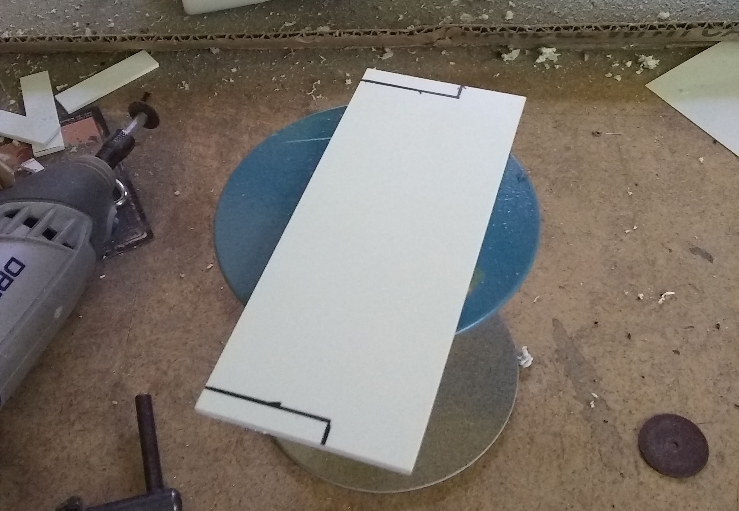

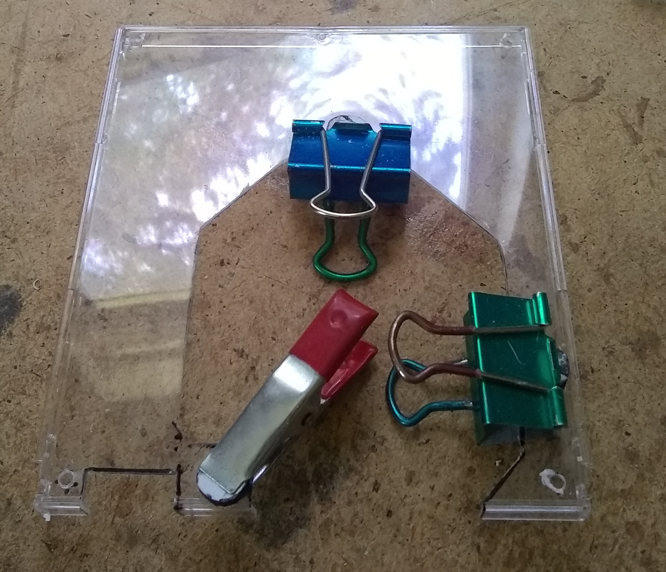

So how do we do it? It's easy as...
1!
2!
3!
Well, sort of. I did totally biff this particular set somewhat, and had to redo it a whopping 3 more times before getting it right LOL.
BUT! I got it right eventually! Good thing I have so many to use!
Just look at that smexy fit!

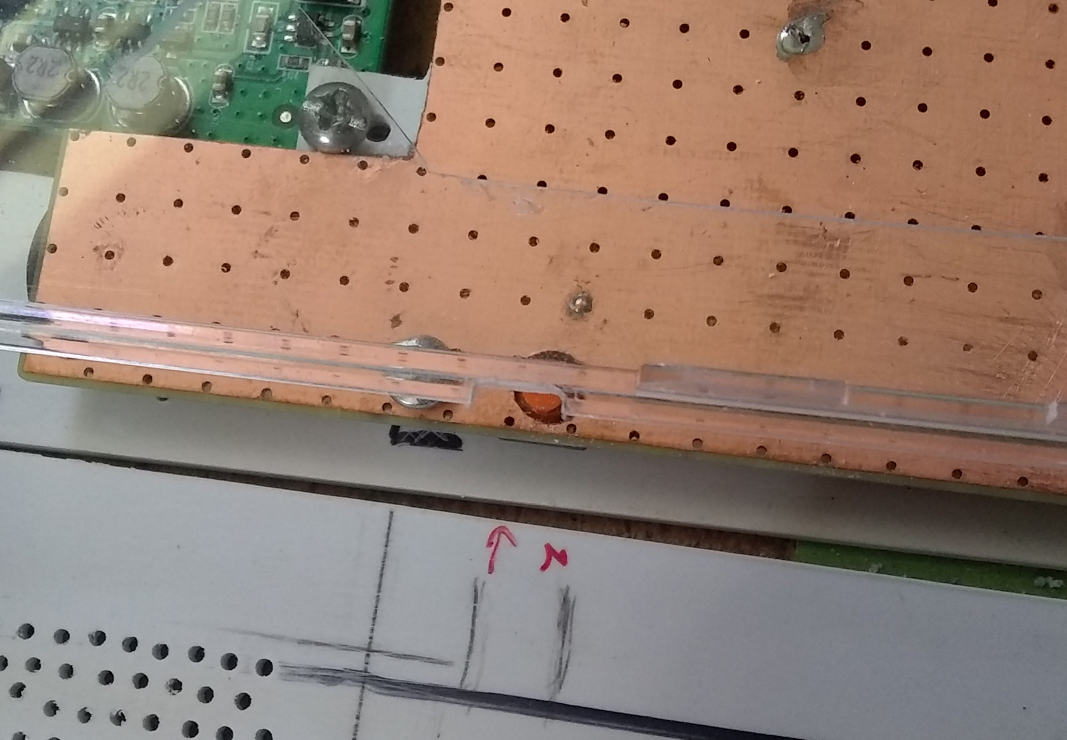

Last thing for today...mounting posts!
I considered doing the posts with clear acrylic...but eff that god-awful material! Gonna stick with my good friend; polystyrene...just gonna paint it black to match the DD :)

Oh my goodness using a transparent cd case as the shell to house the actual cd drive is freaking brilliant. Such an aesthetic way to show off the spinning disc.
The album is Destroyer by KISS
Not only is it clever, it's the most beautiful disc setup I've ever seen.

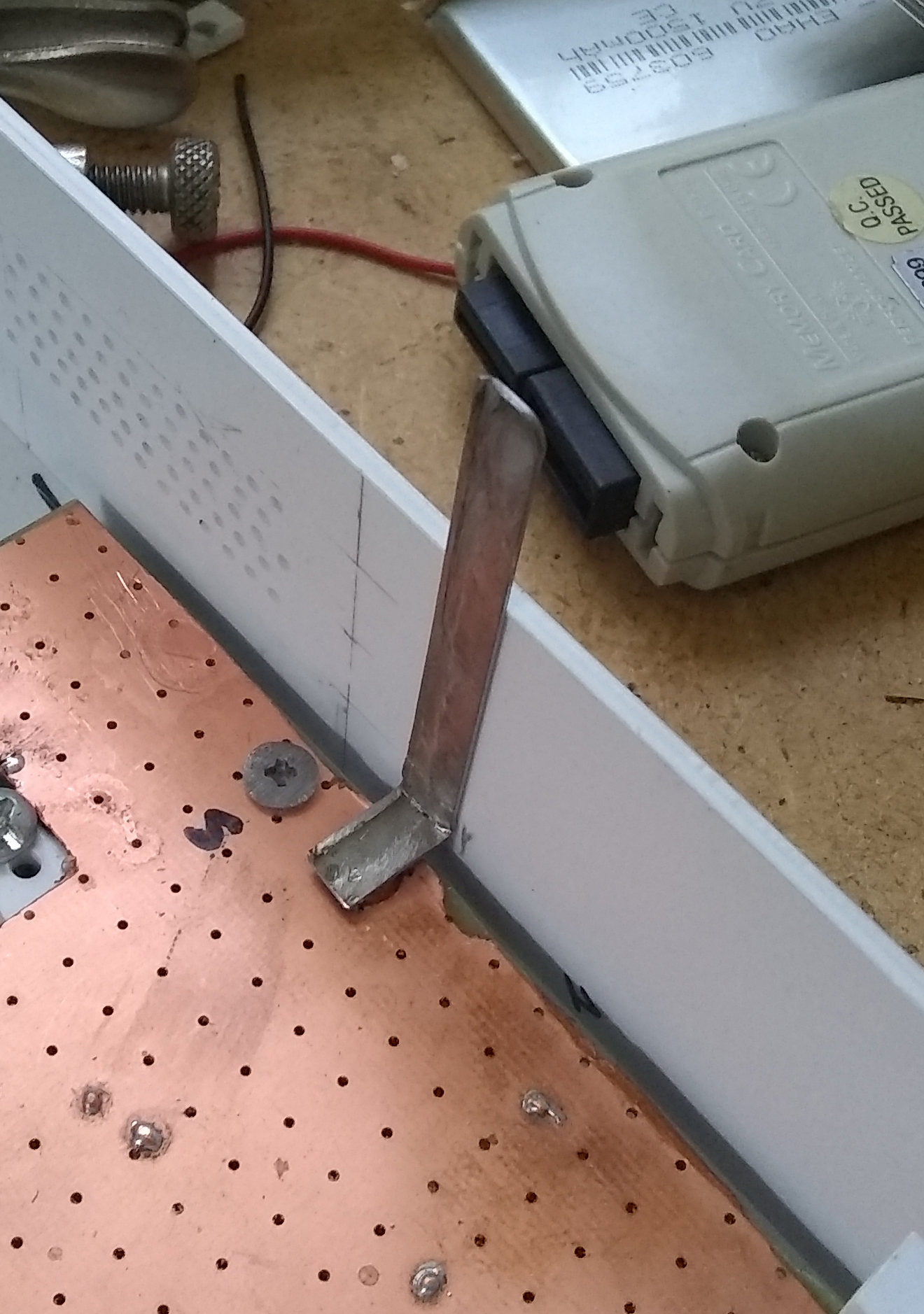

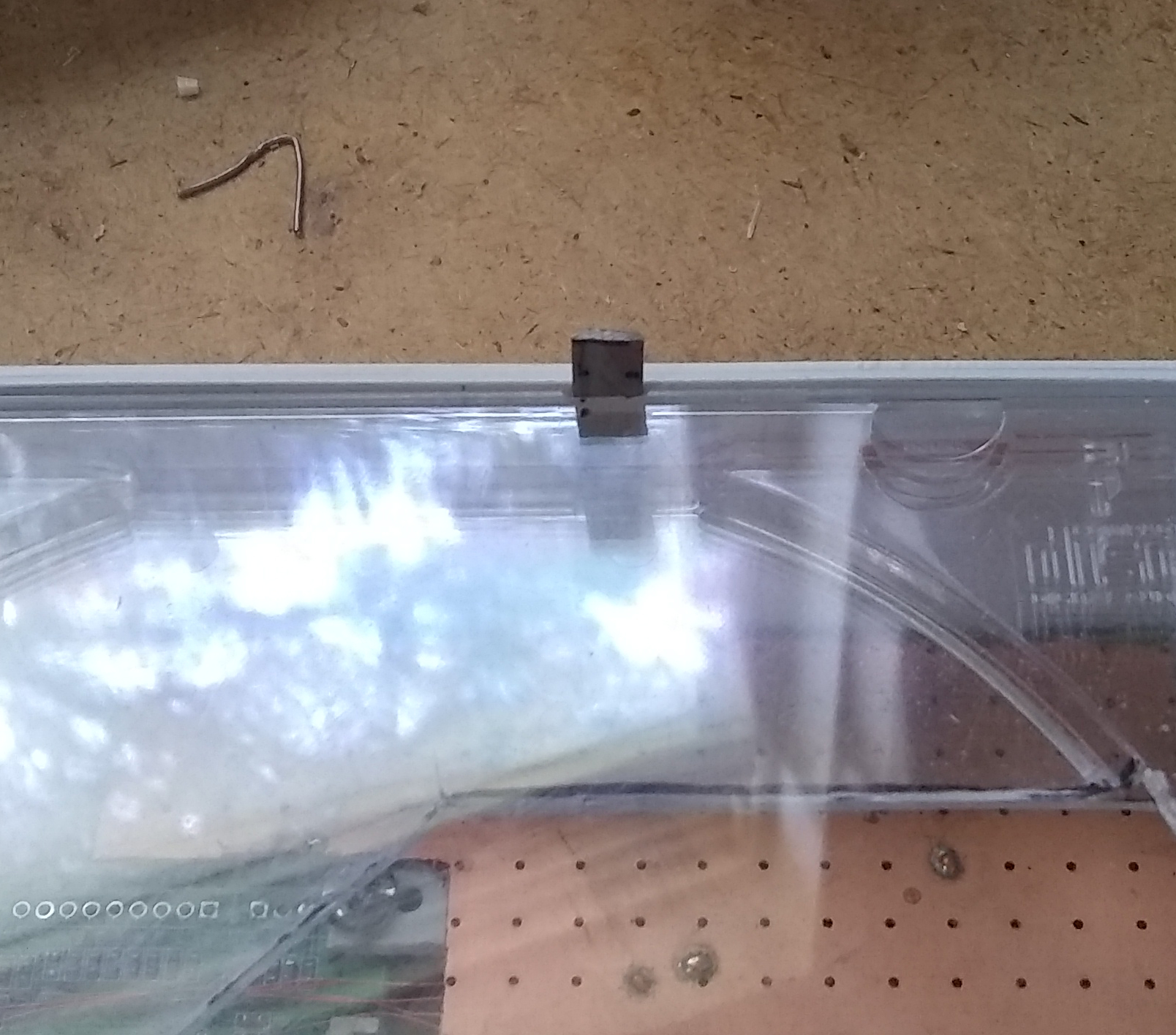

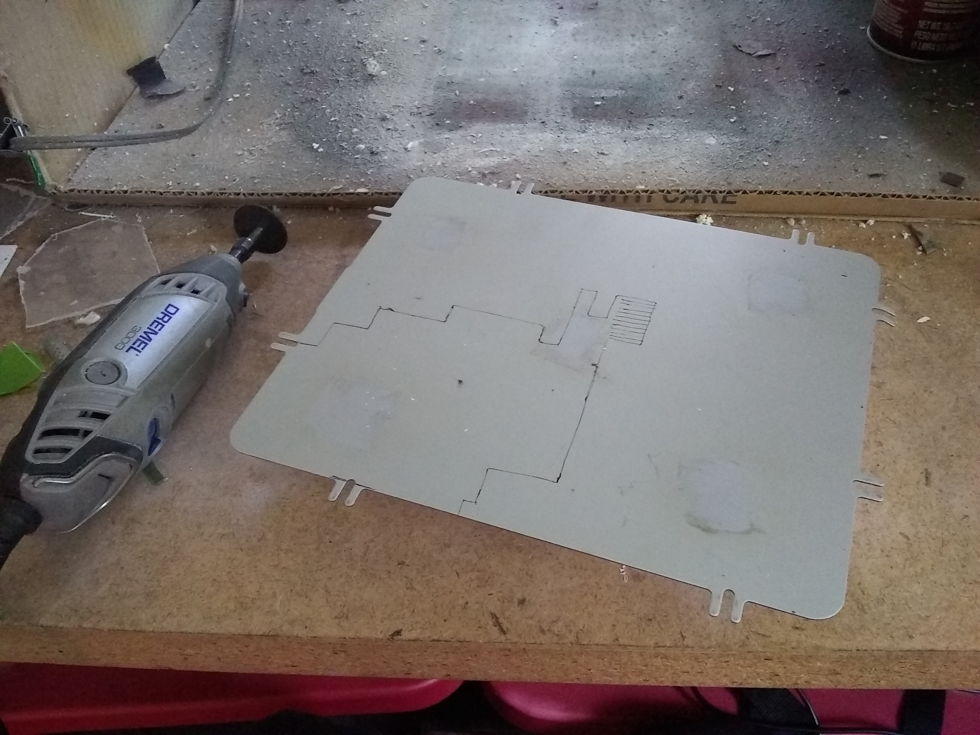

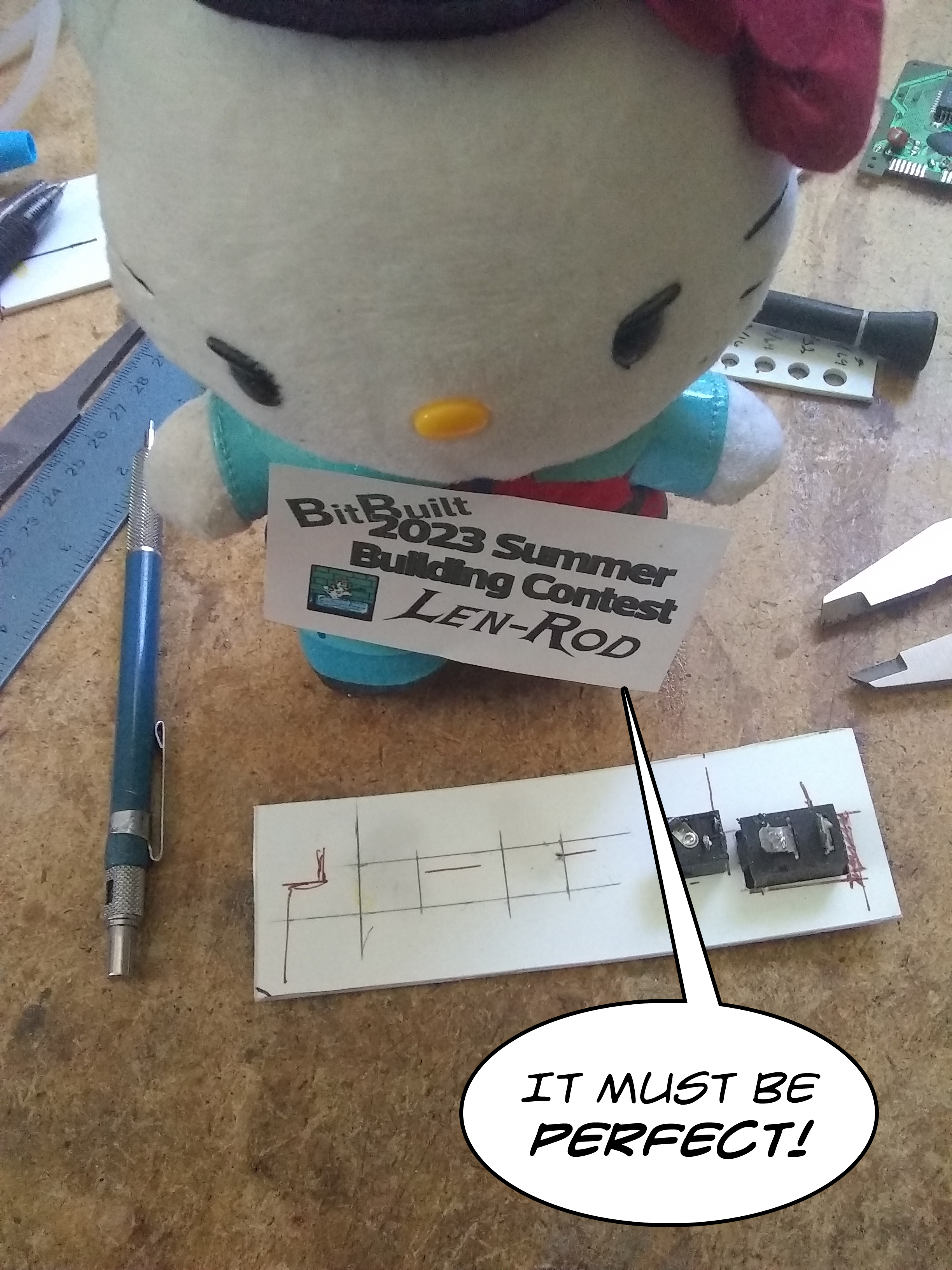

Now onto the next hurdle...figuring out how to actuate the L & R buttons.
After some pondering, I came up with a plan! And that plan requires some metals....this chunk of an old printer should do the job!
Did some chopping and a good slab of metal has been created for the task...
Aaaand here's the idea...small and simple.
...and with a little groove carving...
...We get a very nice little gap for the bar to poke through!
I was planning on putting some button caps on these...but these little tabs seems pretty effective so far...

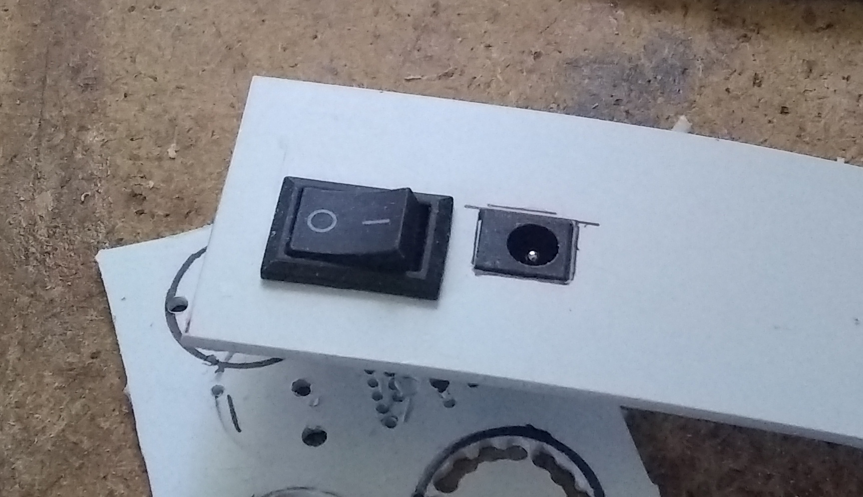

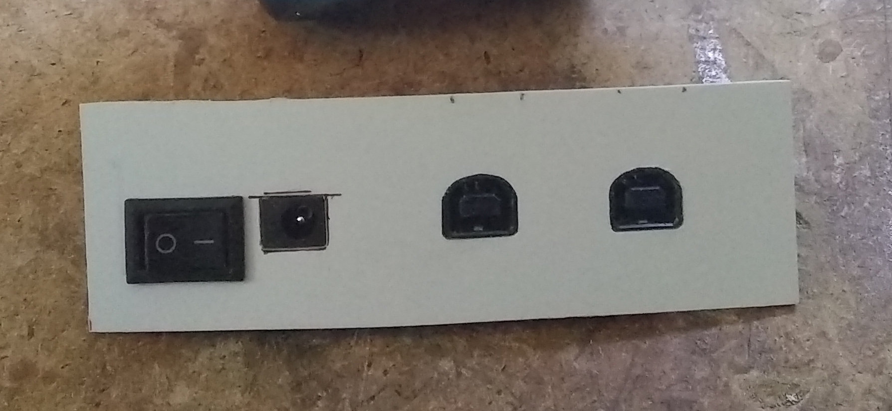

First on the day's list...the POWAAAAAAAAAAAH Switch & Charge socket.
A fine, snug fit for all!
Next up was the dilemma...I wasn't sure about what I was going to do with the memory card. There is more than enough space for an integral memory card, but there is also enough space for a removable slot on top of it.
After much pondering, I came to a decision...

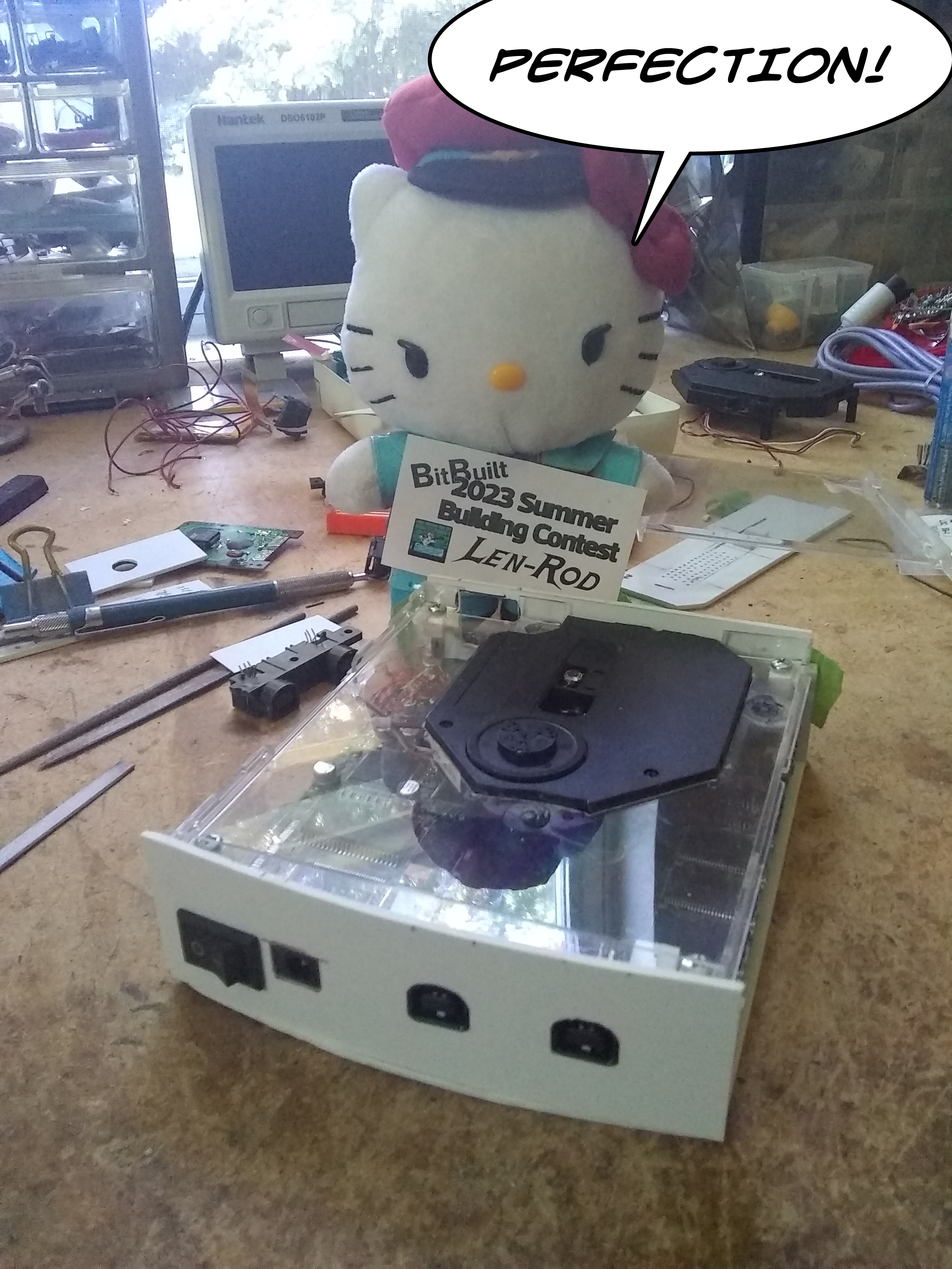

The convenience of an integral memory card cannot be understated, therefore I decided to keep that...
...but one cannot deny the usefulness of removable memory for data transfers when the onboard is filled.

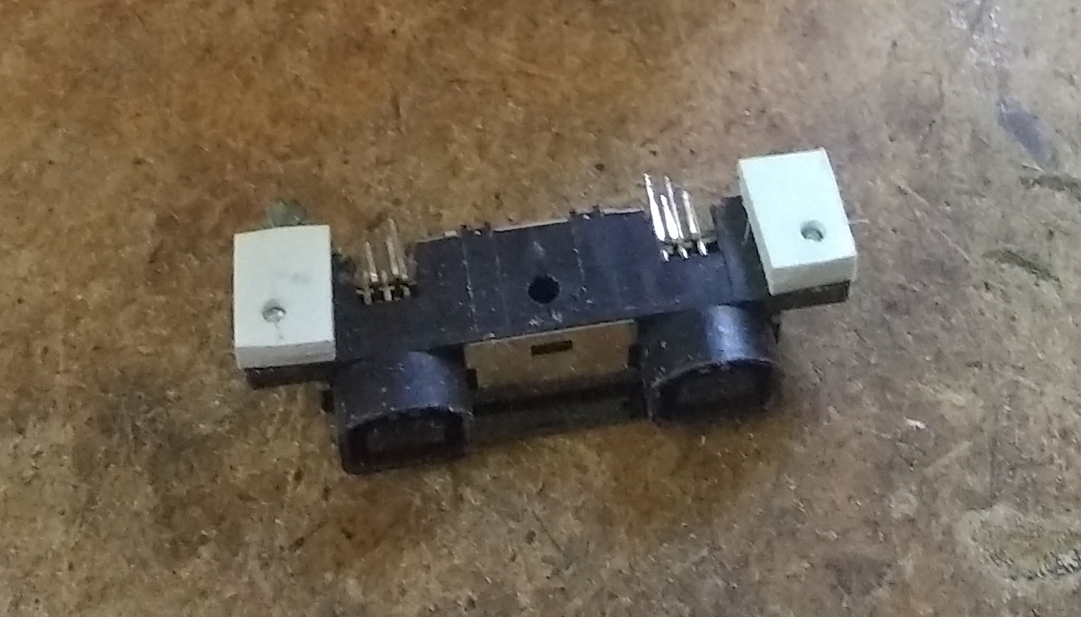

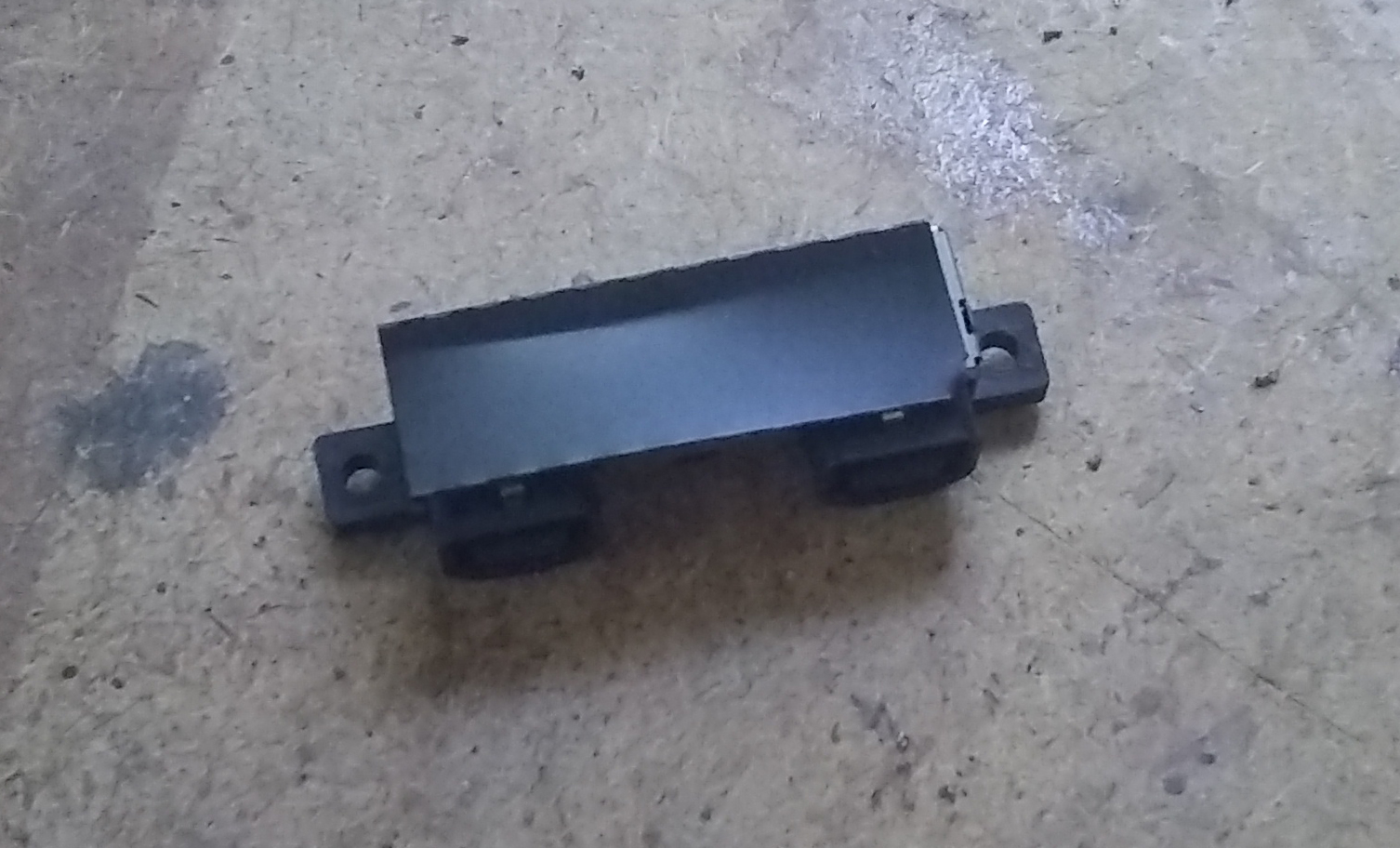

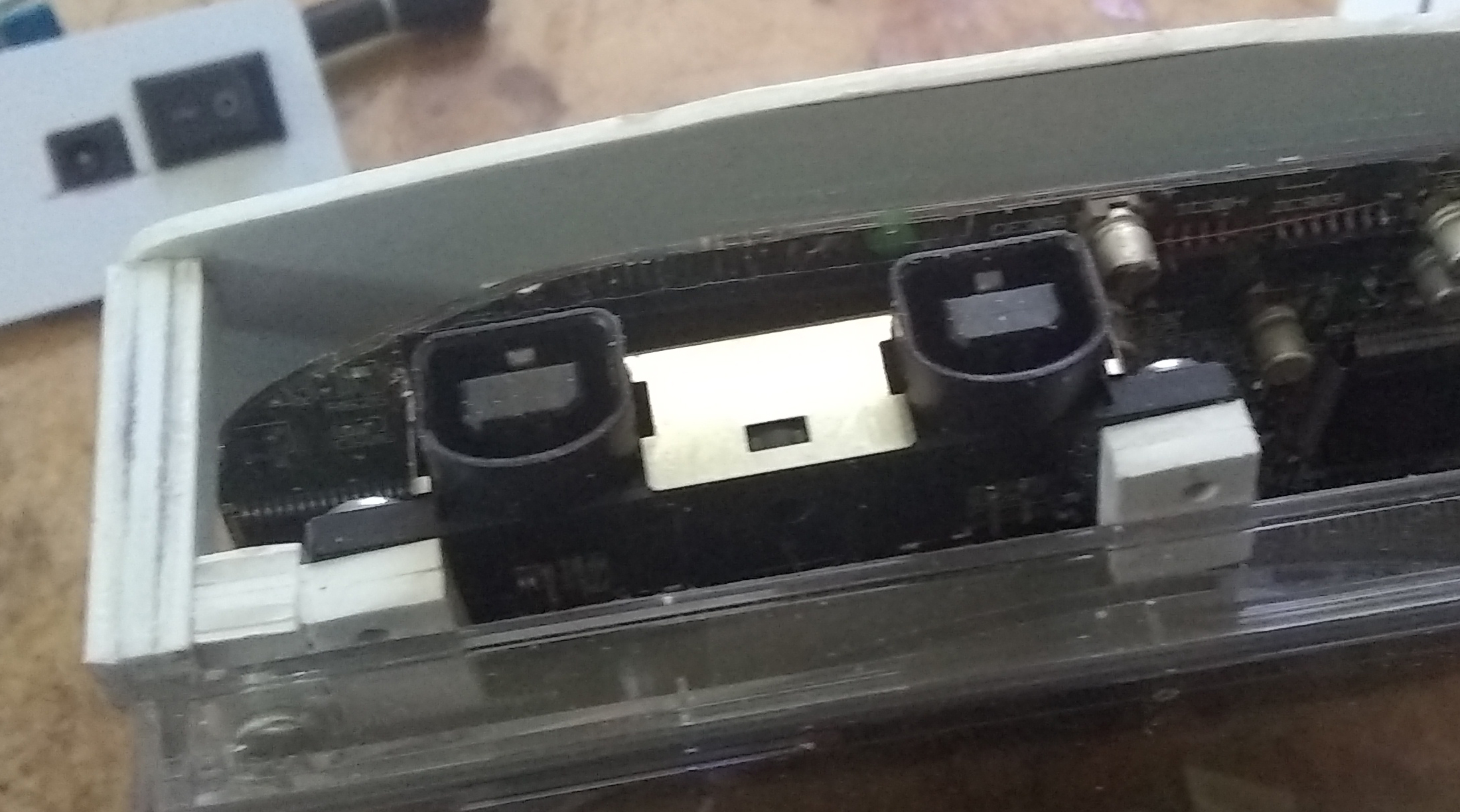

Since the DC memory cards are monstrous, I decided that it'd be far too difficult to make such a big fat hole look good.
Therefore instead of a memory card slot, a 2nd player port was chosen to do the job! Just plug the 2nd card into the 2nd controller!
But then I had a moment of inspiration! The DC's controller sockets come in pairs...
...so why not go with ports for players 2 and 3?
And with a couple of spacers...
...The fit is solid!
As for the case portion; getting the holes to line up with the sockets' attach point requires alotta fine measurements.
But that's no problem for me!
I'd say the fit is good!

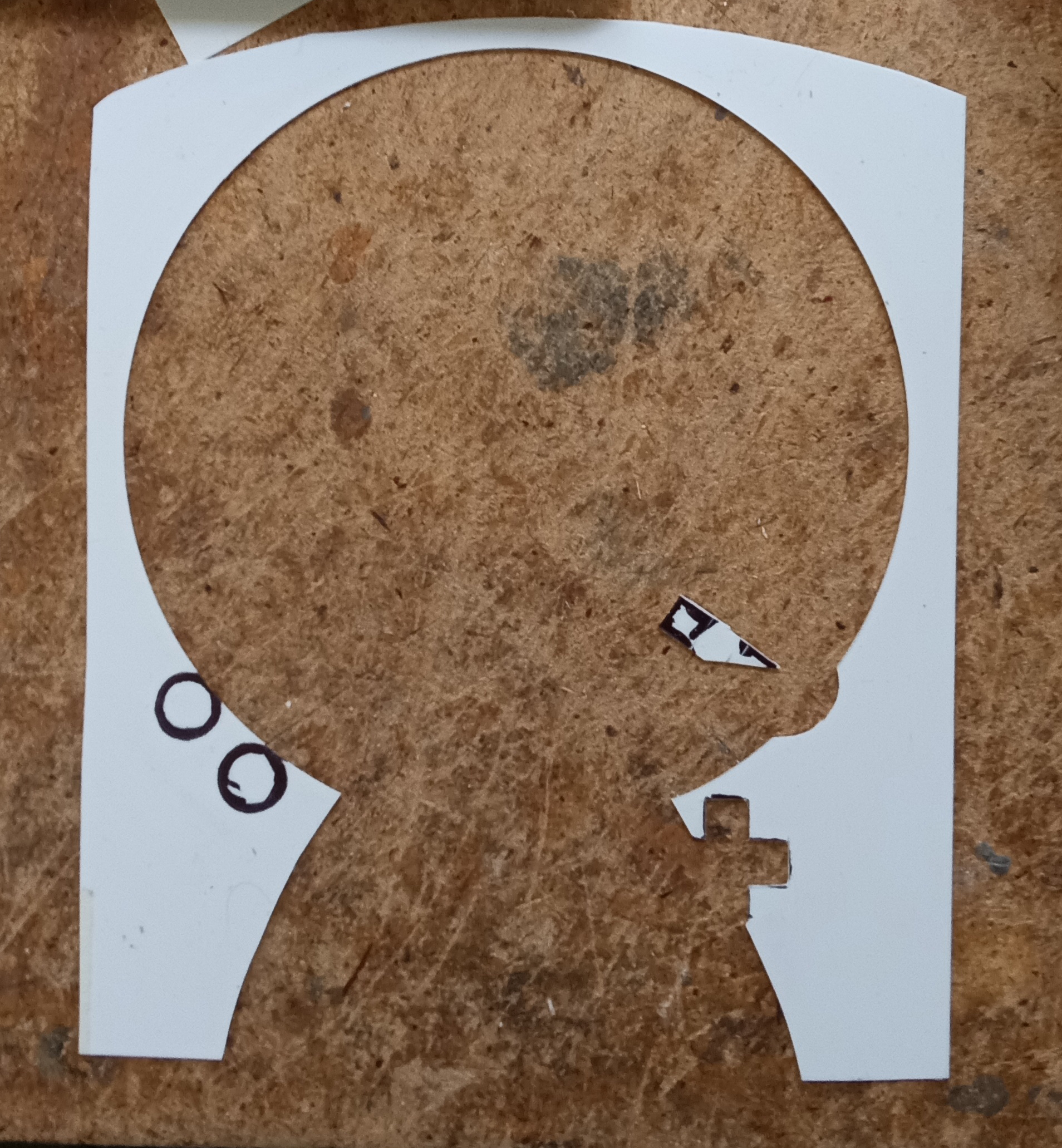

The case work continues, and now it's time to commence to some aesthetics before it gets too hard to attach them!

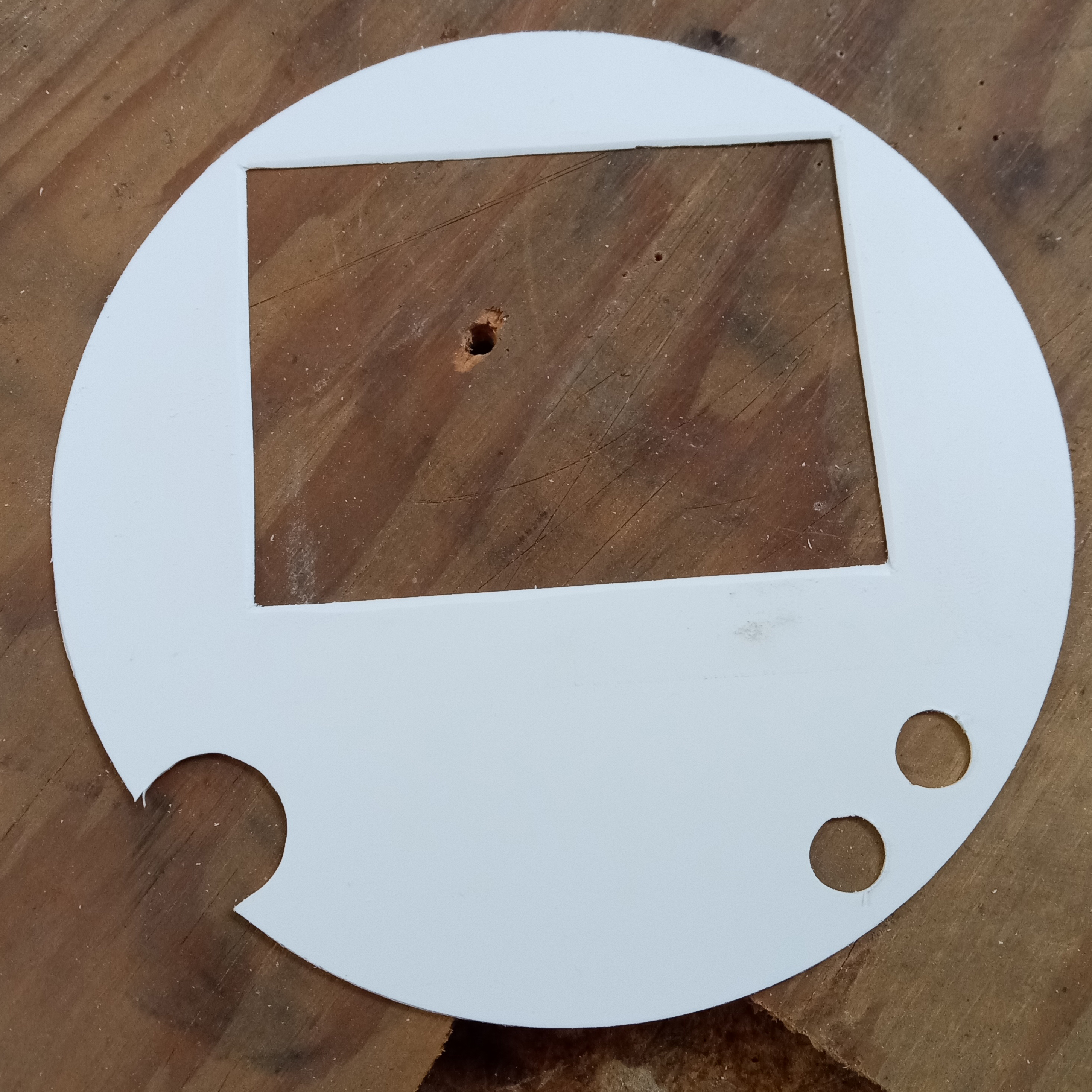

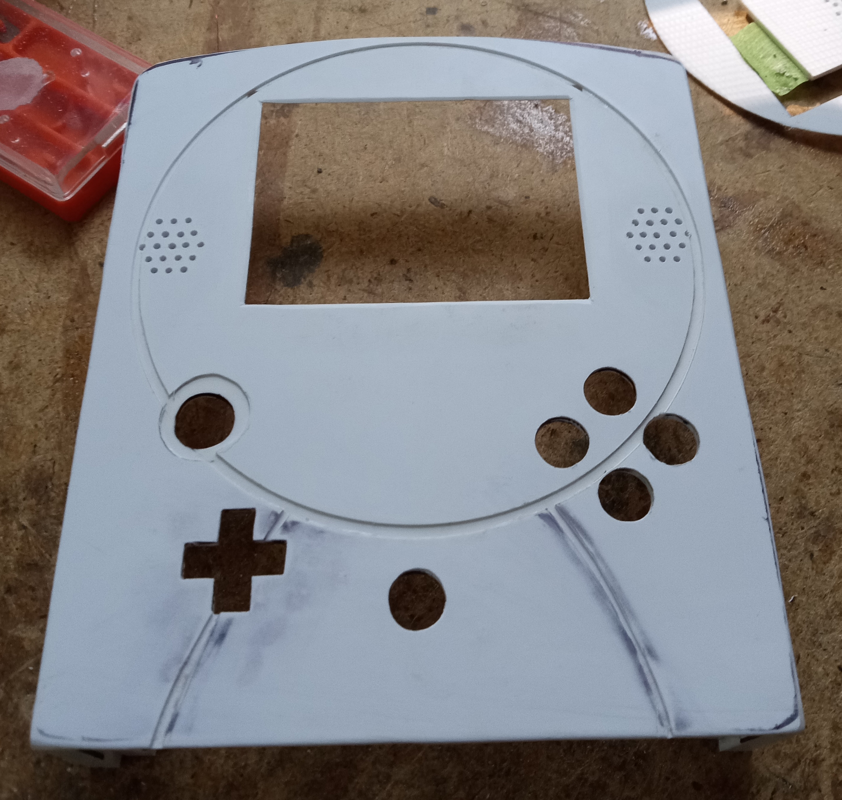

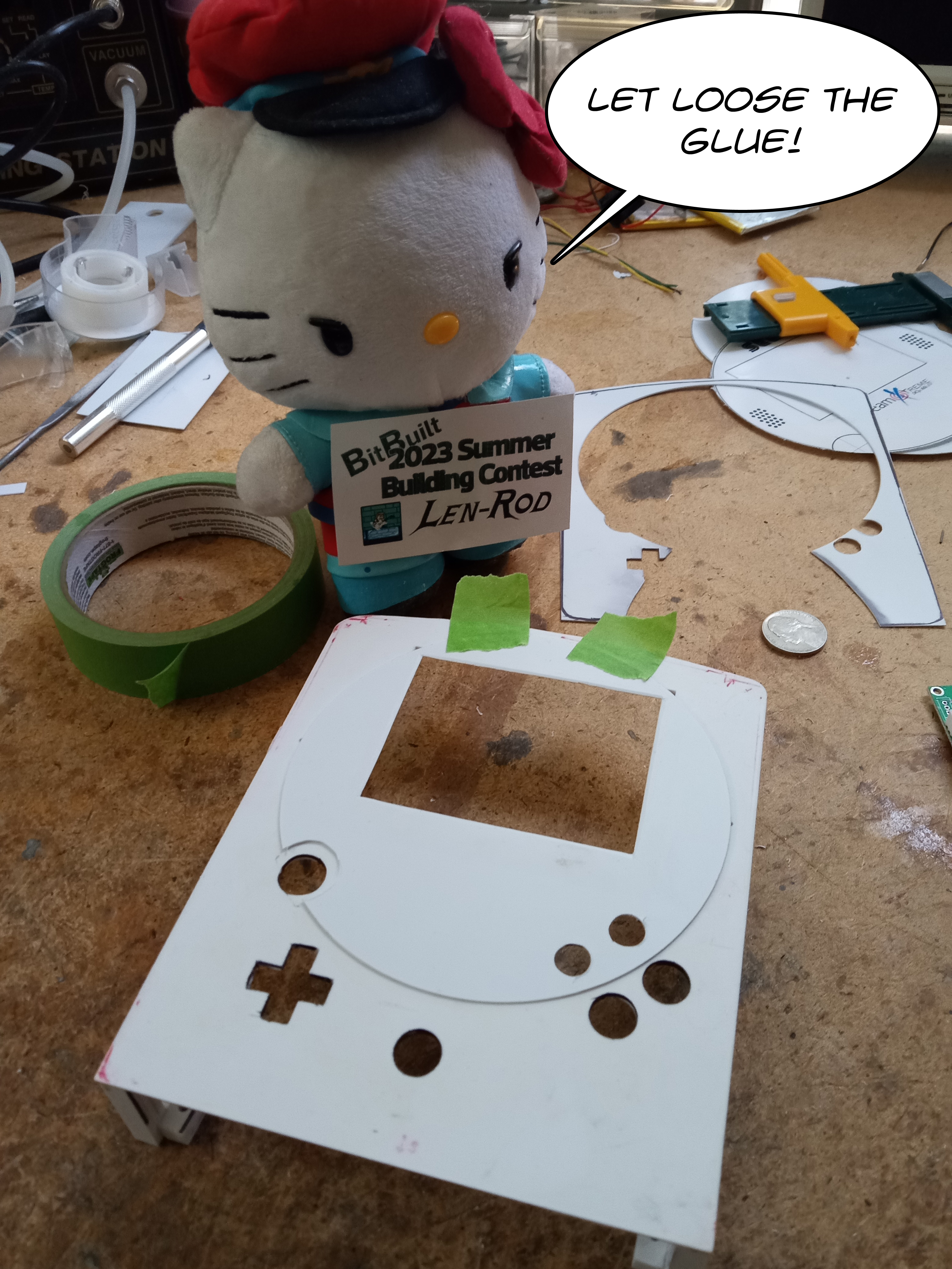

Let's begin the first phase of case front dank-ness!
It took more than a few tries, but eventually, got some seriously nice circles going :)
Got that screen hole puuuuuurfect! Even got it some nice angled edges
Now for that outer ring portion...
...and lastly the tiny middle thingy...

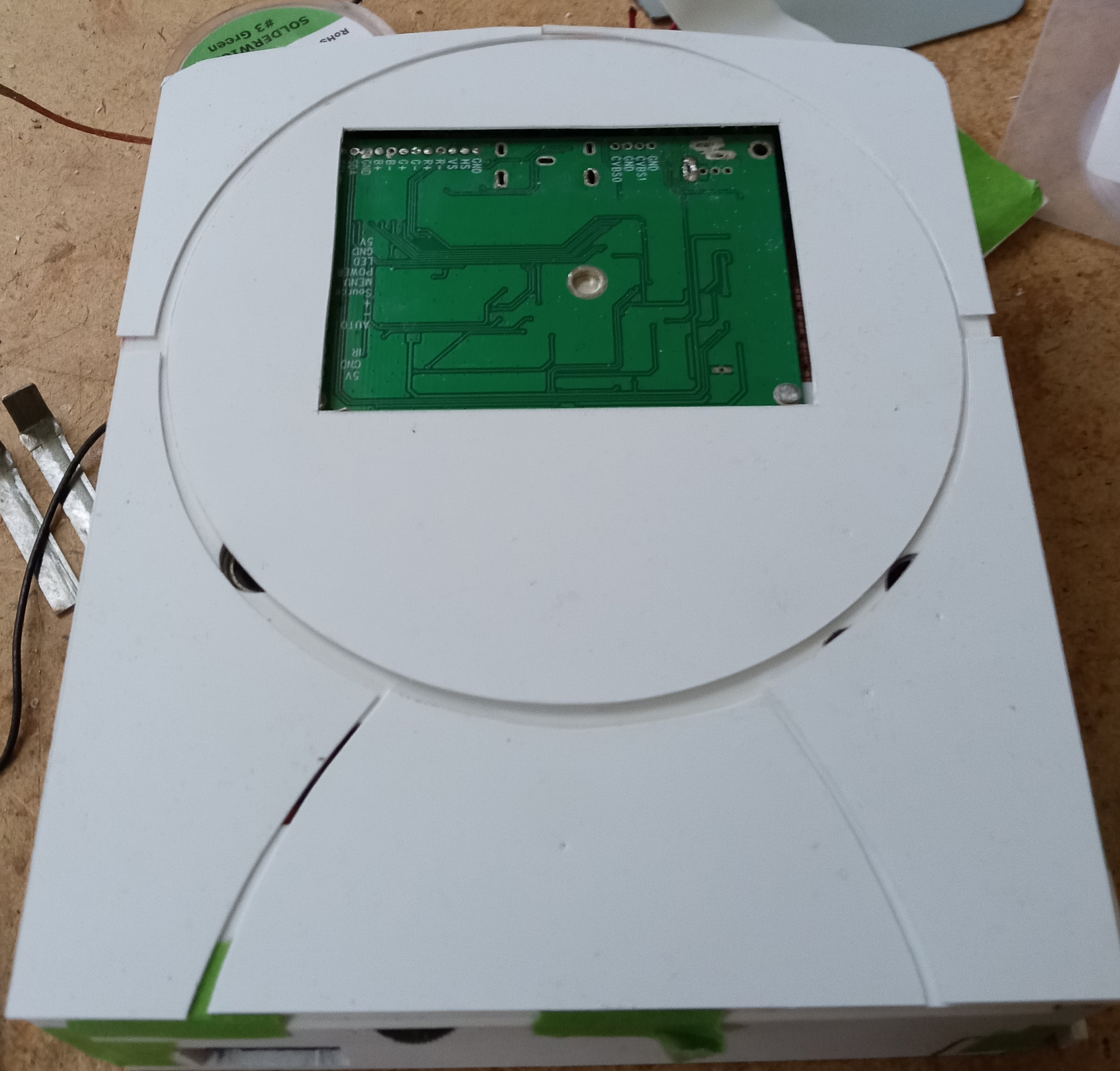

Time to get sticky!
After much glue...and some drilling...and filing....we get this beasty beast!
Oh yeah, the smexy is real *puts on cool sunglasses*
That probably took way too long lol. The circle cutting was the rough part. I destroyed more than a few sheets of styrene in search of perfection lol.
