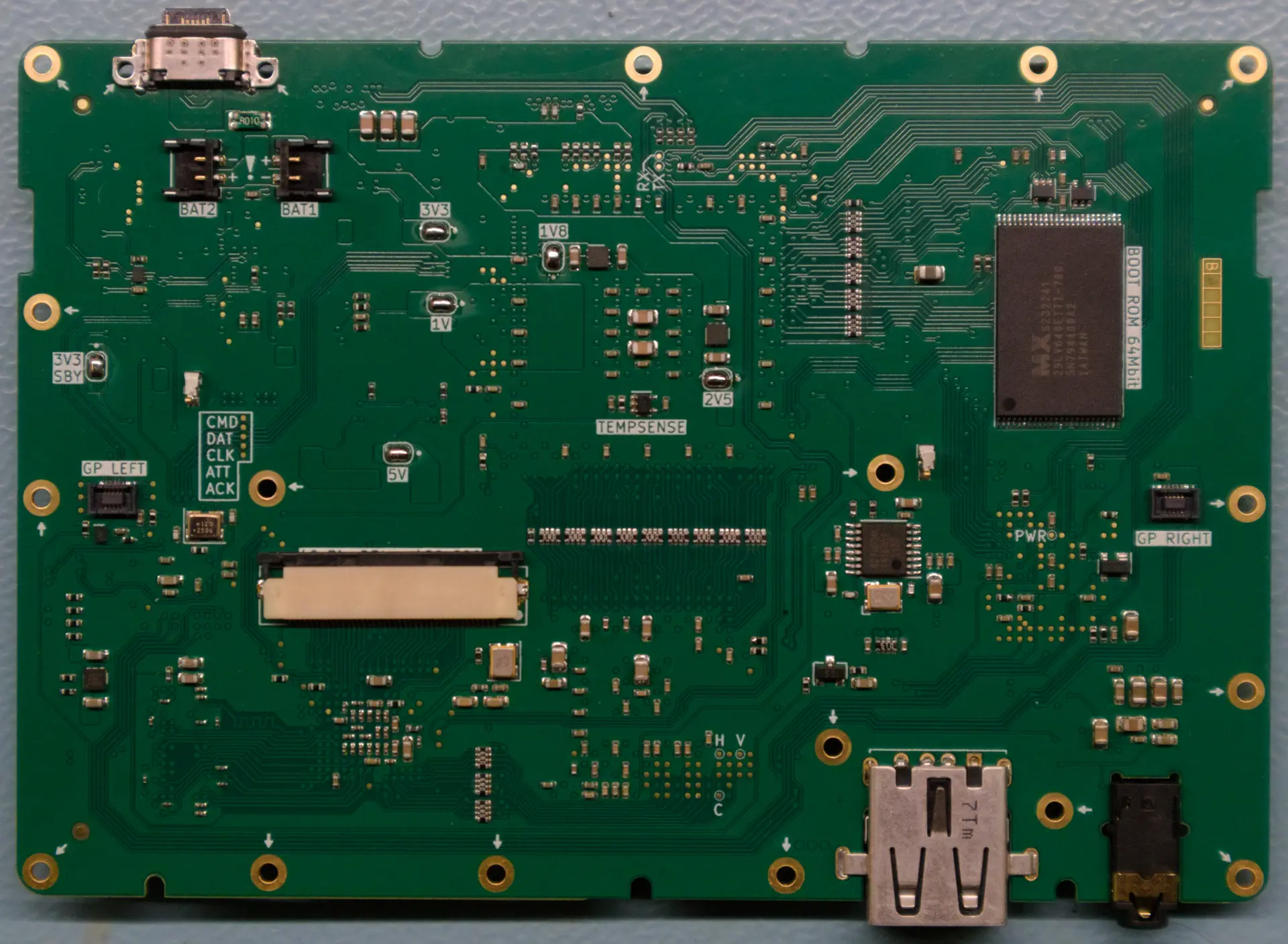

This is a PlayStation 2 portable, custom designed from the gound up with a strong focus on ergonomics and usability. It contains presumably world's first custom reverse engineered PS2 mainboard not made by Sony, and is only reusing 6 ICs of an original SCPH-7900x / SCPH-9000x model.

  • Custom reverse engineered PS2 SCPH-90004 mainboard
  • Custom FPGA-based video processor developed from scratch in VHDL, for digital video output to a 5-inch 480x800p IPS LCD

Mainboard:
