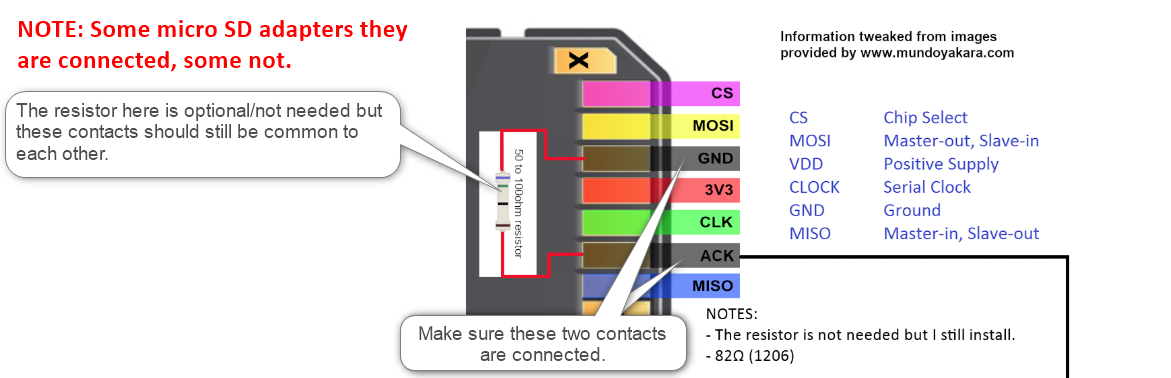

  • What version of OPL are you using?
  • How are you launching OPL? (e.g., from the FMCB menu with the correct path or through uLaunchELF)
  • Are the "GND" and "ACK" contacts connected/jumpered together?
  • Can you include a picture of your wiring?
Hi!
All my PS2s are also chipped.
This one is using Modbo 5.0 (but same issue using FMCB)
OPL 1.2 for MX4IO support
Ack and Ground is bridged.
The issue may be that I didn't use the resistance?
I read all sorts of conflicting guides saying that it is not necessary, but then why include it in the first place?
I think I initially followed Macho Nacho's video, but then I noticed that when he installed the ElectronAnalog HDMI mod, he didn't shield the component wires to ground which IMO isn't great advice as that will introduce interference (I tried without shielding and it was night and day).
So I am wondering if his advice to skip the resistance is also as misguided? In reality, what is the purpose of that resistance?

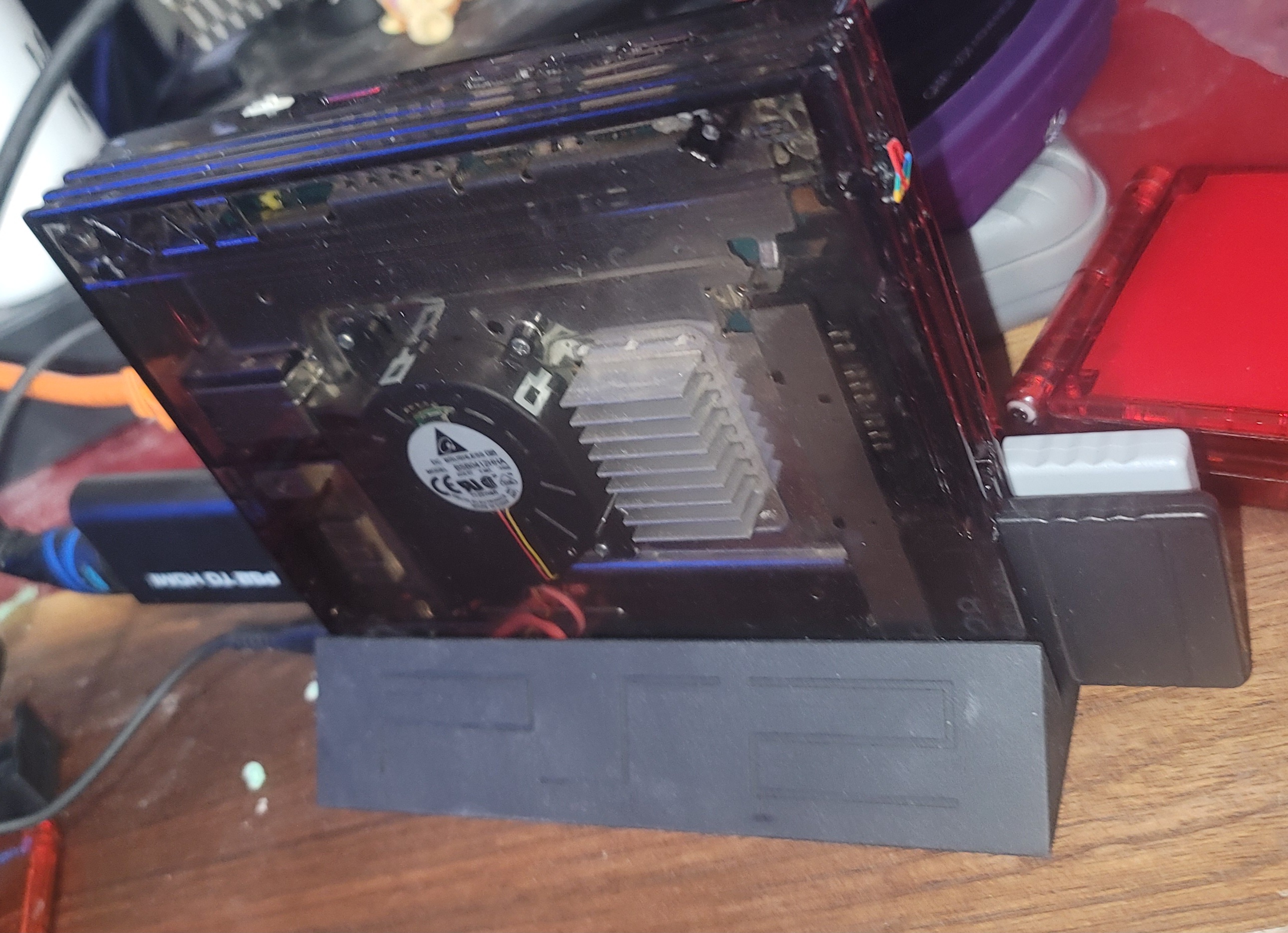

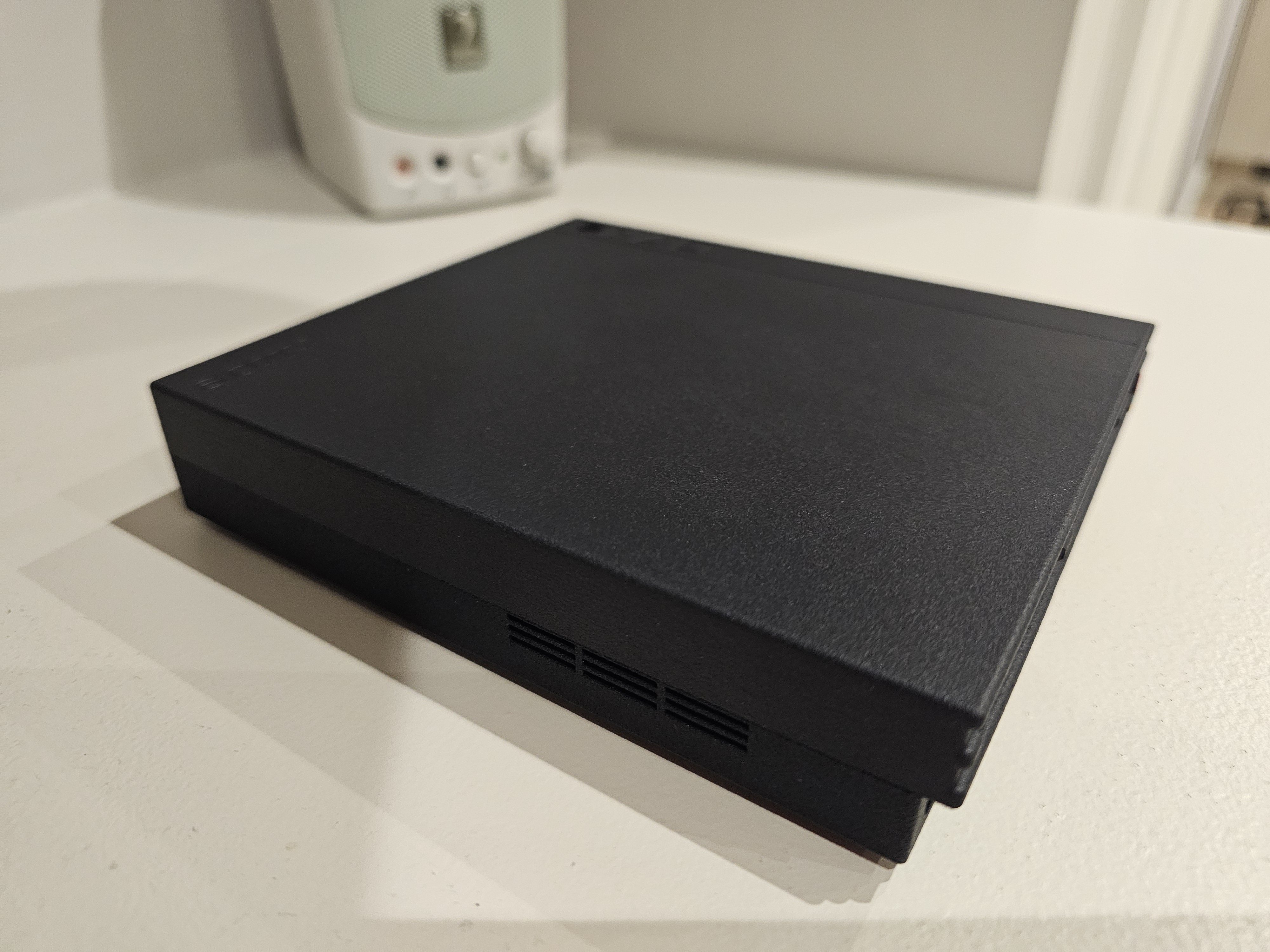

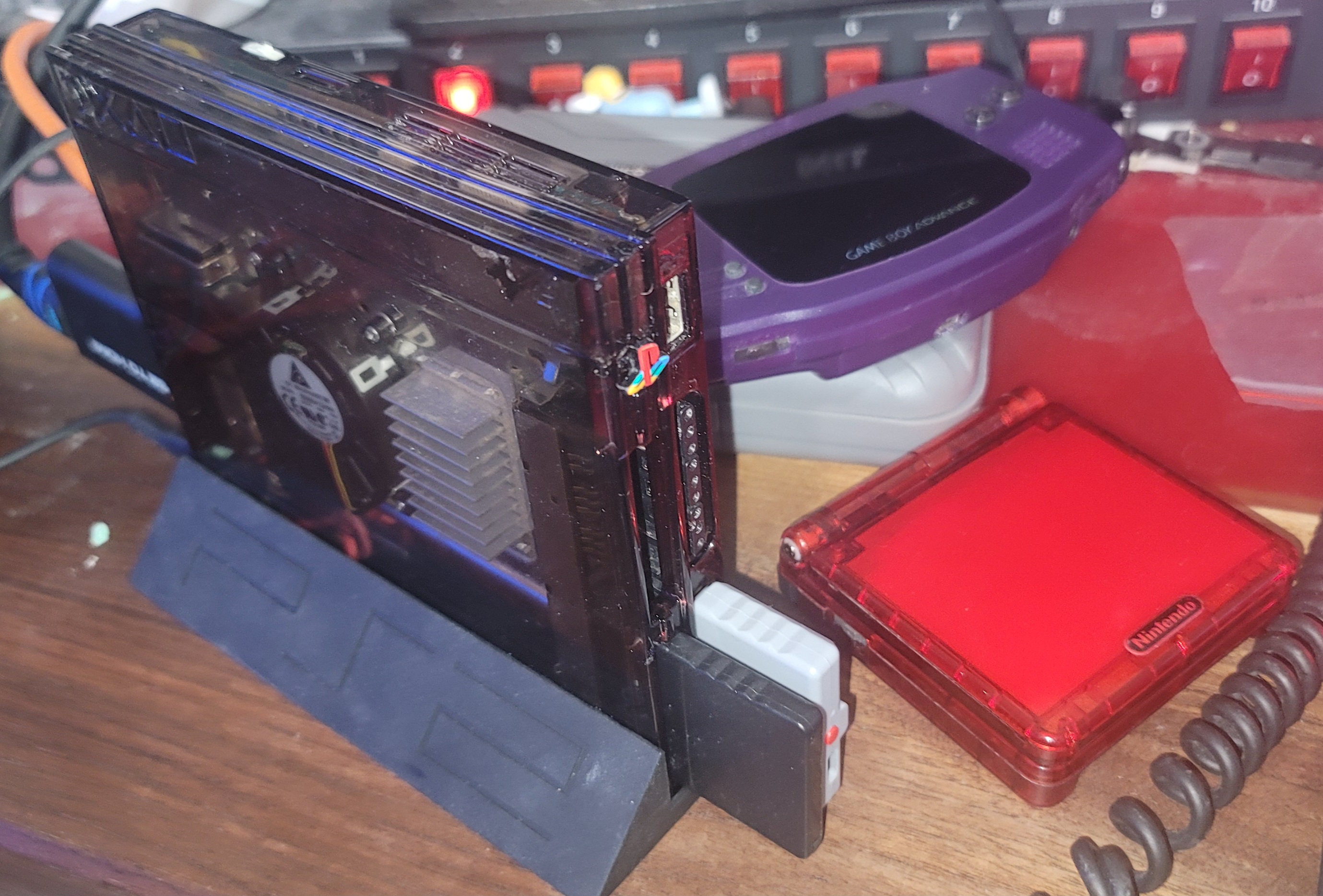

I've attached pictures of my latest build to give you an idea.
The material is is:
HP MJF Nylon PA12
The color is:
Dyed black
The texture and finish is:
Shot peened
I used a website called CraftCloud that guides you through the whole process and makes it easy for you, then gives you a selection of 3D printer vendors to chose from depending of what you selected, your location etc etc, give it a try and it will show you what the finishes and materials look like.
If you want transparent, the PCBway transparent resin is the answer, but be prepared to pay extra.

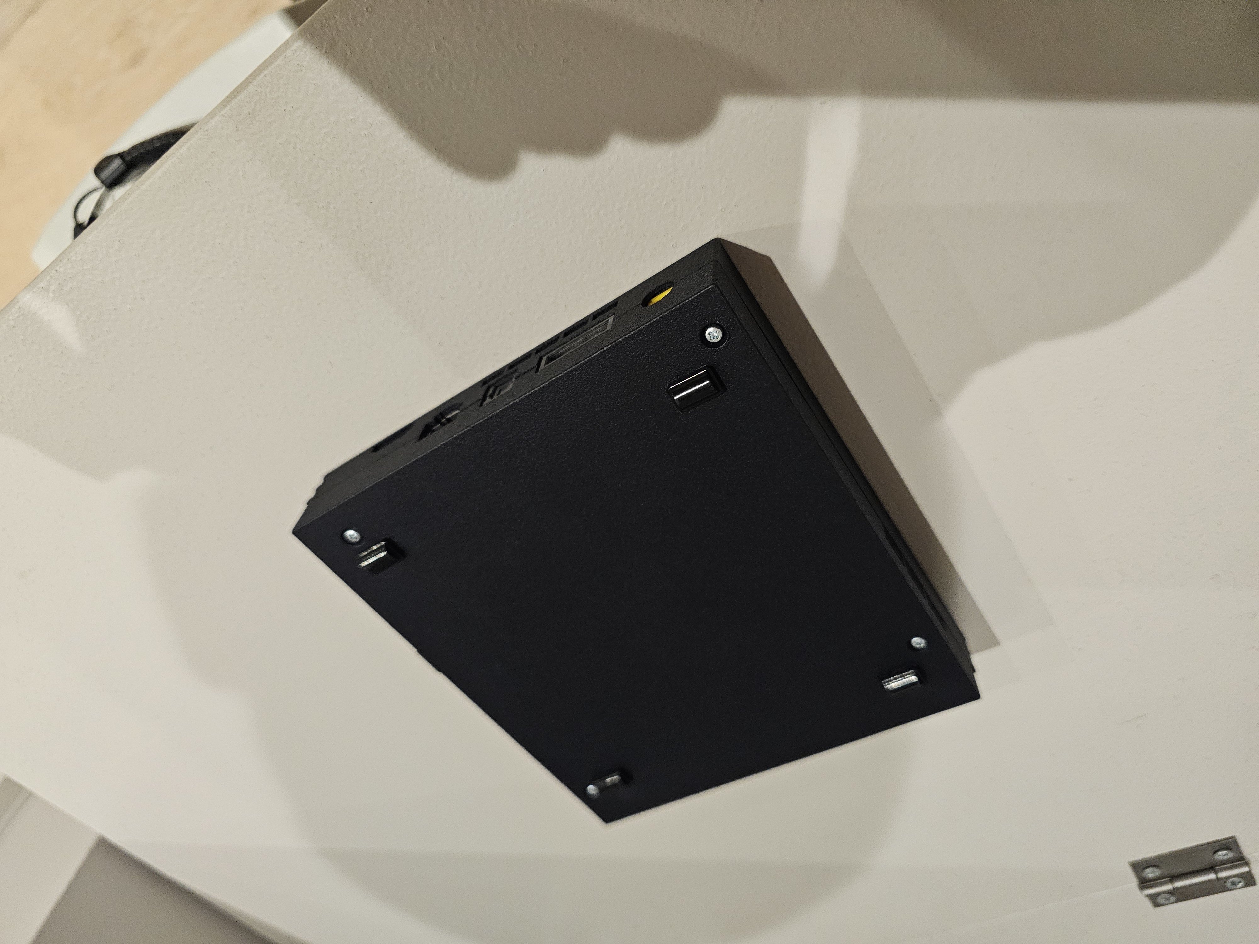

This is my recent build I am refering to.
Just a note, maybe this was trimmed after the fact so ignore me if so, but you dont need to hookup the whole right row of that modbo except CX. SX is for PS1 and Y to A is for DVD, which obviously, we don't need anymore. This will save you lots of time on your next build as those B/G/H/I on this model aren't exactly fun soldering jobs

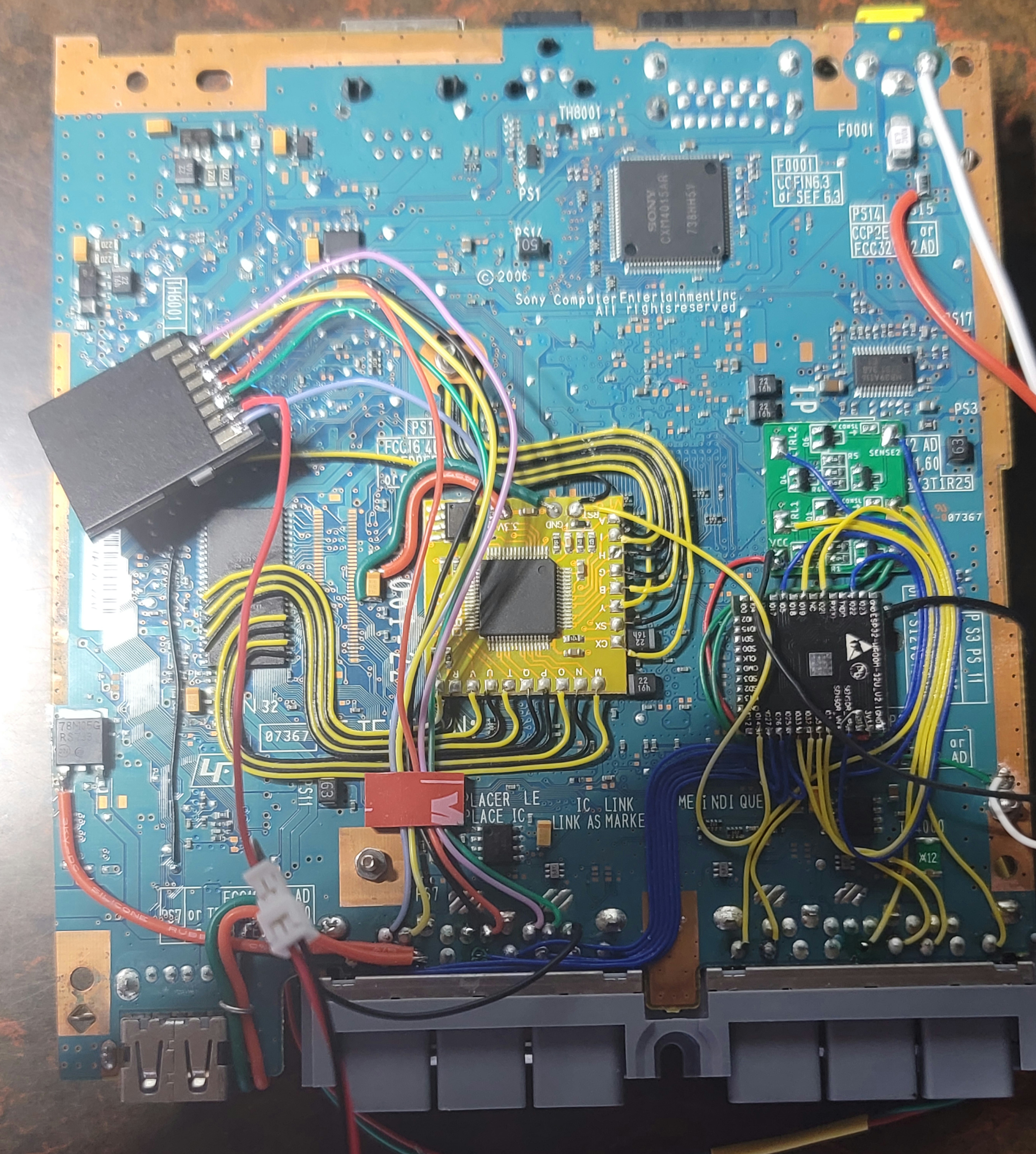

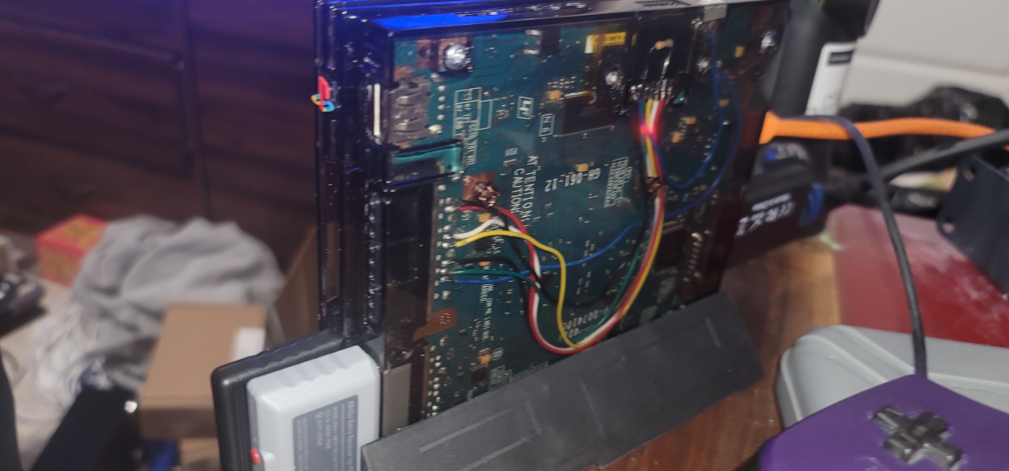

Little update on my own build. The PS2 works with the USB-C and turns on, and boots just fine.
However, I must have done something wrong with the memory card cause it's not booting from the memory card. I do have a feeling that because it's not a Samsung card, that could be the reason it's not reading. Which, if that's the case, i'll have to wait until I can buy one. lol.
But I also wouldn't rule out the fact that my wiring could be wrong as well, even though I did follow the instructions exactly.
Will update once I figure this out. :)

Update on my own Ultra Slim:
PS2 Boots Up, but does not detect the Micro SD card.
Tried it originally with a SanDisk Adapter, and a 1TB Lexar Micro SD Card. (Does not detect.)
Then, thought it could just be because I wasn't using Samsung.
So, because I'm impatient, I went out to Best Buy and bought a Samsung Pro Ultimate 512GB Micro SD Card.
Took out both the Adapter, and SD Card, and replaced it with the new Samsung ones.
These don't work either. So I'm probably going to check the wiring.. again.
But I'm pretty sure I followed the diagram exactly.
I just KNOW the issue is going to be something stupid, it always is due to me overthinking.
Side issue: USB Port also doesn't seem to be working. Not sure why that is either.

Update:
Replaced every single wire with new wires. Still not detecting the SD Card.
Replaced the Resistor: Still nothing.

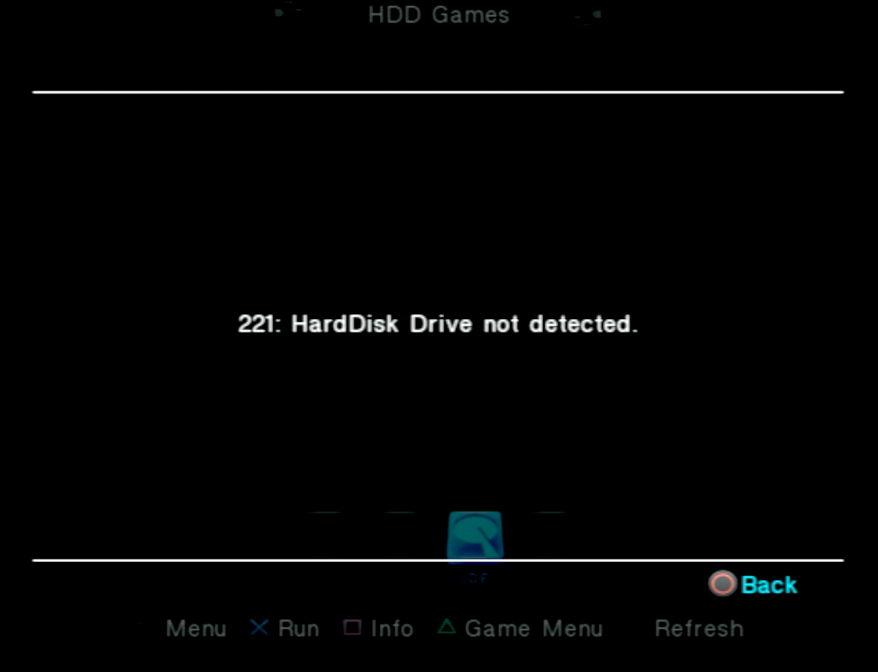

I get this every time booting into OPL:
(Not sure if the MX4SIO is considered the HDD, so that could be why since HDD is enabled.)

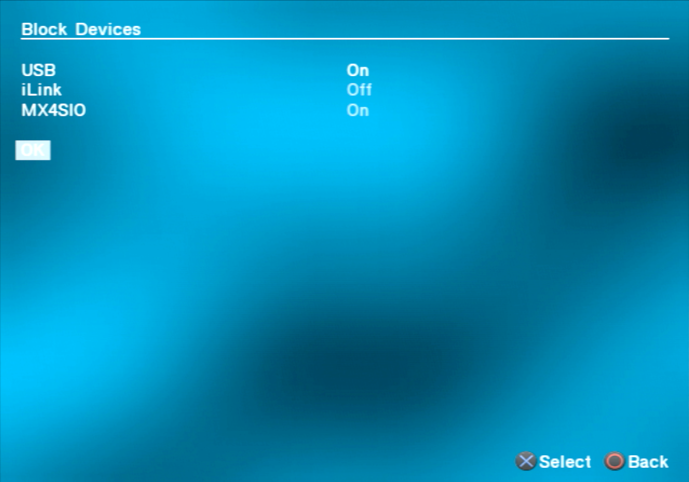

MX4SIO is not HDD, should turn that off. Turn on write operations if you want to save. Then save the config.

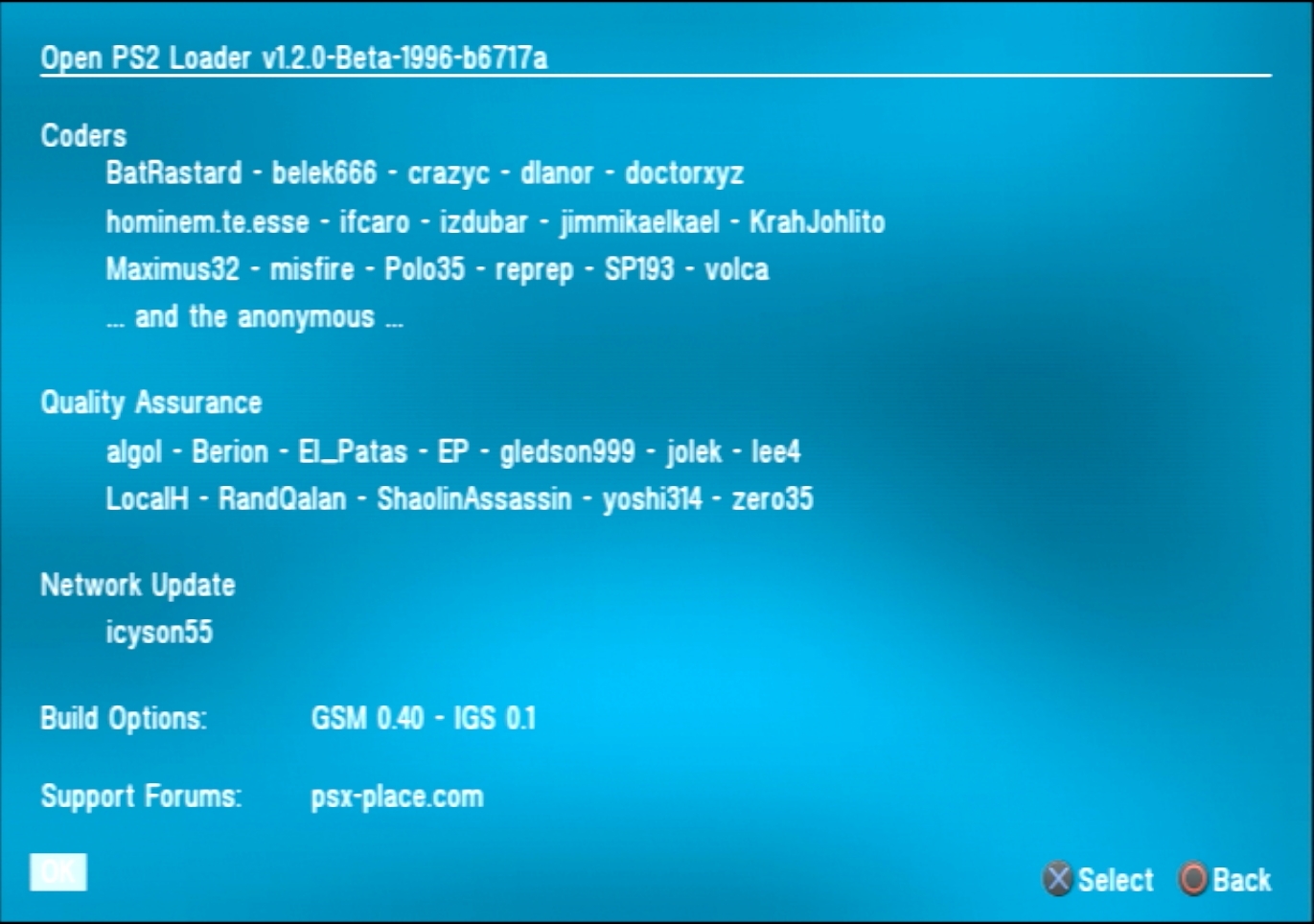

In OPL under "About" what version is listed at the top?
Mine is "Open PS2 Loader v1.2.0-Beta-1991-CCV2-G"
Build Options: GSM 0.40 - IGS 0.1

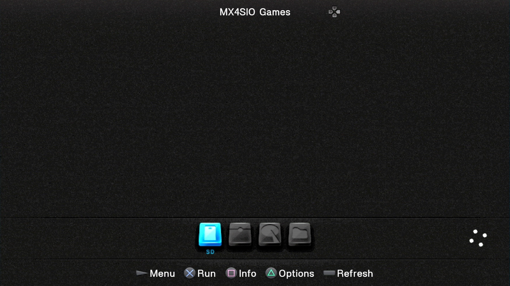

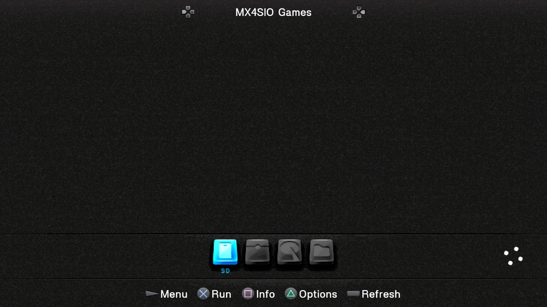

I did eventually get a version of OPL (OPL_v1.2.0.6-1996) to open the "MX4SIO" menu.
About Screen shows:
Which is more progress than I've had so far, and I'm not sure why it has been this difficult.
So, I've formatted the SD Card, and am just currently loading it up with ISO files for games.
As far as I am aware, it will NOT boot from the SD Card to Free McBoot, or detect it any other way like a HDD, but will only load the games in OPL.
Correct me if I'm wrong on this, but it took me THIS long to even get this far. lol.
Will update once games are added to the SD Card and we'll see if it works. :)

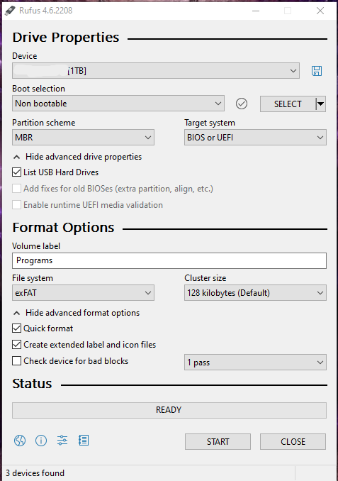

Now it's making sense as to what was going on. Ha! I think you've got it now. Another thing to note is that the MX4SIO doesn't always show up right away on that version of OPL because the default is USB. You have to use the D-pad to select the next location.
Format your microSD card as exFAT and put your games in a folder named "DVD" in the root directory. Also, a handy tool is "OPL Manager" to get all the artwork, saves, cheats, etc., set up. You probably already know this.

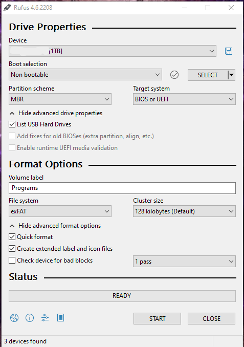

Update 1 on the SD Cards:
Tried to use the 1TB Lexar PLAY UHS-I microSDXC Memory Card (for Gits and Shiggles).
Formatted with exFAT.
Loaded it up with games in the "DVD" folder.

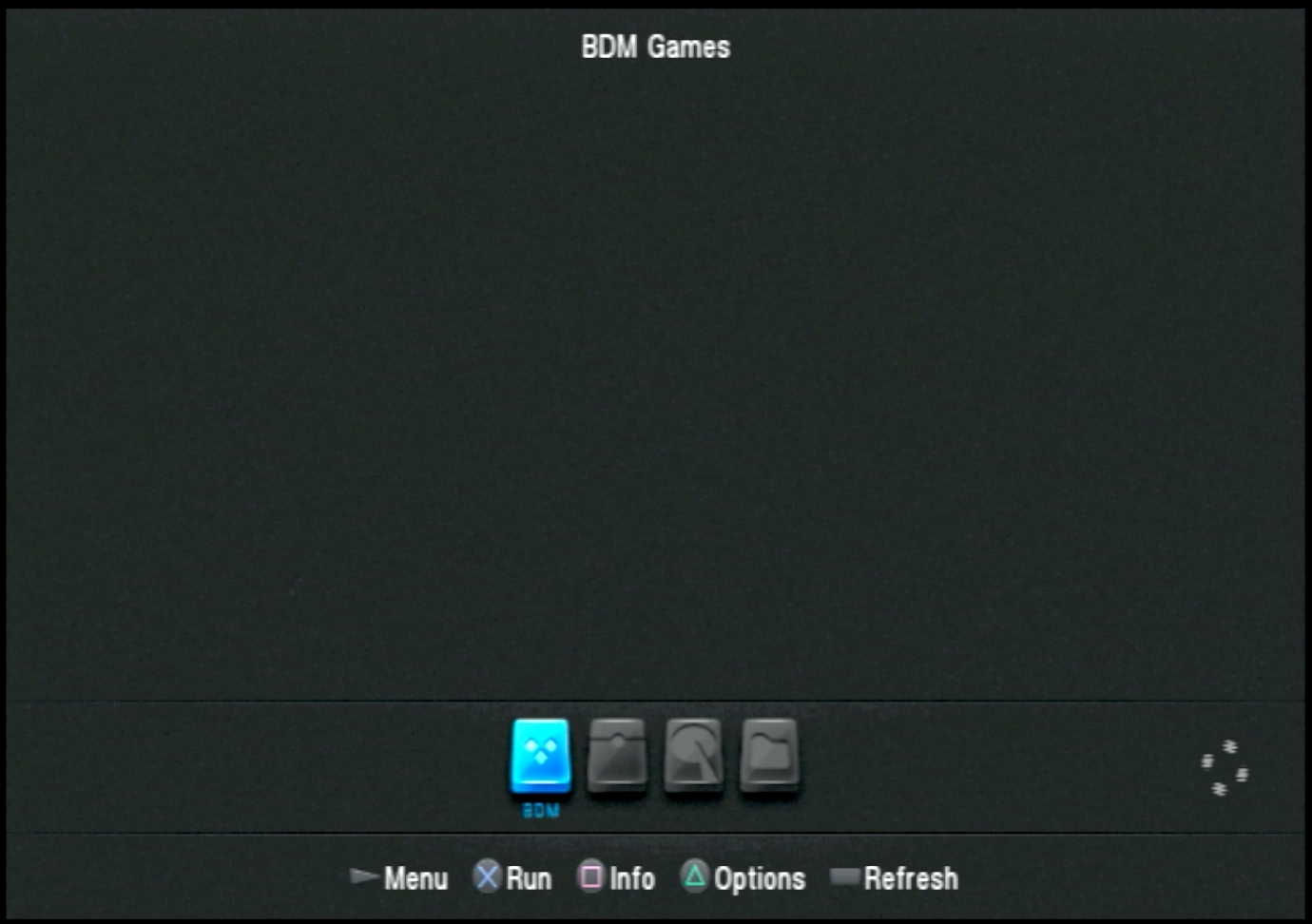

Opened OPL (same version as before), and only the BDM folder shows up, not the MX4SIO folder, even though no settings have changed.
Noticed that when putting the card in while still on OPL, you can see the loading circle pop up in the bottom right corner, as if it recognizes that something has been inserted:
However, nothing comes up, and I get no MX4SIO menu.

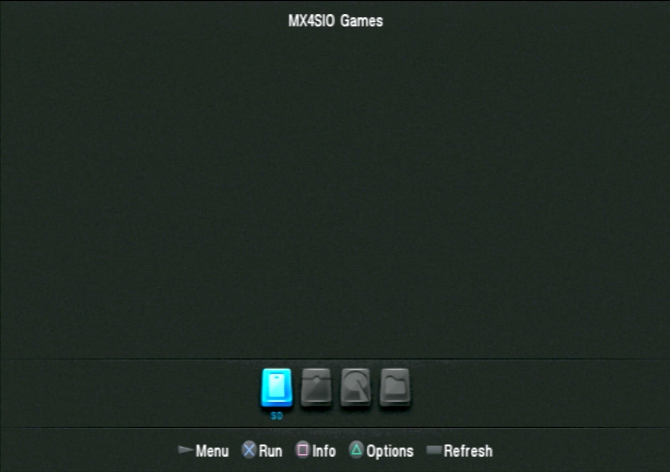

Put it into the PS2, no spinning circle, no MX4SIO Menu. Nothing.
Restarted the PS2. Still nothing.
I feel like it sees the Lexar SD Card, as it shows more life when it's in the PS2.
The Samsung one does little to nothing.
However, neither card is even popping up the MX4SIO screen again.
I'm not even sure how I got that screen to begin with. lol.
After a little messing around with it, i FINALLY got the screen to come back up.
I have no idea still what did it, but I inserted a USB drive, brought the USB menu up, then took it out, and put the SD card back in, and it came up..
However, no games still on the Samsung 512GB card.
Trying the Lexar 1TB card again.
The Lexar, once again, is showing more promise like something is happening, as this time, i'm getting the spinning loading circle.
The loading circle has been spinning a few minutes now, i'm not going to bother it in case something is happening.
It now has popped up... a second MX4SIO Games menu? .. but the circle is still spinning..
And now it's made a 3rd menu.. I have no idea what is going on..
As much as I want to wait for it, I think it's going to make endless copies at this point with no games. lol.
Waited about 5 minutes.
Rebooting the PS2 once again. *sigh*
Did the same thing again:
- Inserted the USB Drive, and the USB menu came up.
- Took the USB Drive out, and put in the Samsung SD Card.
- Absolutely nothing. Some spins from the loading circle, but only for a moment. No MX4SIO menu.
- Took the Samsung Card out, and put in the Lexar card.
- Spins for a little longer than the Samsung.
- Rebooted the PS2
- Took the USB drive out, Put the Lexar back in, it then brings up the BDM Menu, and sits on the screen with a spinning circle in the corner again..
- It does eventually bring up the MX4SIO screen again, so now there's a BDM and MX4SIO (for the first time) but still spins.
It seems to see the Lexar more than the Samsung, which is extremely odd, since this mod prefers Samsung cards, but IDK.
I'm done with it for tonight. We'll see what I can figure out tomorrow.
I'm going to leave the PS2 on while i'm asleep, just in case ANYTHING happens.
Maybe i'll just end up with a million MX4SIO screens like before. Haha.
I do hope nobody is annoyed by my posts, but I just wanted to share my issues/steps in case anyone else has any issues.
Woke up, and still no luck with the PS2.
Did a bit of searching, and saw that someone had some luck with a similar issue formatting the SD card with an application called Rufus.
Downloaded Rufus.
Used these settings:
Loaded the SD Card up with games.
And FINALLY we have success!
For some reason, using Windows formatting, or WinHIIP formatting did nothing.
But Rufus saved the day and a LOT of headache.
It does create some "Autorun" files, which you can just delete.
I guess it's just to make the drive bootable.
And this is using the Lexar 1TB MicroSD.
I'm sure the Samsung will work just fine as well with the same method.

Yeah, the entire issue was it just didn't like the way I formatted the cards, I guess.
Cause once I formatted the SD Cards using the Rufus application, it worked immediately with no issues.
And i even tried it with the Lexar, Samsung, and even a SanDisk card using this method, and every one of them works.

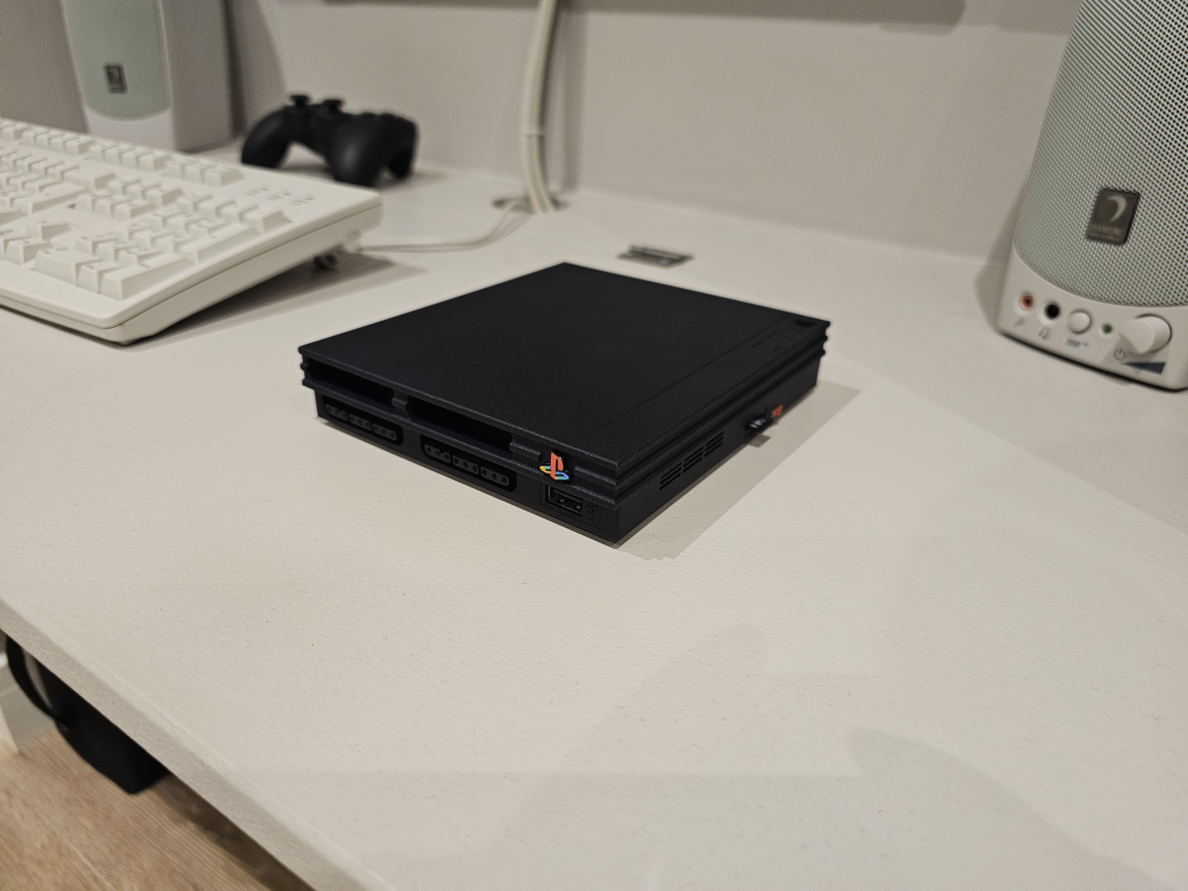

Hello everyone. I just half-finished my build, I still have to do the SD card mod, but it is working with a MX4SIO card. Really happy with the result.
I 3D printed it in PCBWay, black resin, paid about $42 total with shipping to USA
Bought a broken PS2 in Ebay for $22 + shipping
I used the electronanalog HDMI card, really easy to install and also looks professional. The problem I have with the card is that it works with my monitor but is not detected by the big TV. Also sometimes the video looks stripped or the sound deteriorates, things that get fixed by resetting. I also have one of those cheap PS2toHDMI adapters and it works perfectly. I'm thinking of gutting the adapter and putting it inside.
