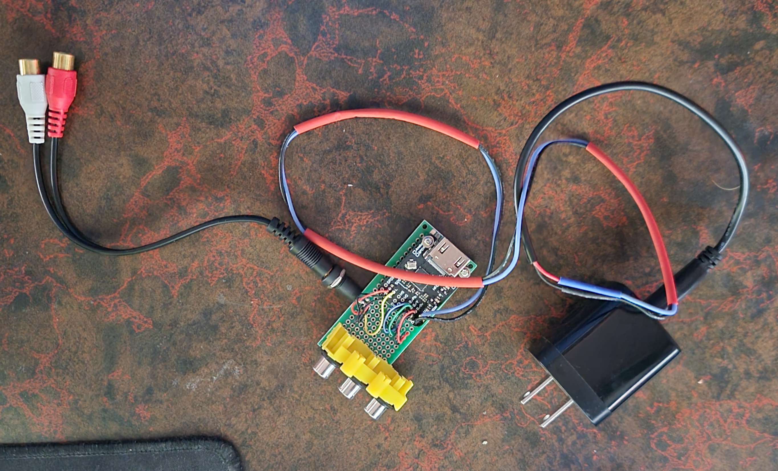

Looks like you got some dirty power. Where you getting power from? Hopefully the noise is not coming from your USBC mod supply.
I wanted to share my experience with the ElectronAnalog too. I had a similar issue recently because I was powering it with a voltage regulator that didn’t have a decoupling capacitor. I just moved to a different regulator for the 5V.
I typically reuse the chopped off USB port for an internal USB drive on my builds. The missing capacitor was the one that had to be removed when you made the cut. I was using the voltage regaultor for that port DOH!
Also, (You may alsready know this) Electron Shepherd suggests not using power from the A/V port. Instead, they recommend drawing power directly from a voltage regulator, as the A/V port doesn’t supply enough power for the ElectronAnalog.
I was still on the A/V port (was following Titos Video, read the suggestion later, but forgot to change it). I am now using 5V from a regulator, no change. added a capacitor for filtration (16v 100uf), nope... changed the power input from usb to the original Powersupply... still noisy (and changed the HDMI Cable as the first step).
The output from the AV Port directly is fine.

It would be good if you could get a scope on your power rails to see what’s going on.
Just like with anyone, I just want to throw some ideas out there that might seem obvious or basic. I don’t mean to discredit you in any way.
I’m assuming you don’t have this issue when you use the A/V port as is. If the ElectronAnalog is connected and you don’t see any noise using your A/V cables, it could be your ElectronAnalog adapter's HDMI output (though it could still be noise at the ElectronAnalog itself).
Have you tried disconnecting your USB-C power mod?
You did solder the analog jumper on the ElectronAnalog board?
Another thing to try is powering your ElectronAnalog adapter with a buck converter like what TizzyBac is showing then solder some RCA connectors to your ElectronAnalog board. Then test it on another device or even with this PS2.
Here’s an example:
I think you get the idea—test your ElectronAnalog on something else to make sure the issue isn’t originating from the adapter itself.
You also mentioned that you blew a fuse, I think in your first thread? What was happening when it blew?
I hope you can get this figured out!

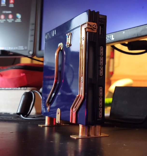

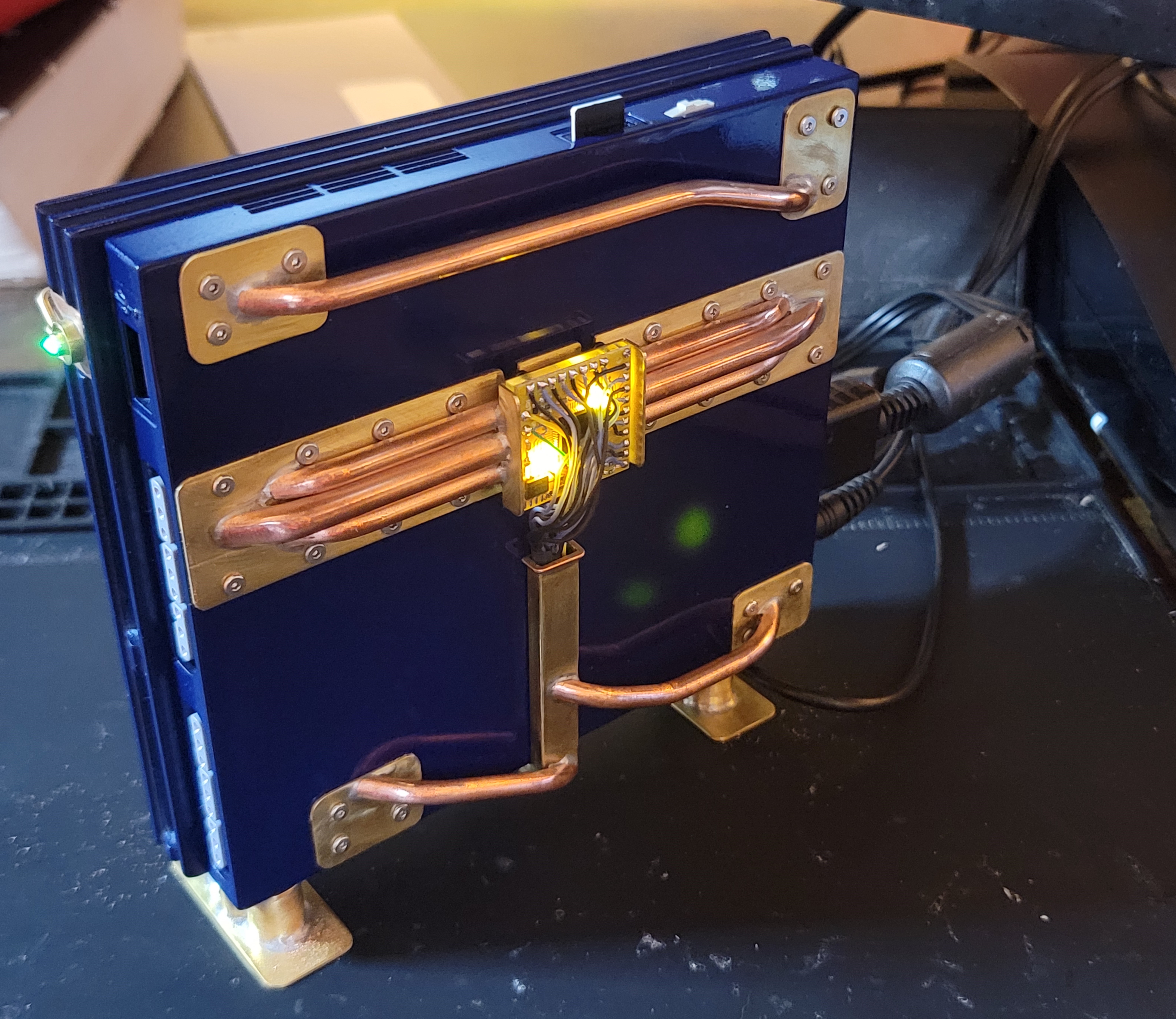

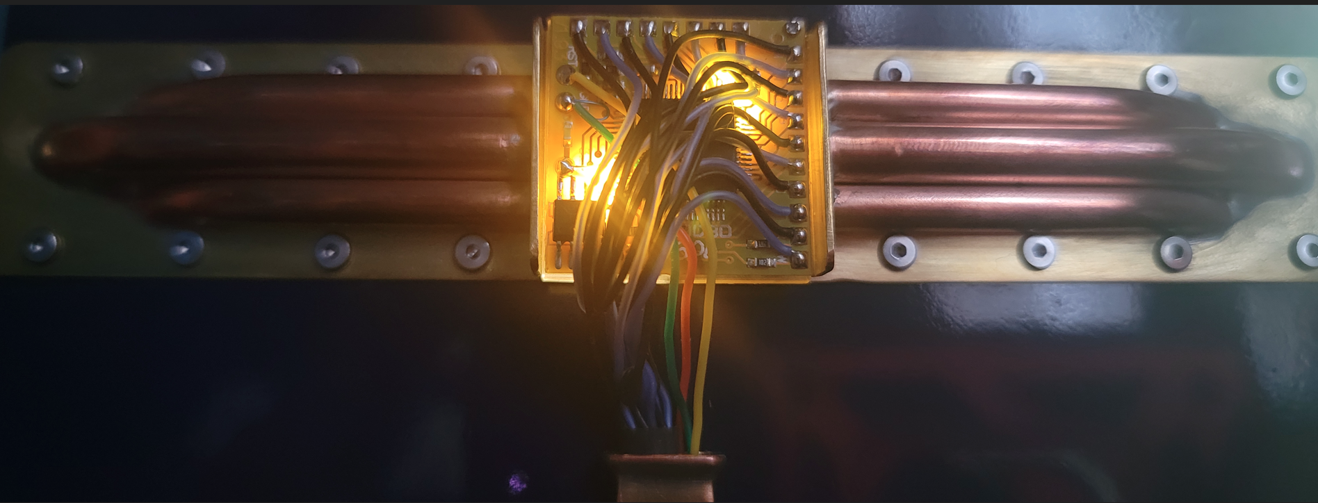

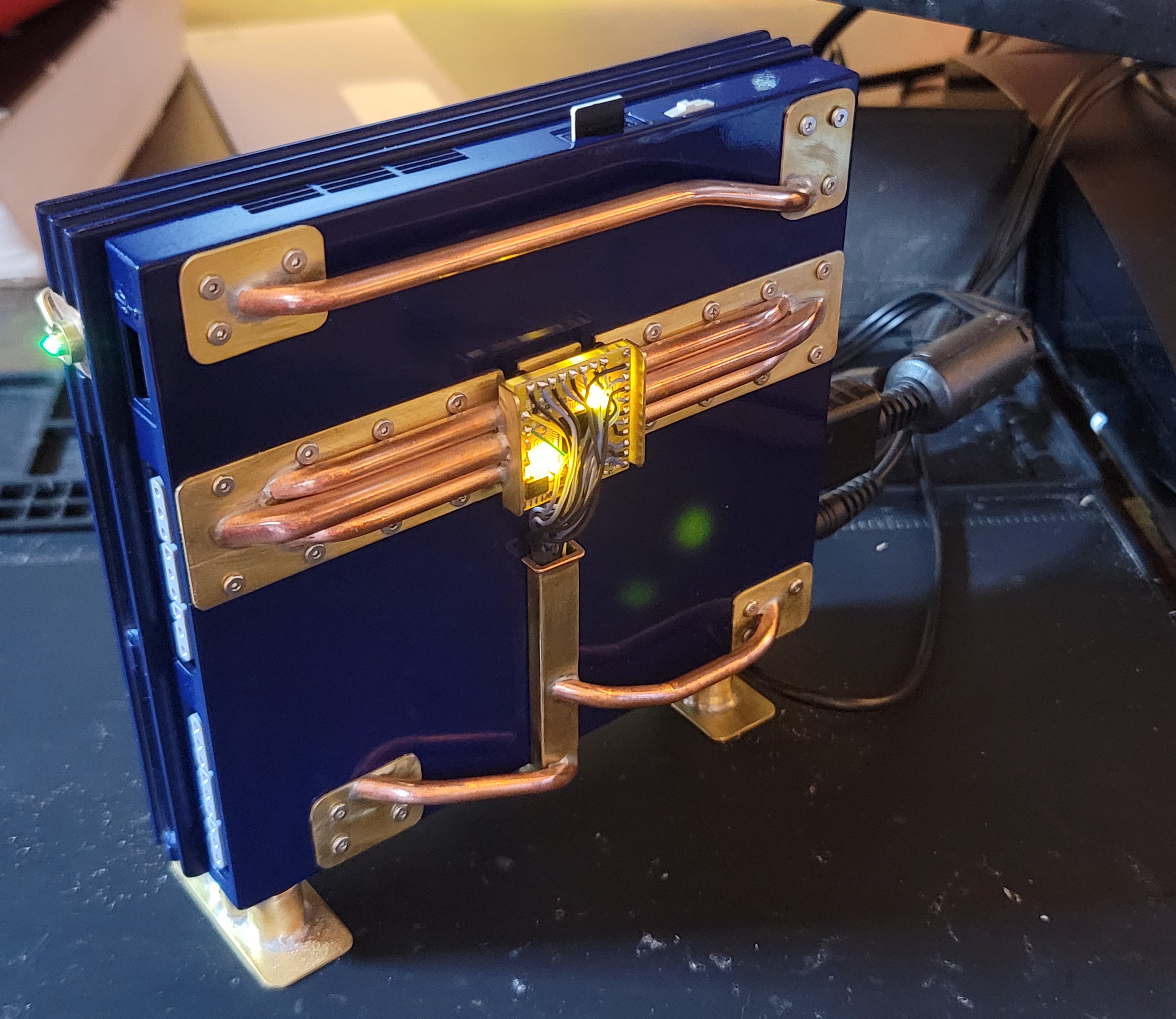

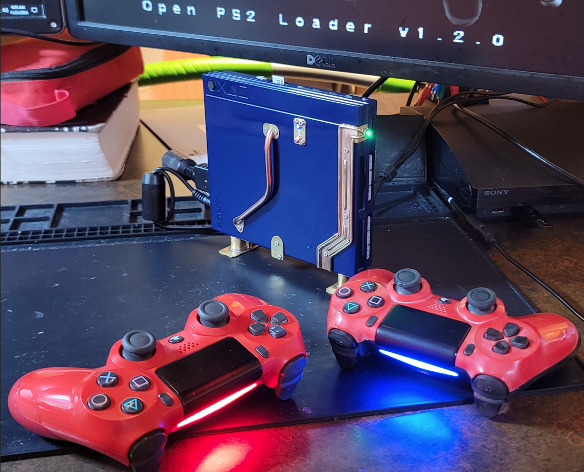

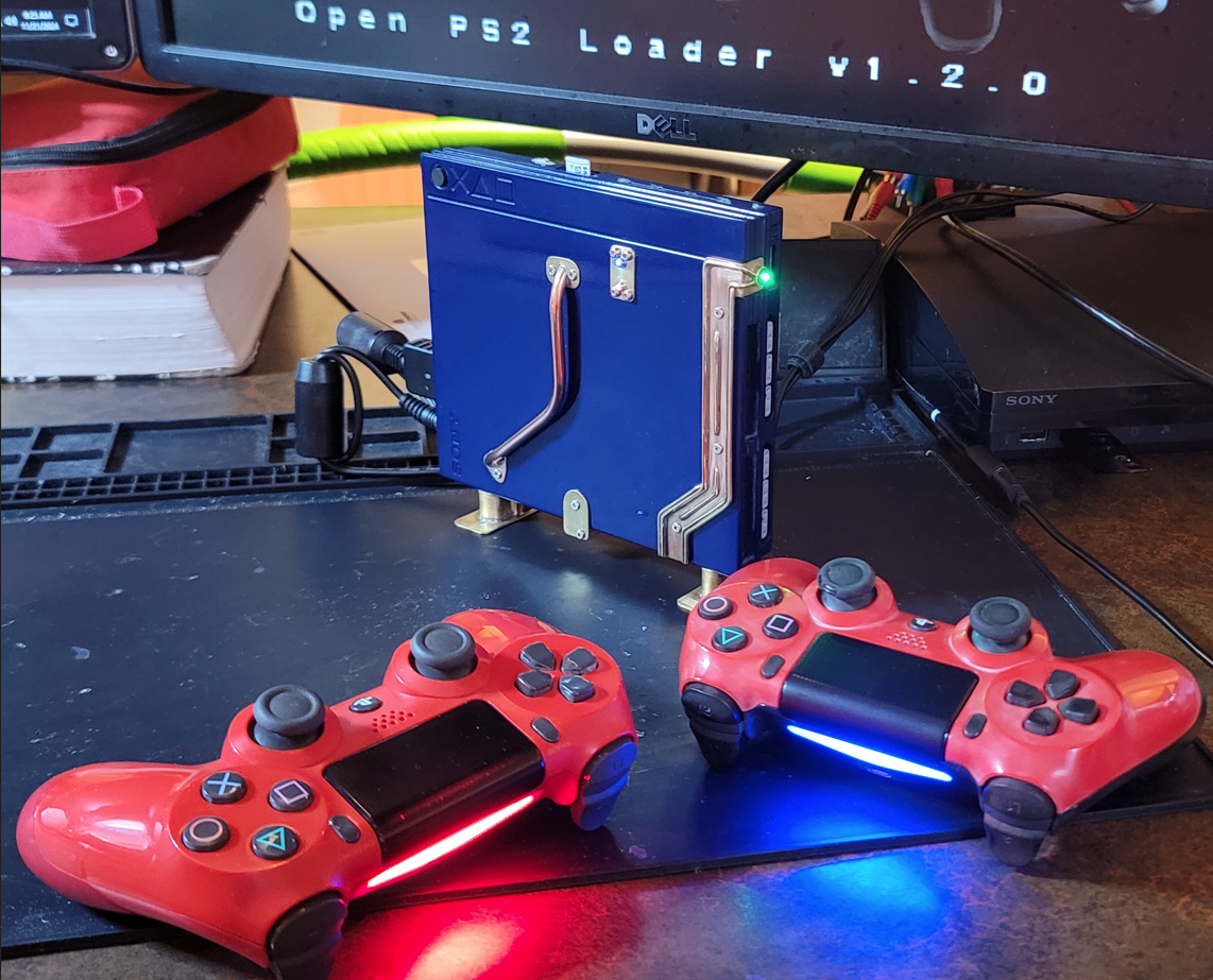

I Finally Finished Blue Assimilation!
The other night, I wrapped up (dramatic pause) "Blue Assimilation." Just wanted to share some pics and talk about it here for a bit of post-build therapy—now that the thrill of the build is over. Any of you guys know what I mean?
Challenges & Learnings:
Putting the ModBo on the outside was a small challenge because I wanted the console to remain serviceable in the future (anyone can solder wires together, but future-proofing is key). However, the bigger challenge was getting the internal Blue Retro (HW2) installed to work how I envisioned.
Let me clarify: I wanted it to function like Gusse's Methylene mod. I missed the mark—because, well, he’s Gusse, and I’m FatBaldDad. That said, the port detection works really well (thanks to Helder’s Game Tech), and I can turn the console on and off.
Here’s what I’d like to improve: I want it to work like the newer PS3/4/5. A quick-press of the PlayStation button would reset the console with a chime, while a long-press would turn it on or off with a "hello" and "goodbye" chime. I learned that the Methylene mod uses its own Blue Retro firmware, which Gusse provides on his website.
For my next step, I plan to make a PIC board that interfaces with an ESP-WROOM-32 running DarthCloud’s latest Blue Retro firmware. I believe this will allow me to control the PS2 reset pad exactly how I want (yes, there will be some sweet chimage). This way, I can stick with DarthCloud’s latest Blue Retro release while customizing the functionality. Or just get a "Methylene" (sigh) I think the base is something like $45 the full is around $102 I thinks.
Let’s face it—the Ultra Slim needs Blue Retro. They’re just perfect together.
Upcoming Ideas for My Next Build:
I want to take a moment to again credit Wesk for this incredible design and highlight what a brilliant execution it truly is. From what I understand, he created it on a whim, and in doing so, he inspired a lot of people with what’s possible.
I want to be clear: by mentioning my ideas for changes, I’m not intending to discredit his work in any way. I’m not saying he did it wrong or that this is how it should be done. Rather, I see my work as continuing in a different direction. I hope my fellow builders can understand and appreciate what I’m trying to convey.
Just some ideas, I think some of you have already done some of these changes already.
  • Add thread inserts: After opening it 100+ times, the threads wear out in the resin.
  • Reuse the original power button board:
    • Keep Wesk’s circle design for the button but mount the reset/power button board underneath using a long ribbon cable to a breakout board located elsewhere and also a shorter plunger.
      • I feel that this would ease the pain for the times I end up with a board with no lid switch.
      • I understand the ElectronAnalog is under there but I would like to move that to the other side.
      • Increase clearance for the ElectronAnalog HDMI adapter (or move it over).
  • Use the smaller slim hood ornament instead of the FAT.
  • Increase motherboard clearance underneith:
    • Add more room for the Blue Retro ESP-WROOM-32 board and wires.
    • Also get some real estate available fo a raspberry in there somewhere to load games via SMB.
  • Add memory card slot flaps: I’ve had trouble with this but think I have a solution.
  • Include provisions for a docking station.
  • Switch to the BitFunxMX4SIO adapter:
    • It’s inexpensive and will simplify the build.
    • Add acrylic rods for lighting placement.
  • Combine USB-C power and standard power into one system.
  • Add silicone anti-slip pads to the base.
The biggest idea I’m currently working on is a docking station that incorporates parts of the original console. I’m envisioning something that resembles a small record player, where the discs spin in the open, and the Ultra plugs into the top using pogo connectors. The docking station would have its own power supply and HDMI adapter, allowing you to keep everything plugged in at home.
Hurdles to overcome:
  • I will be using two 20 pin pogo connectors and one 10 pin
    • Might be hard to pull apart, but I have not found a 50 pin pogo connector, might have to make one or elimnate/relocate the magnets
    • drive has three ribbon cables
      • 24 pin, 12 pin and a 4 pin = 40 pins
    • will need to pass some interfacing signals 10 pins
      • Ultra onboard power disable signal (1 pin)
      • Power from base to Ultra (2 pins)
      • on/off/reset (1 pin)
      • Video signals (5 pins)
      • Lid open and close (simulated with PIC module and momentary pb) (1 pin)
The benefit of this setup is portability—you could simply grab the Ultra and pull it off the base. Since the Ultra already has USB-C power, HDMI, and Bluetooth, you wouldn’t need to pack much to take it on the go. For example, if you’re heading to a hotel, you’d just need the Ultra, a Bluetooth controller, an HDMI cable, and a USB-C charger with a cable.
As someone who used to travel a lot, I think it would be pretty cool to fit a PS2 into a backpack pocket. I know there will be challenges ahead, but that’s part of the fun, right?

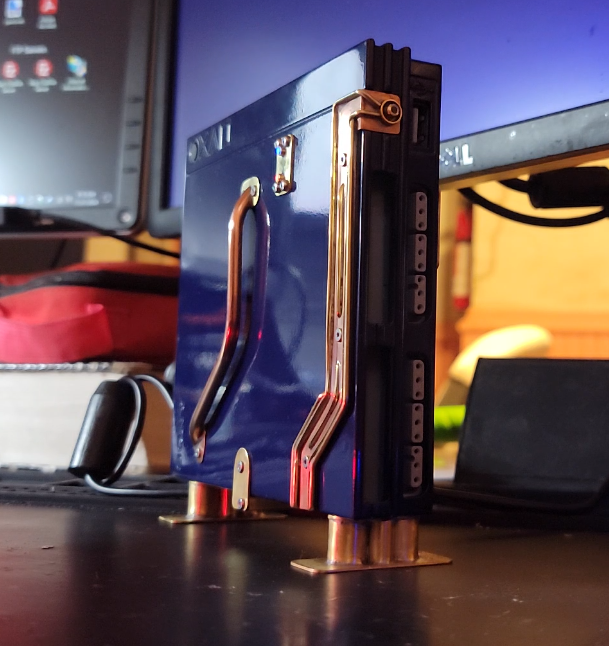

I finally finished (dramatic pause) "Blue Assimilation" the other night. Just gonna share some pics and talk about it some here for some post-build therapy as the thrill of the build is over. Any of you guys kow what I mean?
Putting the ModBo on the outside was a small challange in that I wanted the console to remain servicable for the future (anybody can just solder wires together). However the bigger challenge for me was trying to get the Internal Blue Retro (HW2) installed to work like I wanted it to. Let me clarify, I wanted it to work like Gusse's Methylene mod but I missed the target becuase he is "Gusse" and I am the "FatBaldDad". The port detection works really well though (Helder's Game Tech) and I can turn on/off the console. What I would like is it to function like the PS3 when you "quick-press" the Playstation button and the console resets with a chime. "Long-press" powers on and off with a hello and goodbye chime. I learned that the "Methylene" mod has its own Blue Retro firmware that Gusse has available on his website. So I think what I will do is make a PIC board that interfaces with an ESP-WROOM-32 running the DarhCloud Blue Retro latest FW. I beleive that using a PIC I can control the PS2 reset pad how I want (yes I'm adding some sweet chimage!) and also be able to just use DarthCloud's latest release of Blue Retro. The Ultra Slim needs Blue Retro, they just go really well together.
Upcoming ideas for my next build
SHELL TWEAKS:
  • Adding thread inserts.
    • After taking it apart 100xs the threads wear out.
  • Power button changes to reuse the orignal power button board again.
    • Keep Wesk's design with the circle location but mount the board underneith
      • Might have to add more clearance becuase of the ElectronAnalog HDMI adapter.
  • Add in
  • Increase the clearance under the motherboard.
    • Make more room for the blue retro ESP-WROOM-32 board
  • Add Memory card slot flaps.
    • I got burned on this one already but I think I has an idea to make it work.
  • Provisions for a docking station (yeah that's right I'm taking the whole can of soda).
  • Change the MX4SIO microSD card adpter over to use the "BitFunx" MX4SIO adapter
    • Really cheap and will make the build easier).
    • This will include using acyrlic rod placement for the lights.
  • USB C power and standard power together as one.
  • Add provisions into the base for silicone pad placement (ant-slip feet).
View attachment 36243View attachment 36244

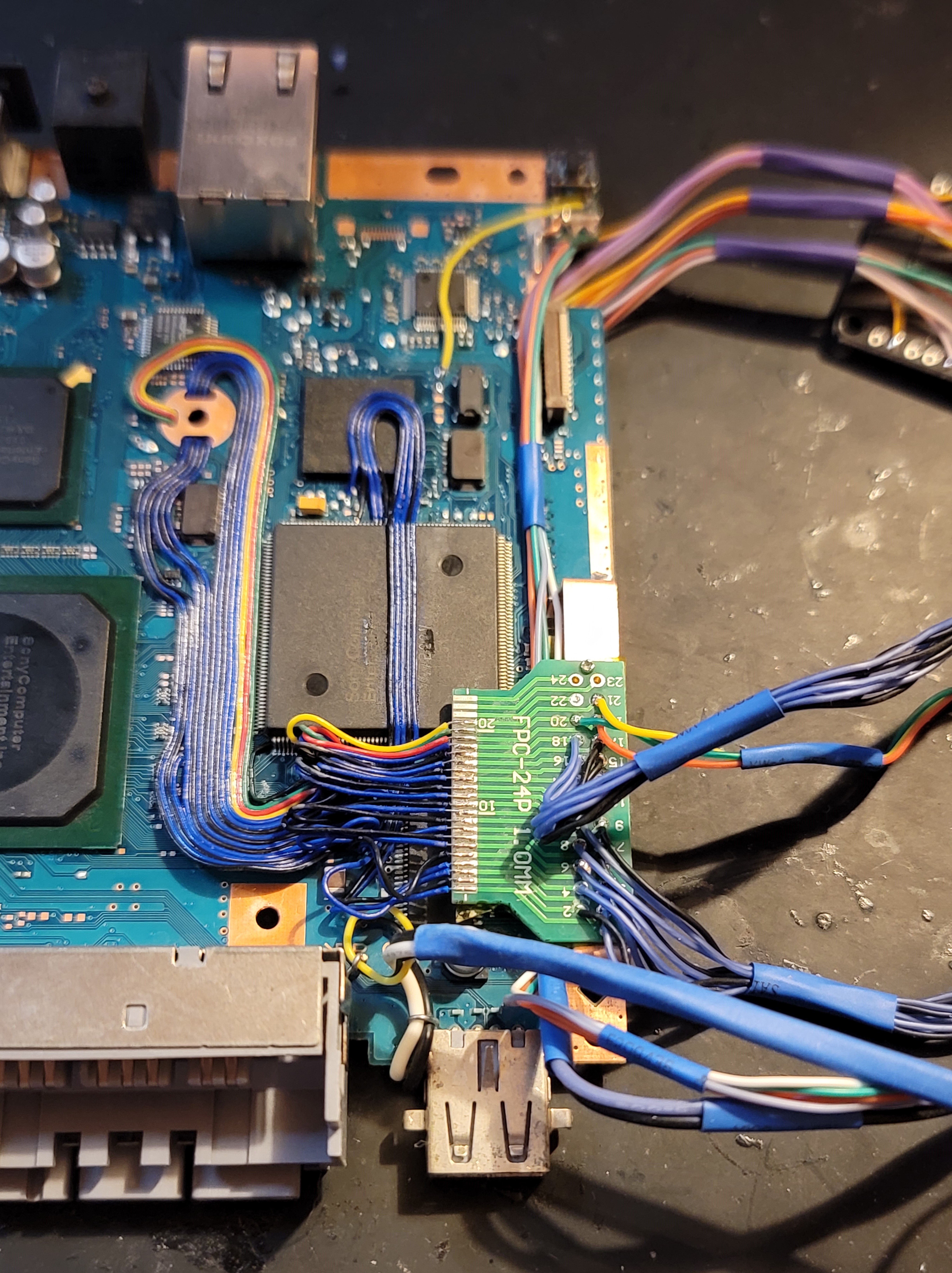

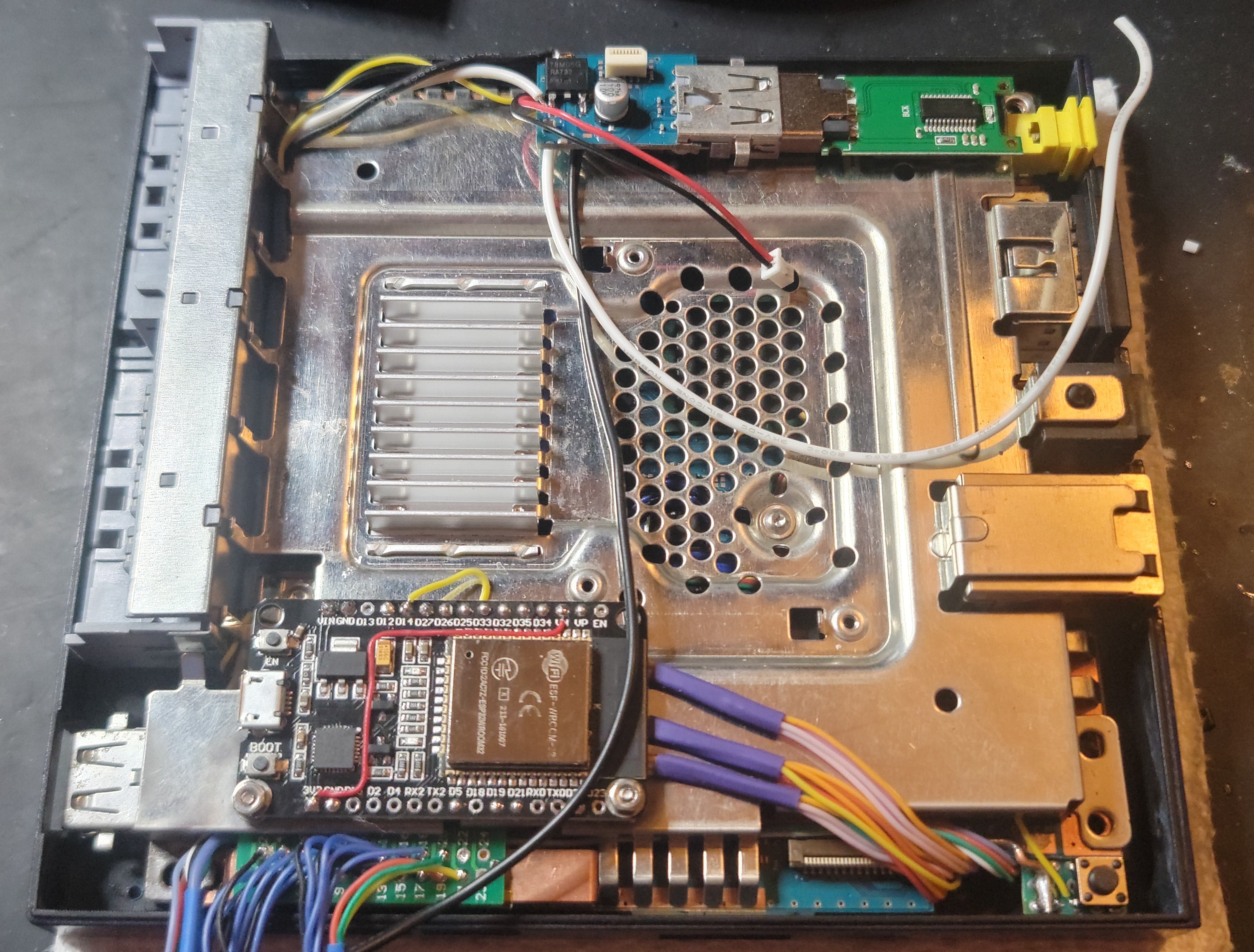

Hi everyone! New modder here. First of all, Wesk - thanks for the mod, awesome job!
I have few questions, especially to PAL version of 79k modders.
PittStone, You didn’t give any feedback. Did you manage to finish the mod? If so, please show how you did it and where you soldered, that would be very helpful for me and other PAL users.

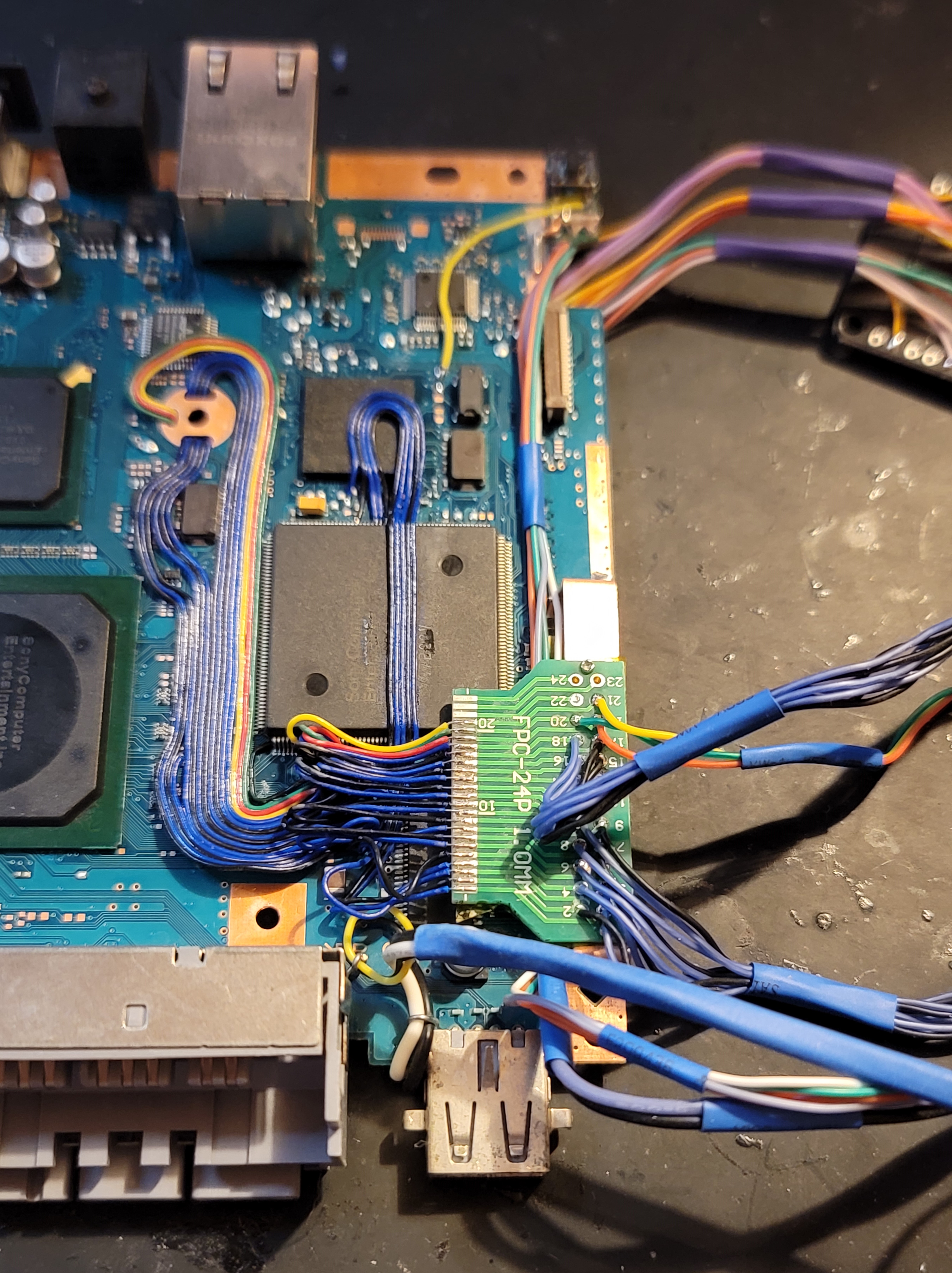

I successfully trimmed the motherboard like you did (does it look any good?), and now just to be 100% sure where to solder to restore power - is your method good and effective? Does everything work, including the USB port? Additionally, if everything works for you, could you show exactly where you cut the traces on the board under the purple wire?
Photos would be best, because I’m not sure exactly where to use the scalpel to cut the traces near the button. I’m attaching photos.
Thanks everyone in advance for the help. You’re amazing, guys.

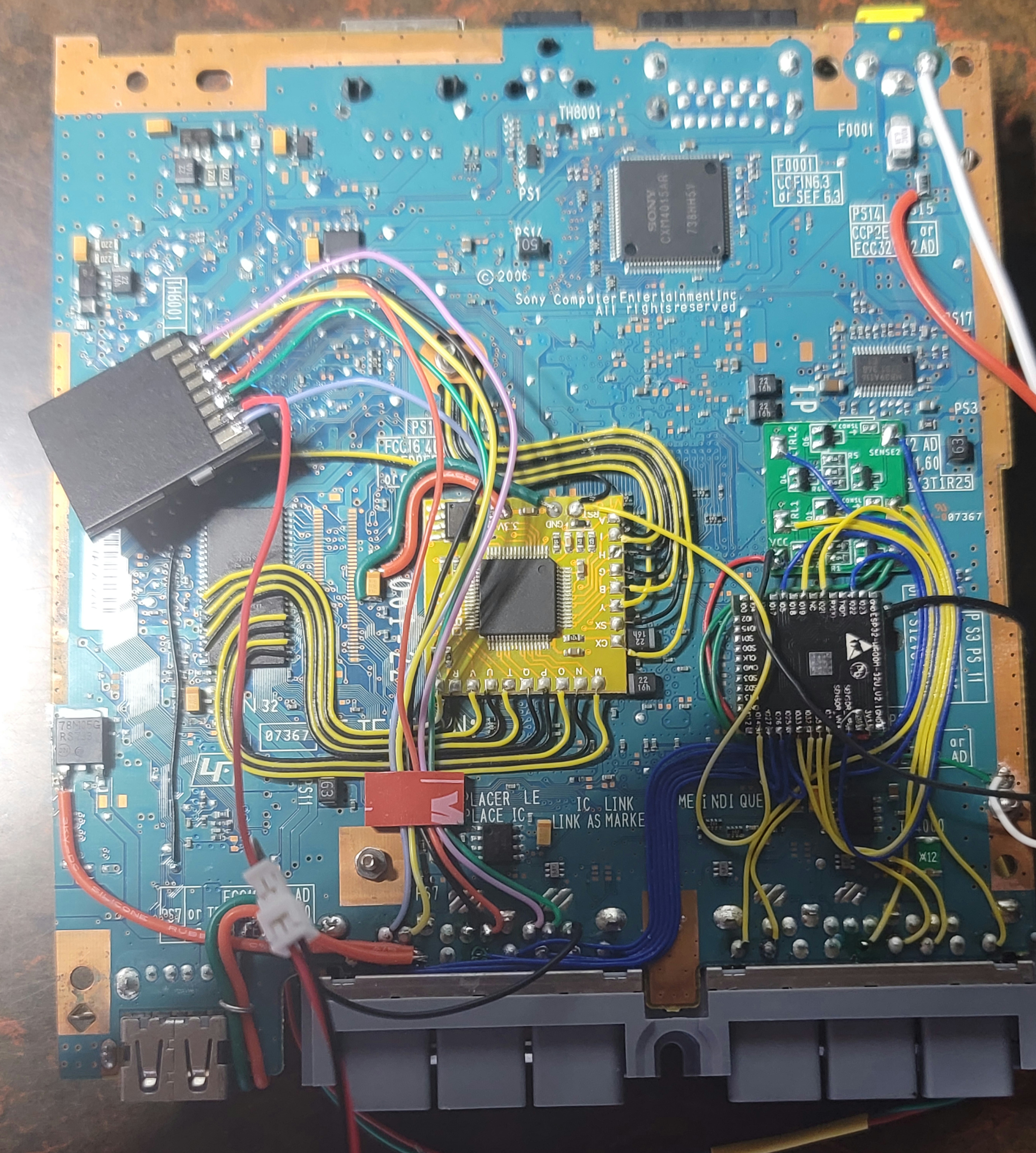

Those are pictures of my build:
It looks like you’ve got it right! If I may, I’d like to offer some suggestions for your solder points. It seems to me that your iron might not be hot enough. Also, be sure to use plenty of flux.
Your iron should be set to around 600°–700°F. Pre-tin your wires, apply flux, and then heat the joint with your iron for a moment until the solder melts. Next, introduce the wire to the joint, hold it in place for a moment, remove the iron (while still holding the wire), and then let the wire cool before releasing it.
I’m just concerned that your joints may break over time or might not have a solid connection. Sometimes it’s the flux that’s temporarily holding the joint together, which could lead to issues later.
Check out Tito’s build tutorial on YouTube to see how he solders. Voultar also has excellent modding videos that demonstrate proper soldering techniques. Keep in mind that different joints may require different techniques (e.g., when soldering to the legs of a chip, the technique I mentioned above wouldn’t apply—you’d use a different approach for that).

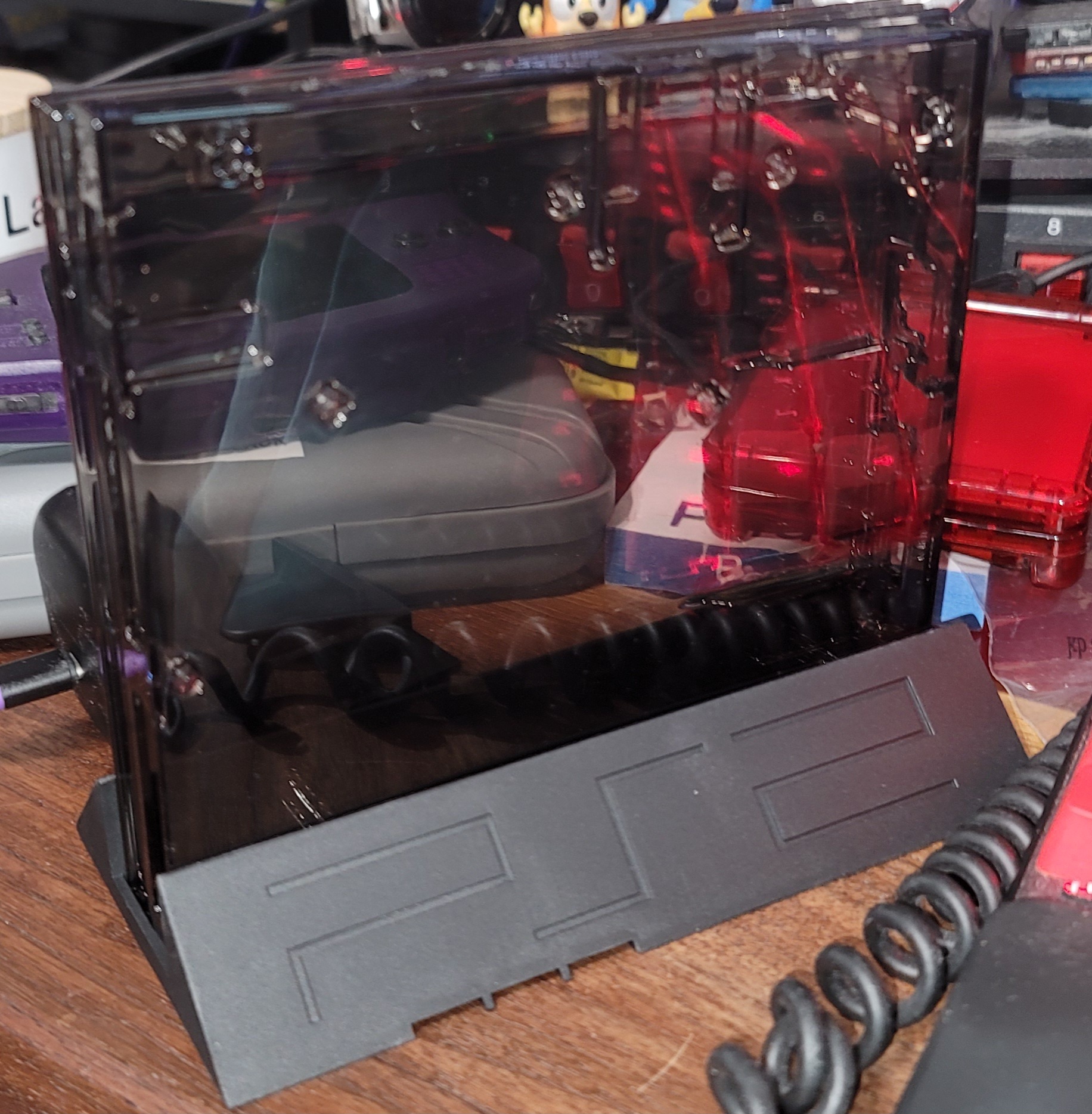

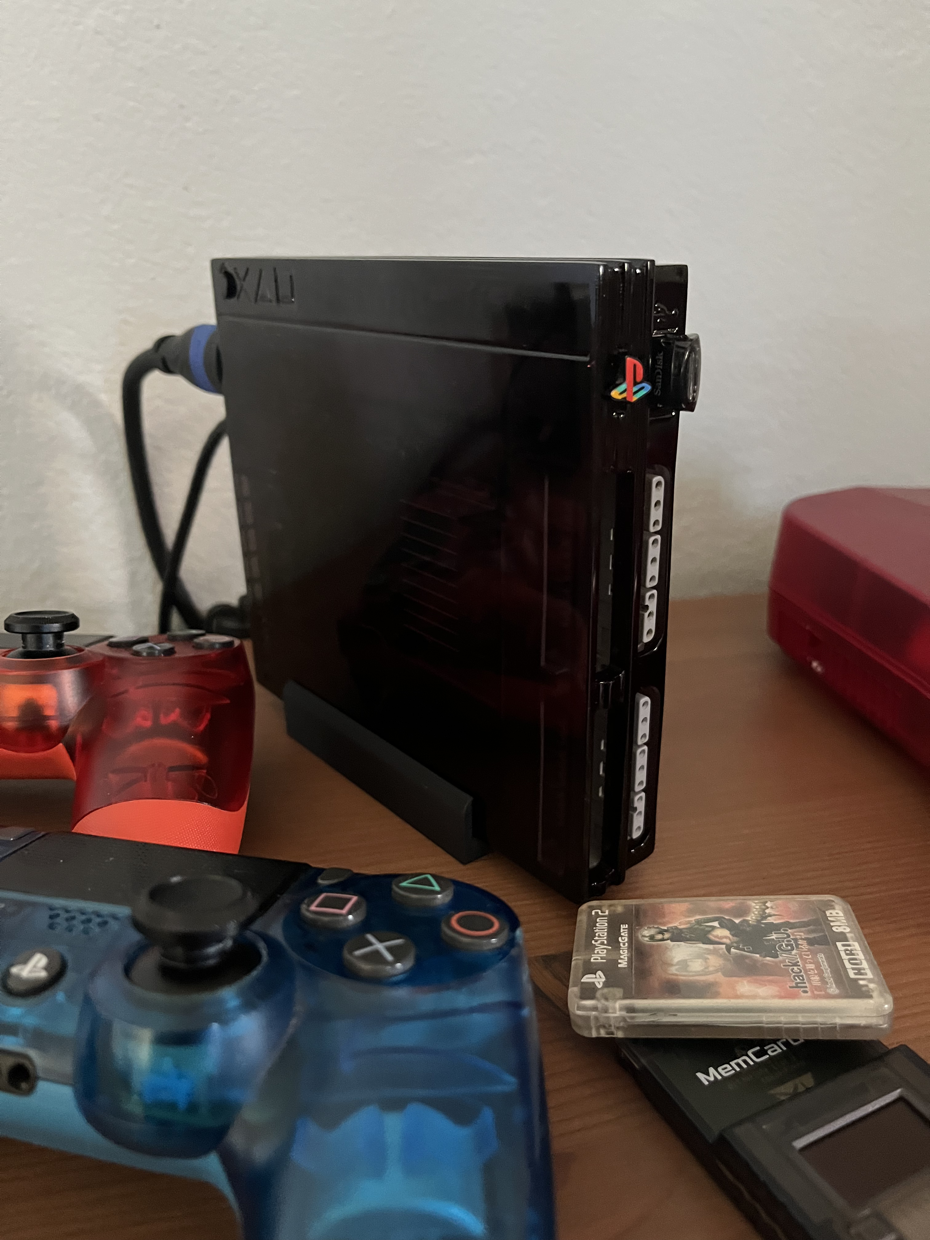

Do you guys like the semi-transparent piano black?
Brings me back to the first Ps3's days.

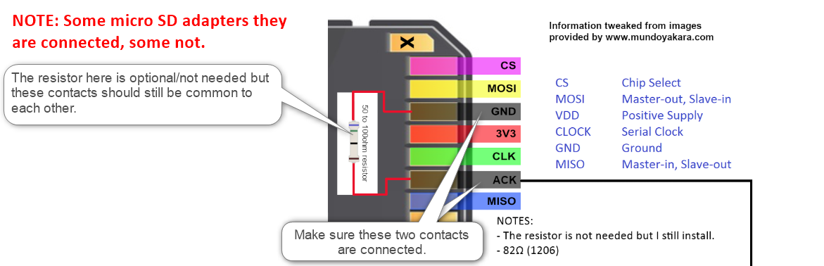

  • Are the "GND" and "ACK" contacts connected/jumpered together?
  • Can you include a picture of your wiring?

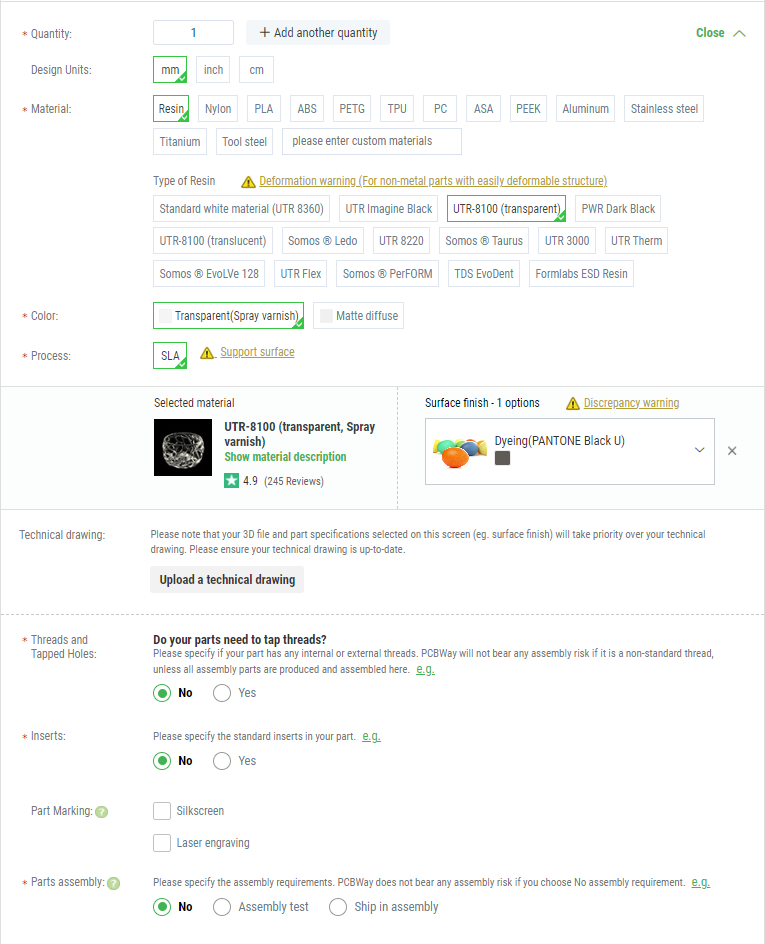

Hey! I’m new to console modding. What’s the best setting for PCBWay when I order the 3D print file from them? PLA, Resin, etc since I don’t know the differences. Otherwise I’m excited to try the build
Finally got my shell back from PCBWay. (I'll also answer your question in the process, @WinterWhoBlue.)
The way I went was a glassy transparent (UTR-8100 (transparent)) with a PANTONE Black U Surface Finish.
(see below)
Which came out exactly how I wanted as a smoky black glassy transparent shell.
You can also do other colors, or just do no surface finish to make it completely clear.
If you don't want transparency, you could always do any of the other options and colors to choose from to fit how you want it to look.
I did this with the top shell, bottom shell, and power button (which the power button is in the files provided by Wesk on page 1 of this thread, and took me way longer to find than i'd like to admit.)
For the other pieces, like the SD Card Bracket, USB-C Retainer, and stand, i just used the basic UTR Imagine Black option, which is cheaper, and looks just fine. Feels very solid and sturdy as well.
I'm very happy with the results of the print, and will be putting it all together later tonight, and will post my progress when I do. :)
Hopefully that also answered your question, @WinterWhoBlue.
It all depends on how YOU want it to look, though.
Good luck with whatever you decide to get printed. :)
Side Note: If you do plan to go with the transparent resin option, don't put any super small details on the 3D model if you decide to edit it. I tried to make my own "DoeKeStation" logo, and have it in the front corner opposite of the playstation shapes, and well.. it's not very detailed. And the small text is just not there at all.
Can only do so much with resin printing, i guess. Haha. I'll know that next time I ever decide to do another print.
