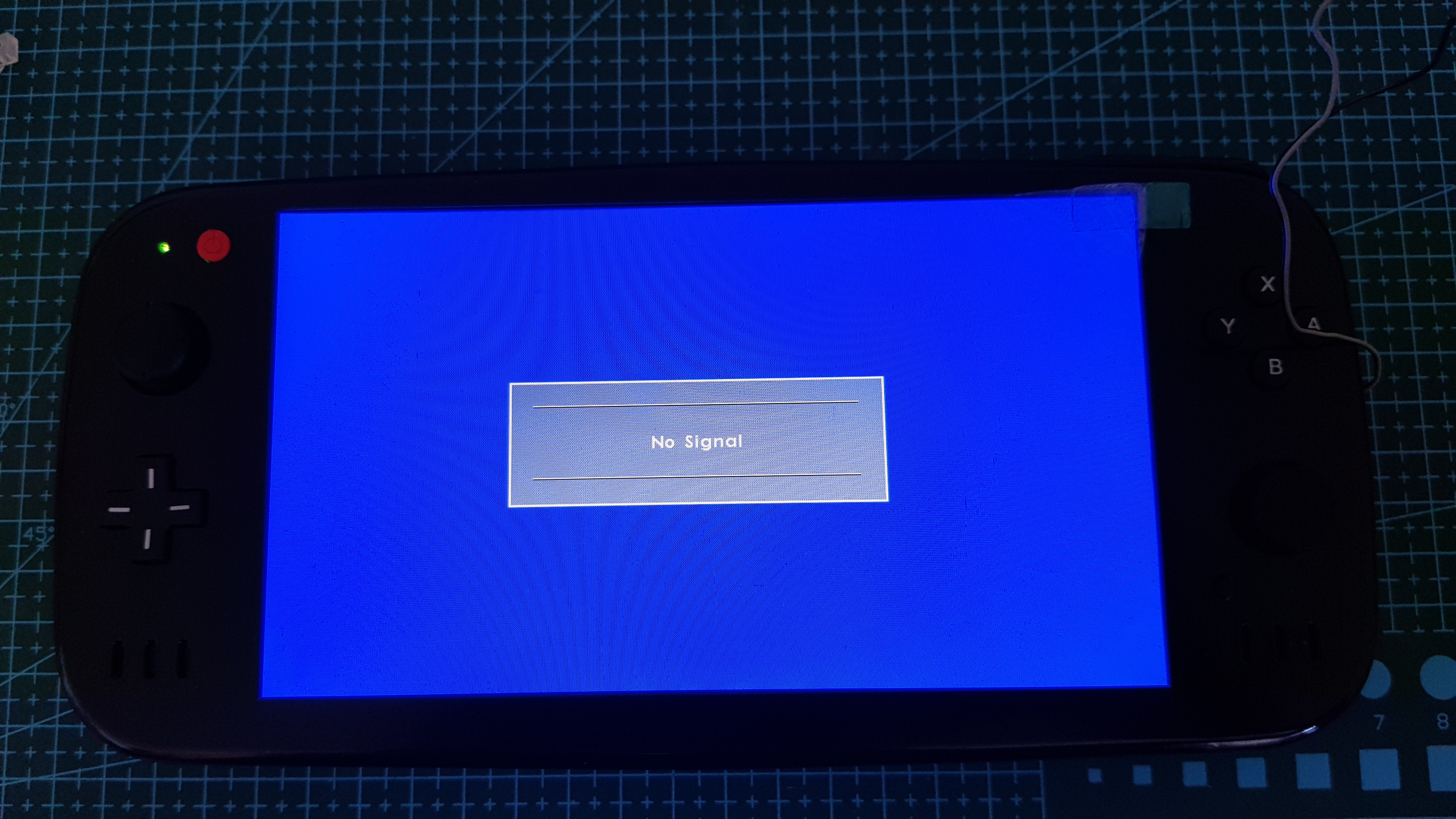

Hi all, I really need some help i dont understand why the VGA patch is not working for me :rothink:
I have plan to use VGA on my O-Wii, but after installing BBloader and activate the VGA nothing apears O.o
I have tried many times to make it work, I have checked my connections several times, the cables go to the right places and do not make any short circuits.
I also tried to disconnect the RCA and leave the VGA connected, it didn't change anything.
I reinstalled BBloader to be sure I enabled VGA, but still nothing.

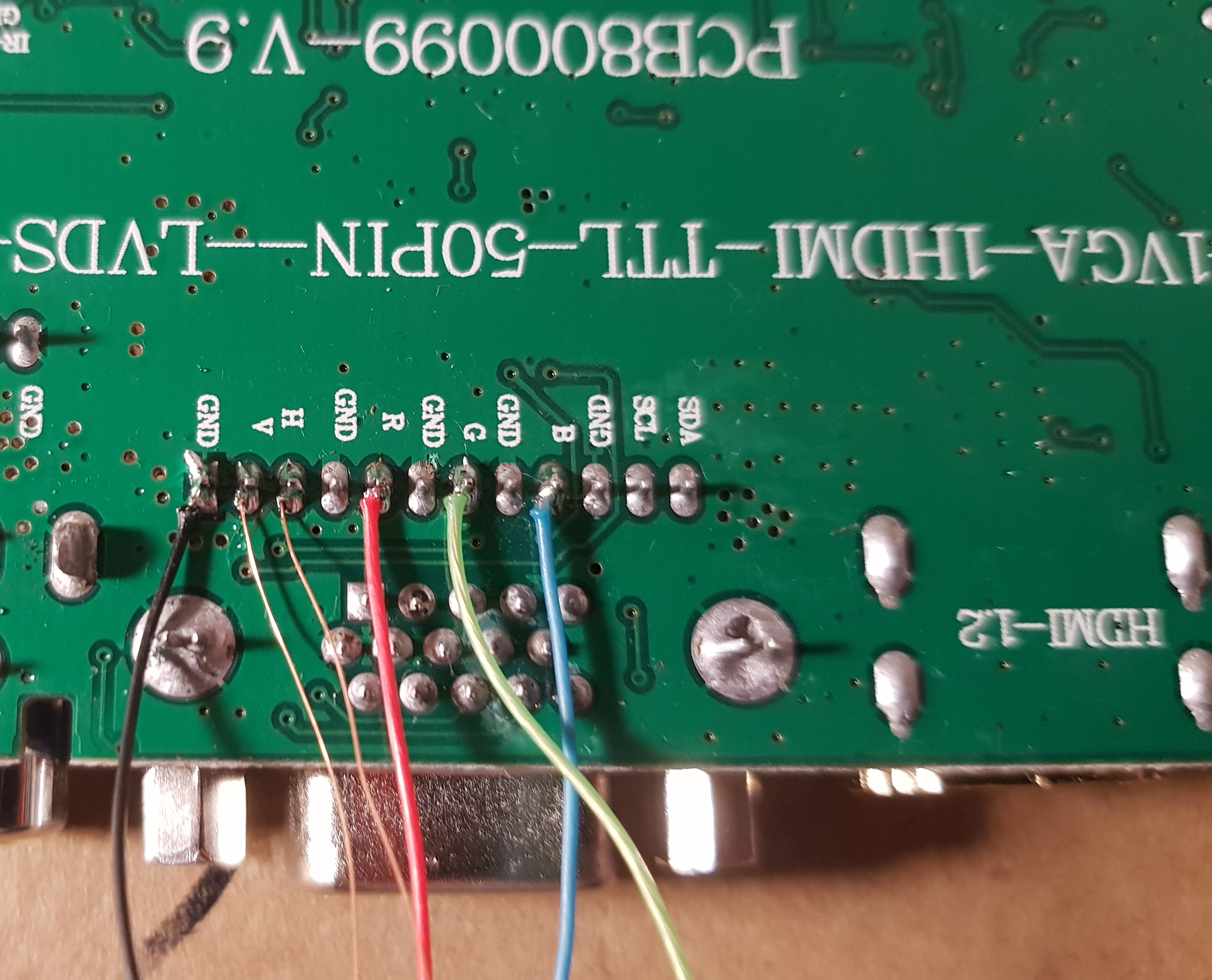

To see if it was not from the screen or the screen card I tested that the VGA works fine by plugging it into my laptop and it works fine :?:

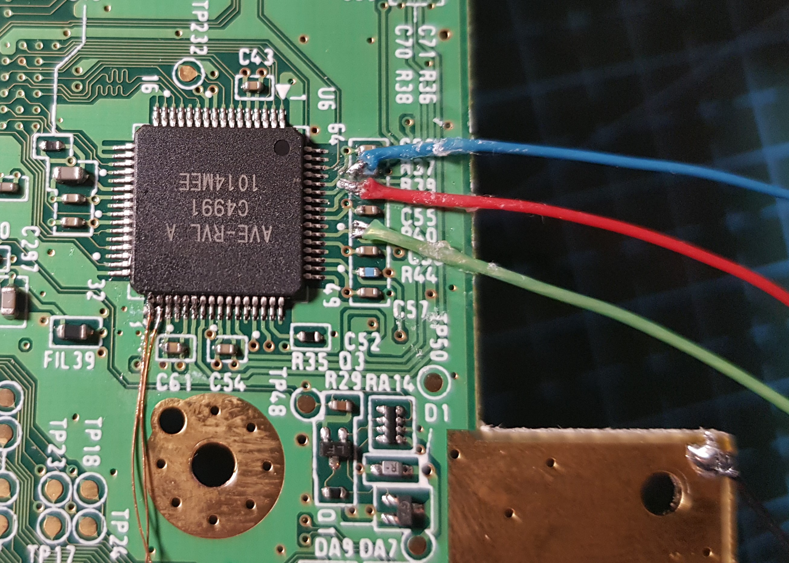

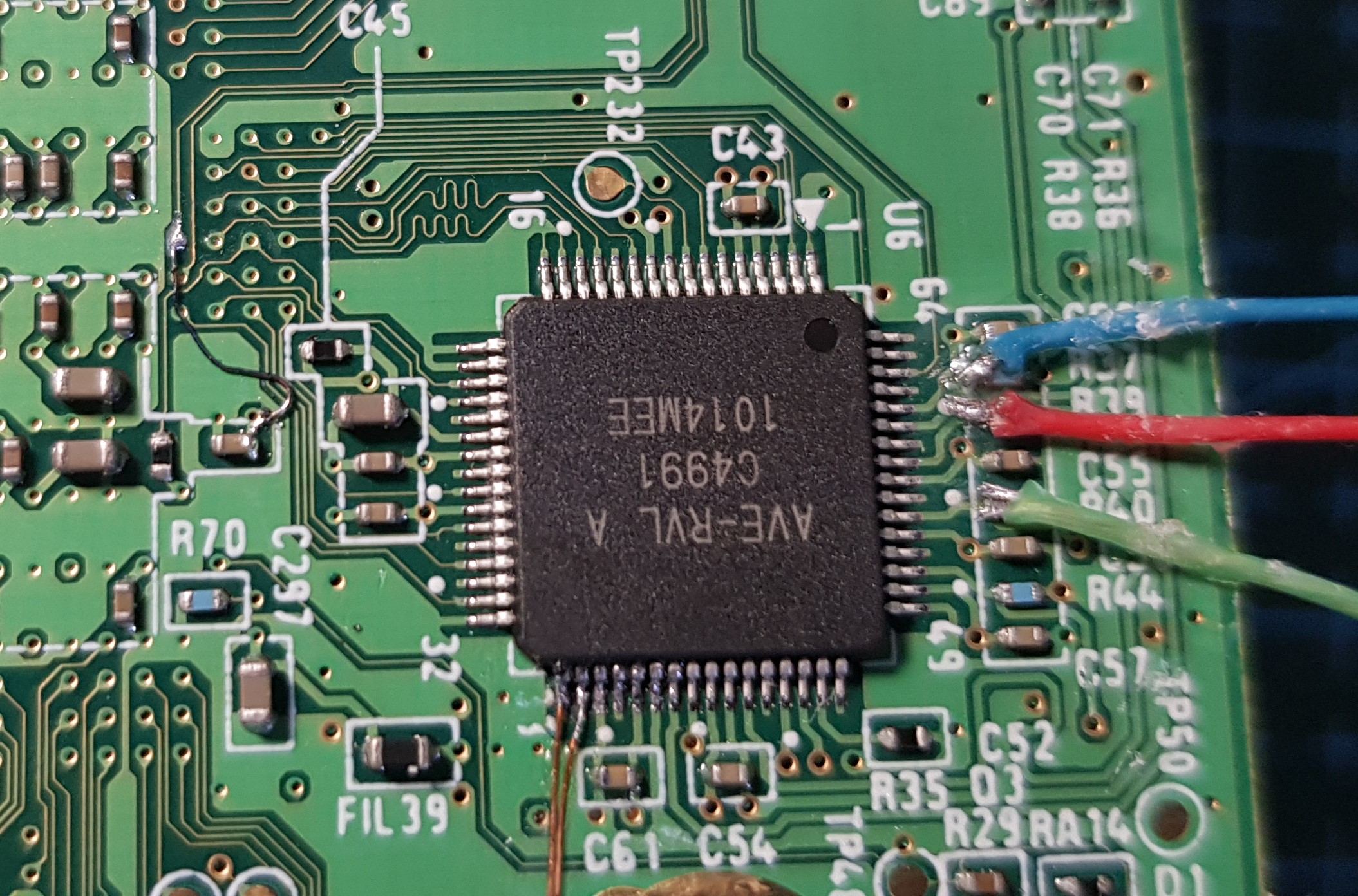

Finally I hacked a black wii (RVL-CPU-50), installed BootMii in IOS with the Homebrew channel and installed BBloader with the VGA patch activated.
I soldered all wire for VGA with RGB color to be sure not to make a mistake in my connections :
(this is for test so it is an untrimed wii)
And after several tests I unfortunately do not have a VGA signal with this wii either :'(

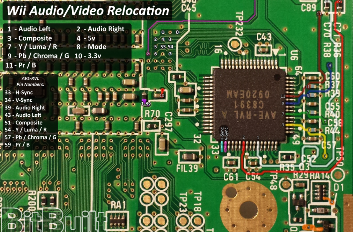

From what I can see, it seems you're missing 3.3V to mode. 3.3V to the mode pin is needed to force VGA instead of composite.
You can take 3.3V from the right edge of FIL39 in this picture. Or from pin 10 as documented in the picture.

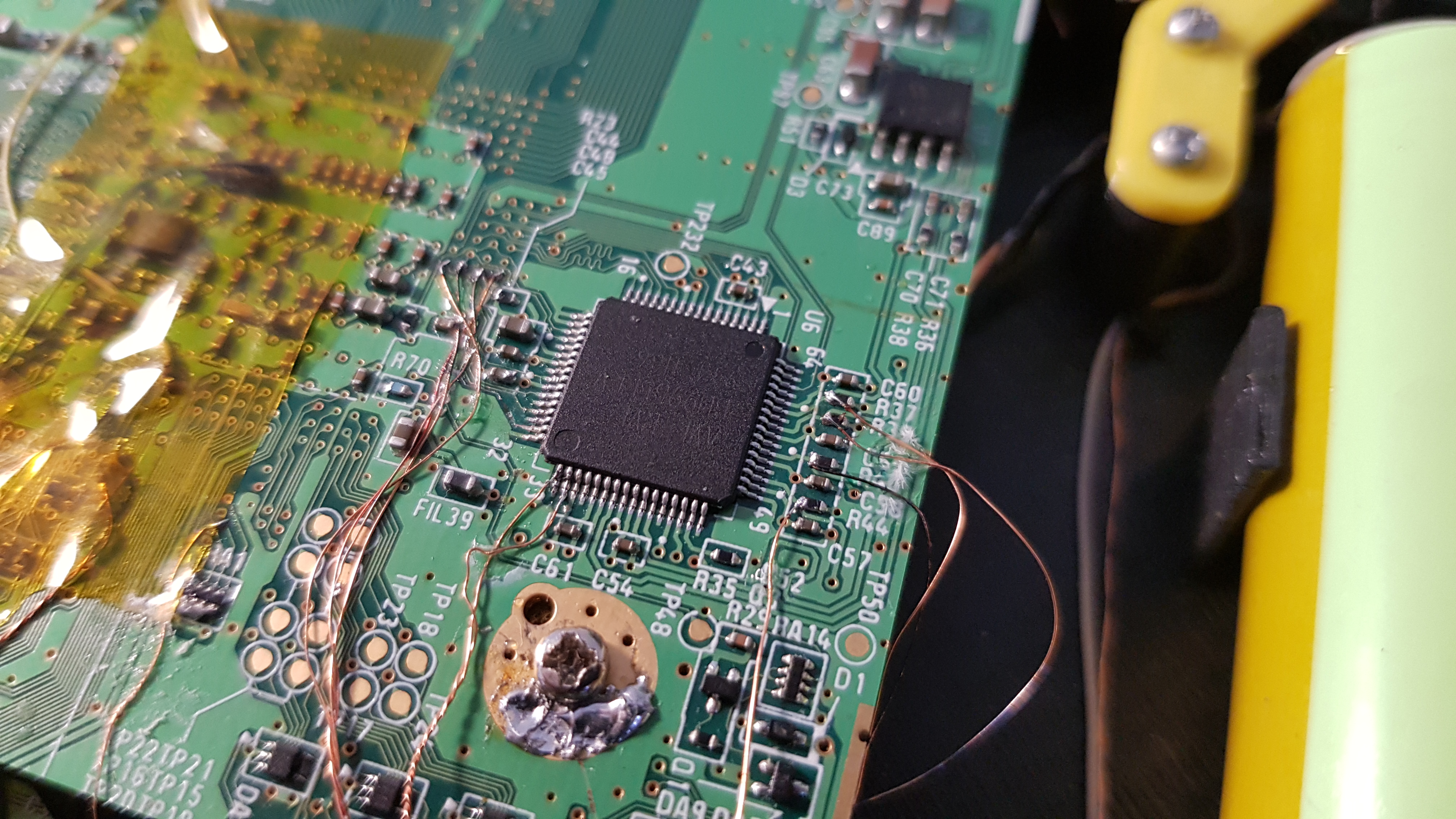

3.3V is directly connected to my trimmed screen board on my portable with my trimmed Wii, the RCA work but not the VGA.
On my second test with the Untrimmed wii the screen board is the same but it is not trimed and powered by external 5V, of course I have connected the GND between the Wii and the screen board, so I don't need the 3.3V line.

I might not be understanding you correctly, as the only portable I've completed is a GWii. To be clear, I'm saying you need to wire 3.3V to Via8 in the documentation of the picture I showed you. That is what is needed to force a trimmed Wii to output VGA with the VGA patch in BBLoader. I'm not saying you need to do anything else with the driver board. You need to wire 3.3V to the mode Via on the Wii. This is easily done by stealing 3.3V from the Wii itself with a single strand of magnet wire from Via10(3.3V) to Via8(Mode) in the documentation provided.
In the picture you showed you don't have anything wired to the mode pin. This pic is what I assume is your trimmed Wii. As you don't have 3.3V to the mode pin you won't be able to get VGA output.

I need to put 3.3V on Via8 (Mode) to make it work !

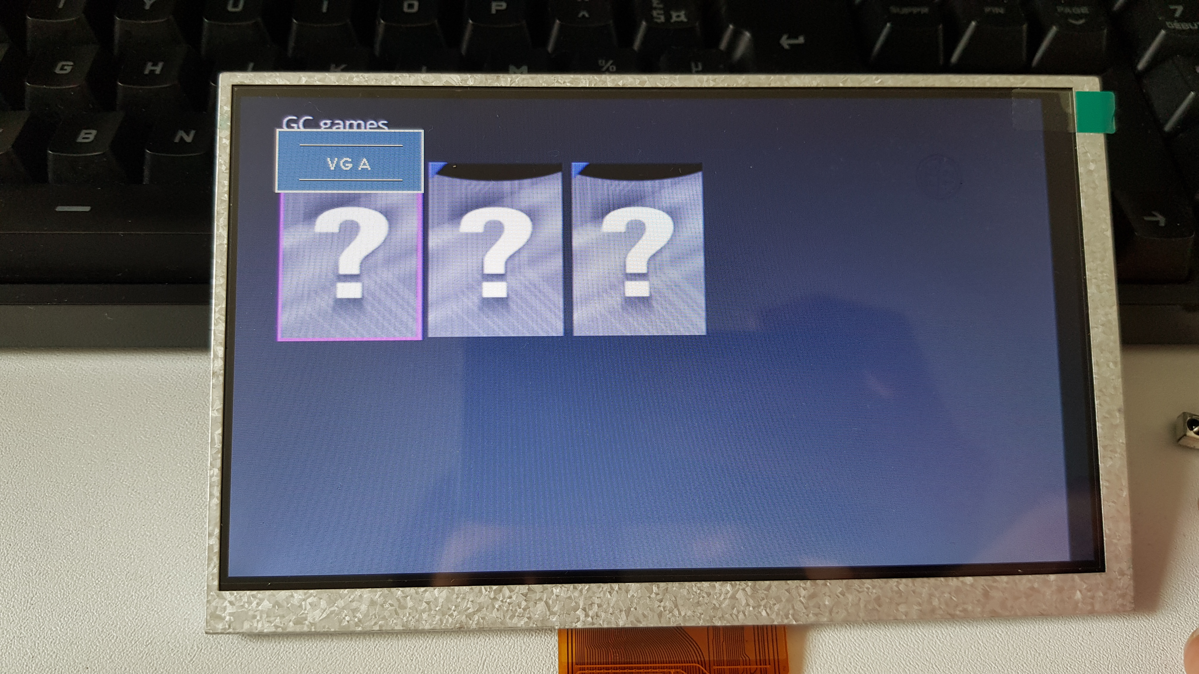

Yeah it work !
Woow the VGA its very clean
Thank you so much @waldie

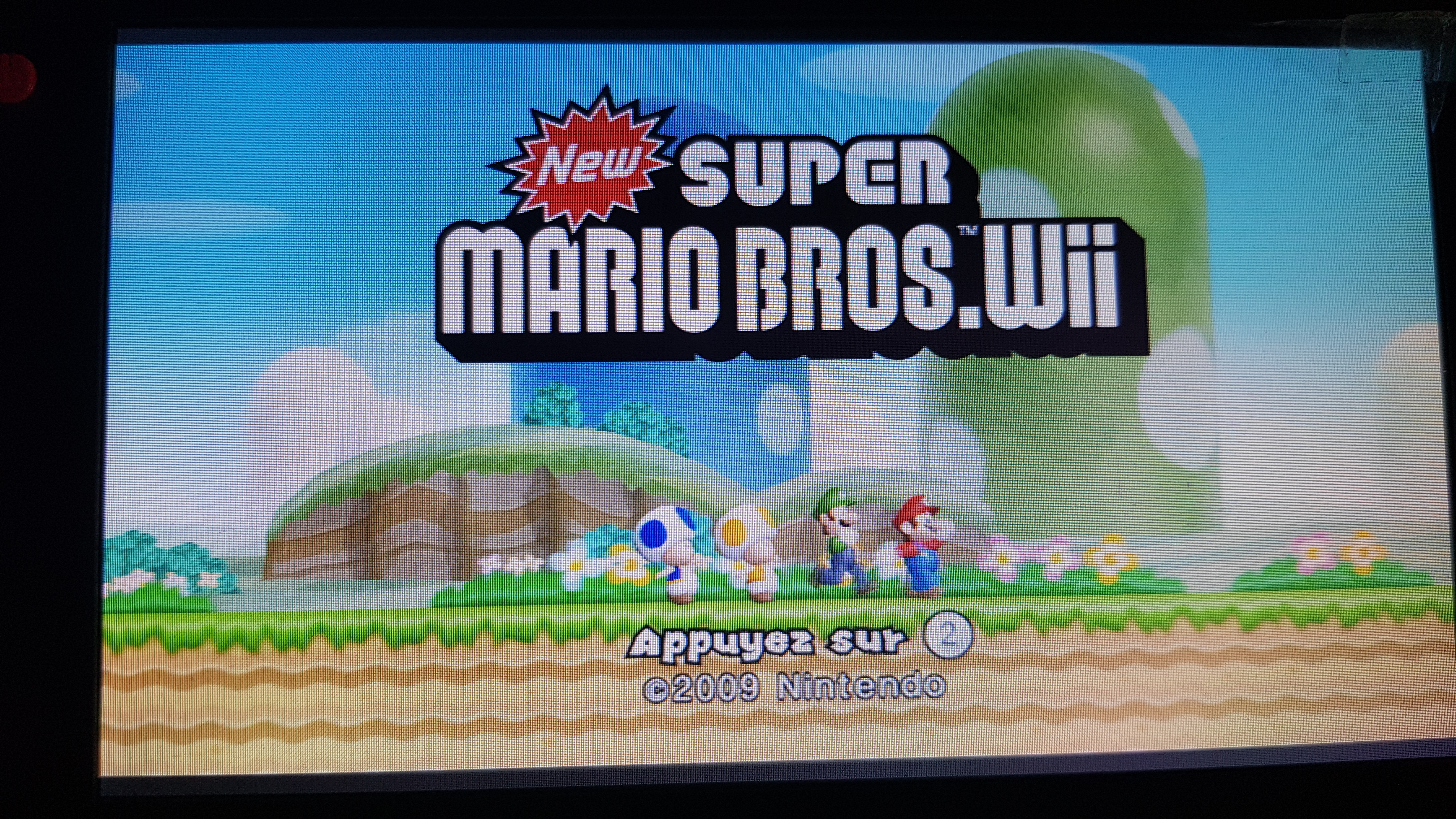

It work ... but the colors are strange :
I inverted the green and the red :facepalm:

The pictures in the guide with the colored tracks are confusing since they are not the corresponding colors O.o

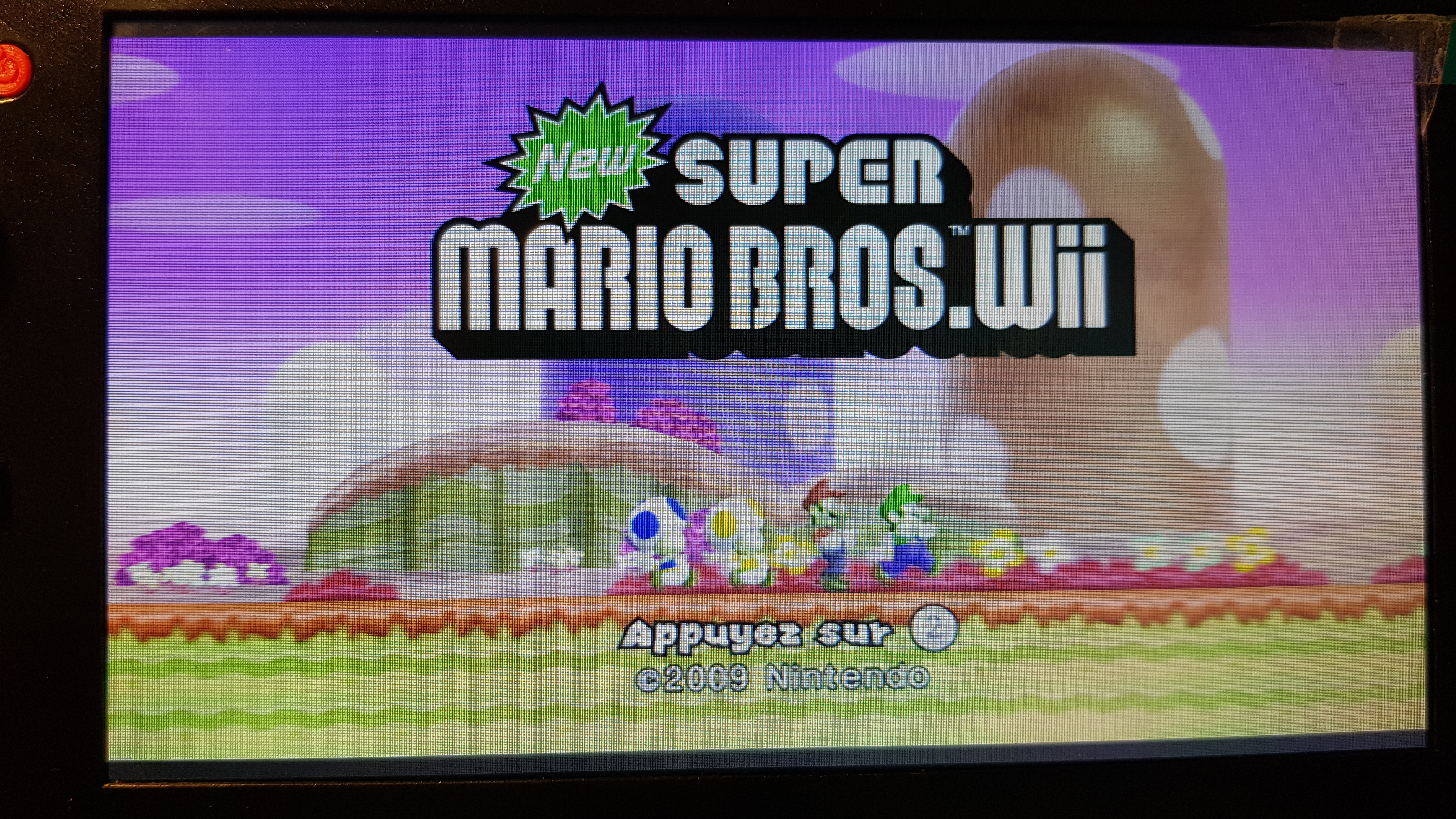

Now it work fine :
I am impressed with the notable difference between RCA and VGA :D
This is really a big improvement, thank you very much for allowing this !
The traces color matches with the YPbPr component cable ones, which is the official output and the diagram was made back when VGA wasn't even a thing yet
