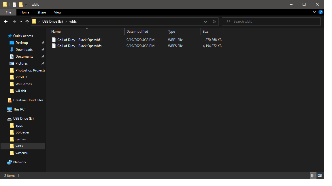

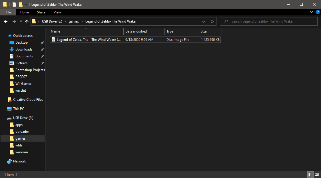

I'm getting my wii prepped for trimming but im having some issues testing bbloader out. First my gamecube game isnt showing up and secondly my wii game launches and I loss signal to my monitor. I patched for vga and i disconnect my wii2hdmi to get the main menu of gc games but as soon as I try to launch like a wii game it goes no signal and nothing works to get it back. Ill attach my file structure. (Also sorry if this is the wrong section).

To start, it looks like your structure for GameCube games is incorrect. As per the guide linked to in the FAQ the correct format is:

USB:/games/Game Description/game.iso

Yea I disconnect and connect to be to see the main menu but after trying to launch the wii game it goes no signal regardless if I disconnect and connect it. Same happens if I try to use the safe menu to get to system menu. As for my file structure whats wrong with it? I have "games" in the root then a "Game description" which is the Legend of Zelda folder and inside of it is an iso. Im structuring the wii iso right? Because it had to be split for fat32
Your GC game isos should literally be named "game.iso"
Ahh that makes sense, I guess im just dumb. I will test gamecube Zelda and see if it outputs on my monitor.
Edit: Gamecube game worked successfully and displayed on screen. Could the split in wbfs file be why this wii game wont work?
Your "issue" is caused by BBLoader booting in VGA mode and reactivating it when launching Hiidra for Wii games. To bypass this you need to disconnect the wii2hdmi BEFORE powering your Wii on, then plugging it back in after few seconds
