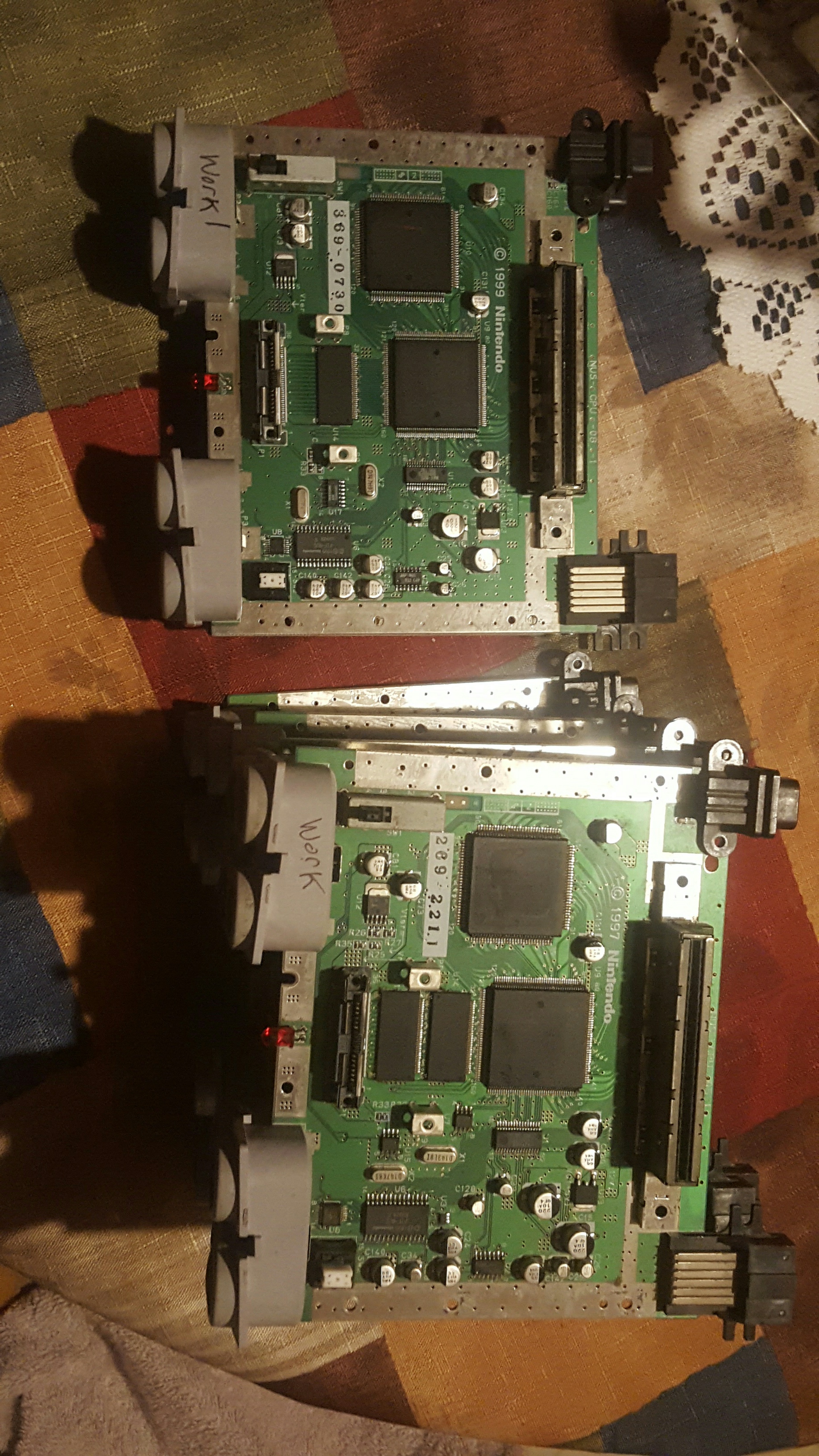

I have 2 of the same ones on the left and 5 of the same ones on the right
