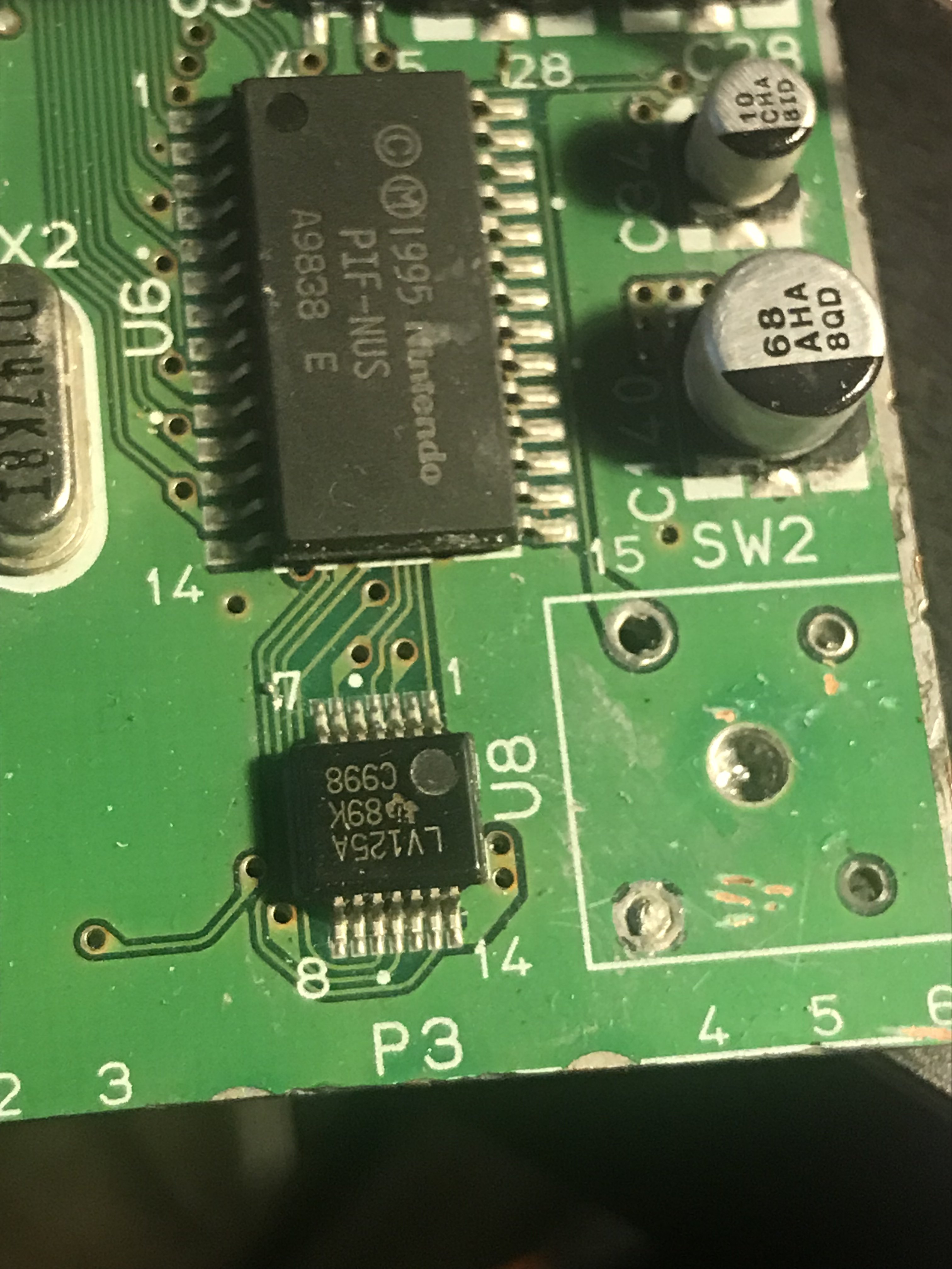

Okay so I’m just dumb and realized I didn’t cut too much off. I just cut off the part that told me what trace was what. But I still have the u8 chip and the pif. Can I just connect the data line of the controller straight to the u8 and if so is there a pin out of that chip?

You can check continuity between the current solder point and the chip with a multimeter and see which pin goes go which controller that way.

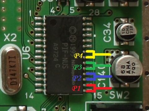

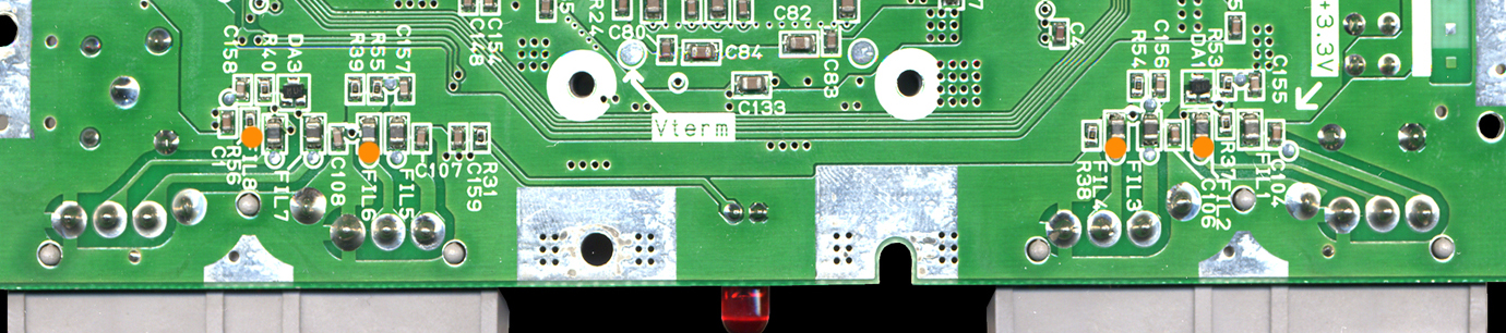

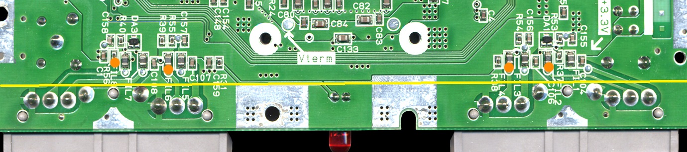

I'm going to be adding 4 player functionality to my portable. Based on the orientation of my motherboard I'm going to wire to the rear. I'll be wiring to these points.

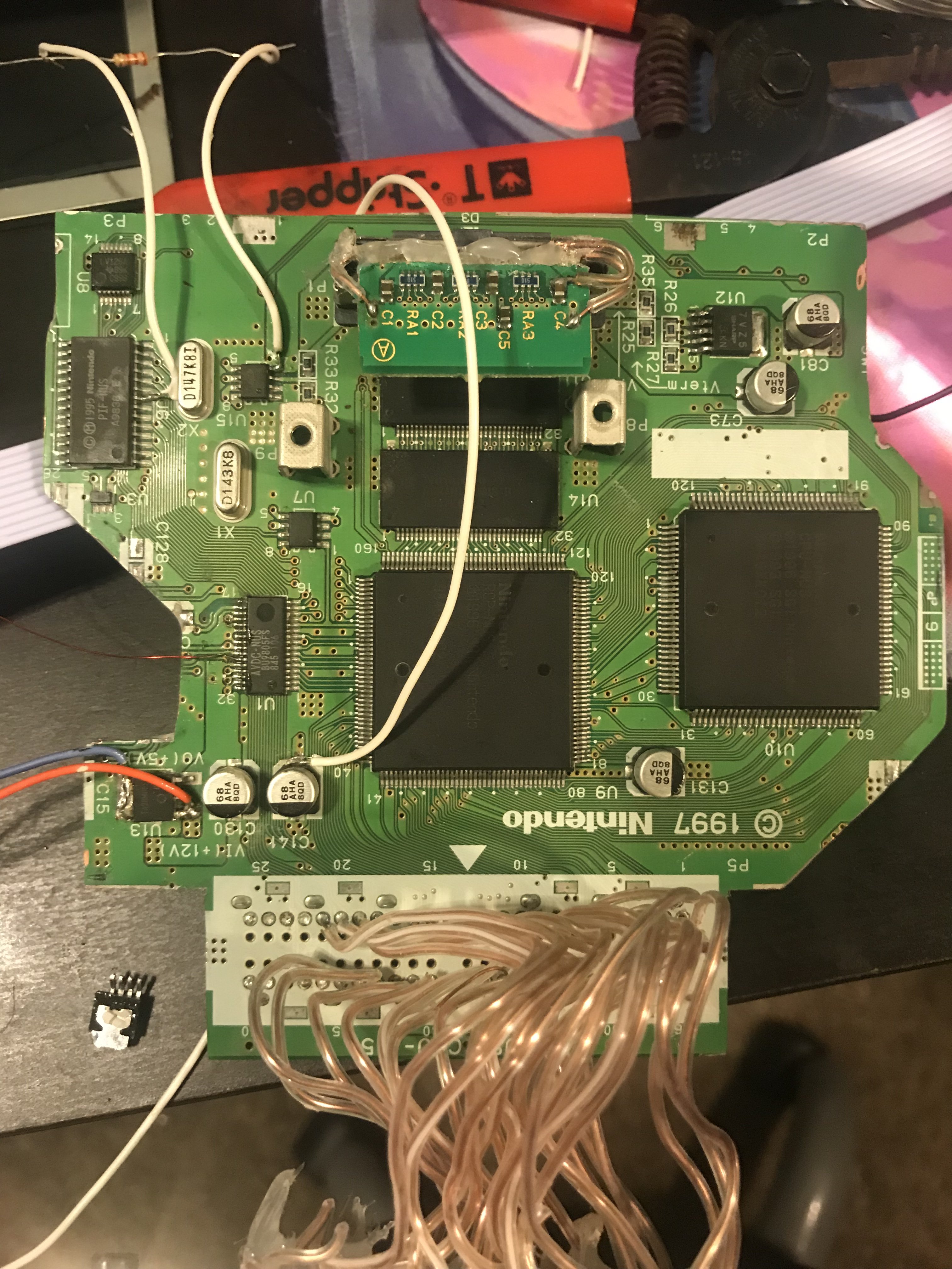

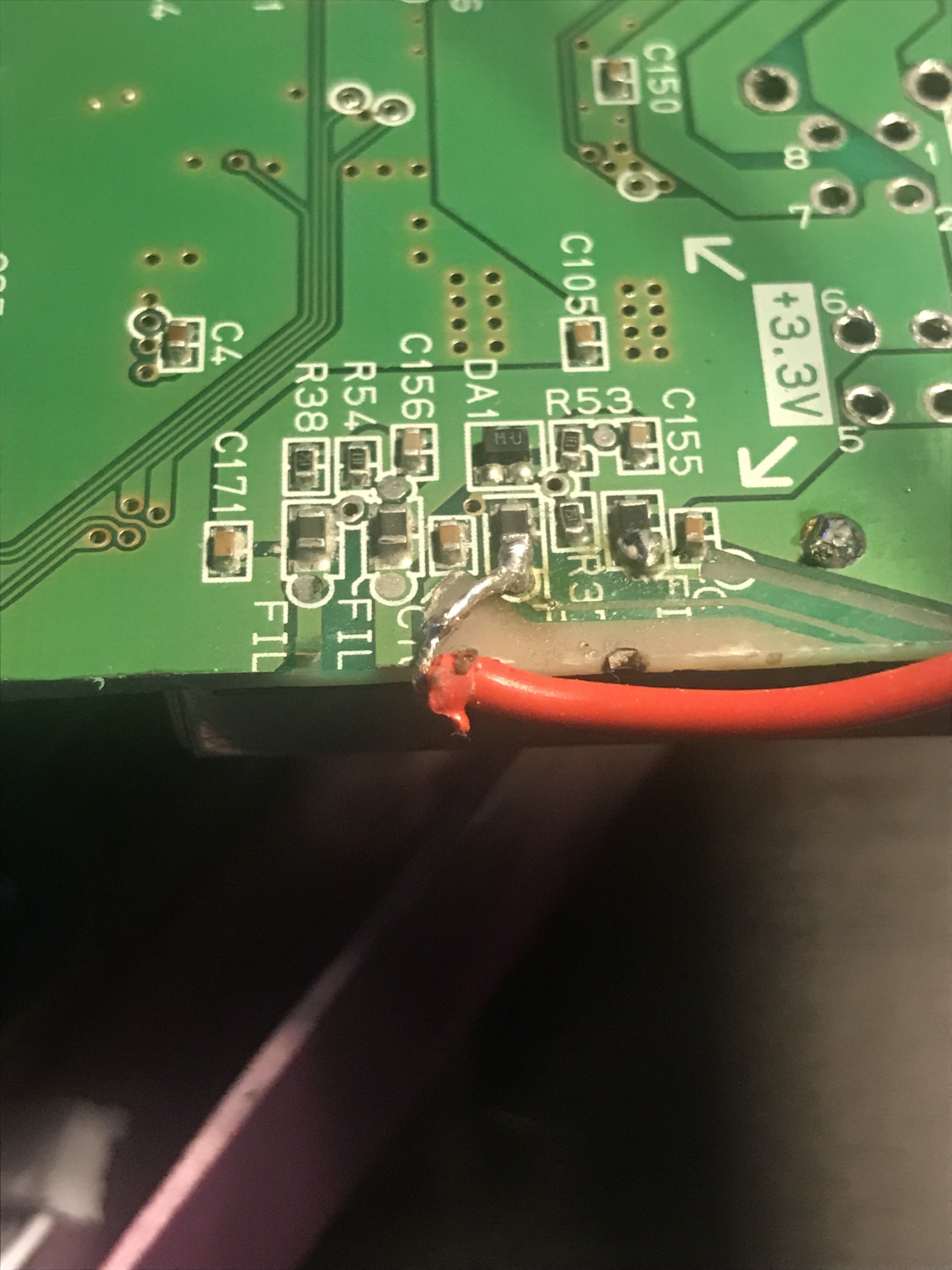

Alright so I finally got my n64 hooked up after a long wait for parts but unfortunately it doesn’t do anything. The chips get warm so I know it’s on. I have a rev 5 and was doing some research about possible fixes. I didn’t have a 2k resistor for pin 8 on the pif so I used a 2.2k. I know for anything under rev4 I need to rewire some 3.3v traces on the back of the board. Does this apply for the the rev 5? I’m also wondering if I trimmed too much off near my 7.4v input

I'm going to be adding 4 player functionality to my portable. Based on the orientation of my motherboard I'm going to wire to the rear. I'll be wiring to these points. View attachment 8202
So you're saying you just need to solder to those smt chips to get the data signals for the p2-4. im trimming my board around here(refer to yellow line). it shouldn't cause any issues right?
Apologies for the lateness of the reply, I just saw this. That's about where I'm going to trim to, I believe it will be fine.
I honestly don't understand why you would cut that much off the area? My only thought could be a port that sits there? But on a serious note, you should practice running your wires more nicely. That 2.2k shouldn't be in the air like that lol
Maybe your video line is too thin too. Try something thicker and shorter
Looks like 30 awg magnet wire?
