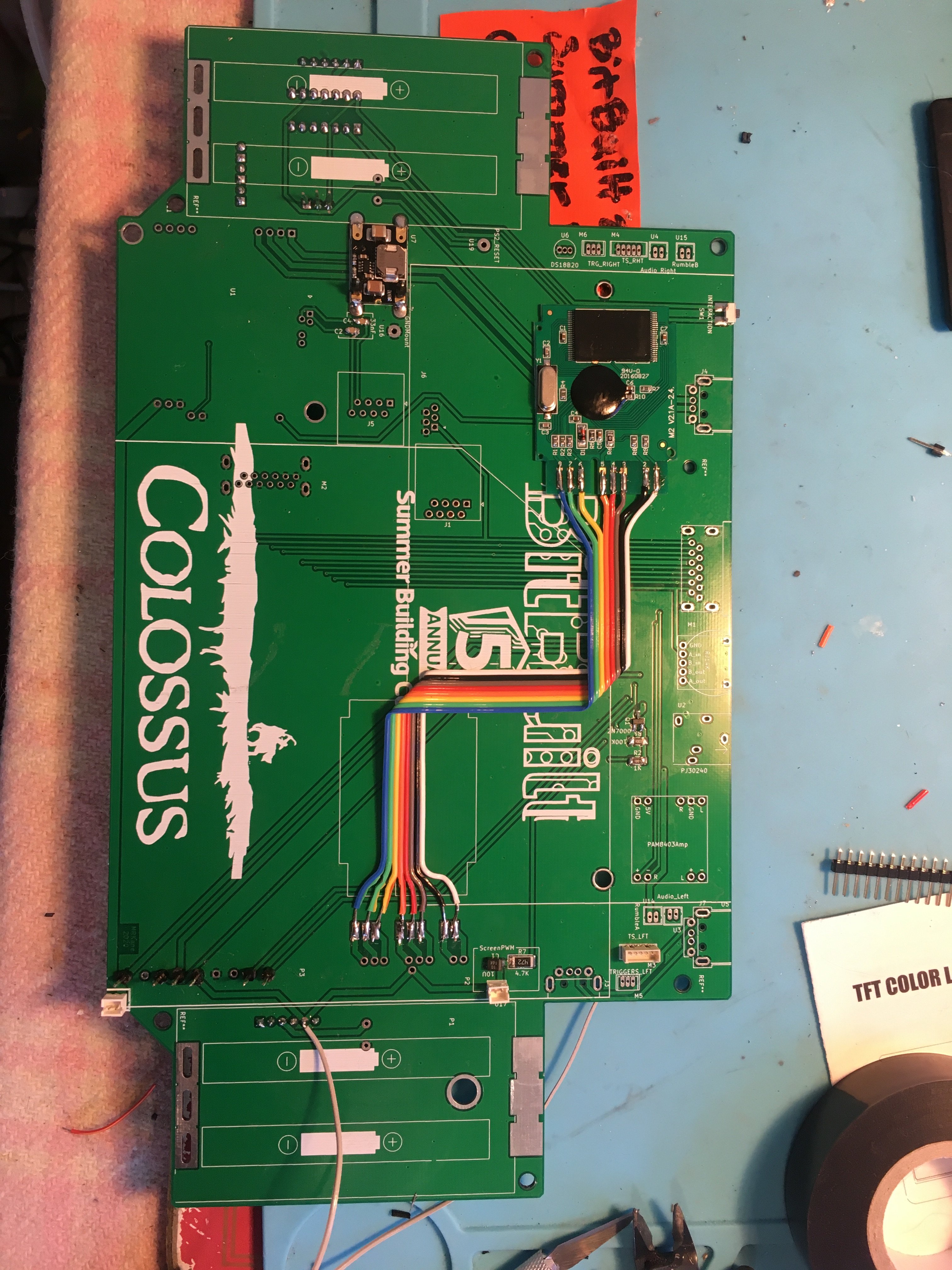

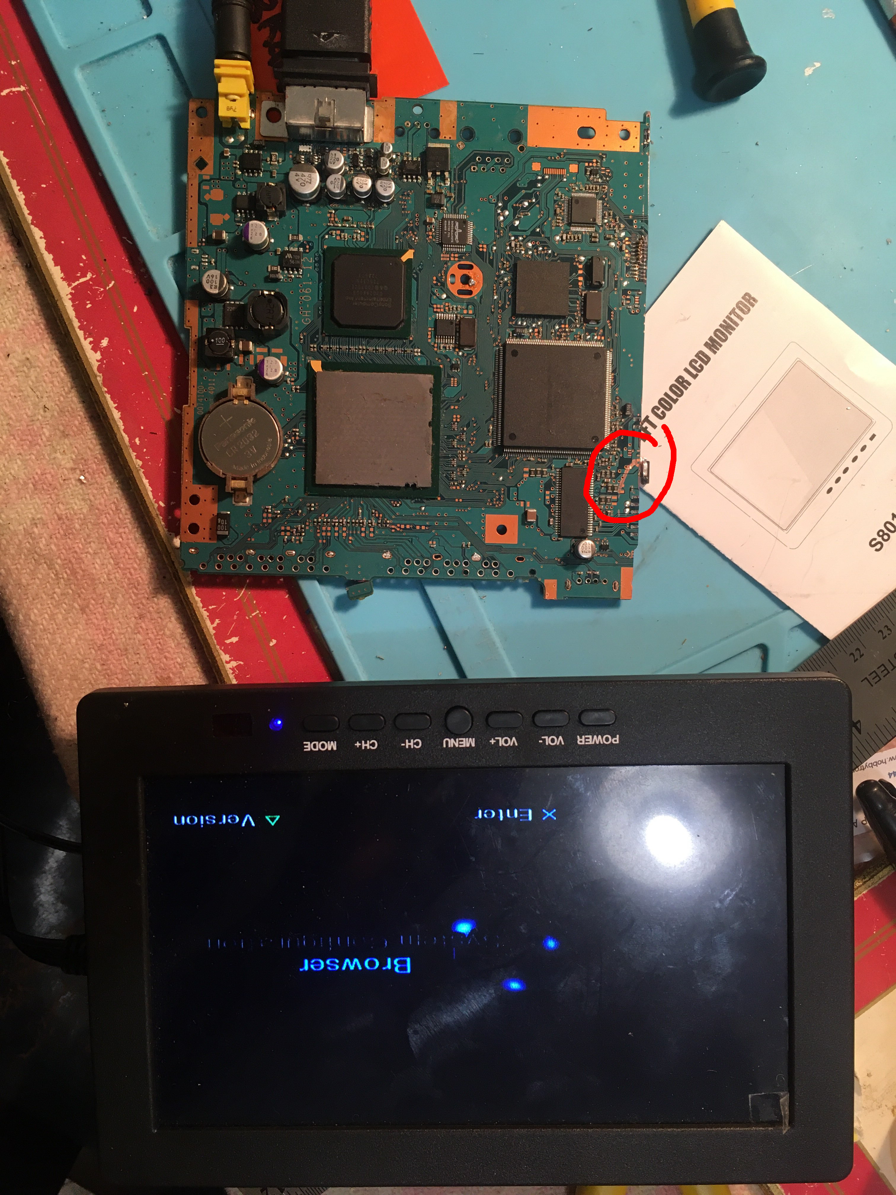

Fun day setting up the screen control!
TLDR: Fluffy isn't in this post ;)

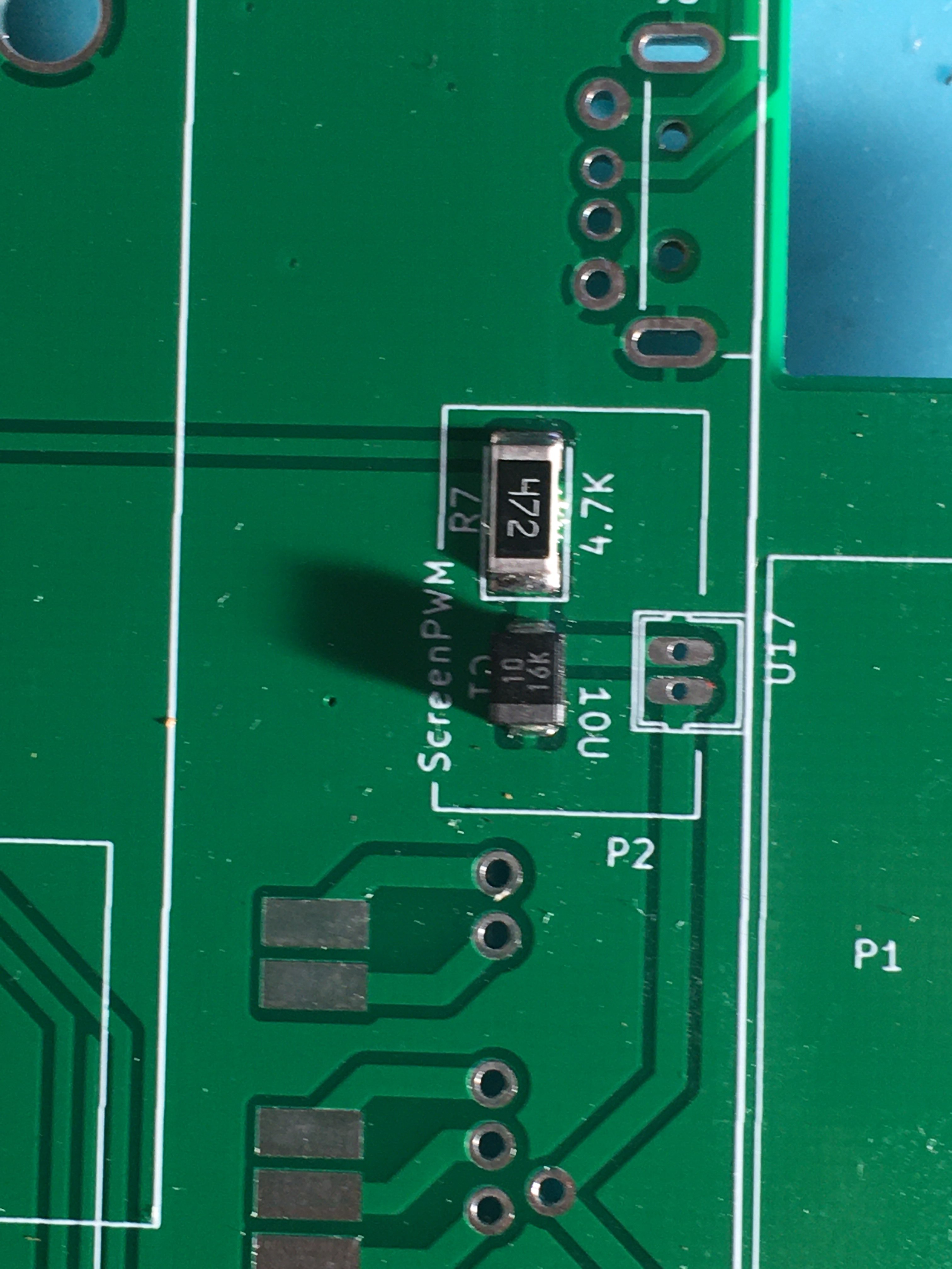

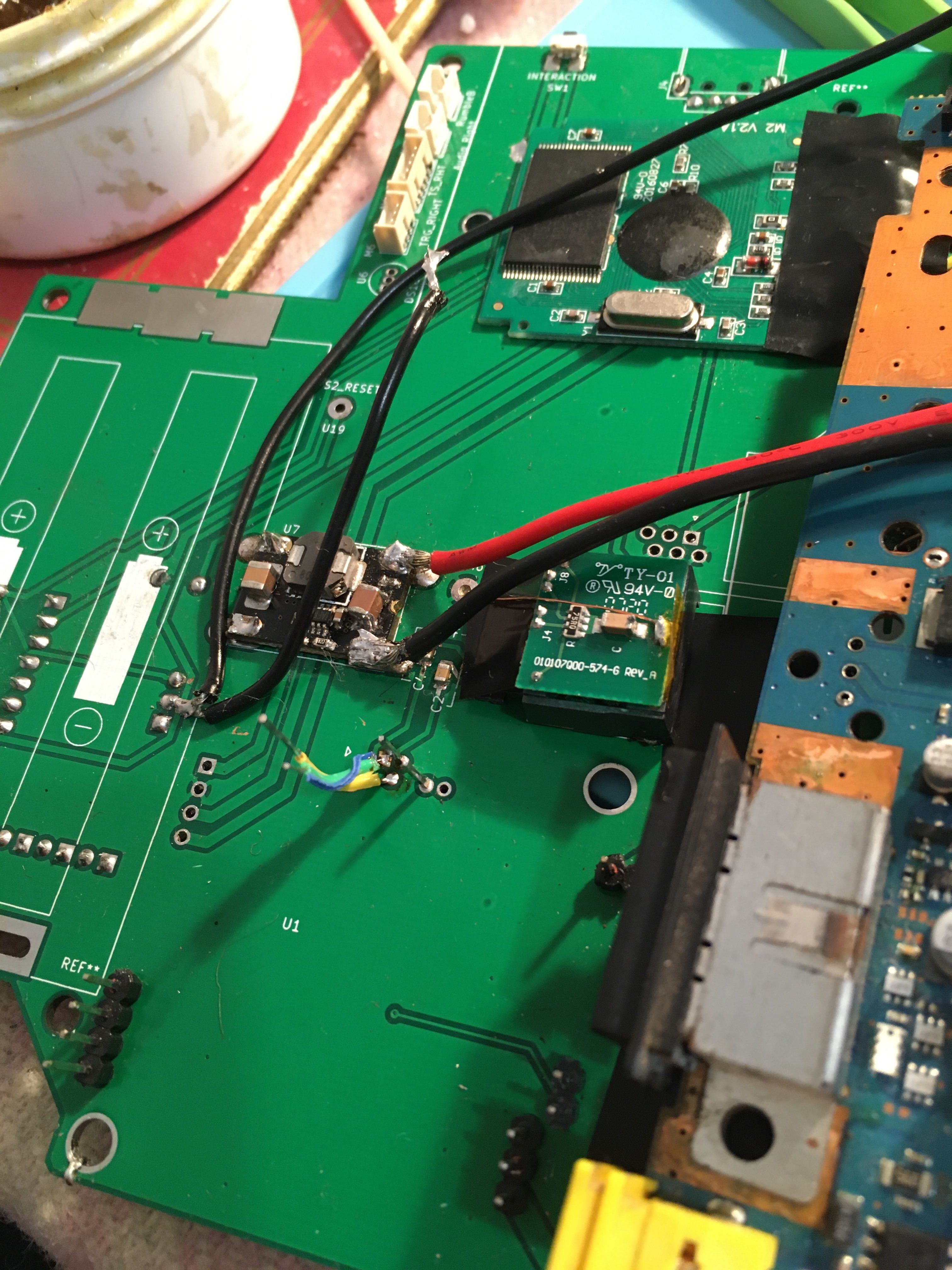

Turns out some of the guides on which direction the SMD caps should go are mildly misleading, and this is important if you've a basic little low-pass smoothing filter for a screen signal. I eventually asked a friend for help and he pointed me at a very old jpg that had all the information I needed.
This was also a bit too small given the space, but I made these 1206 to make life easier on myself. This is also the WRONG way around, and the last time I'll see it with neat soldering. NOTE: This might be more for my reference later if I'm unsure of something.
And this is the correct wire placement...so between these two things it became annoying to narrow down just where and how there was an issue. Plus I couldn't do heat gun soldering on the board anymore thanks to having mounted plastic parts close by.

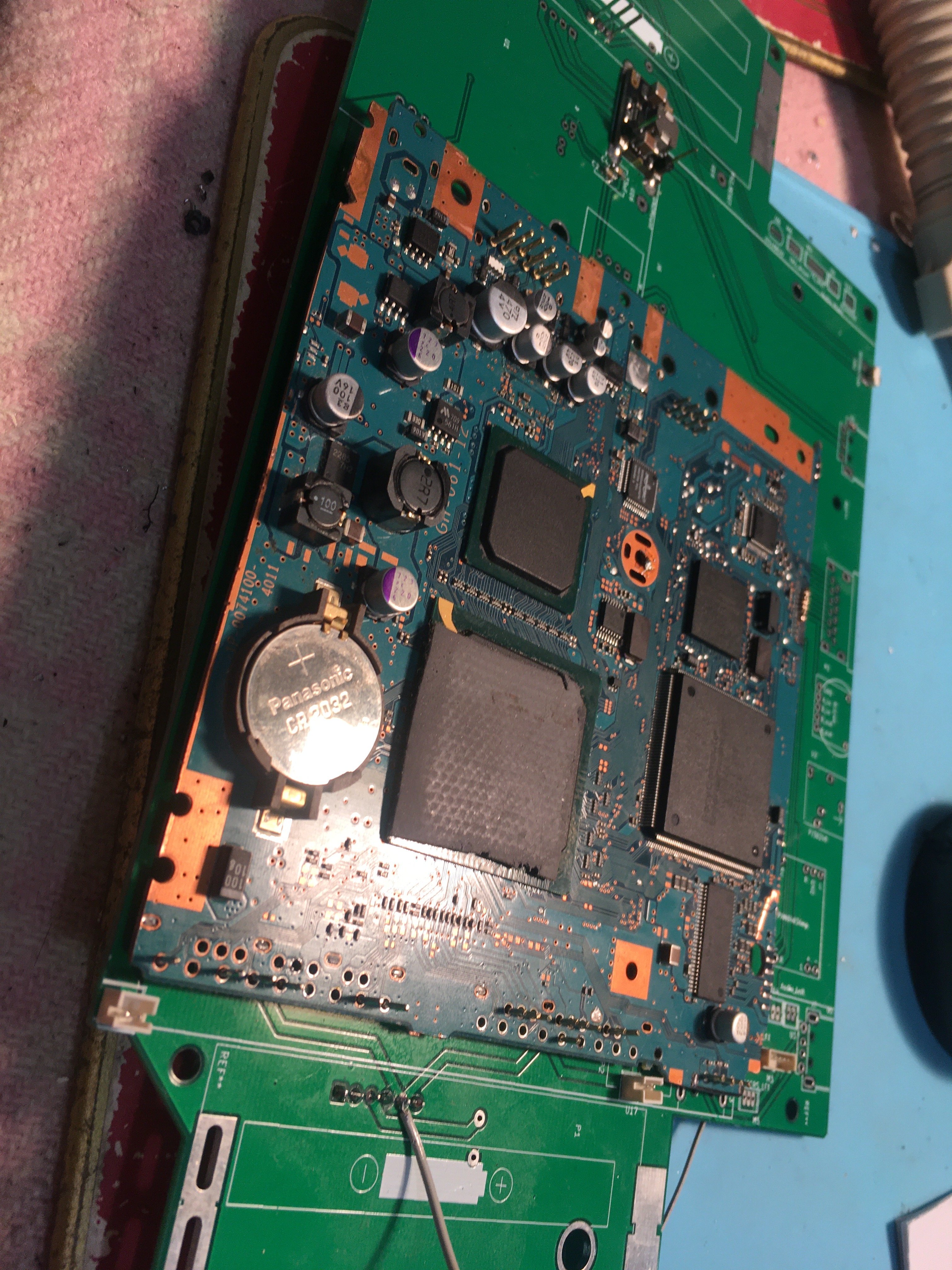

So it's been a while up my neck of the woods with a few things I didn't consider coming to play. The first is that I sunk a mounting post through the PS2 so will have to run some power lines for the USB port (it's a prototype) and the second is that I forgot that the memory card had a crystal on it so that it had to be relocated.

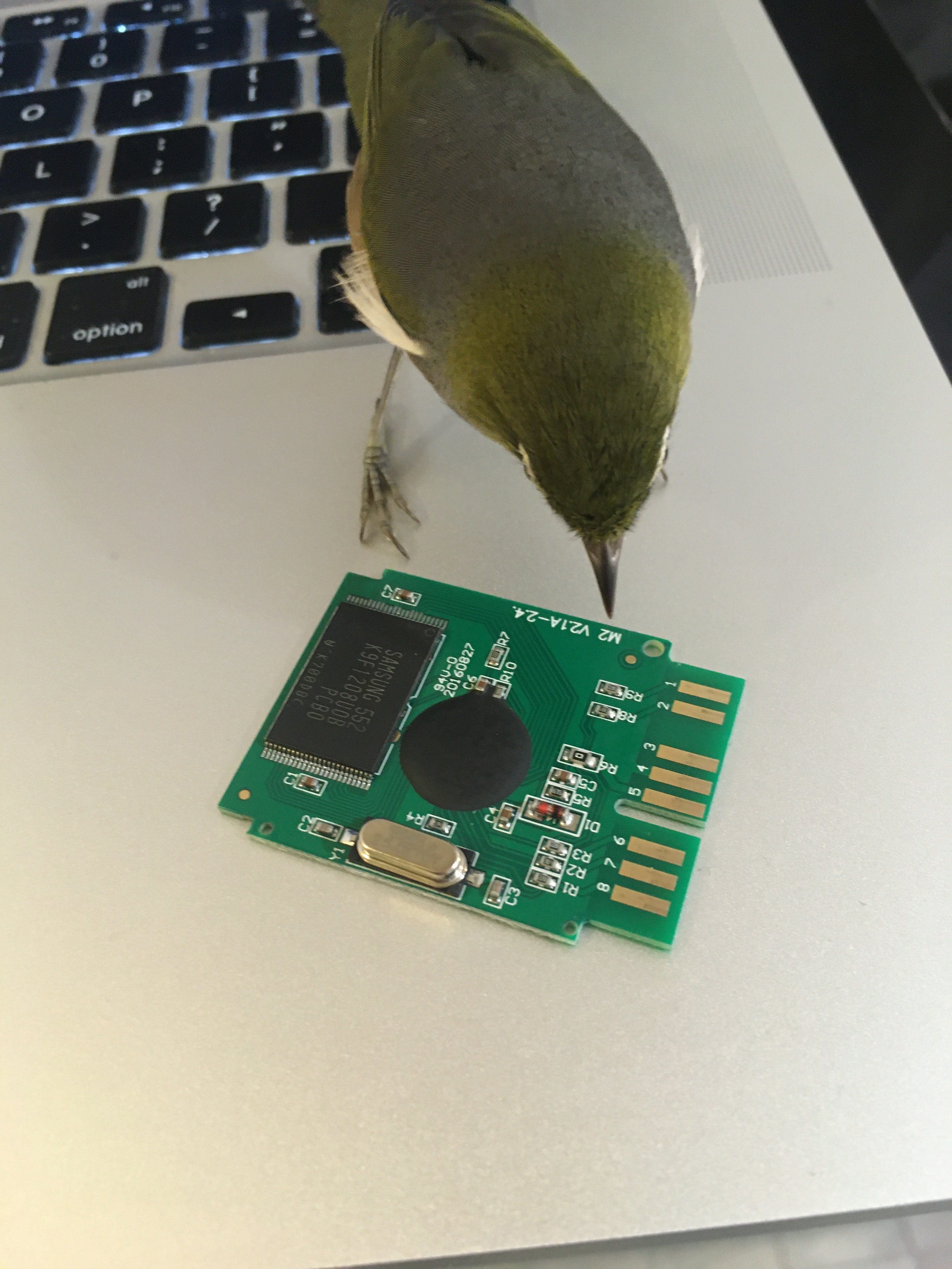

Fluffy inspects memory card for fatal flaws and issues. Birds are known for having exceptional vision which makes him perfect for this task! Bit of a shame that I can't speak his language so can only guess at what he's inspecting.

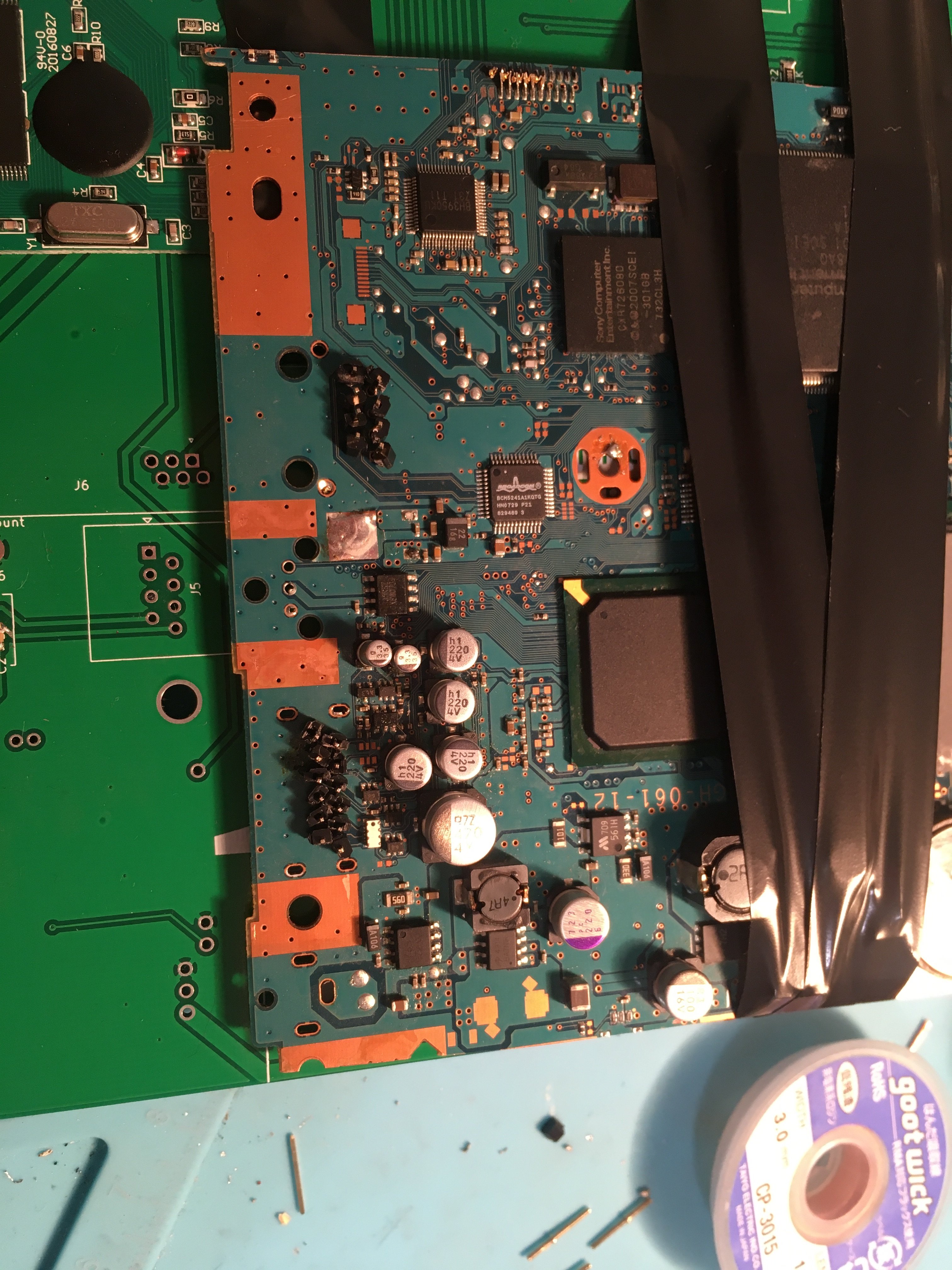

Relocated memory card. Original positioning was underneath the PS2 motherboard, but I left room in this area for just this reason.

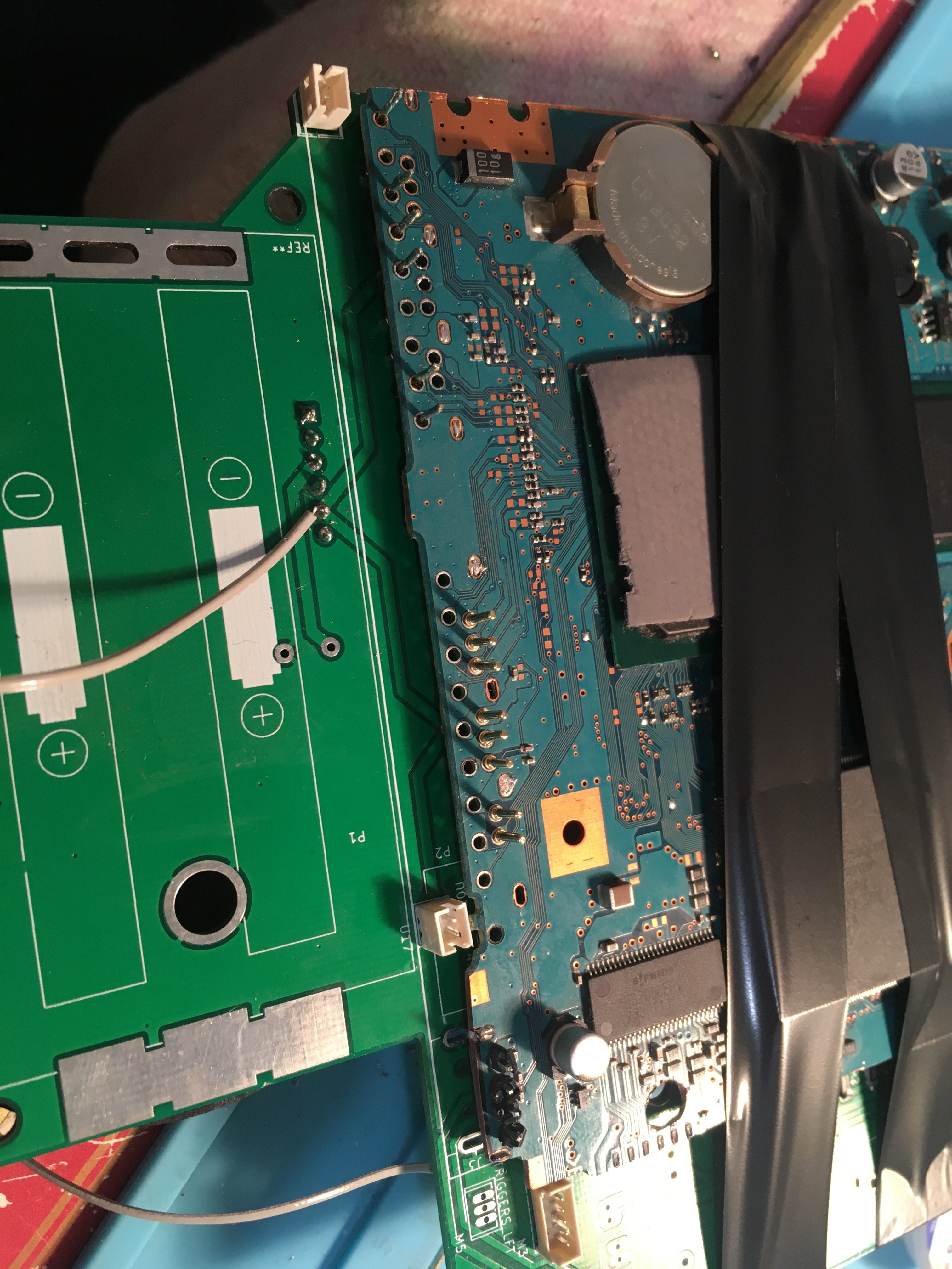

So naturally no plan survives the first contact intact and this was where I found out how much of an impact 0.1mm could make on a setup like this. So the brass headerpins I've got for a few of the connections have a diamater of 0.85mm, and the standard header pins I've got are 0.7x0.6mm. Now the ethernet pin holes on the PS2 are 0.8mm diamater, and the AV port is a little below that so I had to try and thread things through to make them work accordingly because naturally my measurements and placements weren't perfect, but I managed and didn't have to break out the 0.6mm copper wire which was my backup plan. Took a very long time...
So the header pins had the plastic tabs cut in half and then trimmed to make them fit close together. Fun times with things failing here and pins falling onto the ground. Fluffy actually made off with a brass header pin and we don't know if he ate it so I guess we'll find out tomorrow.
So the bit not pictured was covering all of these with tape so that they couldn't fall through and soldering the underside of the unit. I did get to remove all the black bits. The following was a photo of the test arrangement, but I rather like how good it looks before I mucked up the soldering ;)

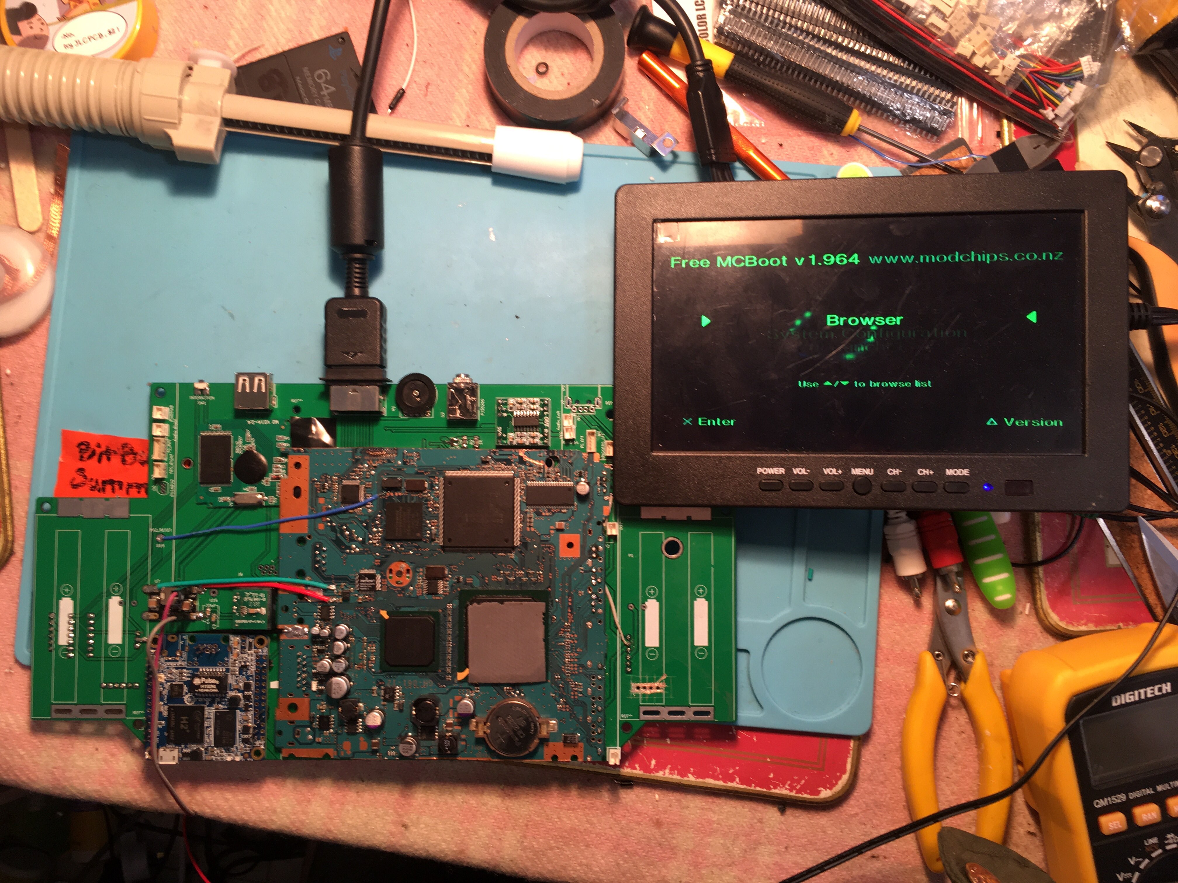

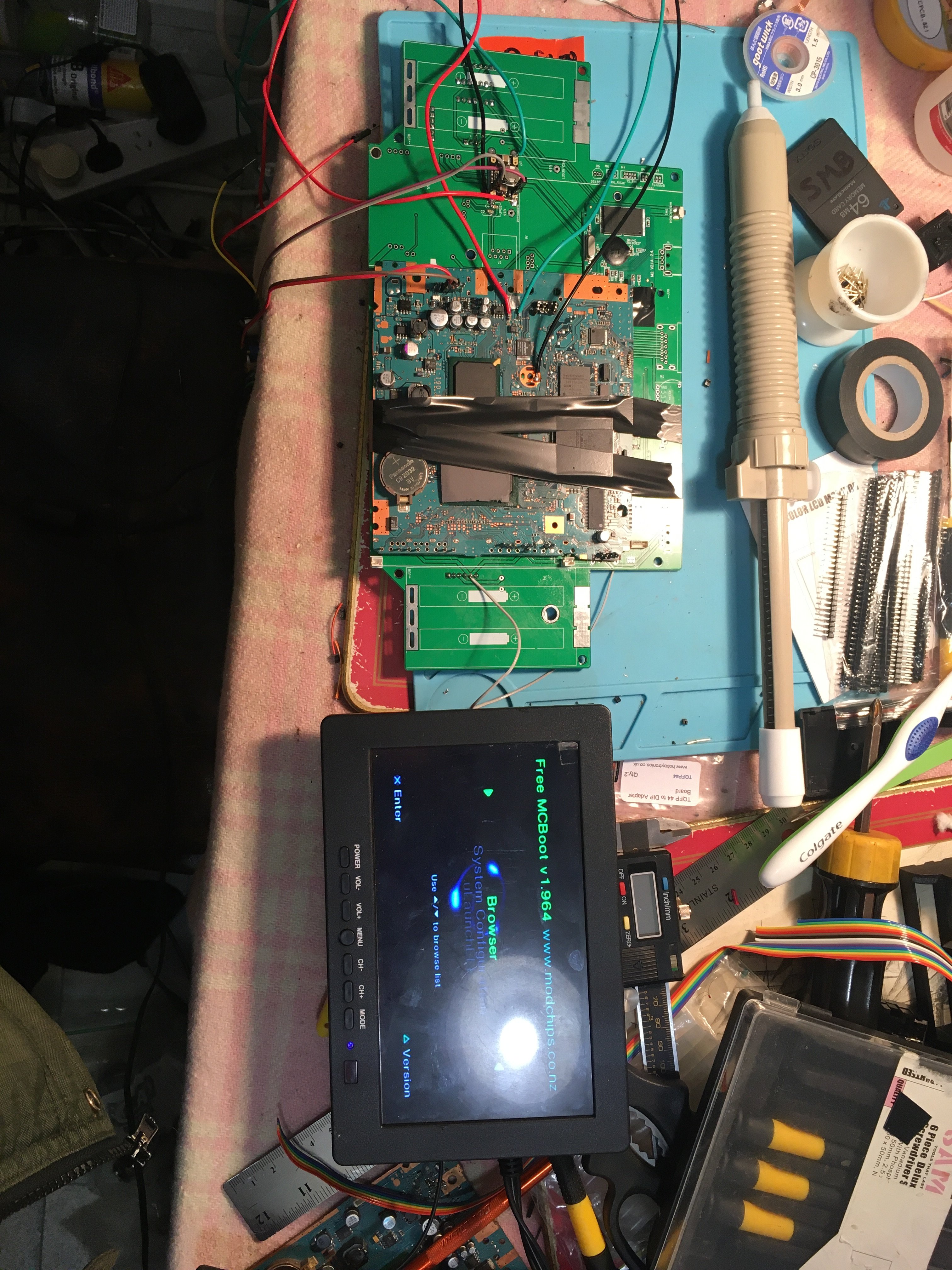

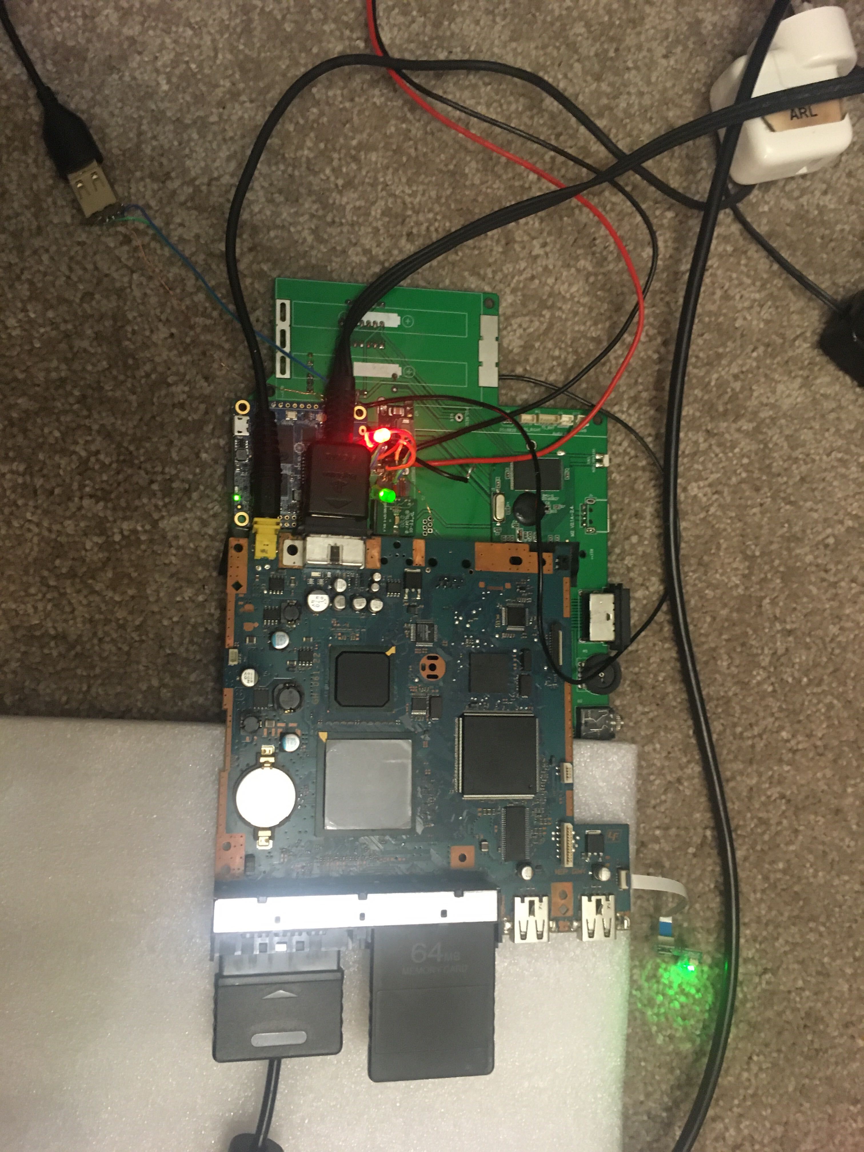

Enjoy my monkey rigging just to get this test powered up and working. Those long graceful power lines, in vivid red, green, and striking black! Oh, and there's also a working PS2 rig here meaning my rushed, yet grand, plan hasn't fallen to bits just yet despite my mistakes.
I've got a lot of tidying up left to do here, but the most critical electrical assembly of the unit is essentially done now.
So I spent about a day poking things with a soldering iron and going through all the tests I had planned during assembly. I started to get suspicious that something was terribly wrong just after lunch time because none of the tests had failed so far (and if you're a programmer you know that nothing is ever that successful!). Turns out the biggest issue I had were a couple of noisy connections and a crappy yPbPr breakout connector (but I already knew about that).
I love that I didn't have to solder a heap of wires, the pins were a task enough, but I was determined to go out of my way to make the wires I did use as colourful as possible hehehehe.

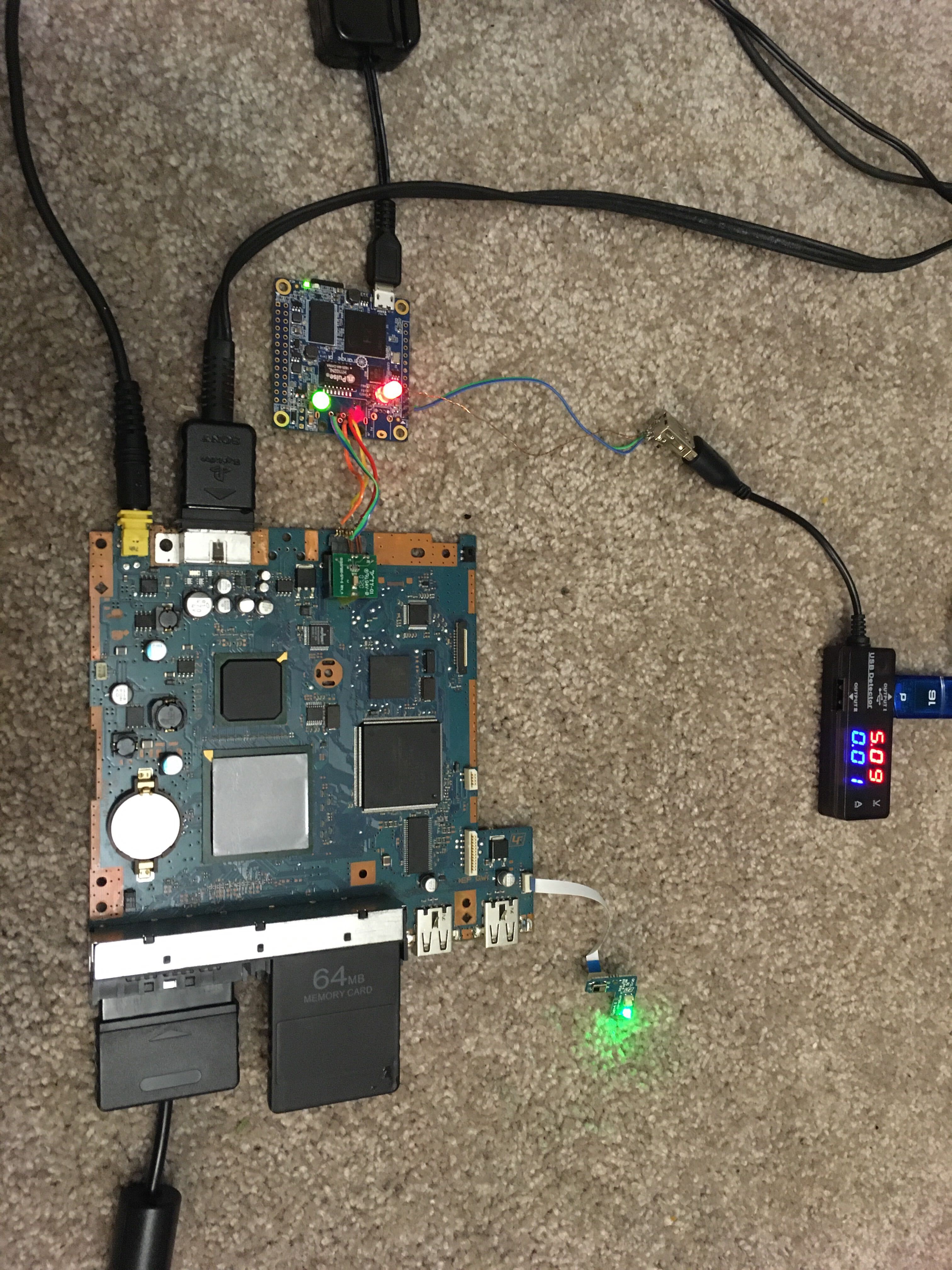

UPDATE: Just can't get the OrangePi to talk to the PS2 while mounted to the board. I've a strong suspicion that there's something wrong with the caps I've got so have ordered some new ones. To be fair I rather expected this.
UPDATE 2: Somehow all 3 of my SD cards are corrupt. This makes zero sense, or is incredibly unlucky from a statistical angle. The image was a pain to setup too. At least I know the issue :)

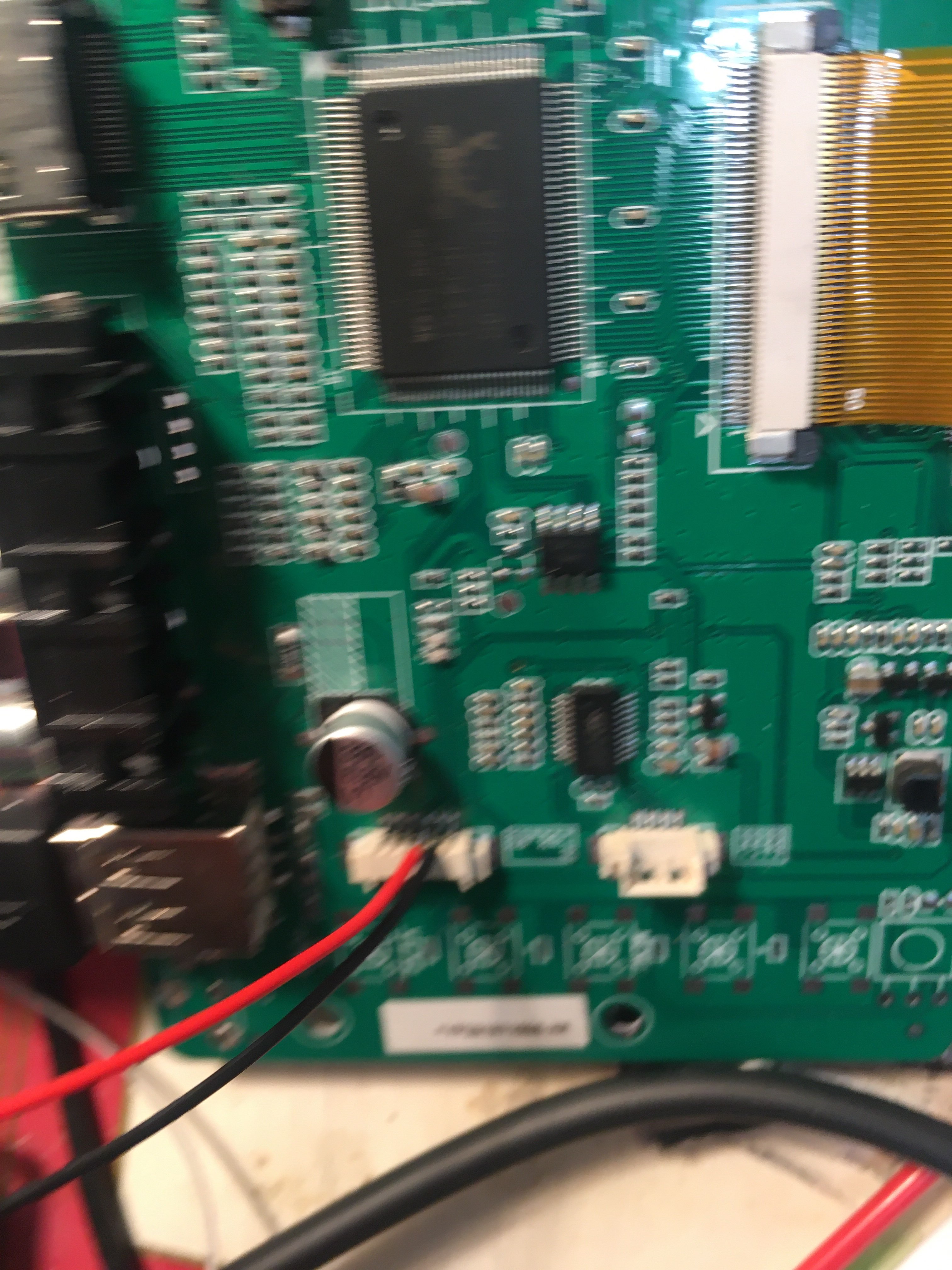

Need a little help here. While I'm waiting to crash out of the competition for things to arrive, I decided to do a few more tests and start linking a couple of other things up. I've discovered that it can't see any attached USB device :(
So wiring a USB is pretty straightforward but testing the voltage showed I was getting some significant drops (down to 4.8v) and that the regulator was possibly giving out - doesn't worry, I've got spares, but the main question is: Before I lift the board and put another one in does anyone know if this can be simply solved by getting the mean voltage on the PS2 back up to 5V? I've tried putting a 5v step down just for the USB and that had no change. All lines that I could test on the board seem fine.
So under the bedsheet is my workbench/table and he's developed a penchant for stealing inedible things from the table. Suffice to say we had a scare not long ago when we thought he'd somehow managed to swallow a brass header pin, and after that everything got covered up!
UPDATE:
After numerous checks I eventually concluded that the USB wasn't, for whatever reason, working. It turns out that things do come apart easier than they go together, or perhaps it was easy because I don't use hippie lead-free solder. I pulled out a spare PS2 I've got and checked it over before starting to strip it down and trim it. I'm not happy with this sort of thing happening but given that I have about a third of the PS2s show up DOA I guess it's to be expected.
Fluffy is pretty much always with me, and I'm always making sure he doesn't eat anything he shouldn't. I know if he's up to something because the peeps that he makes changes.
UPDATE 2:
New board, left everything on and tested right up to the last parts were removed, still doesn't work. I'm beginning to suspect that it has to do with the 5v regulator being noisy, or something else in the system. This stuff should be pretty "dumb" at the end of the day and just 4 wires.
UPDATE 3:
After days of troubleshooting and pulling things apart then re-assembling them it turns out that the wire MUST solidly contact the pad and not just the through hole, and this was the cause of my issues here. As a result of this I'll make some changes to the base mounting board so these areas are always accessible least it becomes an issue in the future but for the moment I think it's finally resolved. Not impressed that this took me so long, but it is what it is I guess.

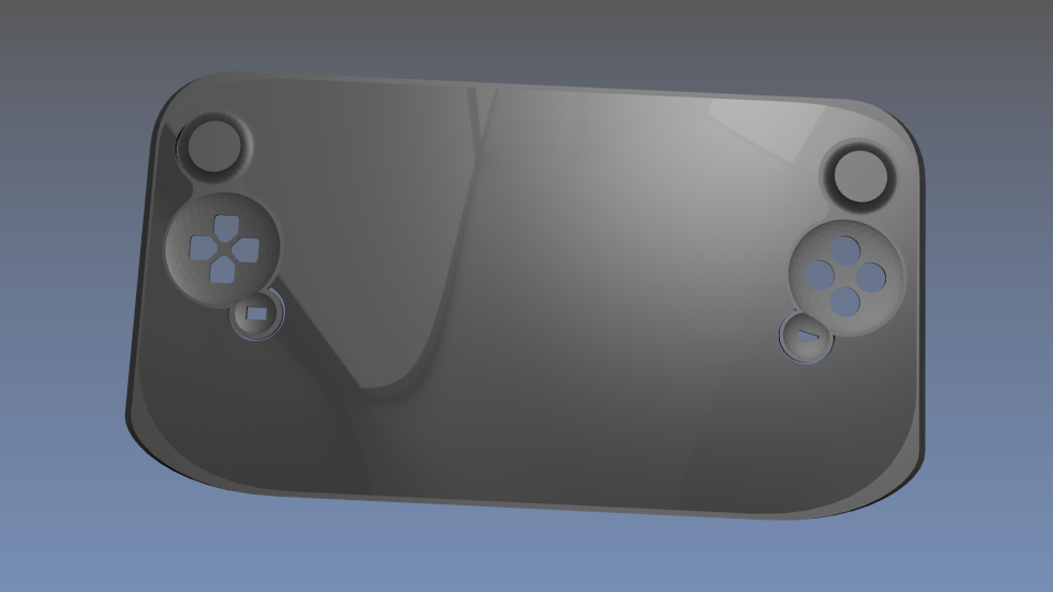

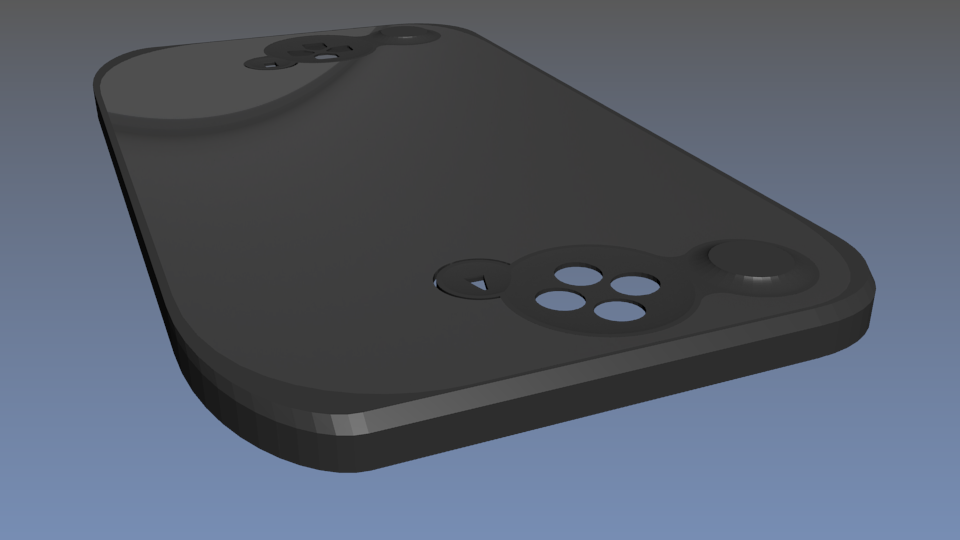

So aside from the small nightmare that I've been having getting that USB port to work, I have been designing the case. By and large the unit so far has been a "minimum approach" but after stumbling across a few items around the office and having a drink with a few mates I think I finally got inspiration in the direction I wanted ("What would it look like on 'Star Trek'?). I've contracted a local firm to cut me out an acrylic faceplate for the unit and am aiming to 3D print the rest of the shell.Essentially I'm aiming for something similar to the other acrylic-fronted portables because life for me involves a lot of dust and I quickly got sick of cleaning down my other unit and not being able to clean parts of it so hopefully this will get around that, plus provide a very solid base for the rest of the case to mount to, and it's bulletproof :)
This'll be one of the more expensive parts of this build for me, but I feel it'll be well worth it.
Terrible quality because what am I? A graphic artist?! Actually, I am a trained graphic artist so lets ignore that...
It's going to be big.
EDIT: forgot to put the speaker holes in for the render! It's a couple of holes...you're not missing anything.

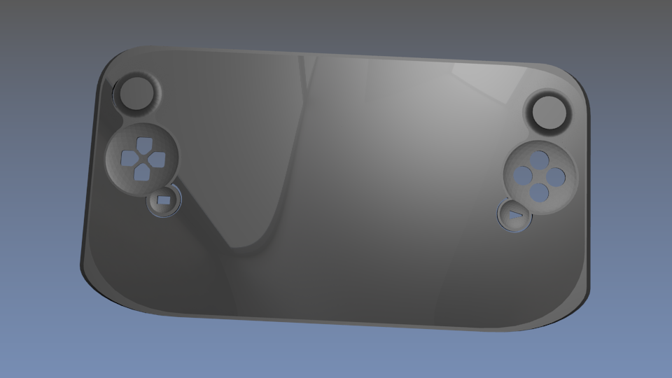

Minor update, but it's taken a lot of cobbling things together to get to this point. While I've been frowning over getting this OrangePi to behave (turns out I didn't clone the boot sector information on the armbian image and thus didn't actually have a backup when it failed) I've also been working on the case, and the shop finally got the acrylic parts cut so I could push forwards with seeing how I'd get everything to work.
Hint: I still don't have many great ideas here and figure there may be a handful of revisions.

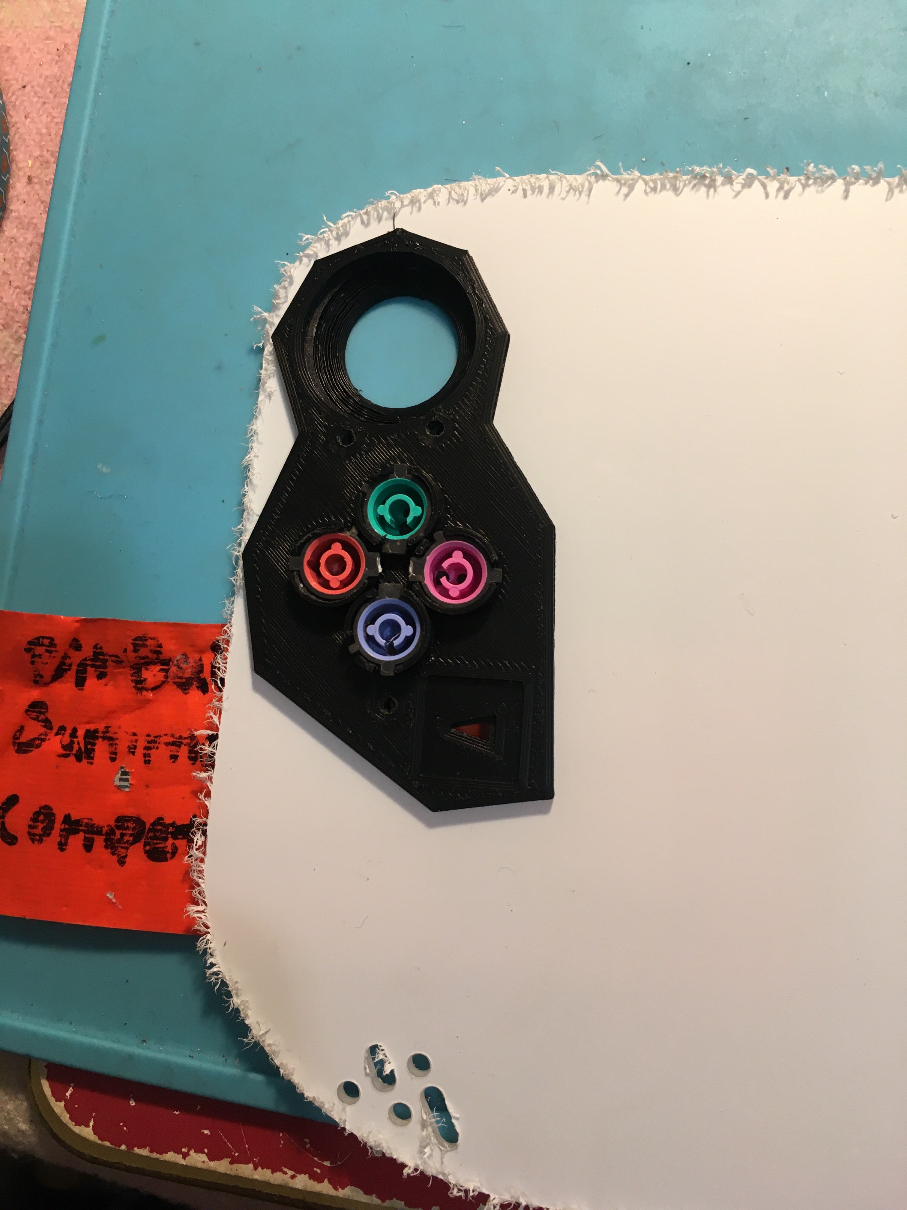

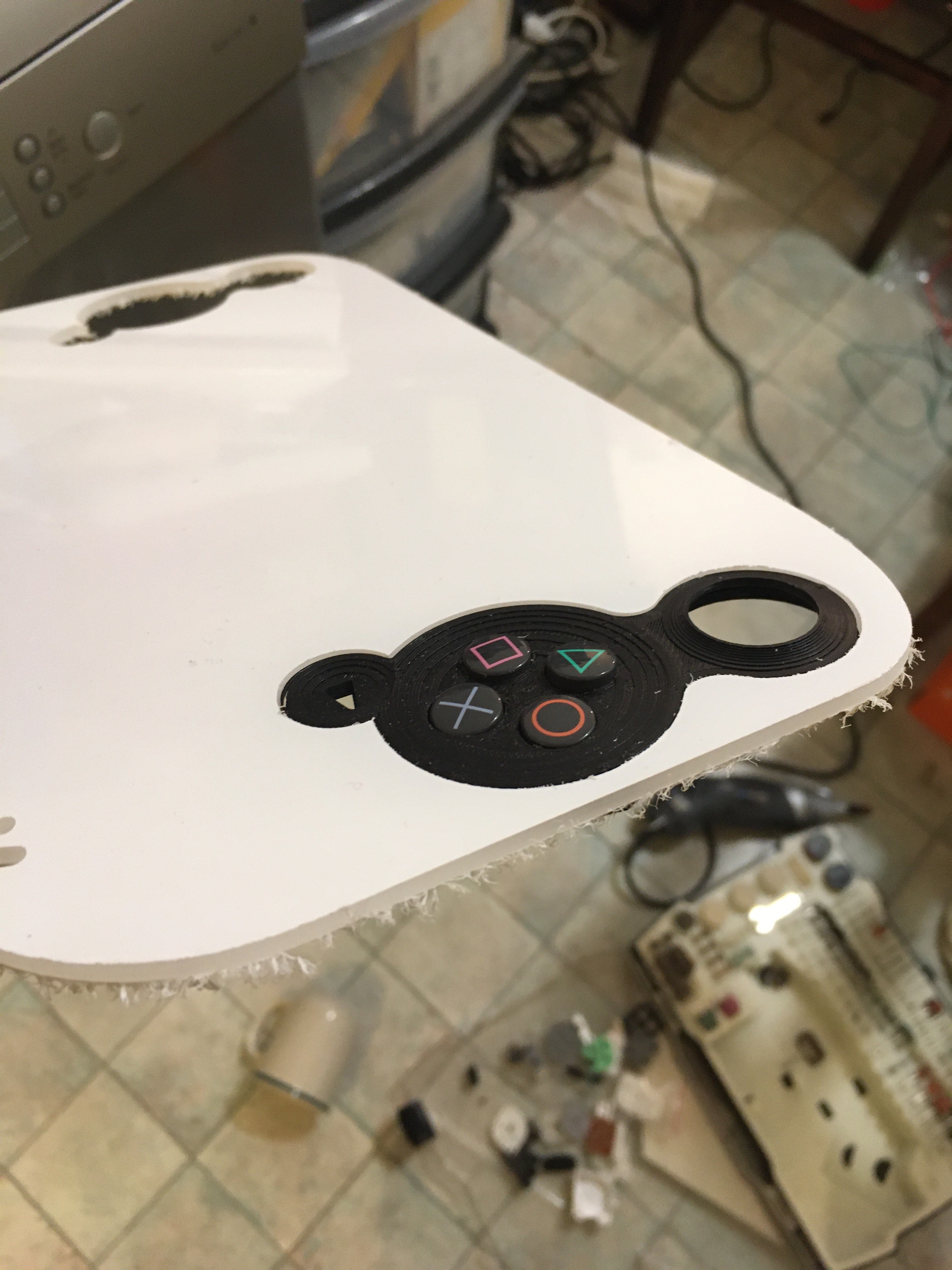

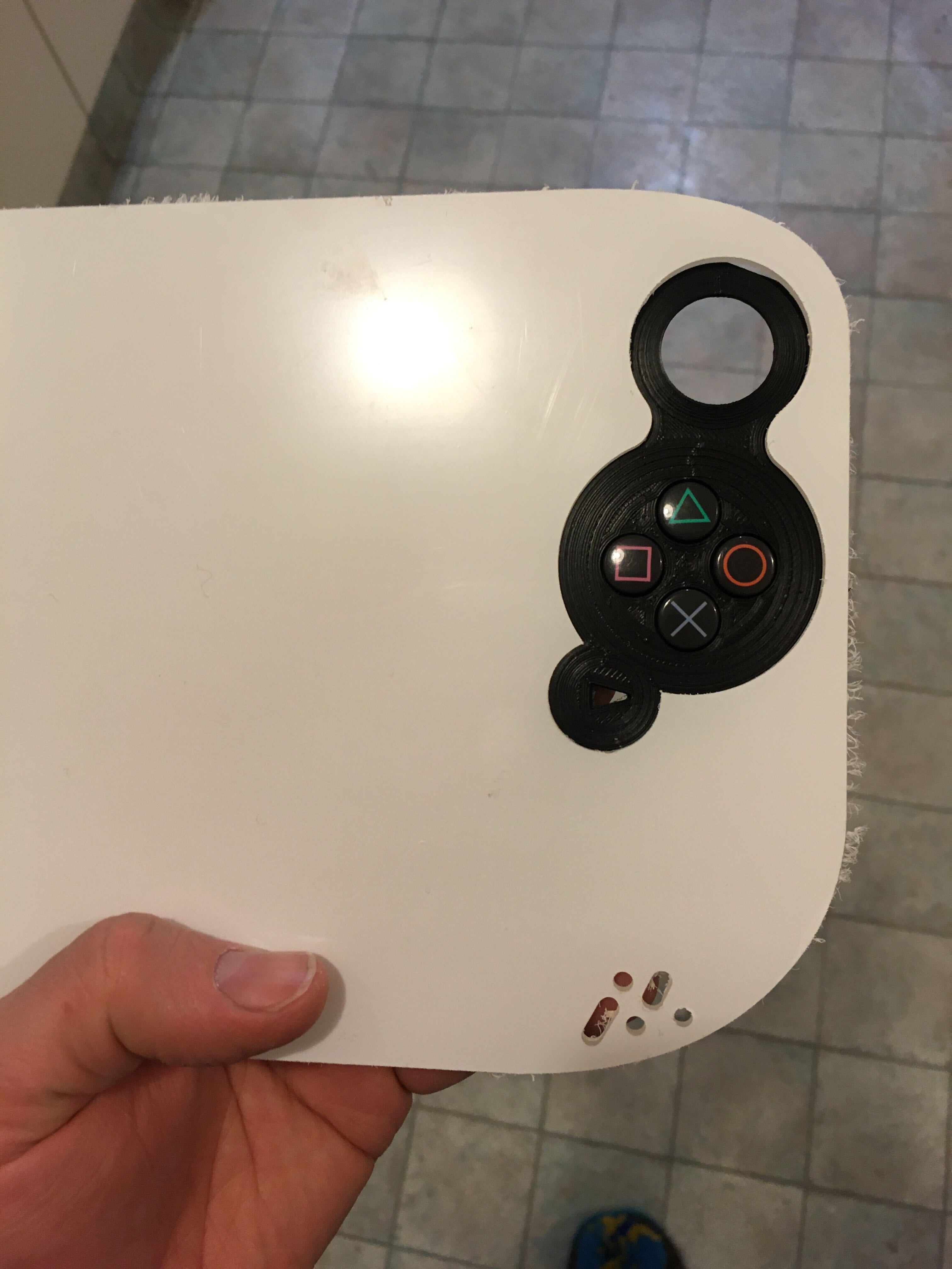

So I got the cutting guide from the shop, and promptly found that Blender wouldn't talk nice with their version of DXF files. I eventually got it open in Maya then kind of lost my cool at the software for making 3D printed parts and so exported it back to Blender again. Seriously - why does anyone use Maya? Anyway, it's nice to have a win for a change and to have things line up! Like. A. Glove.

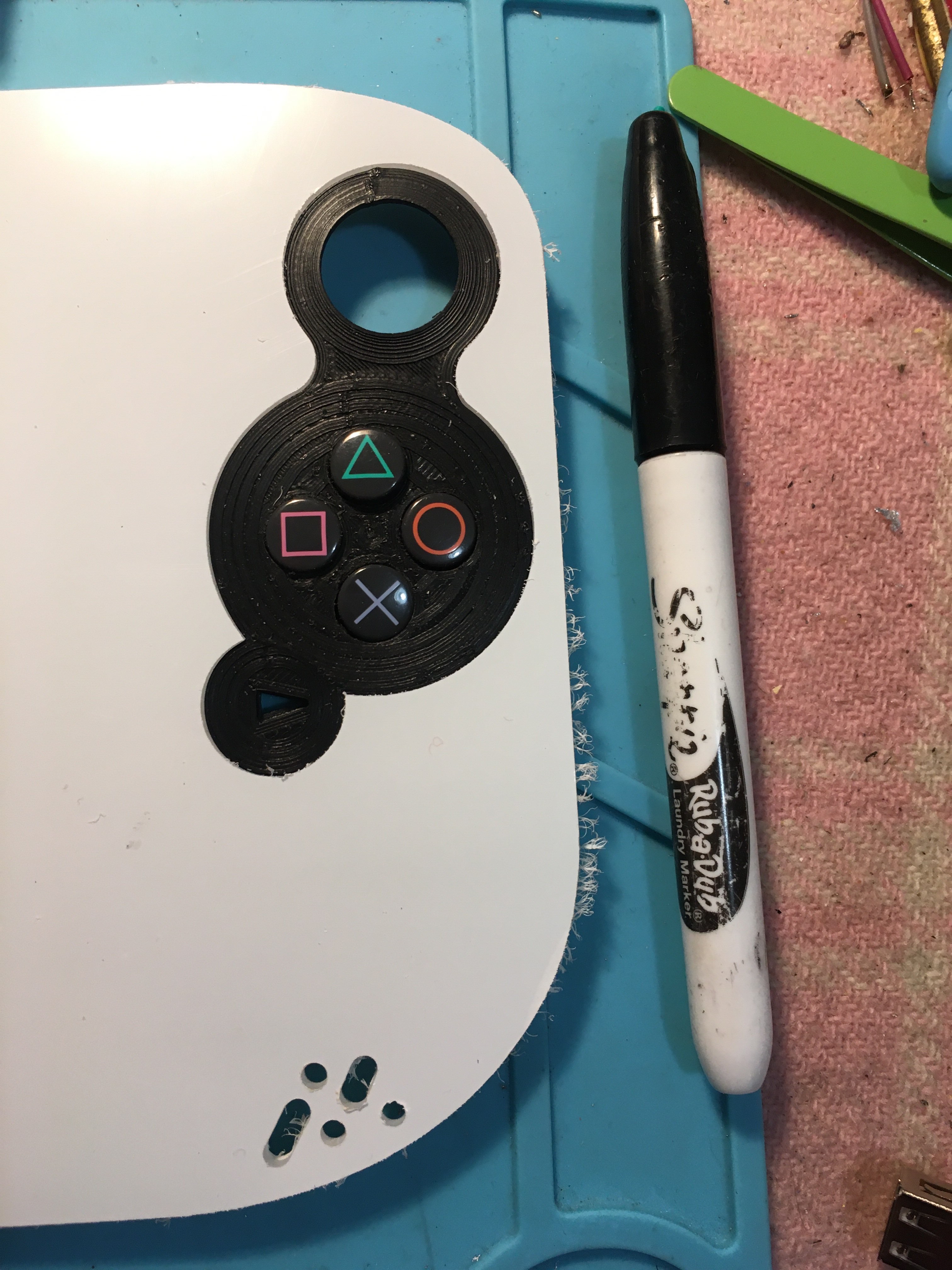

Now, that X button. Still don't have it alined, but don't know if I should align it to the side of the case, the bottom angle, or the angle of the controls insert. I've got myself a conundrum...
The back is simply placeholder, but my "master plan" is to print these in two parts that will be pinned and glued together.
Which of course brings me to the point where naturally things don't go quite according to plan: By my measurements this should have been flush. This isn't flush. I think I'd be a clever monkey to design it slightly protruding especially because the acrylic I've got varies between 3.2 and 2.8mm depending on sheet pour and doing a "oh, but it was supposed to look like that" is an easy way to hide parts variance.

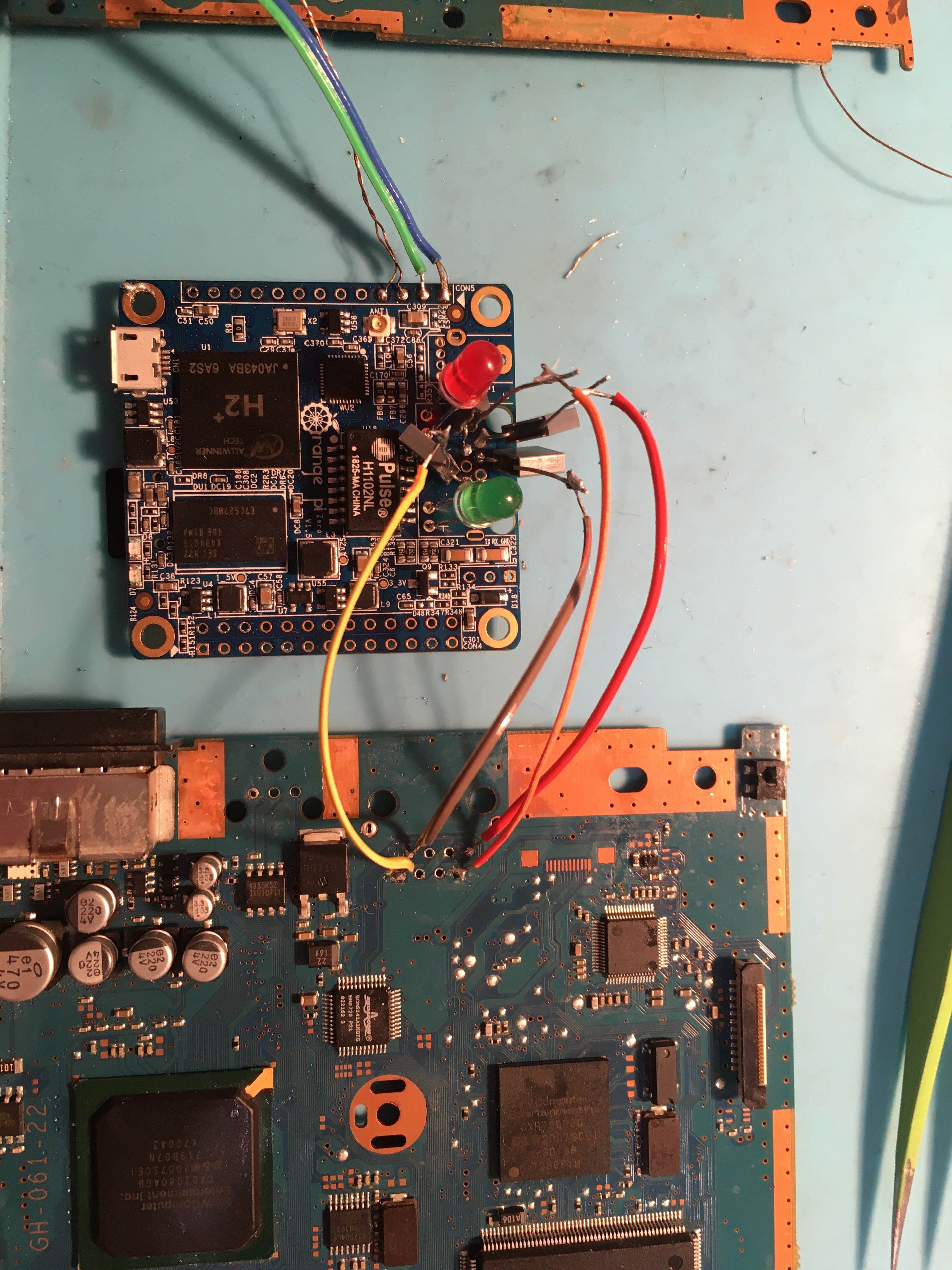

Whelp, this is a "help" post as it's just not fun anymore.
I've burnt a week trying to get the OrangePi to communicate to the PS2 through the ethernet and while all the indicators suggest that it should be working, it's just not.
So initially I set this up using the test case that I'd got working back at the start of the competition. Turns out I'd noted it down wrong and one of the connected pairs was around the wrong way, but this wasn't before I'd pulled everything up and gone over all of my connections. Weirdly the OrangePi ethernet port has a different pin slant to everything else I've got (British/American?) which made matters more complicated. In the end a bit of educated guesswork and noting down what didn't work turned out to be the answer:

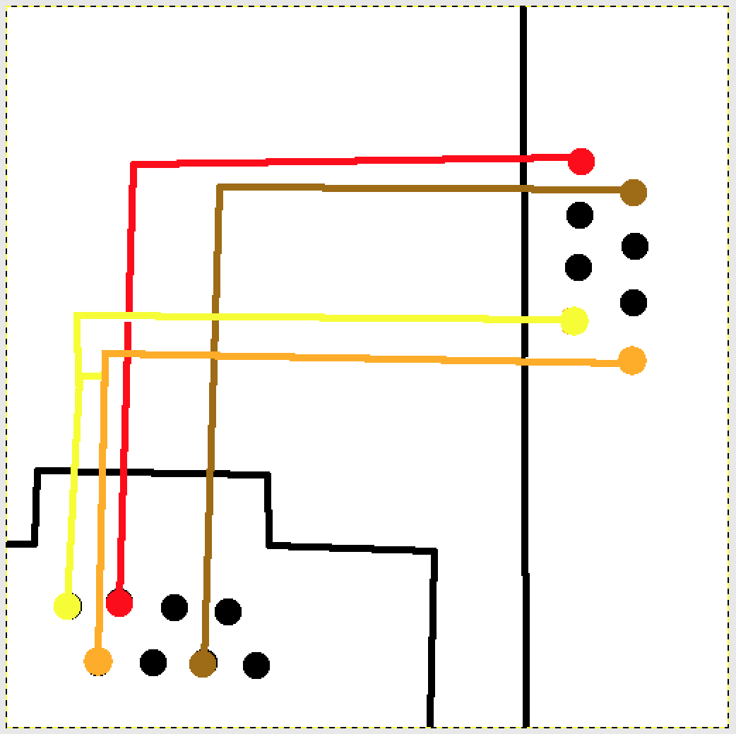

Corrected wiring diagram:
A bit to unpack here, and I'd love everyones insight on it: So oddly enough it'd seem that I need both the 33nF caps, and the ethernet transformer in place for it to function. Now in my PCB design I moved the transformer off of the PS2 PCB and downstream, now I'm wondering if this is the cause of my problems so would love someone with more knows than me to suggest a course of action here:
At that point I was sick of finicky magnet wire and just opted for some more MS-friendly ribbon cable. You can see the transformer in the middle of the picture there - should I mount it back on the PS2 board?
Finally on this topic: Fun times in almost working but naturally not managing to fix whatever the issue is:
Amusingly as it turned out if the OrangePi was hard-shutdown with a power off it'd occasionally need a good cycle restart before it'd start working again, so there's every possibility I got it going but the Pi just wasn't working. To add to this entire mess it's getting to the point where some of the pads on my test board have started to lift from the concessive soldering and testing. The solution of course was to up my game! So today I got my act together and put a clever little script on the Pi to shut it down at a button press, and plan to drive it through the system control PIF as I'll not be using two of the pins that were hallmarked for the BMS.
And a quick brightener which I know will please anyone who's as OCD as myself :)

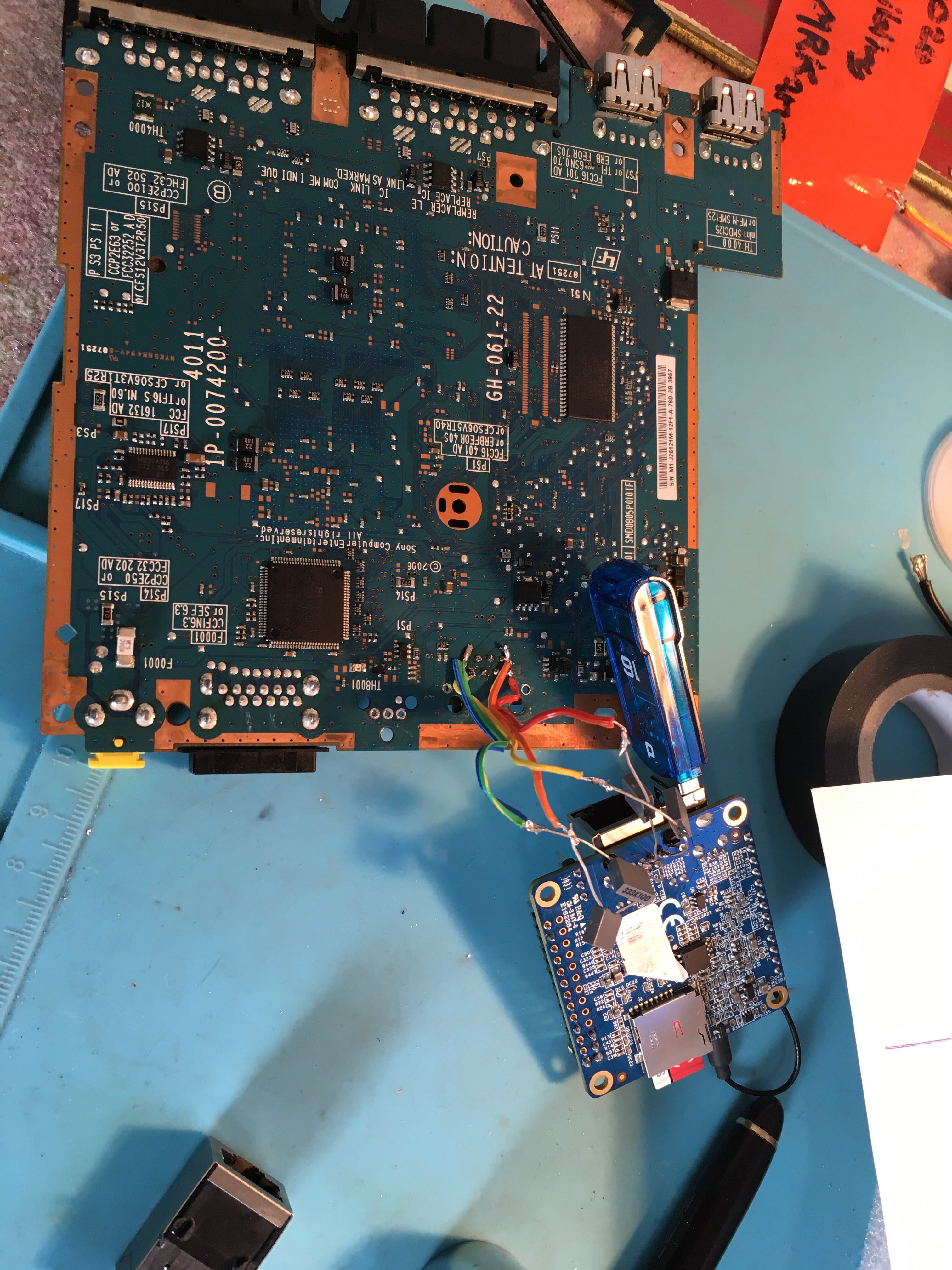

Well this has been a fun 24 hours, but I'm finally getting answers. Remember the only difference between screwing around and science is writing it down.
So I broke everything down into a collection of paired experiments and to save boring you all to death my breakdown is happening because the distance from the PS2 Ethernet transformer to the BCM5241... chip is too far. That's it - murder she wrote. So tomorrows experiment will involve making use of the 33nF caps I've got lying around to see if they can solve the signal issues I've got here over long distances.
Quick community question: The PS2 ethernet only seems to use lines 1&2 and 7&8, but does the transformer require the other lines to be intact for standard function?
This works, standard crossover wiring, no caps or anything apart from shoddy ribbon cable so it looks so horribly wrong...but my Playstation 2 thinks it's so so right.
Where as this doesn't work. Possibly to do with impedance, or something that I don't understand because I missed this paper in my Biochemistry course, or perhaps because the wiring is terribly ugly - that's also a possibility.
