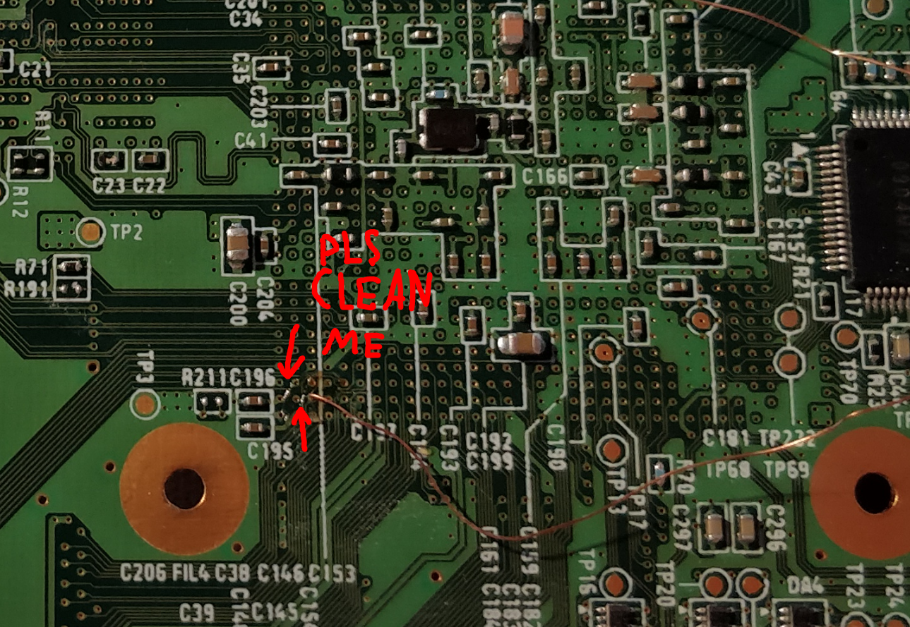

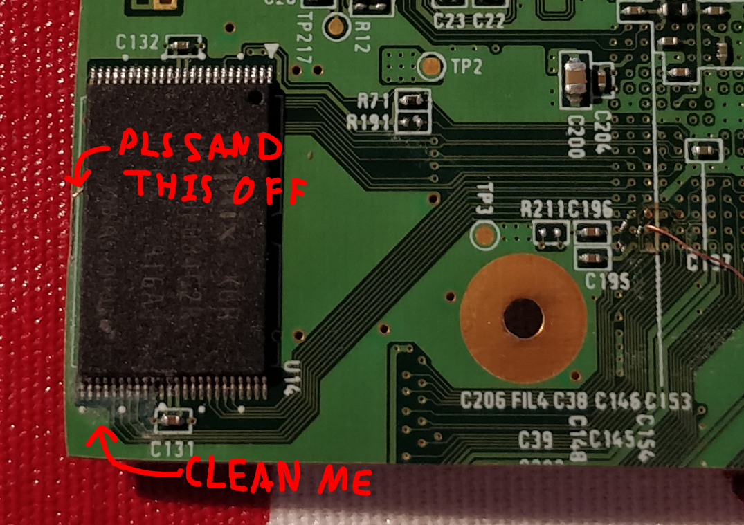

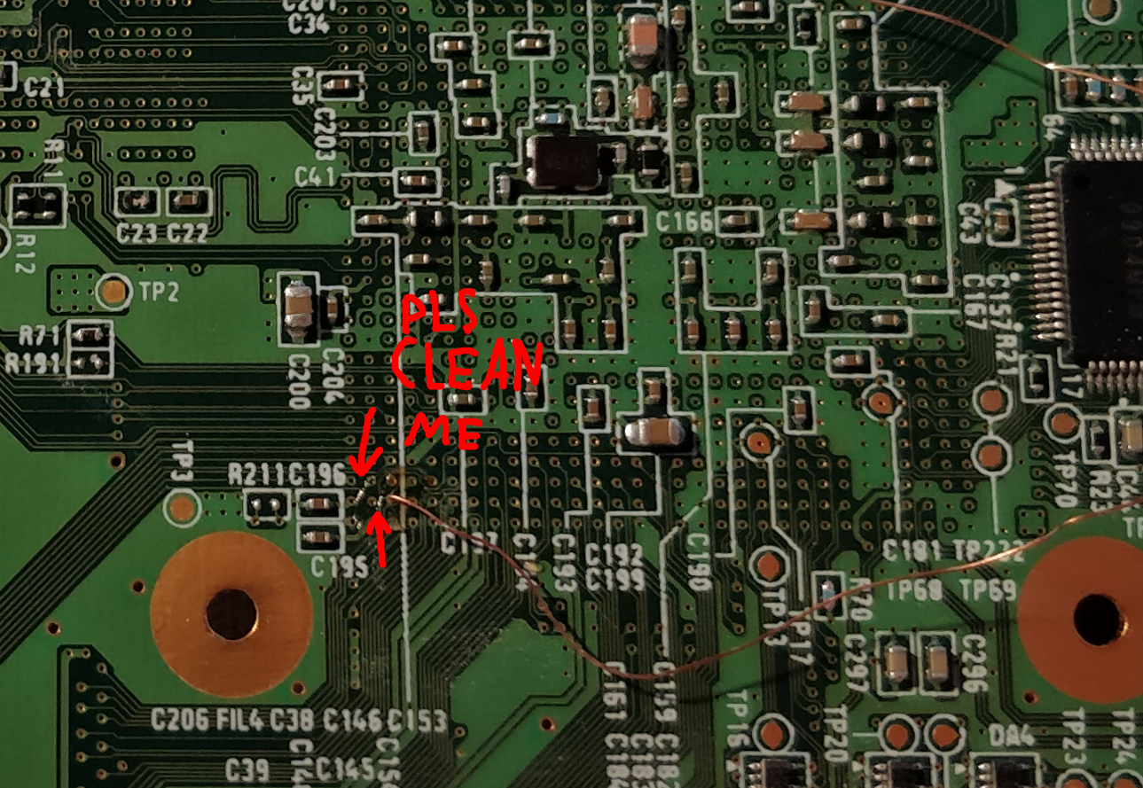

I've found a capacitor that has been removed somehow, ive only spotted it now so unsure when it went off, or even if it gives any problems but I thought I'll share it in the quest to find the problem
It's c23, the one pointed at with the knife

I wasn't able to make the 6 layer work, neither the 4 layer i had at home. The 6 layer was put to side and the 4 layer was shipped of the BocuD for inspections, he has been a big help over the last couple of months so big props to him! But after getting some neat infrared camera pictures of my board from him he declared it dead. We worked out a deal and he shipped a working one back for me to work on <3

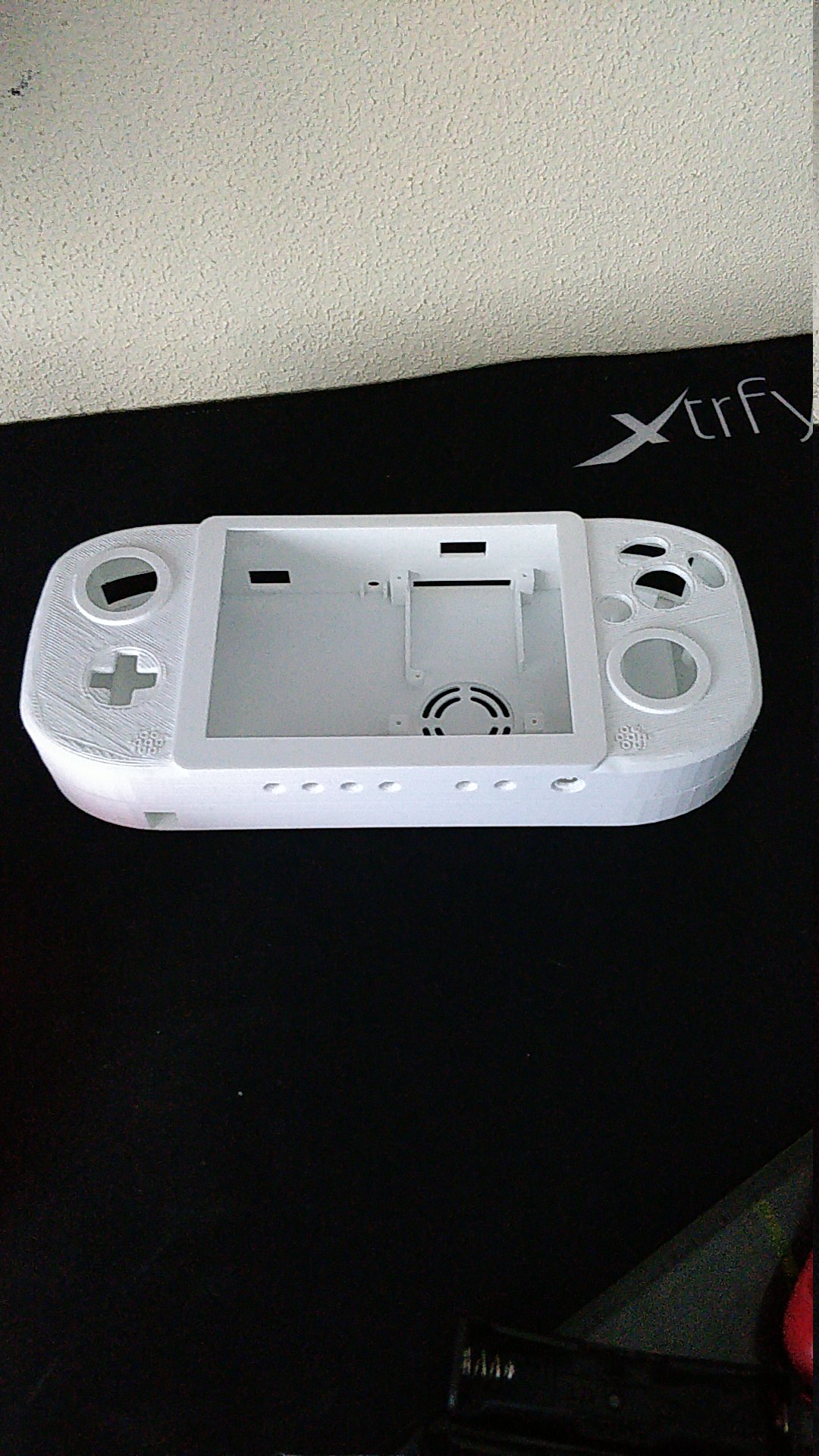

I've been slowly getting all parts in / ordering new ones over the last weeks, i currently posses everything that i need besides a fitting barrel jack for my case. As for the case i currently got a white G-wii printed by again, Bocu, but stupid me send the wrong top half STL so my neighbor was kind enough to print it again on his Ender cr-20, but print difference is huge between Bocu's lol.
Currently i have a trimmed Wii with USB connected, Bluetooth reconnected, Display connected and a powermii lite to power it all on. But the issues i have right know is that the bluetooth doesnt work, have tried some stuff with people over at discord but nothing works so far, gonna try rewiring it today or getting a different module from a other wii. Usb also works 50% of the times, guessing because the wires might be a bit long? But if i get everything working im gonna put it all in the case hoping this weekend to finish my project!

Edit 2: I got Bluetooth working and USB seems to be alright too!
I rewired the data lines and used a different Bluetooth module which seemed to do the trick! Thank you all guys so much for helping so much! It's been a blessing :D

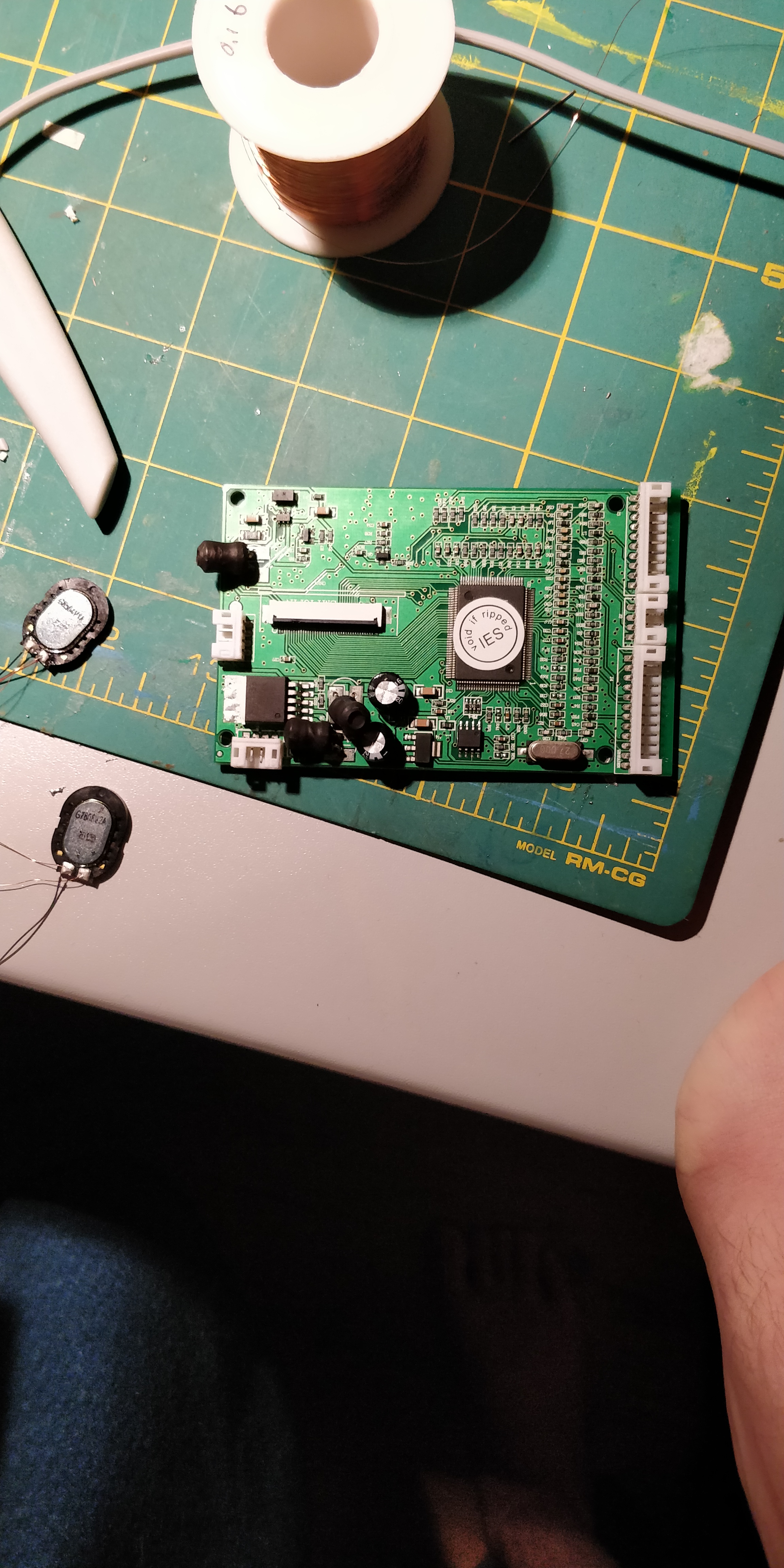

The last thing I needed to do is 5v mod my display, but I have looked around a handful of threads here about display modding but I can't find the same motherboard that I have, and one said to be very careful when using a multimeter on them, so does anyone know how to mod mine? To scared to look around after that warning

Don't know if I can help much with your audio issue, but that screen driver board is pretty easy to do a low voltage mod on. I run mine off of just 3.3v, you can see how I do it in this thread.

As for the display, I'm looking over your pictures, and did you use hot air? Because I currently don't have a station for that and I'm unsure if I can remove that what I think is an ldo then at the bottom left? Also if I don't use a PMS but a powermii lite, then where do I leave on the removed inductors?
Well everything was going alright, the display mods works thanks to Aurelio's help after me being stupid lol, the only thing left to do was vga mod and put everything into a case, but it failed "un the priiloader VGA installer and follow the on-screen steps. At the end of the installation it will boot back to the Homebrew Channel." But I booted into Wii menu instead, which I thought was weird but didn't think to much of it so I continued and I guess I should have been worried because I did step 6, load/ install postloader but it was loading and half way it stopped and the screen turned black and the speakers are giving a high beeping noise right now

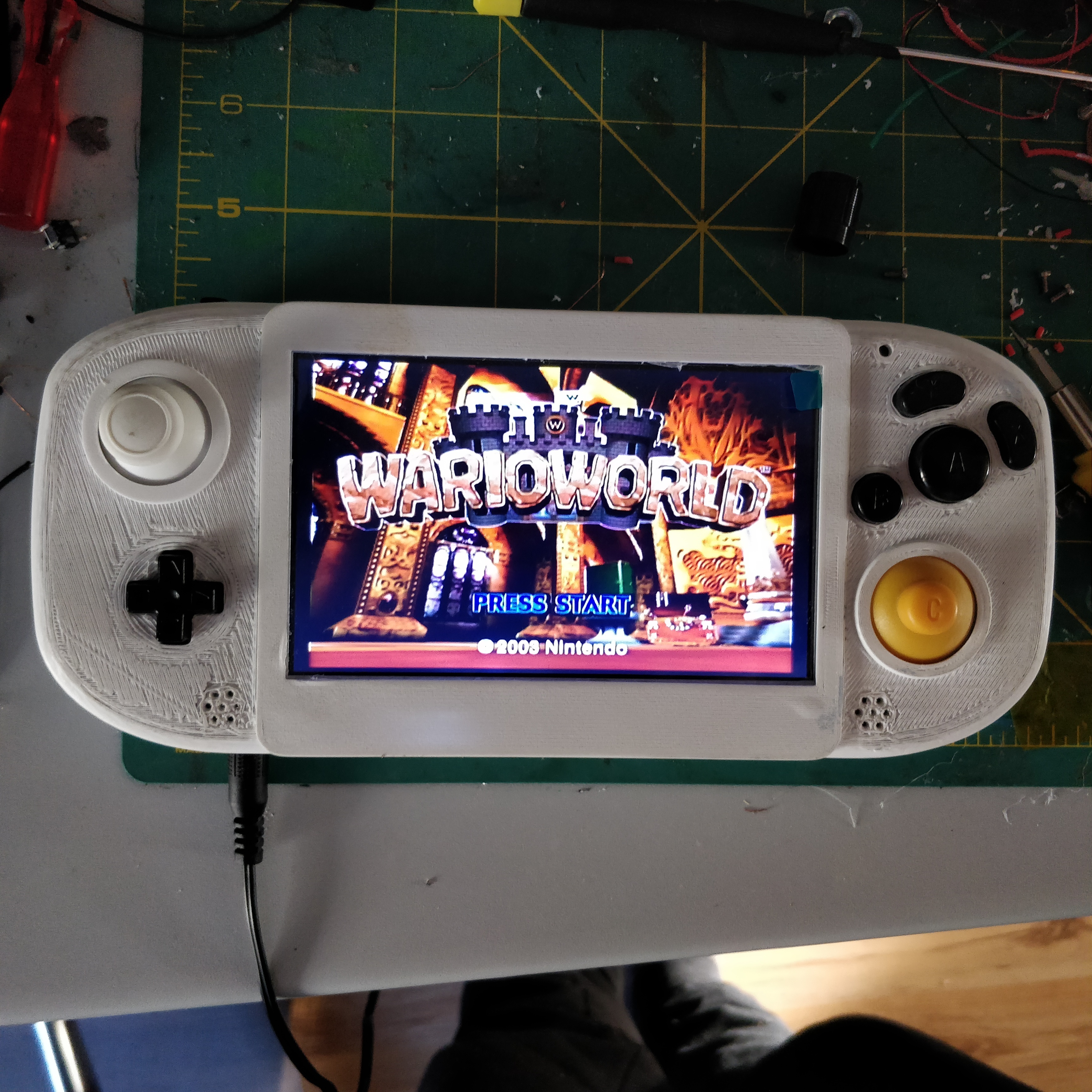

Trimmed my own board, and got it successfully working on my own this time without BocuD's help so little proud of myself.
But here is a glorious video of it working with audio, Bluetooth and USB and display 3.3v modded

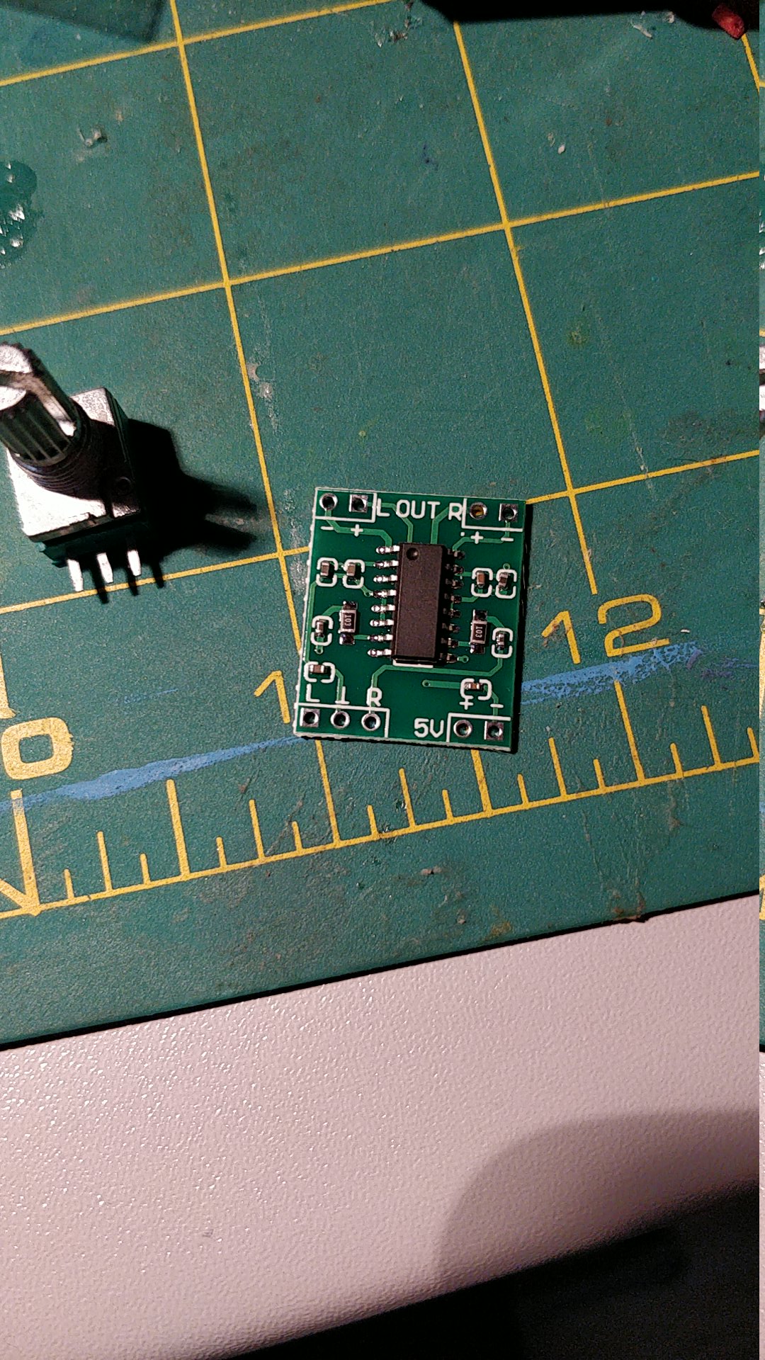

I fixed those today, the only thing I need to fix is audio, currently I use a pam8403 which has no volume controls so it's stupidly loud, can i hookup this 10k ohm potmeter and if so how? Can't really find a diagram on how to do it
With that amp, you would need a potentiometer for both audio channels or a dual Gang pot which is 2 pots on one axis. Hook up the middle pin to the L/R audio input, then one side to ground and the other side the audio output from the wii. This is creating a voltage divider to ground to attenuate the audio signal before the amp. Its not ideal, that's why you generally see amps with digital control.
I'll have a look in the shed to see what we have left, thanks tho!
I was originally gonna use the pam8803 but the left side audio doesn't work for it So I'll give this a try :)
Edit: it worked but sadly doesn't fit :( so I can't close the case

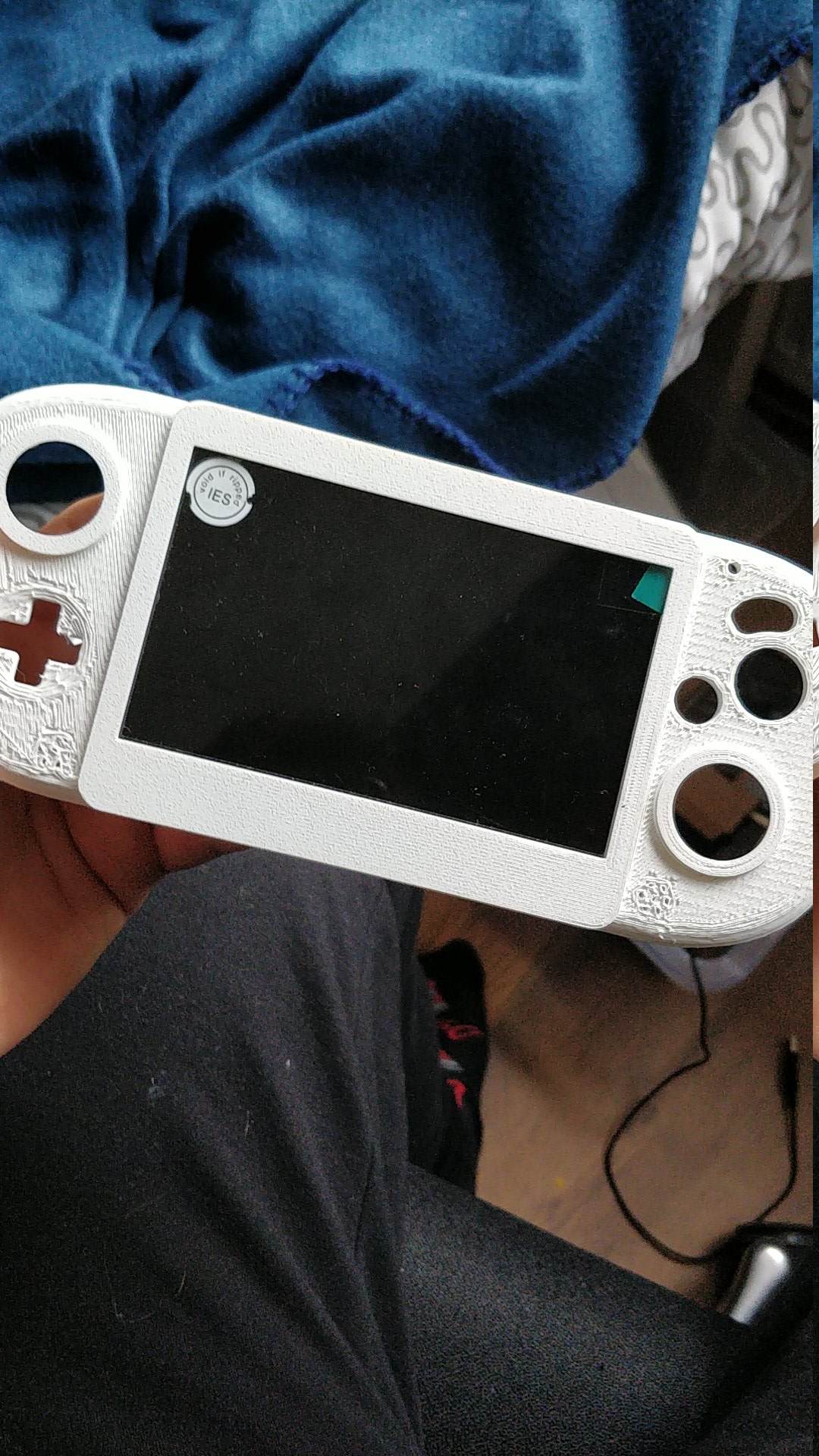

Besides in discord I haven't fully shown it off yet, not really satisfied with the looks, not at all tbh
But since there is a deadline on it because of school there wasn't much I could do. I think the sticks not being black is ehh, kinda want to order two black nunchucks to replace it. Also didn't have the time to Bondo / primer / paint it so it's sure ain't the prettiest.
