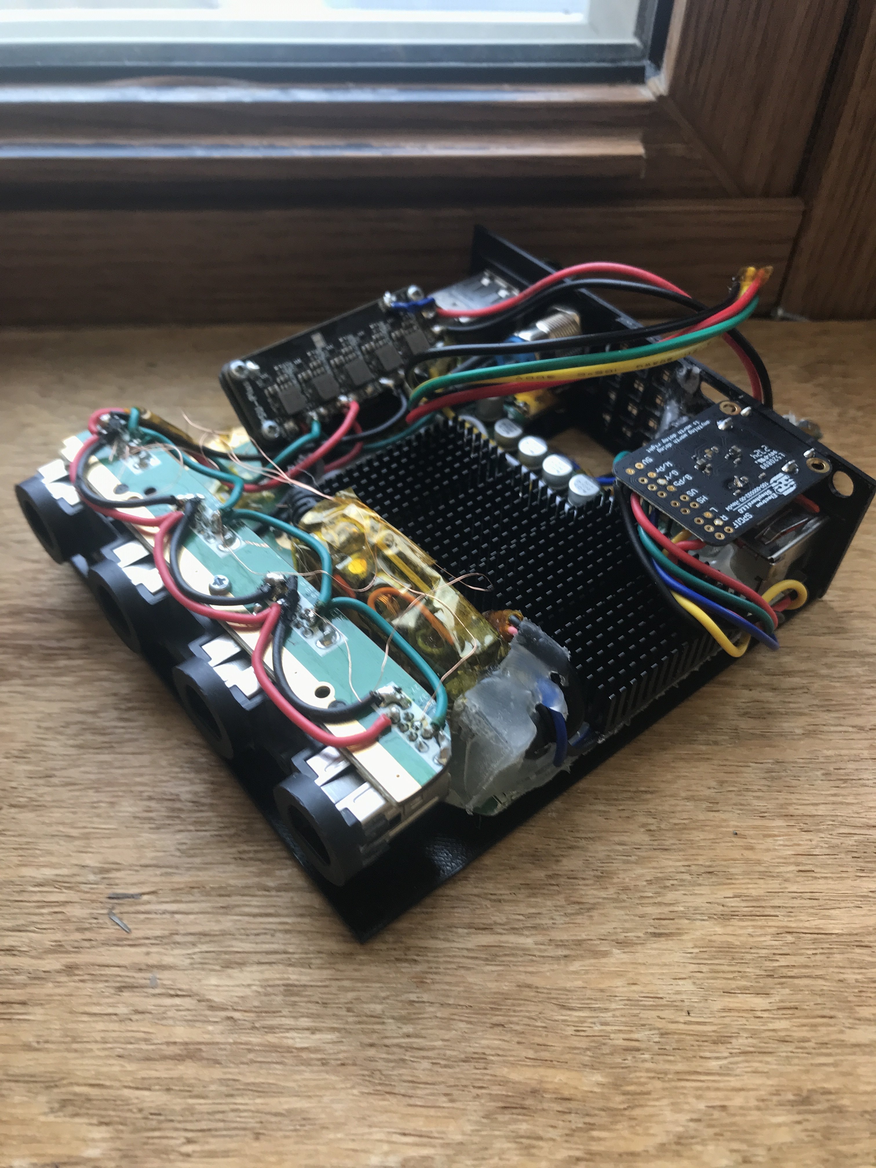

)Yep. Zero ohms. Think it’s a faulty product or should I be alright to test it on the Wii?Shorted as in 0 ohms? That's very strange, can't say I've heard of that happening with a AnalogHDMI before
Cool! So just hook up my 12v line to the Sensor 12v pin on the mobo then connect that to my sensor bar port then connect it’s GND line to the Sensor GND on the mobo?The sensor bar GND is PWM'd (pulsed on and off) to limit the current through the LEDs (this is called low-side switching).
Early sensor bars have more LEDs (5 per side) and need the ~7V or so that the motherboard's circuit provides. Later sensor bars only have 3 LEDs per side and can run from 5V and GND directly. To maintain compatibility with all sensor bars, it's best to keep the original circuit and provide 12V to the sensor bar port on the mobo.
