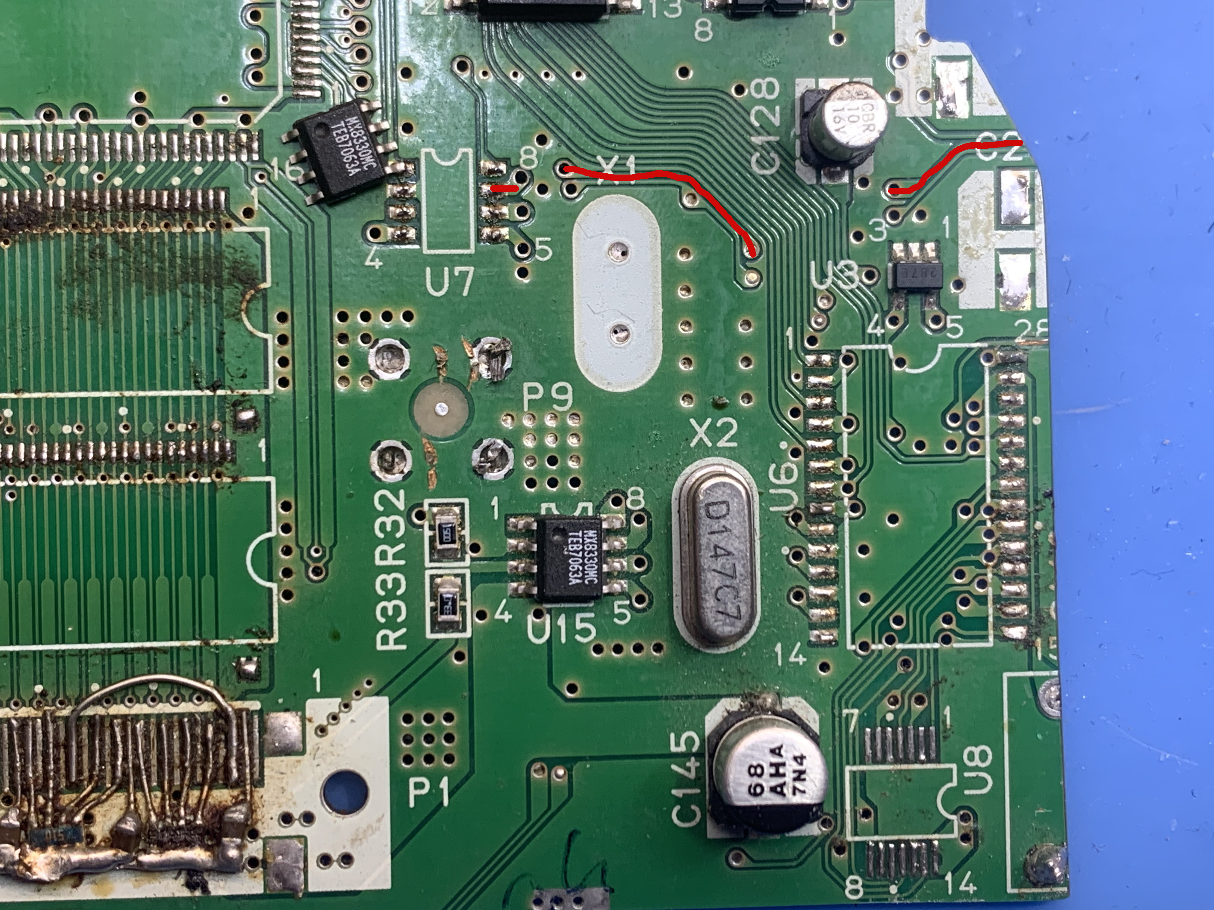

if it wasnt having this experience before I think it is most certainly due to the stability of the 48Mhz clock. The oscillators have a short limit to how far you can relocate them before they stop working well

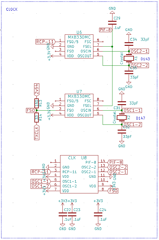

1 FSO/5: Clock output. FSO divided by 5
2 GND: Ground
3 FSO: Rambus clock output. Rambus interface level.
4 Vdd: Power supply
5 OSCOUT: Crystal pin
6 OSCIN: Crystal pin
7 FSEL: Frequency select pin (High:FS0=17*4*FSC,
Low:FS0=14*4*FSC). Toggling of FSEL will reset the counter in the FEEDBACK DIVIDER.
8 FSC: Clock output. Crystal frequency divided by 4.
Pin 3 is Not connected
Pin 7 goes to a trace that has been cut and not needed
Pin 8 goes to a testpoint only
Should be doable and hopefully stable.
I need the space below the X1, so must be relocated.
All the above for a 1996 model PAL
Pin7 is a delayed 3.3v signal to several components and is needed to be relocated
Really? I traced it a few times now, it goes no where after the trim everybody does. This is on a PAL with a DENC NUS 1996 board.
Yes it connects between Pin7 of both clock generators and PIF pin8. Maybe this is source of instability?

Ah I see. I believe on PAL this will be unconnected for frequency 50hz video. See on JP1, if this is jumpered, it will connect both Pin7s and set in 60hz mode. My mistake.

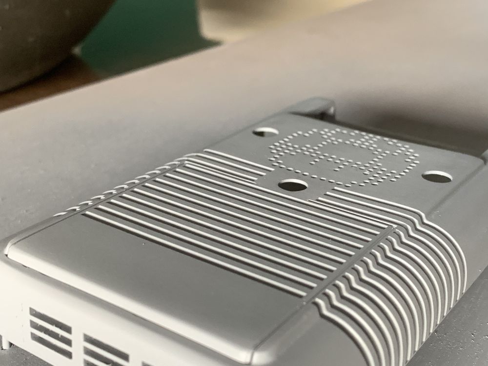

- Removed all the paint from the old back piece, going to re-use it, took ages from 5-year-old paint.
- Remade the front piece and frankencased parts in it
- Decided on the color scheme, and ordered paint and parts
- First layer of prime...

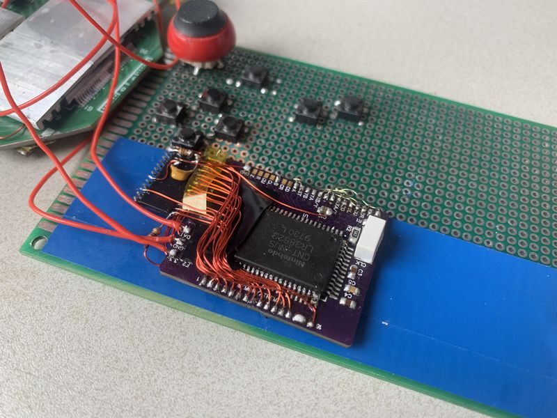

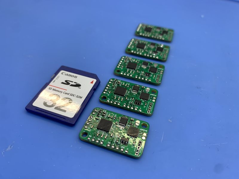

But i finished creating 5 board of 64 Amp.
- Finding all the parts, some were only available from some Chinese eBay seller..
- Soldering them up by hand..
- Making a programming cable for that insane small pin header on the board..
- Asking Gman a lot of questions..
All working, all tested! :mrgreen:

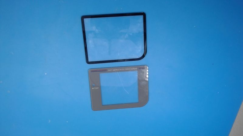

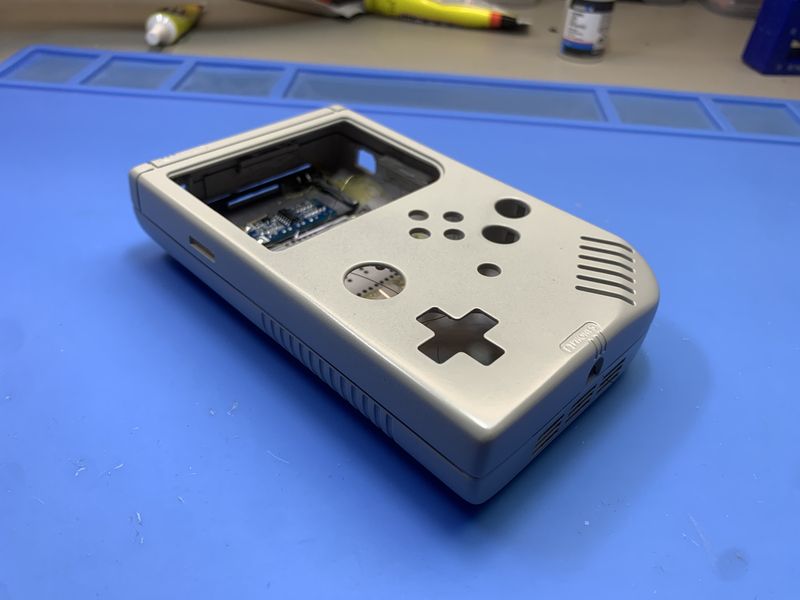

Little setback, i tried one of those ali express front lens glass with small borders. they are 5.2mm tall
the space i got is 5.15mm, and not counting in paint/clear coat.
i measured a ali express replacement dmg shell, and they have a opening of 5.2mm....
I need to remove all the paint from front piece, make more space and repaint it..
These glass things are a little larger then stock...
I don't know much about glass, but if it is not tempered, could'nt you grind it?
