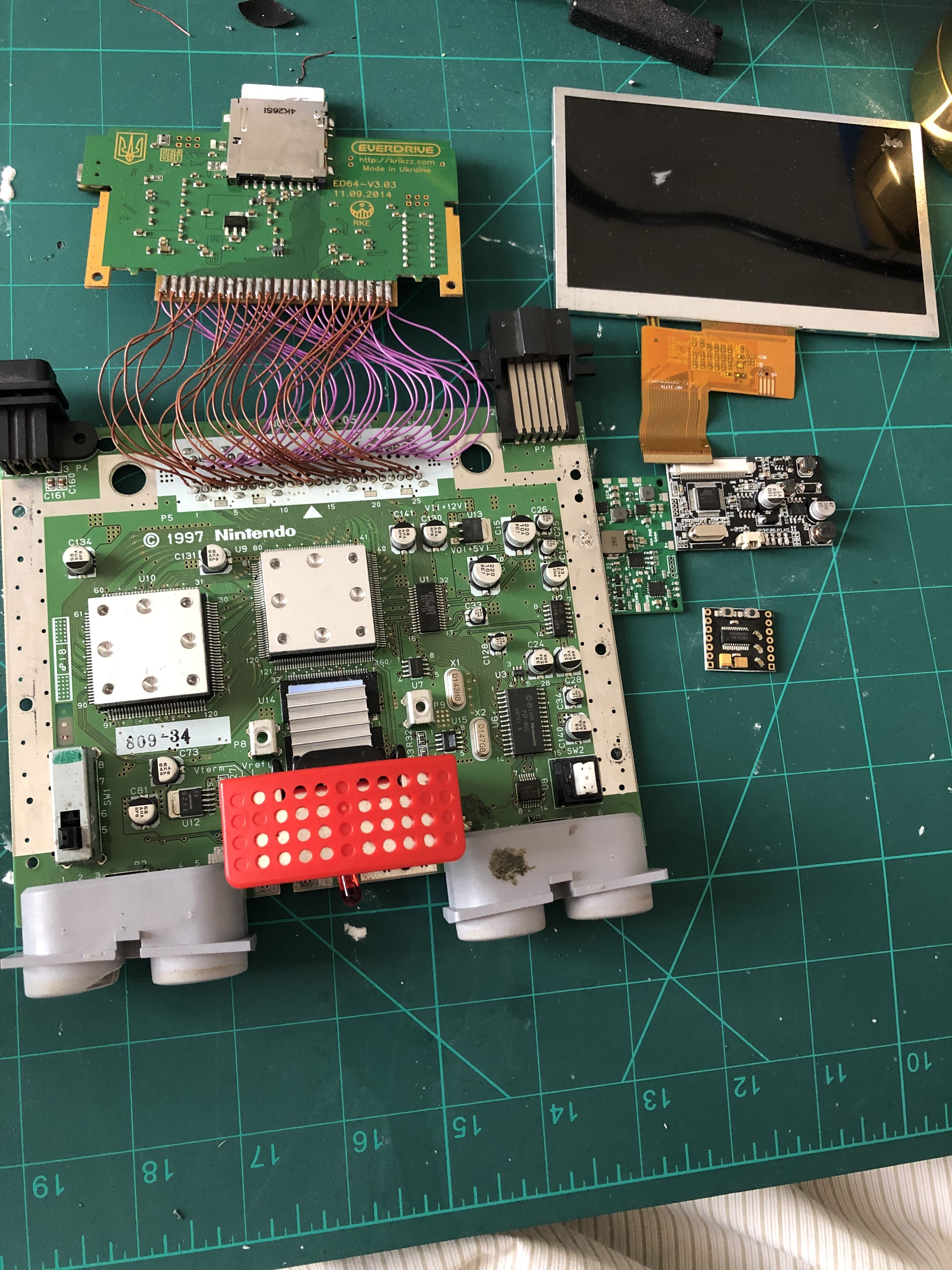

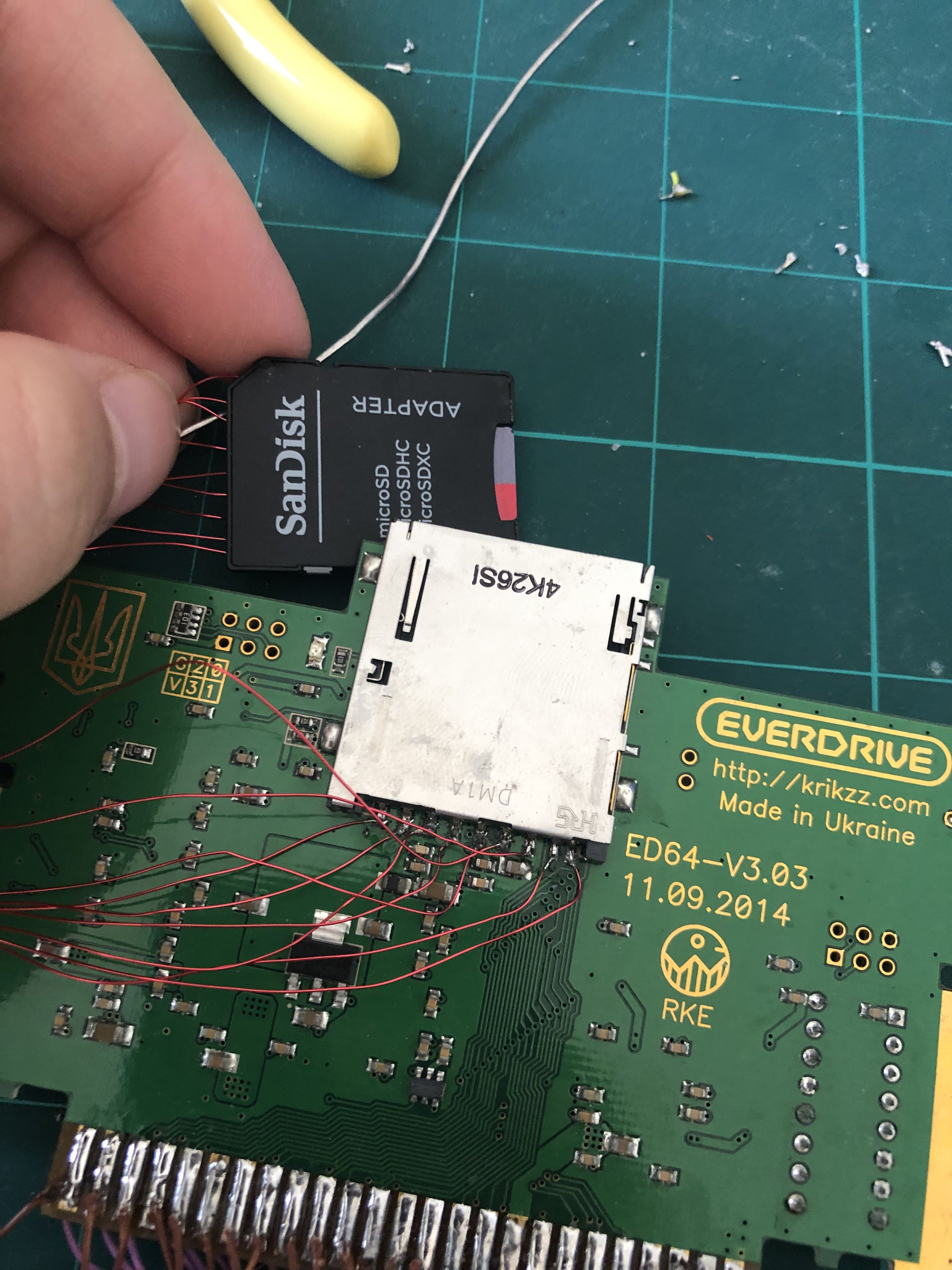

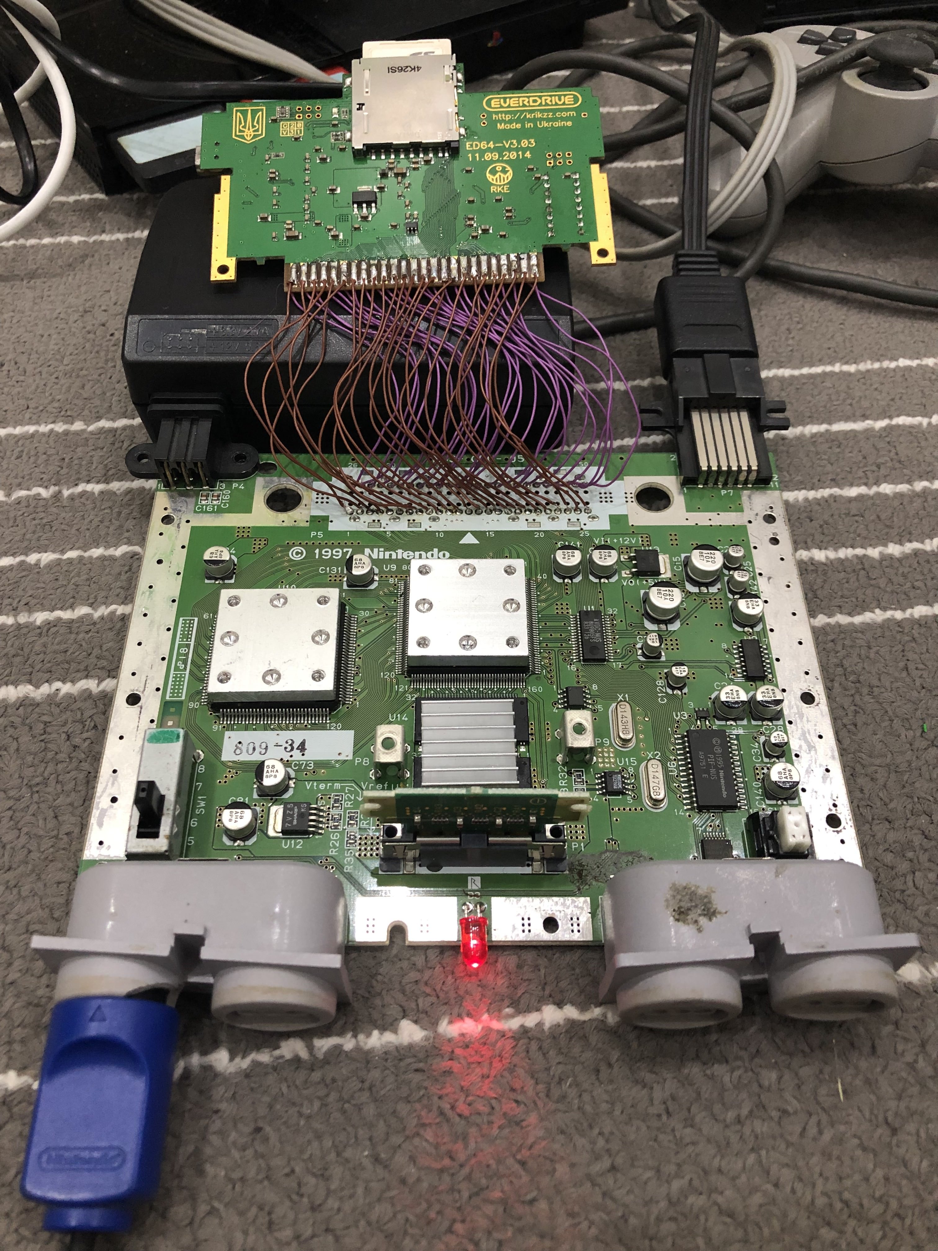

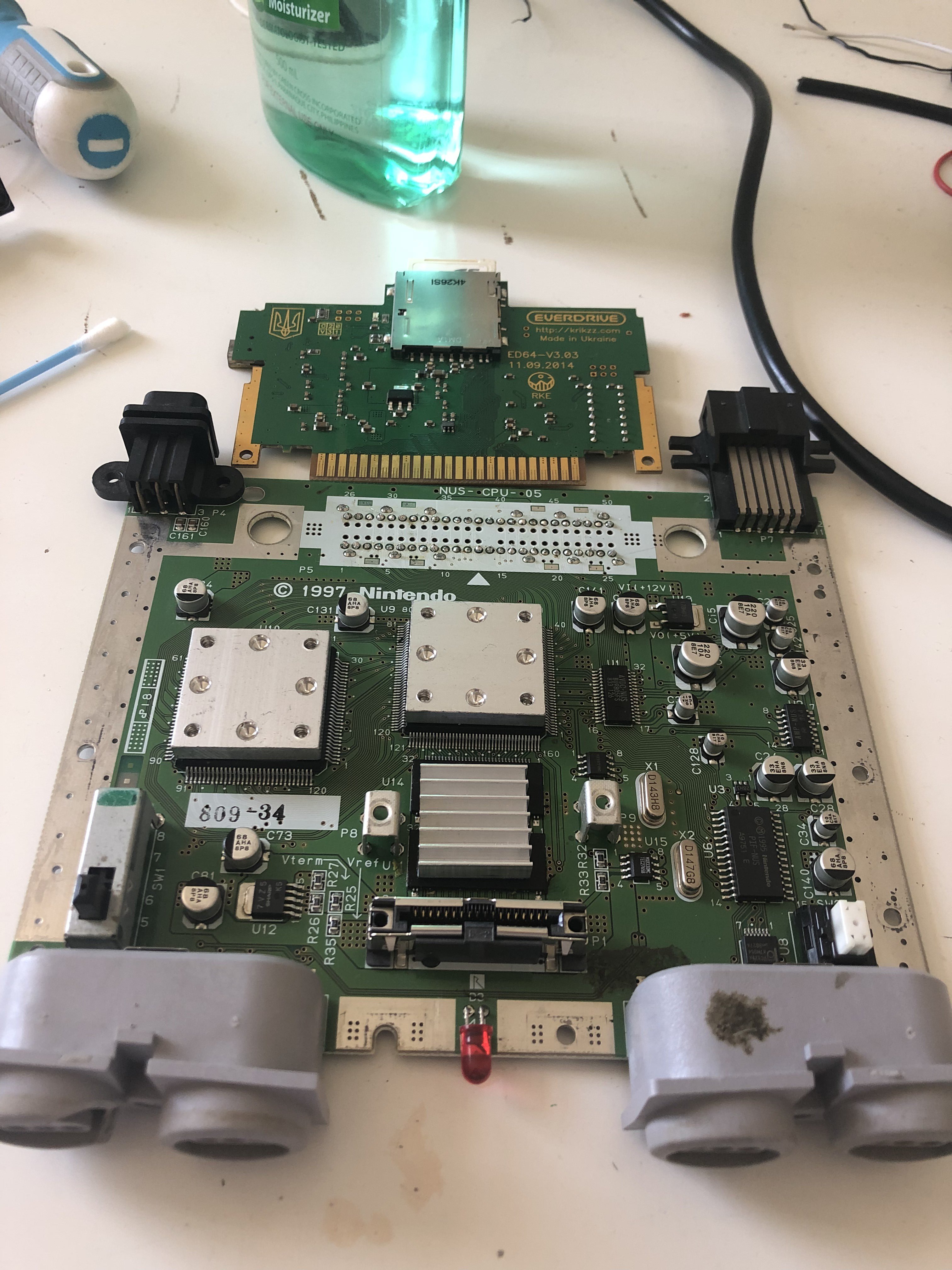

Here's the n64 stripped off it's cloths, as well as the everdrive without it's fabulous case.

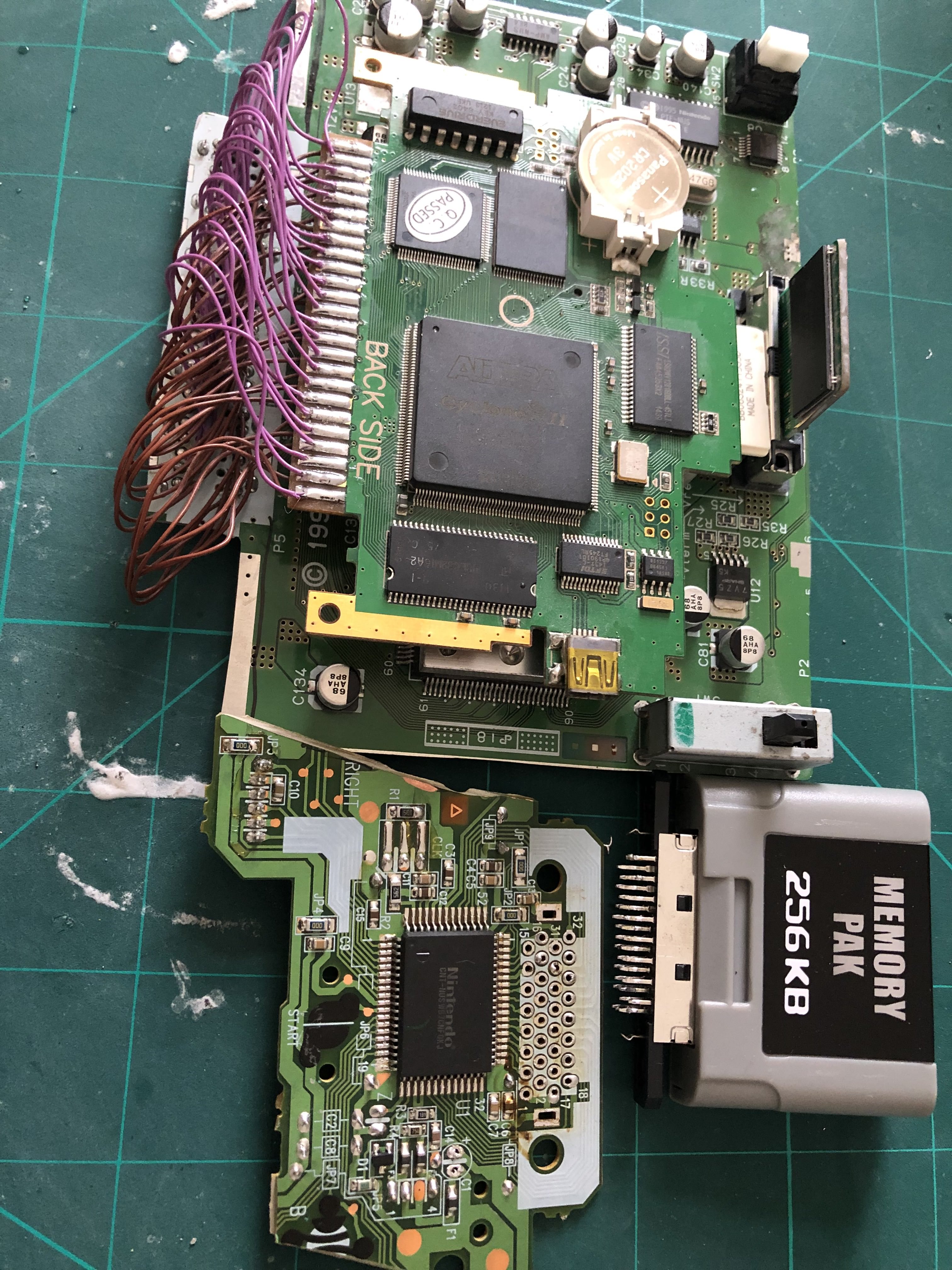

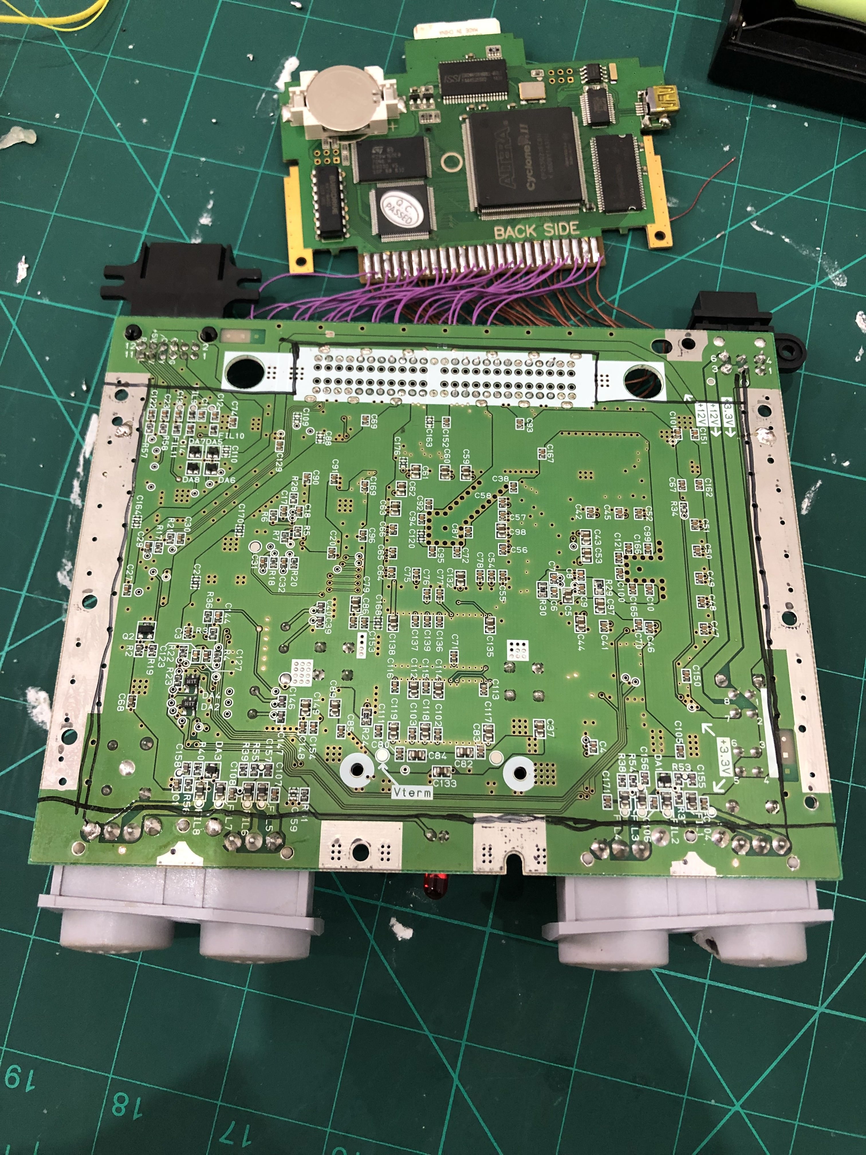

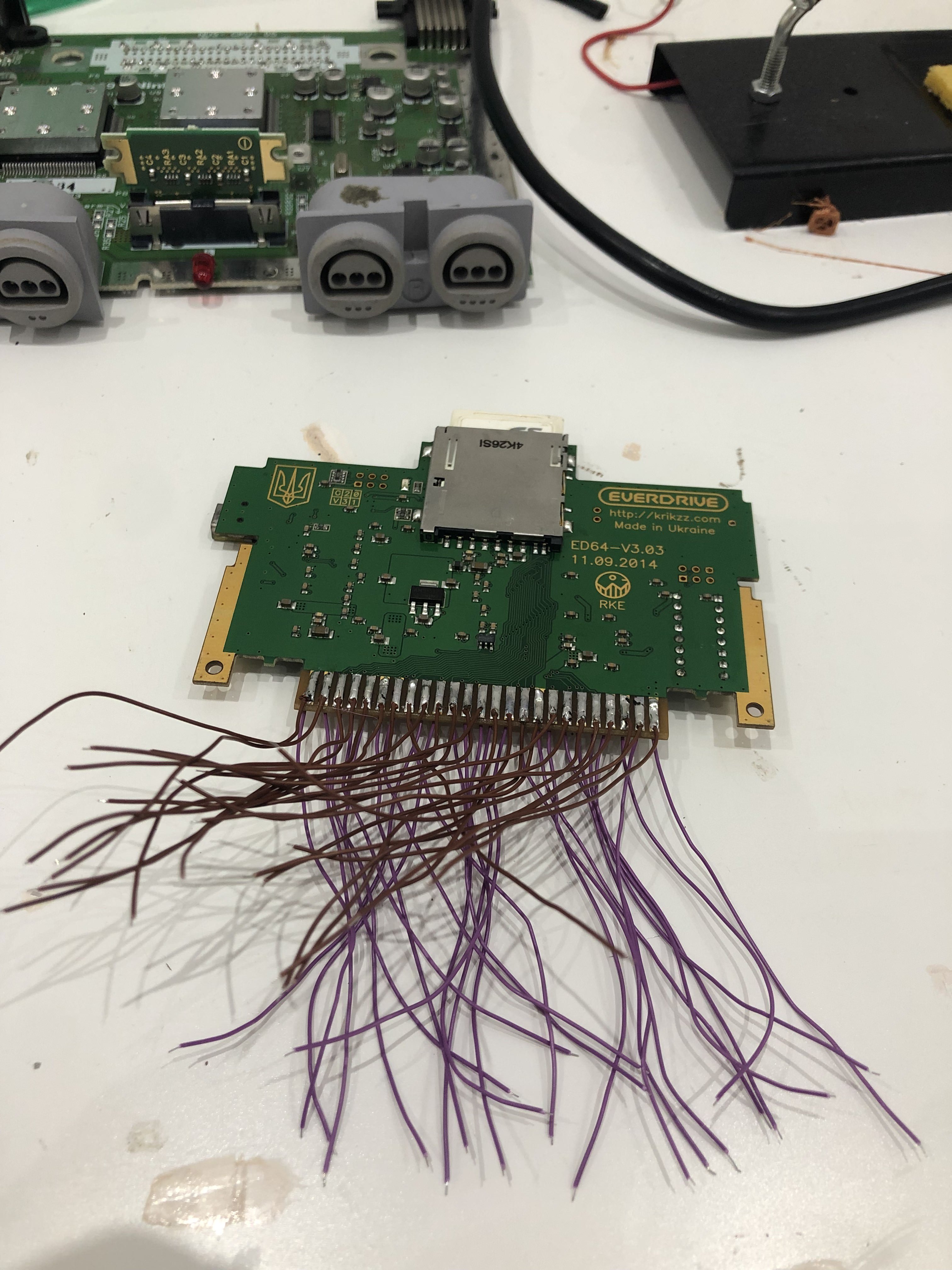

The idea is to connect the everdrive directly to the n64's motherboard and expose an SDcard adapter so you can just take off the microSD to add games and put it back, instead of having a big slot for games to fit in, you just put the SD card.

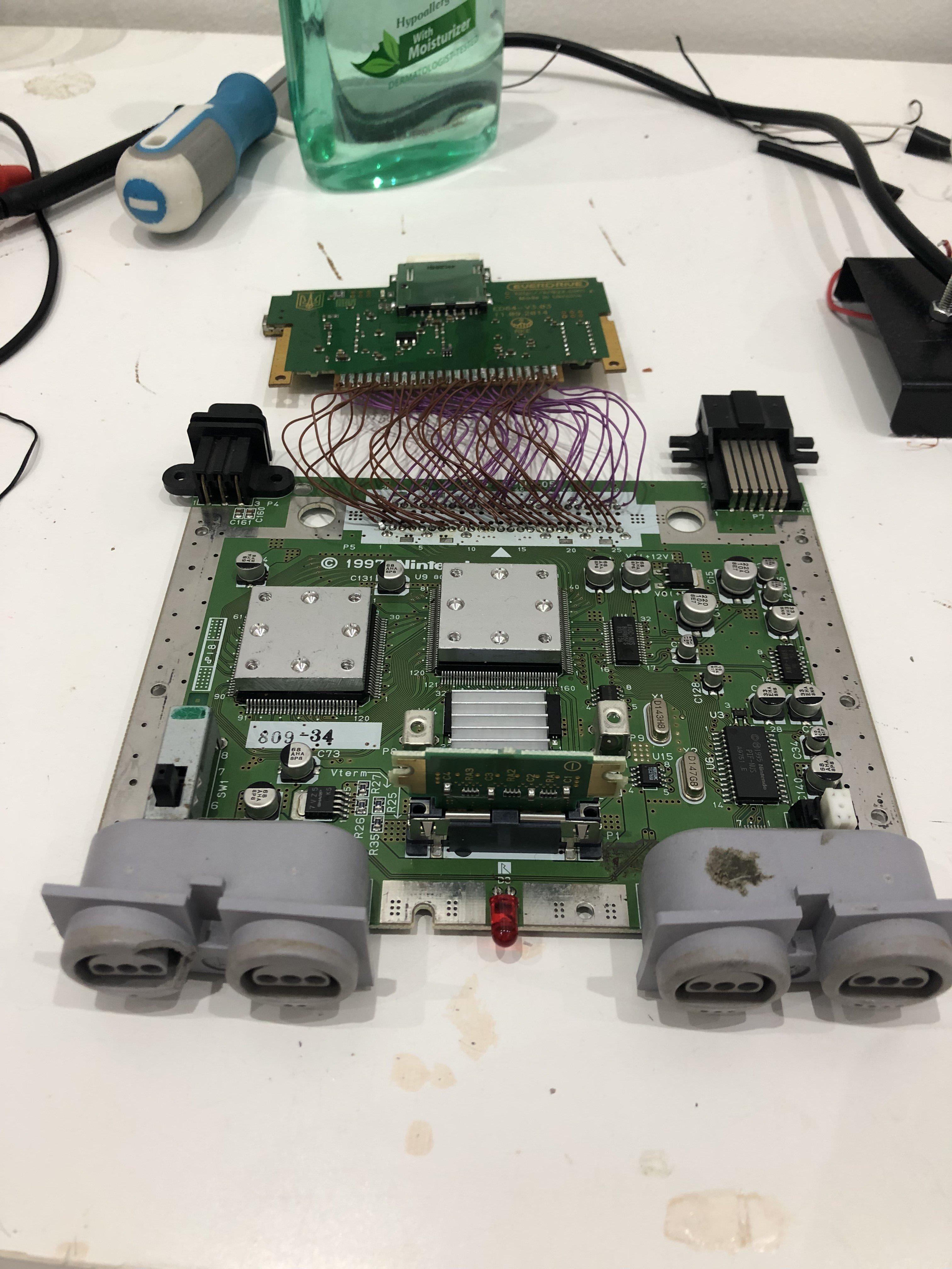

The wires are approx. 40mm~ and all cut to have the same length.
A quick test to check if it was working, which it was. I have connected all 50 wires to the motherboard, i heard that you can connect less wires, but since this is my first console portable, i opted for the safe way.

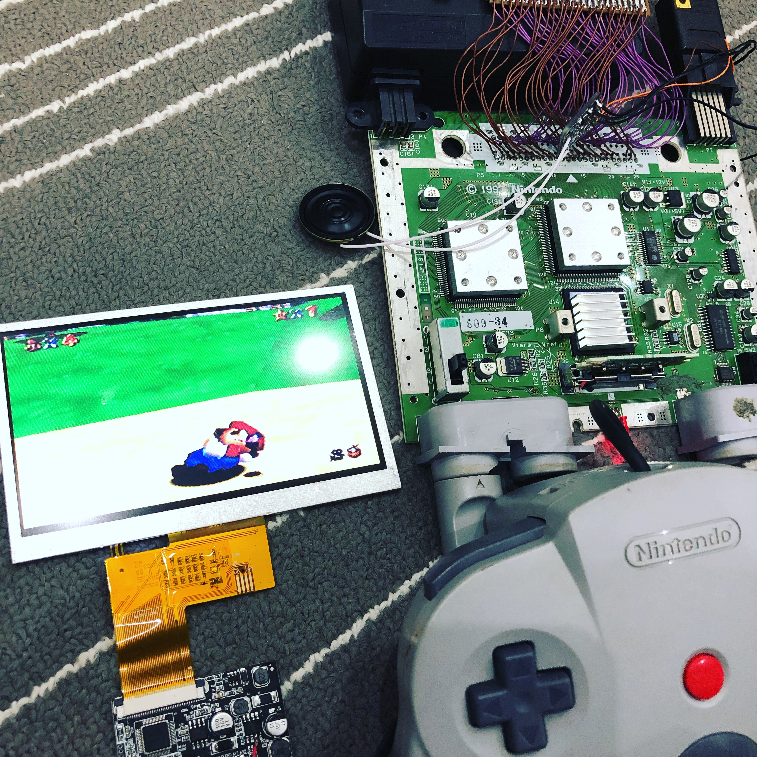

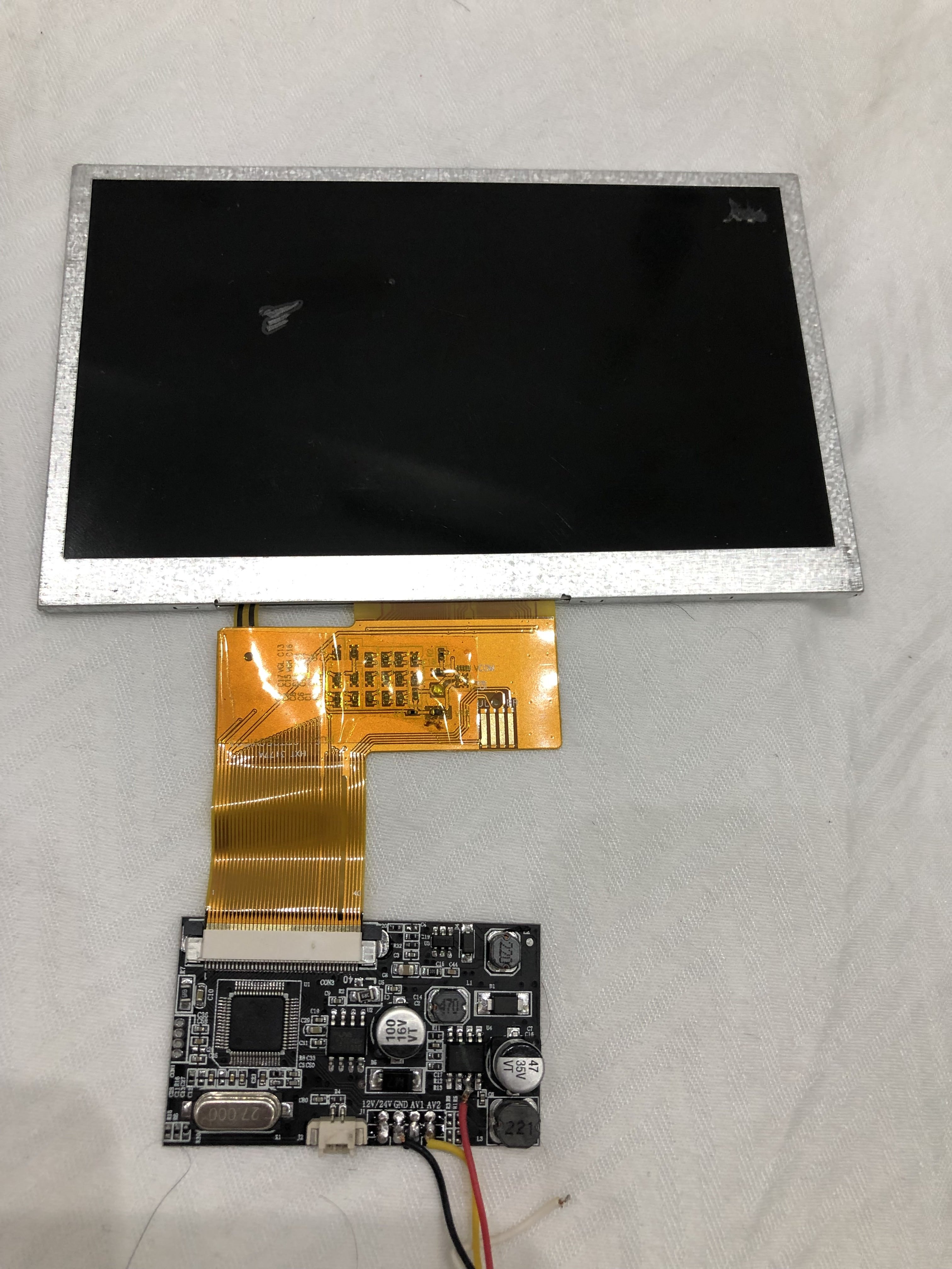

This is the 5" i'll be using.. I know, the bubble, i just had to use it, no other options. the board runs at 12-24v, however i modified it to run at 3.3v, how convenient, am i right?

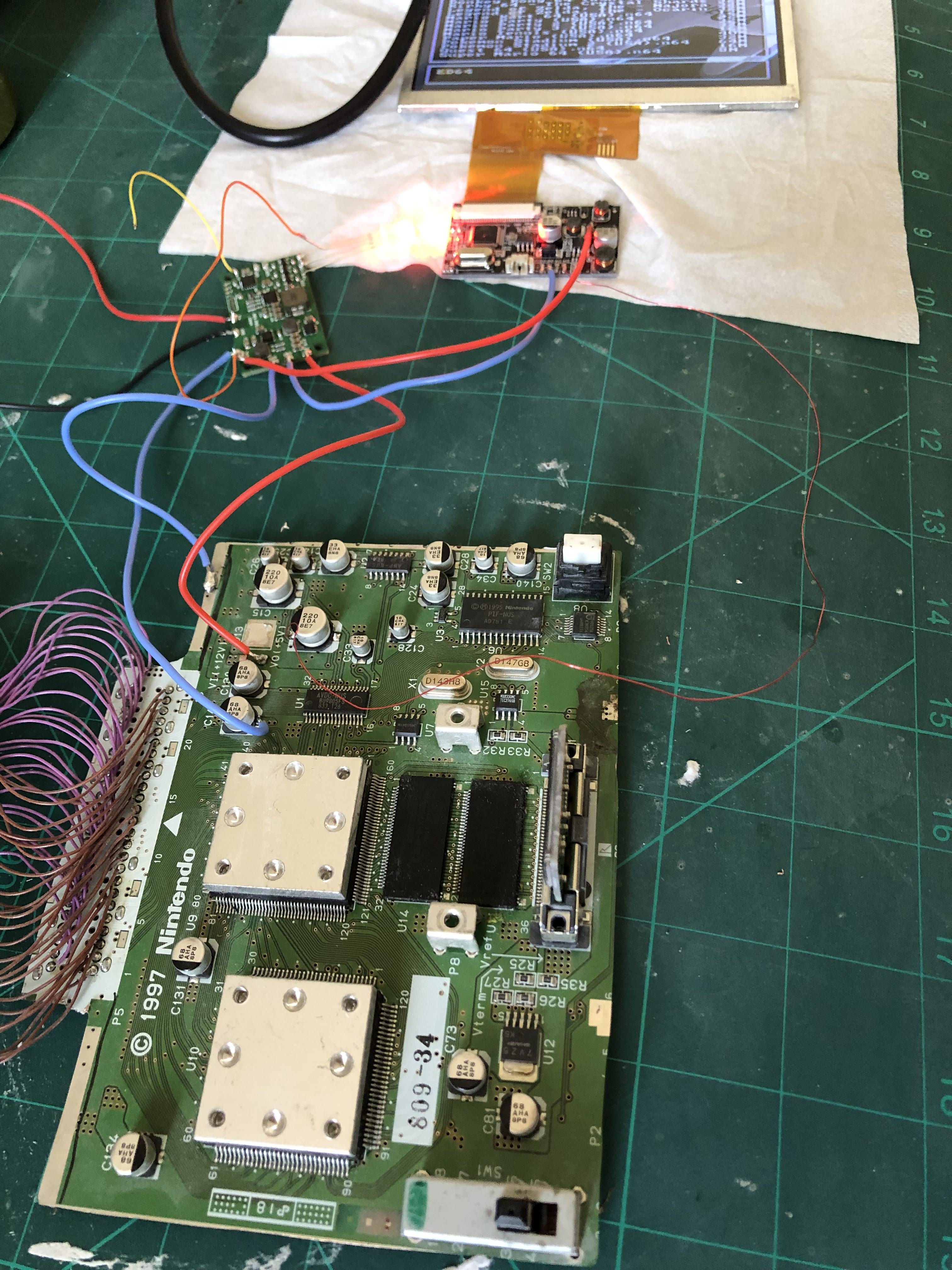

A quick test before the powersupply becomes USELESS!

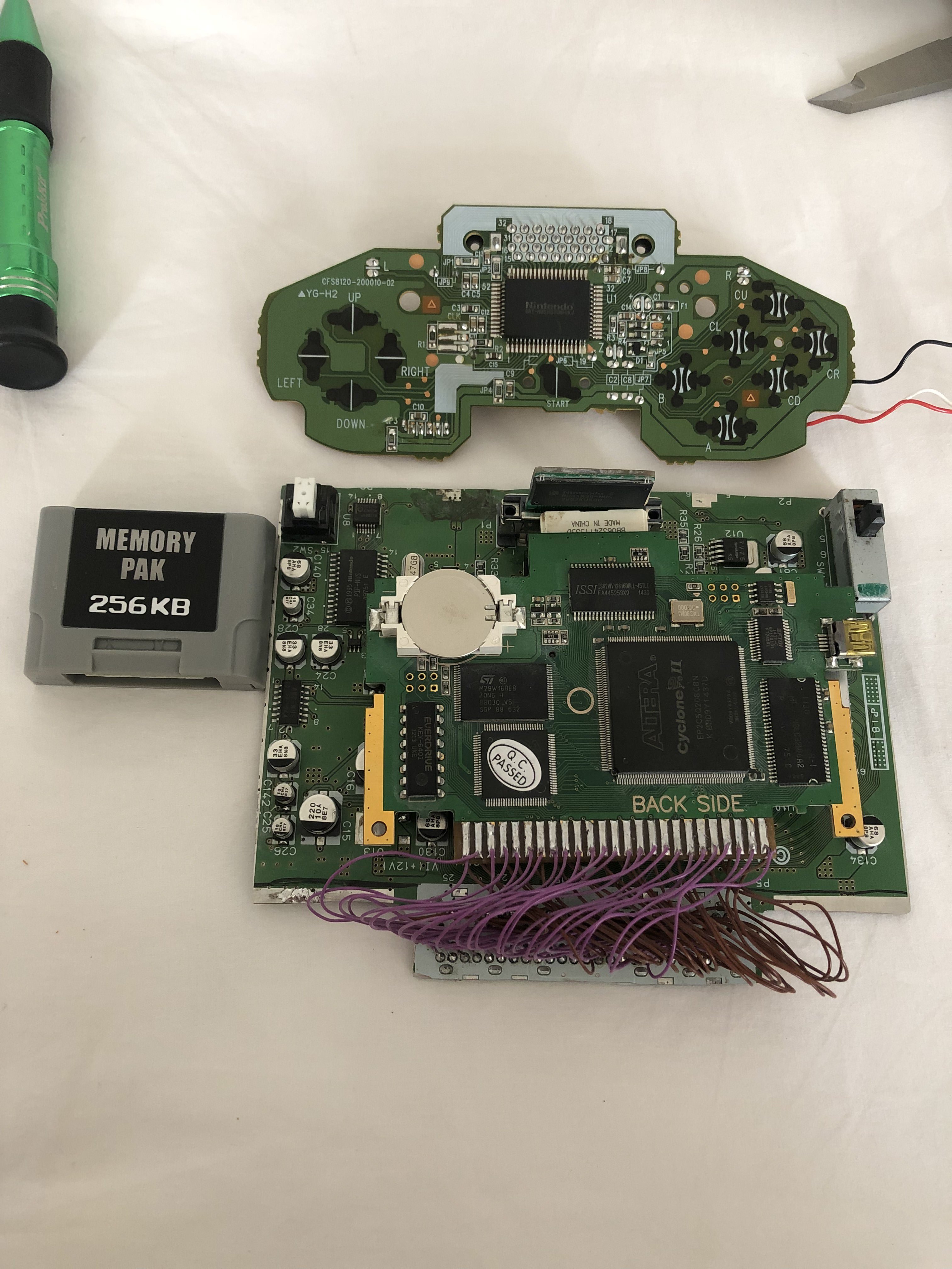

The mainboards that will be used as shown above

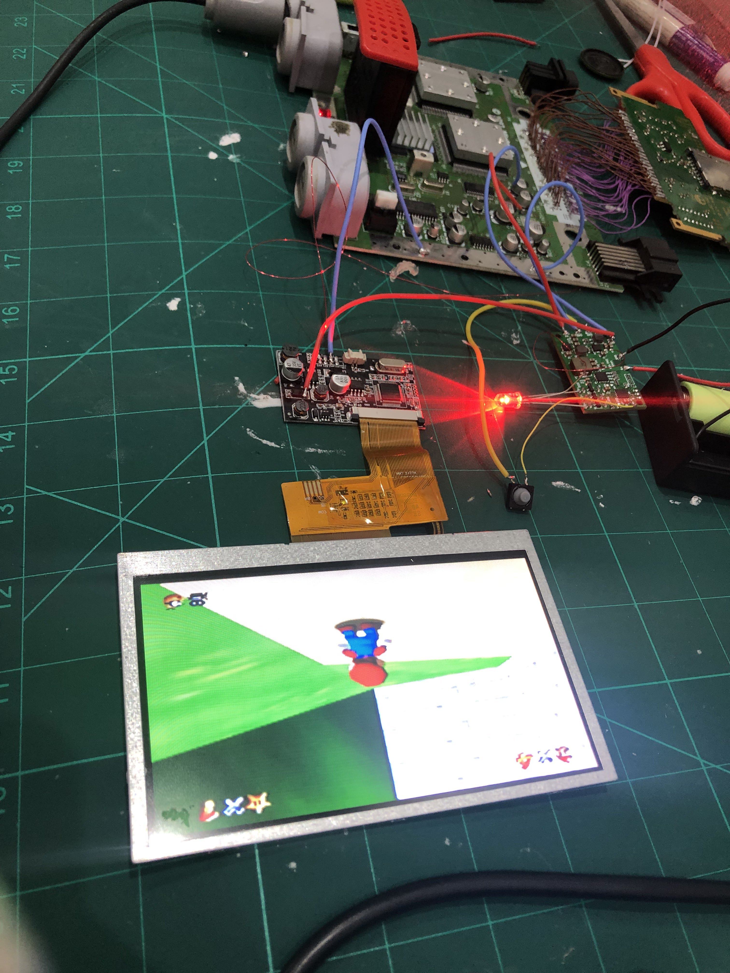

A quick test with the n64pms.
Now for the trimming phase, I'll be doing the minimum trim as this is my first portable console.
That was my first trim with console modding, and i really love this idea, HELLA nice..
This is the working unit, trimmed and sanded. as well as the expansion pack right there.
Moving on to the controller, i decided that it also needs some trimming:
This is the controller trimmed, as well as desoldered the memory pak slot.
I decided that i will not persue the memory pack as it adds a lot of wires for little benefit, at least for me, hopefully in the future i will add memory pak slots.

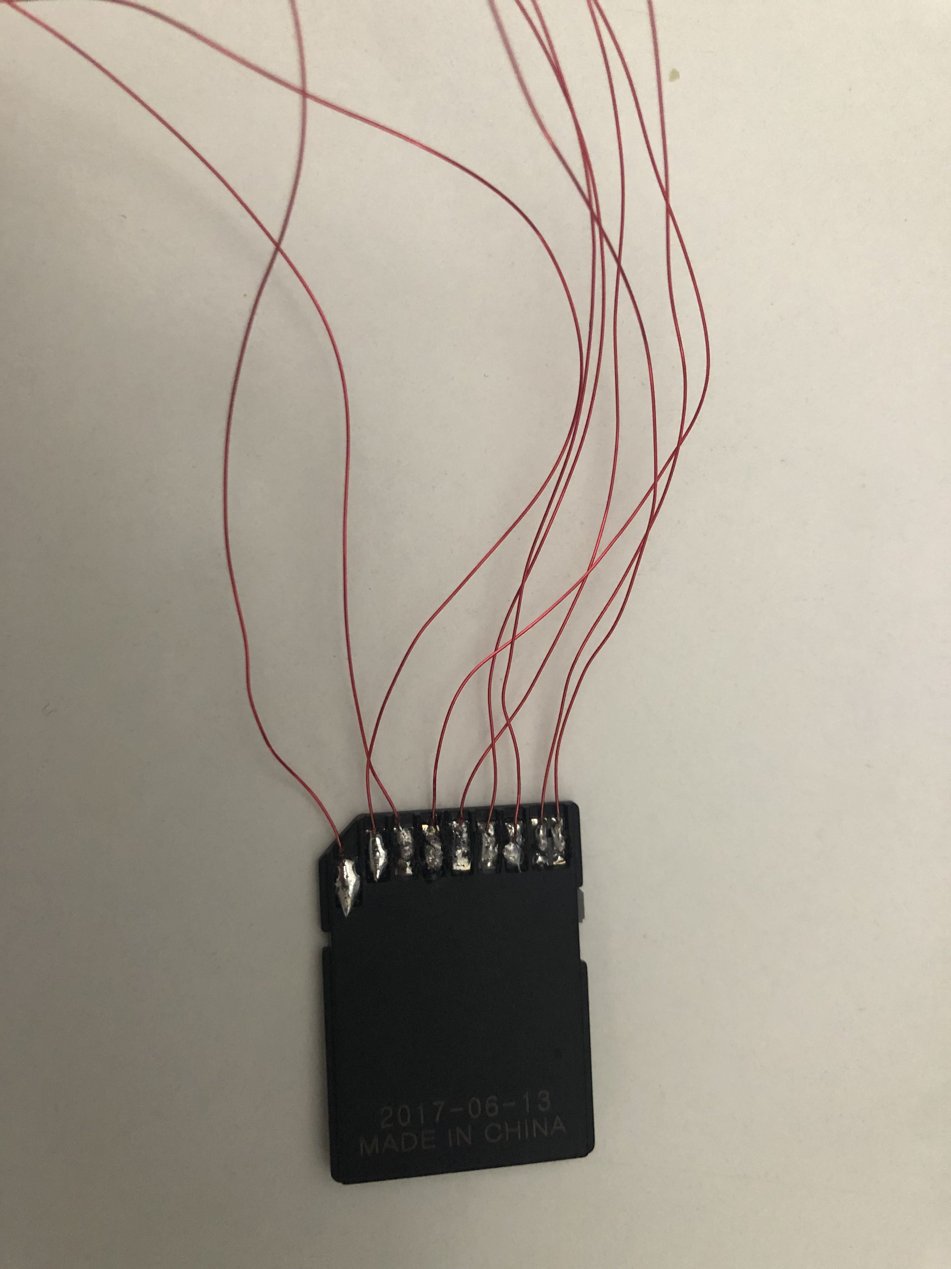

Here's the preparation of the microSD card adapter.

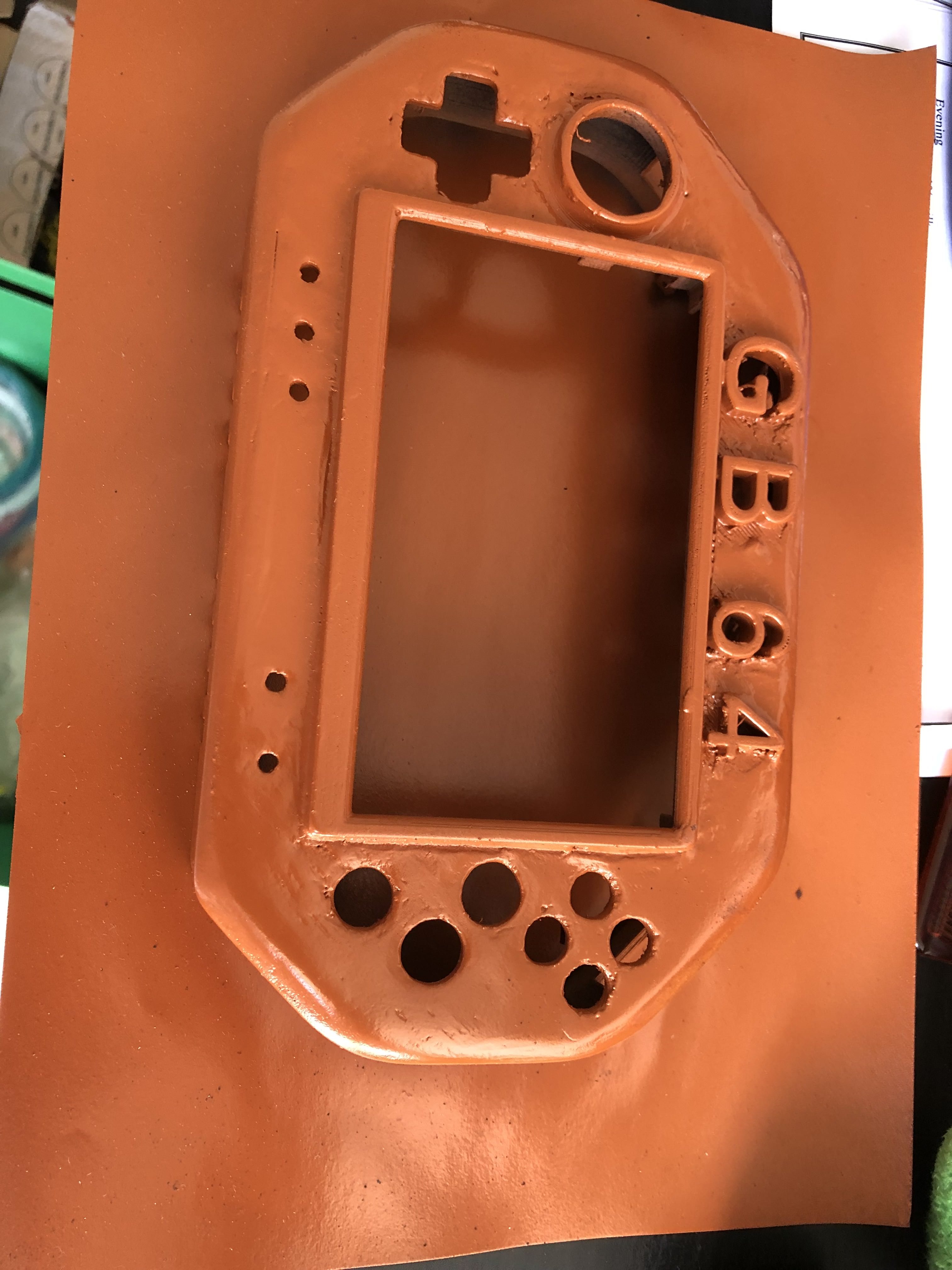

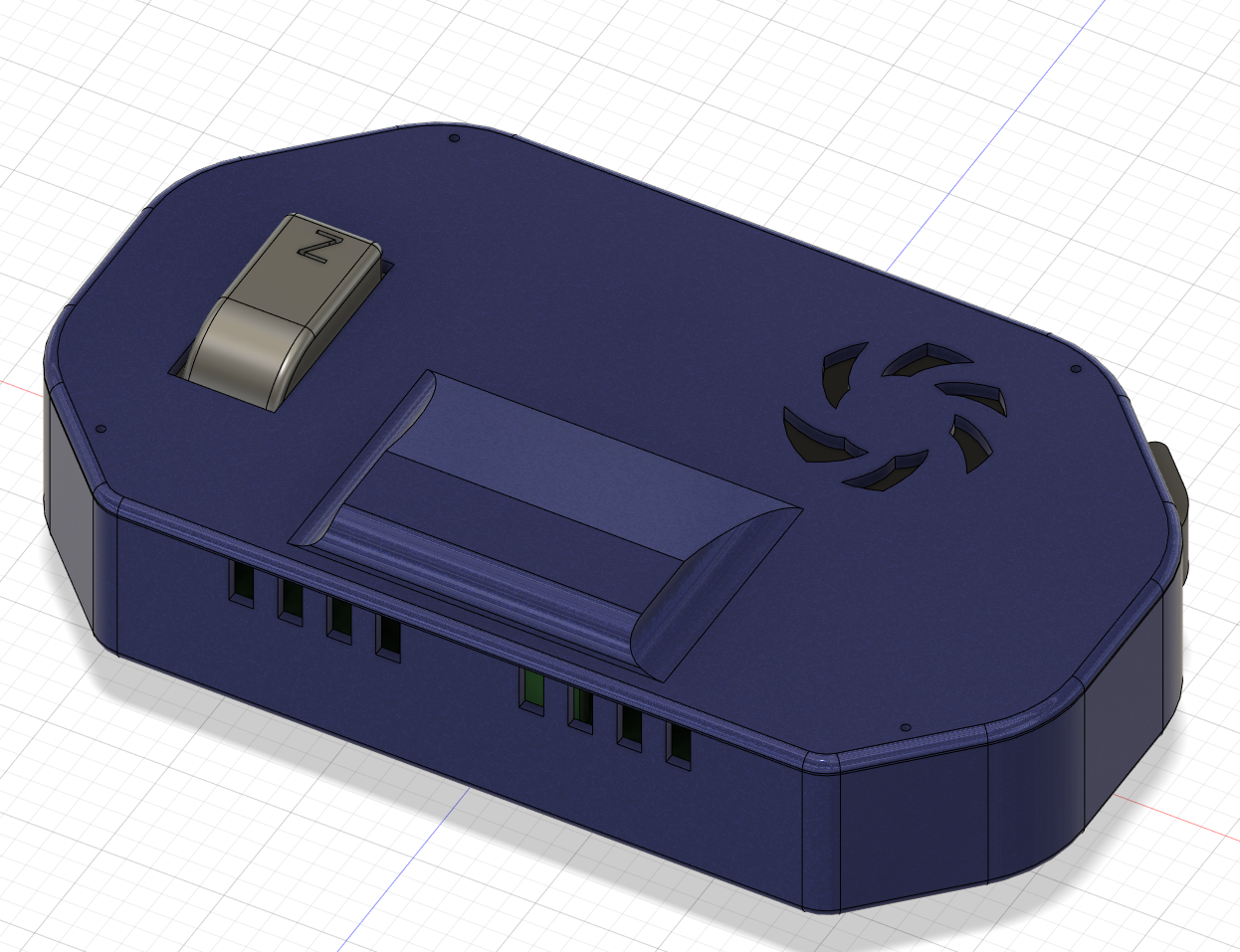

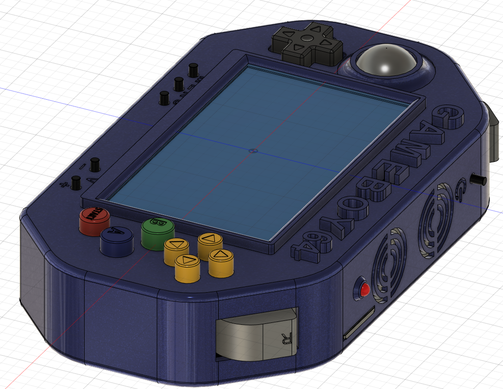

So from the name of the portable, Gameboy64, i wanted to to keep it as close as the gameboy advance design, Also, i wanted to mention that the case also used some ideas from the G-wii case that was made by
Gman, to be exact, the analog frame as well as the LCD frame.
I don't have all the pictures of the design but here's the result, i did do some tweaking before printing it out though.
I know, it's not the best paint job out there. but this is my first time working with these things. i added body filler and sanded it for a while, then used this nice color, i love it.

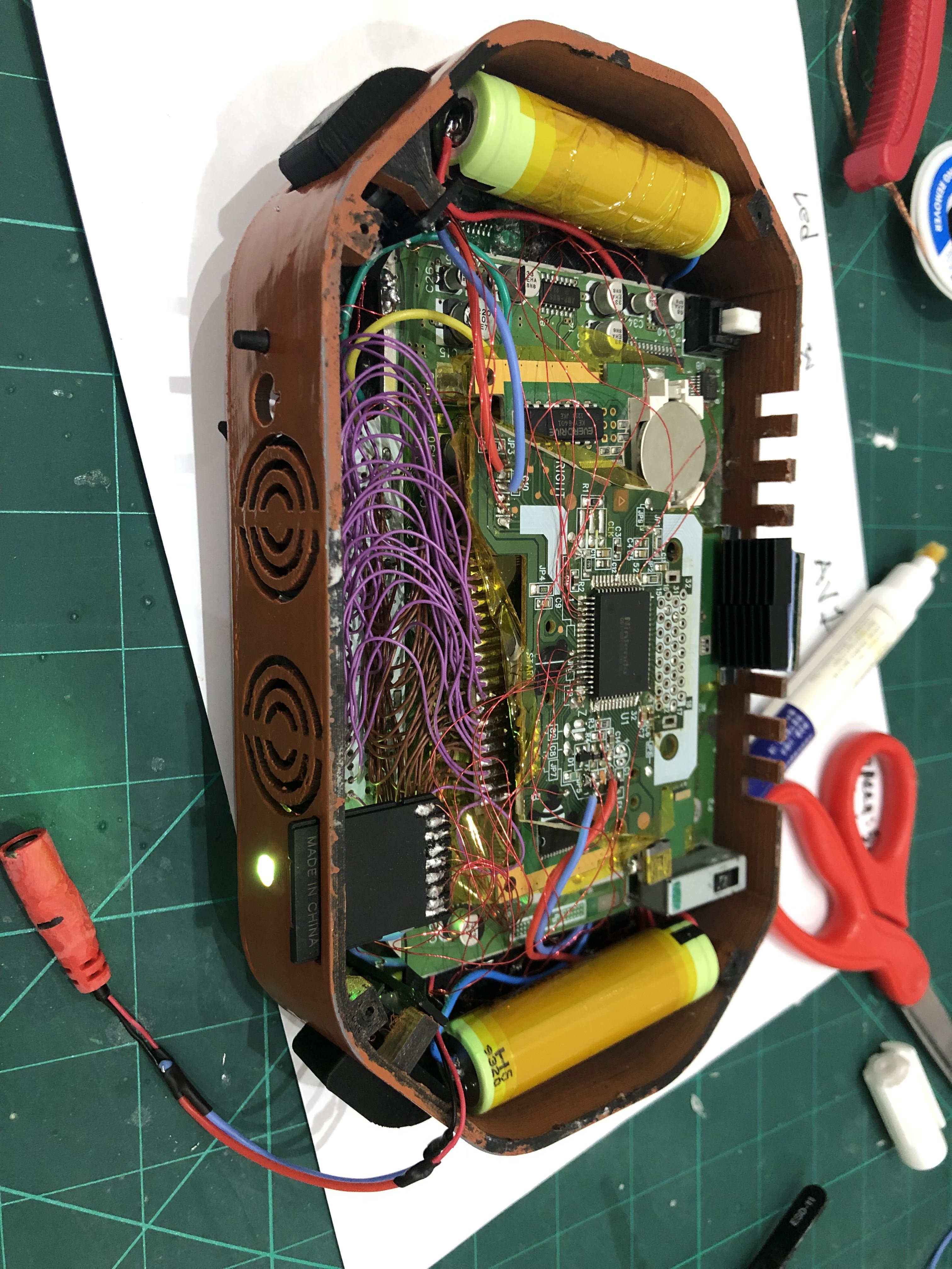

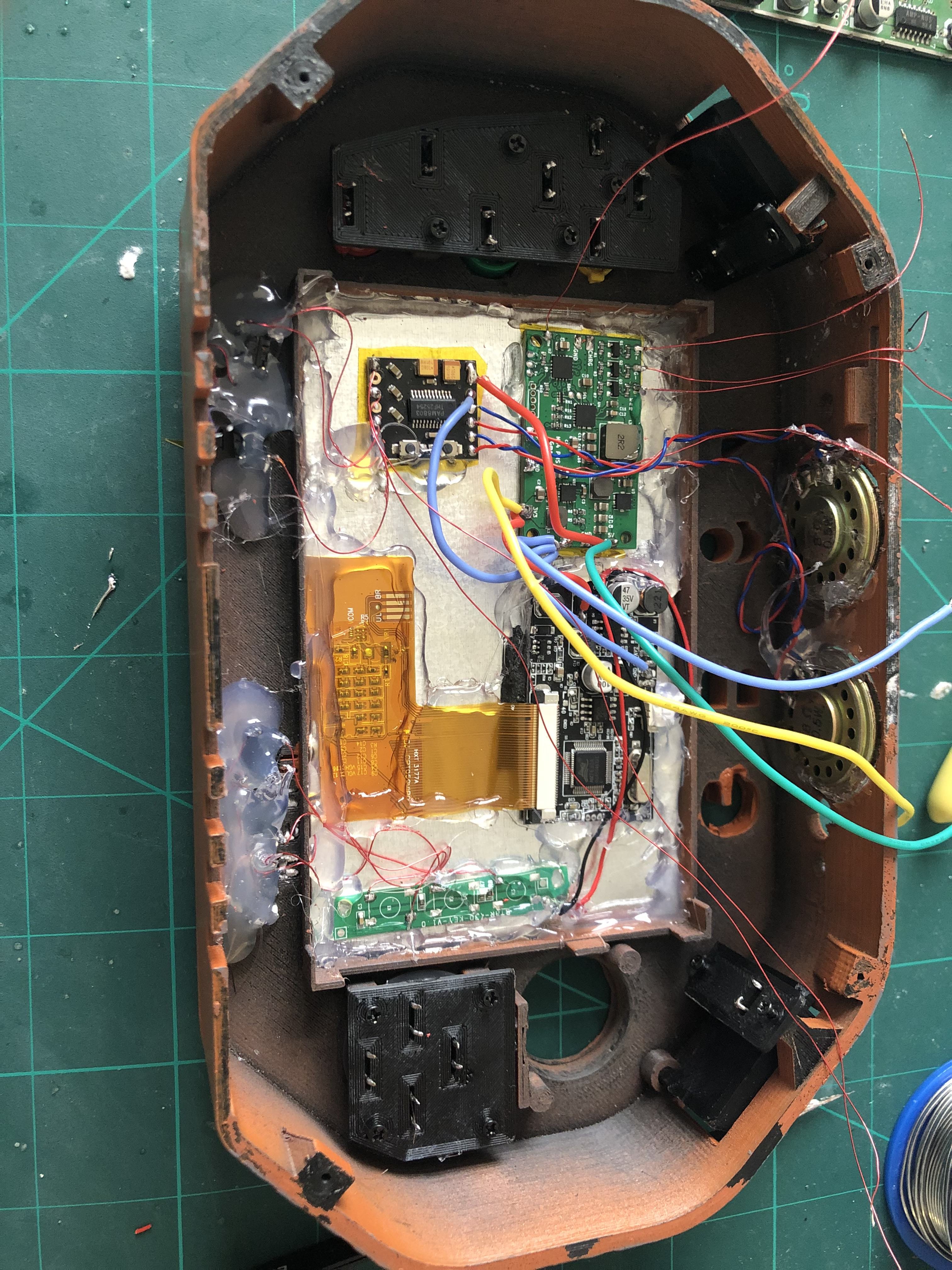

I decided to use the LCD's back panel as the bed for the motherboards, i used kapton tape to insulate the motherboards from the panel since it's conductive, in fact, you'll see me use it to insulate the other motherboards as well.
Since I'm using 3400mAh in parallel, the system can run for about 2 hours and 40mins(?) give or take. and charges for like 3 hours.
The SD card will always sit in this position, all you have to do is remove the microSD and add your games >:D

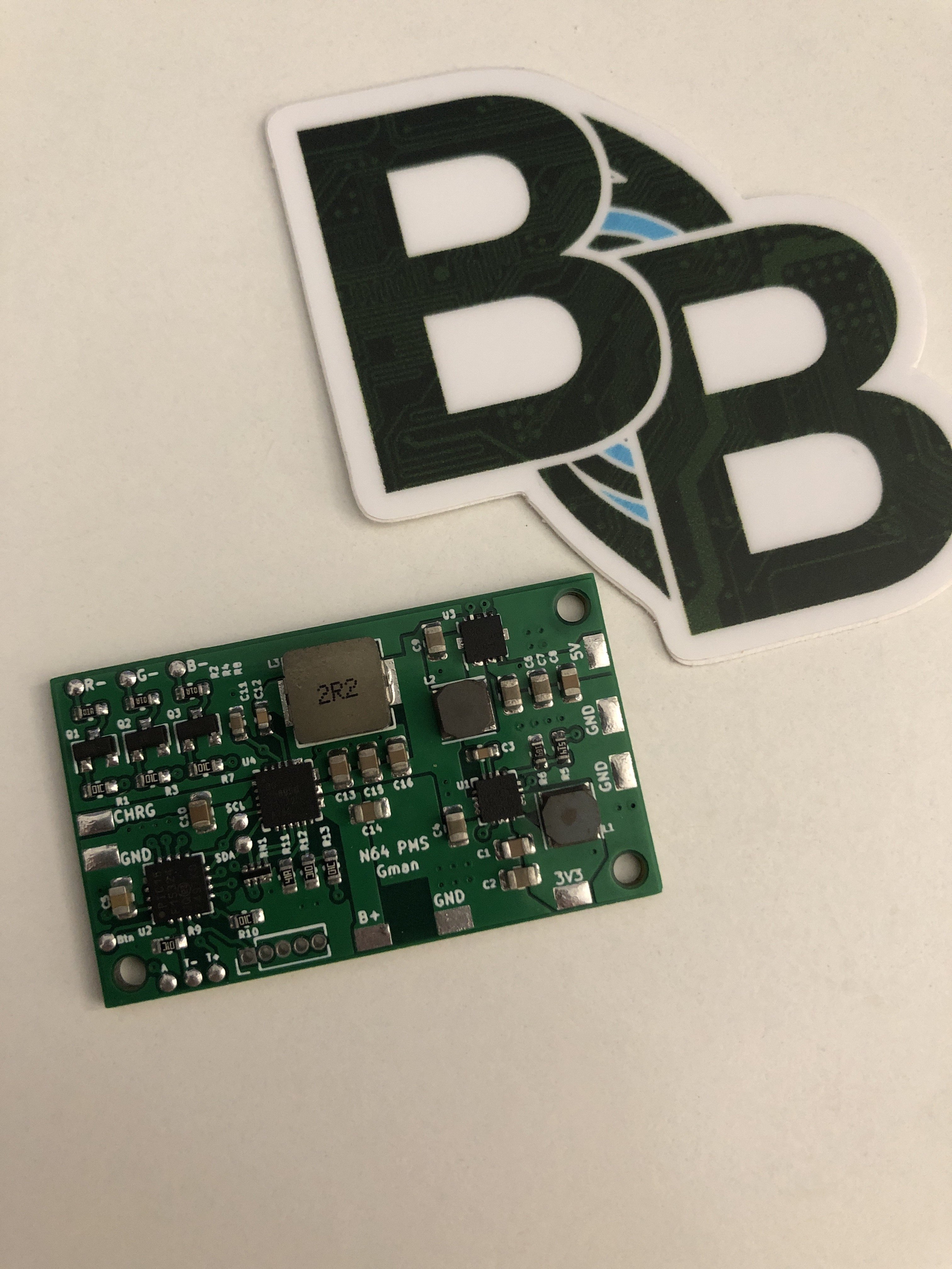

The button on the Left represents the power button, that is connected directly to the n64pms as well as the LED, you can also press the button for a bit to change the LED color, all thanks to Gman and his contributions!

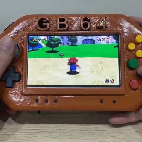

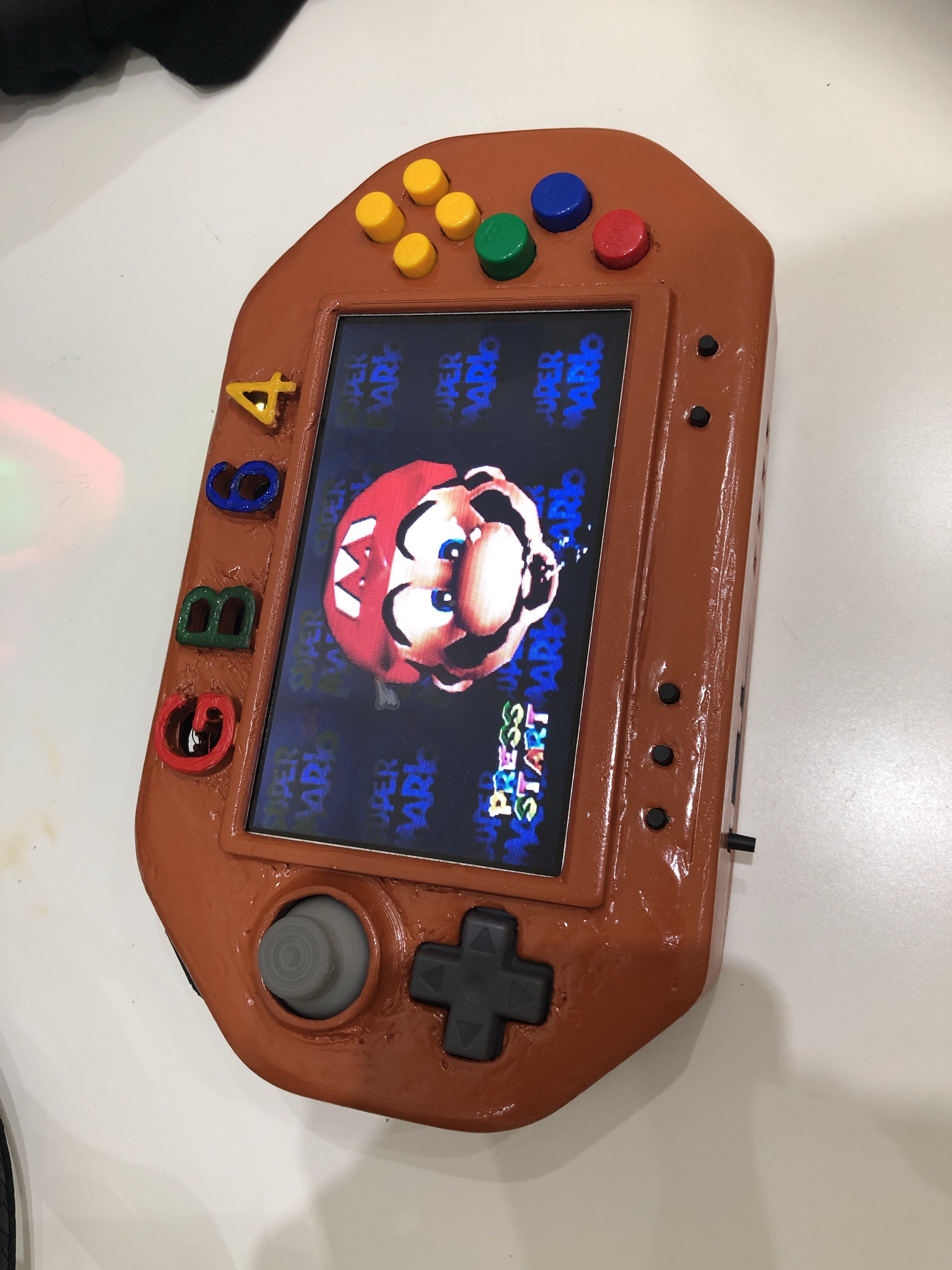

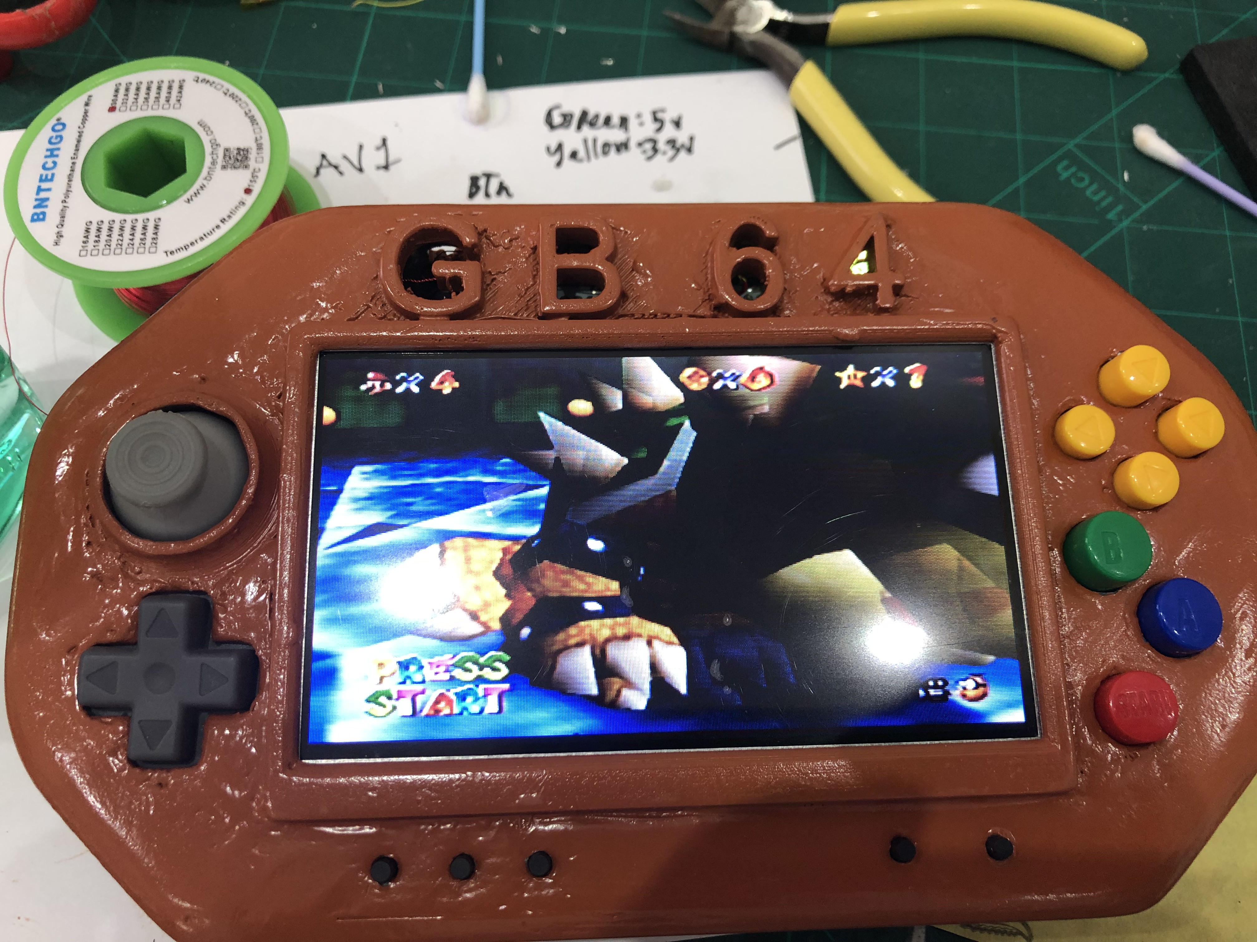

Here's my first successful portable :D the GameBoy 64!
There's still one thing i want to do, I'll paint the Letters with different colors: RED, BLUE, GREEN, and YELLOW.

Overall pretty damn good, I also had issues with squishy tacts in my build.
I feel the only thing that lets it down for me is the case finish. Reprinting with the GB64 letters not being raised so high or even recessed would make it much easier to sand around those areas.
Find yourself some plastic filler primer. That's what I use to fill imperfections and then sand until perfect.
Again though, great first portable :D

Hey,
I did have the same feedback with the finishing.
This is only my second time sanding and painting, The idea of the letters being raised so high was to reach the same level as the analog and lcd frame since the whole thing prints with support.
I do feel like i could've done things better though, however i did learn a lot from this one, my next one is a ps2 portable, ill take note of your advice.

Yes, i used the n64pms because it also provides a battery indicator feature which is really nice, and it’s all in one, couldn’t ask for more.
