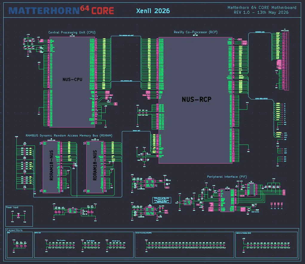

In order to create this unique all-in-one Matterhorn 64 motherboard, I would first need to reverse engineering the original Nintendo 64 motherboard.
This process is extremely complicated, and is without a doubt the most complicated step of the whole project.
As I just mentioned, there are four people who officially gave it a shot and shared their progress over the Bitbuilt community. Only 2 succeed.
Making my own was extremely complicated because it requires a lot of knowledge.
Since I didn't know a thing about the Nintendo 64, I had to make a lot of research online about how the system worked.
I had to understand in depth the role of each component of the console, and understand how they all communicate in order to operate properly.
Normally, I would have need to probe manually the whole console with my multimeter in order to know where each trace goes and what signal travels through it.
Hopefully though, I was able to find some decent schematic and documentation online which helped a lot with that process.
However, since none of the working motherboard recreation were open sourced at the time, I had to manually understand what component was needed for the motherboard redesign and what component was not in order to make it as small as possible.
This took a lot of time, but with the huge help of @YveltalGriffin , I was able to figure it out.

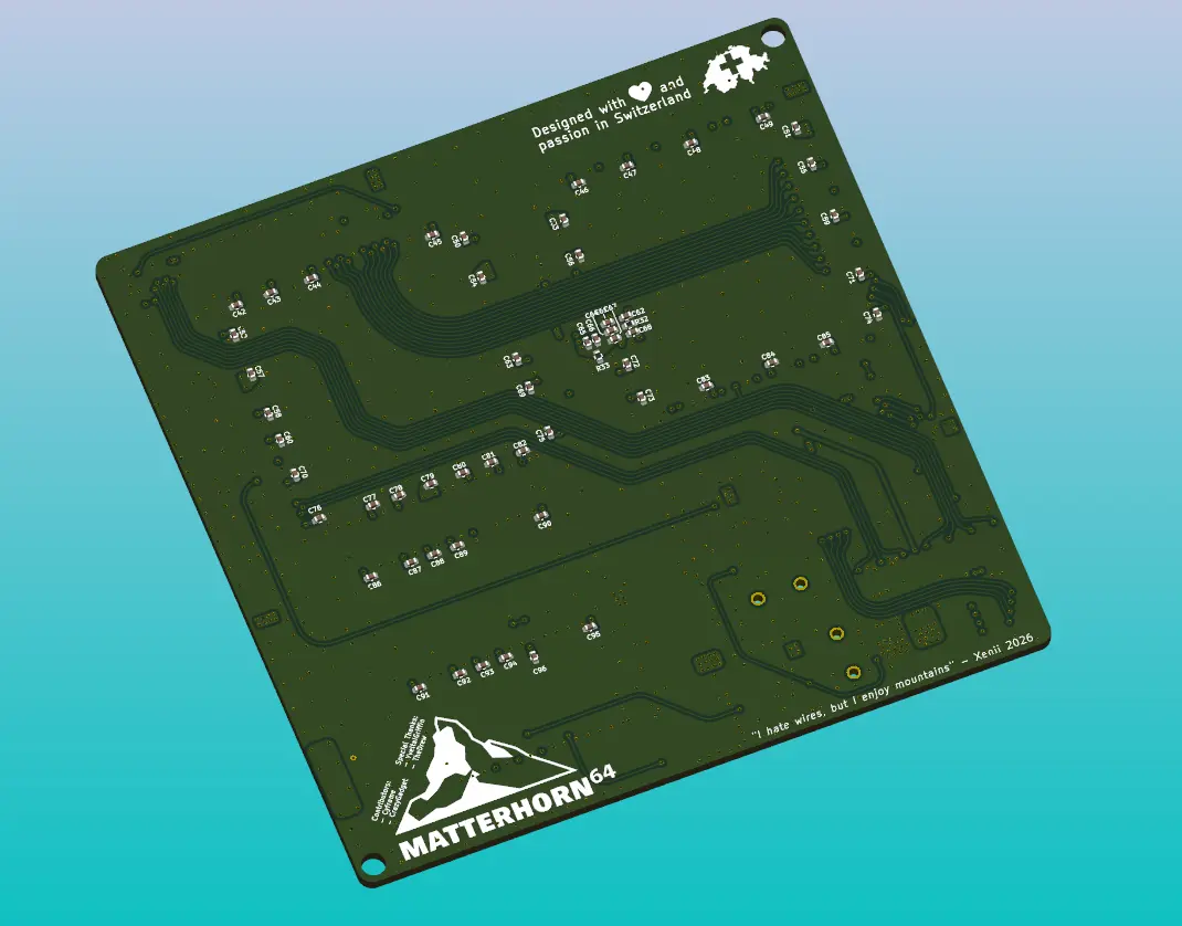

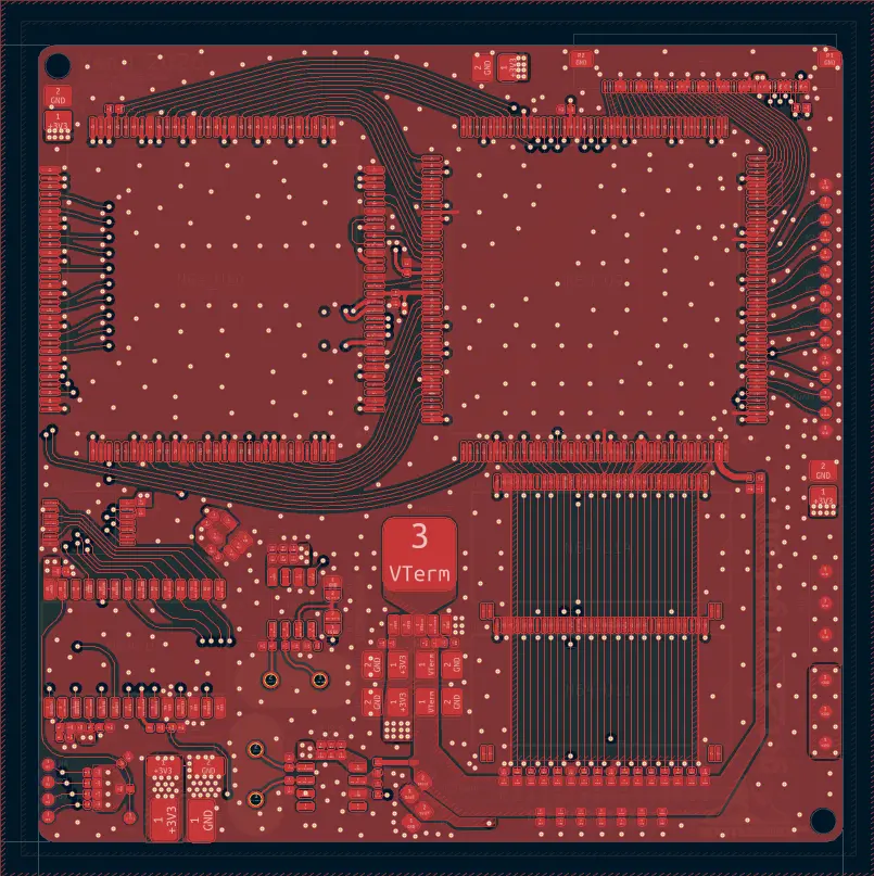

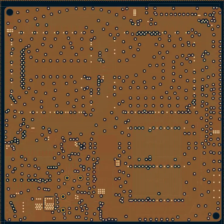

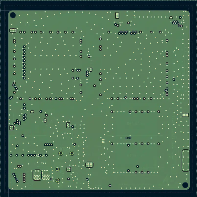

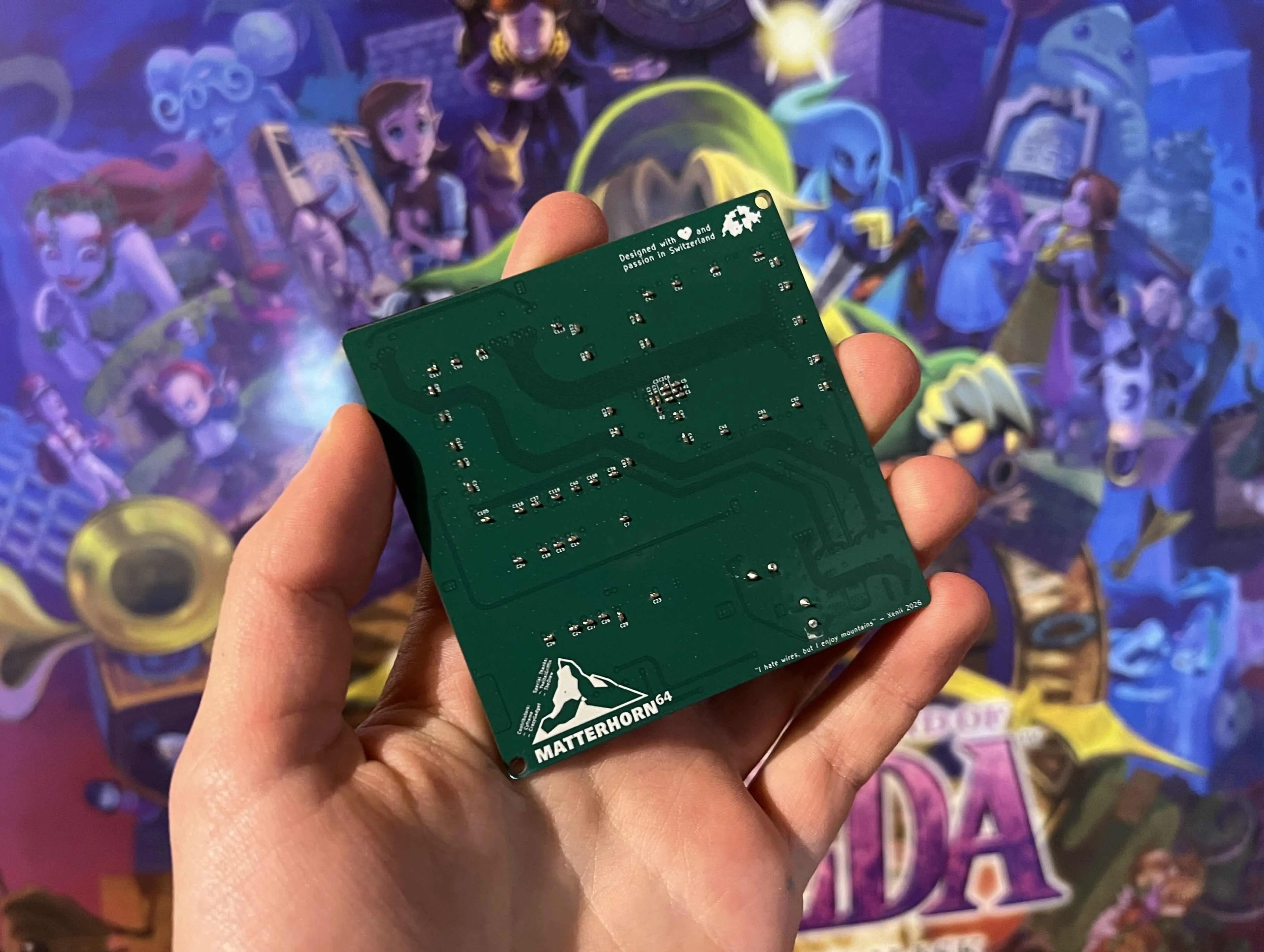

I called the Matterhorn 64 CORE the boards which contains all the necessary components for the system in order to boot and work as intended while keeping it compatible with the whole library of games and by keeping it as small as possible.
When I understood what components were needed, I started designing the board back in October 2025. I first designed the symbol of the Nintendo components on KiCad.
I then imported them in my schematic and made all the connections between these components.
I then designed the footprint with the contribution of @cy. After a few weeks, the board was designed!

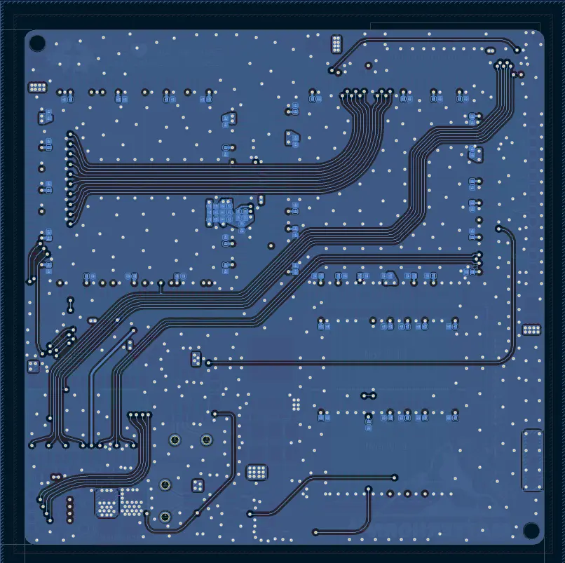

Yveltalgriffing gave me the advice of routing the board with the any angle mode. Basically, instead of drawing the traces with 45° angles, I would be able to route them with the angle I wanted. I also decided to route everything with rounded corners in order to make really pretty board.

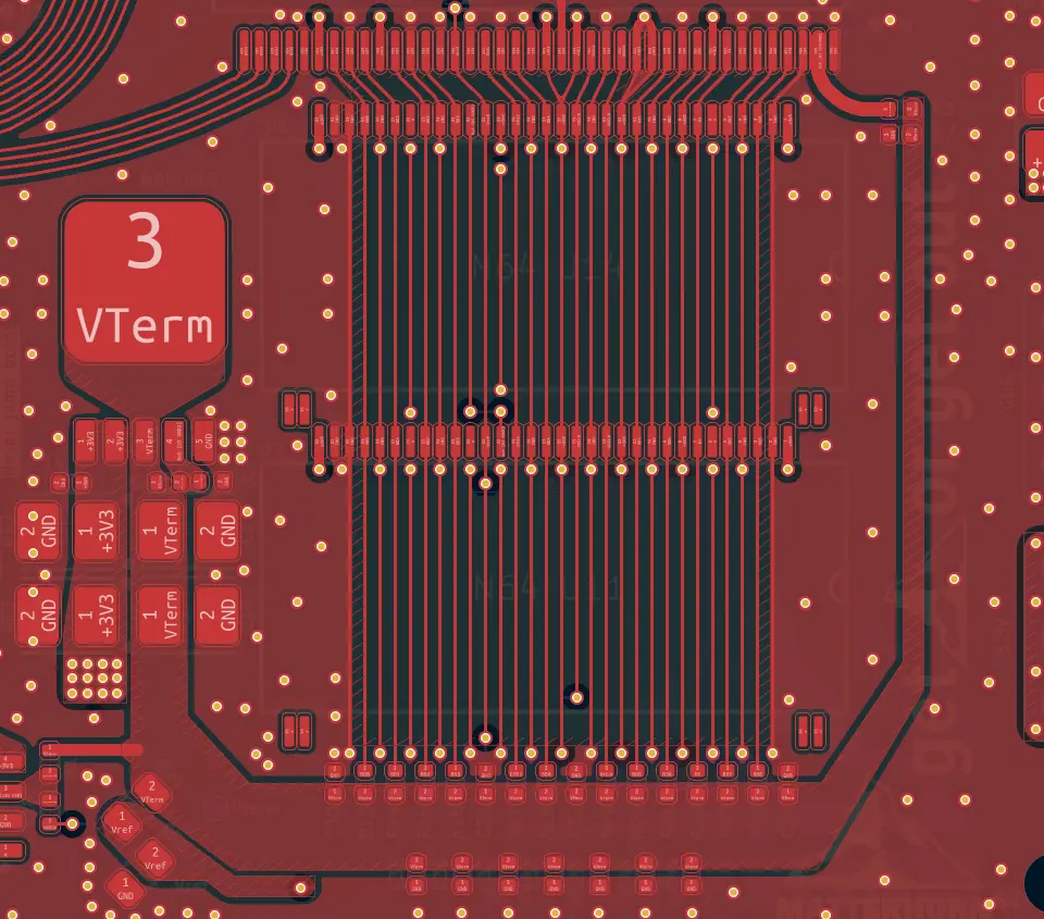

The trickiest part of the system is for sure the RDRAM Bus.
But what's so special about the RDRAM Bus?
First, we need to know the RAM stands for Random Access Memory. It's a volatile memory which is used to store all the temporary data at a high speed.
On the Nintendo 64, Nintendo collaborated with RAMBUS. A company specialised into RAM chips.
RAMBUS developed the RDRAM technology back in the early 90s.
the RDRAM stands for RAMBUS Dynamic Random Access Memory. Unlike regular RAM chips which rely on transistor circuits to maintain a certain logic level, Dynamic RAM relies on capacitors in order to store the data.
If the capacitor is charged, its stored value is 1, otherwise, if it's empty, it's worth 0.
Dynamic RAM is great because it is more compact and cheaper to build.
However, the DRAM uses a lot of power. Since everything is stored on small batteries (capacitors), charging them takes a lot of energy.
Furthermore, like all the capacitors, they are not perfect. Meaning they will slowly discharge after a while, which can cause data loss.
To correct that, the Nintendo 64 has to refresh and recharge all the capacitors in order to keep storing the data.
Also, every single time we read the content of the DRAM, the capacitors all discharge, meaning the system has to recharge them after each read.
Finally, unlike most RAM chips which had one address bus (used to select the cell we want to use), one data bus (used transfer the data) and one command bus (used to say if we either want to write or read the cell), the RDRAM only has two. Both address bus and data bus have been combined, and the command bus is used to tell if what on the bus is either the address or the data.
All of this makes the RDRAM bus to be extremely fast. On the Nintendo 64, the RDRAM operates at 250MHz. This means the signal "repeats itself" 250 million times per second.
Considering a signal changes its logic level 2 times per period, each of the 9 RDRAM bus traces change their logic level 500 million times per second.
Therefore, the RDRAM bus needs to be routed perfectly in order to make the system boot.
I calculated the impedance of the traces to be 50Ω. The boards contains 4 layers, which definitively makes this easier.

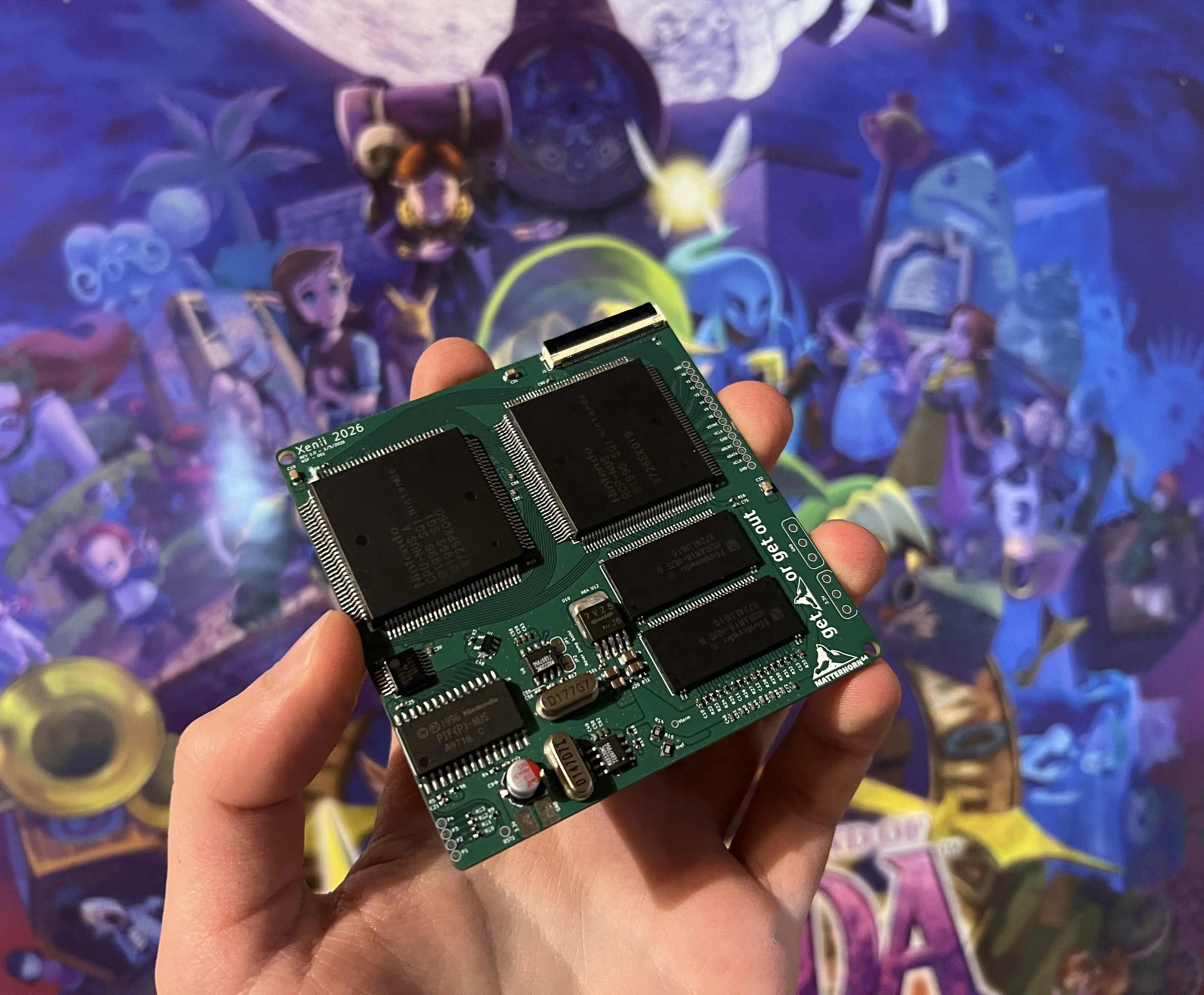

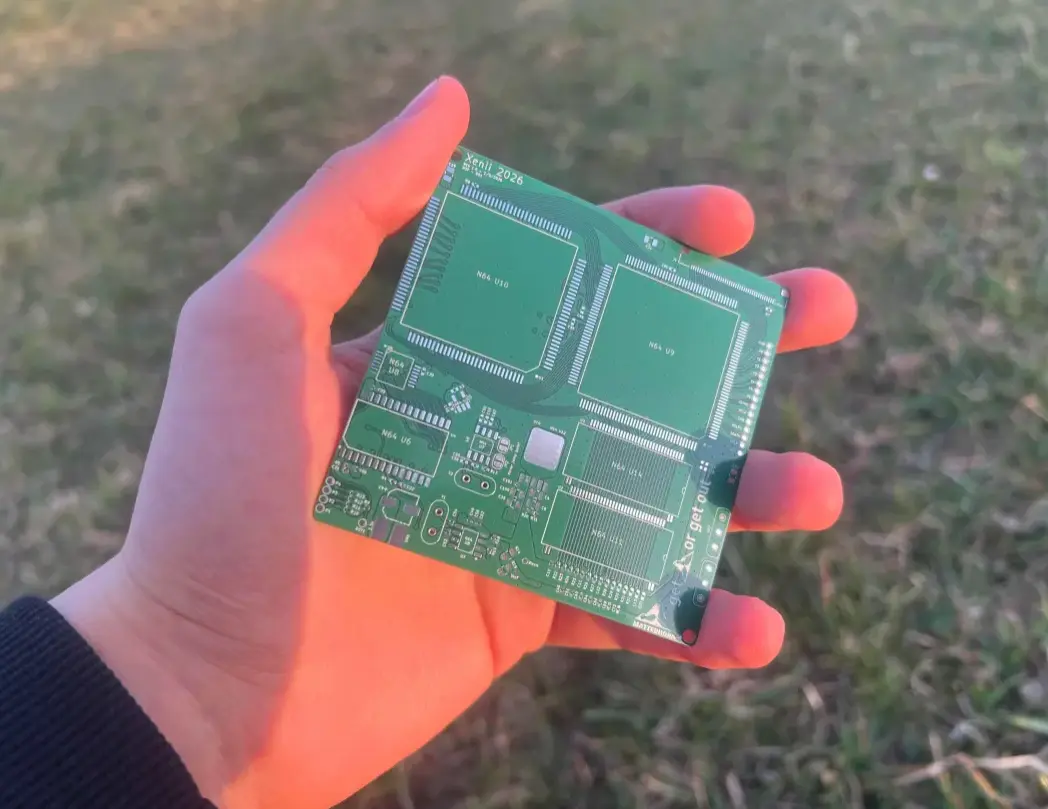

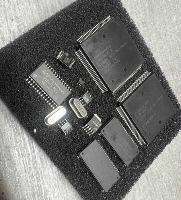

After 5 months shared with both Xii-Boy Ultra Kits and Matterhorn 64 CORE redesign, I was able to order it.
A week later, something came into the mailbox!
I then desoldered the components from the donor board:
And here is the final result!

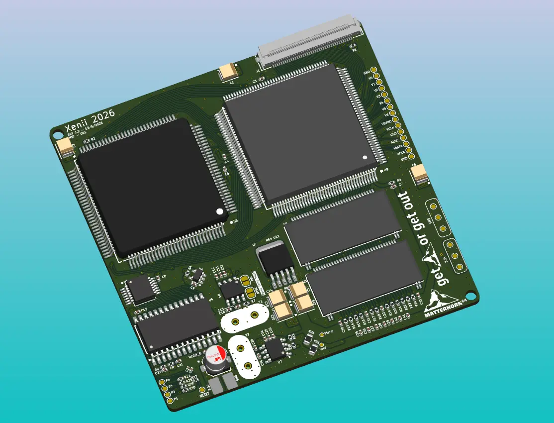

After a few weeks of troubleshooting, I was able to confirm the board was working!!
The board had one major issue though: It only work if either undervolted or heated.
I did a lot of tests and was unable to find what was wrong. I compared most of my measurements with an original console and wasn't able to find any difference.
I assume I damaged one of the components when desoldering it. I also regret having used some low melting temperature solder, which add a level or reliability issues.
Anyway, here is a little video of the CORE running!
I actually released the board on GitHub for anyone who wanted to build their own: Matterhorn 64 CORE Github
