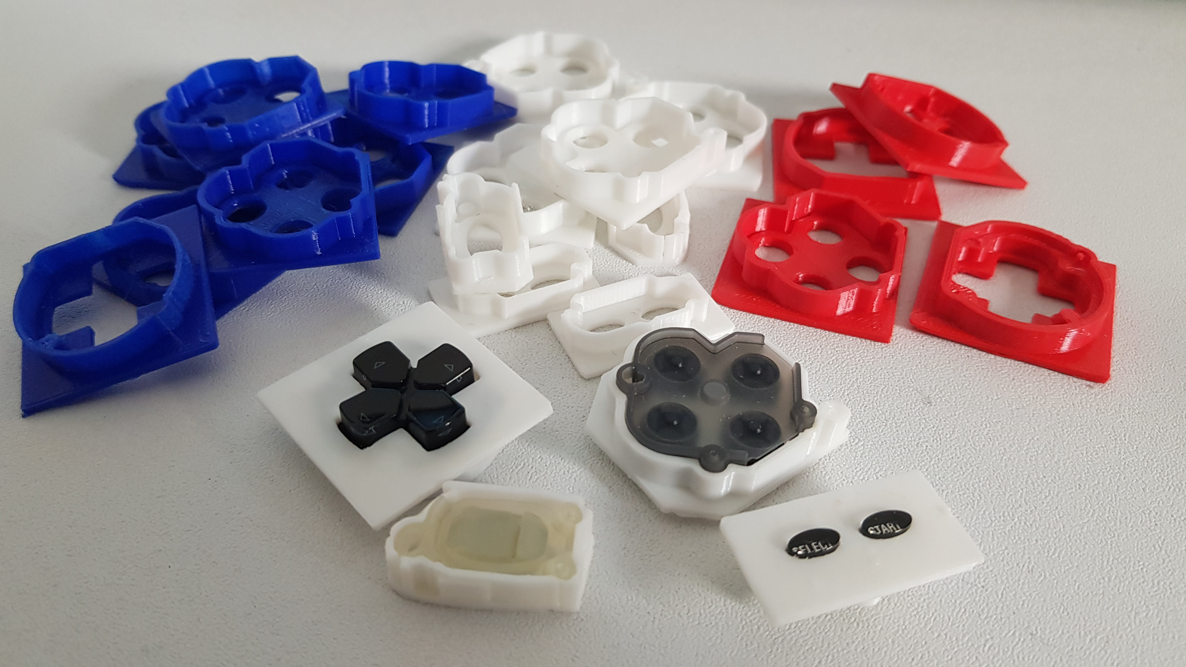

After some test print, I'm back with this :
The print of the night ... (I hate my bed, it is not flat, and I have tried to add a sheet of paper and here is the result :/ )
Fortunately the second try was the good !
I have chosen to keep the original color, because I don't want it black or white, and I think with white or black buttons/joystick it can look nice.
So I sanded the print, and then I applied two coats of varnish :
This time I only had a few very minimal adjustments to make that didn't require printing another version.

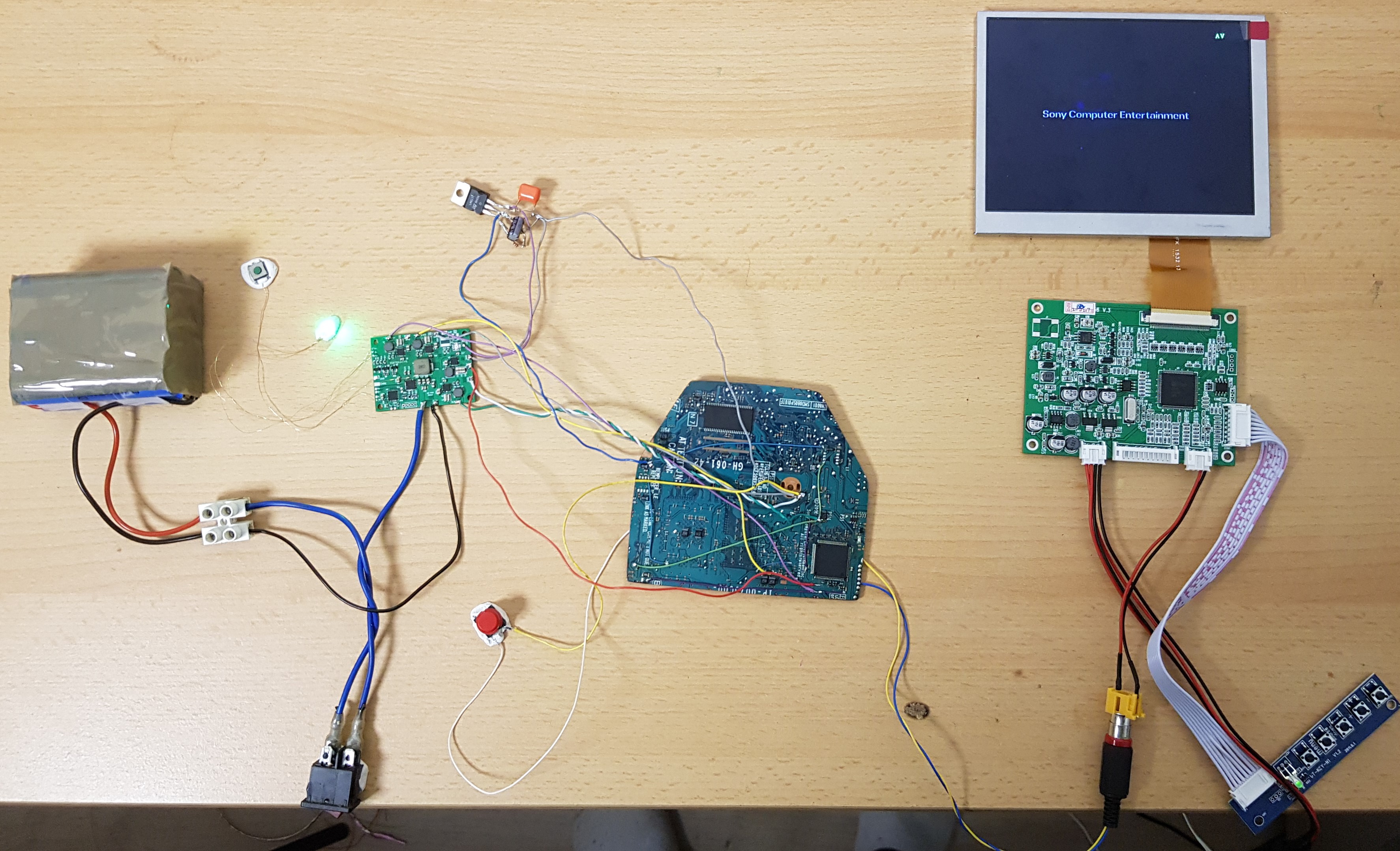

Finalmente, aqui está o conjunto inferior final!

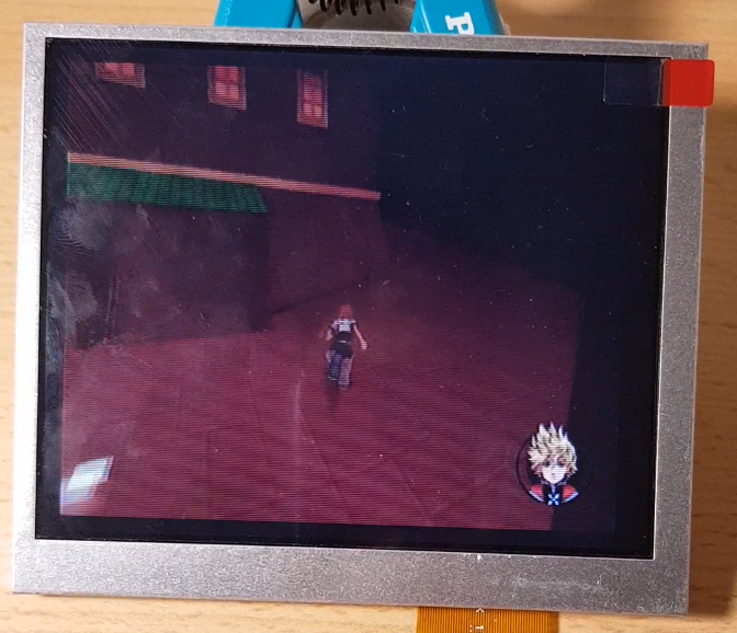

Aqui você pode ver o primeiro teste , e funciona bem!
De momento ainda não testei se o controlador funciona e se o cartão de memória foi detectado, assim como o USB.
Estou esperando meus PCBs ... Mas no momento estou muito feliz com este resultado!

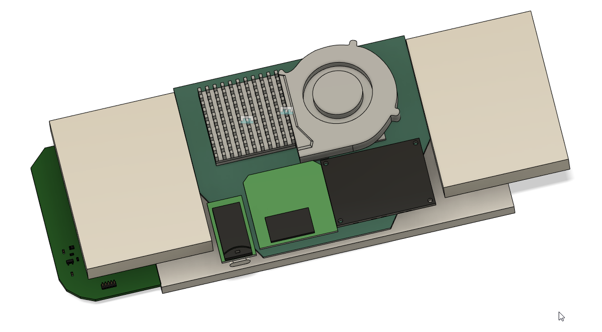

It is tomorrow and this is what the end result should look like :
I don't know how much is the thinnest ps2 but my goal is to make the thinnest !
*Yup I forgot the Power button (of the PMS) and the power indicator hole

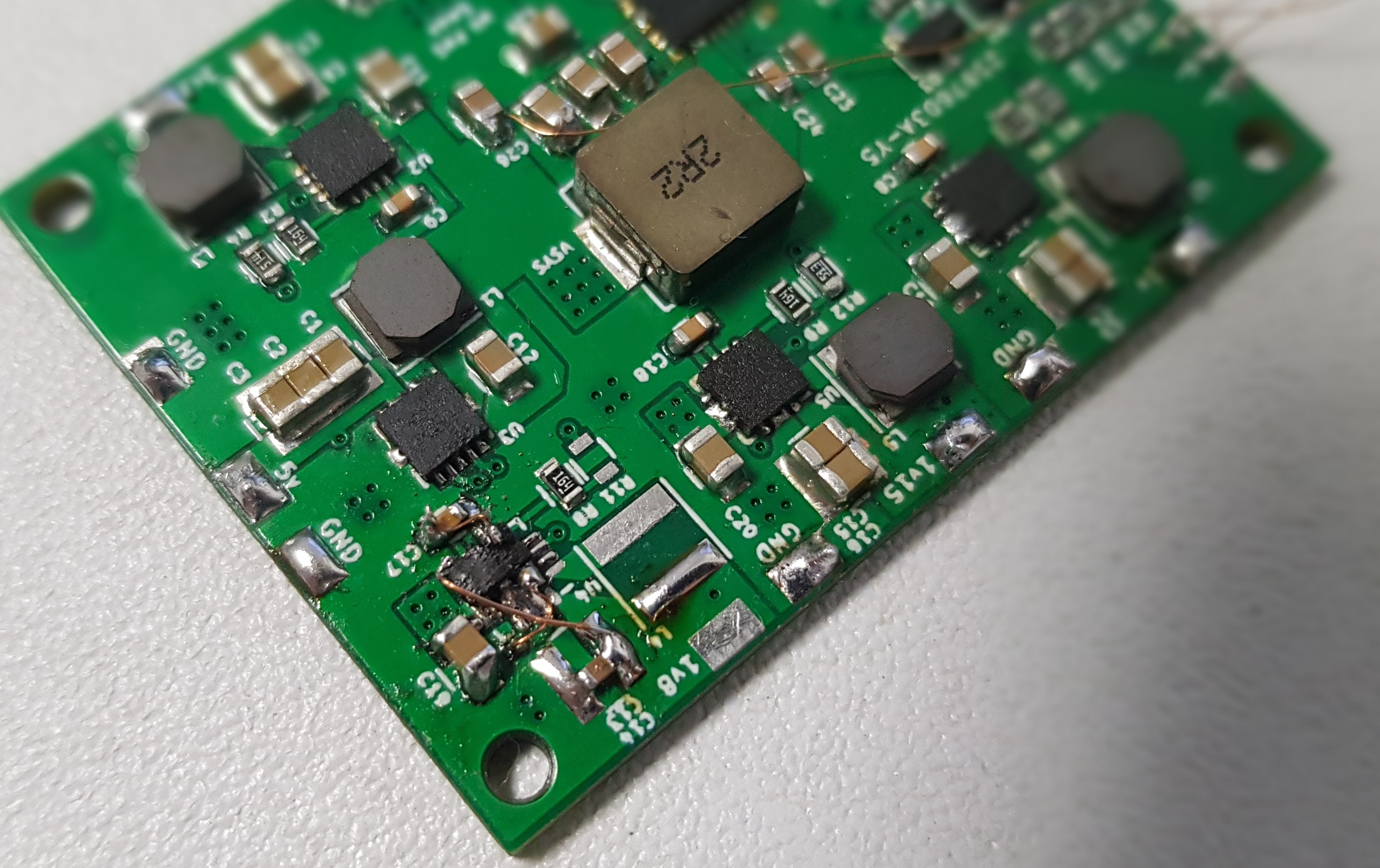

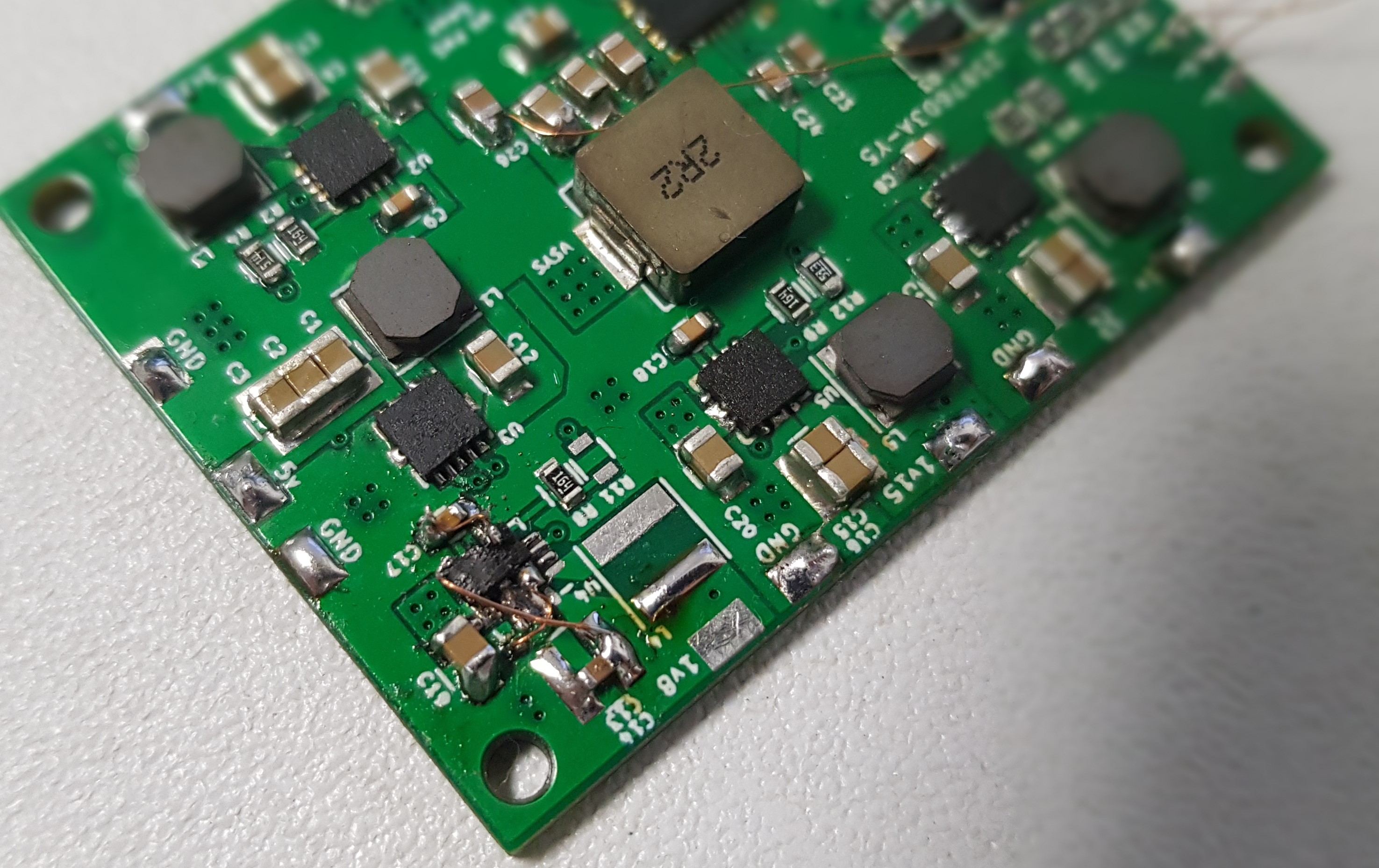

I saw a post they did with the regulators, PTH 0808, is this regulator good for the project? Can I use this regulator?

To answer your question, no the PTH08080 is too weak to supply enough voltage to the high draw lines. You need a PTR8060 for the 1.25v line. You could use PTH08080s for two of the remaining voltages, but 1.75v shoud be supplied by a linear regulator due to stability requirements. This is outlined in the PS2 Trimming Guide.

Sorry friend, I'm new here, I just signed up, I got it, thanks for answering me, it's a shame they don't sell the pms board ready with the regulators anymore.
An improved version of the PS2 PMS is/was being worked on. I don't know what the status on that project is, but if and when it releases it will probably be available from 4layertech
