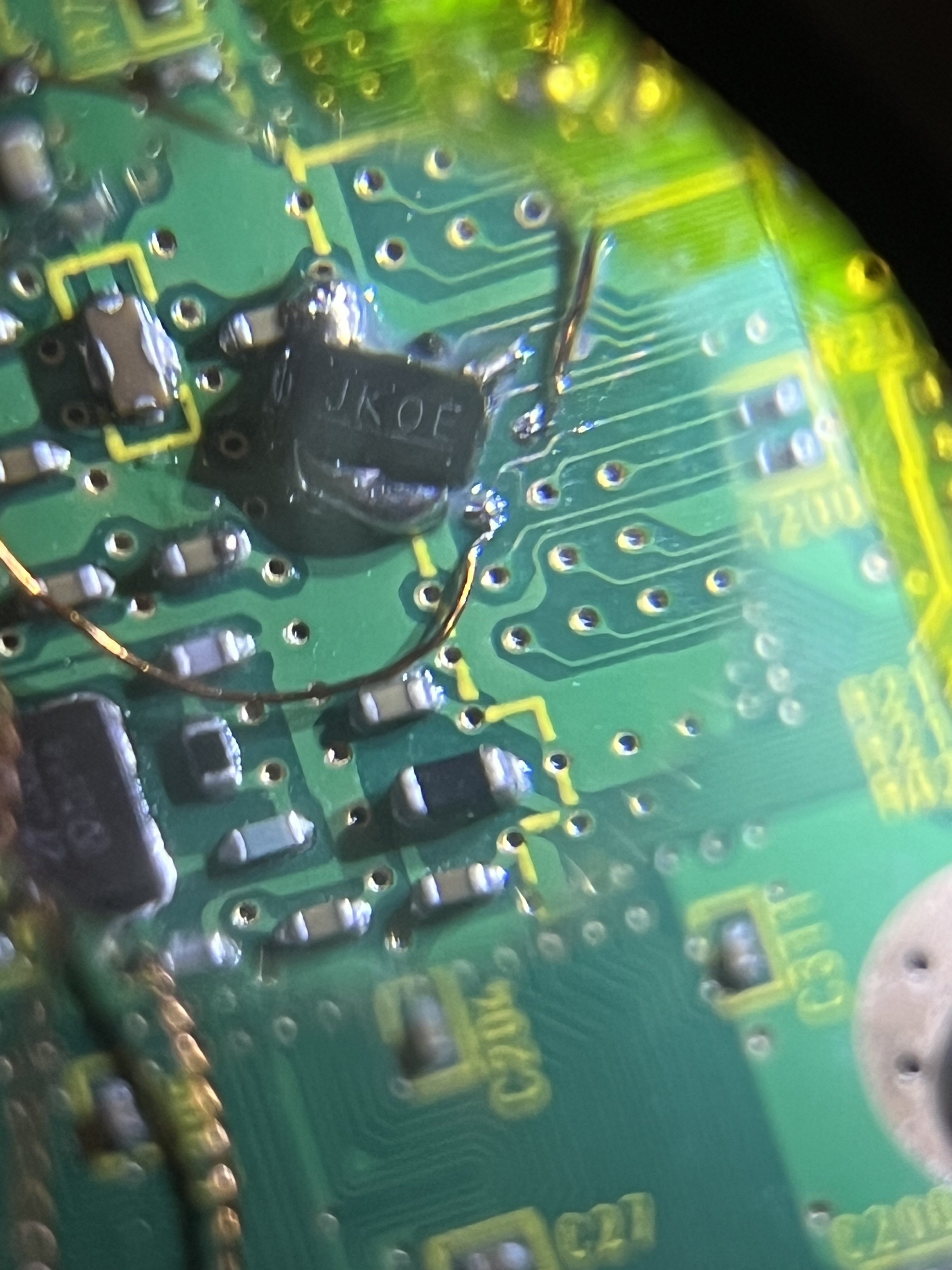

The other issue I was having was unreliable boots... as in sometimes I would need to turn on and off the console 2 or 3 times before it would finally boot. I learned that apparently the size of the U10 cable matters a lot and that the U10 emulation on the PMS is not really ideal to use compared to the actual chip... Thing is, I didn't install mine thinking I was going to be using the PMS anyway... and I didn't want to take the whole thing apart in order to flip the motherboard and install it... So... wireless U10 it is! I simply scrapped a bit of the solder mask off the board (for the ground legs) and sent it. So far, 100% boots!
Ok so, it seems like the SDW/SCW crashes are indeed a bug in RVLoader. Aurelio's been working on it, so we just need to be patient and wait for a new release.
I always enjoy seeing wireless U10
lol I'm so glad that everything is so conveniently in there, juuuuust in reach of the correct legs on the u10 ic. It's almost made on purpose lol. I was not aware this was a thing until a few days ago... I saw a picture and was like "wait, what?? is that cap 3v3 on that side, no way" I checked and sure enough, that side of the cap was 3v3 lol.
Anyway, this is going to be how I'm doing U10 from now on. My console had 100% boot rate since I did that.
Wireless u10 is definitely the way. But you have to run CK and DI first if you are using the DD as wireless u10 can cover those vias. I actually had to redo my wireless u10 to make room.
Yeah I was careful to leave "plenty" of space for them. In the picture they look a bit sketchy, but I did clean them up afterwards.
