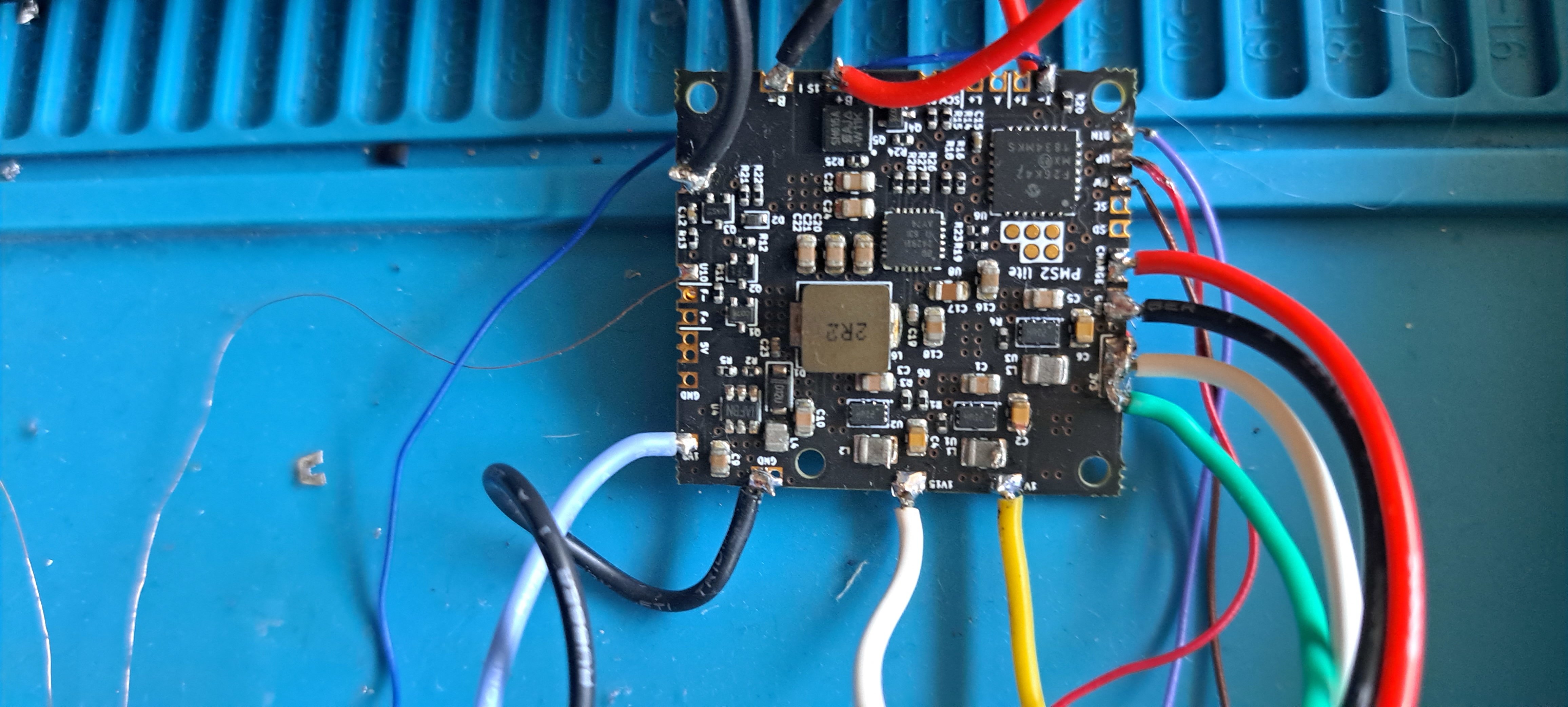

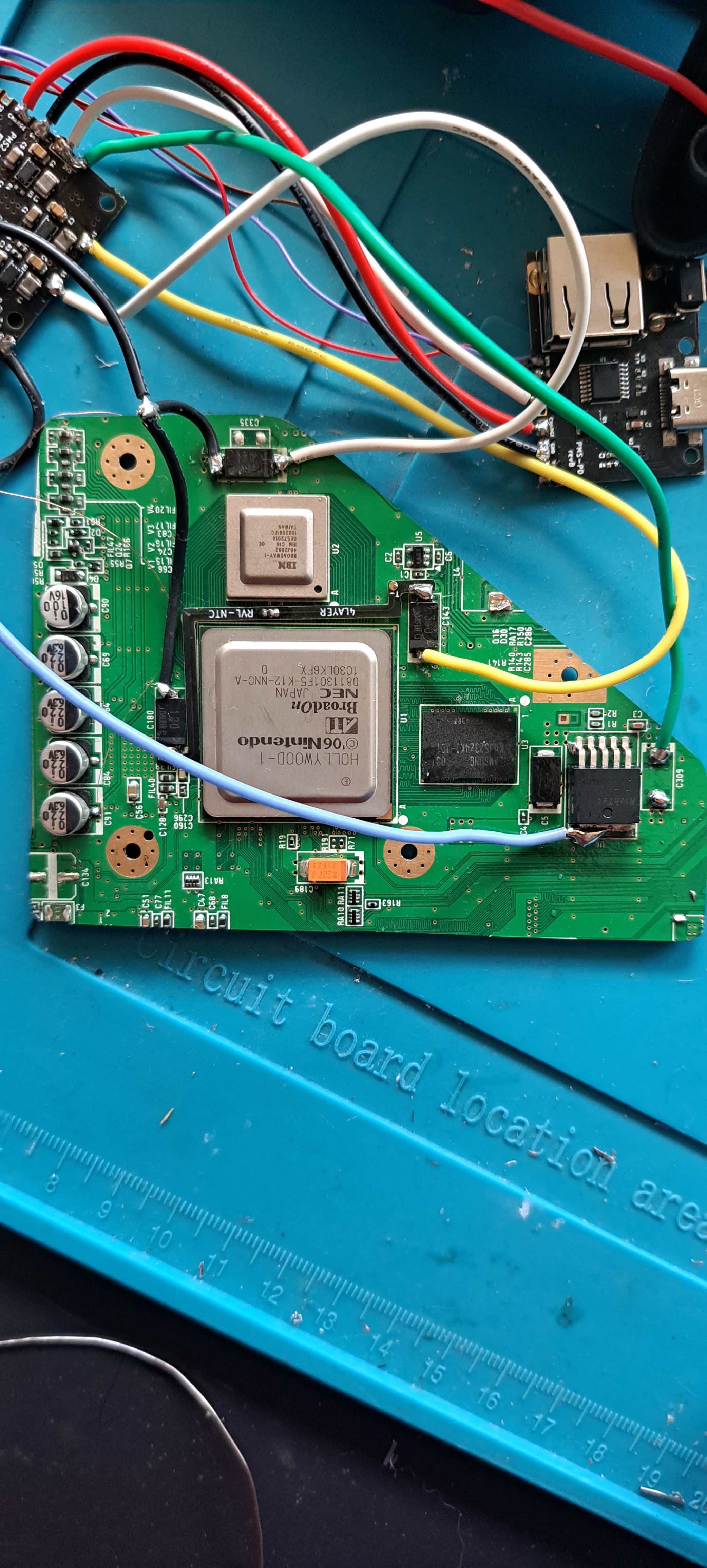

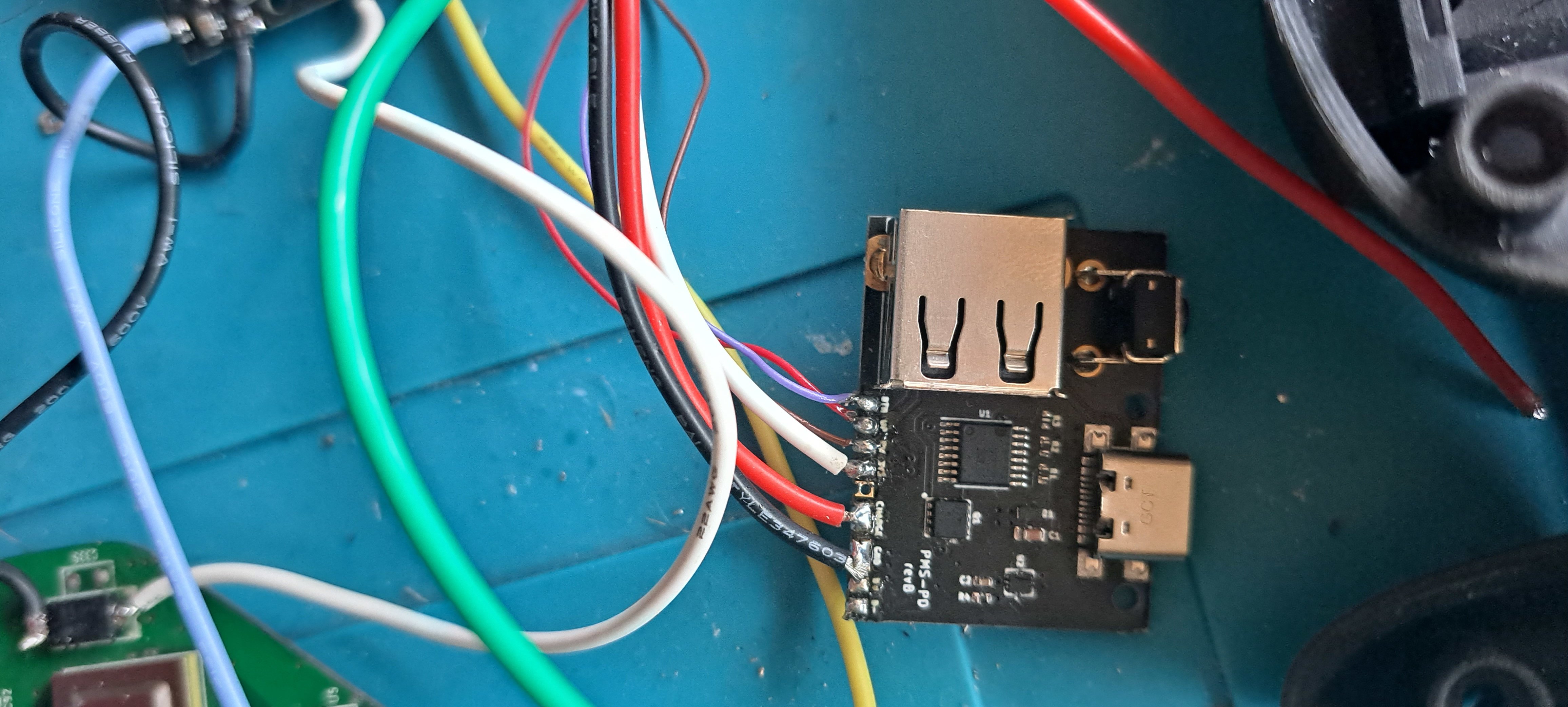

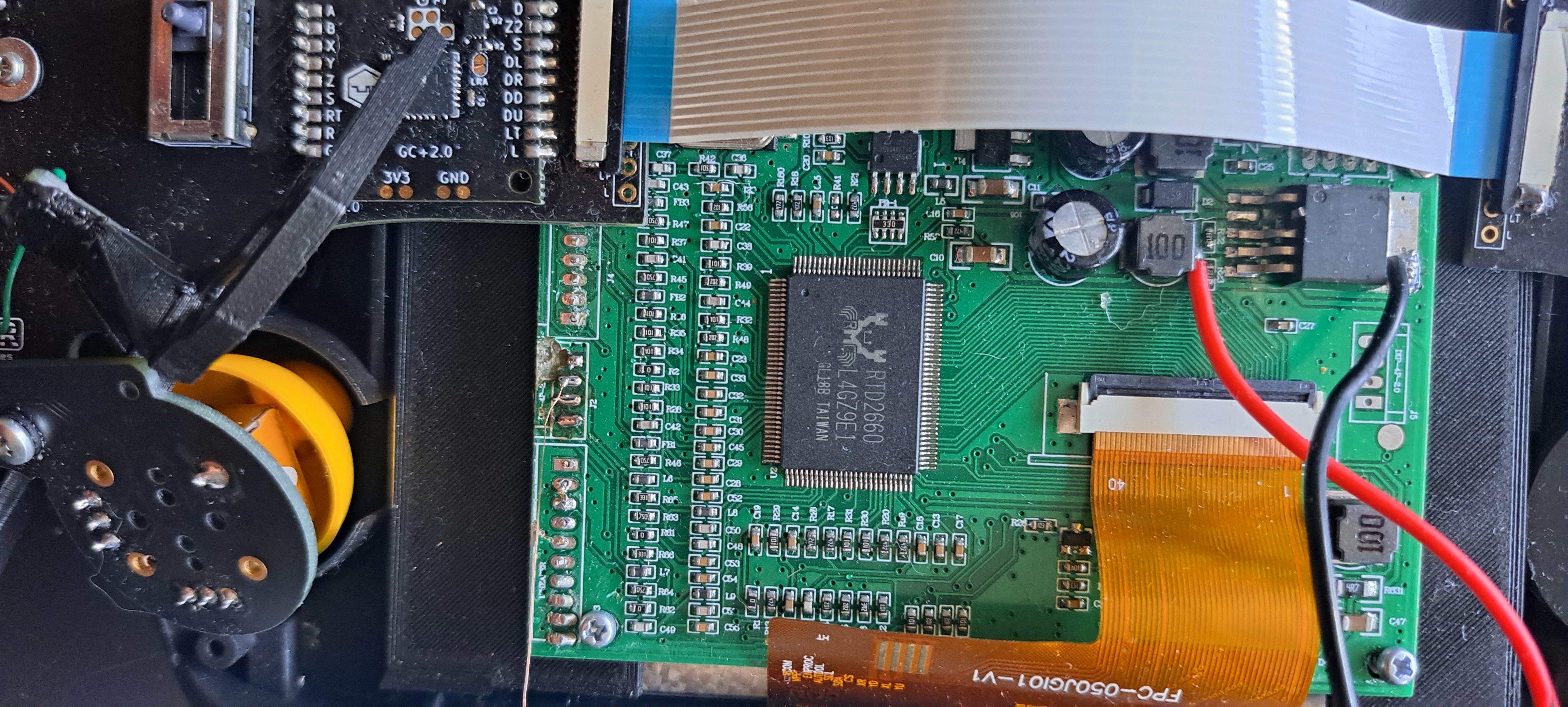

So I am unsure of whats wrong now. After alot of troubleshooting I gave up on the board and trimmed a new wii except it had the exact same reaction as the previous wii. I cleaned the board and verified all my solder joints were fine but its still not working properly. Mind you I still can tell that this wii is booting as well from the cpu and gpu heating up. The only thing I can think of now is I may have missed a step by accident. These are all of the connections I made are any missing?
Driver board:
3.3v, gnd, av-cvbs1 (tried av-cvbs2 as well)
Pms Lite:
gnd, u10, 1.8v, 1v, 1.15v, 3.3v, btn, up, pw, charge
pms pd2:
btn, up, pw, 3.3v, charge, gnd
Wii:
3.3v, 1.8v, gnd, 1v, 1.15v, u10, composite, and rvl-ntc is attached
Here are pictures of the wiring in case that helps spot if I missed a connection
