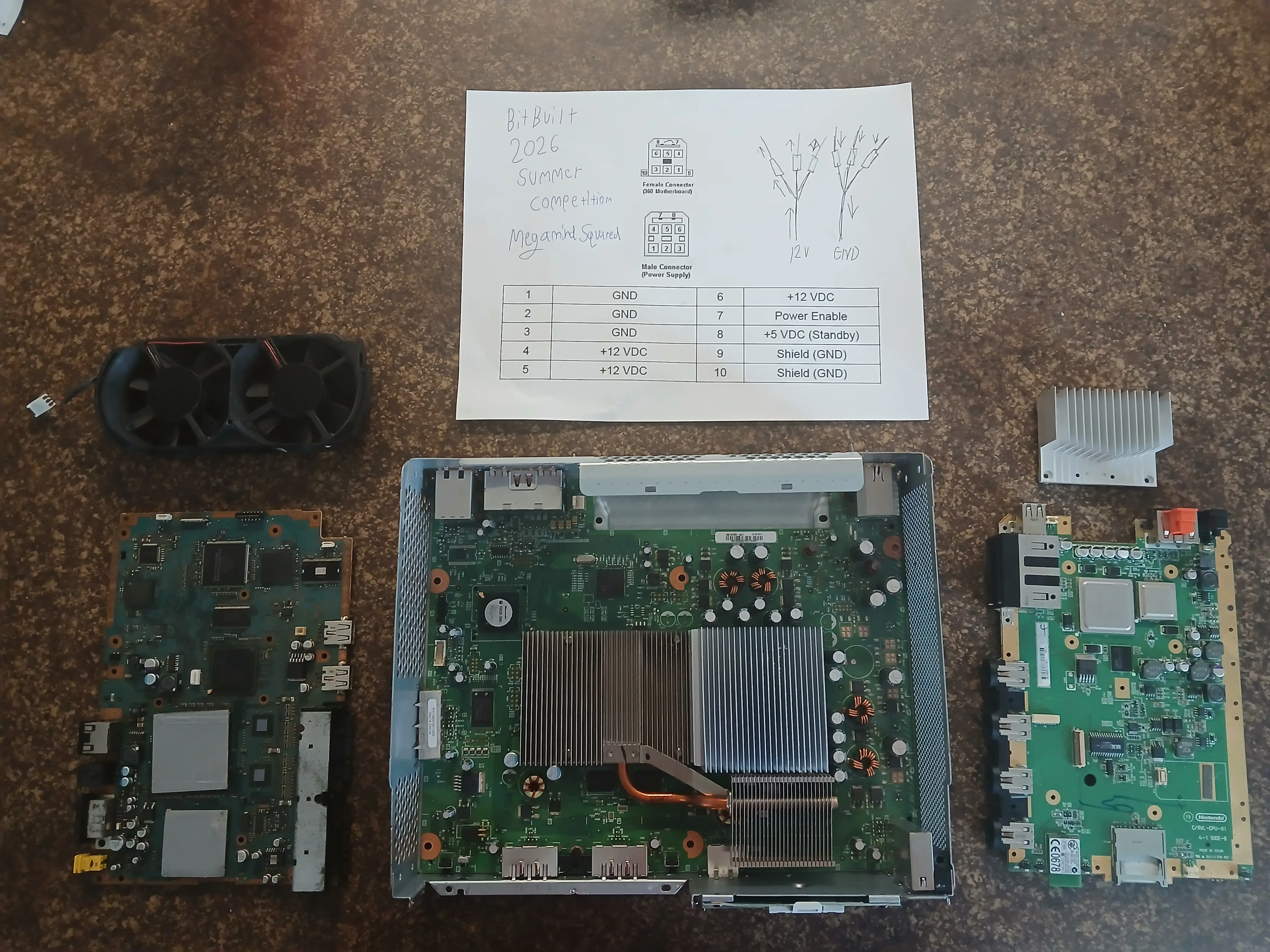

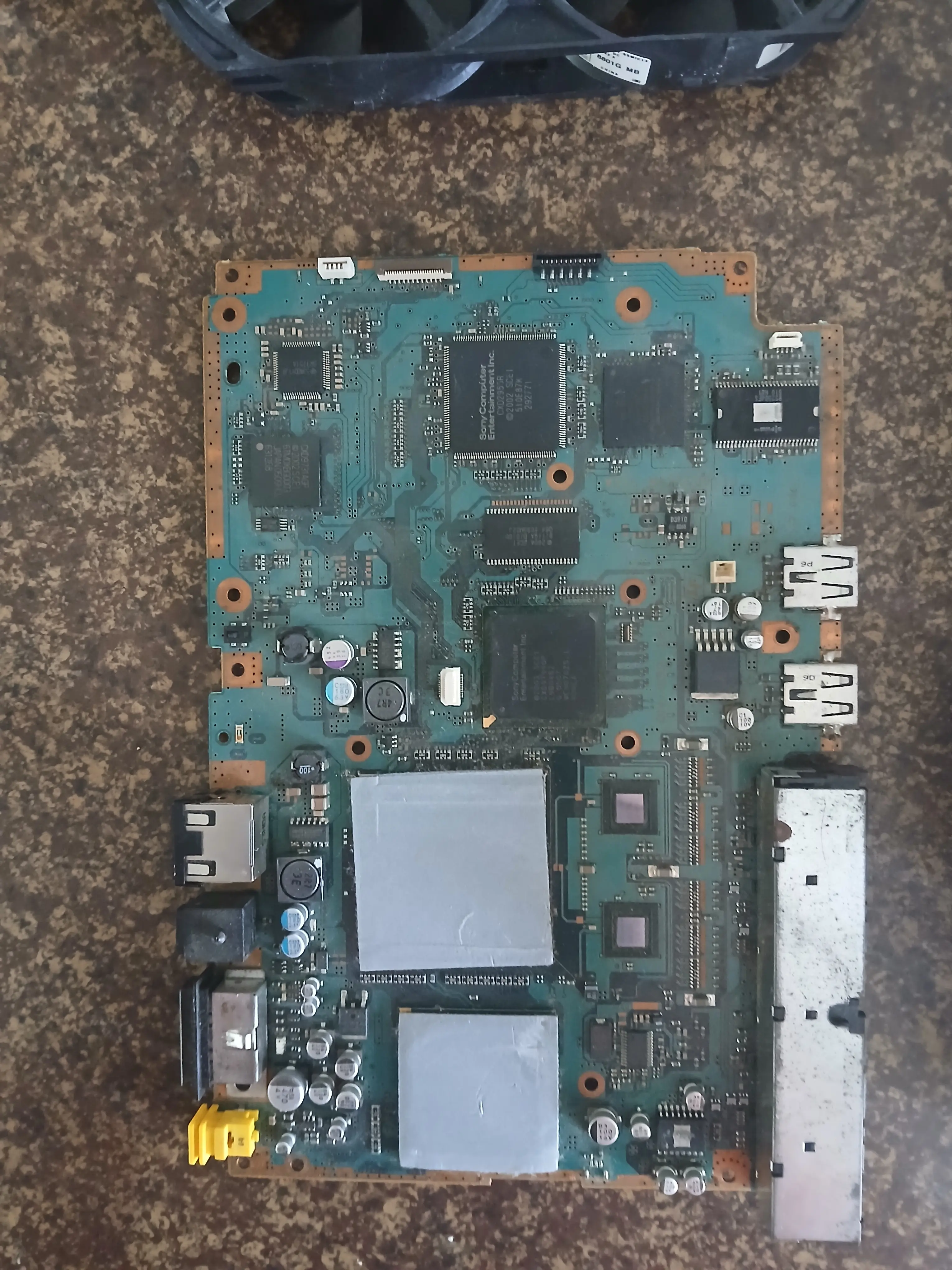

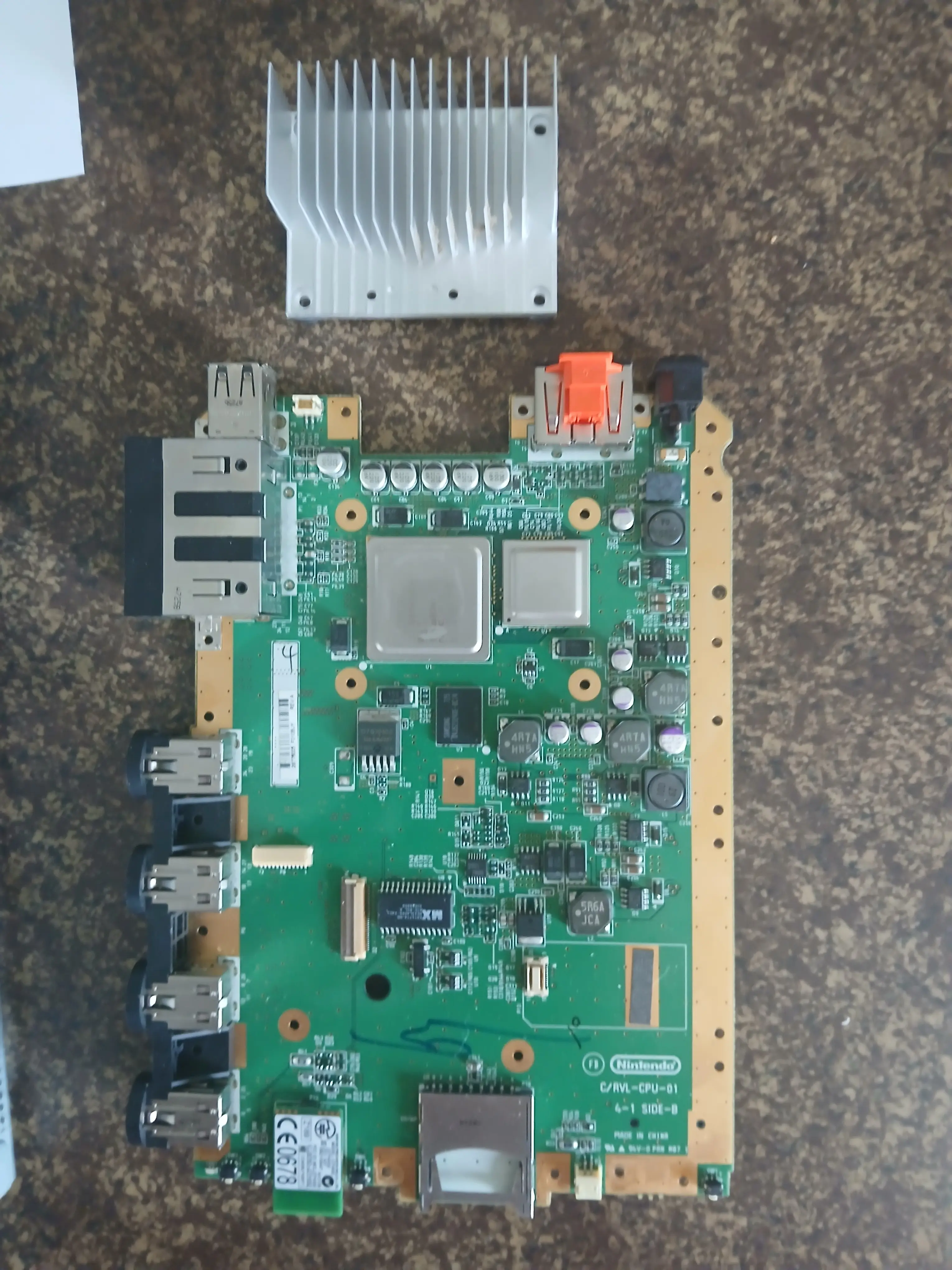

Well, the Trifecta is a mashup of a Wii, PS2 (Slim), & an Xbox 360 in an Xbox 360 shell.
^ Something like this, don't mind the scale.
Also, before anyone says anything, I am using a Later-Gen Falcon (post April 2008) so the Xbox 360 will stay alive (hopefully).
The essentials are as follows:
1. Externally there can only be one power plug (the Xbox 360 PSU plug).
2. All consoles must also output video via one plug (the Xbox 360 AV out).
3. All consoles must boot independently of one another.
4. All consoles must be able to play games and be able to connect controllers.
5. None of the consoles can overheat or have thermal issues (that's gonna be tough).
Here are my stretch goals:
1. Have all of them be able to output via HDMI (custom boards or internal adapters).
2. Have some sort of integrated controller for console/mode selection (rather then the external switches I'm currently planning on).
3. Spend under 20 dollars on additional components or parts for the build (excluding the use of my 3D printer, the consoles, and basic soldering supplies or components I already have ;)).

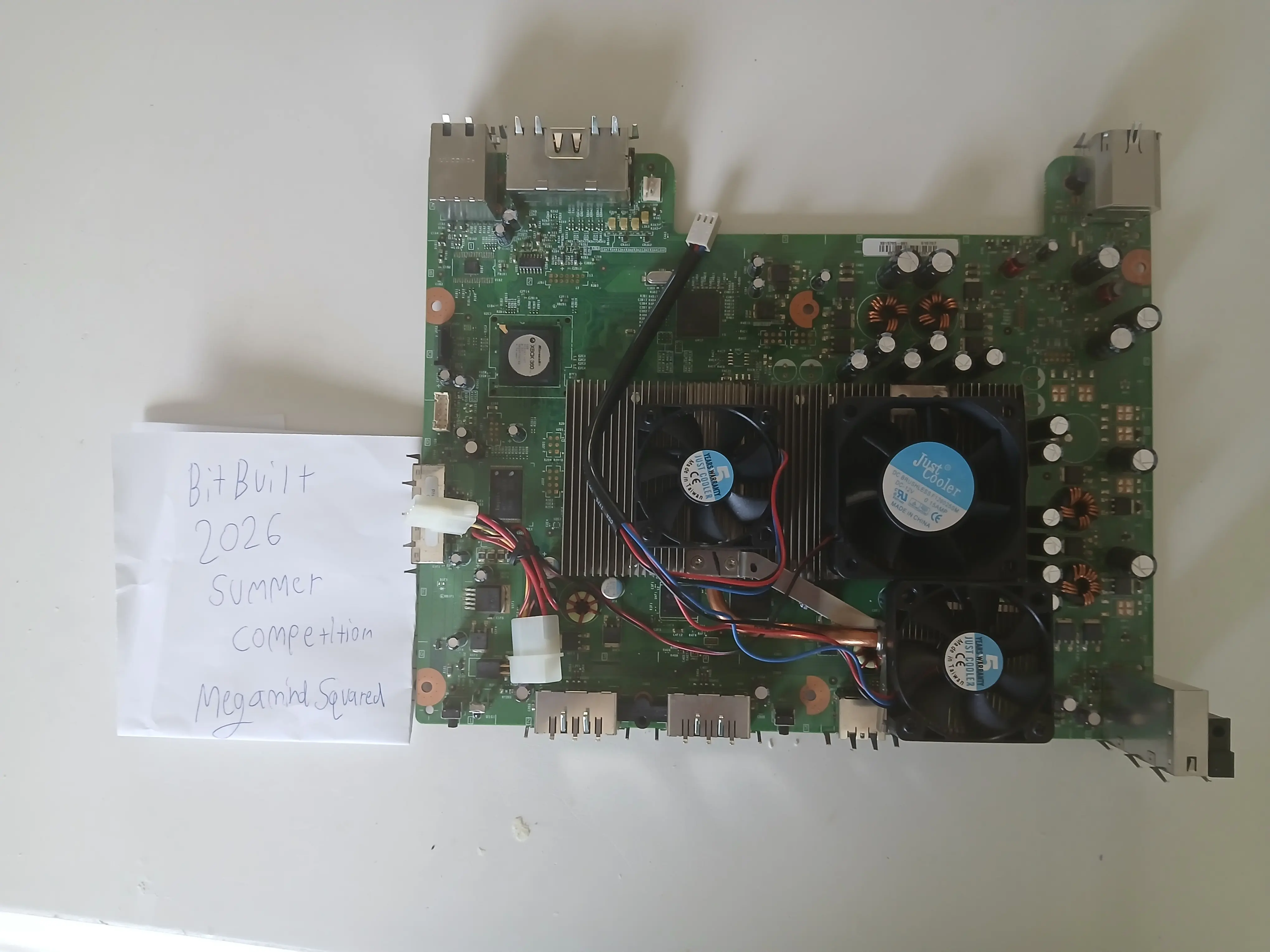

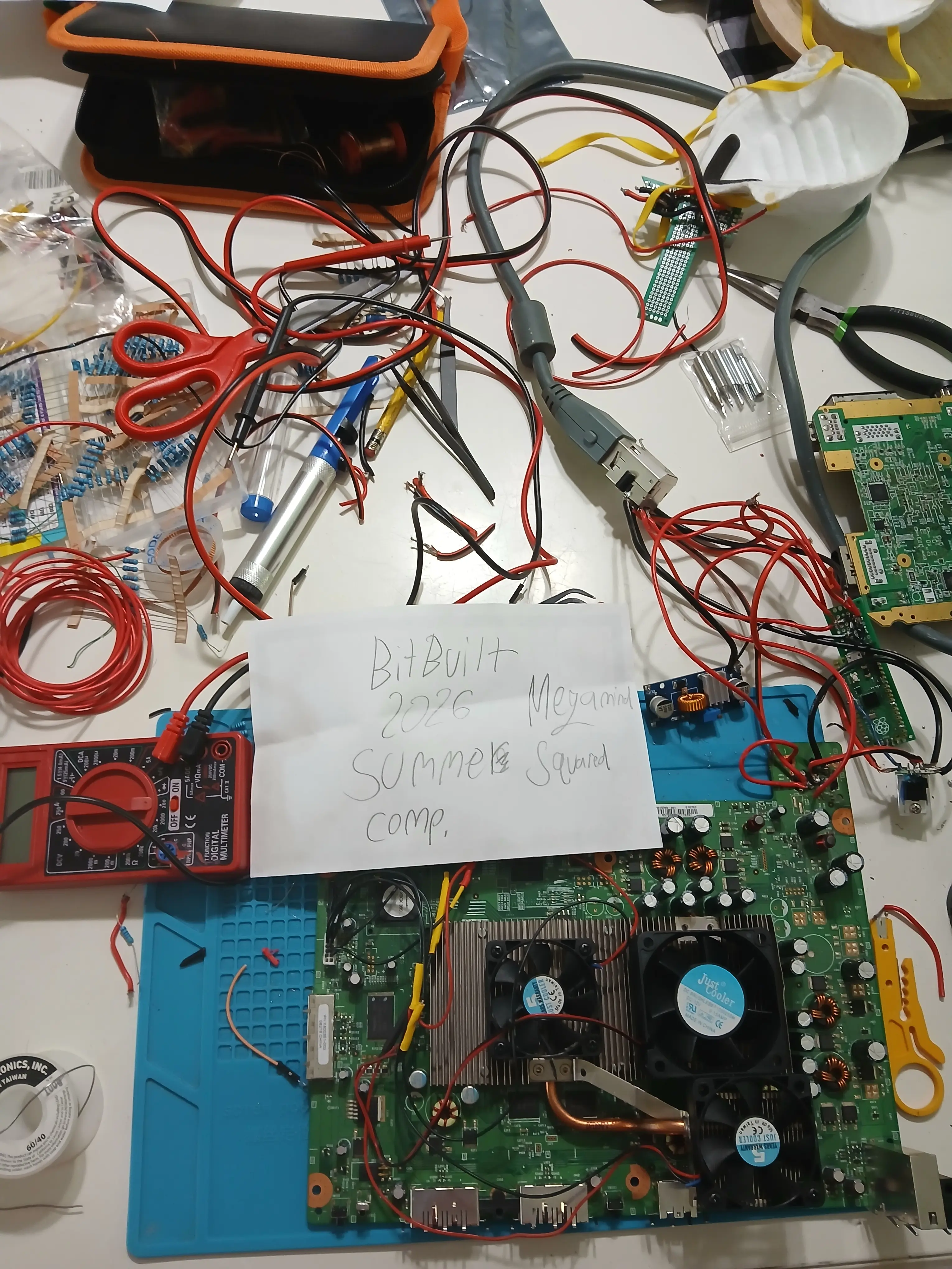

Here's some pictures of what I've got going so far:
I'll post an update in a couple of days, so keep an eye out.

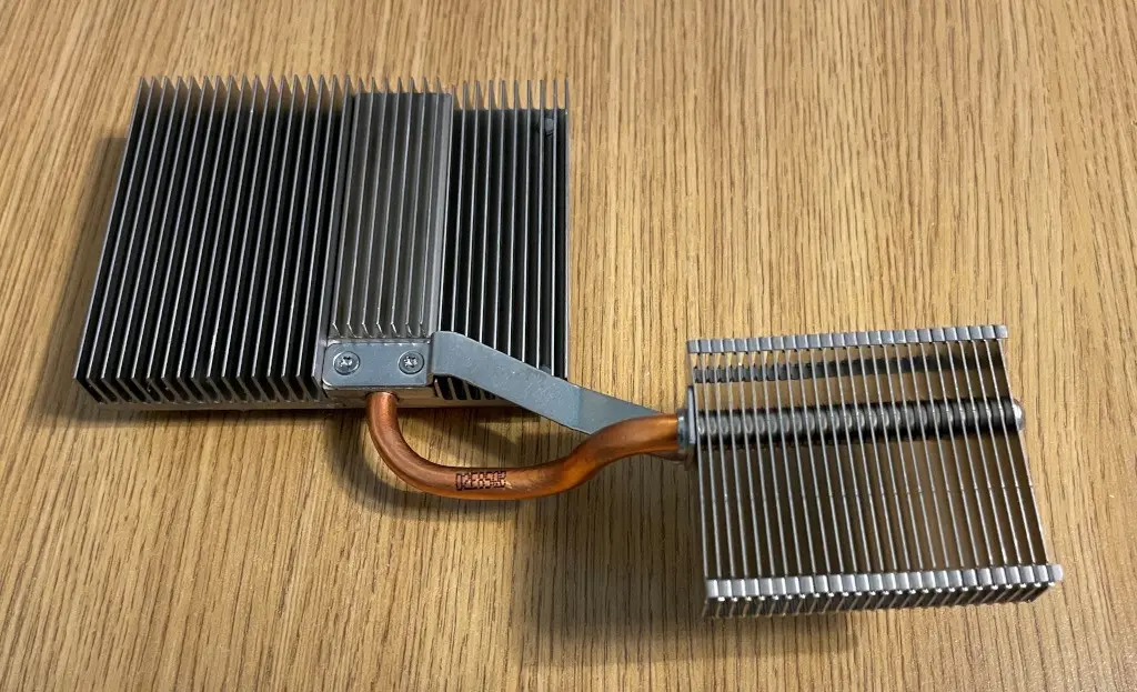

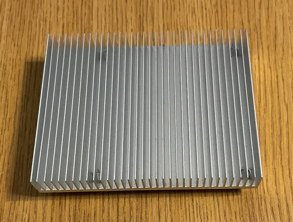

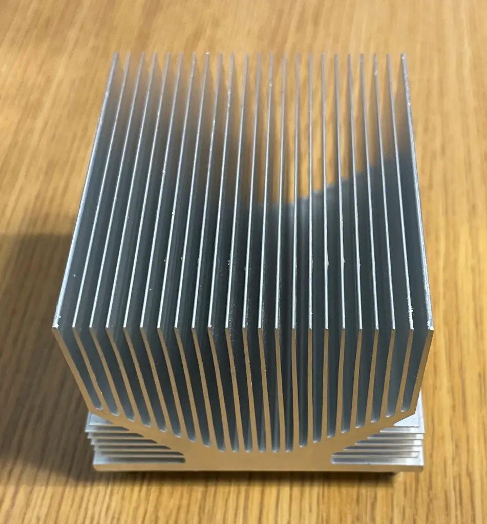

Ok, so after a lot of debate the first thing I decided I would tackle is trying to figure out Xbox 360 thermals while creating more space for the Wii & PS2 Slim. The most obvious choice to make more space would be to remove the fans and the heatsinks from both the CPU and GPU, but that's not possible unless you want instant overheating.

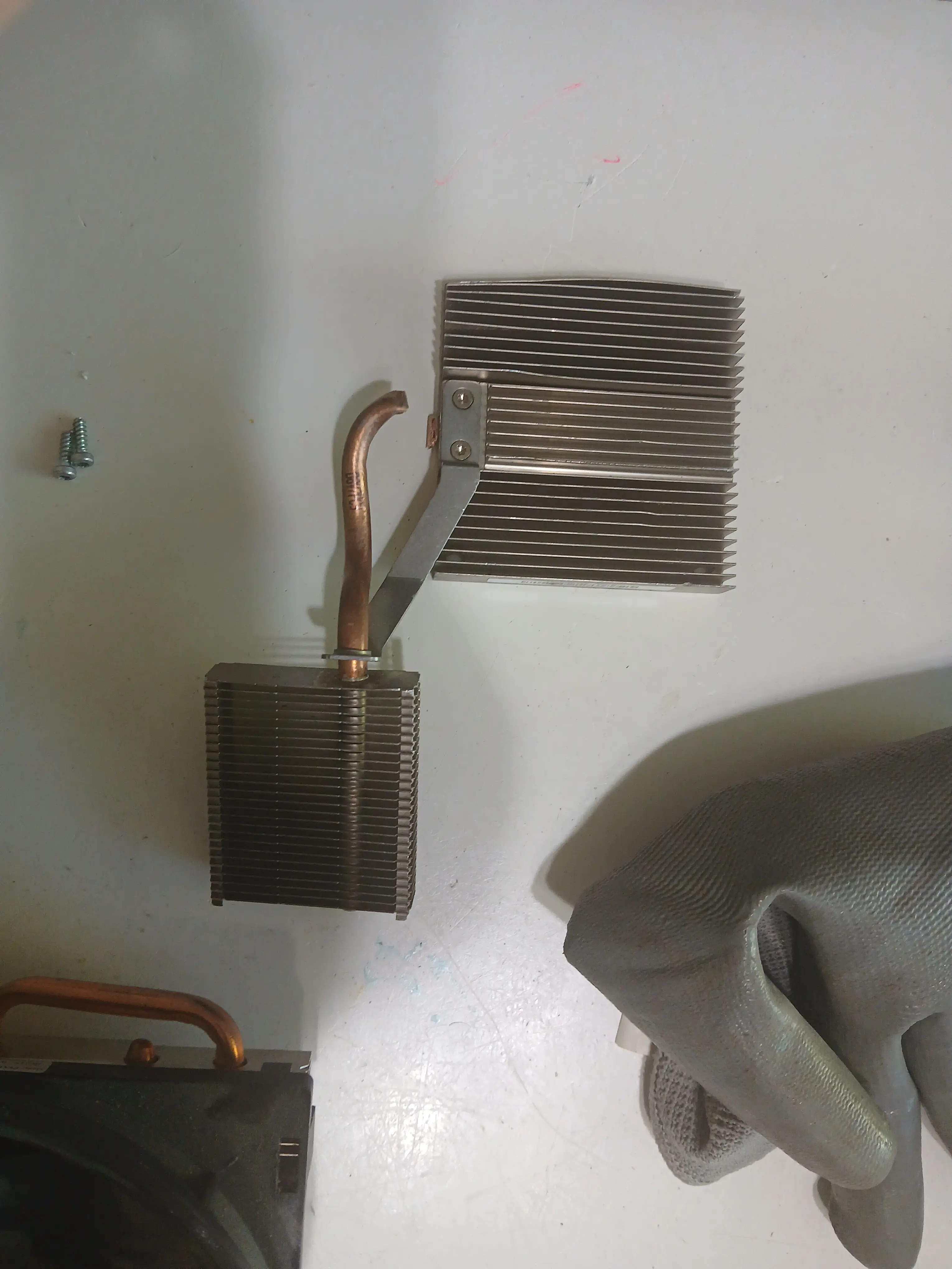

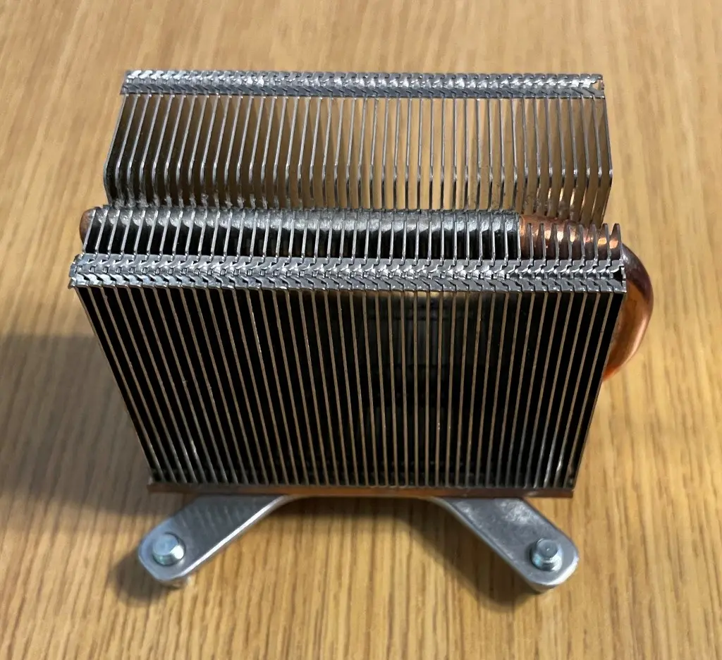

Here's the thing though, the CPU heatsink is massive compared to the GPU heatsink. There are two different CPU and GPU heatsink styles, both either have a aluminum heatsink with a copper slug/heat pipe or they are just plain aluminum.
Here are some examples:
CPU Heatsink + Copper Image Credit: (Xenon Library)
CPU Heatsink Image Credit: (Xenon Library)
GPU Heatsink + Copper Image Credit: (Xenon Library)
GPU Heatsink Image Credit: (Xenon Library)

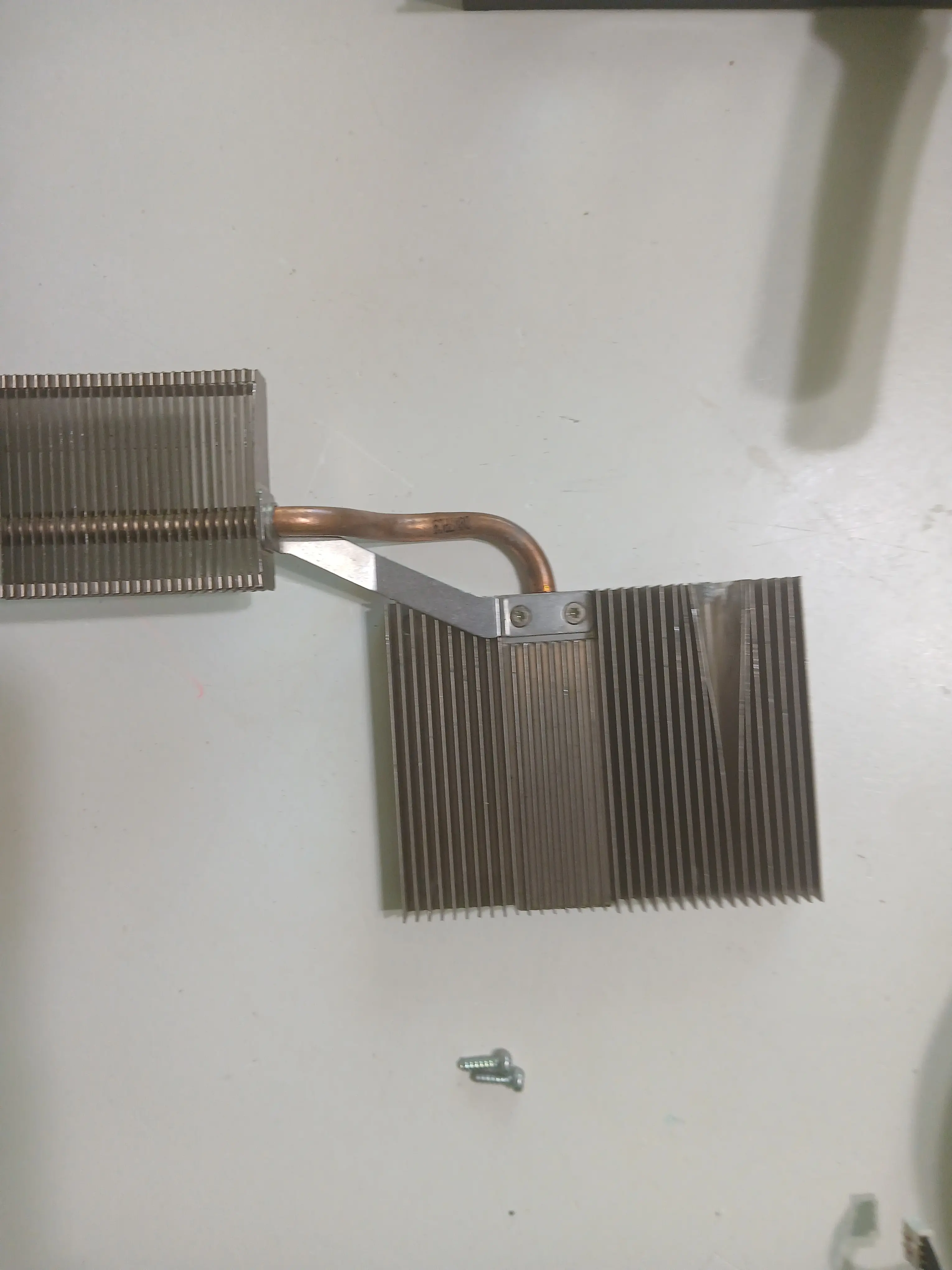

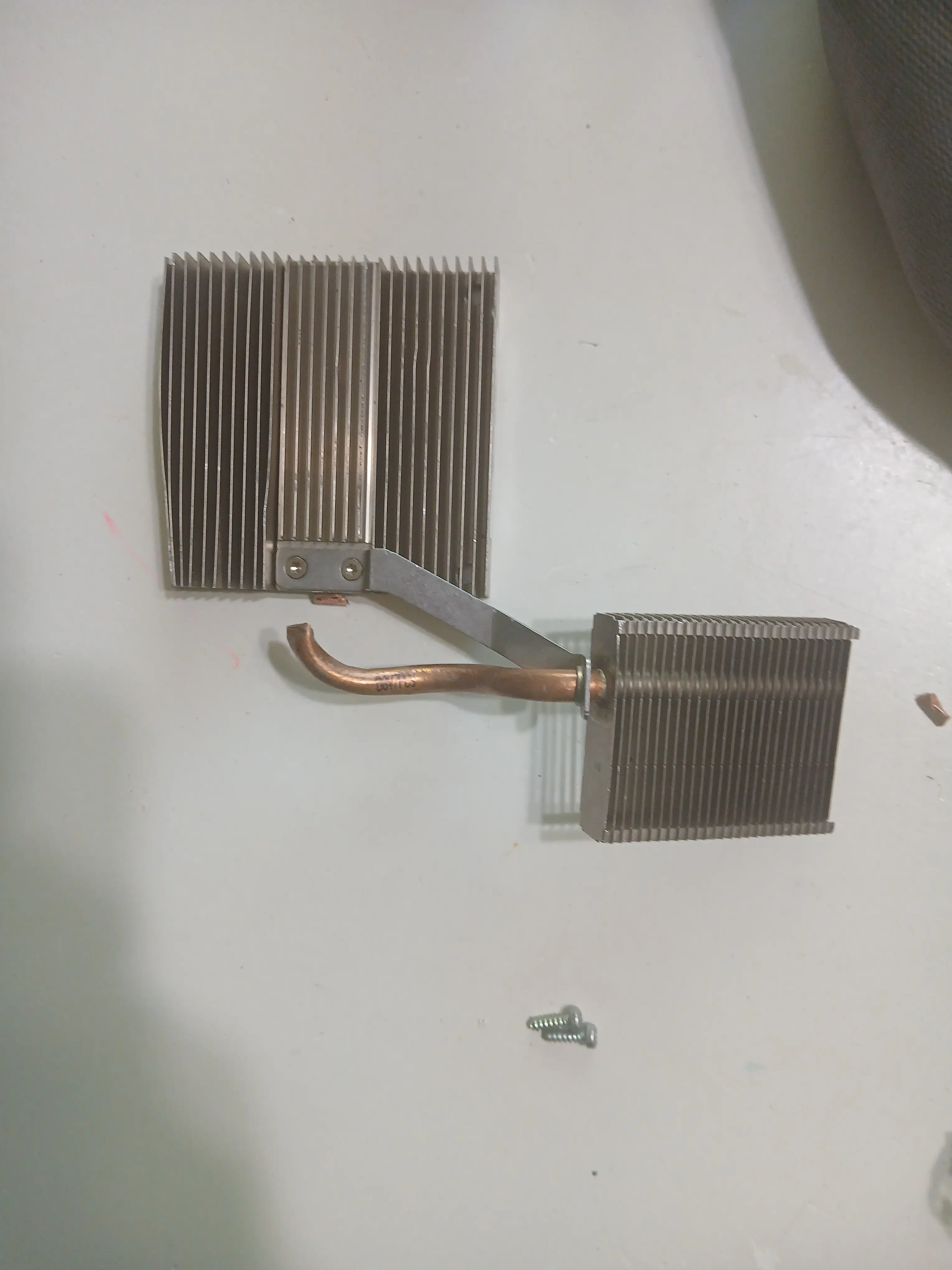

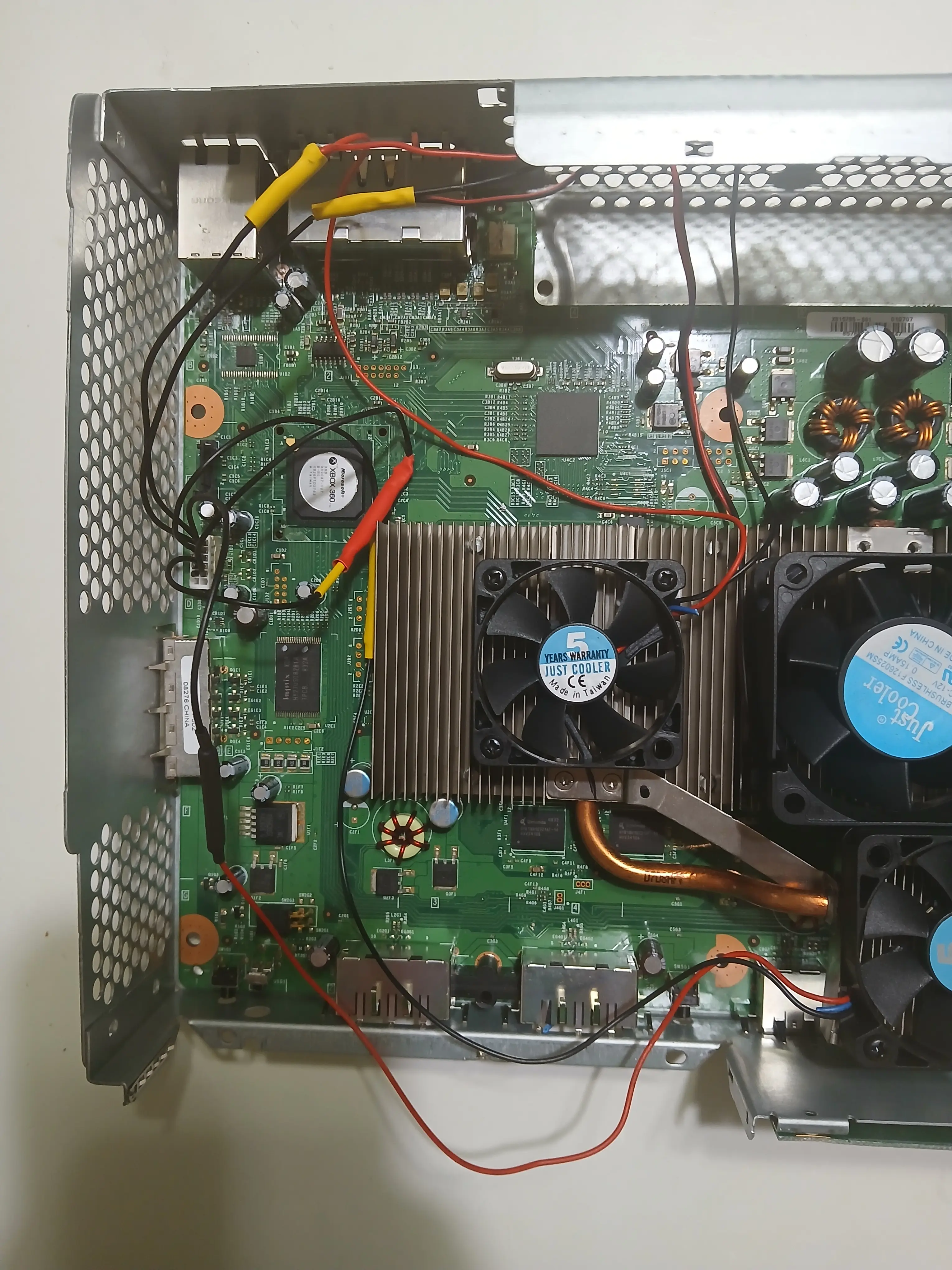

Now, in a perfect world you could just take a GPU heatsink from a donor board put it on the CPU, and everything would be great, right? Sadly, you can't just do that because the power rail has some tall capacitors located at the right of the CPU, and these are so close that they prohibit putting the long GPU heatsink on the CPU. So, what do you do? You take the GPU heatsink, and trim it down into a square the size of the CPU heatsink base. >:D

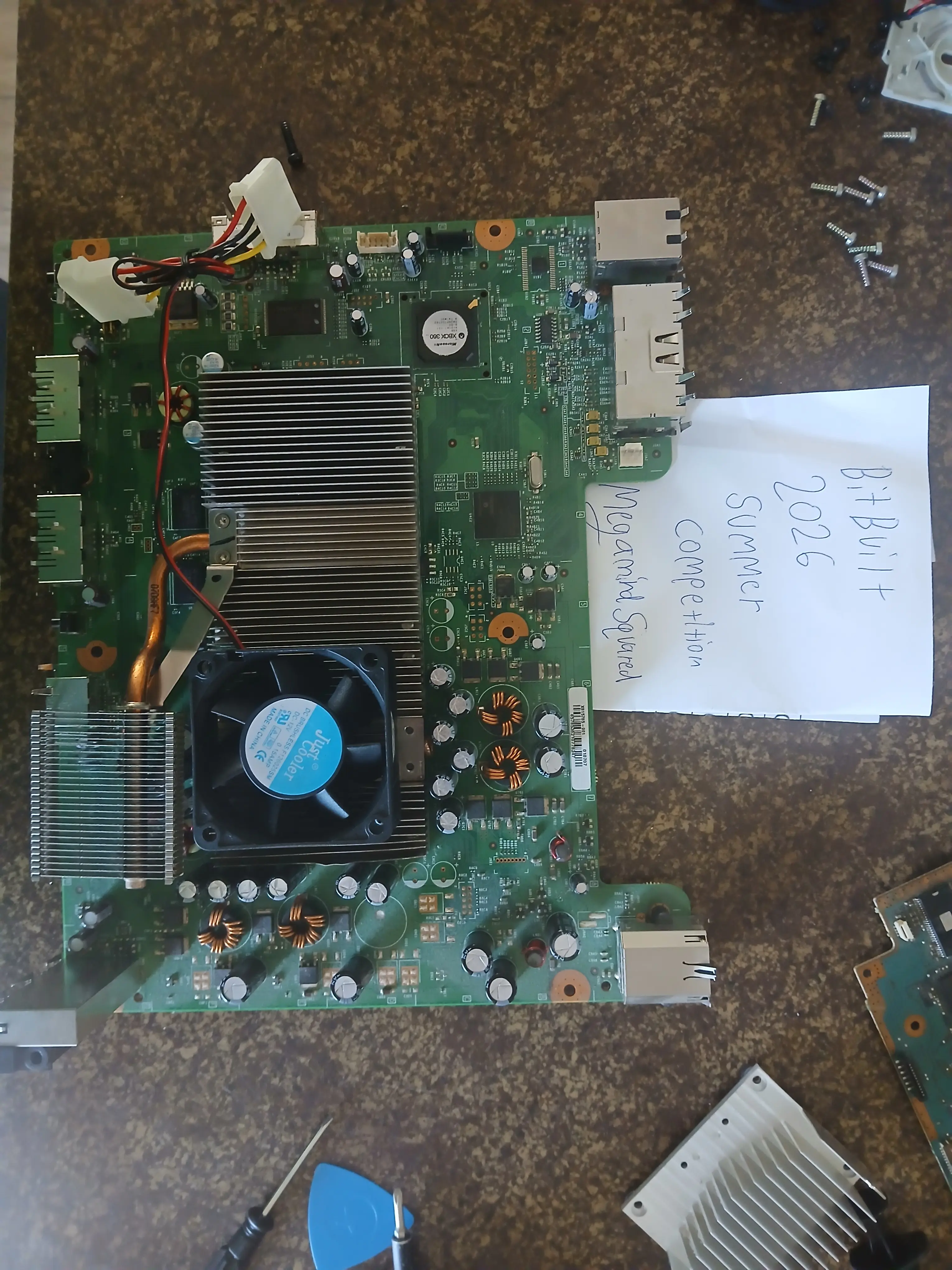

Here was my donor GPU heatsink as it sat:
As you can see, I bent the fins to make the line where I wanted to cut the aluminum to fit it to the proper size. Then with a little work, it was trimmed!
I then cut off the heat pipe to make some more room in the case, and besides we won't be needing it anyway. :)

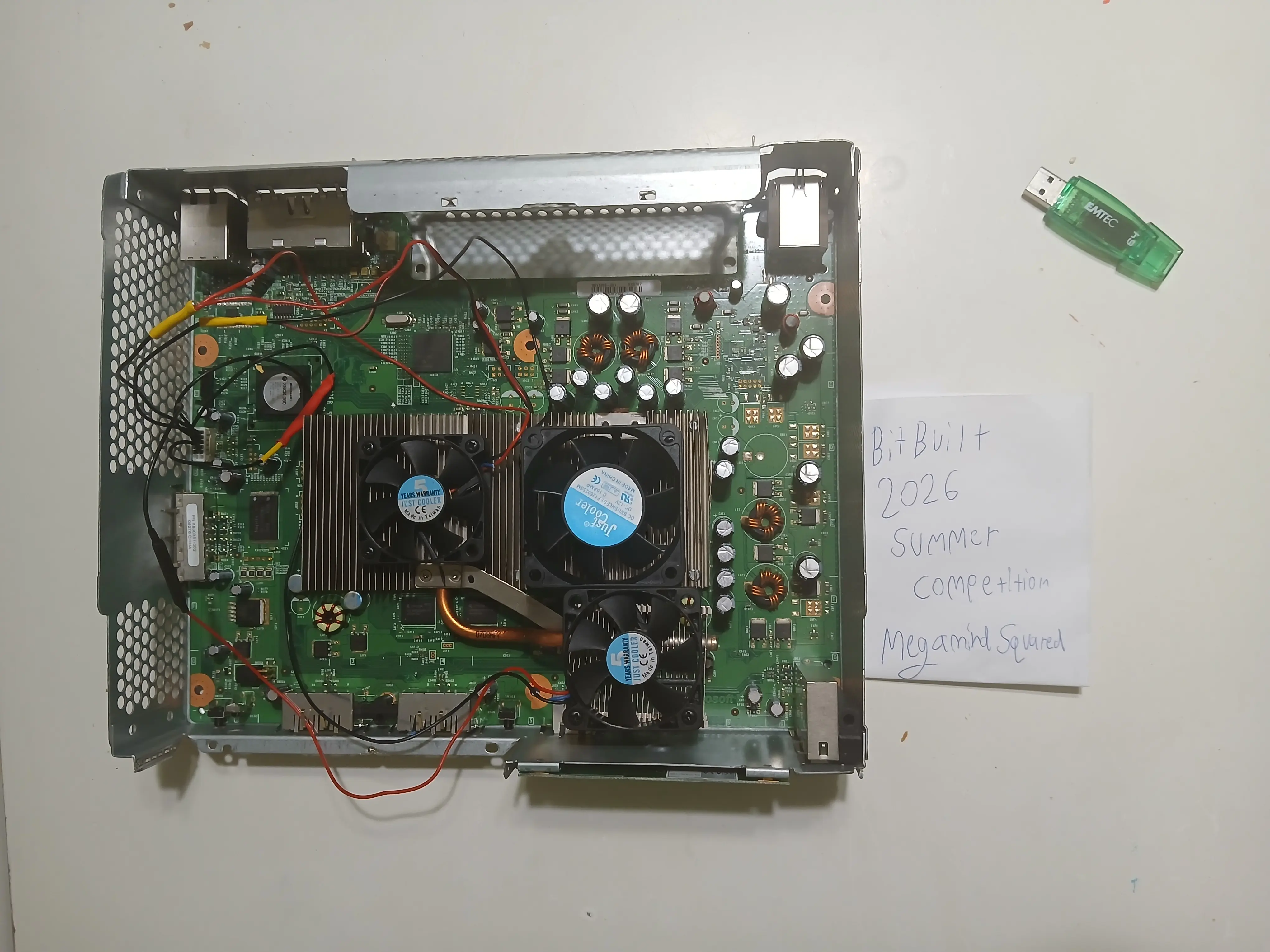

With the heat pipe removed, I mounted the new heatsink on with some brand new thermal paste, and we were ready to rumble. Since the stock fans were out, I then went through my pile of parts and pulled out a old computer fan, and this mounted right on the heatsink almost perfectly.

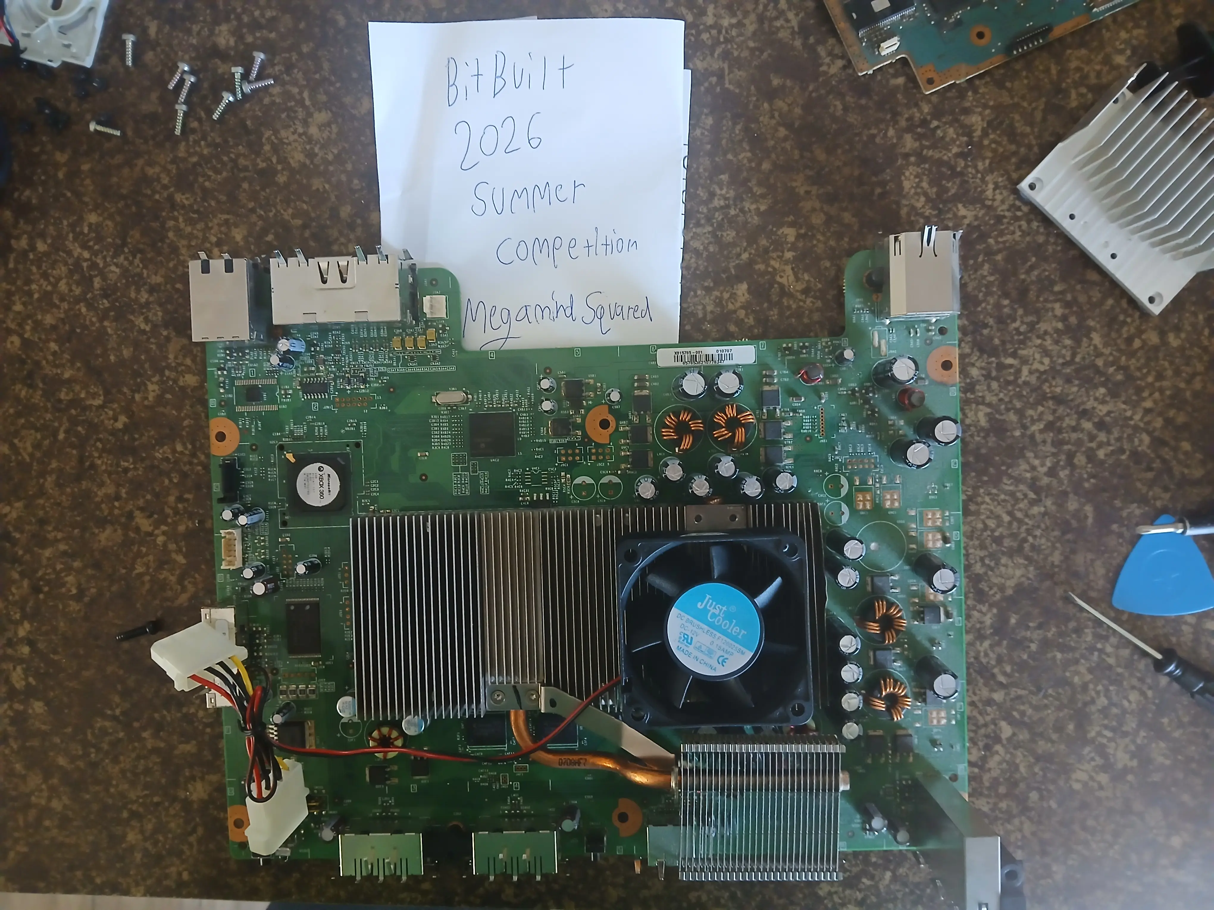

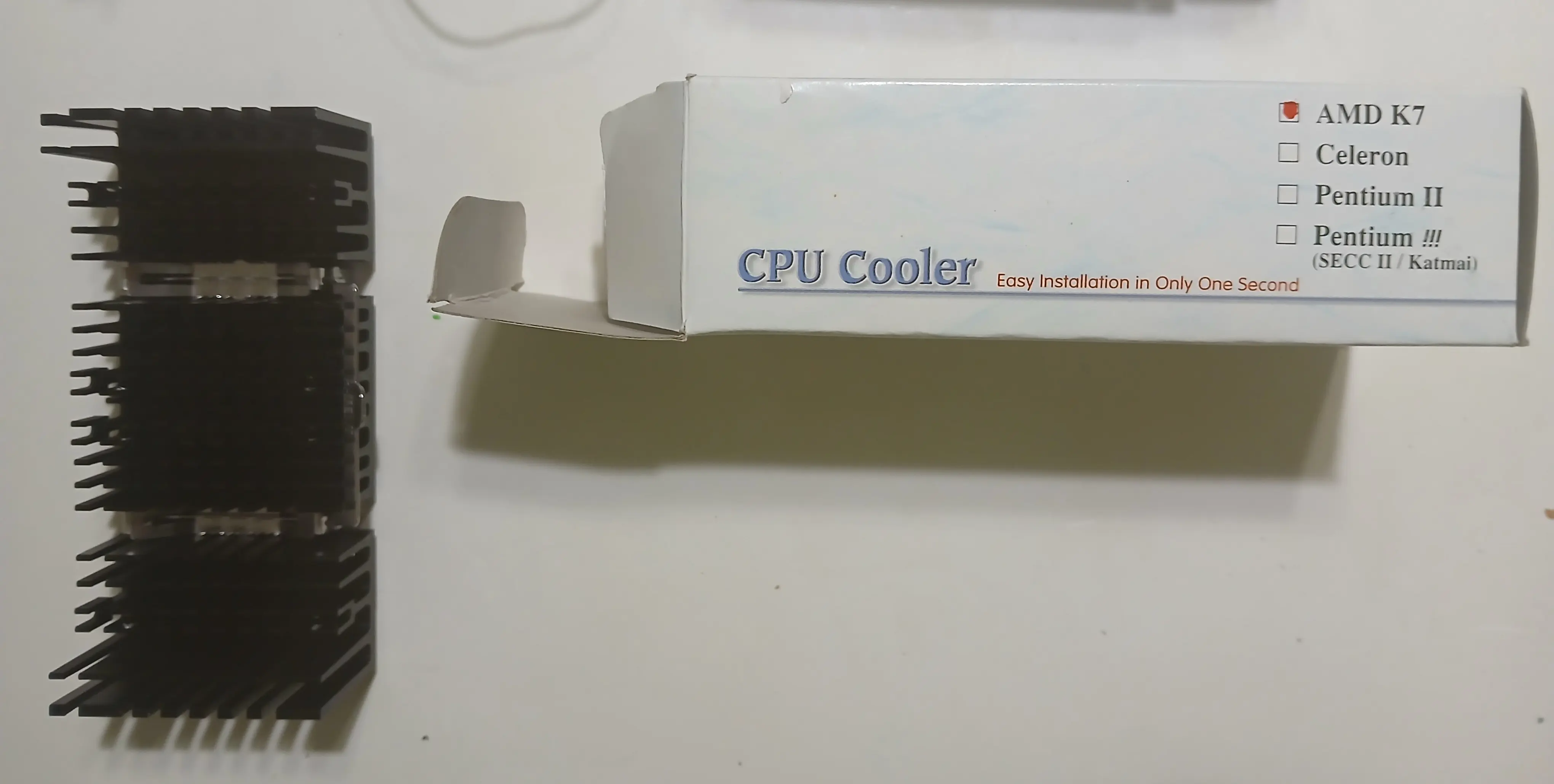

Then I went and took an old replacement AMD K7 heatsink with two small fans mounted on it. I removed those fans and mounted them to both the main GPU heatsink and the secondary GPU heatsink.
^ Here it is (with the two fans removed).
Here's the Xbox 360 with all the fans installed.
Then I needed a place to get 12 V for the fans from, I could have pulled it from the fan header, but that's not any fun. I had to modify the cable for the disc drive anyway (to make the Xbox 360 think the disc drive was there). Luckily, there are two 12 v pins on the disc drive header.
Image Credits: (Console Mods Wiki)
So I did some soldering and wired up the three fans to the 2 12 v sources and GND.
Cable management will come later.
I then went and tested the Xbox 360, and it didn't explode, in fact it seemed to run really well, also the fans were quieter than I expected.

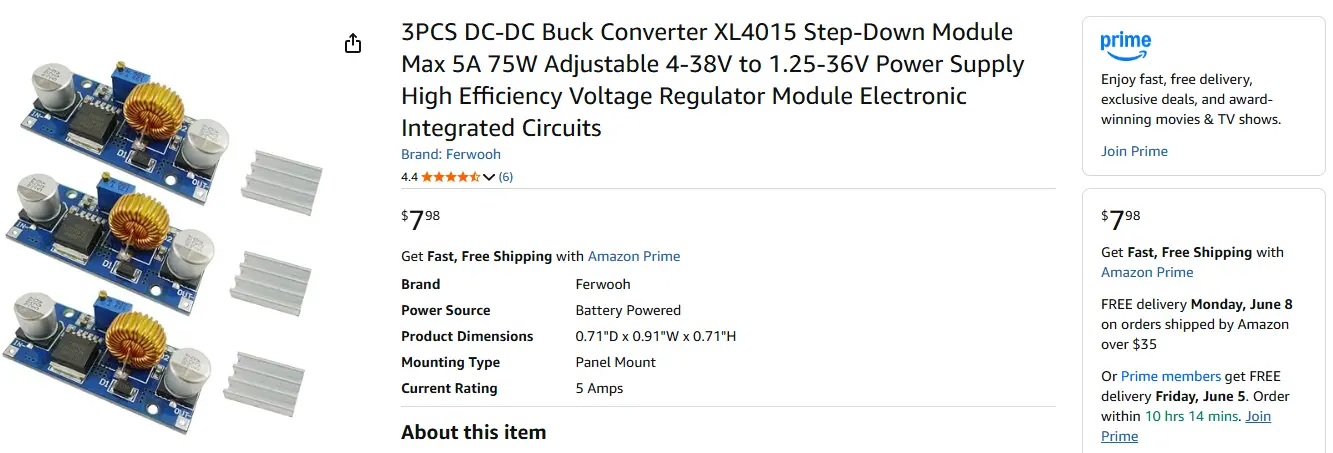

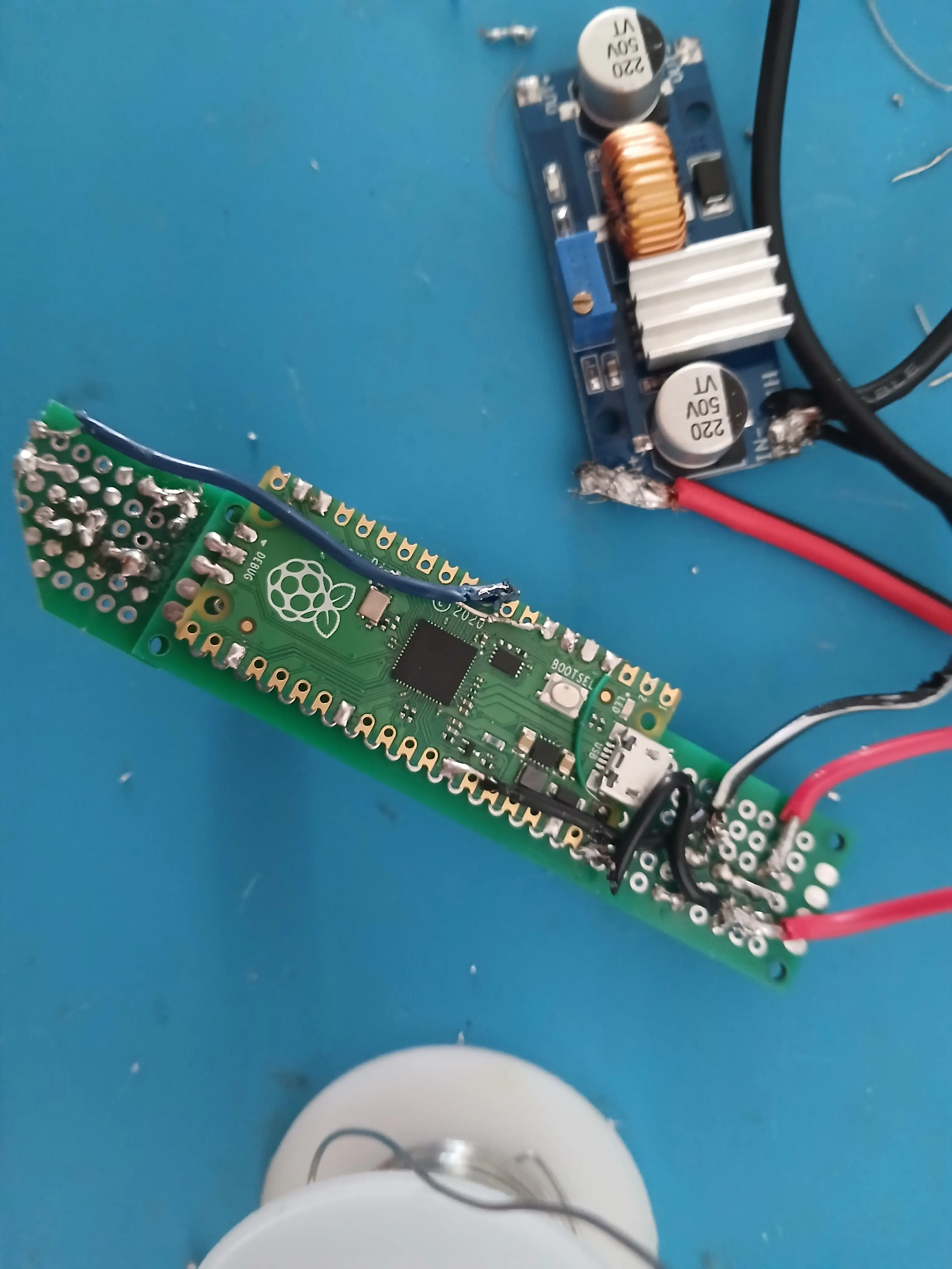

As a quick side note, I bought some of these XL4015 buck converters (which took 8 dollars out of our 20 dollar budget :(). These are necessary for powering the PS2 Slim board though. I am also hopeful these won't introduce very much noise. I don't know how good they are, so we might have a noisy power rail on our hands. :\
I'll put out another update soon, so stay posted!

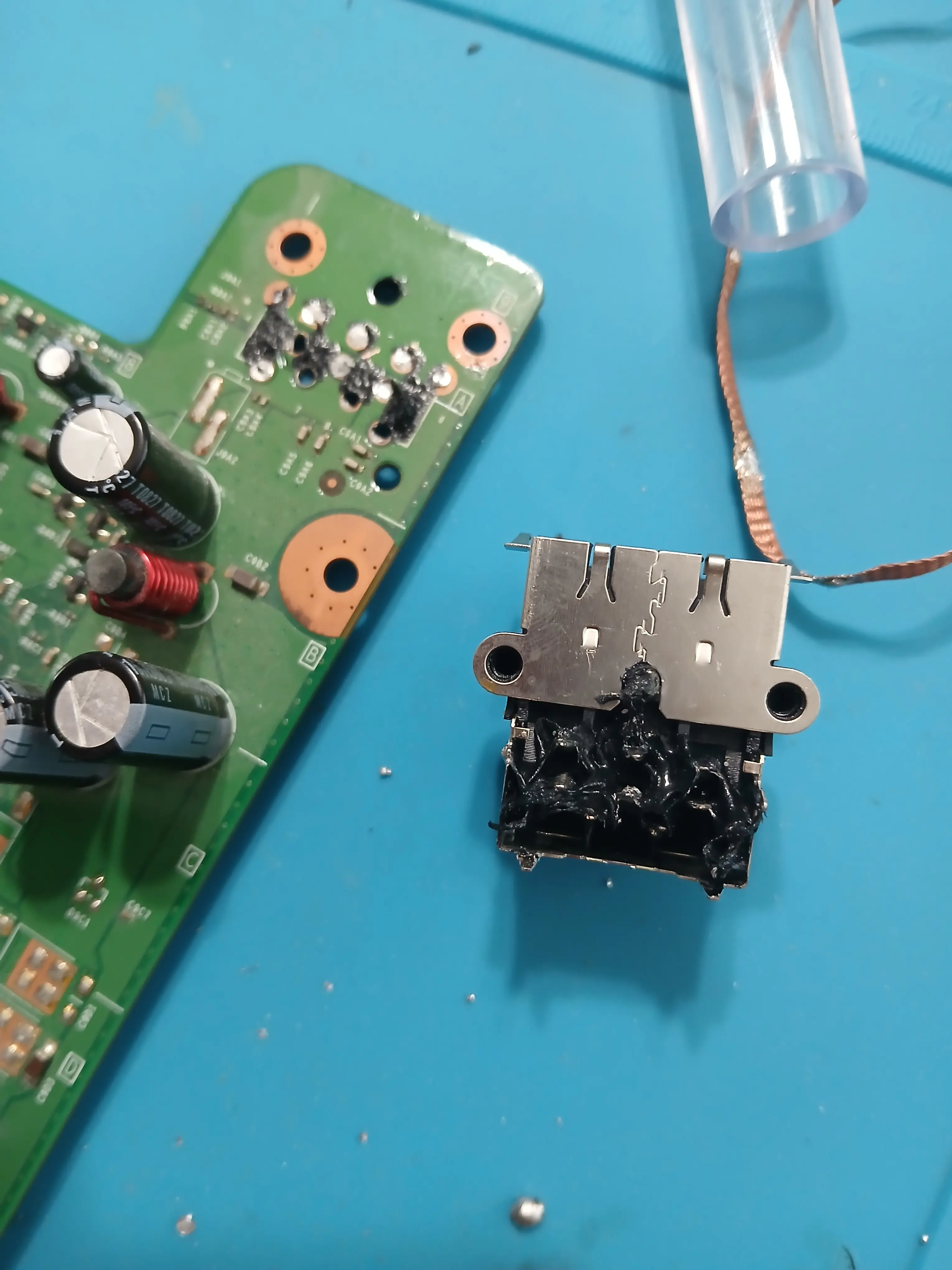

^ For the record I was unaware of the plastic, and was really wondering why it stuck on so well even when the solder was liquid. Oh well, I guess we know now.

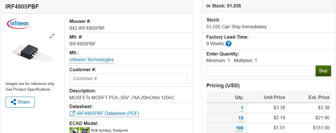

Ok, so the problem I wanted to solve before this update was getting the Xbox 360 PSU to power all consoles. I wanted to be able to switch what console receives 12v using a microcontroller, then when it had a good 12V rail I wanted to send a power on pulse to the respective console. I wanted to do all this from a single button.

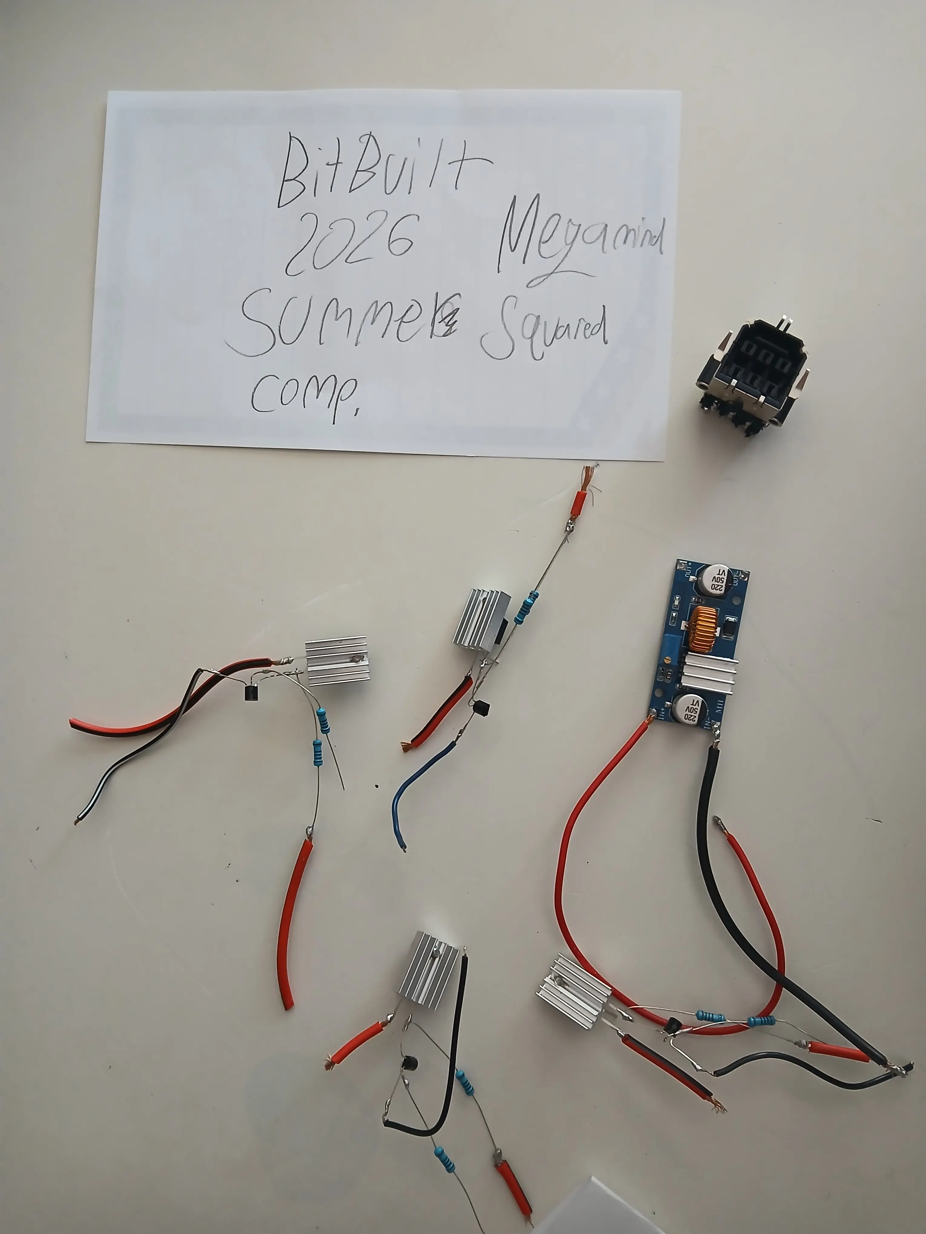

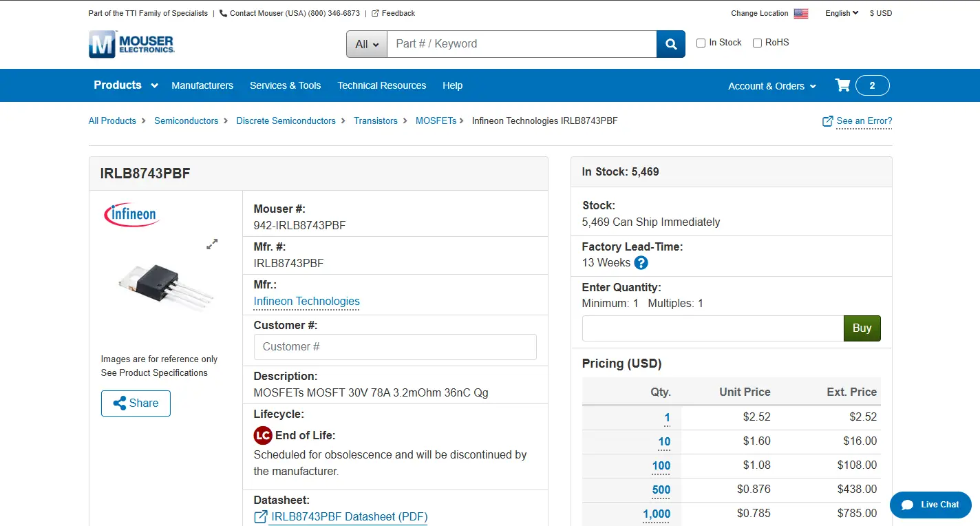

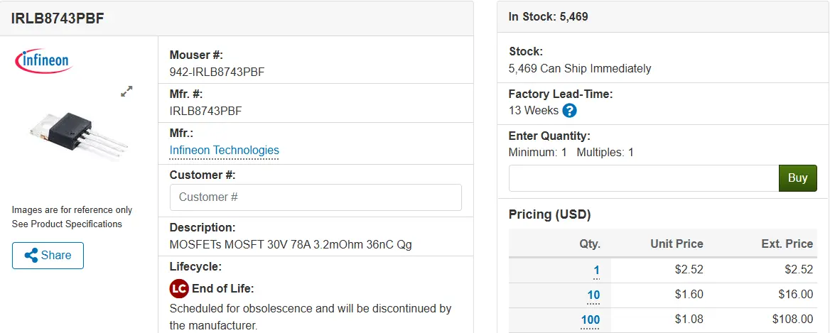

At first I planned on using N-Channel MOSFETs to cut/supply power, as they had an attractive price per performance ratio, and I found some good ones that could switch off of 3.3v.
^ Like this
Then I found out that N-Channel MOSFETs are used for low side switching, and I didn't want to low side switch any of the consoles, as that would leave floating power which might back feed through lines or blow stuff out trying to make it back to GND. So I pivoted to P-Channel MOSFETs. I wanted some that could handle a lot of power (mostly for the Xbox 360 as it pulls 12V at 14.2 A). I did some research and decided on the IRF4905(PBF).
I needed at least 3 (one to power on the Xbox 360, one for the Wii, & one for the PS2), that would have set me back ~16 dollars after shipping. I ended up finding a great deal on Amazon, and got 10 + 5 heatsinks for 10 dollars.
Now might be a good time to mention that our budget is absolutely gone. To properly drive these MOSFETs, I had to buy some discrete transistors, I wanted to stock up anyway, so I bought a big pack for another 10 dollars so our total is around 30 dollars now.

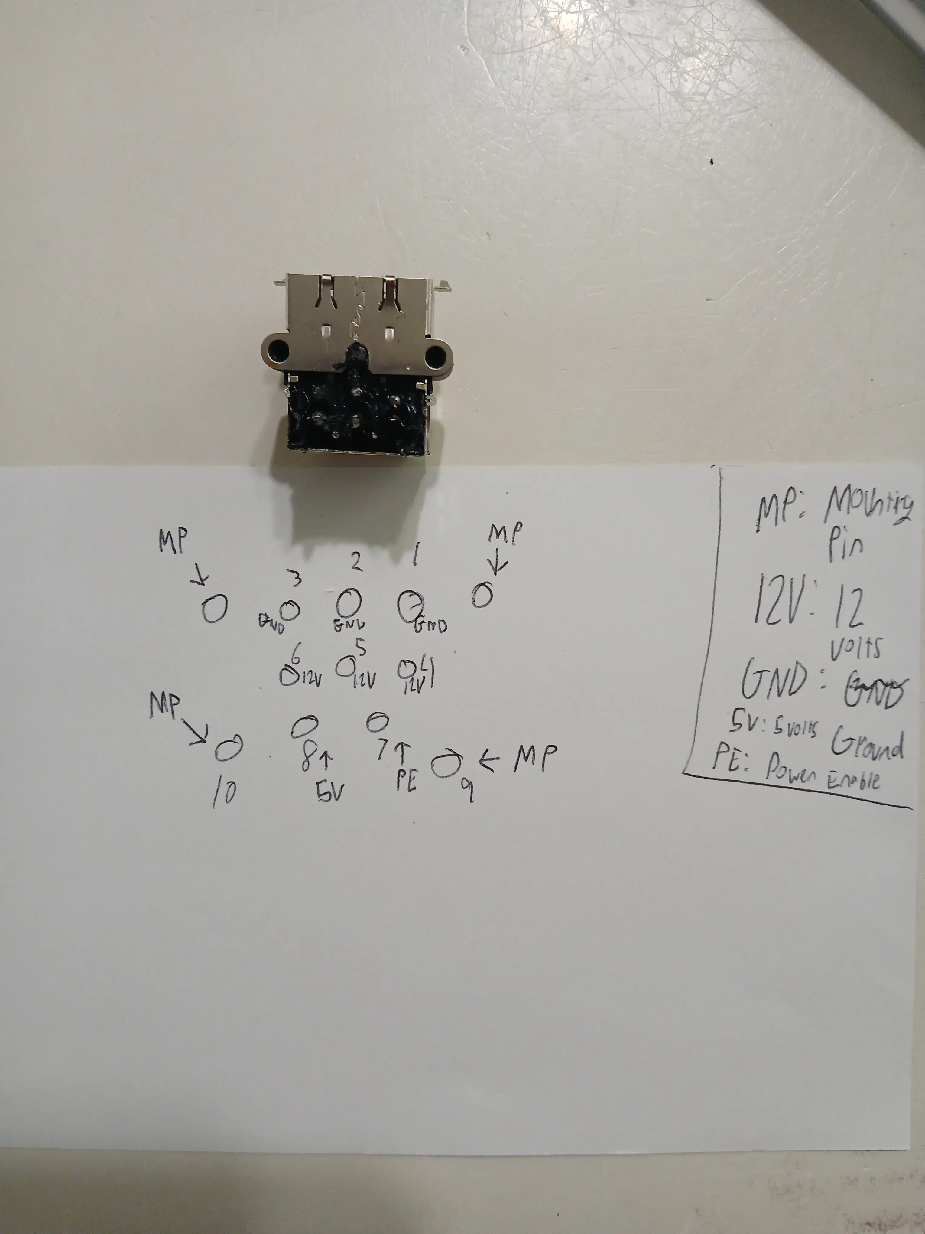

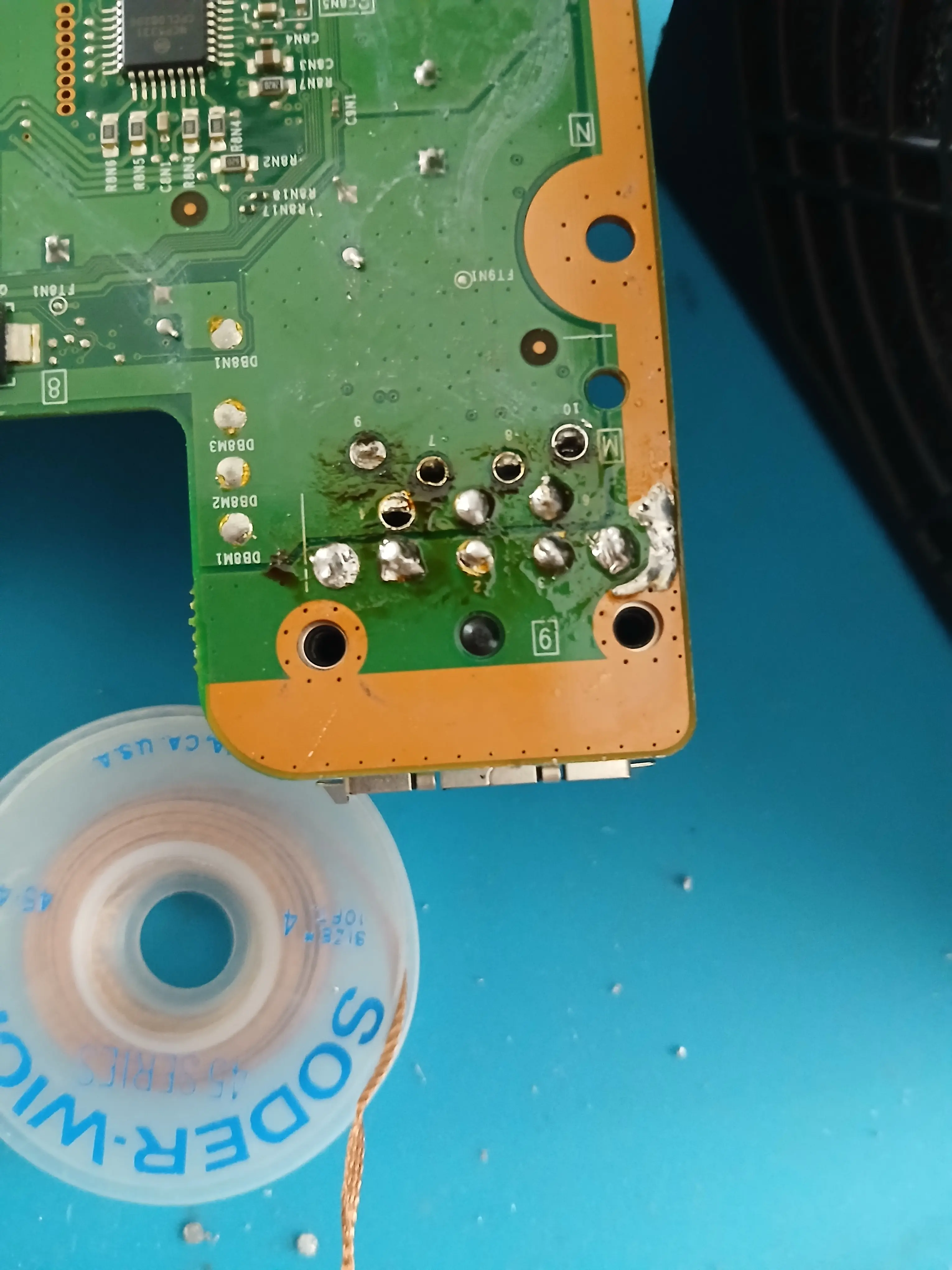

Ok now to get into the nitty gritty, I first had to isolate the PSU from the Xbox 360 so I desoldered it, and found out about the magic plastic underneath. O.o
^ Here it was halfway through.
^Now here it is taken out.

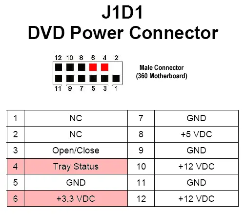

I then took some time to find out what pins did what.

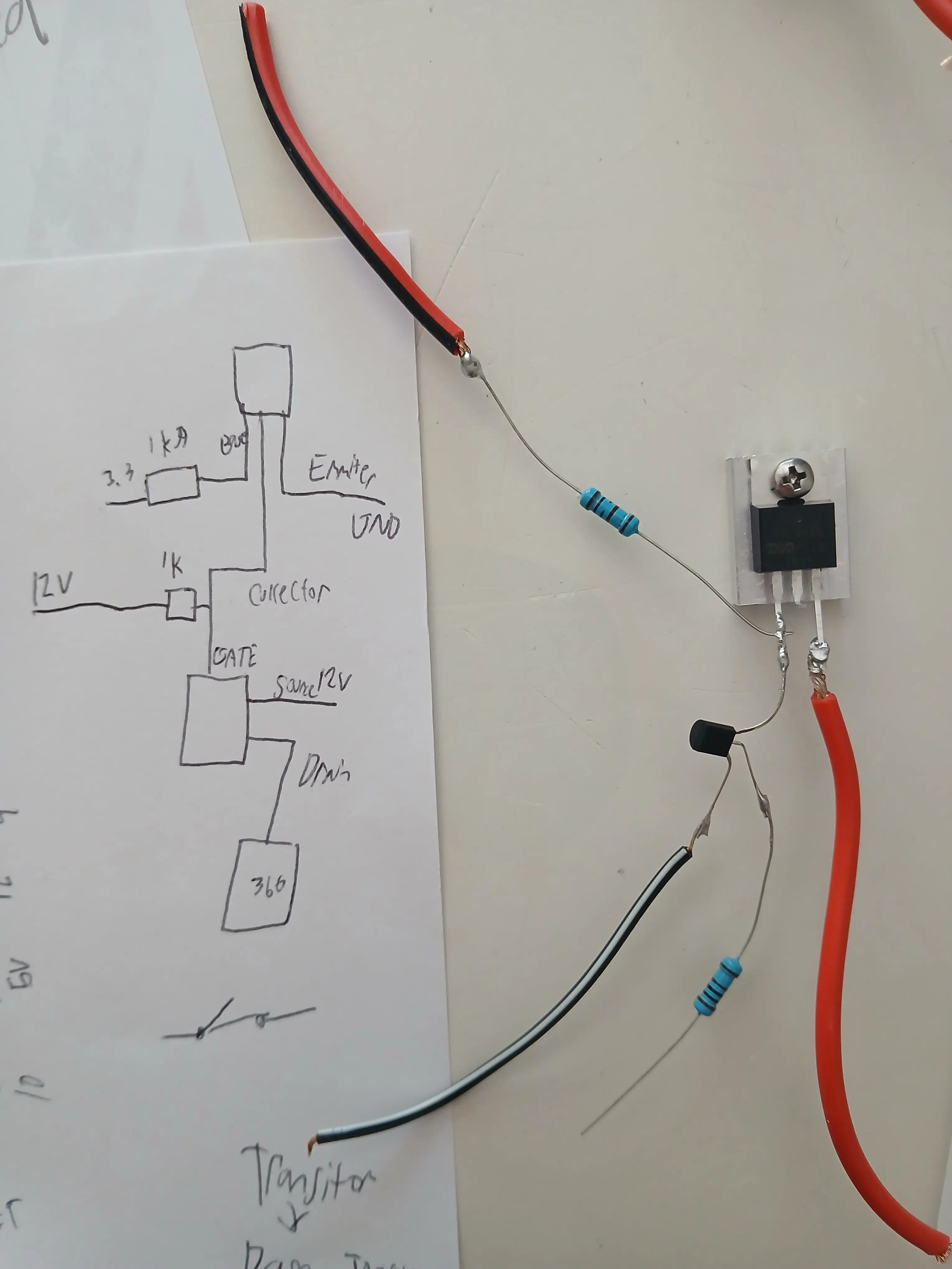

From there I decided to make a schematic of our circuit and start wiring.
^ I hope this is right. :|
I then made 4 of them and was ready to go.

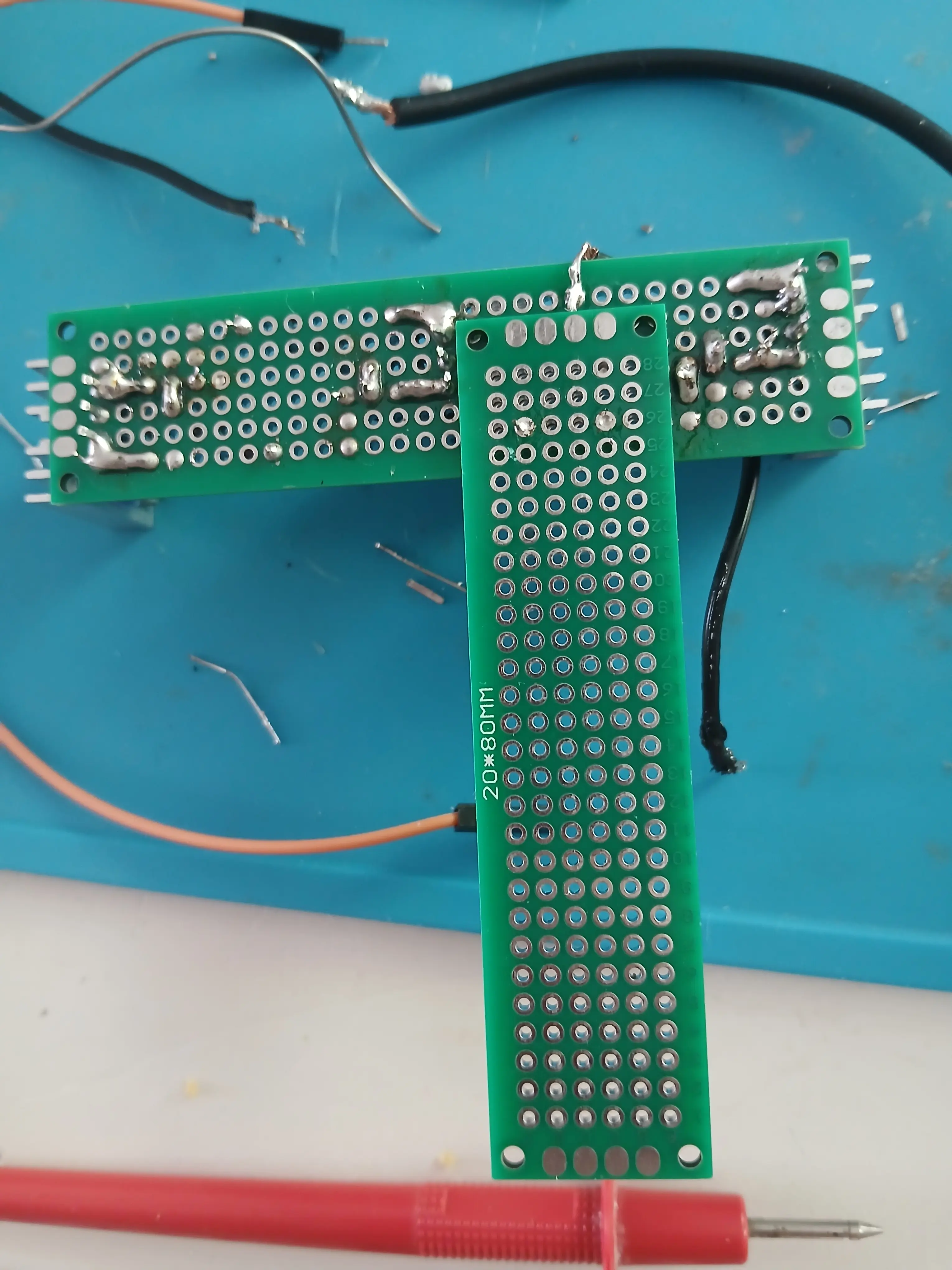

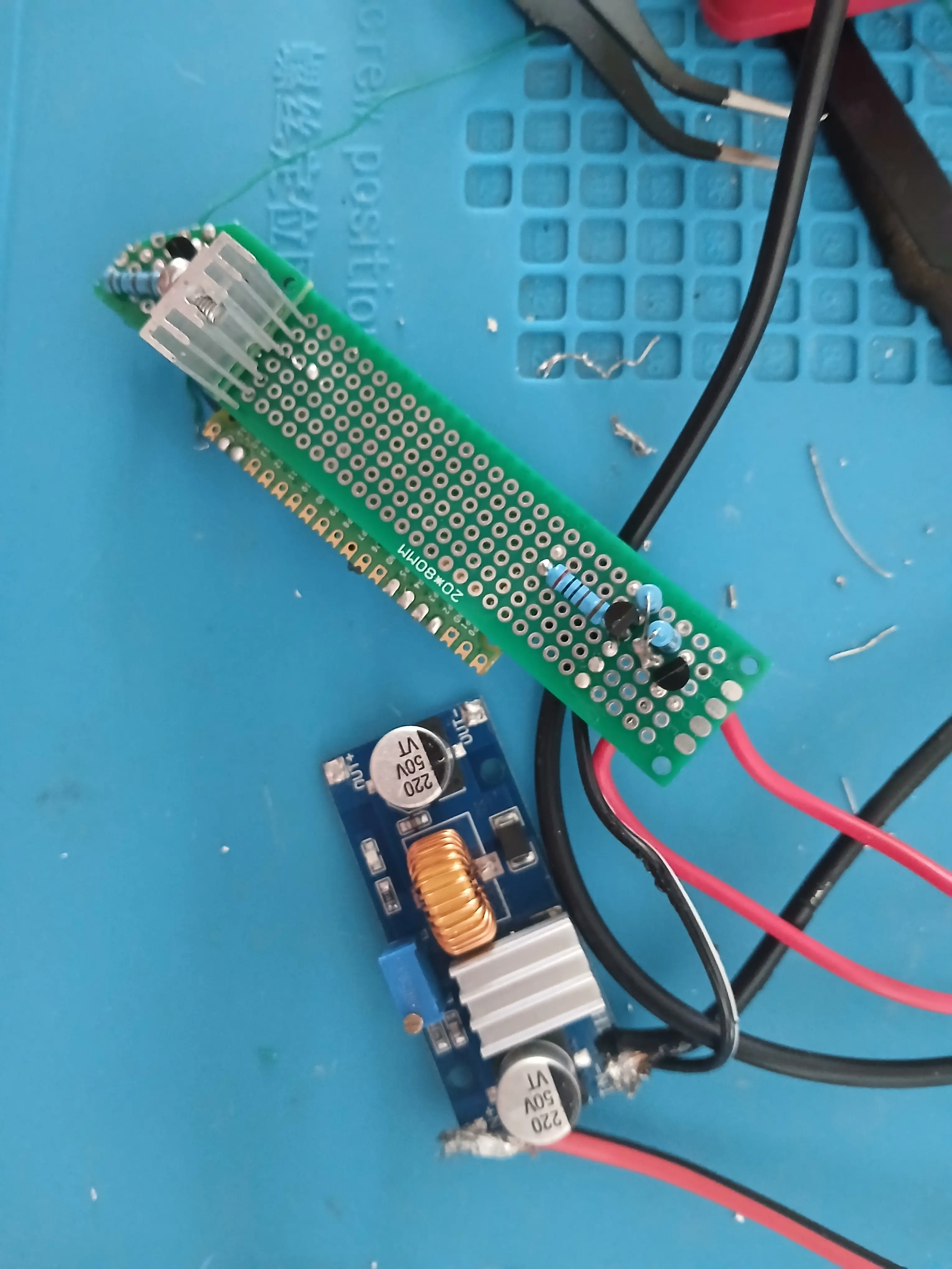

I then spent way too much time wiring up a POC.
^ Obviously this won't do.
I could say I didn't buy a couple of perfboards, but I dropped another 10 bucks so we don't have a pile of spaghetti. Then I wired up one line, and...
^ It worked!

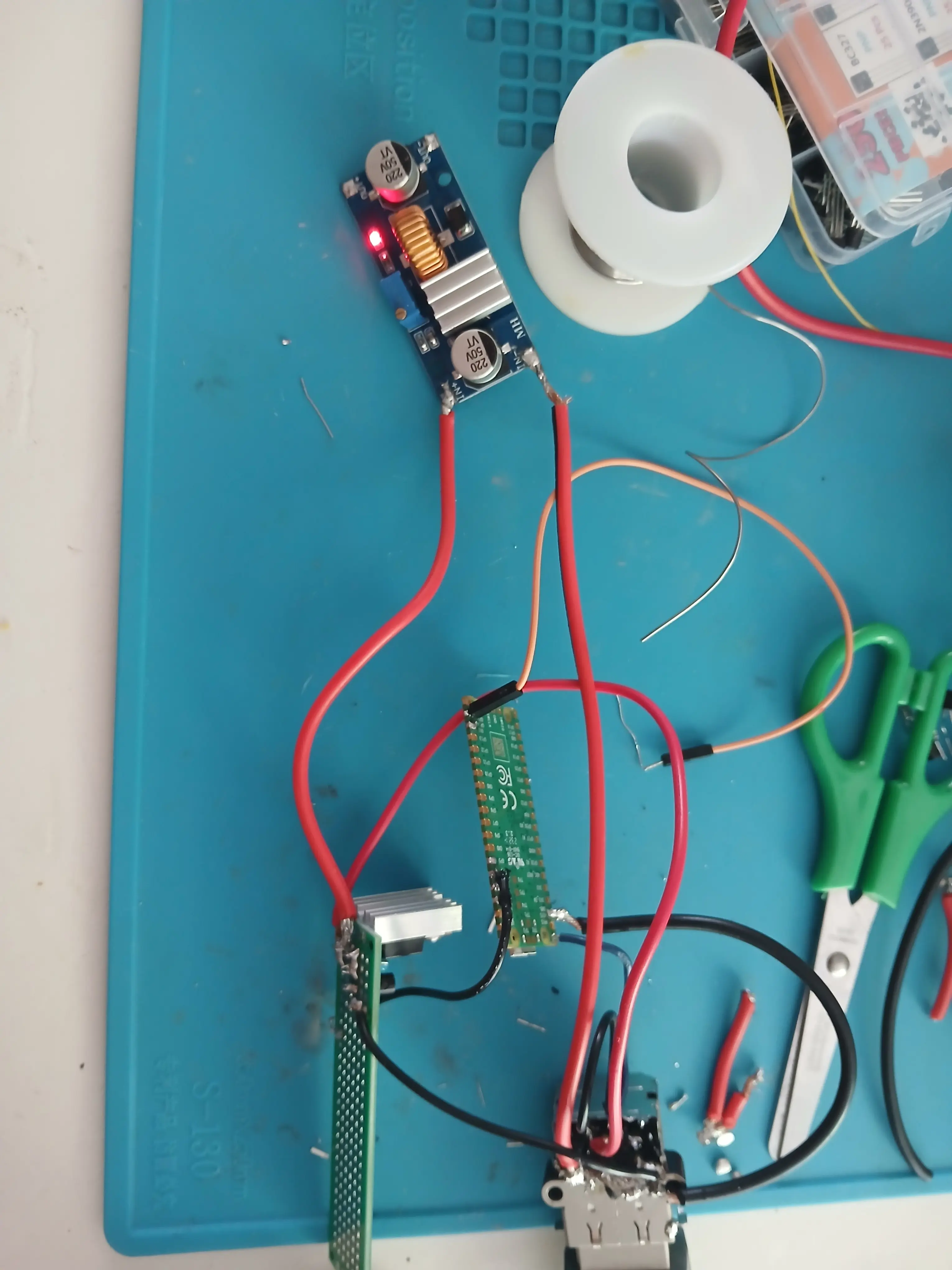

Then I decided to make two more, and finally, I wired up a transistor to be able to switch the power-enable line.
^ Voilà
I ran a test, and it worked!
sorta...
It enabled the right lines and everything but I was only getting ~8.5 V out of the MOSFET rather than the expected 12.
I am unsure what the issue is, but I will be messing around with it some more and hopefully get it working, or if I have too, I can pivot and find a different solution.

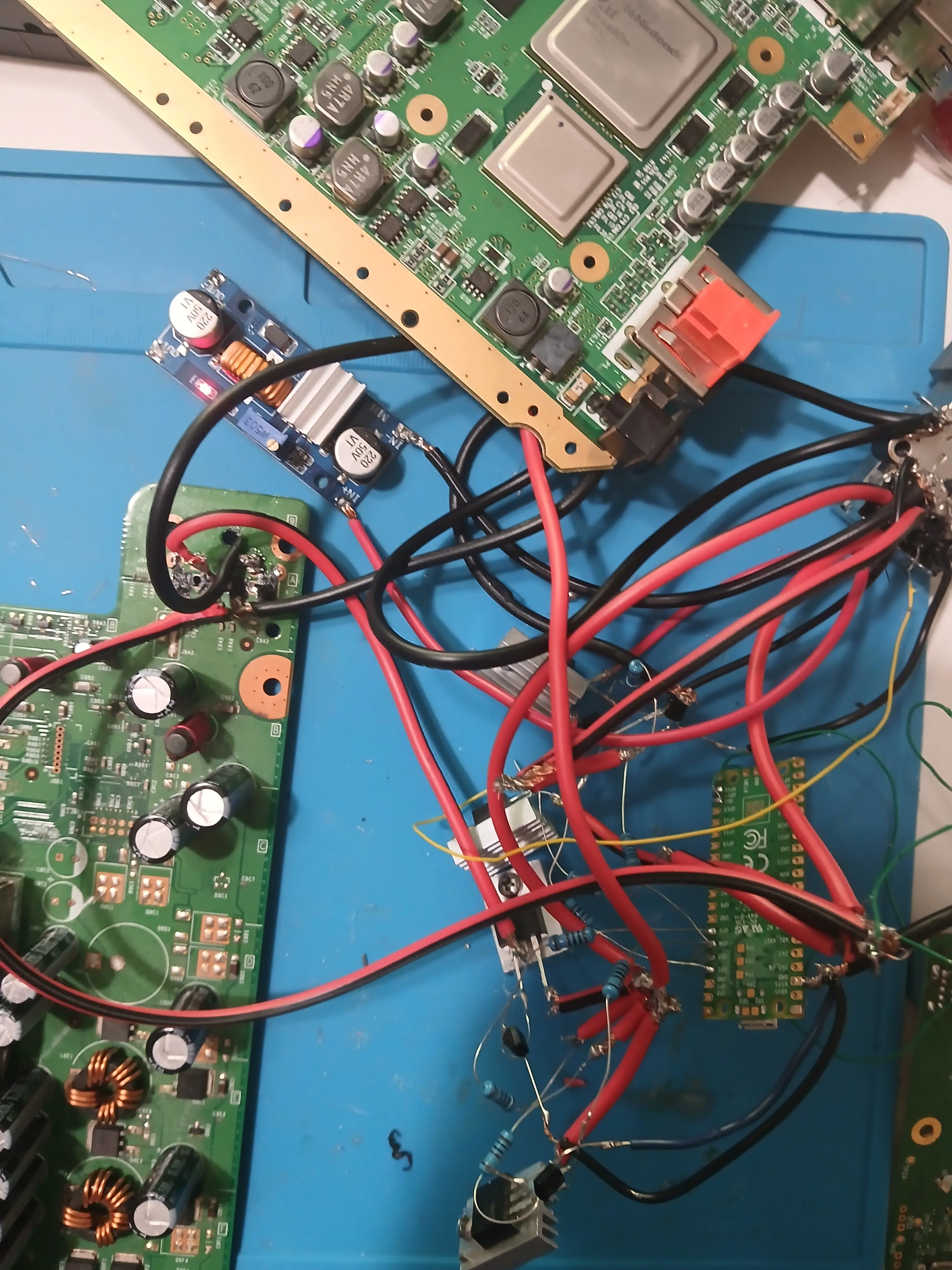

Okay fellas, I have a new update.
First off, sorry it's been like 2 weeks since the last update, but I've been really busy with work and stuff. I'll try to be more consistent about updates, but they may be more like every two weeks rather than every week.
I have made some progress on the power management system and have a rough 3D model done.

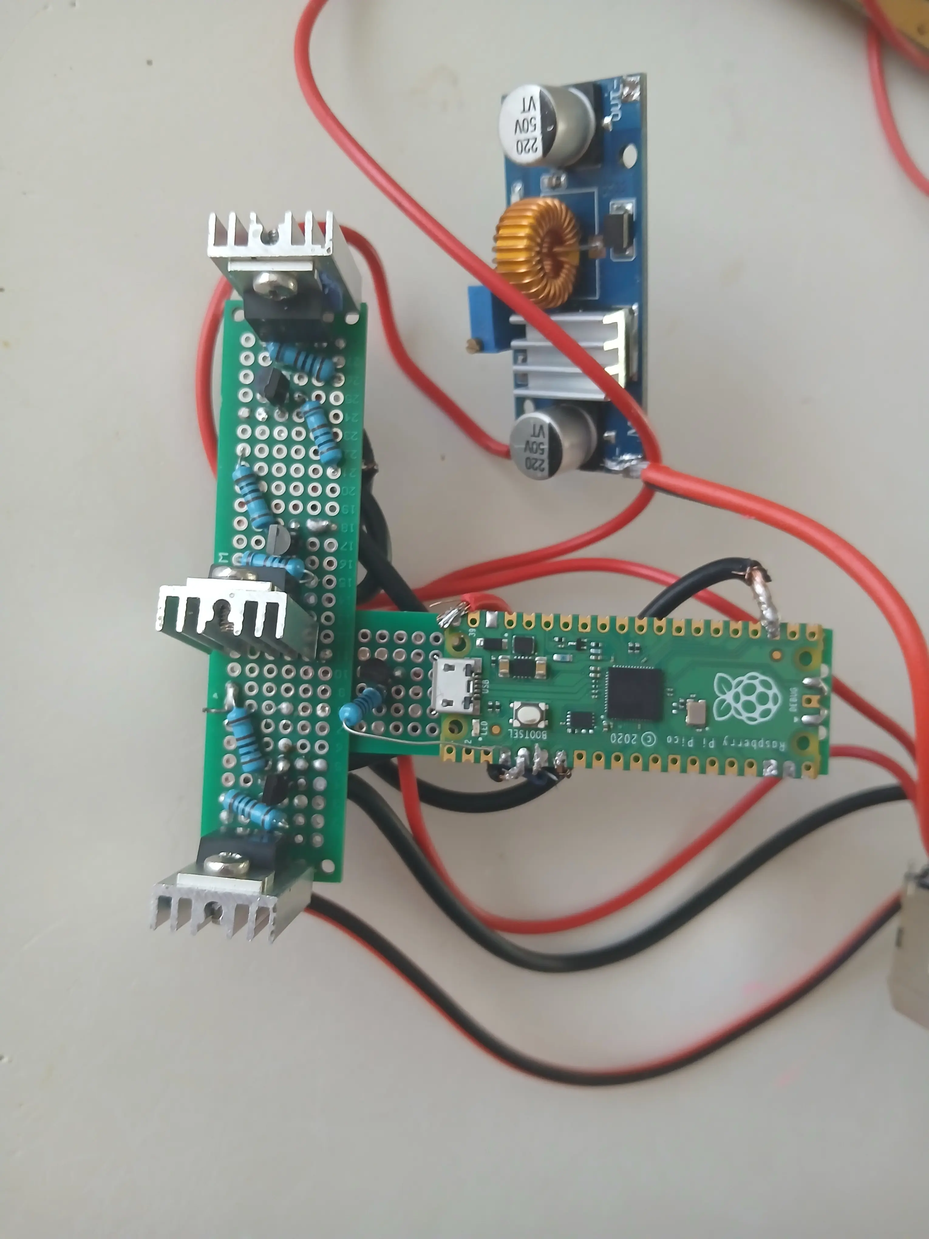

So, for the power management system, I realized that both the Wii and PS2 can have a standby 12v/8.5v respectively, and both of these can be pulled from the 12V rail, so I only needed one of my MOSFET 12v on/off circuits, which will save space (space is at a premium), and that would just be for the XBOX 360. Also, to help save the PSU, I built a NPN PNP transistor circuit to switch the 5v rail on and off from 3.3 V (from the RPI Pico). I mounted both of these on a simple perf-board and soldered the RPI Pico to the perf-board.
^ Glorious!
^ The other side.
I then hastily wired the whole thing up for a test run, and the 5V switching circuit, the Wii, & the PS2 buck converter received power, and functioned properly. I did run into a snag with the Xbox 360 though, with the 12V, 5V, PWRGD, & GND lines wired up, when powered on, the fans would jump for a second (the 12V fans that is), then stop as the power brick changed from a green light to a red light (I think that shows when either overcurrent or overvoltage is tripped.) So, it works but for some reason or another the XBOX 360 is tripping the PSU. Hopefully I'll be able to figure that out and fix that soon. :\ If not, I have been considering doing a double PSU thing.
^ I know the wiring is a little painful.

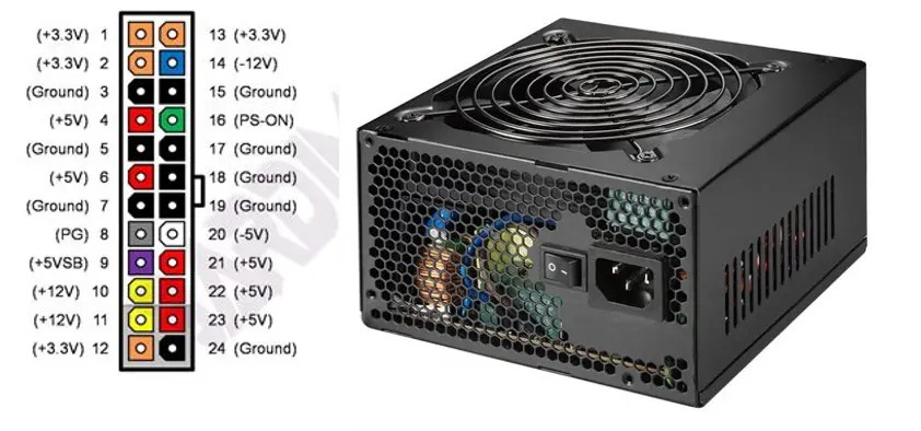

For now, I have decided to pivot from the power management system I have been designing and I'm going down a new route.
The main reason I have pivoted is simply the fact that the XBOX 360 PSU is a little sensitive and to get a proper power signal down the 360, you have to have a pin going all the way through the via, because of the inner layers (found that out the hard way).
This route may or may not include an ATX PSU.
(Image Credit: Cirkit Designer)
I have been super busy, but I am confident that my next write up will include a working POC that will have most of the requirements showcased.
