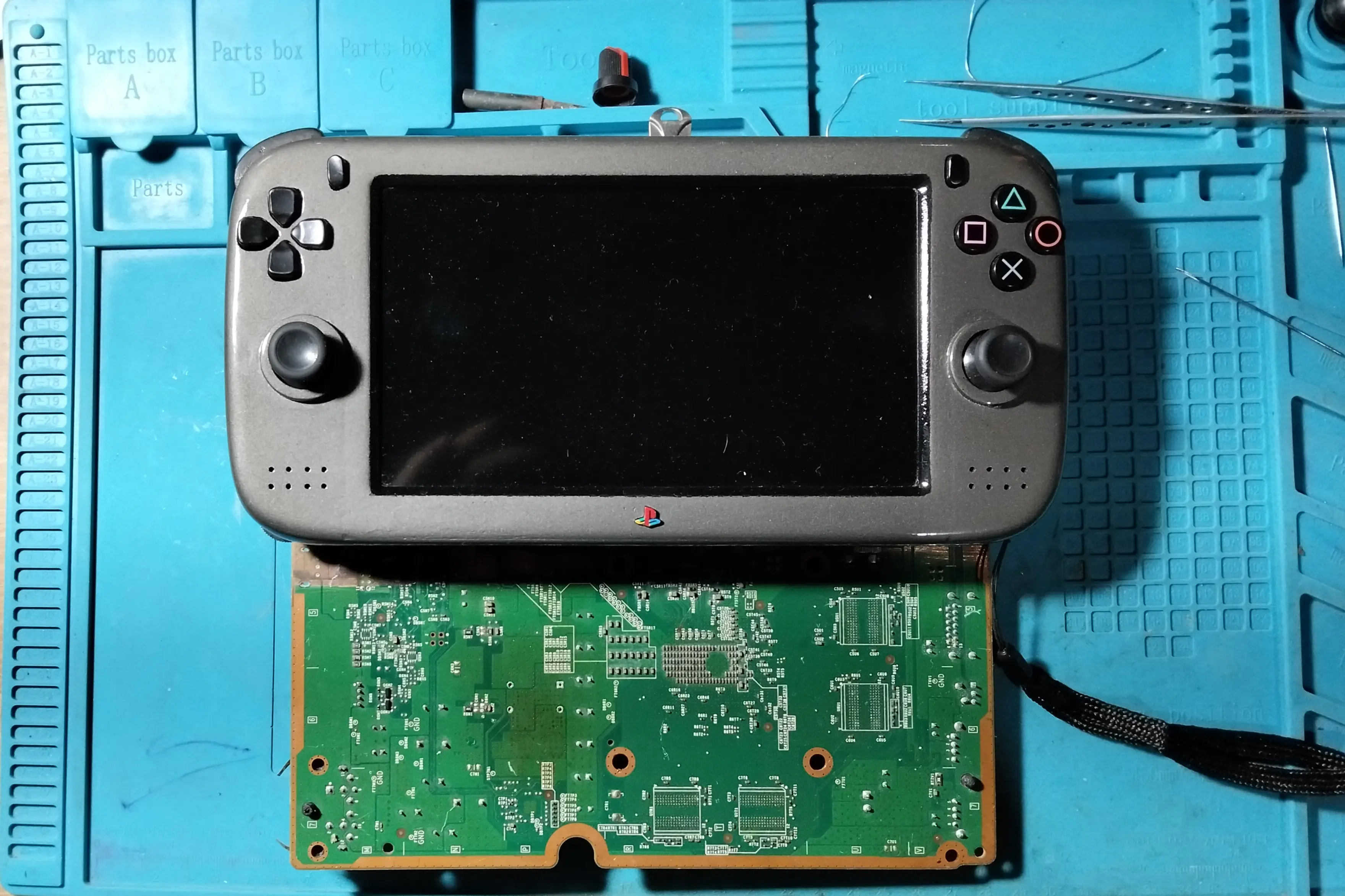

The goal of this project is to build a portable Xbox 360 using original hardware, focusing on reducing the motherboard size through physical division and reorganization while keeping the console fully functional. Below is a comparison between a portable PS2 that I built some time ago and the Xbox 360 motherboard. I believe the final size will be quite reasonable.

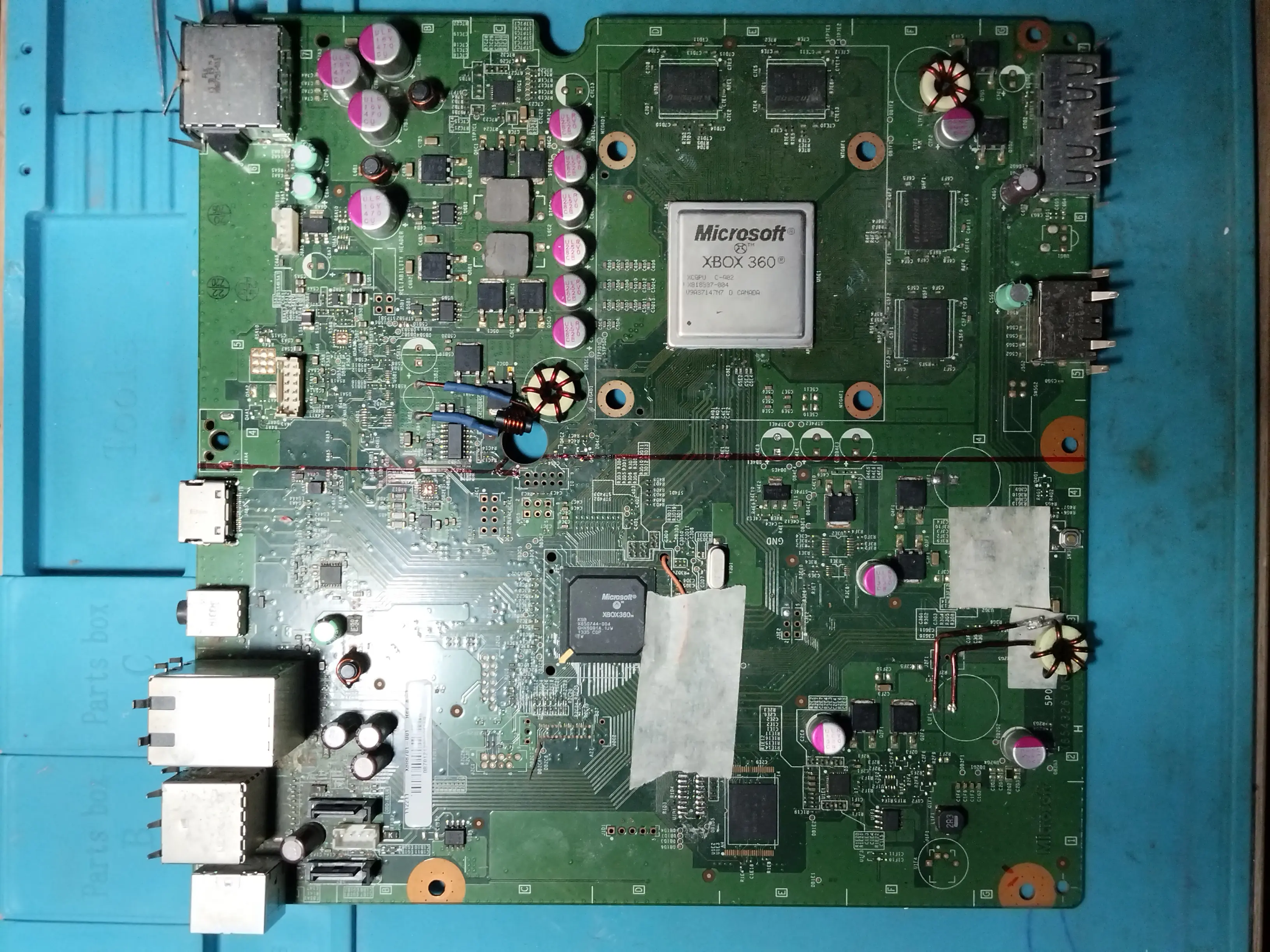

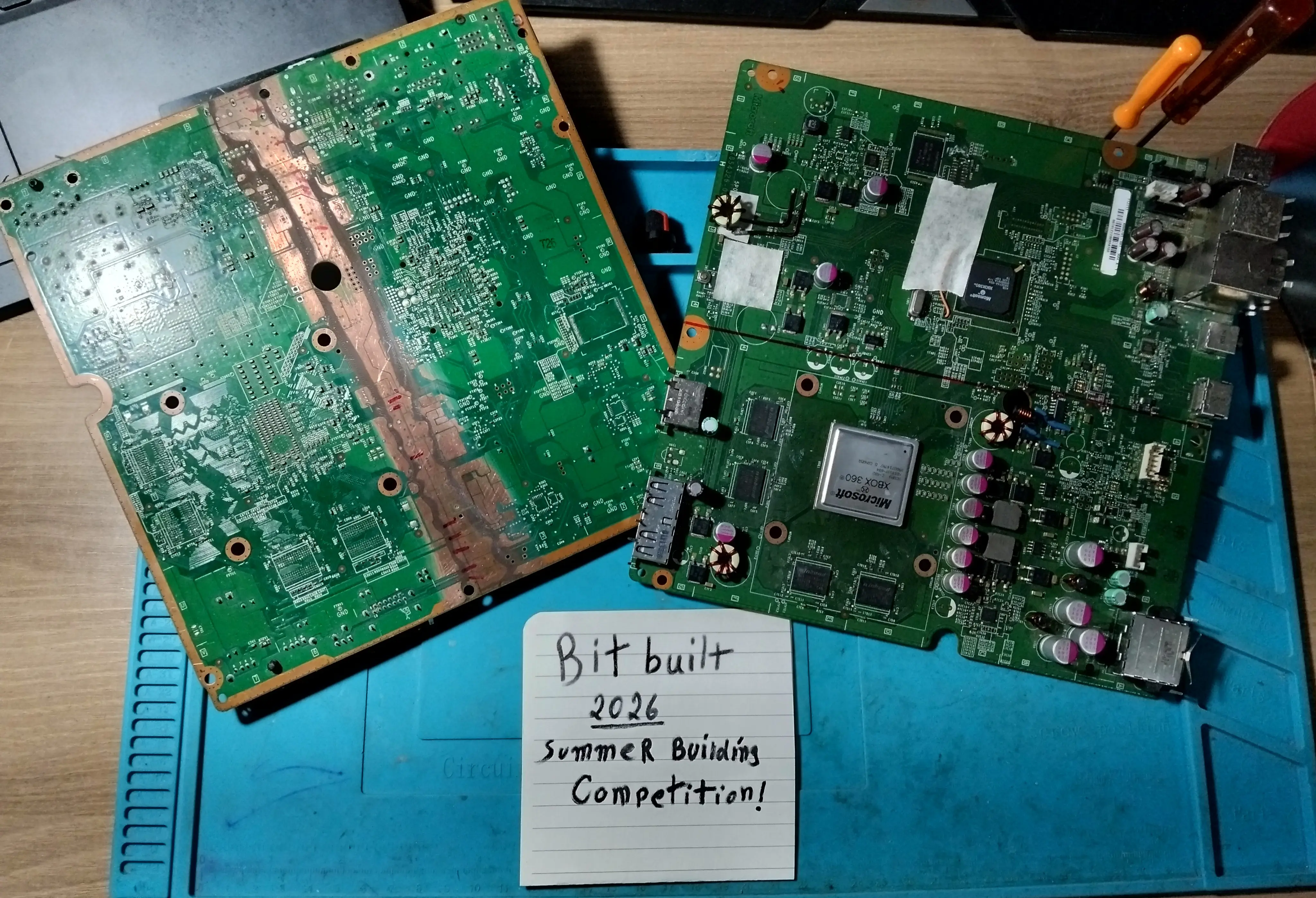

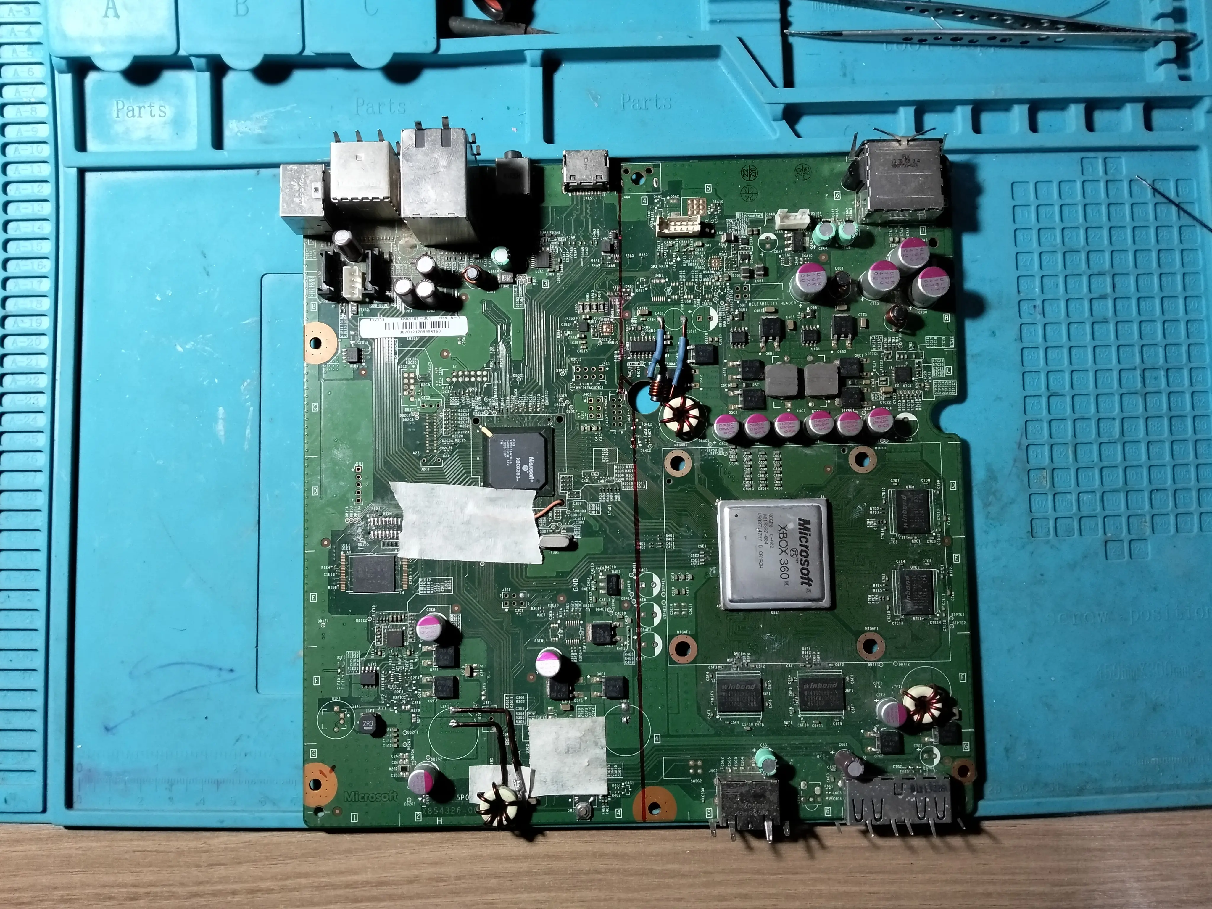

I recently got a working board at an affordable price. I unlocked it with RGH 3.0, installed Aurora, and transferred a few games to a 250 GB Kingston SSD. After confirming that everything worked as planned, I’ve already marked the line where I’ll make the cut. You’ll also notice that I relocated some components (I was running some tests). I also replaced a large doubler coil with smaller ones since they have a smaller profile. The old one took up space that I’ll need in the future.

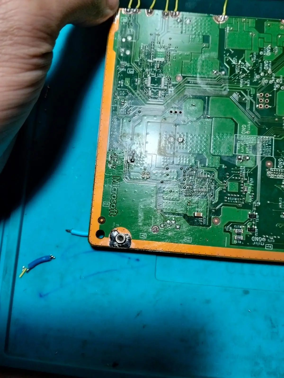

I also managed to get some dead boards for research and testing. Since the Xbox 360 motherboard has four layers and one of the internal layers is primarily dedicated to ground, I only need to fully reconnect one of the internal layers. To better understand the internal routing, I sanded down one of the dead boards to identify the internal traces, as shown below.

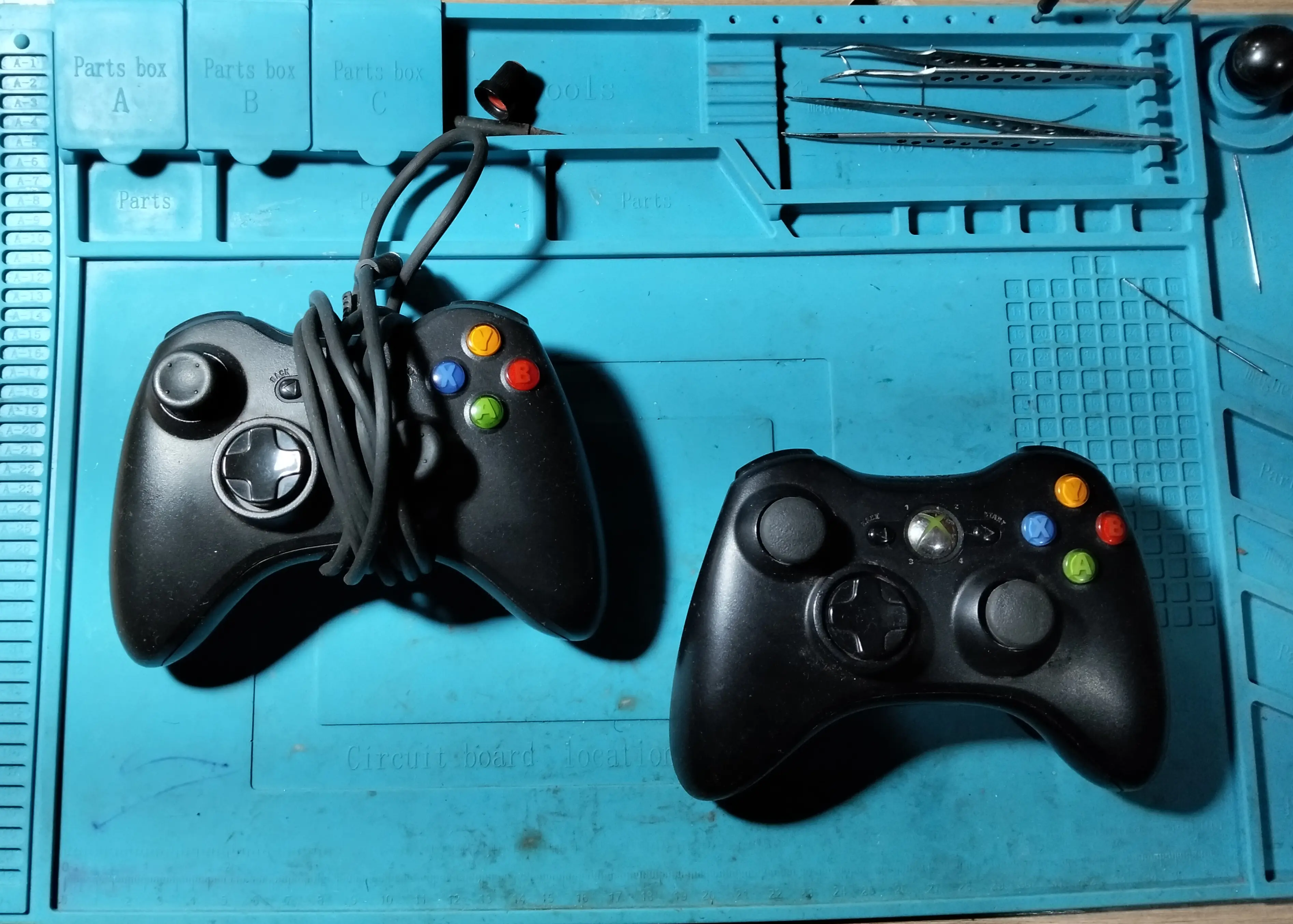

I also got a good deal on two controllers: one third-party controller that will be used for the project and one original controller.

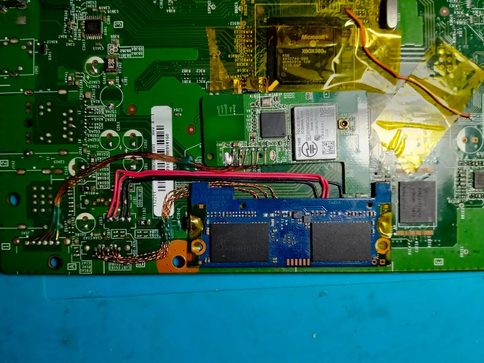

Just a quick update on the project: I’ve finished installing the SSD in the console. It has a very low profile, and I positioned it strategically so it wouldn't take up too much space. I also took the opportunity to integrate the Wi-Fi module; I have the option to include it, and I see no reason not to.

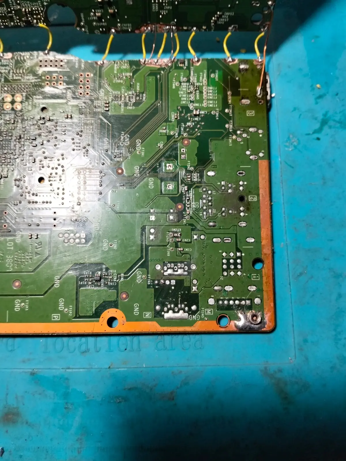

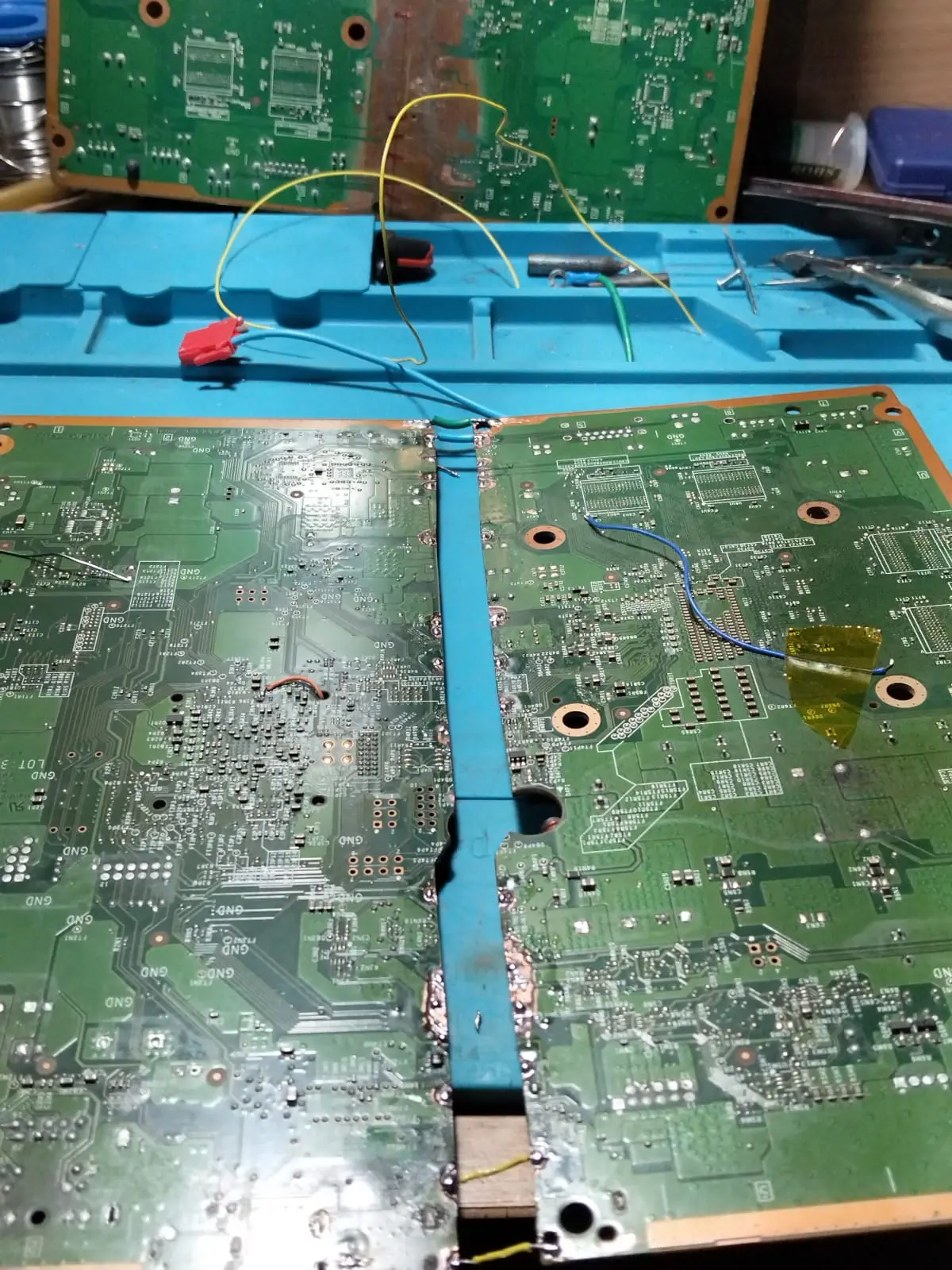

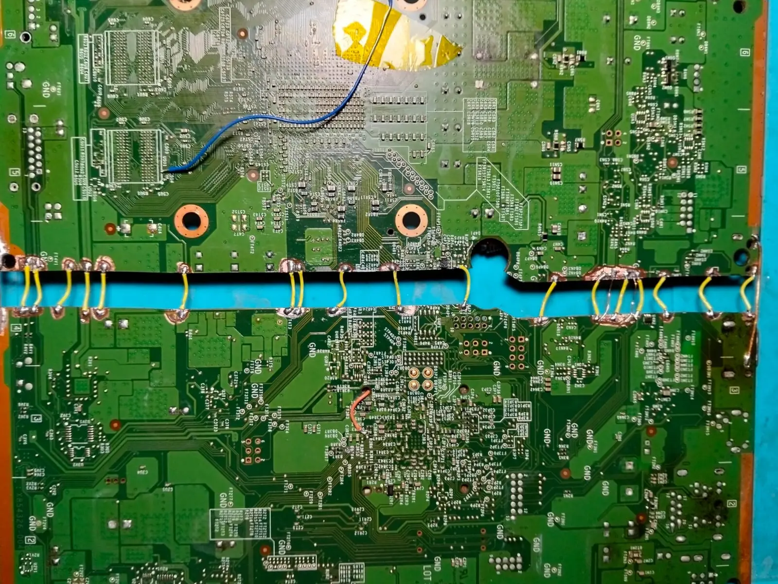

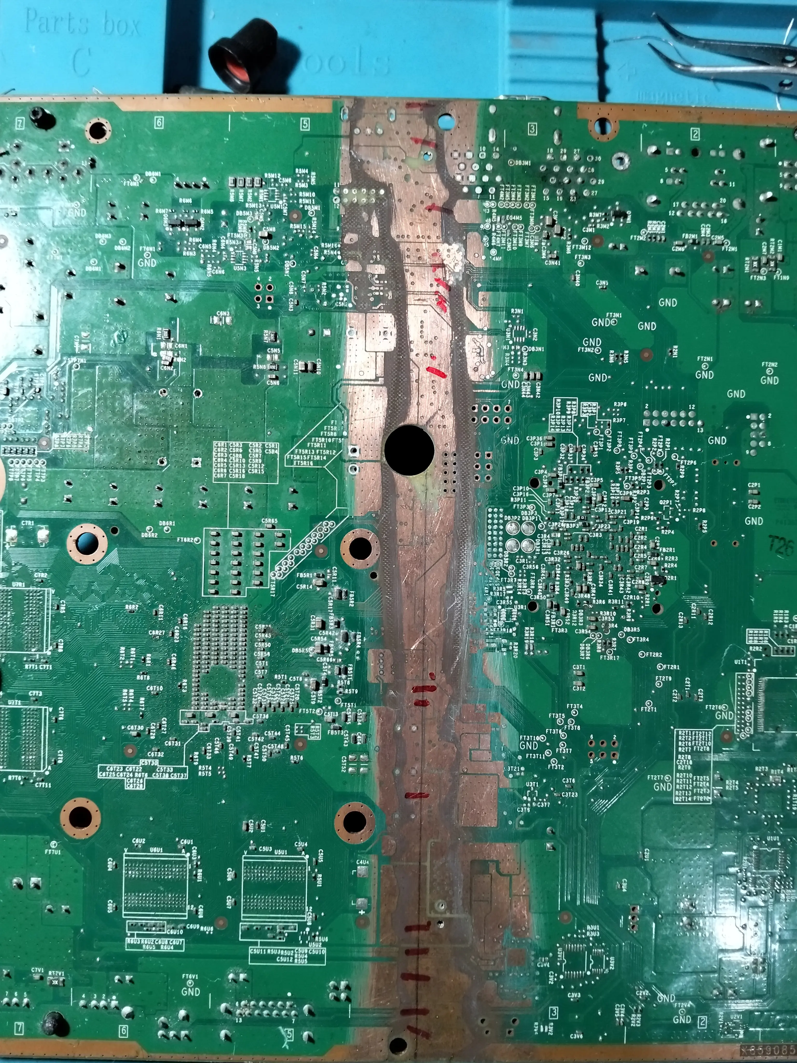

I was also quite apprehensive about cutting the circuit board all the way through, but I decided to go ahead and make the cut anyway. After thoroughly sanding the edges and verifying that no internal layers were touching—which would have caused a short circuit—I began exposing the traces on the voltage layer that needed to be reconnected. In total, I had to reconnect 20 traces on that internal layer; since I knew the other internal layer was used solely for grounding, a simple wire connecting the ground points from one side to the other would suffice.
I also left a safe distance between them to ensure there would be no serious issues when folding; for the connection, I used flexible cables to facilitate folding without breaking any traces.

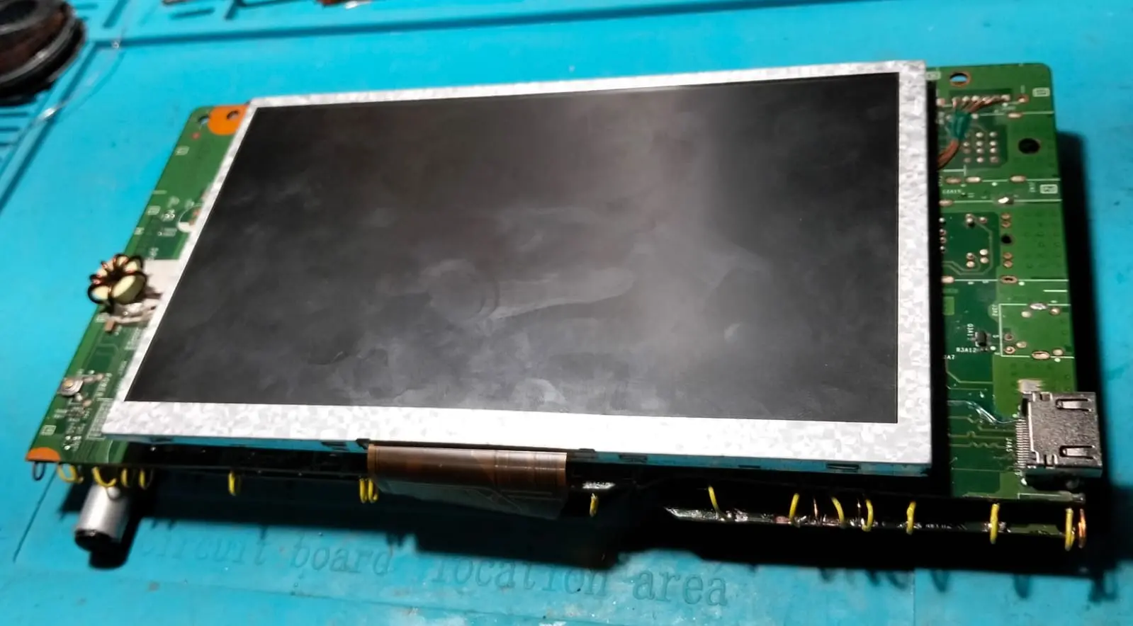

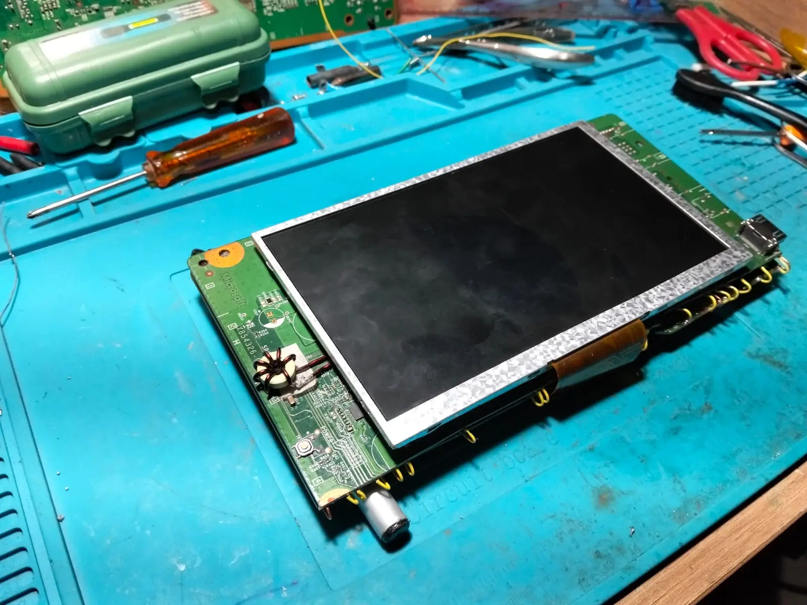

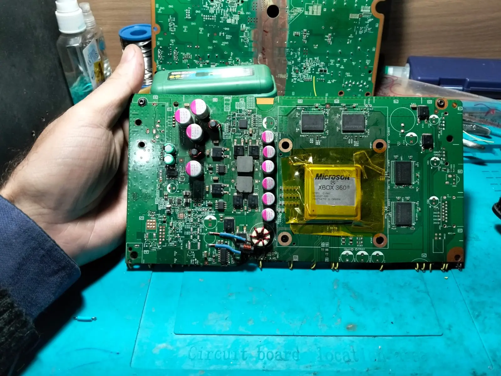

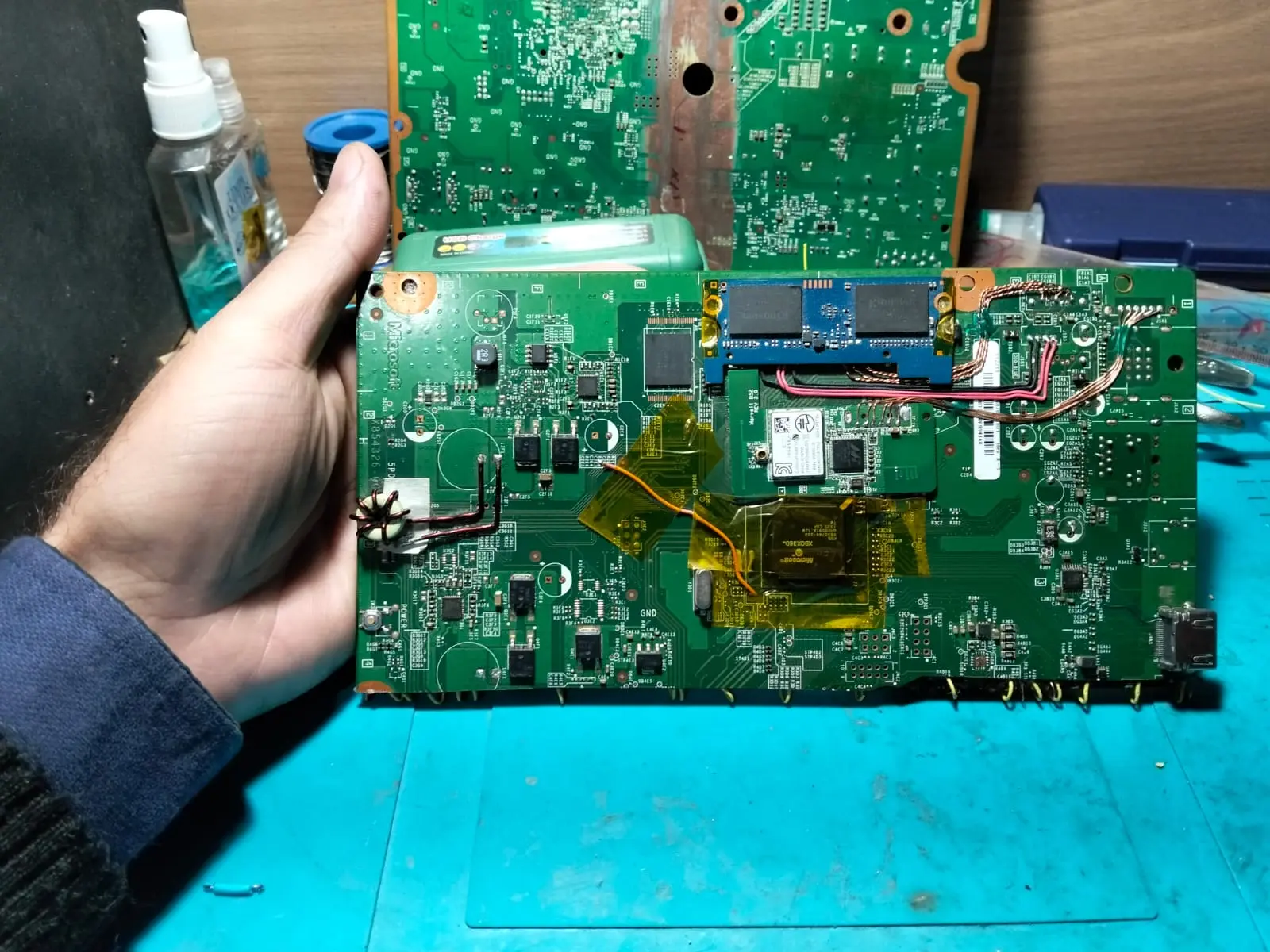

When performing the 360-degree fold, I need to ensure the boards do not come so close that the components touch; to achieve this, I soldered threaded inserts into the corresponding holes on the top board—connecting them to the ground plane—so that they remain fixed in place and do not shift.
This is the view we have of it once folded.
Now, two attractive images of it with the 7-inch screen.
