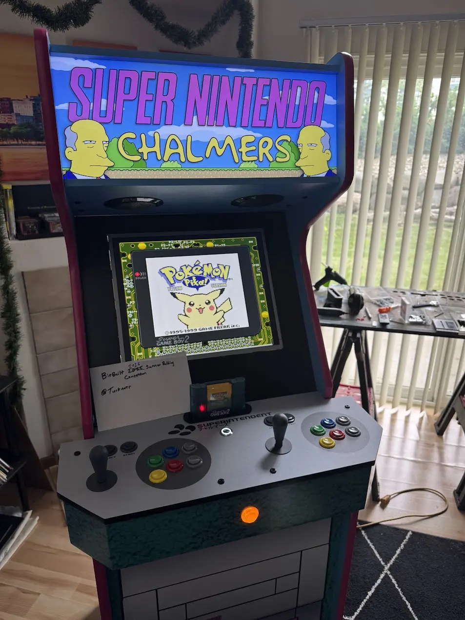

Some of you may remember me from my 2025 BitBuilt Summer Building Contest project, the Sega Genesis 4. Just a few weeks ago, myself and many other members of the BitBuilt and Benheck.com communities exhibited our work at the Midwest Gaming Classic in Milwaukee, which was an absolutely life-changing weekend. The Genesis 4 drew a lot of attention from convention-goers and fellow modders alike, and in the time since then many people asked me what I will do next. To be honest with you, I really wasn’t sure I could (or wanted to) do another project of that (or any) scale again.
This is me on top of the world at MGC 2026
You see, I’ve been attending the Midwest Gaming Classic on and off for the past 17 years, and this was the first year I’d actually created (successfully) and brought something to showcase. Attending the show as an exhibitor was a totally different experience than any other year. There certainly was significantly more cost associated, both with funding the actual project and staying/parking/eating for the longer duration. There was also a lot more stress, with figuring out how exactly I wanted to present my project, the logistics of transporting it to and from the show, and worrying about if everything was going to work when I got there. Also, I was a bit worried about my experience at the show, knowing that I'd feel obligated to stay pretty close by and nervous about venturing off to explore the other areas. Leading up to that last weekend in April, I was certain that this would be a “one and done” experience for me. I was looking forward to not having to go through all of that again.

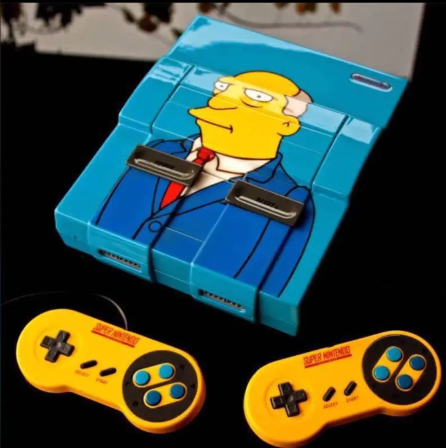

I’ve been a huge Simpsons fan my entire life. Probably one of my top 5 fandoms. In Season 10 (in my opinion the last actually good one) Episode 7, “Lisa Gets an A”, there is a scene where Principal Skinner and Superintendent Chalmers take Lisa into the school’s computer lab, where Ralph Wiggum is “learnding” how to spell on the school’s lone COLECO computer. Ralph says hi to Lisa, and then turns to the superintendent and says “Hi, Super Nintendo Chalmers.” That’s it, it’s just a one-liner. It’s a stupid joke from a single episode, but it was exactly the inspiration I needed.
Now, I’m not the first person to take this one-off joke and turn it into a meme project. A 2017 reddit post from u/SpicySNES shows off a custom paint job he commissioned on an actual Super Nintendo, done by an artist named Zoki64. Images of this custom console went somewhat viral around that time and still pop up in Google results when searching that phrase. The thing about this one is that, while it’s very well done, it’s just a case mod. Plus they didn’t even do it themselves (lame). It looks really dope, but it doesn’t actually bring Super Nintendo Chalmers to life.
I think that I can actually bring him to life.
u/SpicySNES's Super Nintendo Chalmers from 2017

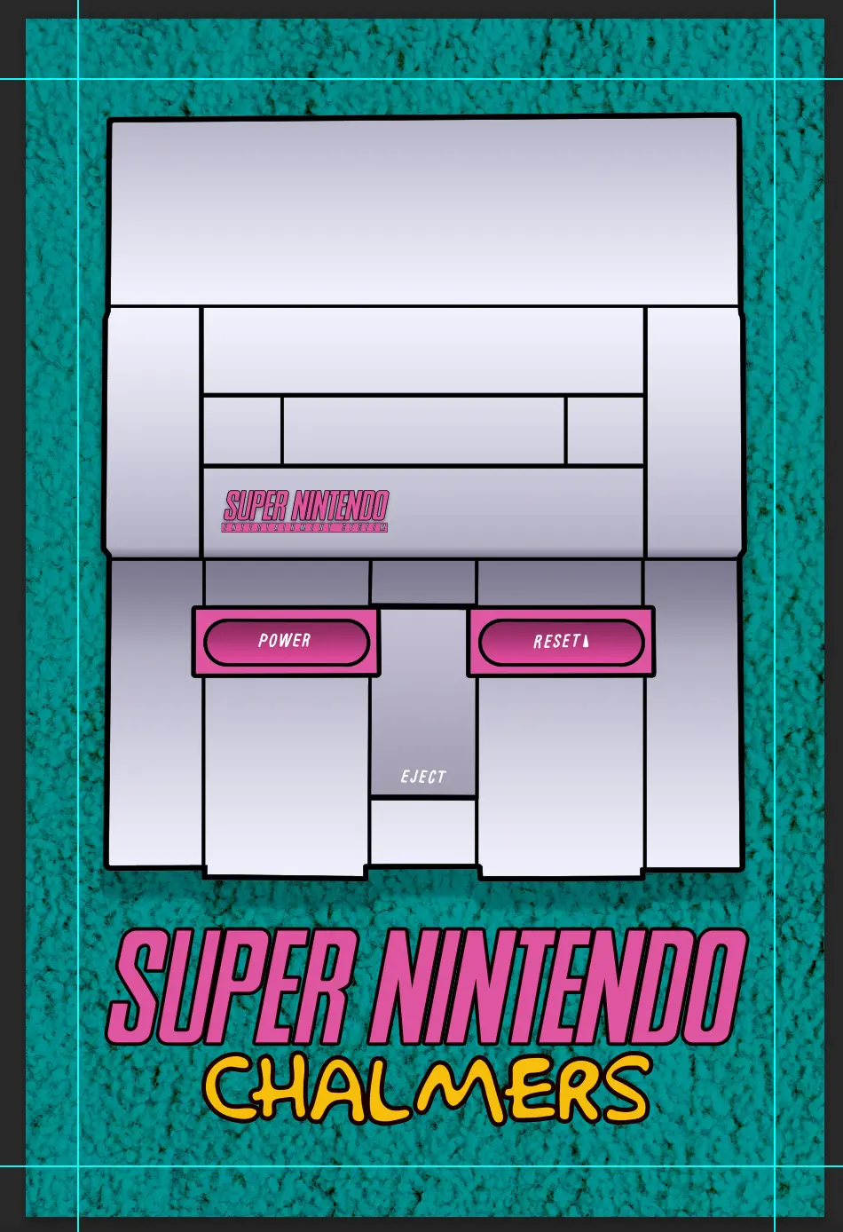

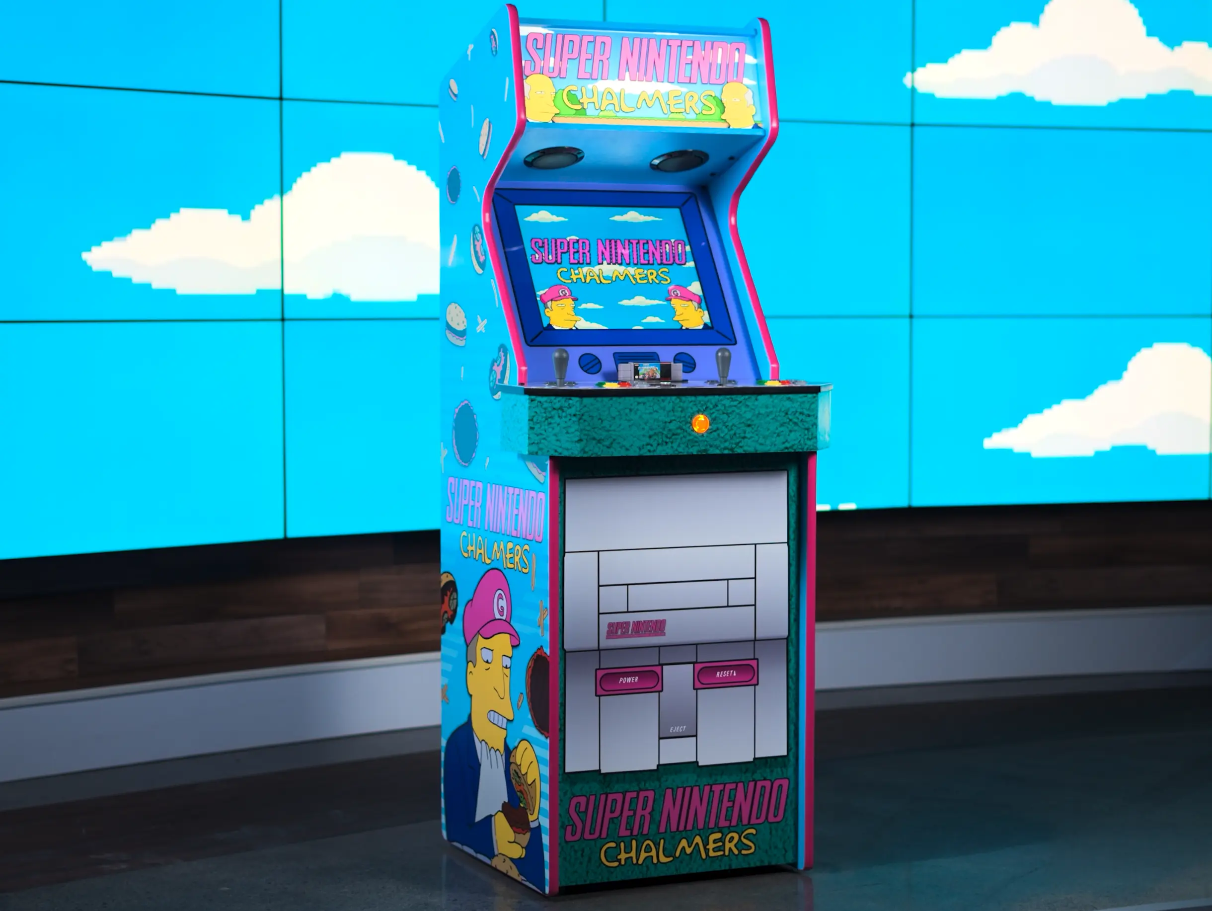

Okay, So I’ve got the name. That’s condition #1. Now what about the design and art?
One of the things I was most proud of with the Genesis 4 was the custom full-art vinyl wrap and the assets I created for the presentation. I spent countless hours in Photoshop and Premiere/OBS last summer and in the weeks leading up to MGC making sure everything was absolutely stunning. I am an art school graduate (survivor), so naturally the first thing I did was sketch out some concept art and cabinet designs.
One thing I knew I wanted to do differently than the Genesis 4 was that I wanted to build this cabinet completely from scratch. This is not going to be a modded Arcade1Up. This is not going to use wood from another structure. This is going to be 100% custom. I knew I wanted it to be roughly the same size/shape as my previous build, both so that it looked natural next to it in my apartment, and so that I knew I could transport it by myself. I also knew I wanted it to be a little less wide, since the 4 player control deck of the Genesis 4 barely fit through standard doorways. I spent the first few days sketching out rough dimensions for a cabinet, building those physical pieces out in a 3D model, and then nailing down the size of the individual pieces so I could begin actually decorating it.

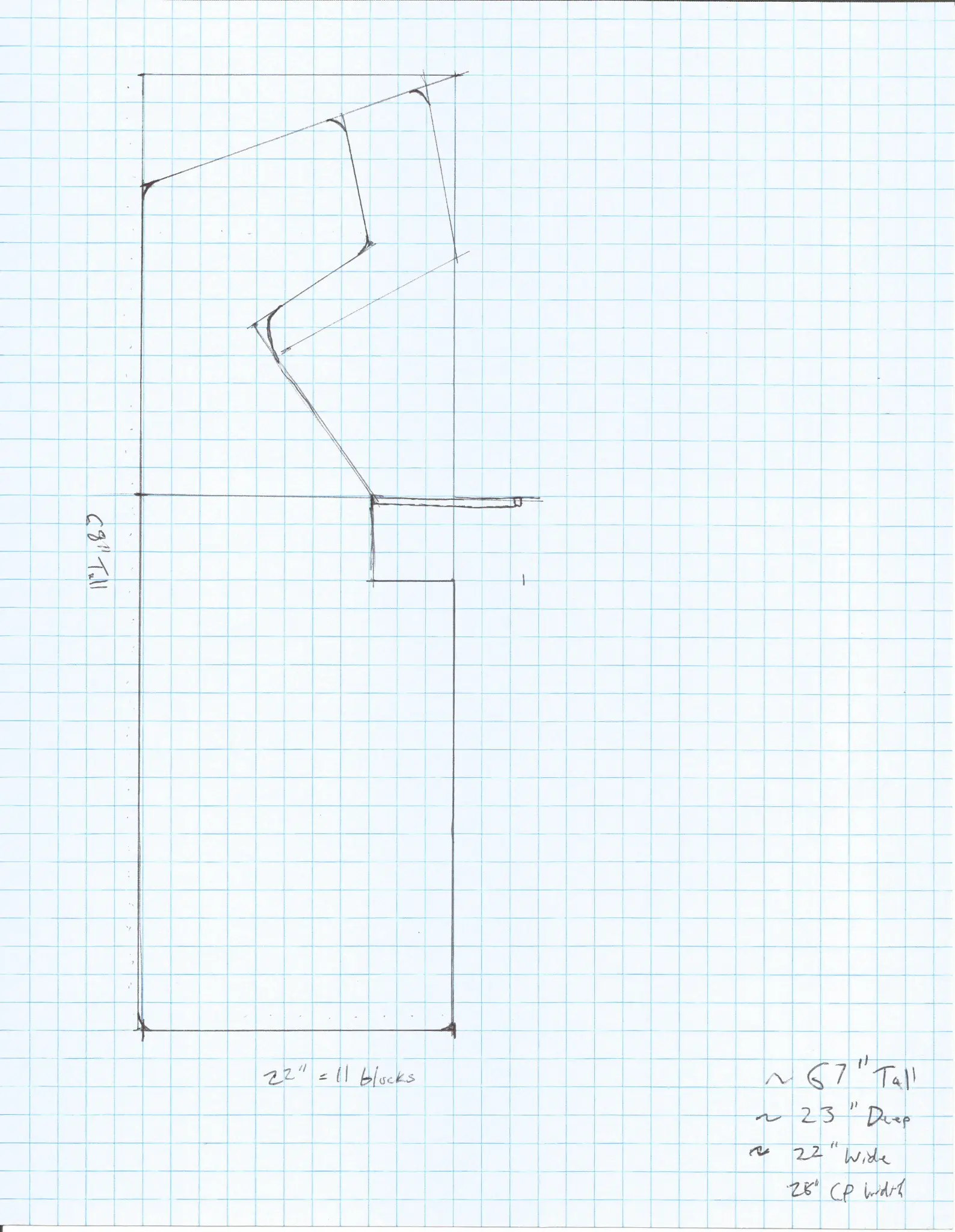

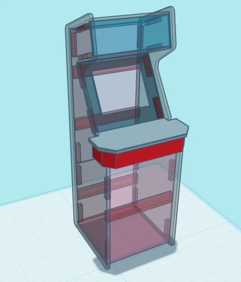

Showing the progression from drawing to early modeling to completed design

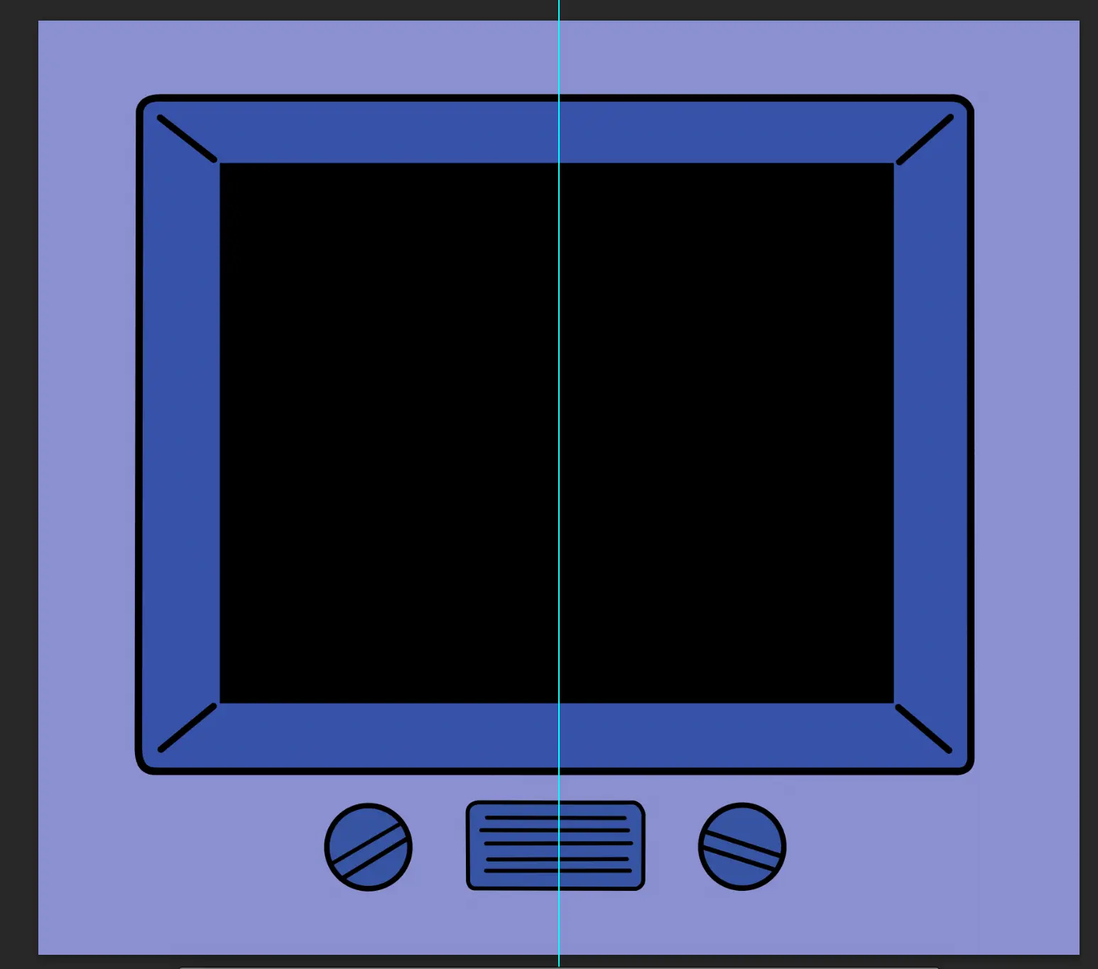

I knew that it would need good branding. Something more significant than just slapping stock Simpsons art onto a cabinet. After I nailed down the font/logo choices, I began assembling composites of reference artwork in Photoshop. I decided early on that I wanted to hand draw all of the elements (Apple Pencil on iPad) to give it that authentic “Golden-Era Simpsons” feel. With the Genesis 4, the first piece I designed was the marquee, so I figured I’d start with that this time around too.

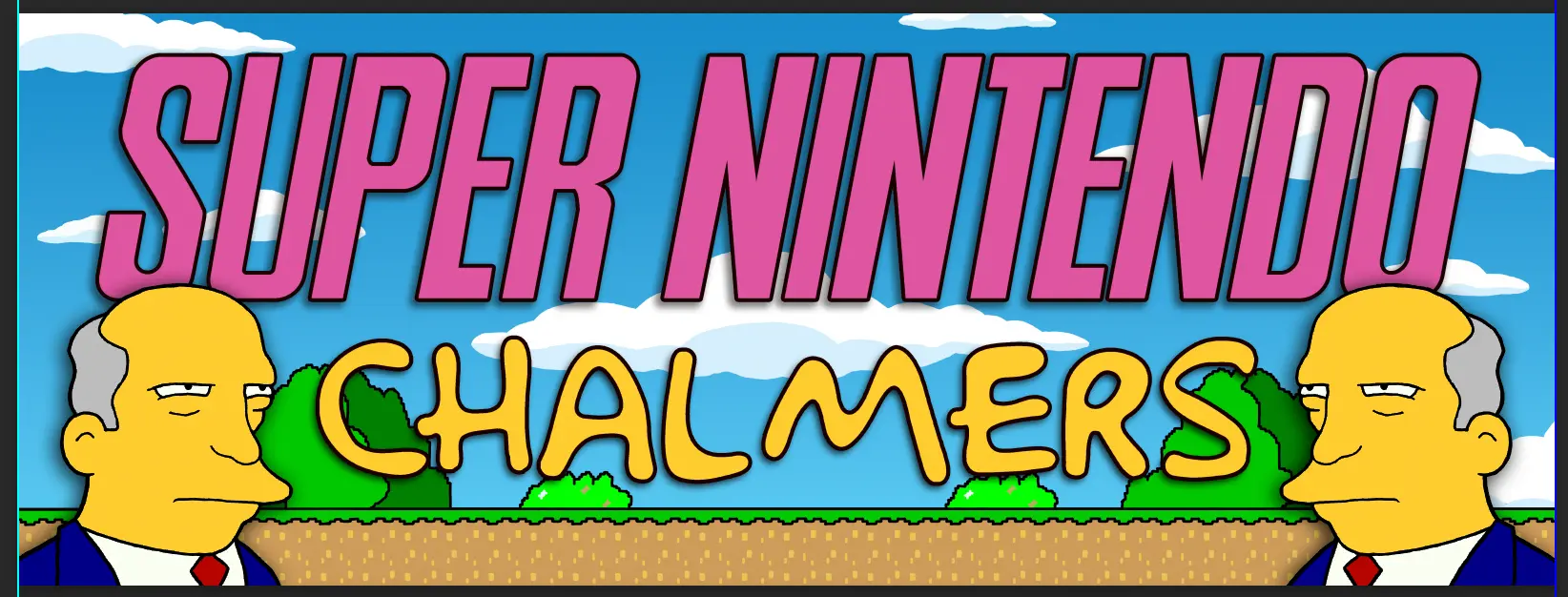

Marquee Design
For the Marquee, I decided to combine imagery of Superintendent Chalmers with some Nintendo flair. I tried a few different versions of this, and settled (for now) on this design. The base is a blue sky with clouds, referencing the show’s opening animation. The ground plane is directly referential to the environment of Super Mario World, which was a pack in title for the console for some time. Flanking the left and right sides are drawings of Chalmers himself, providing a strong visual anchor to the edges of the piece. Of course, featured in large bold text, is the name of the project itself. I chose this particular shade of pink for the Super Nintendo logo not only because it pairs well with the rest of the artwork (think of the Simpsons pink donut), but also because it will perfectly match the T-molding I purchased for the panel edges (more on that later).
Side Art Design

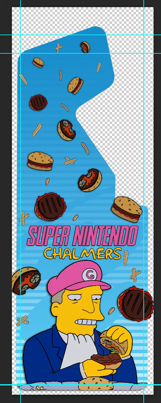

Alright, next it was Side Art time. Since this is the largest art piece on the entire cabinet, I knew it had to be special. I chose a still from the Steamed Hams segment from Season 7 Episode 21 “22 Short Films About Springfield” for the main part. It features the superintendent inspecting the patented SkinnerBurger©️, which he is originally told is called a Steamed Ham, despite the fact that it is obviously grilled. I gave him a bit of flair with a pink Mario-Style hat to tie it in with Nintendo a little bit more. You may also notice the subtle alternate SNES logo behind him, which gradually fades into the same sky-blue towards the top. The rest of the negative space I filled with a bunch of Steamed Hams and fries falling from the sky, just because I thought it was goofy. I only actually drew 3 different hams and fry designs, and just rotated and repeated the design to save time, as hand drawing all of those assets is extremely time consuming.

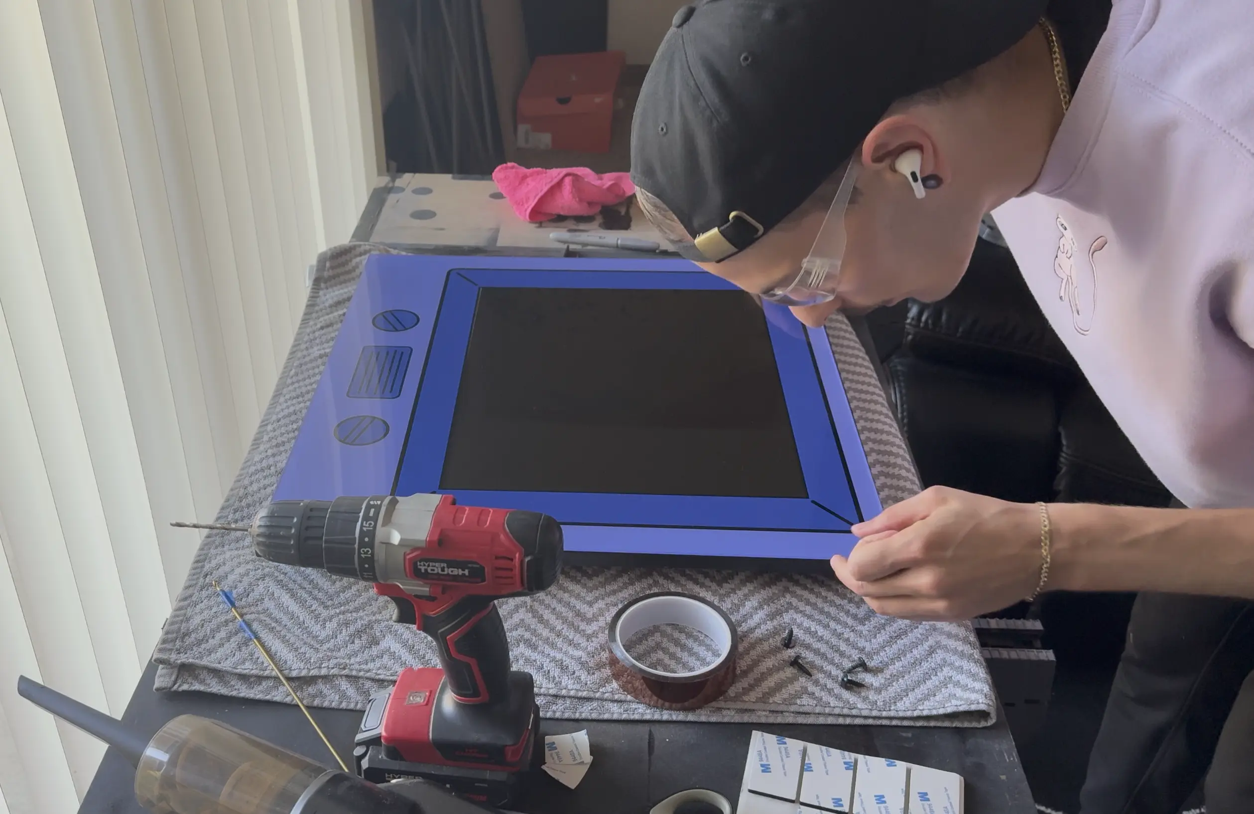

Bezel and Kickplate design
Next I decided to work on the Bezel and Kickplate art. These two pieces are designed to give the cabinet sort of a “Simpsons Living Room” vibe. For the kickplate, I decided to make a vector drawing of a stylized SNES console with pink accents, replacing the usual purple. For the background, I used an image of a carpet and blended that with a solid color layer below to match the exact shade of teal that is in their living room, and of course, the bezel is a redesigned version of the Simpson’s living room TV.

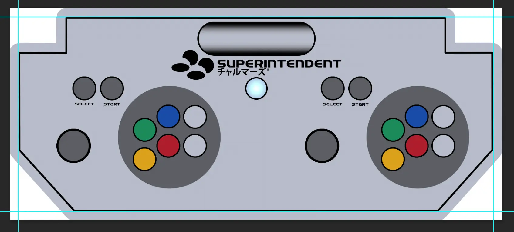

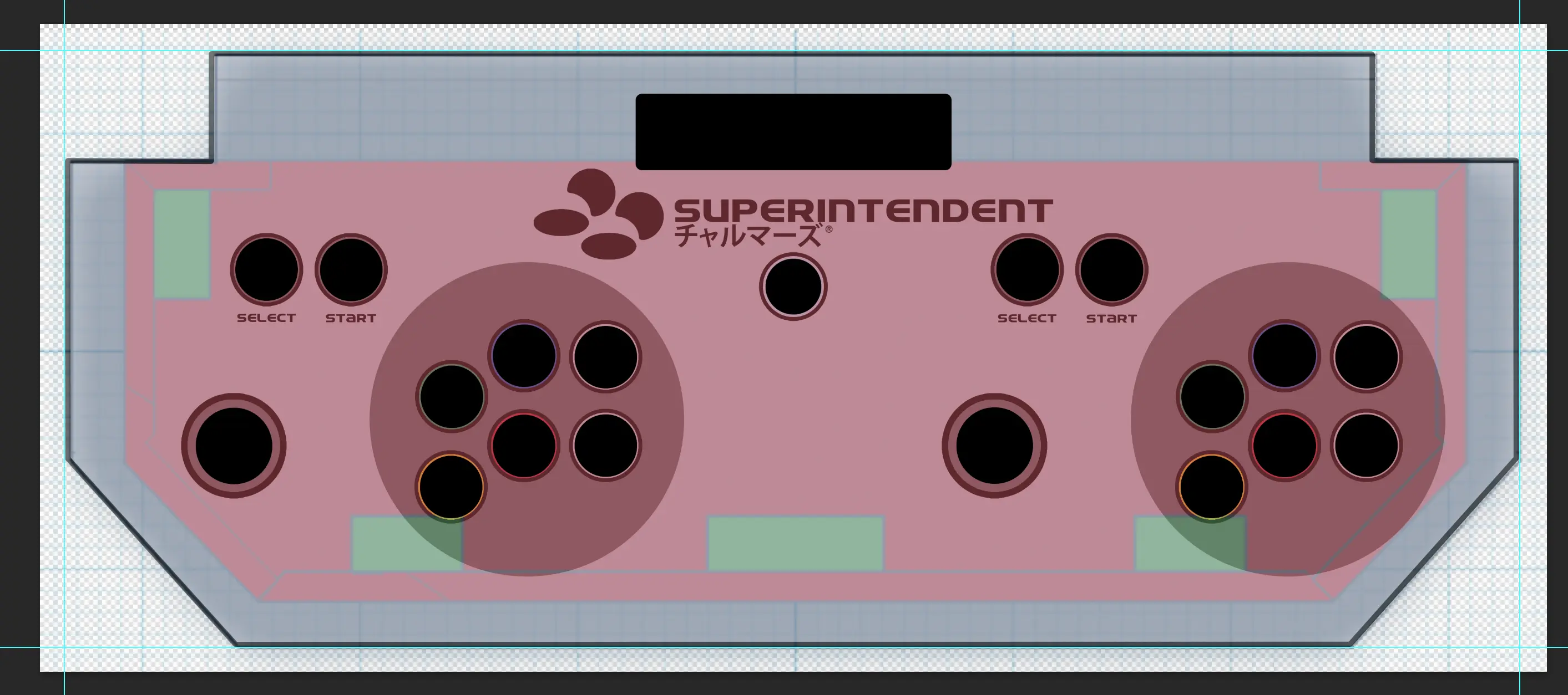

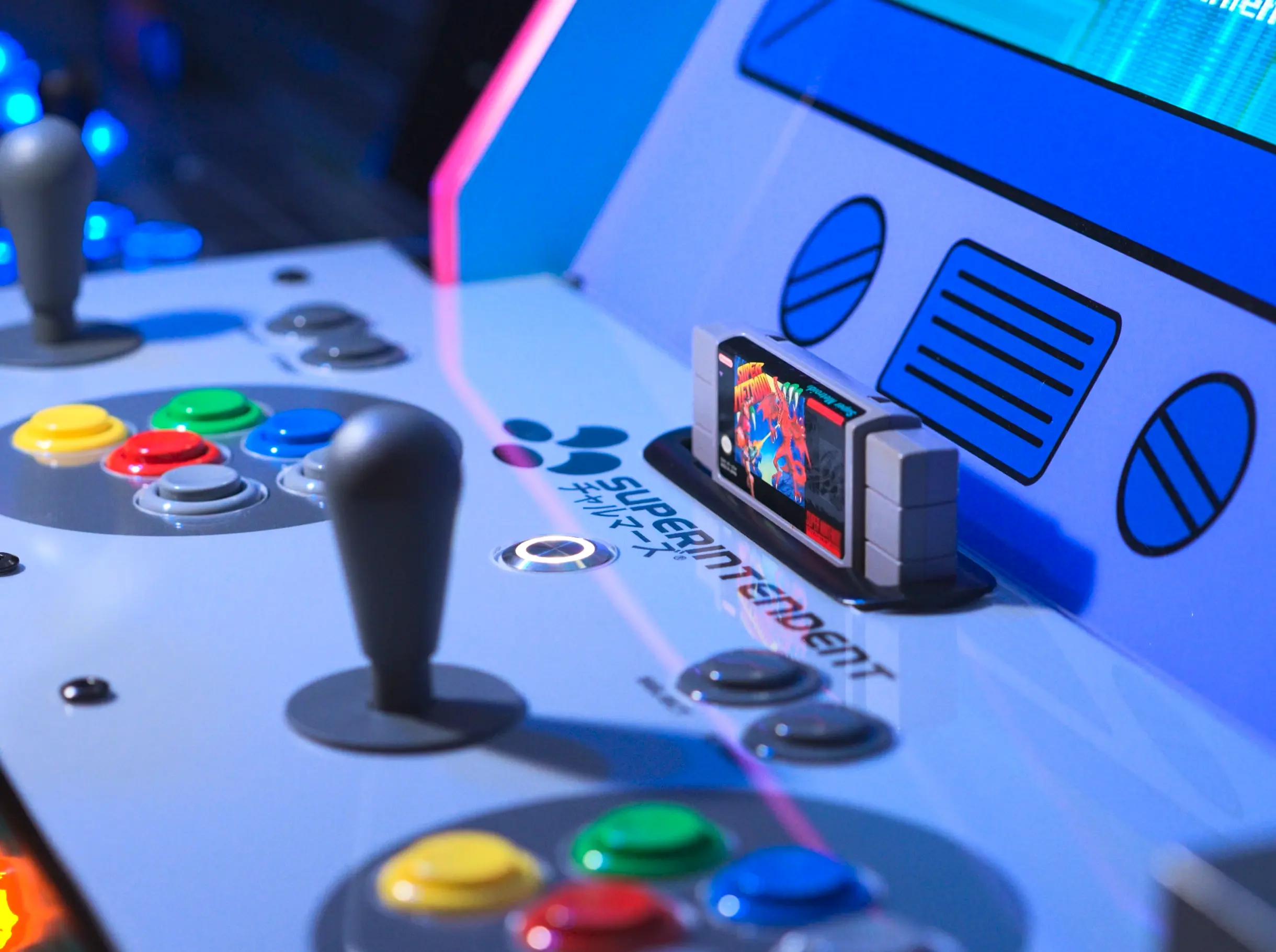

Control Panel Design

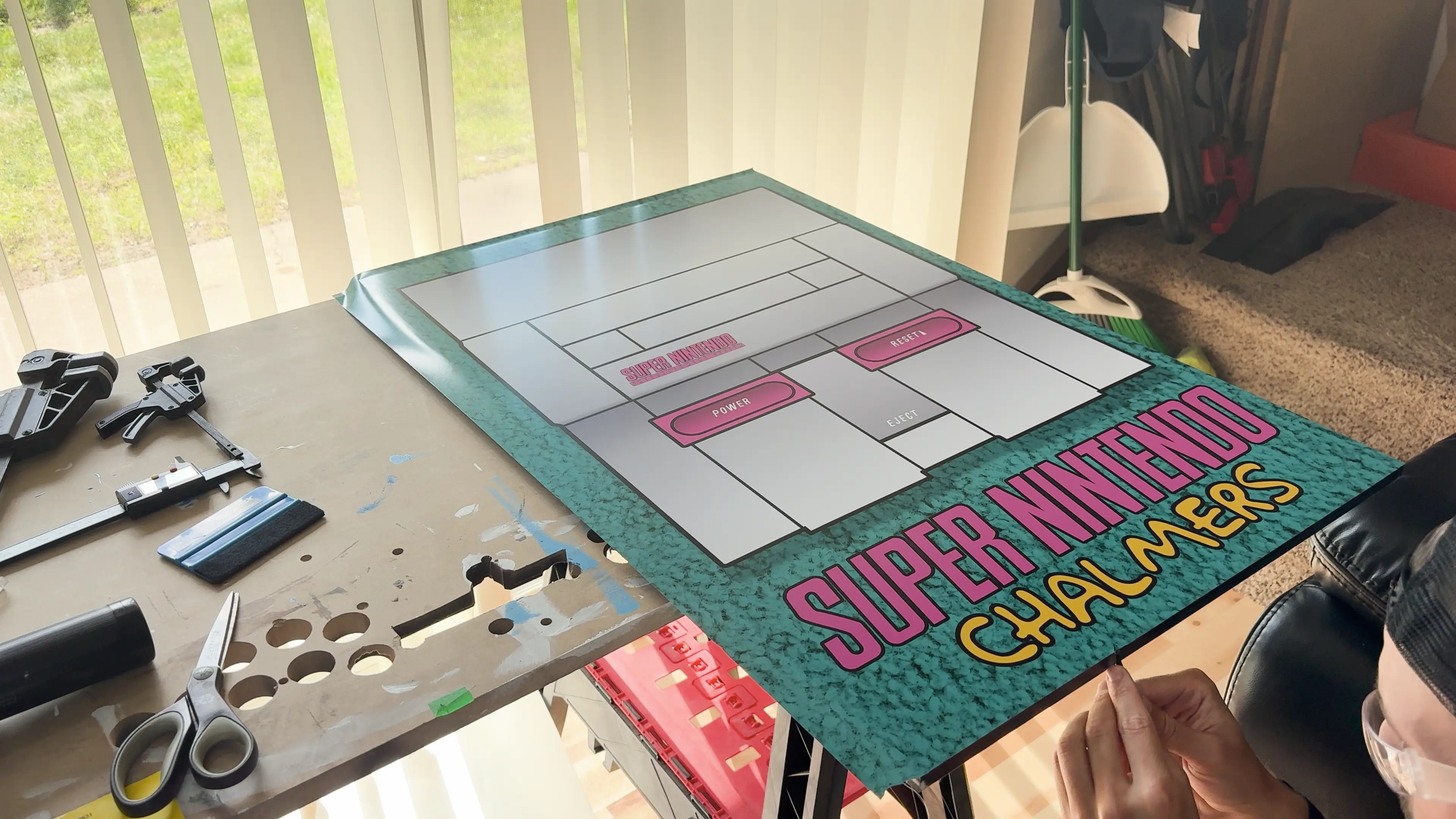

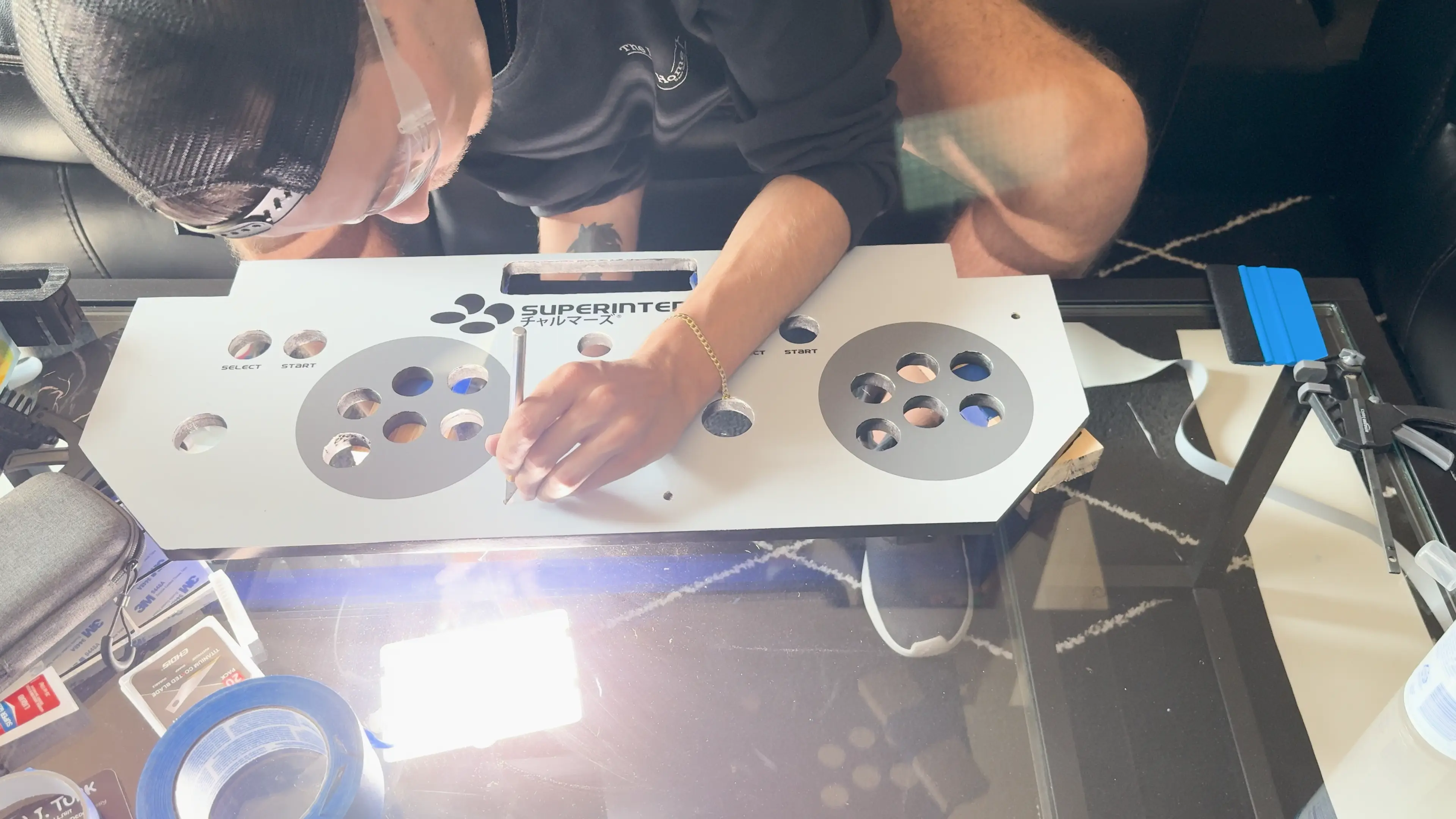

The final piece was the Control Panel. For this, I tried many different designs, but the one I settled on is probably the least Simpson-y thing on the whole cabinet. I really wanted to pay homage to the Super Famicom in some way, especially since I plan on having the cabinet be fully compatible with both North American and Japanese cartridges. I am really drawn to the color scheme of the Super Famicom controllers, as I feel that the buttons are much more clearly indicated and I’m really big on keeping control panel design minimal. The Japanese text (according to Google Translate) literally says “Chalmers”, so I thought it was a fun subtle way to tie in the Simpsons theming while also giving it that classic look everyone will instantly recognize.

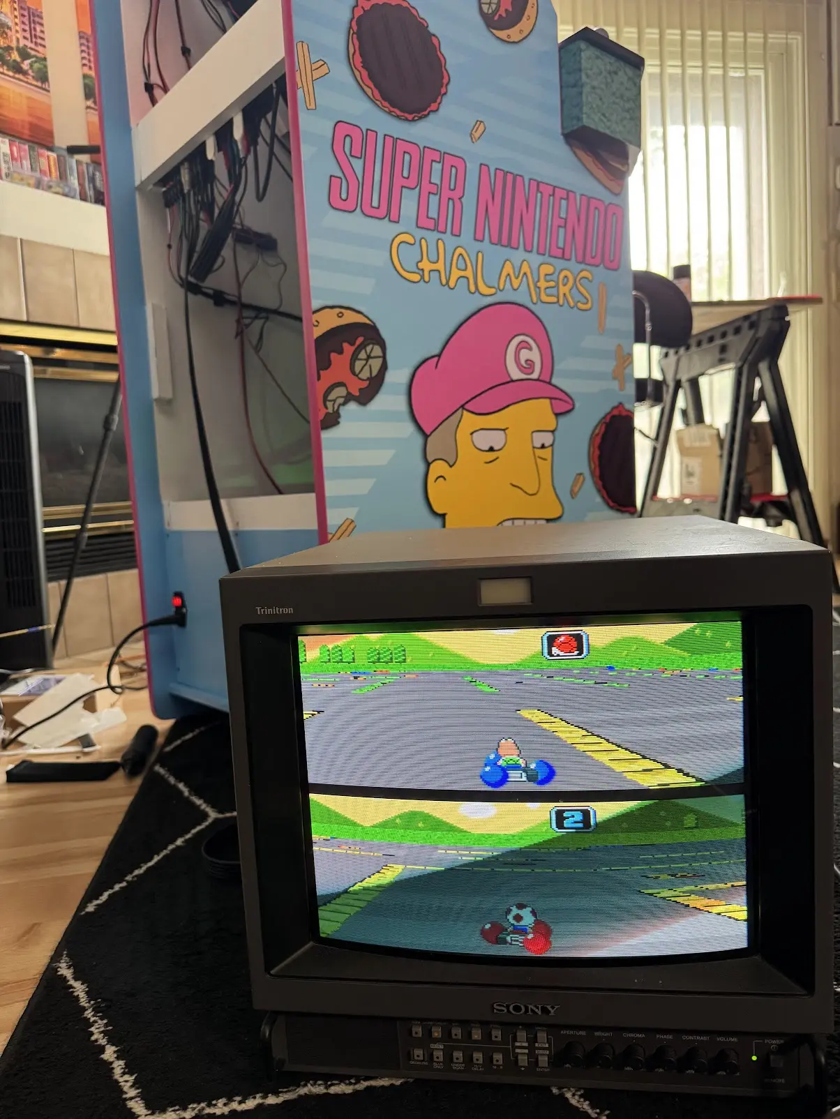

Now that condition #2 was met, I needed to come up with something that made it unique. Besides the aggressively themed artwork, what really is going to set this apart from just being a “pretty” console? It’s not going to be 4-player, that idea I had scrapped early on. I thought long and hard about what I could do to embrace the meme, and I think I came up with a pretty good solution.

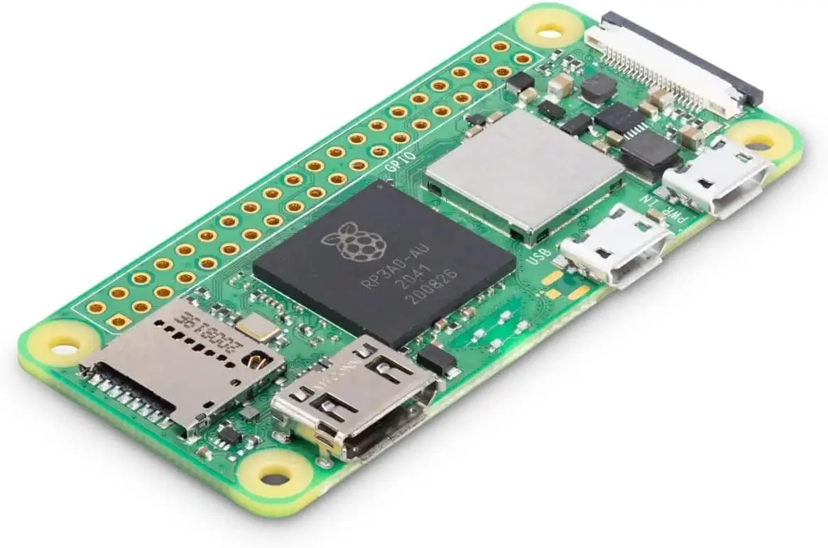

My first idea was a custom startup animation. Now, this is something that would be easy to do if I were just taking the easy route of emulating, but gets infinitely more complicated when you’re dealing with real hardware. How would I get a specific video to play when the console turns on? Also, how would I make sure that after the video concludes, there is a seamless transition into the startup screen of the game? I knew that I’d have to integrate a second device to accomplish this. I looked into controller boards for Digital Signage, but they were expensive and harder to customize. What I eventually settled on was the Raspberry Pi Zero 2 W.

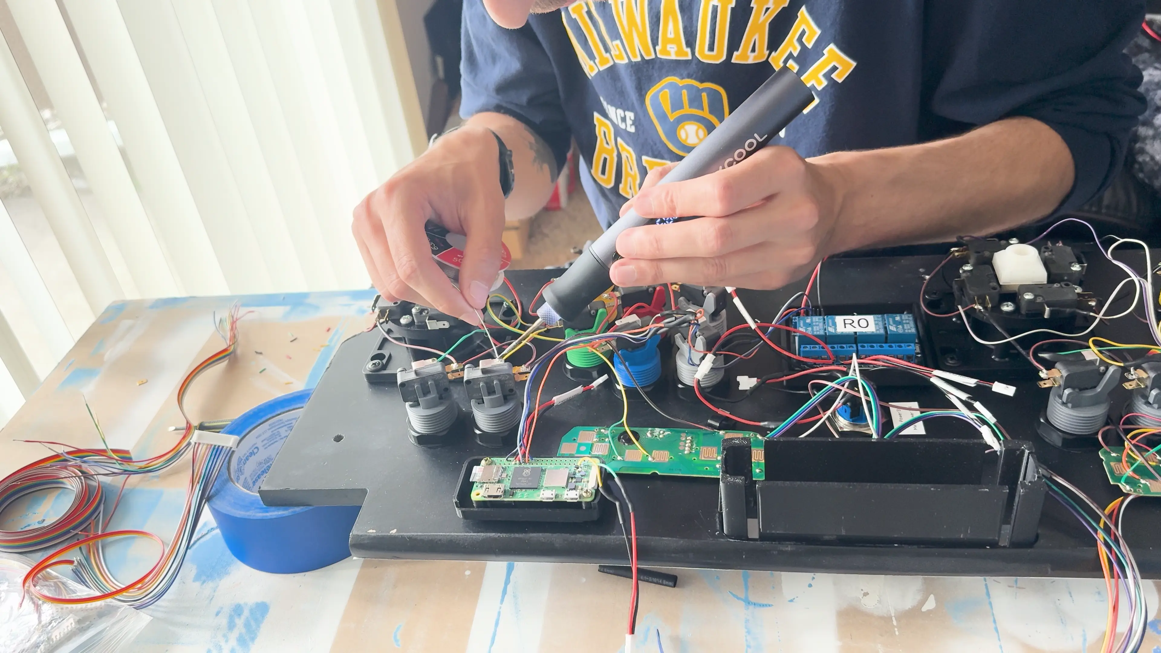

A Raspberry Pi Zero 2 W
I chose the Pi because I know a lot of people really like them, and that they are extremely customizable. I found that the Zero 2 W had all the technical capabilities to accomplish what I wanted, but I still needed to figure out how to transition from that to the actual console. I shopped around and decided to buy an Auto HDMI Switcher. The idea being that the Pi would play the short animation, turn off its HDMI signal, and the switcher would detect it was no longer “live” and auto-switch to the SNES (via the RetroTINK 5x Pro, naturally). Seems like a slam dunk, right?

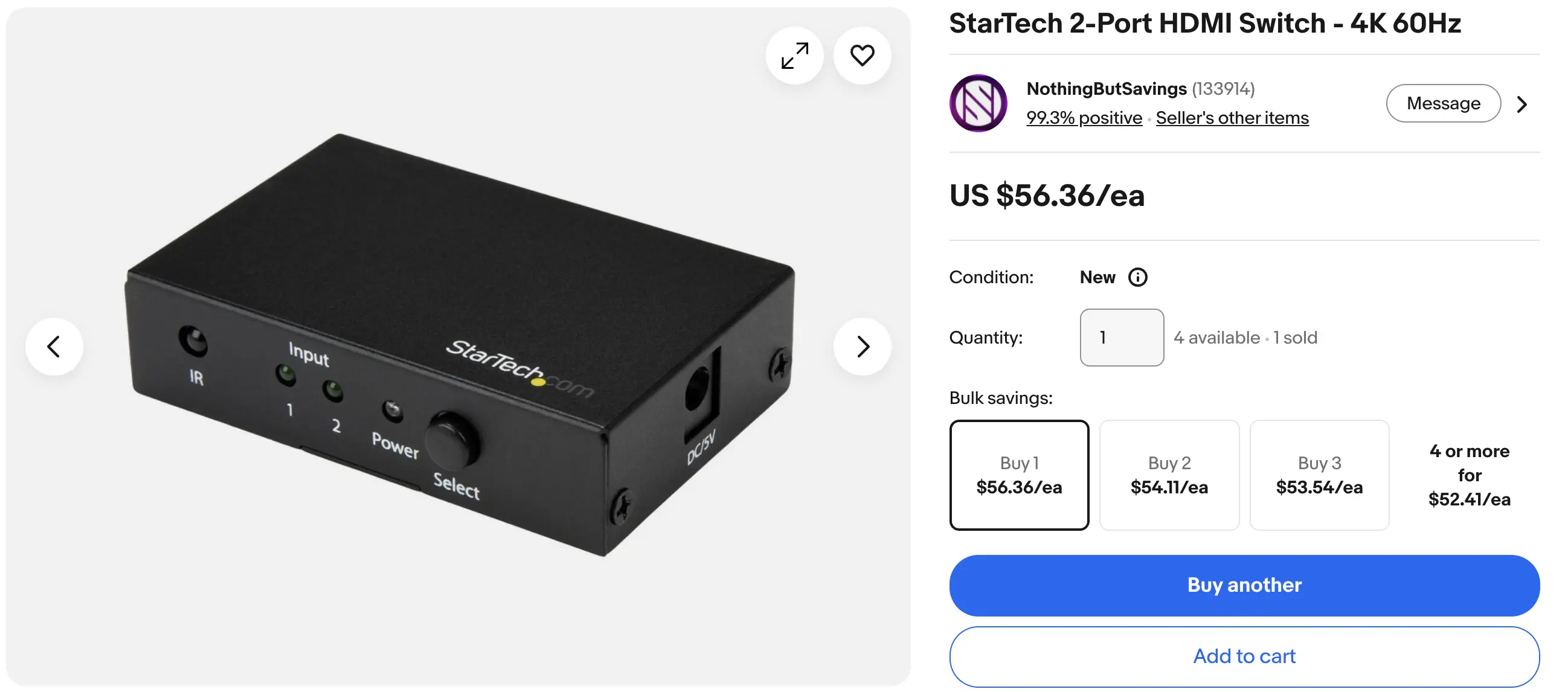

The stupid Auto HDMI switcher I bought
WRONG!!
Looking back, it does seem too good to be true. Plus, that solution would have meant that I lose however many seconds from the opening sequence of whatever game I was playing, which is also a no-go. You see, the HDMI switcher really only knows to switch automatically when it detects that a new source SENDS a signal, not when another drops it. That really sucked because that single component was like $60, and I know that a “dumb” switcher would be just as useful if I was going to manually control it anyways. Okay, so how do we get this to all play nicely together? Well, that’s where my old friend the RELAY comes in…

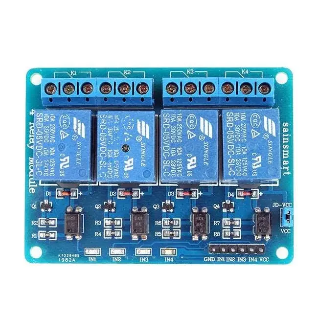

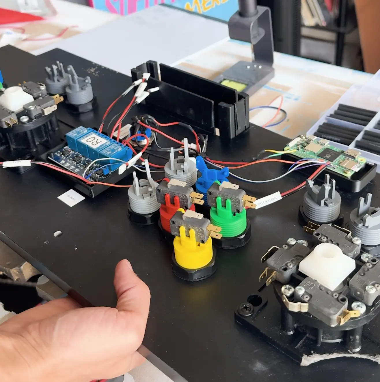

A 4-Channel Relay Module
I used a total of 42(?) relay channels in my last build (5x 8ch, 2x 1ch I think) to control the vast network of control signal routing. That was honestly the greatest engineering feat if you ask me. Now, there certainly are more elegant solutions, but for someone who was basically starting with zero knowledge of electronic switches a little over a year ago, I was extremely proud of my extremely mechanical solution to that problem. Well wouldn’t you know that a RELAY was once again going to bail my ass out. I started with just one relay channel, but decided pretty quickly that I’d need two to get it right.
I luckily already had a spare 4-channel relay left over from last summer. By utilizing the GPIO pins on the Pi Zero, I’d be able to precisely time the control signals to the relay to do exactly what I needed. The first channel would be used like a time-delay switch to start the console just as the opening animation is ending, and the second channel would be used to temporarily “pulse” the HDMI switcher to trigger an input switch just after. This way, the video would play, and then it’d seamlessly fade to black and the first screen of the game would come right after, as if it was built right into the console!
Demonstrating the Relay Timing

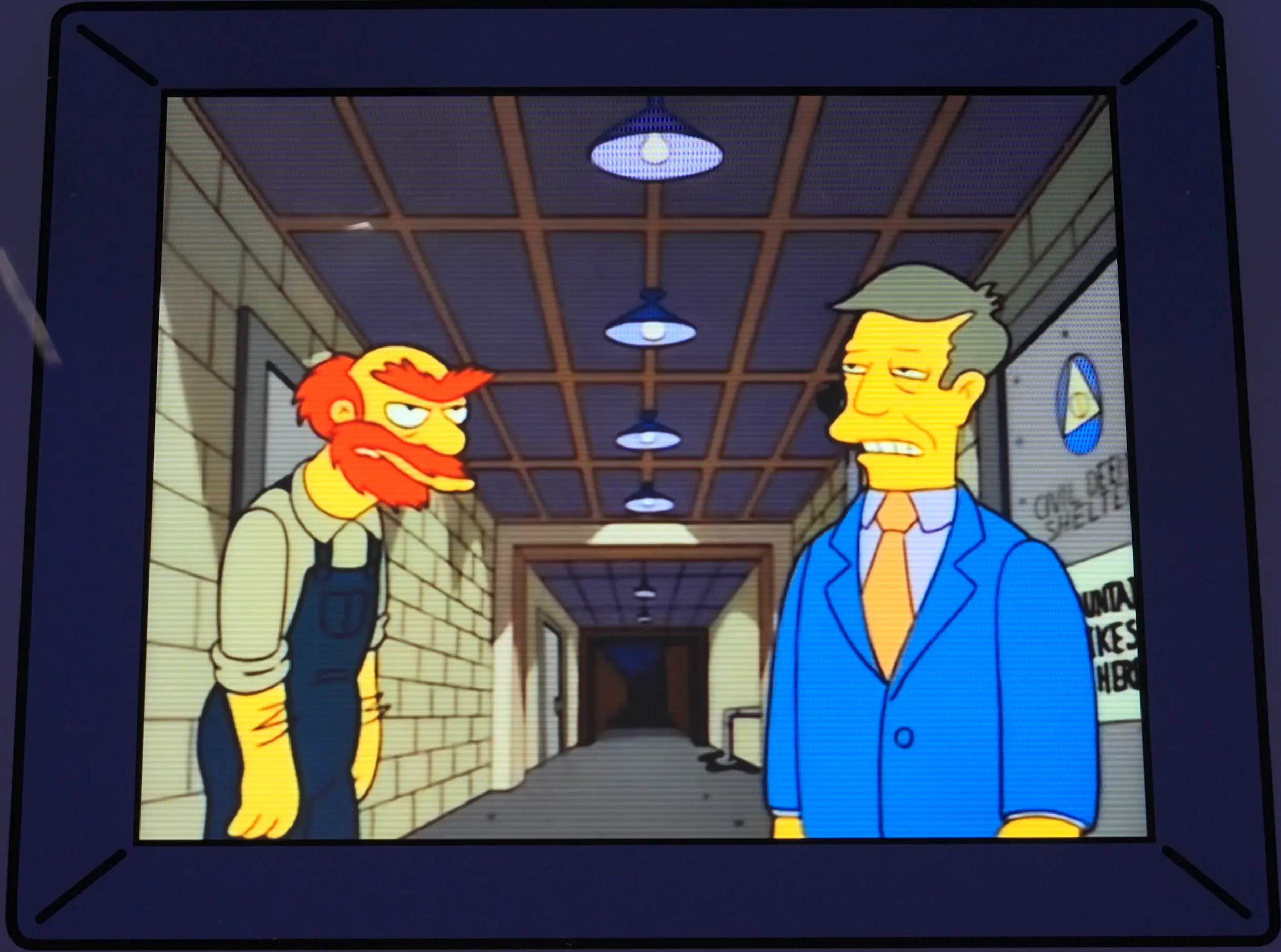

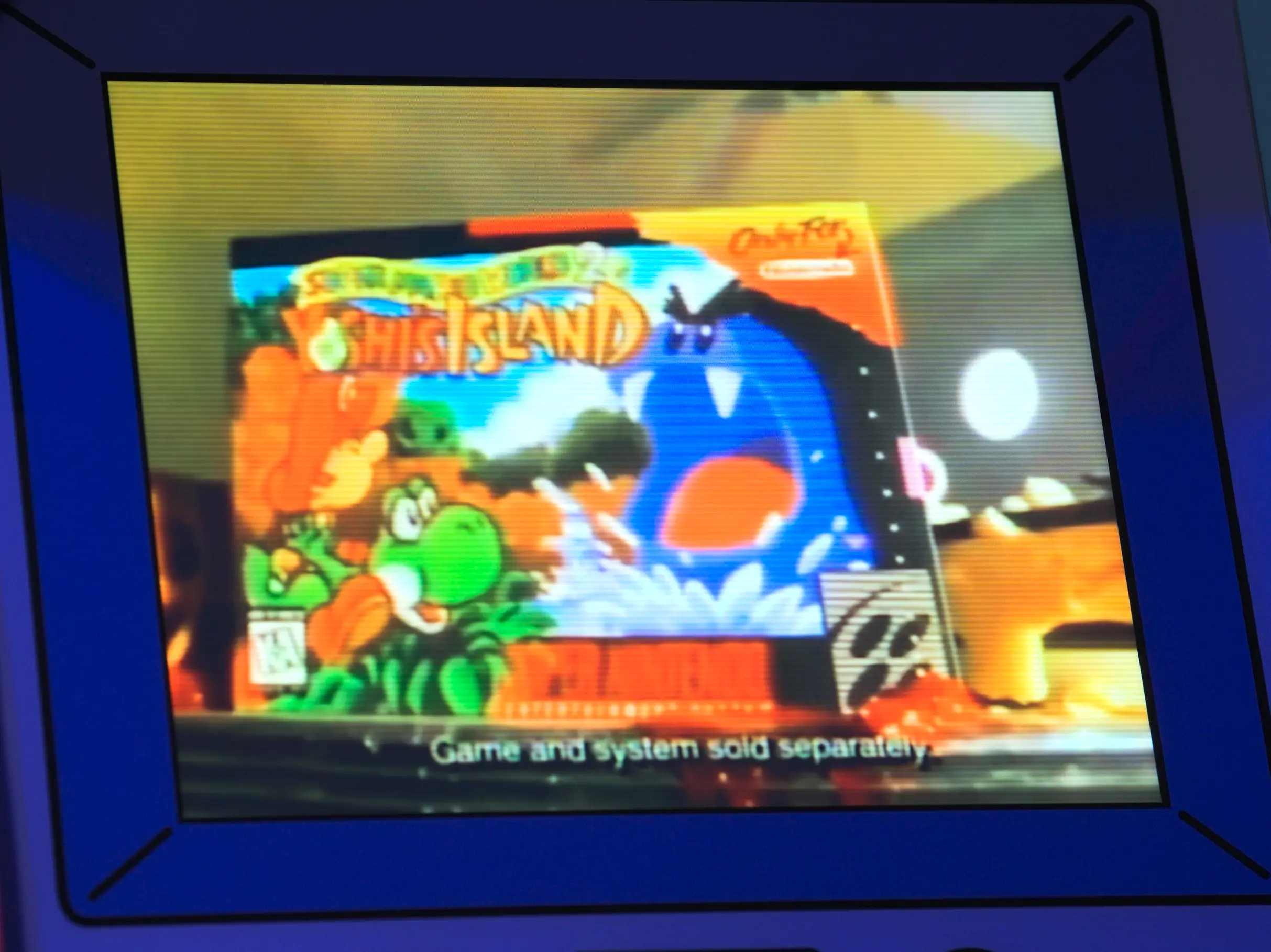

But the fun doesn’t stop there. Since I had already committed to adding the Pi, I thought it’d also be fun to have a Chalmers soundboard. I bought an illuminated 30mm yellow pushbutton that I’m planning on putting front and center on the vertical face of the control panel (similar to how I had my two latching pushbuttons on the Genesis 4). This button will play a Superintendent Chalmers sound clip every time it is pushed, completely independent of what the rest of the cabinet is doing. To accomplish this, I had to hook up a separate USB sound card to the Pi, and I’ll have a separate mono amp and speaker inside so that it can happen independently. For now, I’ve got 10 audio clips from the Steamed Hams segment loaded in, and for now they also play sequentially, but I may change that later.
Demonstrating the Soundboard Functionality

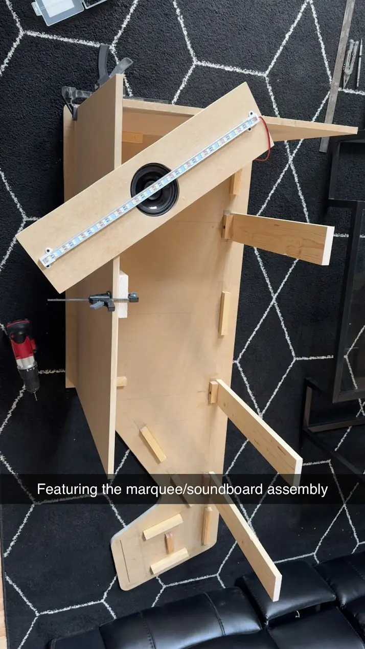

BUT WAIT, THERE’S MORE: Since we’re already fully leaning into the meme, I’ve also added a second function to the yellow button. If you press and hold it for 3 seconds, it plays the Steamed Hams clip in its entirety. This “easter egg” functionality was a bit complex to integrate, as it should happen regardless of the state the cabinet is in. So, if the cabinet is in “SNES OFF” mode, it simply launches the video. If the cabinet is currently running a game, it rolls the video (with a few seconds of black “pad” beforehand) triggers an input switch back to the Pi, and plays the video while keeping the game running in the background. At the conclusion of the clip, it simply returns to whatever state it was in beforehand. You can also manually bail out of it by holding the button for 1 second.
Demonstrating the Steamed Hams Easter Egg

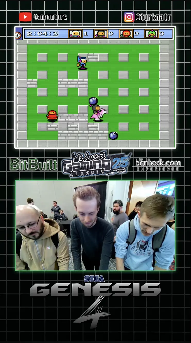

I do plan on adding a similar Livestreaming functionality just like I did with the Genesis 4 in the weeks leading up to MGC. Let’s consider that a stretch goal. I certainly don’t need that to be added to feel that it is complete, but hey, it’d be pretty dope to have that done early since I know how to do it already.
The Livestream from MGC 2026

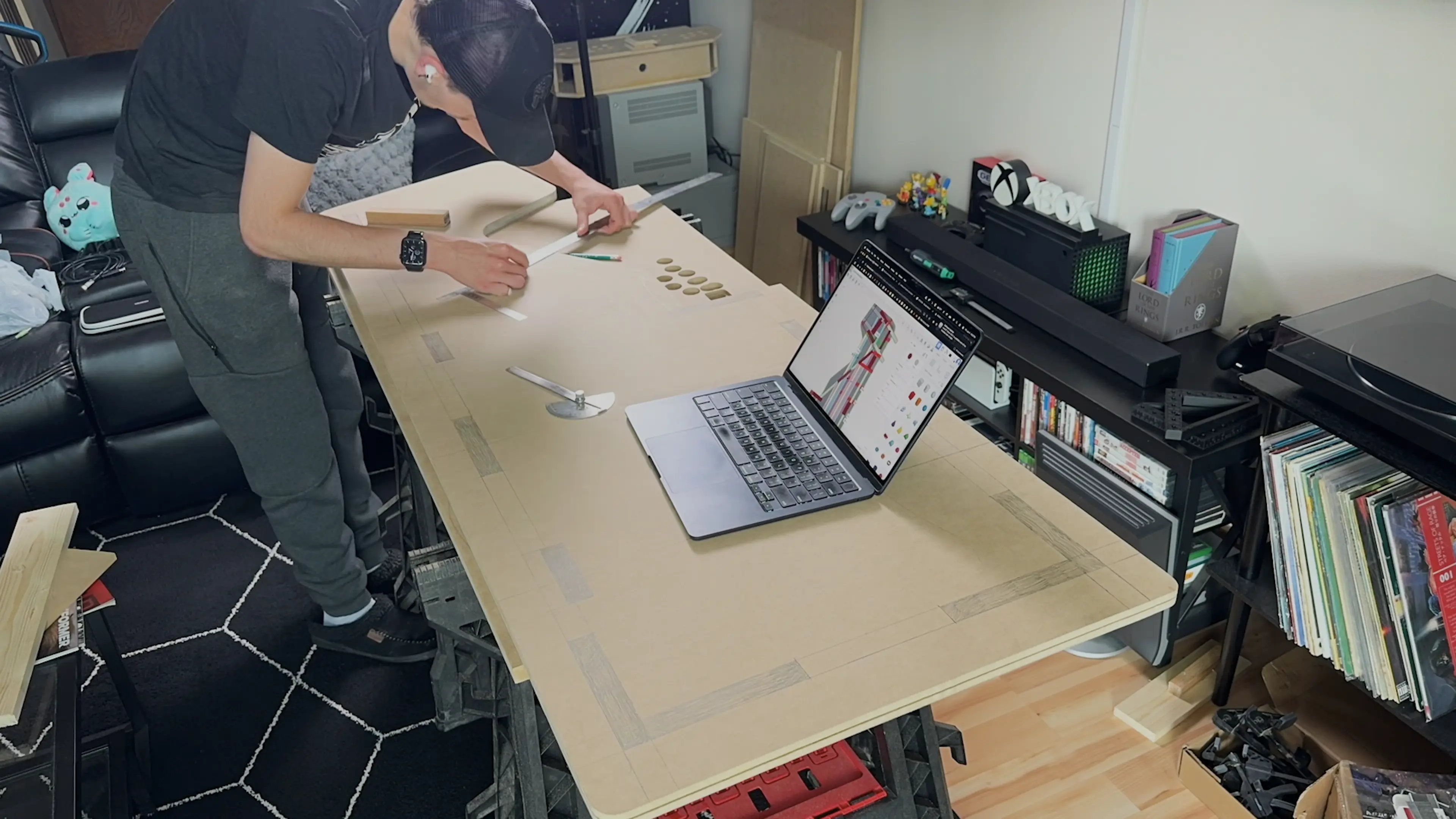

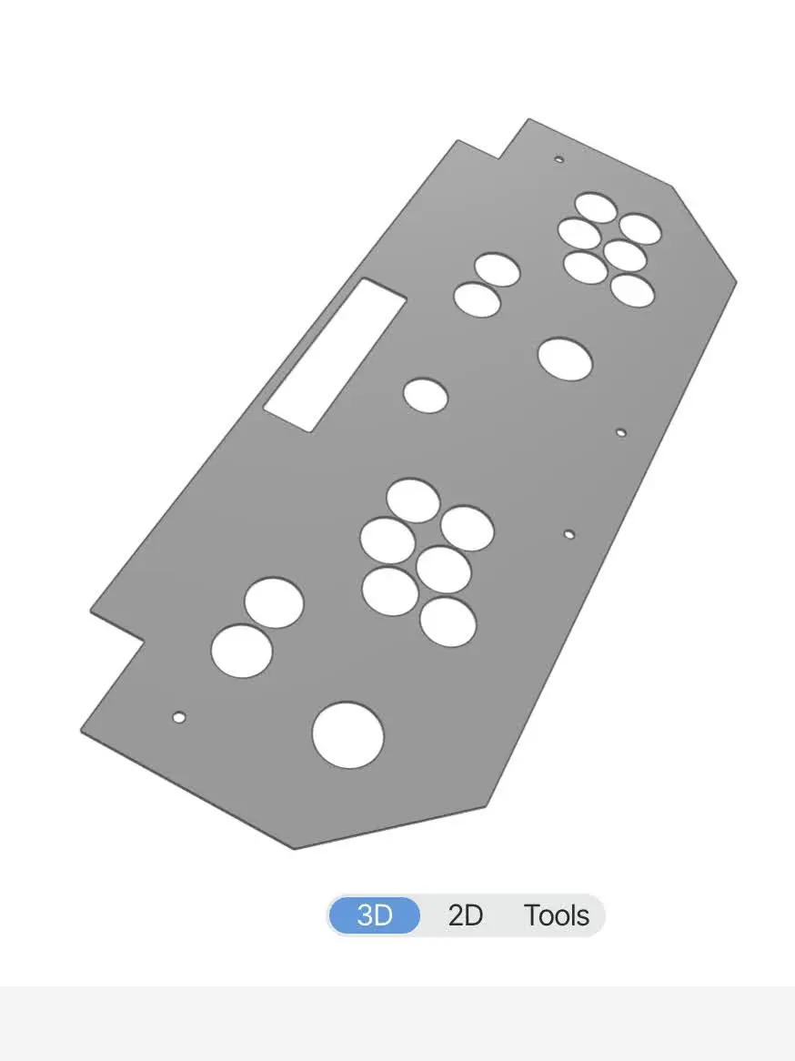

Pretty much everything I've been working on the last few weeks is all related to the physical structure. I had already designed the entire cabinet in a mixture of 2D and 3D using Photoshop and TinkerCAD. I'm not familiar enough with anything more advanced/specialized, but for my purposes it worked just fine. Certain complex pieces like the control panel necessitated Photoshop's precision, but for the large panels TinkerCAD was just fine.

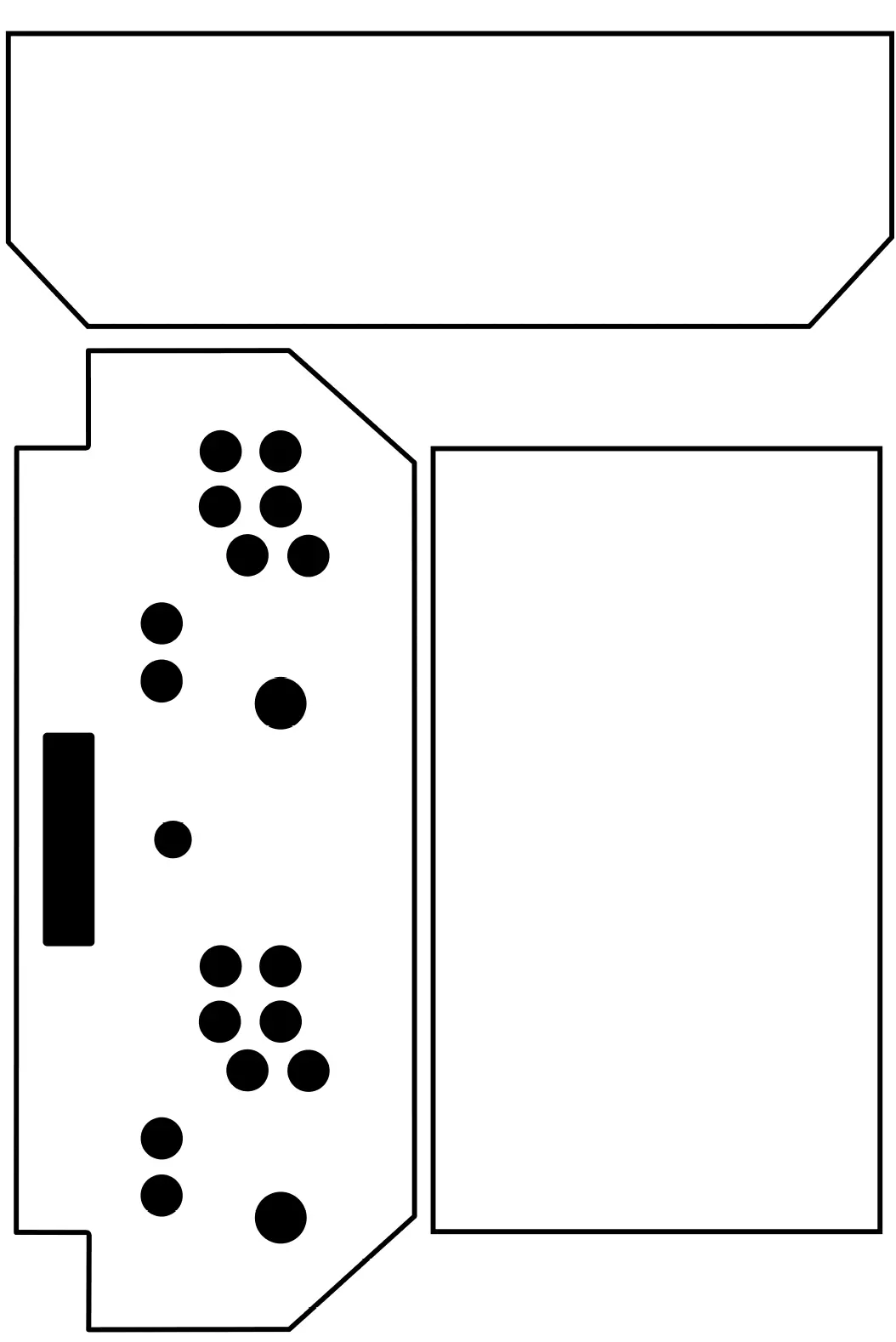

Photoshop layout demonstrating the translation from 3D object to 2D cuts.

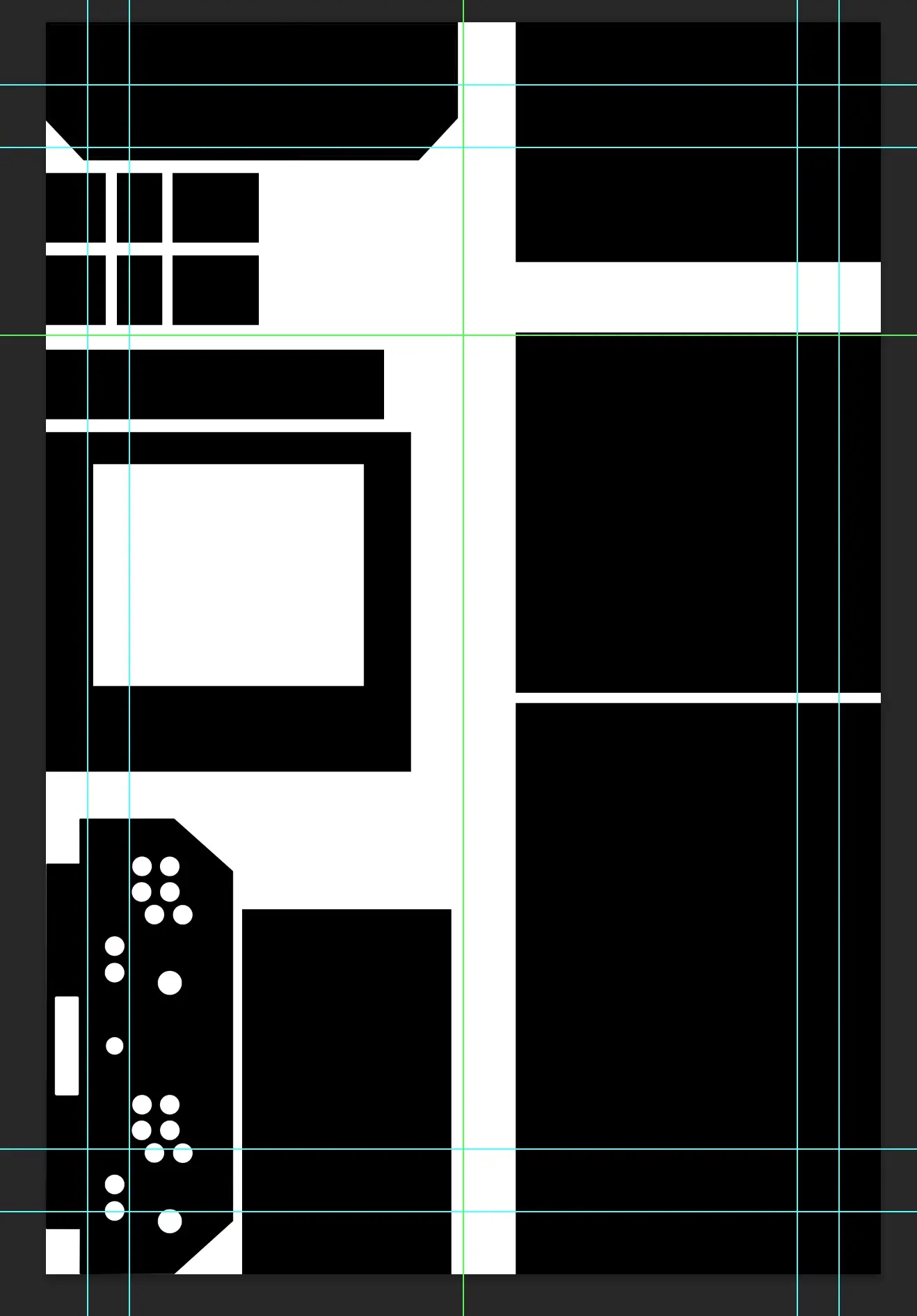

I then translated all of the pieces, large and small, from the 3D model into a few 2D PSDs categorized by the thickness of the wood I'd be cutting it out of to get an idea of how much MDF I'd need to buy. Because I designed the 3D model in TinkerCAD, I used millimeters as the units, and made everything 1:10 scale. I then translated these measurements inches for the actual wood. For the PSDs, I needed to convert these values AGAIN to pixels with a density of 300ppi. There was a lot of unit conversion going on here, but it was necessary to keep everything precise.
An example of a 4'x8' Photoshop layout for wood cuts.

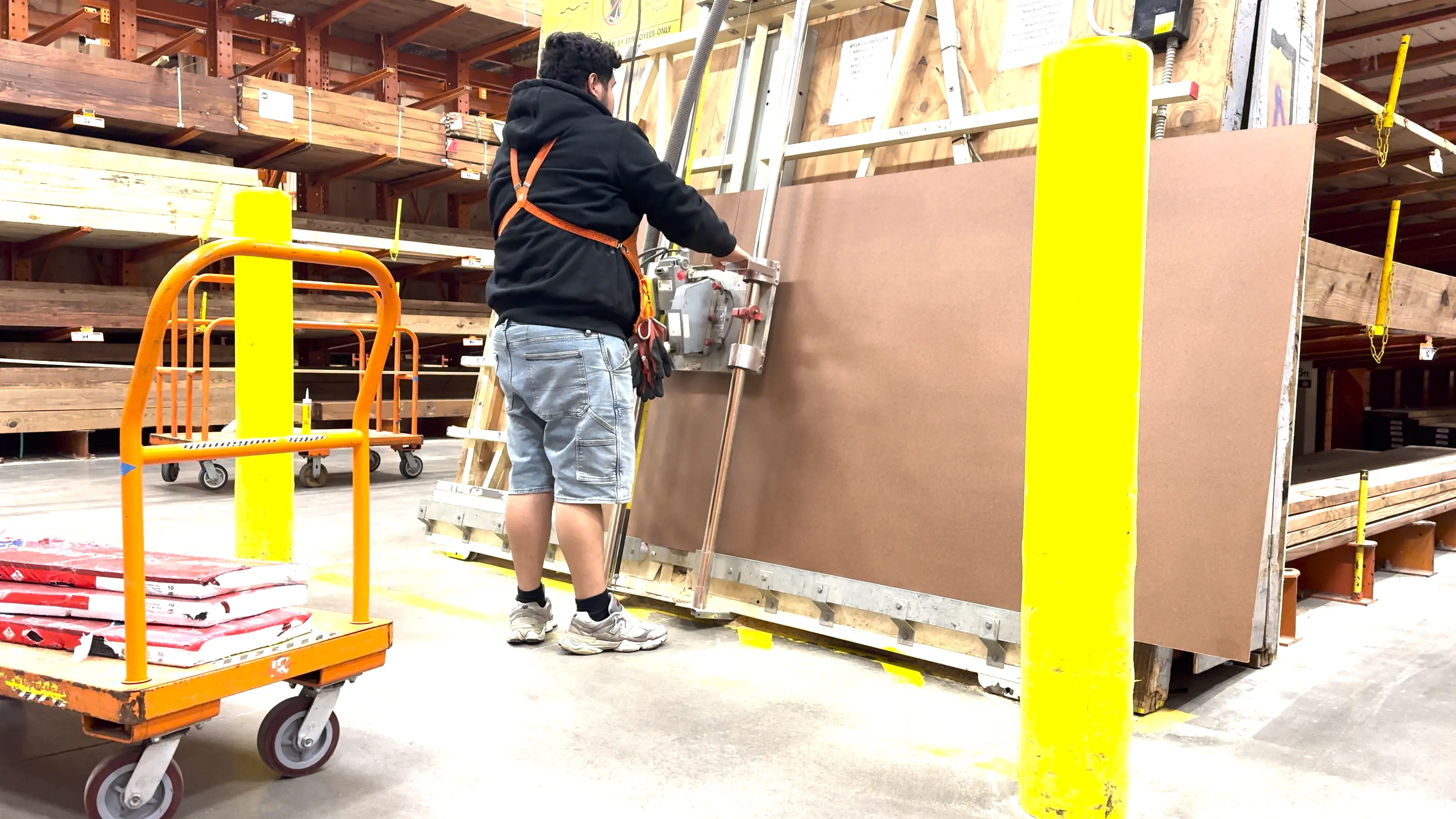

About 2 weeks ago, I went to Home Depot and bought all of my wood. I got 3 sheets total, 1x 3/4" MDF, 1x 1/2" MDF, and 1x 1/8" hardboard. I also got a 1"x4" 8' pine board to use for spanning beams, and about 20' of 1"x1" pine moulding to use for cleats.
The employee at Home Depot cutting down the large 4'x8' panels so I could fit them in my car.

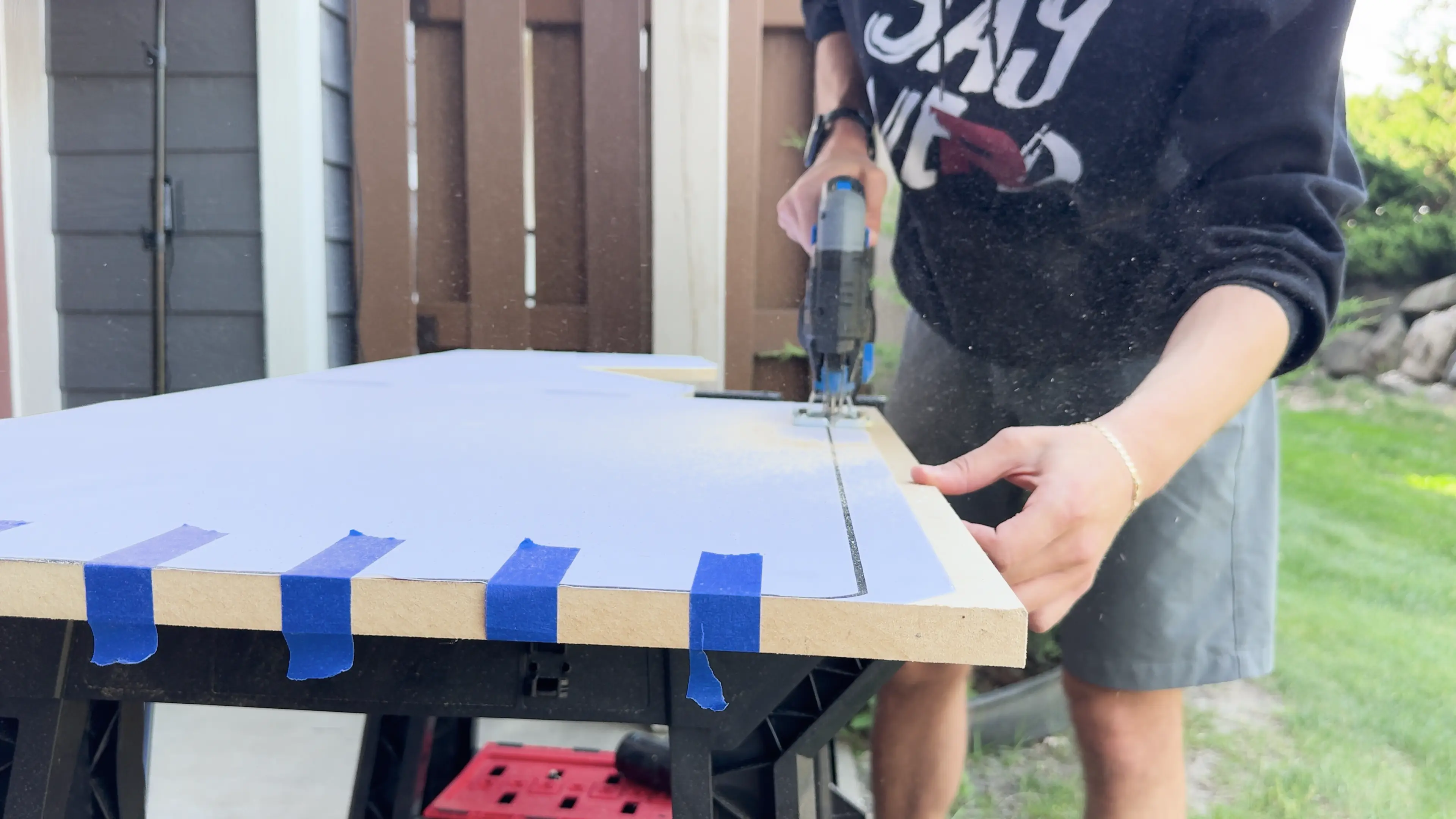

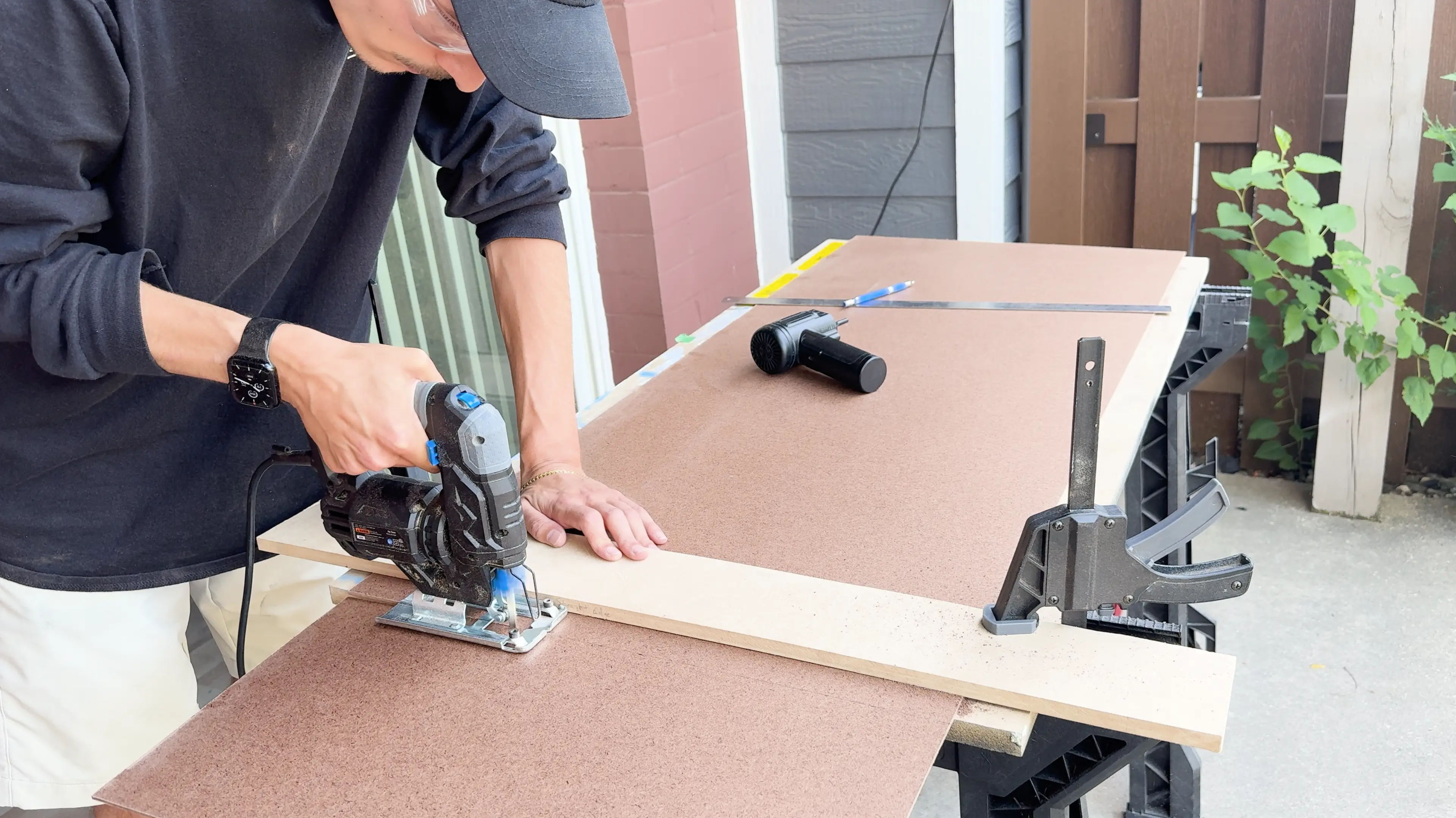

With everything on hand, I spent my next set of days off from work heavy on the power tools. I used a repositionable spray adhesive to attach the paper templates to the surface of the MDF, and then just followed juuuuust outside the lines for the majority of the pieces.
Cutting what I would later discover to be an incorrect side panel.

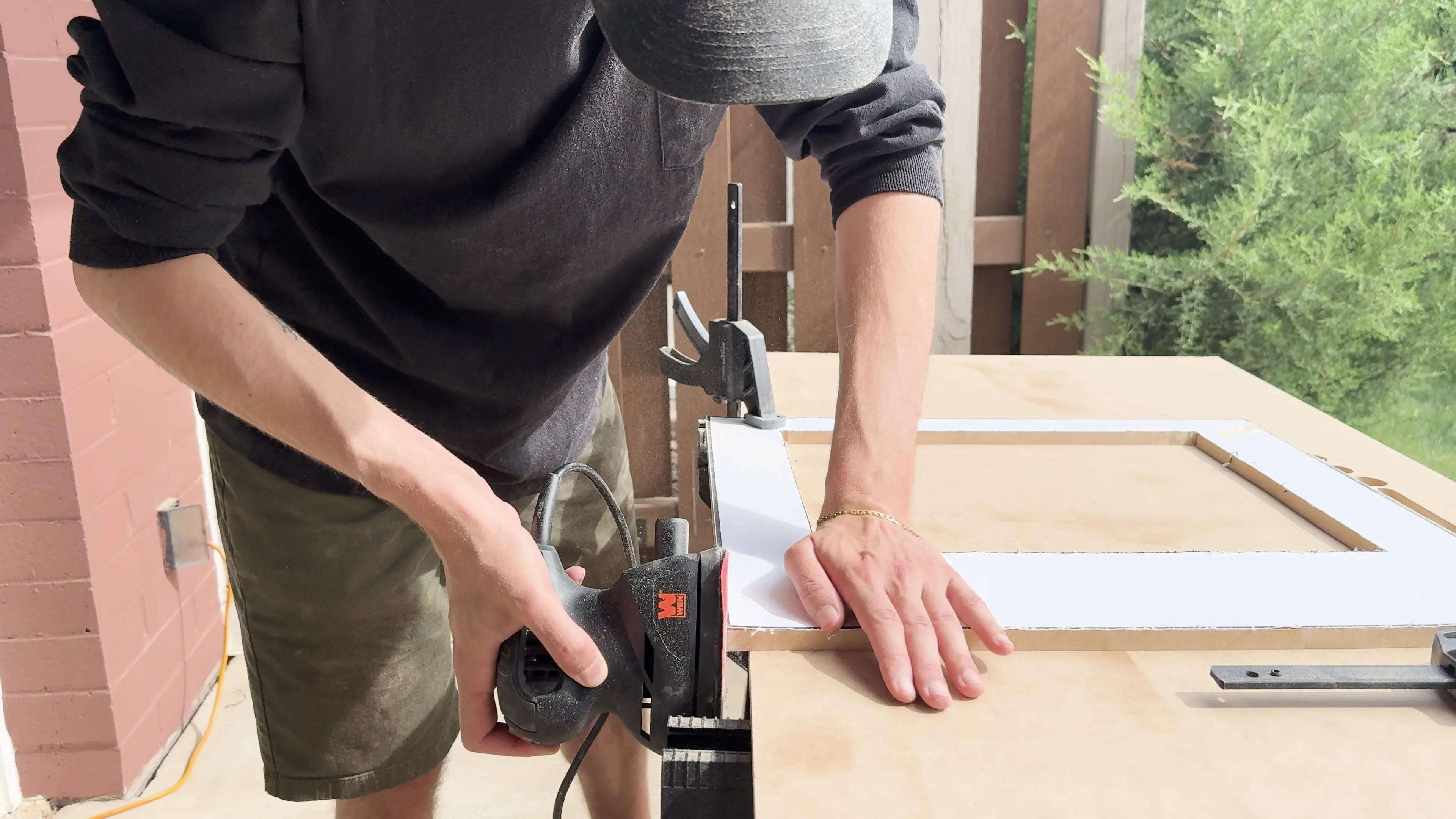

Somehow, I accidentally screwed up the translation of the side panel dimensions on my first one, so I actually had to get that template re-printed and had to buy more 3/4" MDF at Home Depot, but other than that, this part went great! When each piece was cut, I hit it with the detail sander on the outer edge (and sometimes the inside too), doing my best to keep the edges square and nail the dimensions.
Sanding the edges to the template dimension.

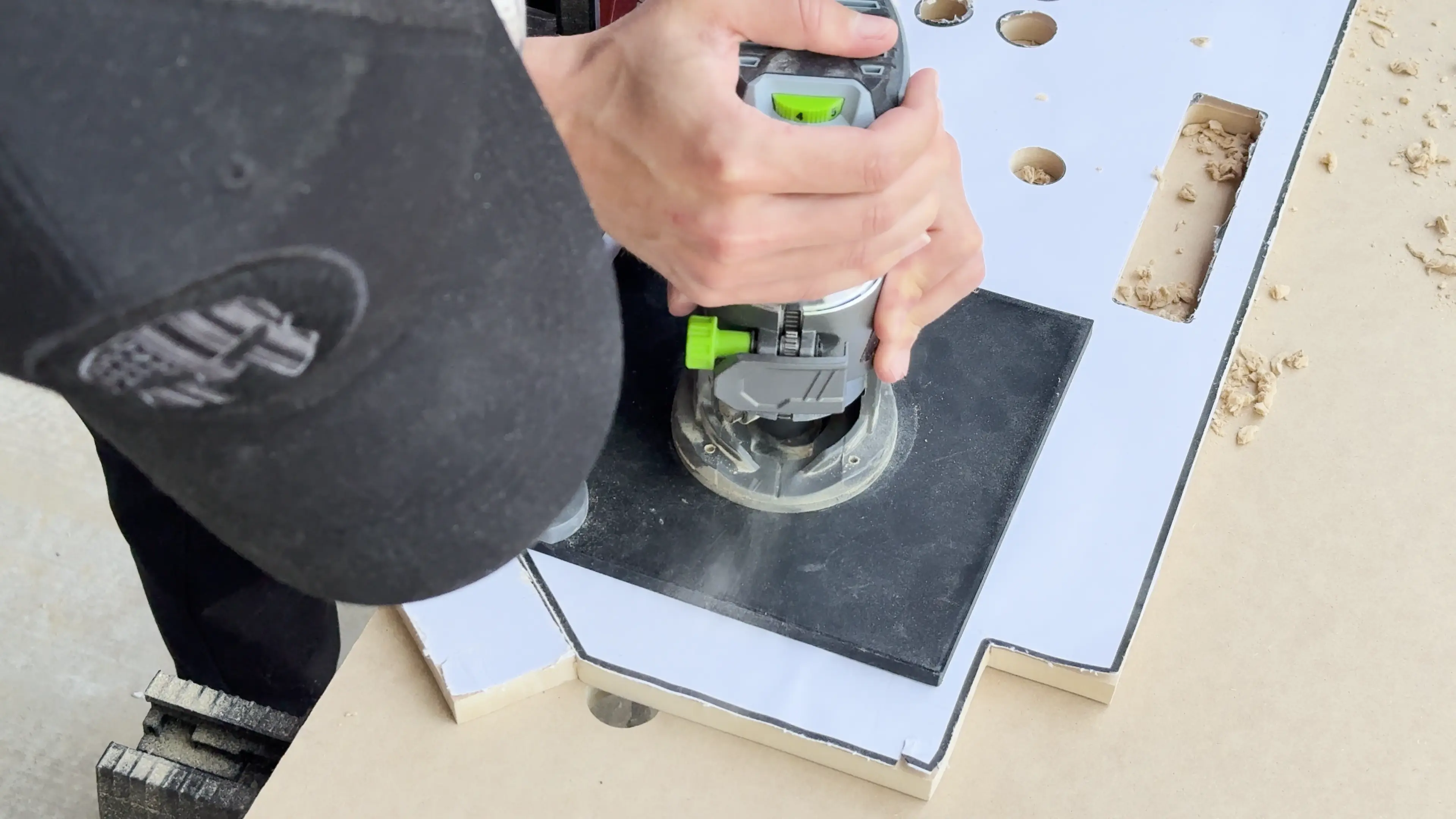

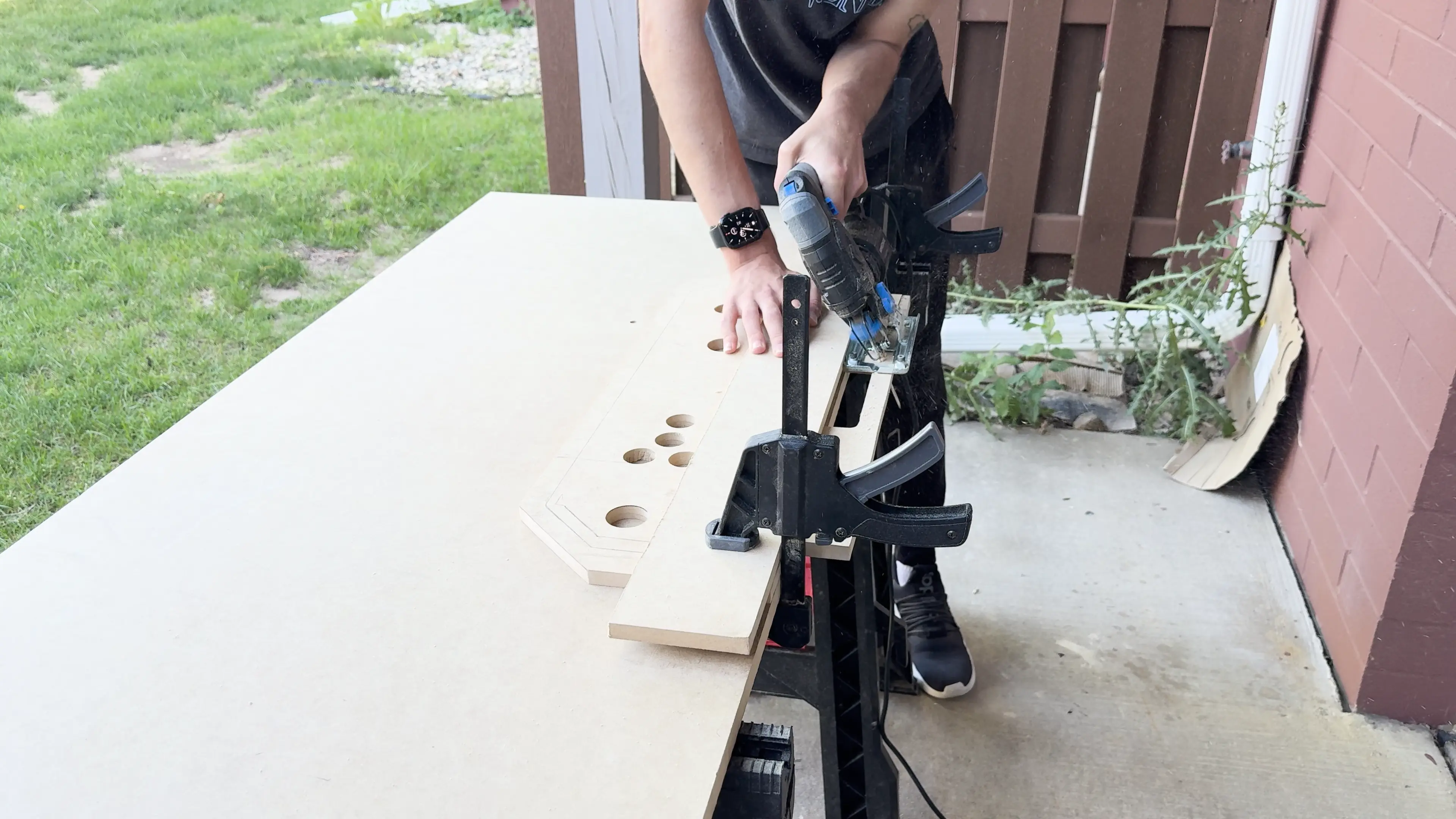

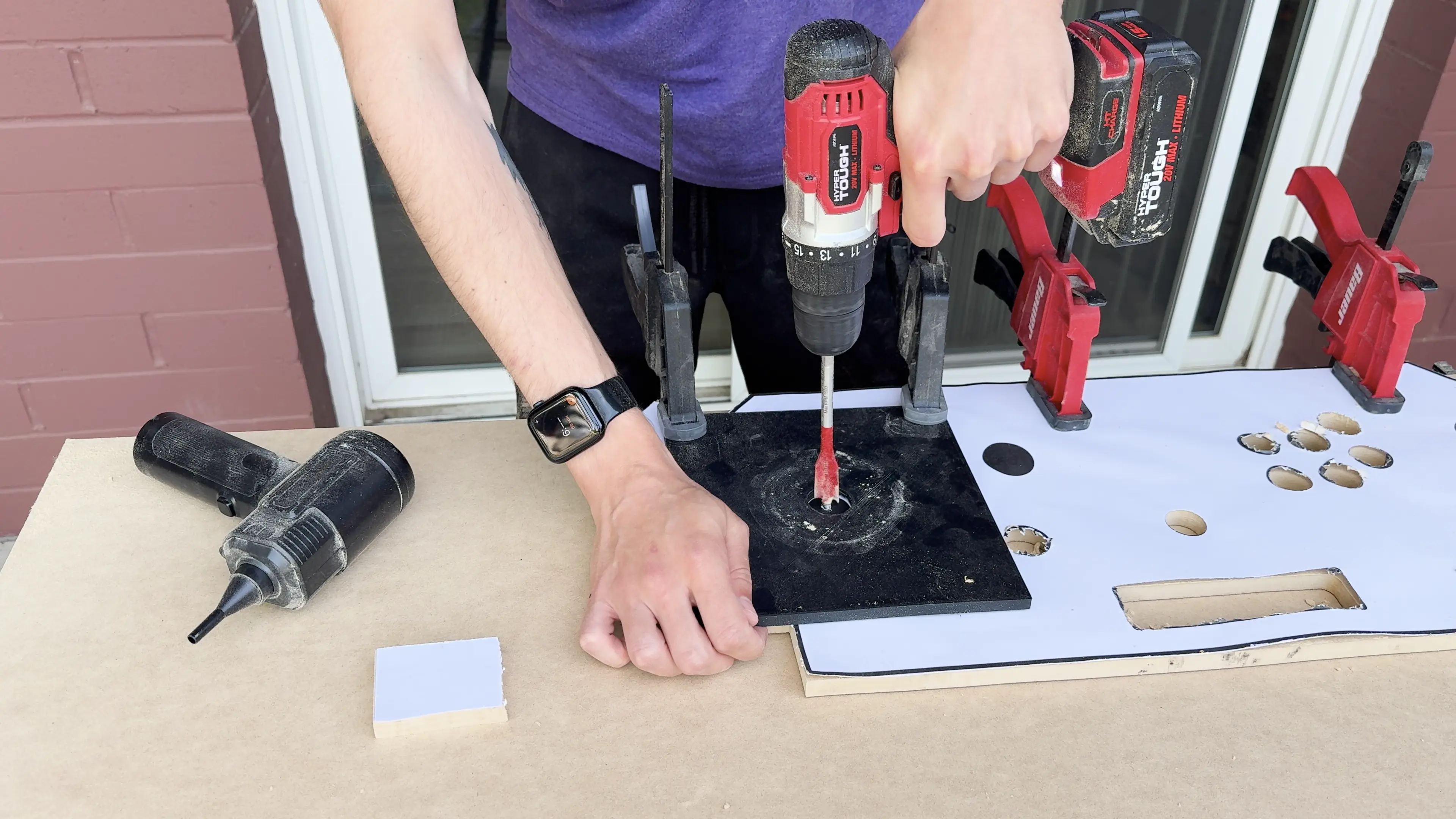

For the control panel, I knew I'd have to use something other than a jigsaw to get the cuts I needed. I opted to use a spade bit on my drill to get some kind of hole in the correct spot. To prevent tear-out on the back side, I just drilled all the way through the scrap wood I had clamped it to.
Using a spade bit to drill a very large pilot hole for the router.

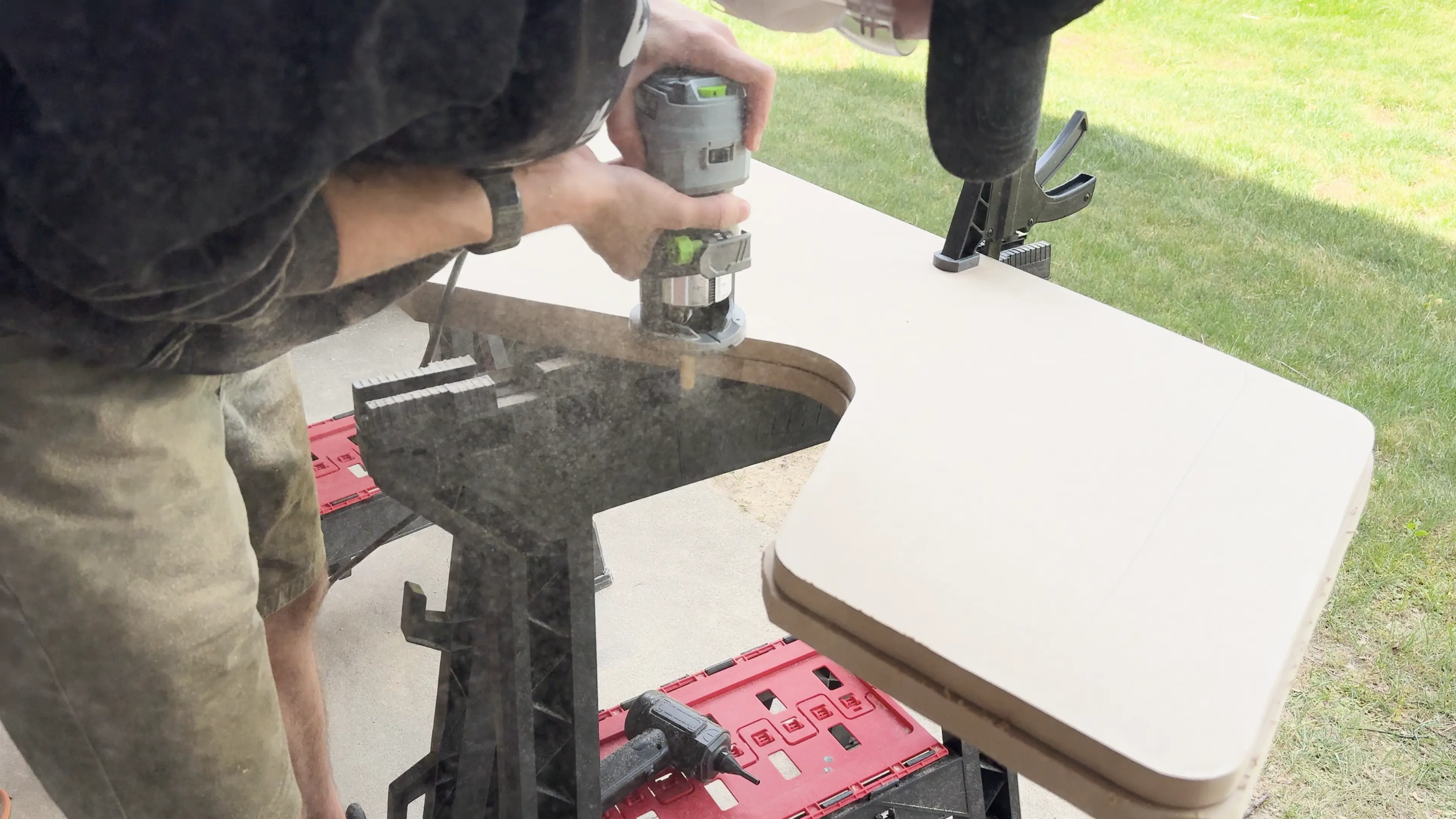

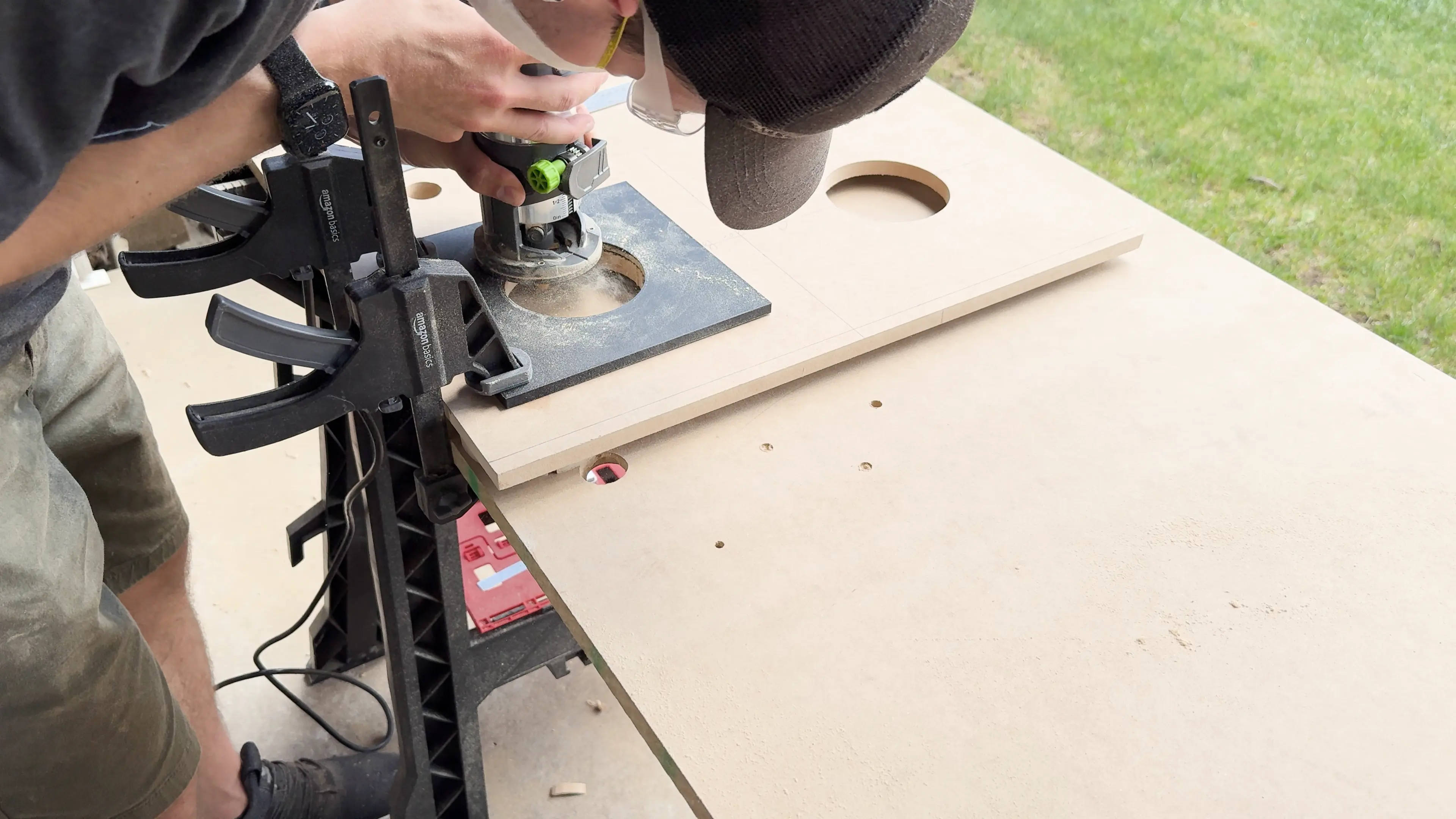

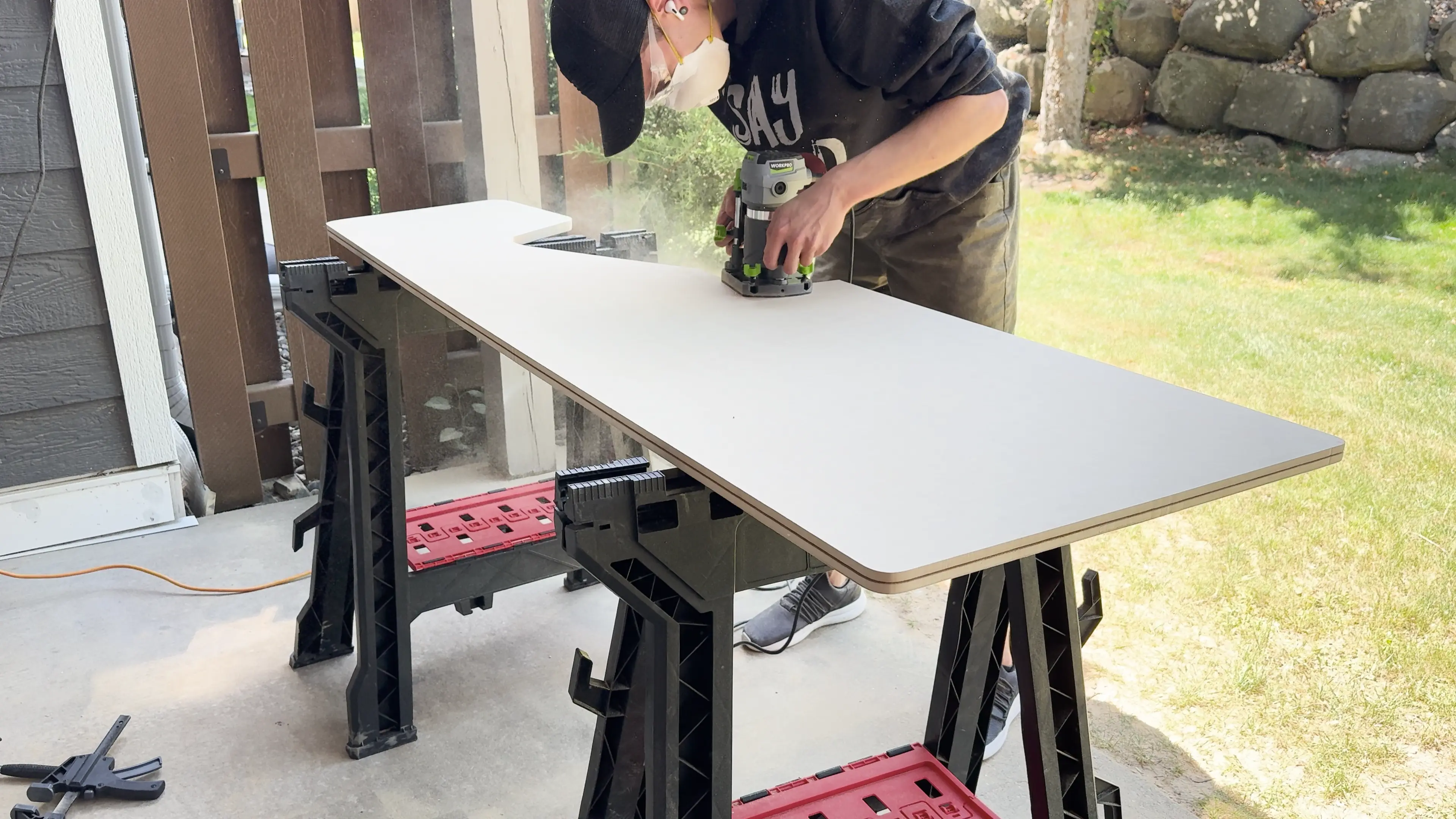

I also 3D printed a few different router jigs for various sizes of button holes as well as the cartridge slot. The bearing on the flush trim bit rides along the edge of the jig, and leaves a really nice clean hole (most of the time).
Me watching very closely as the flush trim bit rides along the inside of my 3D printed router jig.

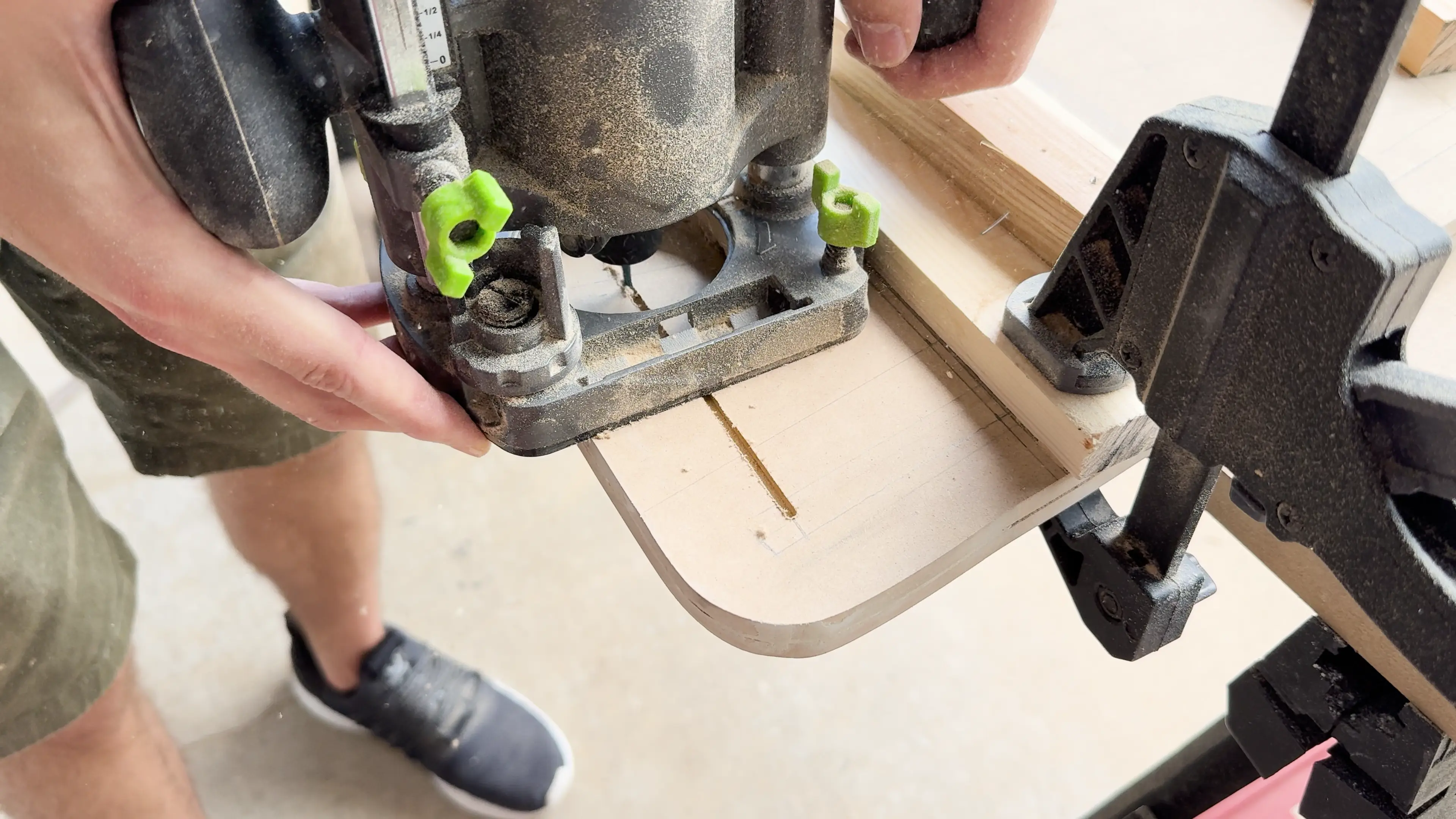

Next I used a slot cutting bit to cut a slot for the (eventual) t-molding. I actually had some trouble with some spots near the top during this part, so I filled those with Bondo and will re-attempt once the structure is a little more rigid.
Using the slot cutting bit to cut slots for future t-molding.

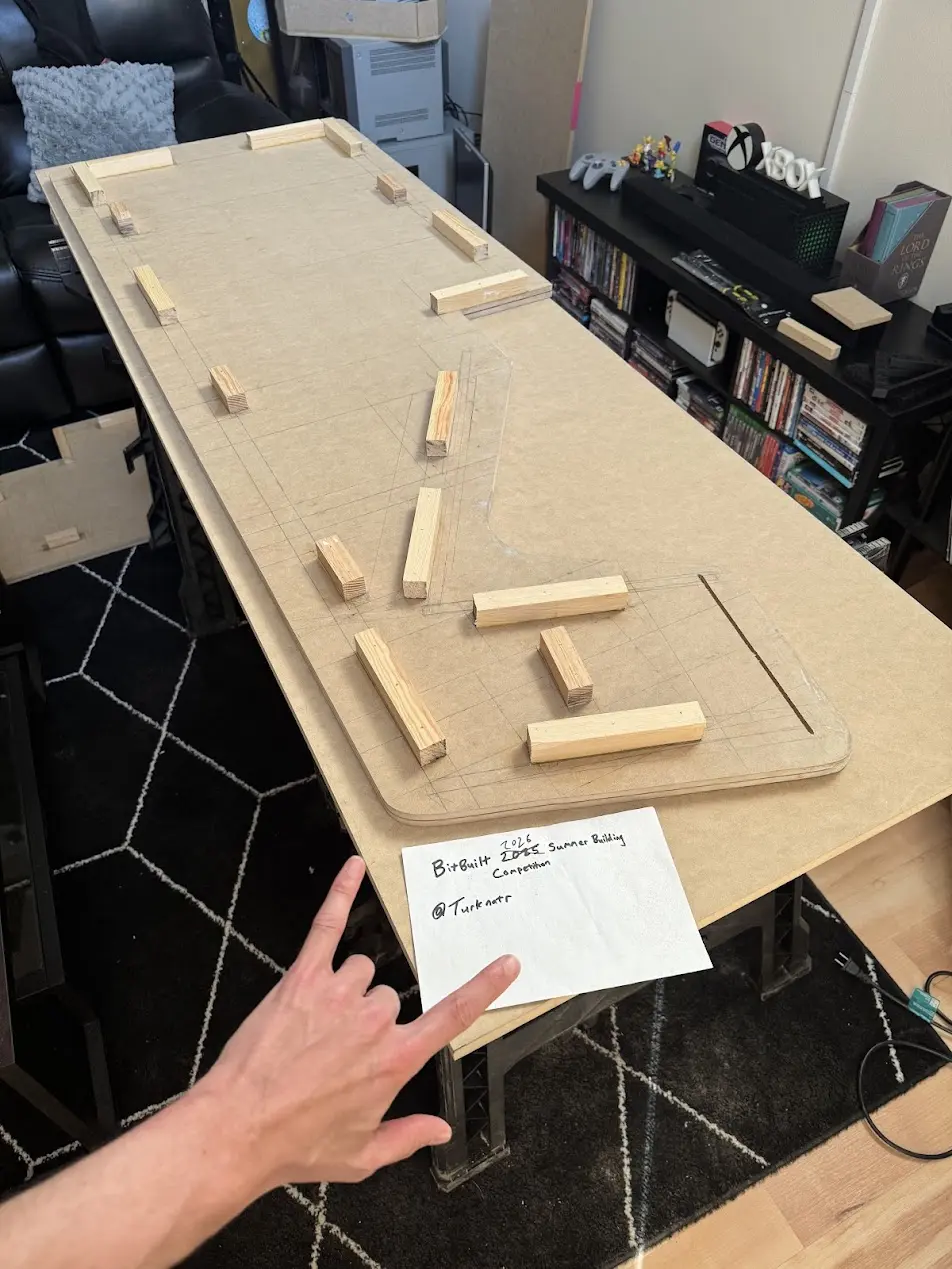

I spend a lot of my day yesterday meticulously mapping out locations for the cleats on the inside face of each side panel. Cleats are basically wooden backing blocks that serve as attachment/alignment points for all of the other panels, eliminating the need to drive screws or nails through the beautiful side panels/art. I had a system within TinkerCAD, using what Saint Google told me was a digital "story stick" method that I thought was flawless, where I just measured from the back and bottom edge for each corner of each 1"x1"x6" cleat, but it wasn't as perfect as I thought it was. Still, I managed to map out (hopefully) identical but mirrored locations on each side panel.
Marking out the locations of every single cleat on the side panel. This took FOREVER.

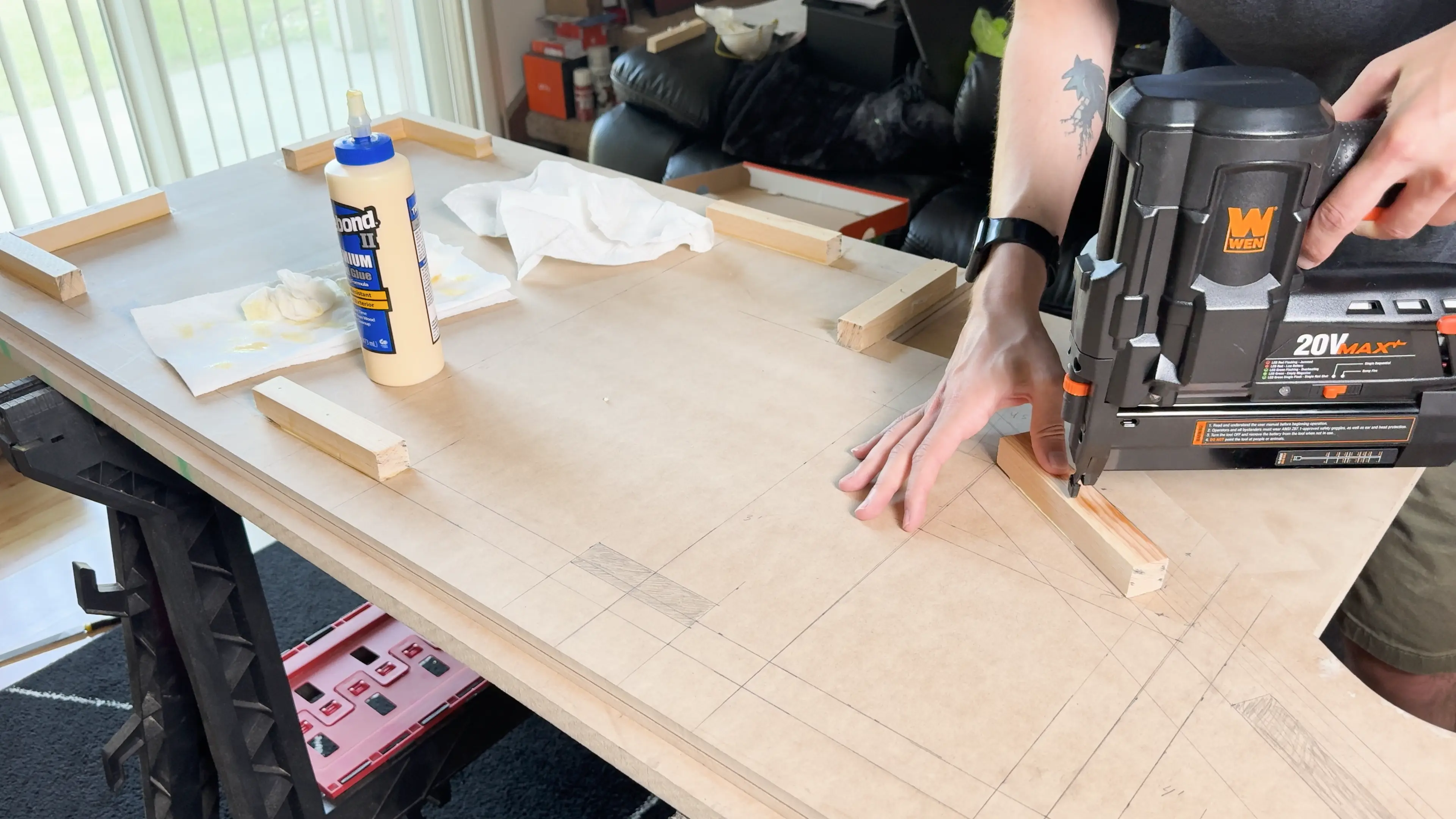

Next, it was time to begin attaching cleats. I used wood glue and brad nails for this part. The 18g nails don't really provide much structural support, but they do keep everything "clamped" while the glue sets. This part was mostly straightforward, but I had to be careful to not let the cleats slide around when shooting the nails. After each cleat is attached, I just wiped up any excess wood glue and moved on to the next.
Using the brad nailer to secure the gluey cleats.

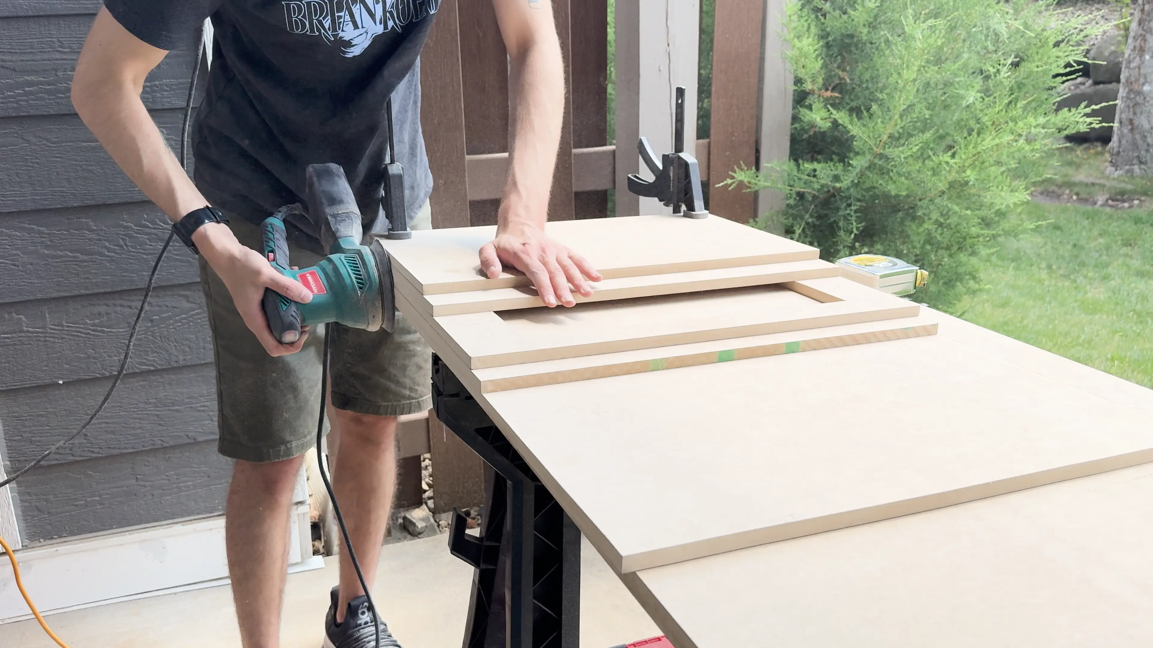

Another thing I did just today was a little gang sanding. I took all of the individual panels that span the interior width along with the 1x4s and sanded then to exactly 21" while clamped together. This should eliminate variances and keep everything nice and clean.
Whole lotta gang sanding.

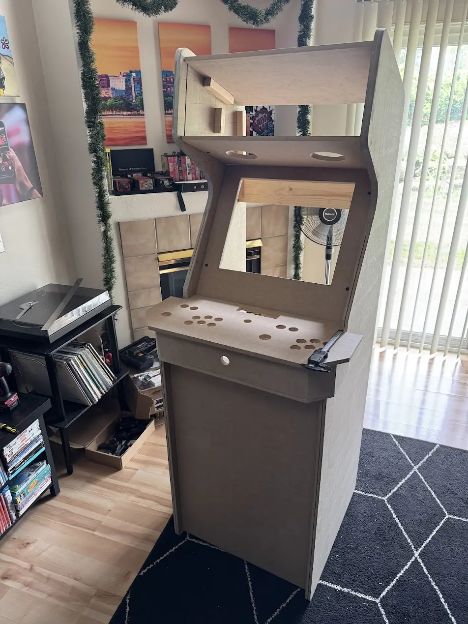

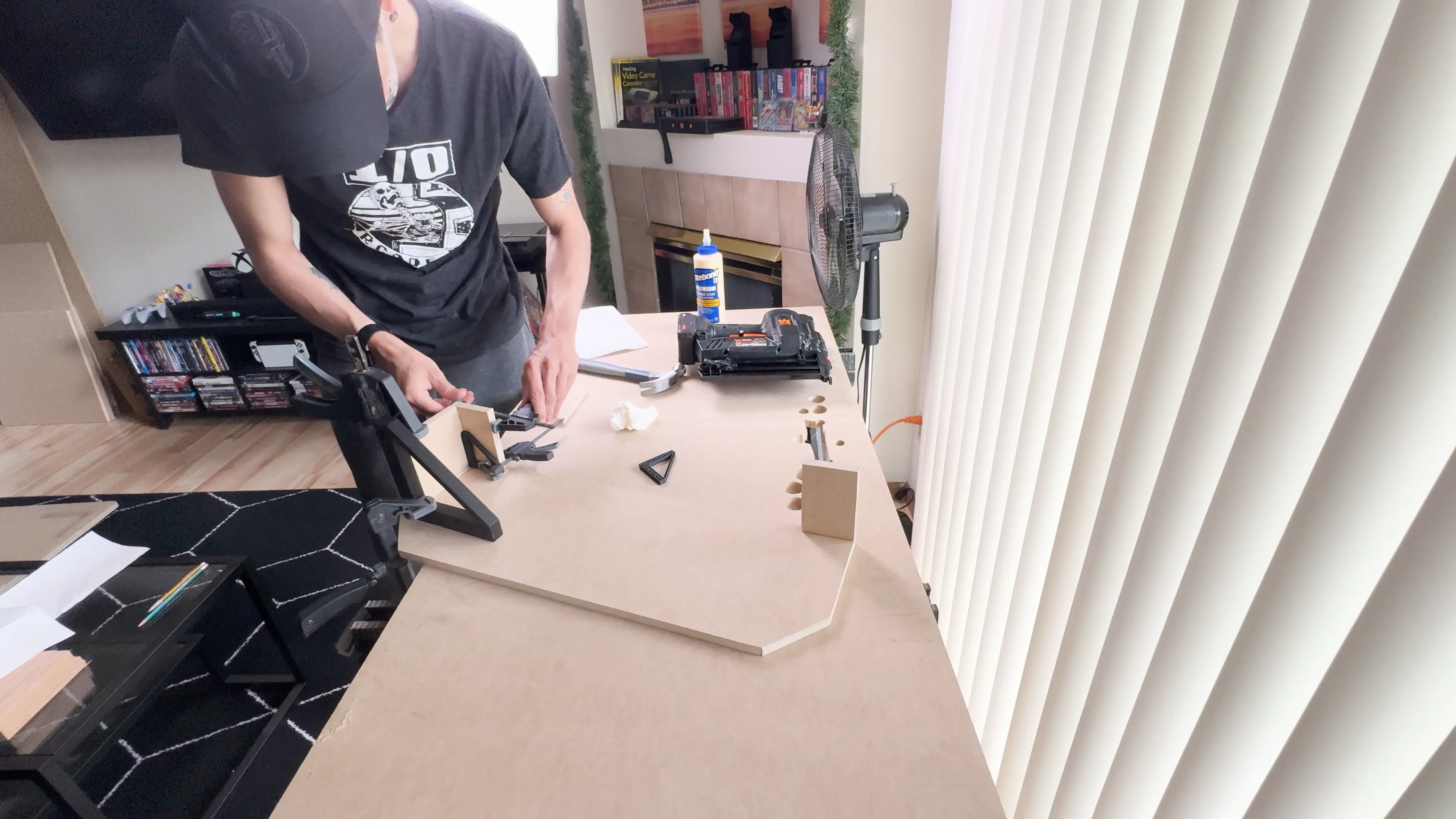

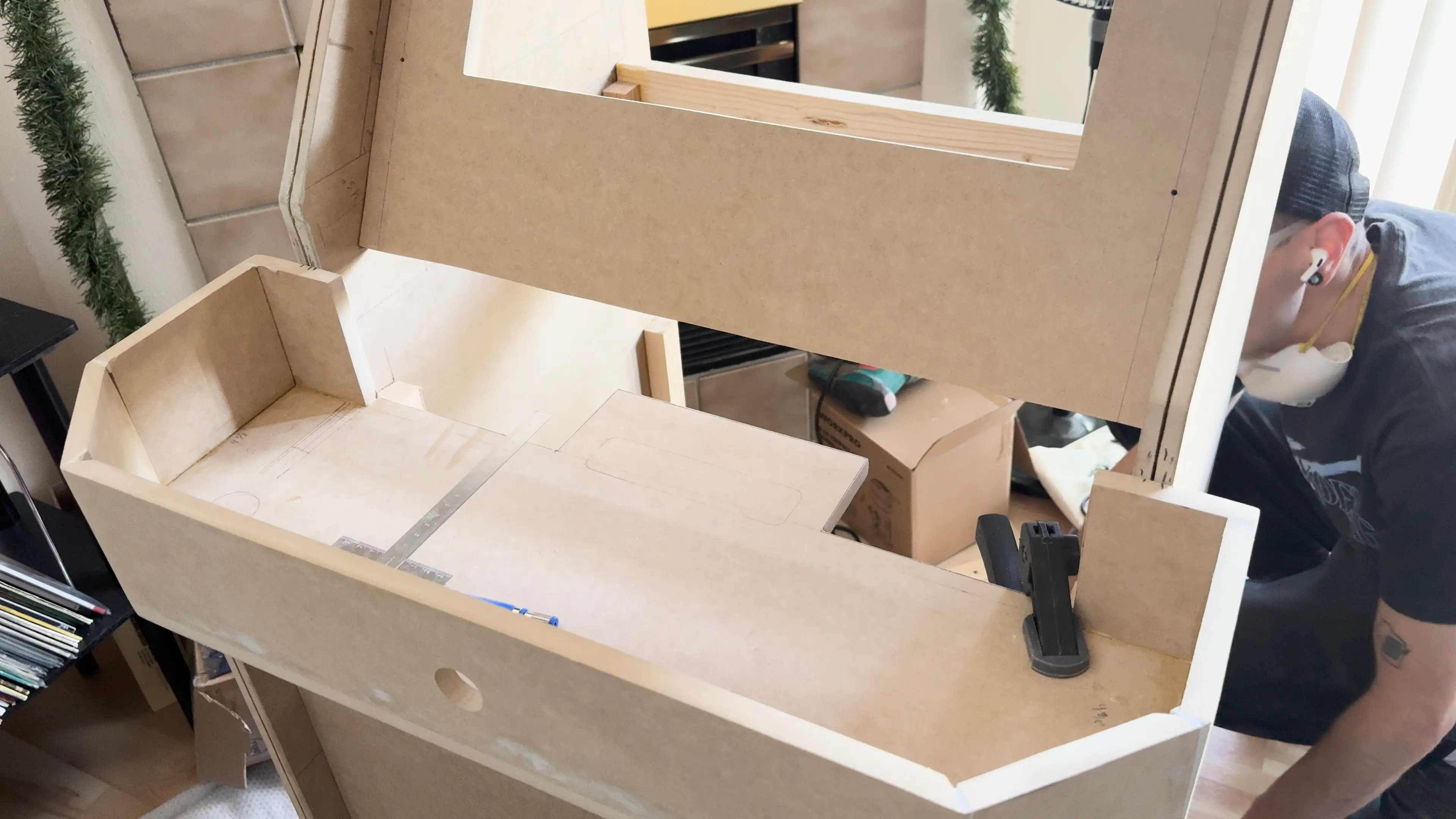

We left off last time at the tail end of pre-assembly. Now that all the individual panels were cut and sanded, and the cleats were cured, it was time for a dry fit of all the pieces. I didn't get a ton of pics/vids of this because I was tired and occasionally frustrated, but basically I just clamped everything in place with a bunch of right-angle brackets, and drove in #8 wood screws from the interior/exterior where appropriate. This was mostly just to check for collision points, design oversights, and to see it all together.
A Snapchat©️ view of the dry fit assembly process since I was too grumpy to capture it properly.
As you might expect, not everything went 100% according to plan. One of the things that I realized was that my marquee light/soundboard speaker assembly would need to be trimmed down to allow for the actual speakers to also fit into their home.
The entire structure finally vertical during the dry fit.

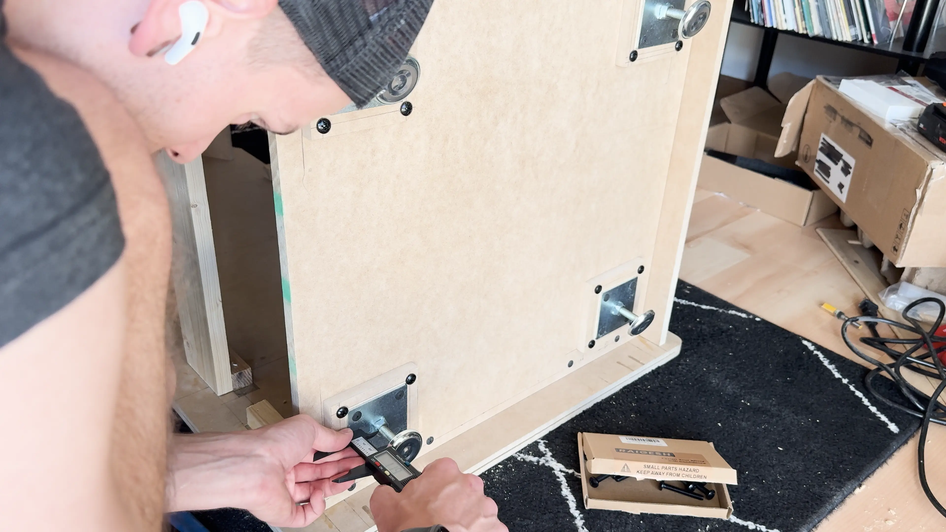

Measuring the height of the adjustable feet on the bottom panel.
With everything "locked in" I also took the opportunity to install adjustable feet to the bottom panel. These are the exact same type you'd see on commercial arcades and pinball machines. To reinforce the steel plates, I cut 4"x4" squares of 1/2" MDF and attached those to equidistant locations on the bottom panel. These are attached with bolts and nuts, and then the plates are wood screwed through the thickness of both, but do not penetrate the bottom interior.

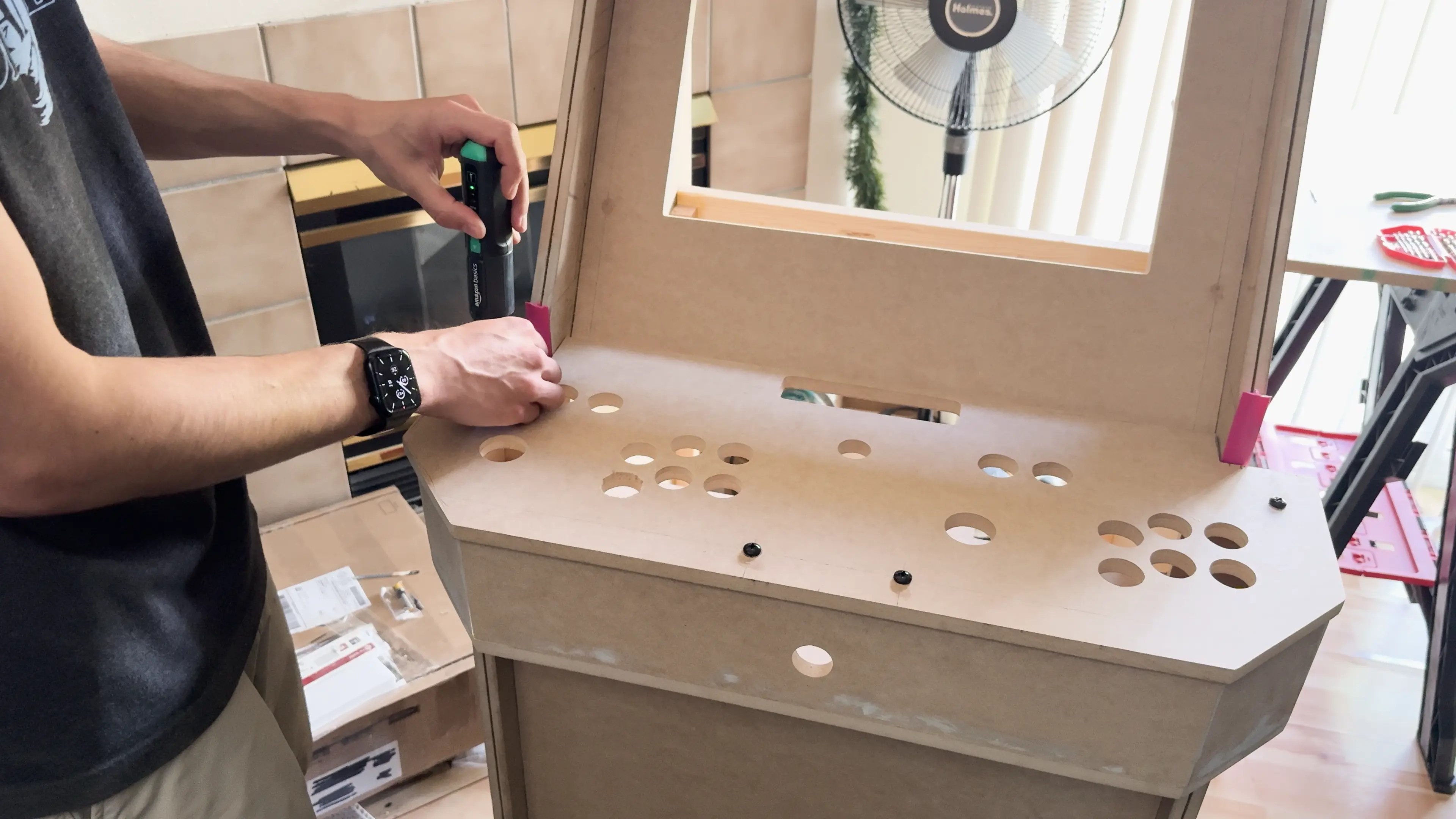

After that, it was finally time to set the T-nuts for the control panel. For the control panel box attachment, I tried to hammer them in from the back side of the cleat. That worked OKAY, but not super great. For the top of the control panel, I 3D printed plastic washers and simply torqued the bolts tighter and tighter to force the T-nuts into the cleats. Mapping out the holes for these was also a little daunting, since I wanted to ensure that everything was symmetrical AND lined up with the invisible cleats underneath. It definitely took a lot of measuring and pilot holes.

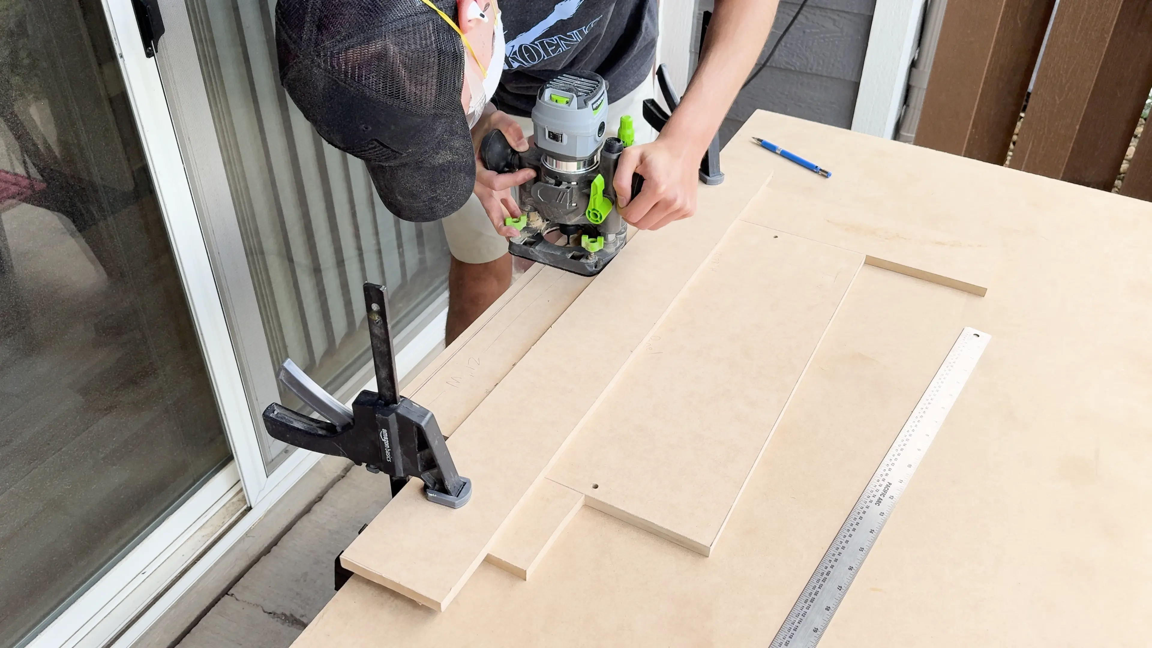

Cutting the final marquee grooves in the top panel with the scary router.
One of the final woodworking tasks was cutting the additional marquee grooves in the top and speaker panels. To get this right, I needed to calculate the exact size of the marquee I ordered down to the 1/32 of an inch, and also account for the thickness and angle of the plexiglass piece since it is not perfectly perpendicular to either panel. Since I don't have the piece in hand, I left about 1/8" "breathing room" in all dimensions so that it (hopefully) doesn't need any future adjustments to the cut. If it does, it's not the end of the world, but I just really don't enjoy using the router (it's scary loud & unforgiving).

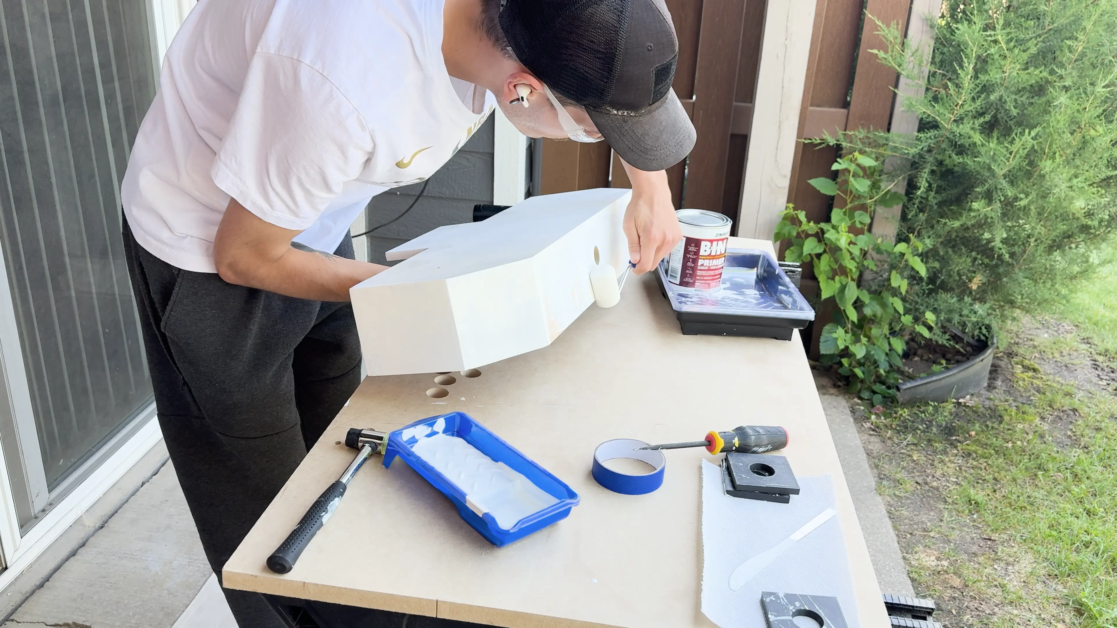

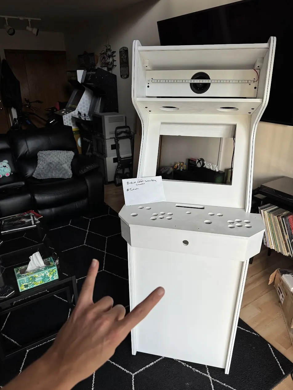

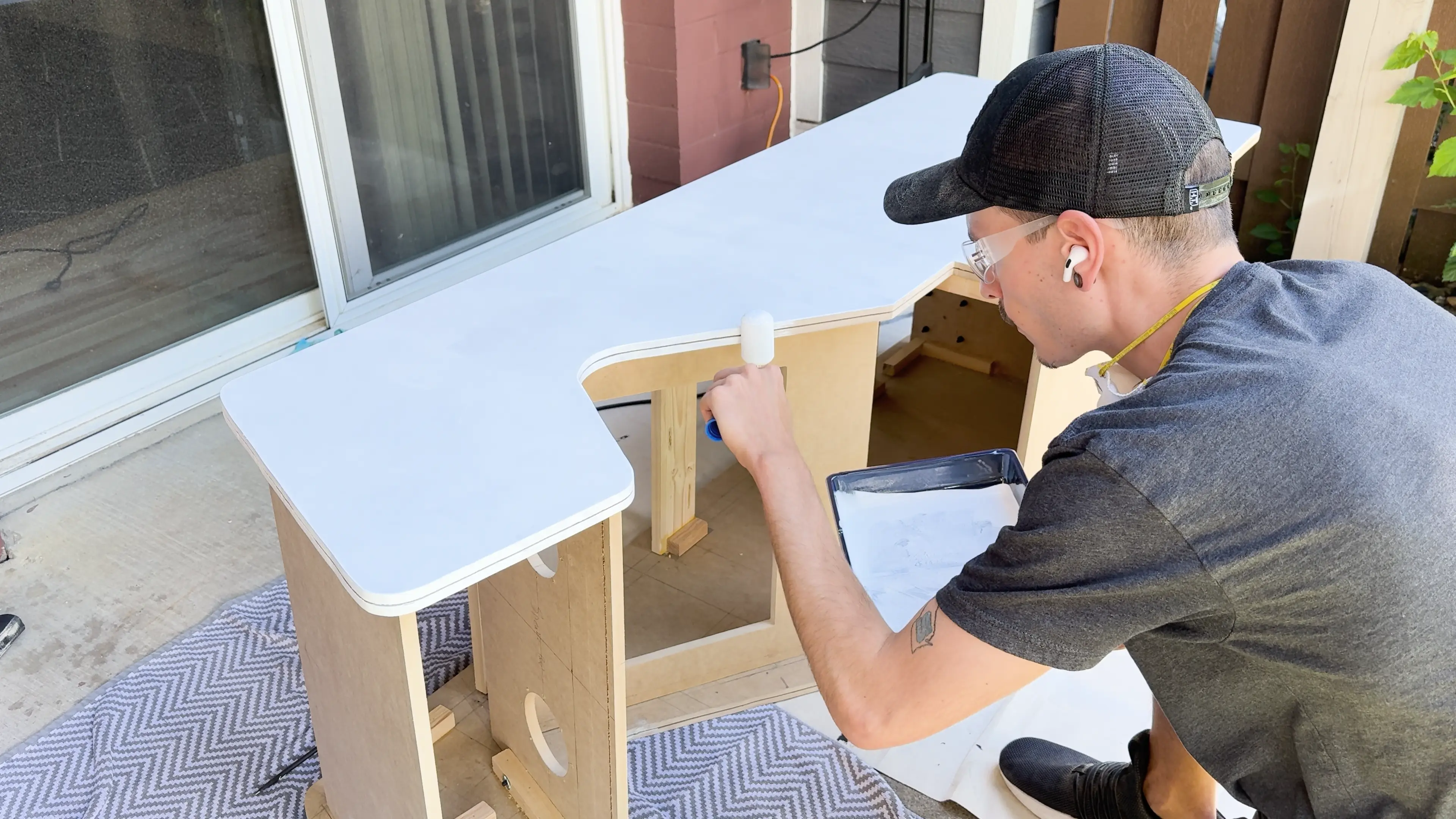

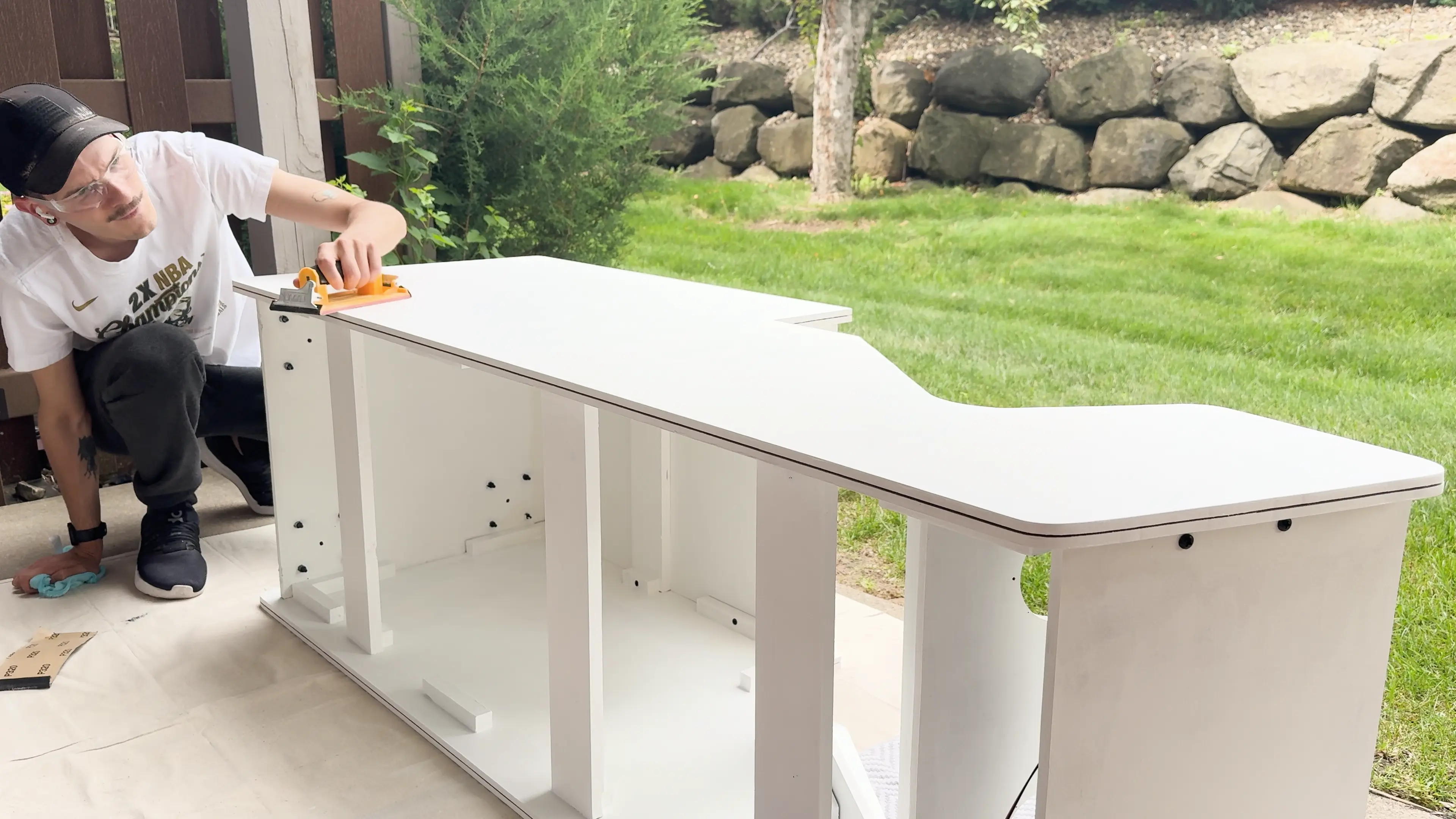

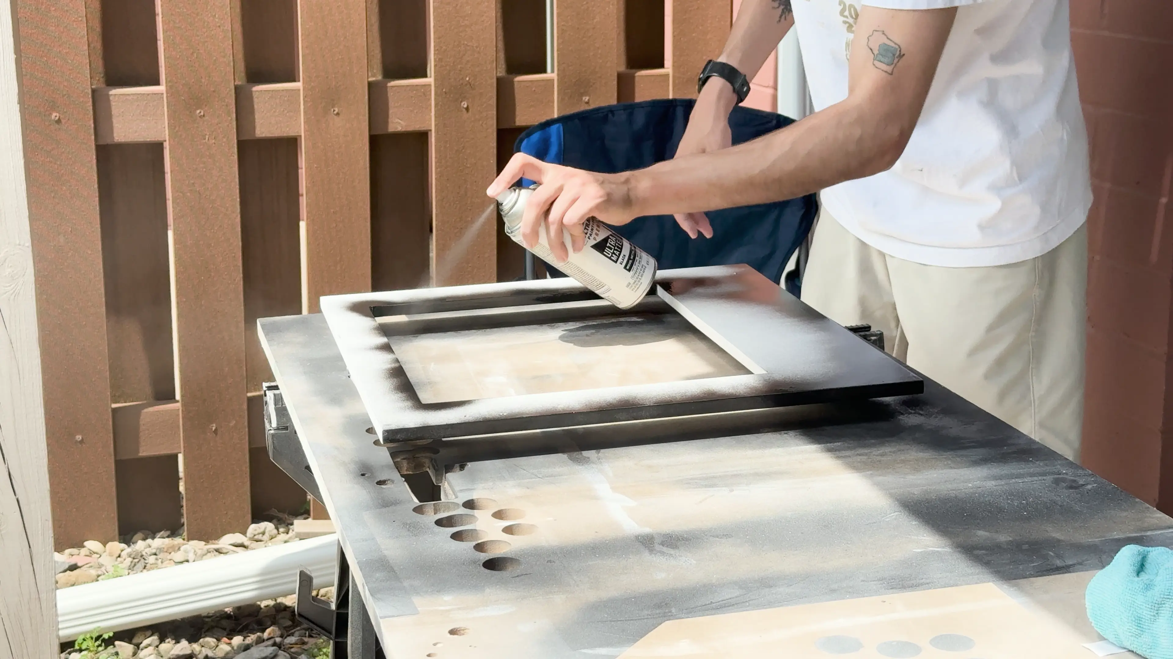

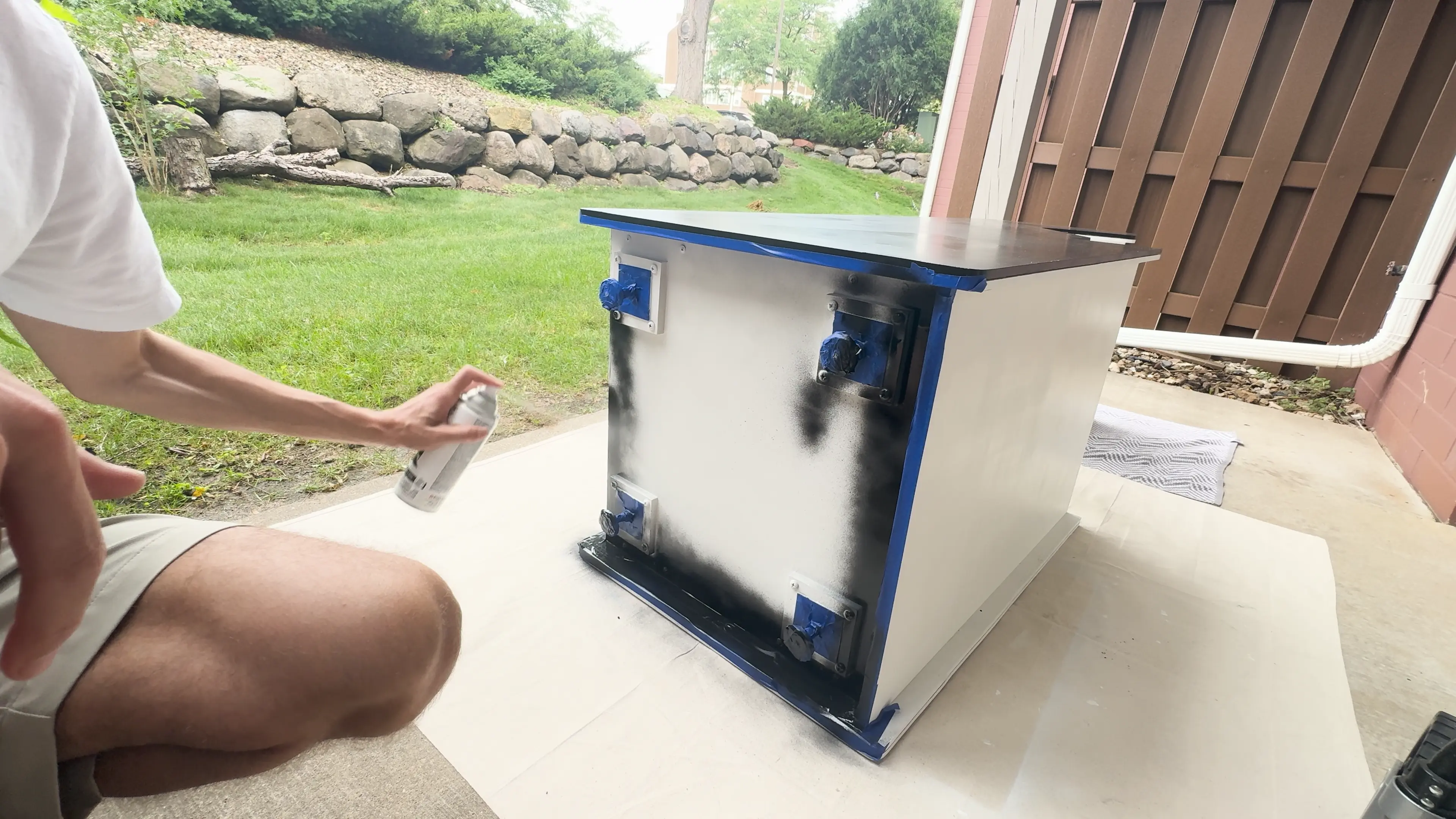

Now that everything was "finalized", I could finally begin applying primer! I bought some "shellac" on Amazon weeks before thinking that it would be the perfect sealer for my MDF panels. What I actually bought was "synthetic shellac" which seems to be glorified acrylic primer. It takes WAY longer to dry and does not sand as well, but I had already committed to large portions of the paint job before I learned the difference. Oh well. I did a couple of layers on both side panels, the panel edges, and any interior sections with this inferior product. Once that can ran out, I got some of the good stuff from Home Depot and decided I'd use that for the exterior faces of kickplate, speaker panel, bezel, and control panel. The "authentic" shellac primer will sand nicely and provide a great base for my oil-based topcoat and subsequent graphics installations.
Using the REAL shellac primer on the control panel box.
With that, I'm going to give the various primers a few days to fully cure and harden while I have a friend in town, before attempting to sand and paint again. I really am quite pleased with my progress so far, despite the hiccups I've experienced. Super Nintendo Chalmers is looking really great and I can't wait to get some actual paint down and continue progressing towards the finish line.
It's giving Gandalf the White. Looks really good.

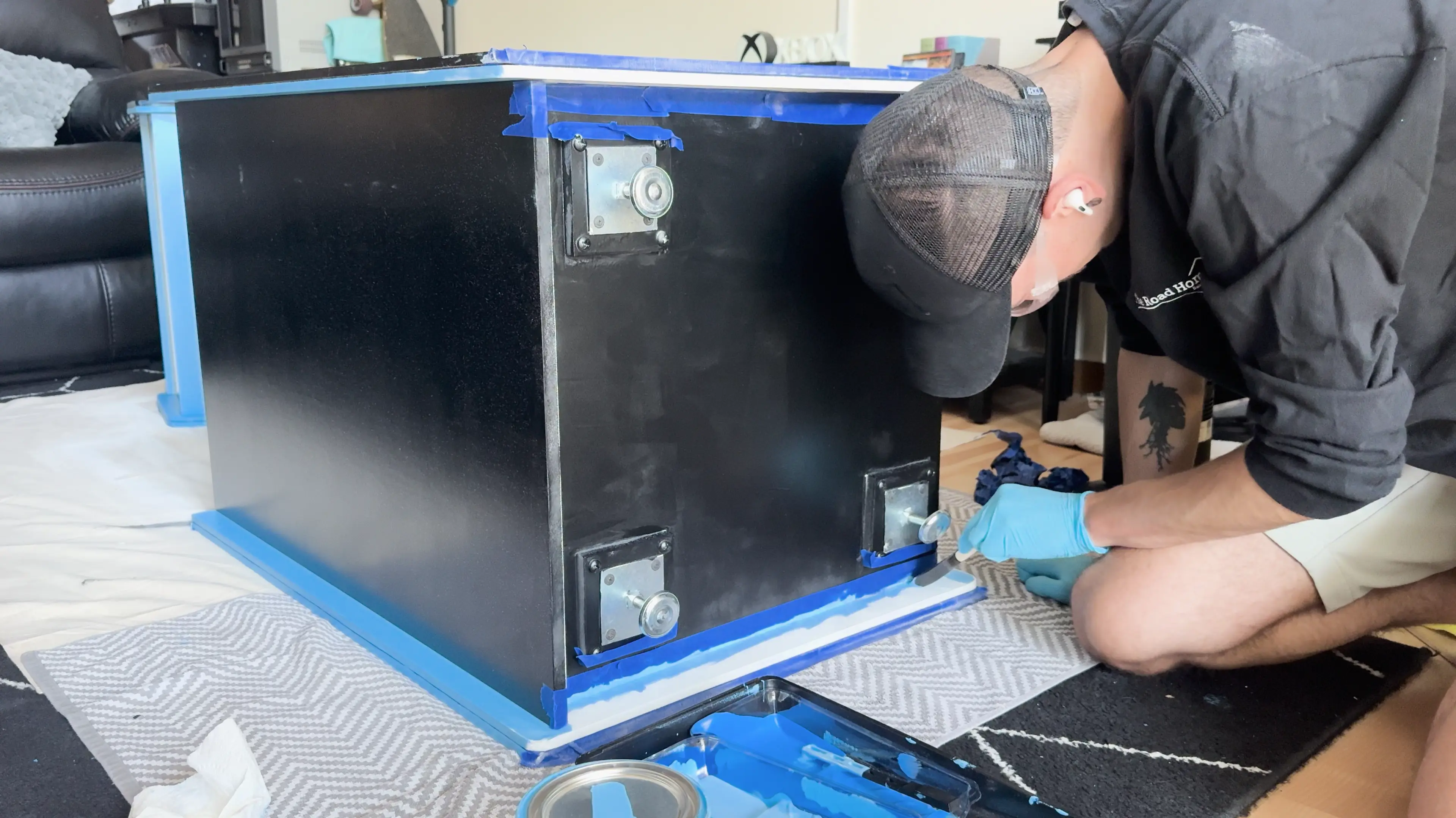

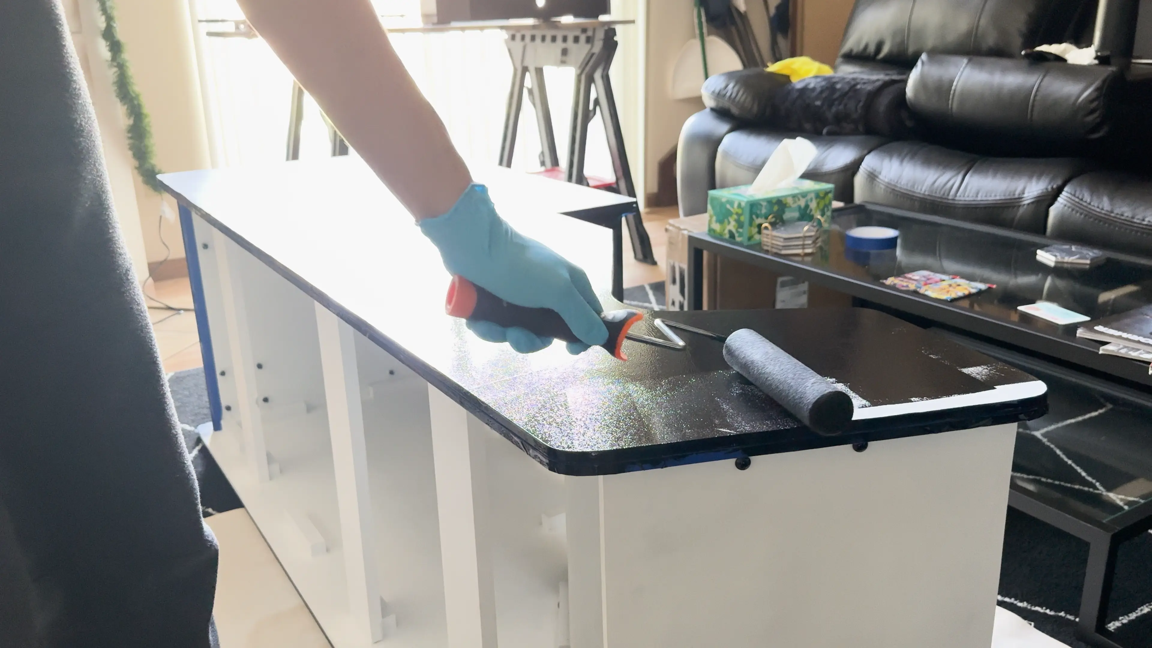

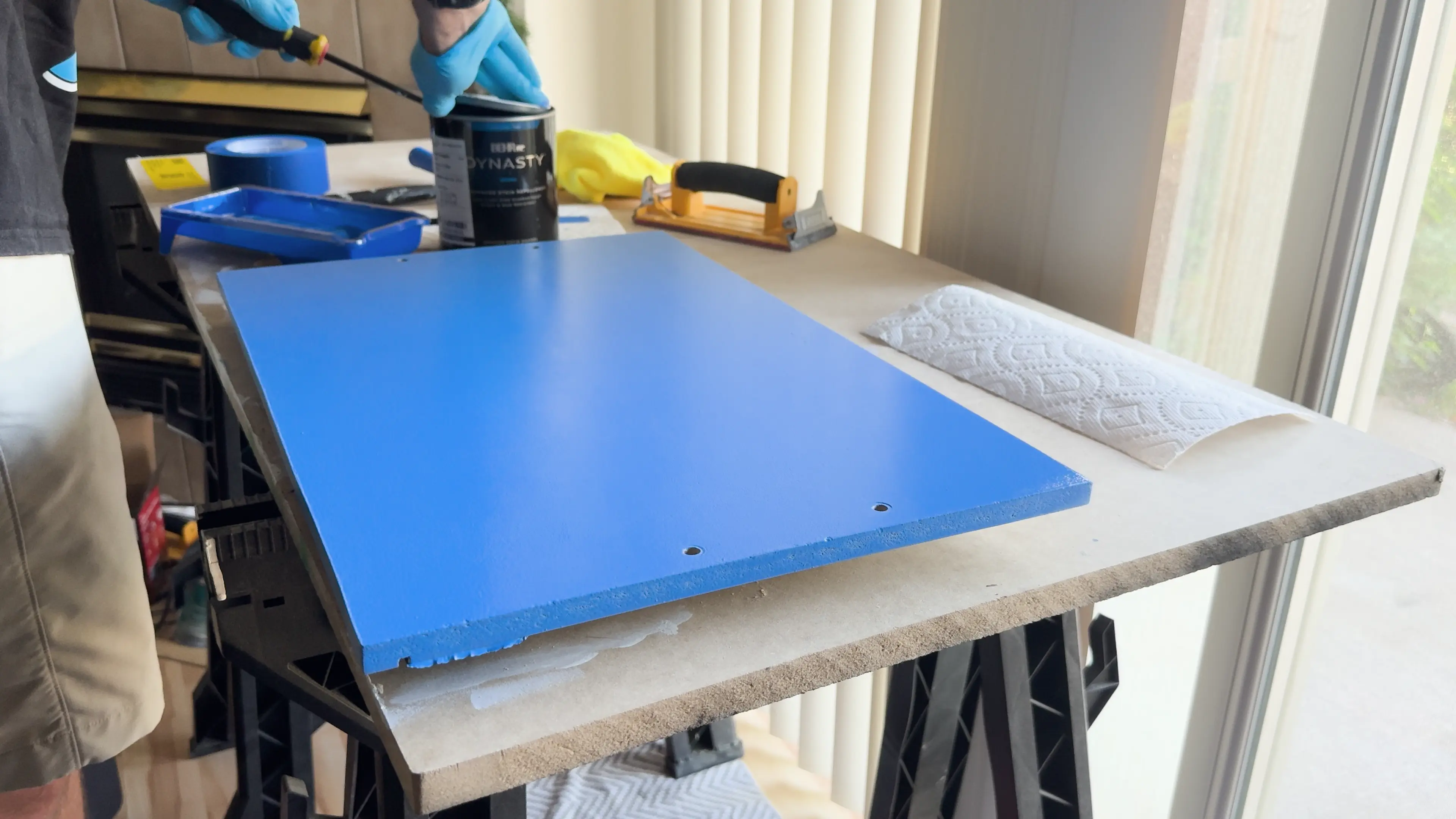

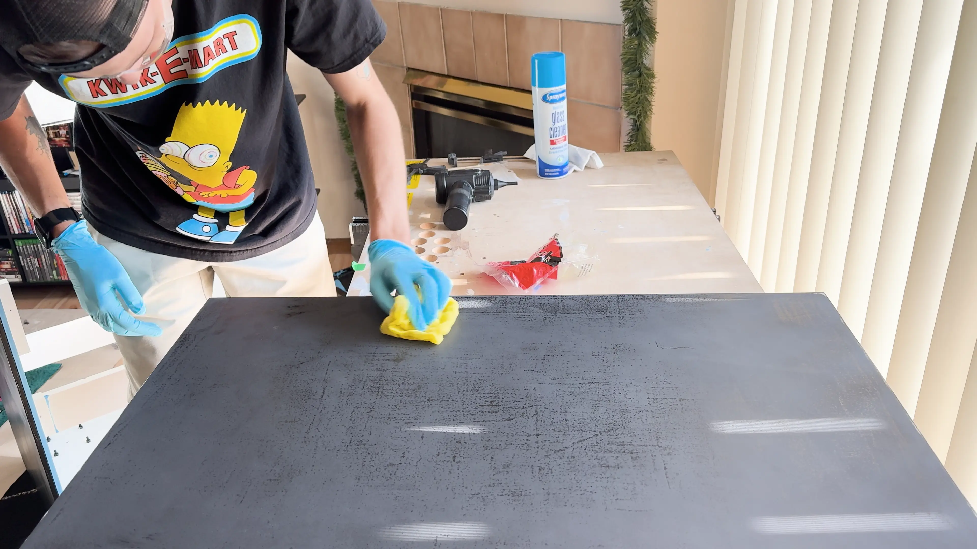

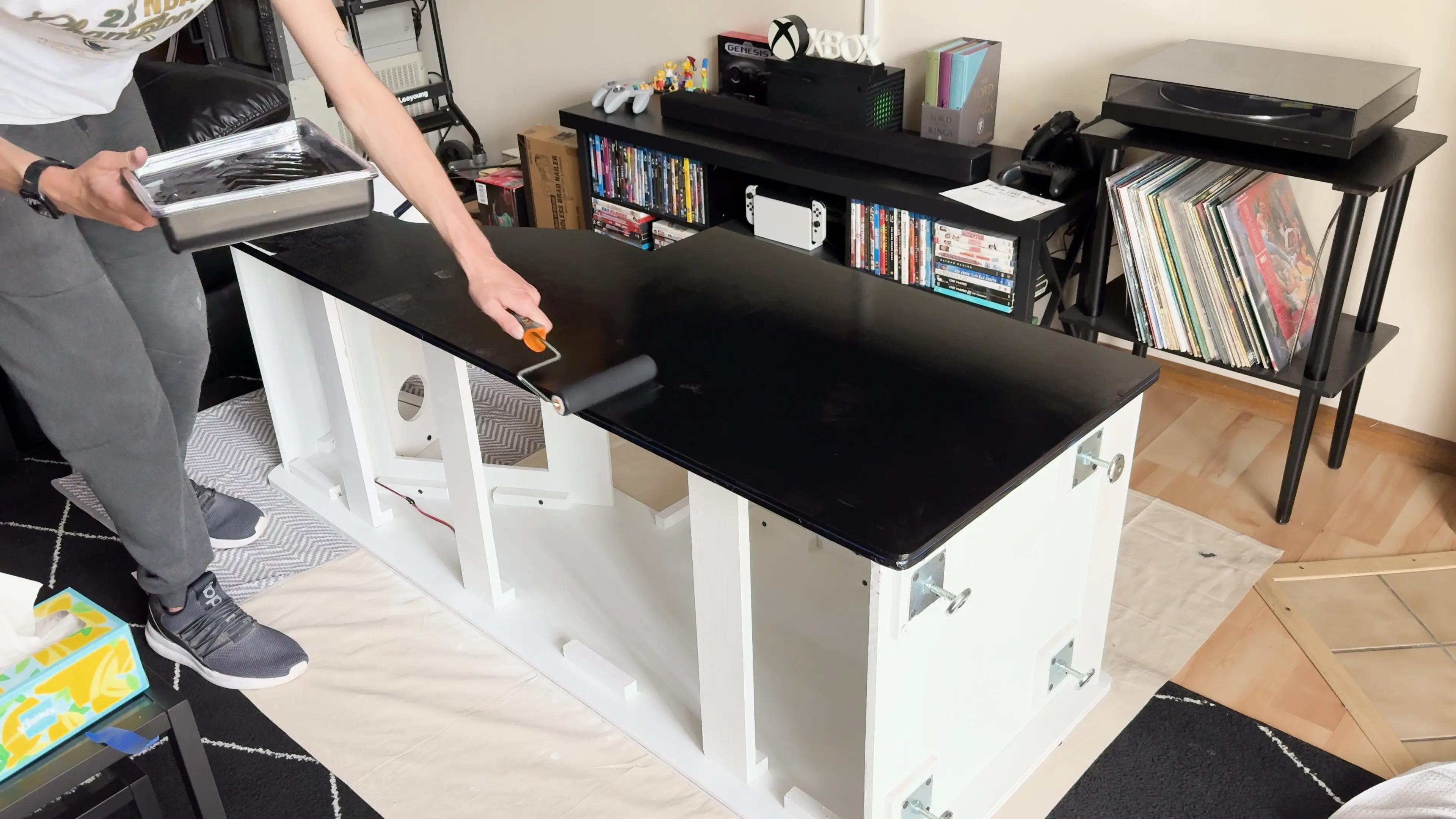

I am very happy to have made enough progress to warrant another update!

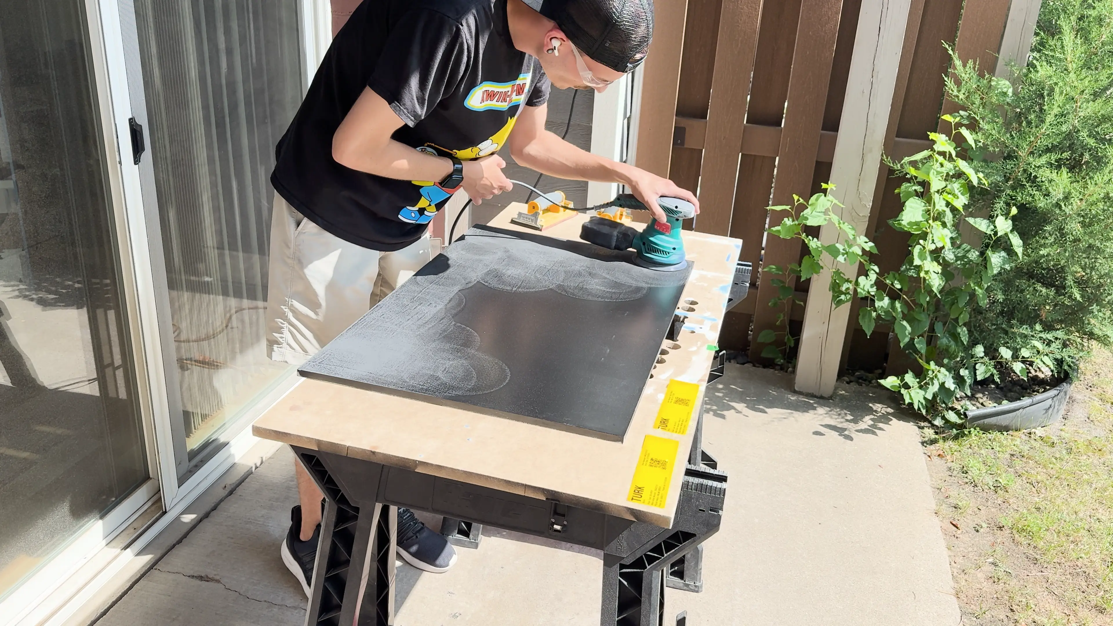

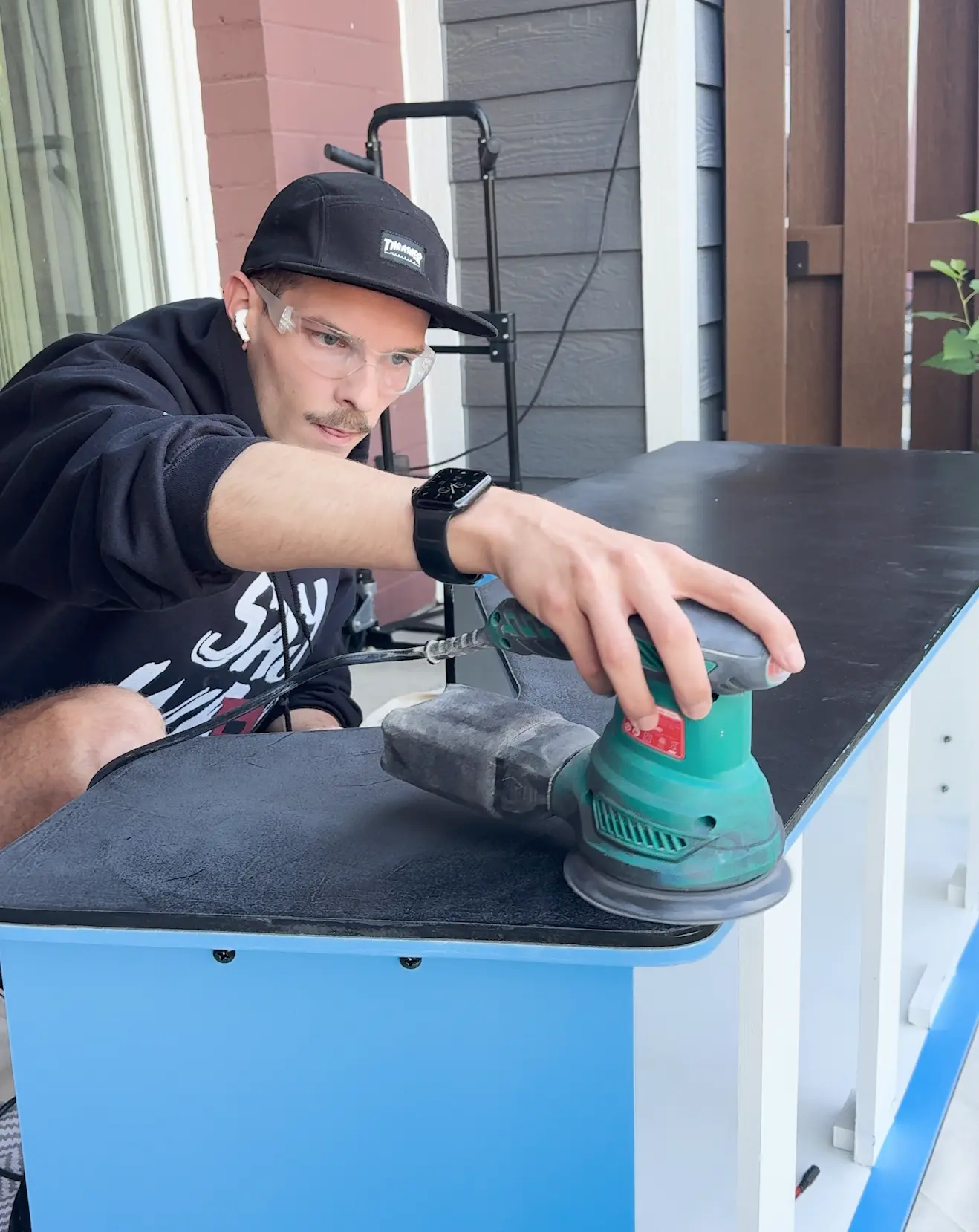

We left off last time at the end of the priming phase, which was a huge milestone. I had a friend visit town shortly after, so it was the perfect time to let everything breathe for about a week before I started sanding and painting.
Carefully sanding down the mix of synthetic/natural shellac primer.
I had very mixed results with the sanding. Because there were 3 different types of primer used, the amount of work required to get a smooth surface varied greatly depending on which part of the cabinet I was working on. Still, I think I was able to do a pretty good job knocking down any unevenness, and I prepared to begin the LONG process of painting this thing.

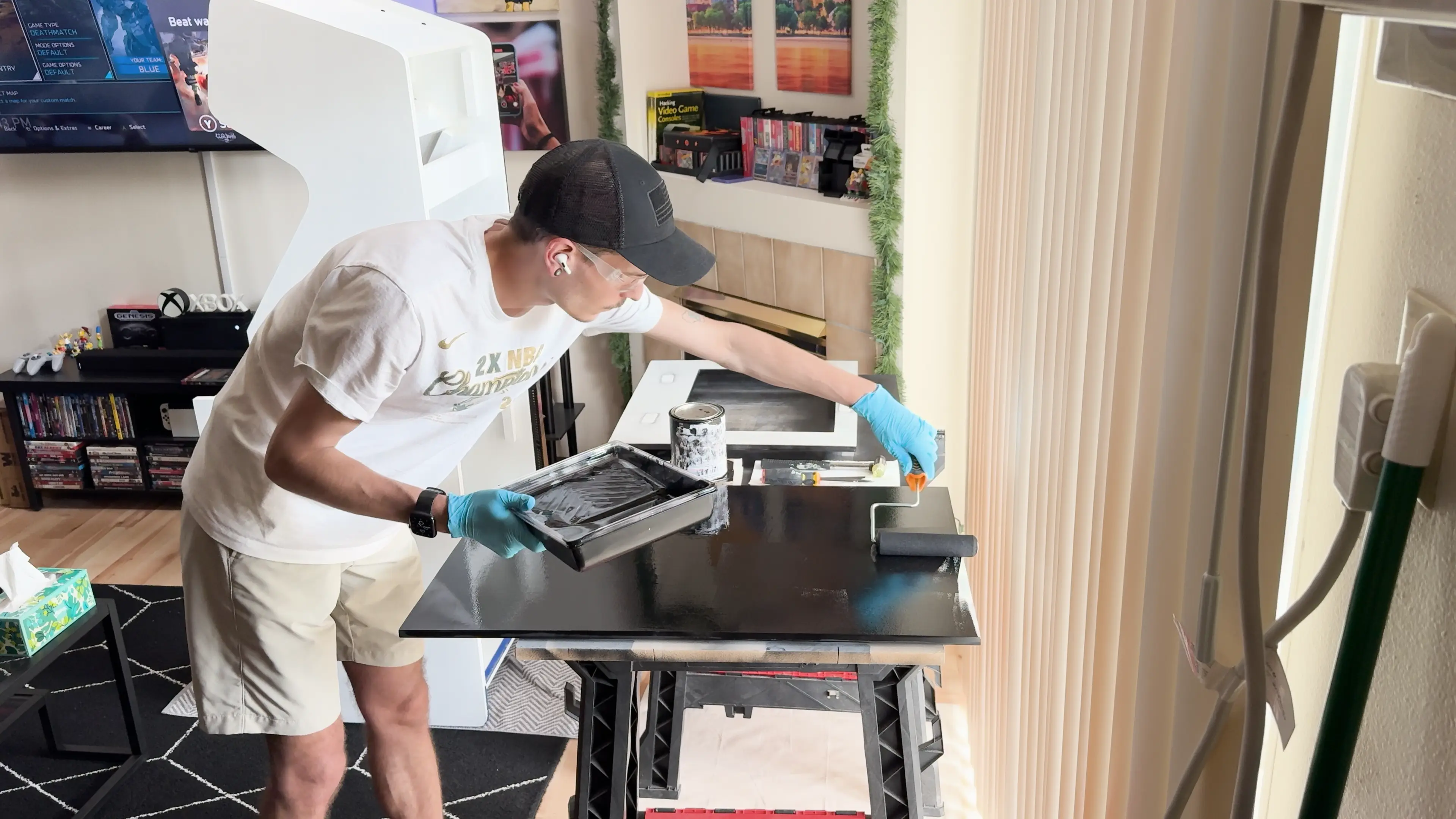

Rolling on the oil-based topcoat for the side panels. This is a long, boring process.
For any surfaces that would be getting vinyl graphics applied, I opted for a Rust-Oleum Satin Black oil-based paint. I'd heard many great things about oil paints last summer when working on the Genesis 4, but decided against it at the time. Basically, you trade a longer cure time for increased durability and self-leveling. I decided I was going to wait a full 48 hours between coats, and an additional 72 hours before turning the cabinet upright. So each side took about a week, just for the side panels.
I used spray paint for areas that no one is ever going to see. Big brain stuff.
Somewhere in between the two side panels, I decided to spray paint the bottom panel black. No one is ever gonna see this besides me and maybe someone who helps me load it into my hatchback, but I still want it to look good, so I meticulously masked off the metal feet and did my best to cover it evenly. I eventually touched this up with the oil-based black too, but it was a quick way to get 90% of the way there.
Spray paint fucking rules for those hard to reach areas too.
The ol' rattle can was also extremely handy for painting the non-graphics sides of the bezel/kickplate/control panel. There were a lot of edges, holes, etc. that would have been annoying to paint with a roller or brush, so I prepped those with the same matte black.

Tackling side panel number two with the same black paint. This was basically my life for half a month.
With the minor pieces done, it was now safe to proceed with the other side panel. Same story, it took about a week to accomplish. Note that I threaded painters tape into the t-molding slot, and masked off one side of the panel edge. More on that shortly.
This is a great picture of a paint color you won't see anywhere on this project ever again.

Most of this week looked like this. Remove a panel here, mask off there, tip, tilt, cleanup, repeat. I've gotten very good at pouring the exact amount of paint I need into the tray, which is handy because that Behr Dynasty is like $36 a quart. You can see the Aztec Sky color better here, it's almost the same color as my gloves, which wasn't a good thing as it was hard to tell how paint-y my hands were. Still, I think it was the better choice.
The orbital sander was so much nicer than trying to sand all of this by hand.

When I tell you I measured the hell out of this graphic before applying, I really did. I think I spent at least 20 minutes with the caliper going around all the edges, clamping, re-measuring, adjusting, re-clamping.... you get it. I got the graphic down with almost no issues, and once I started trimming the bleed, I measured one area again and discovered it was off by maybe 1 degree. I don't know if this was my own error or maybe an error of the vendor who I had print it (I had other issues with them that would require a whole additional post to properly explain). With this kind of stuff, you really only get one shot, so I beat myself up a little bit over it. It's probably not noticeable to anyone except for me, but it was still a little bit disheartening.
You wouldn't know it, but there is at least 5 microscopic crumbs under this graphic.

Here's what it looks like so far! The edges where it's blue-black split will be covered by the t-molding anyways, but I wanted to keep the sides crisp and separated because it looks super cool. I plan to wrap the edges of the side panel art over the edge for an extra-clean look once the t-molding is installed.
That's all for this update! Thanks for reading, and I look forward to sharing more with you in a few weeks!

Using the orbital sander is so fucking fun.

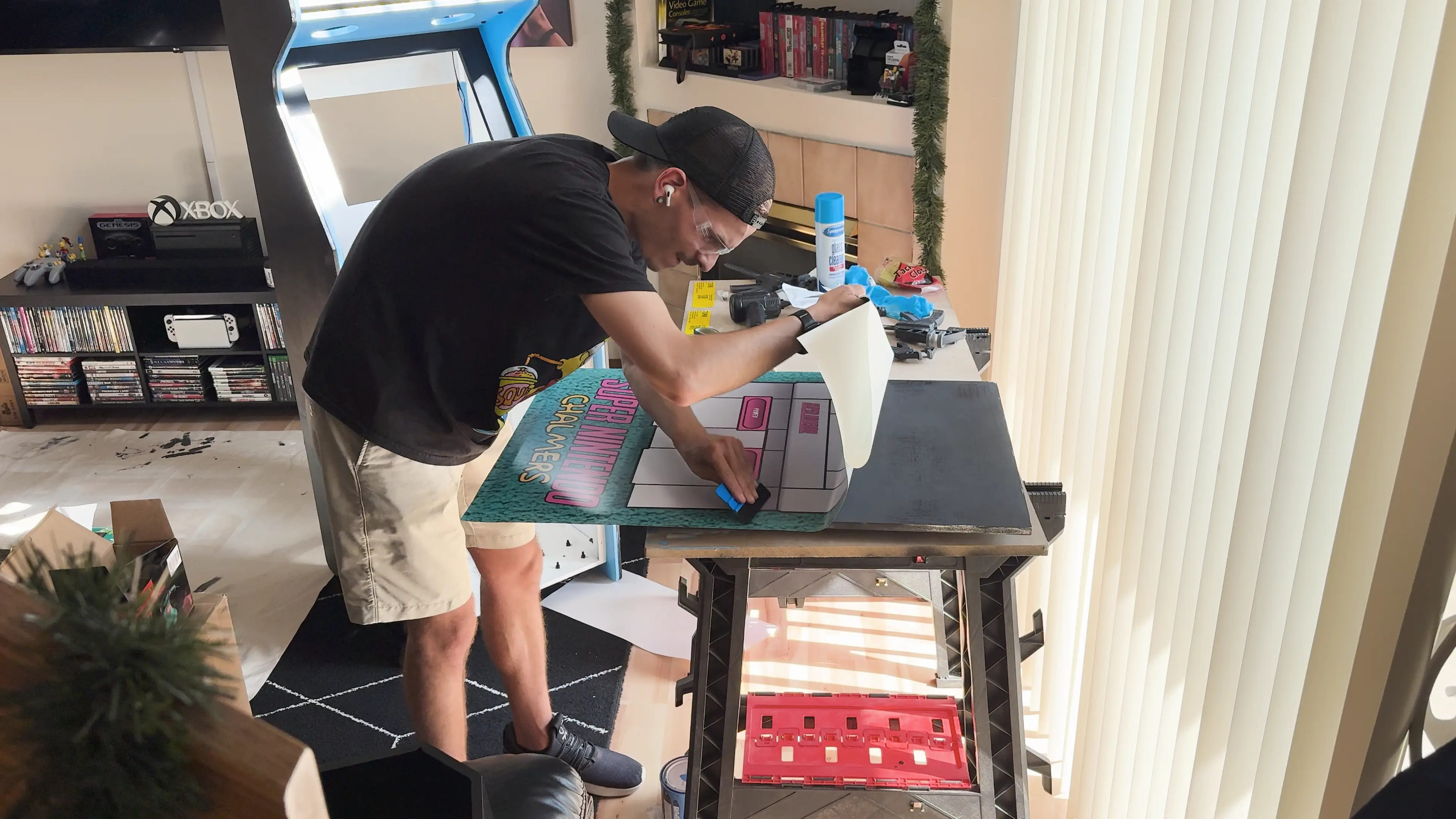

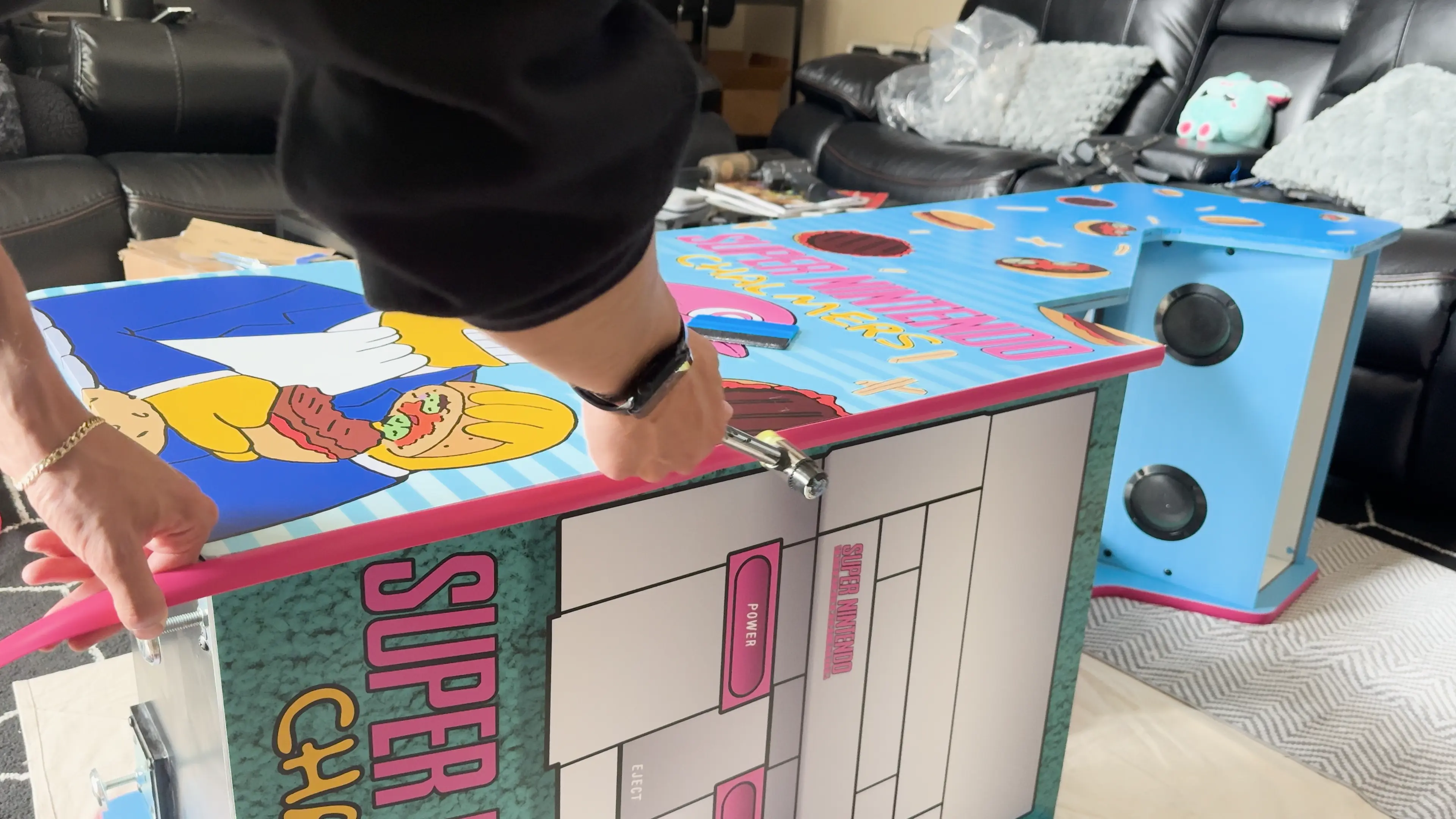

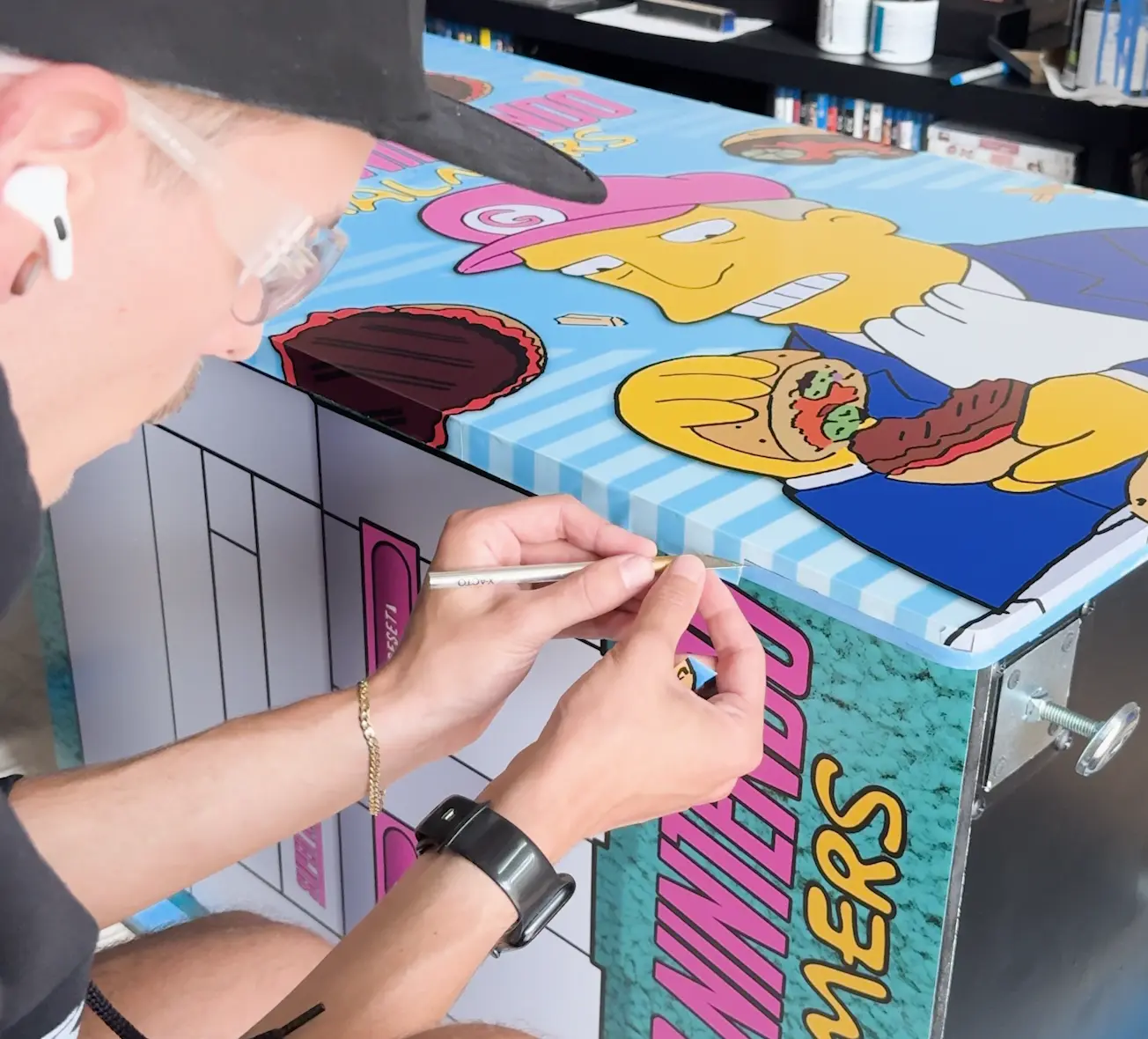

My next objective was to apply the rest of the vinyl artwork. I decided to tackle the side panels first, since I'd have to take the entire structure outside to prep it. This part went pretty smooth, and I tried a few modified techniques when applying the graphics. Instead of cutting the vinyl right at the edge, I cut slits into it and stretched it over the side right up against the T-molding slot. This made for an extremely clean look.
This is me (very carefully) wrapping the vinyl over the edges and cutting it away.
I also opted to bite the bullet and shell out for some RapidTac application fluid. I'd never used this stuff before, and honestly, it solved some problems and created other ones. Overall I think I'd still recommend it, especially for larger graphics like the side panels, but it kind of made the edges a little tougher to stick down and it also created more potential for material stretching. I'd give it a 7/10.

Somewhere in between the smaller graphic applications I decided it was time to cut the rear panels. I had purchased this 1/8" hardboard material from Dome Depot back in May when I bought the rest of my wood, and it finally met my workbench on a hot July afternoon. It was already cut into 2'x6' panels from the store, so I just did cut it down to 21" W and then figured out how long I needed each segment to be after. Nothing too exciting happened here, but I was glad to (hopefully) be done with the scary tools and the huge amounts of sawdust.
Using the glass coffee table as a light box is one of my favorite uses of my living room furniture.

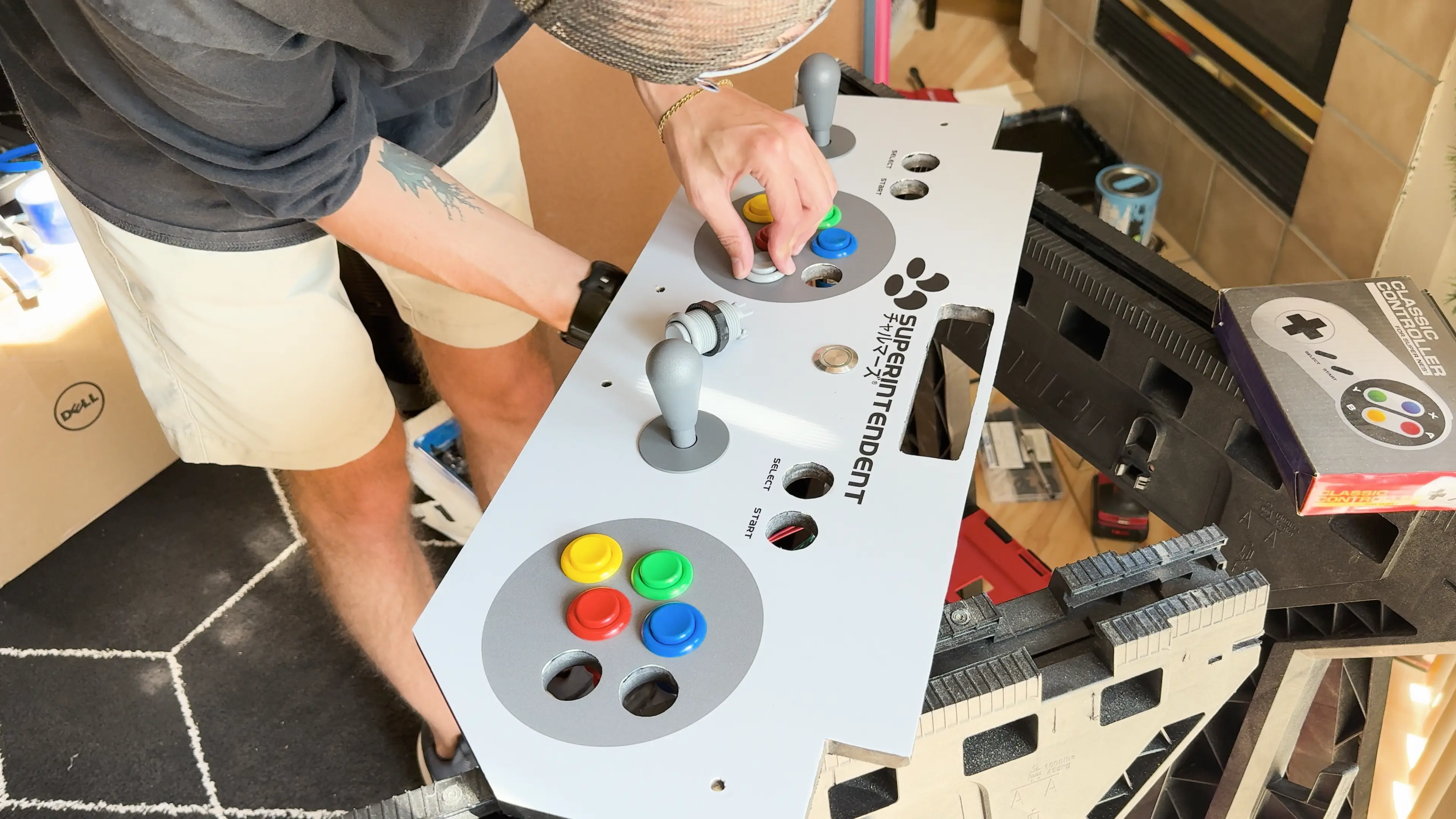

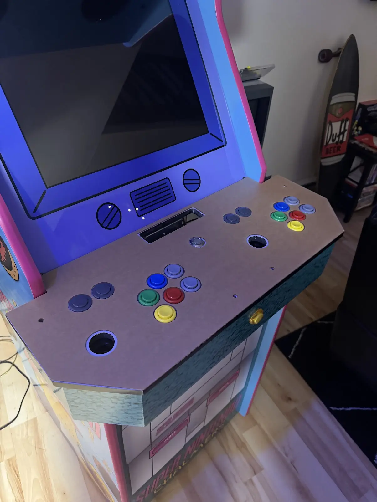

Okay, back to the vinyl. One of the more time consuming pieces to work on is the control panel. The stakes are quite a bit higher since there's text on the graphic that has to line up with specific holes, and then you have to carefully cut those holes out of the material. I did this the same way I did it last summer by setting it on my glass coffee table and shining a light from below for alignment.
Installing the physical buttons is actually kind of awkward with the joysticks already in place.
With all the holes cut out, it was time to populate them with the controls. Everything on this panel (besides the power button) is made by Industrias Lorenzo, the Spanish manufacturer who originally made the iconic joysticks and buttons for Happ in the 80's and 90's. I opted for 75g Cherry switches for the buttons, which have a bit more resistance than what some people might choose, but I like the feel of them. With the way they are designed, I can easily swap them out later if I change my mind.
I decided to mount some of the smaller electronics to the control panel underside.
I decided to mount some of the smaller electronics to the control panel with the buttons and joysticks.
After that, it was time to start wiring everything up! This is the most exciting part of any project for me. One huge benefit to working with such a physically large enclosure is that you don't really need to decide exactly where a lot of components go until the end, so I decided in this moment to put the Raspberry Pi, the 4-channel relay, and the HDMI switcher all on the underside of the control panel. I just figured this was an easy enough place to access for servicing, and it also meant I could run shorter wires from the power and easter egg butttons.
Something about wiring up a rat's nest just really excites me.
Now, as for wiring the actual SNES controls, I used a similar method to the Genesis 4. I mounted the raw controller motherboards under the panel, and just ran wires directly to the buttons. This was actually a lot easier this time around since there was only two controllers. There is also no control routing needed. On top of all of that, I also used aftermarket controllers that had handy test points for every single button, so there was zero need to scrape off any solder mask. 10/10 experience.

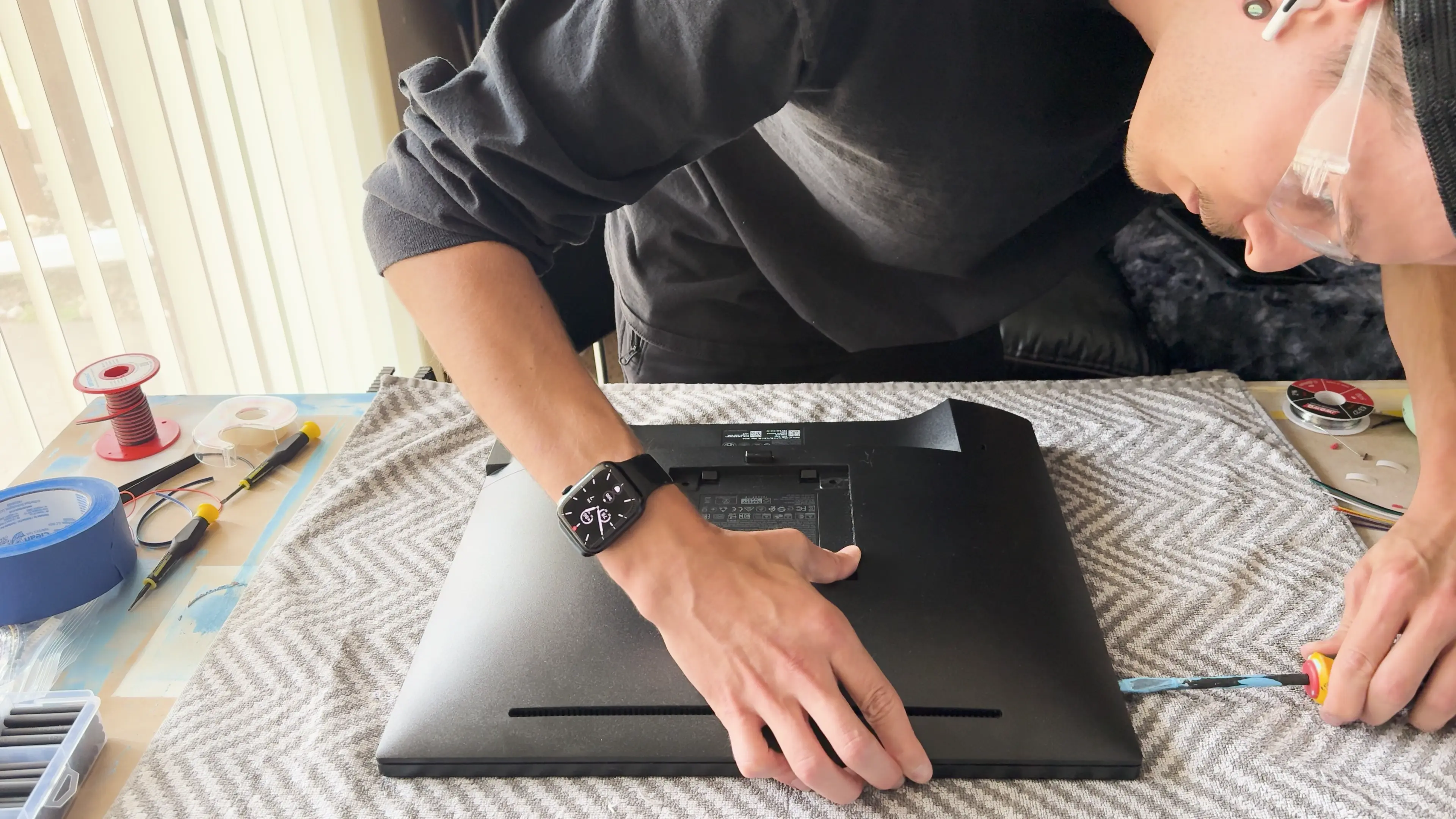

Decasing the monitor is always sorta scary even though I've never broken one.

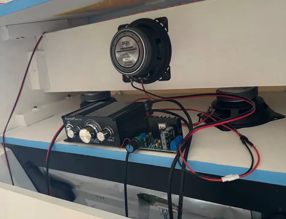

I feel like every update I write has some sort of "I wish I had thought about XYZ" element, and this one is no exception. When it came time to decase and integrate the display, I learned that I had ordered the incorrect LED driver board, and while the controller itself worked, I couldn't actually see the picture without holding a flashlight directly to the panel. The part itself is relatively inexpensive, but they only ship from China and I was facing a two week setback.

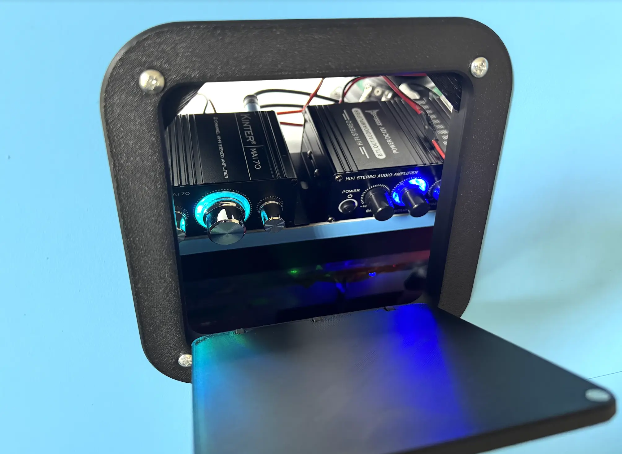

A look at the audio setup in the top part of the cabinet.

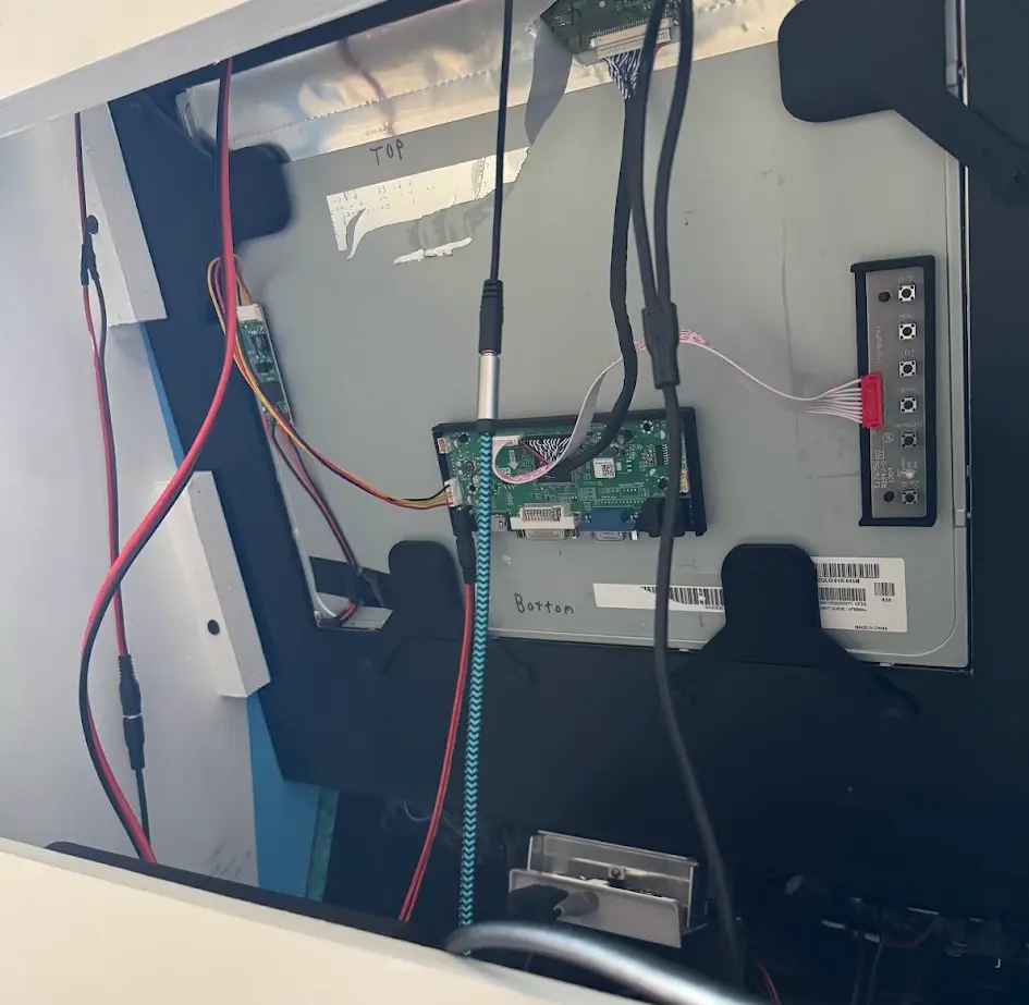

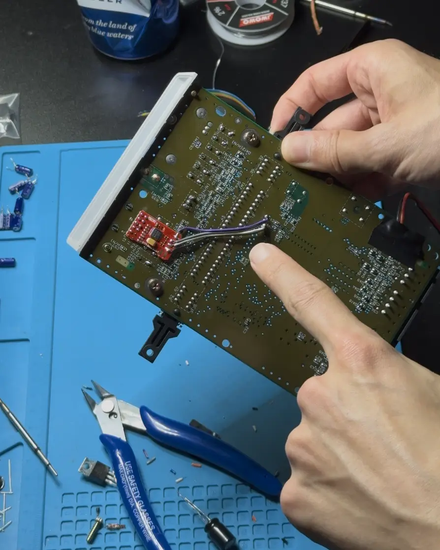

Despite this, I pressed on and started to put the rest of the components inside the machine anyways. I got all 3 speakers integrated and wired up the amplifiers, I added the power input and internal power supply, and I did the entire video signal chain (including the RetroTINK 5x Pro).
A rear view of the display before I corrected the LED driver board.
Right around this same time, I posted a casual clip of myself testing the soundboard as an Instagram reel, and well, for some reason it took off. I was so mad at myself for not researching more, because now I had tons of eyes on the project and I couldn't actually show it playing any games.
This video really blew up for some reason. I'm not complaining!
I sat waiting for about 5 days before I decided I could not risk losing this momentum, and I decided to just "borrow" a compatible board from a different cabinet I had. It was literally plug and play, and with everything else integrated, I could finally show off some gameplay and some of the visual easter eggs. I haven't done too much since then, but there are still problems I hope to solve before the bezel arrives and I can consider this project "done".
My follow up reel I posted last night for all my new followers.
One thing that really bothers me is that EVERY time one of the easter egg videos plays (both the startup animation and the Steamed Hams clip) the display throws a large INPUT: HDMI graphic in the upper right corner. I spent a fair bit of time yesterday trying to figure out if I could remove the OSD entirely, and, well, I just can't. I'm thinking I'm going to have to add some sort of frame buffer in between the existing HDMI switcher and the display controller board, which sucks, but honestly I think adding a very small amount of latency is a fair trade until I come up with something better. I have a tracking number for the bezel finally (took some harassing but we got it done) and it should arrive sometime next week!

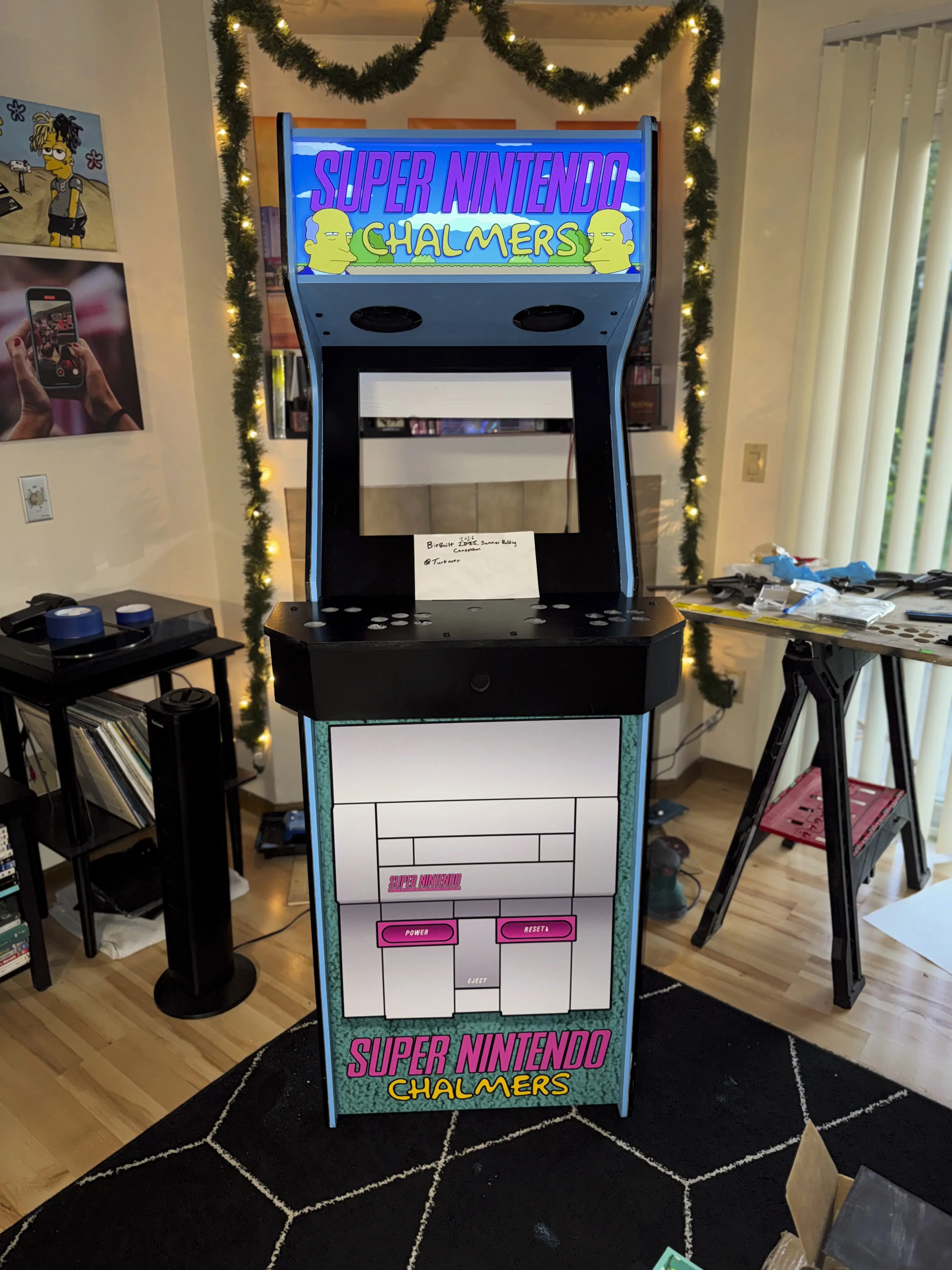

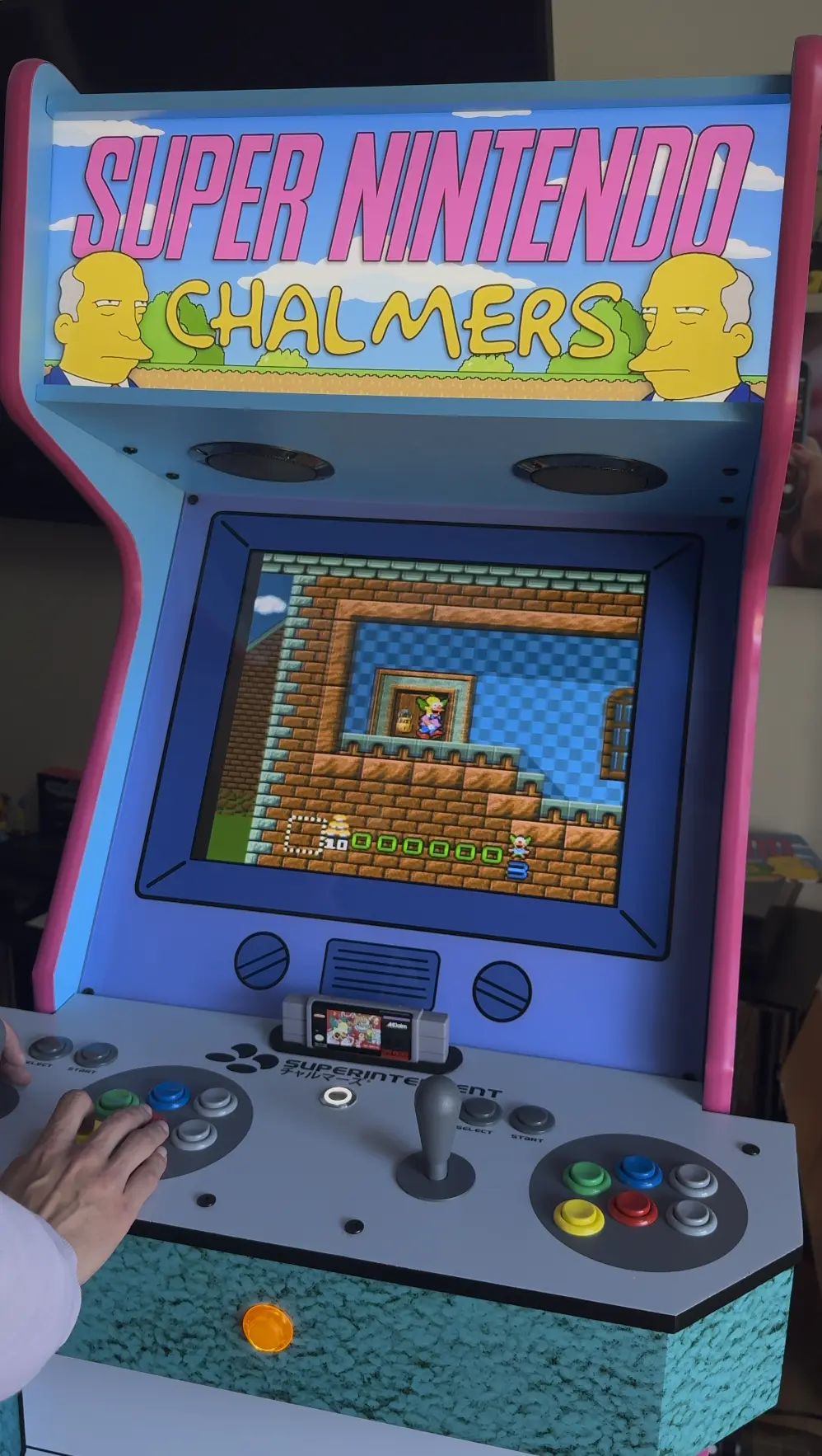

The bezel-less cabinet as it stands in my living room today.
