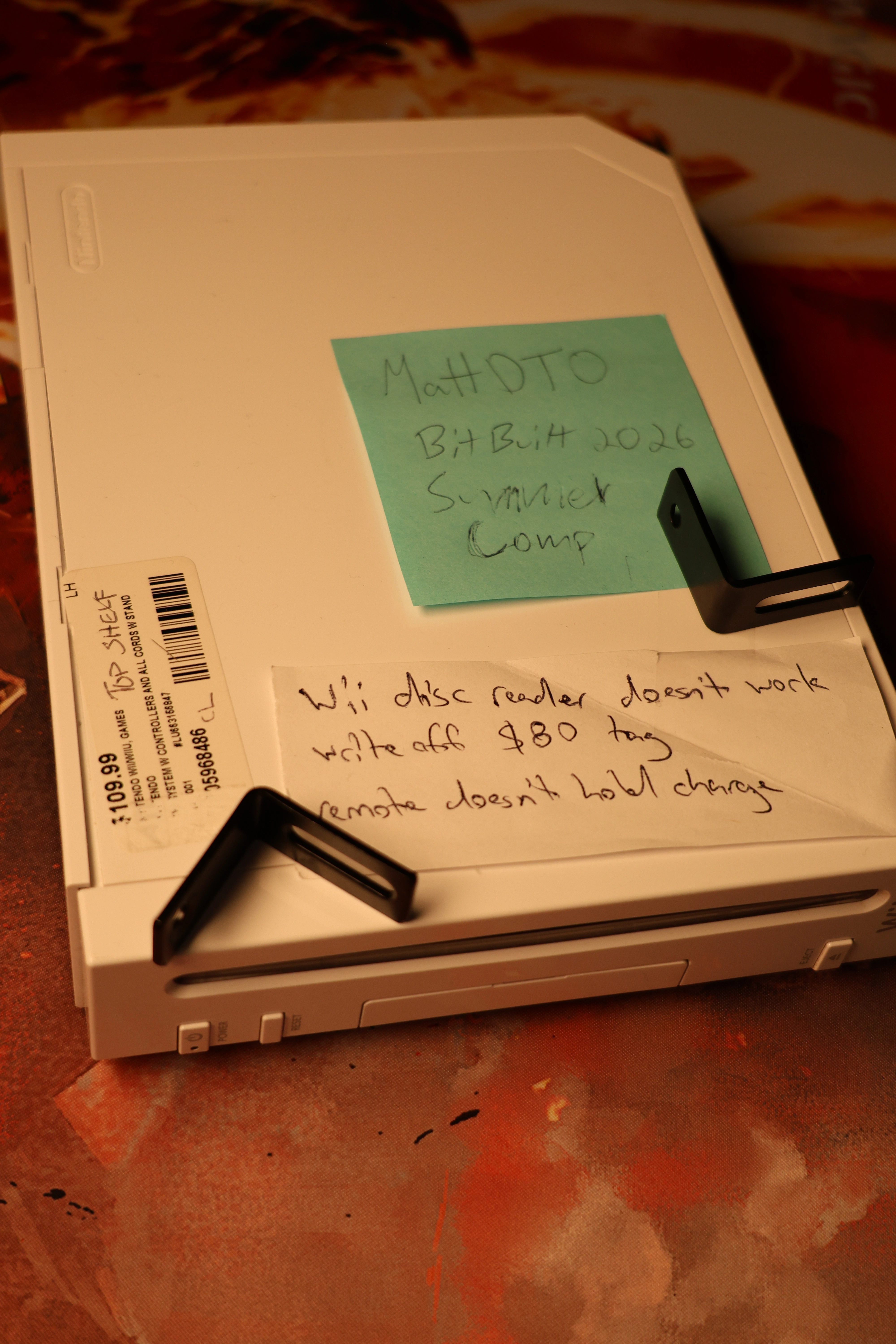

Anyway, I went to a pawn shop and asked if they had any broken consoles in the back. I feel like I got super lucky and was able to pick up this bad boy for $20!
I haven't even turned it on yet, so hopefully there are no surprises.

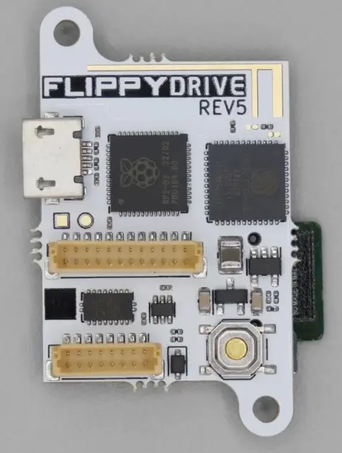

Comparing this to the Gamecube, the GC actually has ODEs that are alive and well:
  • GCLoader
  • FlippyDrive
  • cubeODE

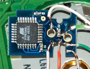

Most of them are designed to region-unlock the Wii. Like the WiiKey:
They are designed to work with the disc drive to unlock it, not fully replace it.

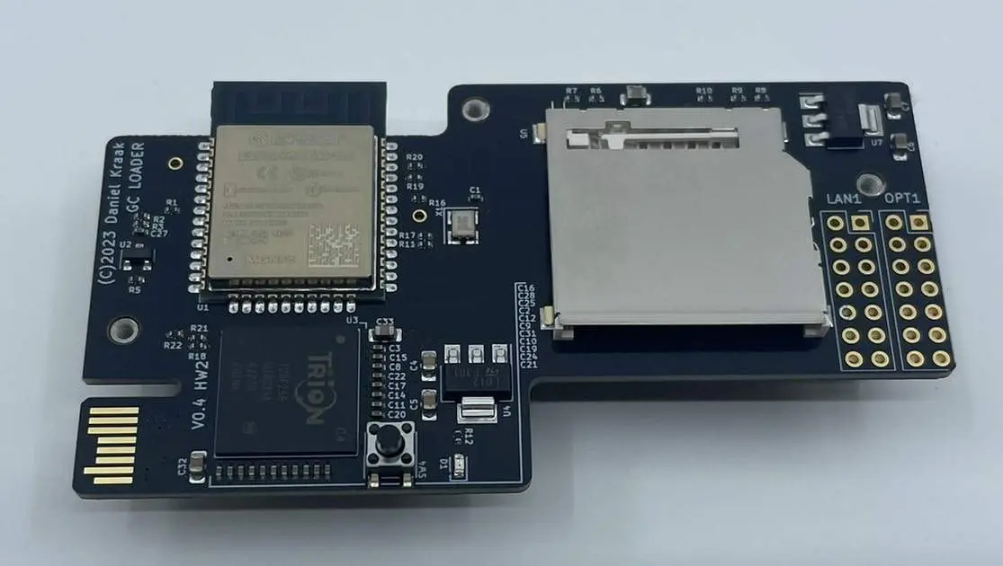

Such as the FlippyDrive: https://www.crowdsupply.com/team-offbroadway/flippydrive
and GC Loader: https://gc-loader.com/product/gc-loader-pnp-hw2/
But those are both for the gamecube.

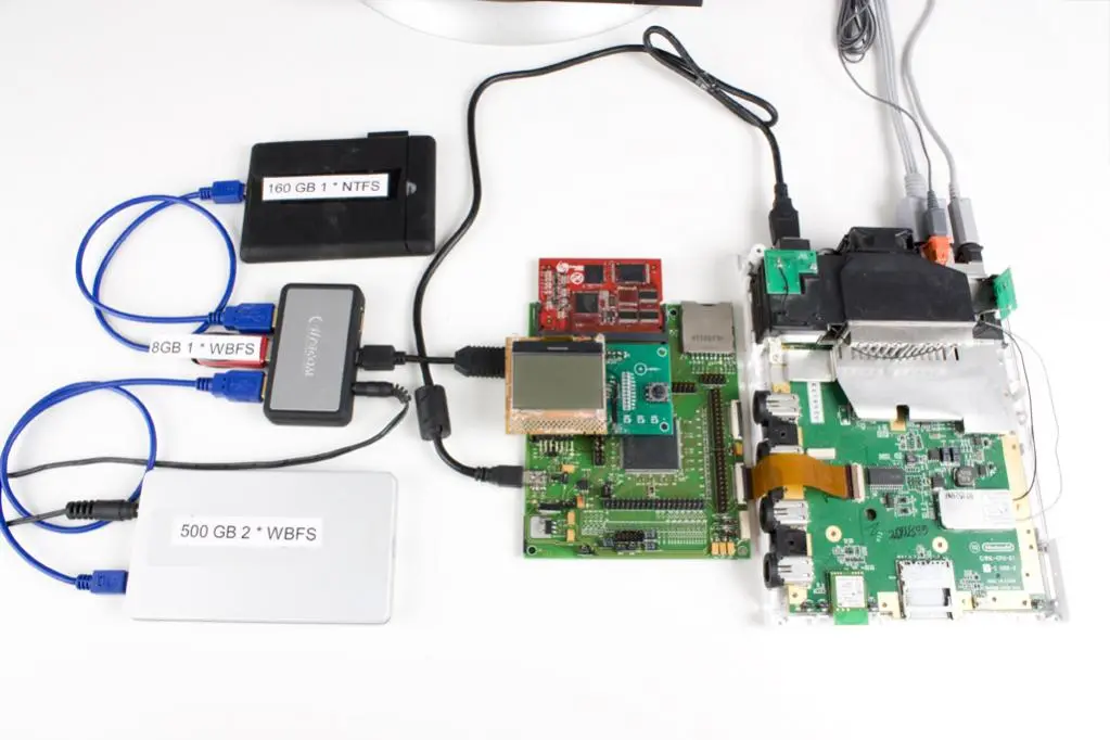

Interestingly, I found this article from 2009 for the announcement of WODE too. You'll have to translate it from Dutch to read it: https://tweakers.net/nieuws/62596/hackers-bouwen-nieuwe-mod-oplossing-voor-wii-console.html
Here's a picture of the WODE:

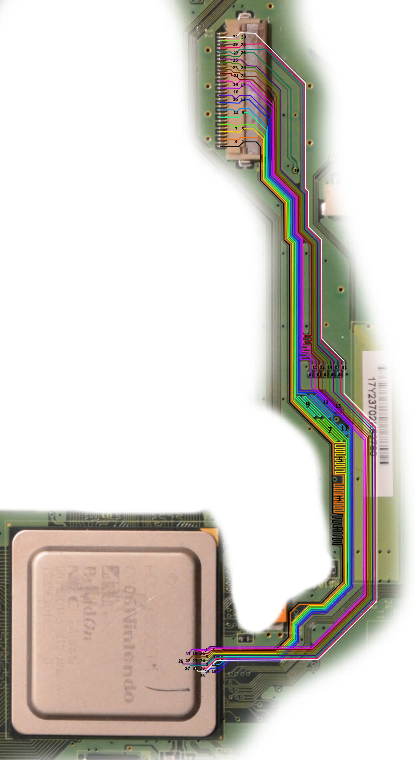

I also downloaded the images from here: https://bitbuilt.net/forums/threads/shanks-wii-super-thread.216/
So I could crop this picture of the traces that the Wii uses to connect to the disc drive:

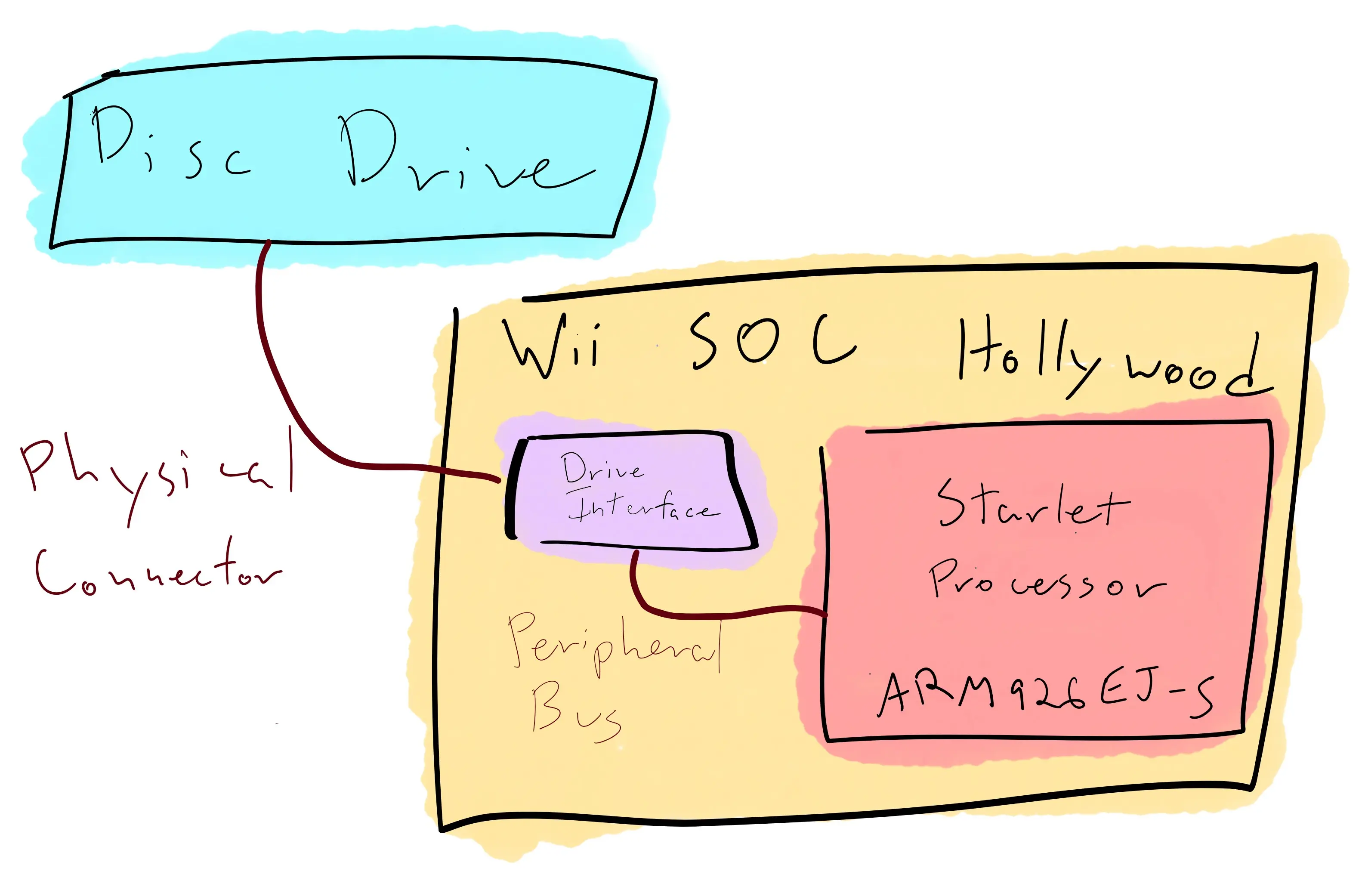

I want to add a little more information about how the disc drive works in the Wii, along with more links.
First, I spent way too long (like almost 2 hours) drawing this picture:
In the Wii, the main CPU, Broadway, is not actually connected to the disc drive. https://en.wikipedia.org/wiki/Broadway_(processor)
The Wii has a SOC (System on Chip), Hollywood. https://en.wikipedia.org/wiki/Hollywood_(graphics_chip)
Hollywood is what actually contains the drive interface hardware, along with an ARM processor core.
So in the Wii, the main CPU uses the instruction set PowerPC ISA 1.10, but the ARM coprocessor uses ARMv4T. Pretty interesting!

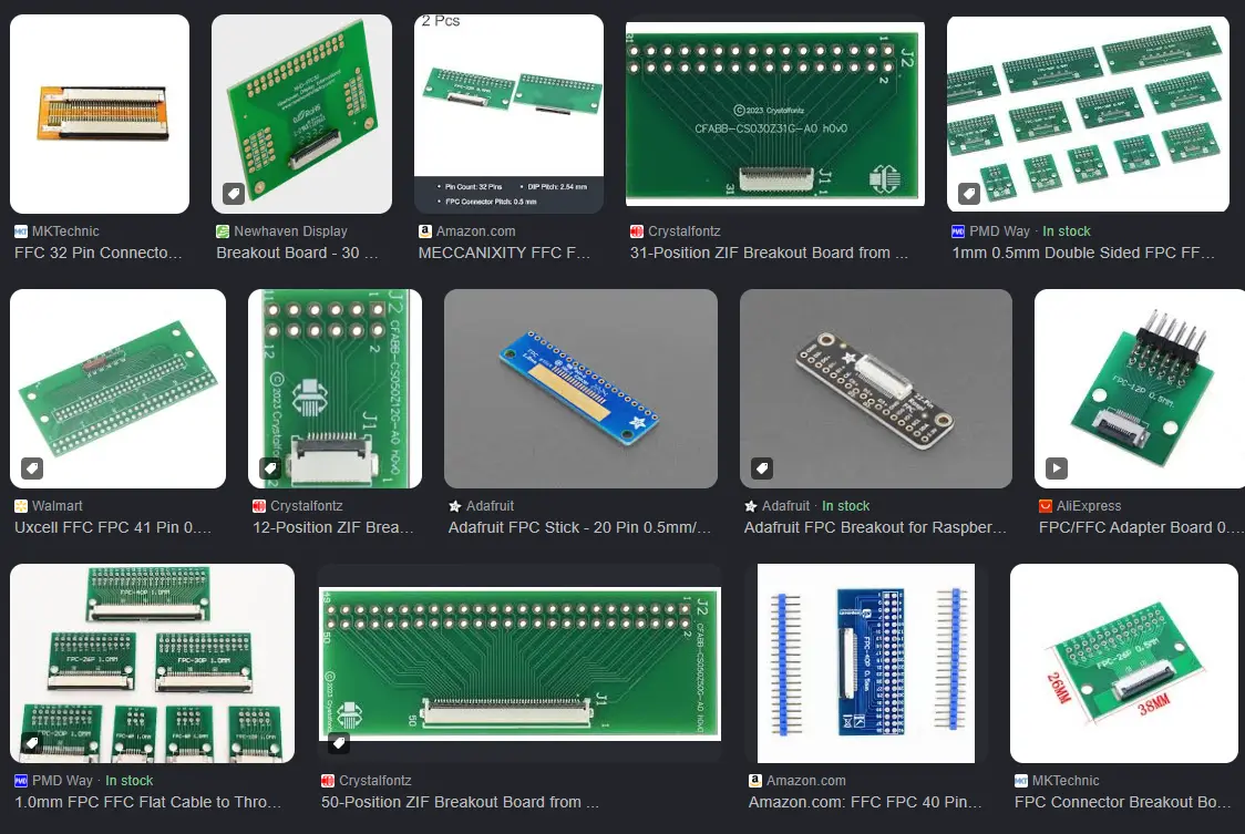

The next step is to pick a breakout board compatible with the ribbon cable.
Then I can hook it up to my Sispeed SLogic16U3, and try to read the signals just like we saw Wiibrew talking about!

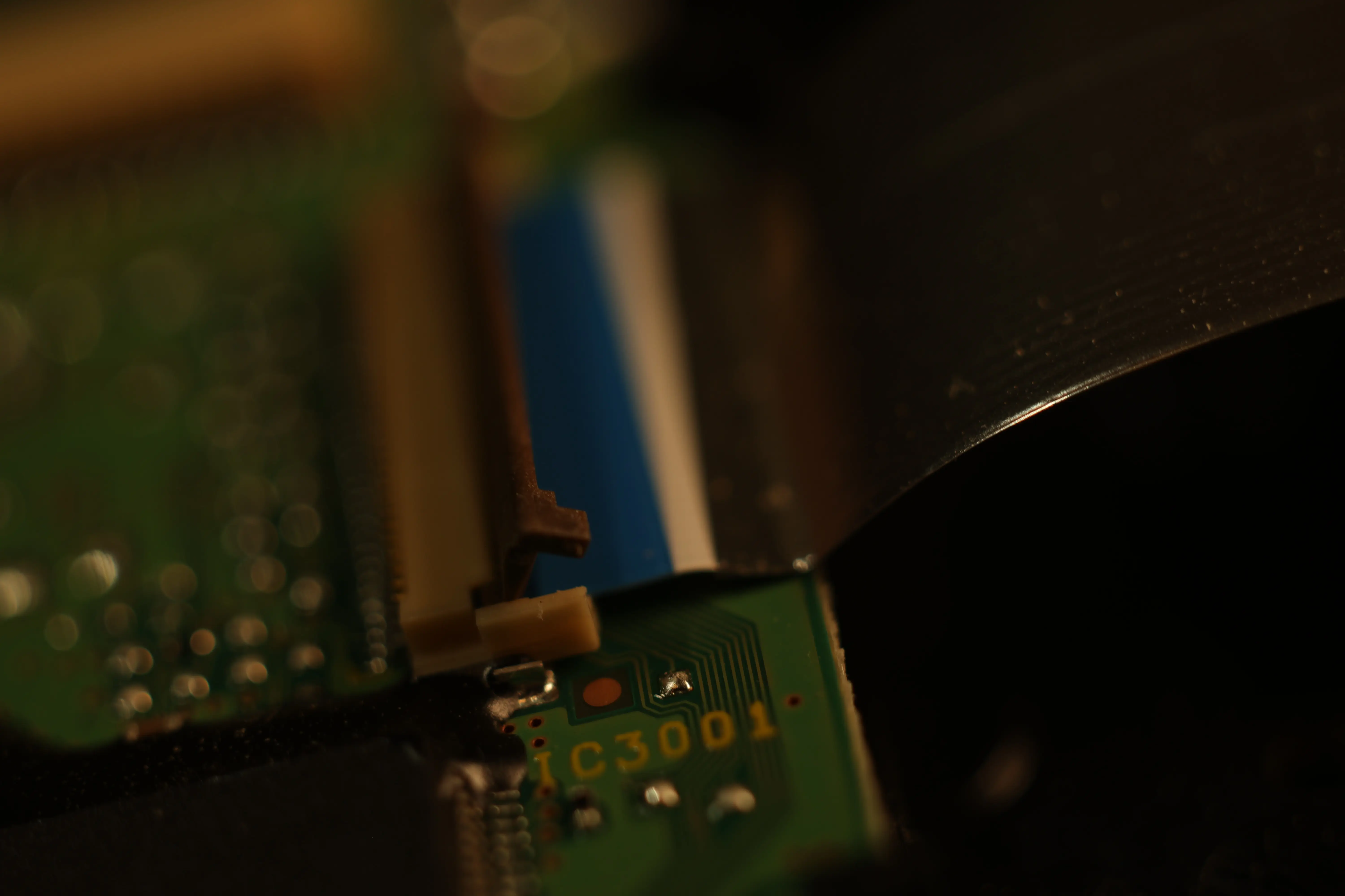

Ribbon Cable is a different thing than Flat Flexible Cables (FFCs) and Flexible Printed Circuits (FPCs).
As an example, @emberwolf posted some images of the FFC and FPC used in Gamecube in this post.
I included the pictures here too.

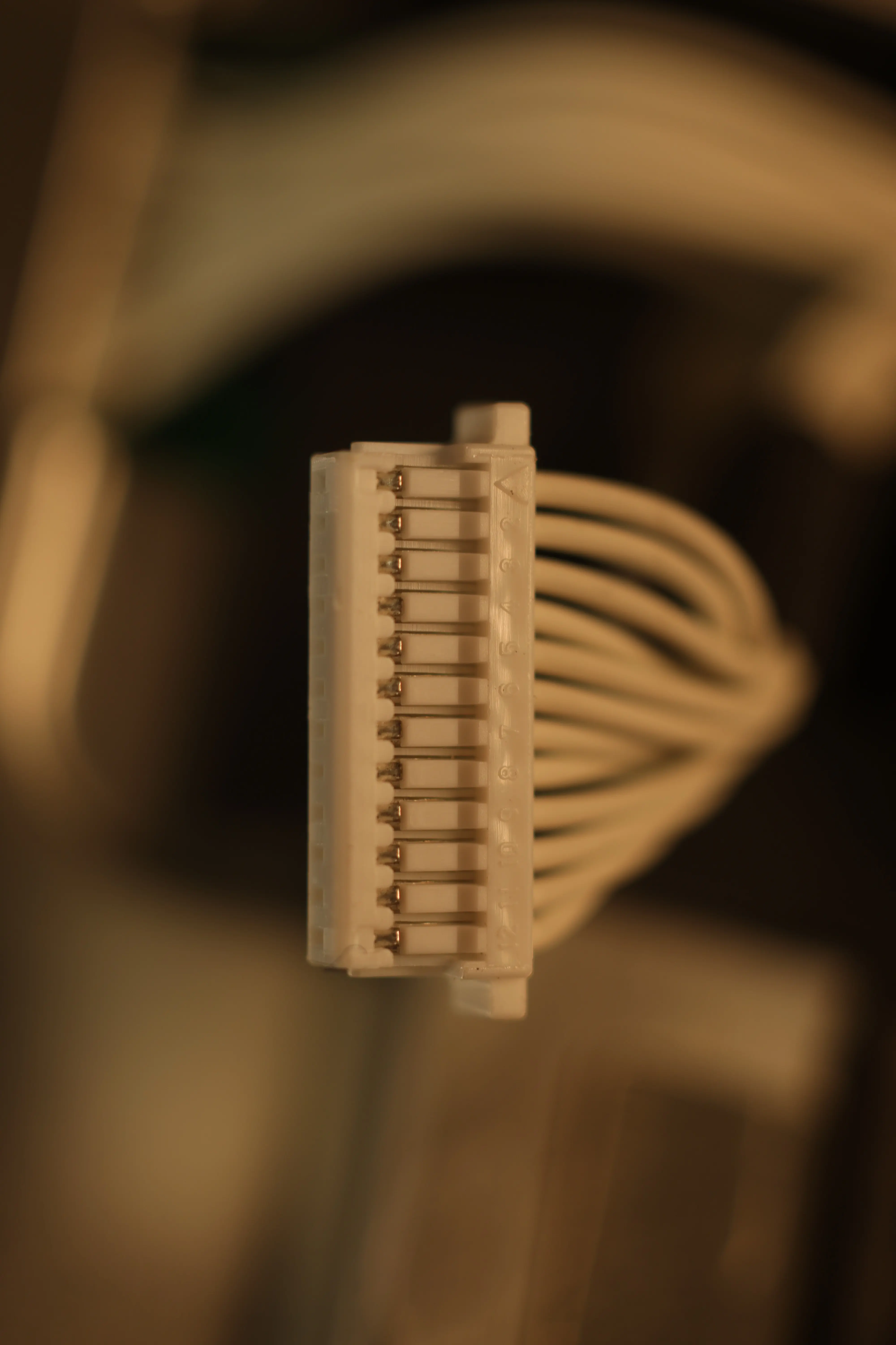

Here's the FFC from the gamecube:
and here is the FPC from the gamecube:
A ribbon cable is basically a bunch of wires glued together, where the above FPC/FFC are more like a sandwich made up of different layers.
Flat Flexible Cables are designed to bend over and over, where Ribbon Cable is more stiff and would wear out if used that way. That's why FFC would be used for something like the Gameboy SP to connect the display to the motherboard. An FPC is like a PCB, but flexible, and it can also use a similar connector that FFC uses to attach to another PCB.
The Wii uses an FFC to connect the disc drive to the motherboard. Funny enough, the Wikipedia page on FFC calls out "DVD players" as an example of where FFC are widely used.

The most important values are the pitch and the pin count. For the gamecube, the pitch for the white FFC cable is 1mm 12 pin and the orange FPC cable is 0.5mm 20 pin.

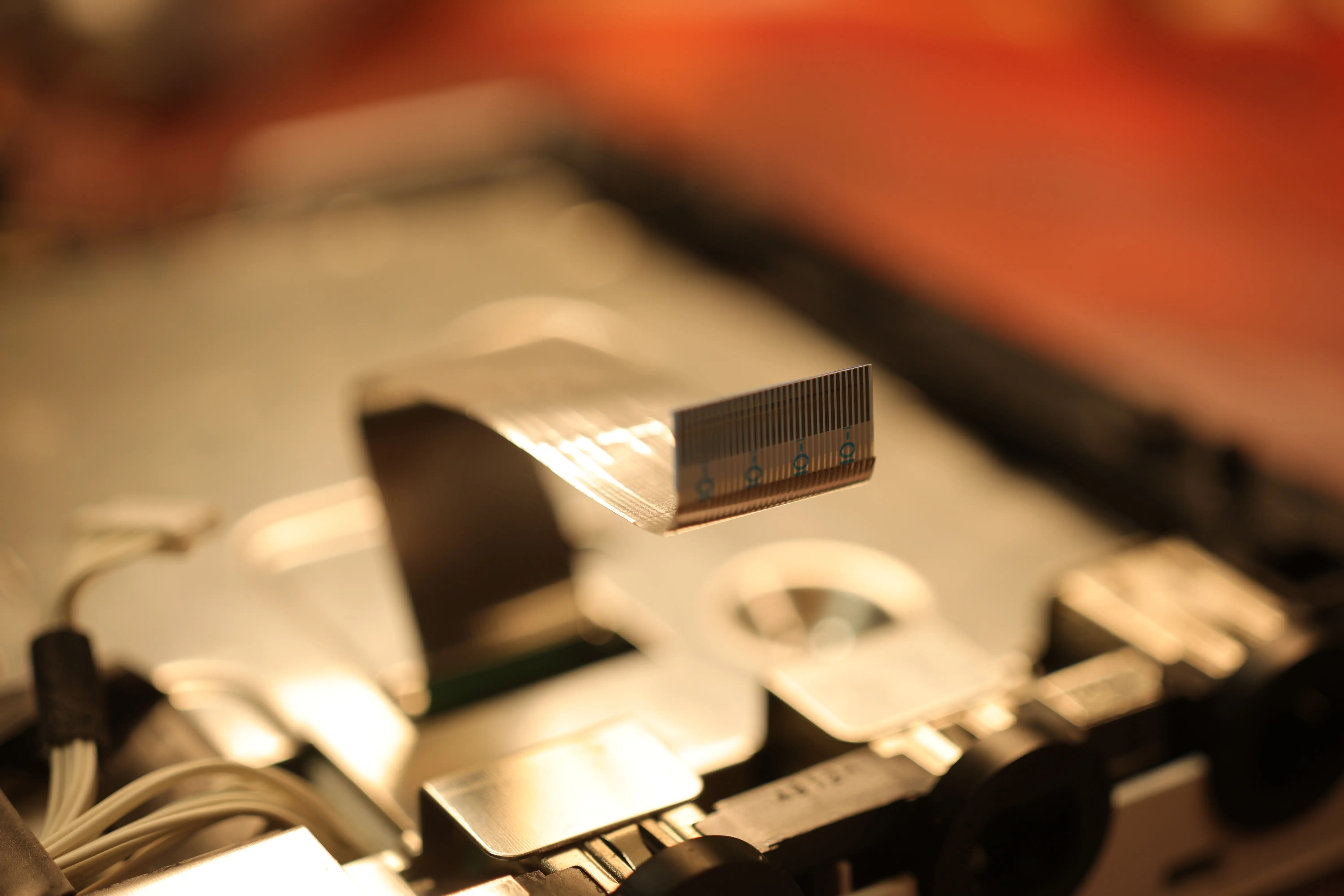

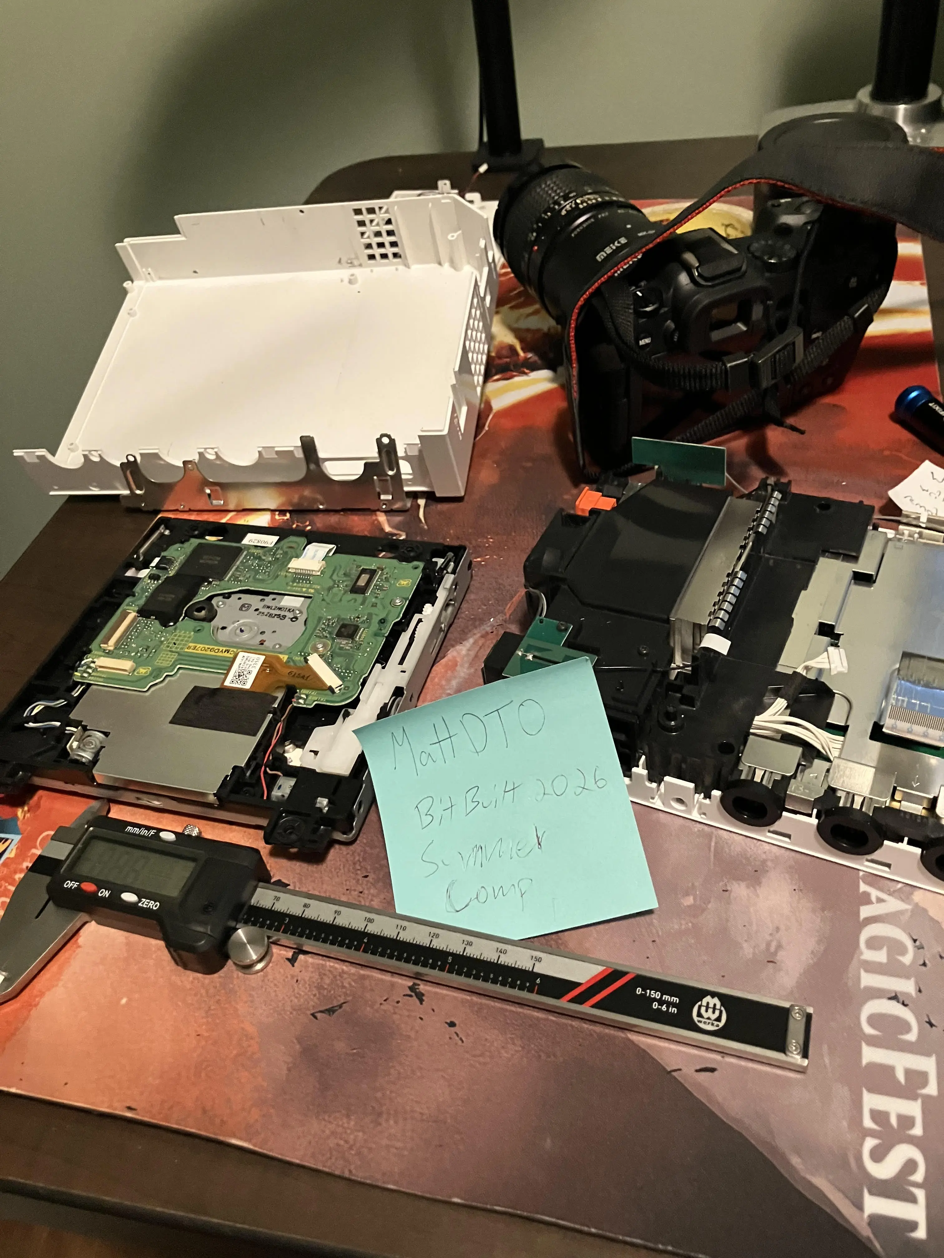

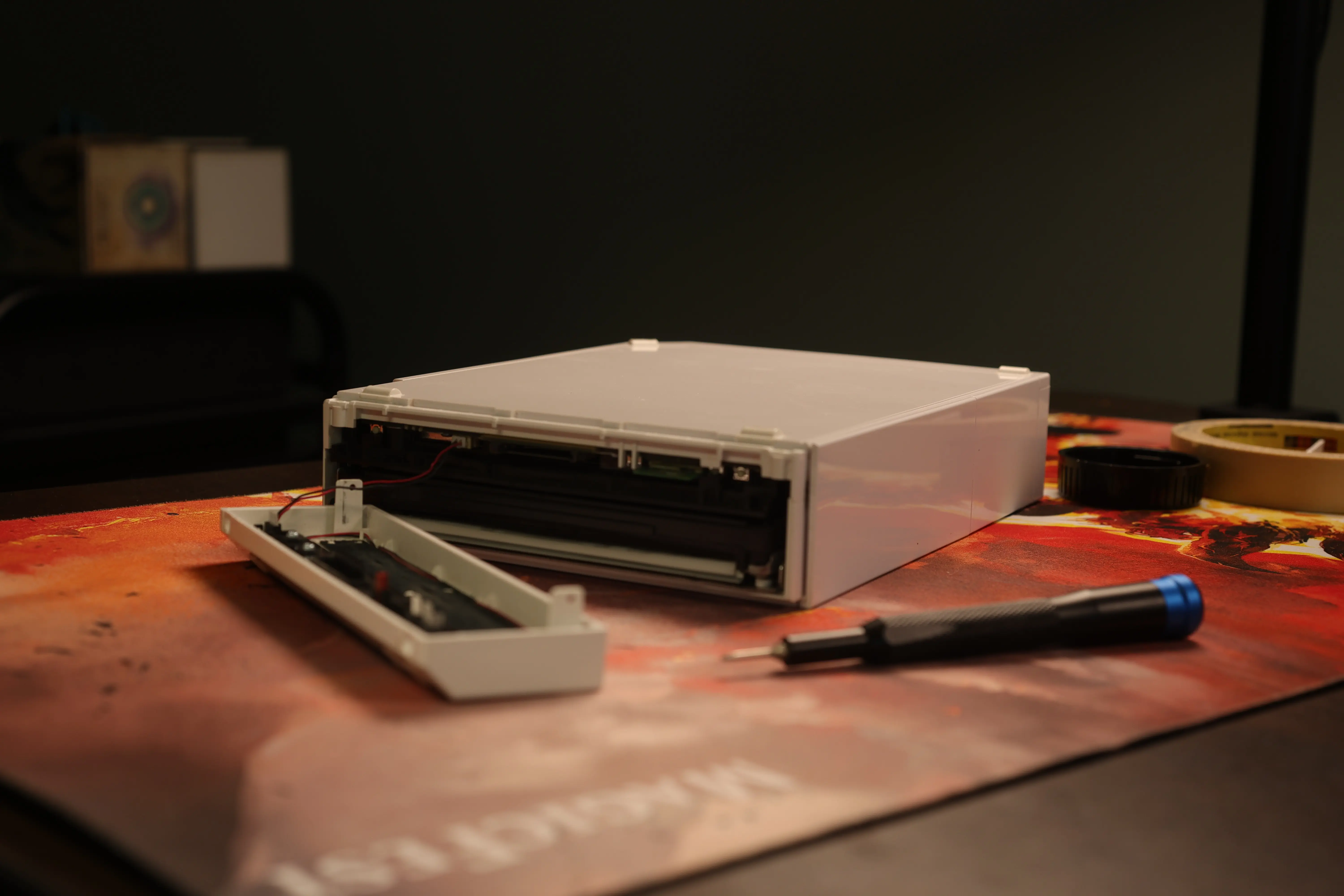

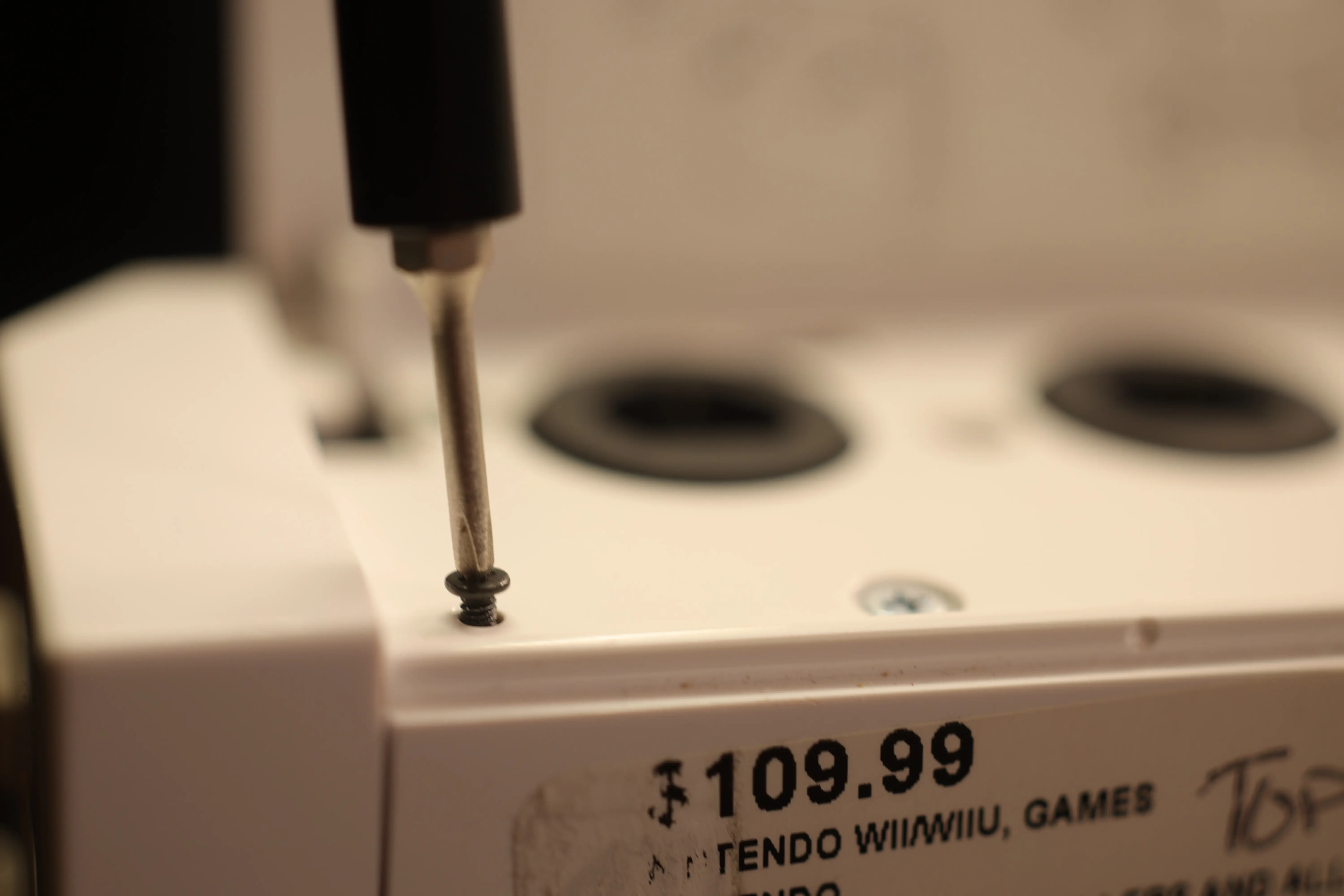

Anyway, before I got side-tracked researching FFC cables, I did undo a couple screws on my Wii and take the front panel off.

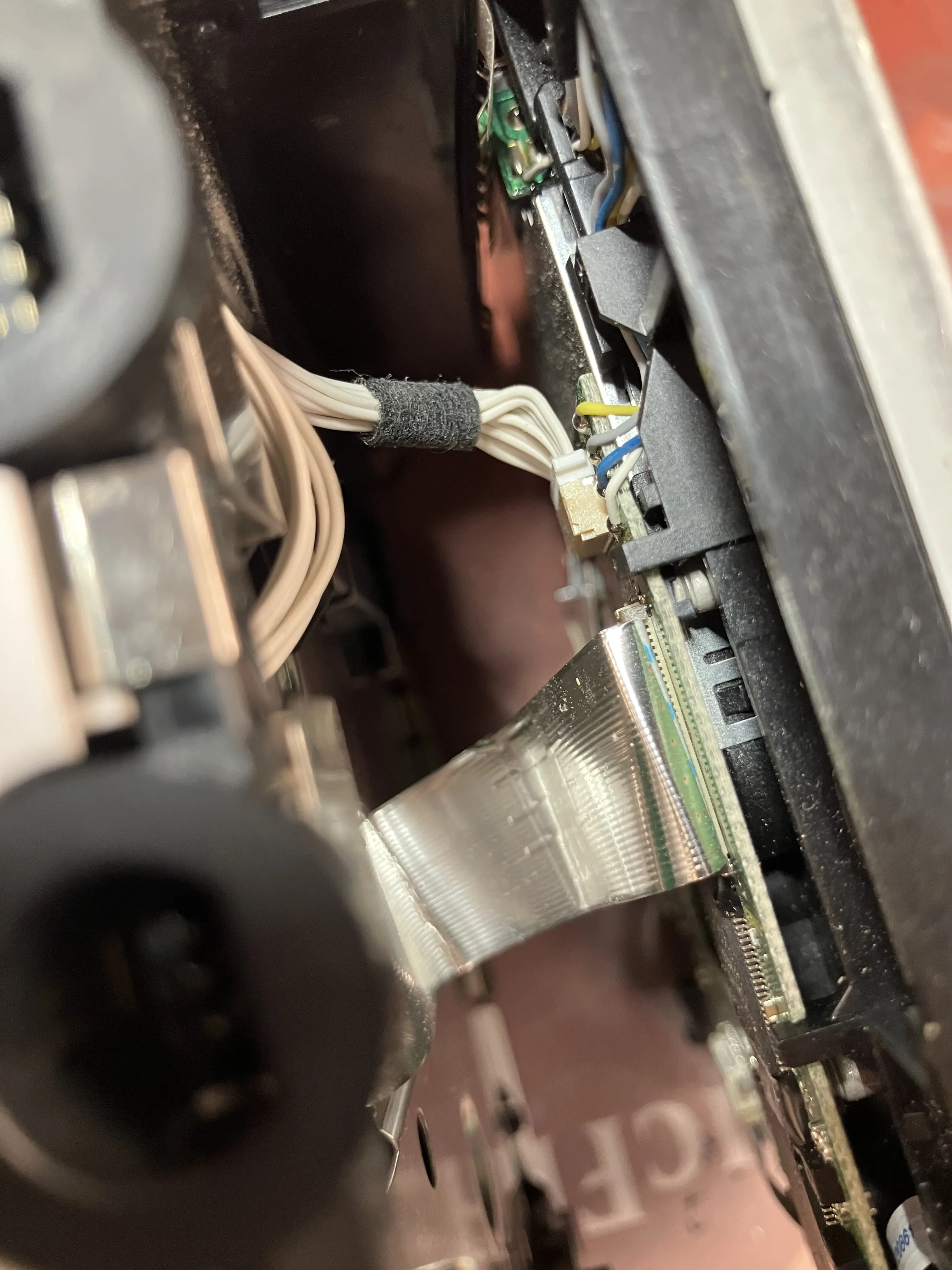

I got the Wii open, and here is a glimpse of the disc drive cables:
I feel like with this project, it has been interesting for me to dive into every detail of the disc drive interface. It's like I stopped asking whether I need to know something, and instead just exploring every detail I can.

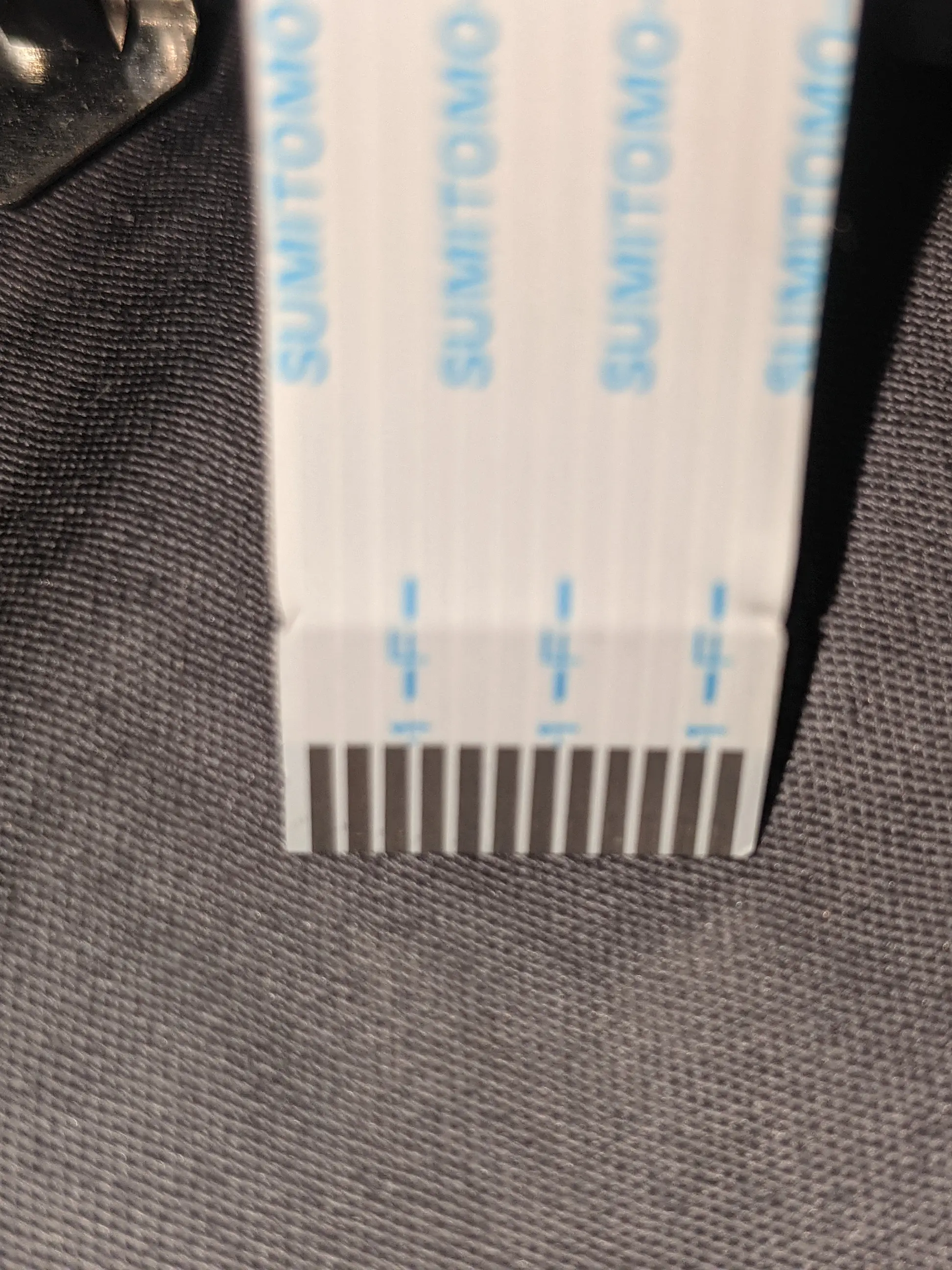

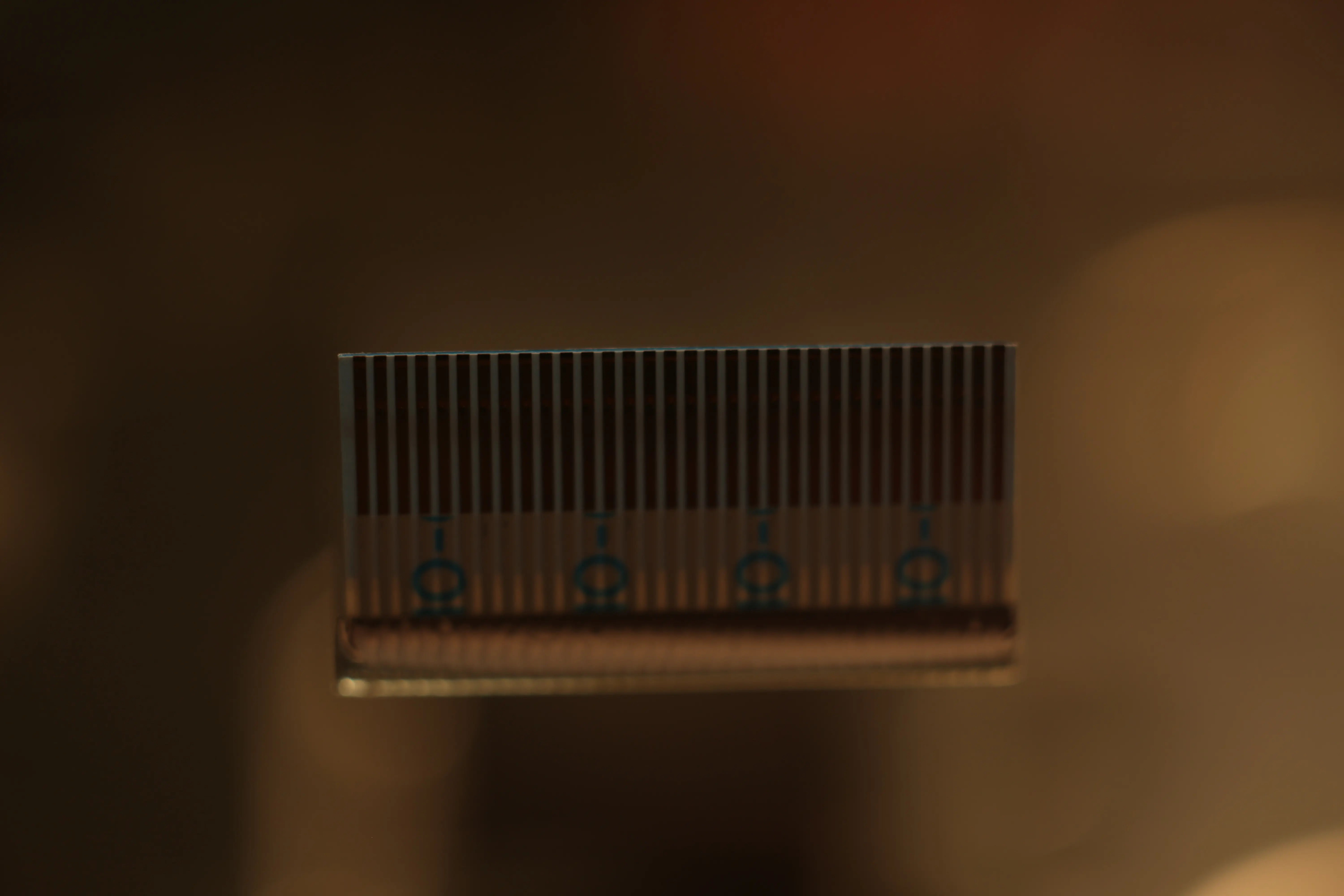

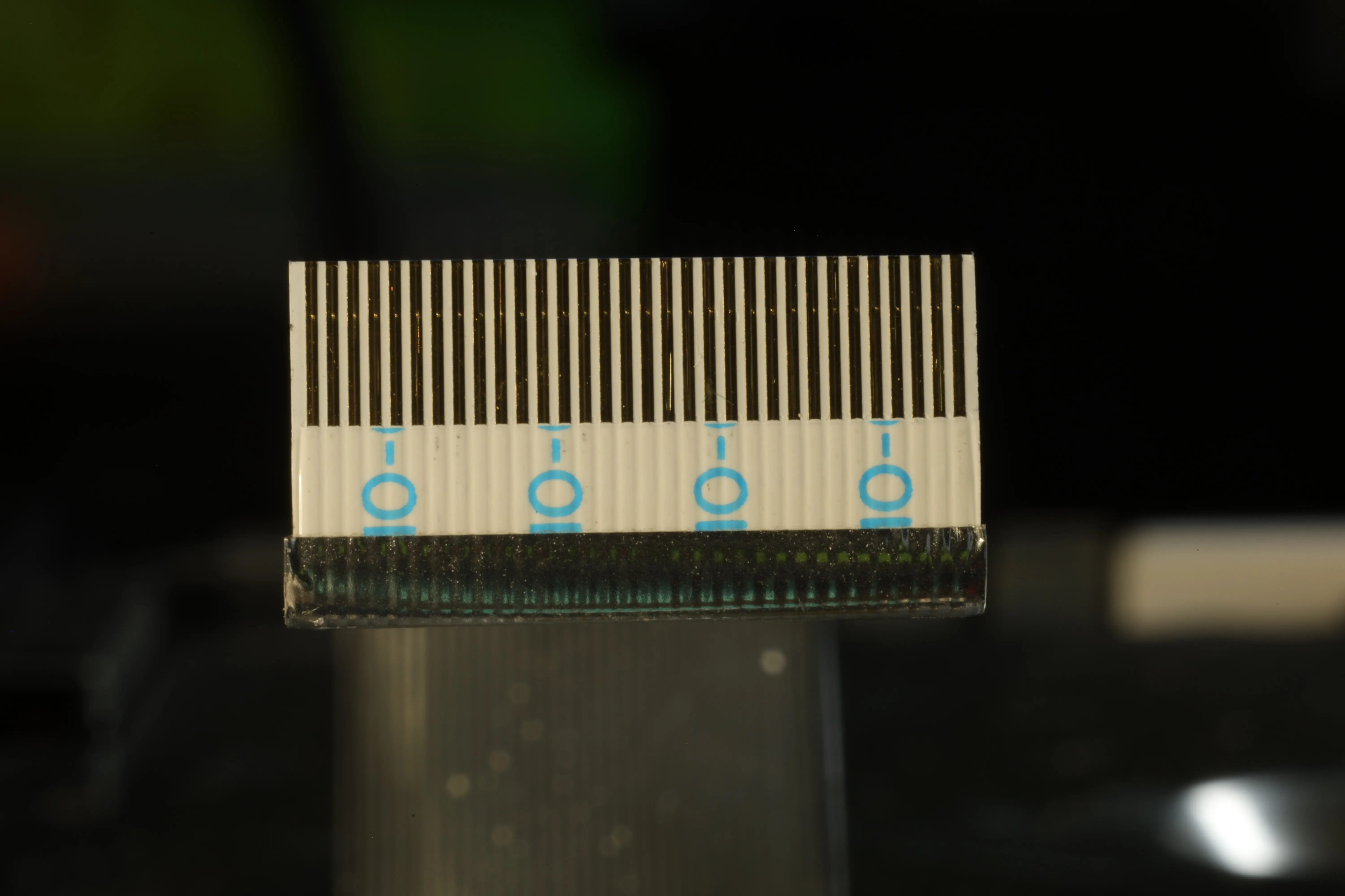

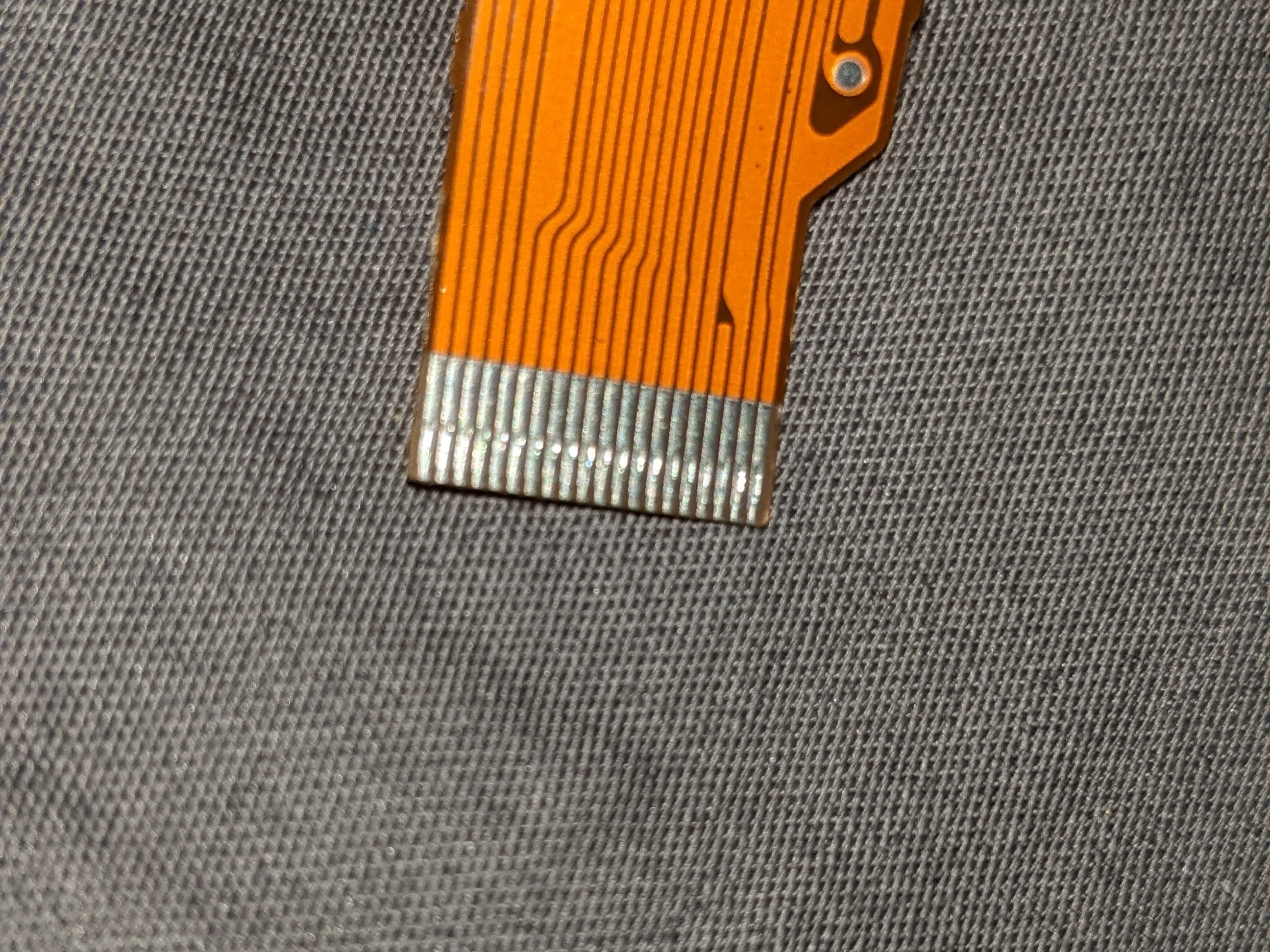

Like here is the exposed electrical connection of the FFC disc drive cable:
It has enough detail I can easily count the pins.

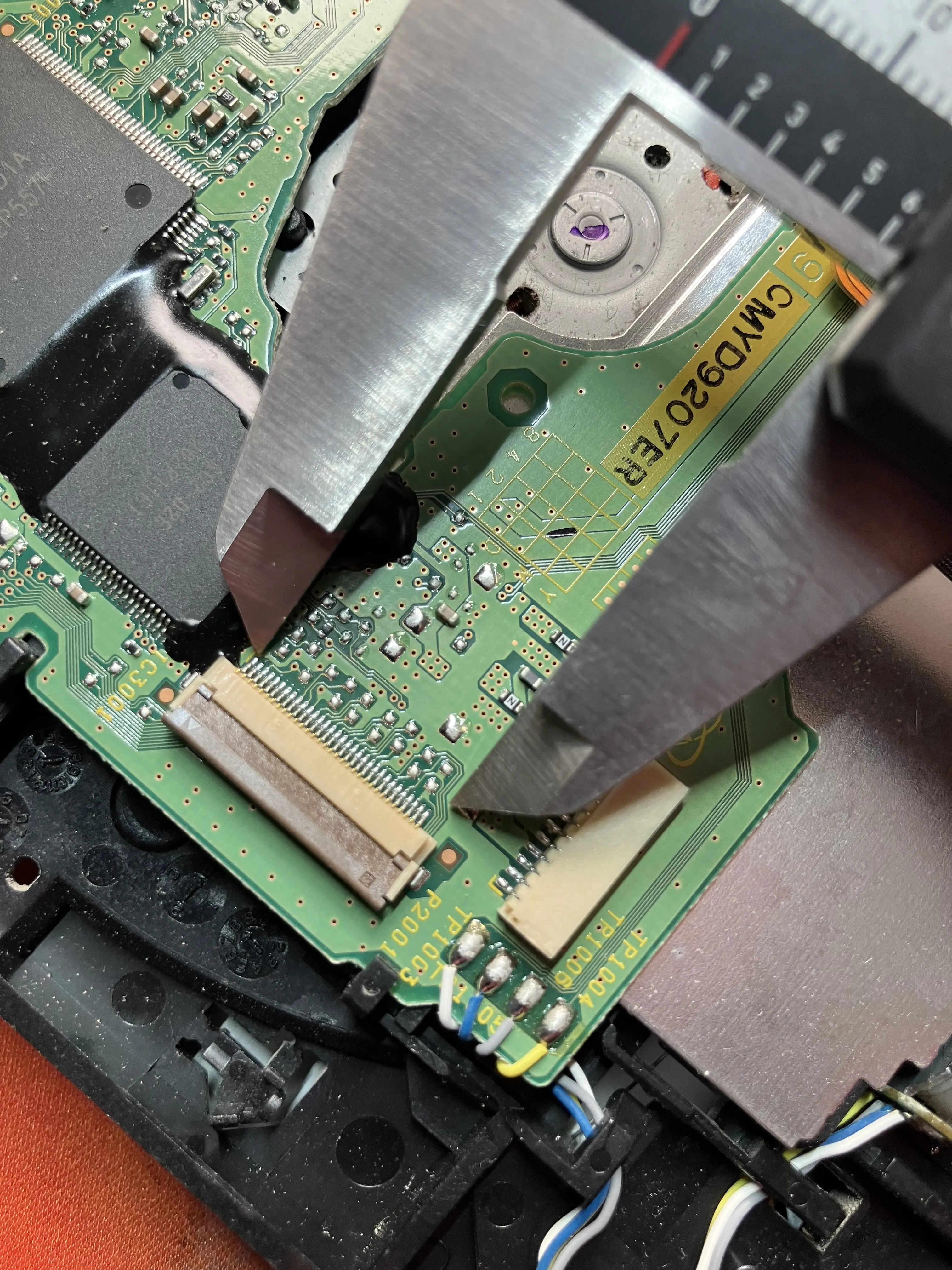

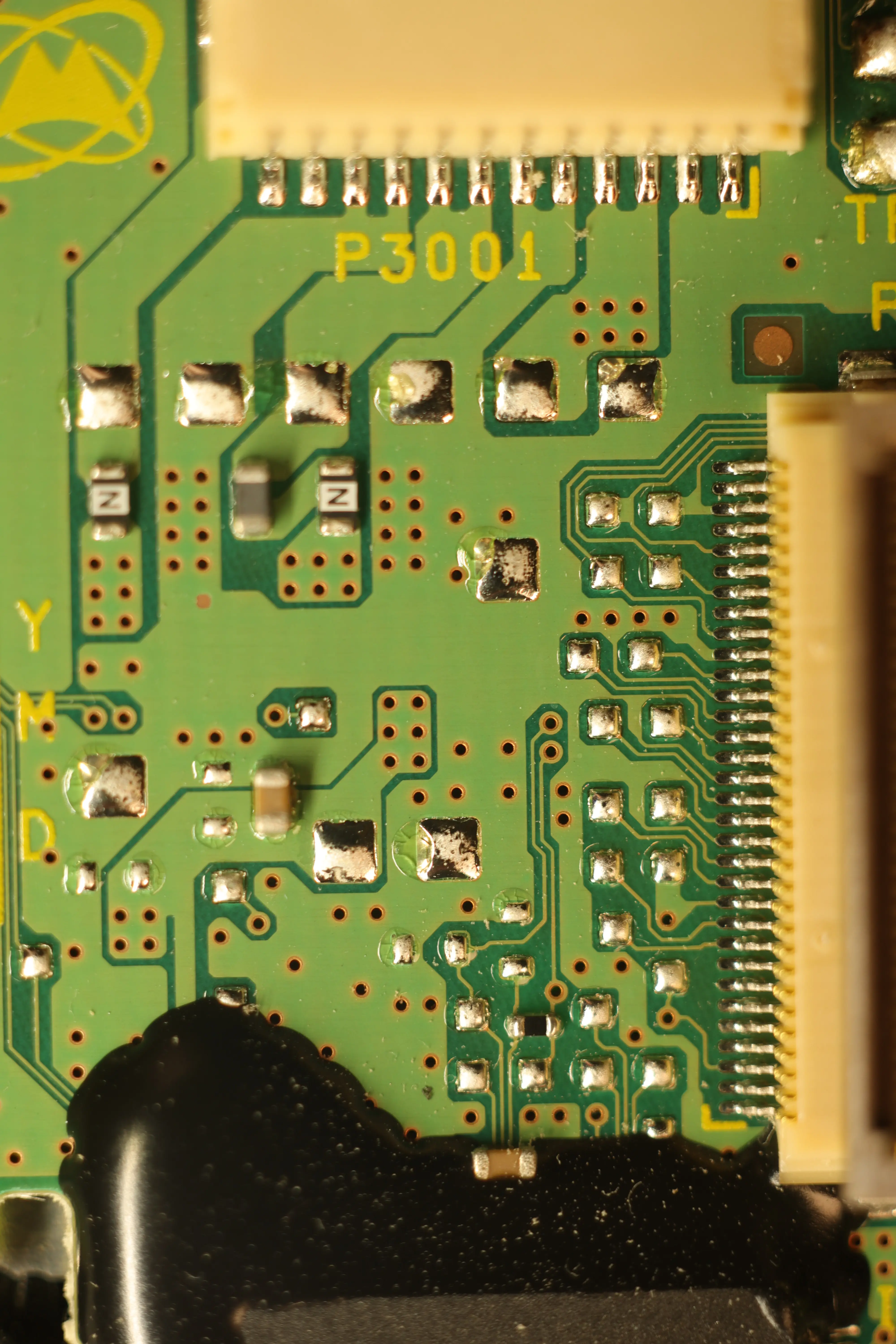

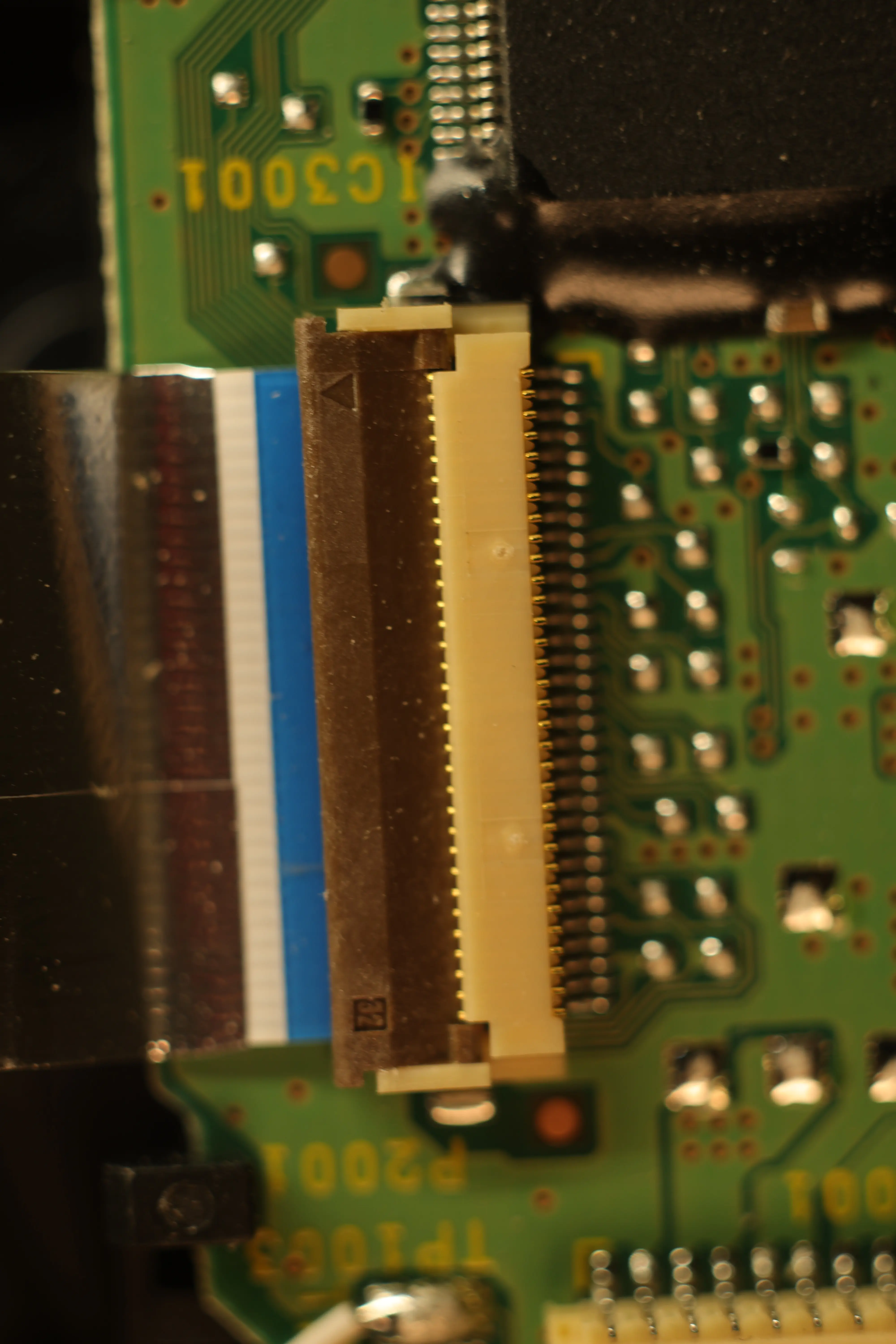

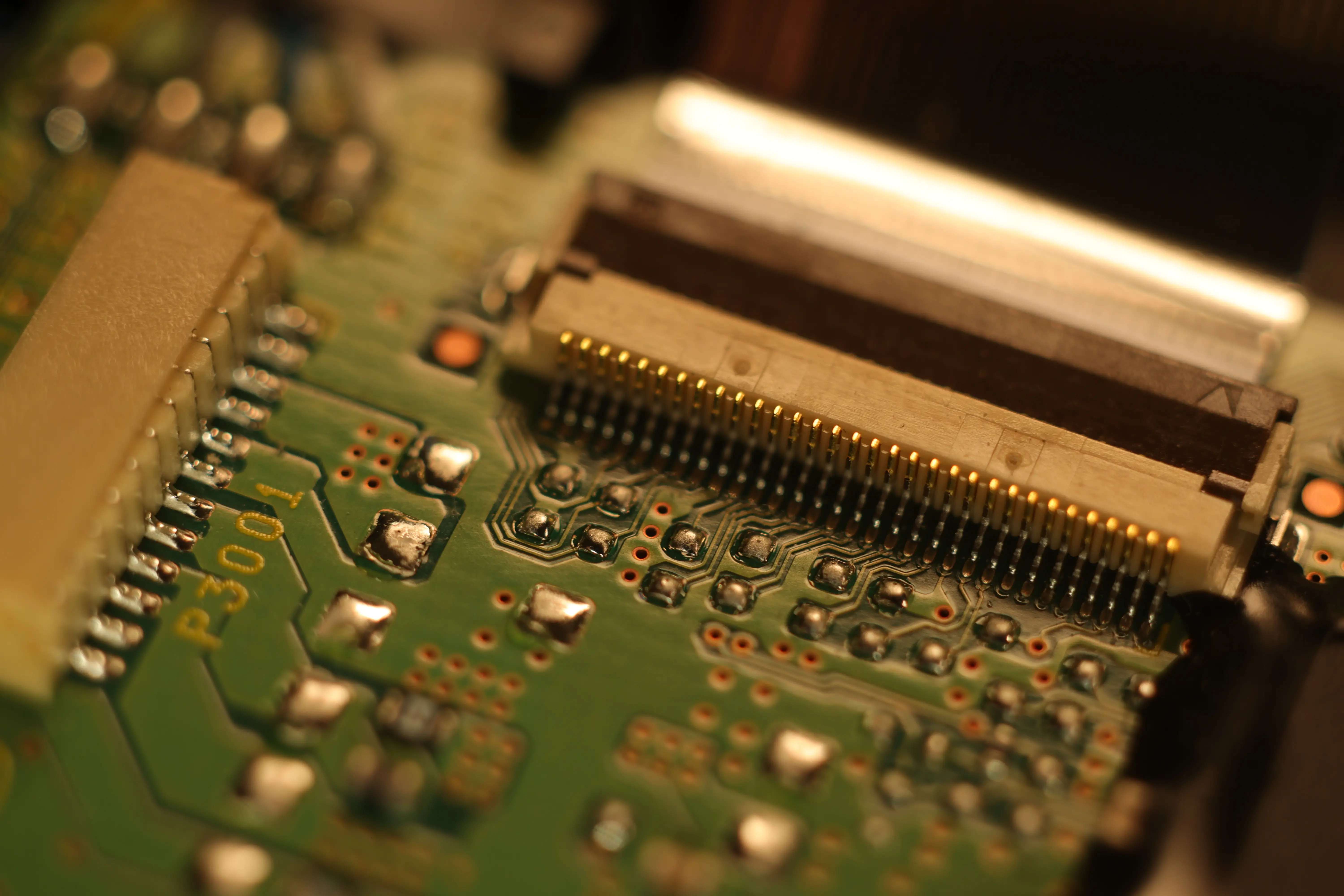

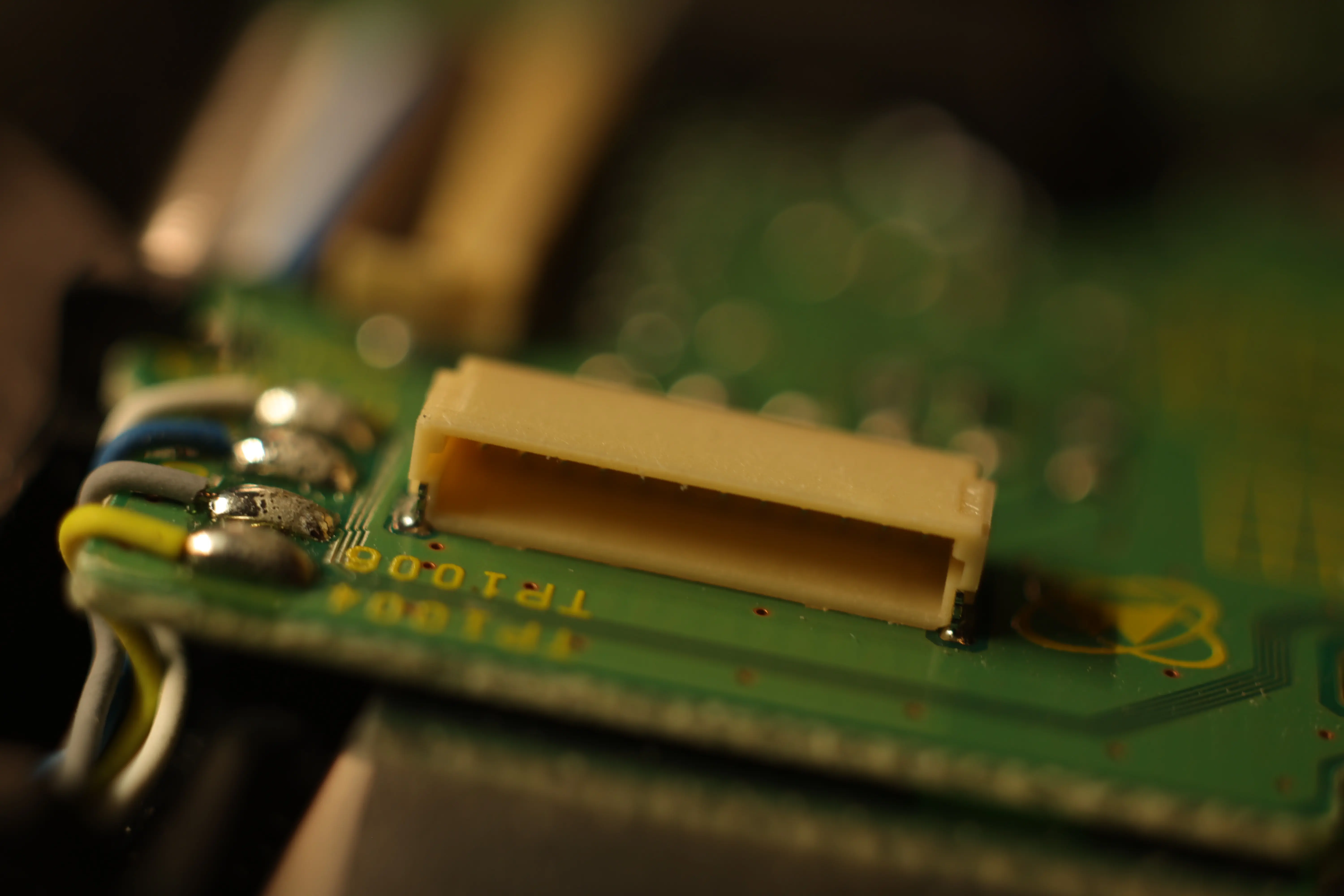

And here are where the two disc drive cables attach to the disc drive board.

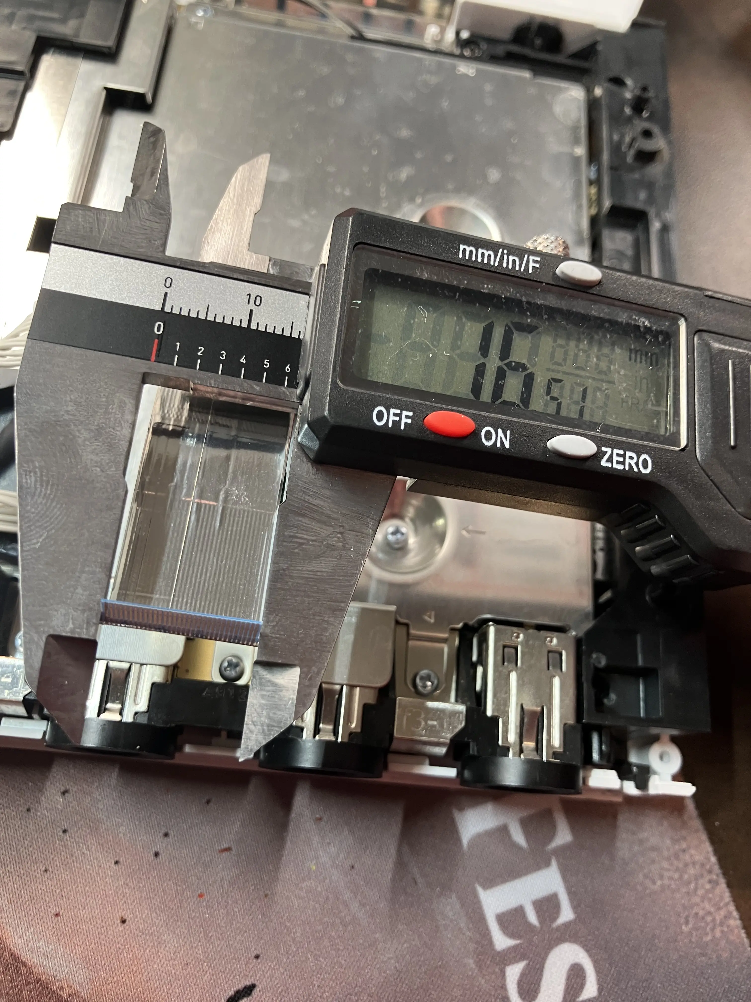

I also measured the width of the FFC cable with a caliper.
So with 32 pins, and knowing 0.5mm is a common pitch for FFC cables, it makes a lot of sense the cable would measure at 16.5mm. The math is mathing. Plus I was pretty sure already it was documented somewhere at .5mm pitch, but I wanted to see for myself.
I set the caliper to 16mm and held it up to the connector.
LGTM!

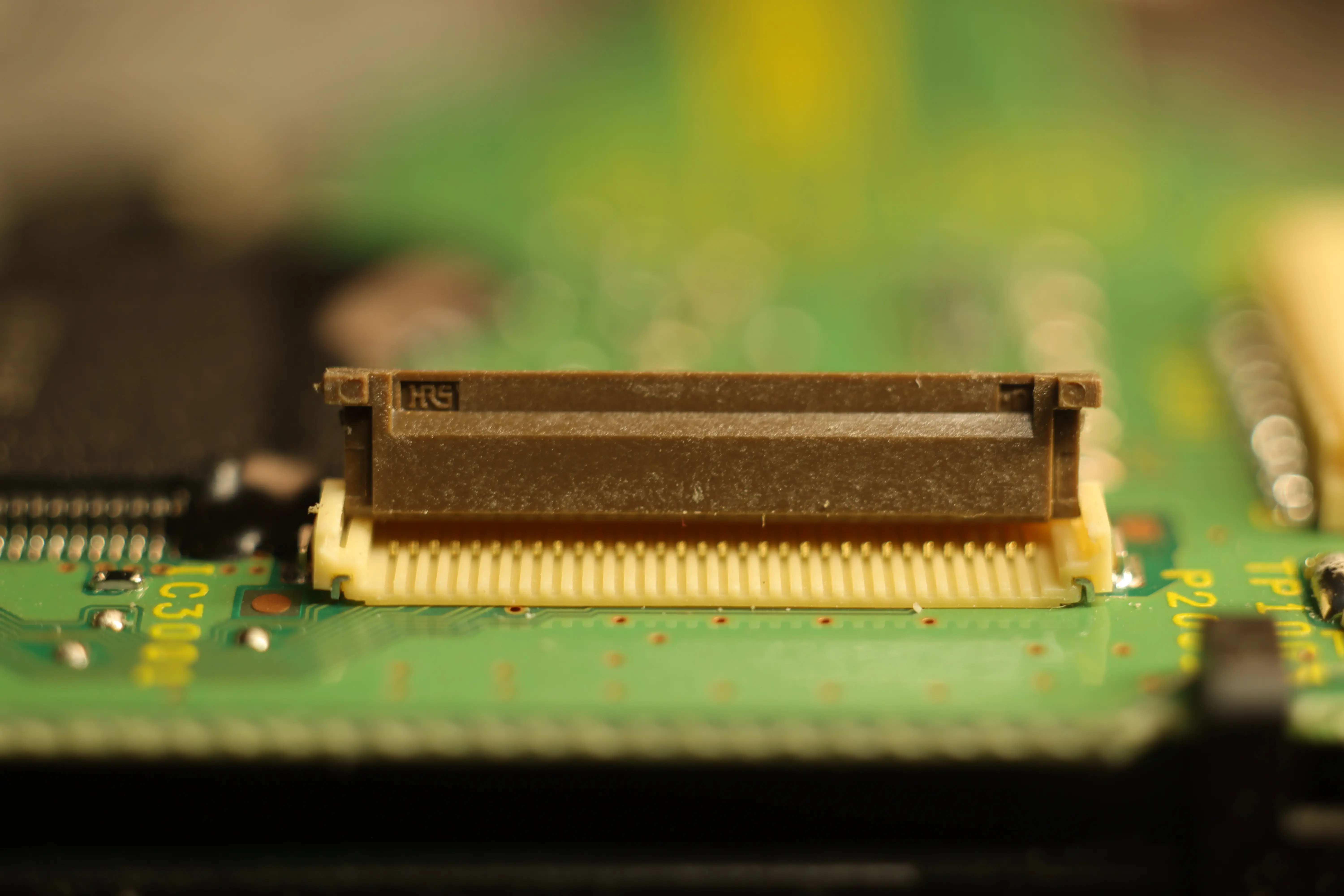

And here is a picture of before I detached the cable.
It has this latch you need to flip up to get the cable out.
When you flip it up, you can see the logo in the upper left, "HRS".
That is for Hirose Electric. It's really cool we can see who made the part. Maybe it would be possible to figure out the exact part number! This company still manufactors FFC/FPC connectors today. Here's a link to their page on mouser: https://www.mouser.com/new/hirose/hiroseffcfpc/
This is the other cable that connects the disc drive, and gives power to the disc drive. It looks like a JST SH connector.
It's worth noting the pinout from the power cable too, got this info from Wiibrew.
PinName
1GND
2GND
33.3V
43.3V
5GND
6GND
75V
85V
9GND
10GND
1112V
1212V
Here's the female connector on the disc drive board.
Finally, I grabbed a picture of how the traces look coming out from the connectors.
and almost forgot a picture with my name in it!
Here are my measurements:
FFC cable:
32 pin
0.5 mm pitch
0.3 mm thickness
4 mm exposure length
The housing was surface mount with a flip lock.
The power cable is 12 pin with 1mm pitch, using a JST SH connector.
Now I can order breakout boards and hope I was right about this!

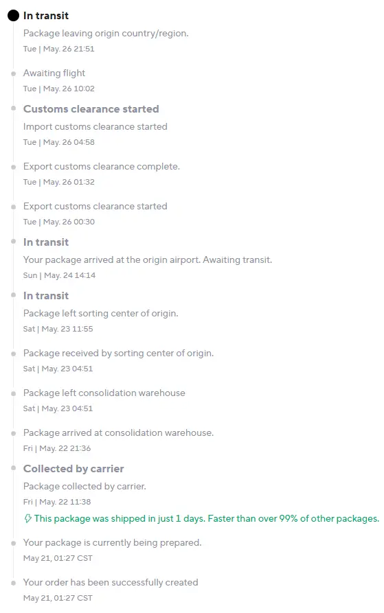

I have been patiently waiting for the breakout board to make its way to the US from China. I bought a couple from different shops. Here is one of them:
It is on quite a journey!
Meanwhile, I decided to use this time to get a more detailed picture of the 32p FFC disc drive cable.
I set up the tripod with my Canon R8. The lens I'm using is the Minolta 50mm f/3.5 MD Macro Rokkor-X.
The R8 is a full frame, mirrorless camera, so you can mount vintage lenses to it. This Minolta lens was originally released in 1977. Crazy that it's so old and easily outperforms my iPhone camera!

Here is the image I liked the best! I thought it showed the most detail.
Enjoy the fabulous, 16.5mm wide, 32 pin, Flat Flexible Cable that connects the wii to its disc drive.
