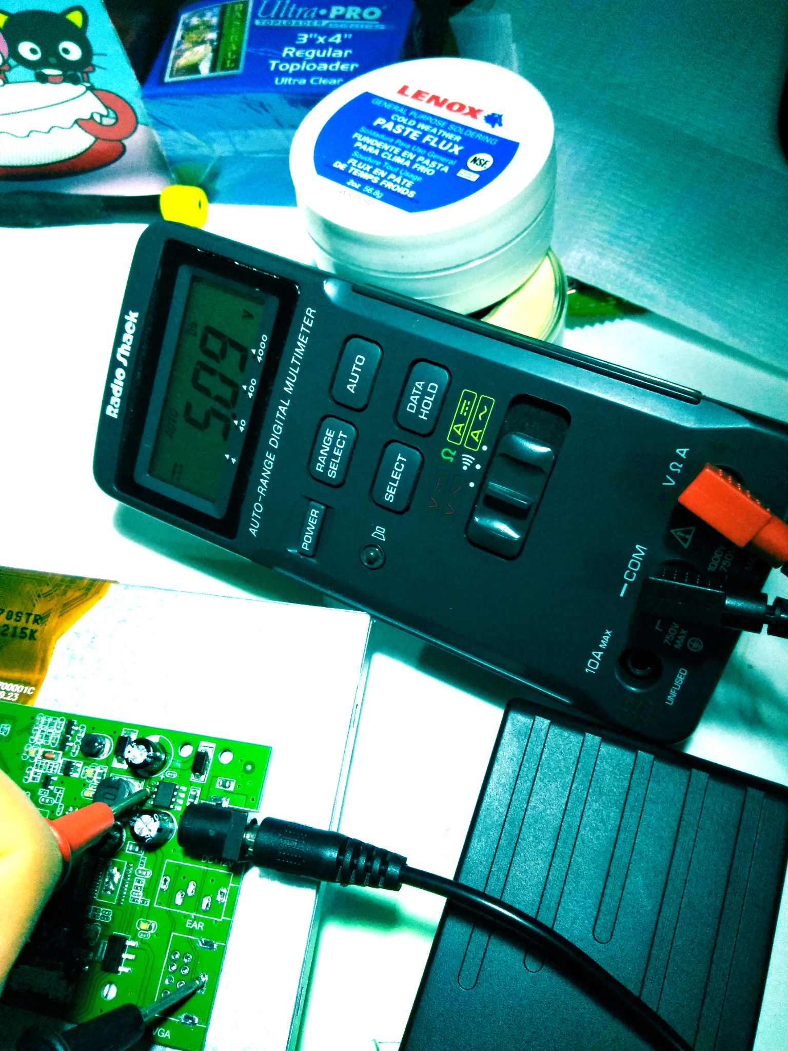

Before you wire your display to 5v, first measure if the pin is 5v to be sure.
Okay, I'll solder the power socket back on and check with the wall adapter first.
Edit: It's 5 volts!

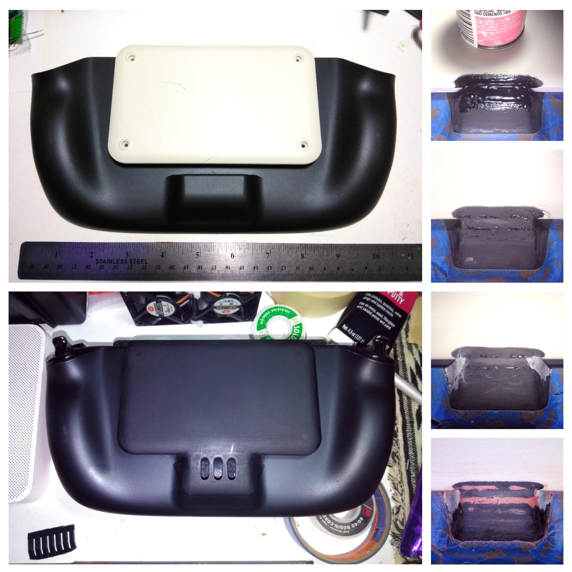

I'll continue to work on the screen and raspberry pi in the next few days. Thanks to you guys, I've pretty much got it figured out as far as the hookup to switch A/V sources. Currently I've been continuously working on the back of the case where I glued the plastic enclosure half to the open spot where the Wikipad tablet would have normally been placed. It looks pretty good so far. I cut the vent holes for the fan and layed a quick coat of dead flat black on to figure out where I need to add more spot putty. There's more work needed to be done before I put the final coats on. The real test will be to figure out how to blend the black with the rubberized coating on the rest of the casing. I do have a spray rubber coating like plastidip, but it doesn't hold up to much touching and use. I want to keep that satin feel it has. Works well for long gameplay.

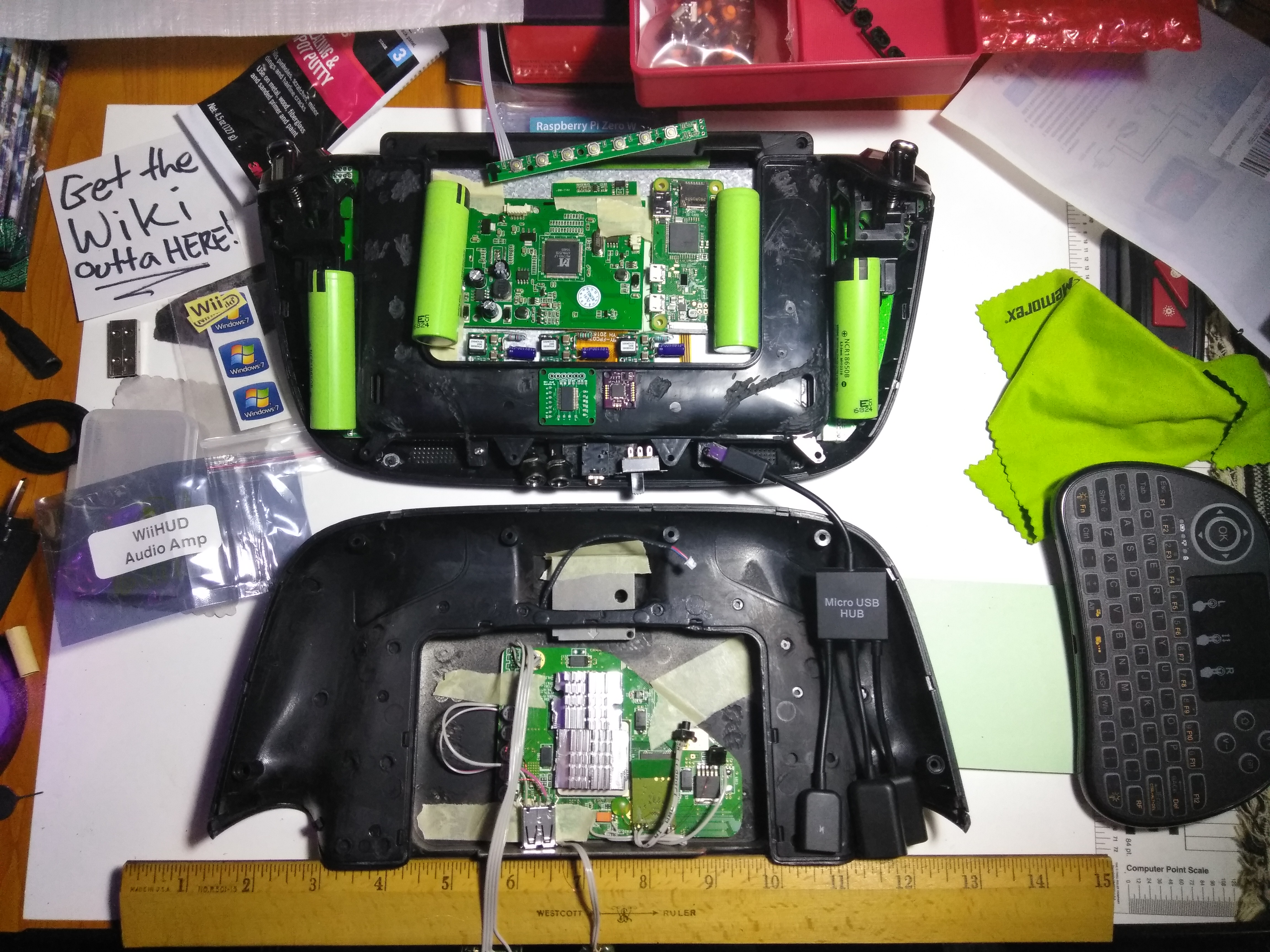

I have been wrapping up the layout of all the electronics, trying to make everything fit well. Mainly now I've been slowly cutting away plastic and drilling the holes for ports. The back of the casing needs to be finished up with some fine sand paper, but is almost completely done. I just need to cut the USB ports before applying the clear coat. Hopefully I'll have time to post another update video by the beginning of next week. For now, I'll try to wire up the batteries.
