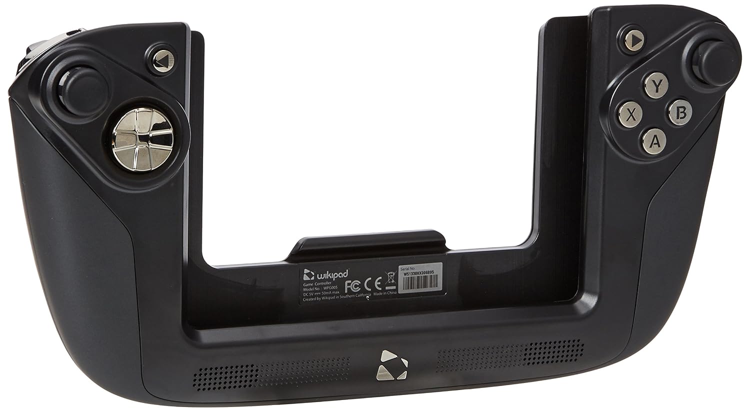

Hey all, I've decided to go ahead and order this Wikipad casing to try to use as the base of my portable. I'll glue in the housing from the LCD and add an extended backing to hold the Wii and other components. I'm really excited to see if this casing will work, it's for a 7" android tablet. I've never held one, but it looks like it should make for an easy frankencase. I will be starting up progress on this soon after the gamepad arrives. I have been slacking on actual work for this project. I have all the main components except for the heatsink for the Wii cpu, and the raspberry pi 3. I am open to suggestions for the better heatsinks out there for this type of portable. I'll also see if I have any old heatsinks lying around that could work. I'll be filming the whole process as I build. And hopefully will make weekly updates as to where I am on the project via my YouTube channel. I'll try to update more here as well!
How thick is the case? If it is for a 7 inch android tablet, it might be too thin. Just want to help you out just in case you need to return it.
