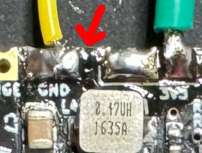

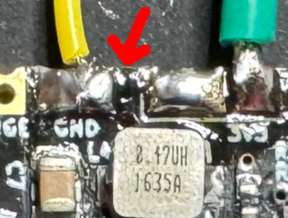

That suggests that there may have been a 3.3v to GND short on the PMS that you cleared, which I'd wager was these little solder bubbles here.
As for why the 3.3v line reads 0v when the Wii is connected, I'm not sure. That would usually be evidence of a 3.3v to GND short on the Wii, but your resistance table indicates normal resistance to GND
That would make a lot of sense, I did reflow the solder there to clean things up when I disconnected everything but I wonder why it didn’t immediately fix the issue.
Strange about the Wii too. I did manage to get a second Wii for cheap just in case so maybe I’ll just do another trim and see if that one works out.
I guess since the resistances are fine, it’s probably not this, but does it matter that I got solder inside of the via circled? I cleaned up the solder on the pad that 3.3v is connected to on the Wii as well so the section with the arrow is not touching either.
Nah, those vias are directly connected to that pad anyway. The solder getting on them is not an issue.
