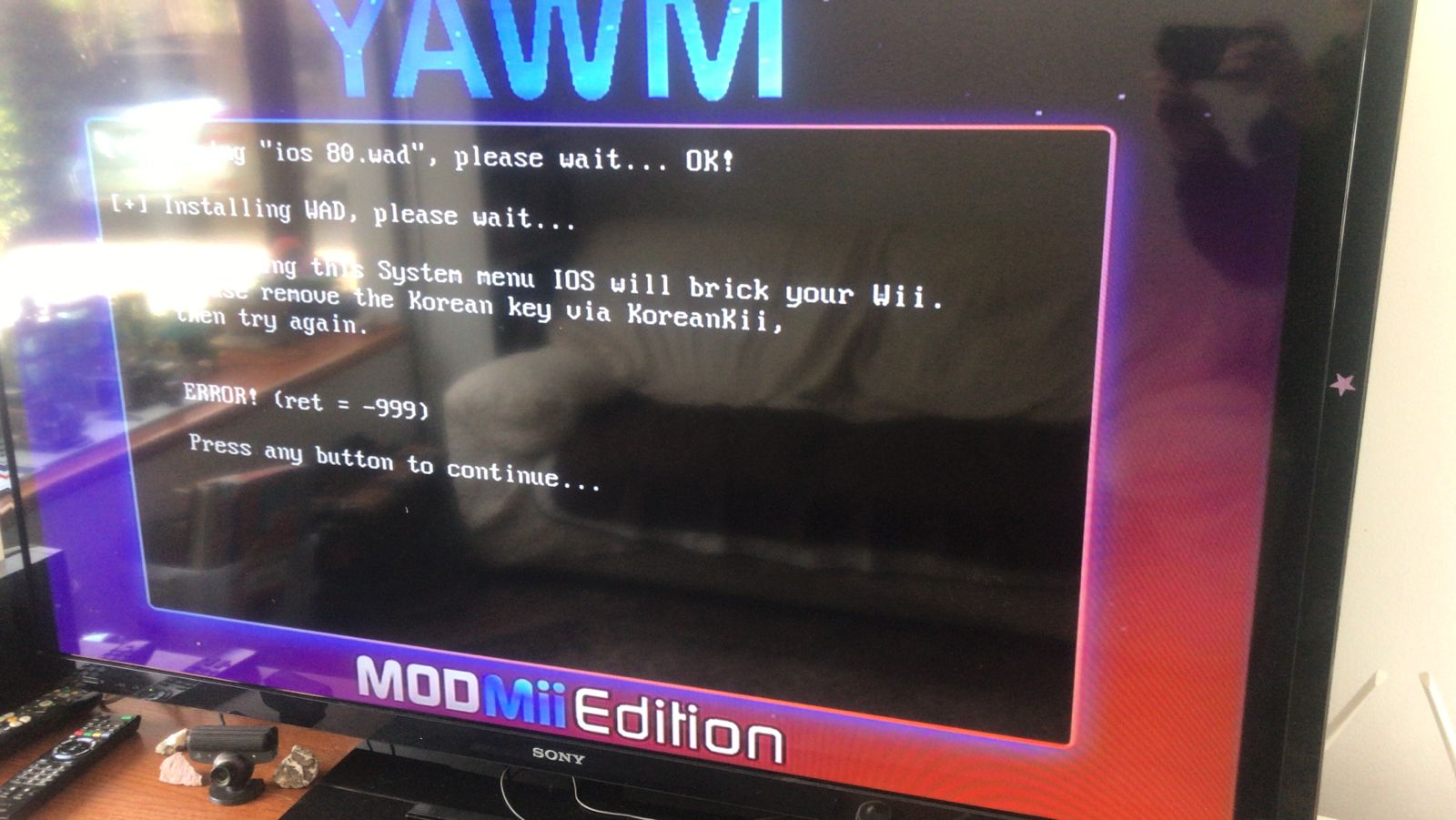

What do you mean when you say you rearranged some stuff? Have you tried clicking on the option System Menu in priiloader? If your Wii still doesnt boot, then it seems like you have managed to stub your system menu IOS, you propably need to reinstall it, download it with this tool:https://wiidatabase.de/downloads/pc-tools/nus-downloader/
1. Click pack wad
2. Go into IOS, select IOS 80 V6943
It should then download IOS80 from the Nintendo servers. You need to put this into a wad folder on your wiis sd Card.
You can then install it with this:https://wiidatabase.de/downloads/wii-tools/yawm-modmii-edition/
Now, you need to be sure that your wii doesnt lose power during the next steps, that you dont turn it off and that you have a nand Backup ready. I do not take responsibility if anything goes wrong.
Boot up your Wii into the priiloader menu, select homebrew channel and boot into it.
There, start YAWMMM and install the ios 80 wad. Once its done, exit back to hbc and then go into your system menu. If it still doesnt work, then you might have another problem.
What region is your wii?
EDIT: Try and see if you can change your IOS in priiloader to IOS48.
It seems like your american wii for some reason has a korean system menu and the KoreanKey installed, which is why setting the system menu IOS to 48 fixed it. I do not know how this could have happened, but at least the wii works again.
