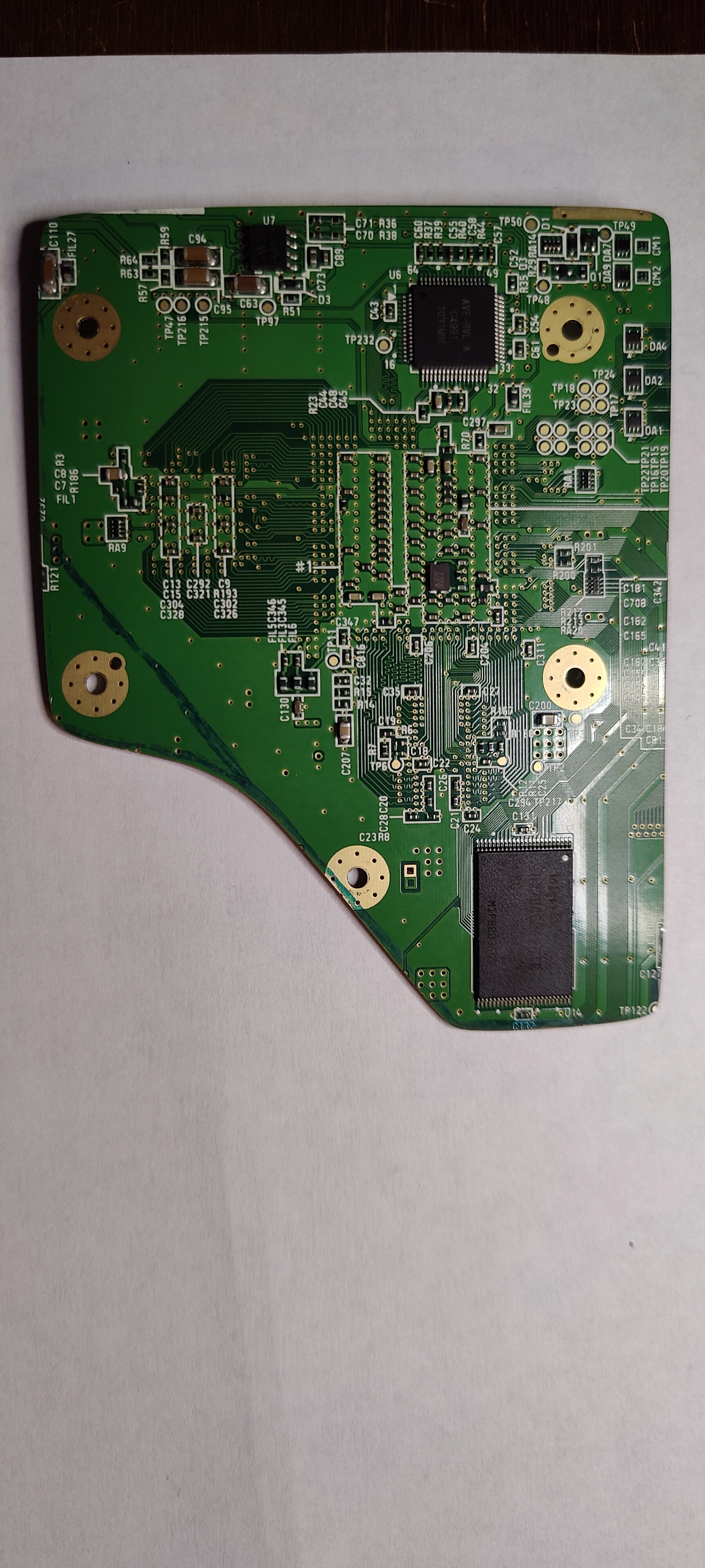

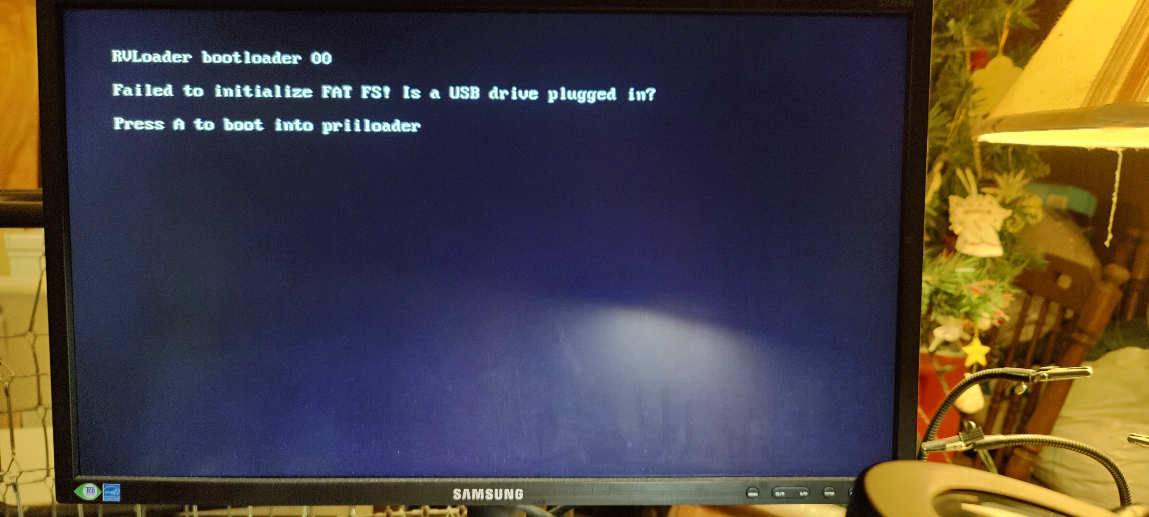

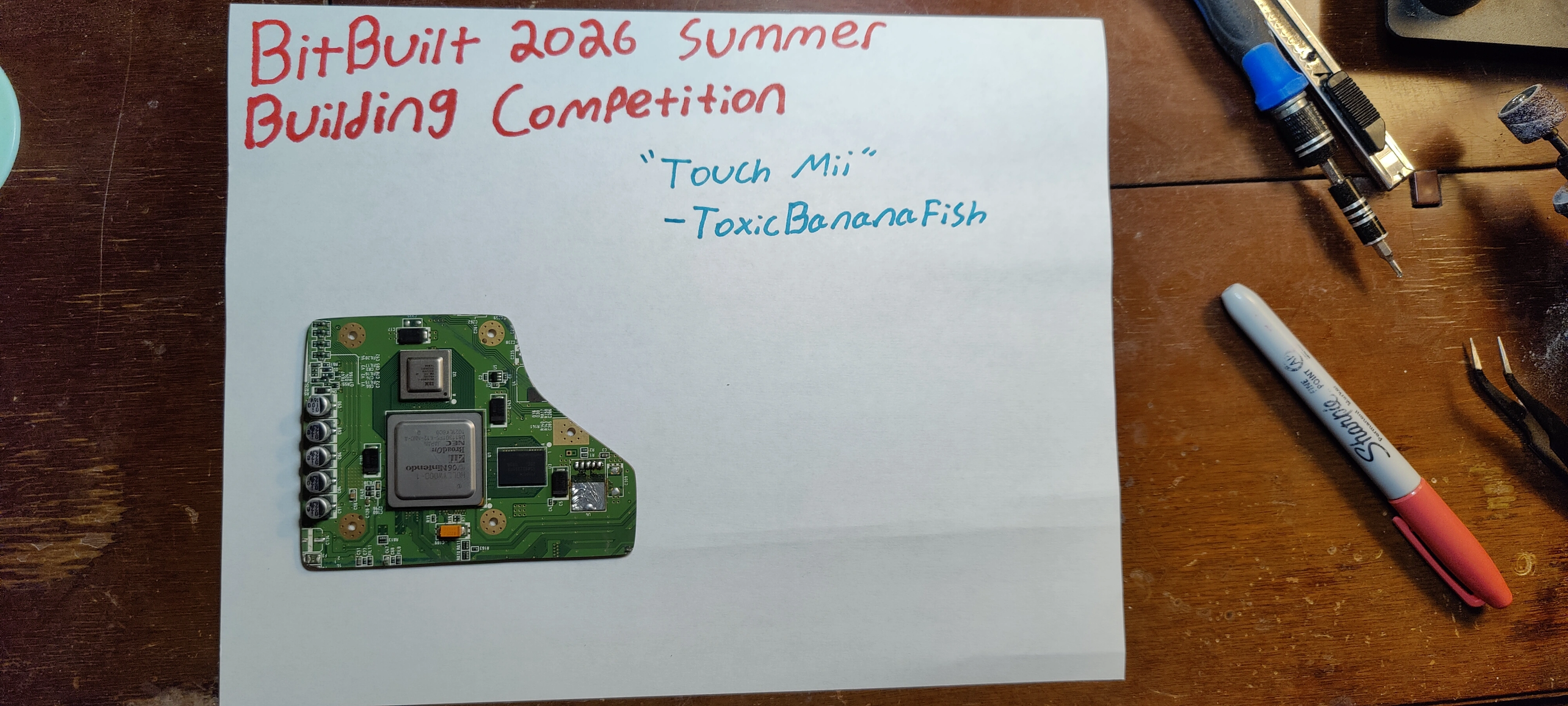

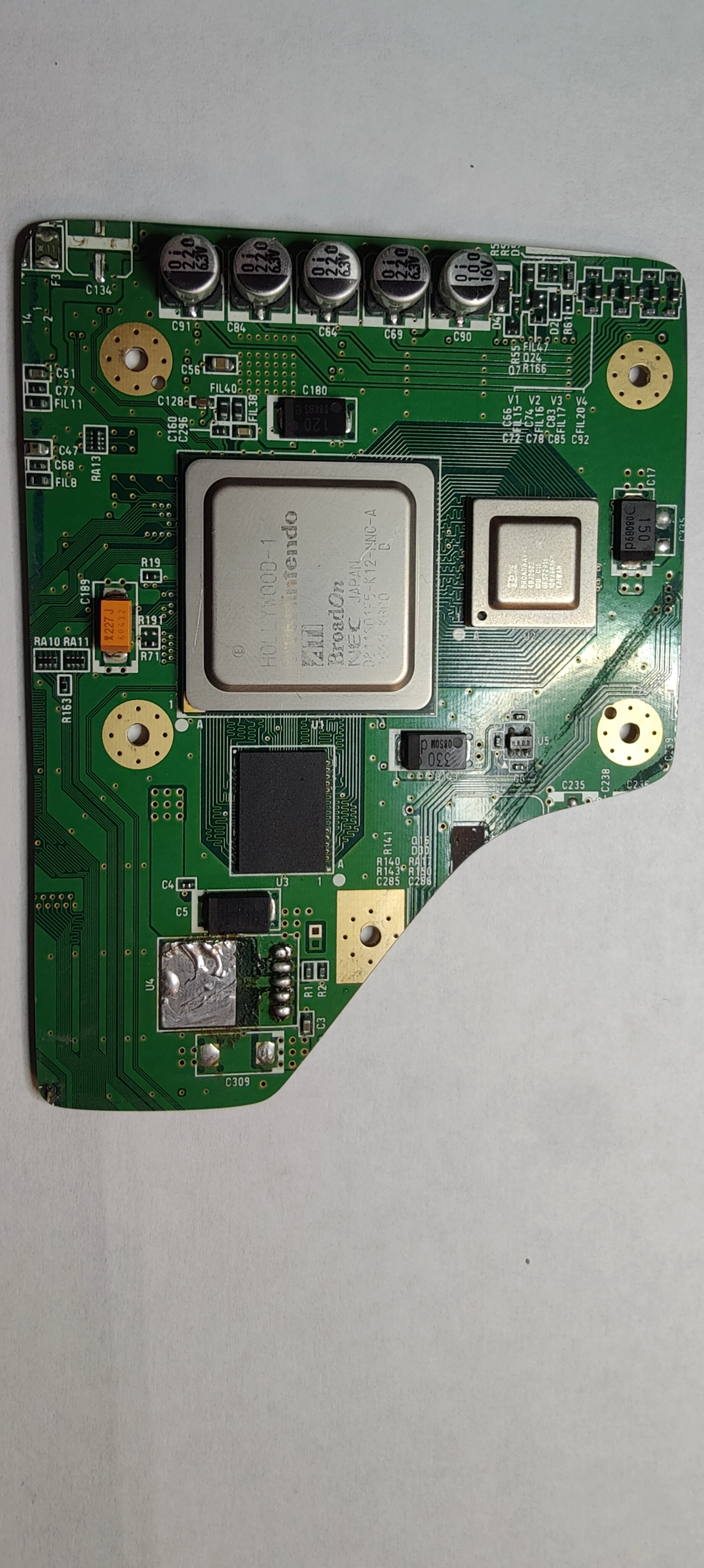

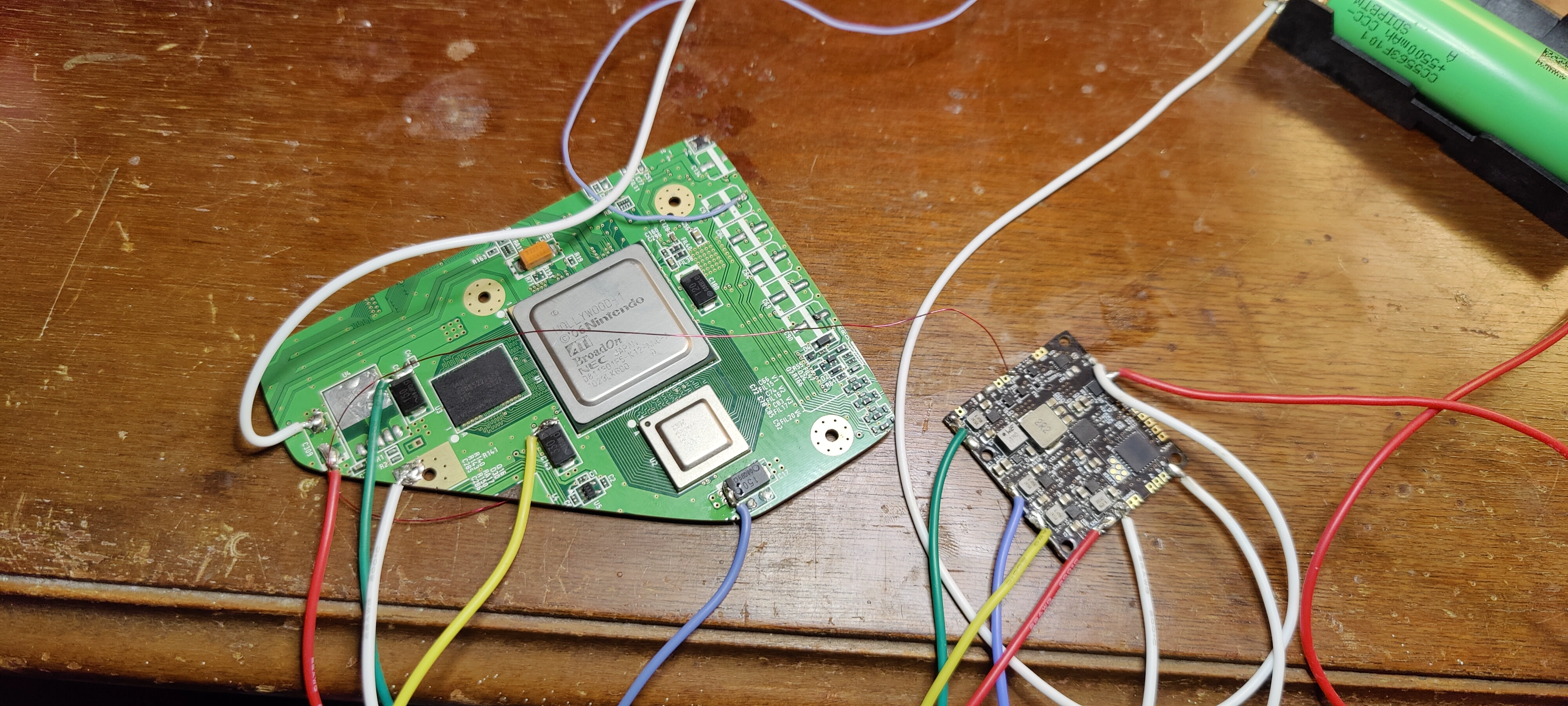

I haven't been able to do any work for a while due to being away, but I finally got myself a Wii, PMS2 and PMS-PD and got the wii trimmed up. I initially wanted to keep an extra mounting hole but could get the Wii to boot up and all the resistances seemed off, so I eventually resorted to cutting it down to a more typical trim. The resistances still seemed off then, but eventually I tested it again and it still didn't work, until I finally disconnected the power for my video adapter (which I was using to test with my monitor) from the PMS and instead hooked it up to my desktop Power Supply, and I finally got it on. In fact, I highly suspect that it was actually likely working the whole time, but regardless I can't complain since I got it working anyway and the only thing I lost in the process was a redundant mounting point. I also suspect that my seemingly off resistances might be a result of a super cheap multimeter that maybe doesn't work all that well...
Here are some photos of the initial trim:
And here's what it looked like after I finally confirmed that it was actually working, after sacrificing that extra bit in my troubleshooting:
My next step (as far as I've currently planned) is to install a FujiFlex PCB, which should allow me to use a single Flex cable for Video As of right now I'm also planning to see if I can get away with using the LCD Driver's built-in amp instead of having to wire up a custom one, but we'll see how that goes. Once that's confirmed working, I might remove the AVE and make sure it still works and then trim it a bit further, although honestly I might skip that, since I'm not really focused on size for this project. But for now I'm just waiting for JLCPCB to get the ZIF connectors I ordered so that I can have them assemble some PCBs for testing
