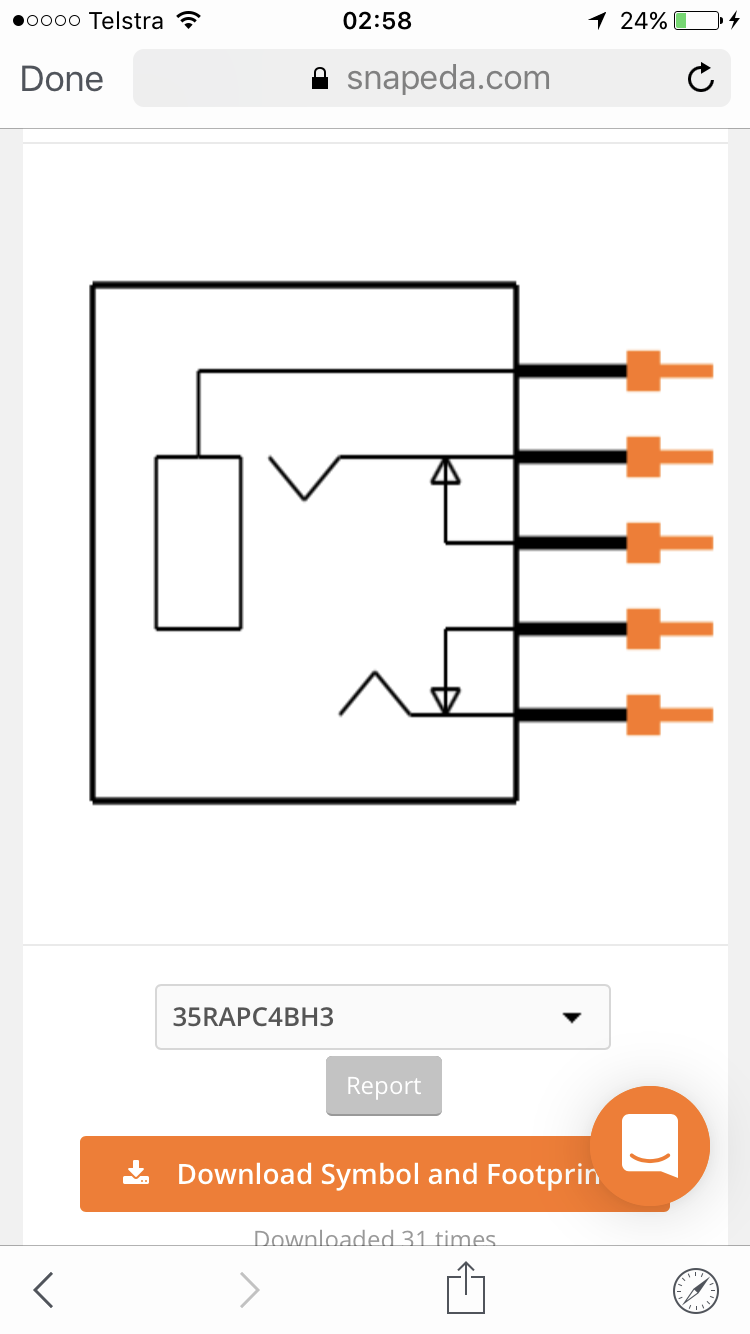

As for headphone jacks, where are you looking? If you’re buying them from digikey, nearly every part has an accompanying data sheet with a pinout. Headphone jacks usually have 5 pins. Two of those will be “sense/switch’ pins, two will be for left and right audio and the other is the common pin which goes to the headphone ground.
The two pins with tiny arrows are the switch pins. They are usually NC switches connected to each of the L/R inputs, so the connection breaks when you plug a connector in. Nearly all headphone jacks work in the same way. Hope this helps! Check out JacksonS BOM for his audio amp. He has a link to a commonly used 5 pin switching headphone jack.
