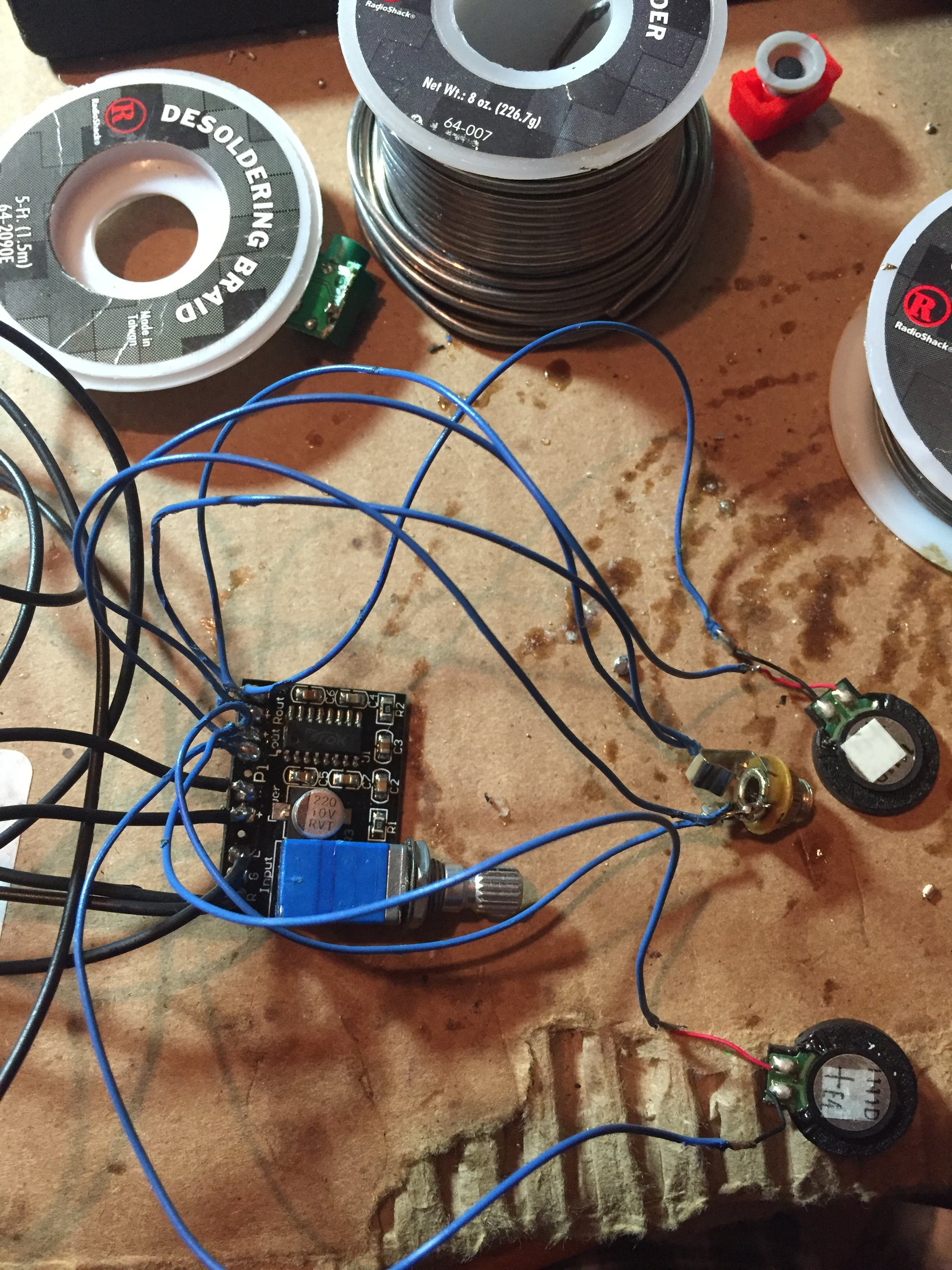

It is stereo for anyone still wondering. I've decided to leave out the headphone jack on this project because of the clicking issue that seems impossible to resolve. As Luke said, I think the issue has to do with the amp. I'll use a more documented amp next time that's confirmed safe to use with headphones (I would just get a new amp, but I don't have time or money to redo the audio portion of this project).

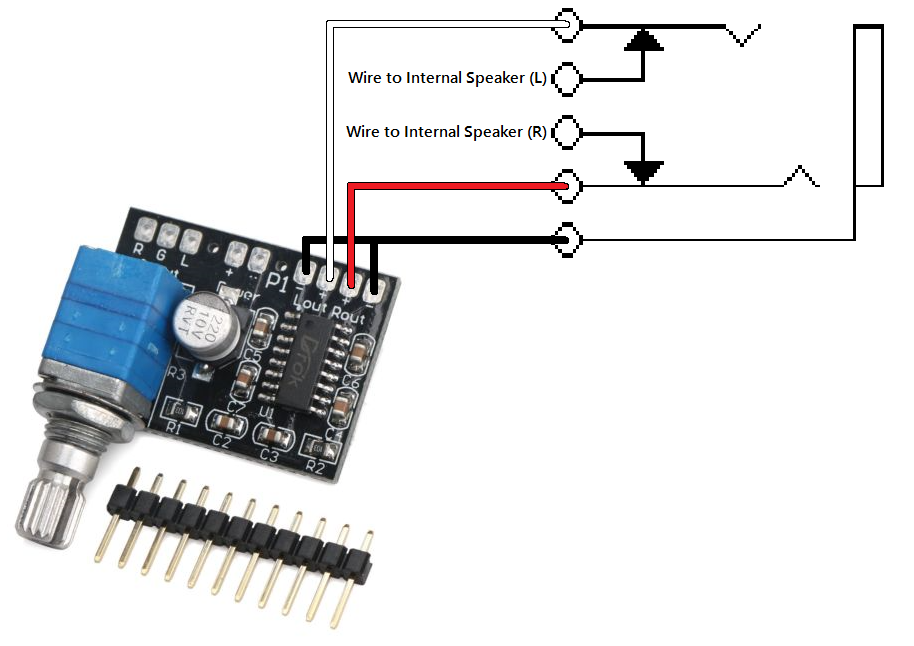

you can salvage a audio amp from a stereo speaker. I recommend using the ILuv smashbox pro, all you have to do is to connect the amp to L, and R audio, then connect the amount of volts to the amp, then connect ground on you motherboard and that's it. you can add a spdt switch to turn off the speakers when your using the headphone jack . use the jack I mentioned, and connect L+, r+, and ground to the motherboard. your welcome

EDIT: I just reread his post, and I wanted to say that what you want is a switching headphone jack. You should not have to manually turn off your speakers when you plug in headphones.
