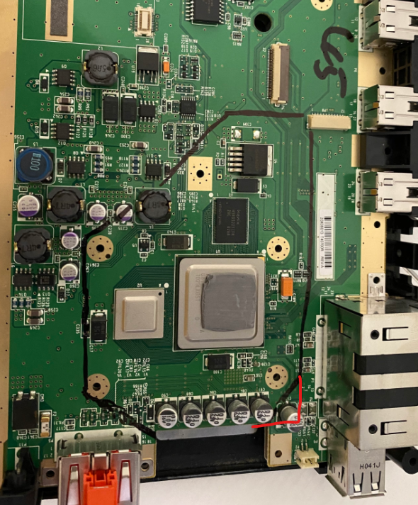

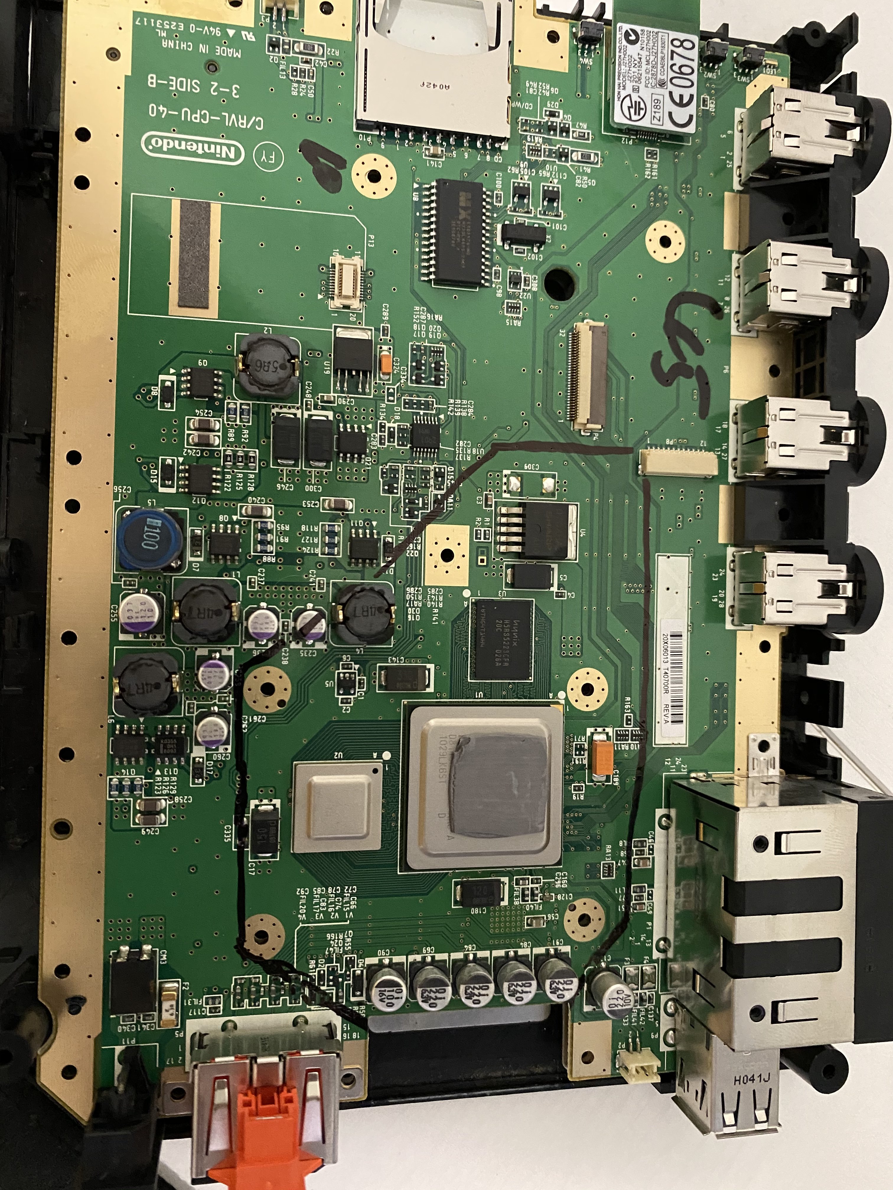

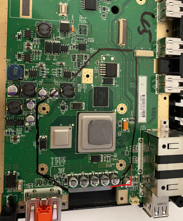

This is my first attempt trimming the wii. Does this look okay? Or is it too thin?
I'd cut it a little more conservative in this corner, your line is pretty much ontop of the USB vias. Also keep the vertical line towards the GC controller ports more straight to avoid cutting into crucial traces.
Yeah much better
