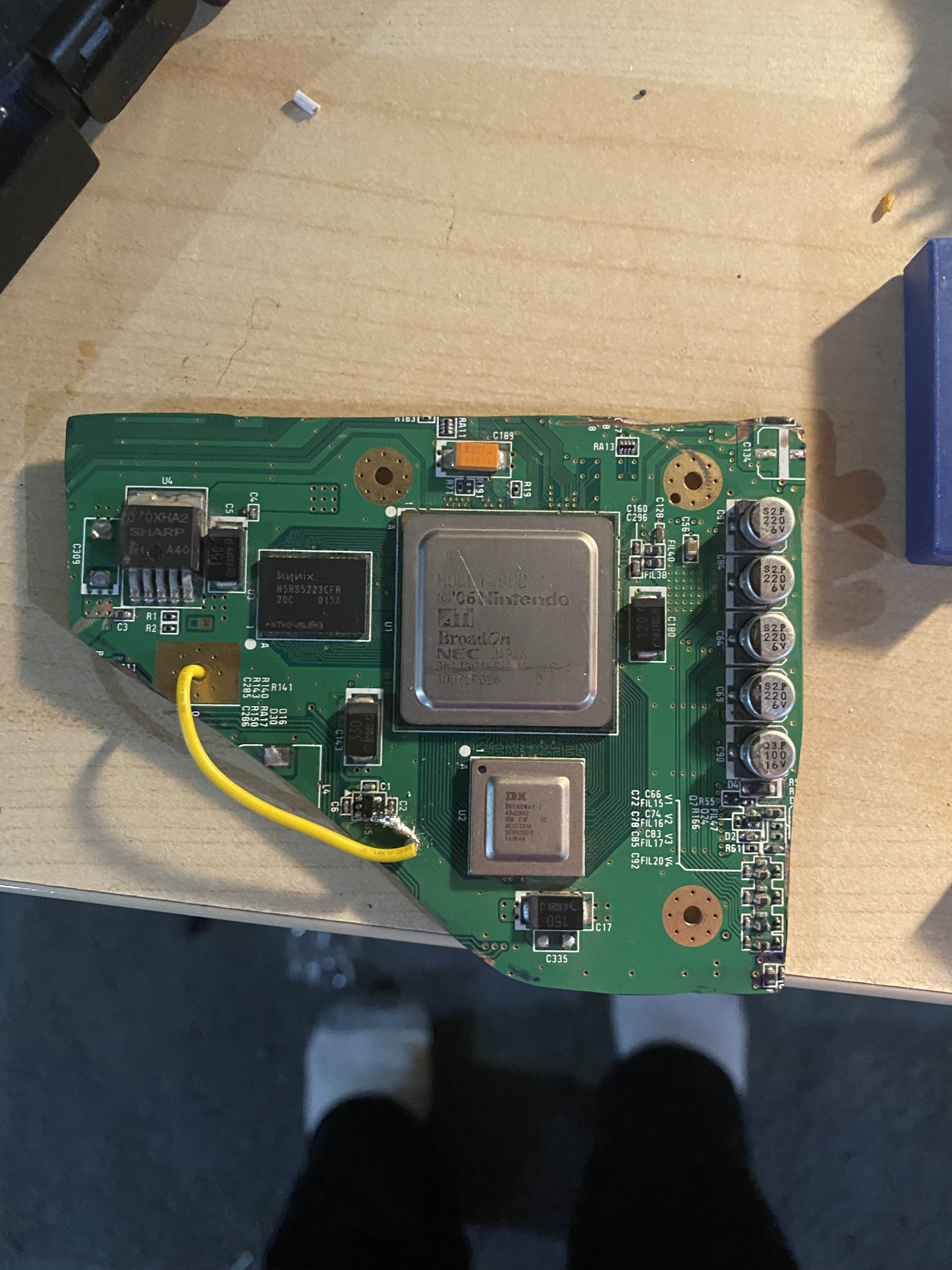

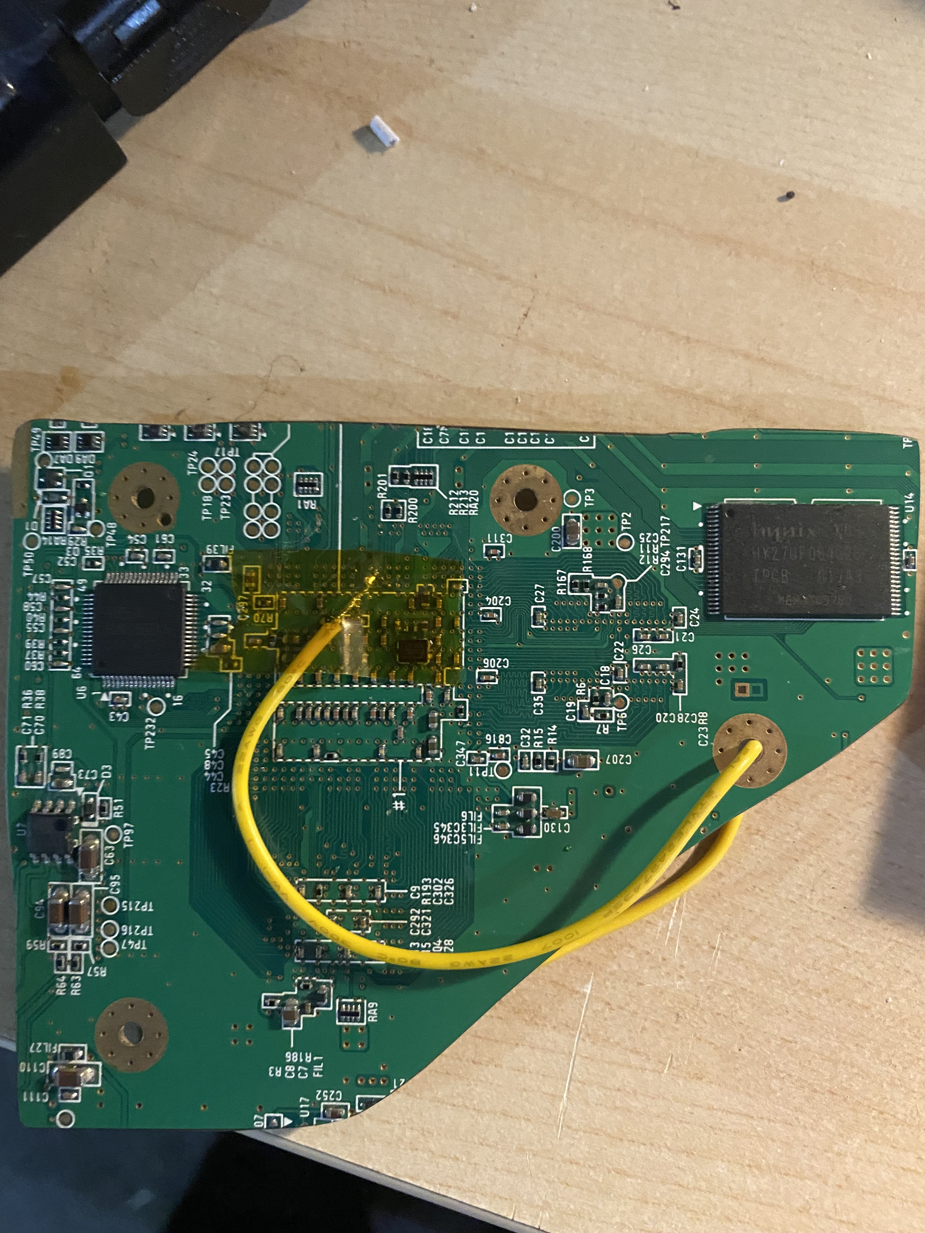

Does this Trimmed Wii Motherboard look right enough to function? (Haven't tested yet)
WillF
Oct 22, 2020
21
4
I'm getting back to my first Wii Portable Project I started almost a year ago during my college break. This is a Wii trimmed and rewired based on the OMG-WTF trim method. It's been heavily sanded using 600-1000 Grit Sandpaper but I haven't wired this up to power yet, but before I do so I want to make sure maybe I didn't trim this too much or little. Can anybody who done these mods before tell me if this looks like it should be functional?

The trim lines look okay, but that giant U10 wire needs to go. It's a huge short risk
EDIT: You've chopped through the NAND traces on the underside. You're going to have to repair that with magnet wire or the system will not boot
