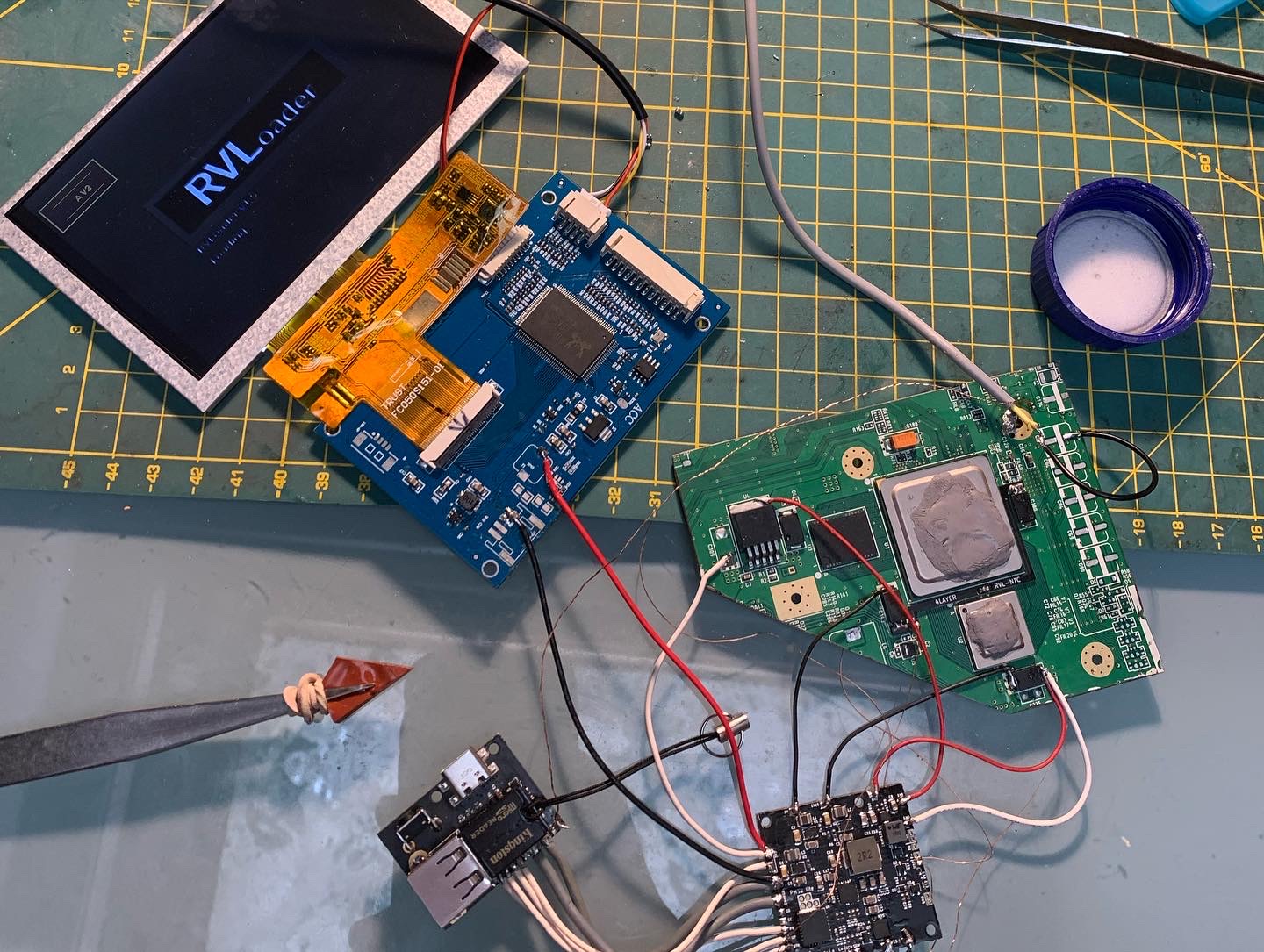

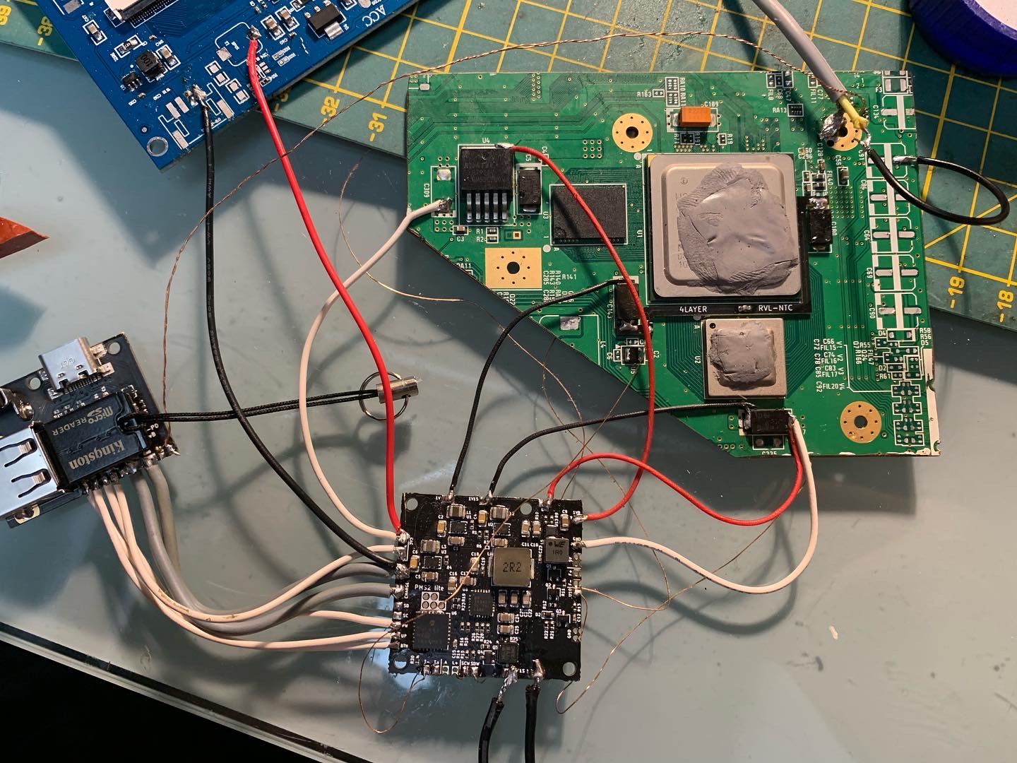

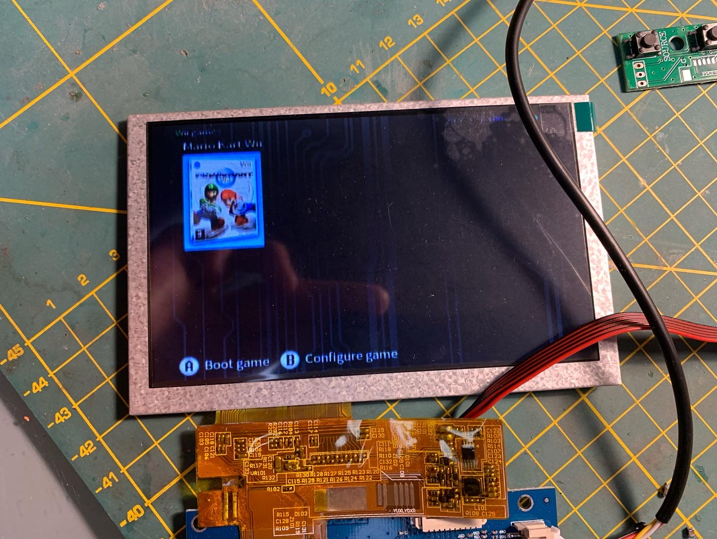

Finally I got everything I need. I started by trying to wire up all the 4layertech PCBs so I can check that everything works. I’m having some problems with the video output, but for now is the only problem i have.

I’m also uploading the image where you can se the components that I’ve removed to run it off 3,3V
SOLVED VGA PROBLEM:https://bitbuilt.net/forums/index.php?threads/no-vga-signal.4980/
