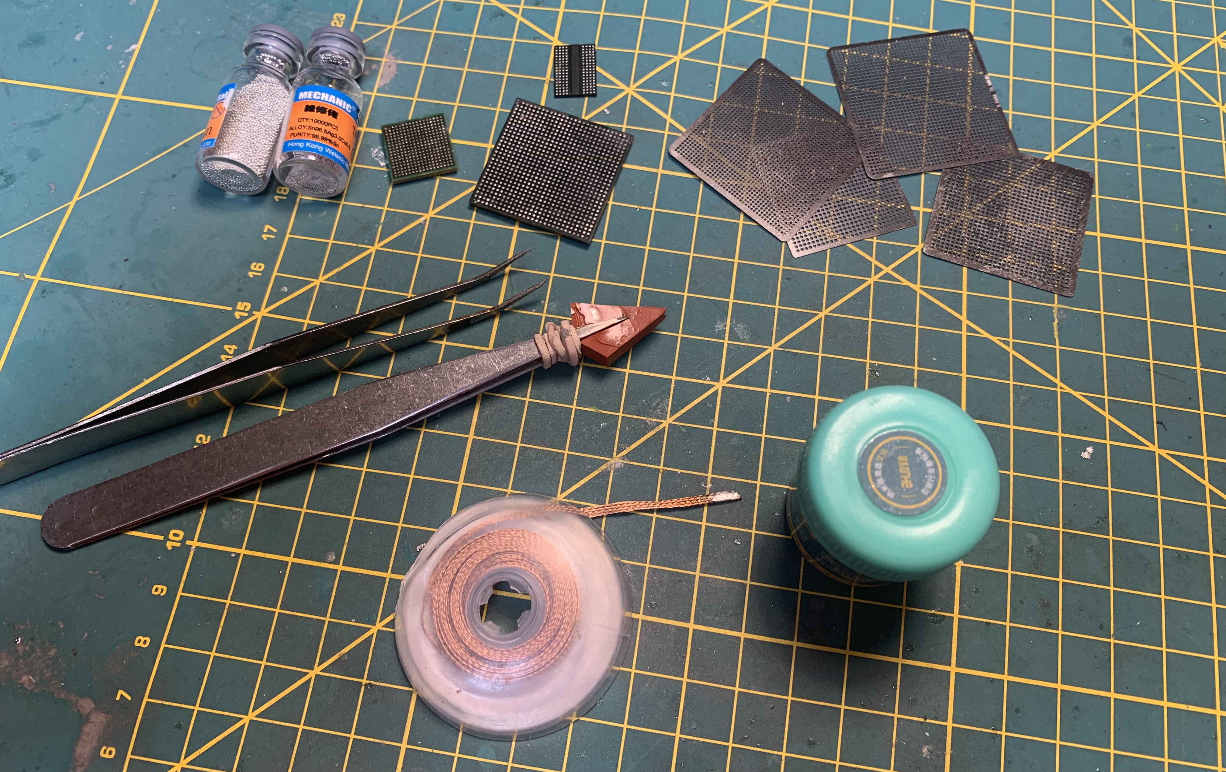

Tracking your project. would like to see the tools you are using, do you have pictures of the tools to show us?
, especially as I'm trying not to spend too much on the project. When I do these kind of stuff I try to use the most common materials I have available.Don't worry friend, I understand you perfectly, I think like you, I don't have the courage to spend a lot on a hobby, I also think about using or developing low-cost tools. I'm looking forward to seeing your project completed, I'm also working on something similar on PS2, we can exchange ideas and information for the benefit of both.I'll try to upload some images tomorrow, but don't expect to see anything in particular, especially as I'm trying not to spend too much on the project. When I do these kind of stuff I try to use the most common materials I have available.

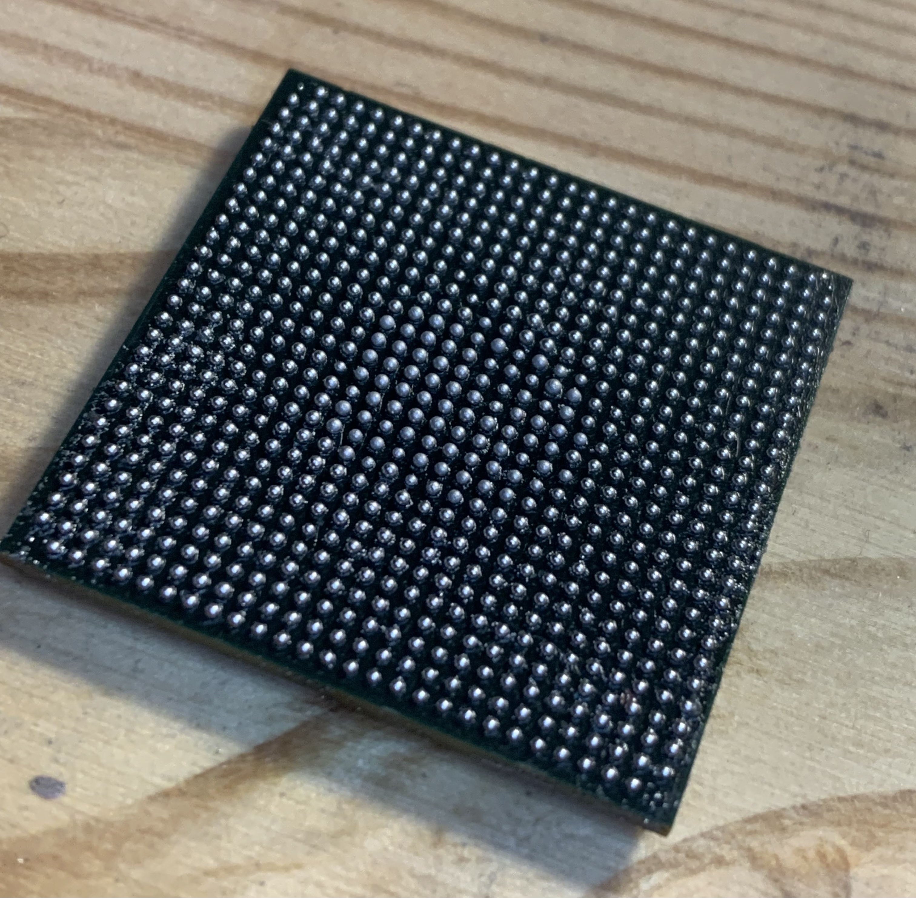

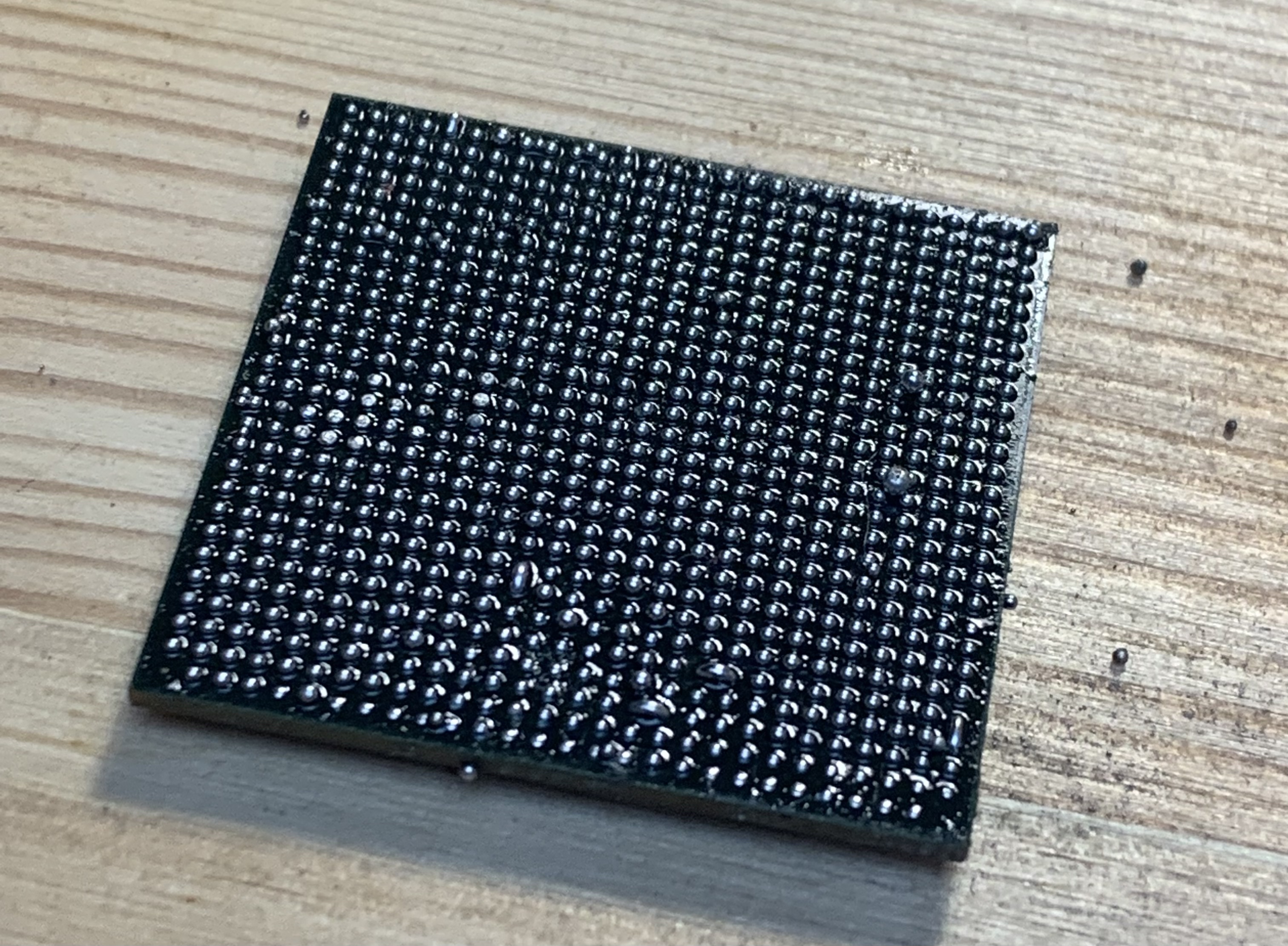

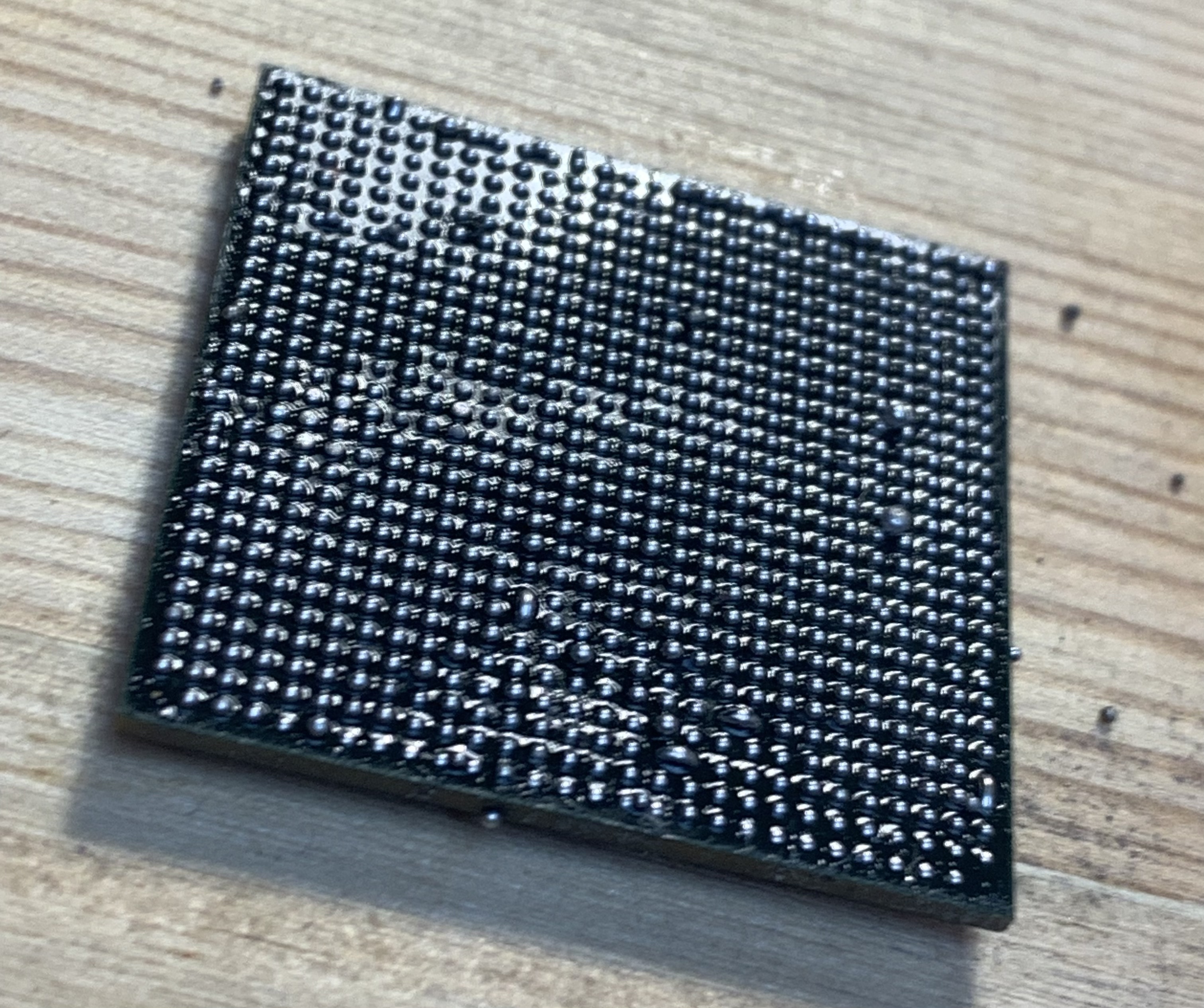

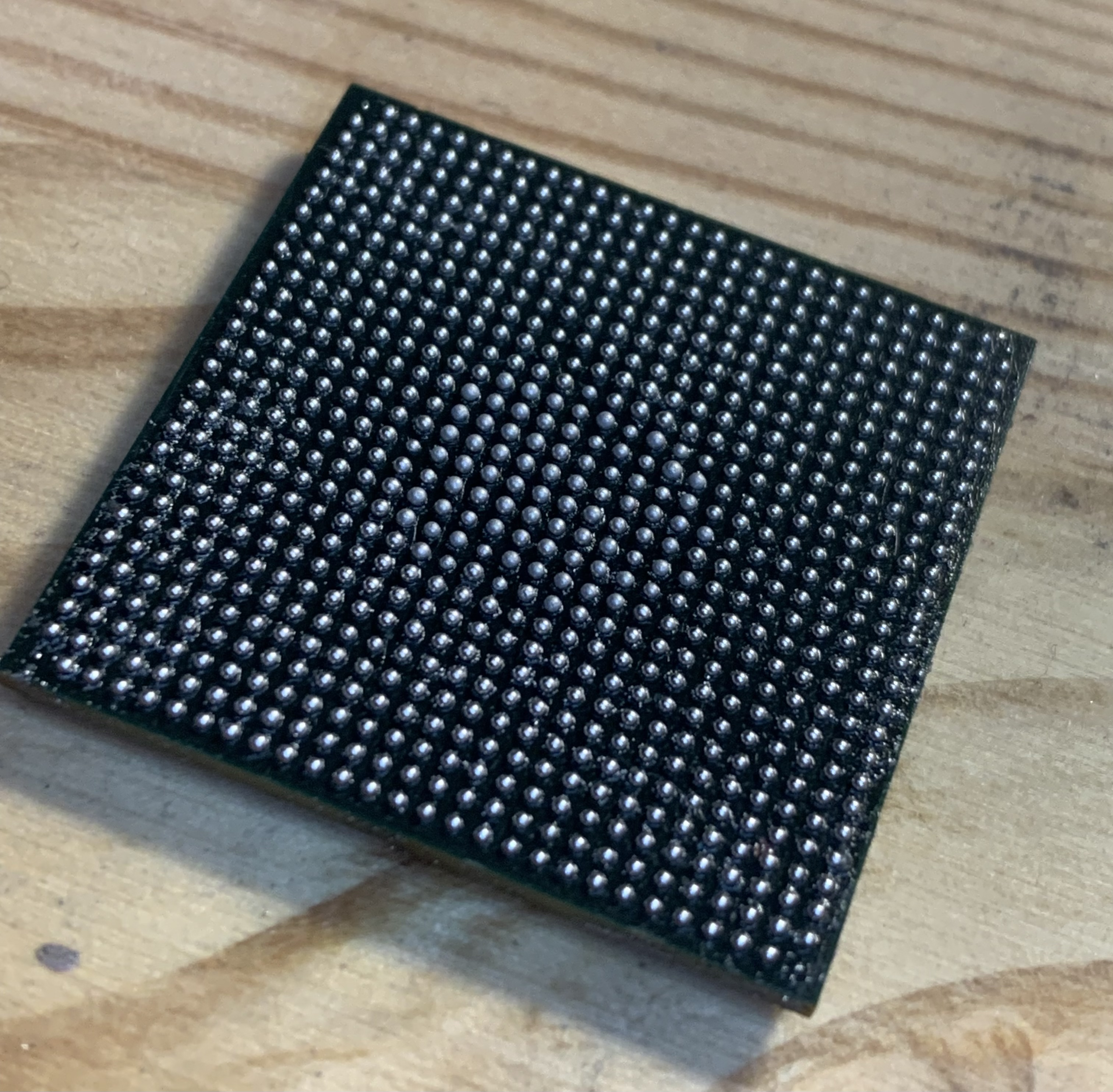

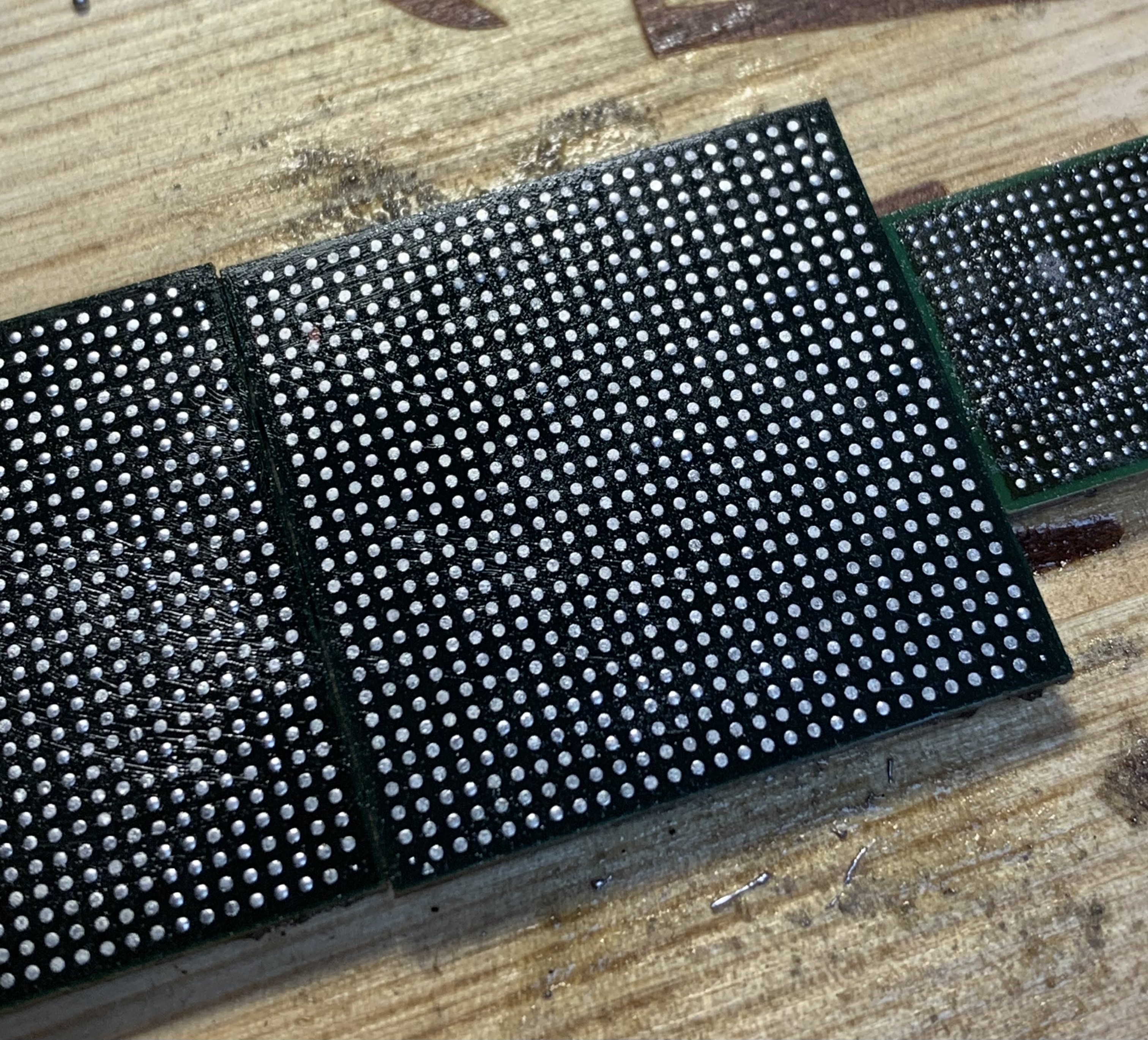

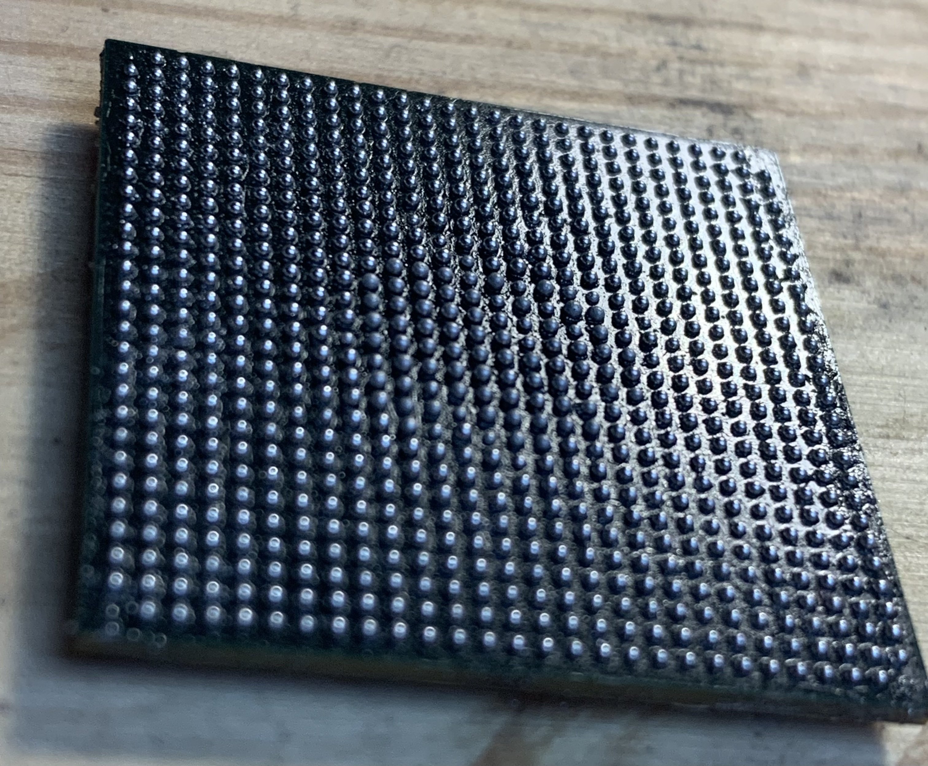

I don't know if these components are working, but you run the risk of damaging them, you can create a PCB to train the reballing of the spheres. In this link I share my idea for this.Here are some pictures of my first attempts of trying to reball the GPU.
First I cleaned all the pads

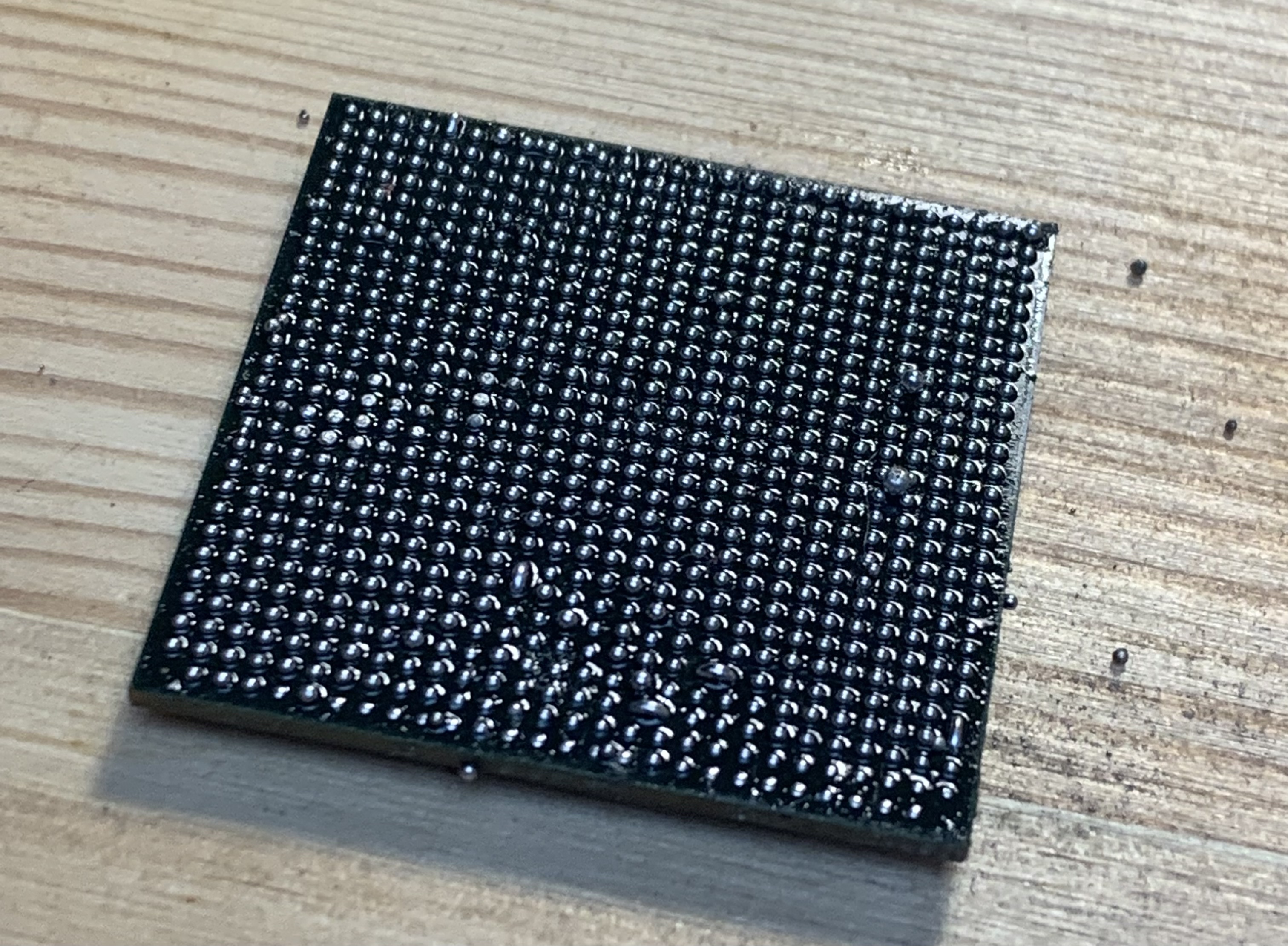

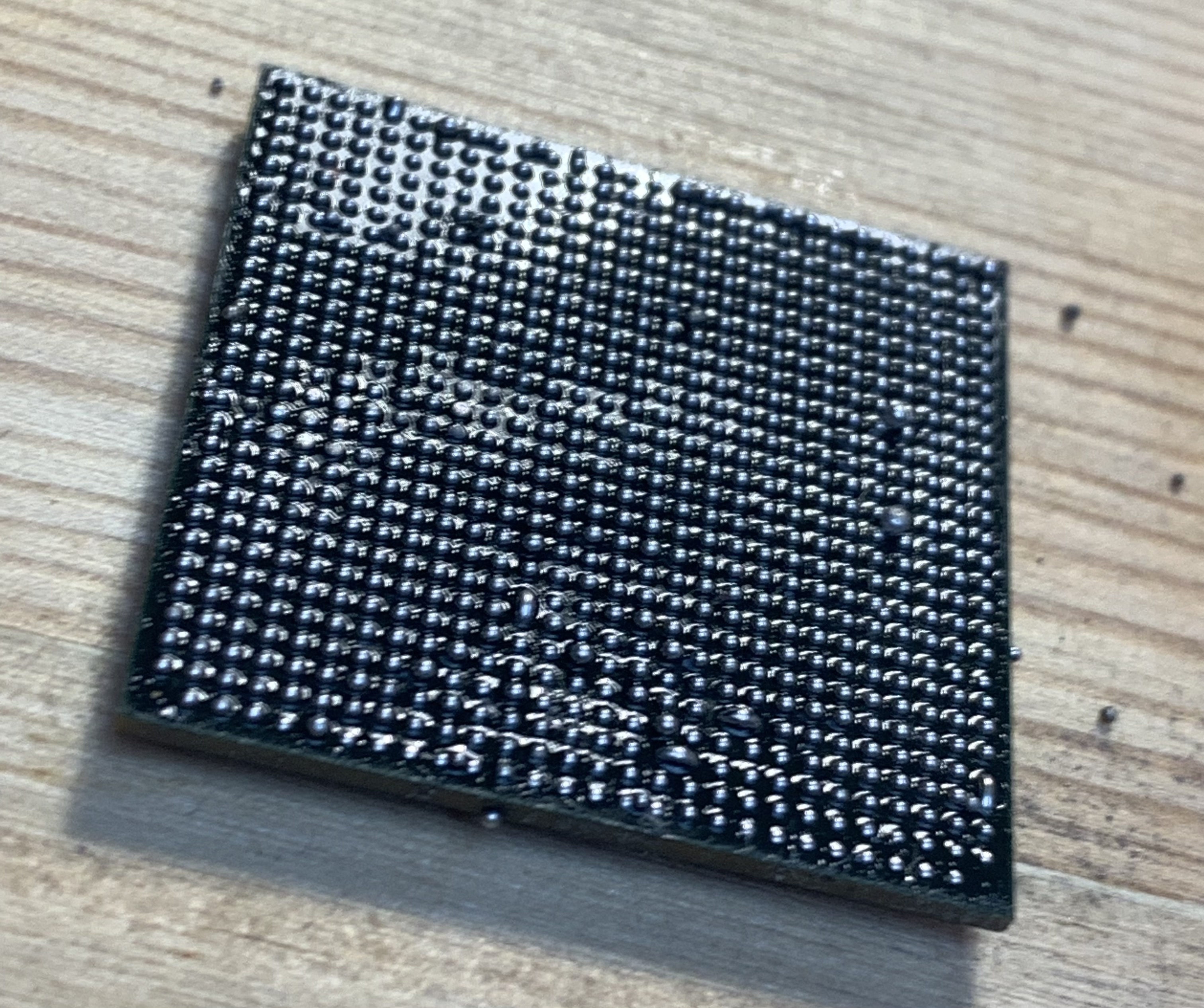

First try: I've messed upquite a lot of solder balls, and many of them came off
View attachment 22710View attachment 22711

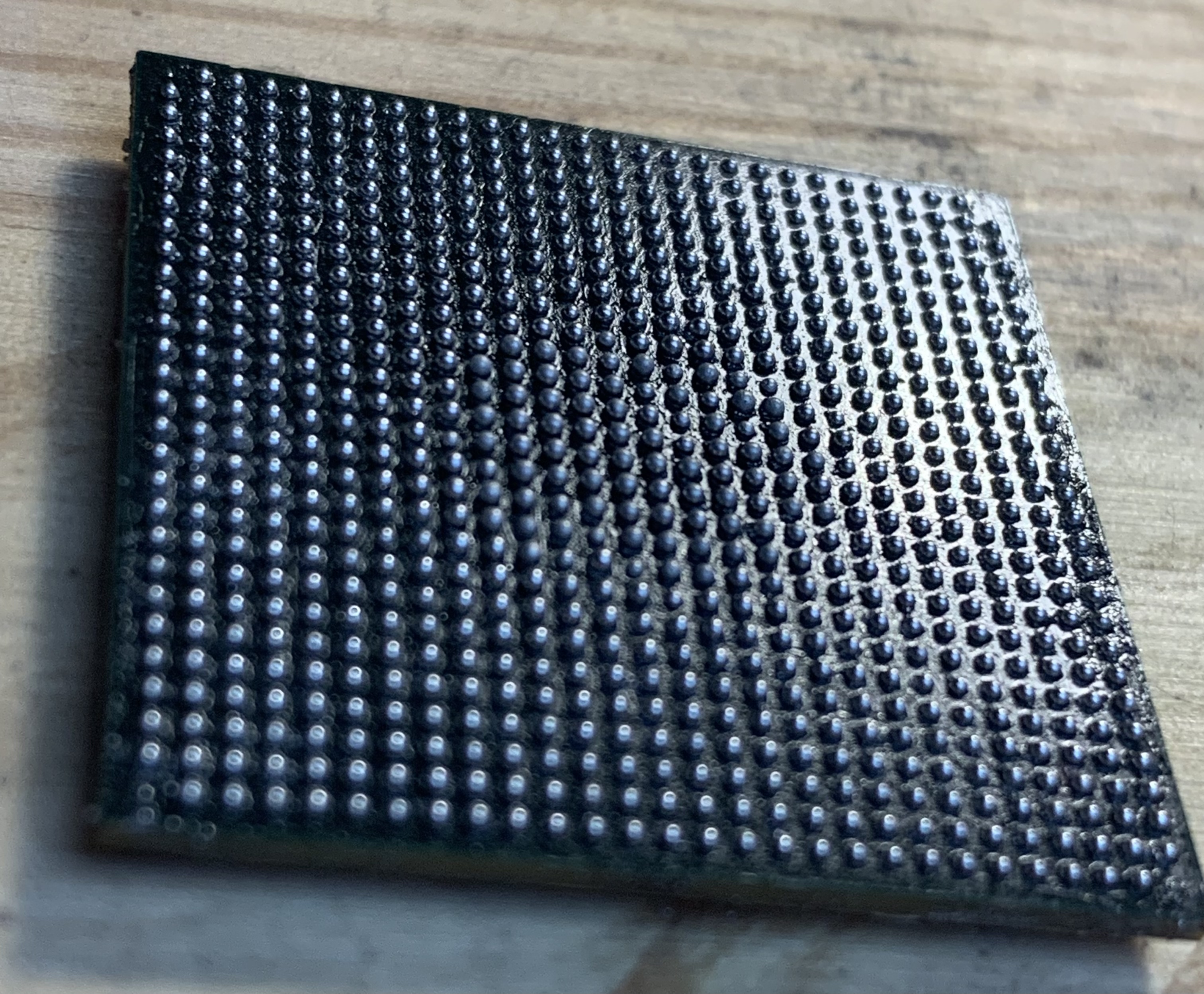

Second try: this time it went a little better but still some solder balls came off, and some of them didn't melt properly.

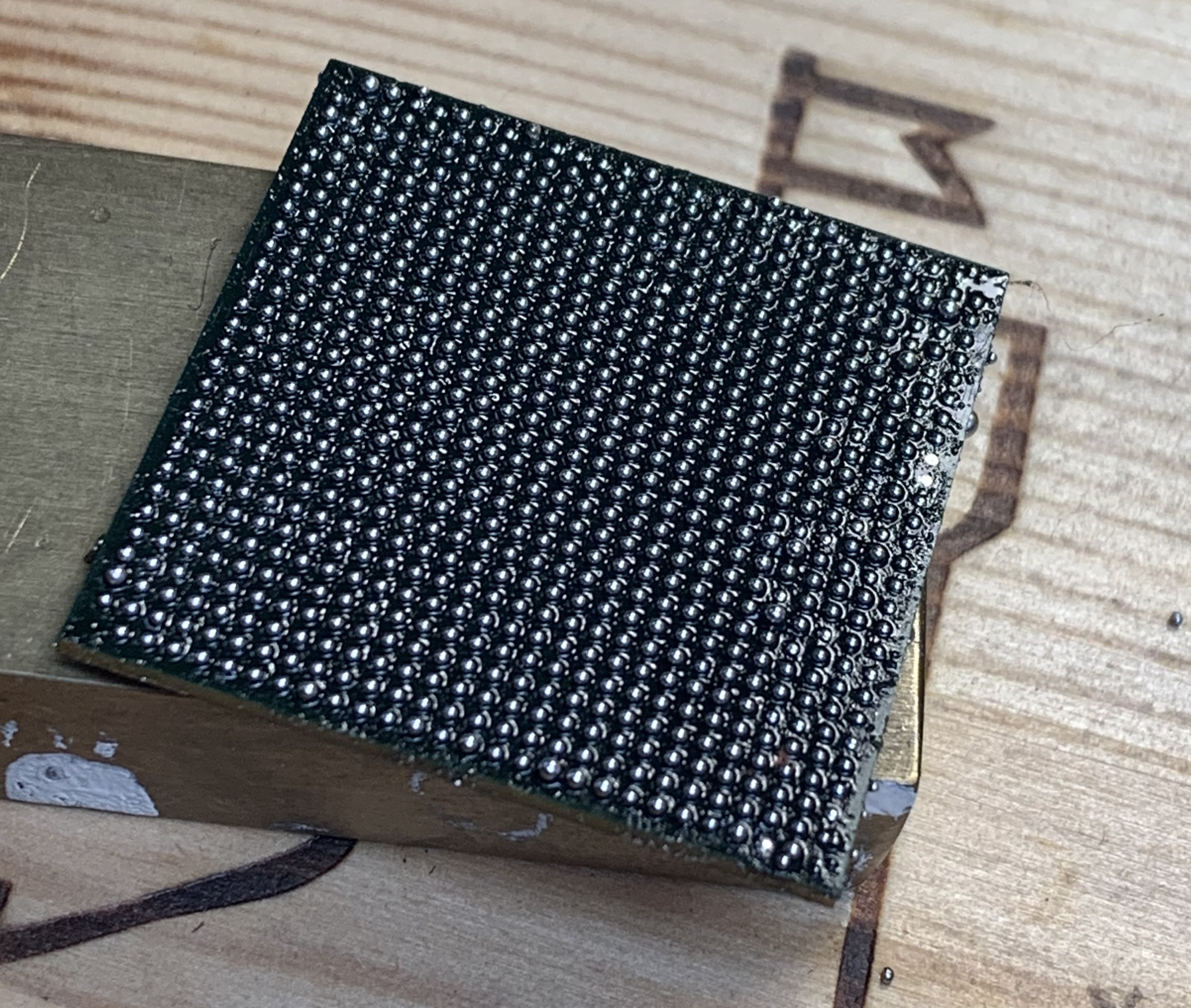

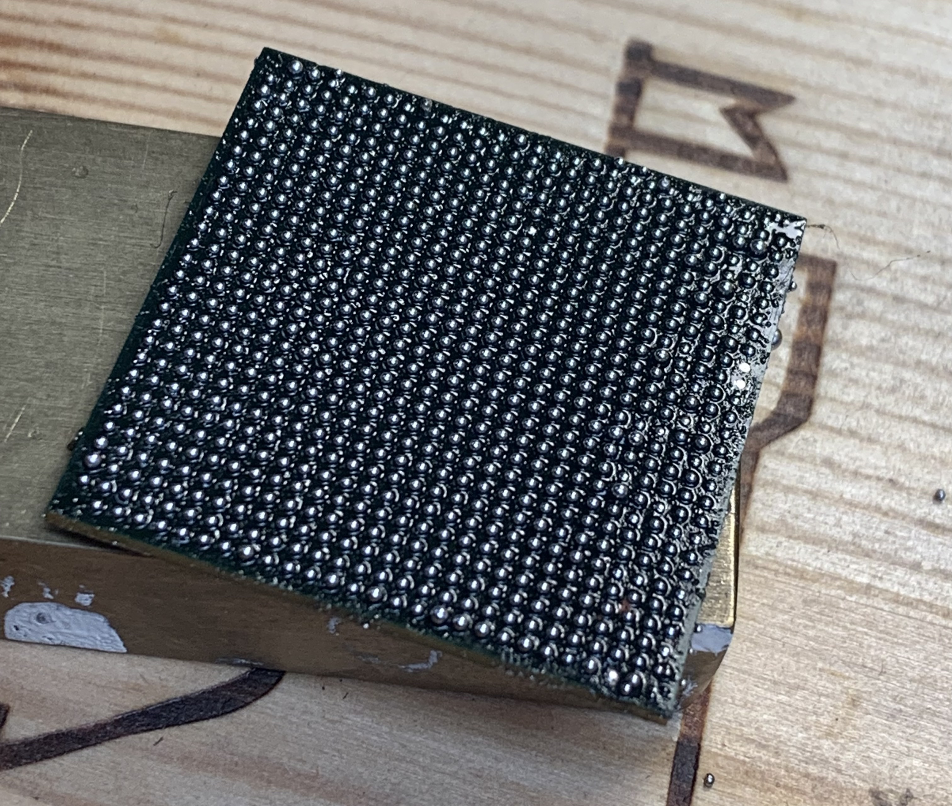

Third thry: this is my last attempt for today and it turned out pretty good. The problem here are the dimensions of the solder balls. They came out like this because I didn't spread the solder paste very well. But instead I understood which technique works better.
View attachment 22714View attachment 22713

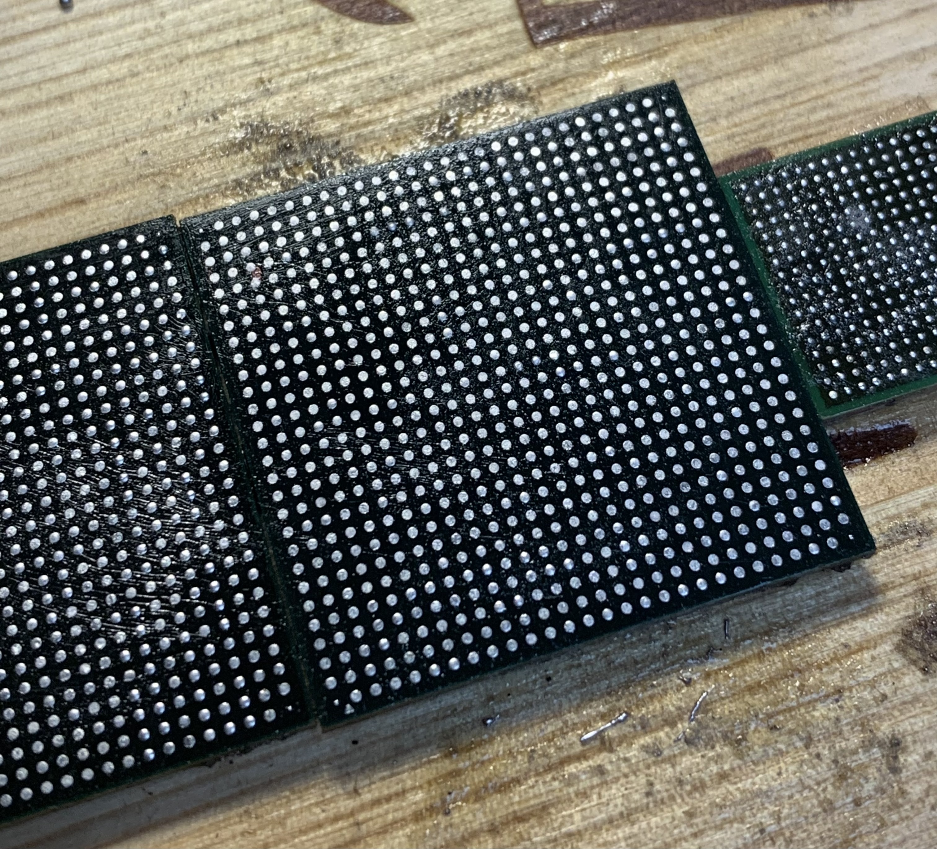

I'm already using a PCB to train reballing. Plus I'm using the components from a dead Wii, so I can practice as muck as I want. In these days I'm trying to change my technique in order to get a perfect reballing at the first try, so after that I can start dealing with the working components and be sure I don't break anything.I don't know if these components are working, but you run the risk of damaging them, you can create a PCB to train the reballing of the spheres. In this link I share my idea for this.
I’m using a heated basa to warm it up from underneath in addition to the hot air gun. Yesterday I managed to successfully remove the working RAM, GPU, and CPU; so it won’t be much longer before i start reballing them.Are you using any heat source to heat the PCB? For a reballing, two heat sources are needed, one on the bottom of the pcb and the other on top of the pcb, so you will need to heat up the chips less and avoid damaging them.
i can not wait to see the resultI’m using a heated basa to warm it up from underneath in addition to the hot air gun. Yesterday I managed to successfully remove the working RAM, GPU, and CPU; so it won’t be much longer before i start reballing them.
