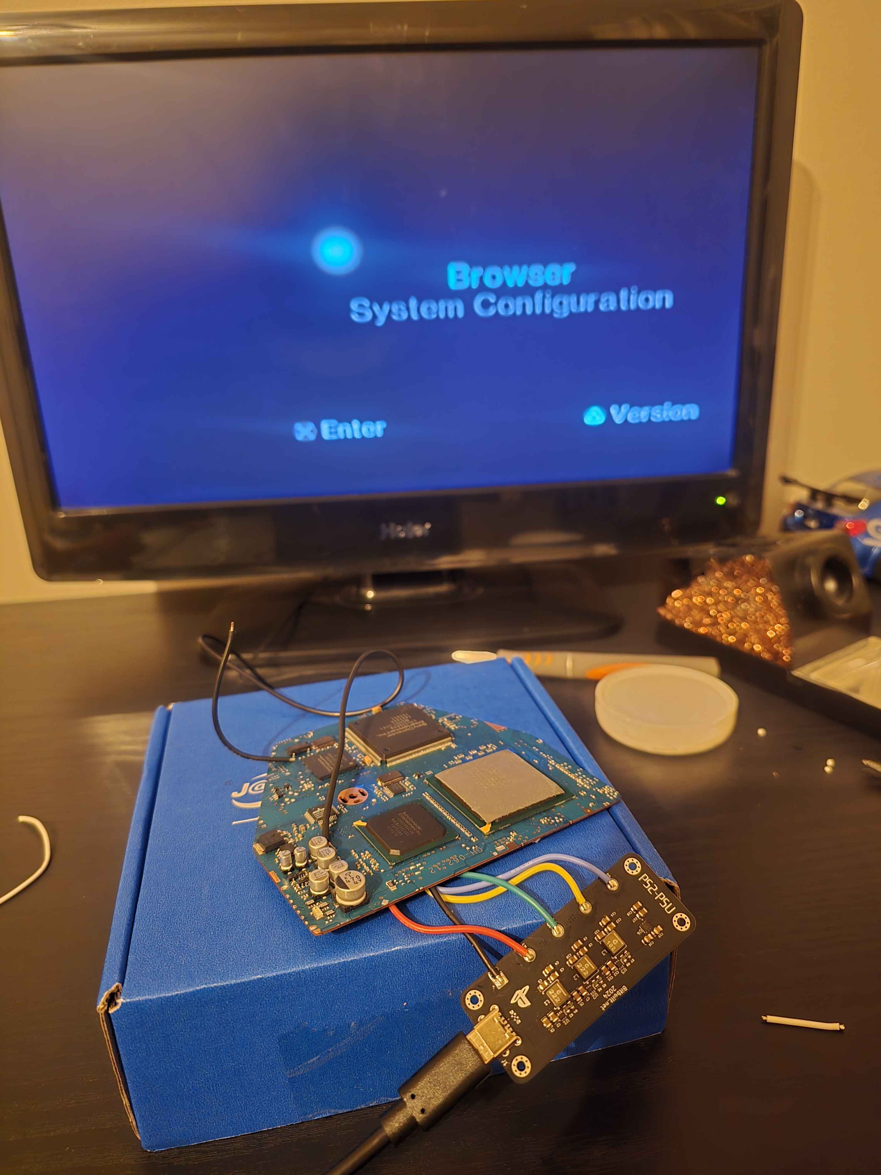

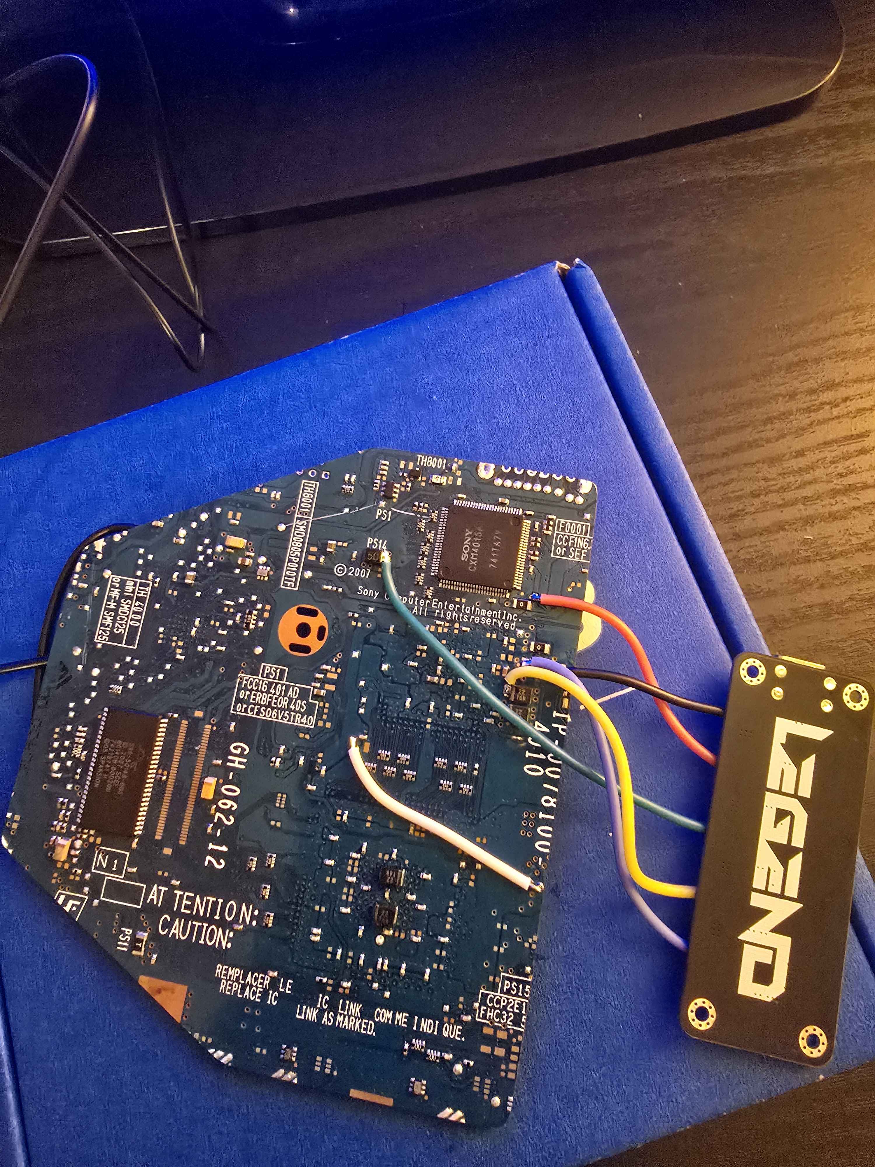

Bit of a breakthrough update:
Lately I havent had much time to work on anything but with the little time I do have, ive been trying to tackle establishing communications with the PS2.
I picked up a TTL to USB adapter and started looking into ppctty.irx as its a module for ppc debugging, however it only has code for TX handling. This meant that I could only read what was coming from the console rather than having the 2 way highway I need with RX as well.
I peaked around and my best resource at the time was an app called ppc monitor which is a full debugging app for deckard ps2's (79k included). The one thing I noticed with ppc monitor is that it uses a .elf and essentially patches the ppc ram everytime its booted in order to execute its code. This was a no go for me as we need to have everything contained to an irx module to keep things as seamless as possible. The code base did however house the RX registers needed for testing.
I hooked everything up and over the course of a few days, tested a multitude of things in hopes to get RX working in the environment I needed, all of which failed. I was doing a lot of echo tests to send a character over to see if the ps2 would echo it back to me, but it never would. On top of that, I was loading the module via XEB+ and it wouldn't stop freezing/ crashing during certain tests.
After all of this, I took a night off and did some more research, and finally revisted it last night with a fresh outlook. I took a stock ppctty module and started working on it again. I mainly ran into roadblocks with freezing again but I eventually figured out it was because of how XEB+ was loading the module so I revisited the plugin I made and was able to get it not to freeze anymore. From there I started doing small tests in steps, and eventually worked my way up to victory lol. I was able to get a stable echo test (and tried to type bitbuilt in the 1 second it was polling lol).
This means I finally have a solid working building block for the transport layer of the eventual goal of a PMS bridge! From here, I have to revisit the XEB+ plugin and find a way to keep it contained to just a plugin, and find a way to load it on boot as right now it can only be loaded after boot by navigating the menu and selecting it. Once I have all of the assets figured out like I showed in my previous posts, I'll run some tests to make sure UART comms can actively change things in real time and run a bunch of tests. Then its evolving it to work with a real MCU. Its gonna take a fair bit of work so I don't get ahead of myself but we'll get there eventually.

Big update!

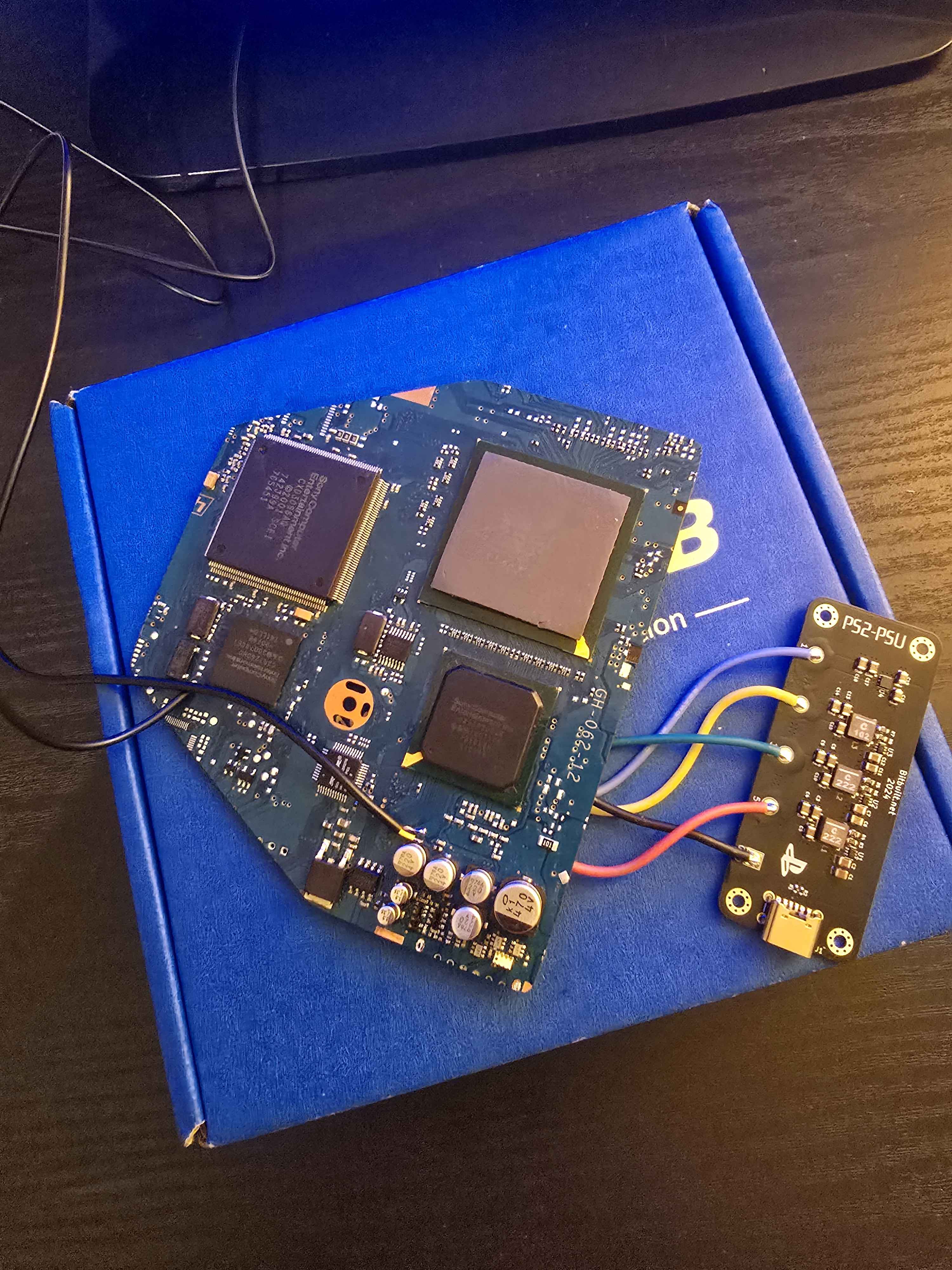

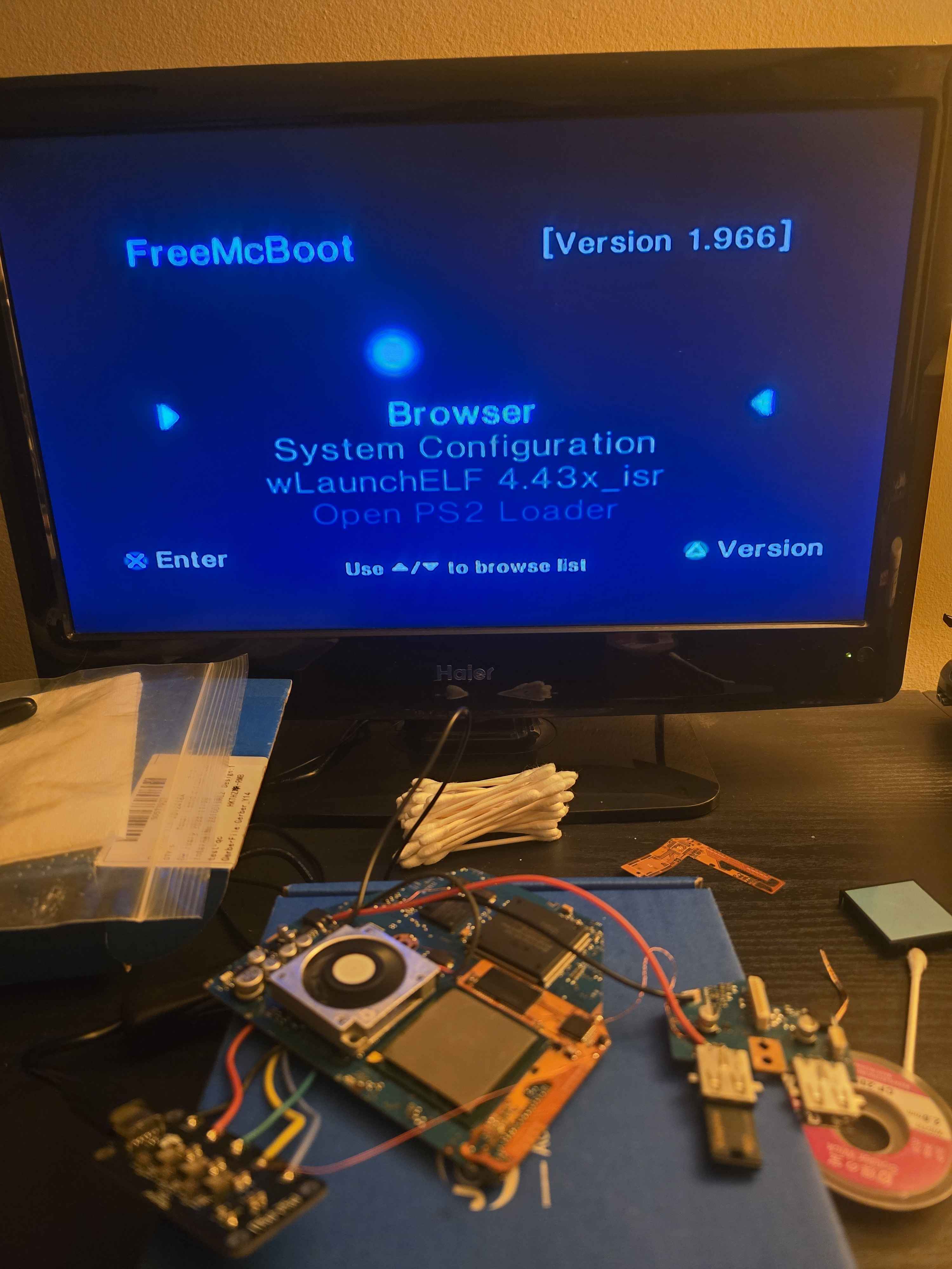

Having made the UART transport layer successfully, I decided to try to put it to the test and see if i could get it working on the PS2.
Now that I am working directly on the PS2 as opposed to using PC2SX like before, I opted to remake the front end plugin showing a battery bar icon, battery percentage, and temp. This wasn't too bad as its really just drawing into the UI using Lua with the difference being that last time I did this, I was modifying the theme files rather than keeping it contained to just the plugin. This time its still technically bleeding into the theme so to speak, but its contained to the plugin. The plugin may clash with different themes other than the default theme but all it would take is just adjusting the position of the bar, percentage, and temp via the lua file which I plan to add instructions for in the code comments for anybody using a different theme. I havent tested it yet with other themes yet but there's already technically a fix for that so im not too concerned. As of right now, I still need to modify the battery icon to add colors, and different levels as it calls on a image based on percentage (0, 25, 50, 75, 100, and charging).
I was able to add all of this and test it manually by adjusting the percentage in XEB+ itself:
Now that I had a front end to test with, next up was trying to get UART actually working to update those values live, which unfortunately proved to not be as trivial as I would have liked. I cant stress enough that even as of writing this, the main issue im still facing is connecting the LUA front end to the backend (this will make more sense soon as to why im still facing this issue).
I started by seeing how I could achieve this directly, but it ended up with me having to create another irx module that the front end connected to, that then connected to the UART module. So it was:
PC > ppctty.irx > backend.irx > XEB+ front end
This kept crashing XEB+ so I tried a multitude of things to get it working and what I ended up doing works, but is not an elegant long term solution. I eventually landed on having to use a middle man essentially by having to read and write to a live cfg file separately. So that way the lua front end connects to the cfg file via backend.irx and reads/ writes values to it, then ppctty.irx accesses the file and reads/ writes over uart.
After getting this working, the issue became uart comms itself. I had it set to take a string such as PCT=90 from the PC to update the battery percentage live, but the issue i had without getting too much into specifics was with the timing and capture window of the bytes being sent. This caused it most times to only catch "C", "=", and "0" separately. I tried to do what I could to make sure the whole string was sent reliably but I opted just to change the protocol to single byte sends for testing and finally got it to work, confirming that this whole project is viable:
I ended up sharing my progress in a PS2 server and had somebody inform me that constantly reading and writing to a cfg file would cause a lot of wear on the NAND, and suggested I write the live state to RDRAM, which is a great idea considering the live cfg file is kind of a dirty way to do this anyway.
I set out to figure this out immediately but have been running into roadblocks. In my tests, ive confirmed that my backend.irx can access the ram no problem but the issue now is how that backend.irx works with the lua front end. The cfg file method was less invasive but unfortunately the ram method wont work the same through the front end. I still have options to try so I will exhaust everything I can before pivoting to something different.
I do have the XEB+ preview source code and could most definitely make something that flows better than what ive been doing, but i have strict rules on what I can do and how (if i do) distribute it, so i really wanted to keep all of this confined to a plugin that is just drag and drop, which ive done a good job of so far. The issue with modifying the source is distribution and upstream compatibility for when XEB+ eventually has its full release.
So the new TODO list is: get ram writes working properly while still staying contained to a plugin and fix the protocol so I can send full strings, as single byte sends will not work for the multitude of different parameters.

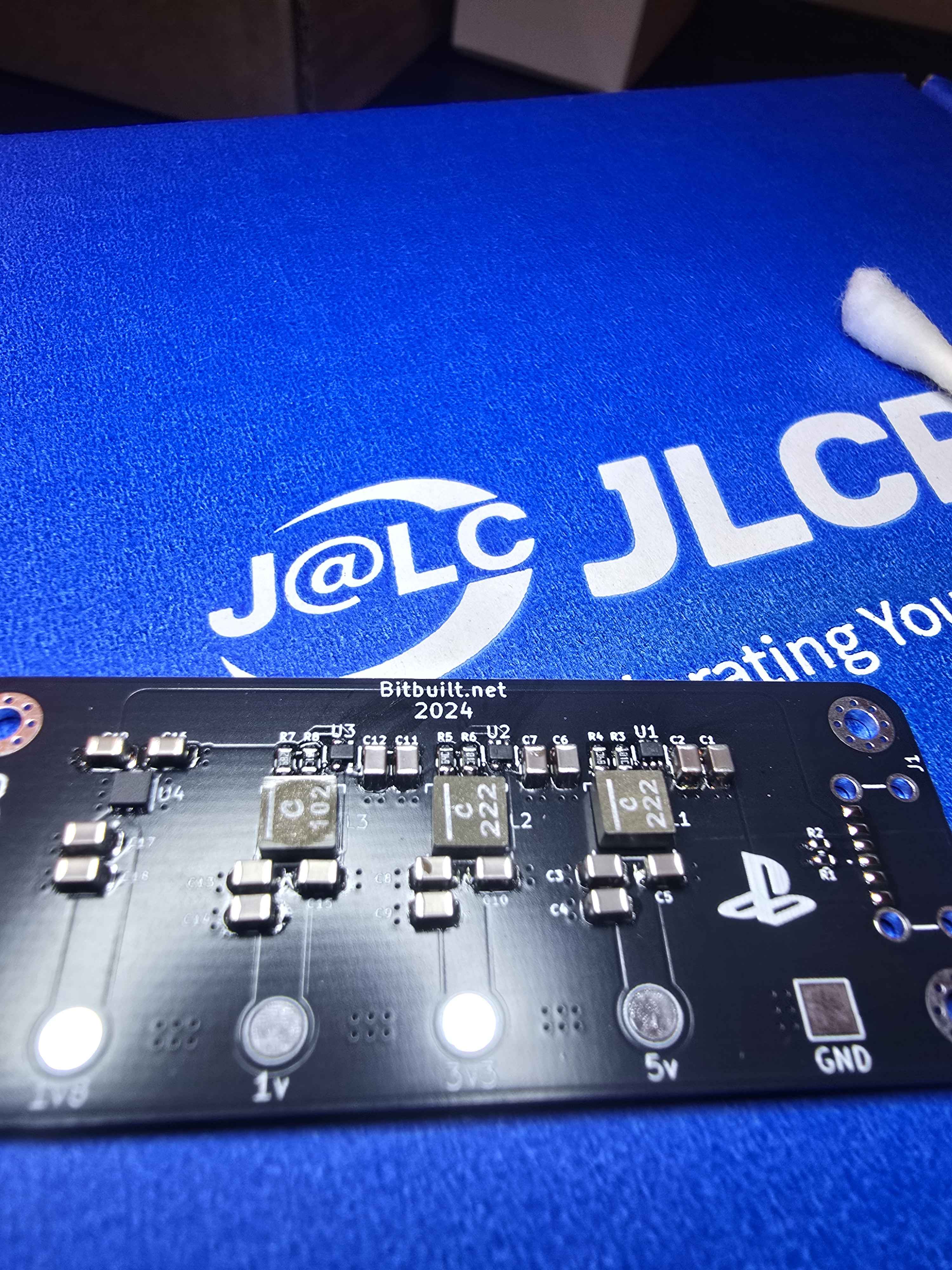

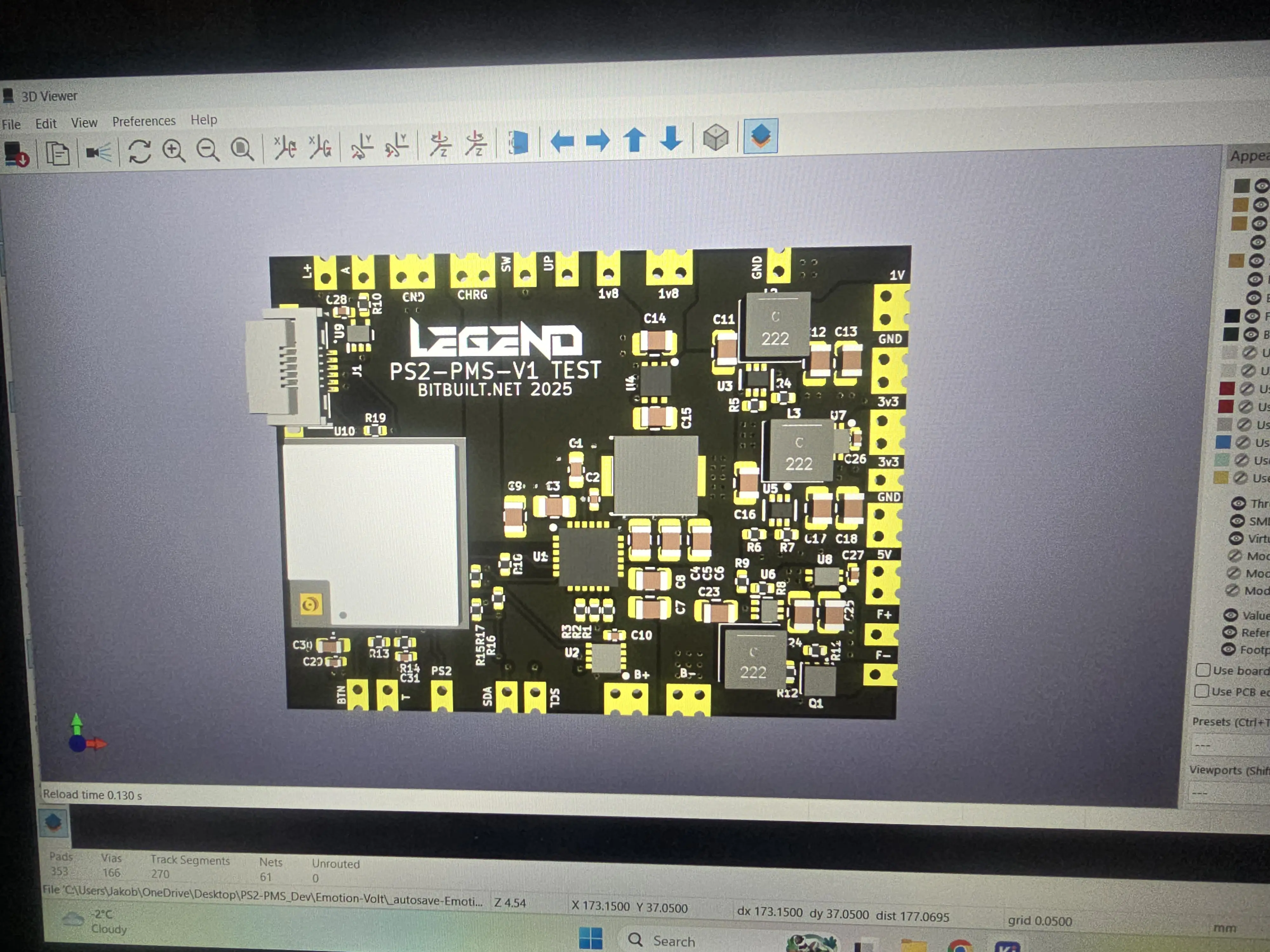

On a separate side note, the new PMS will use a ATtiny16 as its brains, so I ordered a dev board and UPDI programmer for when I can get everything working so we can move from the PC to a more live test.
That is all for now! Thanks for reading!

Next up was getting a MCU connected to the PS2 directly as opposed to using the ttl to usb adapter that you've seen in previous tests. The idea was just to test running through the battery percentage values sequentially to verify functionality, and it was giving me a little trouble as using the AVR code directly as opposed to something like arduino or platformIO is foreign to me lol, but I got it working!
After getting this all working, I started thinking about the capabilities of the ATTiny1616 and came to the realization that I dont think it'll be enough for what I want to do. It certainly would be if I was good with optimization and keeping everything minimal but im not good at that yet so I think I may move to something like the ATTiny3217 for more breathing room. It seems like the best choice for what im doing right now and it gives me the ability to create a more robust bootloader without having to worry about maxing out a 16kb flash. The extra IO are a plus as well.
I have some things ordered to perform more testing but once I can get some of this stuff working, I'll then focus on creating the PMS itself, ordering it, and testing each "block" of it in steps to ensure we have a good working product! In the meantime, I need to clean up the UI and add some things so it all flows together nicely.
