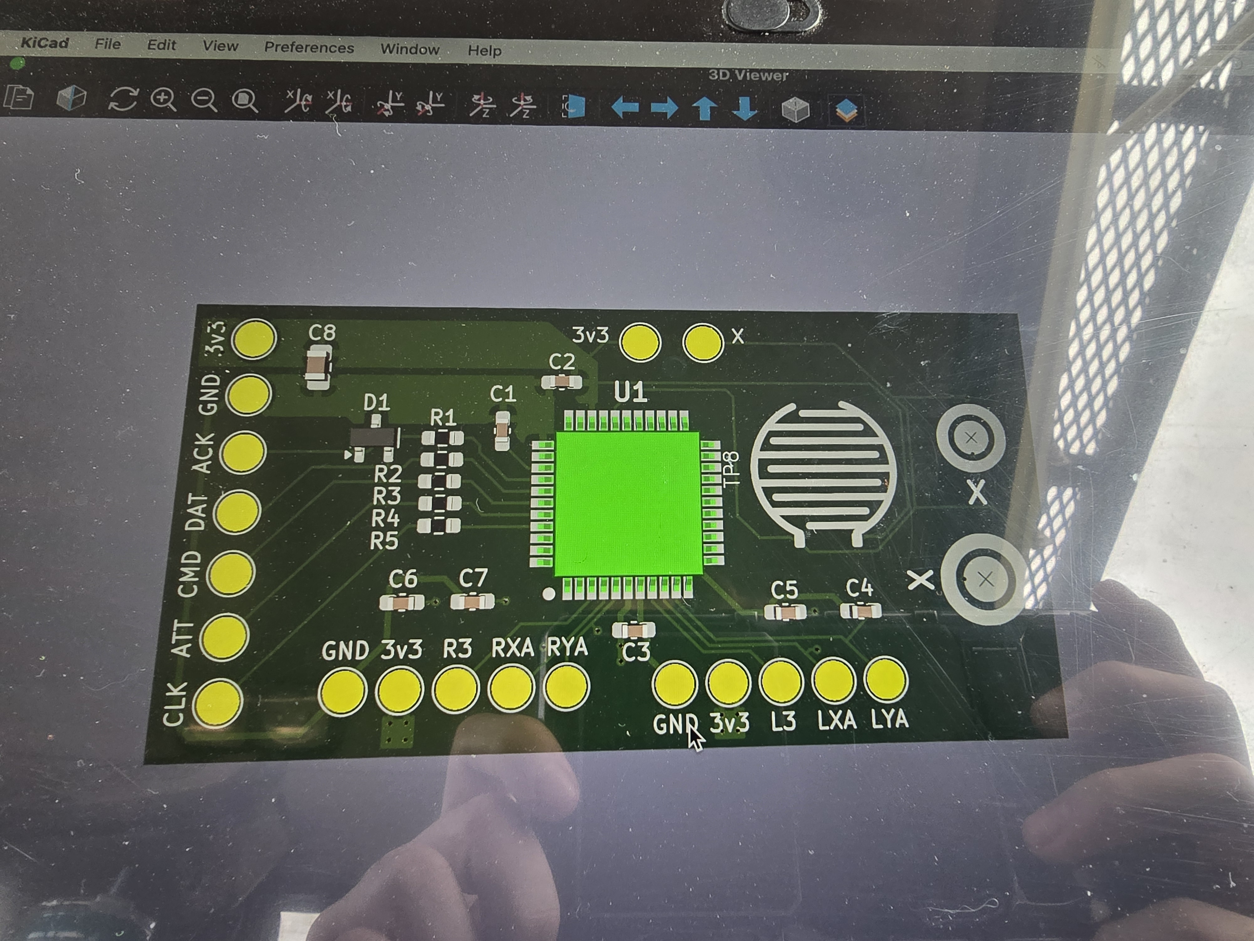

After finishing the pinout of the SD731A, I designed a quick and dirty test board that had different types of contacts (clicky and membrane) all for the X button so I could test it. I also included connections for the switch style joysticks that were converted to analog sticks to try them out.
I had made a few mistakes that I'll get into after but this is why we make test boards lol. I have the big contact for testing membrane buttons and the 2 smaller contacts to test dome switches similar to the 3DS or Switch.

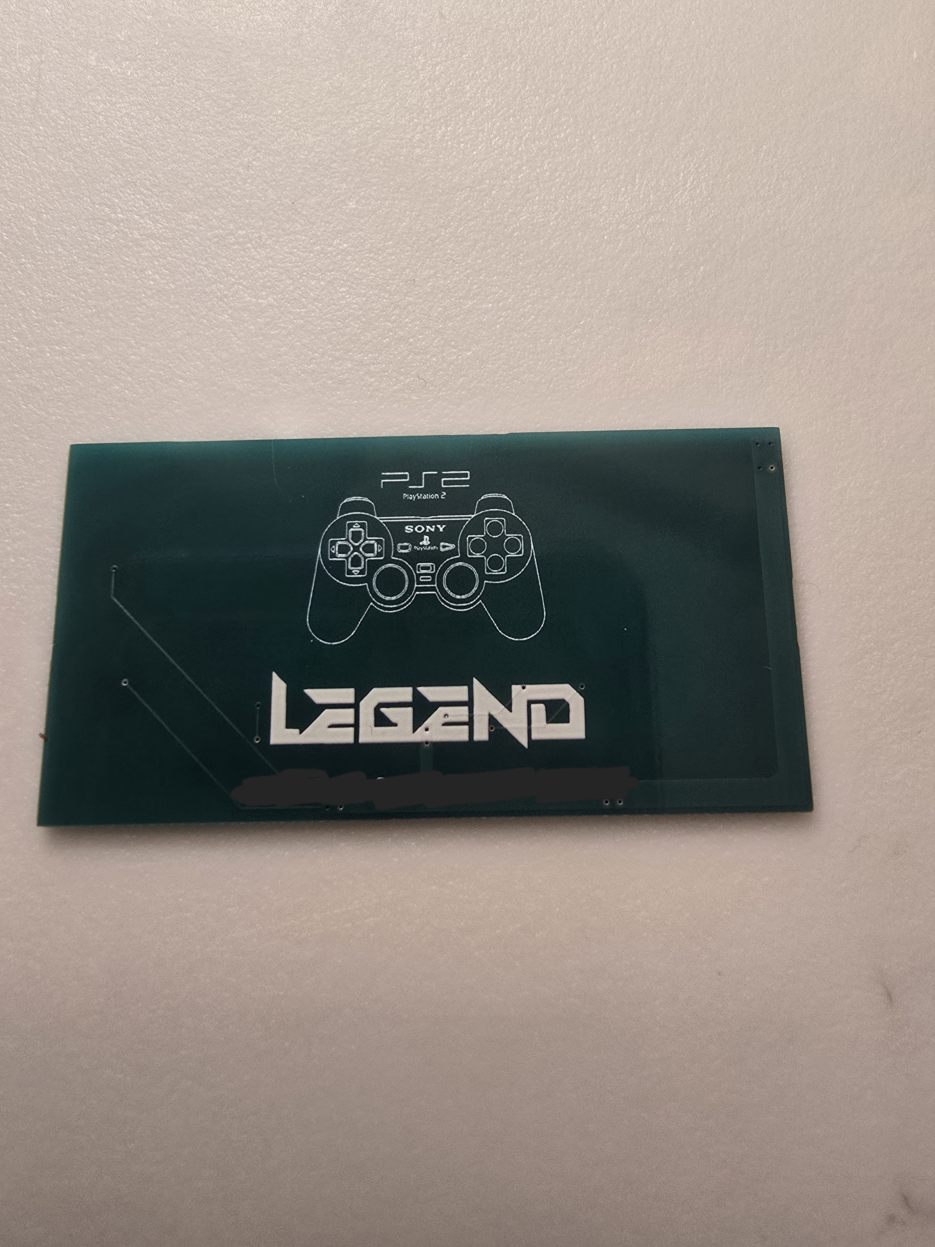

So i ordered everything and waited, and when it all finally came in, I assembled the board and had a chance to test it this past weekend. JLC also did a really good job with the logos as I've heard they can be a hit or miss

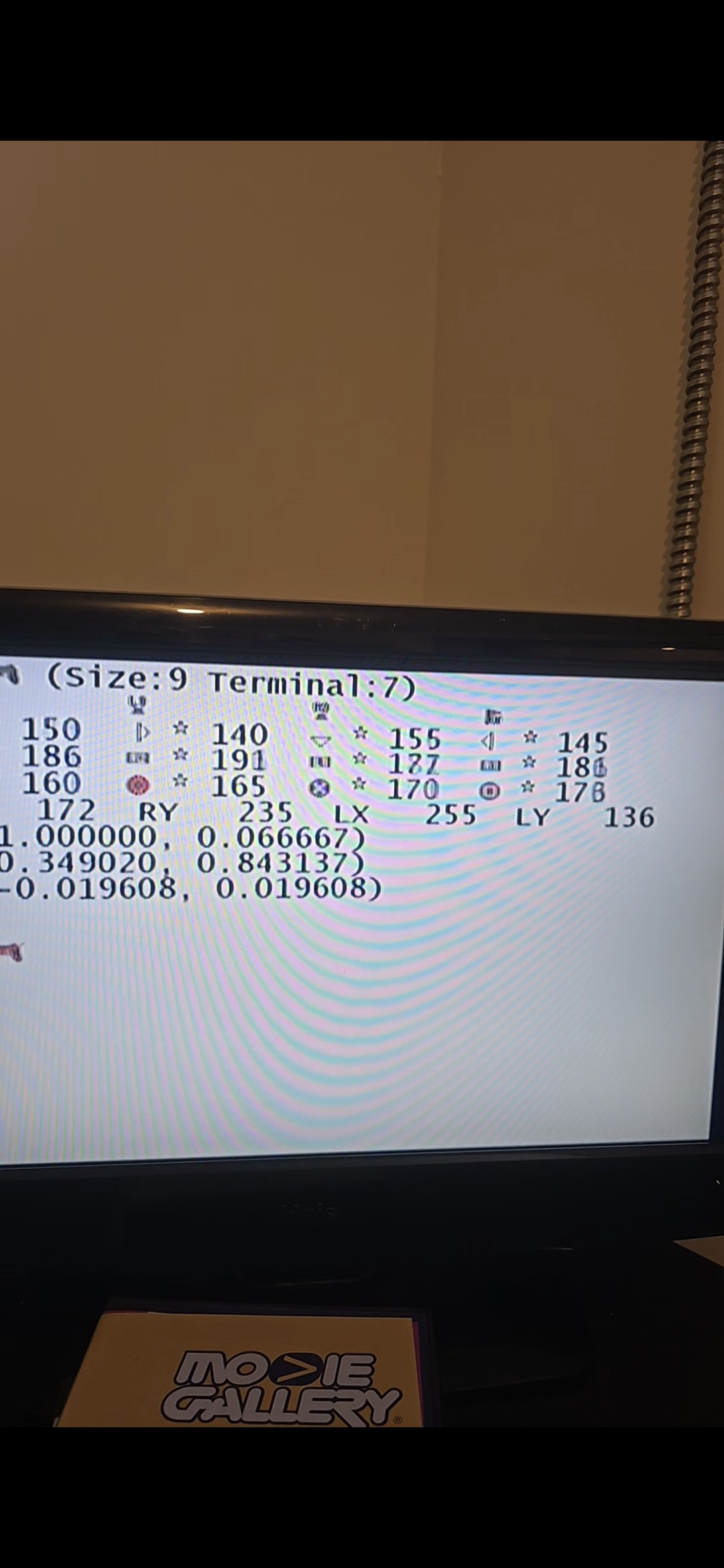

After assembling the board, I was excited to test it out but upon plugging it in, the gamepad tester on the PS2 was showing it freaking out so I hit my first roadblock.
After messing with it for a bit I was concerned that maybe the decoupling Caps were causing my issue, namely the fact that I replaced the electrolytic cap with a ceramic, so I put the original one on and was still having the same issue. After some more head scratching for a bit, I thought that I had maybe fried the chip with heat when taking it off the original board. I searched around and found out that the "extra random button" on the original button film was actually a (7k - 10k) resistor that needed to be connected to 3v3, so I bodged a 10k resistor and that calmed the inputs down. I was once again excited but upon trying my button connections, I wasn't getting any input at all.
I spent a few more hours scratching my head and searching around. I went as far back as modretro and even the benheck forums as I figured the resistor on every button thing was my issue. I found some info that said each button needs a 20k - 27k resistor on it so I hooked up a 20k resistor in many different orientations and still got nothing, so it was back to searching.
A few more hours later I was doing some laundry and thinking about my issue and it dawned on me. I had designed my board without the resistor I was missing in mind because of the way everything was connected. I thought that the buttons common was 3v3 with the way everything was connected on the original board, and I was confused at some of the button diagrams online as Start, Select, and Analog had a different common than the rest of the buttons but to me it looked like everything was connected to 3v3 (not having that resistor in mind initially).
I ended up figuring it out. Start, Select, and Analog use regular ol 3v3 as their common, and the rest of the buttons use the resistor (or pin 11 on the SD731A) as their common. My issue was that I had everything connected to 3v3. So I bodged a wire between the resistor and pin 11 of the chip and got some input finally!

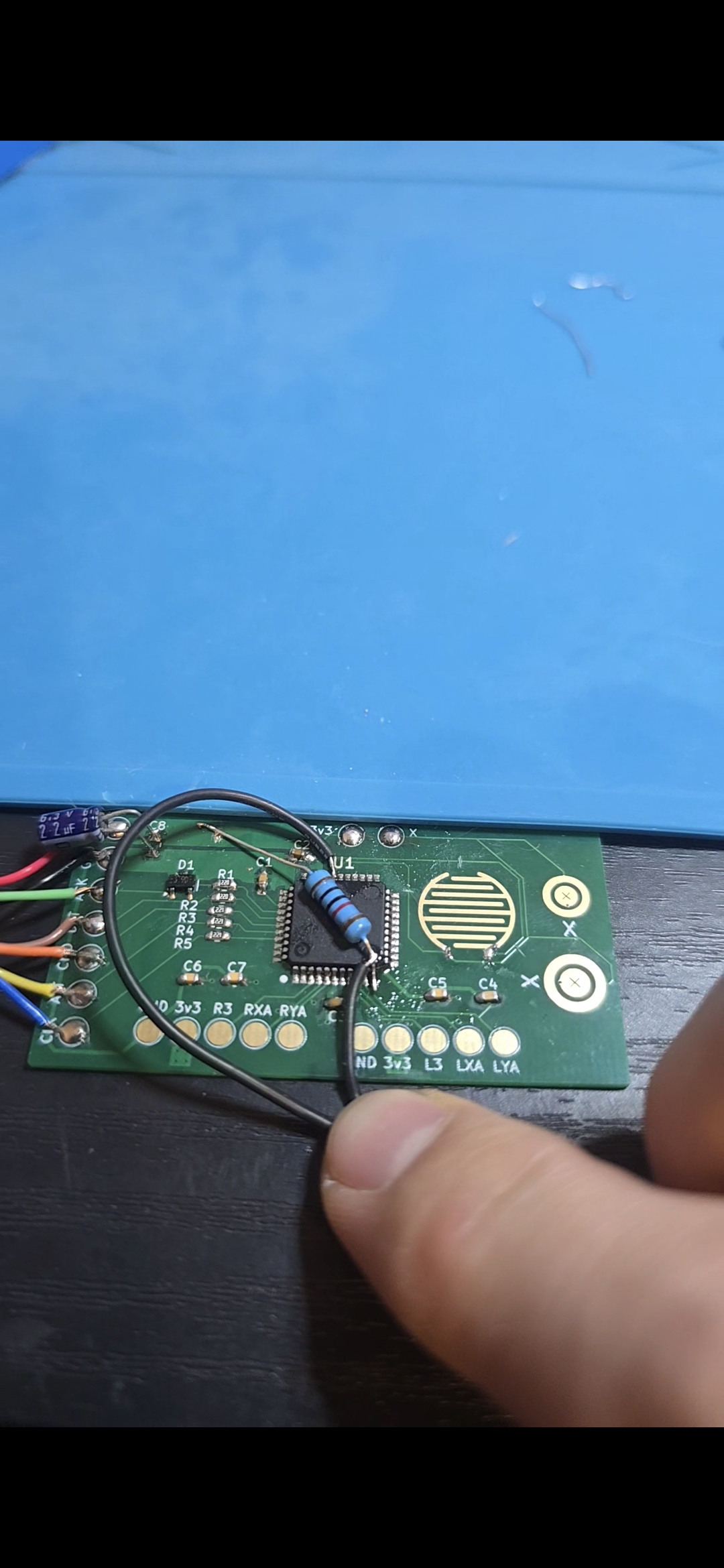

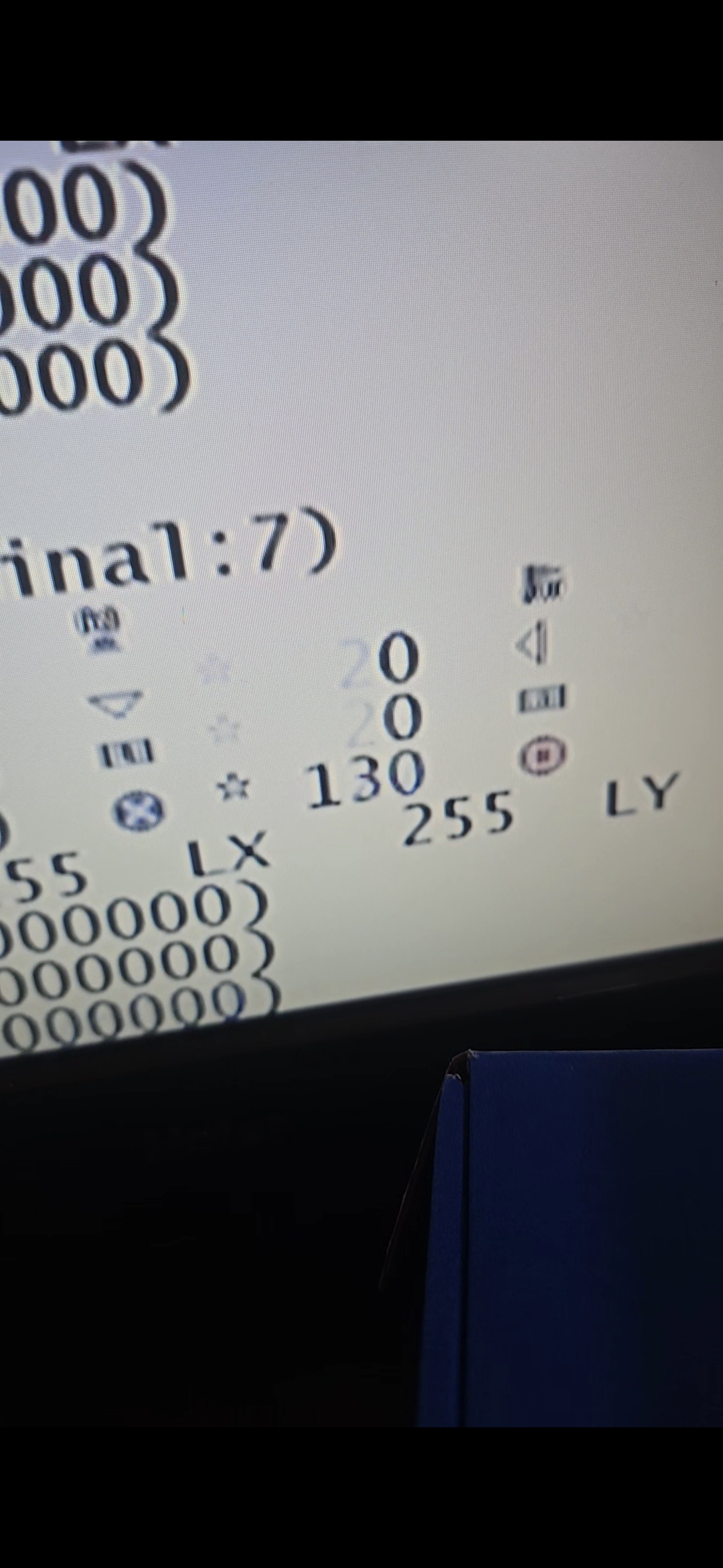

My boards contacts seemed to have been noisy and was registering random button presses as I was trying things so I initially put a small piece of velostat between 2 wires instead of using the pads and was getting the pressure sensitive inputs I was looking for.
After this, I really wanted to try the pads as I wasn't getting a consistent output without noise using the bare wires, so I connected one of my other boards to the input wires and was able to try it without the noise and everything worked perfectly! I was getting no noise and perfect input from 0 to 255 depending on how hard it pressed.
I also figured out that the sensitivity of the button presses can be adjusted via the value of the resistor connected between pin 11 of the chip and 3v3 but everything seemed to have worked great so I don't think I'll need adjustment. I'm also realizing that the noise was present because I was using my bare finger, so I didn't need to use my separate board but I'll still have a gnd plane in the final revision etc.

First I kept a 10k resistor between pin 11 and common and put a 20k between the button contacts and while it worked. The sensitivity was too high so even the lightest press was registering around 220 on the gamepad tester, and that's too close to 255 so that was a no go. I was trying to achieve at least around 60, if not a lower number by the time the dome switch had clicked.
I then hooked up a 10k potentiometer between pin 11 and common to try different resistances as I went and while it worked out fine, I could not find a sweet spot without having to press too hard to get to 255. We don't want to have to put 20 screws in our custom boards in order to be able to achieve a pressure sensitivity lol, so I focused my attention to the resistor between the button contacts.
I ended up finding a potentiometer that went to about 20k ohms so after messing around with both resistances, I ended up finding what seems like a good sweet spot so that we have a range of near 0 to 255 when pressed without pressing too hard:
- 8.6k ohm Resistor between pin 11 and 3v3
- 17.6k ohm Resistor between button contacts
The resistances could probably use even more dialing in, and I'm sure it's maybe going to be different for each button and on a case to case basis, but that seemed to work with my one button on my specific setup, so take those resistances with a grain of salt but know that they are needed.
