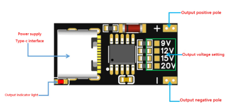

Once configured to the 9V setting, I recommend probing the output to make sure you are getting 9v (while wired to a proper 9V capable PD power adapter, of course). Once ready, set aside the PD board, and remove the DC power input barrel jack on the PS2 board. I recommend using a hot air gun in this step. Once removed, cut two ~2-3" (cut more than you need, not less) 22 AWG wires. These will connect the output of the PD board to the input of where the barrel connector once was. Simply connect the corresponding terminals (Positive to Positive, Negative to Negative). The central hole is positive, it's seperated by the ground polygon around it. The other 2 holes are ground, simply choose one to wire to.
You should now have a PS2 with USB-C input! You can test boot in this step by connecting it to a USB PD charger and turning it on (via the repurposed lid switch).

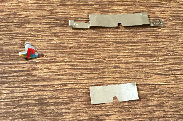

Once removed, trim the retainer bracket to 20mm or less as shown above. Insert the PS2 logo piece into the whole on the front of the top case (oriented horizontally). Once it's pushed in all the way, insert the metal retainer into the slot on the inside of the case, behind the hole. Make sure it is fully inserted! Once in, you can add a small dap of CA/Super glue onto it to secure it in place. You should now be left with a swivling PS2 logo (for free)!

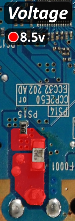

Is there anyway you can share a bit more info or photos on where you’re connecting the usb-c board to the PS2 mobo? I guess the red sections on image are throwing me off a bit
I printed the bottom part of the shell (doing this project too), and I had soldered to the bottom of the motherboard. This is not advised, but can work using 22AWG. I used some thicker stuff which isn't as flexible. I'd maybe recommend doing it from the top of the board honestly.
If you mean the pads, the center one is positive. The two outer ones are both ground, solder to either.

I've encountered only a minor issue, with noisy video if using HW-398 PD USB-C.
Suspecting an issue in the USB charger / cable, which one did you use? Any specifics?
Thanks again!
Hey, I'm having the exact same issue (pretty bad video noise using usb-c.) Did you ever manage to figure out what the issue is or how to fix it? Cheers
Hi @Mrak408 , thanks for this fantastic project!
Thanks again!
I can't say for sure, but my first guess would be that it's caused by the PD board having no filtering caps. Back when we would use PTH regulators on the Wii and Gamecube, video noise was one of the things that could happen if the input and output lines weren't properly filtered.
Try adding a 15v 100uf electrolytic capacitor between the positive and negative output pads on the PD module. If it's that same kind of output noise, it should resolve.
Be sure to pay attention to the capacitor's polarity btw. Electrolytic caps have a positive leg and a negative leg and mixing them up will make the cap burst or catch fire.
Would you be open to recording and sending a video clip? I don't remember ever having this problem on my unit.
Hey, thanks for all the info. I added a 1000uf 16v capacitor between output and ground pads on the PD trigger board, and unfortunately, it made no difference. The interference/noise remained exactly as it was.
Hey, yep I can do that. I'll come back to you once done, many thanks.
Damn. That's all I can think of atm

Based on this thread and other posts I take that the console runs on 9V 3A with the chargers recommended. Seeing that the original powersupply delivers 8.5V 5A, has anybody seen that playing on 9V 3A has caused any issues? Maybe with demanding games? Even though I understand that without the disk drive the console consumes less power, I am surprised that 3A are enough.
Currently working on my making my own PS2 UltraSlim Fusion and wanting to make sure that I have a good enough charger ready to supply my console with:)
Hi together,
The official power supplies are overspecced for longevity and to ensure there's no voltage drop. The Original PS2 was kinda thirsty, but the slims barely touch half of the max 5A current
