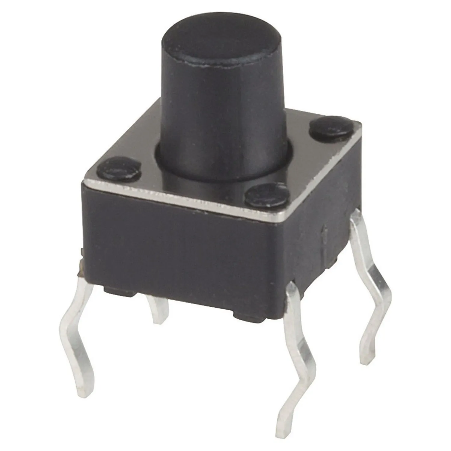

1) Purchase a taller tact switch similar to this:
2) Mount it to the bottom of the case with a little bit of glue in the same location that the lid switch would be.
3) Solder one leg of the tact to GND and the other to the Reset pad as shown in Tito's video.

A momentary switch off of Amazon should work the same not 100% positive I ordered so I’m gonna try it out when they get here

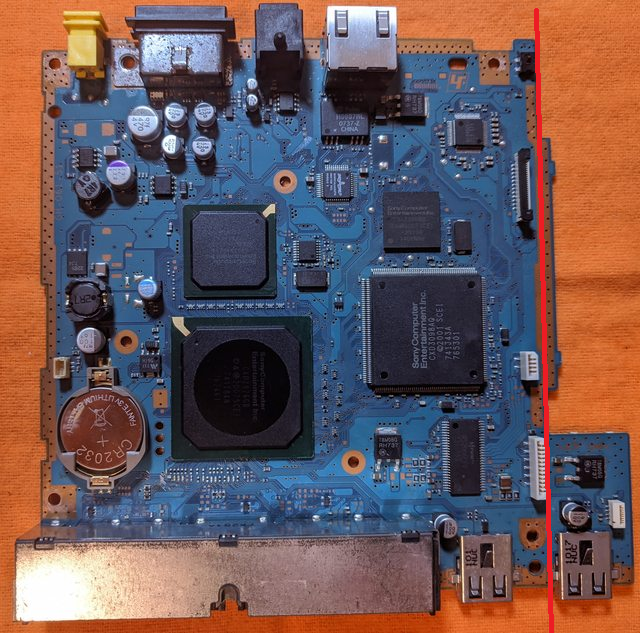

Seems that I got a SCPH-79004 with a GH-061 motherboard, it's slighty larger than the GH-062 found in other 79K consoles.
Got some components in different places, will take some photos myself of the bottom later but are these safe to just trim down so they fit the Ultra Slim case?
You should have no issues trimming along the same edge, you may want to send pics of the back of the board just to make sure the 5v reg for the USB isn't in the way.

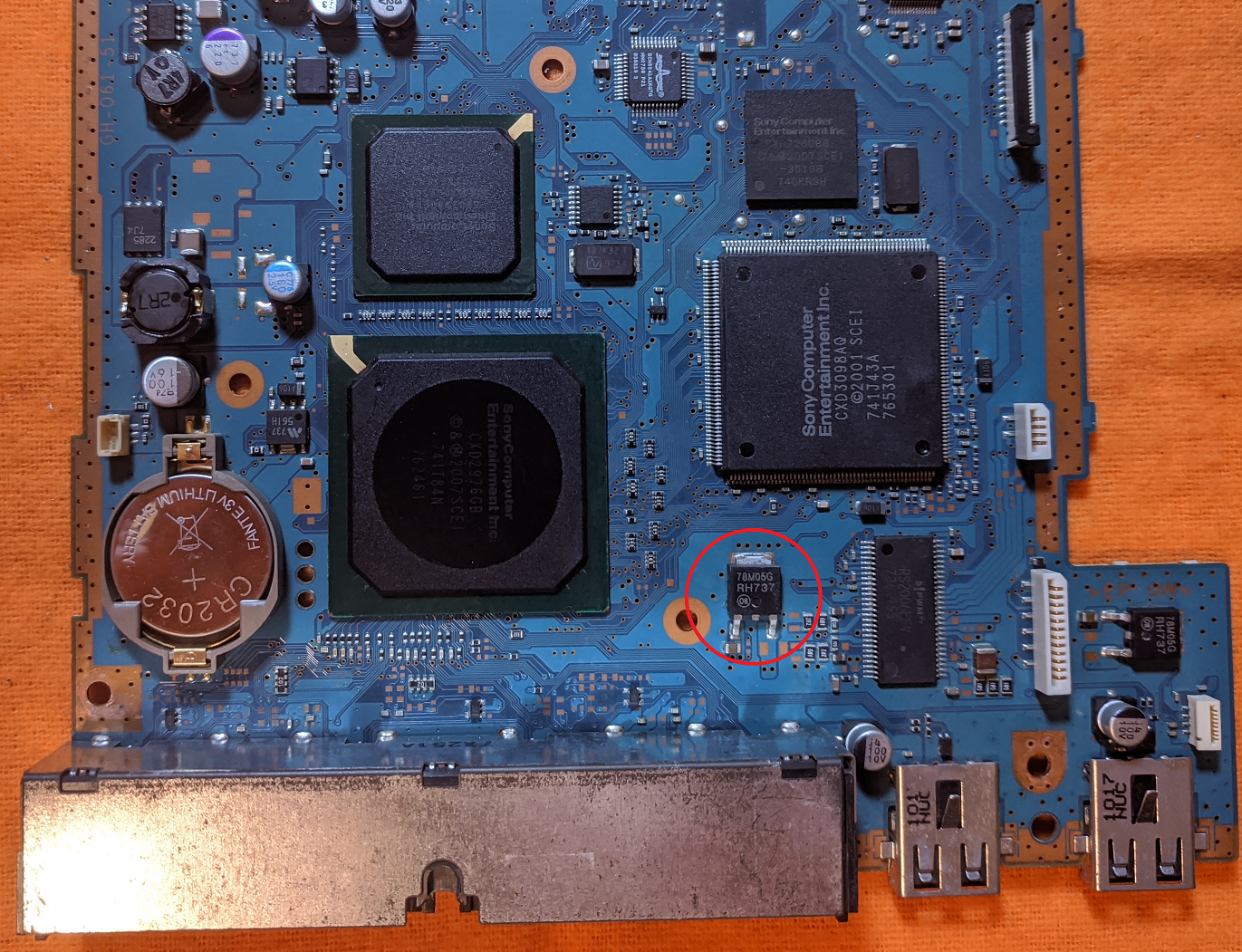

[EDIT]
Doing some further checks it looks like there's nothing on the underside. Seems like the other regulator for the 5v USB may be this one here:
Although be sure to check with a multimeter, it's possible you might not need to rewire power to the USB port on this motherboard after trimming.

[EDIT]
I believe you are right, should be a pretty easy trim, here is a photo of the back anyways to double check if all things are fine.
Will check with a multimeter to make sure also.
